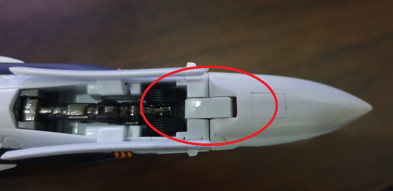

Rein+ Posted June 11, 2021 Posted June 11, 2021 So... anyone has any idea to disassemble nose joint of VF-25 ? i found someone that willing to part with his Vf-25s and he said the nose joint is cracked. i want to know if the joint can disassemble and whether it can be fix .
no3Ljm Posted June 11, 2021 Posted June 11, 2021 (edited) 12 hours ago, Rein+ said: So... anyone has any idea to disassemble nose joint of VF-25 ? i found someone that willing to part with his Vf-25s and he said the nose joint is cracked. i want to know if the joint can disassemble and whether it can be fix . I have a feeling that the box shape on the right beside the circled area is the screw cover. Also here's the Shapeways link to @ChaoticYeti's Hip Replacement joint in case you don't have one yet. https://www.shapeways.com/product/P3NMXGCSY/v2-messiah-cracked-hips-replacement My bad. Apologies on my reply. I thought it was the hip. But still, I think the screw cover is that box shape on the right. And to remove the pin, you have to use 'Roll Pin Punches'. Good luck. Edited June 12, 2021 by no3Ljm

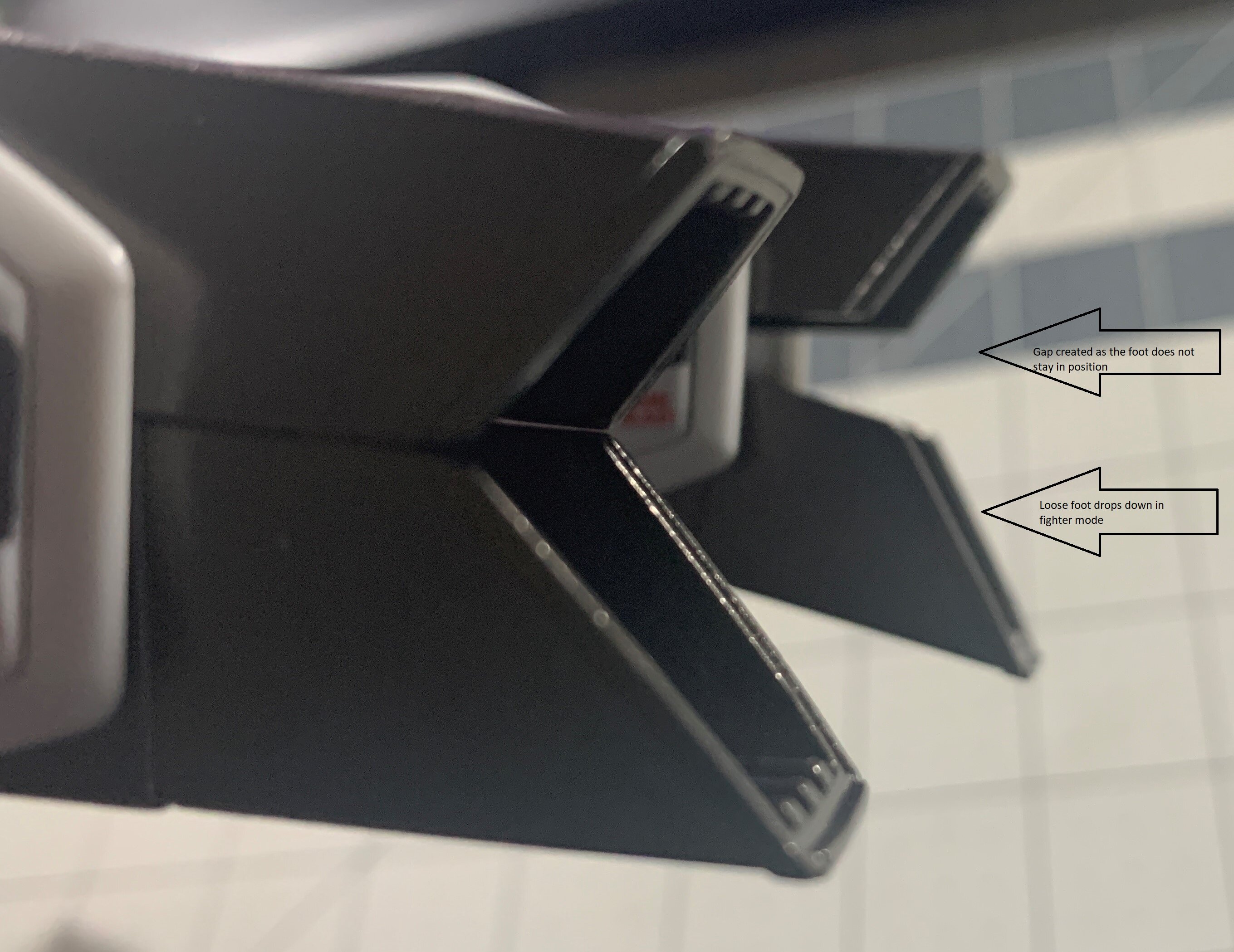

Marauder Posted August 31, 2021 Posted August 31, 2021 Hi Everyone, I have a rather unusual issue with my recently acquired VF-1 DX toy. One of the foot is loose, does not hold its position. It drops a when its in it is in closed position in fighter mode. Has anyone ever had this issue? Any thoughts or any ways to fix it are appreciated as I have not seen any posts with a DX toy having this trouble. PS: I tried to look through options if I could somehow open the foot area and tighten it but everything seems to be glued on and I dont see any screws. Does anyone know if something needs to be tightened or how I can go about it?. Thank you.
no3Ljm Posted August 31, 2021 Posted August 31, 2021 17 hours ago, Marauder said: Hi Everyone, I have a rather unusual issue with my recently acquired VF-1 DX toy. One of the foot is loose, does not hold its position. It drops a when its in it is in closed position in fighter mode. Has anyone ever had this issue? Any thoughts or any ways to fix it are appreciated as I have not seen any posts with a DX toy having this trouble. PS: I tried to look through options if I could somehow open the foot area and tighten it but everything seems to be glued on and I dont see any screws. Does anyone know if something needs to be tightened or how I can go about it?. Thank you. Sorry to hear about this problem, @Marauder. Not sure if it can be fixed since most Bandai DX figures are kind of hard to fix it afterwards. Mostly they are glued as what you mentioned. Is it bought new or used? Quick question though. When the feet are opened, say in Gerwalk/Battroid mode, is the foot loose or it holds correctly not wobbly or anything and just go back on becoming loose when it goes back to Fighter mode?
Marauder Posted August 31, 2021 Posted August 31, 2021 23 minutes ago, no3Ljm said: Sorry to hear about this problem, @Marauder. Not sure if it can be fixed since most Bandai DX figures are kind of hard to fix it afterwards. Mostly they are glued as what you mentioned. Is it bought new or used? Quick question though. When the feet are opened, say in Gerwalk/Battroid mode, is the foot loose or it holds correctly not wobbly or anything and just go back on becoming loose when it goes back to Fighter mode? Thanks for your reply @no3Ljm. To your question, I did get this used recently. When the feet are opened all the way in Gerwalk/battroid modes, the foot locks perfectly without any issues, but it goes back to becoming super loose when they are retracted in the Fighter mode . I have been trying to find any internal structure pics/blueprint or any disassembly guide over the internet but have had no luck. I would like to see what is inside before I attempt a foot surgery for the VF-1. But no one seems to have issues with their VF-1 DX's.
no3Ljm Posted August 31, 2021 Posted August 31, 2021 3 minutes ago, Marauder said: Thanks for your reply @no3Ljm. To your question, I did get this used recently. When the feet are opened all the way in Gerwalk/battroid modes, the foot locks perfectly without any issues, but it goes back to becoming super loose when they are retracted in the Fighter mode . I have been trying to find any internal structure pics/blueprint or any disassembly guide over the internet but have had no luck. I would like to see what is inside before I attempt a foot surgery for the VF-1. But no one seems to have issues with their VF-1 DX's. I see. I'll try to check mine tonight and see what it does to the feet in fighter mode and why it becomes loose. I'm not going to pry open mine. But it's more of see what I can find approach and guess from there.
Marauder Posted August 31, 2021 Posted August 31, 2021 8 minutes ago, no3Ljm said: I see. I'll try to check mine tonight and see what it does to the feet in fighter mode and why it becomes loose. I'm not going to pry open mine. But it's more of see what I can find approach and guess from there. Thank you
Sanity is Optional Posted August 31, 2021 Posted August 31, 2021 Could always try the superglue trick, or kiki's "fix loose joints".
Marauder Posted August 31, 2021 Posted August 31, 2021 1 hour ago, Sanity is Optional said: Could always try the superglue trick, or kiki's "fix loose joints". Thanks @Sanity is Optional I didn't even know these options exist. Super Glue: I looked up some videos on the 'Super Glue' technique and because the access to the joint is so narrow I am worried that I might screw it up while applying the glue. Kiki's joint: I found it on Amazon and the reviews seem to be good. I also found @sqidds thread on it and looks promising as well. I am wondering if anyone has any experience with metal joints. All reviews on amazon seem to be for Transformer/Gijoe toys that to me look like they have plastic joints. Thanks again
Slave IV Posted August 31, 2021 Posted August 31, 2021 29 minutes ago, Marauder said: Thanks @Sanity is Optional I didn't even know these options exist. Super Glue: I looked up some videos on the 'Super Glue' technique and because the access to the joint is so narrow I am worried that I might screw it up while applying the glue. Kiki's joint: I found it on Amazon and the reviews seem to be good. I also found @sqidds thread on it and looks promising as well. I am wondering if anyone has any experience with metal joints. All reviews on amazon seem to be for Transformer/Gijoe toys that to me look like they have plastic joints. Thanks again I've used Future Floor polish on metal joints and it works great. Should all be similar stuff and is just an acrylic based coating and it is really good with capillary action to coat joints in tough to reach places. Kiki's comes with an applicator tip but if you use another product, just use a toothpick to drip the fluid as close to the joint as possible and then move it all around to coat it. Then leave it alone for at least a day to dry and repeat if necessary.
