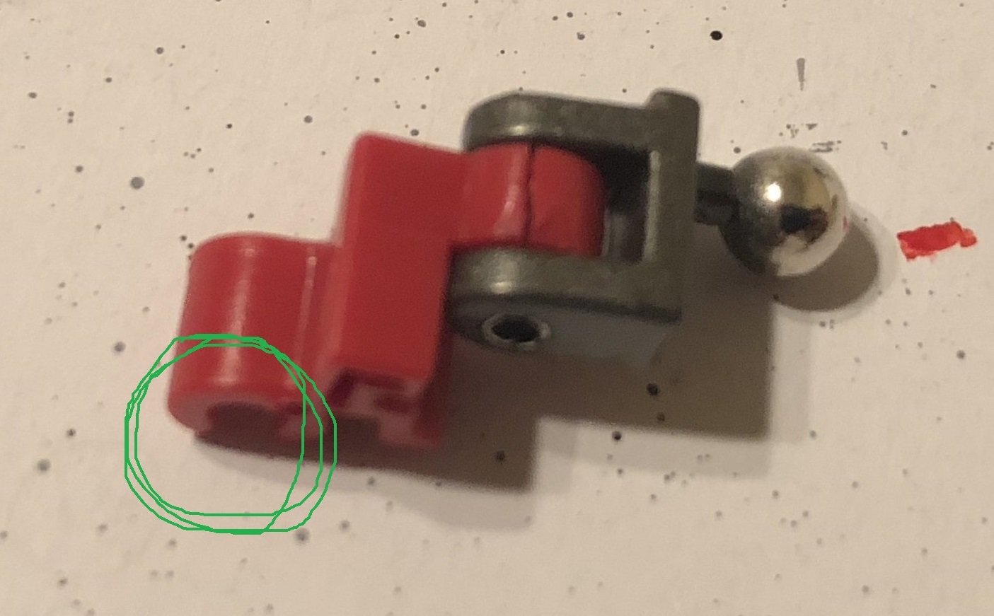

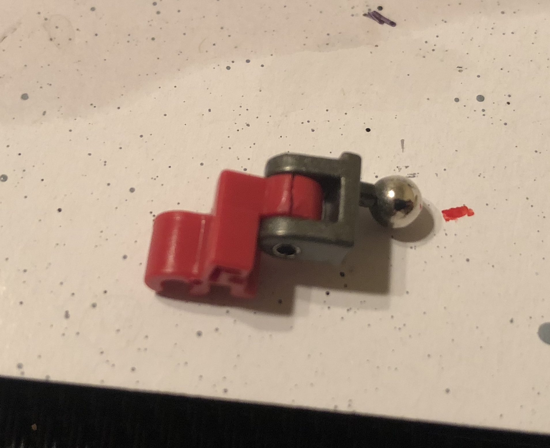

Lord_Of_Tetris Posted August 27, 2018 Posted August 27, 2018 (edited) AAAAH! AAAAAAH! Help help help! I just purchased my first HMR VF-1 mold. I hadn't even transformed it yet, and I noticed it was broken out of the box. I received it MISB. The left shoulder joint has a crack in the plastic! AAAAAH! It's the cylinder part of the plastic shoulder piece, where the pin goes through. AAAAAH! AAAAAAAAAAAH! How do I fix this? Is there a replacement part on Shapeways? Can someone sell me a junker so I can take the left shoulder piece? It is easily removed from the body of the Valk. I circled in green where it's just a C-clip holding it to the body. Help! Edited August 28, 2018 by Lord_Of_Tetris
jenius Posted August 27, 2018 Posted August 27, 2018 At least it wasn't the metal part that broke... that happened to me once. It looks like it should still function fine though, just be gentle with it..
Lord_Of_Tetris Posted August 27, 2018 Posted August 27, 2018 Any suggestions on replacement parts or ways to repair? I couldn't figure out how to remove the roll pin.
jenius Posted August 27, 2018 Posted August 27, 2018 You will break it worse removing that pin, your best bet would be to find someone who has one that is broken some other way to land that joint... but it's a Miria version so that's unlikely. You could try putting a bead of glue on there if you're worried about it getting worse. I just bought some stuff that is UV light curing... that looks like the perfect break for that sort of thing.
no3Ljm Posted August 27, 2018 Posted August 27, 2018 (edited) 2 hours ago, Lord_Of_Tetris said: AAAAH! AAAAAAH! Help help help! I just purchased my first HMR VF-1 mold. I hadn't even transformed it yet, and I noticed it was broken out of the box. I received it MISB. The left shoulder joint has a crack in the plastic! AAAAAH! It's the cylinder part of the plastic shoulder piece, where the pin goes through. AAAAAH! AAAAAAAAAAAH! How do I fix this? Is there a replacement part on Shapeways? Can someone sell me a junker so I can take the left shoulder piece? Help! You got it like that the moment you open it? Did you try to email the store where you purchase it? If that's HLJ, then it would be easy if you're still in their 10-day grace period. Edit: I just noticed that this is Millia based on the color which is a TWE release so it's probably didn't came from HLJ. Edited August 27, 2018 by no3Ljm
borgified Posted August 27, 2018 Posted August 27, 2018 It looks like that Lord_Of _Tetris might have gotten it from Manda, Amiami, Jungle, NY, Anime Export or any other stores that sells TWE after it's been released. Note: Did you read the fine print when you ordered the HMR Miria? Some places do not cover the damages upon you receiving it, as they sell the stuff "AS IS" so that means no dice in getting a replacement. Shapeways doesn't have any replacement parts for broken HMR as of yet. The only choice is to fix it by UV weld or fork out more $$ to get a replacement. It sucks to have a busted HMR upon getting it...
Big s Posted August 27, 2018 Posted August 27, 2018 Could try bondine abs glue, if other solutions don’t work. I have been very surprised by how strong that glue can be on hard plastics. Just let some seep in the cracks and do a tight squeeze while working the part a little so it doesn’t stick to the pin. I still would take extra care not to rebreak the part.
mechaninac Posted August 27, 2018 Posted August 27, 2018 4 hours ago, Lord_Of_Tetris said: Any suggestions on replacement parts or ways to repair? I couldn't figure out how to remove the roll pin. That part looks to be easily repairable. Get yourself some ABS cement (Tenax, Ambroid, or even Testors' Liquid cement for plastic) and a toothpick. Use the brush applicator of the liquid ABS solvent -- lightly loaded, not dripping -- and apply a small drop to the crack, let capillary action carry the liquid into the split; next, wedge the toothpick between the plastic and the metal to force and brace the crack closed; lastly, let it cure overnight and then cut or scrape off any plastic that oozed out. Done, and good as new.
derex3592 Posted August 27, 2018 Posted August 27, 2018 Ambroid Pro-Weld is wonderful stuff for that kind of break.
Lord_Of_Tetris Posted August 27, 2018 Posted August 27, 2018 3 hours ago, mechaninac said: That part looks to be easily repairable. Get yourself some ABS cement (Tenax, Ambroid, or even Testors' Liquid cement for plastic) and a toothpick. Use the brush applicator of the liquid ABS solvent -- lightly loaded, not dripping -- and apply a small drop to the crack, let capillary action carry the liquid into the split; next, wedge the toothpick between the plastic and the metal to force and brace the crack closed; lastly, let it cure overnight and then cut or scrape off any plastic that oozed out. Done, and good as new. Won't that glue the metal to the plastic, and then the joint won't move?
amptor Posted August 27, 2018 Posted August 27, 2018 My first one should be here within the next couple of days. So much for people giving me thumbs down for buying ten of them earlier. After all, I AM helping support your hobby guys. The more we support this product line, the more Bandai will be enticed to produce different toys. Also for the above, trying to get replacement parts from Bandai is like pulling teeth but it can be done if you have a good hobby dealer located in Japan that will do the legwork for you.
mechaninac Posted August 27, 2018 Posted August 27, 2018 7 hours ago, Lord_Of_Tetris said: Won't that glue the metal to the plastic, and then the joint won't move? Nope. It's not a glue, it's a solvent for ABS, Styrene, Polystyrene, Butyrate, and Acrylic (Testors will only react with Styrene, PS, and ABS); it will only affect the plastic as there is ZERO reaction to metal. The stuff works by melting the plastic and welding it to itself or another piece of plastic of similar chemical composition. The worst that can happen is that the melting causes plastic to ooze out and mechanically lock to any surface imperfection or detail on the metal part, but this impediment to free movement would be fairly weak and temporary... moving the parts against each other with a small amount of force would wear the offending obstruction down and free up the joint. The beauty of this repair method is that, if done properly, you'll hardly be able to tell that the crack was there in the first place as the melting of the plastic makes the part whole again.
