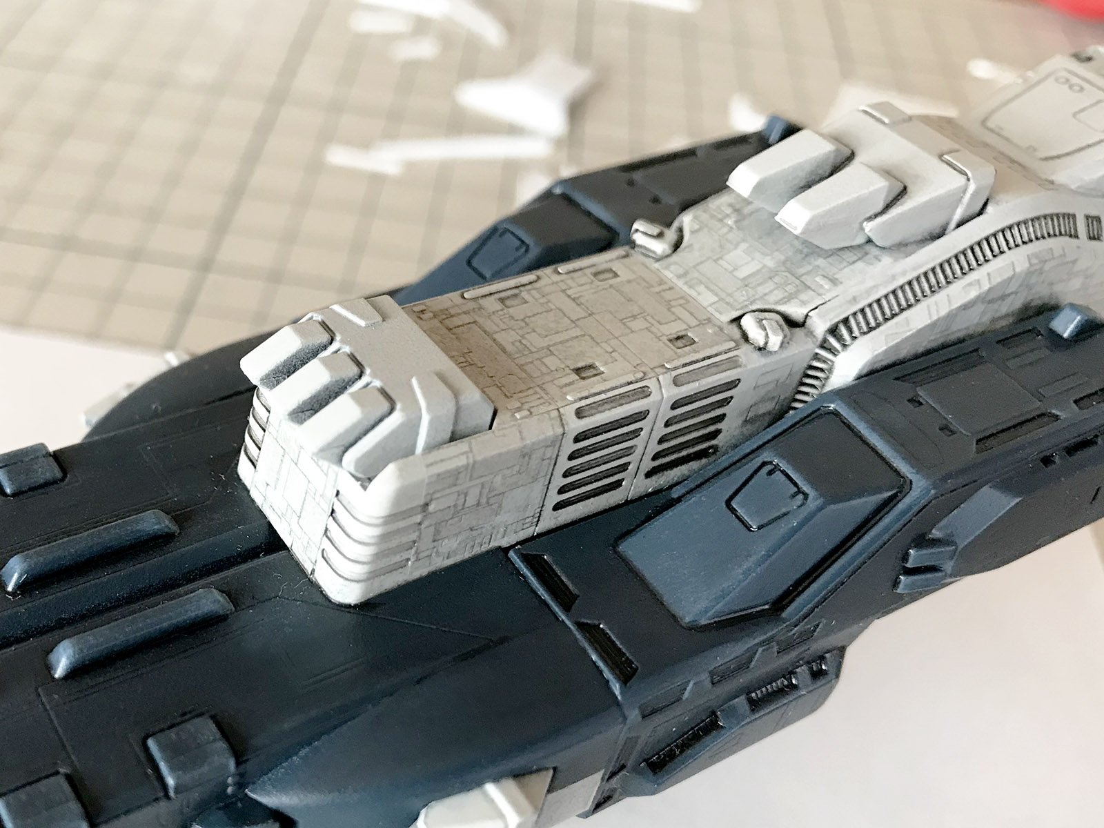

So, I've been experimenting with a way to give those flat, featureless portions of the hull a greater sense of scale...
Still using the Hasegawa as a guinea pig, I tried the ol' ILM approach, with intersecting lines and raised panels.  This is how the Star Destroyer studio models were detailed.
Unfortunately, the results looked crude and sloppy, so I abandoned the analog approach and decided to rely on digital tools instead.
I created this pattern in Photoshop, and printed it onto clear decal paper.  This is far more detailed than what I could do by hand.
The results were definitely more encouraging this time.  ^_^

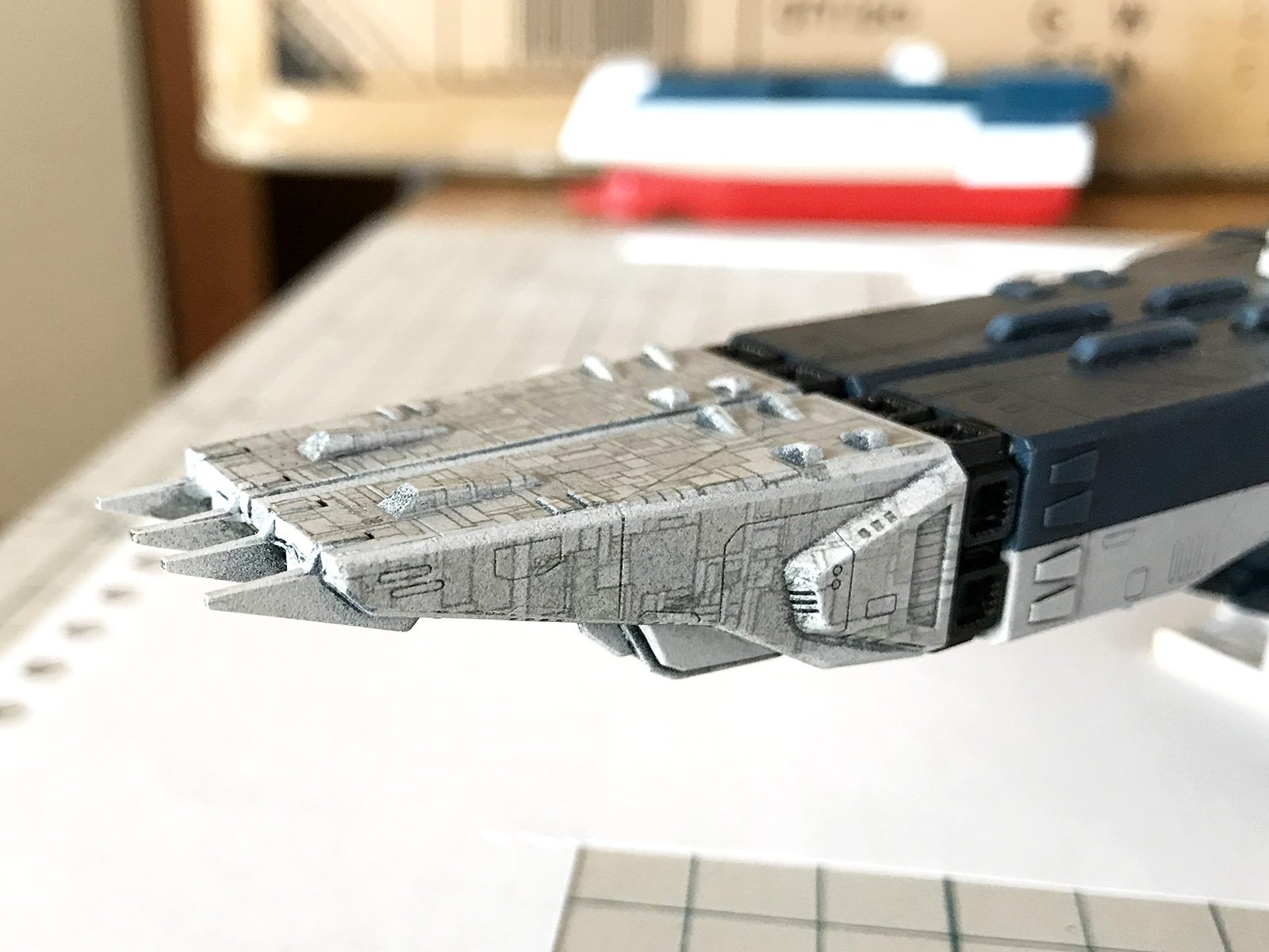

Thanks to so many of your wonderful suggestions, I've attempted to incorporate different shades and off-color panels to enhance the level of detail:
I'm not sure if I want every surface covered, or how well it will show up in the darker areas, but I'm very pleased with how it's looking on the Hasegawa kit so far.  8)

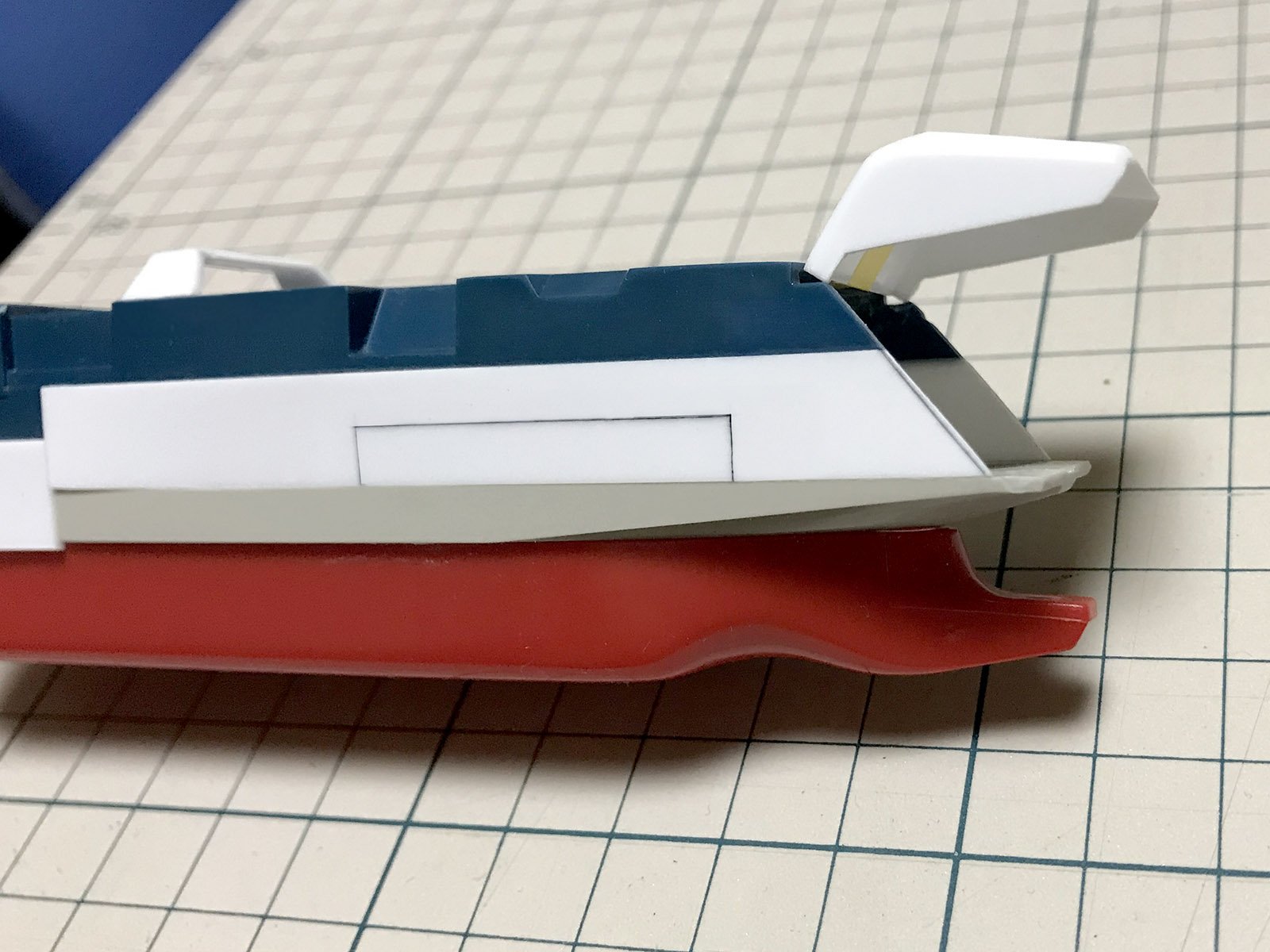

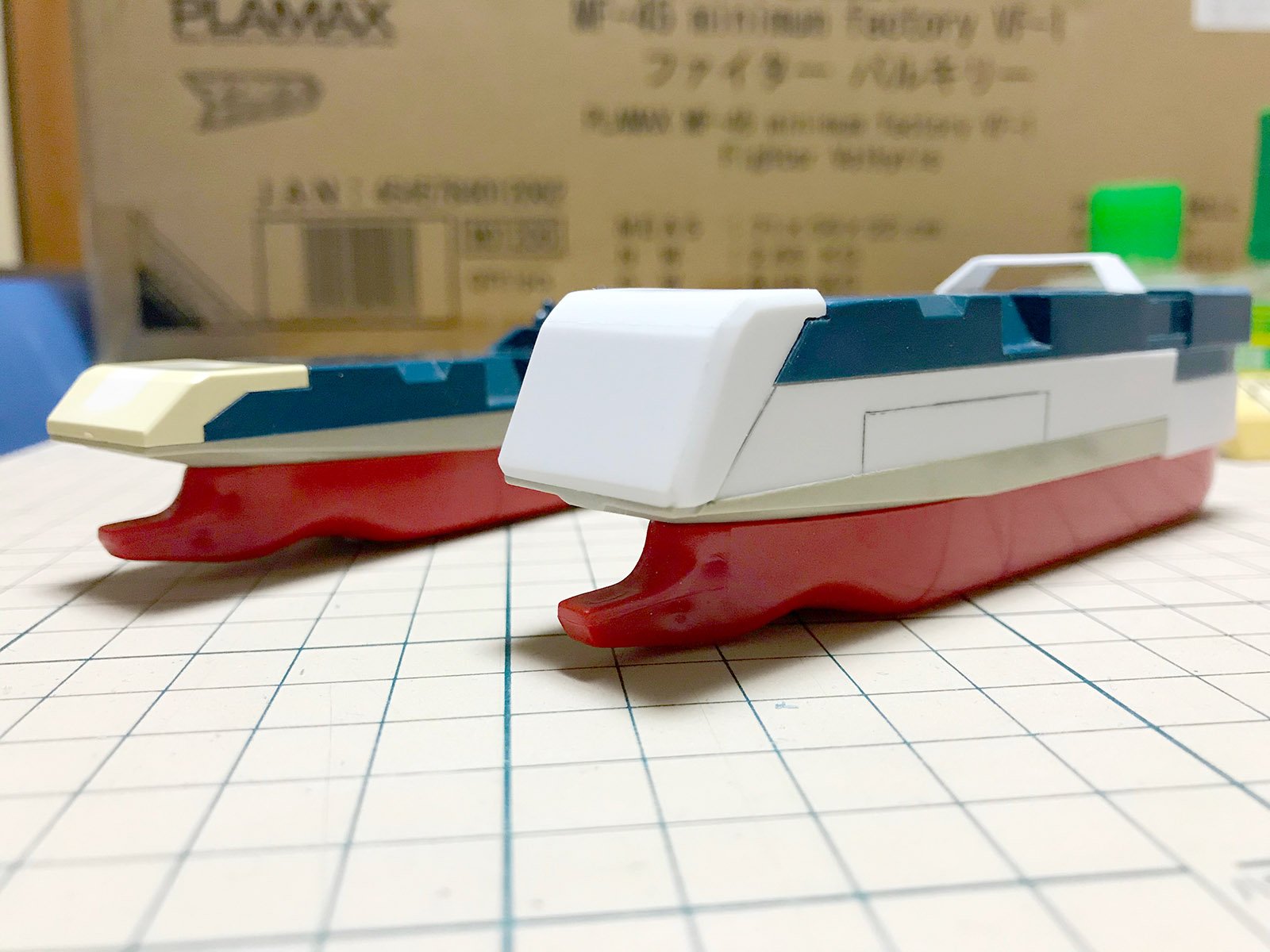

In the meantime, I've built up the sides on the Matchbox Daedalus with styrene, hollowed out the interior and scratch-built a prow hatch:
It's starting to look more like the ship I remember from the anime.  :good:
Now to figure out a hinge mechanism...!  ^_^

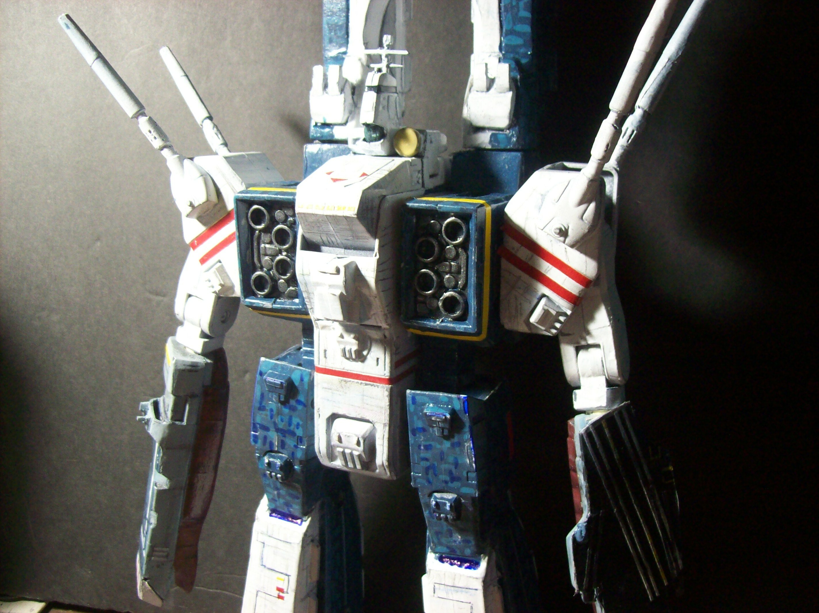

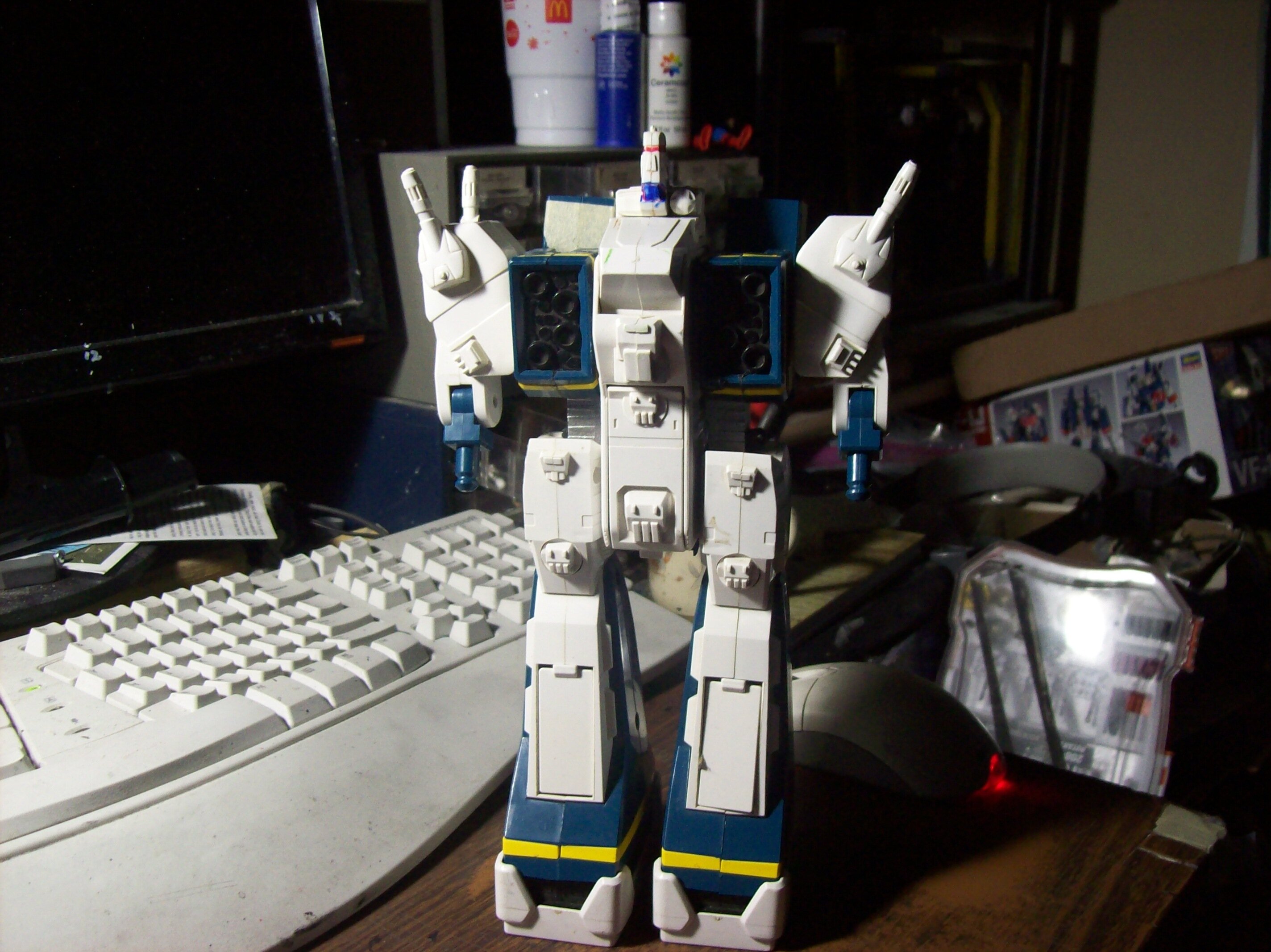

Update: my progress so far-101_0163.JPG.44f5e53b11cb1e11d840dedcc4223f7c.JPG
Just got through extending the lower legs, as well as modifying it for the "A" stance.
Stay tuned...

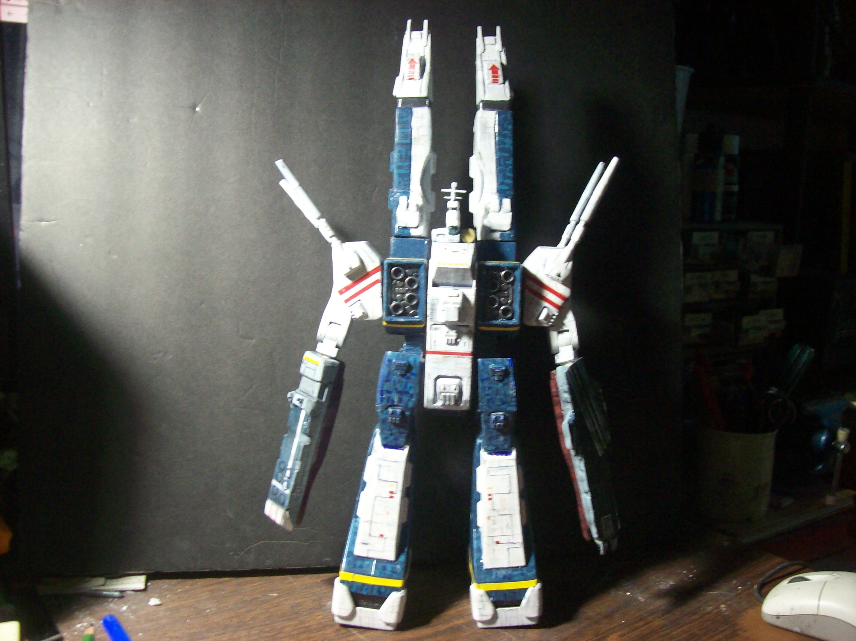

UPDATE:
A LOT of progress since last I posted in this topic:
101_0246.JPG.e320ed1304703998397189c545a89d2a.JPG 101_0247.JPG.67455edd721b3f67f47fc3716dabab96.JPG

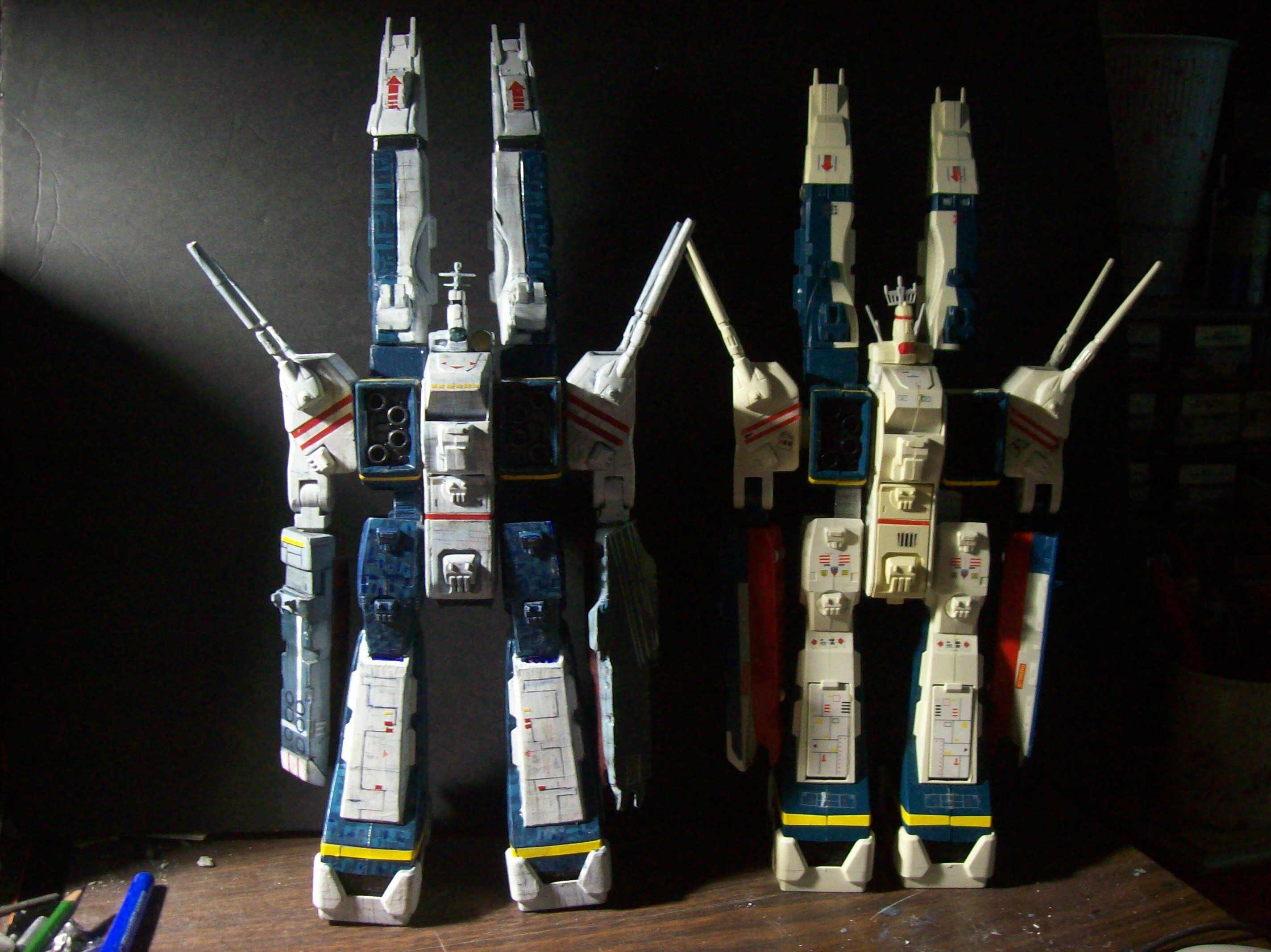

Comparison to the original (I got a second one while working on the first; when it rains, it pours!):
Stay tuned folks....

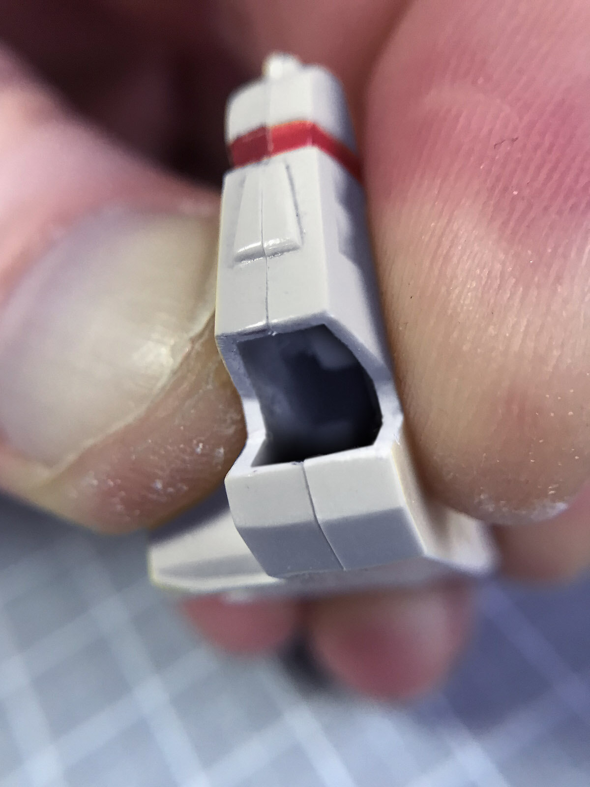

After a two-year hiatus, I'm finally back at it!  From here on out, I'm going to post weekly updates to this build until it's finally completed.

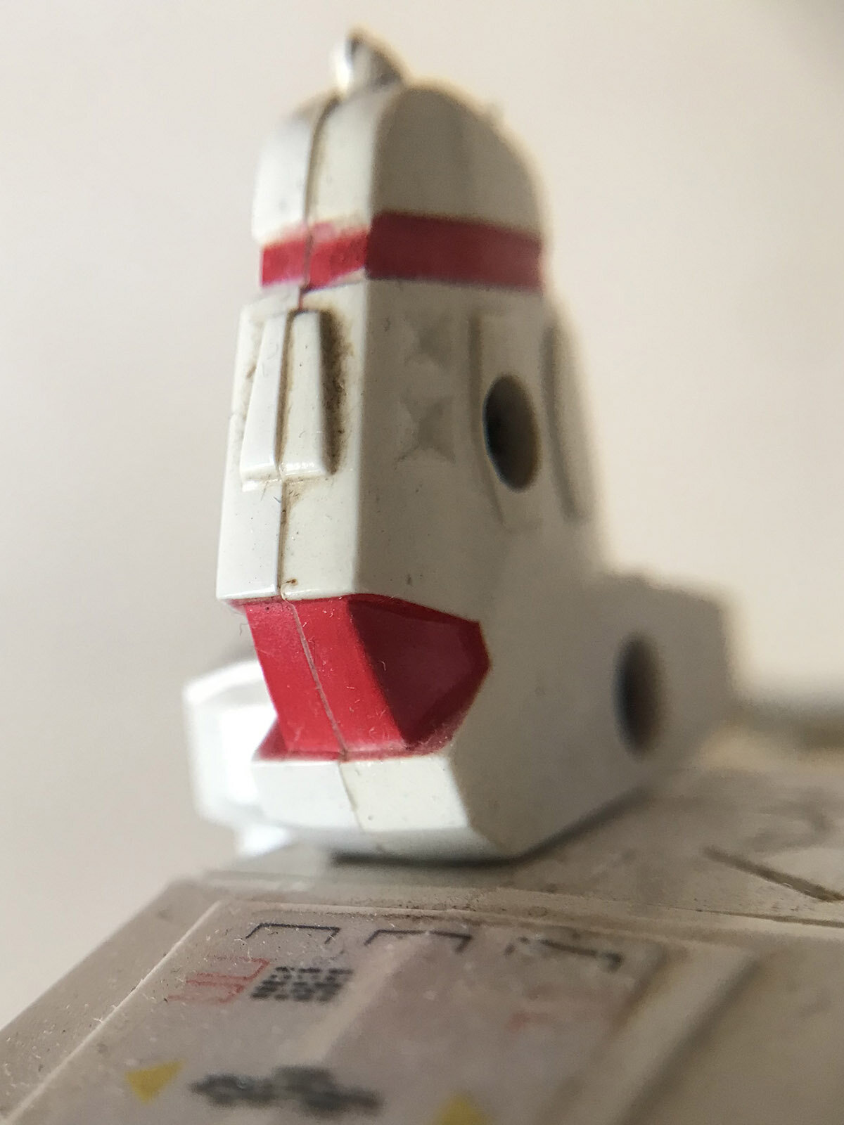

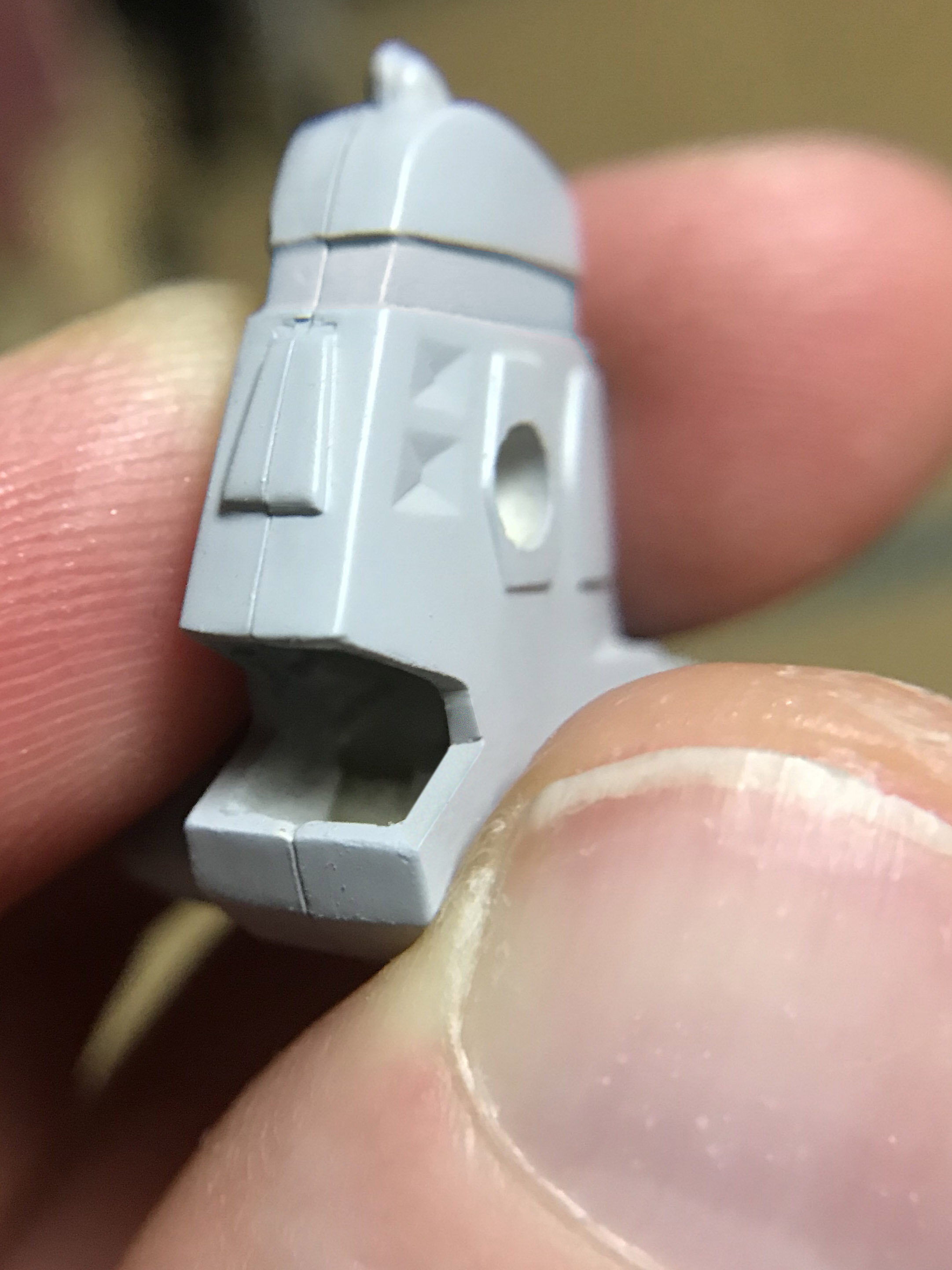

Despite the narrative significance of the Macross bridge, Takatoku made absolutely no attempt to reproduce it on the toy.  All we got was a solid red inset in the conning tower, where the bridge should've been visible (had there at least been a clear plastic piece)...

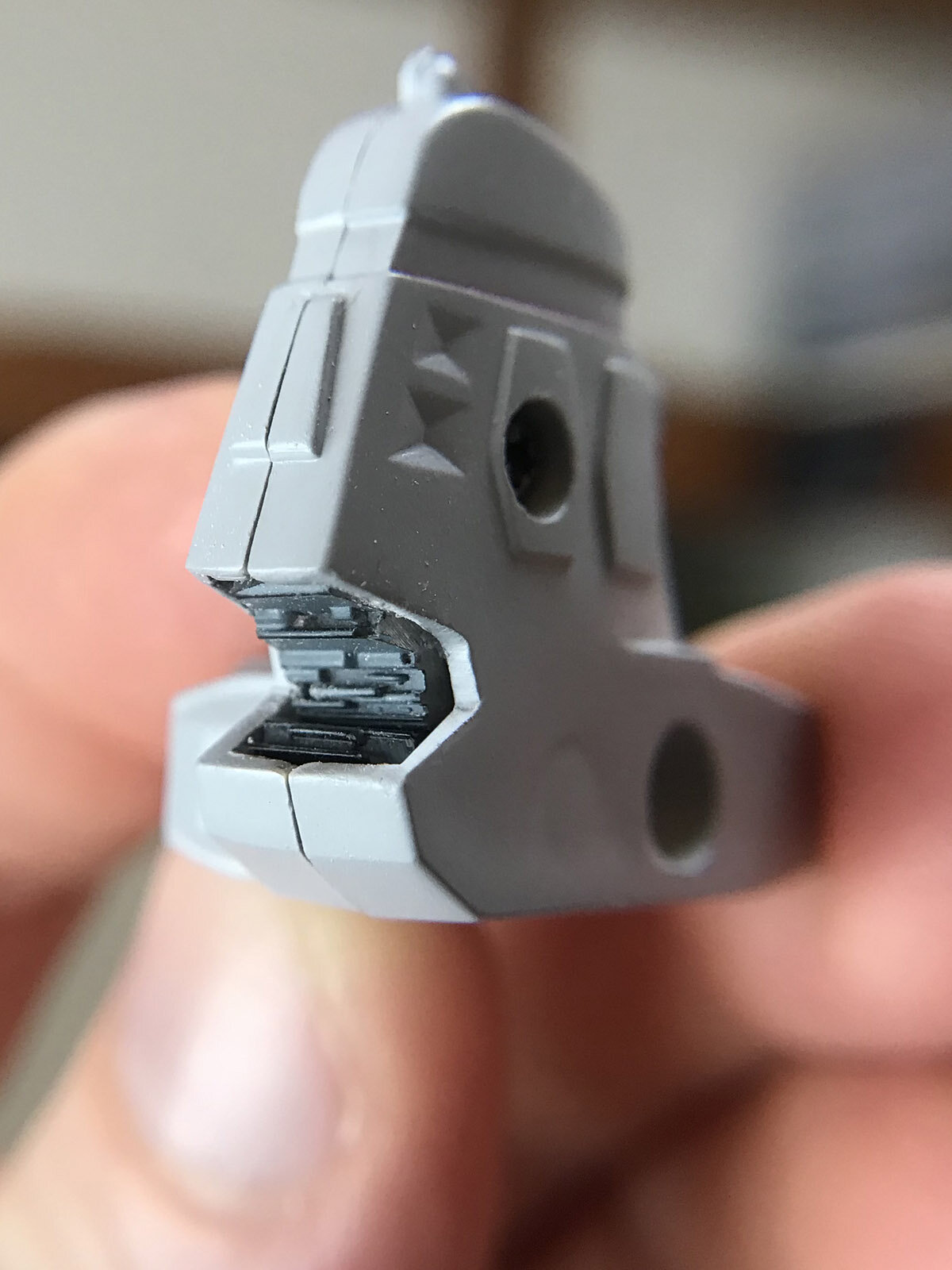

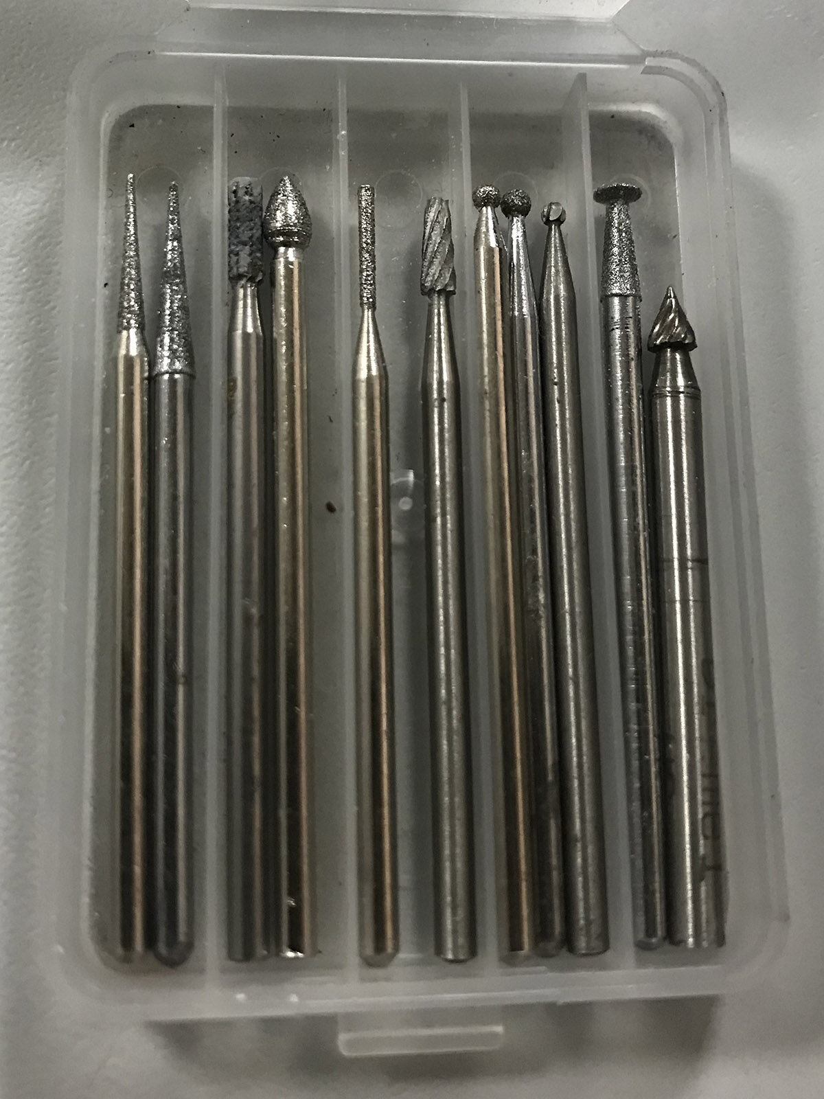

So the first thing I did was to hollow out the "head."
I've got plenty of dental files for detailed work like this:
Nevertheless, it's very difficult to be accurate at this scale.  As you can see, the opening is very small -- less than a centimeter, in fact -- and I needed a special macro focus lens just to photograph it properly.
Now, scratchbuilding a bridge at this scale would be impossible, of course (and I don't have access to a liquid-resin 3D printer), so kitbashing is the only viable solution here.  ILM elevated kitbashing to an art form making Star Wars, creating incredibly detailed studio miniatures by adding little bits and pieces from unrelated model kits, so that will be both my inspiration and (thanks to Bandai) my source of parts:
Bandai's insanely small "Vehicle Model" line of Star Wars kits includes a highly-detailed Star Destroyer I can cannibalize parts from, approximating the multi-level "face" of the SDF-1.
Once the seam lines in the conning tower are removed and the "head" is painted, I can add a transparent plastic cover.
