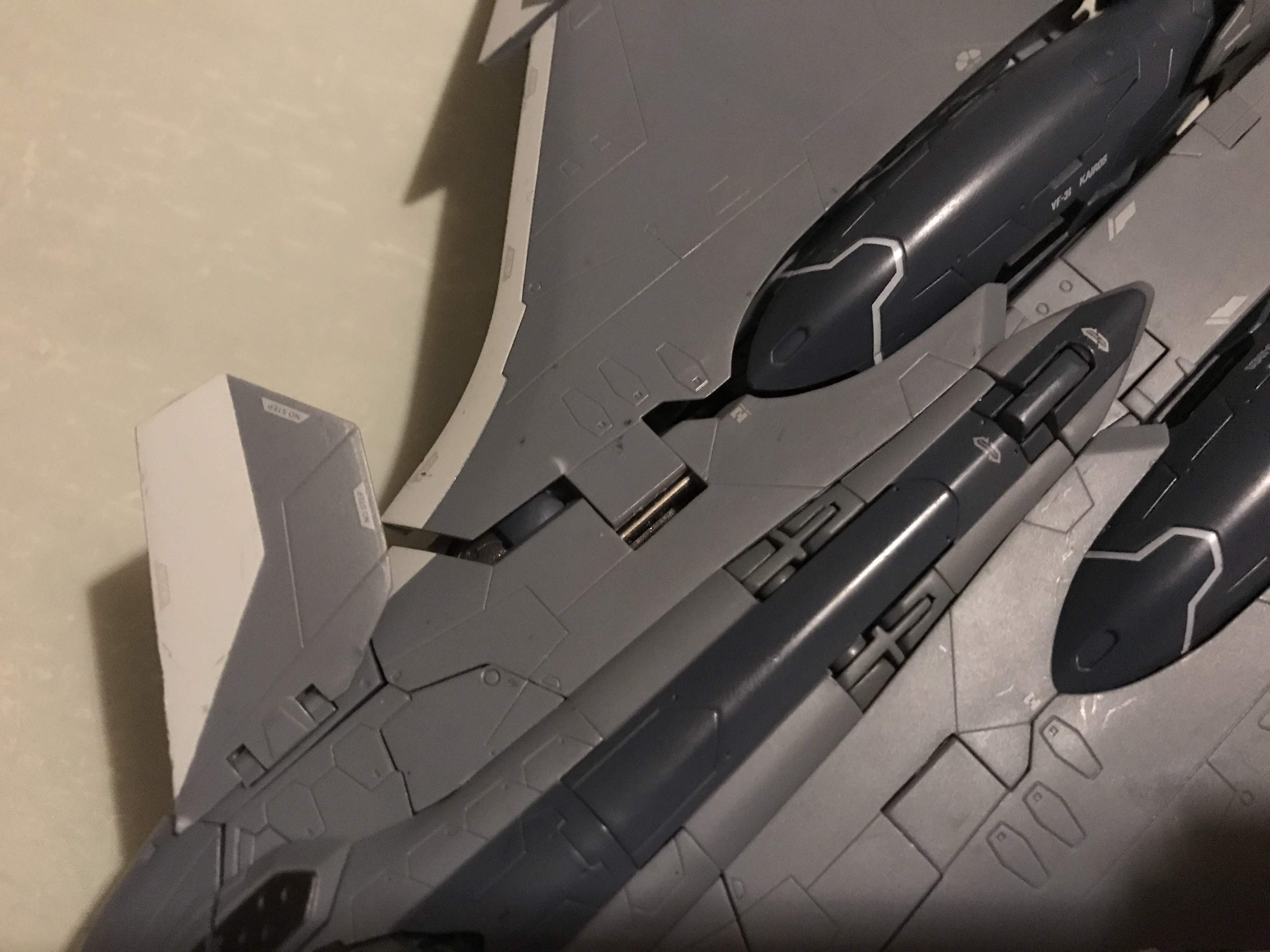

BlueMax Posted February 27, 2019 Posted February 27, 2019 Dear all, i’ve managed to score a VF-31A! But it is used and has a big problem: the wing root swivelling mechanism, specifically the tube/cylinder that swivels round the rod for transformation is broken. Can anybody advise how to go about doing that? The broken tube parts are safely in storage. thanks in advance
no3Ljm Posted February 28, 2019 Posted February 28, 2019 (edited) Sorry to hear about that. The canard wing looks beat up as well. Hope you didn't pay too much for it. Edited February 28, 2019 by no3Ljm
Sildani Posted February 28, 2019 Posted February 28, 2019 Use a “hot” plastic glue like Pro Weld to cement the broken parts together. You’ll have better luck transforming it part way to get to them, plus you’ll be moving parts out of the way of the glue. Let it cure for at least 24 hours, and treat it with kid gloves afterwards.
Xigfrid Posted March 1, 2019 Posted March 1, 2019 I had so far no luck finding a good welding glue and living in France doesn't help sourcing the good US/Jap stuff. But I recently came to this thread which contains great tips. In particular the one using super glue to attach the parts together, then use MEK/Acetone to weld the parts together and keeping them together during the 24h curing.

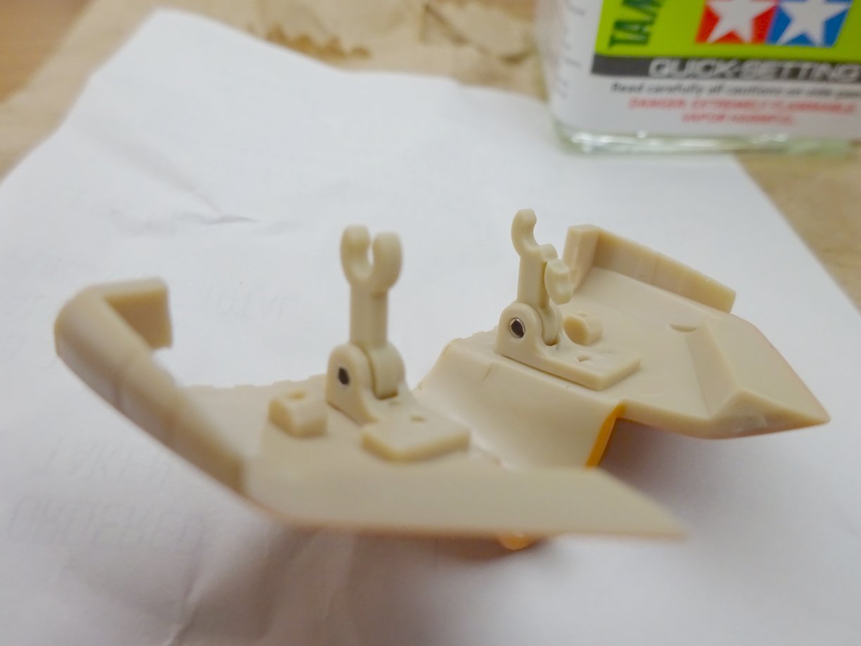

DewPoint Posted June 1, 2019 Posted June 1, 2019 On 3/31/2019 at 4:02 PM, davidwhangchoi said: Bandai plastic sucks Speaking of.... This happened. I've only transformed this twice! This is like my 6th HMR VF-1. I tried Tamiya Extra Thin Cement (Quick Setting). So far I've tried it three times and It dosen't seem to be holding. I'm reluctant to fool around with it more at the moment for fear of the part fully separating and then I'd have to deal with alignment issues. Is there a better product for the HMR plastic? Did I use the wrong type of Cement? I haven't done anything with plastic models in over 20 years!
DewPoint Posted June 2, 2019 Posted June 2, 2019 (edited) Tamiya Extra Thin Cement (Quick-Setting) (Acetone, Butyl Acetate, Methyl Ethyl Ketone) was in effective. Based on my research, that tells me that the plastic is not Polystyrene (PS), Acrylonitrile butadiene styrene (ABS), or Polyvinyl chloride (PVC). I just picked up a bottle of Plastruct Plastic Weld (Methylene Chloride (dichloromethane), Methyl Ethyl Ketone (MEK)). So far it seems to be working. I'll try to apply a bit of pressure on it in a few hours. If this fails, I'm moving on the the plastic specific super glues. Going to give it a full 24 hours to cure before I try to reattach it. You need to look really closely to see where it broke. Edited June 3, 2019 by DewPoint Added image
slide Posted June 4, 2019 Posted June 4, 2019 On 6/2/2019 at 5:18 PM, DewPoint said: Tamiya Extra Thin Cement (Quick-Setting) (Acetone, Butyl Acetate, Methyl Ethyl Ketone) was in effective. Based on my research, that tells me that the plastic is not Polystyrene (PS), Acrylonitrile butadiene styrene (ABS), or Polyvinyl chloride (PVC). I just picked up a bottle of Plastruct Plastic Weld (Methylene Chloride (dichloromethane), Methyl Ethyl Ketone (MEK)). So far it seems to be working. I'll try to apply a bit of pressure on it in a few hours. If this fails, I'm moving on the the plastic specific super glues. Going to give it a full 24 hours to cure before I try to reattach it. You need to look really closely to see where it broke. If MEK doesn't do it for you, you're probably s-o-l [in my experience]
DewPoint Posted June 5, 2019 Posted June 5, 2019 10 hours ago, slide said: If MEK doesn't do it for you, you're probably s-o-l [in my experience] No surprise, it split when I tried to push it on. I think I may have at least 3 options. 1) Coat the pin area in petroleum jelly and try to glue the part back together in place. 2) Ask my co-worker to 3D print me some replacements (maybe 10). 3) Try to find a parts Valkyrie.
Slave IV Posted June 5, 2019 Posted June 5, 2019 2 hours ago, DewPoint said: No surprise, it split when I tried to push it on. I think I may have at least 3 options. 1) Coat the pin area in petroleum jelly and try to glue the part back together in place. 2) Ask my co-worker to 3D print me some replacements (maybe 10). 3) Try to find a parts Valkyrie. That part is pretty tiny but if you can find a way to drill a hole in each side to glue in a support pin, it may work. For me, I'd just call it broken and live with it.
DewPoint Posted June 5, 2019 Posted June 5, 2019 49 minutes ago, Slave IV said: That part is pretty tiny but if you can find a way to drill a hole in each side to glue in a support pin, it may work. For me, I'd just call it broken and live with it. True enough. It will function fine with a single support.
kkx Posted June 5, 2019 Posted June 5, 2019 3 hours ago, DewPoint said: No surprise, it split when I tried to push it on. I think I may have at least 3 options. 1) Coat the pin area in petroleum jelly and try to glue the part back together in place. 2) Ask my co-worker to 3D print me some replacements (maybe 10). 3) Try to find a parts Valkyrie. Not sure if this is similar to what you have tried. When I try to repair a few VF-1 1/60 v2 with broken/split shoulder hinges, I found this and it works great. Loctite bonding system The Yamato shoulder joint plastic is a bit smooth and oily (not sure what type it is), and nothing I tried works until I attempt this. The pressure on those hinges might not be as strong as yours, so not sure if it will work but worth a try I think. You can also try to thin out the bar a bit to reduce some pressure on the hinge. Good luck.

DewPoint Posted June 5, 2019 Posted June 5, 2019 (edited) On 6/4/2019 at 7:48 PM, kkx said: Not sure if this is similar to what you have tried. When I try to repair a few VF-1 1/60 v2 with broken/split shoulder hinges, I found this and it works great. Loctite bonding system The Yamato shoulder joint plastic is a bit smooth and oily (not sure what type it is), and nothing I tried works until I attempt this. The pressure on those hinges might not be as strong as yours, so not sure if it will work but worth a try I think. You can also try to thin out the bar a bit to reduce some pressure on the hinge. Good luck. I looked at that. It is my last resort before going to replacement parts. My major issue, as you all know, is that the part needs to widen to go back in place. Major stress on the re-bonded joint. My co-worker is a Machinist by hobby. He has milling machines, lathes, 3D printers, laser engravers, etc. Doesn't hurt to ask! Edited June 7, 2019 by DewPoint
