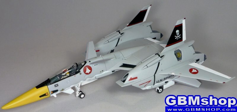

Well, here's some shots of my hinge breakage.
post-244-0-61180000-1358130815_thumb.jpg post-244-0-06521600-1358130817_thumb.jpg
Note to everyone else, do not work on the bird while its together, take it apart to start sanding and masking. I must of damaged my hinges while I was trying to sand the nosecone until I figured out I could take the nose cone off with just two screws inside (argh!)
A sleep does wonders - after tossing and turning all night thinking about the broken hinges, I came up with a way to "rebuild" the hinges. There really was nothing to salvage, the plastic just crumbled. So I sanded it down and found some stock plastic tubing. I then drilled a hole down and added a cut piece of pin as a metal reinforcement like you would pinning a resin model - hopefully that will take most of the stress.
post-244-0-11839200-1358131010_thumb.jpg post-244-0-40950500-1358131011_thumb.jpg
post-244-0-89808700-1358131012_thumb.jpg post-244-0-21003200-1358131014_thumb.jpg
Here's a shot of the finished nosecone...
A shot of the finished wings with the white moveable surfaces (before decals and weathering)
And this is where I am tonight... leaving it to dry and cure. It takes a lot of getting used to working with enamels (being an Acrylic guy) - it seems to take forever to dry/cure and it forms a seemingly dry skin, but its quite soft underneath. I think I've been fiddling too much before it's dried properly and I have a few tiny nicks and dings here and there, but I'm not going to strip it and start over again. I think after I do the decalling and weathering, that should hide some of the sins. Additionally, Mr. Colour solvent/thinner removed the "Made in China and Big West" copyright tampo really easily.
post-244-0-00147400-1358131273_thumb.jpg post-244-0-46204100-1358131274_thumb.jpg
post-244-0-93013800-1358131275_thumb.jpg post-244-0-35113800-1358131277_thumb.jpg
Gotta keep telling myself to just leave it alone! Its soooo hard, I just want it back together again to zoom around...
