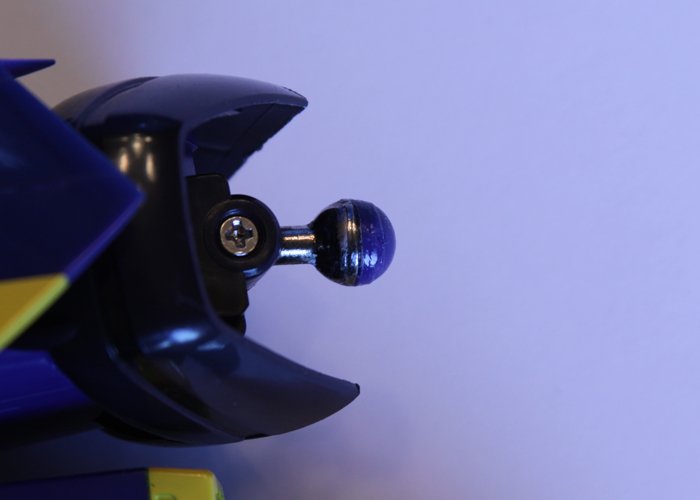

anime52k8 Posted December 8, 2011 Posted December 8, 2011 Good news: I was able to remove one of the foot pins (the heel of the right foot). Bad news is this is not a procedure for the faint of heart/sane of mind (ended up needing to use a hex wrench, a hammer and a block of wood). The pin is in fact a split spring pin so when not under pressure it is slightly wider than the whole, but fortunately the ends are sufficiently tapered that I'll be able to get it back in once everything is said and done. forgot to take pictures while I was working and I'm going to be too busy to keep working on this until Monday so we'll have to leave it at that for a while.

anime52k8 Posted December 8, 2011 Posted December 8, 2011 (edited) So, I couldn't sleep last night and I decided to rip finish ripping the foot part. I was able to get it completely part without breaking the thing so small victory there. Now I need to figure out how to fix the toy joint. Normally I'd just use a coating of super glue or nail polish, but given the ordeal necessary to get the foot part in the first place I want something that's going to be resilient and long lasting. (i.e. remain adhered to the applied surface through repeated use.) I'm also not sure how much clearance I actually have because it's pretty tight in certain directions. it's only loose when angled forward so I get the think it's an issue of asymmetrical tolerances but I'm not sure where I'd need to thicken stuff up to fix it. I'm kind of tempted to pick up some liquid rubber from the hardware store and dip the ball joint in it. Edited December 8, 2011 by anime52k8
MacrossJunkie Posted December 8, 2011 Posted December 8, 2011 I don't know if it's a good idea or not, but maybe you could also score up the surface of the ball joint with something like a pair of pliers to make it rougher and allow for better adhesion?
anime52k8 Posted December 8, 2011 Posted December 8, 2011 I was actually thinking about doing that, giving the whole surface a light sanding then coating it in something. (still not sure what's going to yield the best combination of strength, flexibility and adhesion.)
Mommar Posted December 8, 2011 Posted December 8, 2011 I'm curious to hear what you do and how it works out for you. Would love to be able to fix my issue... though dismantling the thing already sounds scary.
eugimon Posted December 9, 2011 Posted December 9, 2011 you don't need to take the whole foot apart to get the ankle joint free, if you just loosen the exposed screws, you can pop the joint out. Getting it back in is the tricky part. You need to use something to hold the ankle joint in place while you pop the foot back on.

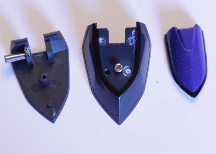

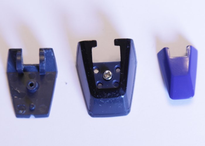

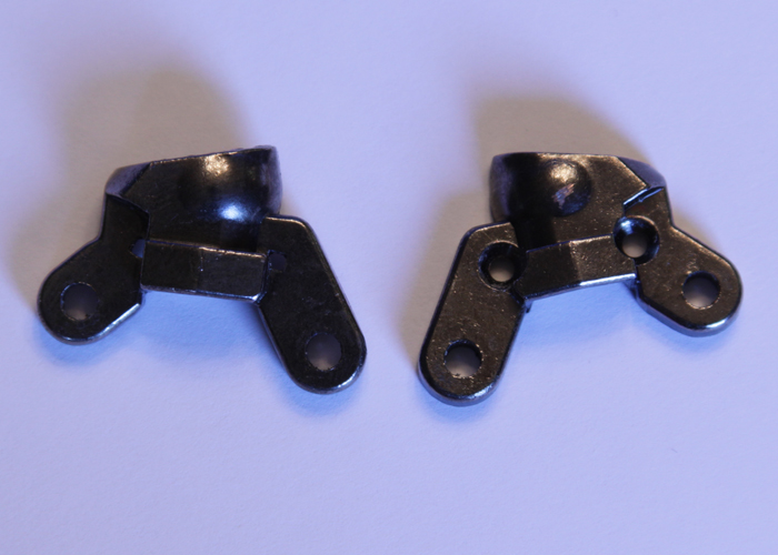

anime52k8 Posted December 9, 2011 Posted December 9, 2011 (edited) we'll I'm just special then because I ripped that crap apart. so here's the pictures of the disassembled foot. like I said, the heel and toe are made of three pieces each, the grey top and sole held together buy a screw with the blue cap pegged on top. the heel had vertually no glue and came apart easily The toe did not. (no worries though, it will be super easy to glue back together when I'm done.) then we have the ankle halves and finally the ball joint proper. The plastic hemisphere was barley glued on and fell off as soon as I pulled the joint part. this is after gluing it back together. :edit: I decided to try coating the ball in future and then putting it back together. just waiting for it to dry now. and finally the accursed pin. Edited December 9, 2011 by anime52k8
Renato Posted December 9, 2011 Posted December 9, 2011 Thanks for the pics! Let us know how it turns out.
Archer Posted December 9, 2011 Posted December 9, 2011 You, kind sir, are one of the bravest people I've ever met. Not a week with the toy and you're already disassembling the darn thing!

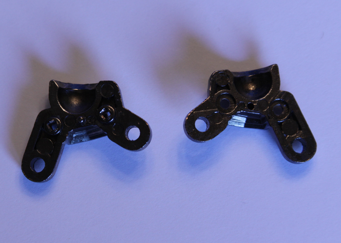

MacrossJunkie Posted December 9, 2011 Posted December 9, 2011 So you didn't try sanding the ball joint? I'm surprised the bottom half of the ball is merely plastic rather than the whole ball being die cast. I have my doubts based on personal experience about the use of future for this purpose as it might just end up detaching from the surface of the ball and make a surface with less friction for the ball to roll around in. Definitely interested to know if it does succeed for you or not. Good luck!
anime52k8 Posted December 9, 2011 Posted December 9, 2011 (edited) So you didn't try sanding the ball joint? I'm surprised the bottom half of the ball is merely plastic rather than the whole ball being die cast. I have my doubts based on personal experience about the use of future for this purpose as it might just end up detaching from the surface of the ball and make a surface with less friction for the ball to roll around in. Definitely interested to know if it does succeed for you or not. Good luck! Actually I did give it a light scuffing up with some 240 grit sand paper before gluing the plastic part back on. and I also wiped the surface down with paint thinner to clean it so hopefully I'll get good paint adhesion out of this. As for using plastic at all, I can see why they did it as a softer plastic will produce more friction than hard, slick metal rubbing against hard, slick metal. the part that gets me is that the joint looks and feels like the same blue ABS plastic that the bulk of the toy is made of, it even has the same gloss surface. Personally I'd think a stronger, more elastic material like POM with a matte finish would have worked better. Edited December 9, 2011 by anime52k8
Chronocidal Posted December 9, 2011 Posted December 9, 2011 Wait, so, there's no rubber friction pad in the joint at all? Like.. every other ball joint Yamato has used in the past? I think the problem with the inconsistent tension is that the socket and ball just aren't spherical at all, or gets stressed out of shape during assembly. I mean, it is made up of two different materials after all, which have entirely different structural properties, and aren't going to react to stress at all in the same way. I'd love to understand why they thought a joint designed like that was a good idea, but every bit of my engineering education tells me there's something really wrong with that ankle design.
Mommar Posted December 9, 2011 Posted December 9, 2011 Didn't you say the tension is actually due to the plastic on the bottom half of the ball? Didn't you also say it was just barely glued on yours? Maybe if the plastic ball is separating on some of the ankles they're losing tension?
Chronocidal Posted December 9, 2011 Posted December 9, 2011 If the plastic ball were separating, it shouldn't lose tension side to side or front to back; if anything, it would spin, because the ball looks like it forms a cap to the metal ankle piece.
anime52k8 Posted December 9, 2011 Posted December 9, 2011 If the plastic ball were separating, it shouldn't lose tension side to side or front to back; if anything, it would spin, because the ball looks like it forms a cap to the metal ankle piece. Actually it wouldn't. The metal portion of the ball plugs into the plastic hemisphere via a rectangular peg. (forgot to take pictures of that before I glued it back together, sorry.) Even without glue the cup is way too tight to let the plastic hemisphere slip down enough to no longer engage that peg. Also, I kind of prefer using a hard plastic like this over a soft rubber. joints with soft rubber inserts tend to loose tension over time as the rubber itself will dry out and shrink slightly, I'm fairly certain that's the reason the joints on Bandai Valks become floppy after going untouched for months. I can see the use of ABS making sense as it will last longer than rubber without shrinking, drying out or wearing down.
