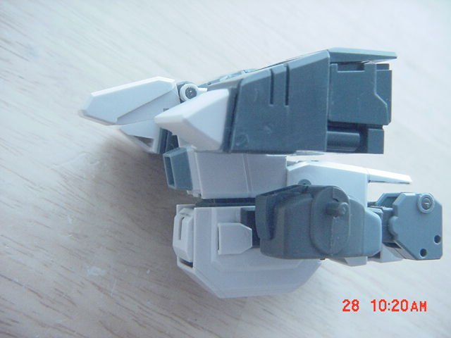

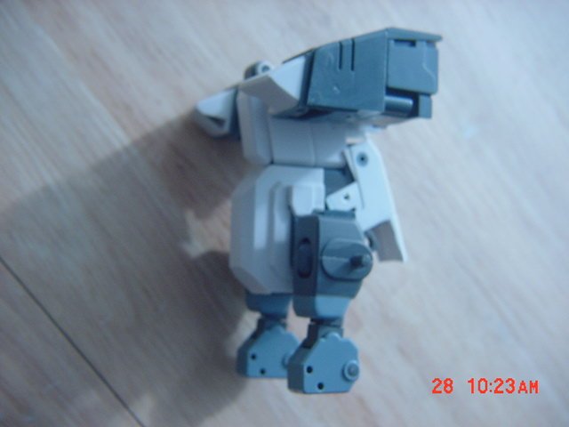

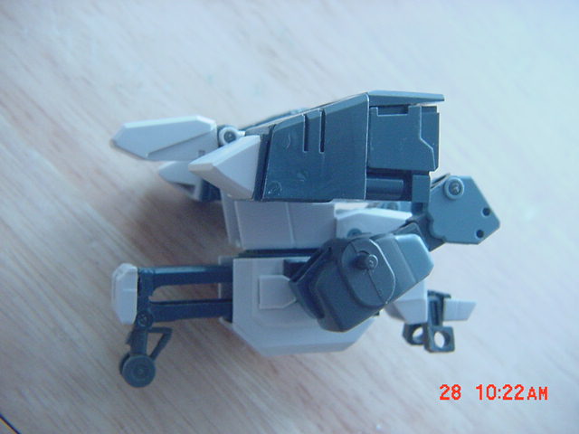

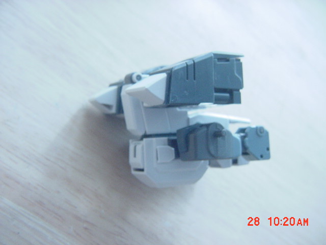

All in all I'm happy with the sculpt, especially on the TRAED. I hope they are accurate with the engineering. If you want to be nit picky, here's how some of those parts should work.
The clamp that hold the Legios and nose gear should telescope back into the hip area.
The hips should actually fold down/up 90 degrees depending on mode.
The cockpit should also fold down into the mid chest area.
The landing gear actually should sit/fold into a pod that folds and holds the center booster.
The arms and legs folding are easy to see.
Here are some pictures of a TREAD look alike I built with spare parts. It looks different, but the mechanics are the same. This is FAR from being done and has a lot of work to go.
[attachmentid=40788] Flying mode. The blue block in the center of the chest is for the cannon.
[attachmentid=40789] Gear and coupler out. The coupler needs gluing and the rear gear need to be added to the struts.
[attachmentid=40790] Cockpit folded in.
[attachmentid=40791] Battleoid mode or soldier mode. The block behind the hip part folds down and the gear fold into it. The outer hip parts rotates 90 degrees down.
All in all there is not a lot of anime magic on this design - much to my surprise. I got all my mechanical workings from the lineart and anime screen shots. I gotta finish building this thing after the Daedalus is done! It was a lot of fun to figure out.
I hope they don't settle for removeable parts. That usually means lost parts. We'll see... :) - MT

The Tread on the whole uses fairly little anime magic to transform, I agree, but the extending coupler mechanism is an exception to that rule: for that segment to extend far enough to reach the Legioss' crotch module, it practically has to be made of two inter-collapsing segments. Then, once the coupler is fully retracted, it has to fit snugly inside the Tread's crotch, and still somehow leave room for deployable landing gear and gear bays.
To try to pull that off with non-removeable parts on a toy of that scale would have been ludicrous; tolerances would be too tight and would be so fragile that the toy would collapse under its own weight. This is most likely why Toynami were taking so long with theirs, but to be honest, these guys at CM seem to have their act together--more power to them.

I really like how the CM prototypes look, but you engineering looks FANTASTIC MechTech. Hope CM do their best with their Tread as you are doing with yours.

I like your proto-tread there.
The part of the Tread's transformation that always required the most "magic" is that the cockpit could never fold down and fit neatly over the gun port. In the line-art the cockpit is too large, and the gun port too small.
In your version you have made a nice compromise, but I've always thought the right cockpit module could make or break a Tread rendition. And the more line-art accurate, the better the Tread looks. That's how I see it at least. That (and the legs) are my biggest problem with this CM thing.
And I had never thought of the forward landing gear/Legioss support arm not fitting. But the Capt's right. Huh.

Thanks guys!
The Captain is right about the coupler. I worked hard on a solution for that, but nothing that could be done in plastic, especially styrene or ABS. Anime magic time!
Phyrox is right about the folding cockpit thang. The way I overcame it was by puttng a small shaped plate under the cockpit. When it folds out the hole is covered. When it folds in the cockpit covers the space.
The drawings never did collaborate well. The cockpit usually gets drawn too large in the anime.
Twoducks, if Toynami tries to copy my work, I'll slam 'em with a C&D :lol: ! Actually if they make this whole thing work good and LOOK good, I'll be ecstatic (as will the rest of us here)! - MT
Nice... I like it alot. Will it have a Legioss look alike to link with? I'm also curious about what you mean by spare parts? I can't wait to see this finished.
Carl

Thank you. I made this in 1/72nd scale so it actually fits up with a Legios model. Of course for the whole hook up link being just a little too short. It has all the missile hatches too, but I left those out of the photos. I made it out of spares from kit parts or completed kits that didn't make past house moves too well. - MT
I take it there was alot of cutting and glueing involved... correct? Its hard for me to believe you could find all the parts necessary to make a Tread as random parts in other kits.
