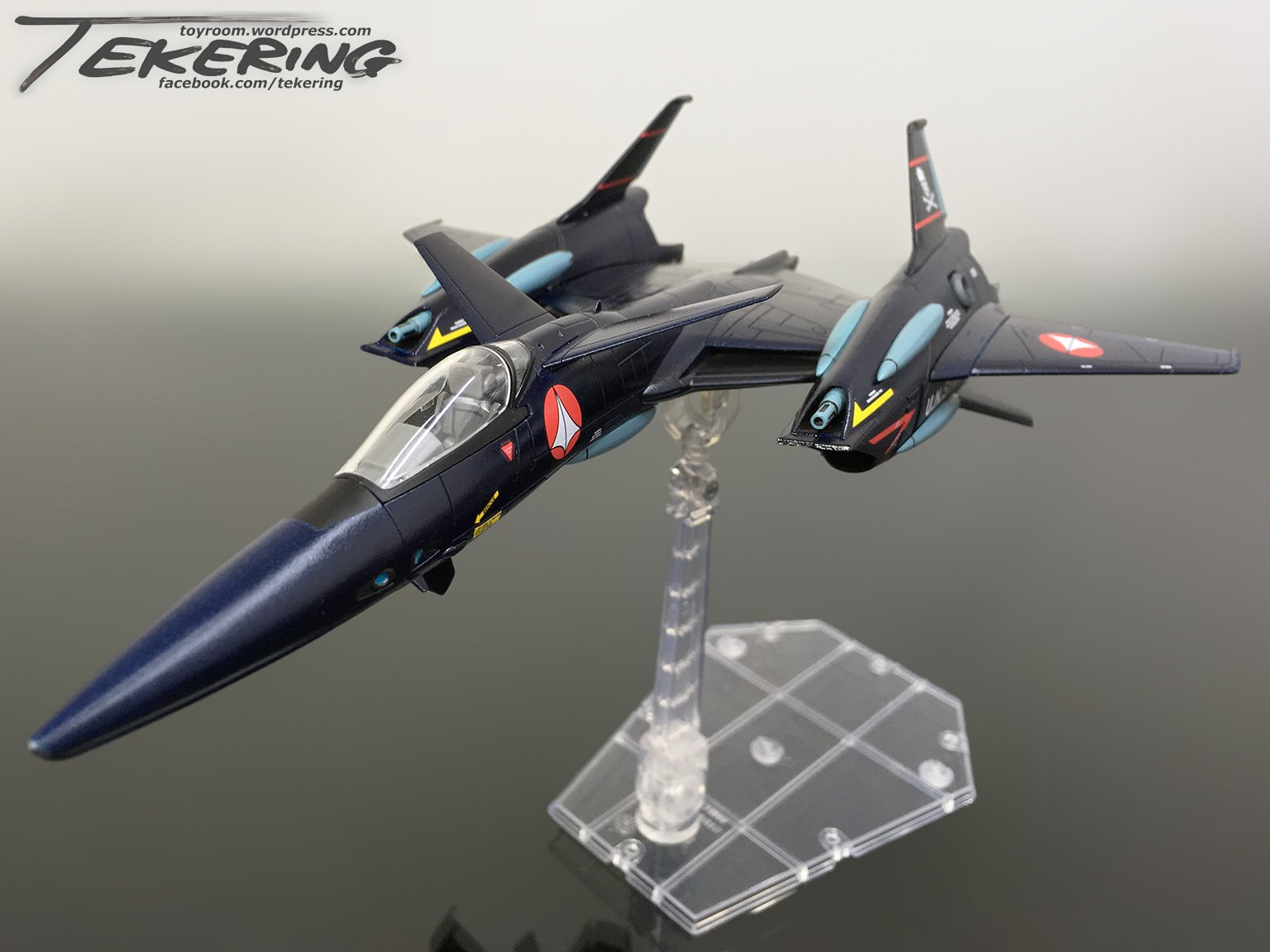

levzloi Posted April 1, 2019 Posted April 1, 2019 That's a gorgeous Cavaliers paint job, could you tell me what specific paint products and colors you used for that look?
tekering Posted April 1, 2019 Posted April 1, 2019 39 minutes ago, levzloi said: could you tell me what specific paint products and colors you used for that look?

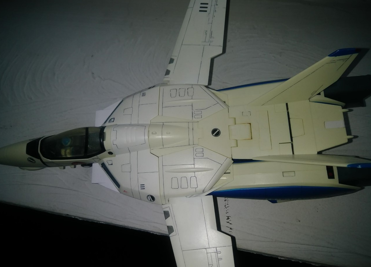

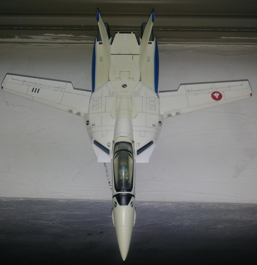

Pulltoeject Posted April 3, 2019 Posted April 3, 2019 (edited) Hmmmm....looks like the messy parts were not finished, say, not cleaned up to leave the clean panel line look. Try the qtip thingie and wipe away the excess paint first along those parts and see if you like the end result, the over all panel lining does not look bad. If not satisfied, go full mister clean and strip it all off. As for the yellowing, I would go the sandpaper route. The scratches on the canopy might be buffed out with an old tshirt and WHITE colgate. Moisten the tshirt with some water, dab a little paste on it and rub in tiny circular motions. Try doing that now, it'll take you about 15 min. Ps, be careful with the black canopy frame ! Edited April 3, 2019 by Pulltoeject
Mog Posted April 3, 2019 Posted April 3, 2019 Thanks for the pics! So, the million dollar question remains: what do you want to do with the yellowed bird? Custom repaint or restore it to pristine white? By the way, that's some really uneven, sloppy panel-lining. Don't know what the person was thinking, trying to panel-line the grey vent on the chest too. Personally, I prefer using a lighter grey pen to fill in panel lines on the white parts; it's subtle but can still pop. Here's a pic of my Yammie 1/48 grey panel-lined on the left side and middle but left untouched on the right side. Panel-lining fully done up (used black micron pen on the blue parts):
mickyg Posted April 3, 2019 Posted April 3, 2019 (edited) Ah, that helps a LOT. Not to disparage Pulltoeject's great advice but I notice a couple of things right off the bat that could use some further comment. Firstly, those aren't scratches, but Shizuka, you probably already knew that. That's Yamato's rainbow tint, disintegrating away on the inside of the canopy the way only their tinting can. It's common. And I'm fairly certain it's something you can fully strip off with alcohol. Second, it looks like the panel lining on the kite along the fuselage was done with something that reacted with the red paint. I'm also tipping it was an alcohol based product. In short, the Tamiya thinner might work, but I'd still start with good old Isopropyl first. Pulltoeject's advice about using it basically dampened is definitely recommended. I'd start on the side of that nosecone where it's just a white plastic background. If the black starts to come off, you're in good shape to tackle the rest. That kite though... That's almost assuredly going to require something special not to make it look worse. Probably best to try and avoid it altogether. Edited April 3, 2019 by mickyg
