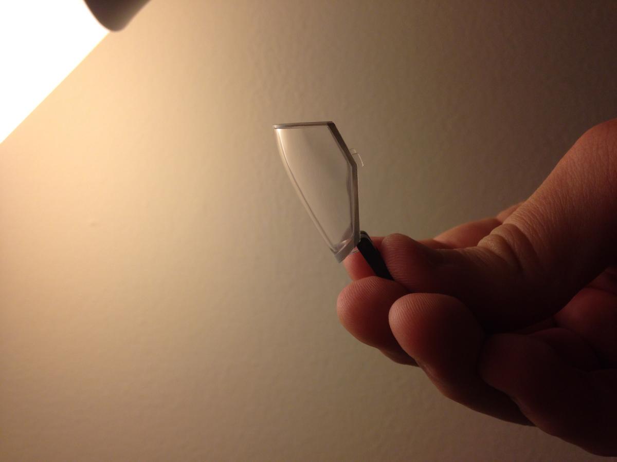

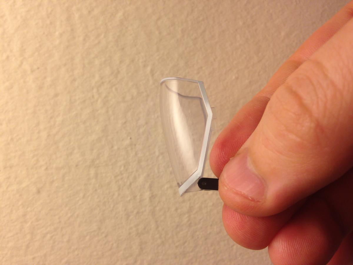

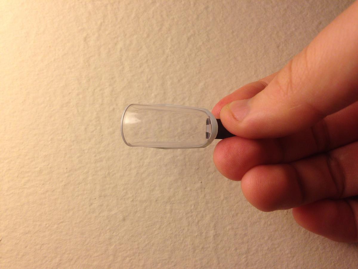

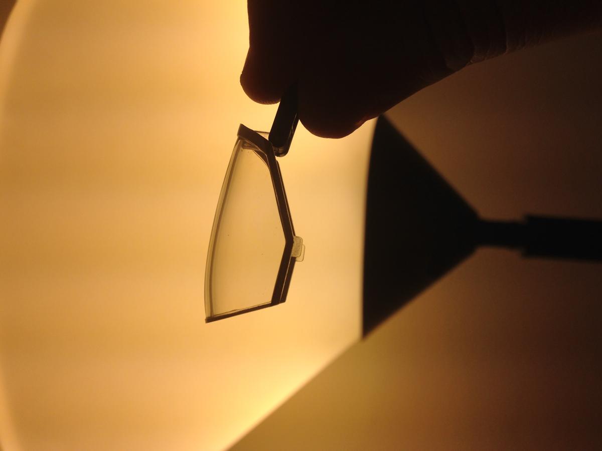

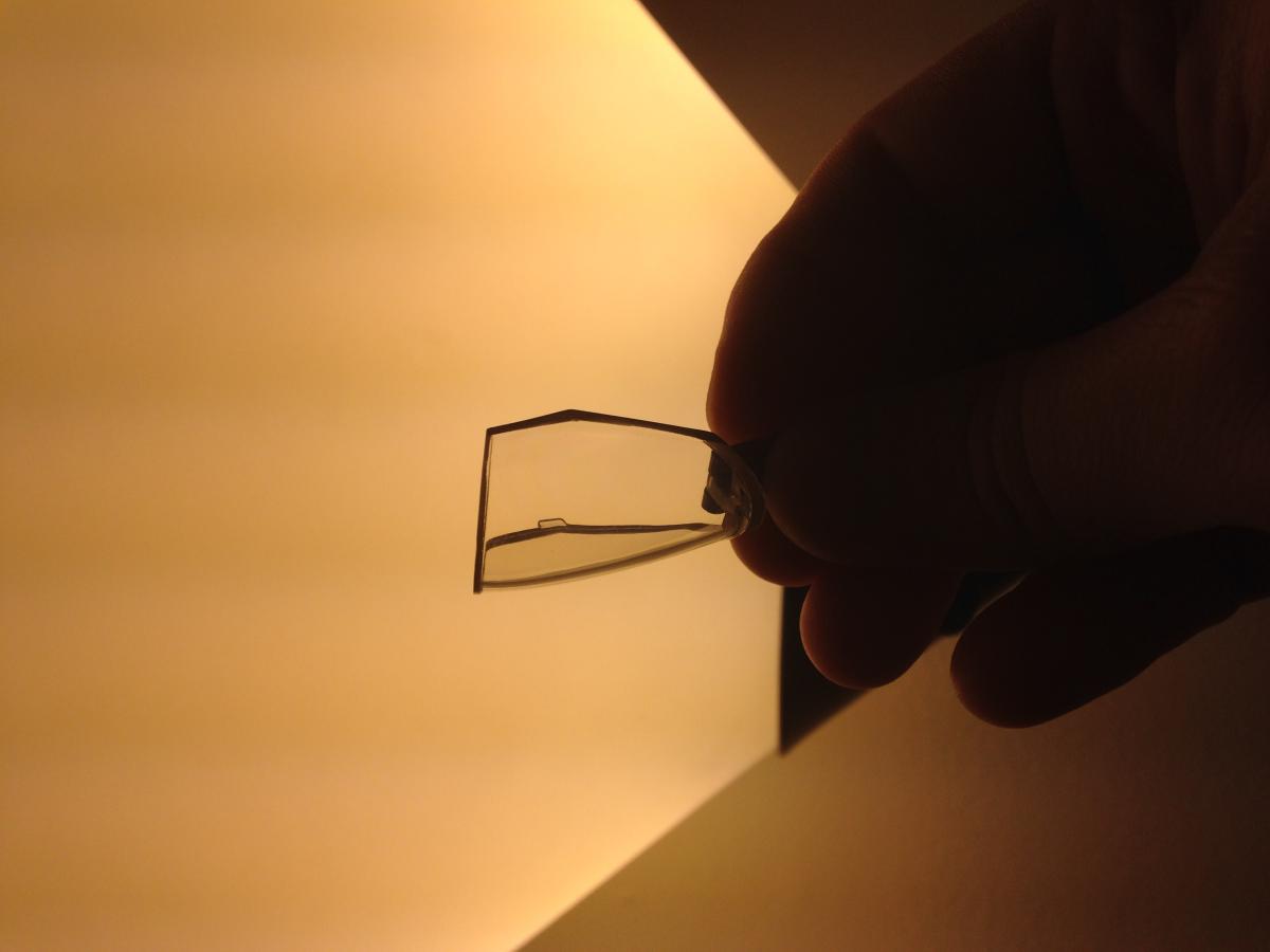

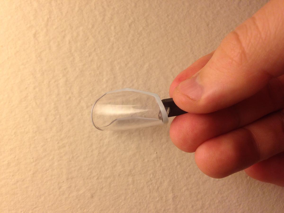

ok, i'm finally done and totally got rid of the deep scratch on my 0a canopy. it took 2 and a 1/2 football games. (munching on snacks too.)
Edited by davidwhangchoi
Link to comment
Share on other sites
Guest davidwhangchoi
What did you do to get rid of the scratch?
ok, i just posted photos on the post above.
i didn't use any sandpaper. just household toothpaste and clean white t-shirt corner.
i have meguiars scratch x remover and zymol somewhere in my house which buffs out scratches on high end instruments w/ delicate finishes, used with mircofiber cloth that i use on my 5k guitars. (works on cars too) but i didn't even bother.
toothpaste works fine. the brand that works best on clear plastic is crest complete multi benefit w/ extra whitening. my scratch was really deep but it came out after rubbing mildly for about 5 hours w breaks.
great work David! One of my Zero-D has a slight mark on its canopy but its the one I keep in Baattroid so its not visible but your scratch removal method seems to be very effective! Means I now have an option in order to rectify the issue!
Wow, very nice! I have scratch X I use it on my car, good to know I can use toothpaste I'll note the brand. Leaves your canopy scratch free, minty fresh and whiter in just 1 week. :lol:
Thanks for posting this up!
yeah no additional purchase necessary, you can use basic household items to fix it. just make sure to avoid the paint outlining the canopy
and to apply pressure evenly while buffing by holding the inside with your thumb to counter the pressure as the clear canopy is fragile.

lol, i just take my window off when transforming it after scratching both sides. one side was light and the other side was 2 separate really deep scratches. i thought it was a goner at first.

yeah, for some reason scratch x felt too liquidy in the past tries... to buff a deep scatch on such a small surface to maneuver. that crest tooth paste gave me a bit more friction perfect for the small area. i used that crest in the past to buff out a deep scratch on my Accord headlight. (it unclouds and makes it clear and shiny too)
