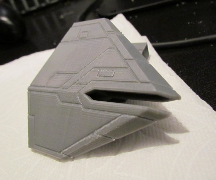

Using brand new Qidi X-Max, I was rather shocked at how solid the reviews (and example print photos) for it were on Amazon, and decided it sounded like a better (and bigger) deal than the other enclosed printer I'd been looking at.
Honestly though, while I'm a little disappointed, I can't say I'm frustrated, or even upset.  You have to keep in mind that the part I was trying to replicate is a 1/72 Bandai Tie Interceptor gun.  I got the CAD model built just fine, but the details are nearly microscopic.  I mean, that part I pictured is only 20 mm long, and the part has details on the 0.1 mm scale.
I might try a few more temperature settings, since I think I was overcooking my ABS, but I think it's probably unreasonable to ask a 0.4 mm print head to duplicate something that tiny. :lol: I've done a few quick detail prints to gauge the printer's ability to print engraved panel lines, and I've gotten down between 0.5 mm and 0.25 mm before things lose definition.

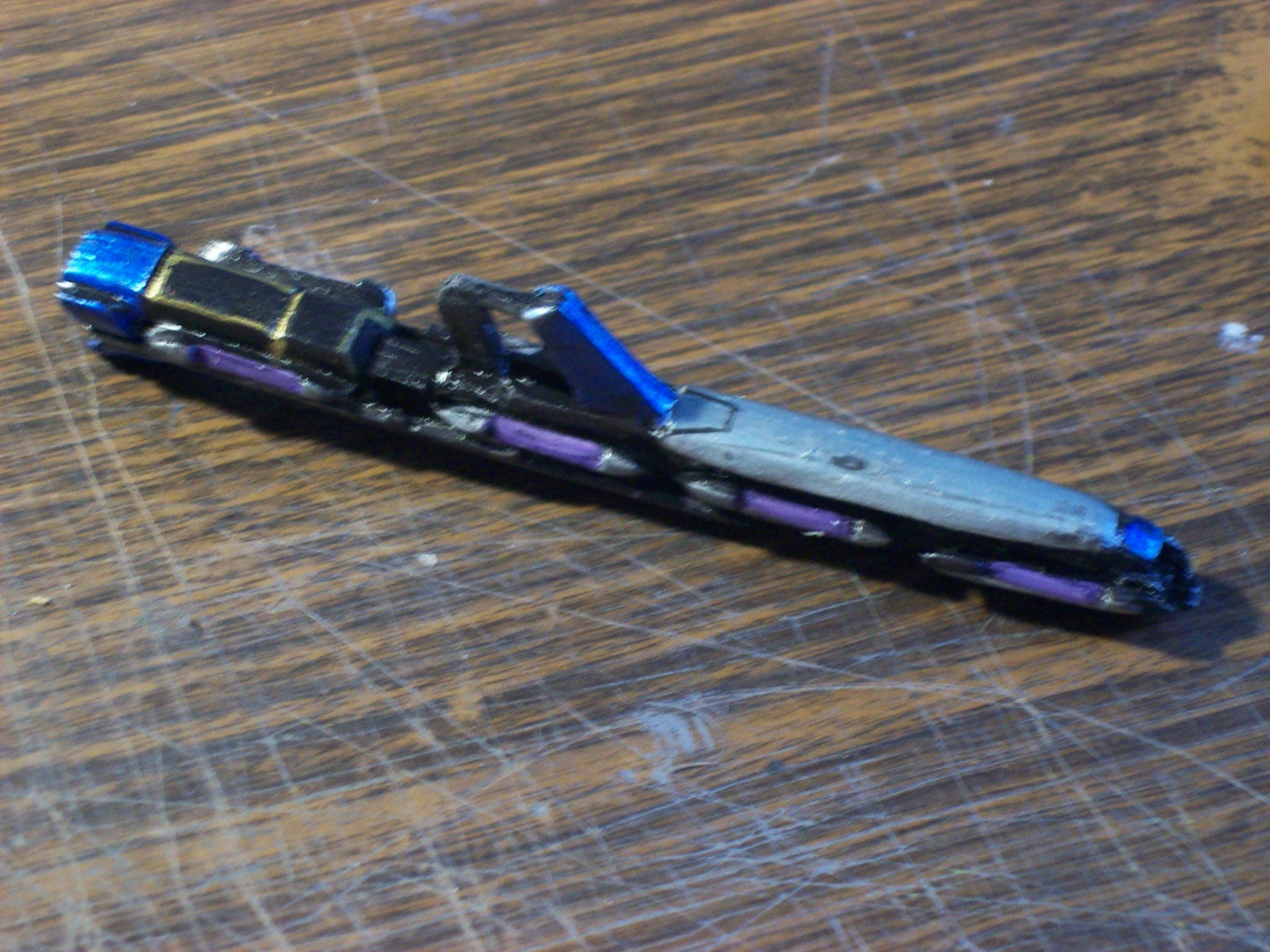

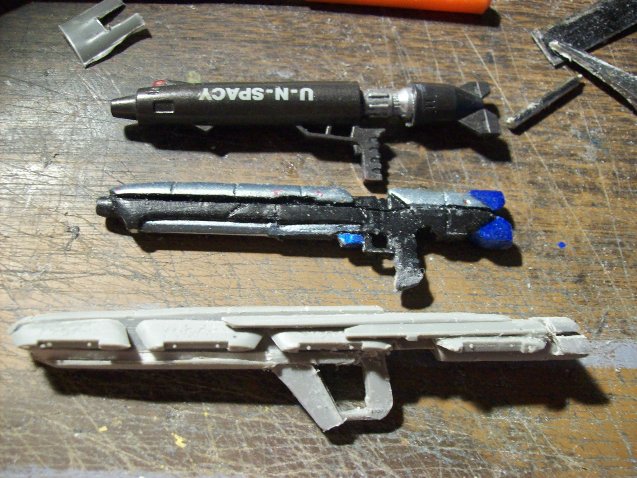

After seeing the beam gunpod unit for the VF-31J in Macross Delta, I wanted to develop one of my own for my custom valk. So, I threw some spare parts and odds and ends together to see what I came up with.
Here it is compared to the GU-11 and the original gunpod I designed for my valk; as a joke, i nicknamed it the "F-U2 Advanced Beampod" :p :
And of course, "in hand":

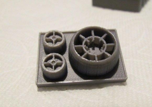

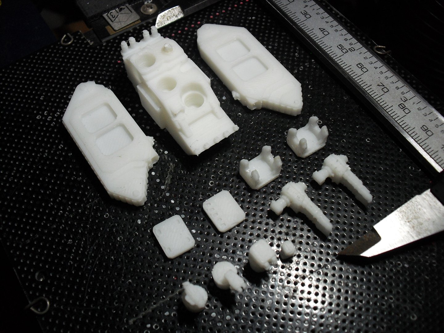

I managed to print something smaller, and with slightly less horrifying results. The trick I use is to keep dimensions above 0.3mm in the model - the printer recognizes the detail as "large enough" so it doesn't ignore them in the g-code. But sometimes, there are way too many details to keep track of, so they don't negate each other.EPIC_LANDRAIDER_ASSY_EXPLa.thumb.jpg.80d10058fb84429ba212049cbfb14c6e.jpgDSCI1356a.jpg.e519268956c597d12e39812b0ab5d683.jpgDSCI1363a.jpg.43f94baffae49c30d5afdfdb1c3f36cb.jpgDSCI1614.thumb.JPG.0c1404581f0276d5b073a62c3a368582.JPG

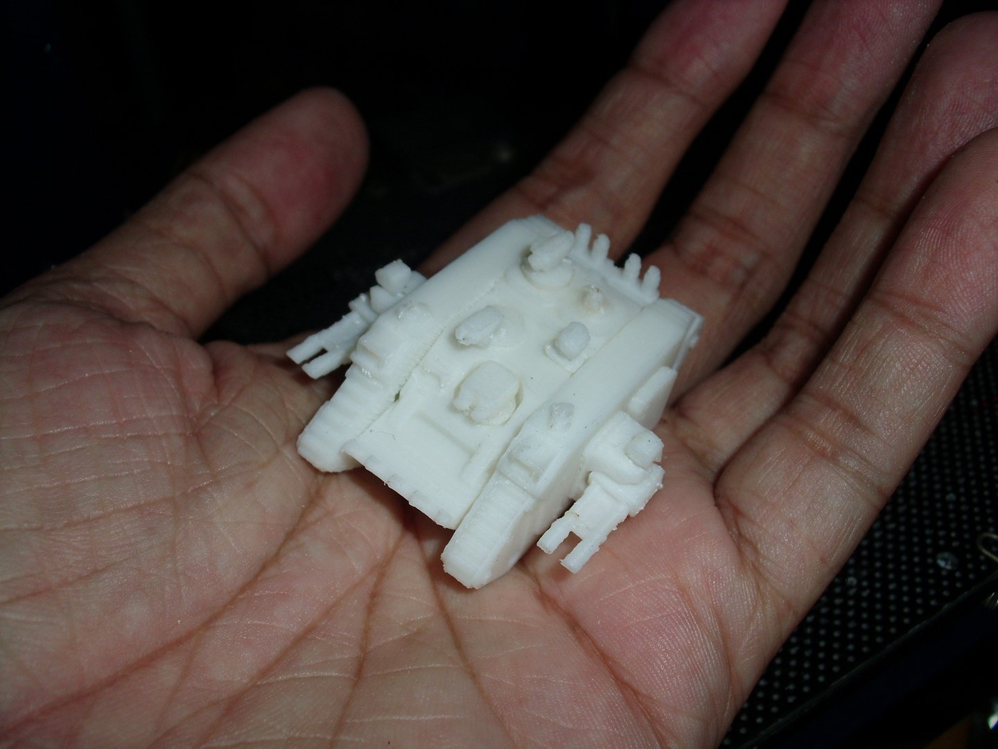

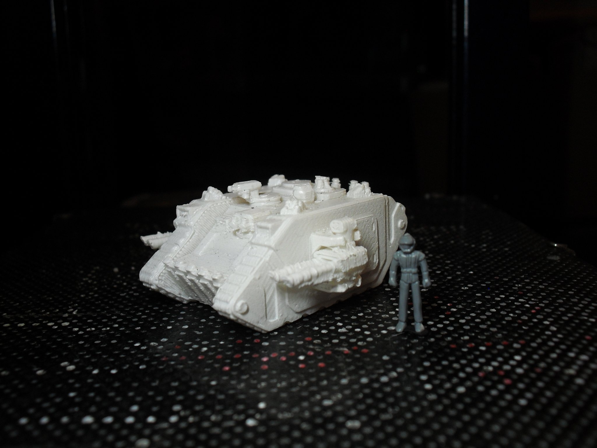

Oh, and... surprise WH40K model!
That's a pretty awesome little kit!  I might dig out my Up! printer and set it up alongside my new one, just to compare later.
What really killed that print was just purely that I was trying to replicate an injection molded part with a much smaller resolution than the printer, and a lot of very tightly-packed fine details.  The only reason I attempted it in the first place was because the printer had managed to spit out the tiny wing cannons on my Excalibur model flawlessly, and they're of a very similar size/diameter.  The big difference is that they are just simple cylinders, with no overhangs, and the only details are vertical strips at the base.  The Tie Interceptor cannon was actually small enough that entire portions of the model were ignored.
I'll post a couple better pics later of my test shots for the tail and exhaust nozzles, which turned out beautifully.  I managed to confuse my cutting profiles, so the tail wound up with 0.375 mm panel lines when I intended 0.3, so I may run another, but it looks really clean regardless.  I think the only pseudo-complaint I have with this printer is that it seems to take a really long time to produce a print, but I also think it's mostly my own fault for printing things on the finest quality setting.  In the end, I think the results have been worth the wait.

Thanks! It's in Epic scale (I think). The STL's are free if anybody's interested in it, although I wasn't able to layout the parts for proper print orientation (I figured different orientations work for different printers).
Micro Land Raider .stl files
I pretty much go for a "close enough" model for printing, it gets sanded down & improved anyway, so any fine details the printer missed is "recovered" later.

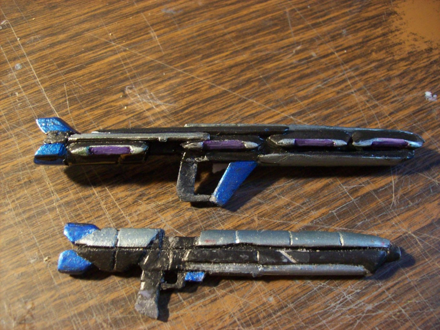

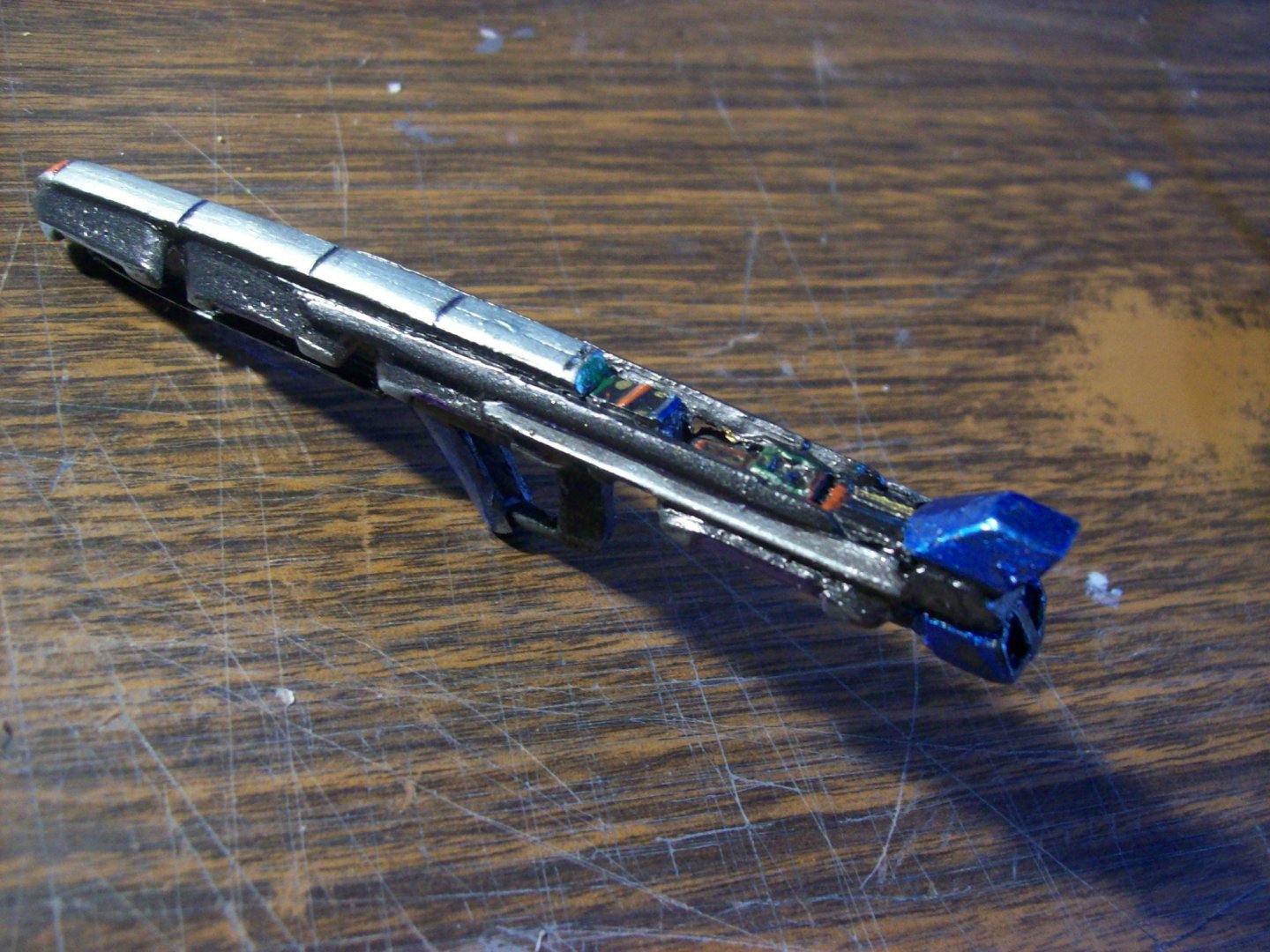

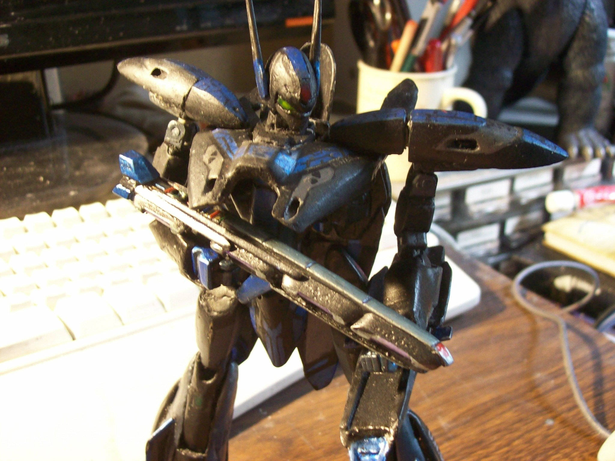

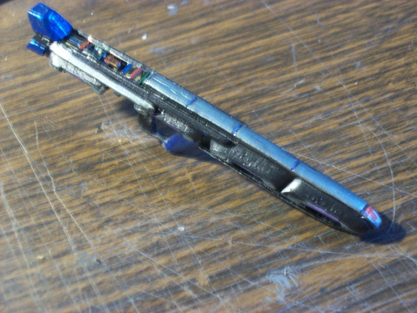

Speaking of guns, I have the new gunpod (with the "official" designation of GU-49 "Gilead") painted up and sealed
In comparison with the smaller original gunpod; I'm planning on using both for this mech as "combat options", with the smaller one being for close-in combat/ melee and the larger one for anti-ship/ fleet ops:
Rockin' the Gilead:
Yeah...ya really don't want to be on the wrong end of this one!

Regarding the 3D printers, thanks for the updates guys! Chronocidal, your print did look too hot with all the melty blobs. I'm seriously thinking of getting a 3D printer, but will have to upgrade my mill first. I'm currently taking my lathe head and swapping it out with my mill as I do one or the other. My mill machine head failed (cheap Chinese circuits). I have a Sherline lathe and bought their adaptor that I machined to fit my mill. Now the same machine head is doing double duty. I'm thinking resign printers too for detail and to minimize bias marks. The only downfalls are that they are messier and the resins can get brittle with age. I watched a factory made model of the X-32 break itself under its own weight over time as pieces got brittle. I just HATE the bias marks that spool style printers can add too. Plus the de-laminating of layers too. -MT
I did seriously consider just printing everything clean, and then scribing the panel lines myself, since that would make the marks absolutely minimal.
Finding the right temperature with a spool printer is the key though, and can make a huge difference.  Personally, I just prefer having a material I can work with.  Small parts I can just scratch build from styrene scrap, but large components are just nice to have ready-made.

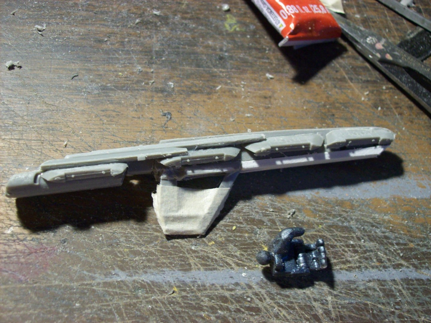

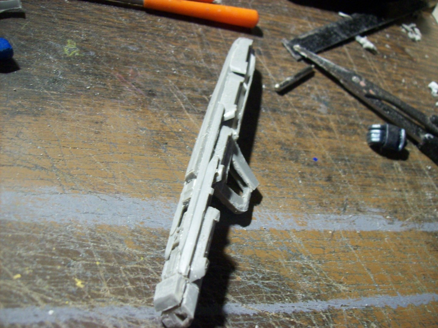

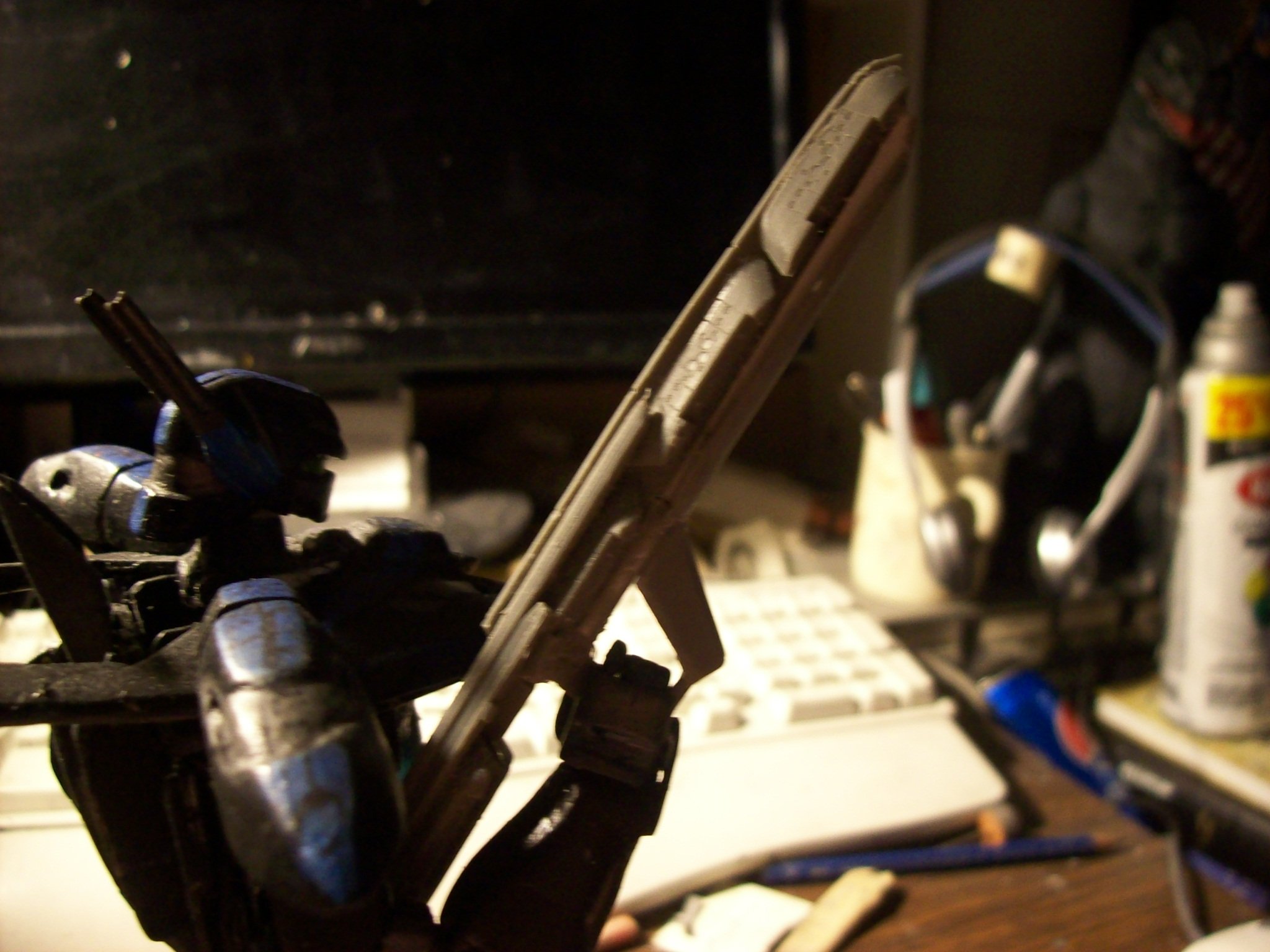

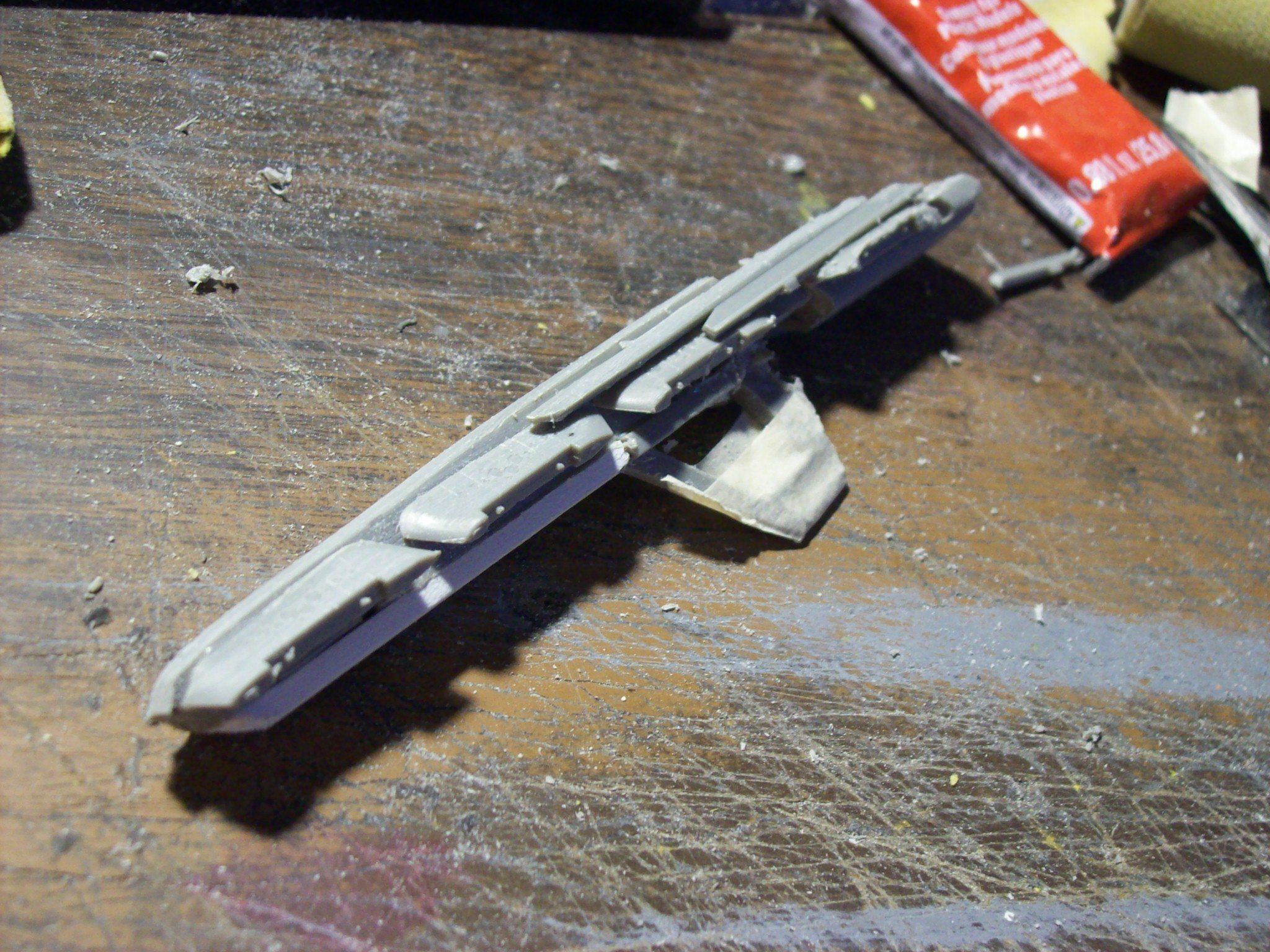

The back end/bracket is done. I drilled the heck out of it to lighten it up. The second photo shows what everything looks like without the motor. I added bearings and machined some things so the mechanism is smoother. The motor attaches to the left-hand upper bracket. The barrel is still not machined and a mechanism has to be made to feed the cap belt through the white styrene chute. Yes, this has styrene on it so technically it is still a model.;) - MT

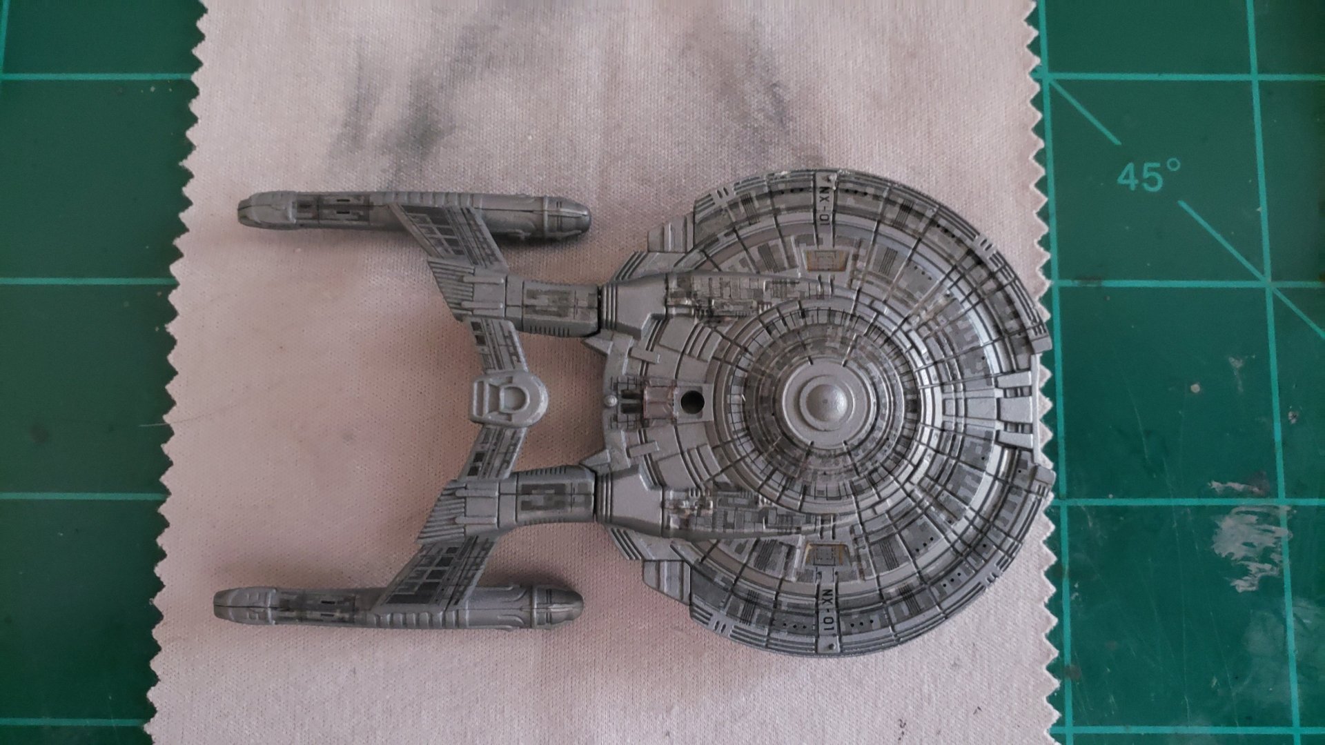

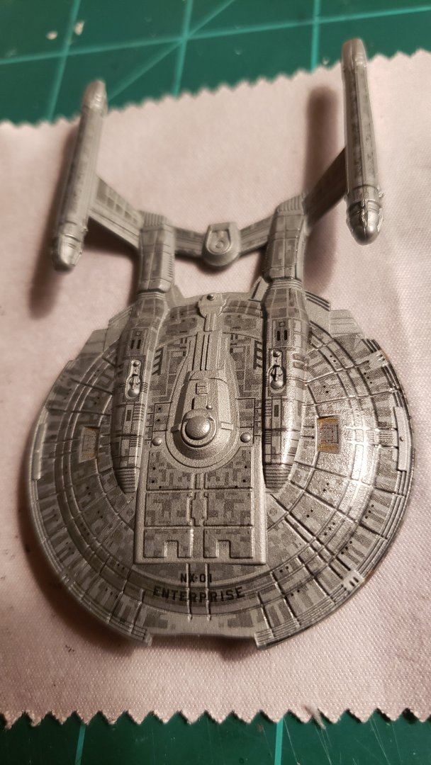

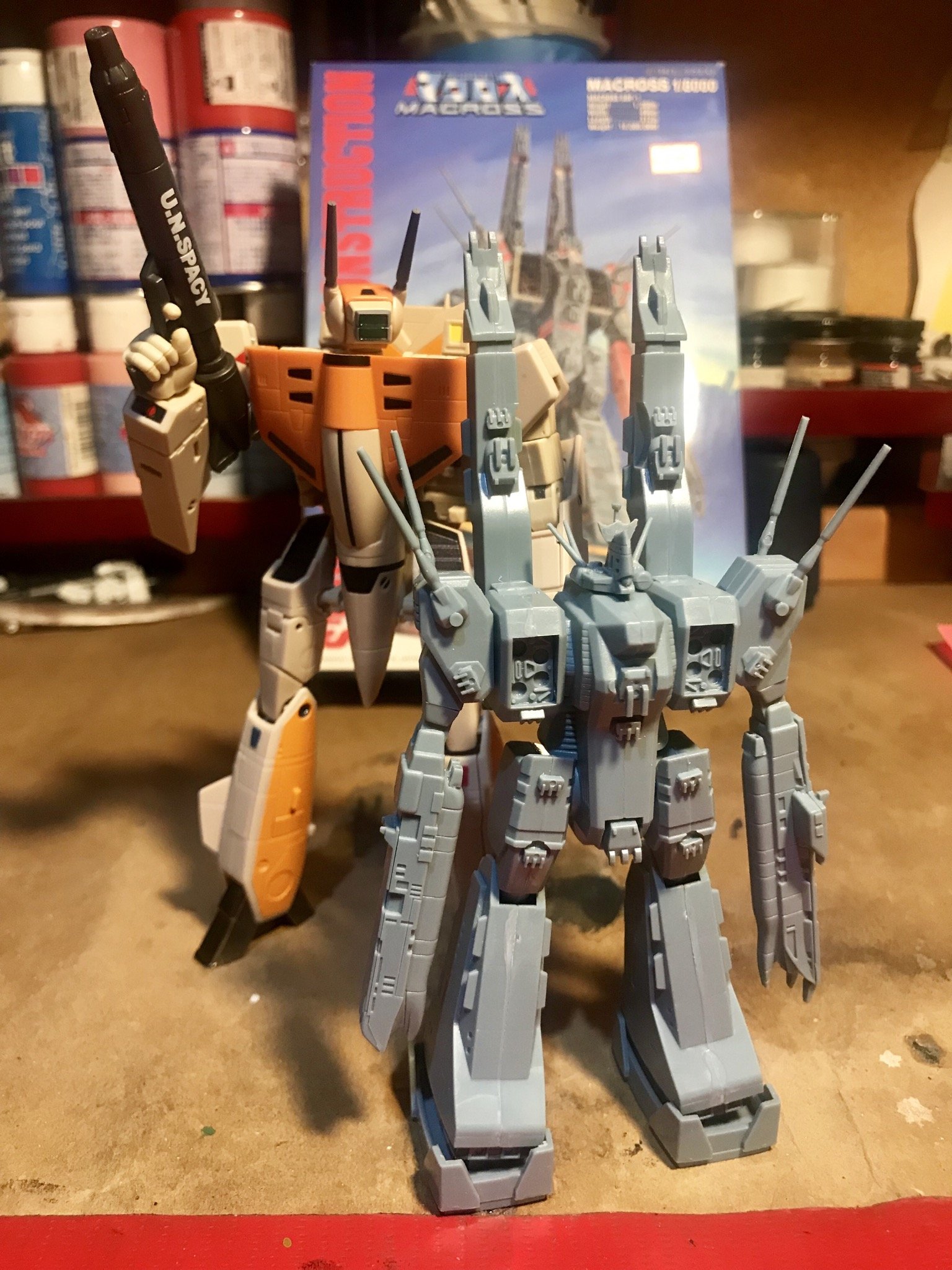

Some good downtime this weekend so I've built the baby Enterprise. Tamiya Primer, Model Master Dark Anodonic Grey Buffing Metalizer (lightly buffed) and now the main draw of these kits..the decals, which so far, are going down absolutely fantastic.

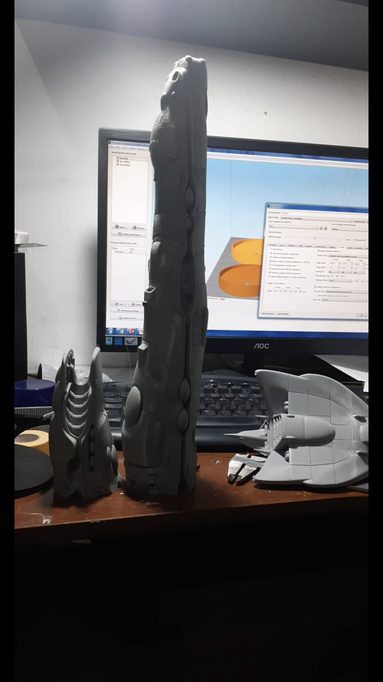

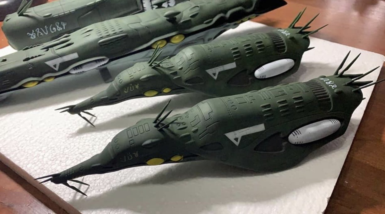

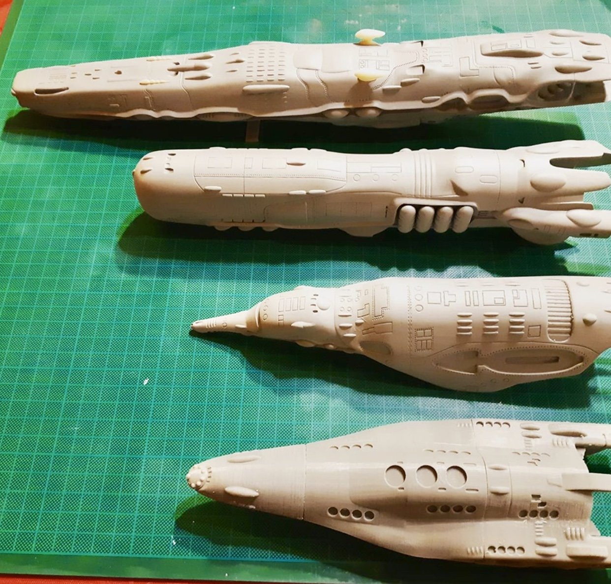

Custom 3D prints.
They’re being printed in 1/8000 as we speak.
Just using the picture as reference. These are 1/10000.
Edited by nightmareB4macross
Pic added.
Mind blown, < insert jurassic park shocked removal of sunglasses gif >
Printing all that couldn't have been cheap.
1 hour ago, nightmareB4macross said:
The guy who prints these is on FB and does these quite often in 1/10000.
He’s over at the Macross Modelers Chile group.
