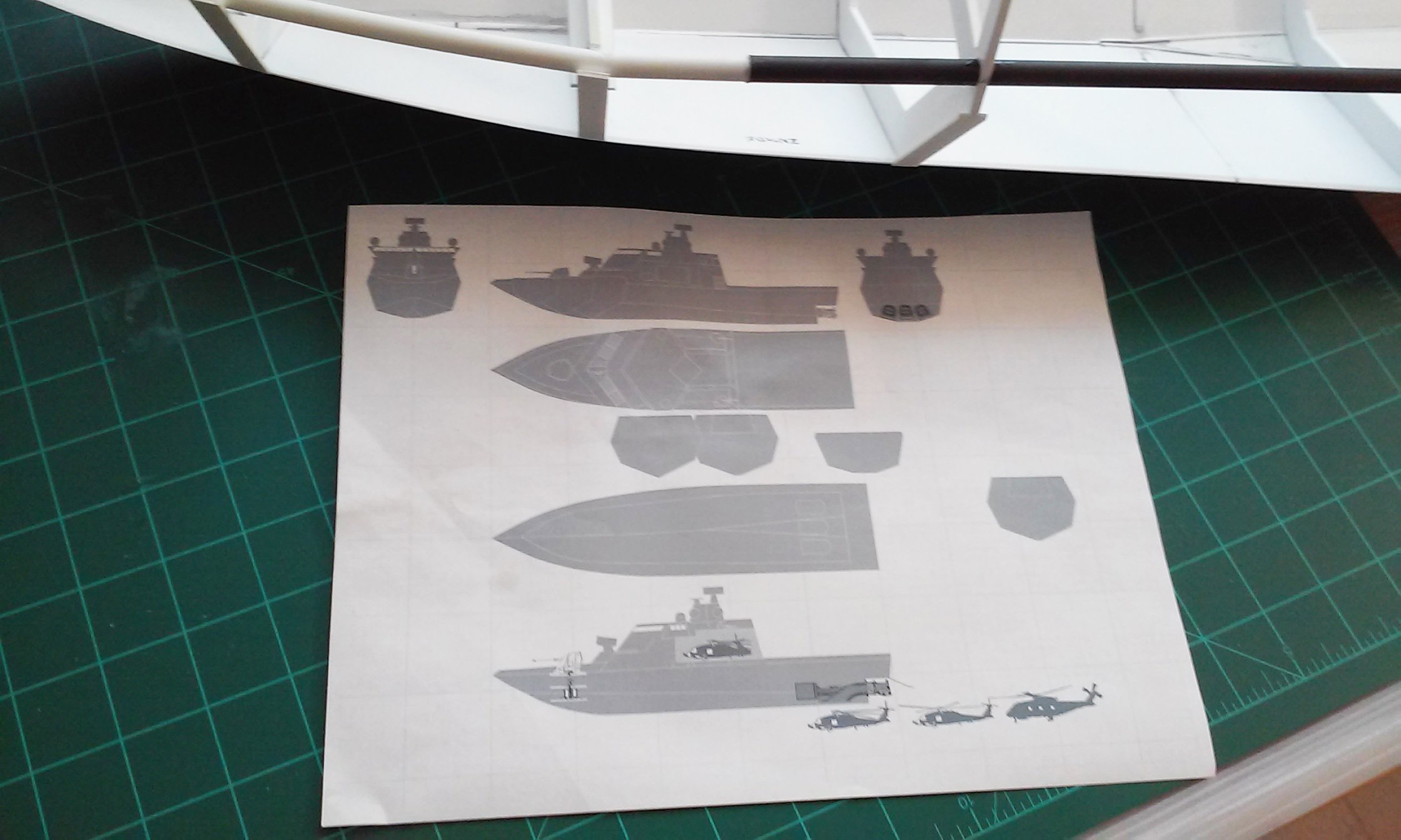

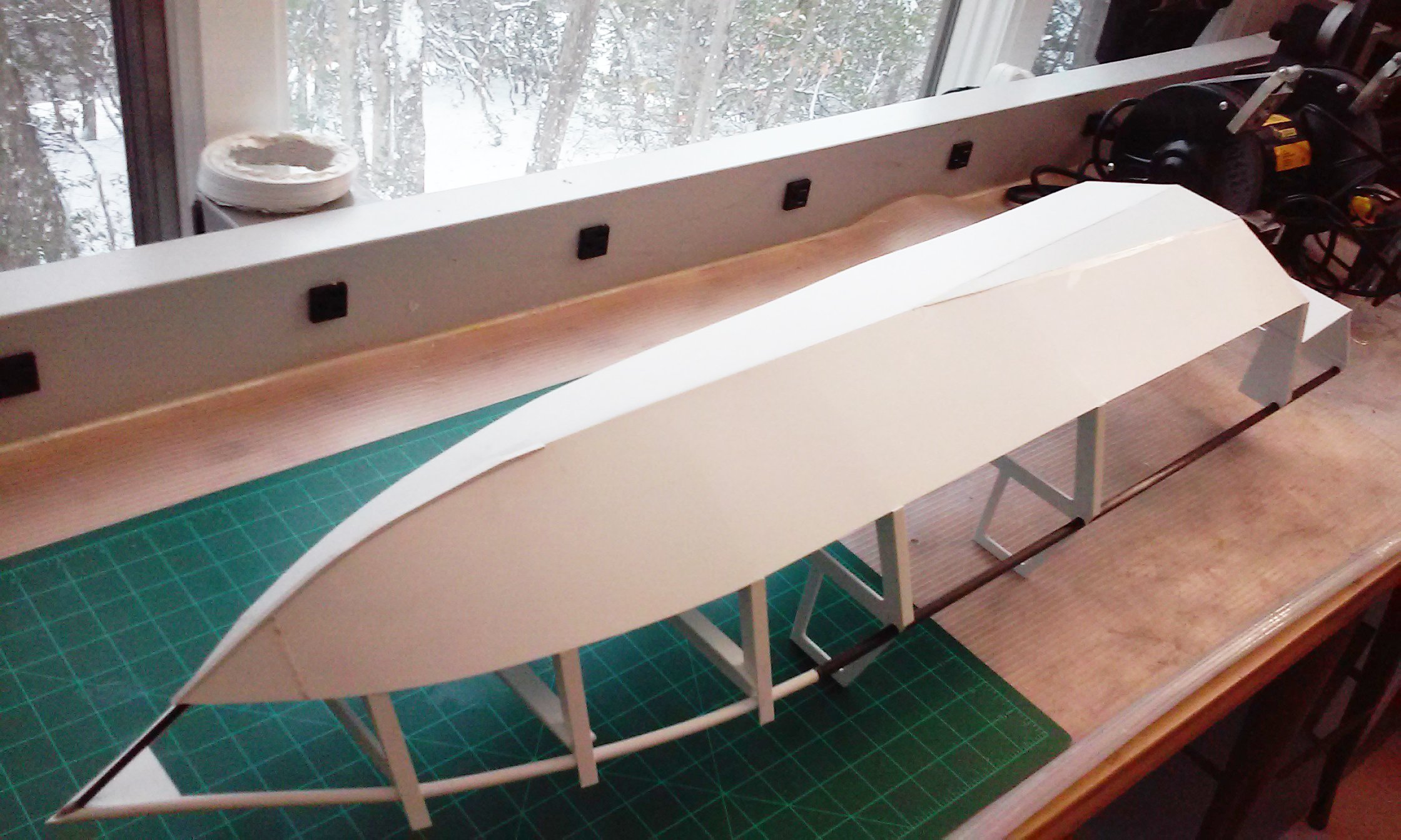

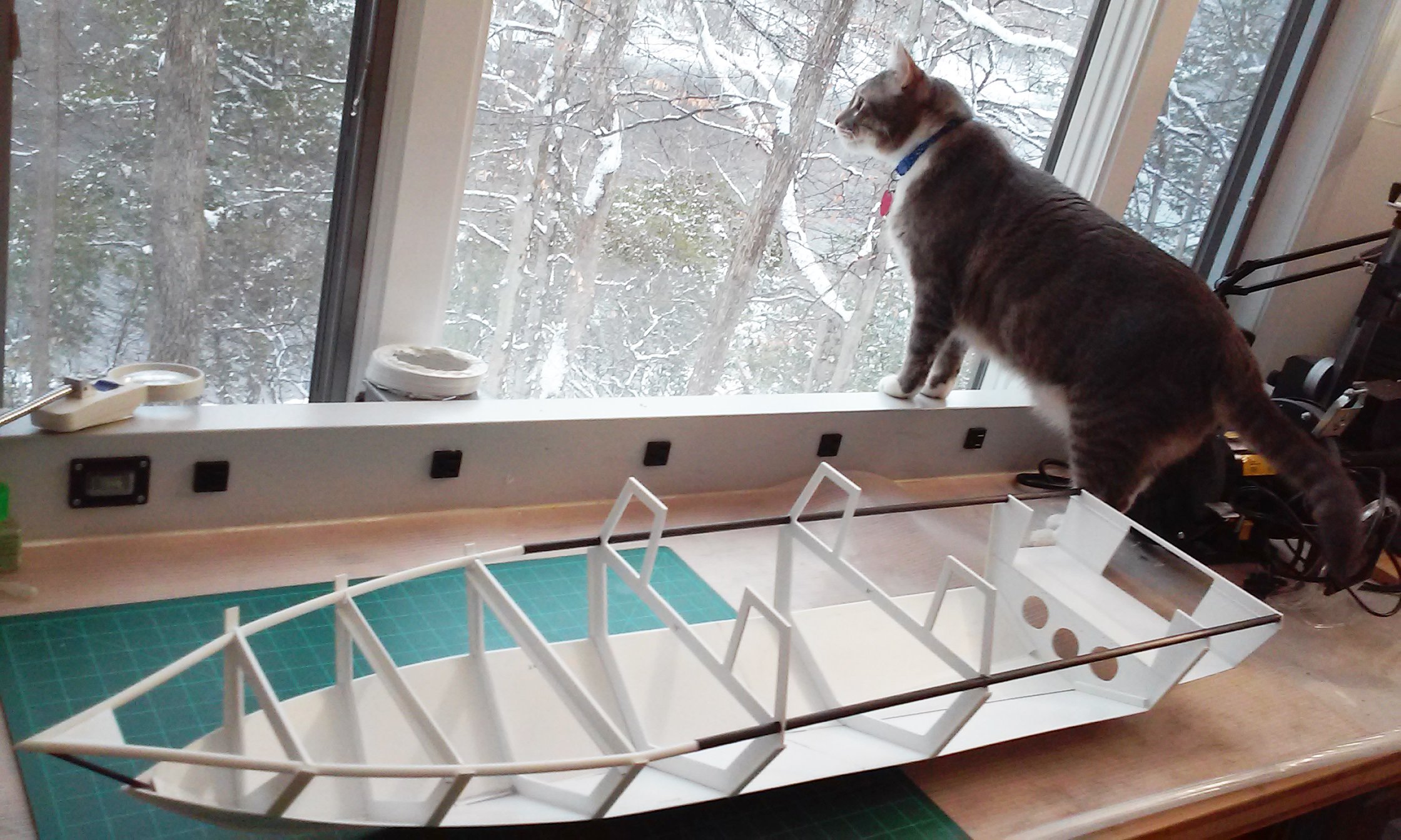

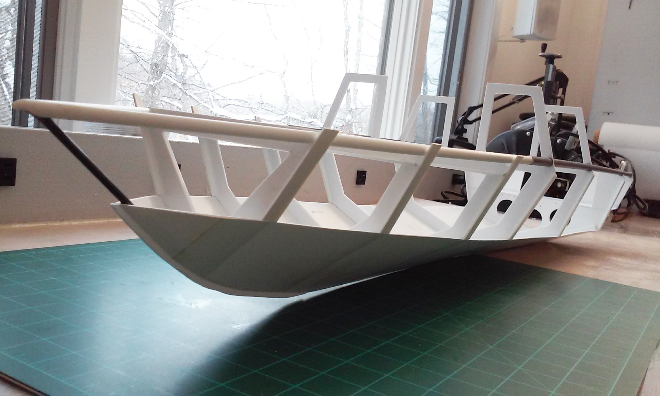

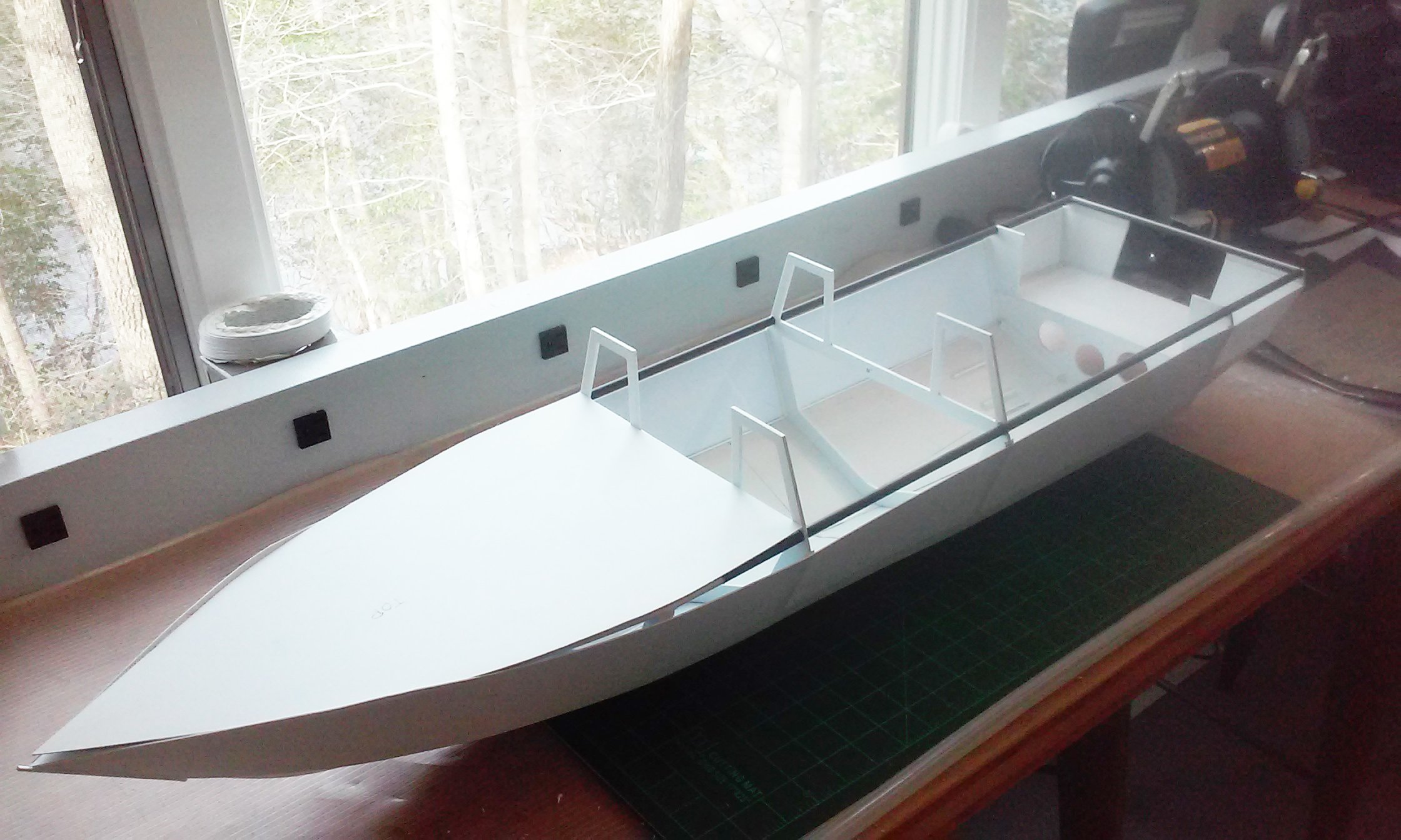

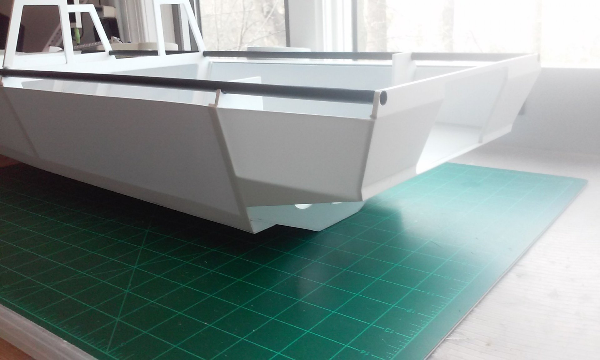

MechTech Posted January 13, 2019 Posted January 13, 2019 Man! I get to work on my model and miss some great builds and good ideas! Lots of great stuff guys! And happy belated New Year too! Starting Christmas 2018, I finally started on the scratch built ship model. Months back it started as a card stock cutout after drawing it 2D for design. Everything is low tech for now. The bottom is one piece of styrene that was actually cut and folded (after lengthening it). Then came the ribs. I'm using cleaned up carbon fiber arrow shafts on sale for $4 at the local sporting goods store. They give stiffness and are so light. The ship will be 40 inches long and have three jet drives. The last photo is CFS (Cat For Scale). - MT
Grayson72 Posted January 13, 2019 Posted January 13, 2019 I KNEW this was yours Mechtech! Even before I read the post and had only seen the pictures! Looks awesome man!
derex3592 Posted January 14, 2019 Posted January 14, 2019 I am envious of that view! Pretty kitty as well.
MechTech Posted January 14, 2019 Posted January 14, 2019 Thank you guys! Snow day today! So I got some minor work done aligning the water jets. I'm now cleaning up some arrows for clean shafts to go on the underside. - MT

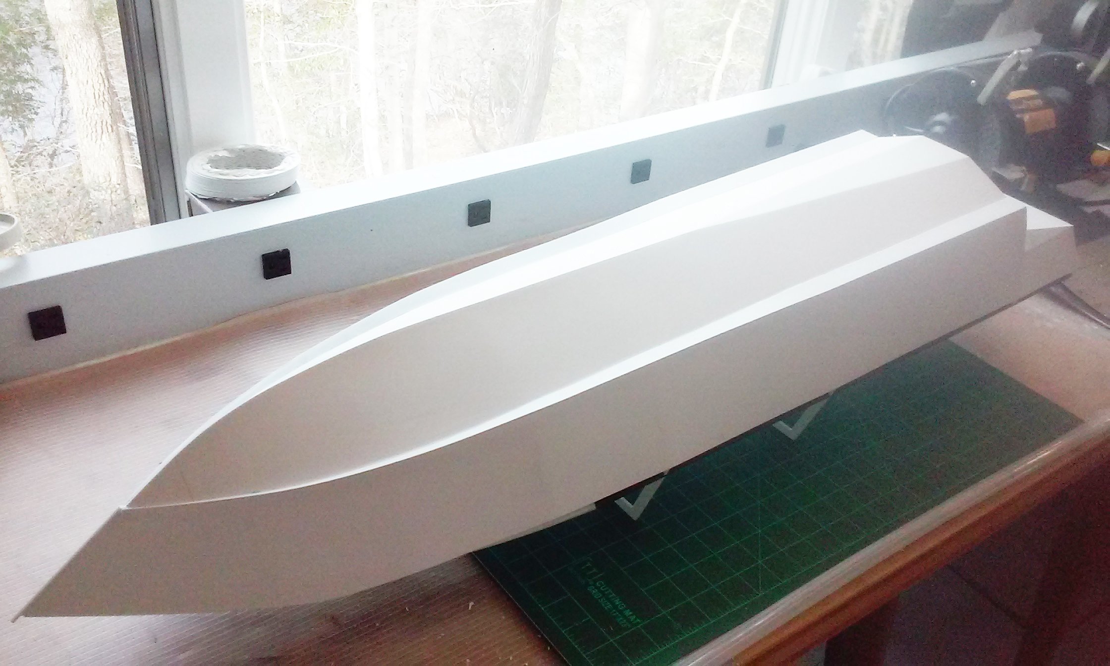

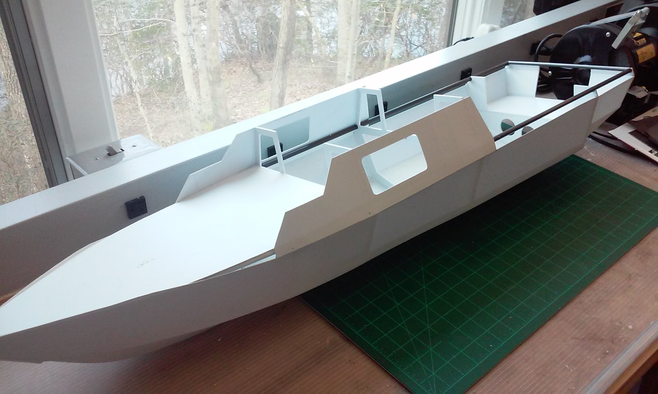

MechTech Posted January 20, 2019 Posted January 20, 2019 Your finishes are always so smooth Electric Indigo! There's sides on it now! The gaps will become "steps" to provide stability and add lift to get it on a plane. - MT

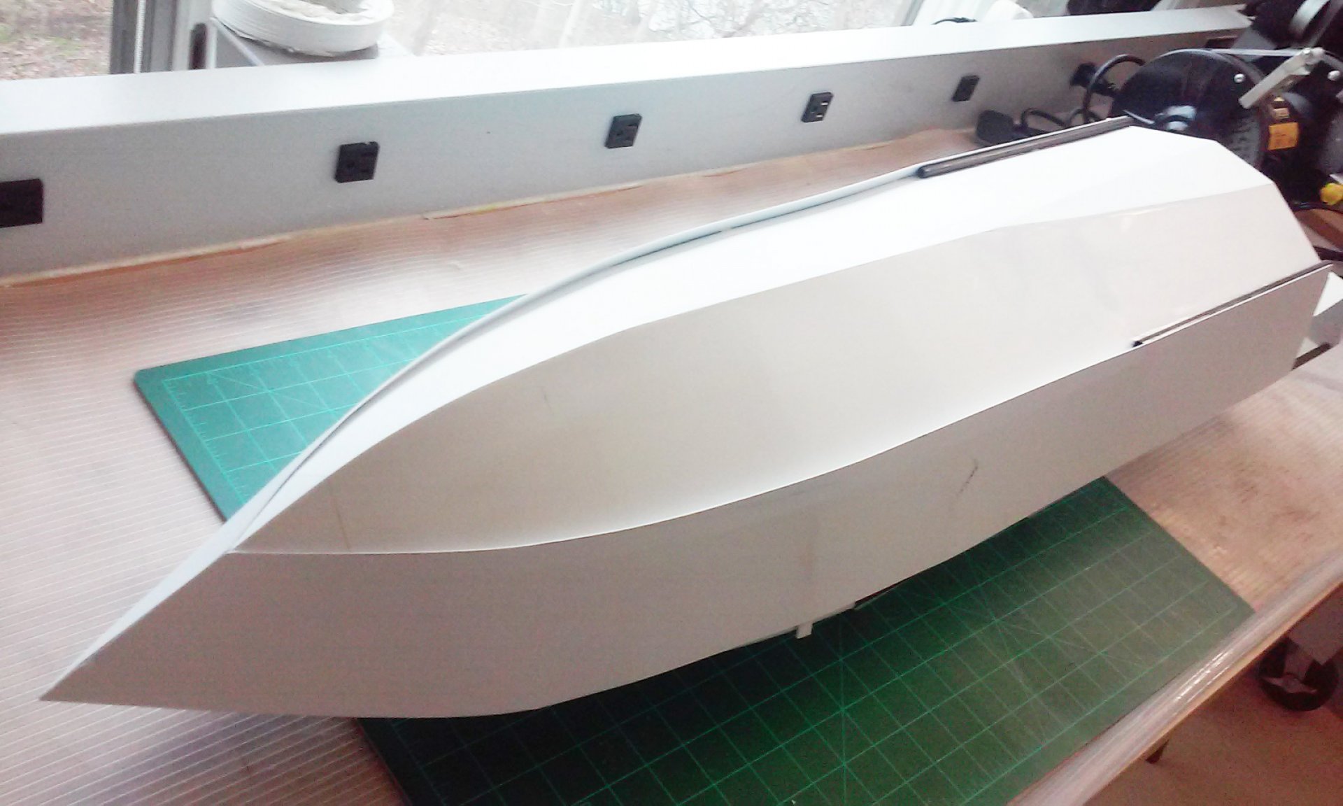

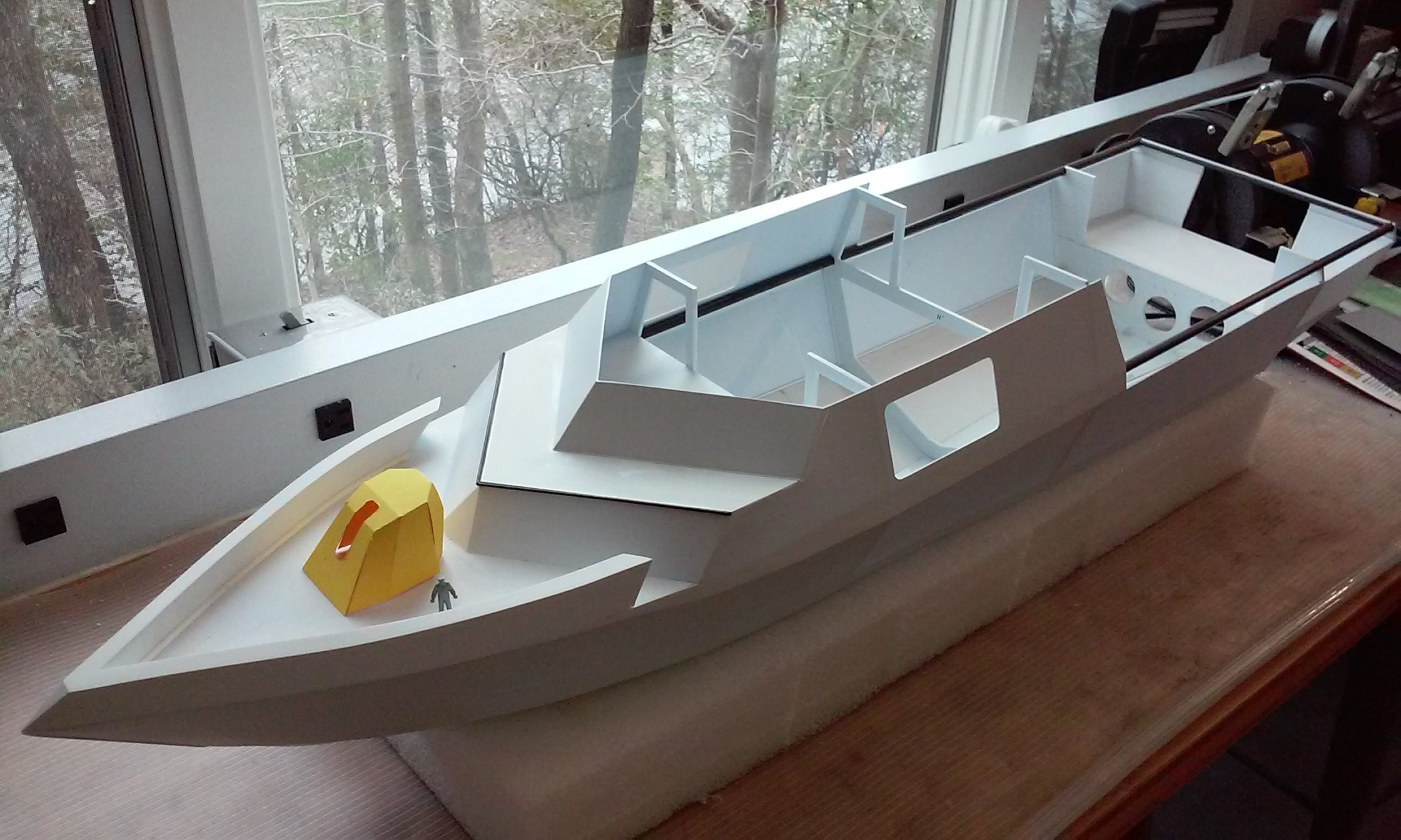

MechTech Posted January 27, 2019 Posted January 27, 2019 Its quiet over here at MW today! The lifting strakes are now done. It was a pain bending them to fit and then using a ton a glue to seal them down. A whole day of sanding just to clean them up and the other joints. Where you see a visible joint is a lot of glue. The top of the bow is just sitting on to measure the rest of the top sides. - MT

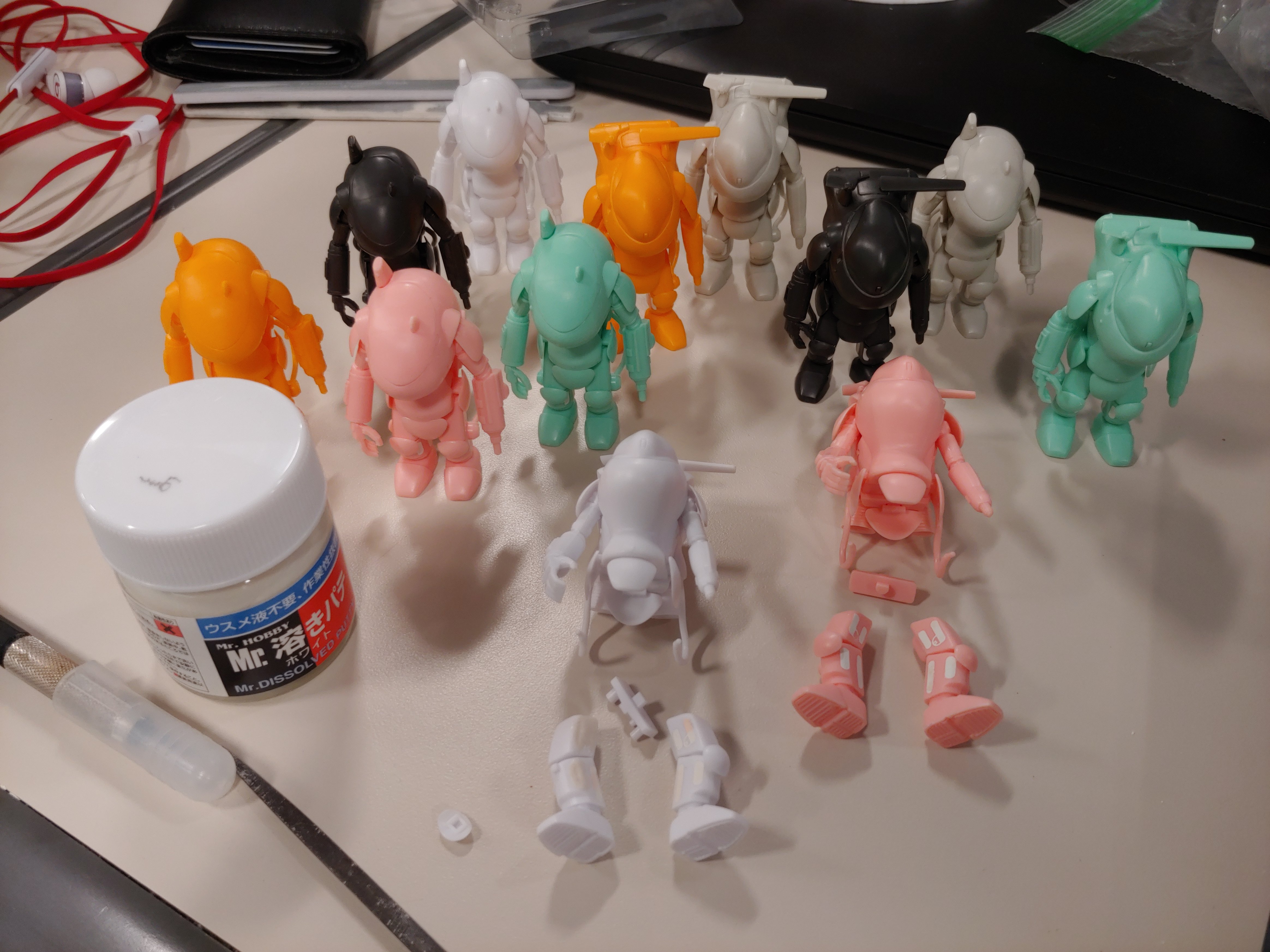

Duymon Posted February 7, 2019 Posted February 7, 2019 (edited) I Just got a set of 1/35 Kaiyodo Ma.K SAFS / Snakeeyes. The clean-up is relatively easy, but I hate the huge gaping holes they have in their legs. I've been filling them first with Milliput super-fine and then fixing the imperfections with Mr. Dissolved putty. After I finish these last two These colorful eggs will be primed and will get some more SD3d-appropriate paint schemes. I love these tiny capsule-toy model kits. They even came with full decal sheets in the capsules. Edited February 7, 2019 by Duymon

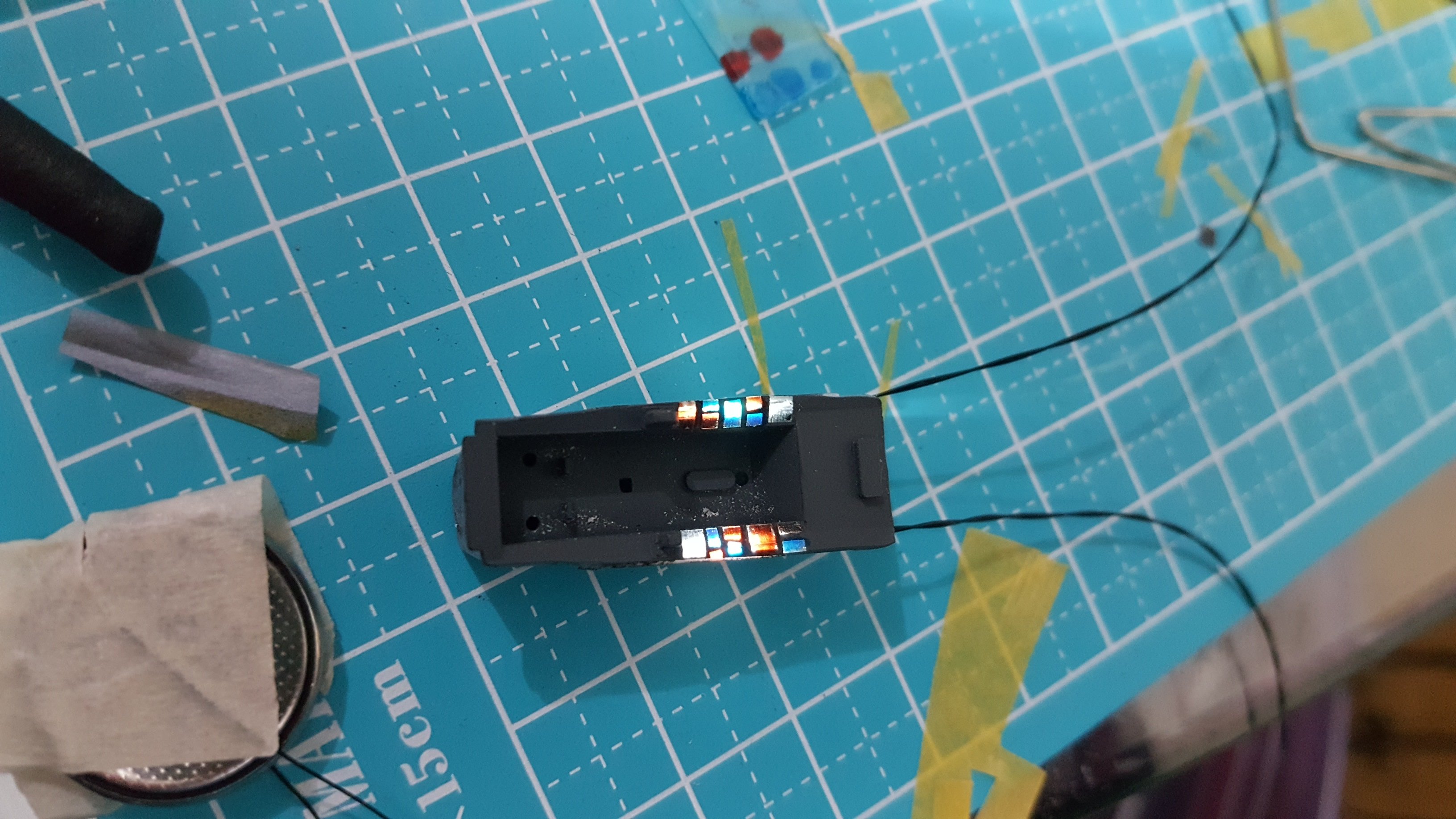

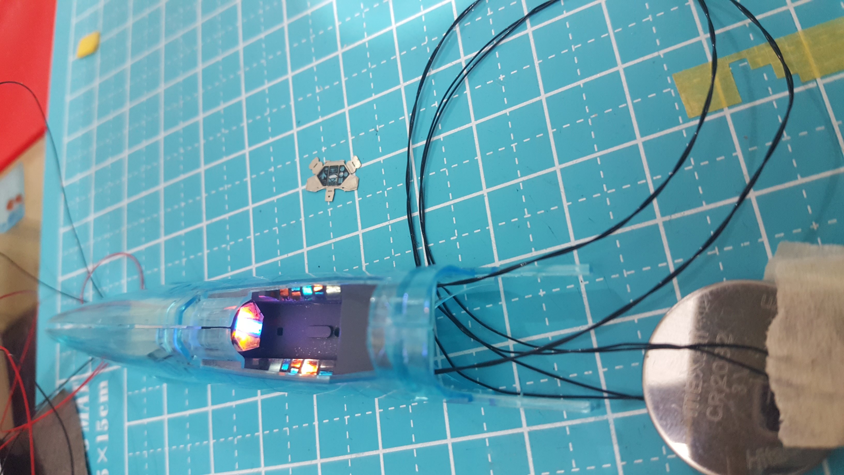

arbit Posted February 10, 2019 Posted February 10, 2019 (edited) This is a new lighting scheme I've been working on a 1/72 vf-1. The control panels are clear parts blocked off with little square pieces of masking tape, then primed thick in black and gray, painted with clear paints, and lit with one smd led. The cockpit screen has three smd leds separated with bits of styrene. All clear parts are sanded down to diffuse the light. Edited February 11, 2019 by arbit

arbit Posted February 11, 2019 Posted February 11, 2019 (edited) 1/72 VF-1 Jasmine photo etch on the screen. Edited February 11, 2019 by arbit
derex3592 Posted February 11, 2019 Posted February 11, 2019 WOOOW -- I can't imagine THAT made for the DX 1J!!!
Thom Posted February 12, 2019 Posted February 12, 2019 On 2/11/2019 at 1:35 PM, arbit said: 1/72 VF-1 Jasmine photo etch on the screen. Real nice light up sequence! Nice work.

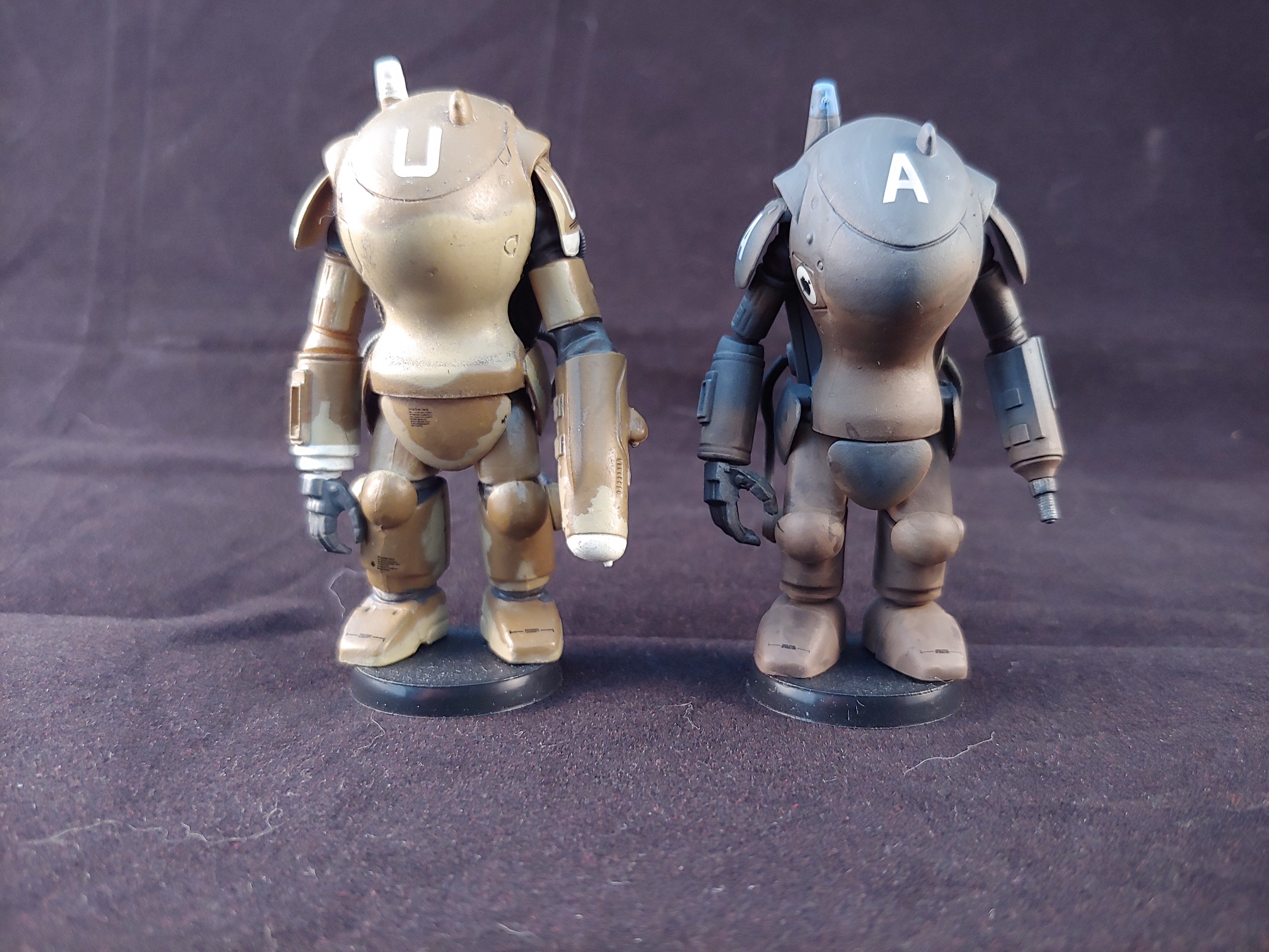

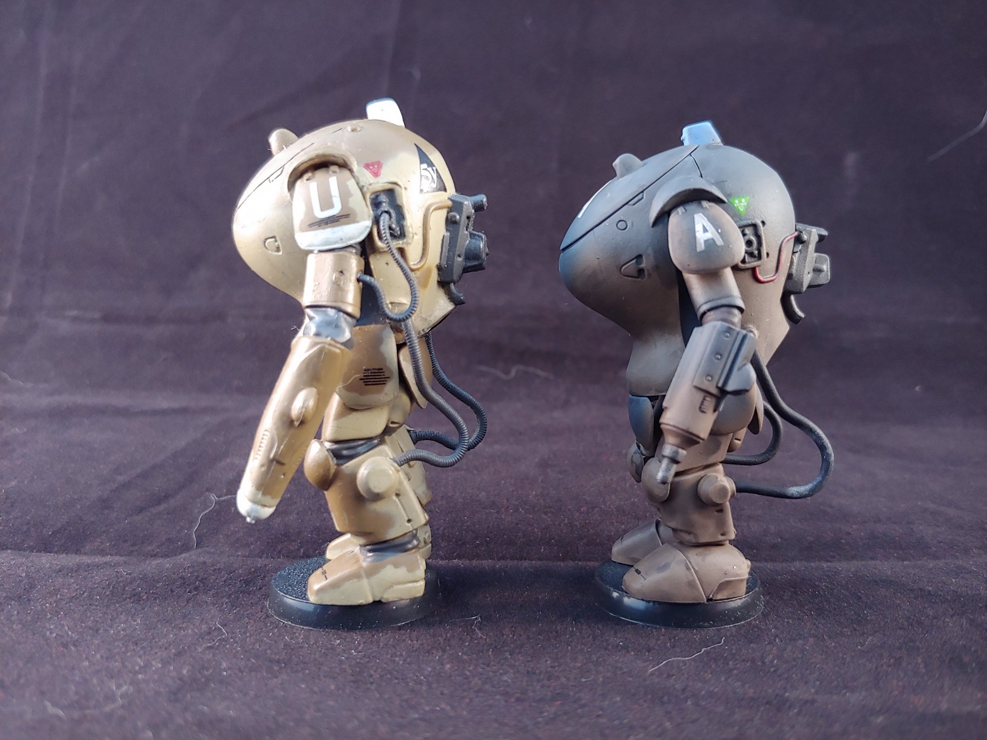

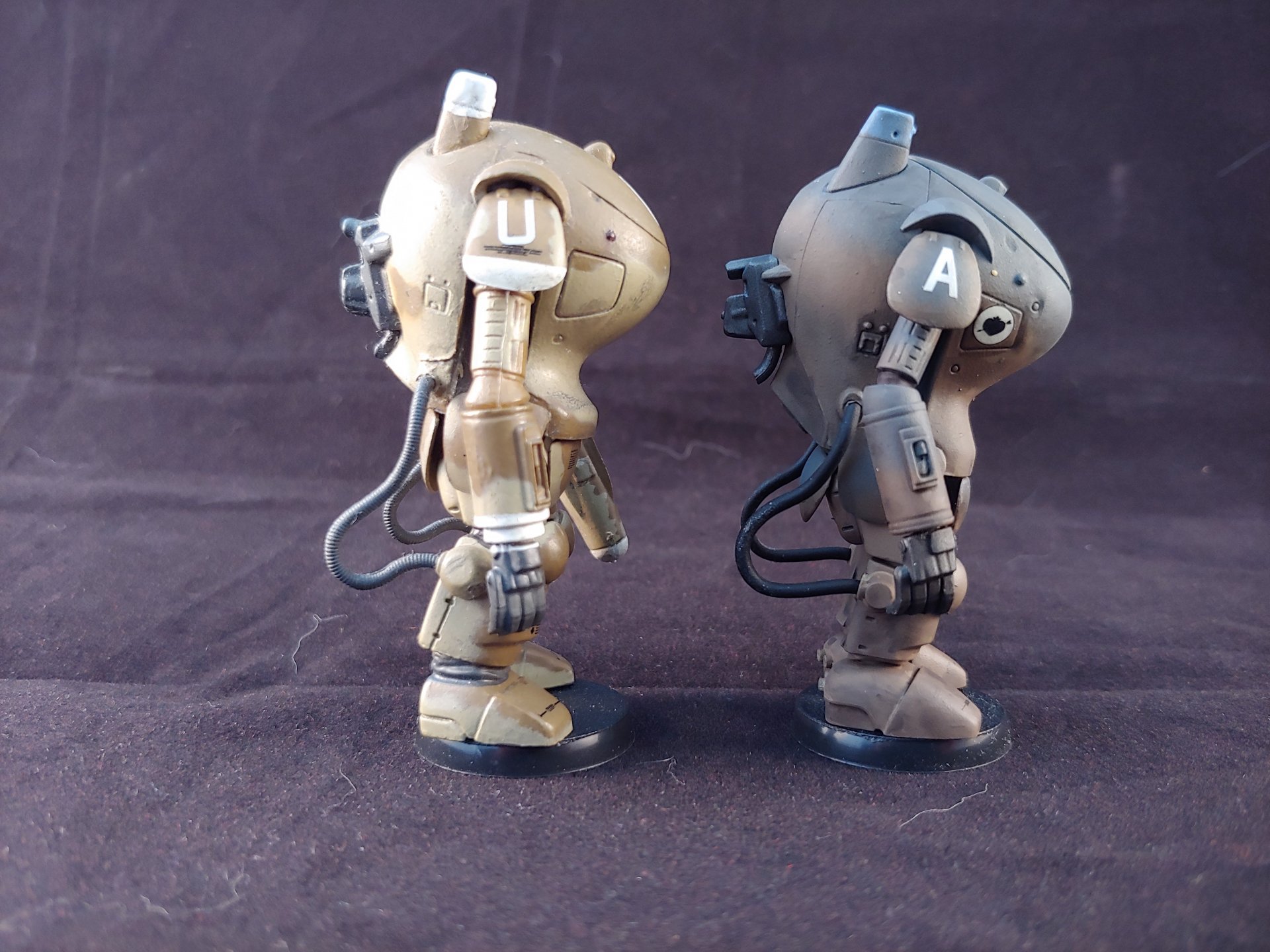

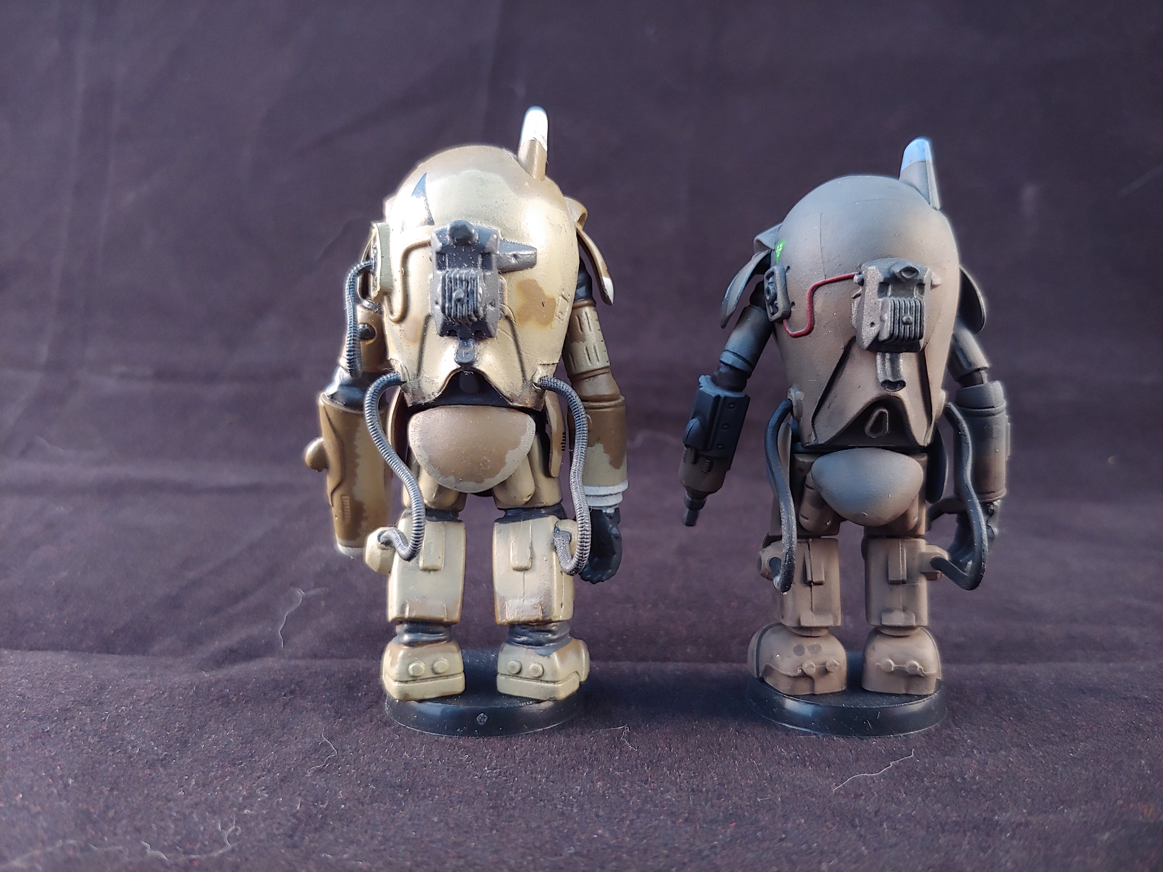

Duymon Posted February 13, 2019 Posted February 13, 2019 I finished up the first of my 1/35 Kaiyodo Gachanen Safs figures. Here's a comparison of it to the good-ole Hobby-Base blind-box fig from 2002. Hobby Base is on the left, the Kaiyodo I painted up on the right. 1 Down, 39 more to go....haha.....damn you w40k army-building sickness

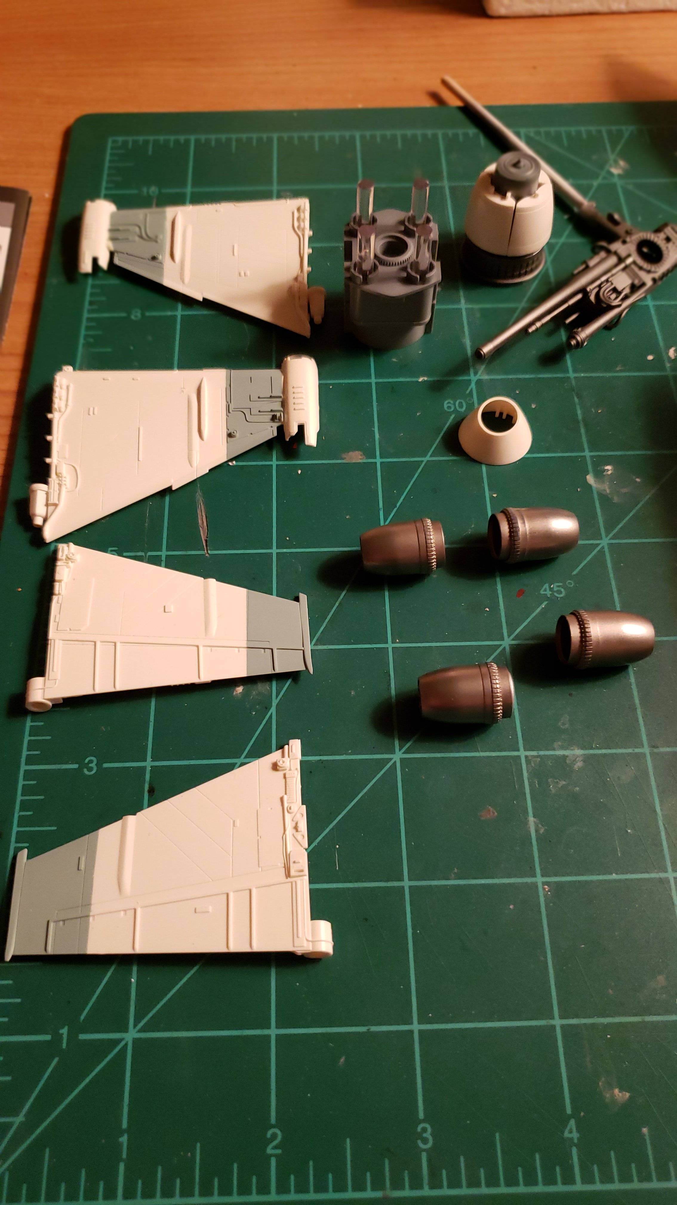

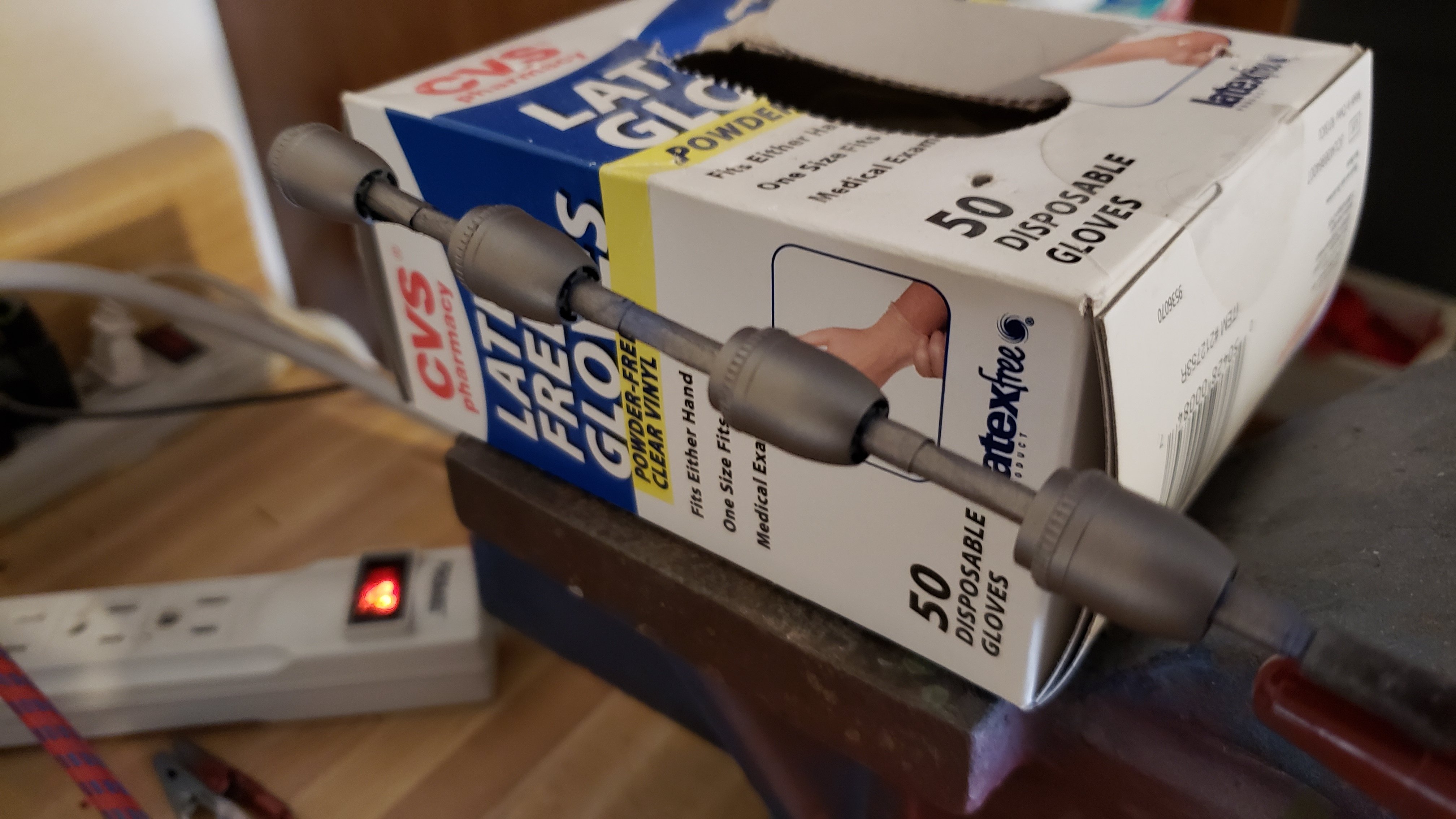

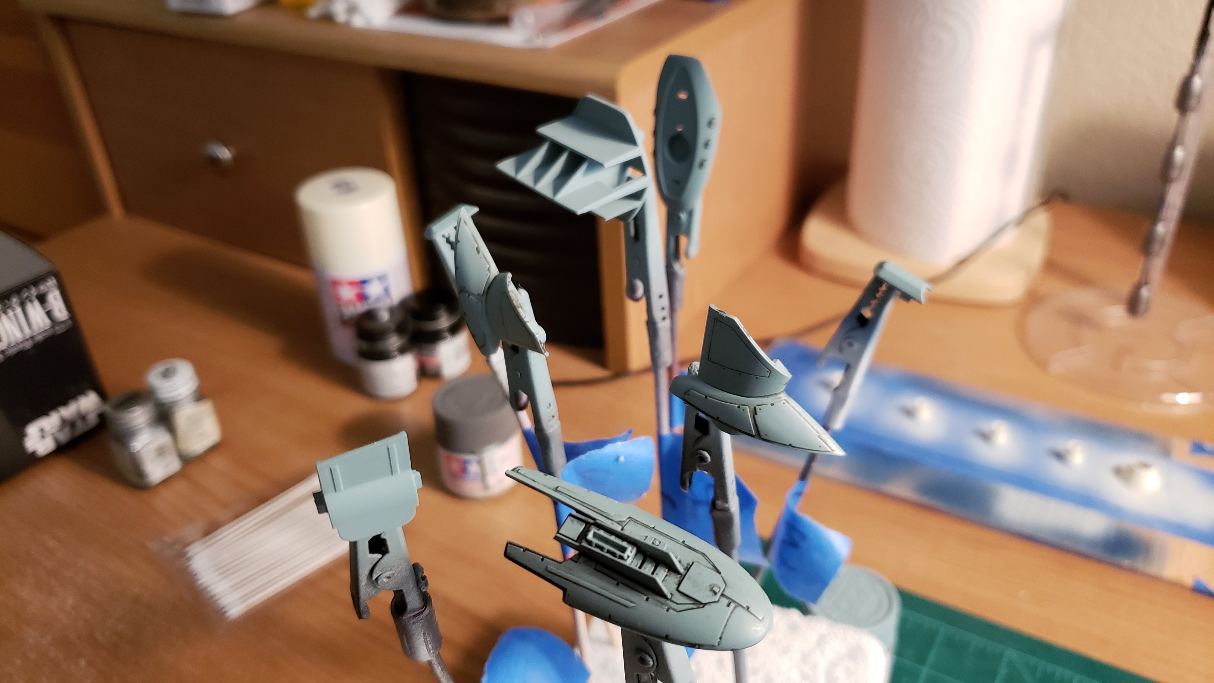

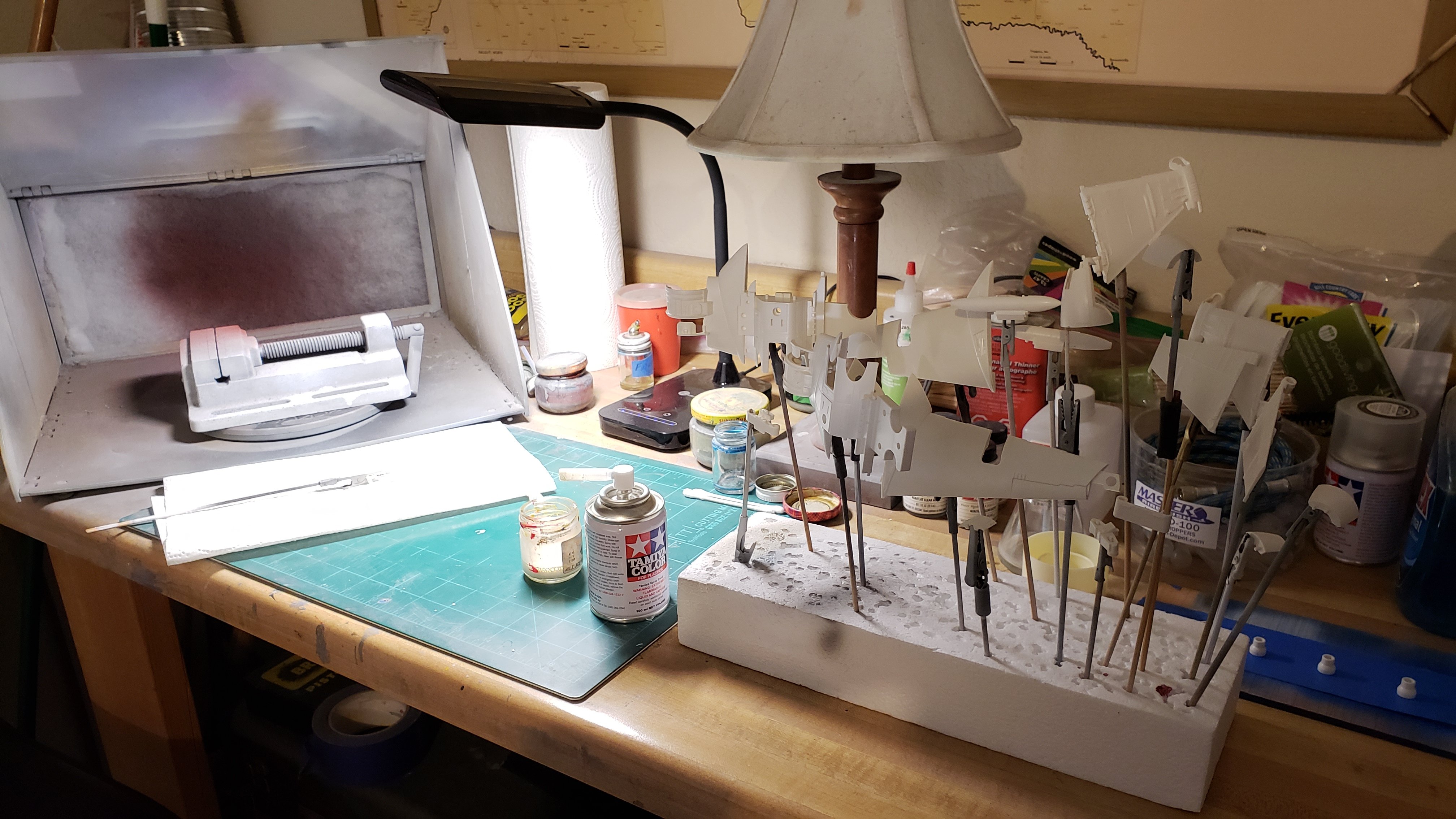

derex3592 Posted February 17, 2019 Posted February 17, 2019 (edited) Getting some painting on the B Wing in today! Decanting Tamiya Racing White for the white parts, Model Master Burnt Metal Metallizer for the engines and Tamiya acrylics Light Blue and Ocean Gray 2 for the other colors. Edited February 17, 2019 by derex3592

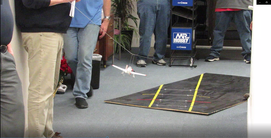

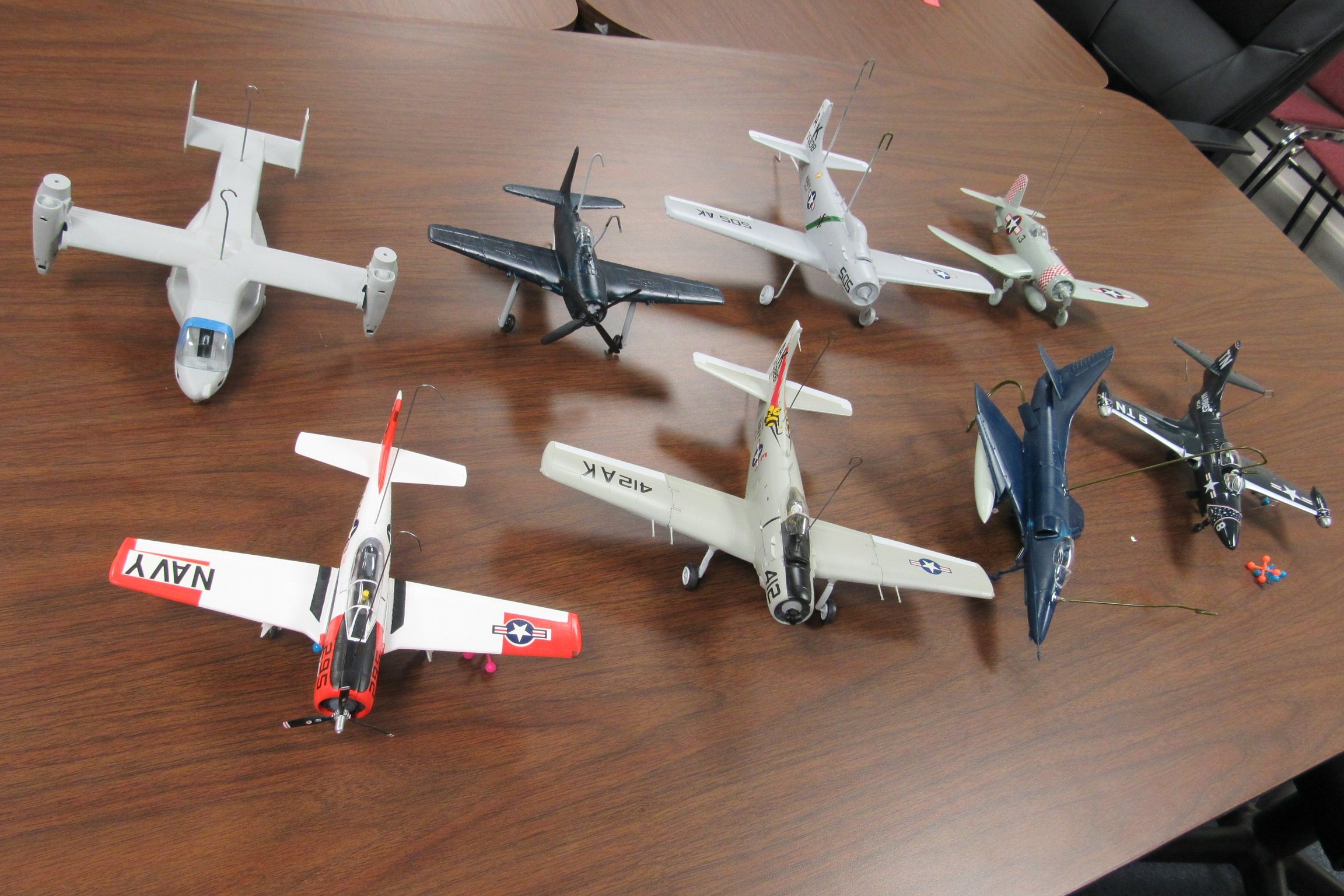

MechTech Posted February 24, 2019 Posted February 24, 2019 Arbit, that LED sequence is great! Duymon, nice finishes on those. Derex, the decanting is a lot of work, but it looks like you have a smooth finish going on. I forgot to take photos of my plane, but as part of our club build, we each built a 1/48 scale warbird and finished it in a NASCAR paint and decal scheme. The 13 foot track the club built is awesome with all the planes on it. I'll have to post photos when I get them. Then I built a 1/72 Osprey with hooks on it. We had to take our models and run them along a cable to make carrier landings using the hooks and a tailhook. I built the Osprey (only plane I had in the right size) and the other photo shows our "carrier deck." It was actually a lot of fun and something different for a change. Back on the ship now. It is taking forever, but it is a PAIN making everything aligned right and getting rid of seams. I'm sure you can see all the clear super glue joints used to fill the gaps a lot of the complicated angles create. Next time I'm drawing this in 3D and cutting parts out digitally. That's it for now. - MT
derex3592 Posted February 25, 2019 Posted February 25, 2019 Little masking, little painting, little buffing, little assembly...onwards and upwards

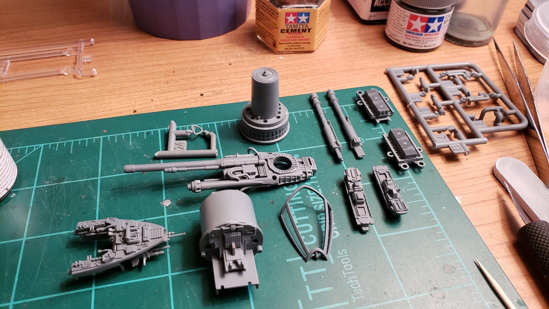

Chronocidal Posted February 25, 2019 Posted February 25, 2019 19 hours ago, derex3592 said: Little masking, little painting, little buffing, little assembly...onwards and upwards Looking beautiful so far! Keep in mind the gaps that might need filling on the B-Wing, mainly the back end of the cockpit pod, and around the big intake on the front of the engine block. They're completely uncharacteristic for Bandai's kits, but those seams are eye-sores on the one I built.
derex3592 Posted February 26, 2019 Posted February 26, 2019 Funny you should mention that @Chronocidal. I tried a test fit of the parts at the back of the cockpit pod last night and yeh, they don't go together well at all! As you said, very uncharacteristic for Bandai SW kits. Thanks for the heads up on the front engine block as well!
Chronocidal Posted February 26, 2019 Posted February 26, 2019 (edited) Yeah, I don't get why they couldn't make the entire thing a single piece, and had to do the pod in so many segments. Far as the engine block goes, they did the kit a disservice by having such a huge flat plate sitting against another flat plate. The main engine block or intake should have had some kind of collar to neatly seal around the opposite part, but there's literally nothing to stop it from leaving a gap wide enough to see through. Unfortunately, it also doesn't help that the pegs on the front of the engine block are oversized, and don't let the intake seat well. I had to file mine down, and due to the way the engine block is built up, I had to remove the exhaust assembly and reach inside of the hull with a flat wooden dowel to apply direct pressure to the back side of the intake block to press it into place. Honestly, you may be better off cutting off the mounting pegs, sanding both the back of the intake and front of the engine block perfectly flat, and just mounting it with glue. That whole assembly was a pain. Edited February 26, 2019 by Chronocidal
arbit Posted February 26, 2019 Posted February 26, 2019 On 2/24/2019 at 11:35 PM, MechTech said: We had to take our models and run them along a cable to make carrier landings using the hooks and a tailhook. I should have thought of that for my Hurricanes and Spitfires when I was 15. Unfortunately they ended up as target practice!

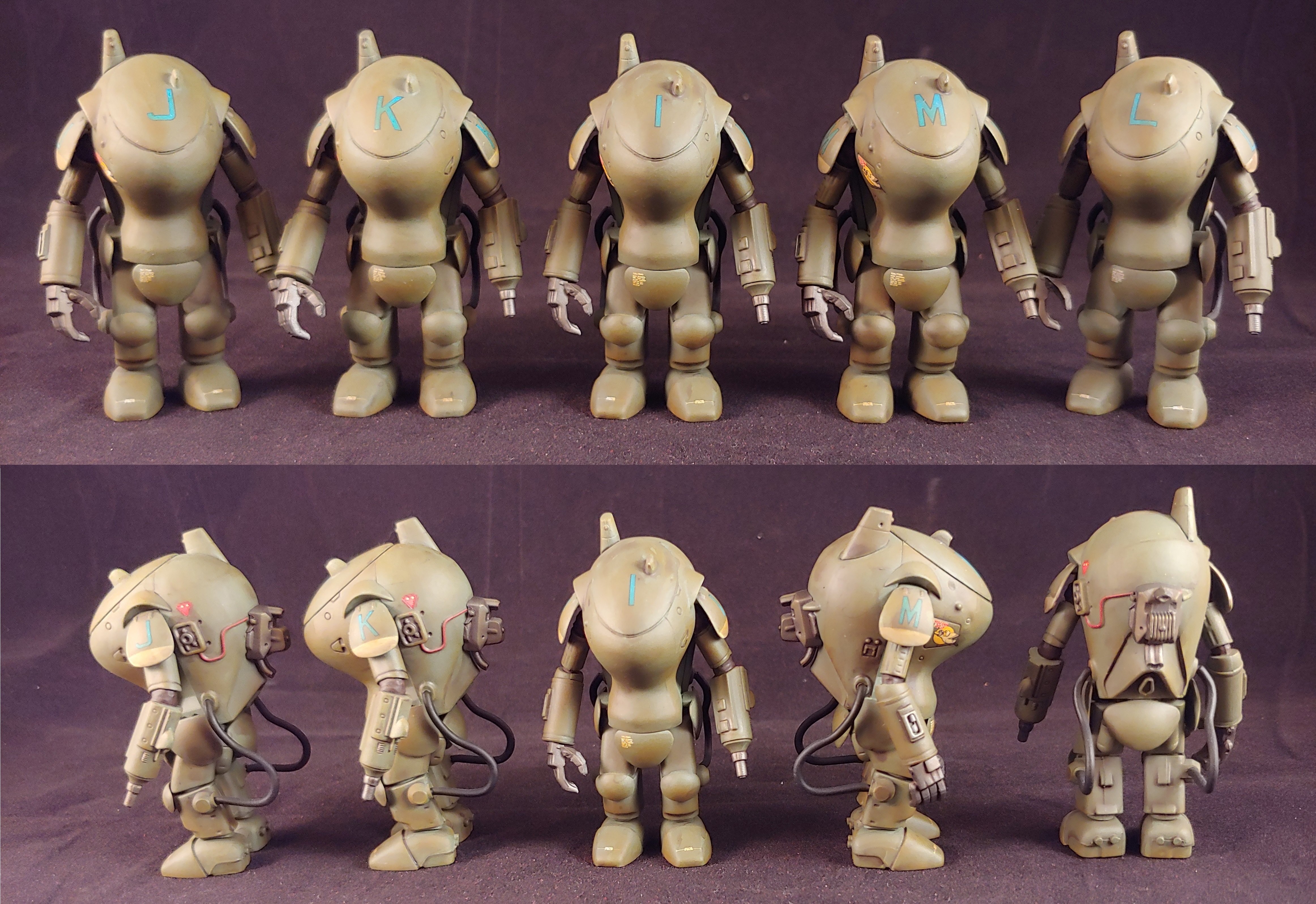

Duymon Posted February 28, 2019 Posted February 28, 2019 (edited) Man I wish I had enough room in my place to build big stuff like that Boat mechtech's got. if I did I'd fill it with more Safs :0 Been on a maschinen krieger bender. Just made a new squad from those 1/35 gachanen kits. Never thought I'd have so much fun doing little 2.5" tall egg soldiers. Edited February 28, 2019 by Duymon
