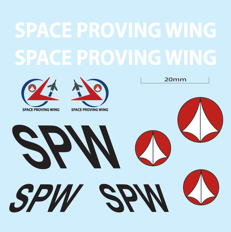

Xigfrid Posted July 10, 2017 Posted July 10, 2017 (edited) Just made these 0B markings for the VF-0B SPW version (based on Hasegawa decals upscaled to fit 1:60 scale) They are in PDF / vector format so they can be eventually processed to be made as water decals. link to download Edited July 10, 2017 by Xigfrid

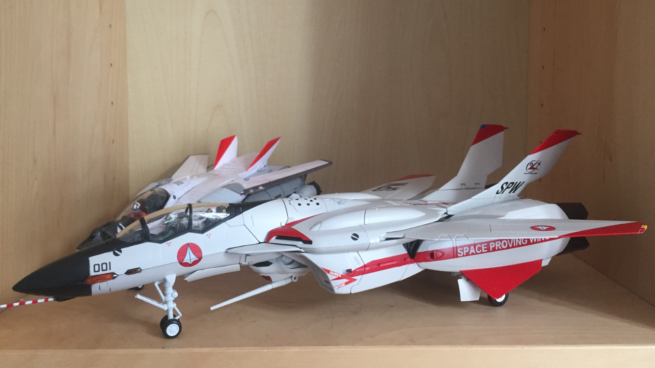

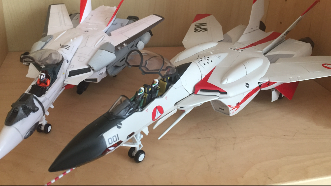

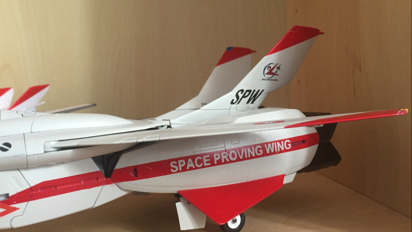

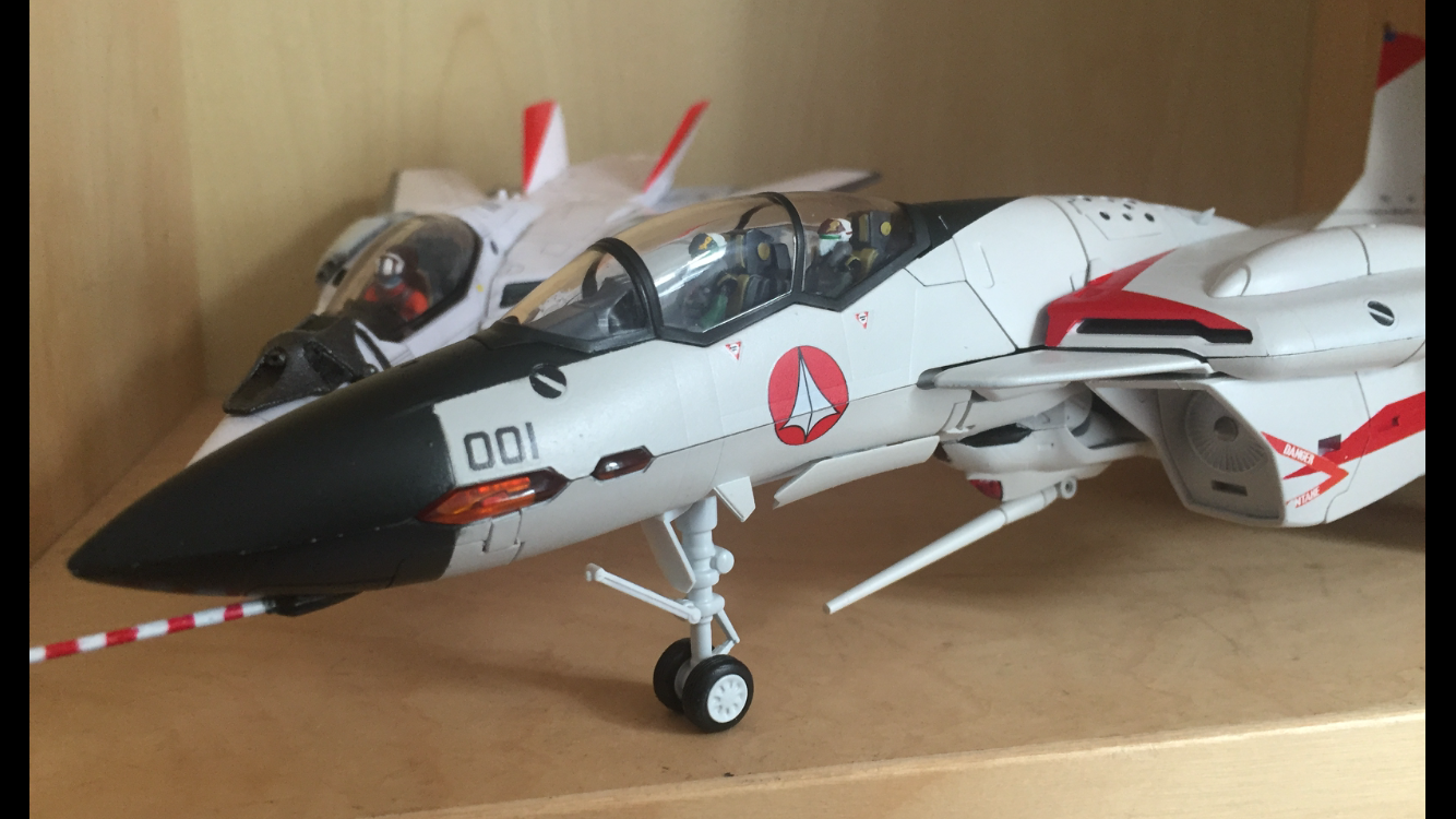

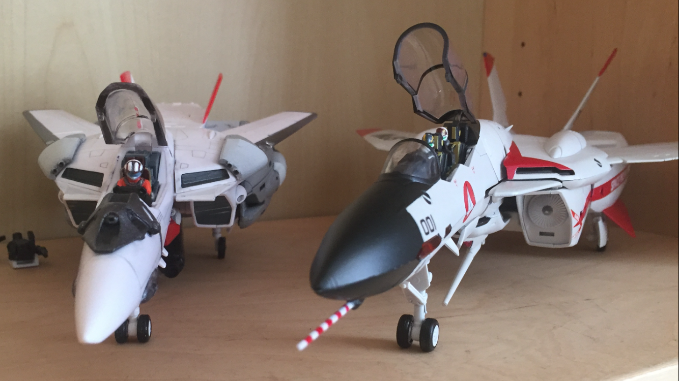

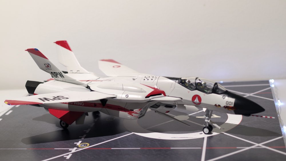

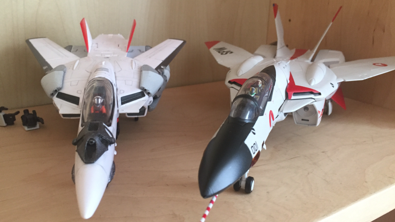

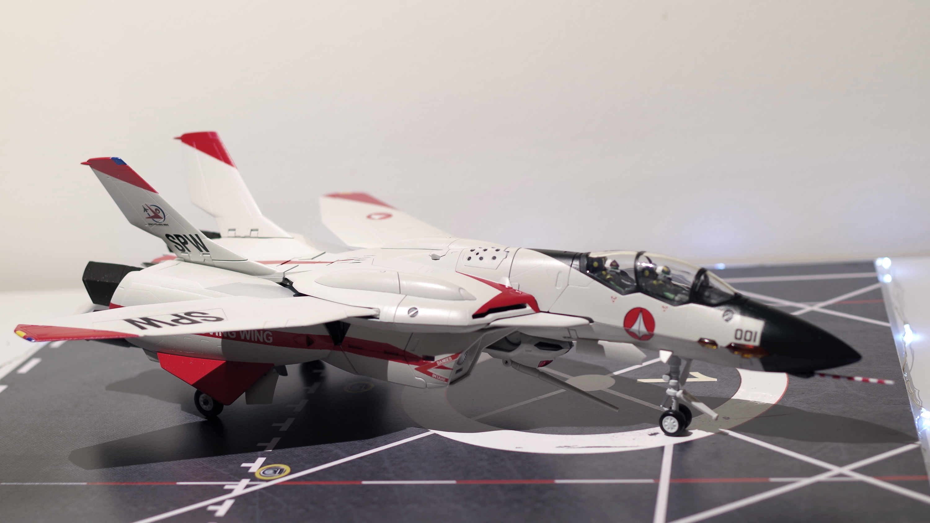

Xigfrid Posted August 26, 2017 Posted August 26, 2017 This came today, this is the classic VF-0B in white/red accents Space Proving Wing version. I need to give my special thanks to wmkjr whose thread inspired me to make another VF-0B conversion, to spanner for letting go one of his invaluable VF-0D for a reasonable price, wmkjr for having the skills and courage to make another conversion and also for making such a good job at painting, sticker detailing, etc This VF-0B is one of my dream that became true thanks to this amazing community, and I am thankful to be part of it too. Until I make a true photo shoot, here are a few shots from my phone. Perhaps wmkjr has better ones too to share.

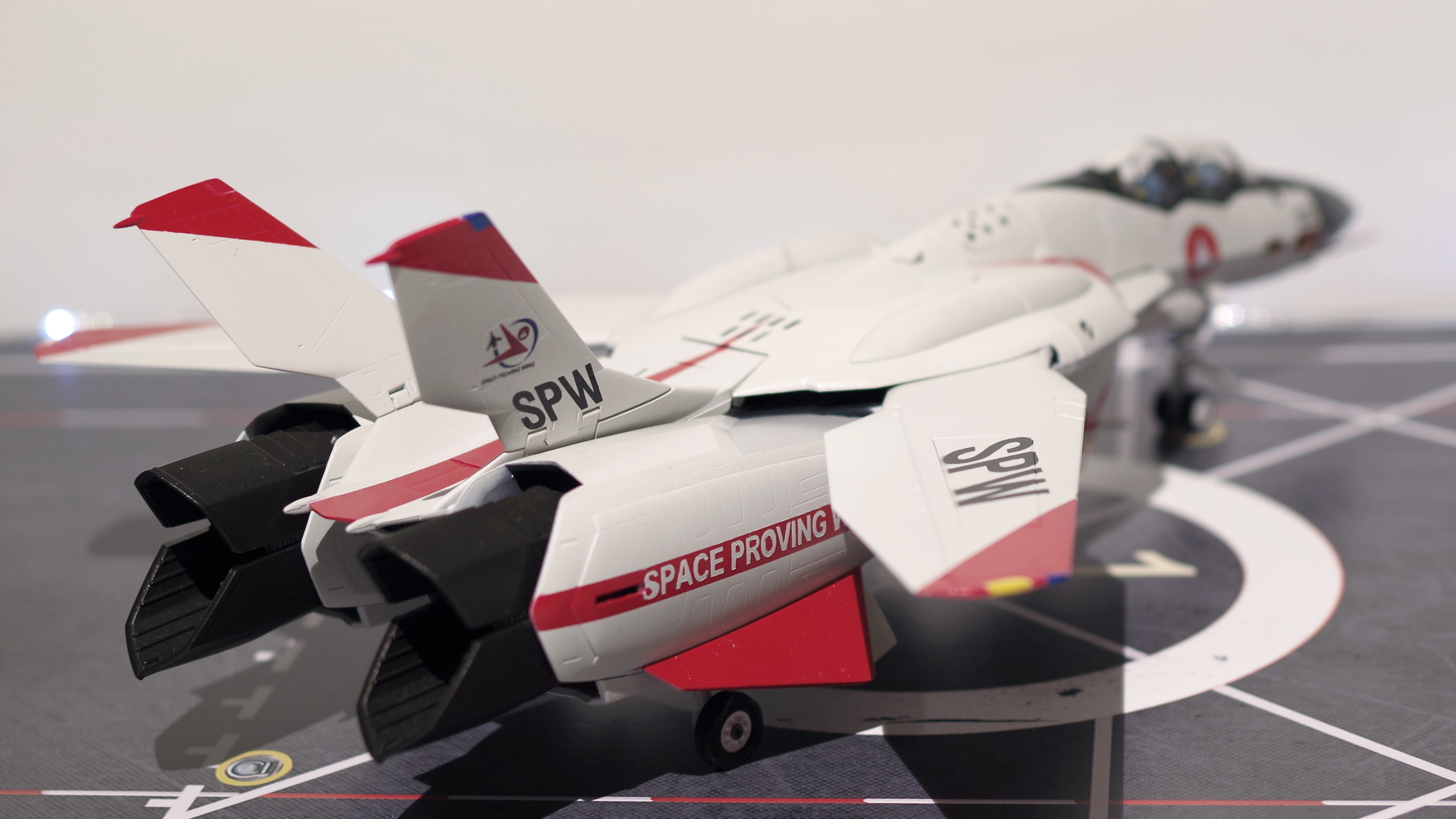

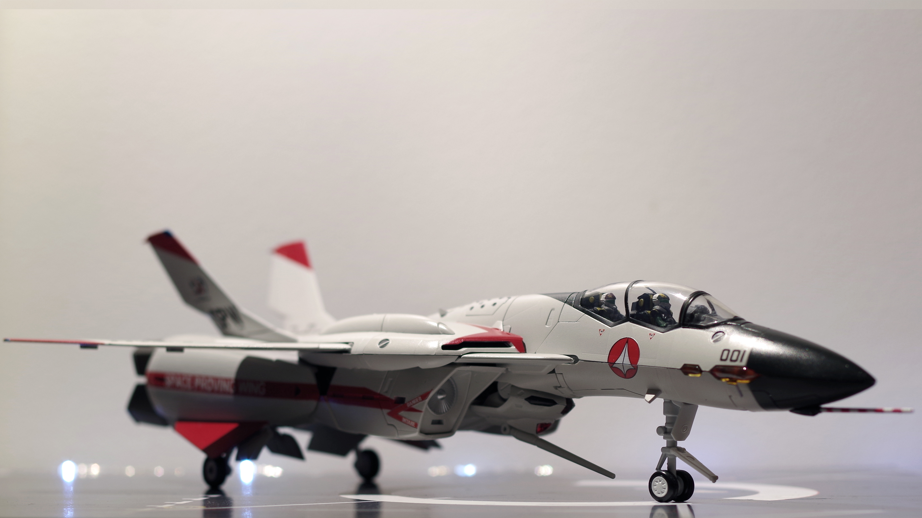

wmkjr Posted August 26, 2017 Author Posted August 26, 2017 Glad it worked out for you. Thanks to your 3d modeling you gave us stuff that we could only dream of too. So far, you're the only one that I know that has the VF-0B in this scheme. As for pics, I have some but need to get it on the computer first. Here is one (I'll add more in the toys section later) wish I had a carrier deck:
505thAirborne Posted August 26, 2017 Posted August 26, 2017 (edited) Xigfrid, that looks amazing, the attention to detail is superb! Come on Arcadia, making a VF-0B is not impossible! Edited August 26, 2017 by 505thAirborne
arbit Posted August 26, 2017 Posted August 26, 2017 Amazing work guys. Those are some beautiful birds. I would never dream of trying that!

no3Ljm Posted August 28, 2017 Posted August 28, 2017 On 8/26/2017 at 7:21 AM, wmkjr said: Glad it worked out for you. Thanks to your 3d modeling you gave us stuff that we could only dream of too. So far, you're the only one that I know that has the VF-0B in this scheme. As for pics, I have some but need to get it on the computer first. Here is one (I'll add more in the toys section later) wish I had a carrier deck: I love this! What are you waiting for Arcadia?!

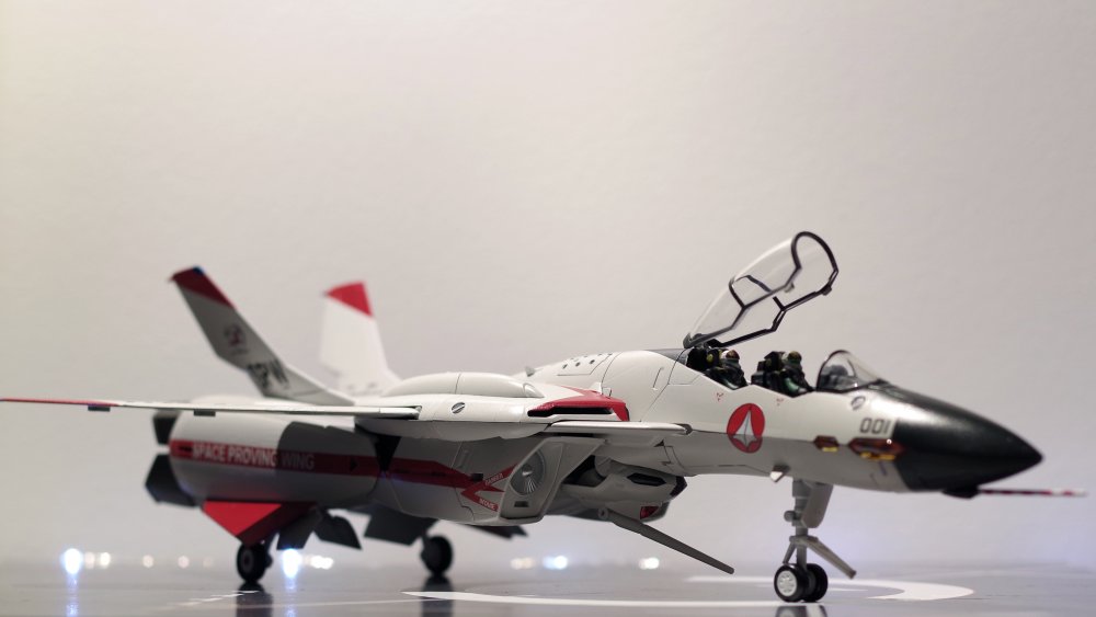

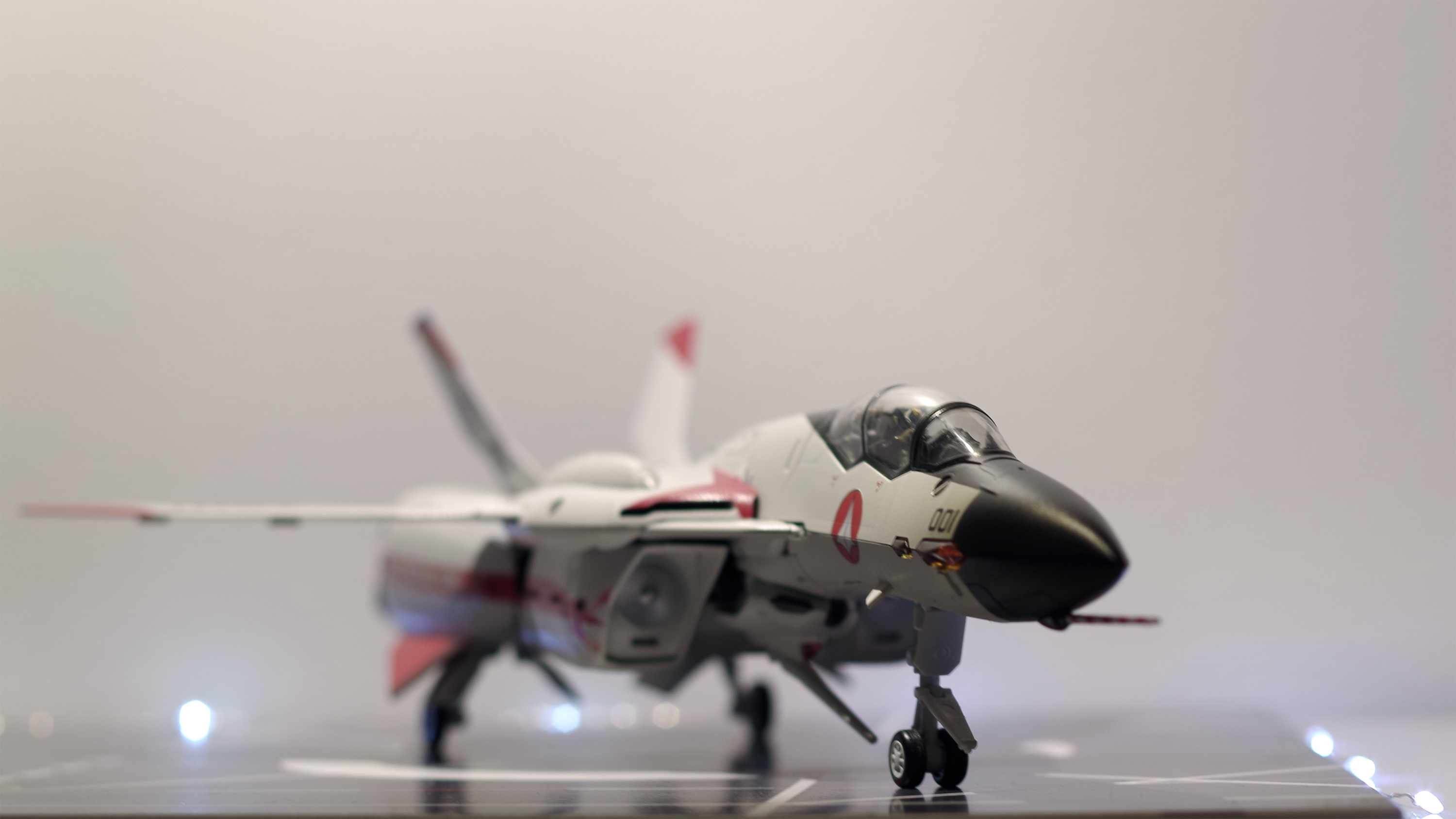

Xigfrid Posted August 30, 2017 Posted August 30, 2017 Tried to make better pictures, but I have to say that they can't compared to wmkjr's
mickyg Posted August 30, 2017 Posted August 30, 2017 Xigfrid, you are a lucky, lucky man! And wow @wmkjr that is some amazing work there! Questions for either of you: Given this front section is cast in blue plastic (at least I think it is) did you have any issues getting the paint to look right/can you see any slight differences in the tone? What sort of paint did you settle on? Any issues with durability that you had to address with any special methods? Did you clearcoat and if so, what did you go with? I'm working on a few projects at the moment and have decided Lacquer paints are the best possible choice for durability. However, I've been really surprised to find that most of the factory paint comes off with Gundam Marker eraser, which I think is just alcohol based thinner, suggesting the paints are actually just regular old acrylics. I'm also having all sorts of trouble with metallic paints. The ones that look the most realistic are also the ones that seem the least durable - as in, they rub off with the slightest touch. Finding that perfect balance between durability and quality seems to be very challenging.
no3Ljm Posted August 30, 2017 Posted August 30, 2017 2 hours ago, Xigfrid said: Tried to make better pictures, but I have to say that they can't compared to wmkjr's So pretty.
wmkjr Posted August 31, 2017 Author Posted August 31, 2017 (edited) 4 hours ago, mickyg said: Xigfrid, you are a lucky, lucky man! And wow @wmkjr that is some amazing work there! Questions for either of you: Given this front section is cast in blue plastic (at least I think it is) did you have any issues getting the paint to look right/can you see any slight differences in the tone? What sort of paint did you settle on? Any issues with durability that you had to address with any special methods? Did you clearcoat and if so, what did you go with? I'll try to answer your questions. The front section is blue. t entire valk was 1st wiped with Simple green on a microfiber cloth, dried, then hit with a couple coats of Tamiya White Primer. I sprayed at least 2 coats of paint after giving it a mist base coat. I couldn't tell of any difference in tone though my eyes are bad so maybe there was some. I used Tamiya sprays for this. Tamiya AS-20 Insignia white, TS-8 Italian red, TS-63 Nato black, and Tamiya Fine Primer grey for the back of the legs was used for this valk. TS-13 Clear then TS-79 Semi Clear was the clears. These Can Sprays seam pretty scratch resistant to me but that's just my own opinion. The only place that was giving me a hard time was the pitot tubes as for some reason the paints didn't want to stick on. Maybe it's a different type of plastic used. I think I should've used some fine sandpaper first to give it some bite. The 001s, red triangles, intake warnings and tail emblems were waterslide decals. The rest was sprayed using vinyl stencils or taped off. Edited August 31, 2017 by wmkjr
mickyg Posted August 31, 2017 Posted August 31, 2017 Super helpful wmkjr. Thanks a bunch! The Tamiya sprays are lacquers and while I'm not sure if they're identical to the Gunze Mr Color range that I'll be using for my own projects, I'd say they're likely close enough that I can expect similar results. Really nicely done on this project!

Chronocidal Posted August 31, 2017 Posted August 31, 2017 So, I believe the VF-0 pitot tubes are cast in POM, same as the VT-1's pack probe, and the old Yamato YF-19's canards. It's just a notoriously paint-resistant material. It may have been much easier to just wrap something like pinstriping tape around the pitot for the stripes.

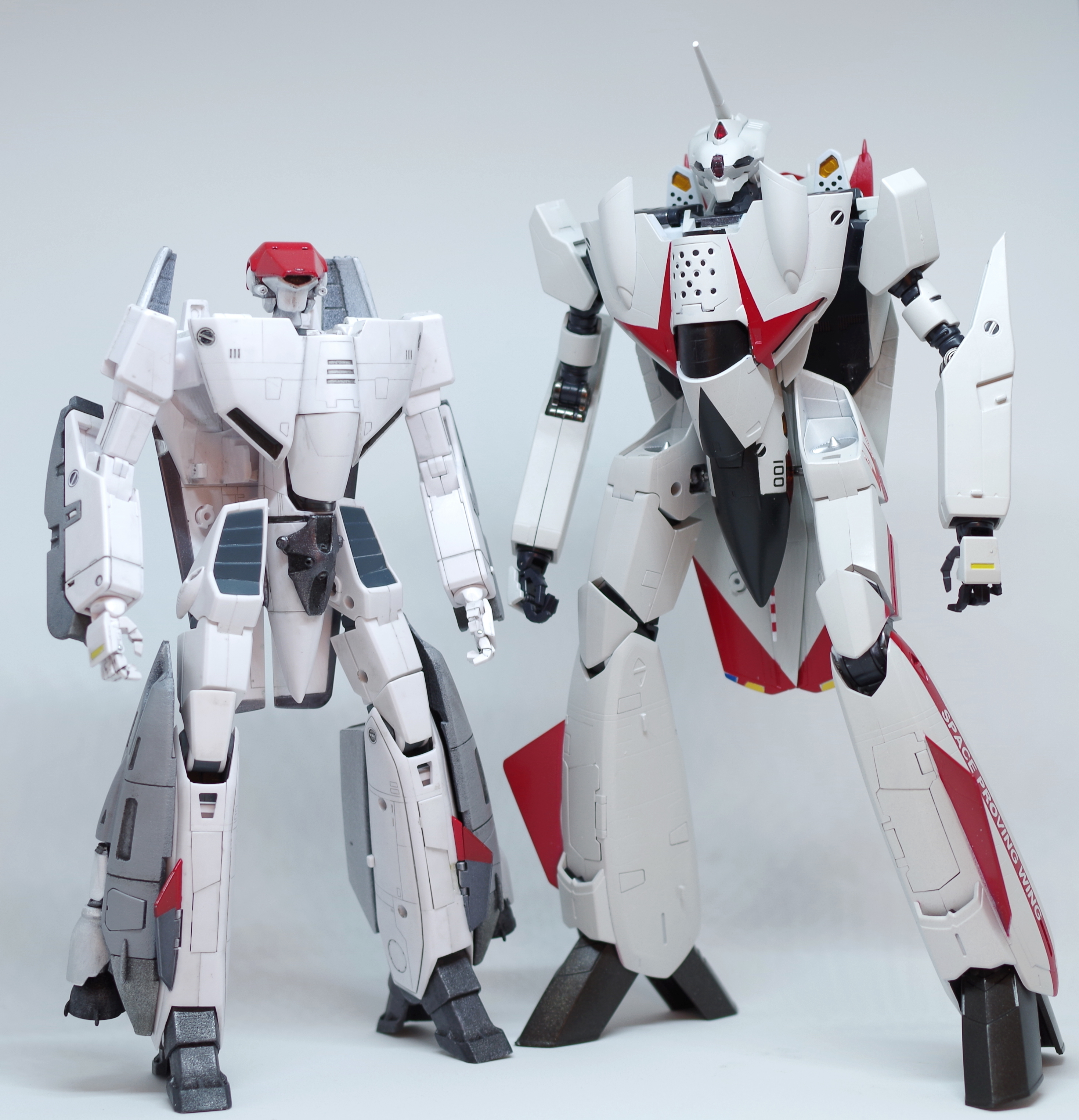

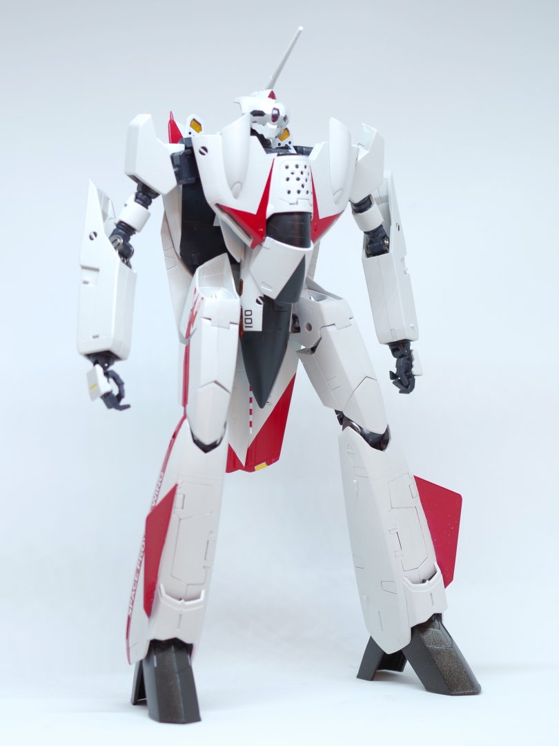

Xigfrid Posted August 31, 2017 Posted August 31, 2017 (edited) Had some time to transform it to battroid, but couldn't take the camera out for a proper shooting, next time! Edited September 3, 2017 by Xigfrid
mickyg Posted September 4, 2017 Posted September 4, 2017 That scheme works really well in Battroid too! I'm actually kinda surprised!
chyll2 Posted September 4, 2017 Posted September 4, 2017 the way the chest in battroid is mark is really beautiful. the scheme also works for battroid
