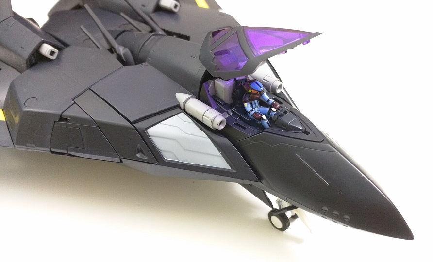

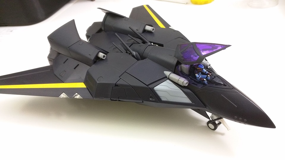

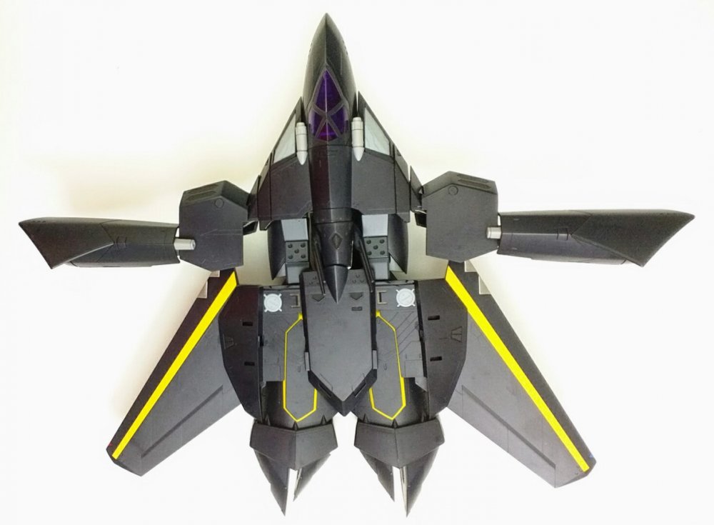

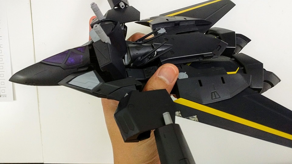

aaajin Posted January 29, 2017 Posted January 29, 2017 (edited) On 1/27/2013 at 1:38 AM, Graham said: Here's my video for unlocking the canopy on a VF-17 if you have one with a really stuck canopy.  Graham A bit of a necro thread, but here goes. OK today I decided to take out my 17S & display it in fighter mode, within the 10 minutes of time window while waiting for my wife to get ready before we go out. Then I realized that 10 minutes was a naive estimate to put the effin pilot in the effin cockpit *clench fists* The cockpit & front landing gear forward panel were extremely tight. I managed to carefully pry down the front landing gear forward panel using a tweezer without any damage, but the cockpit wouldnt budge & I dont want to force the canopy up and damage the edges or worse the hinge. Luckily found Graham's useful post. Will try this tonite! Also saw some posts about the front landing gear panel, neck cover alignment and finger joints cracking out of the box (touch wood). Any advise on other potential issue that I need to worry about? Appreciate member's response & thanks in advance!  Edited January 30, 2017 by aaajin Quote
aaajin Posted January 30, 2017 Posted January 30, 2017  Saw Graham's video on how to : (1) slide the canopy cover up if its too tight. (2) slide the neck cover to its flush position in fighter mode. The video resolution was a bit low, so it was hard for me to see the areas Graham talked about in the video. As I was figuring out how to put Gamlin in his 17S, I thought I might as well make a guide for members who's having the same issues with their VF-17. I'll cover just point (1), because by the time (1) is done, Im pretty sure (2) is relatively easy (OK, I'm just lazy :P) Anyways, onto the steps :  1) Partially transform the 17 as shown below. Transformation videos are available by Jenius aka Anymoon or ColletionDX (forgot the member's alias here on MW)  2) Once its in the above position, locate the slot below the slider hinge (see green arrow) behind the cockpit area. Use a hobby flat screw driver (or anything that is slender with a flat end) and insert the flat end into the slot. Rotate the screwdriver slowly so that the slider is pushed up. Once there is clearance, push the slider all the way up.  3) Walla. Done. Put everything back together in fighter mode and set Gamlin in his rightful place : inside a 17S cockpit. Good Luck! Quote

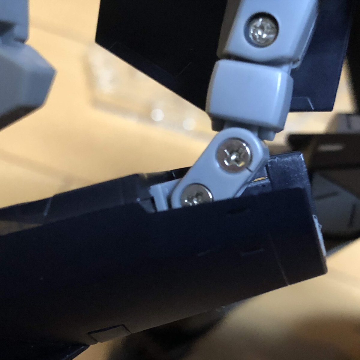

Ignacio Ocamica Posted June 6, 2018 Posted June 6, 2018 Will do when I get home. Hope your 17 stays together.You can use superglue for that crack. Quote
Shizuka the Cat Posted June 6, 2018 Posted June 6, 2018 1 hour ago, valhary said: check your nightmares Wait, can you elaborate on what the problem is? Quote
spacemanoeuvres Posted June 6, 2018 Posted June 6, 2018 25 minutes ago, Shizuka the Cat said: Wait, can you elaborate on what the problem is? I believe there’s a crack below the middle screw. Quote
Loop Posted June 7, 2018 Posted June 7, 2018 @valhary was it just in a stationary pose the whole time or well played with? Quote
Mommar Posted June 7, 2018 Posted June 7, 2018 I have a crack on the right elbow of my 17S, same place as in that pic, and it's been sitting posed like that for years. Not played with. However, no cracks on the elbows of my 17D's. Quote
mechaninac Posted June 8, 2018 Posted June 8, 2018 On 6/6/2018 at 12:25 PM, Ignacio Ocamica said: ...You can use superglue for that crack. I'd steer clear from super glue. Since that piece is ABS, the best solution would be to use a small drop of model cement (Testor's will work). (1) Unscrew, (2) add a small drop to the crack, (3) clamp to close until it oozes some dissolved plastic, (4) let it cure for at least 24 hours, (5) clean the scar that formed with a hobby knife and a flat jeweler's file, (6) sand smooth with a sanding stick, (7) buff with a buffing stick until all the scratches disappear and the sheen matches the rest or the part, done and good as new; lastly, (8) reassemble the elbow but don't over-tighten the screws. Quote
