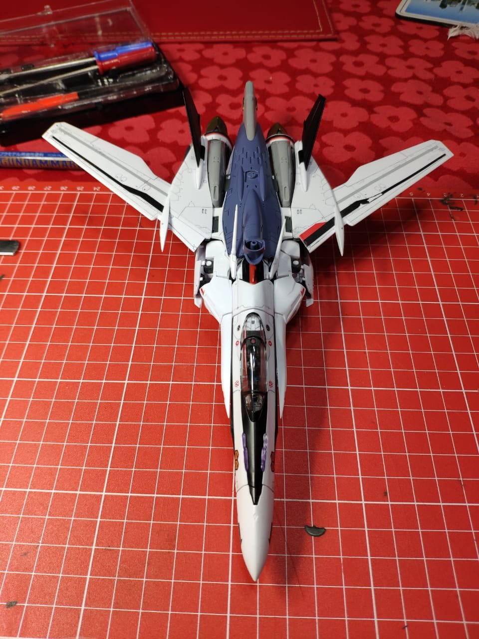

Gabe Q Posted August 22, 2020 Posted August 22, 2020 @MacrossJunkie Your Ivanov looks convincingly weathered. Good job! I could never have the courage to do that to an expensive collectible. @Chas That red Legioss reminds me of my build. It looks great. I bought the green one a while back on clearance and I'm tempted to build it now. Anyhow, I'm just waiting for the glue to dry then I'll attach the legs and little light bits. Then, done!
MechTech Posted August 22, 2020 Posted August 22, 2020 That's looking great Gabe! Nice -n-clean too! - MT
Chas Posted August 22, 2020 Posted August 22, 2020 Agree completely, really clean colour separation and smooth paint application. Looks real sharp. Are you gonna leave it clean or add some subtle weathering?
Gabe Q Posted August 22, 2020 Posted August 22, 2020 I'm gonna apply some light dry brushing to the edges of the armor parts. My AC has been out so it's brutal to sit in my workroom for too long. In the meantime, it'll have to stay as is.

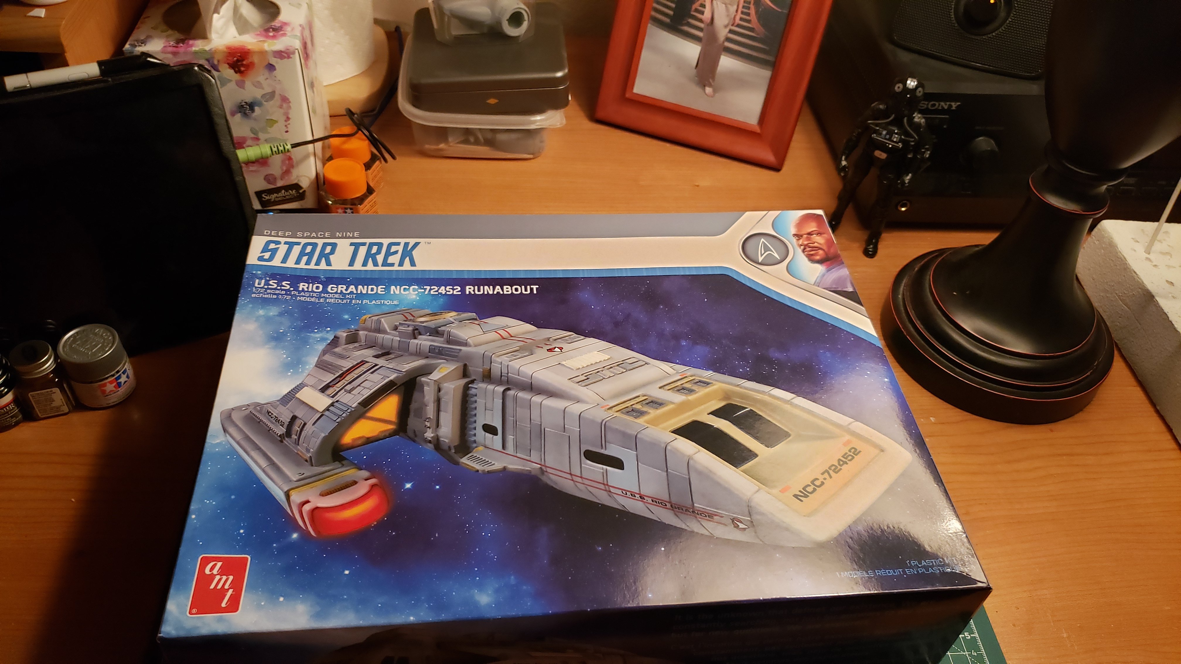

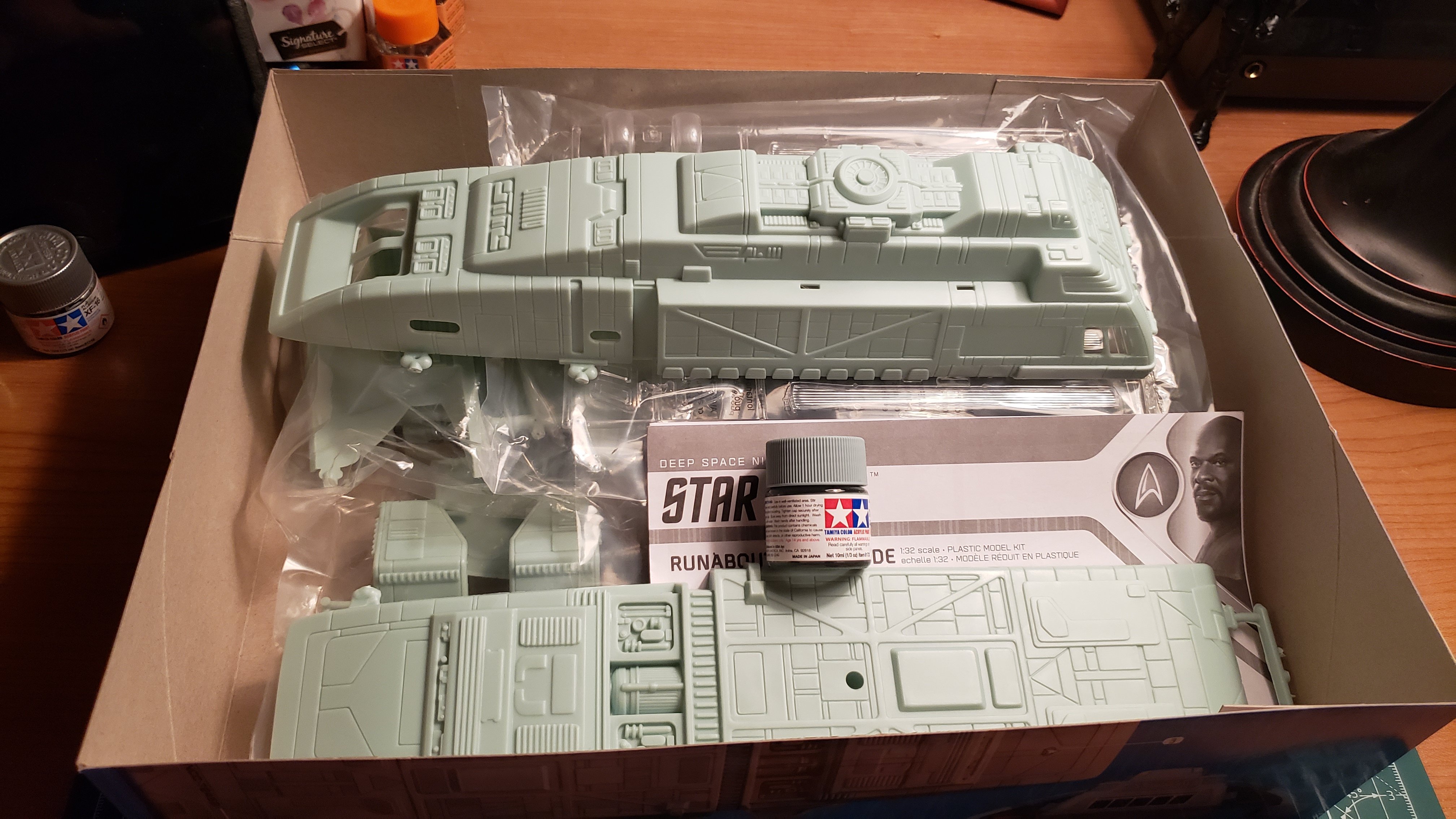

derex3592 Posted August 22, 2020 Posted August 22, 2020 Dang, this thing is bigger than you think it is! There's like 20 parts to this kit.. LOL! Uuuuunfortunately, there is no interior. None. Zero, zip, nada. Soooo.... I'm not willing to pay for all of the parts that are available on Shapeways, I'm sure they would be amazing but I can't drop over $100 on that for a $20 kit, however, I found a YouTube build with a cheaper alternative solution that I will be kind of following with some upgrades of my own along the way. However, not right now. This one's going in the closet for a while!

MechTech Posted August 23, 2020 Posted August 23, 2020 Convectuoso - That's looking good so far. Derex - You should just stick some decals in the windows that look like people. Don't you just love it when your cats "help you" build your kits! Your cat looks like one of our two, minus 20 lbs! - MT
electric indigo Posted August 23, 2020 Posted August 23, 2020 IMO the Runabout has such a heavy handed design that it would look much better with a beat-down, industrial Chris Foss paintjob.

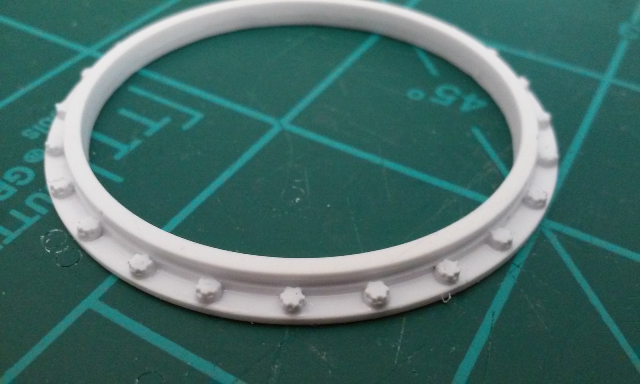

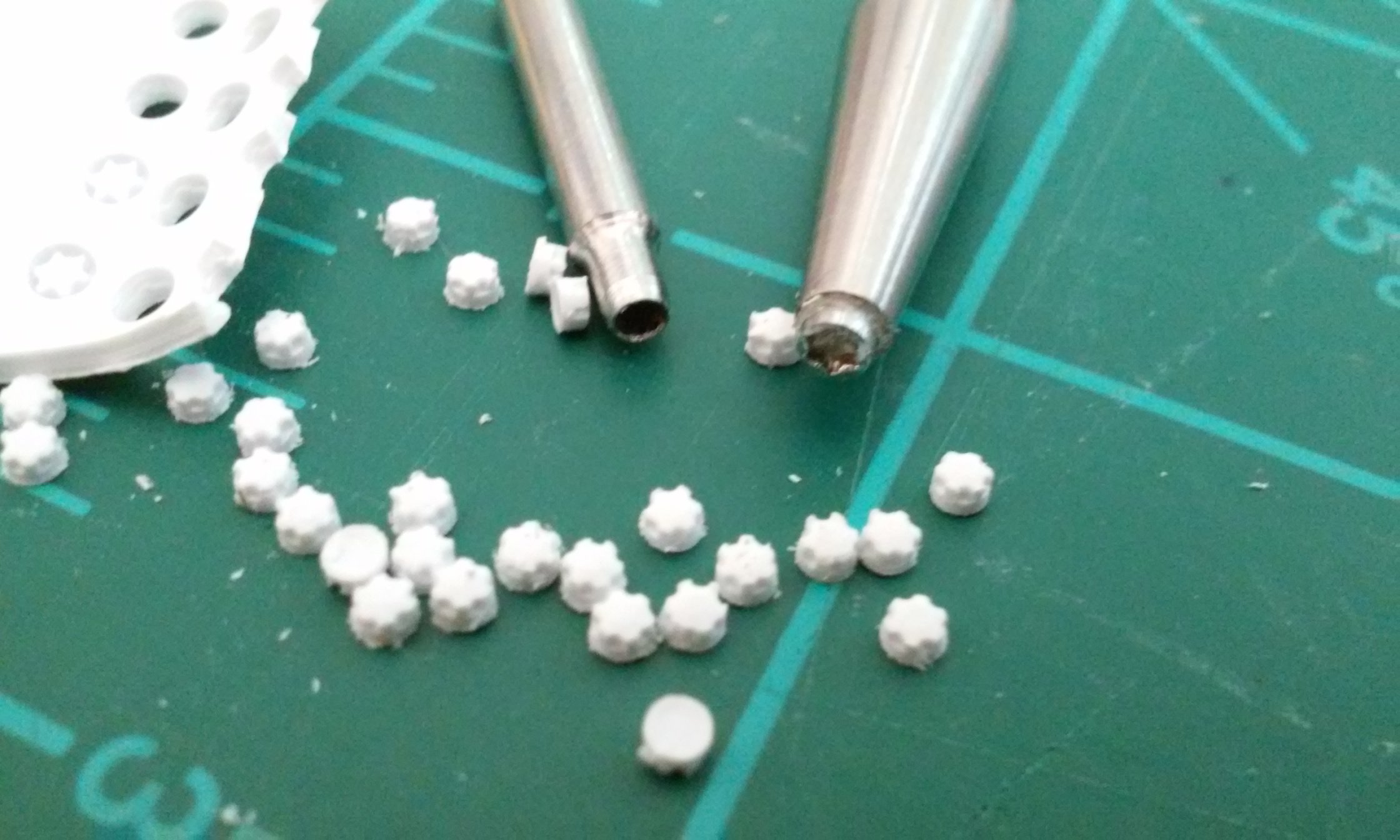

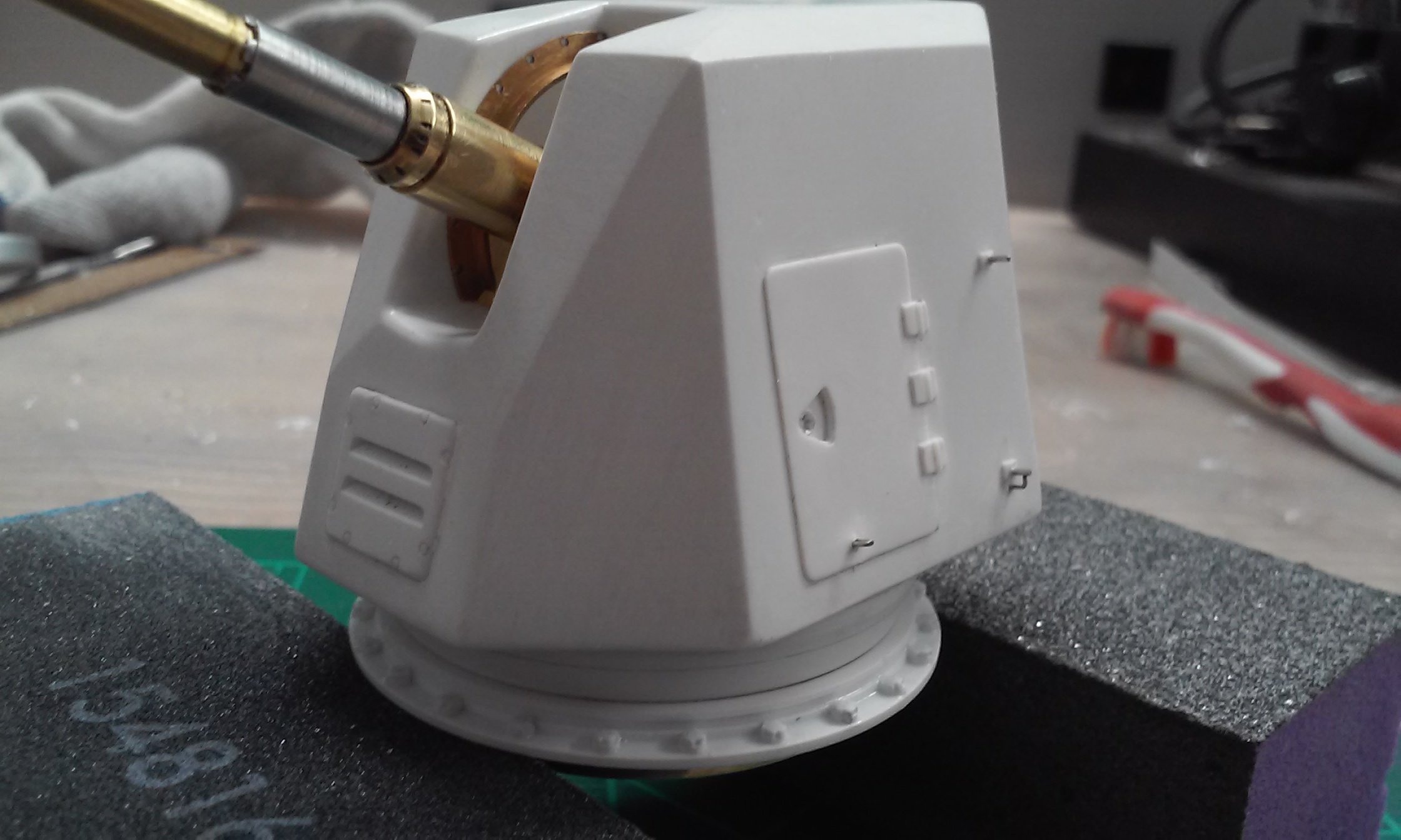

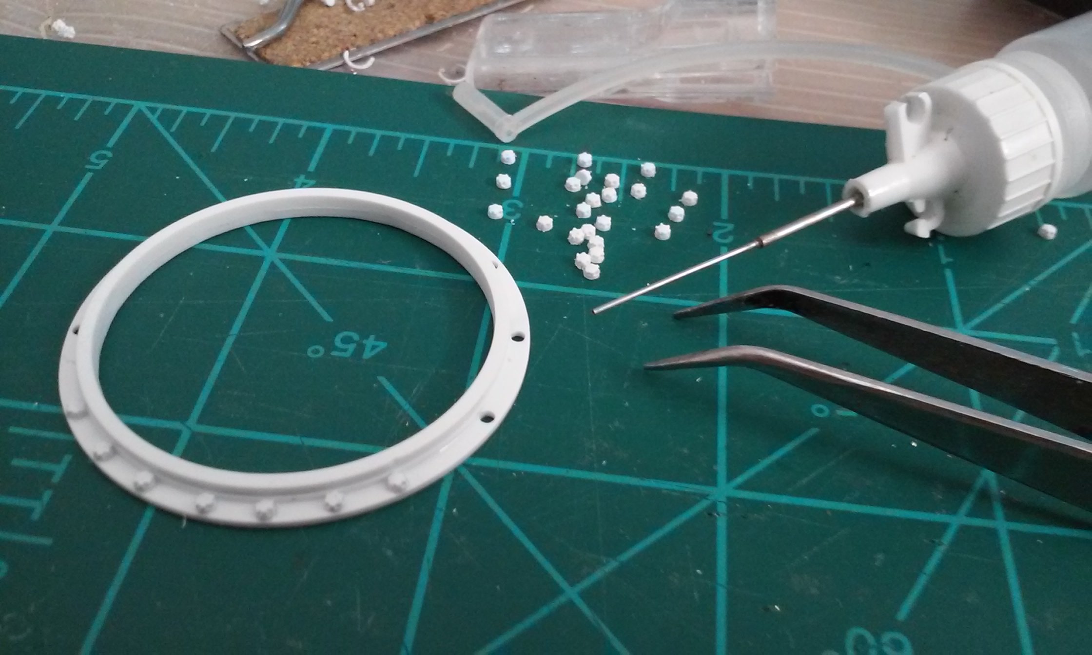

MechTech Posted August 23, 2020 Posted August 23, 2020 There were a lot of photos from a lot of work I finally caught up on, but I'll spare you guys with just a few. I made two rings (actually four for failures). One conical that goes directly under the gun housing, and a second that the gun mount goes into. The conical one is straight forward, but the mount ring was a lot of work. The ring has bolts all around it. I drilled holes just to keep them evenly spaced. I tried to use leftover bolts from the 1/20 Votoms kit, but there weren't enough! So I had to make my own. Thankfully there was the die I made for the flight deck months back. I thought that and a cut-out die might work - thankfully they did! This was also a second attempt. The first one with thin plastic and just stamping out heads didn't work. SSSssshhh, yes the heads are actually Torx bit shaped, but I won't tell anyone if you don't! A quick note about scale. The Rings are the wrong size since parts of the turret need strength or the mechanism in the turret is bigger than scale. It was a balancing act. I used simple sewing pins and old floppy disc springs to make the metal parts on the turret. Those are the doorstops, door latch (on the door) and a door catch on the bottom back of the housing. And a few specs of styrene at their base. A male Torx bit and cut-out die made the door latch/handle holder. The magnifying glass is my friend. Just before calling it quits, I managed to get the gun base shaped out of pine and vacu-formed. The ring with bolts will go on top of this. Thanks for checking in guys! - MT
Thom Posted August 23, 2020 Posted August 23, 2020 17 hours ago, derex3592 said: ....AHEM.... tryyyyyin to get some pre-work done here... 1/1 cat kit! Very nice. The fur looks good, but the eyes... WOW. Just the right blend of Overlord-level of haughtiness with the paint. 13 hours ago, MechTech said: Convectuoso - That's looking good so far. Derex - You should just stick some decals in the windows that look like people. Don't you just love it when your cats "help you" build your kits! Your cat looks like one of our two, minus 20 lbs! - MT That's the cat's box now. Possession has been staked. You can see it in the eyes. 1 hour ago, MechTech said: Those bolts are phenomenal! Great work there!
Chas Posted August 23, 2020 Posted August 23, 2020 MT. Your builds always look museum quality in the level of detail and how clean the lines are. Always inspirational.

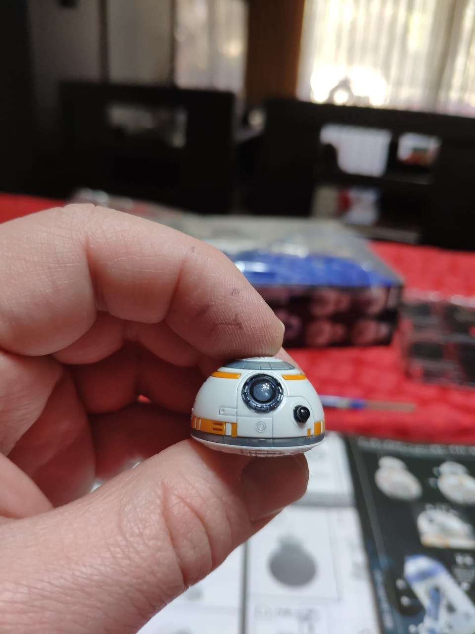

Convectuoso Posted August 23, 2020 Posted August 23, 2020 (edited) 15 hours ago, MechTech said: Convectuoso - That's looking good so far. Thanks, @MechTech. Your build is looking amazing. I got a Bandai BB-8 & R2D2 kit for my birthday and my daughter wanted me to build it right away. I was able to quickly assembly BB-8's head before moving onto other things Edited August 23, 2020 by Convectuoso
peter Posted August 23, 2020 Posted August 23, 2020 10 minutes ago, Convectuoso said: Thanks, @MechTech. Your build is looking amazing. I got a Bandai BB-8 & R2D2 kit for my birthday and my daughter wanted me to build it right away. I was able to quickly assembly BB-8's head before moving onto other things That is a lot of detail for such a tiny kit!

Gabe Q Posted August 23, 2020 Posted August 23, 2020 @MechTech The bolts on that gun look great! The level of precision you achieve is astounding. Also, that base for the gun you vacuformed is impressive as well. 21 hours ago, Dobber said: Looking great Gabe Q! Chris @Dobber Thank you! @Thom Your mods on that Nautilus look good. It looks like a trivial thing to space it out a quarter inch but it is actually a bit of work so hats off to you. And @Grayson72 you're building one digitally! But that's cheating! Jk, looks great. @peter Thanks for the update anyhow even if you think it's not very exciting. I mainly enjoy how you give us updates on your ups and downs both. @Convectuoso That bb8 looks great. Those bandai kits are nice to work with. I built a 3po a weeks back and it went together with no problems. There was a lot of posts! Keep building and posting guys.
Gabe Q Posted August 23, 2020 Posted August 23, 2020 Wow, almost forgot to post my update after seeing all of your guys' stuff. Just getting the pilot ready and she's all done!
Grayson72 Posted August 23, 2020 Posted August 23, 2020 1 hour ago, Dobber said: Awesome Grayson! I’d love the older U.N.C.F ships in 1/500 to go with my Yamato. She could use some company in her display case. Chris Well I’m sure I could be persuaded to make them in that scale too. That’s the beauty of starting with digital.
505thAirborne Posted August 23, 2020 Posted August 23, 2020 1 hour ago, Gabe Q said: Wow, almost forgot to post my update after seeing all of your guys' stuff. Just getting the pilot ready and she's all done! Looks amazing, look forward to the completed Valkyrie!
Grayson72 Posted August 23, 2020 Posted August 23, 2020 40 minutes ago, 505thAirborne said: Looks amazing, look forward to the completed Valkyrie! Yeah I wanna see her in her valk!
