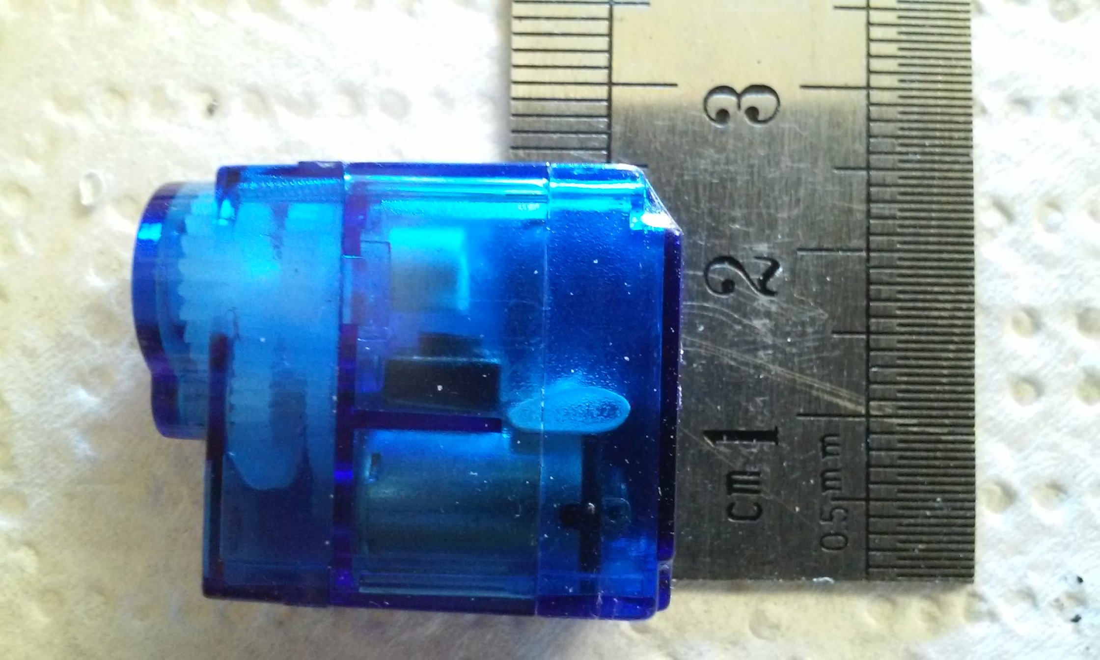

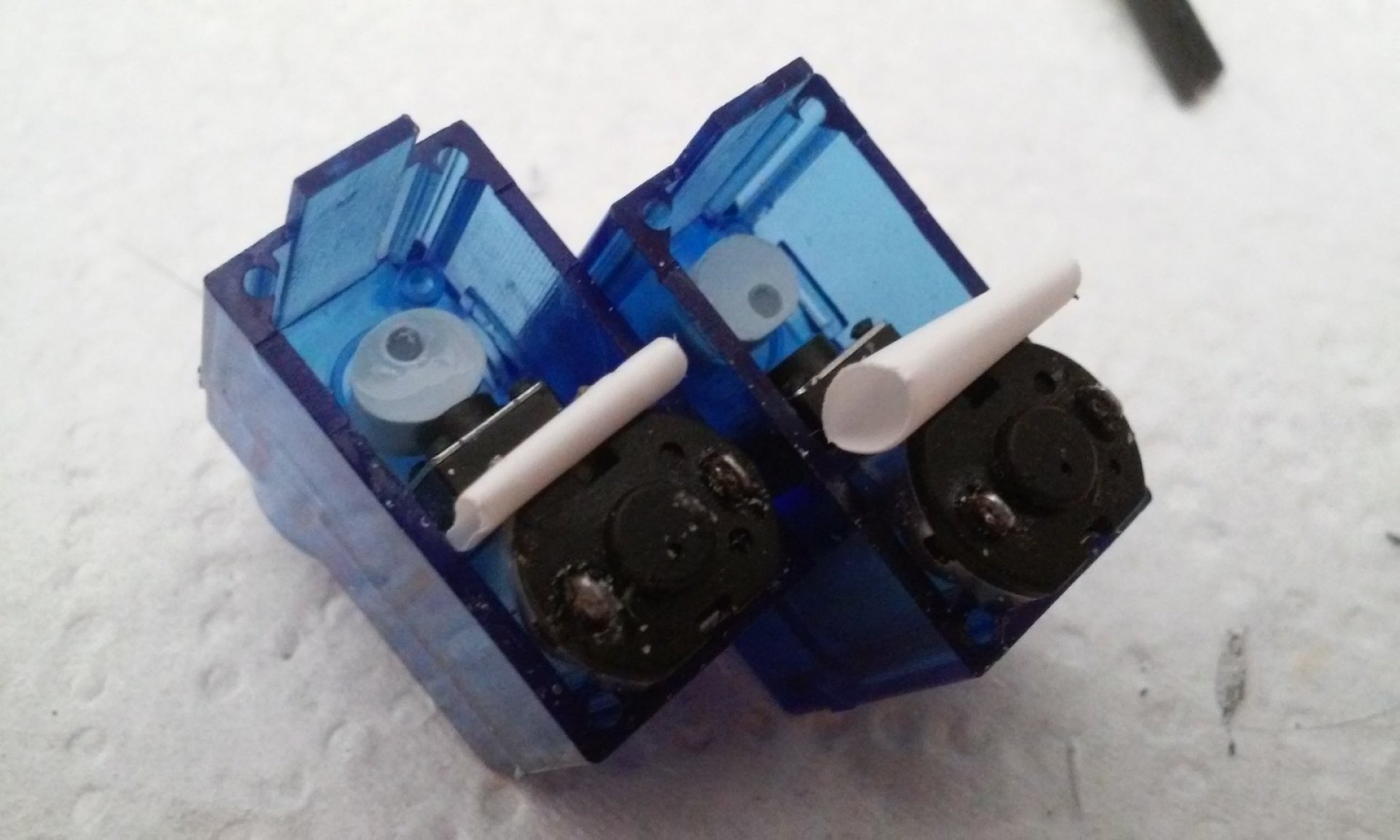

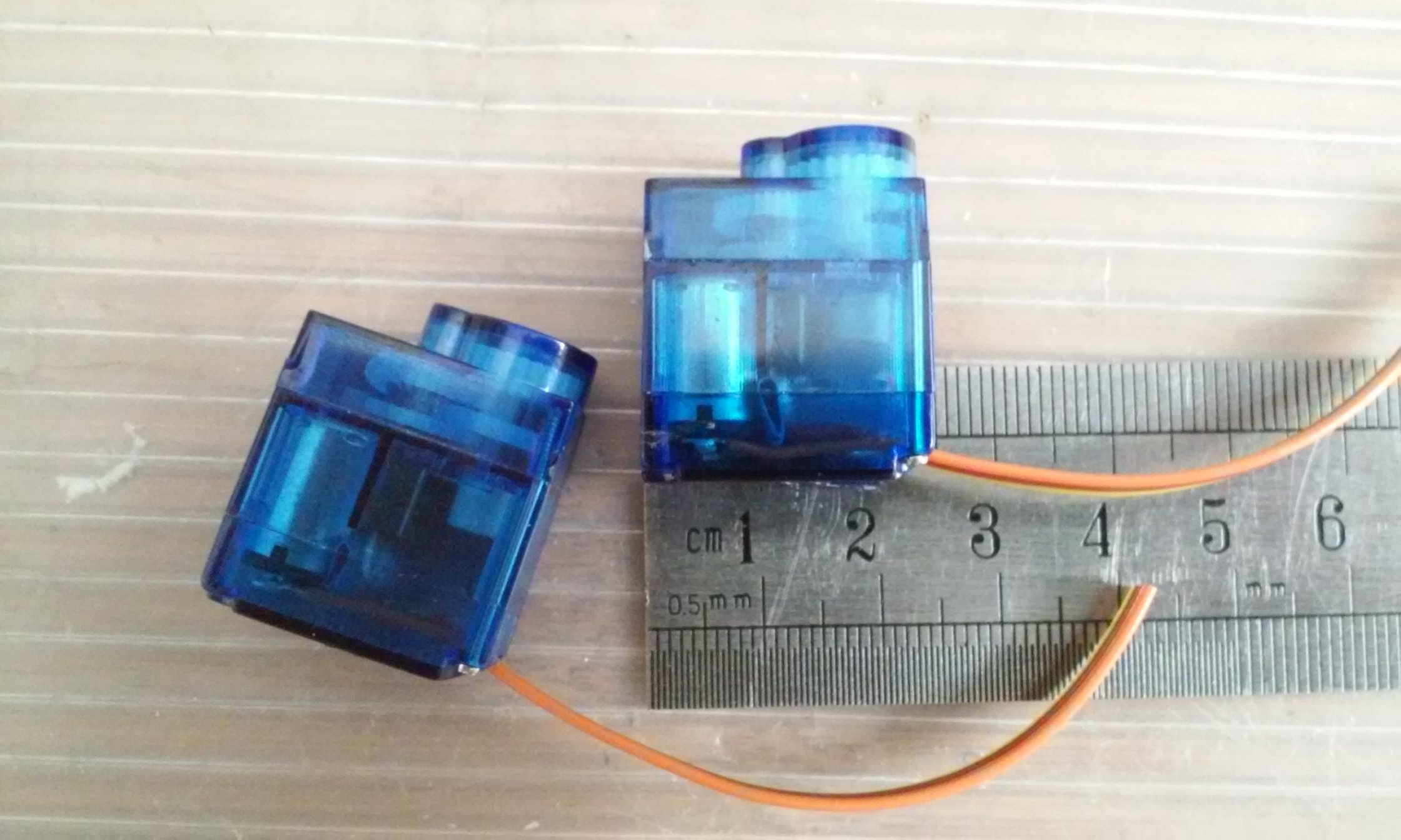

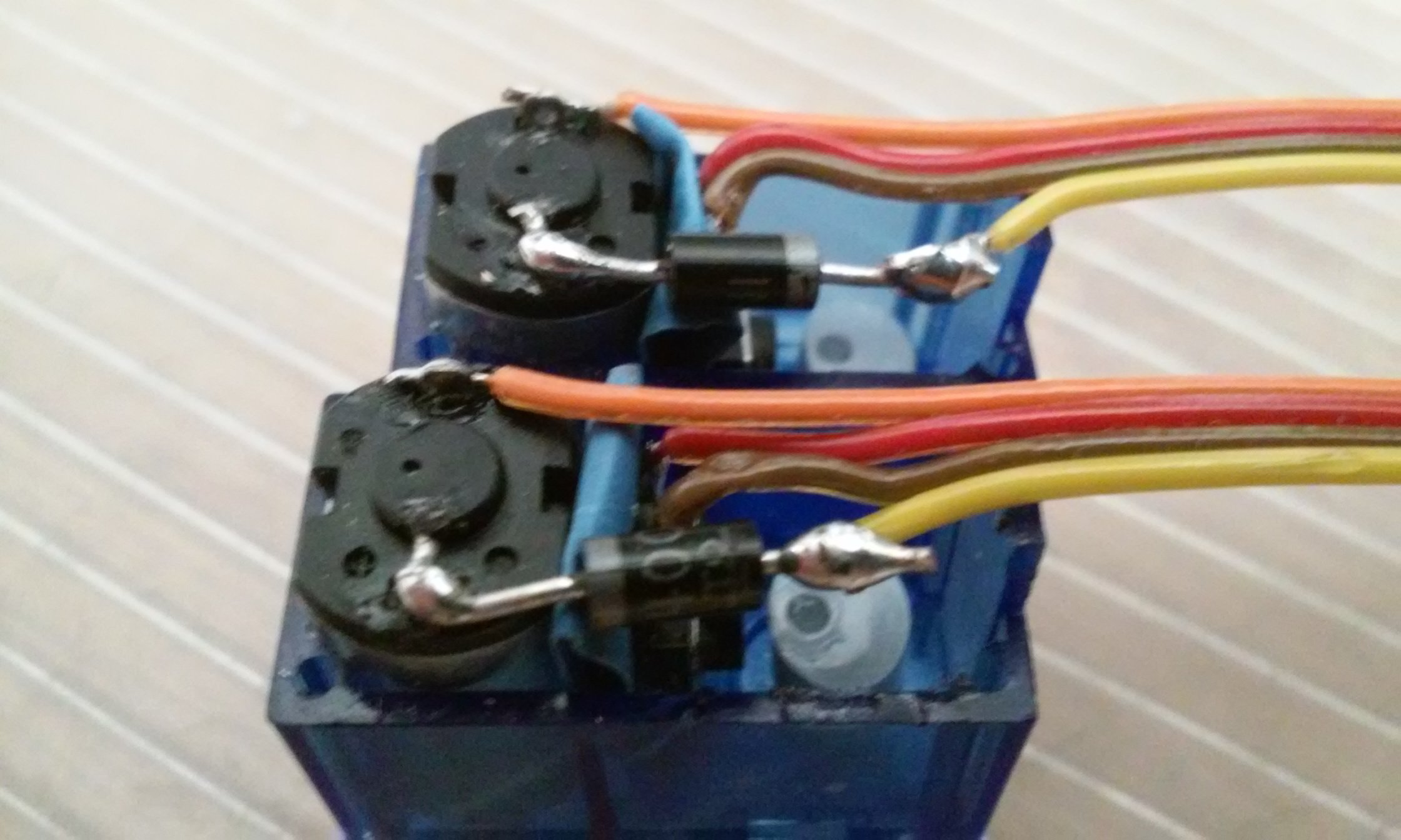

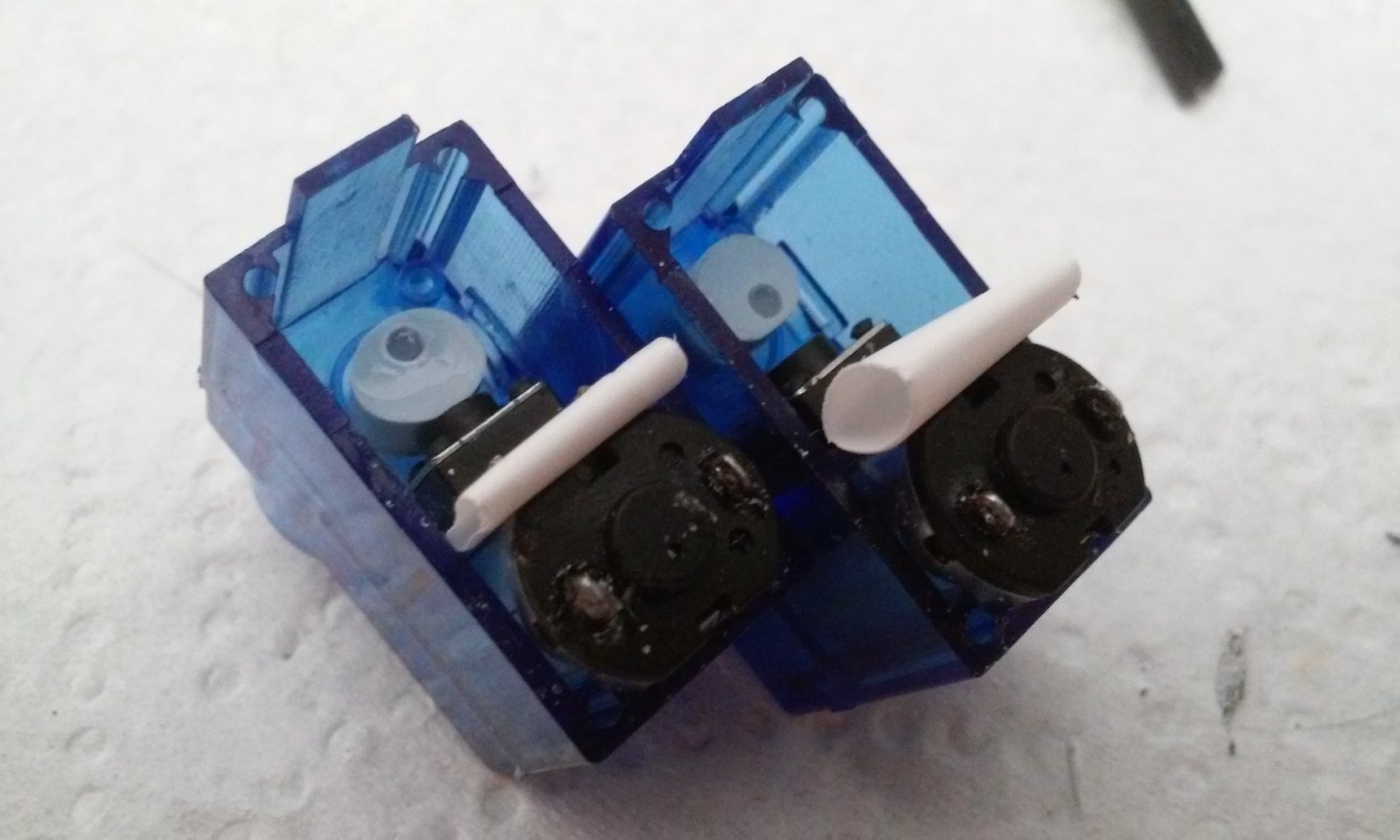

MechTech Posted December 8, 2019 Posted December 8, 2019 Hi guys! The Hexbug remote basically has two channels on it. They both go forward and reverse. One channel will power the hangar door (previous drama in the last few posts) and the other will trigger both lights and the radar. I got 10- 9gram micro servos cheap on Ebay. Two will be made into mechanical switches for the lights and radar. The servos have a shaft that runs down into what used to be the potentiometer so the servo knows where it is turning. I put a cam on that shaft which "pushes" an on and off push button switch (you can see them in the photos-one is open, the other is pushing the button). I'm doing it this way instead of a relay or other electronics because this requires no power to keep the accessories turned on. To make one channel into two, I'm cheating. The one photo with the wires and soldering exposed shows the diodes (the black cans soldered to each servo motor). Sorry, it's blurry. If you notice the stripe on the diodes, one is facing towards the motor and the other is facing in the opposite direction. For those not familiar, diodes allow electricity to only flow in one direction. So when I push forward on the controller, only one servo switch will be allowed to work and the other won't and then visa versa. It kinda makes two channels for the price of one. Now they just have to be wired up to the accessories. - MT
arbit Posted December 8, 2019 Posted December 8, 2019 Mechtech, I had thought you were going to use the servo gear and arm attachment to hit a switch. I didn't know you were going to gut the servo and use the internal shaft to hit the switch. I assume the servo motor will go forward and reverse using the 4-wires? But how on earth did you come up with that? Is repurposing servos typical? I'm just happy if they run right and know where the heck they are, which they never seem to do.
MechTech Posted December 9, 2019 Posted December 9, 2019 Hi Arbit! The gears and motor are the only original guts. Two wires power the motor and two go to the switch. Push the transmitter for a bit and a little rotation activates the switch. There's no exact on or off, just "hit and miss tech," but its simple. The motor will only go in the direction the diode allows it to. One servo only will go when forward is pressed and only one will go reverse when reverse is pressed. I hope that makes sense? - MT

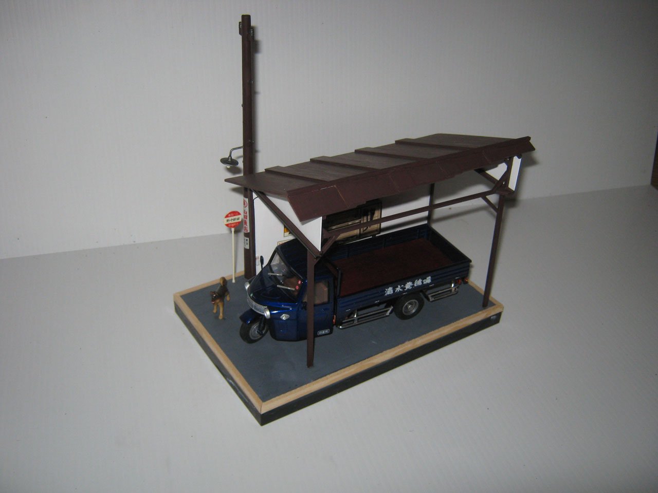

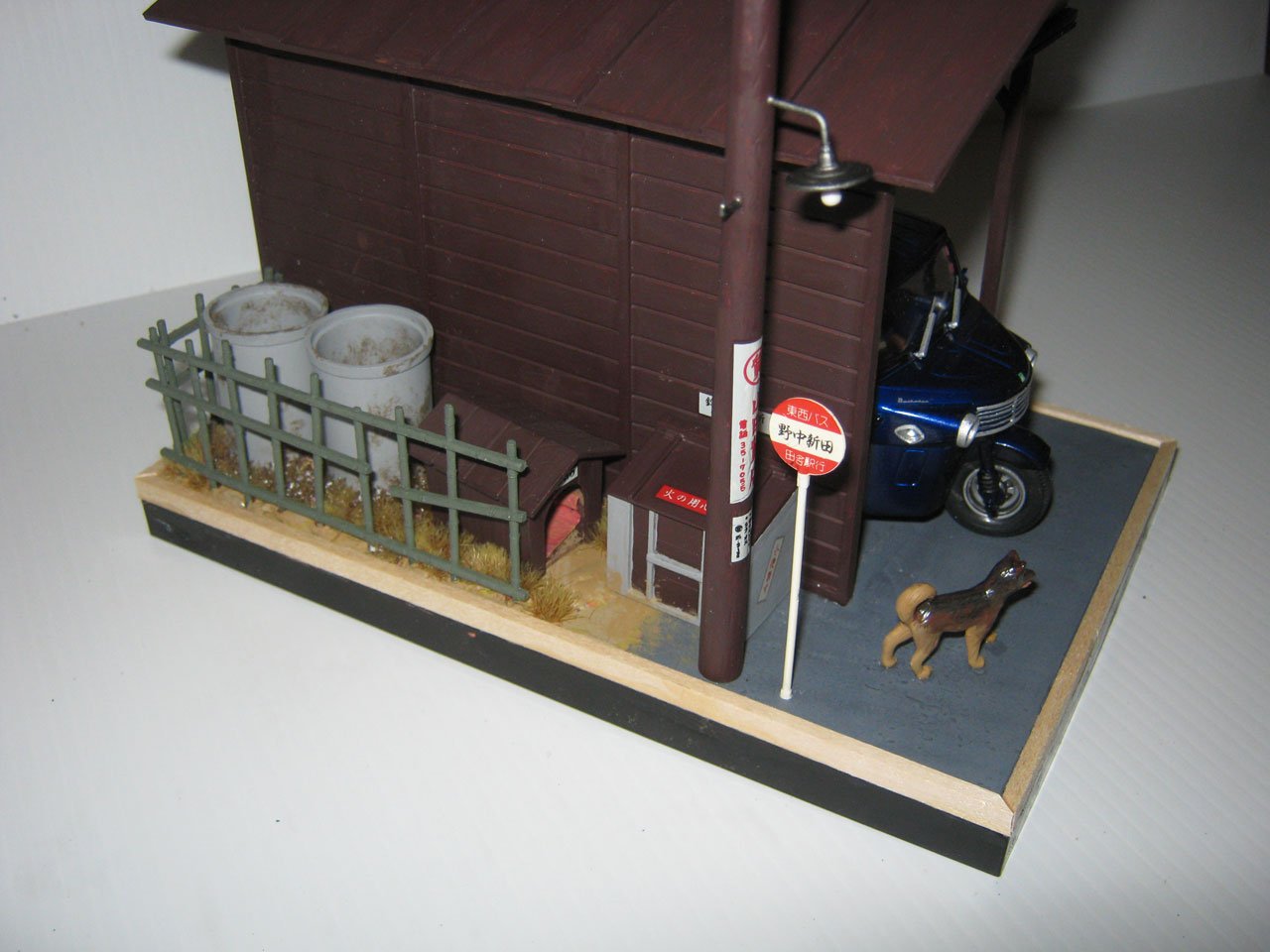

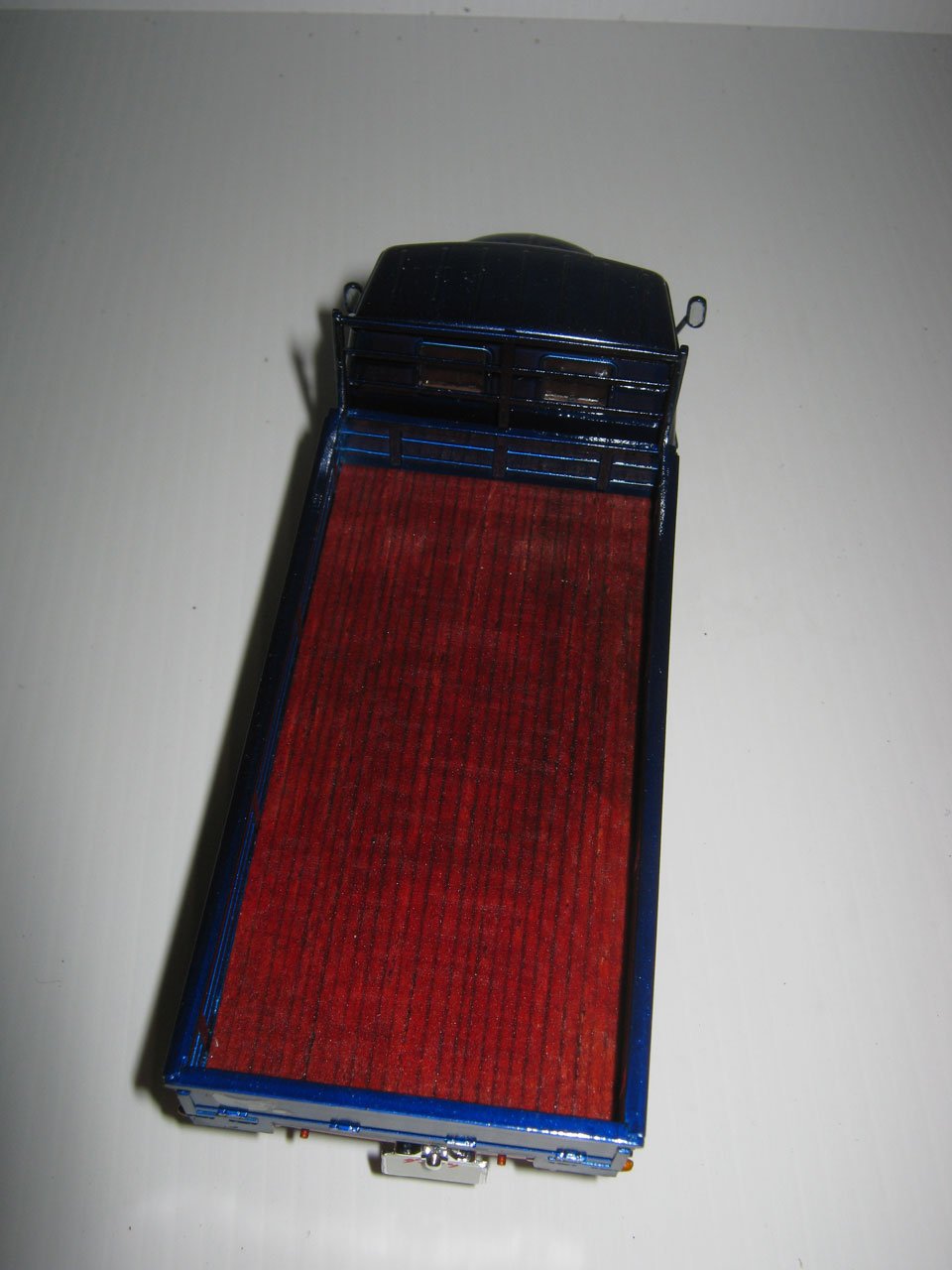

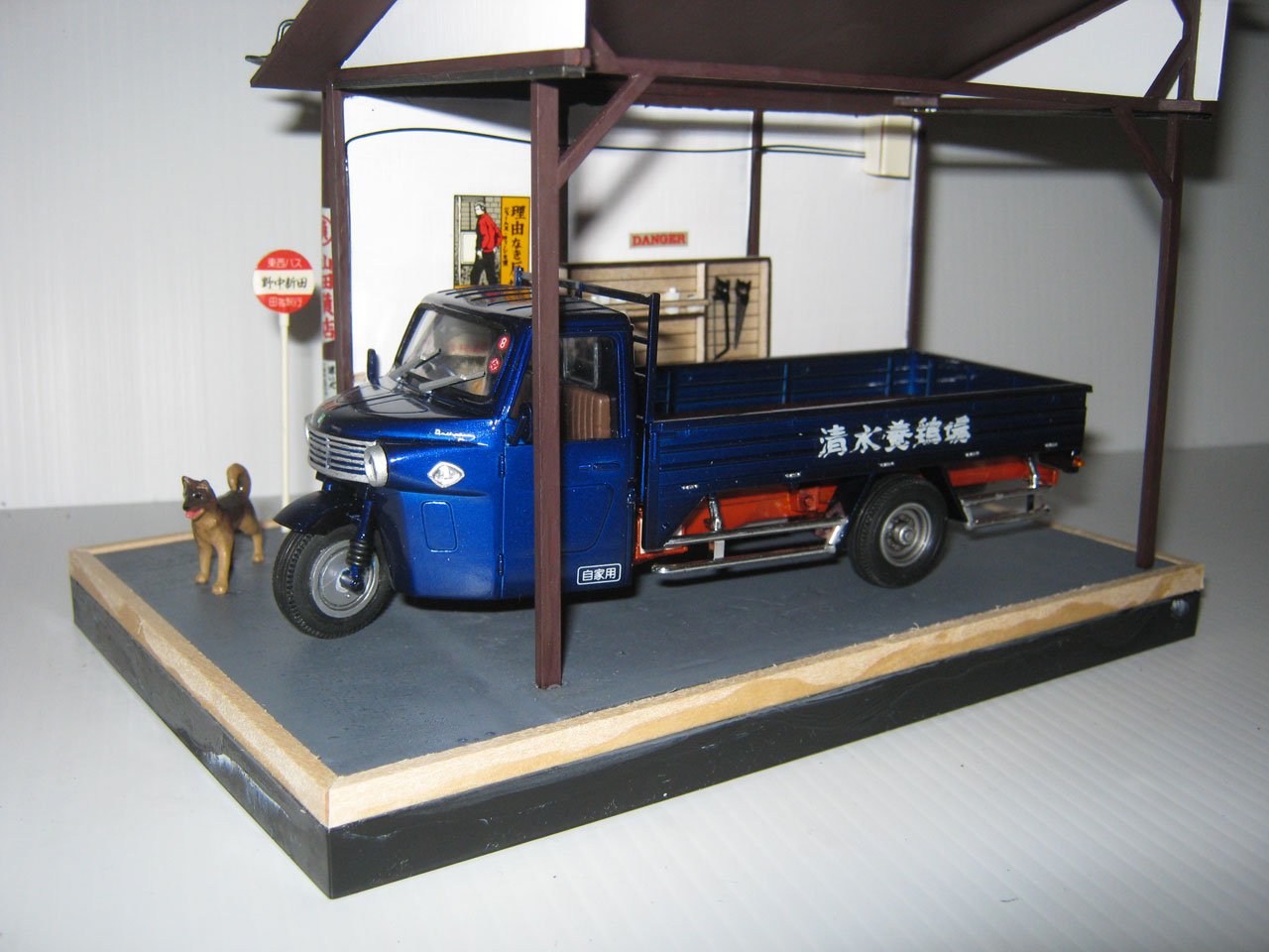

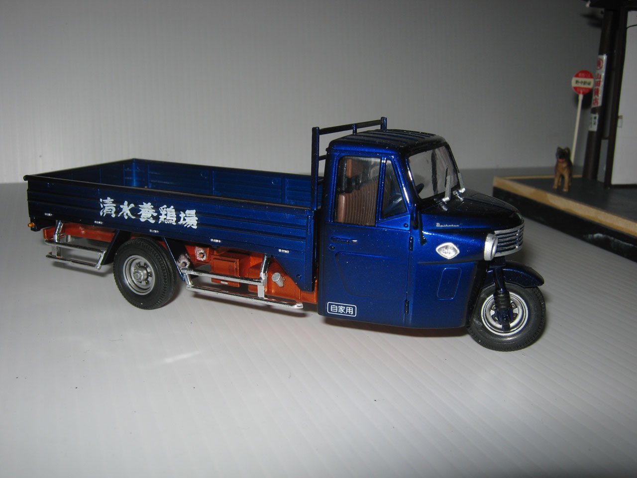

Salamander Posted December 14, 2019 Posted December 14, 2019 (edited) And the end of a project: Someone seems to have pimped their grandparent's old three-wheeled truck in their garage... Base kit: Arii Daihatsu CM-10T diorama kit. Scratch: garage, minor improvements to kit including wooden truck bed. From the spares box: Some chromed bits left over from an Aoshima kit. Other bits: CMK/Verlinden/AK/Yen Models/etc. Paint: Tamiya spray cans for the main truck colors, everything else Tamiya acrylics by hand. Edited December 14, 2019 by Salamander

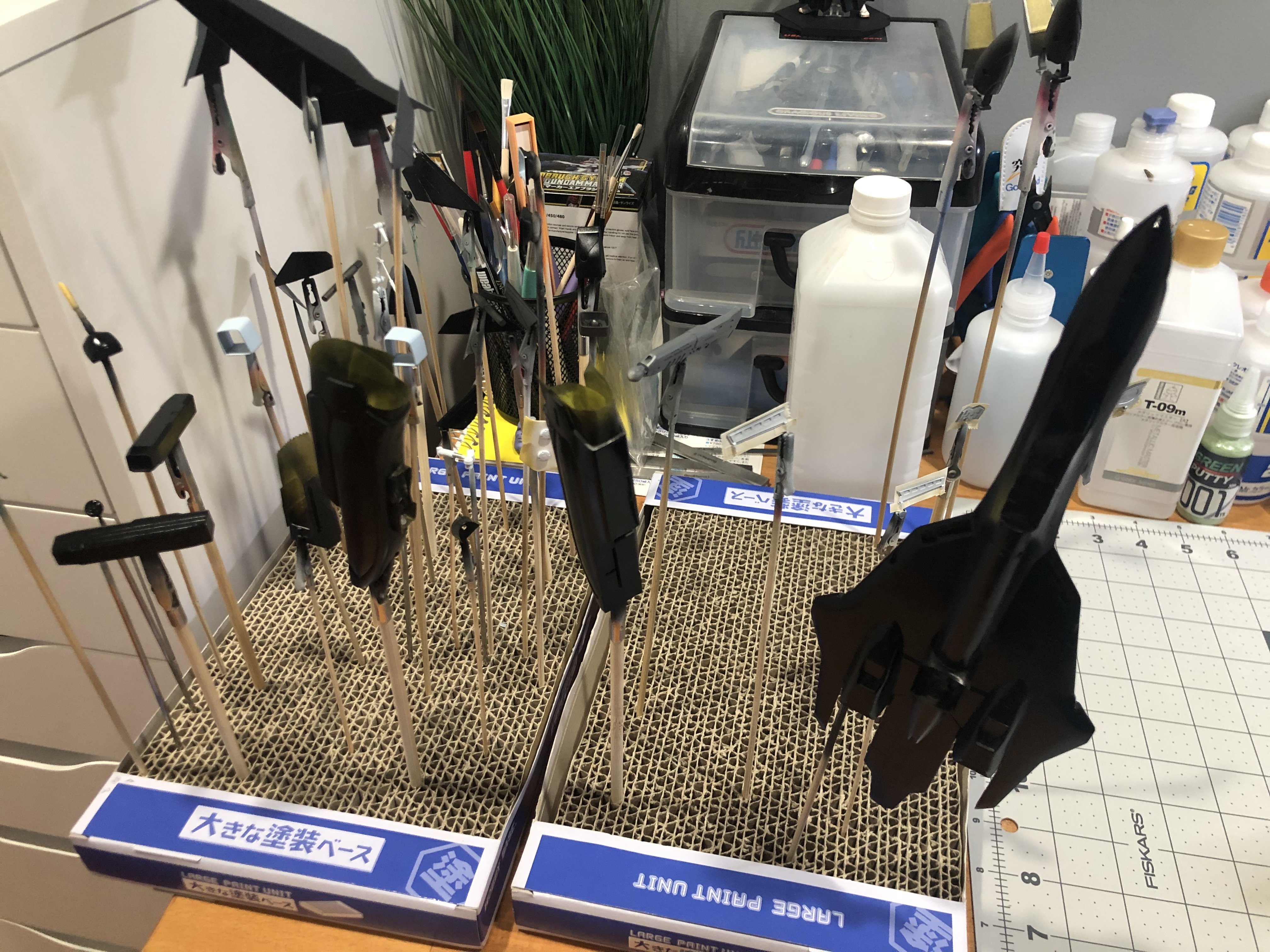

electric indigo Posted December 14, 2019 Posted December 14, 2019 This thread is buzzing as the year comes to an end! I got a long awaited letter from Moscow last week. Paint tomorrow if the sun shows up.

MechTech Posted December 15, 2019 Posted December 15, 2019 The Superbug is looking good Thom! Great diorama Salamander. The details really make it! That car reminds me of the three wheelers in England and Italy. Choice rides for pickin' up chicks in! Electric Indigo, that thing does look like its from Macross! Maybe that's where they got the look from? The paint scheme is looking cool! - MT

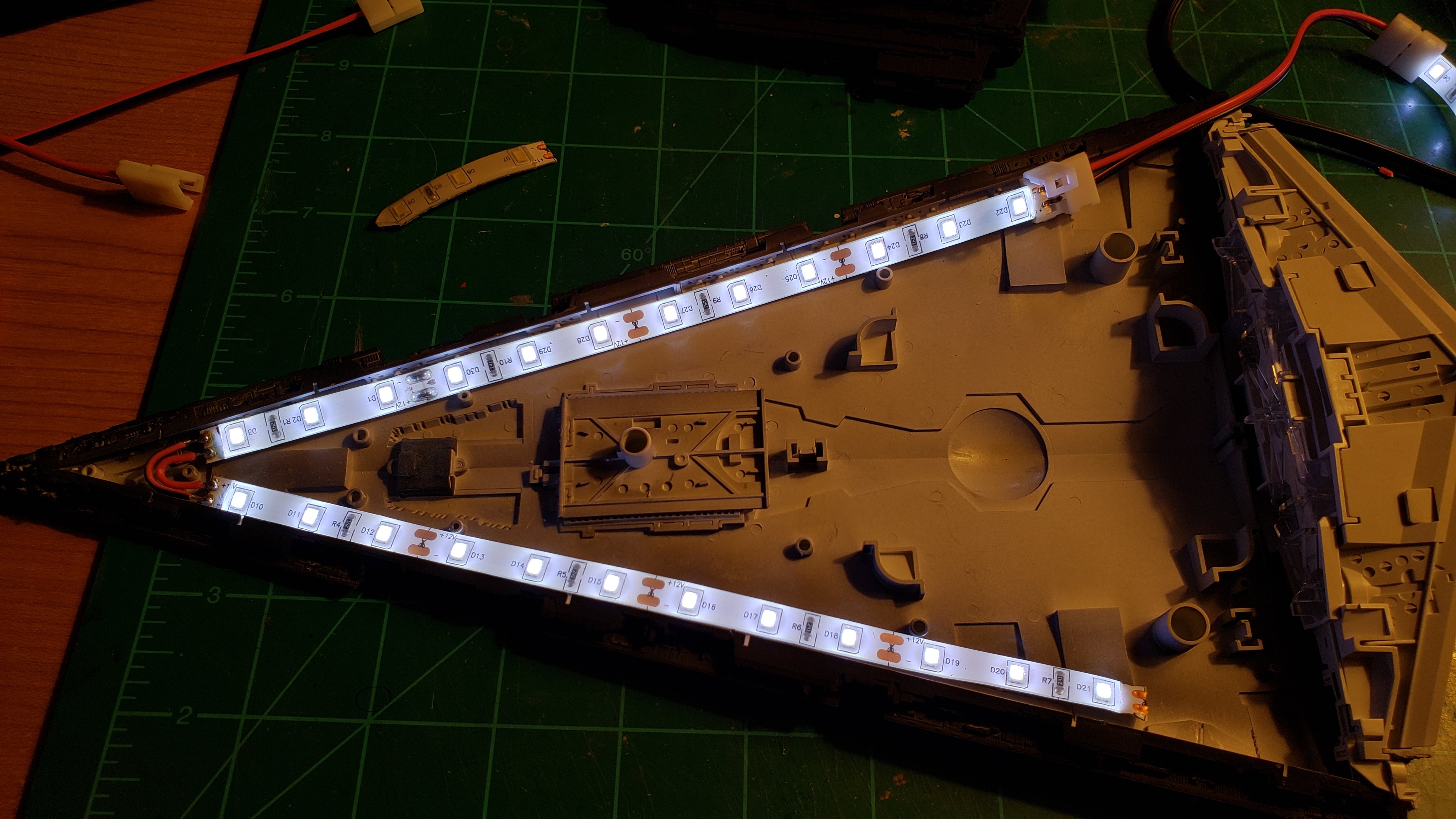

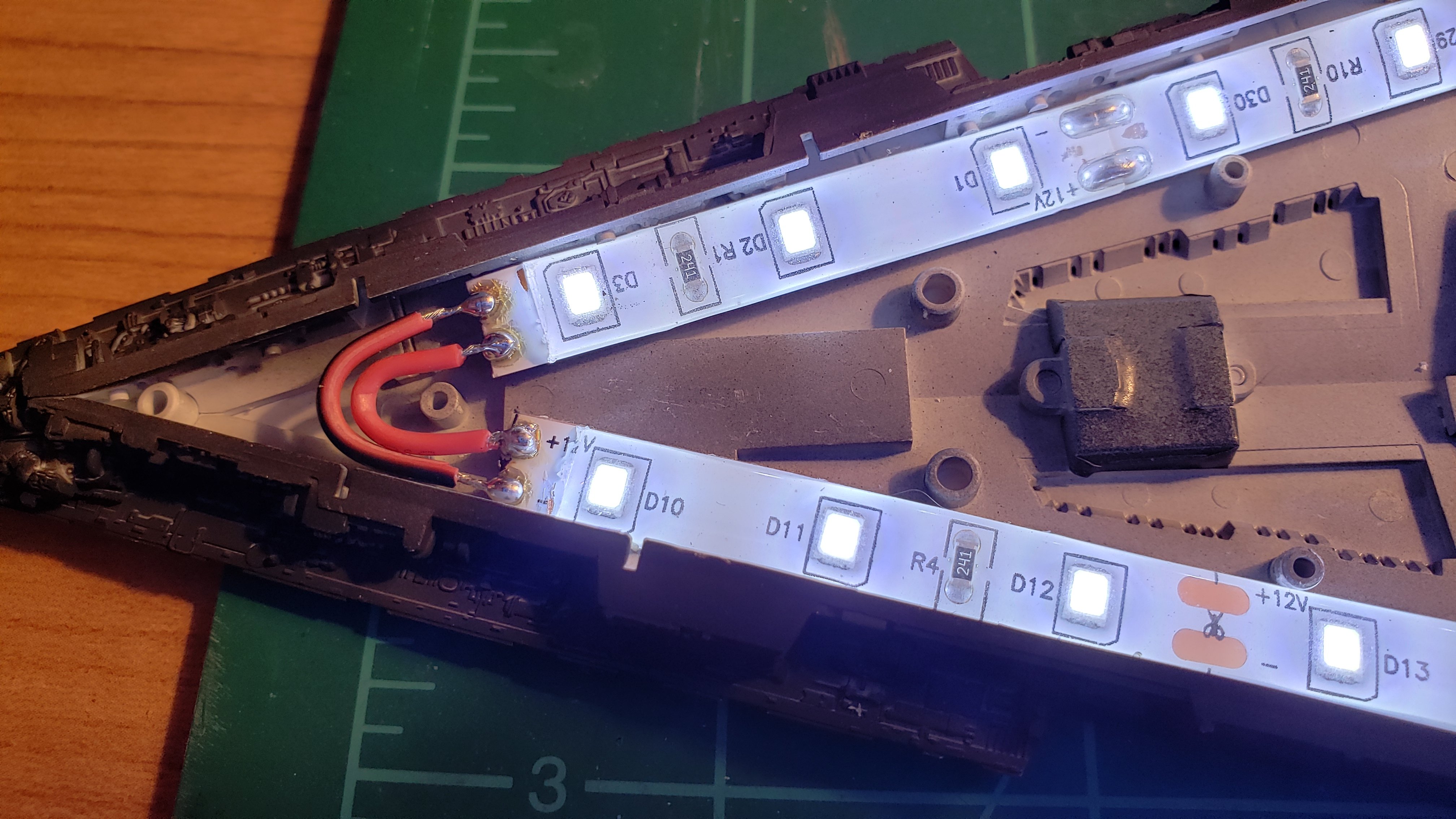

derex3592 Posted December 15, 2019 Posted December 15, 2019 This is only my 2nd attempt at lighting.....and the 1st was very rudimentary. So here we go... Phase 1 complete.

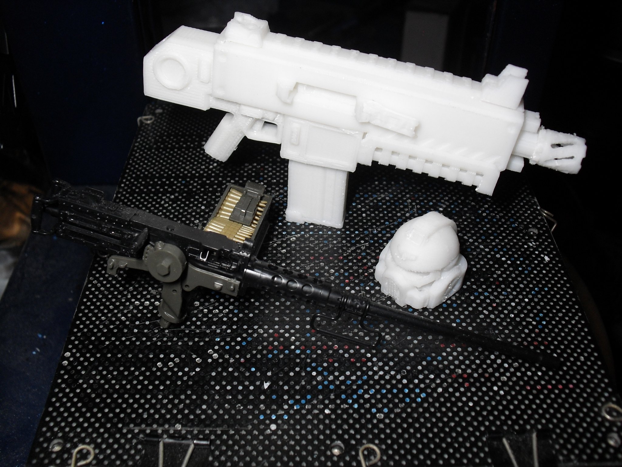

UN_MARINE Posted December 18, 2019 Posted December 18, 2019 New project! Who's into 40K? It'll be in 1/12 scale when it's done. Tomytec Little Armory M2HB for scale.

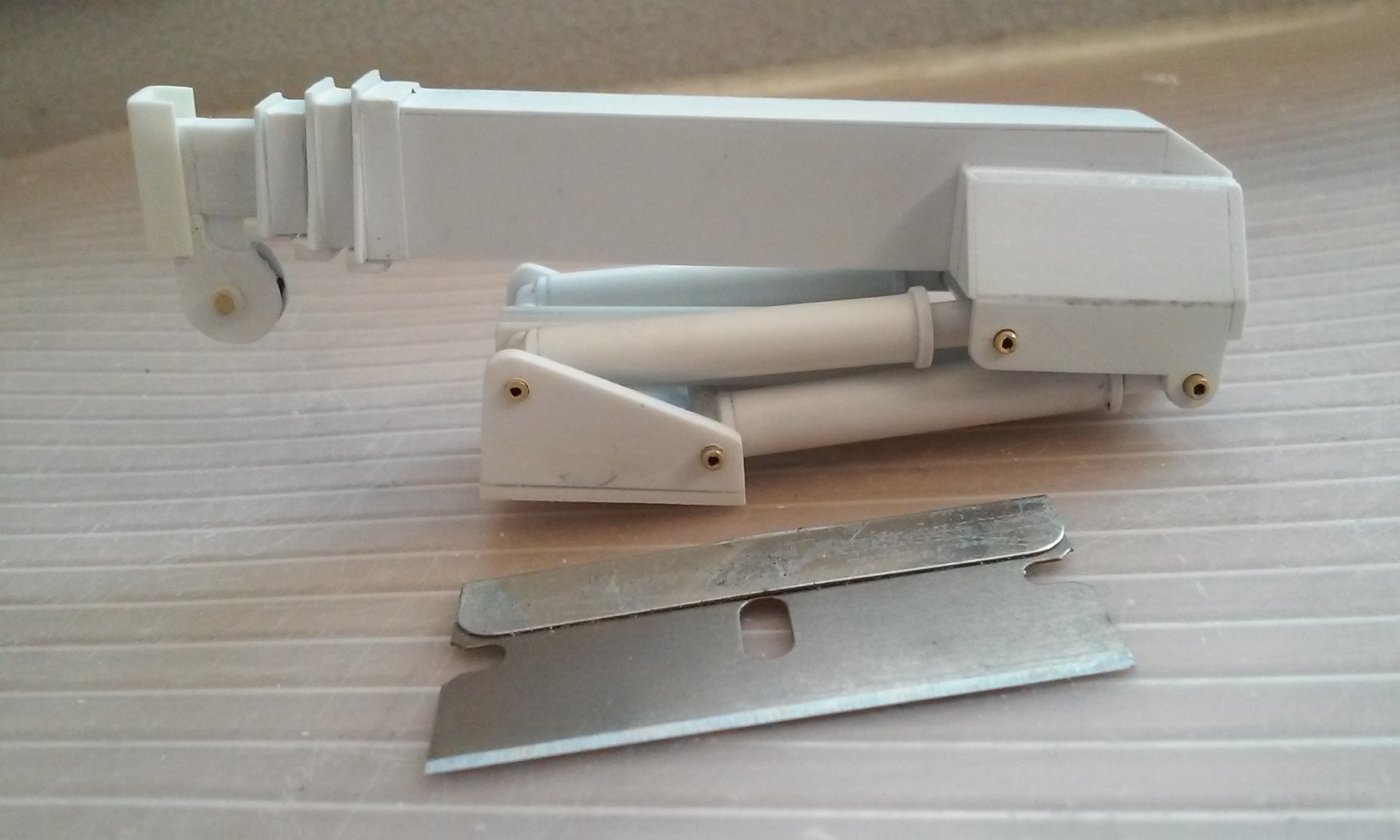

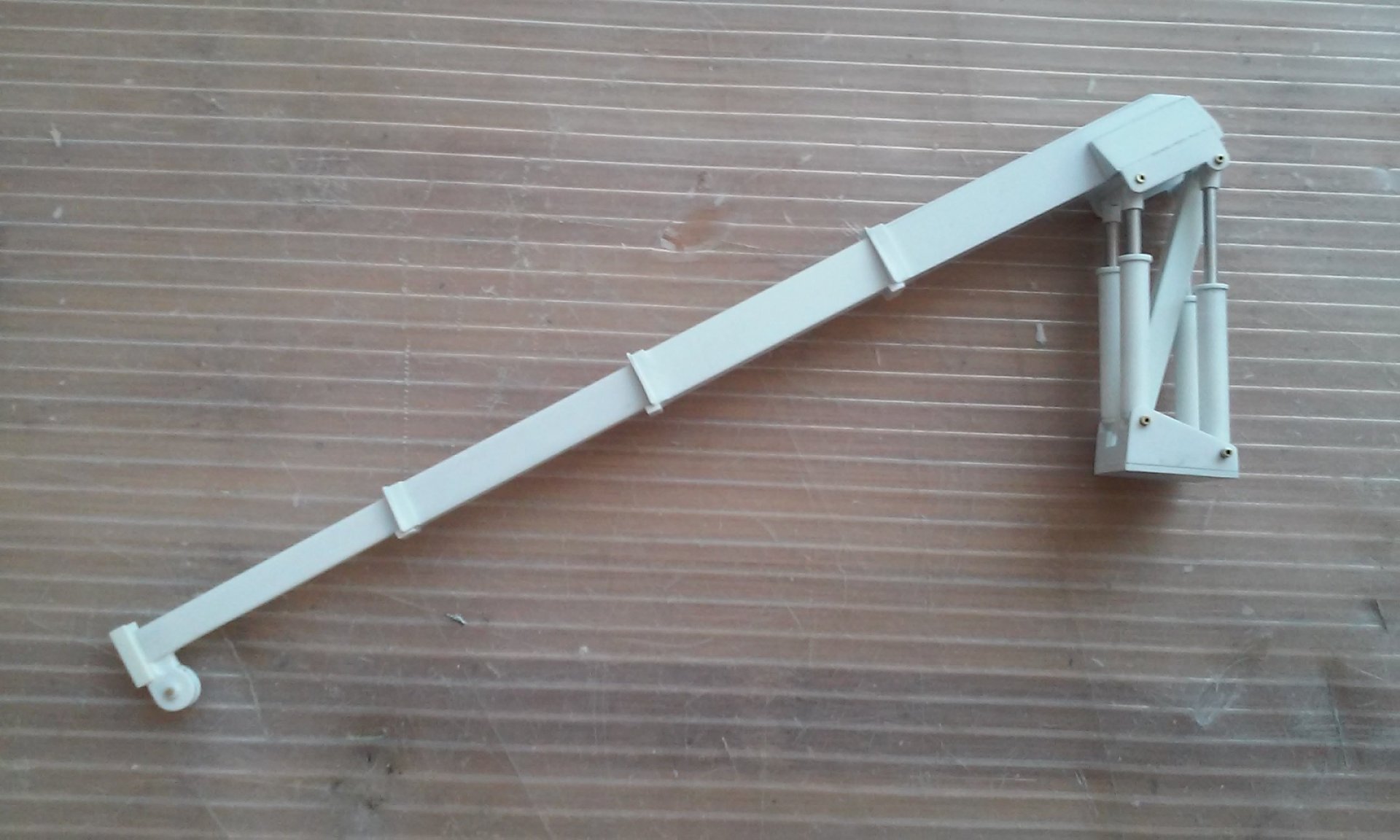

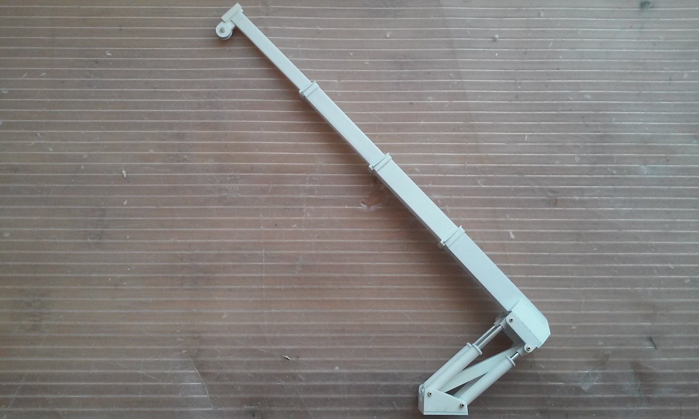

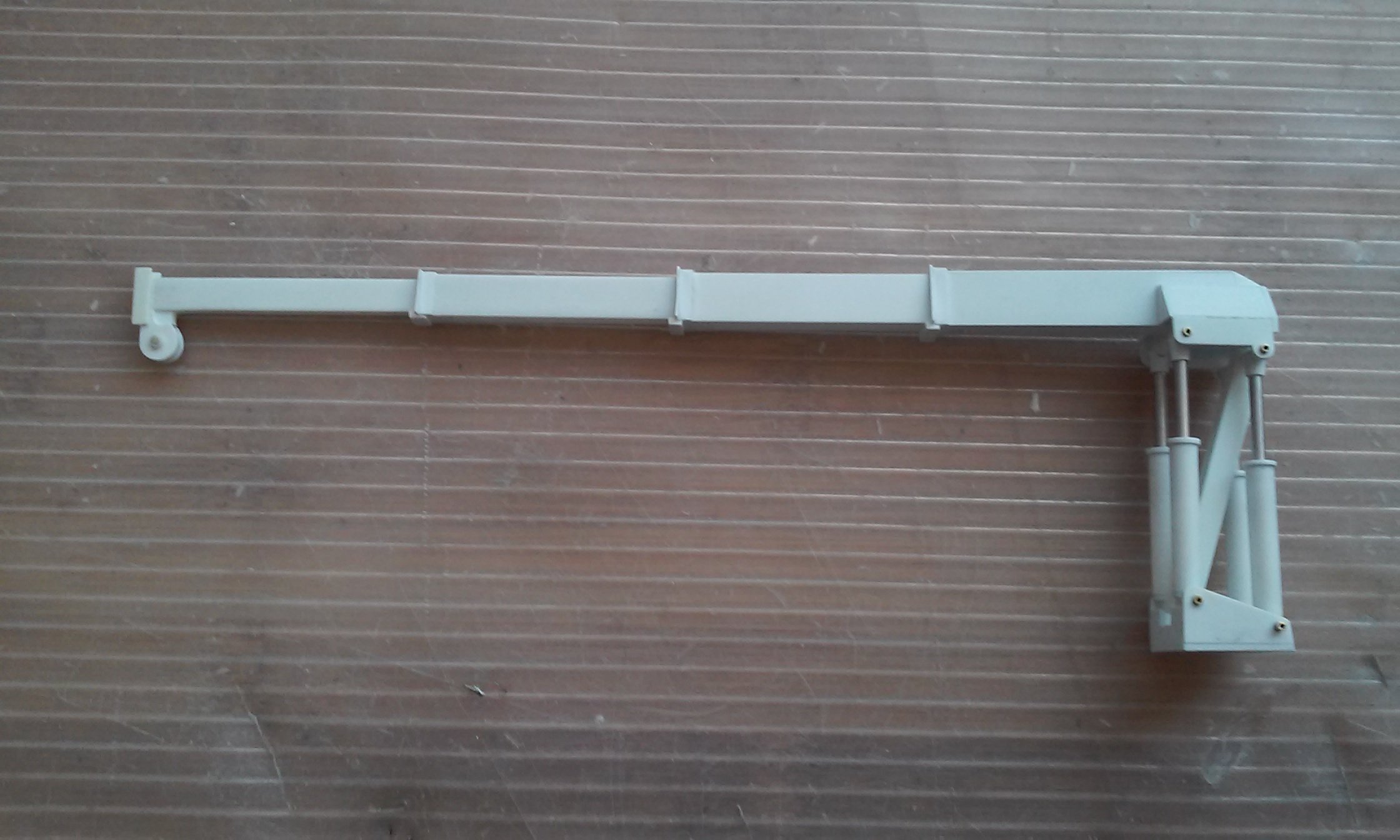

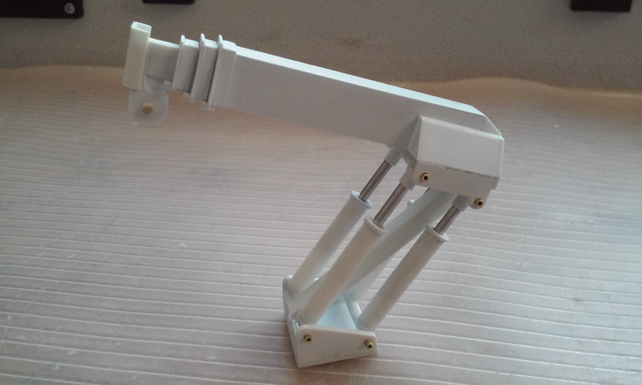

MechTech Posted December 25, 2019 Posted December 25, 2019 Merry Christmas everyone! Nice n clean Thom! It looks great! Been working this week on the crane for my ship. Its a hydraulic style folding crane. Its all styrene except for hollow brass hinge points and aluminum tubing for the hydraulic shafts. Still has more detail to be added. - MT
