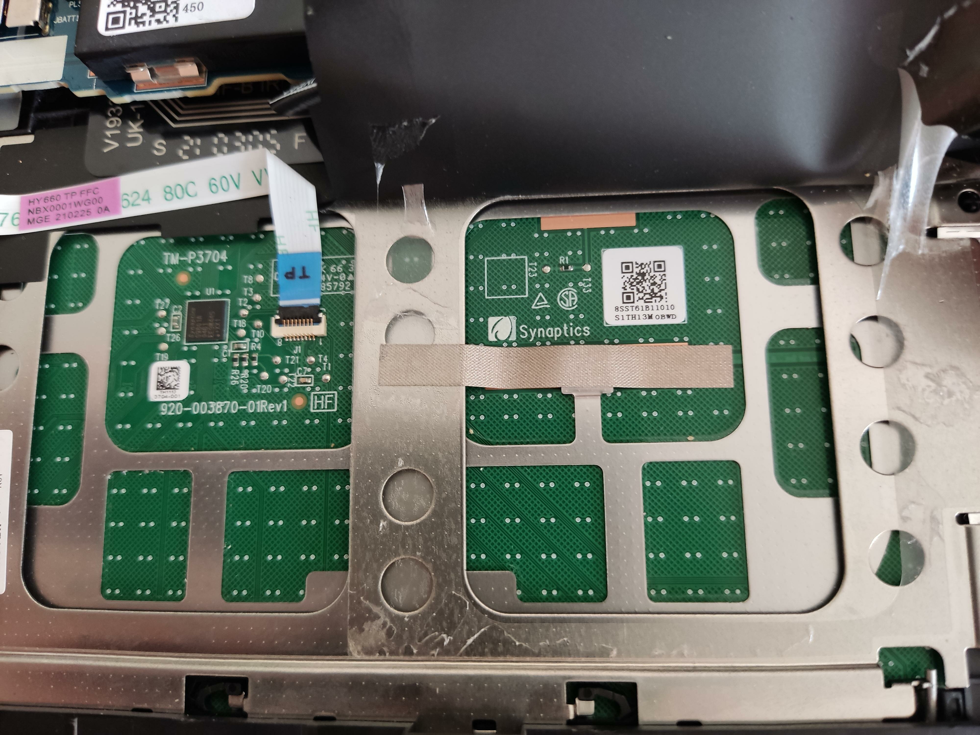

I had an issue with my legion 7 2021 where one of the laptop speakers (the left) would cut out. Turns out on all the legion 7, the ribbon cable for the left speaker with come loose over time (heat, movement of laptop) I would re-seat the ribbon cable and it would again dislodge 8 months later. I put a fine piece of electrical tape over the ribbon near the connector, never dislodged again. This seems like pretty widespread on multiple lenovo models: Re-seat, cable (probably put some tape on it) Ground the trackpad to the chassis. The copper tape lenovo uses at the factory is flimsy causing the touch response to cut in and out so the electrical static build up seems to cause some issues if not grounded). this is the mod that a user on reddit used as a solution: (original and post mod pic) -

👍 My concern is, if the continued expanding/contracting of the plastic along with day-to-day jostling causes the connector to come loose, is just reopening it and re-seating it an permanent fix? -
