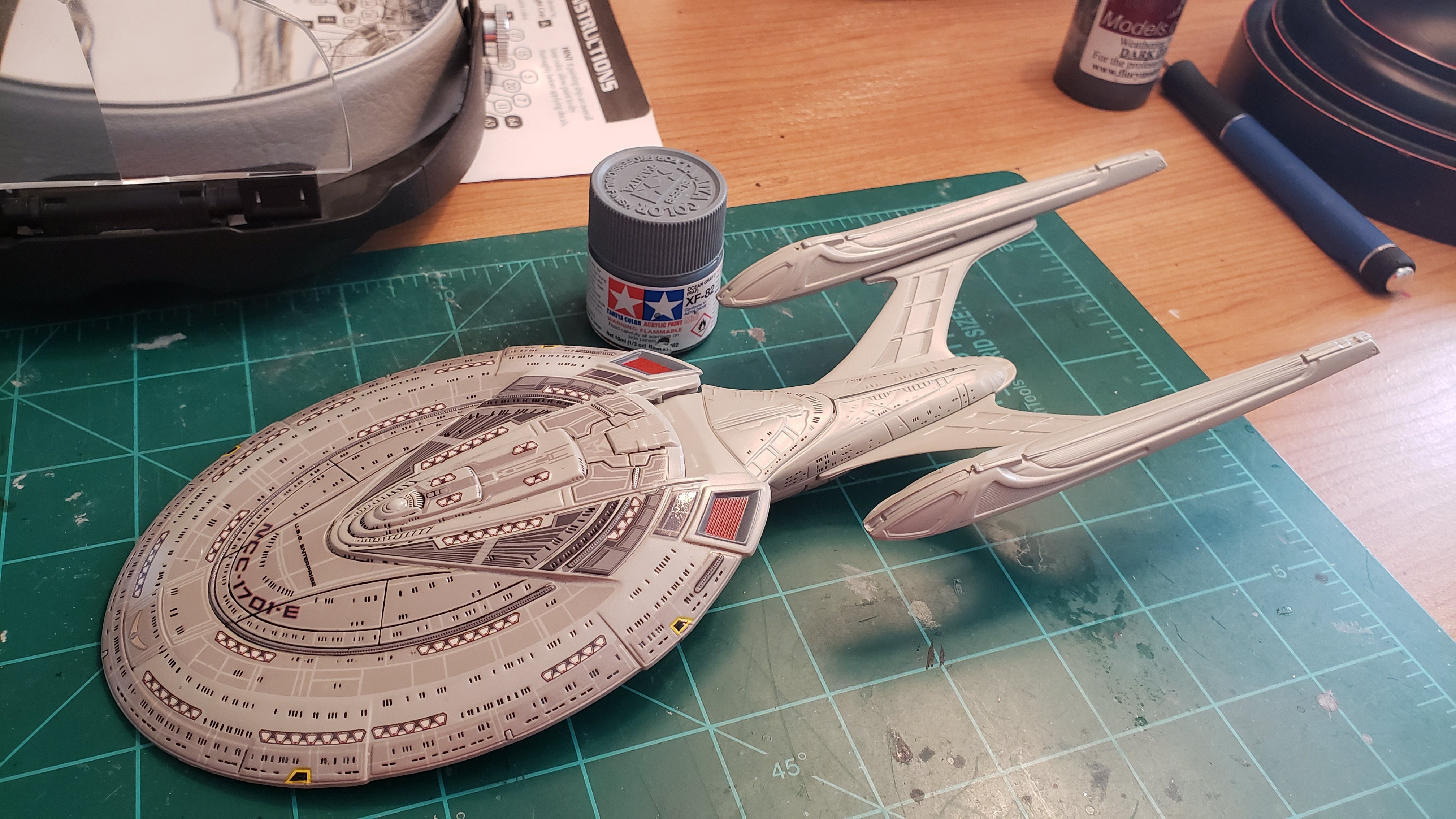

I practiced my method on the Enterprise C, paint, gloss coat, few applications of Flory's Dark Dirt wash, let dry and wipe, then go in with a tiny brush and do a little clean up..is it perfect?...no...but then again neither is the mold. Some are just to shallow to hold the wash, overall though, simple and effective. The "D" the windows were on the decals, which honestly I thought worked out way better, but the "E" was a newer mold so I guess that's why they were on the plastic.

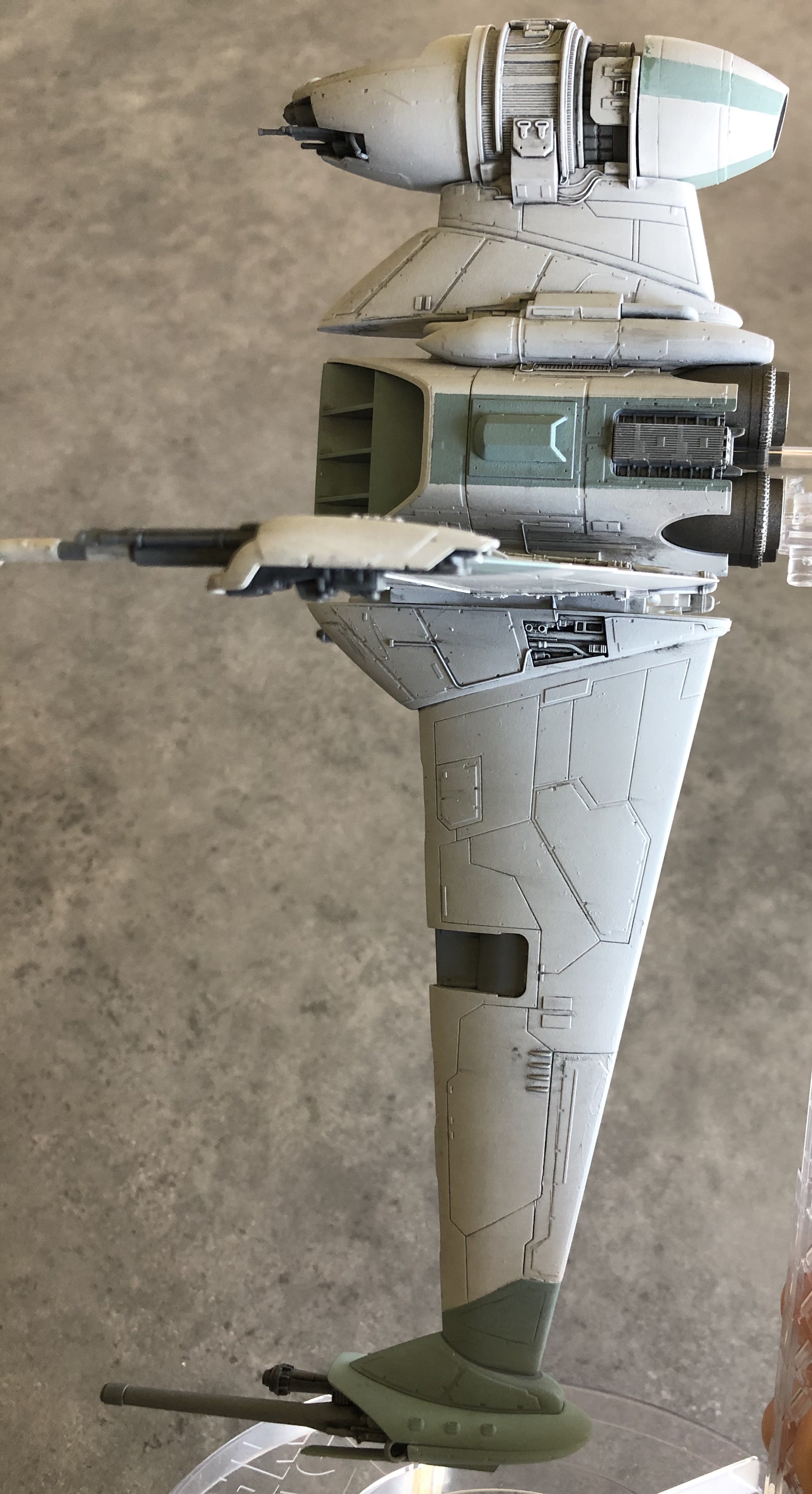

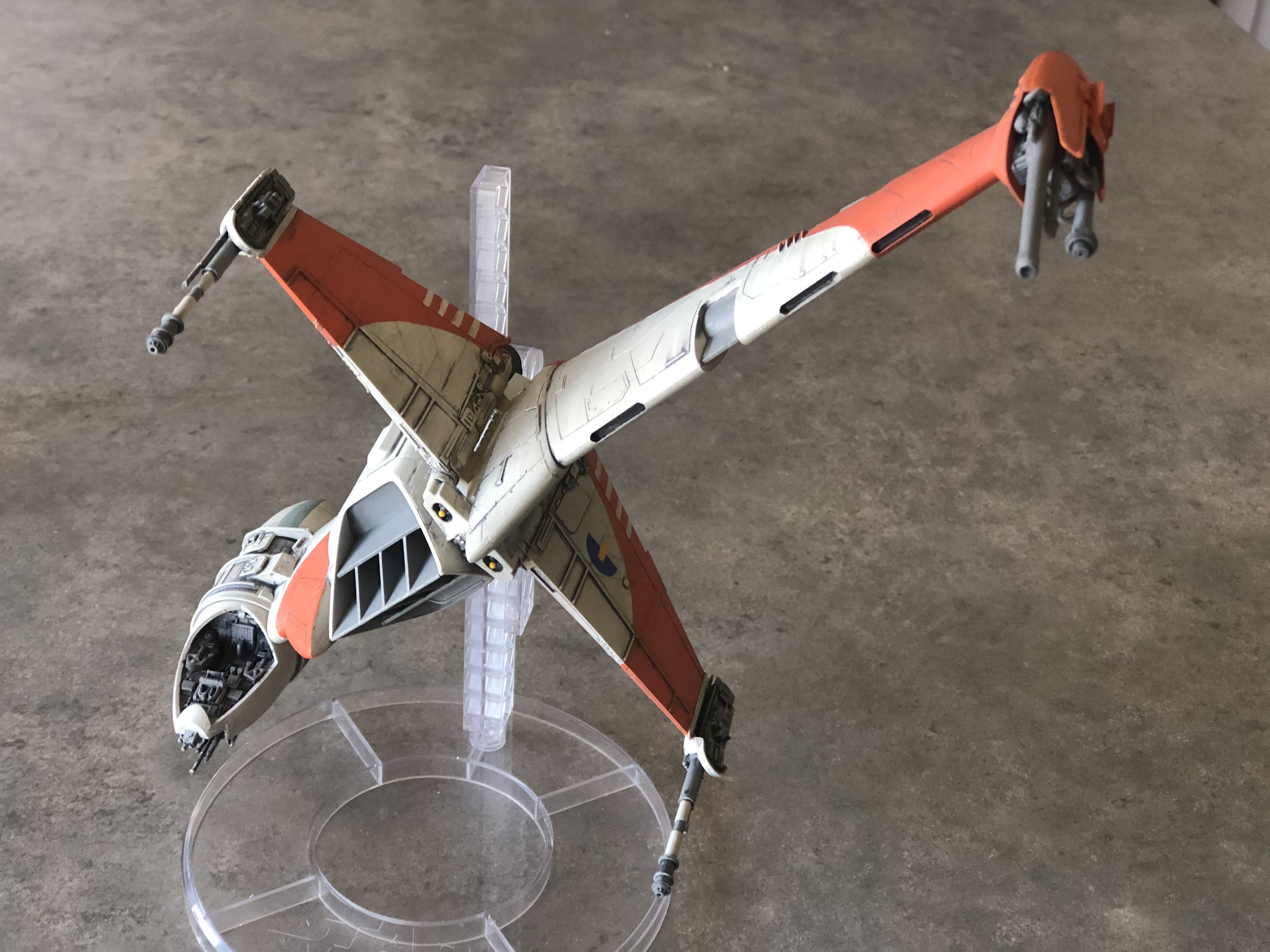

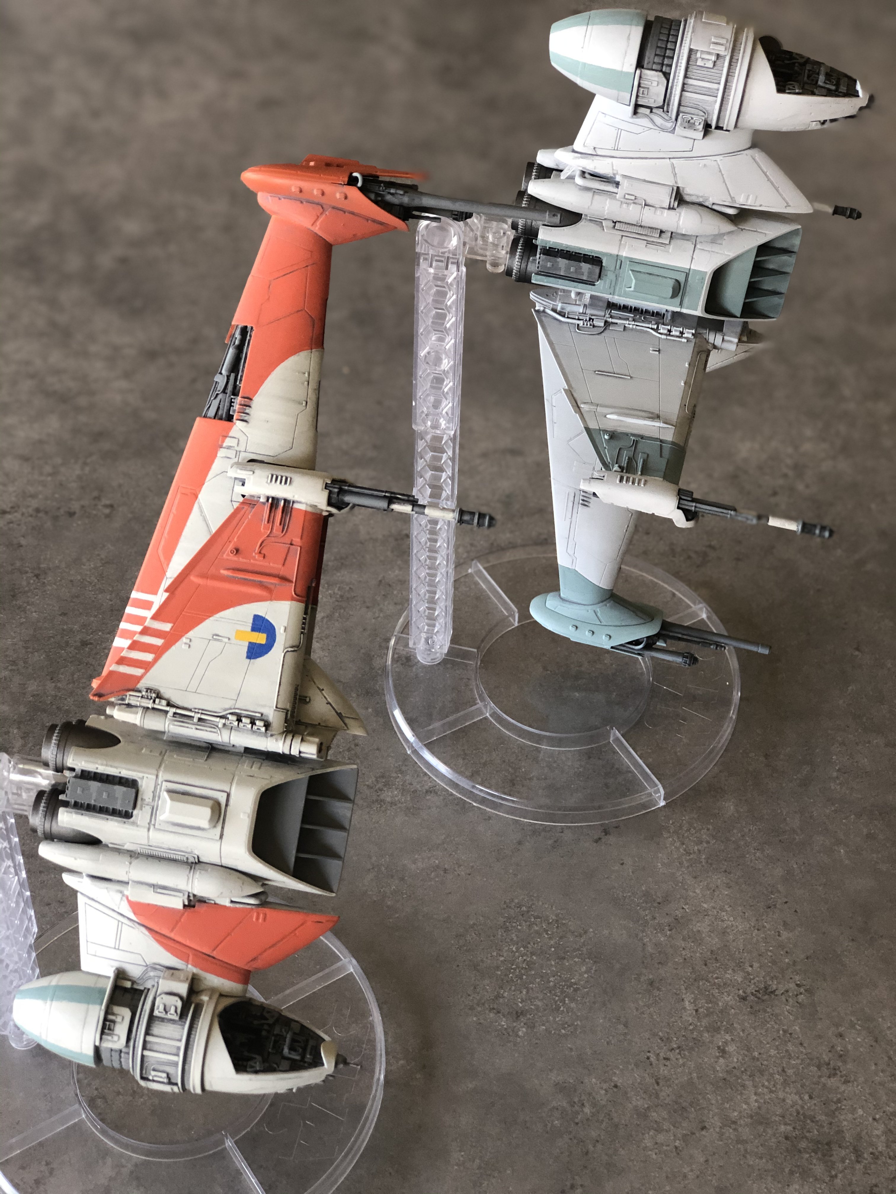

I stepped away from building for a while....some personal issues in my life and lost interest in it....but I’ve started up again. In honor of May the 4th here are my 2 Bandai B-Wings I’ve been working on. Still need to finish the cockpits, pilots, and then decal. 1 custom and 1 will be the battle of Endor Meatball marked one.
Chris
Really nice B-Wings!!!!
Welcome back Benson and Dobber! Long time no see! Those B wings look great Dobber! And May the 4th be with you too! - MT

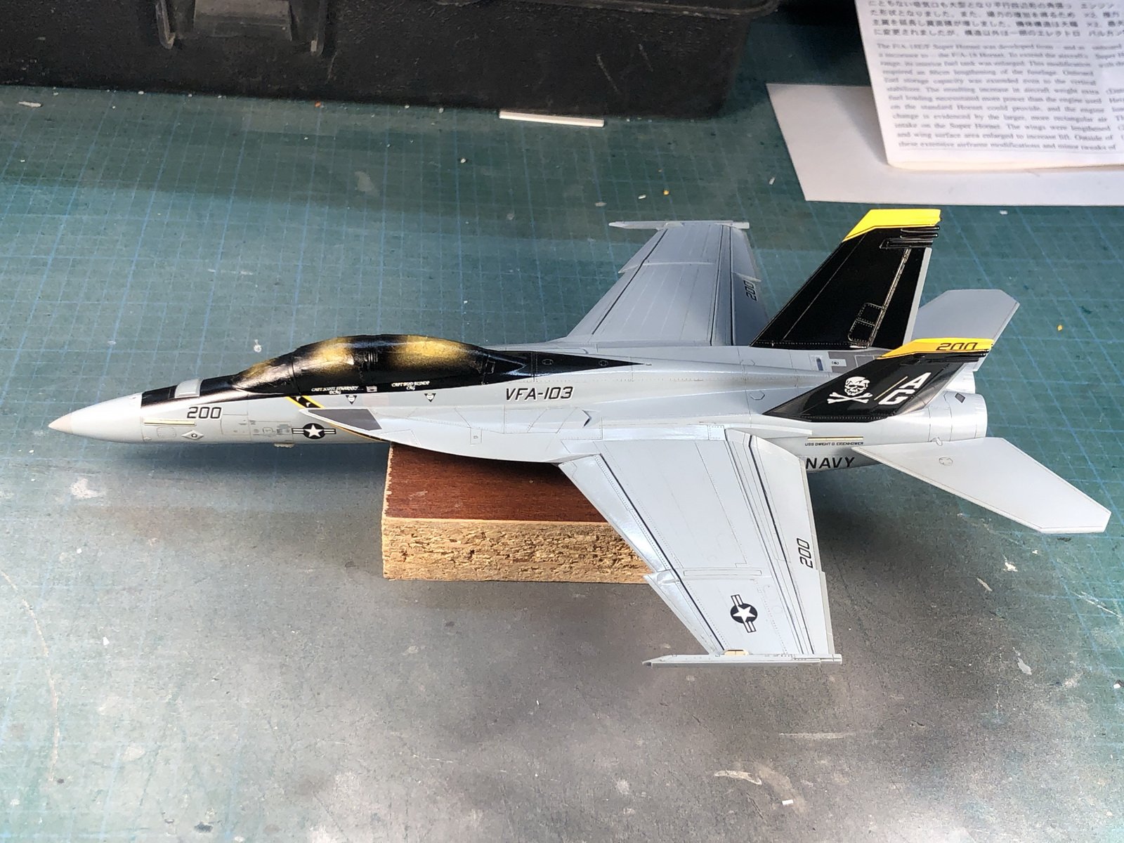

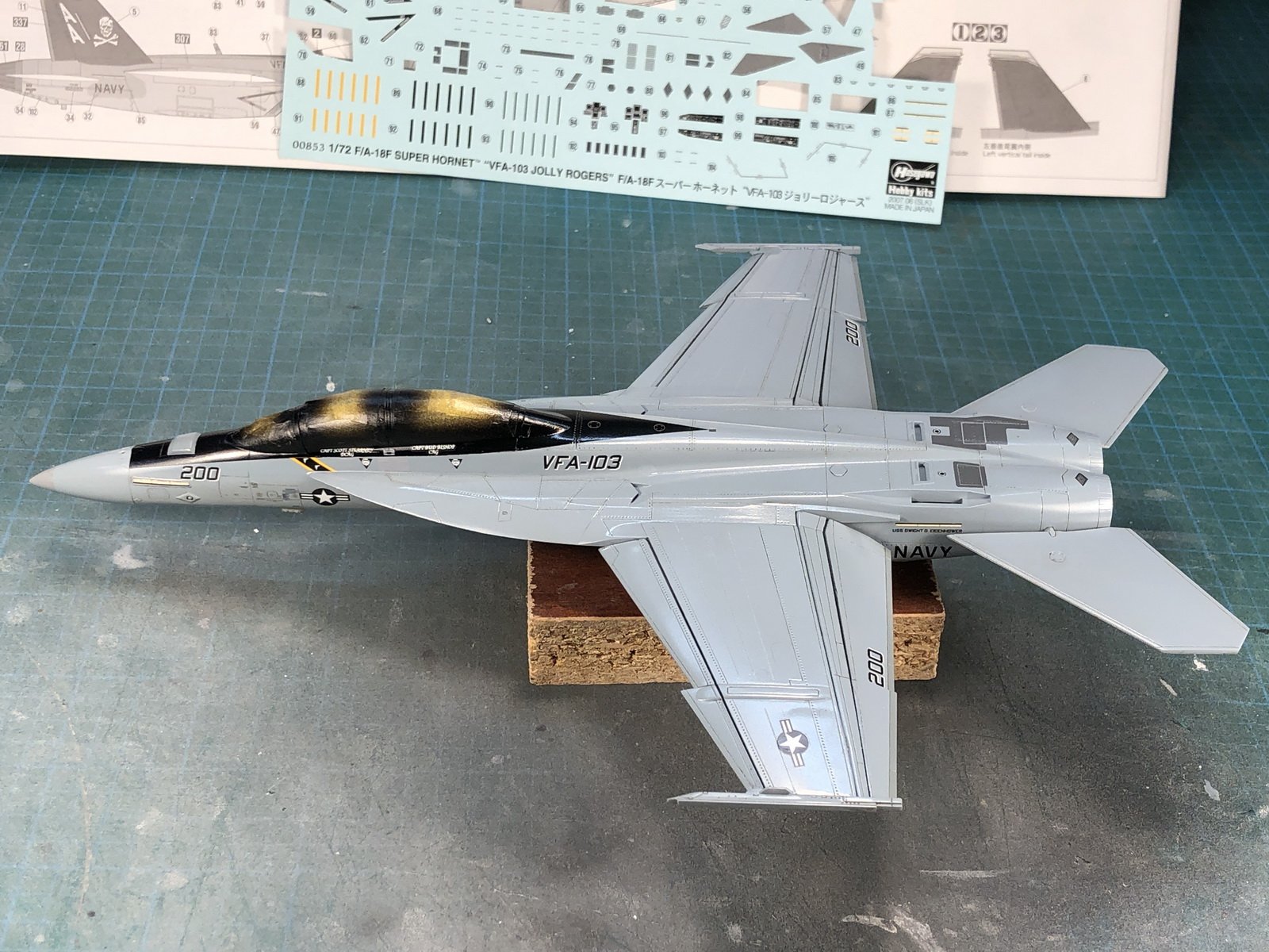

Starting to look a little more like an airplane finally!!!  I love this part, decals are my favourite.  Its looking like it rolled out of the factory at the moment all shiny and new.  Those yellow rudder tips are a bitch to get around all those bumps and flarings - thank goodness I decided to paint the rudders black and only have to deal with the yellow tips, they included the entire black rudder as a whole decal piece (I can just imagine the nightmare).

@arbit  I just use future straight from the bottle.  I airbrush it at low pressure 12-15psi and fairly close to it goes on wet and allows itself to "self-level".  If you spray it too far or to high of a pressure it often "pebbles" and creates a rougher texture which I have done, just make sure its evenly coated to protect the matte paint below.
I love the easy clean up of Tamiya, however I am liking these Mr. Color paints for real world aircraft as they are pre-mixed to the right shade of grey.  Even with my careful matching I have noticed that each batch of Mr. Color or Tamiya could be a hair/shade off.  So even with my careful matching, the Hasegawa data stencilng grey "NO STEPS" are almost disappearing into the top grey.  I don't know if my paint is a shade too light or the decals a shade too dark, but needless to say lots of tiny "NO STEPS" and "NO PUSH" after 5 hrs of decalling almost disappears. :(
I have now resprayed a future gloss coat over just the decals to seal in the carrier film edge (I trim as close to the printed edge as possible) and blend it in.  I will spray it flat over the entire thing to even it out afterwards and start to dirty it up with a little post-shading and rub down of panels and streaks.

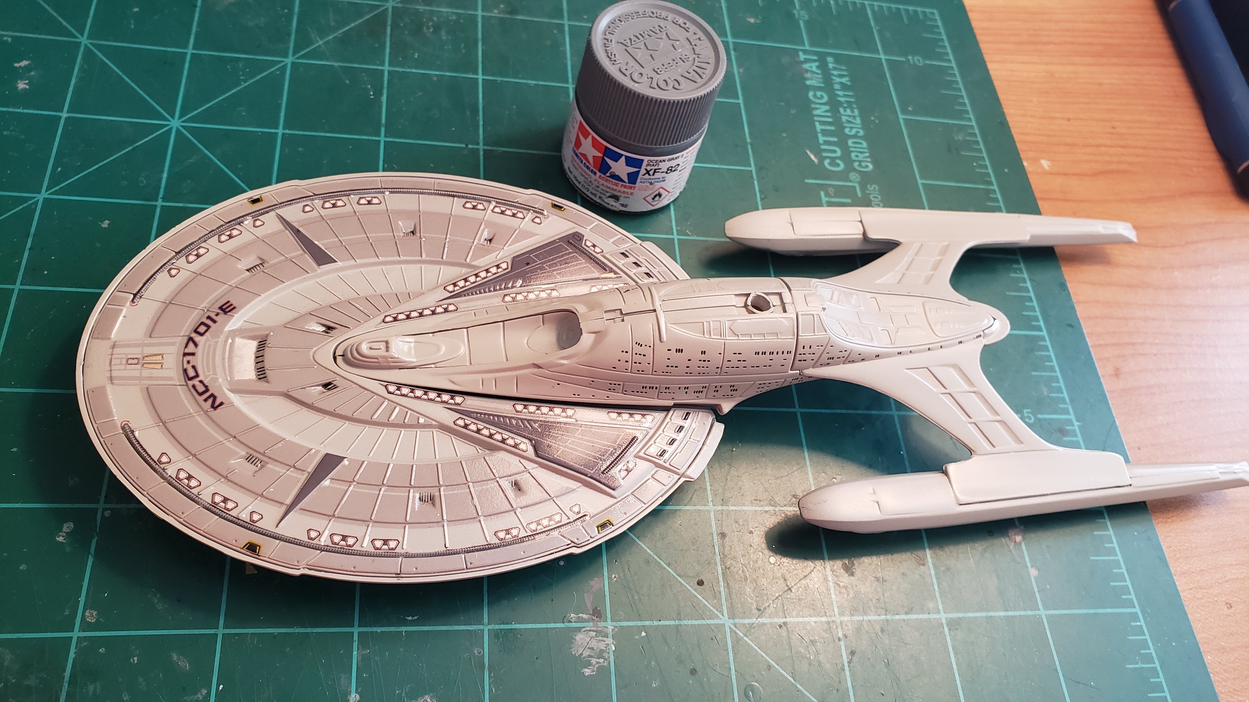

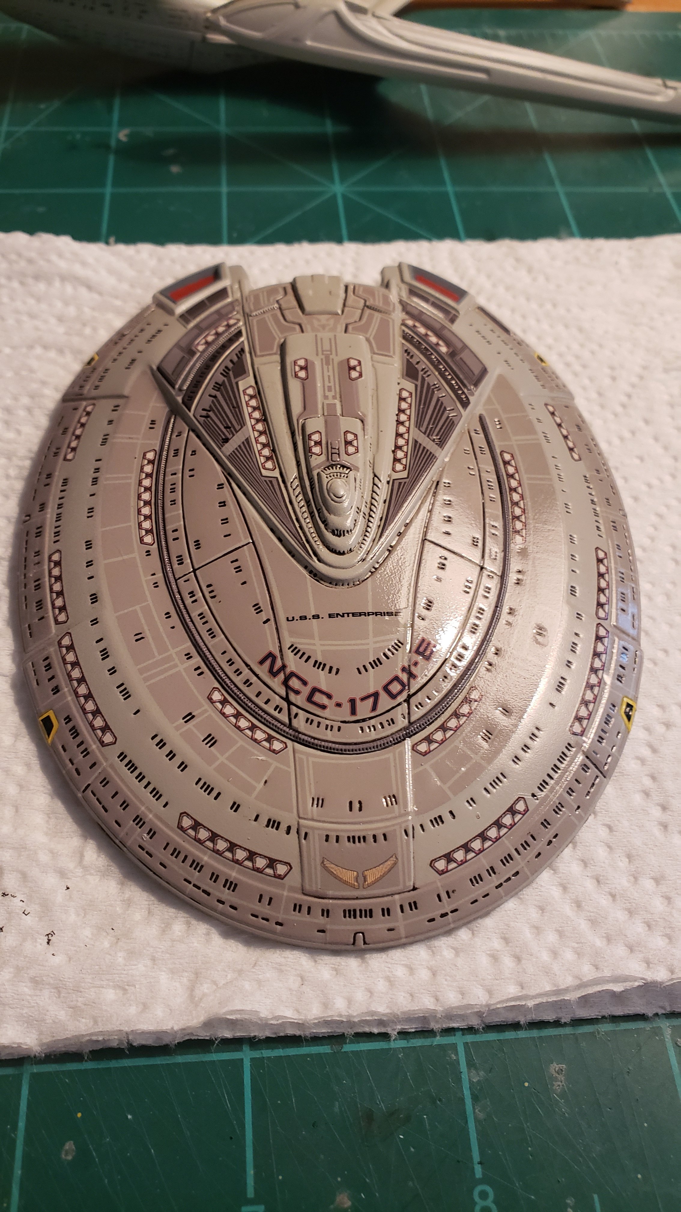

I'm calling the saucer done! B)) Bottom is also finished, now onto the secondary hull and those wonderful long skinny warp nacelles... uhhhgggggg. <_<
Came out nice!  Though, I have to say, the E's decals look pretty simple compared with all the other ships in that set.  Did they just not attempt printing any of the smaller panel details on the decals?
VERY NICE @derex3592!  I was just thinking the same thing as @Chronocidal and was expecting all the little panels inside the main fields printed on the decals too.  I guess I don't understand the size, could you put a ruler or something in scale next?
Well the yellow tips to the tailfins were a nightmare!  Just discovered that you don't leave Mr. Softer on the decal in a droplet or pool, it will completely dissolve the decal in that spot, its much more strong than Micro SOL.  So in order of strength, I've discovered: Micro SET, Mr. Setter, Micro SOL, Mr. Softer (from weakest to strongest).  The yellow tips kind of melted around the tailfin flarings.  I thought it was a disaster.  I spent the last few days trying to repair it, I finally mixed up a batch of yellow & orange Tamiya paint and "handpainted" to repair the melted decals, pretty much the only decals showing is the thin black and yellow stripes in the lower section of the tip.  after a few coats of future to even out the finishes, I'm pretty happy with the way it turned out - only a few days (8-9hrs later - argh!).  I also keep dropping one of the wing tanks on my basement dusty floor (4 times) while it was either wet with paint or clear coat (the same one!) and had to sand it off and repaint - now after 4 times, its finally decent.  Either I'm just clumsy in my old age and just not in the groove somethings, but I spent a lot of this model fixing and repairing instead of building and painting.  Well its almost ready for a matte clear coat so I can do some light post shading/weathering.
Oh BTW, thanks for that tip about painting my decal sheet and cutting that for the interior canopy frame.  I also did a grey patch and did that for the forward LERX wing part with the grey no-slip walk on patch instead of use the kit supplied decals which was a screened print instead of a solid grey.
wm cheng, yeah that Mr softner is powerful stuff. I usually wipe it right off, let it work, then add more and wipe right off again if it needs more, or it will disintegrate Hasegawa decals.
See.. Size should be no problem here.  If they have the printing quality to put the aztec panels on the 1701-A, or even the details for the E's escape pods and transporter emitters, the hull pattern shouldn't be an issue.
I'm thinking they just didn't do it because the surface of the saucer has so many layers.  Or maybe they couldn't pin down an "official" pattern.. or something.  I don't know.  Properly detailing the E would probably require an ungodly amount of massive decals in this case, because the pseudo-random paneling covers the entire ship, and the surface is divided up into so many layers.  (Short reason, it's a lot of work. :p)
The First Contact studio filming model was an oddity for Star Trek, because I don't think they actually had any particular method to how they detailed the hull.. it just looked like patches of tape everywhere.  The CGI model in Nemesis had the contrast cranked up, but the Enterprise E has probably gone through the most design changes of any of the versions over the years, since each movie used an entirely different model.
Edited by Chronocidal
I know what you guys are saying, I noticed that the E's decals are fairly spartan compared to some of the smaller ships. It's definitely meant to be viewed from about 2 or 3 feet away if not further, one guy said it's like the Mona Lisa this set of ships, don't get to close..LOL....and that analogy holds true. My Diamond Select E which is on my desk at work has more detail in the pattern but it's also more than twice the size and the color palette is taken from the Nemesis movie, contrast turned up as Chronocidal said, which honestly I really didn't care for.  For this scale, 1/2500, the decals are just fine IMHO.  It's more from the First Contact version, heck some of the shots in that movie, the damn thing just looked off white!  It will go together with others just fine, let's just see if I can get over the last hurdle and over the finish line here!

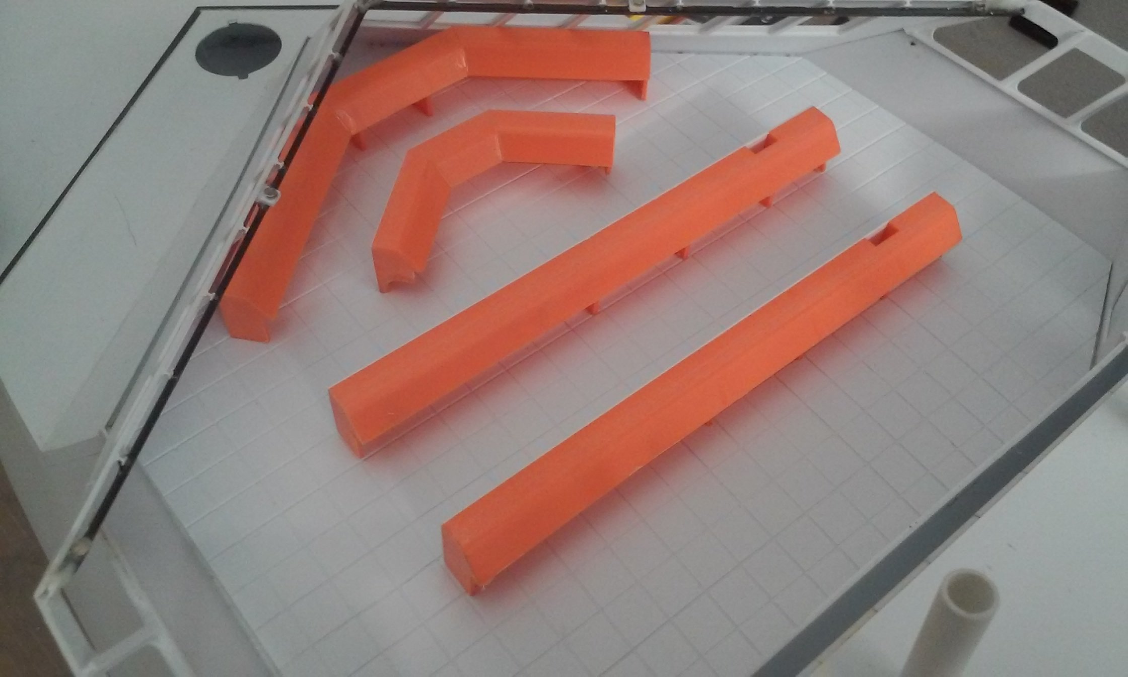

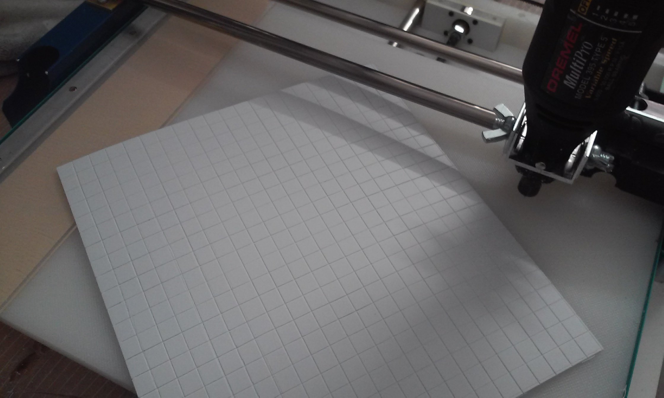

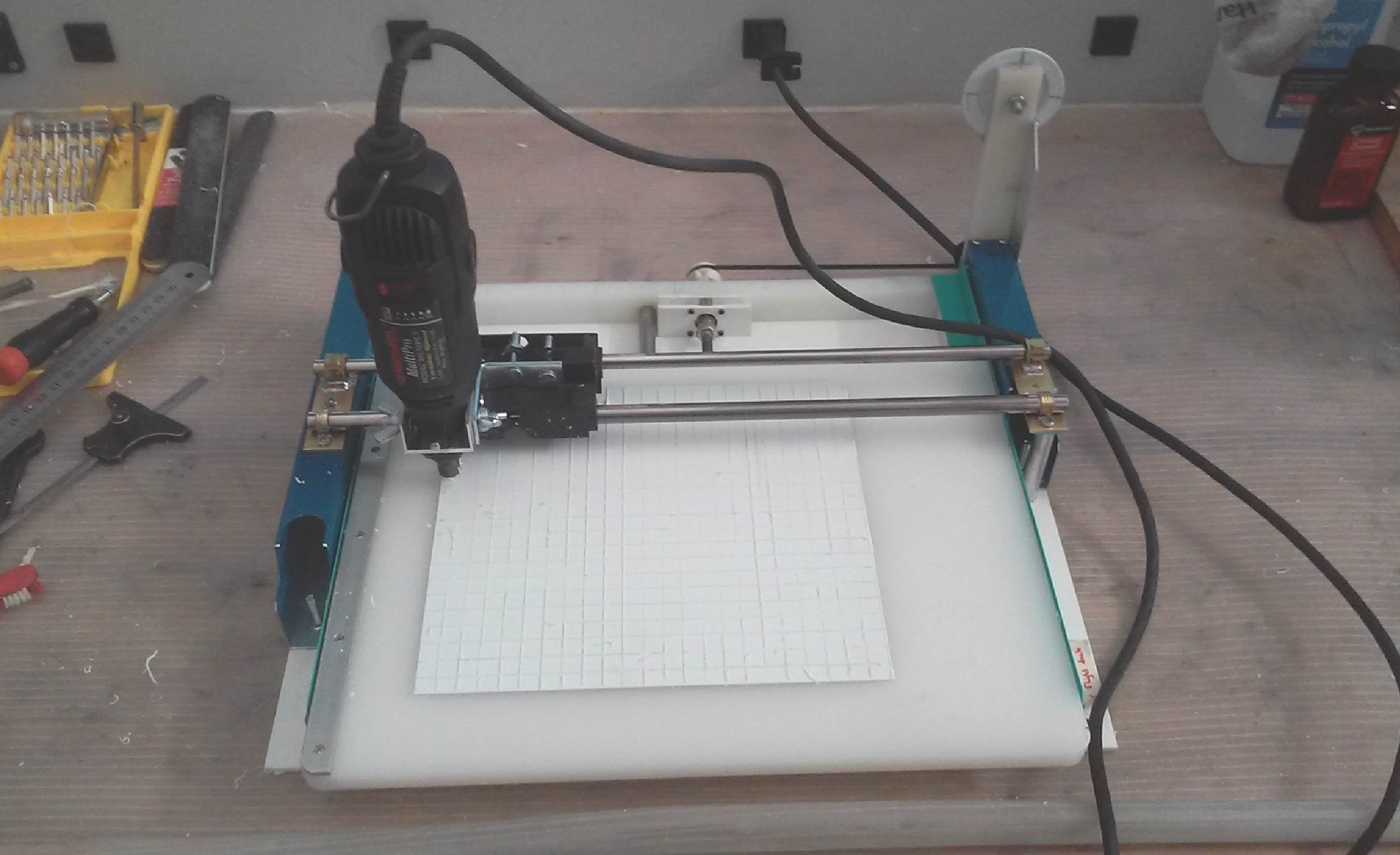

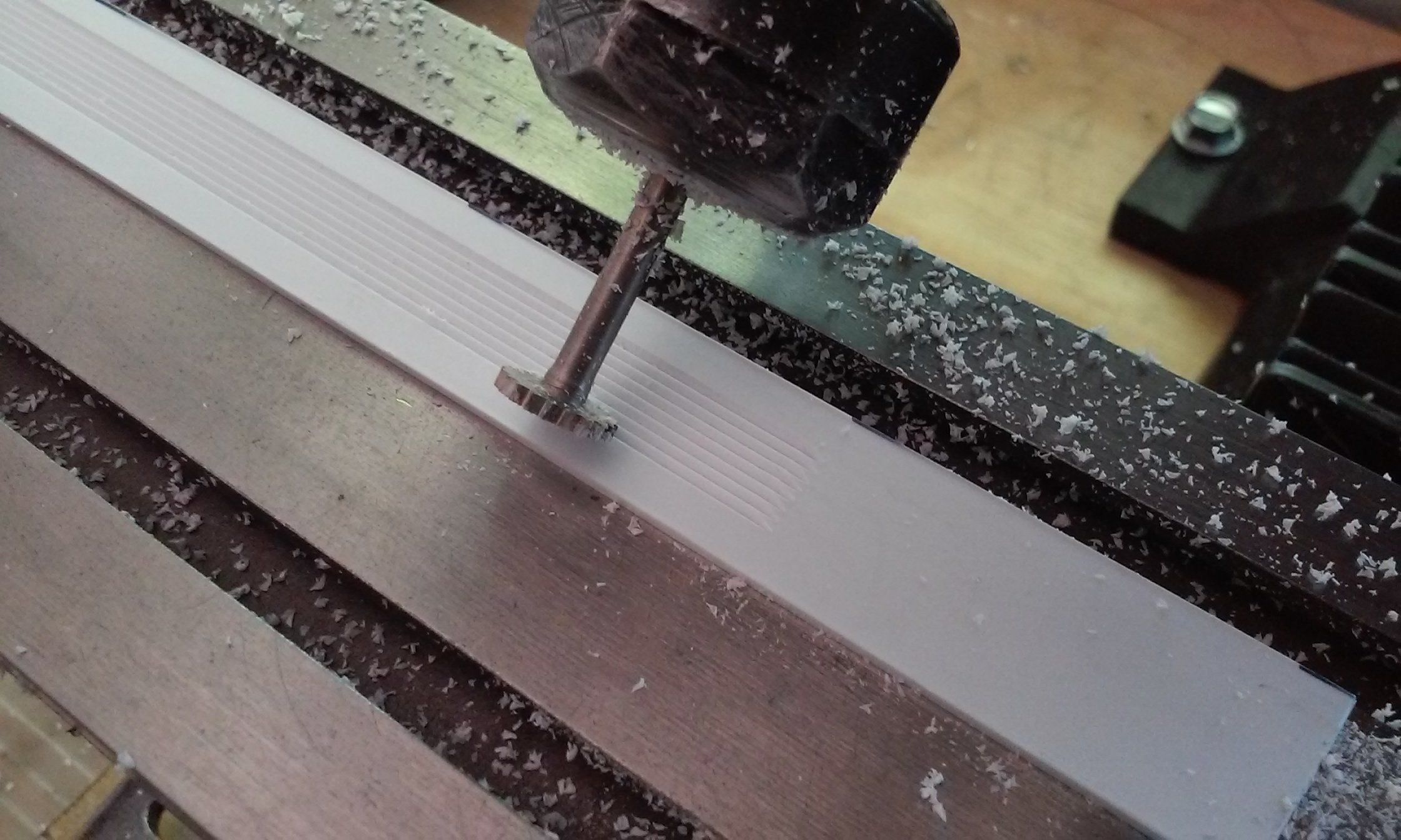

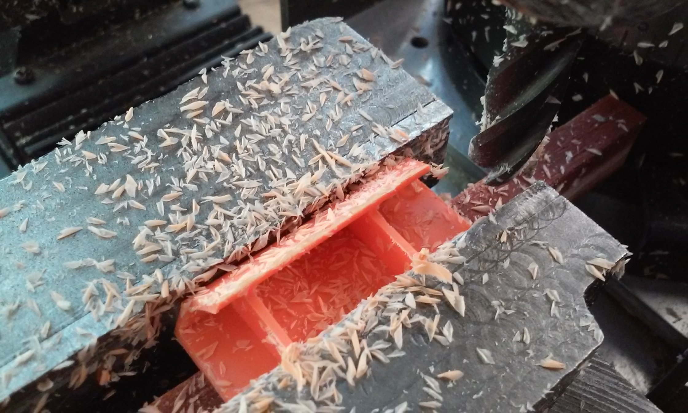

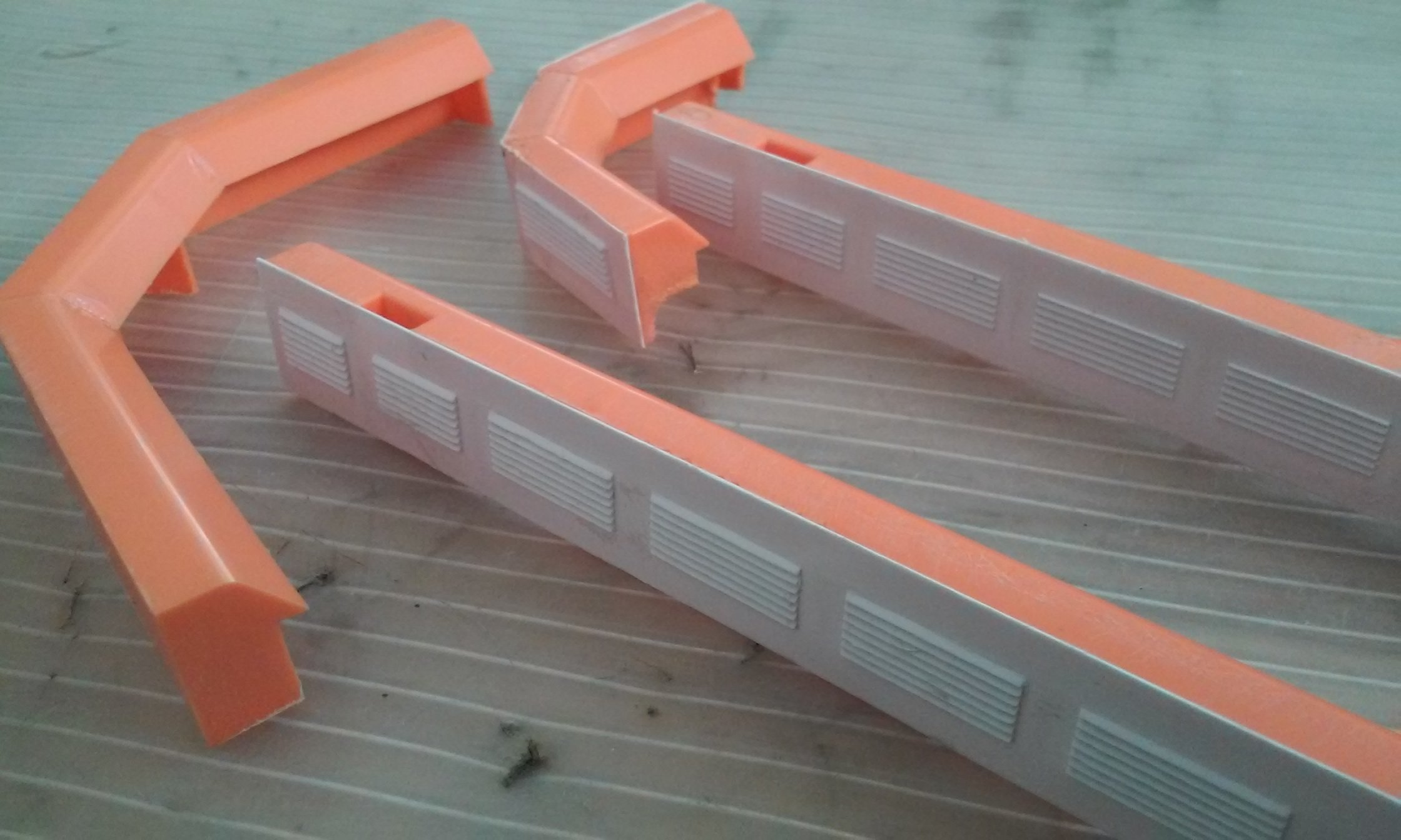

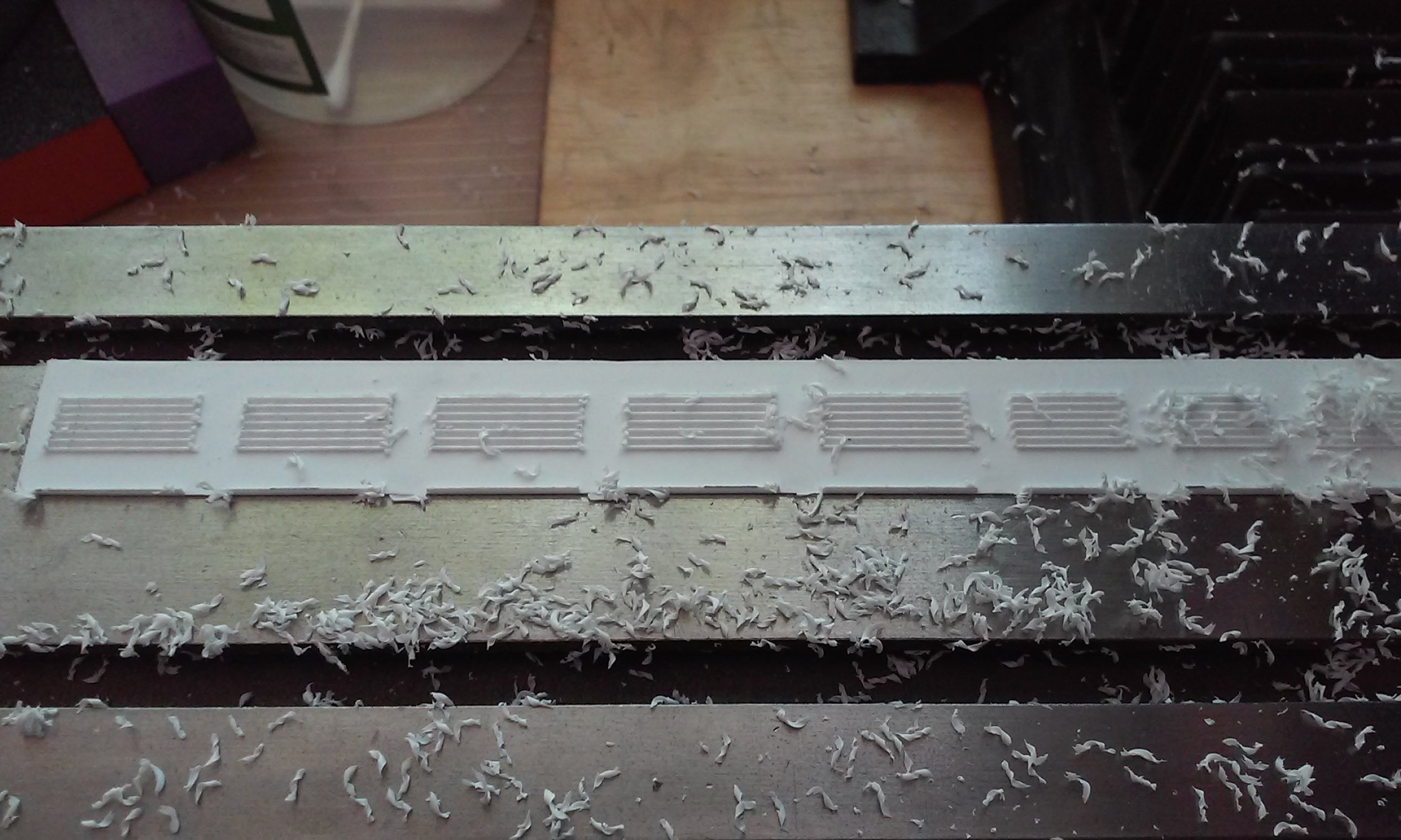

Details are what make models believable so instead of only plain rows of consoles, I wanted louvered vents like many consoles have. “Louvers” were cut into styrene and then the louvers were cut out like islands, so they stick out from the surface. If I had Evergreen cladding sheets, I could have just used them, but I don’t. Ordering from hobby shops stateside is about two weeks wait right now. The louvered sheets were then glued onto the sides and allowed to dry for a couple of days.

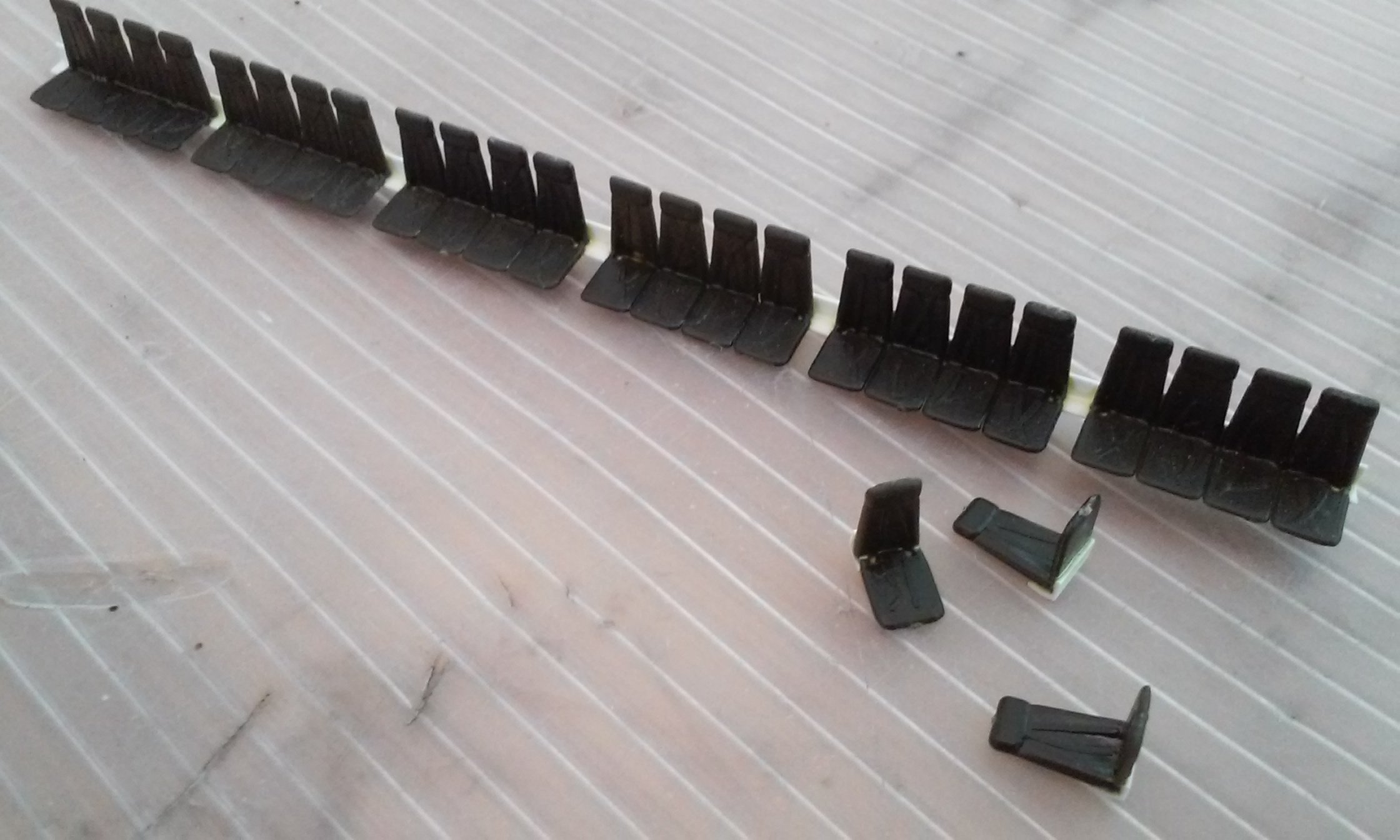

The ship needs about 24 seats for the bridge crew. Besides Shapeways, where are you going to find them? Thankfully I had some HH-60 parts in my spare sprues’ boxes. They were glued together with an angle piece to support them. These were then cut out when dry.
The bridge needed simulated two-foot floor tiles for "under floor cabling and cooling" like in computer centers. When I made the 1/200 Daedalus years ago, it needed nearly six feet of embossed deck area to simulate tie-downs. The hand-cranked machine I made was modified to accept a Dremel (which moves manually across the rails). The machine feeds according to how many cranks you make. This is easier than trying to grid-out the sheet and manually scribe/screw-up all the lines. One side was done, then flipped 90 degrees and the other side done. Clean-up STILL needed scribing which still created some mistakes – which thankfully were cut-out. Why not mill this? The sheet is too big for my little mill. Once again, Evergreen makes the right sheets, but I'm already waiting on other parts in the mail - so time to push through...
Then everything was dry fit together. The consoles still need desk areas and maybe cup holders. Anyone know a good deal on 1/72 keyboards? - MT

This machine needs it own thread on here I think. It looks awesome.
NICE!!!  Love that jig for the Dremel.  Where did you get that?  Was it expensive?  The louvers, were they also done on a jig with a dremel?

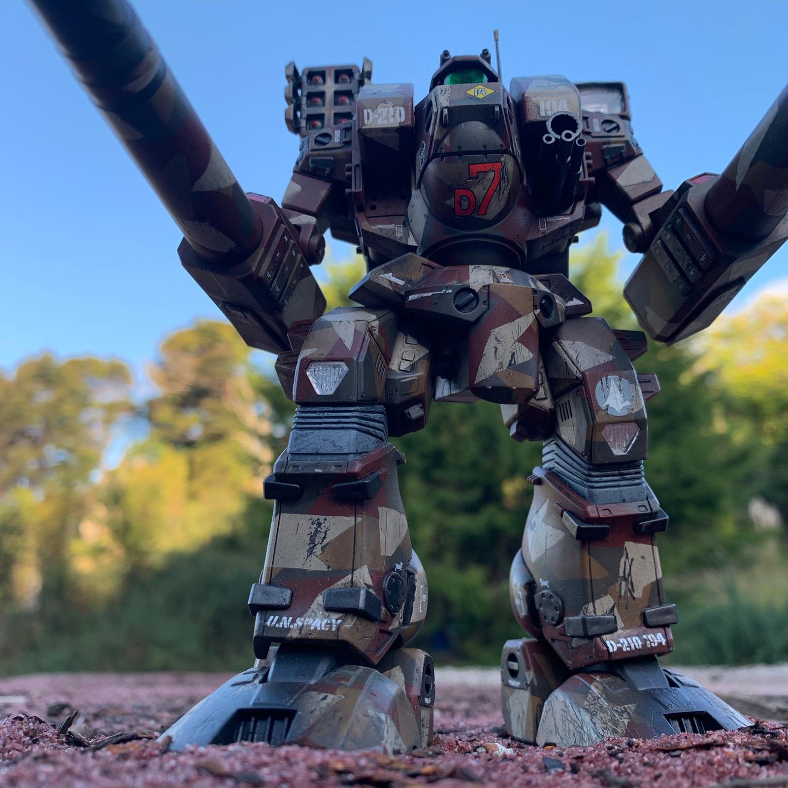

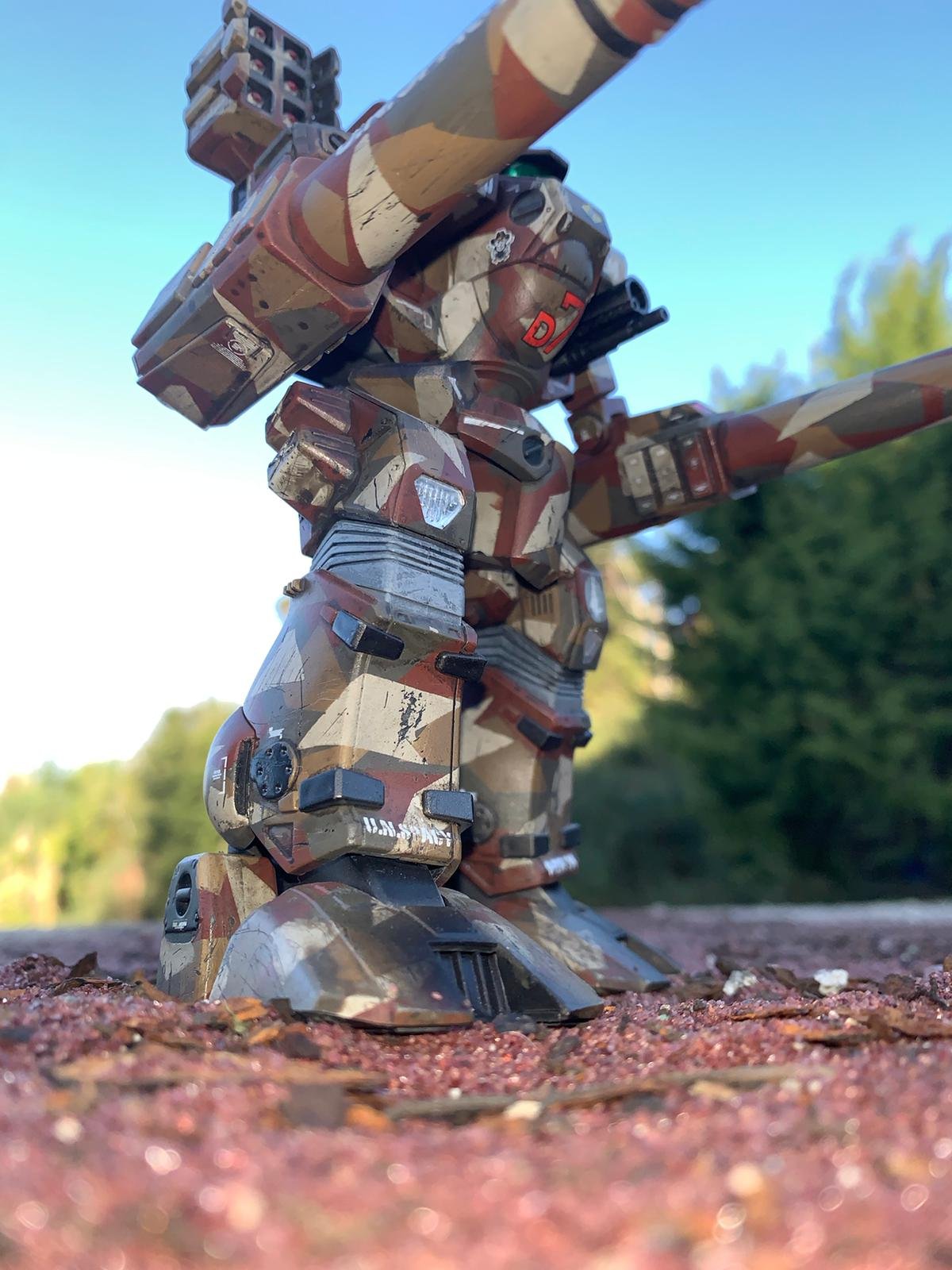

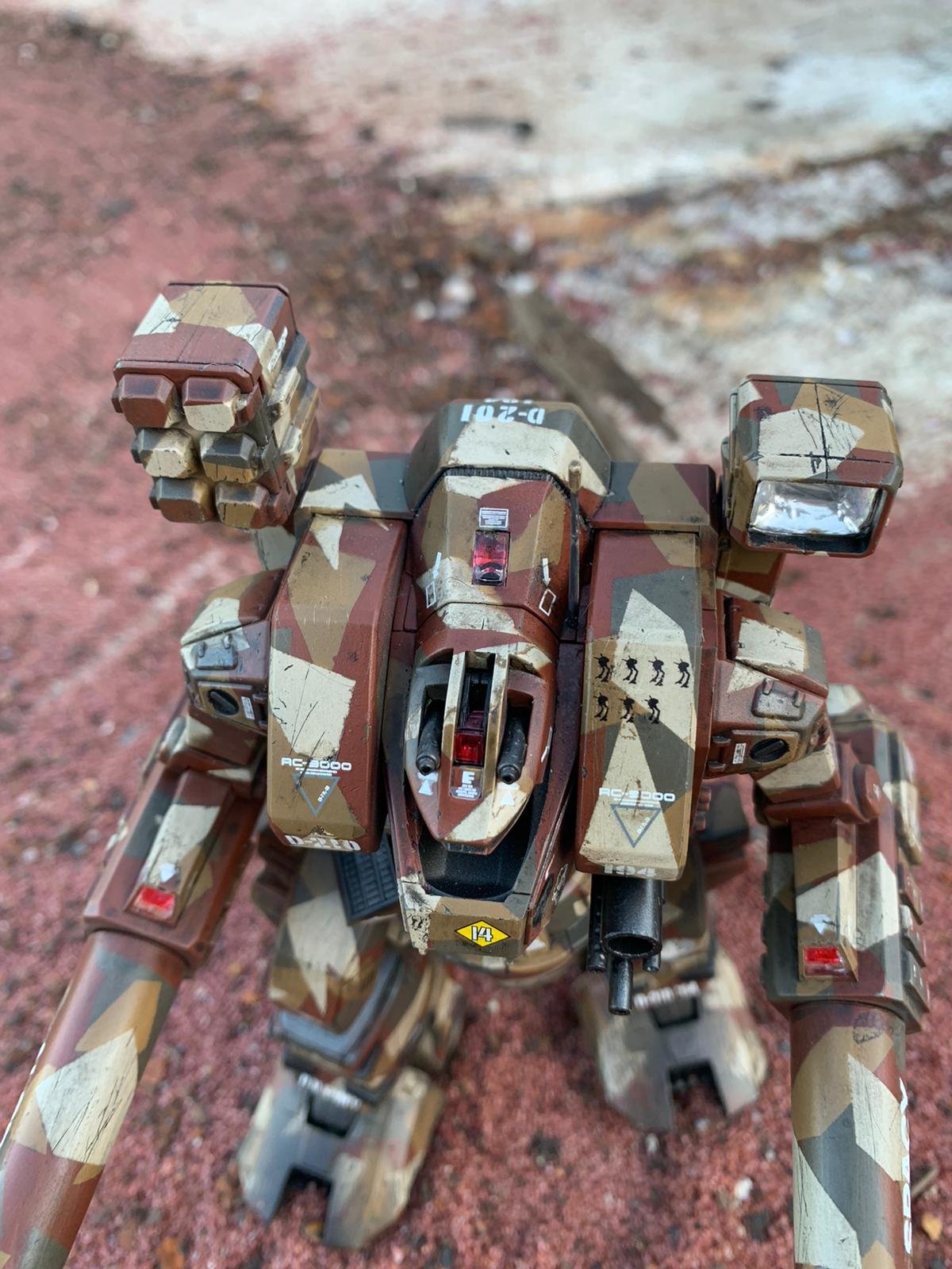

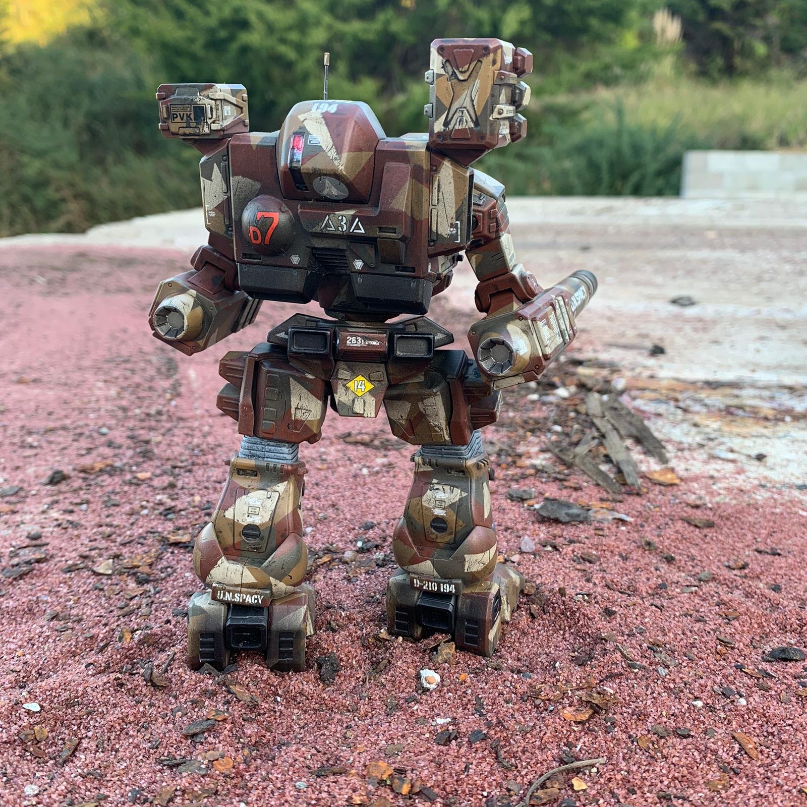

9 minutes ago, NZEOD said:
Almost done...

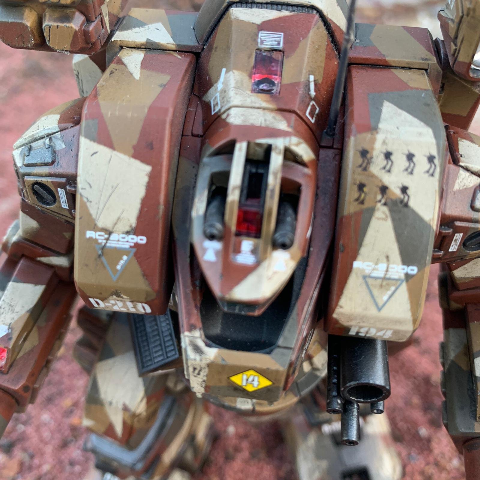

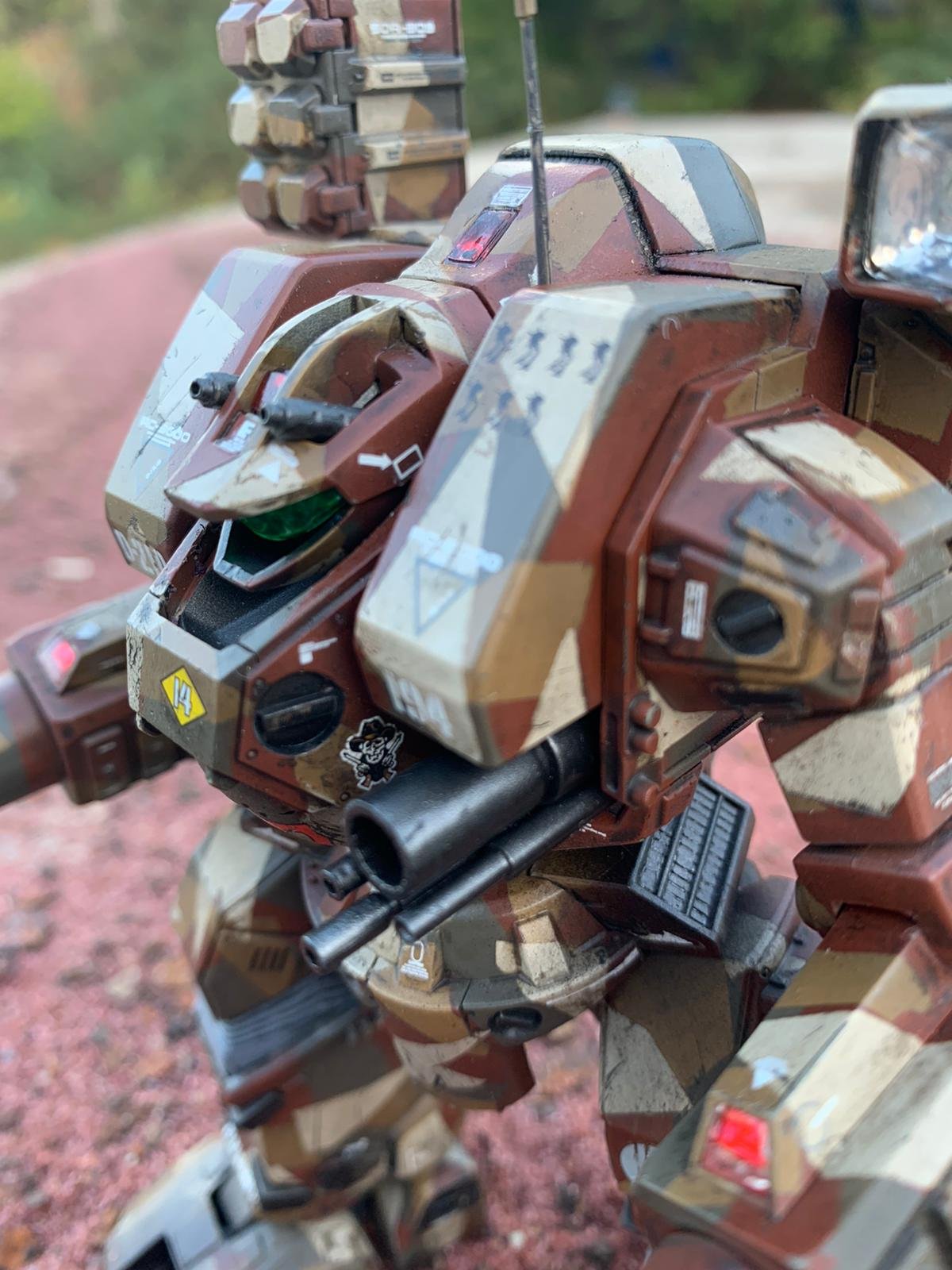

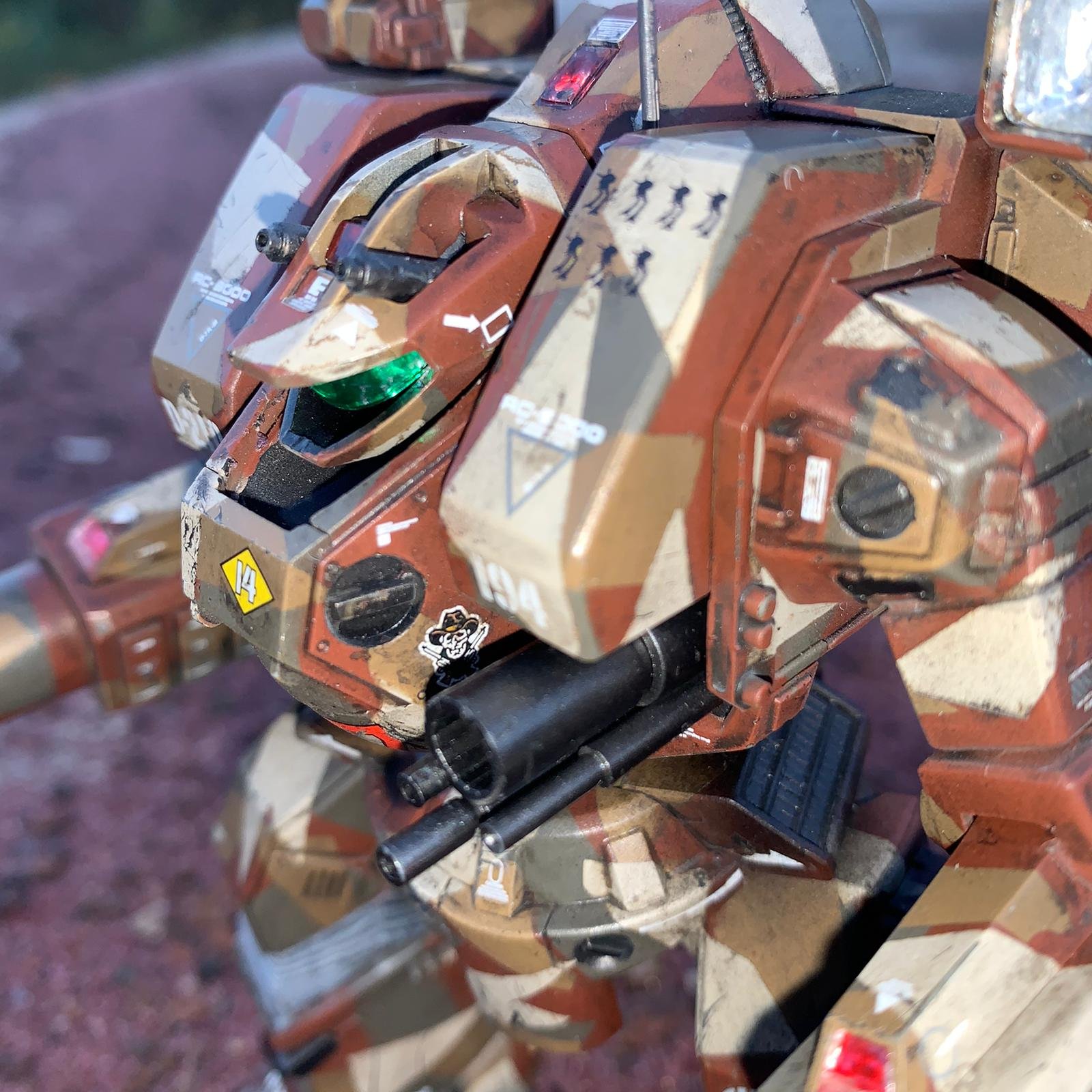

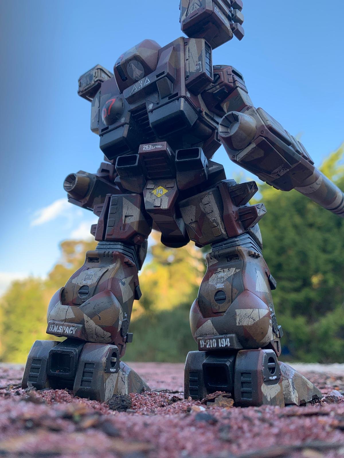

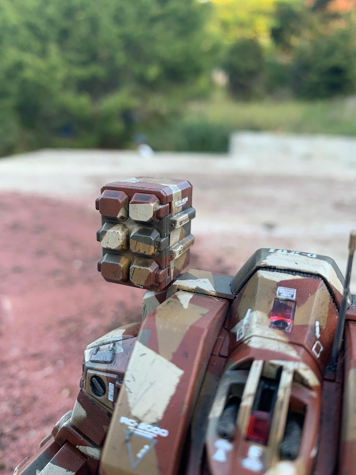

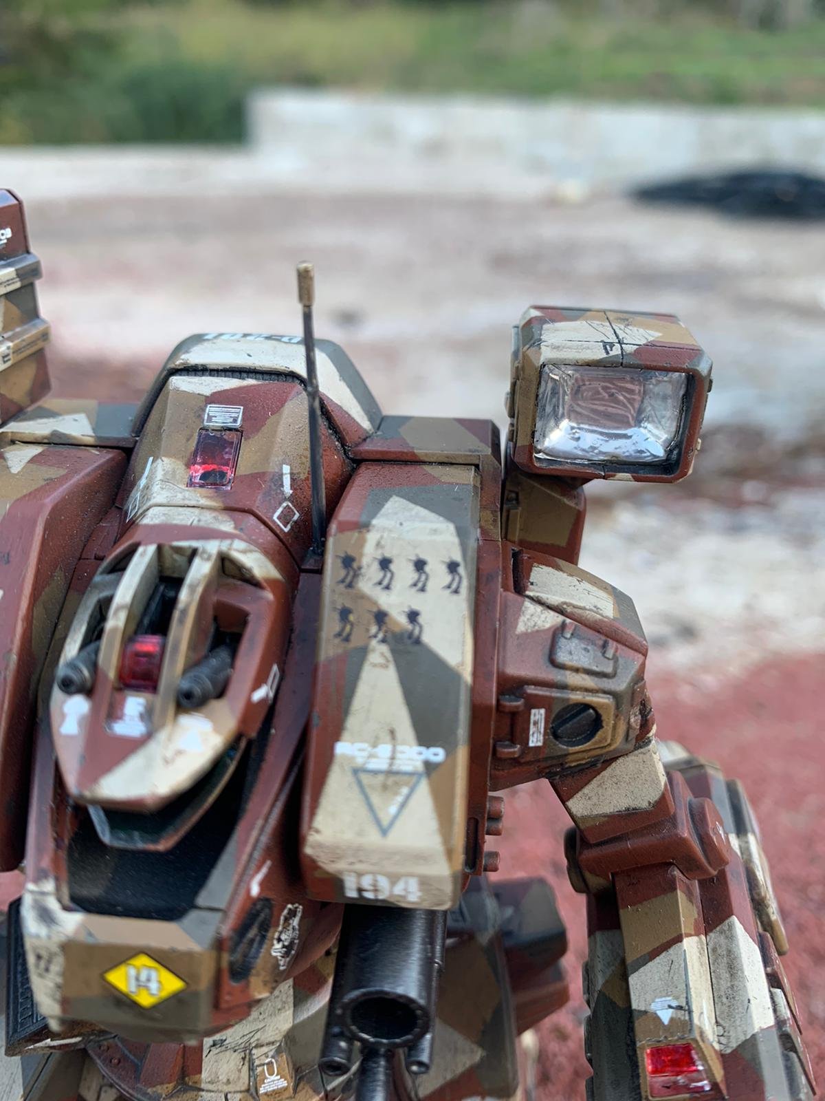

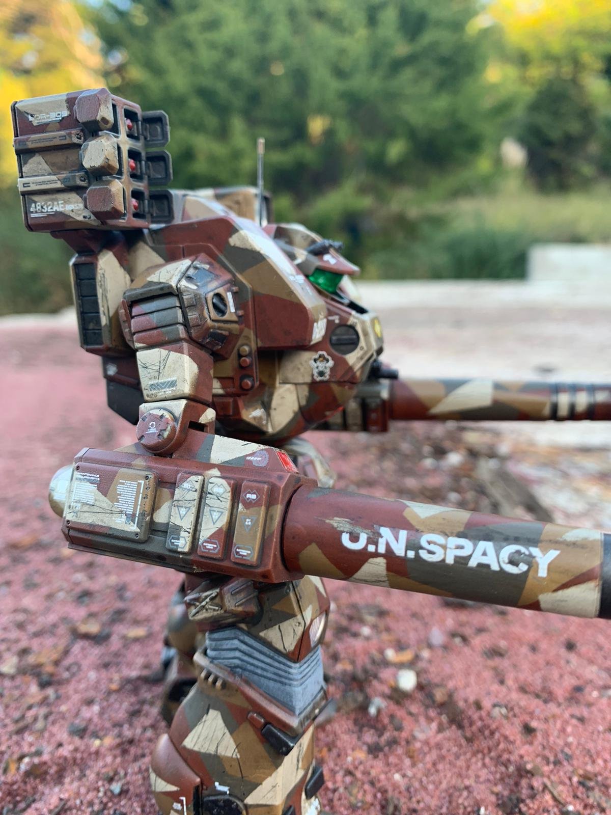

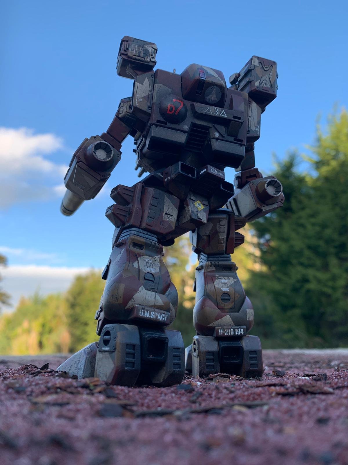

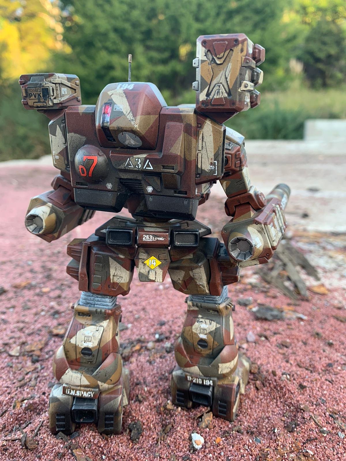

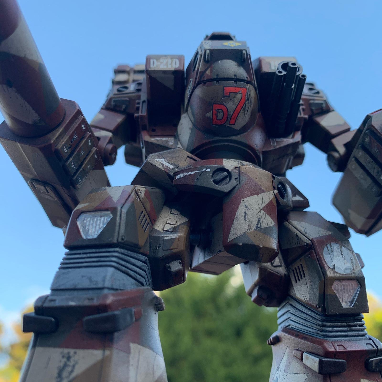

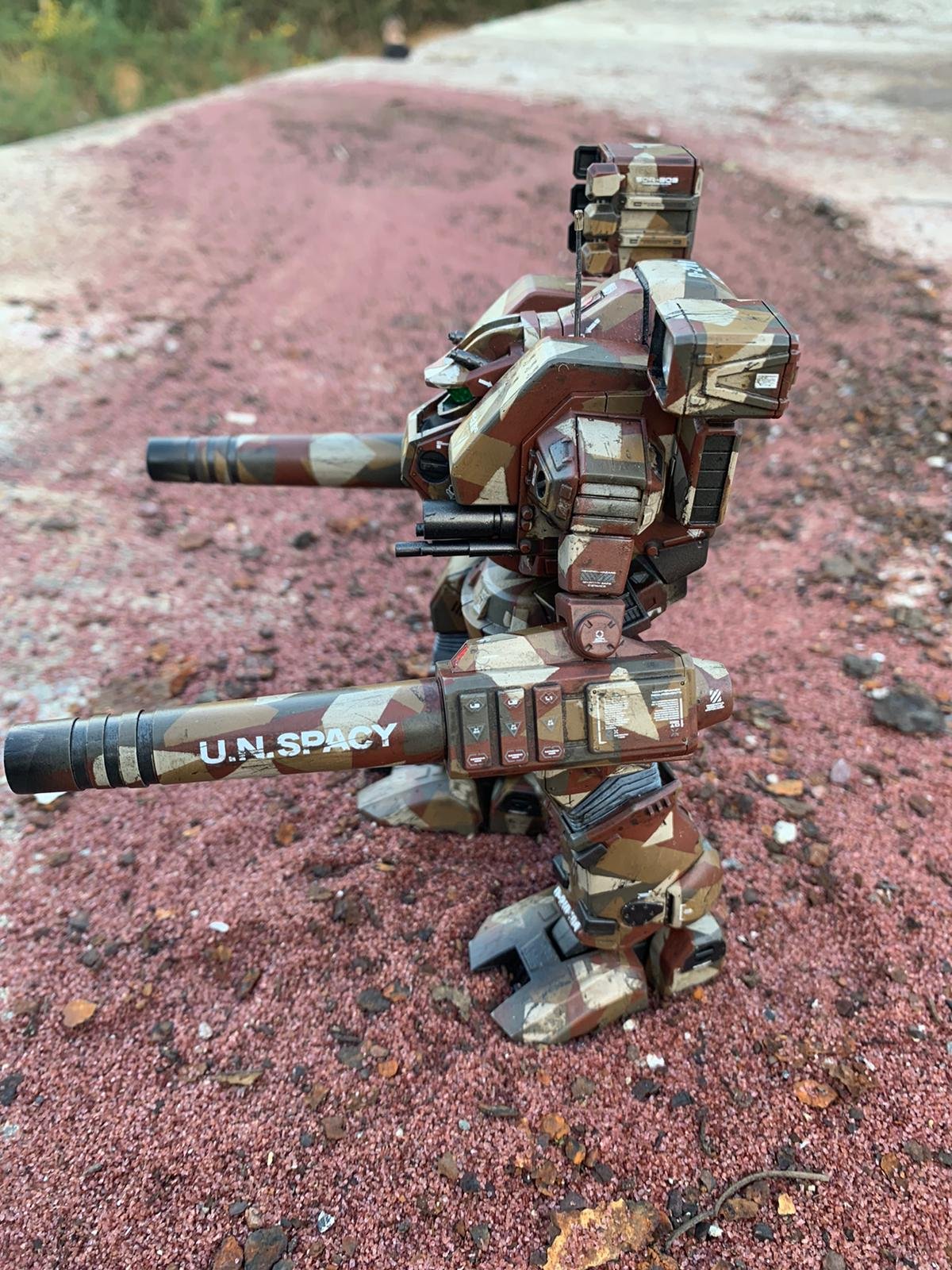

Nice weathering to beat up the old guy. The scratches and gunk are nicely in scale too. I don't have the patience for that level of detailing.
And some of those photos are very well done with the angles and lighting.
Do you plan a matt coat or semi-gloss at the end? Or is that how you want it?
Nice work. Keep em coming.

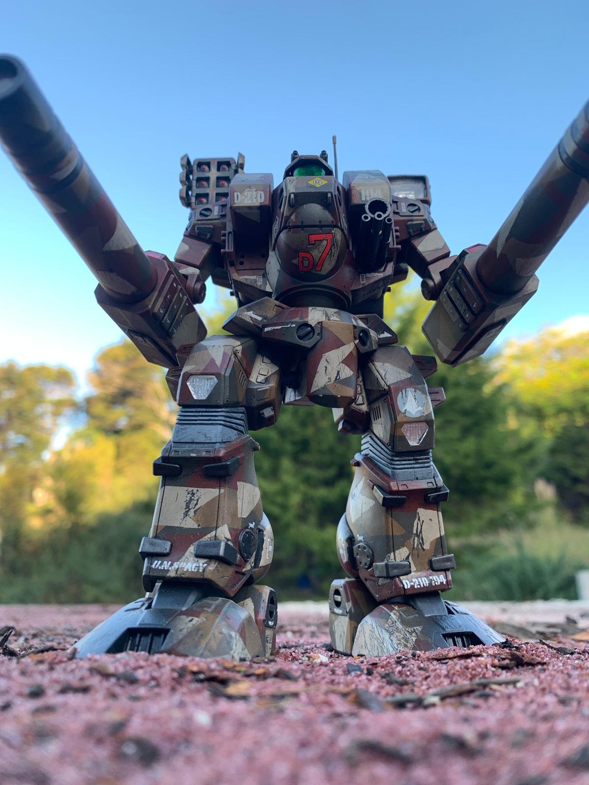

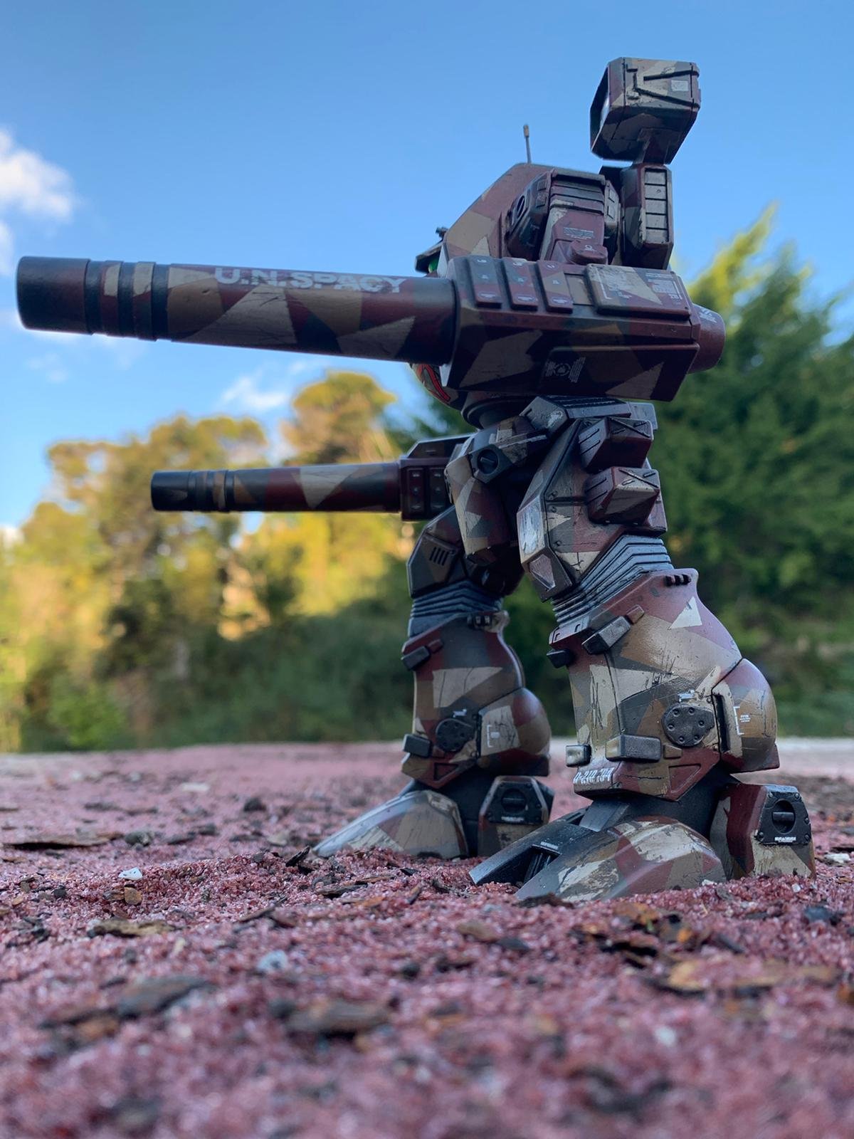

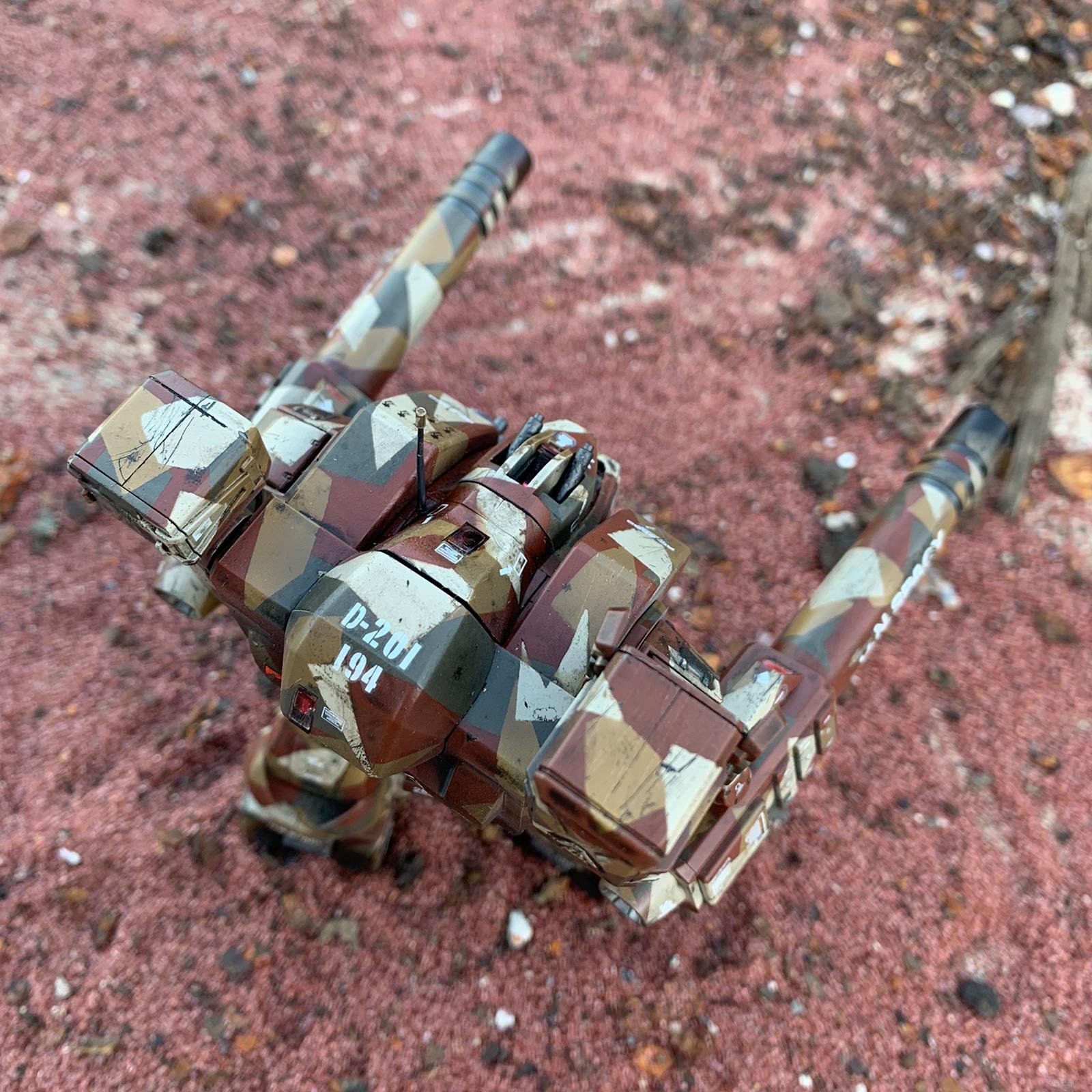

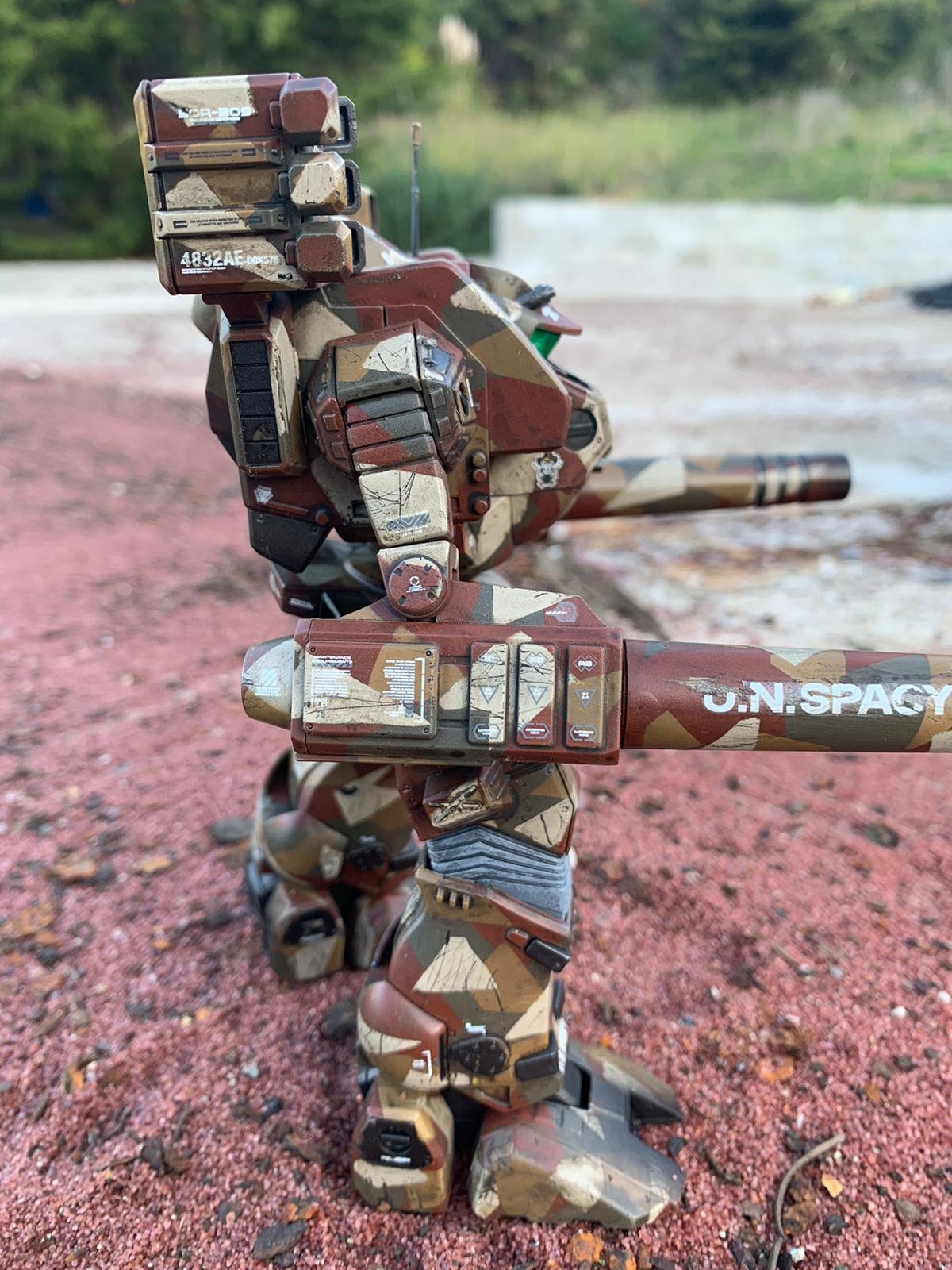

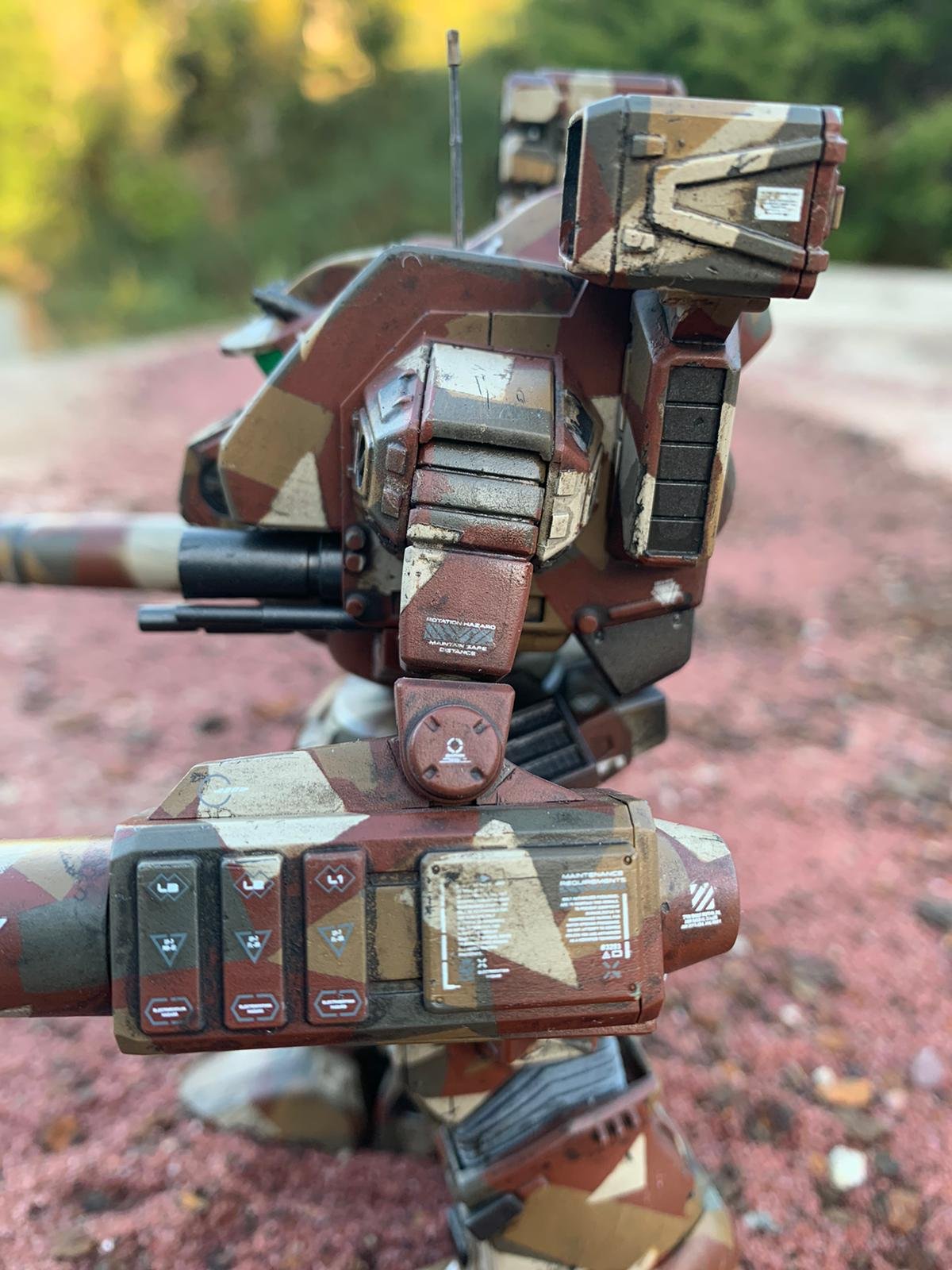

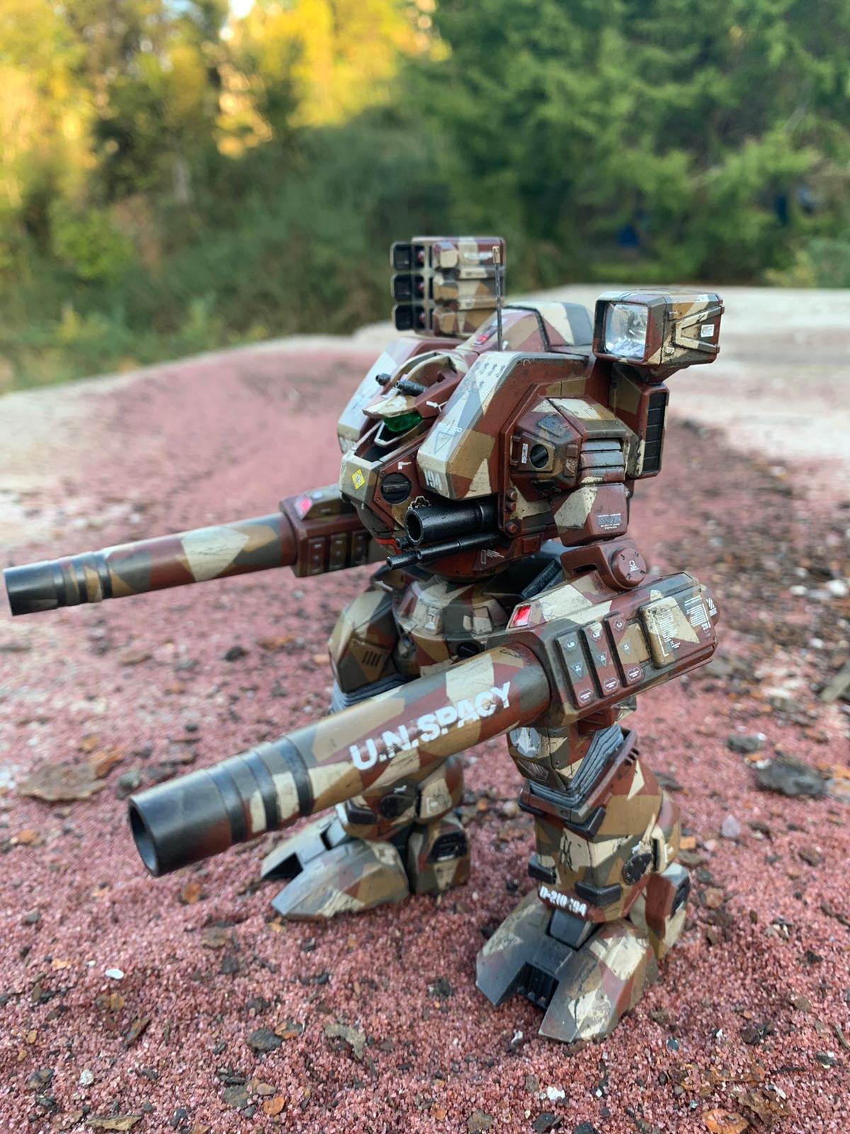

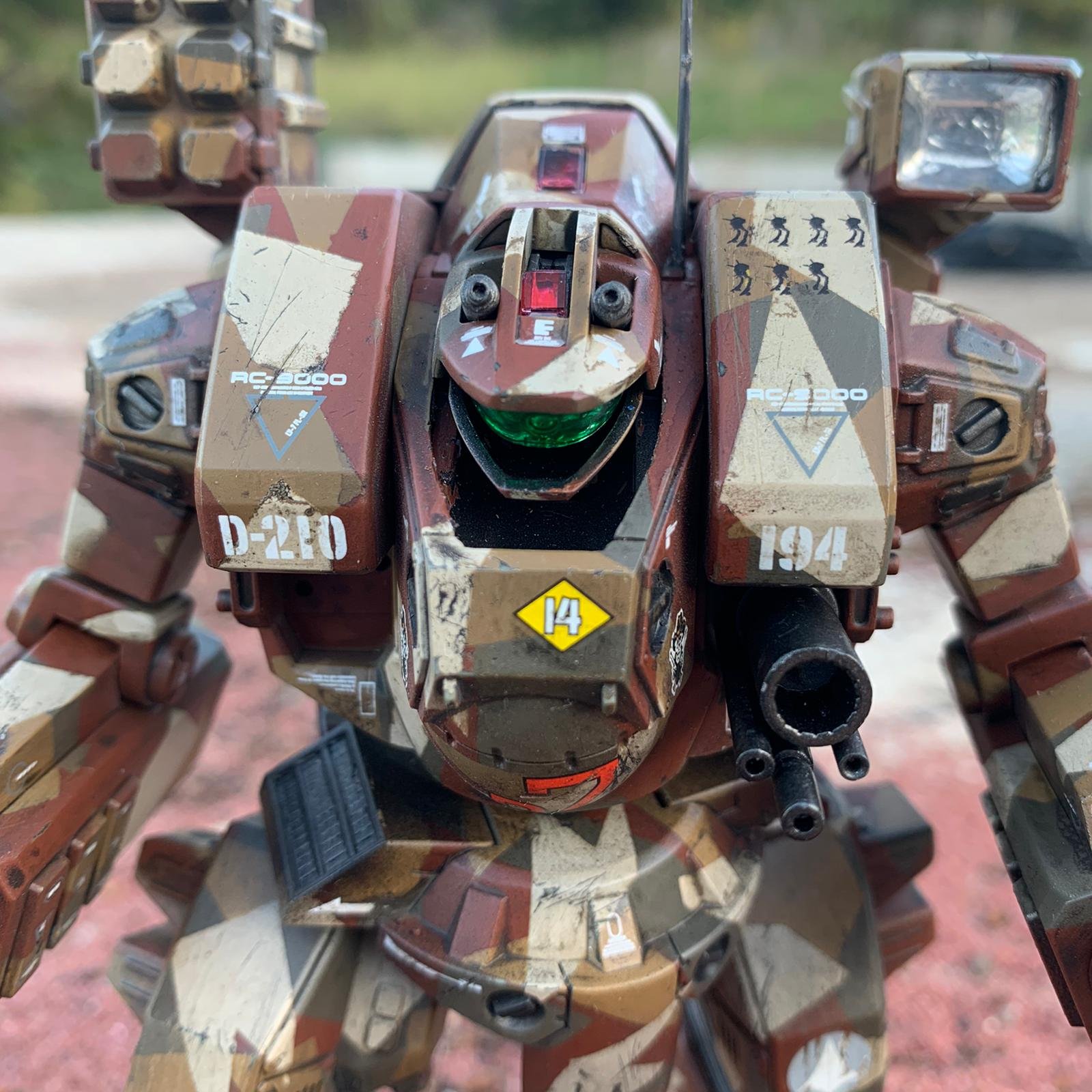

That IS a matt top coat... might need a second one I think.
The weathering is stupidly easy to do... you undercoat with a metal coloured Lacquer (bonds to the base plastic better for later), put down a coat of hairspray or chipping fluid like MIG fluid, spray your acrylic layers, get out a tub of water, some tooth picks, a dremel wire wheel and an electric toothbrush and wet the model and scratch it, scrap it and rub it with the wire wheel in your hand (not in the tool!) and the tooth brush.
Then flory wash it, wipe it with your finger and clear it.
Decal it.
Scratch up the decals to match underneath.
Clear it.
Flory it again.
Wipe as needed.
Matt Clear it.
Decals are a mix of Wave Destroid, 1/100 Gundam Builder warning label packs, 1/144 Gunslinger F/A-18 and VF-1 packs
Edited by NZEOD
