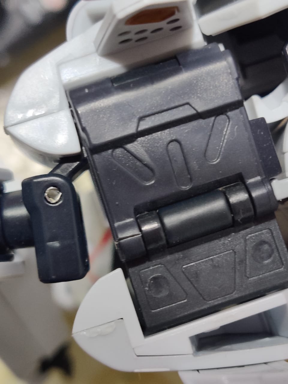

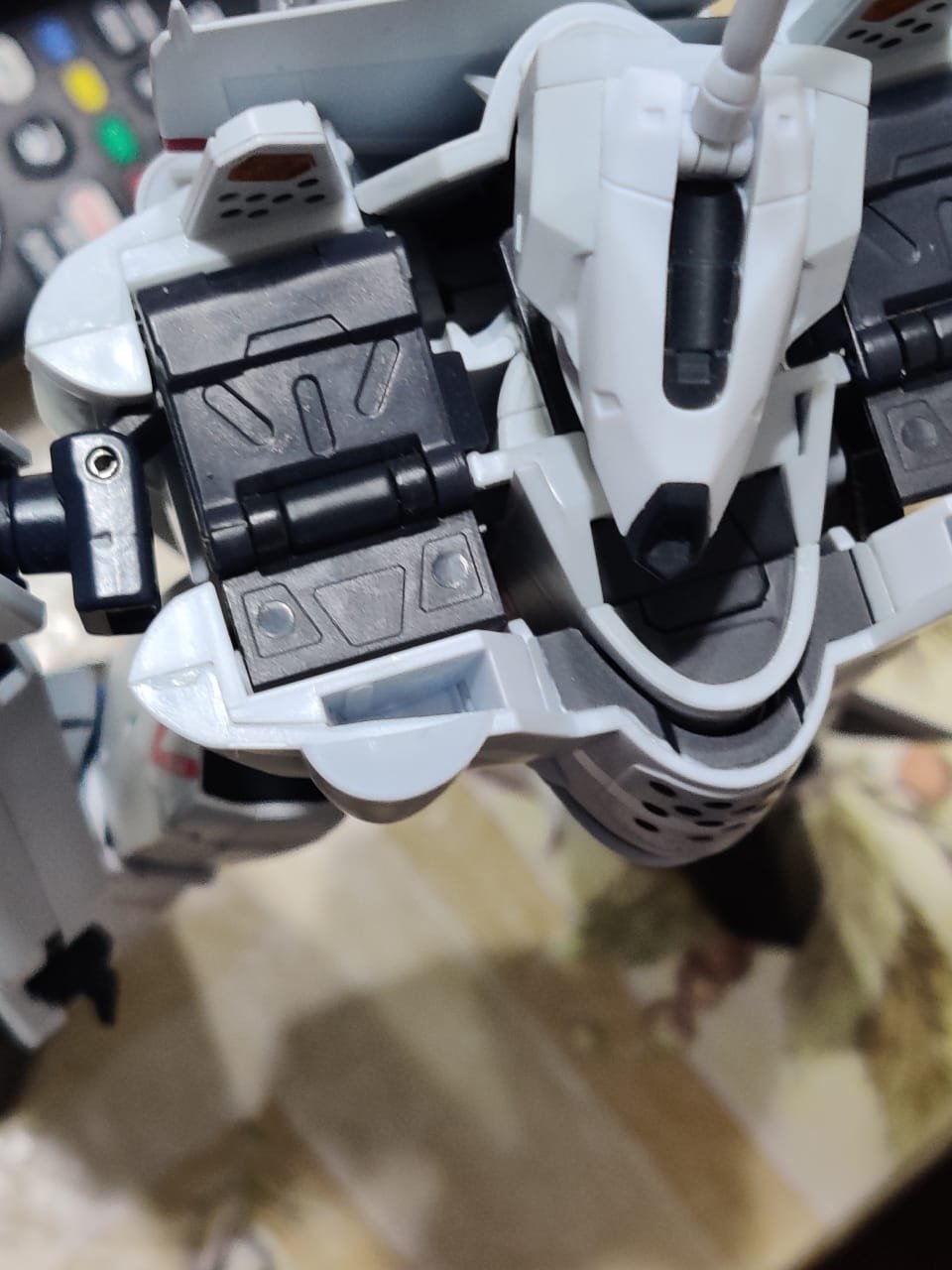

Priss! Posted July 25, 2020 Posted July 25, 2020 Just took out my Arcadia VF-0A copy and transformed it for the first time to Batroid and found this. Damn!
MacrossJunkie Posted July 25, 2020 Posted July 25, 2020 35 minutes ago, Priss! said: Just took out my Arcadia VF-0A copy and transformed it for the first time to Batroid and found this. Damn! Dang, is that a stress mark at the base of the hinge too? I'd suggest at least popping the pin out and then trying something like plastic weld to fuse the crack back together before it gets worse.
505thAirborne Posted July 25, 2020 Posted July 25, 2020 Man that sucks, if it's a clean even break hopefully you can do what @MacrossJunkie suggested.
jenius Posted July 25, 2020 Posted July 25, 2020 1 hour ago, Priss! said: Just took out my Arcadia VF-0A copy and transformed it for the first time to Batroid and found this. Damn! While not something you want to see, I wouldn't do anything about it and I wouldn't expect it to impair your toy at all. That's a SUPER common break anywhere a pin goes through plastic. If you have a Yamato VF-11, you'll probably find a bunch of those same cracks. Since it's a part that just folds, it probably won't get worse.

easnoddy Posted July 26, 2020 Posted July 26, 2020 Those sorts of joints should always be steel IMO. So long as they don't need to hold a position due to tension. Its a simple hinge.
Sanity is Optional Posted July 26, 2020 Posted July 26, 2020 (edited) 10 minutes ago, easnoddy said: Those sorts of joints should always be steel IMO. So long as they don't need to hold a position due to tension. Its a simple hinge. That doesn't really work if they need to be a specific color. If you use a steel part you get your choice of steel color, or horrible flaking paint issues. I'd prefer a plastic part molded in the proper color any day if it's not load bearing. [edit] Also it's not rocket science to get a properly fitted pin joint, really it's not. Even the Yamato issue stemmed from using the wrong type of pin (knurled pin, without changing the diameter to accommodate the knurling). Edited July 26, 2020 by Sanity is Optional
sqidd Posted July 26, 2020 Posted July 26, 2020 8 minutes ago, Sanity is Optional said: That doesn't really work if they need to be a specific color. If you use a steel part you get your choice of steel color, or horrible flaking paint issues. I'd prefer a plastic part molded in the proper color any day if it's not load bearing. [edit] Also it's not rocket science to get a properly fitted pin joint, really it's not. Even the Yamato issue stemmed from using the wrong type of pin (knurled pin, without changing the diameter to accommodate the knurling). Devils advocate. How about anodized aluminum?
Sanity is Optional Posted July 26, 2020 Posted July 26, 2020 18 minutes ago, sqidd said: Devils advocate. How about anodized aluminum? Probably be quite expensive to get cast compared to the usual iron. Also aluminum is generally a bad idea for any part that can fatigue, since it will always develop stress fractures eventually. It doesn't have an endurance limit like iron/steel where stresses below a given boundary have infinite cycle life. That said, anodized aluminum would definitely look the best, right up until it got scratched through the anodization layer.
sqidd Posted July 26, 2020 Posted July 26, 2020 6 minutes ago, Sanity is Optional said: Probably be quite expensive to get cast compared to the usual iron. Also aluminum is generally a bad idea for any part that can fatigue, since it will always develop stress fractures eventually. It doesn't have an endurance limit like iron/steel where stresses below a given boundary have infinite cycle life. That said, anodized aluminum would definitely look the best, right up until it got scratched through the anodization layer. For sure the cost would be astronomical compared to a plastic. You wouldn't be able to have tight joints like you can with plastic. You could hard anodize though. If done correctly it's extremely durable. I suspect most of the plastic issues we see with toys is down to very little actual materials engineering and then quality control. There is no reason why plastic can't do the job and do it well.
Sanity is Optional Posted July 26, 2020 Posted July 26, 2020 (edited) I think most of it comes down to: Improperly accounting for part shrinkage Bad material QC (inconsistent plastic, which can also compound other issues. This also includes inconsistent pin sizes) Lack of post-processing on molds. Bandai will polish their gunpla molds until the part fit is perfect. Most companies will not. Poor design. Sometimes things are just designed badly, gates are placed poorly, parts don't account for stress concentrations. Design is more of an art than a science, really, since it takes some creative thinking to come up with ideal solutions for complex designs. [edit] As far as Hard Anodize: unless you're calling out an anodization layer thickness, don't expect scratch-proof. Just found a big scratch through the hard black on a $1000 part I finished putting together Friday. Time to get the sharpie out again... Edited July 26, 2020 by Sanity is Optional
sqidd Posted July 26, 2020 Posted July 26, 2020 49 minutes ago, Sanity is Optional said: I think most of it comes down to: Improperly accounting for part shrinkage Bad material QC (inconsistent plastic, which can also compound other issues. This also includes inconsistent pin sizes) Lack of post-processing on molds. Bandai will polish their gunpla molds until the part fit is perfect. Most companies will not. Poor design. Sometimes things are just designed badly, gates are placed poorly, parts don't account for stress concentrations. Design is more of an art than a science, really, since it takes some creative thinking to come up with ideal solutions for complex designs. [edit] As far as Hard Anodize: unless you're calling out an anodization layer thickness, don't expect scratch-proof. Just found a big scratch through the hard black on a $1000 part I finished putting together Friday. Time to get the sharpie out again... I've been known to fix anodizing with a Sharpie! I agree with your bullet point list above. Especially the art part of it. I wouldn't know where to start designing some of this stuff. I don't have 20yrs of experience to fall back on. If I were making something to compete with let's say the DX I would buy some, take them apart, figure out what I want to do better, go find people that I can lean on for advice and then doe a lot of FEA work before I felt comfortable putting out a product with my reputation behind it. So, I won't be designing any toys!

MacrossJunkie Posted July 31, 2020 Posted July 31, 2020 (edited) On 7/24/2020 at 10:46 PM, Priss! said: Just took out my Arcadia VF-0A copy and transformed it for the first time to Batroid and found this. Damn! I just looked at my 0A and it has a split in that same area except the one on mine is even larger. I can see the metal pin through the crack. On another subject, I really hate that they painted the black stripe clear across the starboard wing and then Arcadia made a sticker with a white background with the 301, but the white doesn't match and looks like crap. Ended up just masking off a section of the stripe and sanding it away. Trimmed the clear backed 301 on the sheet right along the edge of each number, but still felt unsatisfied due to how thick the stickers are. I was going to use some of the decals from the Hasegawa kit, but while some look just fine despite being 1/72 scale, others are way too small. Looked around on the internet to see if anyone made upscaled versions of the Hasegawa decals and found on ebay there are 1/60 waterslides for the 0A and S based on the Arcadia sticker sheets. Happy day! Bought one of each, though they're pretty expensive for decals. My plans for the 0A and S are now on hold since these decals are shipping from China and will take a good while to arrive. Better late than never though. Edited July 31, 2020 by MacrossJunkie
