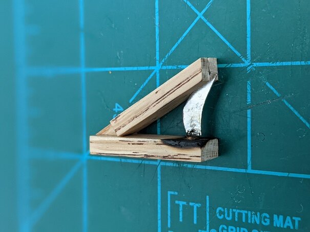

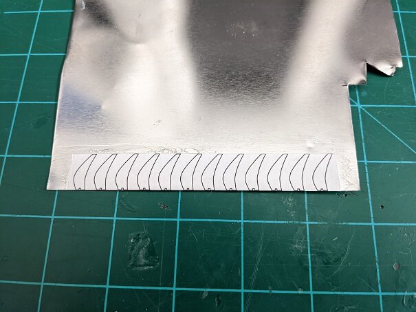

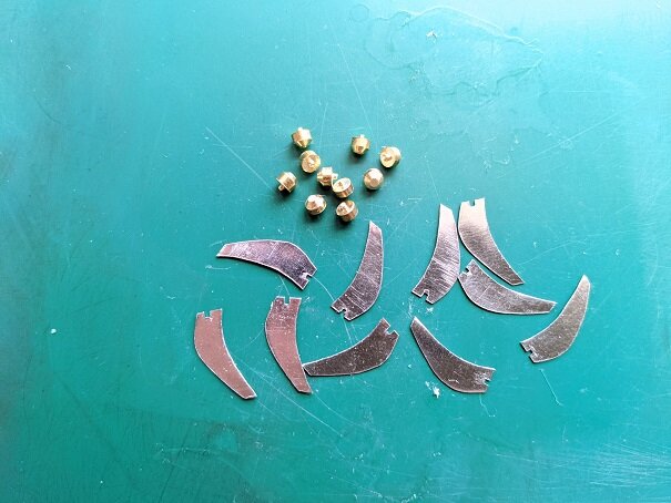

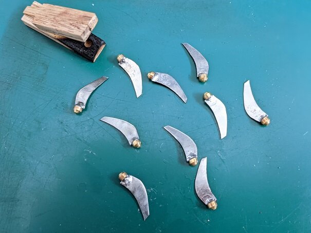

MechTech Posted January 16, 2022 Posted January 16, 2022 (edited) @electric indigo That cockpit is looking great, especially the detail on the pilot! You'll see that I WISH I could use regular blades. The kit comes with ALL of the modern blade versions too! @Bolt Looks like someone is getting all those old kits built up! The Pod looks great! I believe you captured the design from the graphics spot on! Its almost like an evil clown paint scheme. @arbit Thank you, I'll have to check that out! We've been watching "Mythbusters" on TV lately too! Your figure looks great! You also pose a great legal question too. So, the coconut can failed! I couldn't roll it out flat enough and it had mini valleys. So it did get tossed in the end! The next idea that I was trying to avoid was soldering the blades to brass pieces. They'll have less strength, but still WAY better than styrene. So I drew the blades, printed them and contact cemented them to a sheet of K&S tinned steel (the tin allows the solder to adhere better). The lathed brass pieces and the hand cut and filed blades. Gettin' jiggy with it! I made a hardwood jig to hold the pieces while they were soldered. Sometimes you have to make parts that won't go on your model at all. The soldered blades. And a "slightly" burnt jig. The blades after they were carefully milled at the solder joint for uniformity. Then put on double sided tape on my mat and sanded with medium and fine sanding blocks. The sanding put nice edges on the blades. I then blued all the blades with gun bluing compound. The coating wasn't even and looked awkward. So I merely coated them all with a Sharpie marker! They were also given a slight twist like real blades have. They just need to be buffed and another coat of matte finish sprayed on. I'm still working on it, but a new piece for the air intake to go under the nose. And the blades together. Here they are only inserted part way, not all the way in. They will sit in flush with the face of the spinner. For some reason the GIF makes them look like they're spinning in the wrong direction🙃, but they do work properly. That's it for now. Thanks for checking in guys! - MT Edited January 16, 2022 by MechTech

Bolt Posted January 16, 2022 Posted January 16, 2022 @MechTech as always, your work is awesome ! I like how you also used a simple solution, like a sharpie. Lol.
electric indigo Posted January 16, 2022 Posted January 16, 2022 @MechTech That's a mean looking set of blades there!
pengbuzz Posted January 16, 2022 Posted January 16, 2022 7 hours ago, MechTech said: And the blades together. Here they are only inserted part way, not all the way in. They will sit in flush with the face of the spinner. For some reason the GIF makes them look like they're spinning in the wrong direction🙃, but they do work properly. That's it for now. Thanks for checking in guys! - MT Nice job! For some reason now, I want a smoothie! lol

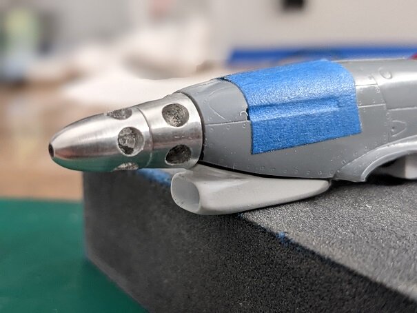

MechTech Posted January 20, 2022 Posted January 20, 2022 @pengbuzz Cats eat bats! Yeah, back to the cat! Quick update for the week. Got the props coated with a final coat of flat. I thought the first intake (not completed) was too big and not very "sexy" looking. So I did a second one and machined it on the rotary table to get a nice curve to it. The LOTS of shaping by hand to get the rest of it into shape, Also in the ROUGH stages, the exhausts and associated cowling. The tubes are actual stainless steel, so I'm hoping some heat treating will give them the correct "burnt color. I put the gearmotor on a 1.5v battery and got it to turn s-l-o-w-l-y. Now the GIF doesn't look so bad, but its too slow. Can't win them all! That's it for now. Thanks for checking in guys! - MT
