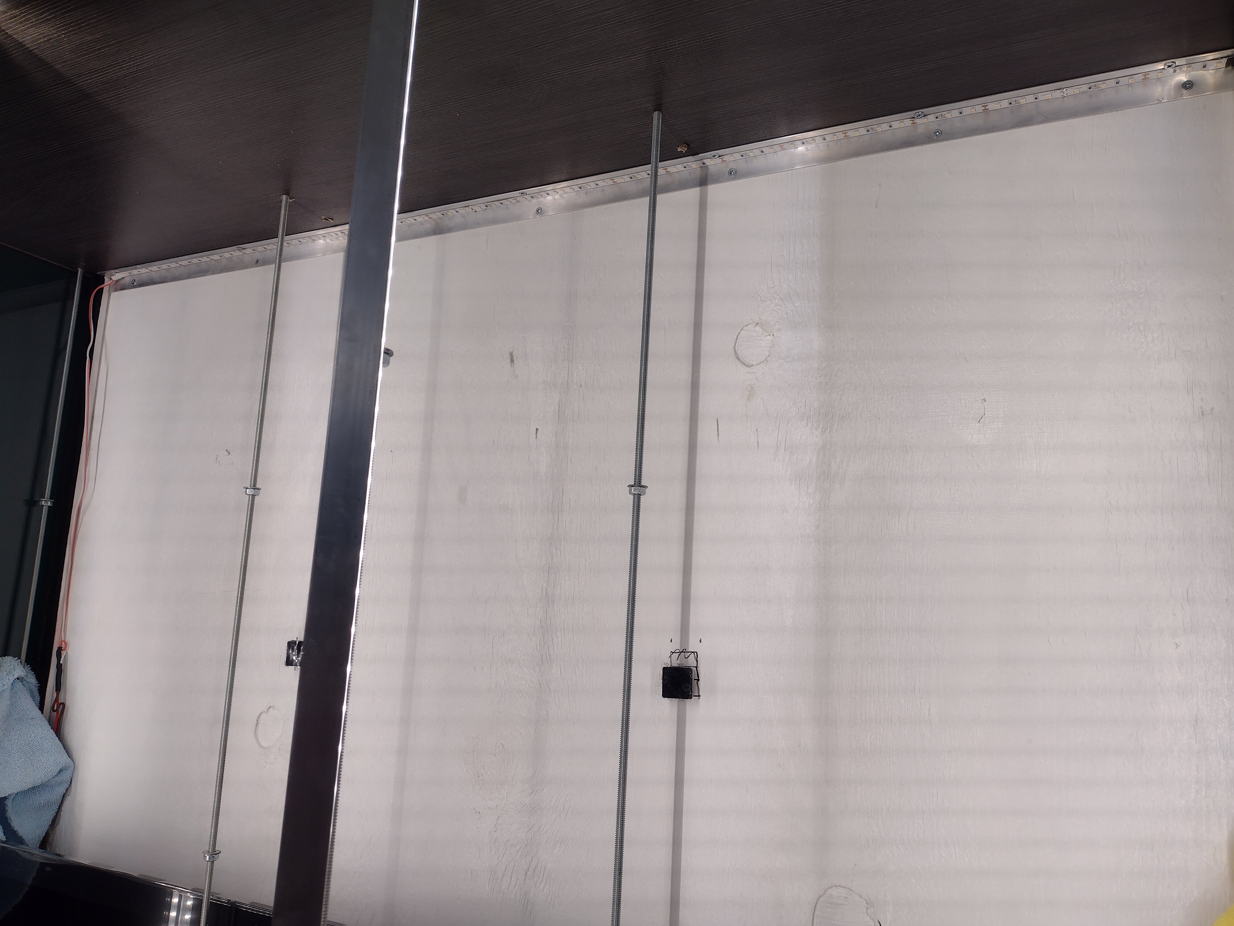

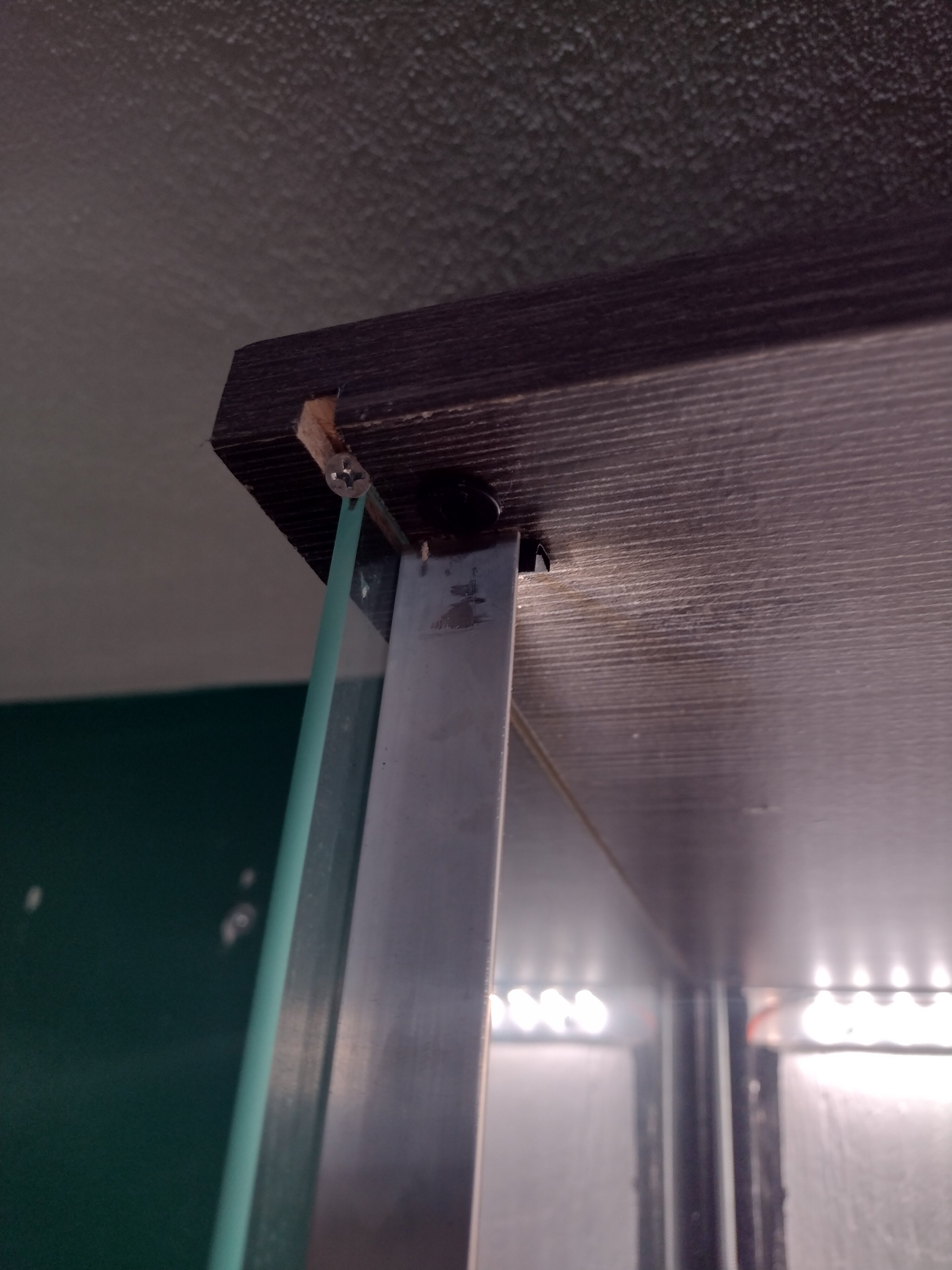

This all started with a trip to Ikea to pick up 3 detolfs and a TV cabinet wide enough to put them on.  But when I got home and got the TV cab put together, I quickly realized that its structure was woefully inadequate for the weight.  I had a spare piece of plywood in my garage tho, so I thought I'd use it to replace the cardboard backing (which was the only thing lending any structural rigidity).  But it was plenty long enough to be taller than the detolfs if I use the whole sheet, and after looking at how the detolfs were built with just slots in wood bases, I figured I could restructure them all to make one big frameless cabinet.
I really hated how the shelves in the detolf are held in by a cheap wire ladder frame and aren't adjustable, so I went to the hardware store for some threaded rod instead.
T-nuts hold the rod on the top and bottom:

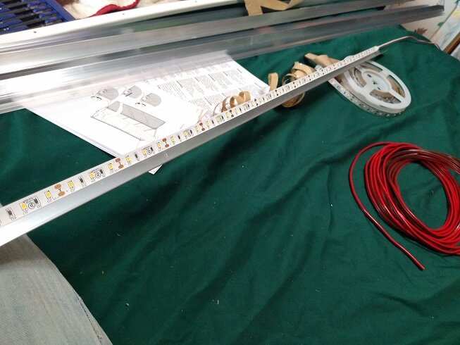

Then came the need for lighting, so I ordered a power supply, controller, and strip lights and picked up some angled aluminum from the hardware store.  I routed the wires through the top of the TV cabinet and installed the power supply onto the back panel plywood with an AC cord out the side.  I used one of those cheap little controllers with remote for dimming, and it's been working well for a long time now (I actually started this project a year or so ago).  The aluminum angle and lighting covers the threaded rod in the front.  I used high CRI neutral white strips from superbrightled.com.  I see a lot of display cabinets where people use cheap, very blue LED strips with really bad color rendering which irks me.  But I would probably not know any better myself if I didn't work for a high end lighting company.  I really hate how good lighting has been slowly replaced by cheap, crappy bulbs over the years in the name of efficiency, and with cheap LED bulbs taking over the market, they're all just low quality garbage that hurts my eyes.  It's actually hard to find bulbs that list their CRI rating at all because they don't want to include a number on the box that tells people the TRUTH.  Anyway, rant over...

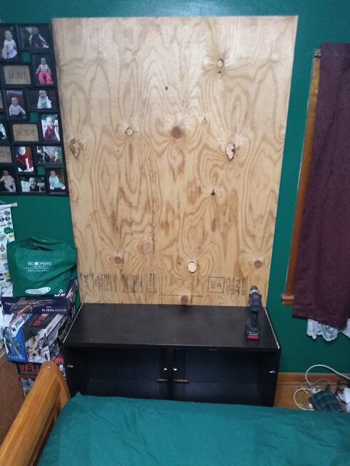

I painted the back panel with high gloss reflective white for a really cool reason that I'll get to in a minute.  I also cut up some shelf rails out of aluminum as well as some custom plexiglass shelves.  I also found that I could use the original glass shelves by cutting down the clear plastic rails that used to hold the vertical glass panes together and cutting slots in the ends.
I installed a matching shelf on the top to hold the glass in place, slid it all together, drilled holes for the door hinges, and it all came together pretty nice!  Nothing to see on the bottom shelf. :ph34r:
As you can see, I lined the bottom shelf with a very short pile, outdoor carpet for a grass look.  I was going to use felt, but this is basically really thick, tough felt and a lot cheaper that comes in big wide rolls from the hardware store.
You might notice the little black squares and the black strips on the side.  The reason for those and the reflective white paint was to put strip lights on the bottom and top in the very back facing up and down such that it would be backlit.  Then the plan was to print a background onto transparent film and install it with the velcro (black strips and squares) such that I'd have backlit backgrounds (basically the same as ads on bus stops which is where I got the idea).  This is what I was considering using for the background to include all the planets featured in the original SDFM:

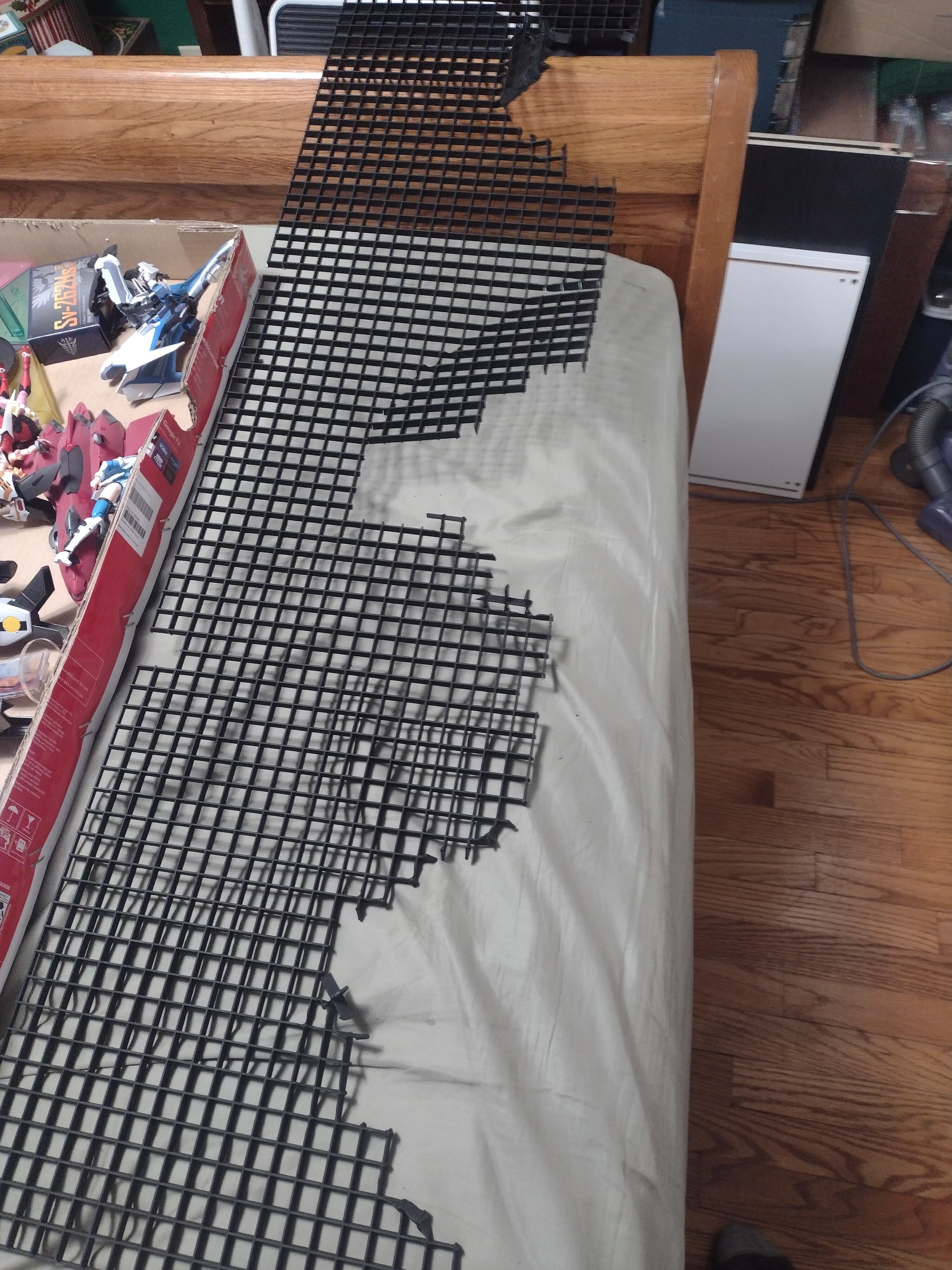

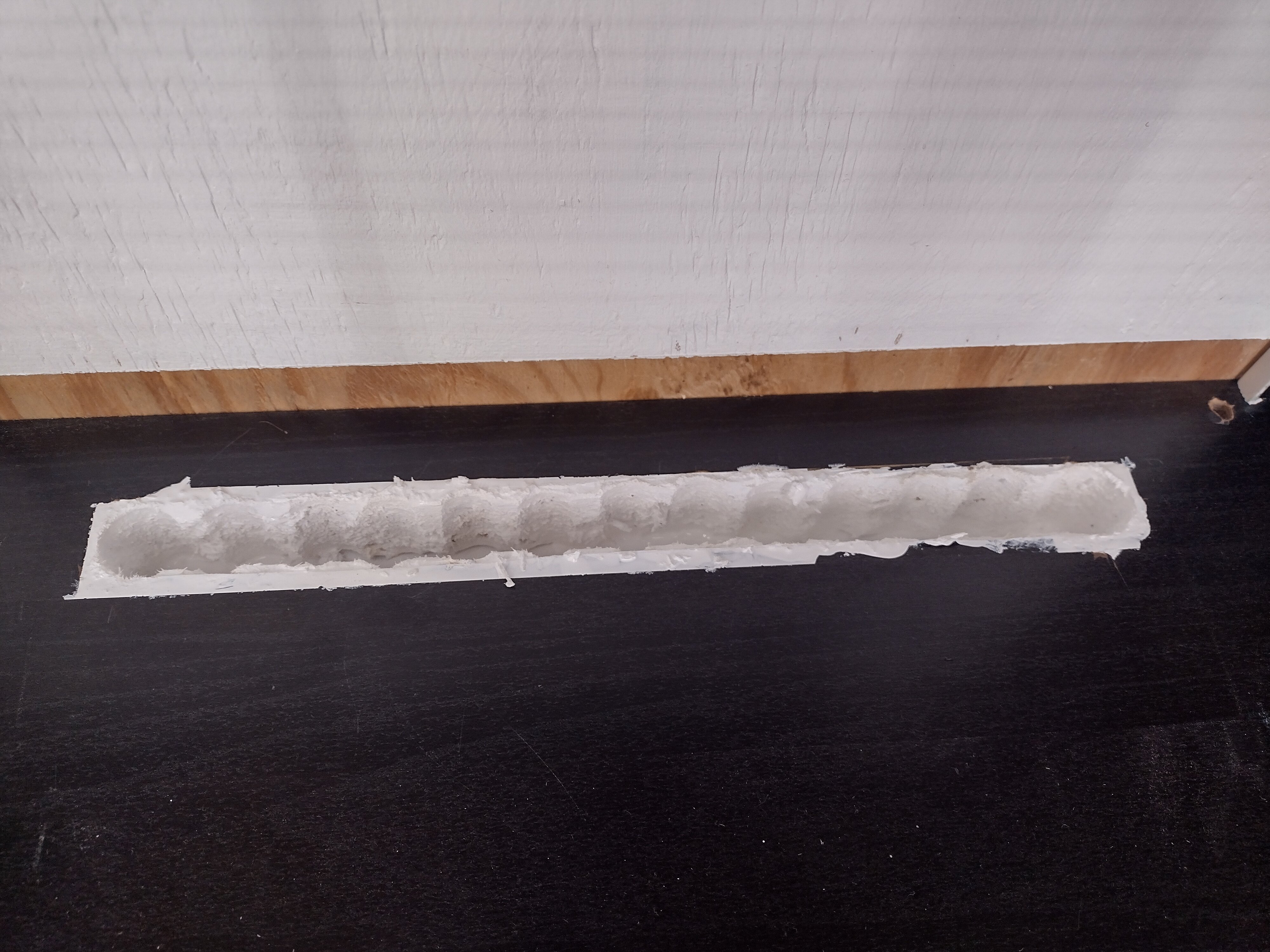

Sorry, ran out. Will you settler for an arc welder?
If you're squeamish about seeing expensive and somewhat rare toys and figures in compromising positions, look away now.
I had to get all my stuff outa the cabinet to work on it, but rest assured that I was very careful with head lasers and such.  This won't be moving anywhere until I'm ready to put them back on display.

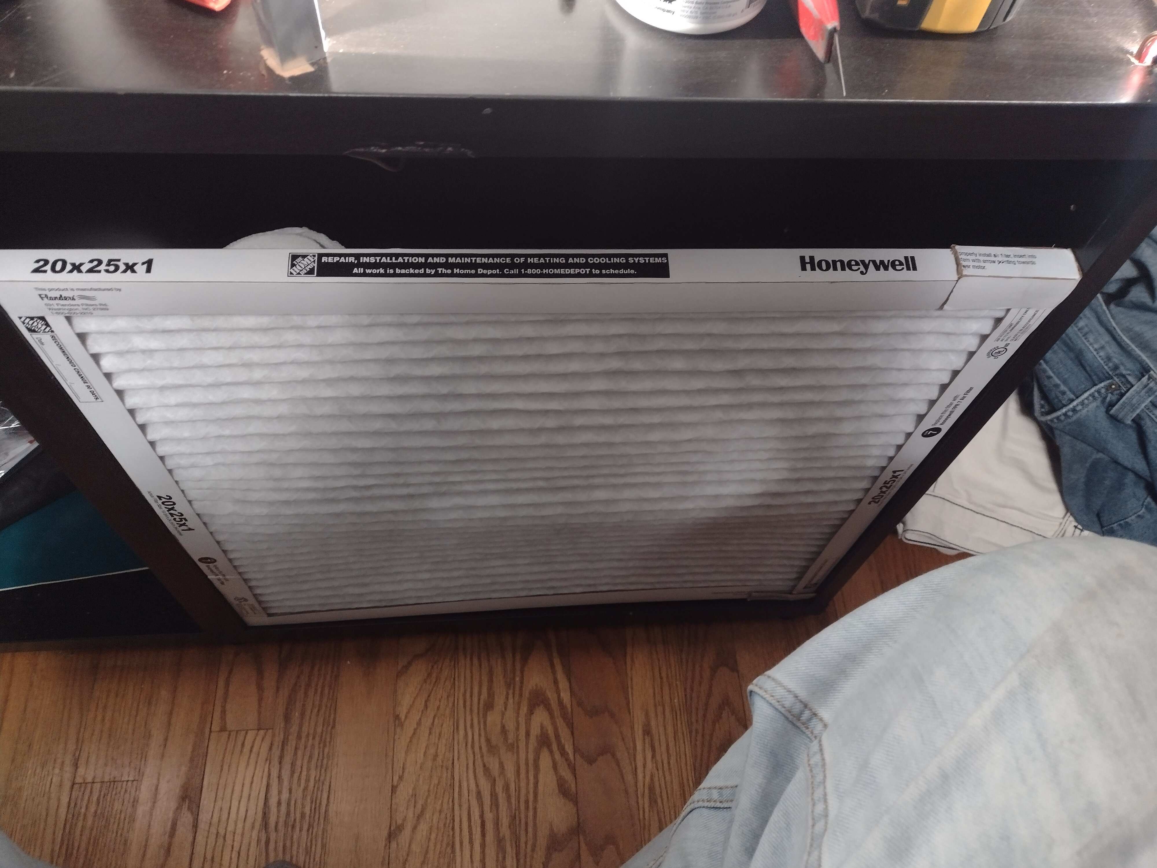

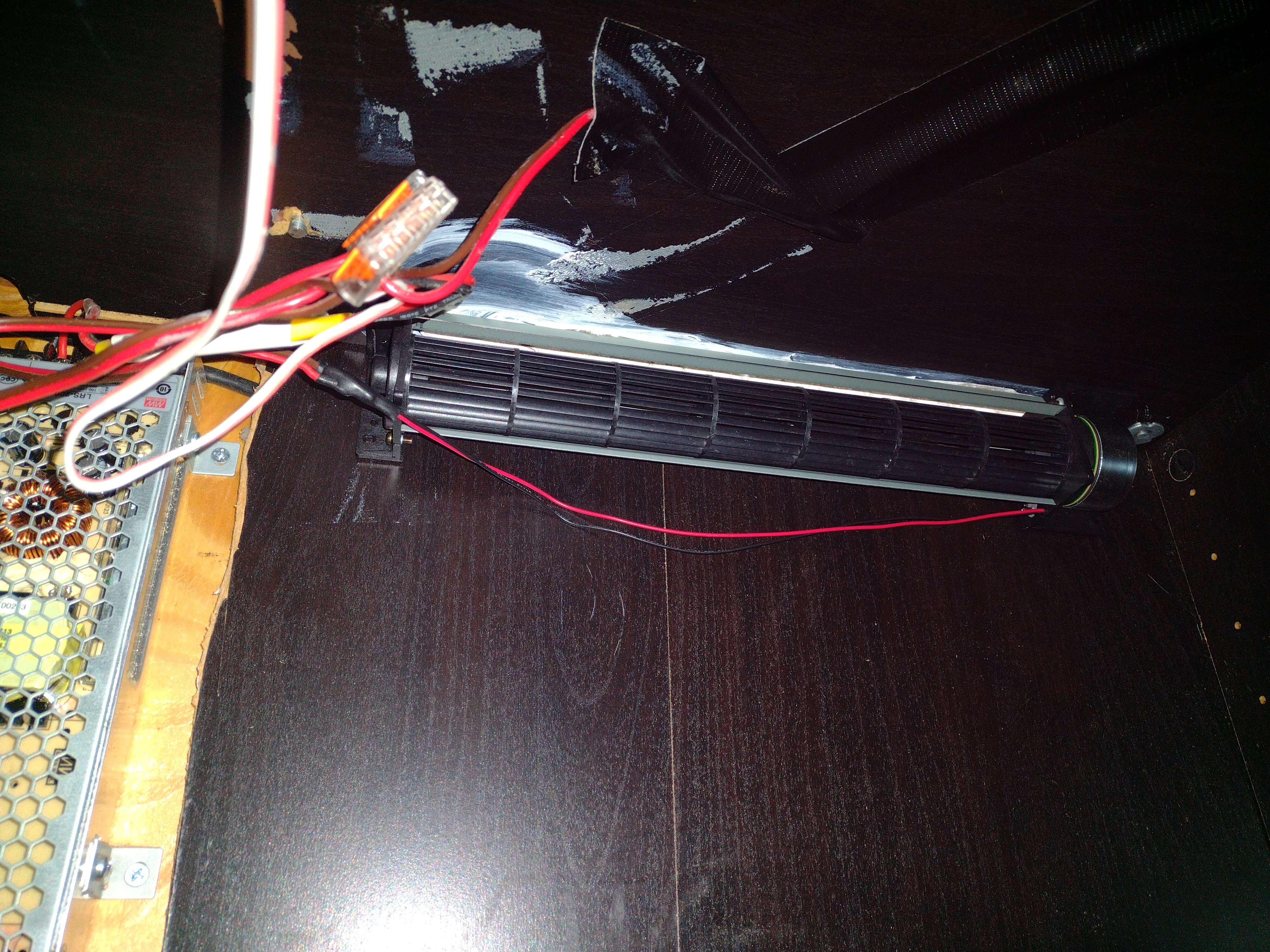

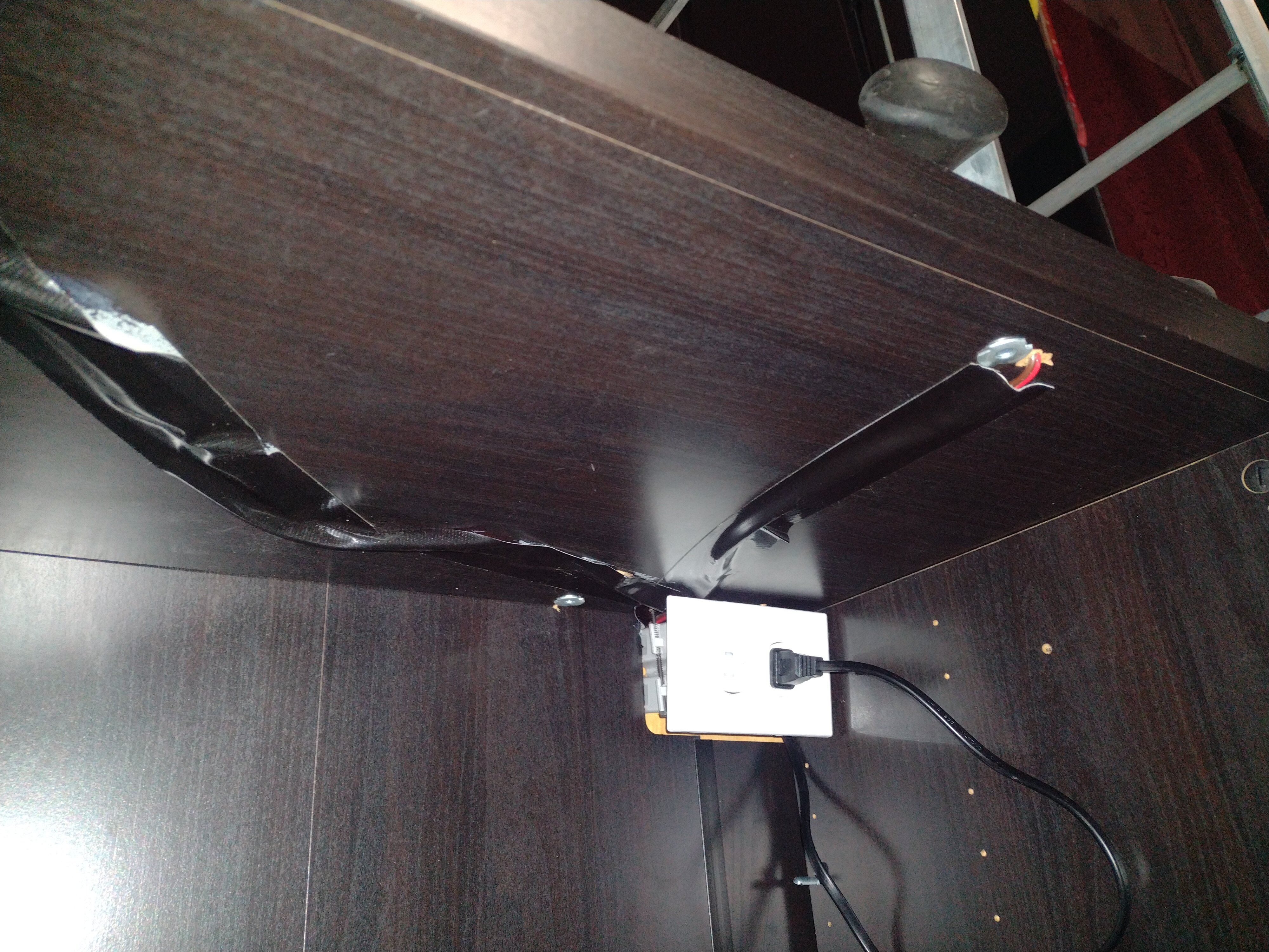

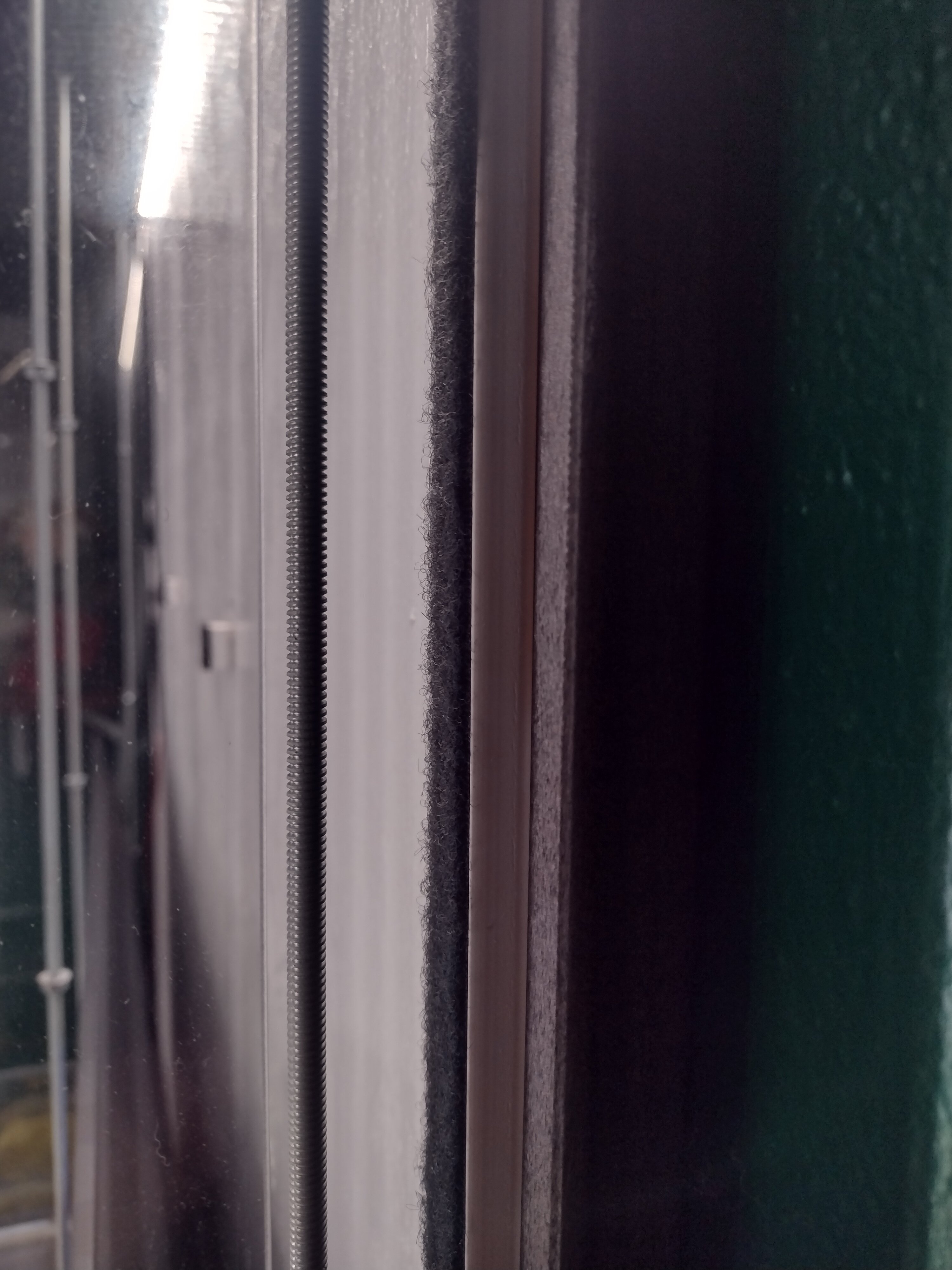

Moving on to dust abatement... I previously experimented with foam strips for the door seals (everywhere else is sealed), but this failed because it was impossible to get it to seal properly with the upright, aluminum L-bars moving about.  I could probably find some whiskers instead, but with the rest being glass and simple lines, anything else is somewhat detracting from the display imho.  So I thought it better to simply creat a higher internal pressure using a fan and filter its intake.  No dust.  Bonus that I didn't even think about until I got the TV, it's going to need some ventilation.  And since the inside will be warmer, I'll never get condensation in or out, and no mold behind it (I have concrete block walls that sometimes get condensation in winter and will mold anywhere not open to air).
I had a 12V axial fan and some spare furnace filters lying around.  Time to make a vent in the base with a spade bit and a chisel.  A little paint to seal the rough wood, and it may not look great, but it'll be covered by felt anyway.
This 3m VHB tape is "used to hold aircraft parts on" as I was told.  I'm not sure what that says about aircraft maintenance, but this stuff is great.  It held my fan instantly and securely underneath.  And this gorilla tape does a nice job of covering wire runs and keeping things sealed up.  Ran the fan to the power supply output (both 12V), and WHOOSH, AIRFLOW!
I carefully cut down a 25x20 filter to match the width of the cabinet opening and took off the cardboard end to reapply over the now bare end and made it whole again.  Now it fits snuggly to the width of the lower cabinet.  I initially thought I'd install some sort of door with a filter, but I like it open.  So I decided to put it all the way in the back over the fan.  Used some of the leftover foam tape to seal at the top, jammed the filter back up there, and taped the bottom to the back of the cabinet.  Clean, filtered heat ventilation and a slight, positive air pressure keeping dust out.

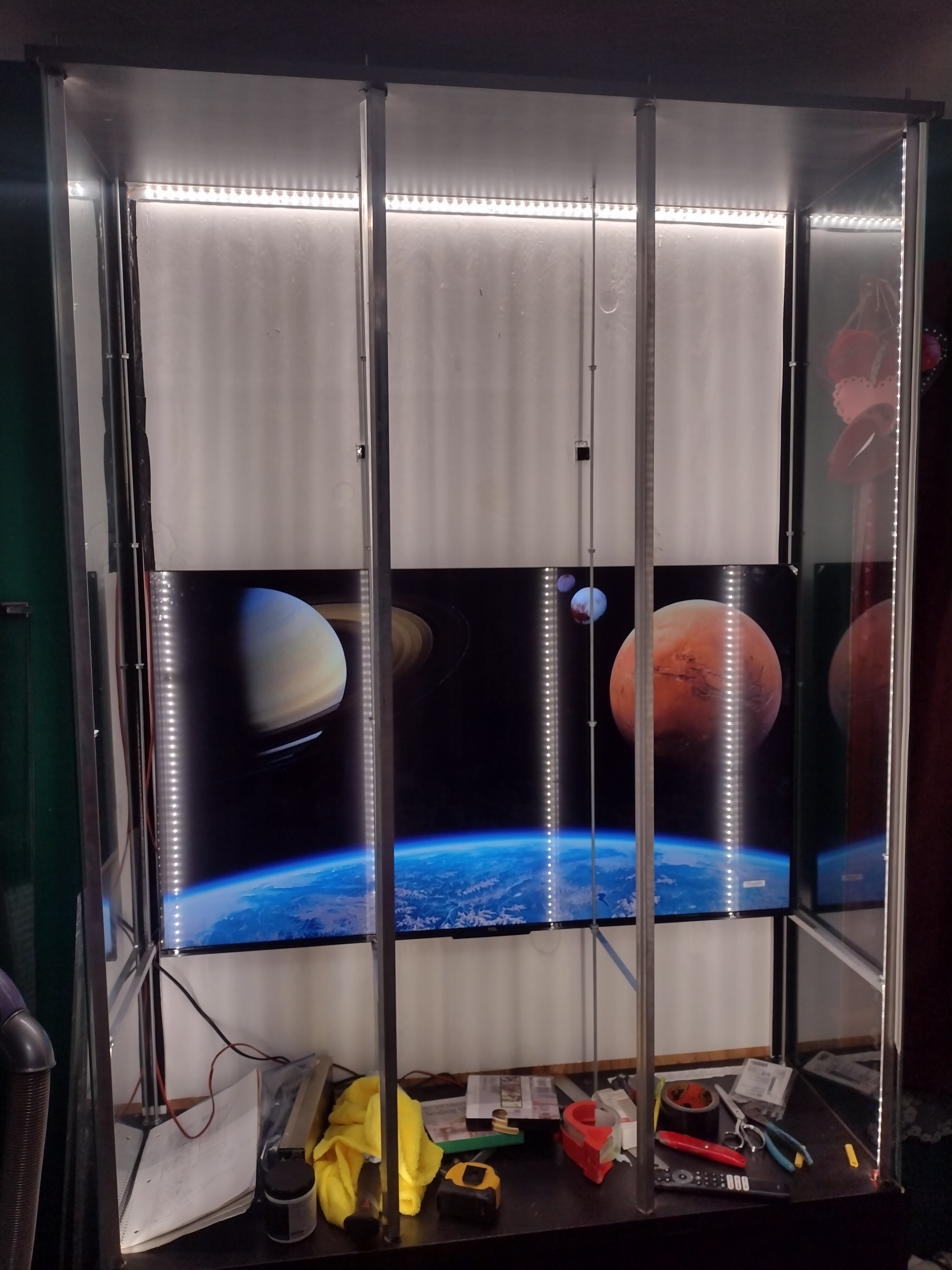

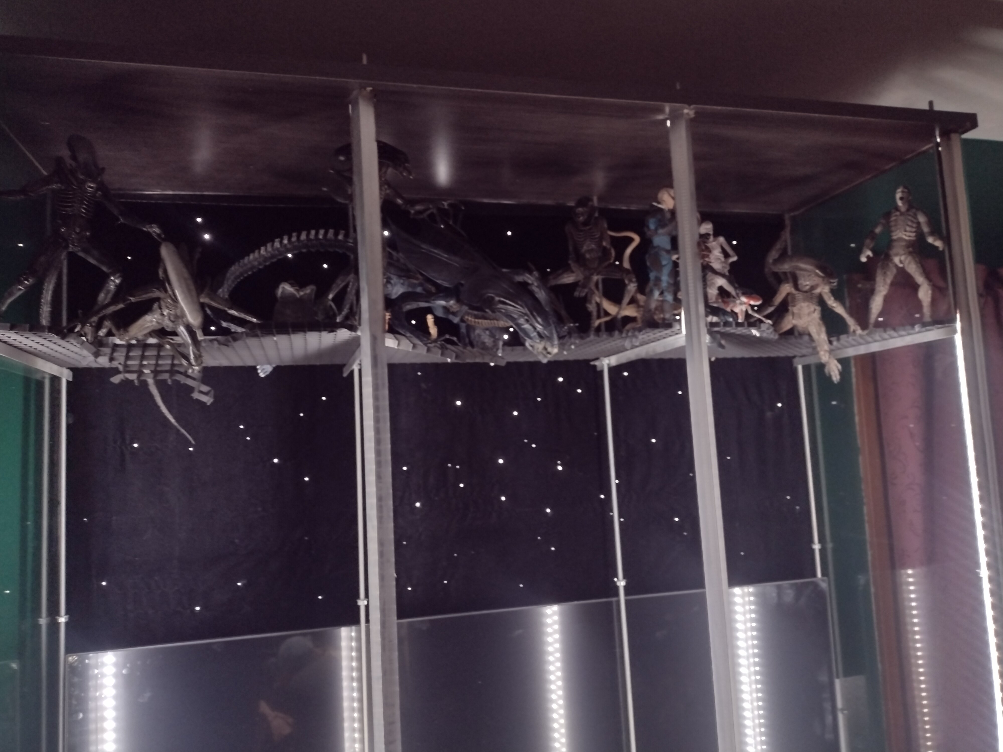

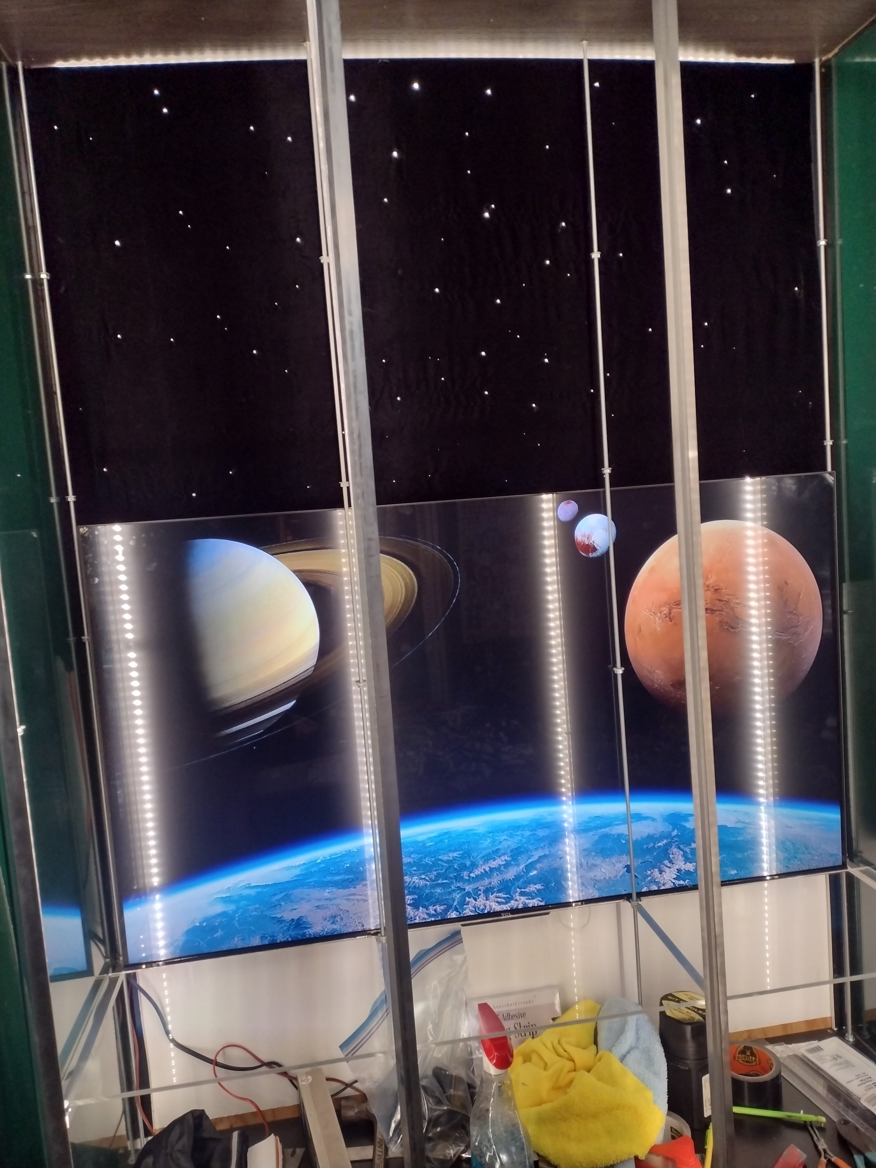

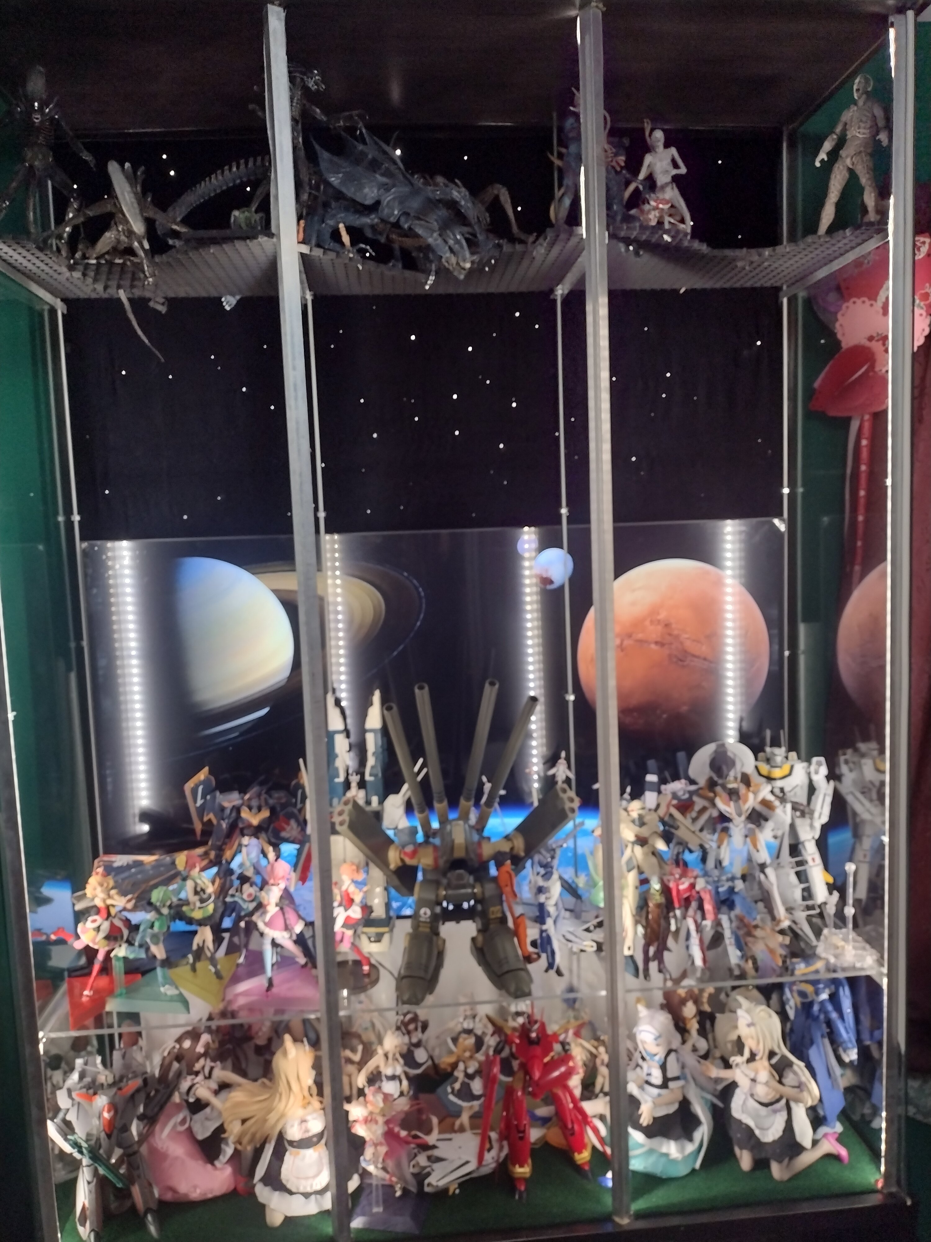

Since I couldn't sleep cuz all my toys are on my bed and I have nowhere else to move them to even if I could, I pressed through the night and made a lot of progress.
First I added a light strip at the top facing down and connected it directly to 12V instead of the dimmer because it needs to remain as bright as possible.  More on that in a minute.  I also needed a place to plug in the TV cuz the cord doesn't reach out of the cabinet, so I wired up an outlet below.
Then I got to setting up the TV and became very frustrated just trying to display one picture from Google photos.  I'm gonna have to set up a usb drive.
I've wanted to set up a star ceiling for a long time now in my daughter's bedroom with the sky at her birth, but I needed a smaller proof of concept before diving into such a big project.  Using a sheet of black corrugated plastic, I popped a short piece of fiber optic thru to see if it will work with such a short piece just pointed at a light source.  Normally, a professional star ceiling runs all the fiber to a dedicated light source in a huge bundle, but that gets very expensive.
It works!  When I built the cabinet my intention was to be able to slide the side glass forward for ease of installing backgrounds, and that came in very handy for a test fit and final install.  I put a small screw in at the top to keep it tight to the grooves in the back panel which keeps the glass from bending (same as the plastic strips of a detolf).

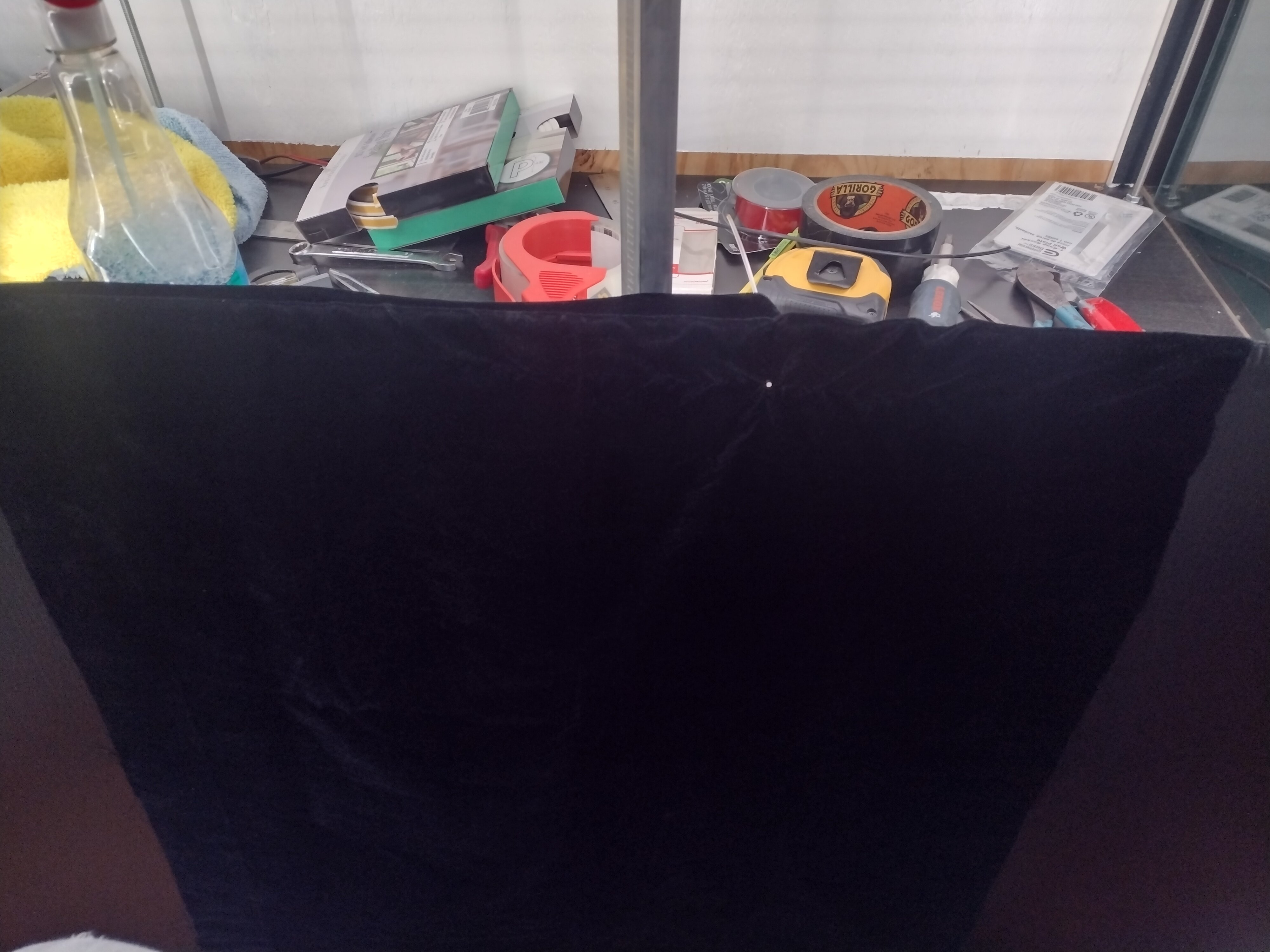

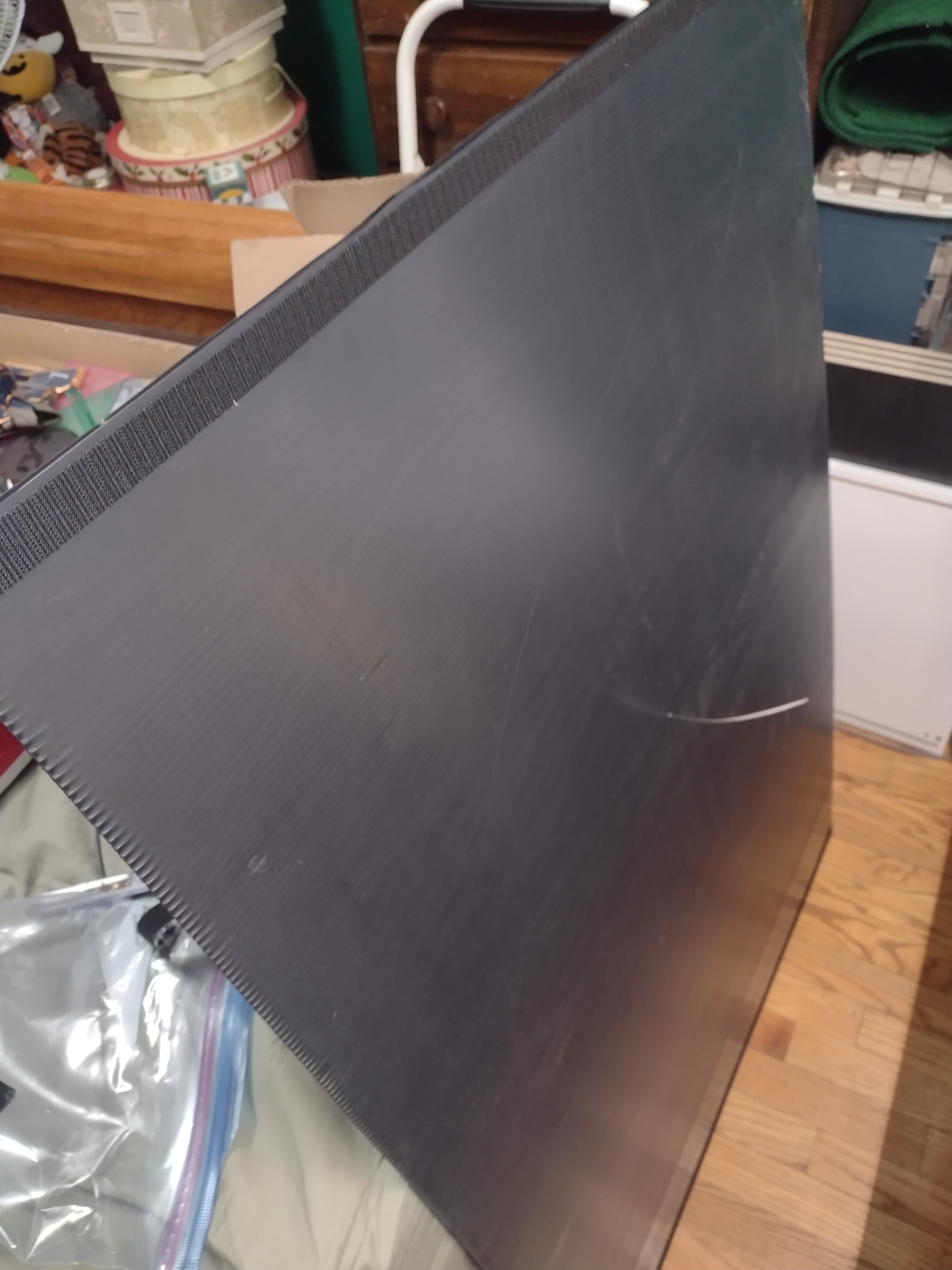

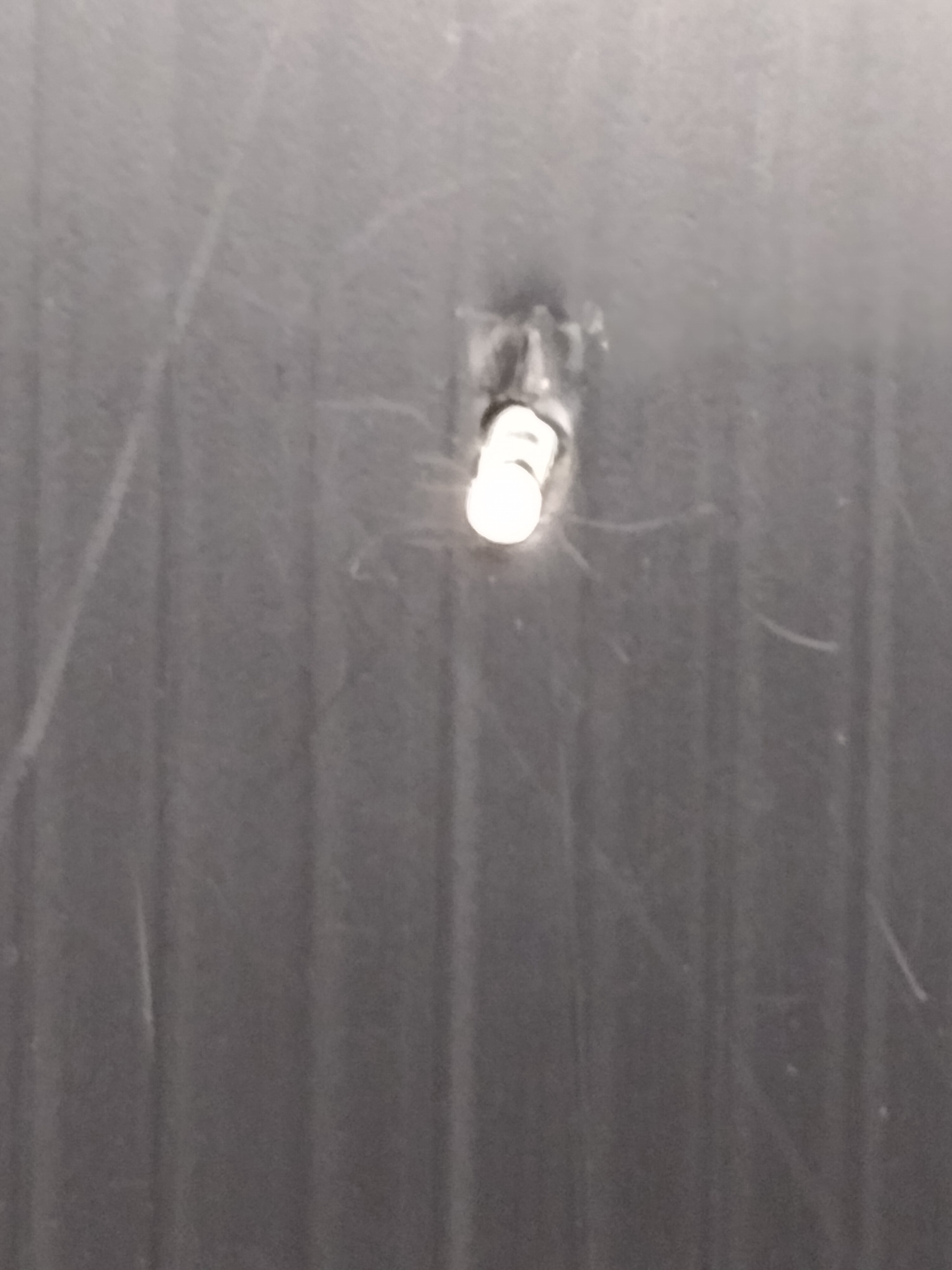

Now for the fun part; I attached a sheet of black velvet to one side of the plastic panel.  I did a test with spray adhesive which bles right thru, so I had to use strips of the 3m adhesive on the top and bottom.  I put said strips on the back so that I could lay the velvet out smooth then fold it over to stretch tight and stick. As you can see, light just falls into it!
Next was the arduous task of poking a bajillion tiny holes in it and filling them with various sizes of fiber optic as randomly as possible.  I installed them all angling upward toward the light source and hot glued them in place.
After wrestling it into place and fighting the velcro for proper position, I think it turned out rather nice.
Next, I can finally start loading it up starting with my Alien collection on top.

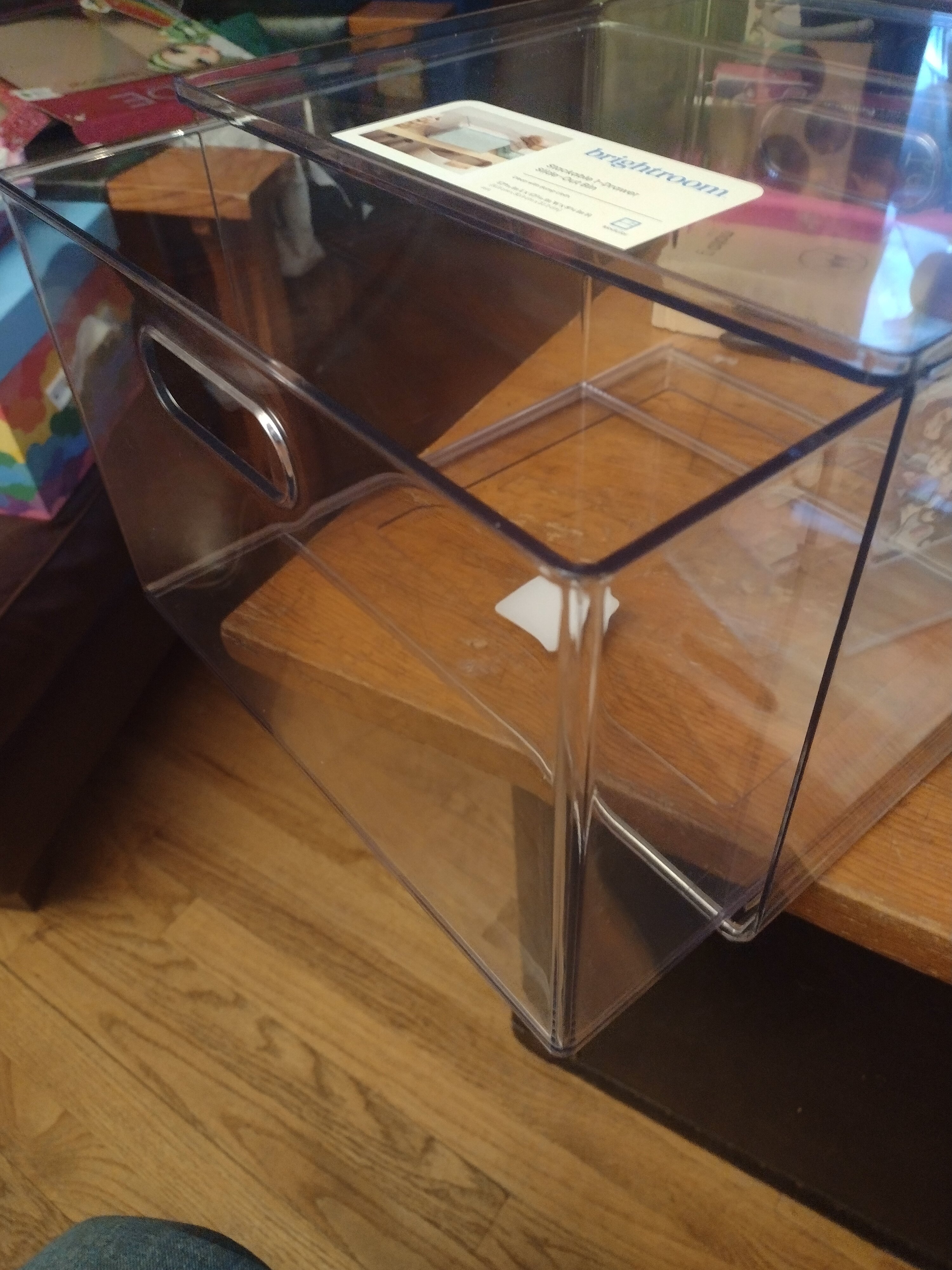

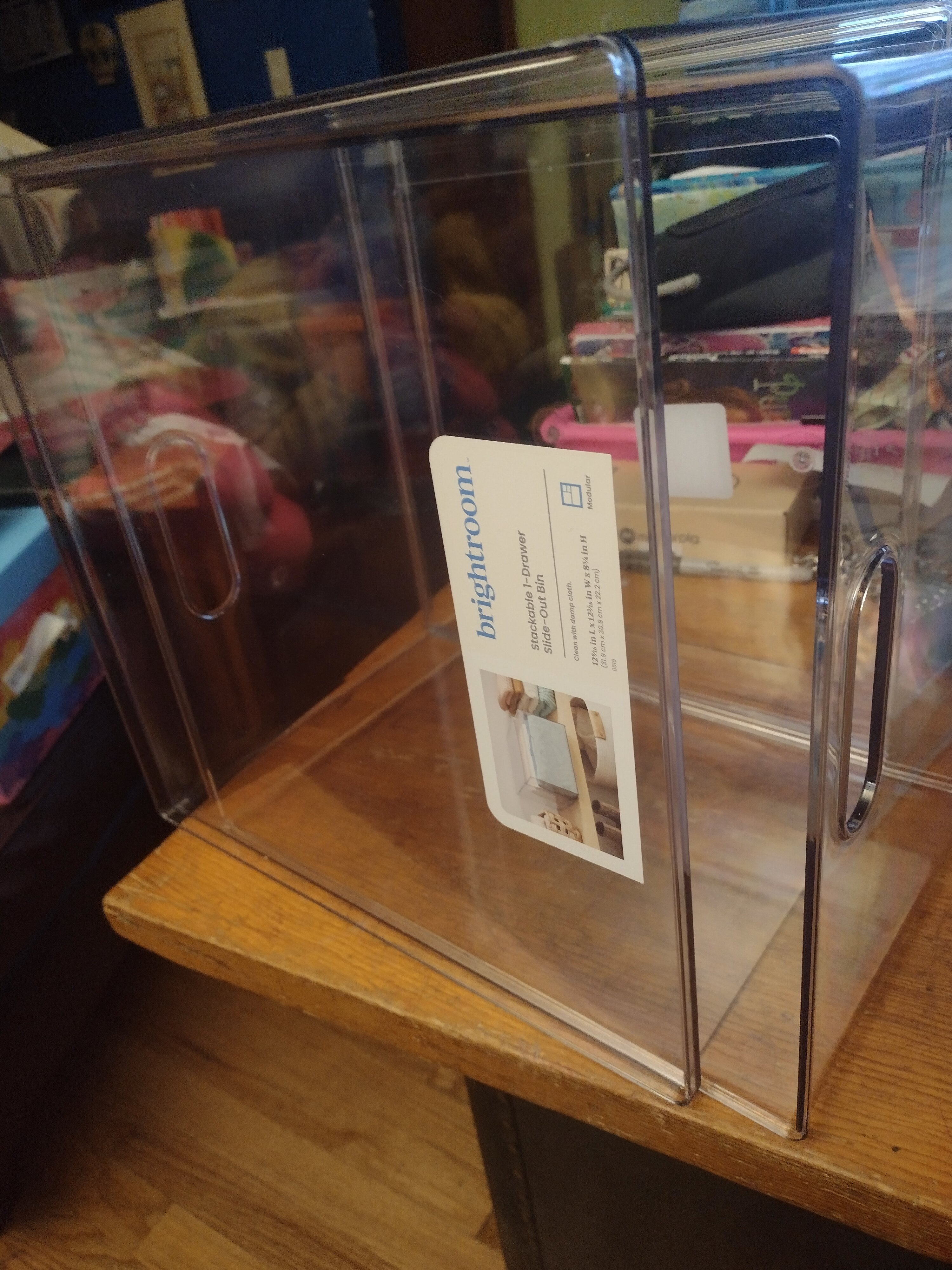

Btw, I just got back from Target, and they have these perfect, single cube display boxes disguised as clear bins for only $15!  You can use them like a drawer as designed or set them on their side to pull out sideways like this:
IMG_20240703_231309261.jpg.099756688e990f680f642c693249e9f9.jpgIMG_20240703_231417486.jpg.2070a8fe5f4c5cf5f1688ba67983de7a.jpg
