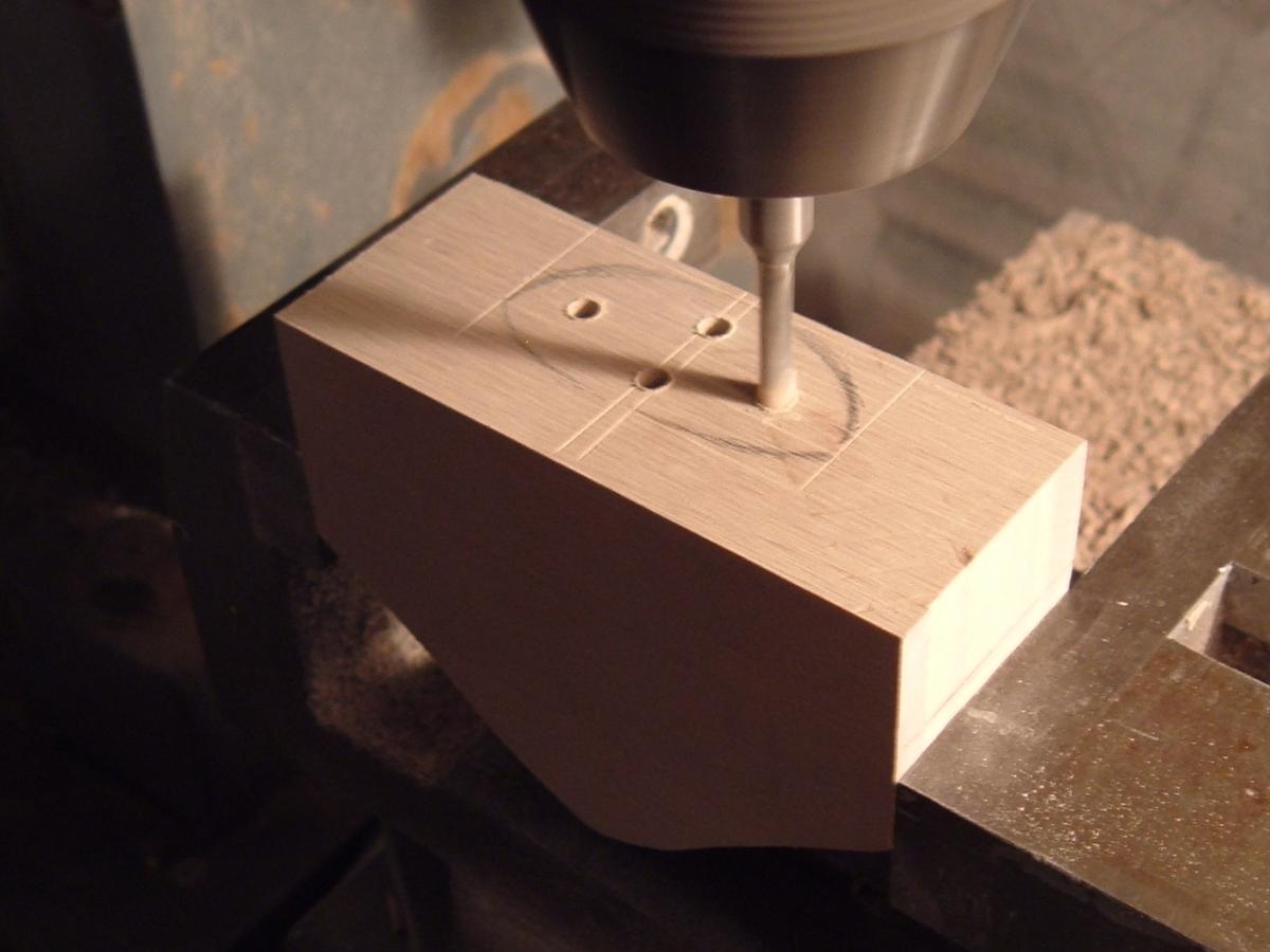

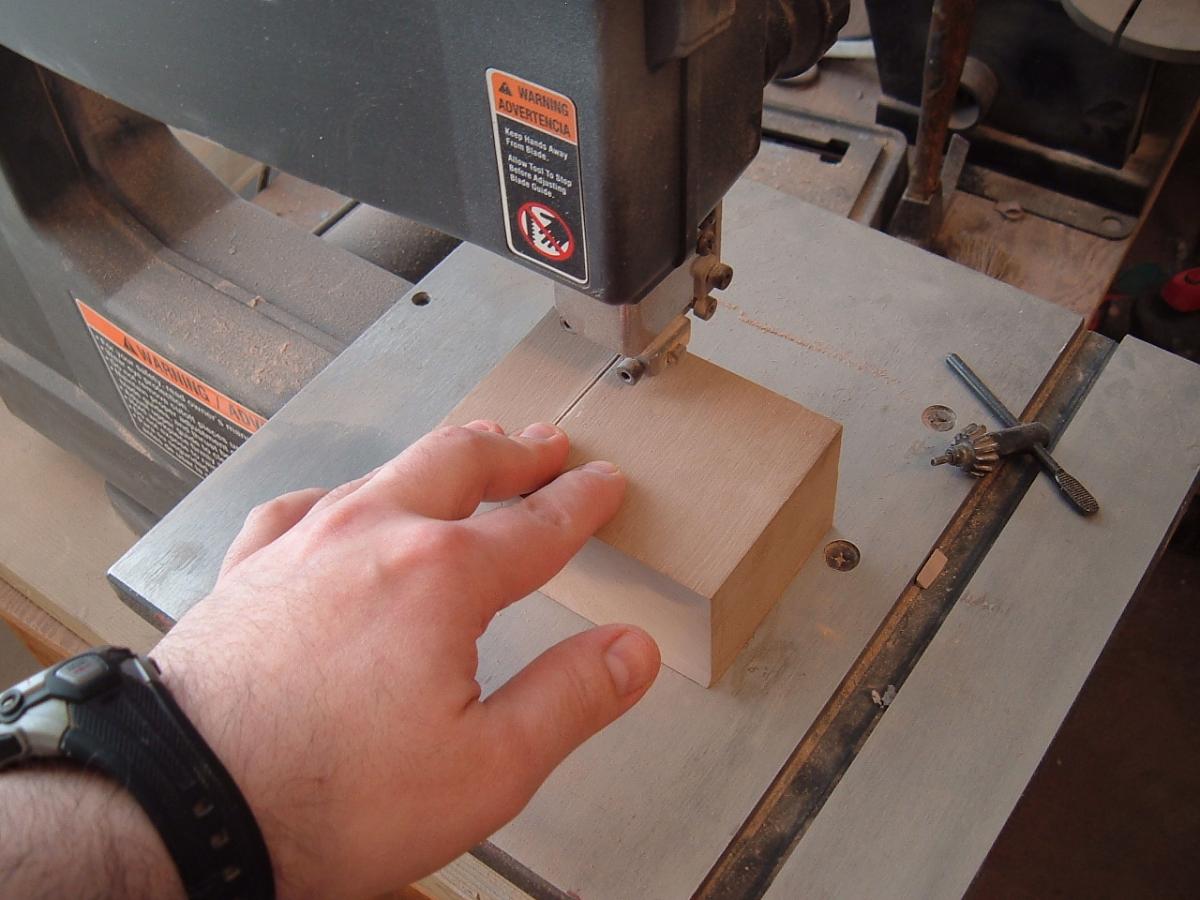

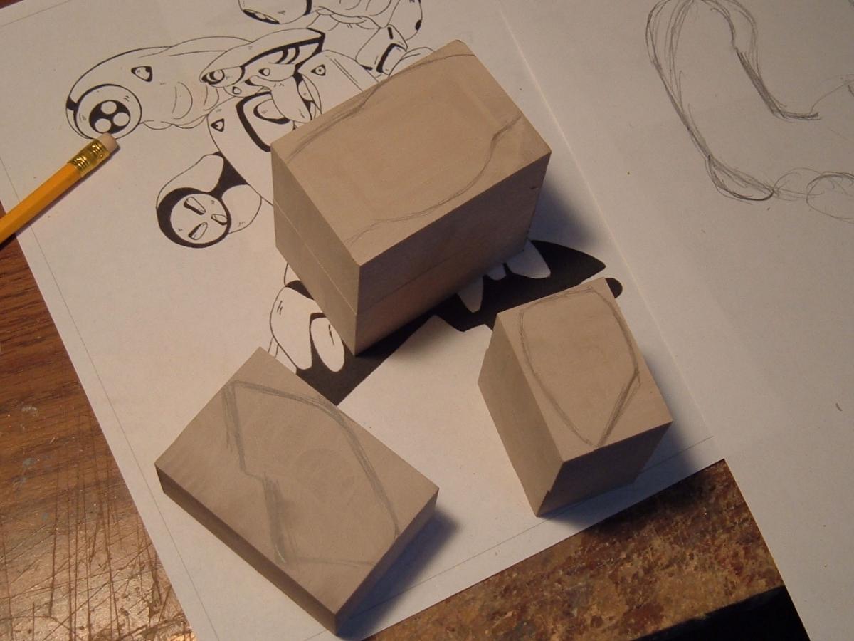

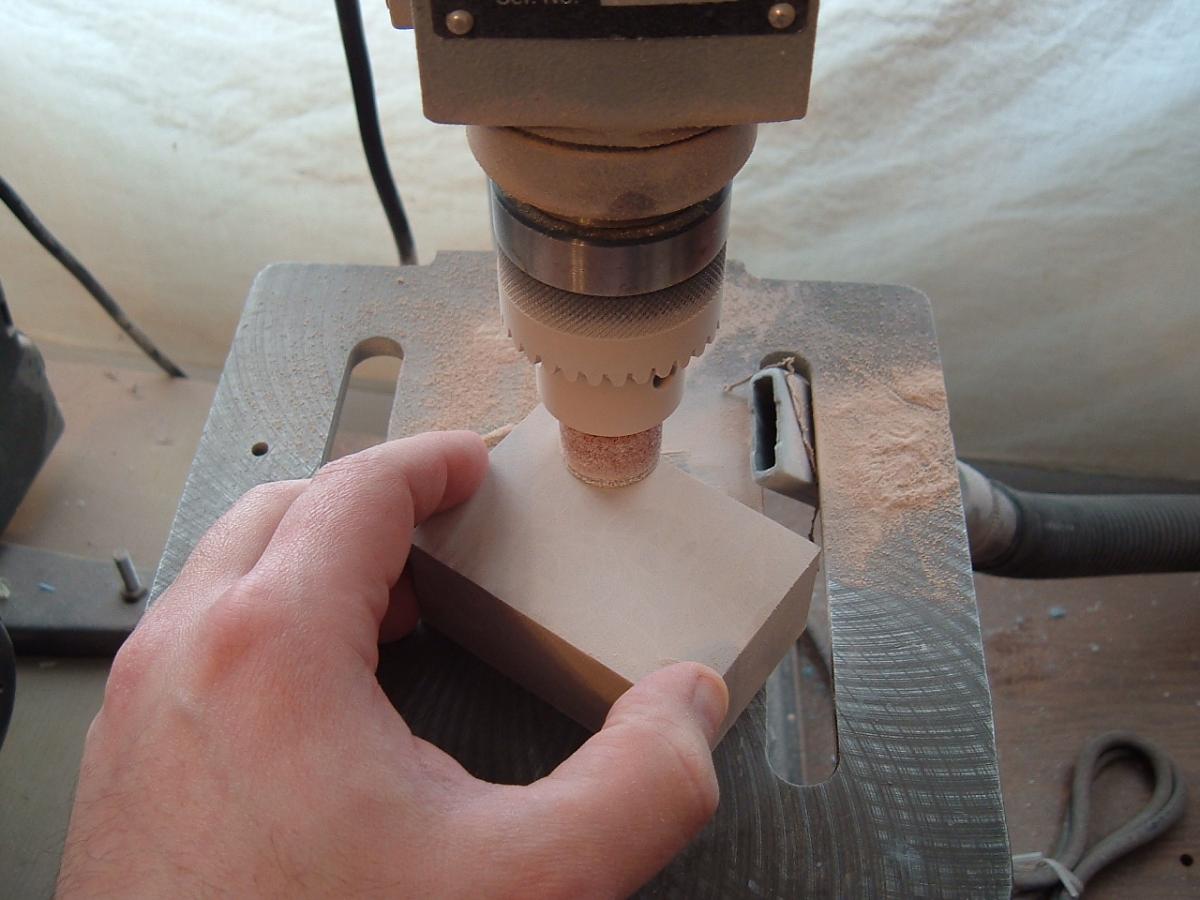

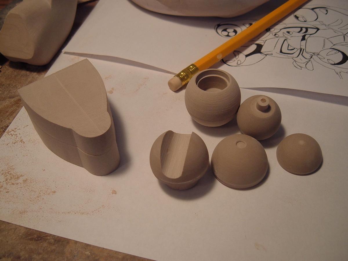

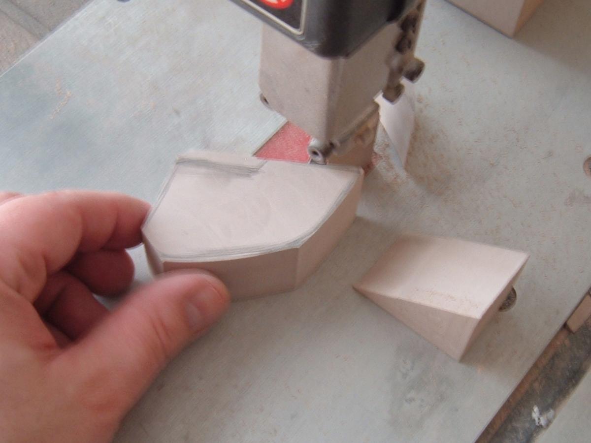

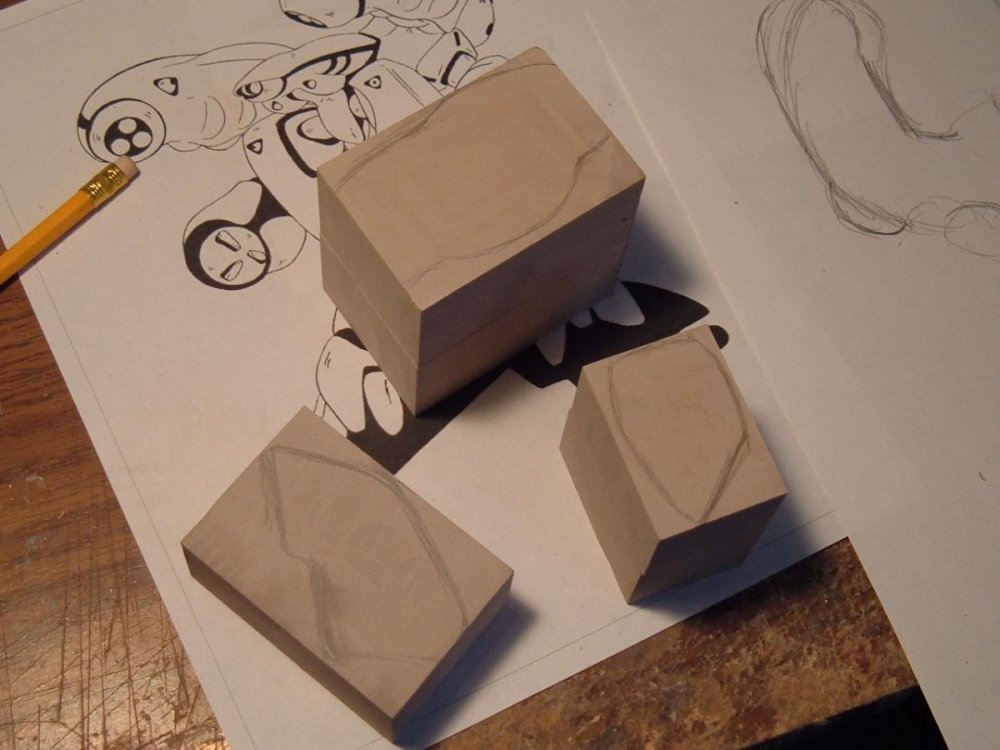

captain america Posted March 22, 2014 Author Posted March 22, 2014 Captain's log, March 21.I'm going to start out by revealing a great secret: I started work on the Gamo a while ago, I was just waiting for the right moment to break the news to everyone!So yeah, let's get this party started! The first pic is, as always, the customary shot of my basic tools and materials in their raw form. For what it's worth, I needed quite a bit more Ren Shape than is pictured, especially for the very large beam gun croissant.4915: since I needed more modeling board, I started by chopping up some new blocks into smaller, more manageable segments.4916: I then run the blocks under my drill-press grinder to make sure they're perfectly parallel.4917: this is a particularly tricky operation, and it involves taking a rectangular block of modeling board and durning it on the lathe in order to make the many round/bubble shapes inherent in the design. I start off using the live center to secure the part, since the knife is jamming into modeling board and air alternatively, and it creates a lot of vibration. By the time this pic was taken, the worst was over.4918: Now that I have some adequate blocks, I begin sketching the outline of the parts I intend to carve. I will then clean them up using French curves… Very artsy-fartsy!4919: the beginnings of the sphere that will become the beam gun "eyeball" nozzle.4920: some quick removal of excess material before lines are cleaned up.4921: You probably can't tell, but this block will become the main beam gun croissant structure. I remove as much material with the mill as I can to maintain my reference points and ensure symmetry.

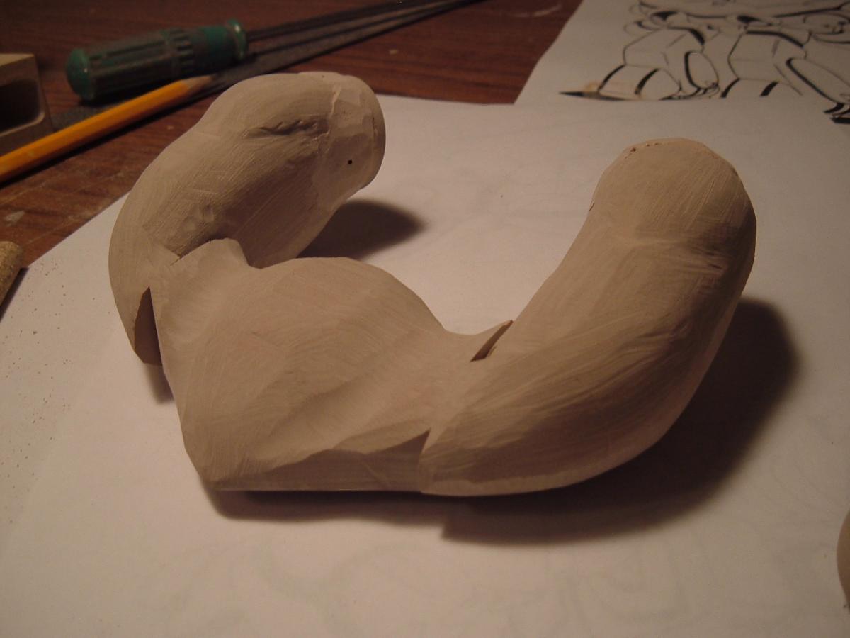

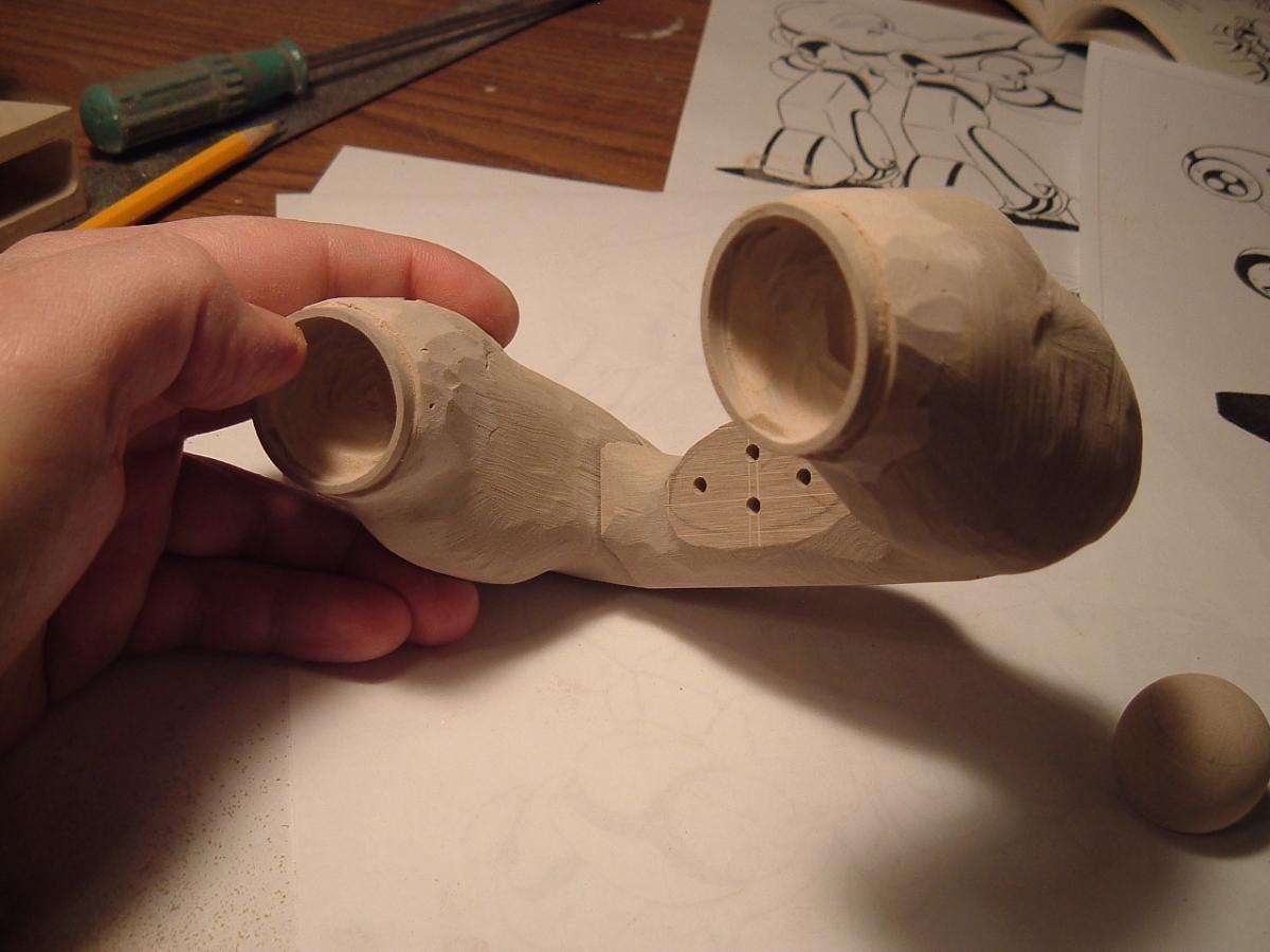

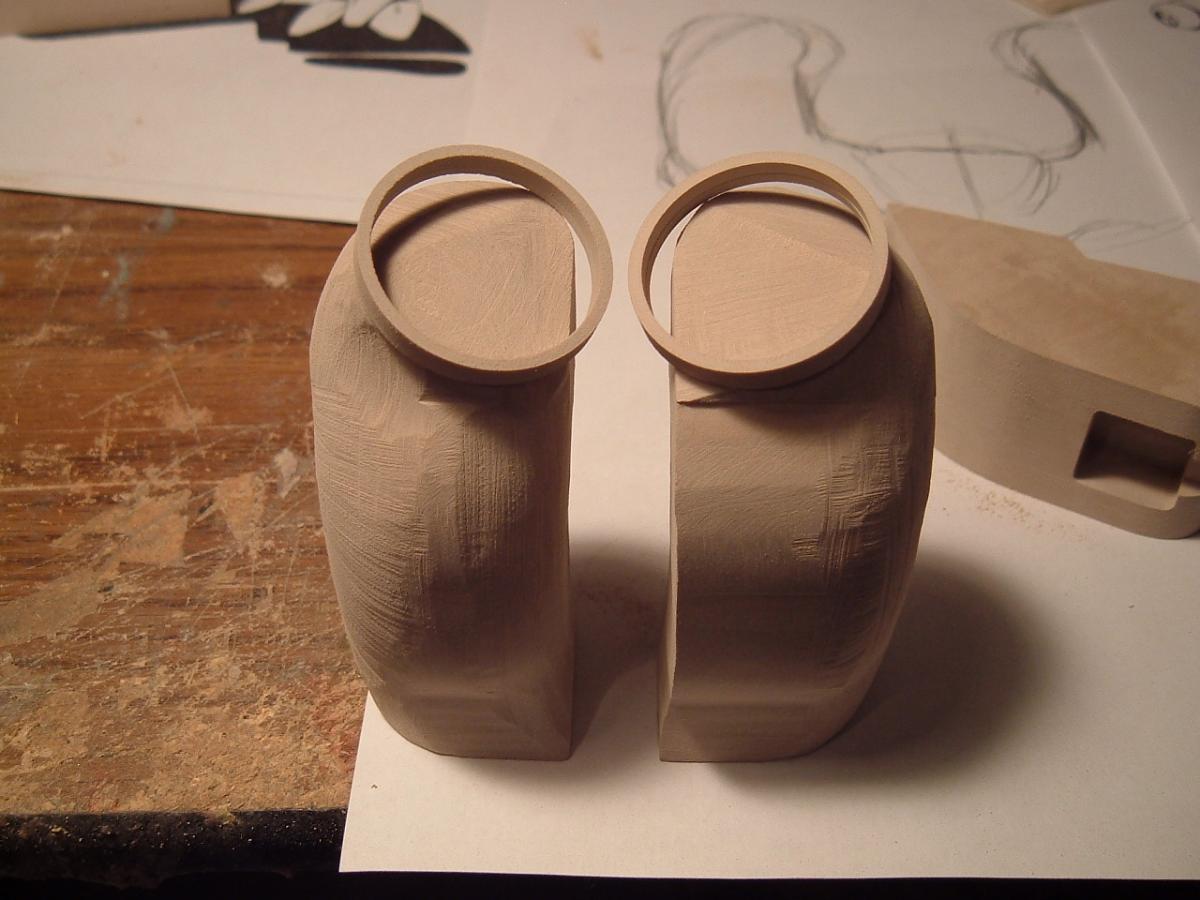

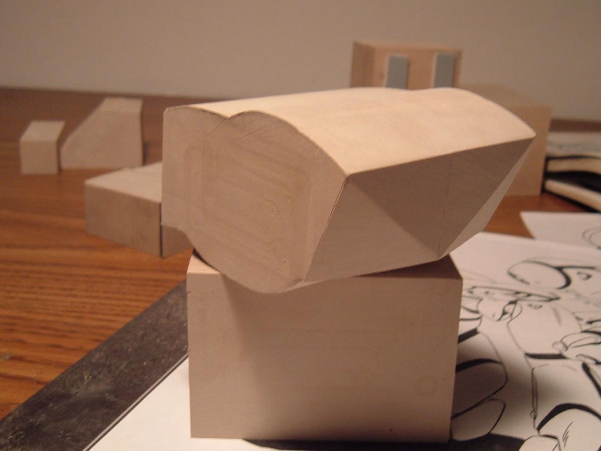

captain america Posted March 22, 2014 Author Posted March 22, 2014 4922: the beam gun housings continued.4923: and continued…4924: more of the beam gun croissant. This is the aft portion where the dorsal shell mates to the croissant. In fact, the penciled oval you see is the rough cross-section of the main shell.4925: after stupid amounts of Dremeling, the croissant is now starting to take shape.4926: the view from the back. It's still in a VERY rough state at this point.That's all for now, but I'll likely post another update on Monday because I have quite a few pics left to show. The project is taking quite a long time because while the line art looks simple, rendering it in 3D is anything but.

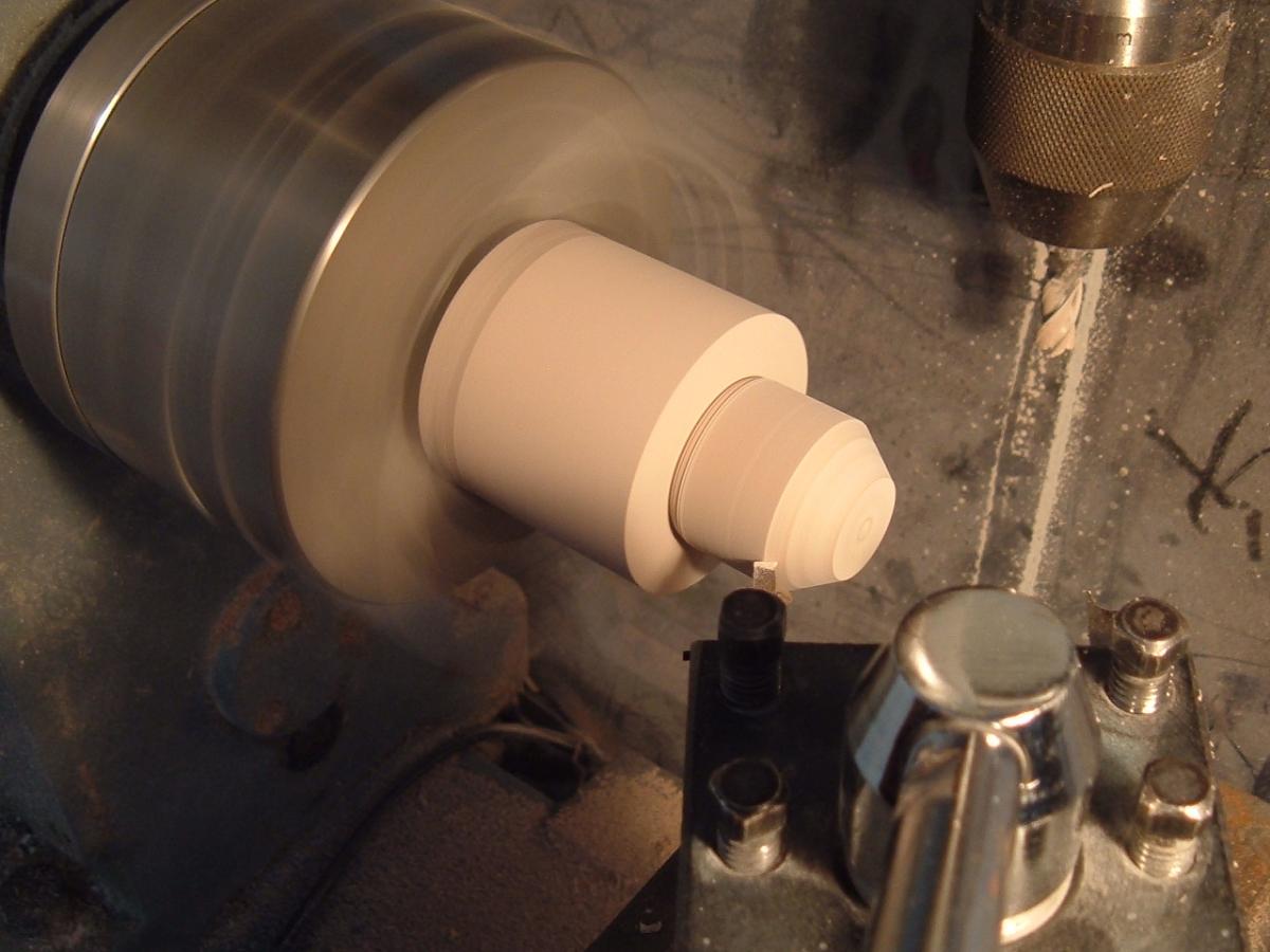

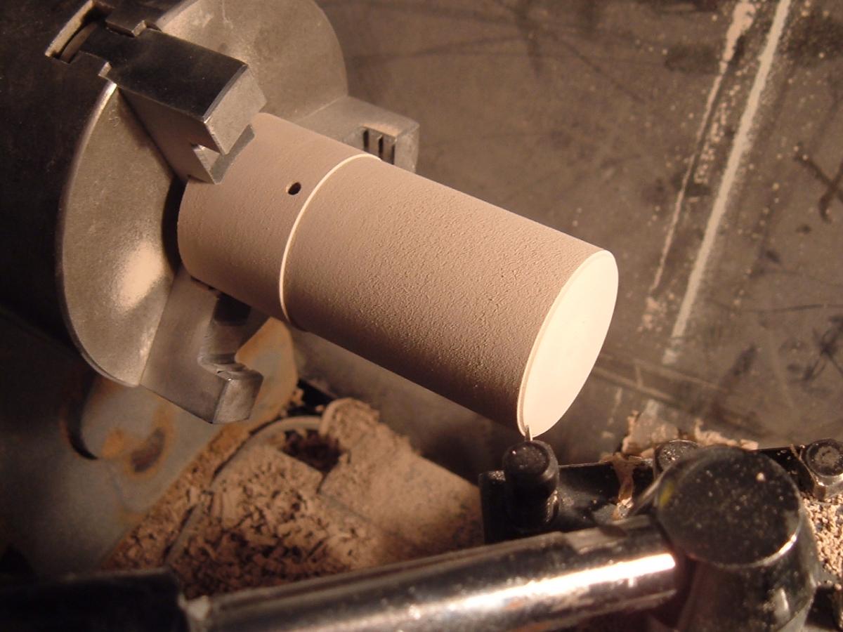

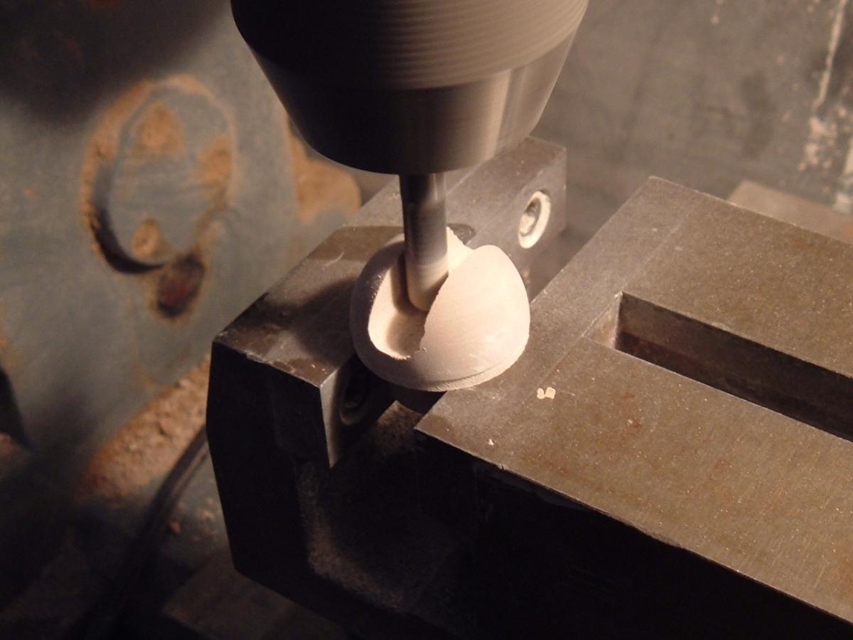

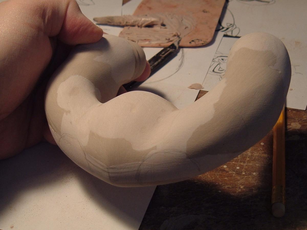

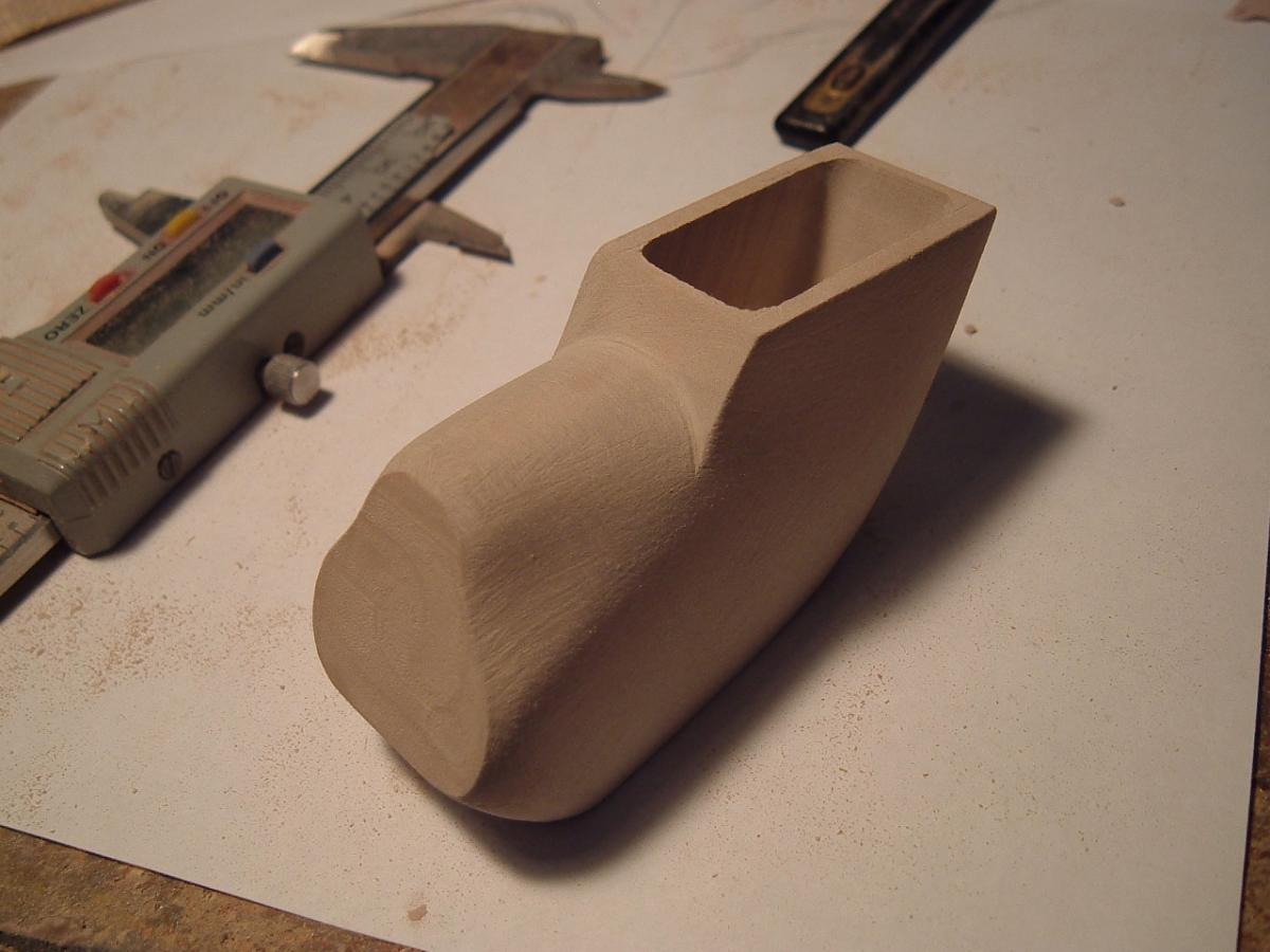

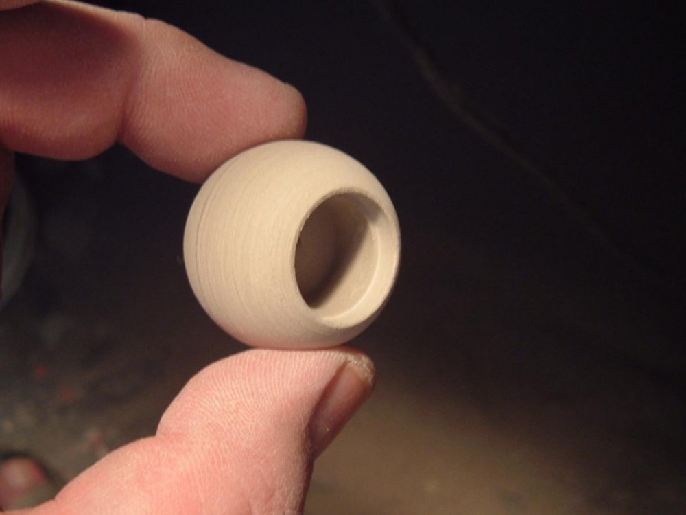

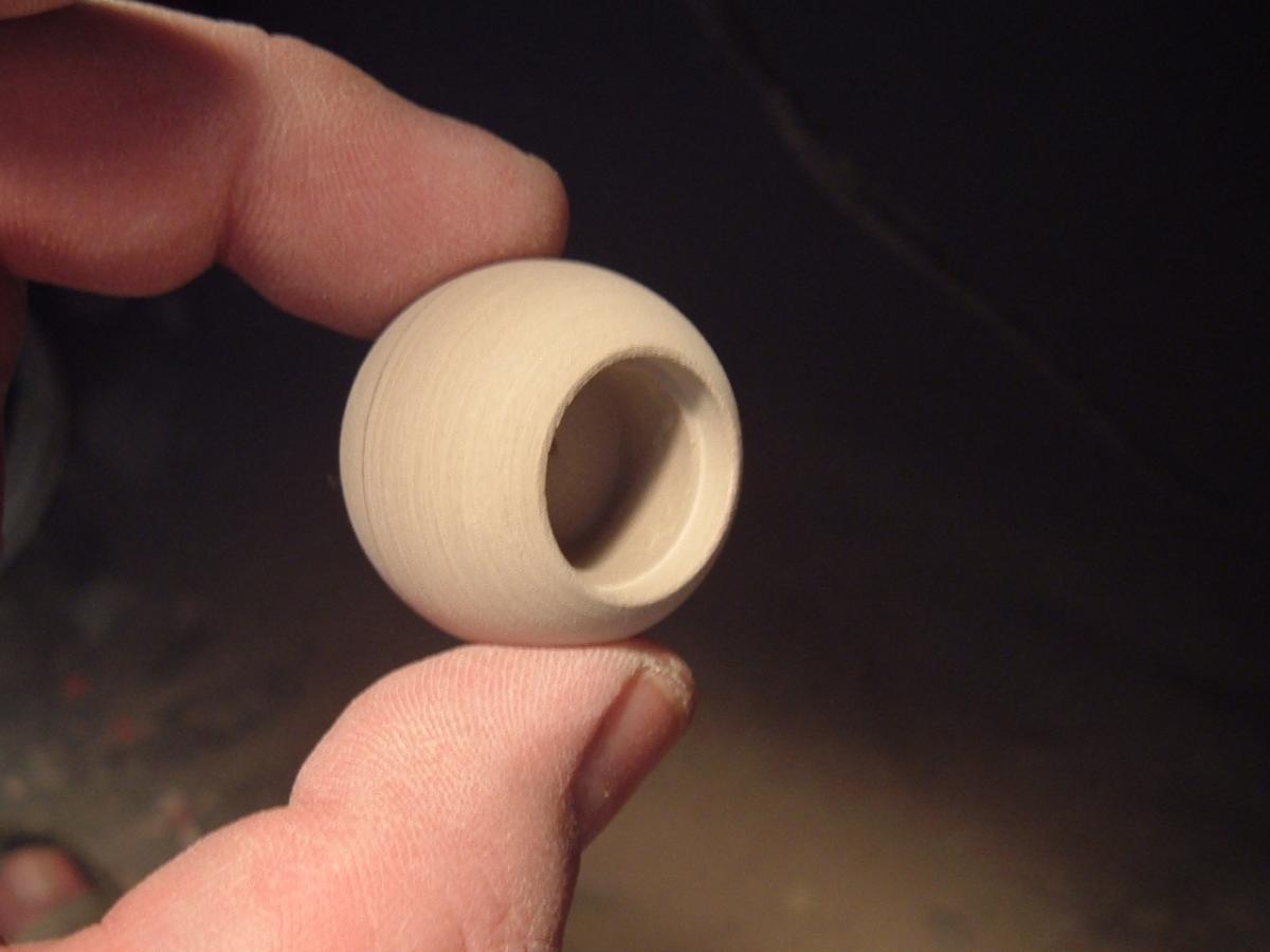

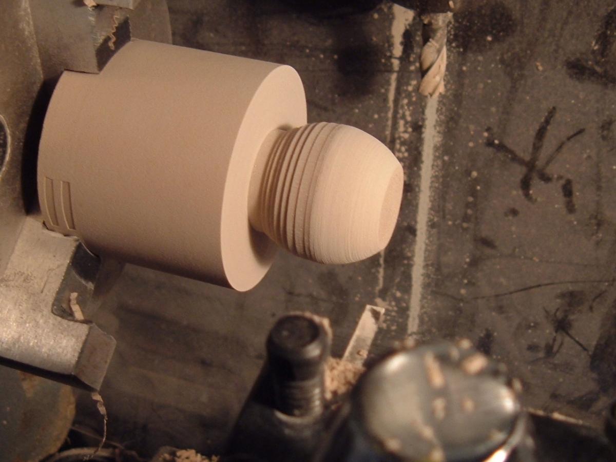

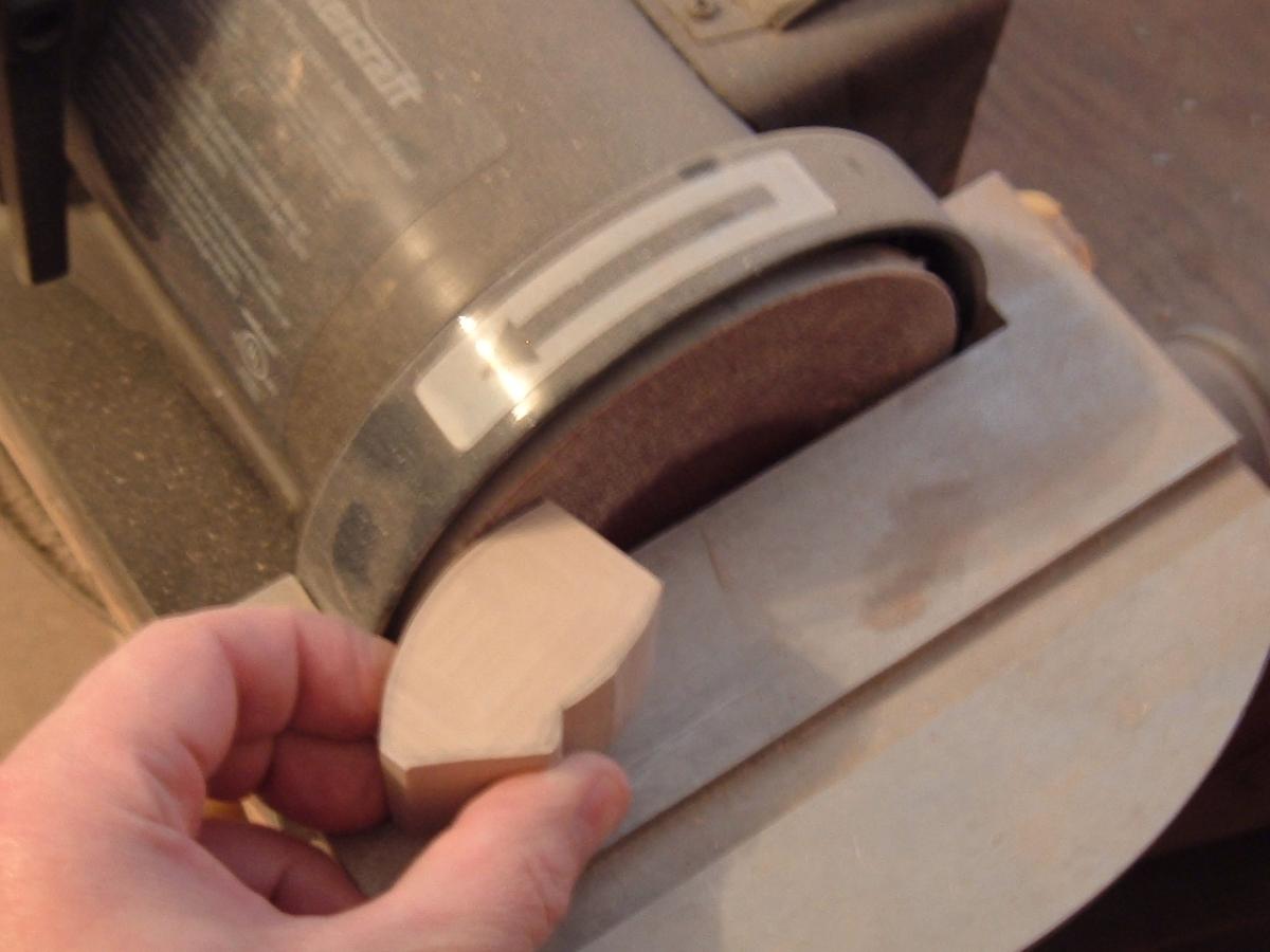

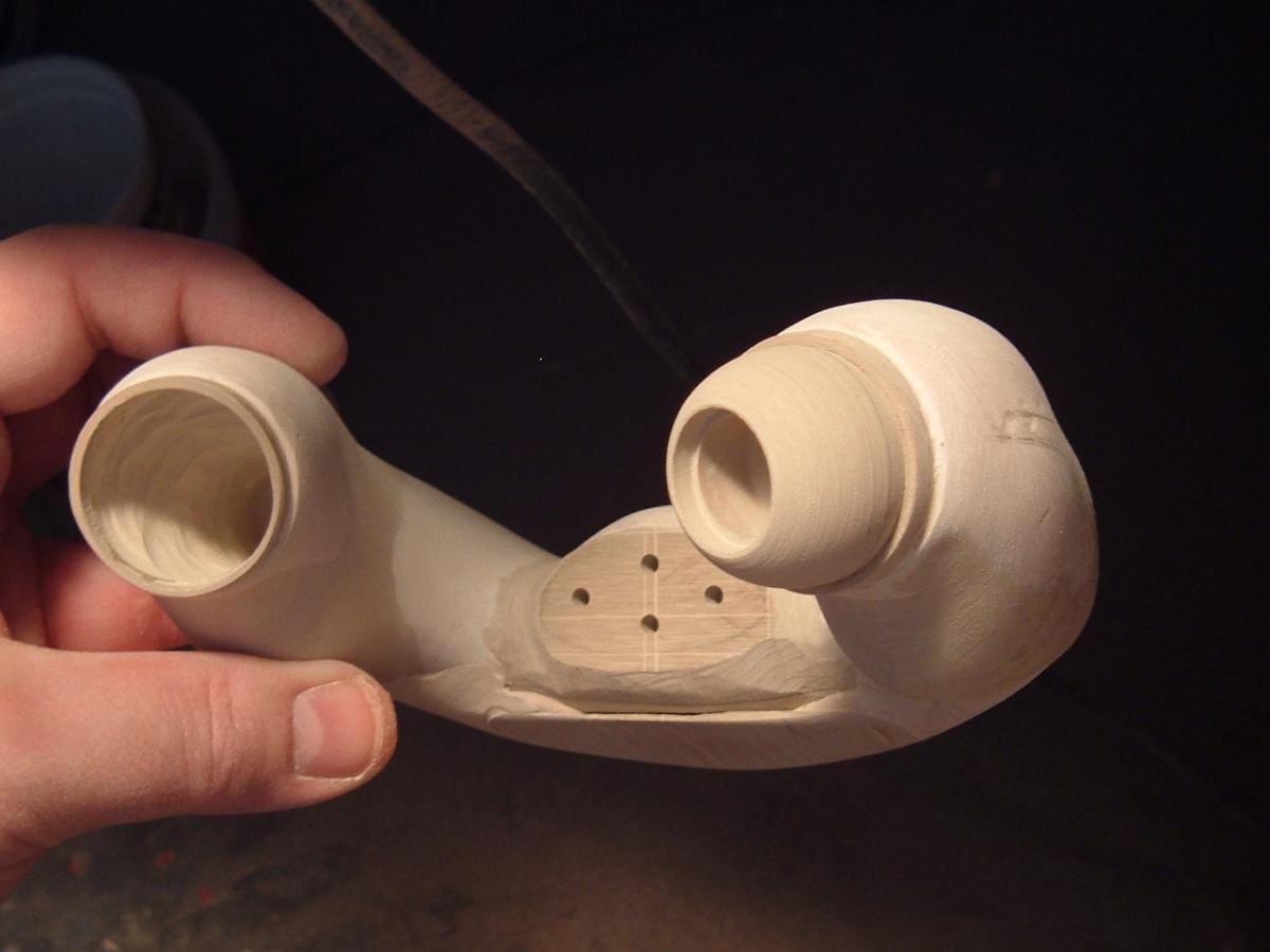

captain america Posted March 26, 2014 Author Posted March 26, 2014 Captain's log: March 26. Wednesday (also BBQ chicken day)As a continuation of my previous update, allow me to jump in right where I left off last time.Pic 4927: the lower leg, which has been milled and shaped on the belt-sander is now being refined with coarse sandpaper.4928 and 4929: the beam gun croissant, now much further into the shaping stage. As I mentioned previously, the beam "eyeballs" will be separate, free-pose, and may be back-lit if desired. The beam nozzle will be molded translucent, just like the eyeball.4931: a close-up of the beam gun eyeball.4932: I tend to jump back and forth a lot, simply because there are so many operations needed, and never in the same sequence. Here I'm turning a block of Ren Shape for what will become the aft thrusters, as well as "Backward Facing Boobies" as seen in the Anime style sheets. I have no idea what they actually do, and I hapen to think that BFB sounds way cooler.4933: the aft thruster nozzle housing being machined. I had to leave some material attached to the bottom side in order for the vise to hold the part securely. This will be chopped-off later.4934: holy balls! At right (starting from the top and proceeding clockwise) the beam gun housing, the elbow, the claw palm, BFB, and the aft thruster. The pieces on the left are what will become the main shell top and bottom.4935: the forearm in an early, rough stage. I'm using the disc sander to get the cross-section to my liking, after which I will proceed to round it out with the Dremel.That's all for now, but next week's update will show a crude mock-up of the standing Gamo. Big AND impressive… Stay tuned!
