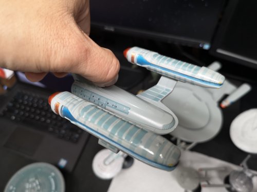

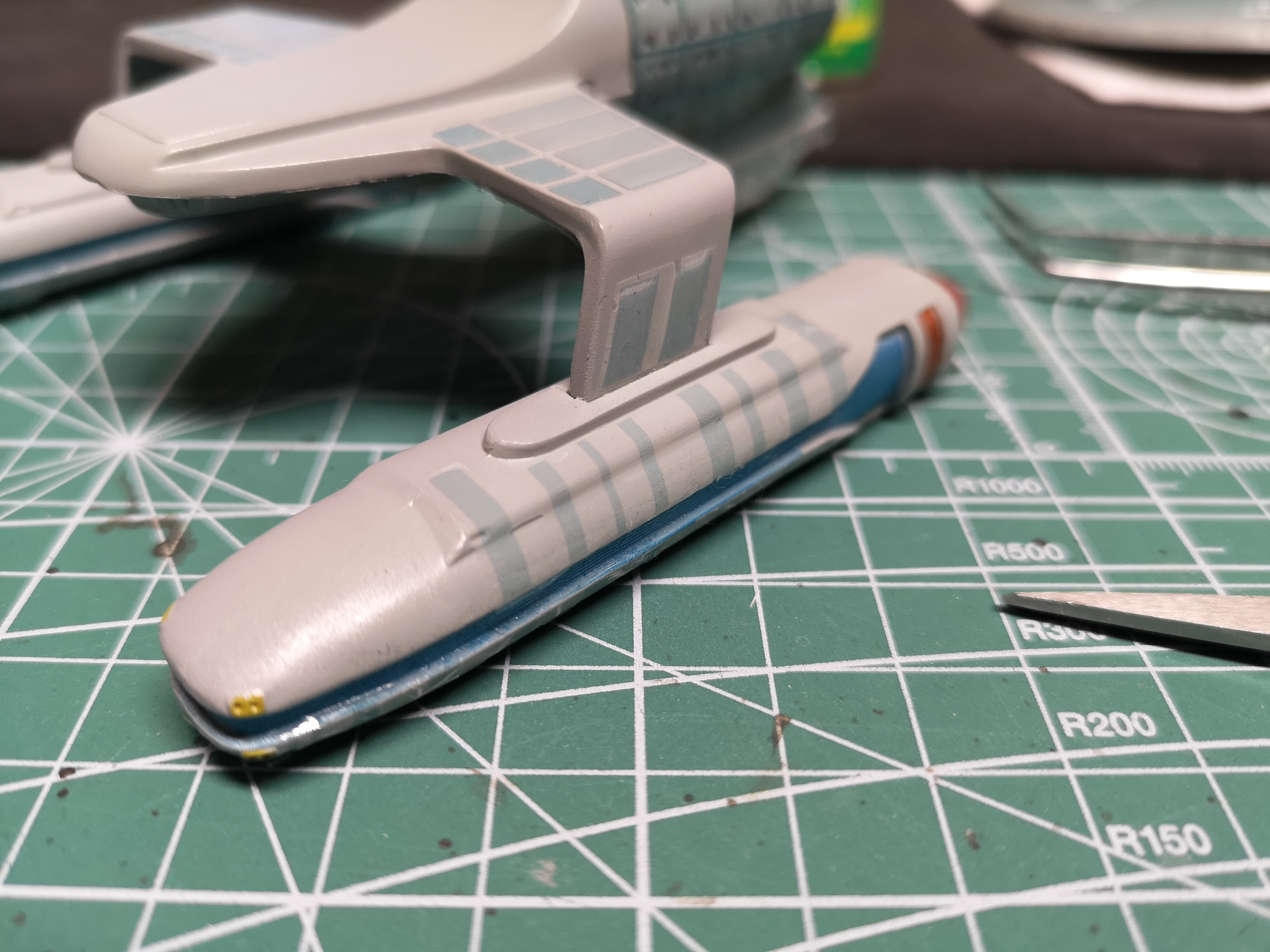

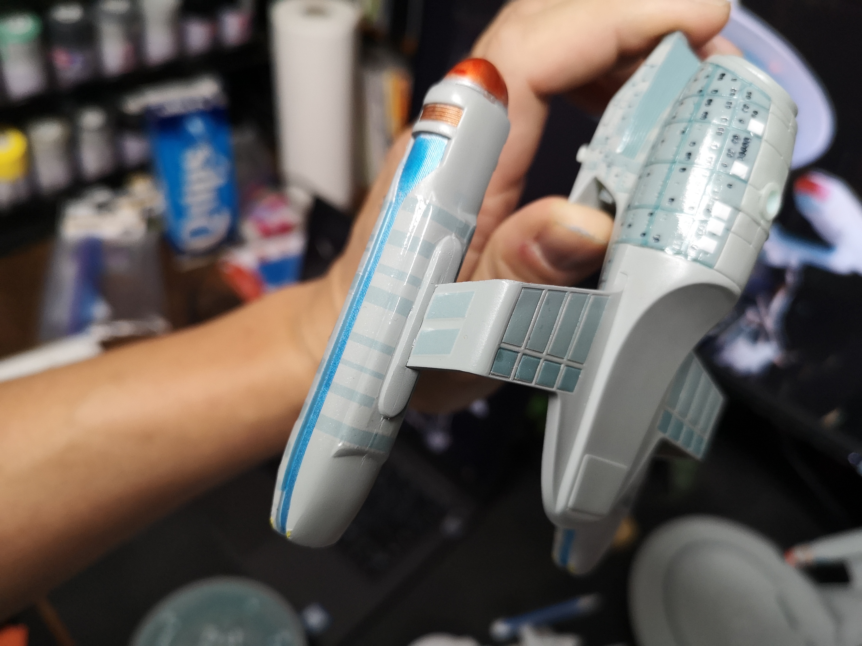

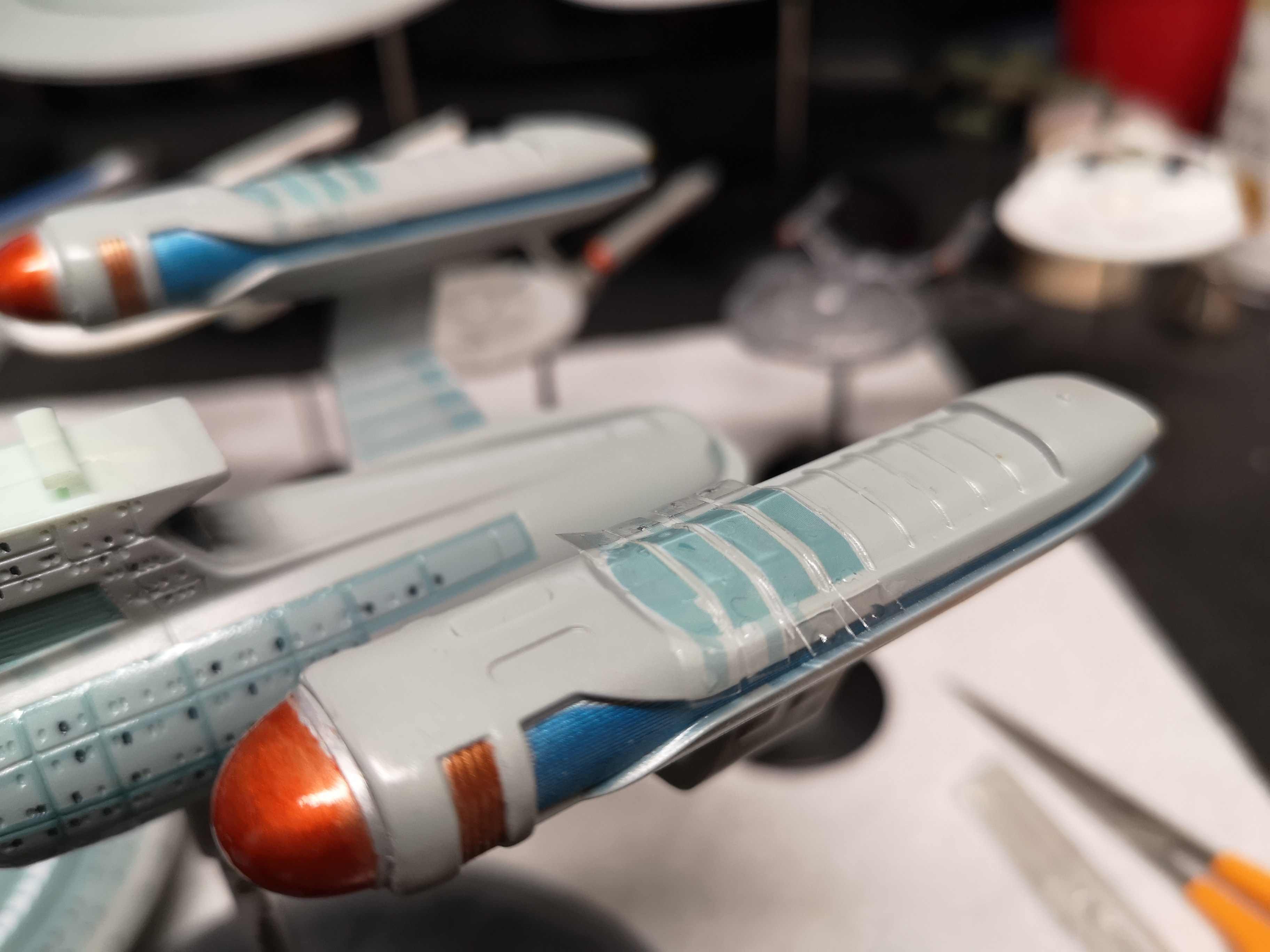

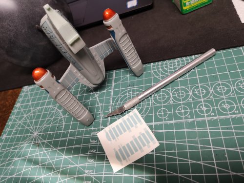

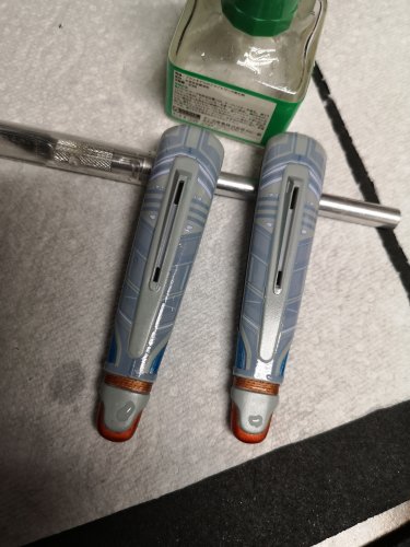

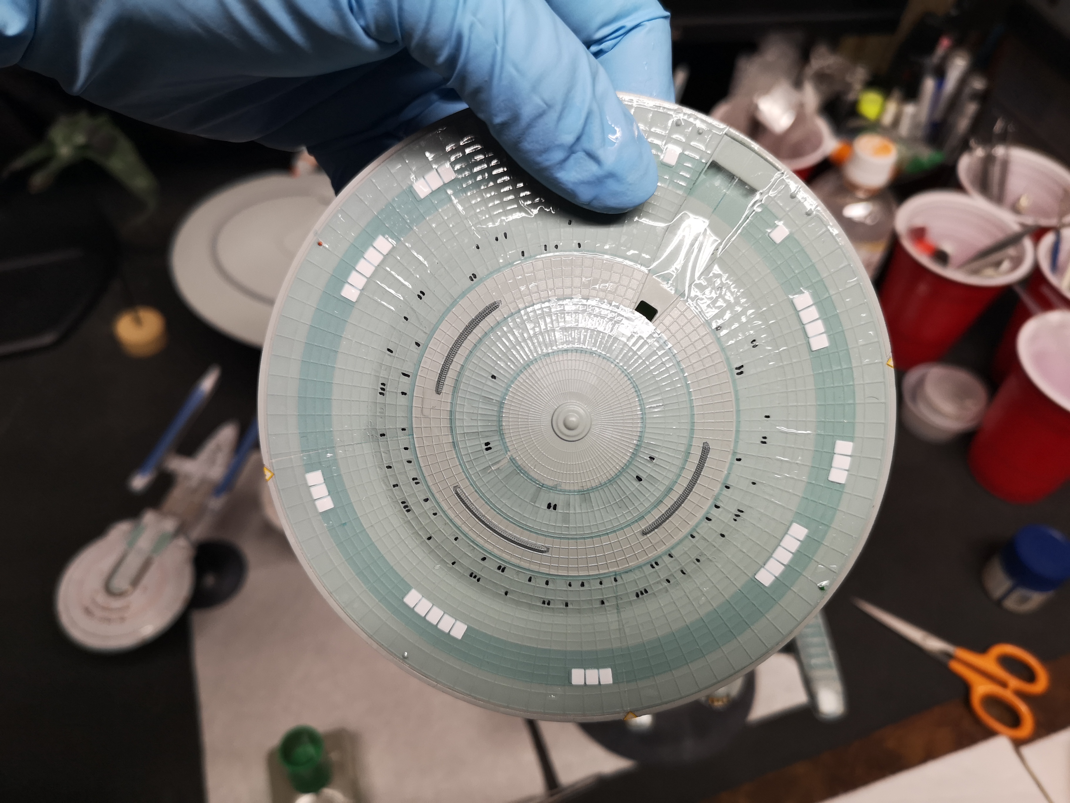

Ent C was a total $hitshow.
I remember the warning about the nacelles so I thought ok, maybe I should cut them into pieces.
Nope, this didn't work.
The upper decals were completely massacred.
Go figure that the bottoms went on with less effort and less grief.
The saucer bottom went on a bit better than the saucer top as well.
I decided to use surgical gloves and loads of water instead of mucking around with q-tips and squeezing each grid square.  The gloves stayed slick so I was also able to readjust the massive decals (cut into three sections) if I needed to.IMG_20210323_133958.thumb.jpg.a0e90072a1a4ec2391cd618fba050ed9.jpg
I also managed to match up the cut edges a bit better with minimal overlap.IMG_20210323_215656.thumb.jpg.e2b5cc5243a8fc1e49639779877de219.jpg
Into the Ent D next.

Don't beat yourself up about the C engine decals to bad, they suck. We all do our best on them and move on!
You did warn me about the Ent C nacelle decals, lol!
The D is a MUCH more pleasant experience honestly, it's actually fun.  The E isn't terrible, the nacelles are challenging, but nothing like the C.

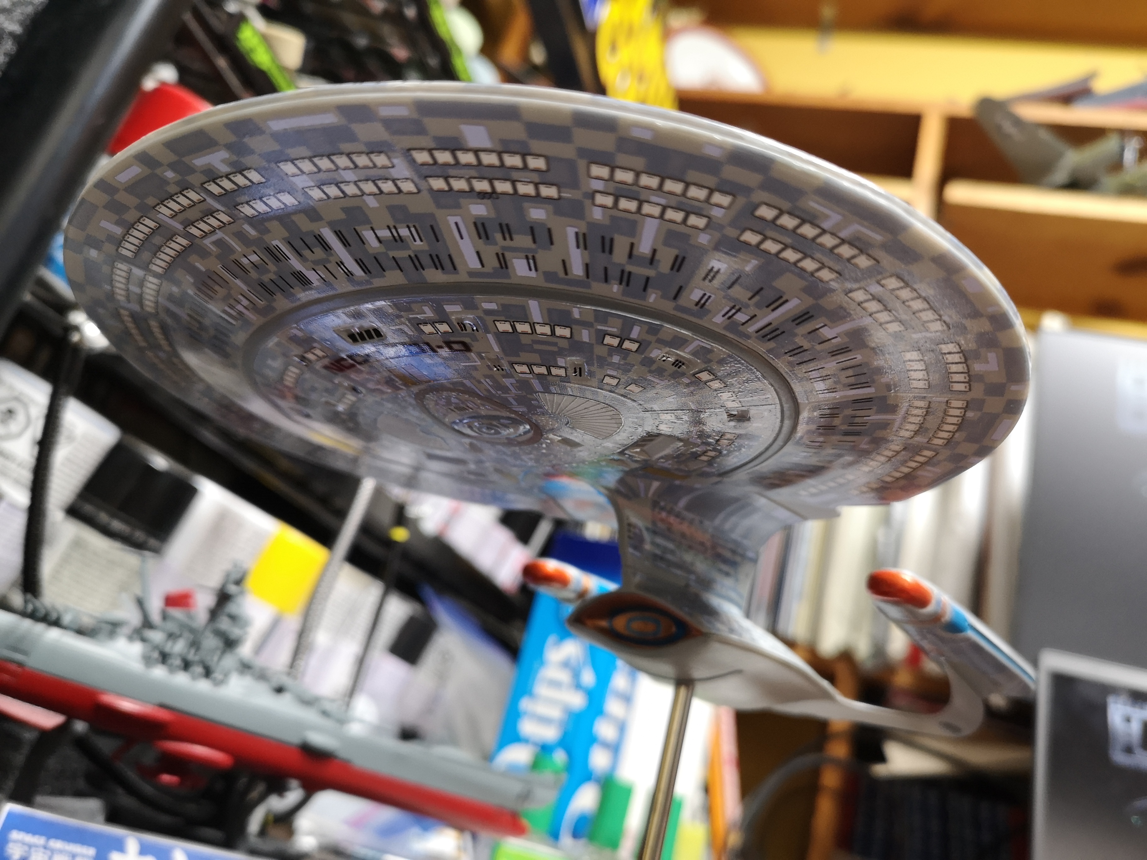

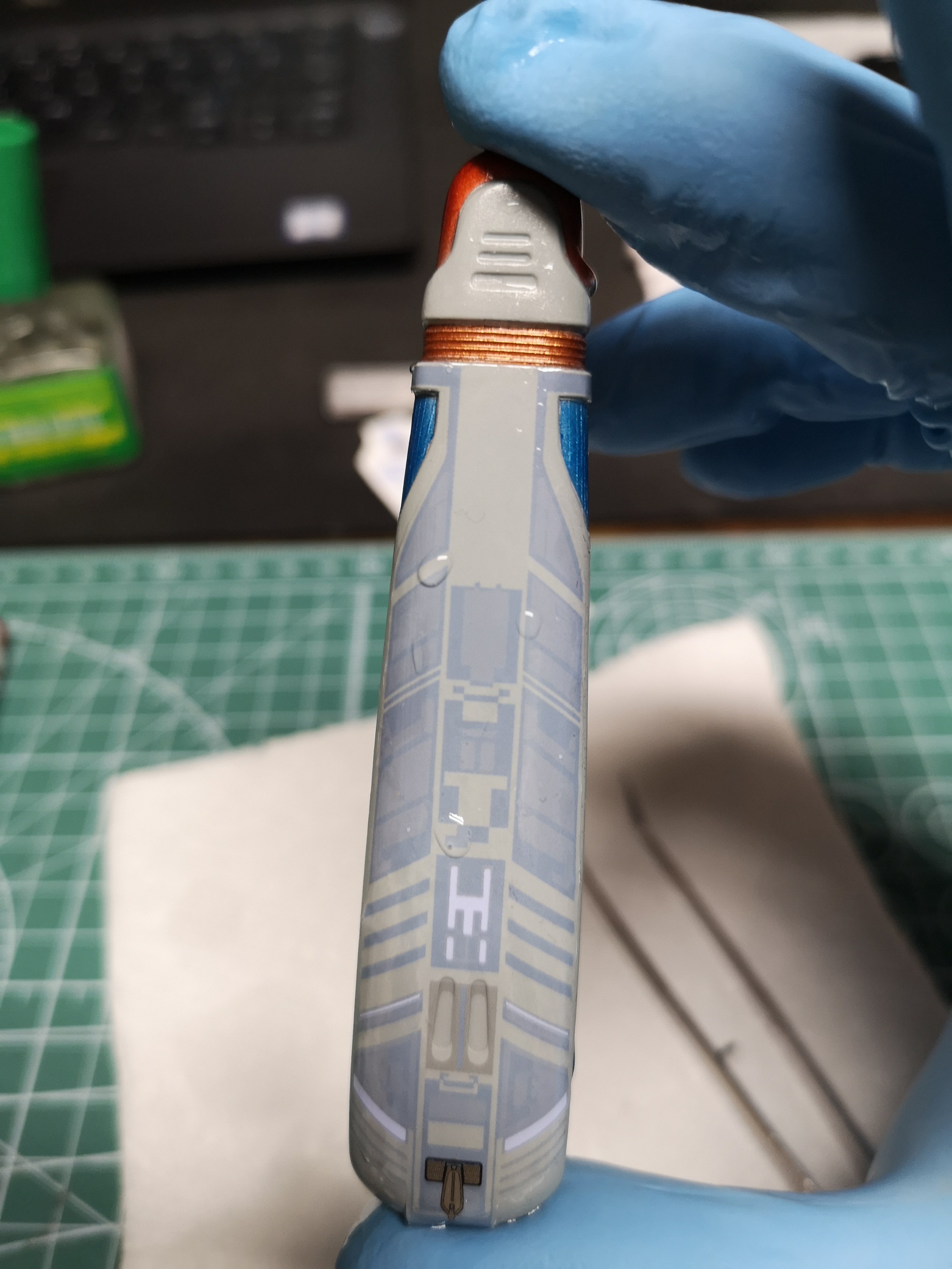

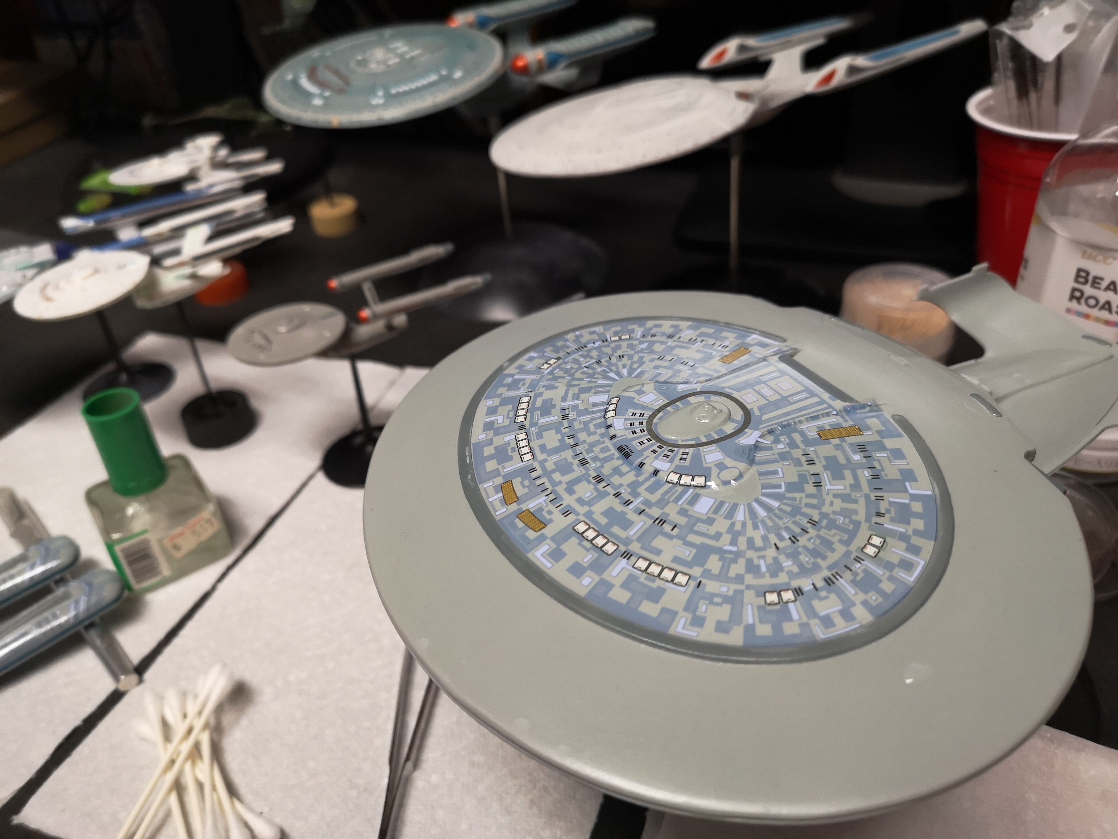

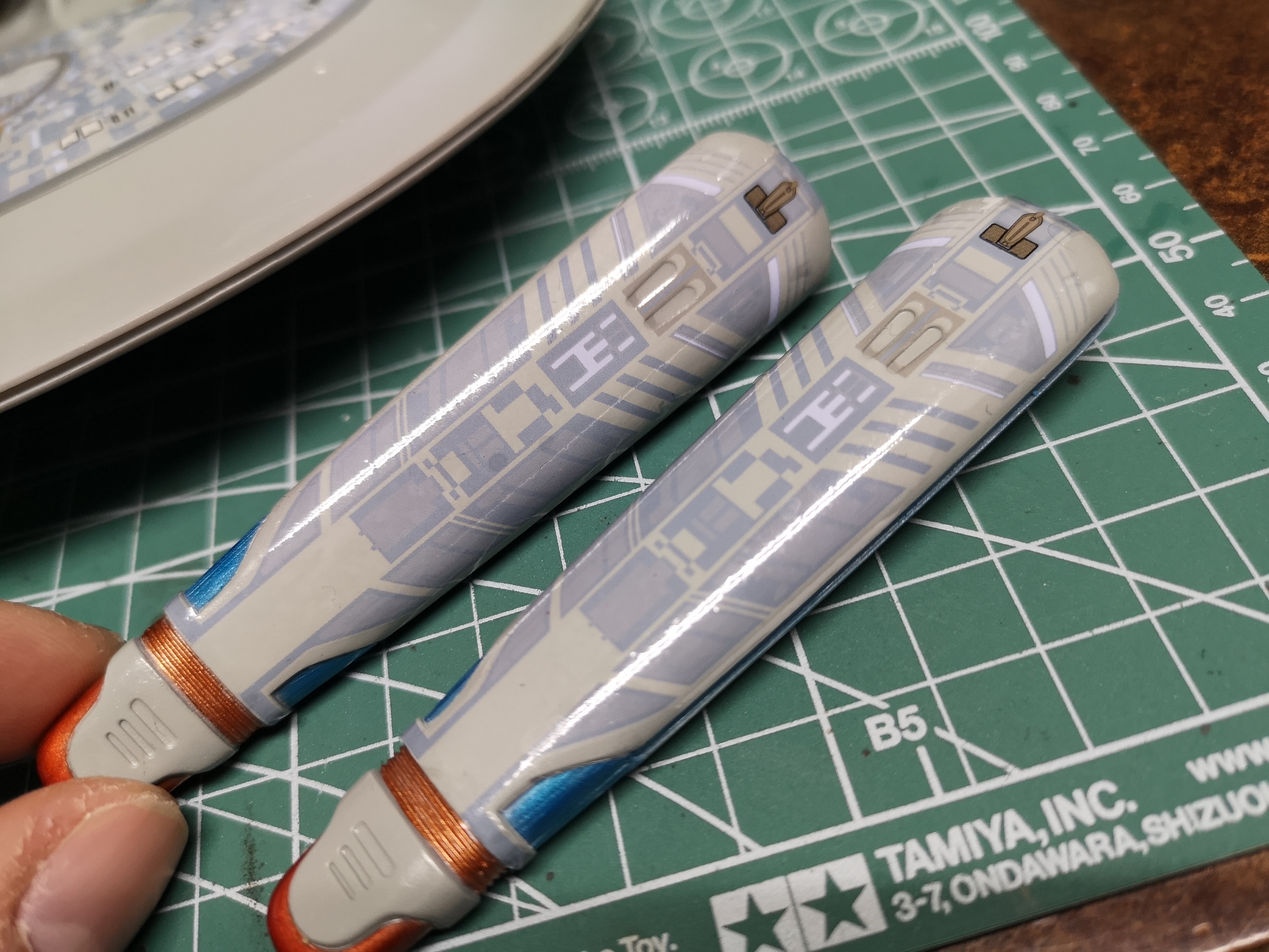

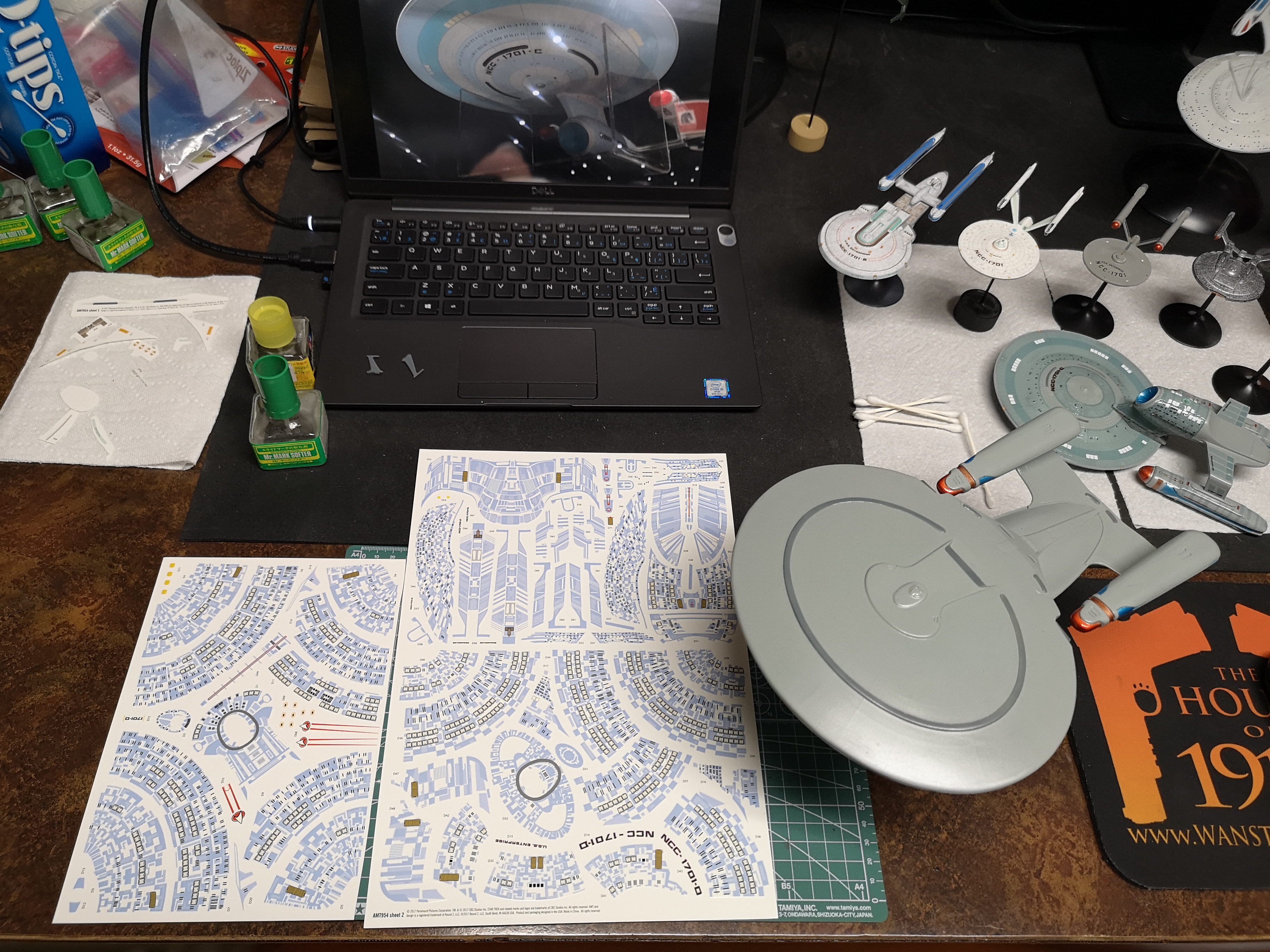

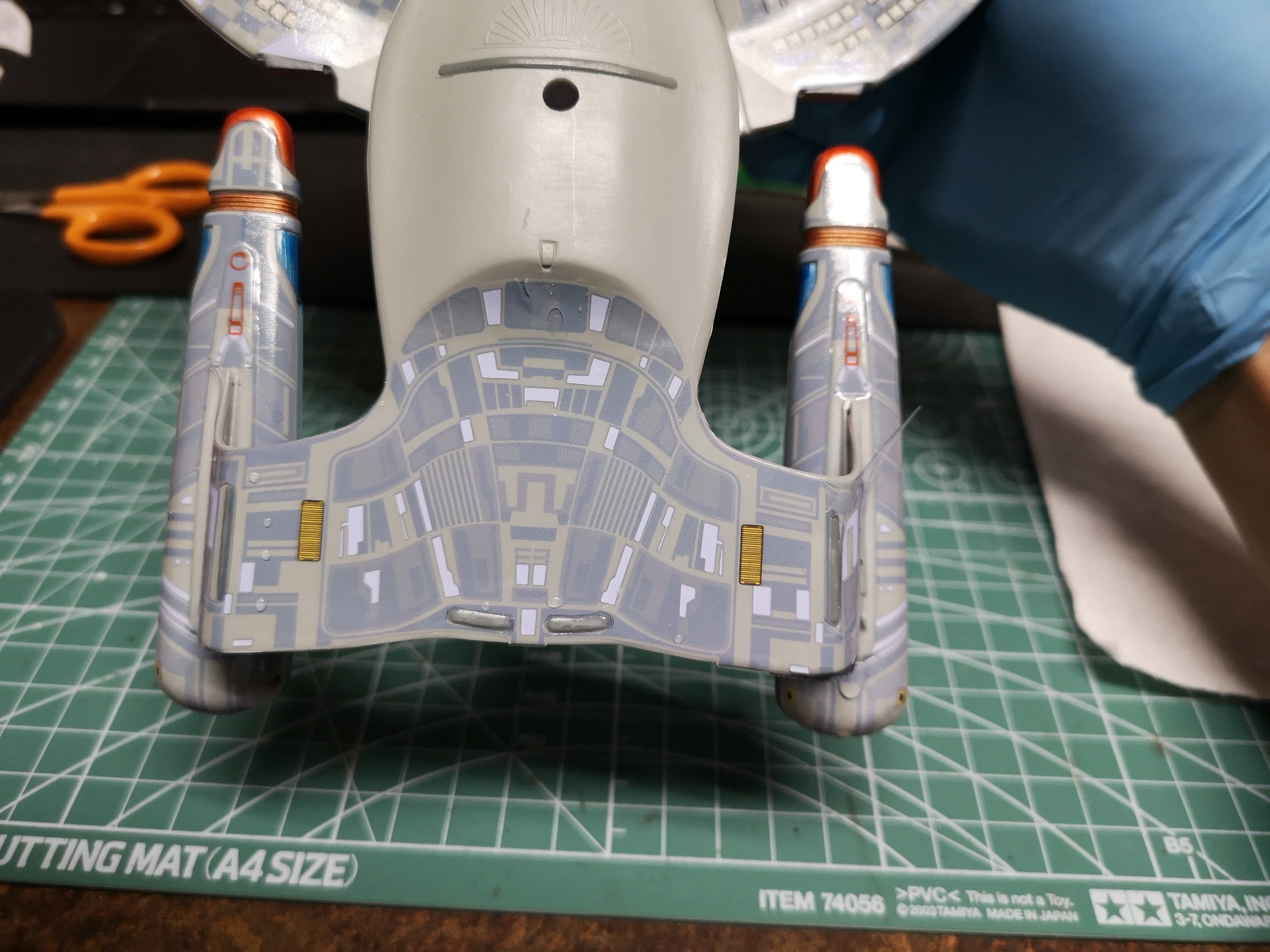

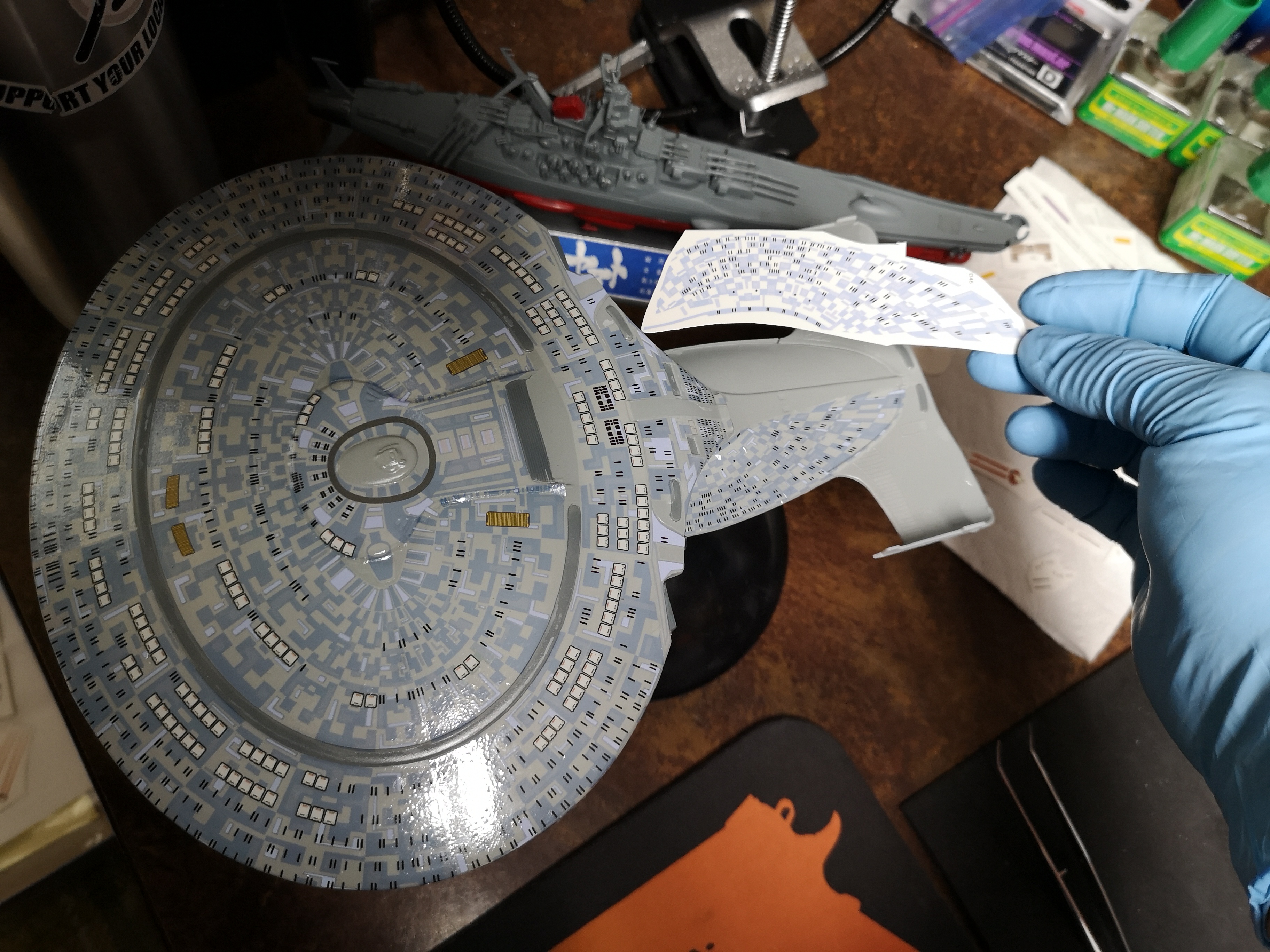

Your advice on making the Ent D a smoothie really paid off.
Looking at the number of decals, I was honestly a bit intimidated.  Even though I sealed my 537 Refit in decals, those were HDA and these were AMT, so I had some serious concerns about ripping and tearing.

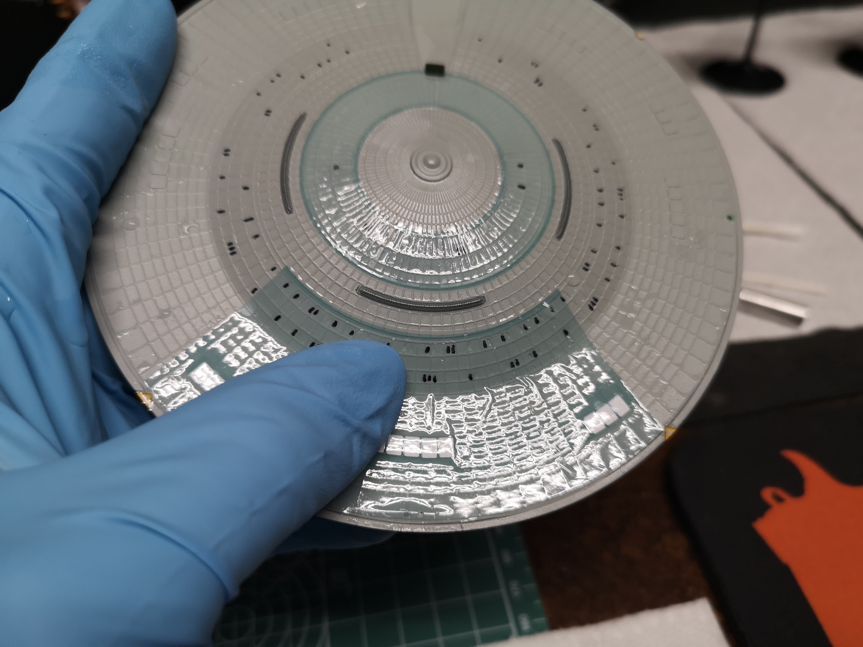

First decal.  The indents didn't line up with the decal, but I'm fine with that.  Look how smooth it is compared to the ribbed mess on the Ent B and C.  Love it!
The saucer bottom when on quick, there was barely any messing around and I didn't have to cut any of th decals into smaller pieces like I did with the Ent B and C.
Nacelle bottoms were fairly straight forward too.
Already on the saucer top.

And the D follows it up with a win! Feels smooth all the way from over here!

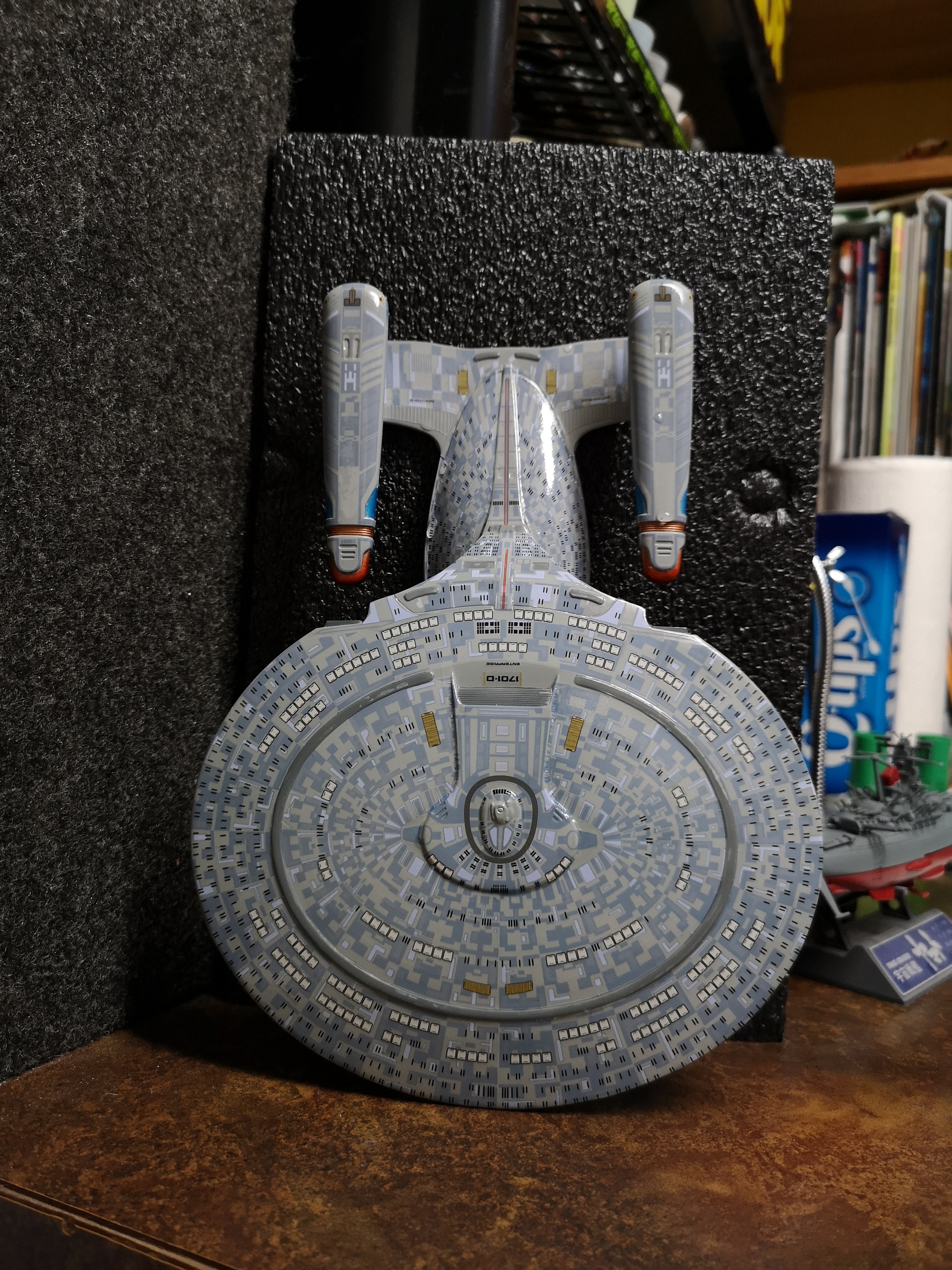

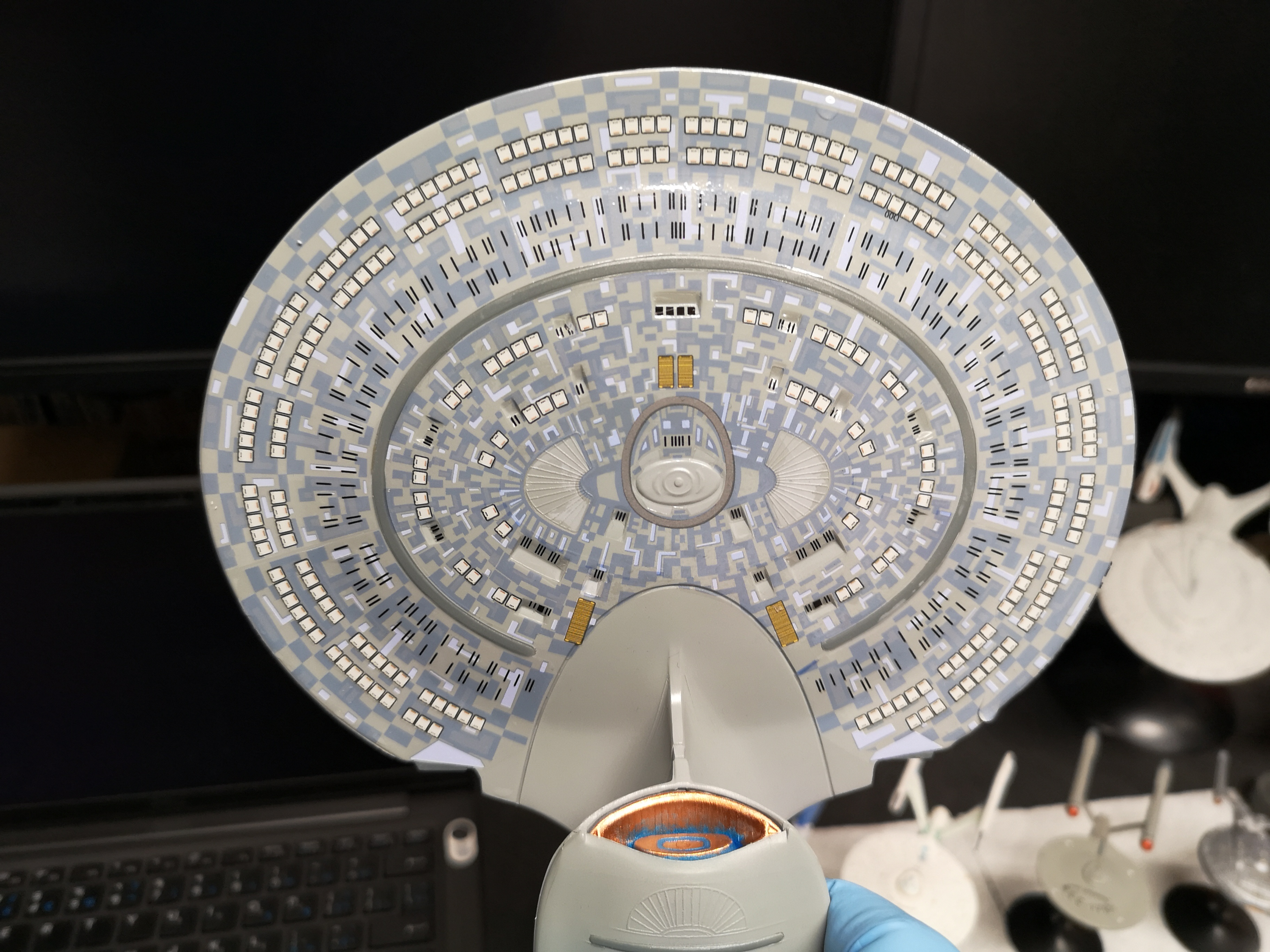

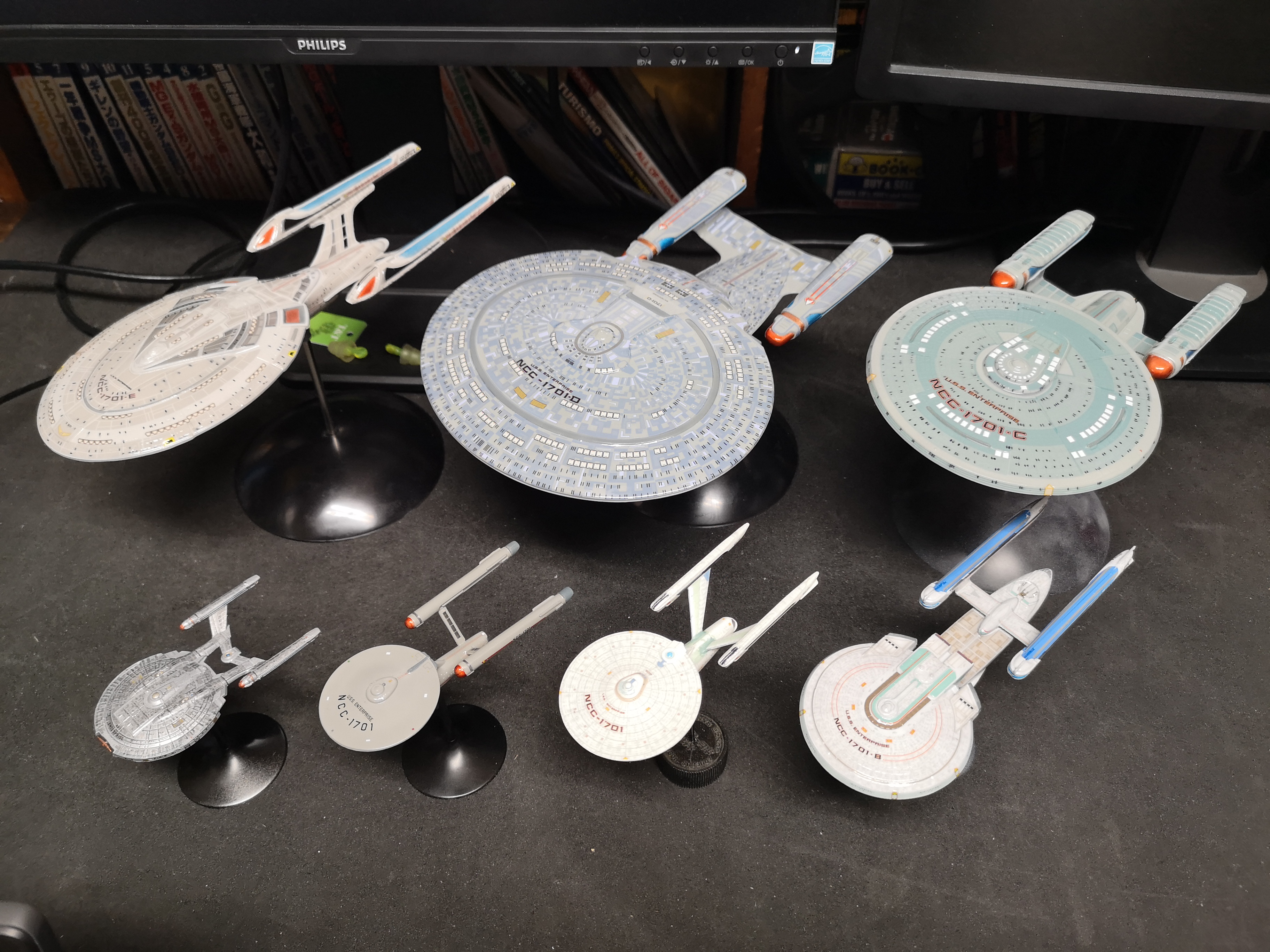

Thanks guys.

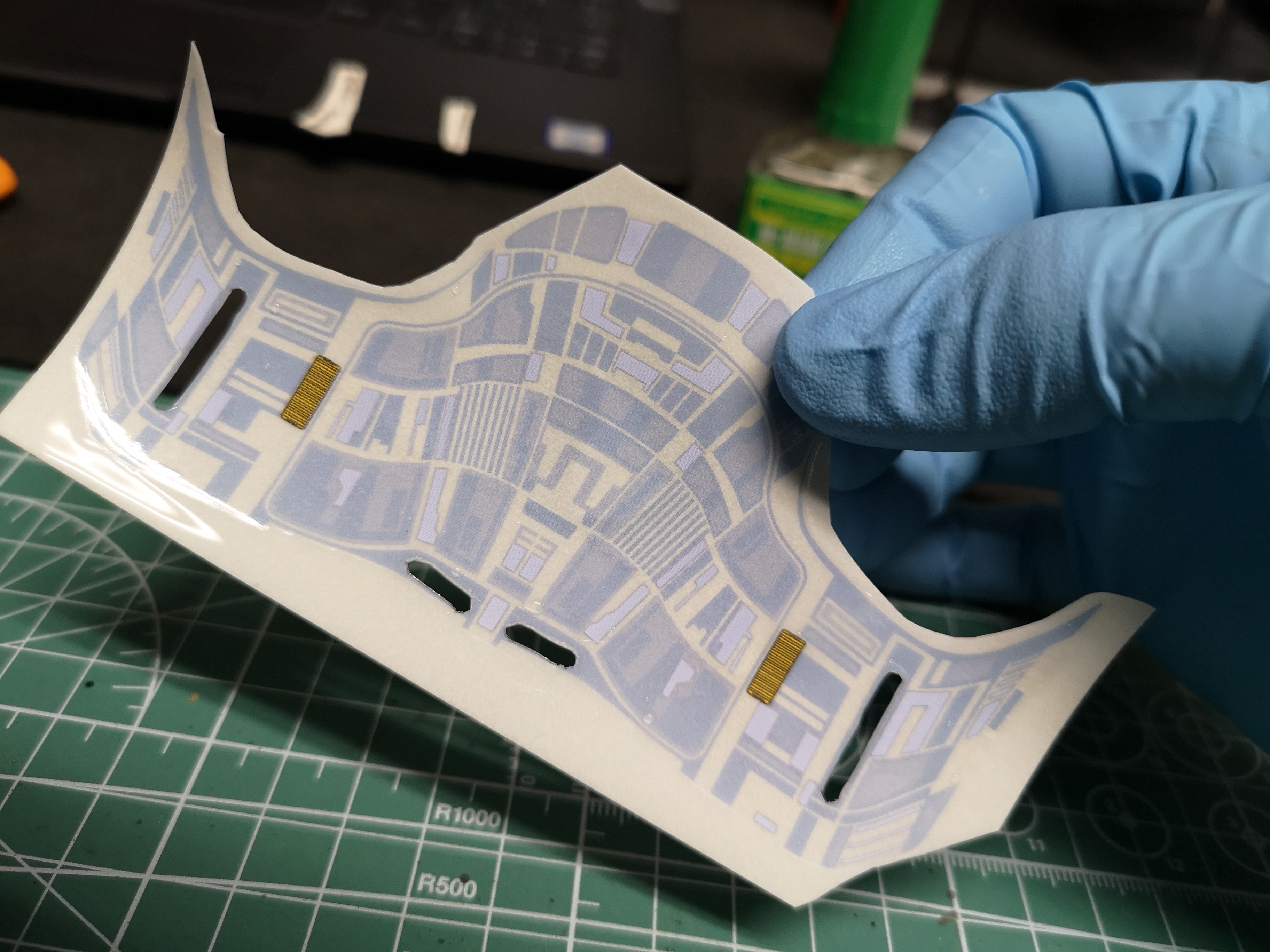

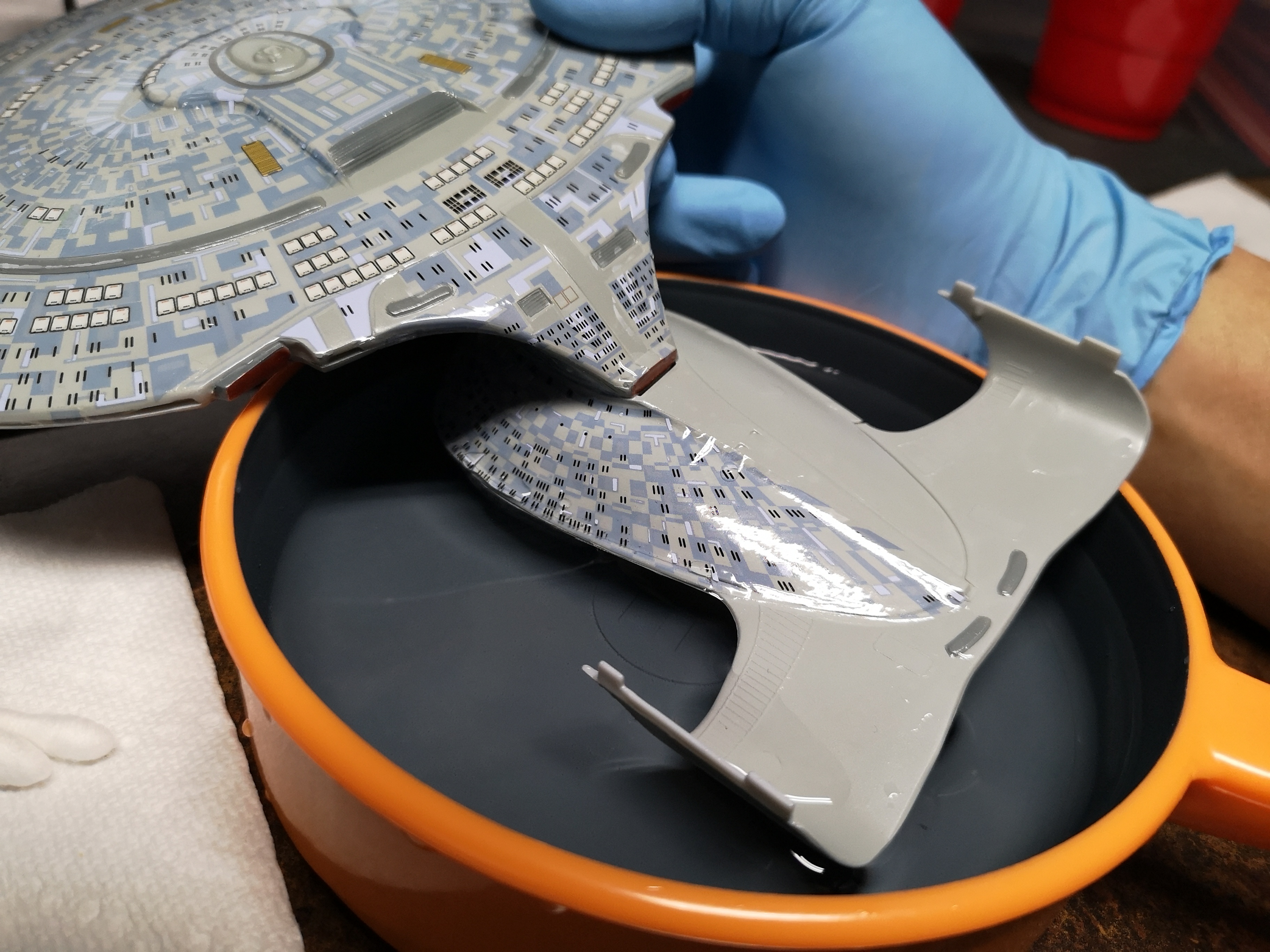

Holy crap the decals for the Ent D are going so well.  I dunno if it's the surgical gloves or what, but hardly any tearing or fragmenting.

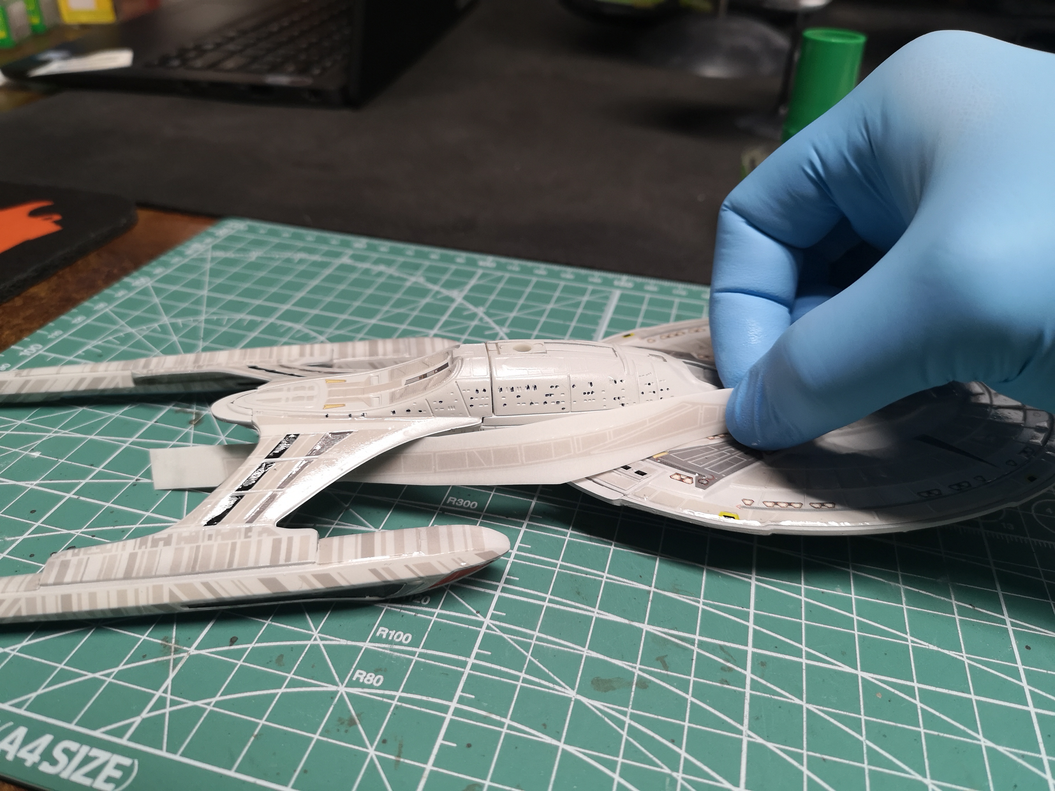

Had a bit of a hard time with the hull decal, especially with the saucer already glued in place.  Had to give the ship a bath just to allow some movement to get this decal in the right place.IMG_20210324_165030.thumb.jpg.e8f86c19ff907a936729afd1b7de7c77.jpg
When I saw Model Chili slide this thing on in one piece, I was thinking there was no way I would have such luck.
But on it went.  The clear spots for the phaser arrays aren't really in the right place.  I cut the clear holds out, but it doesn't line up.  I noticed that a few times with this kit, that the decals don't always line up,  but it's fine.
Almost done.
After struggling with the Ent B and Ent C so much, I felt like I deserved an easy build.  And this was it!
One thing to note, the other variable I changed was the water temperature.  It wasn't just warm, it was hot.  Not boiling, but the tap was maxed out for hot.
I did notice the cracking and fragmenting would start as soon as the water went from warm to cold.
I don't know if the two are correlated, but I'm sticking to hot water on any AMT decals from now on.
GREAT job!!! Looks fantastic! Your main deflector came out better than mine! I also wish I had remembered to paint the 3 shuttle bays a darker grey than the base color, but I forgot!  I fully agree with the hot water trick, I keep a little bowl of water on a small warmer I got years ago that keeps my decal water pretty darn hot and I haven't had as many issues doing it that way.

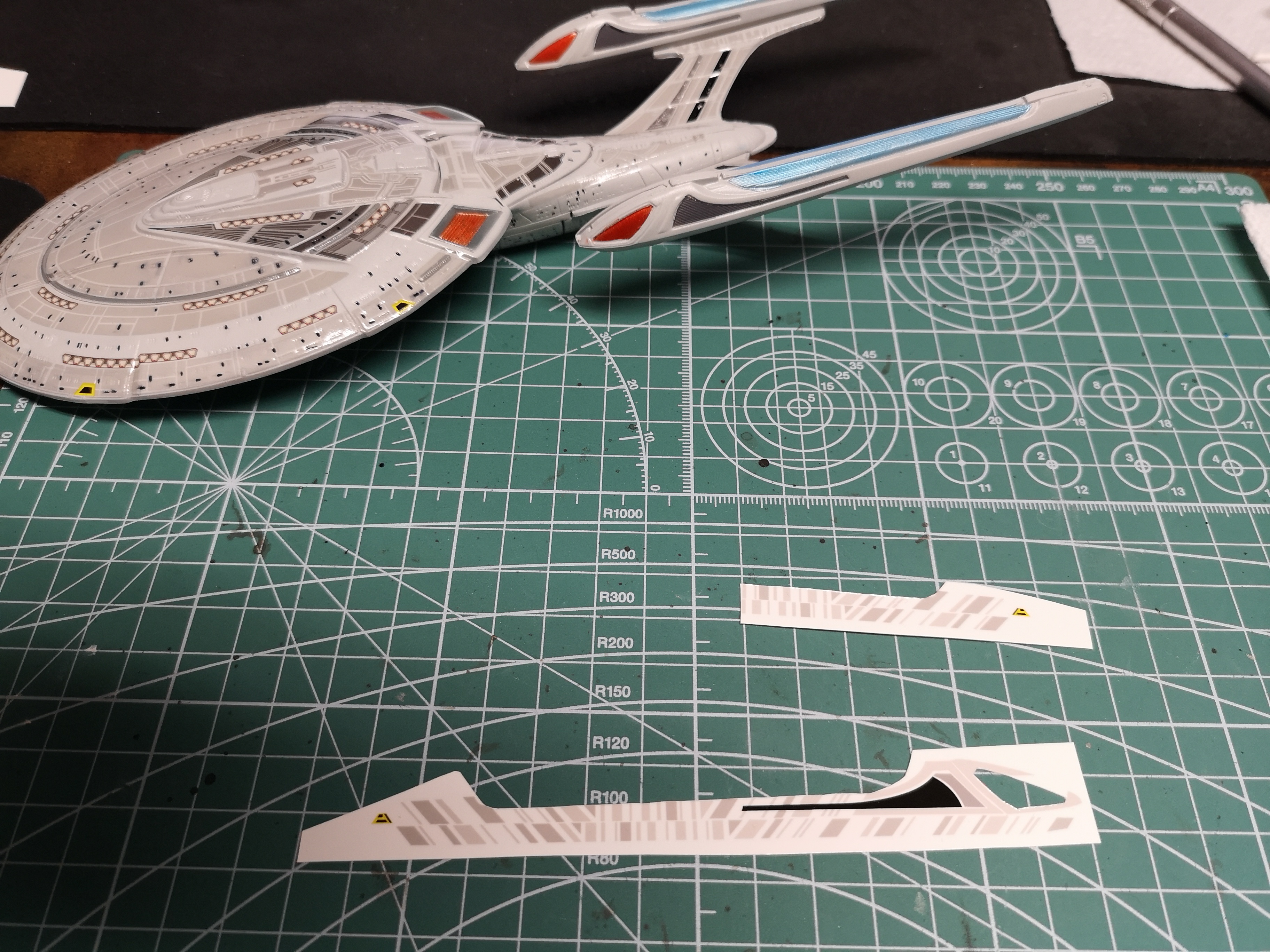

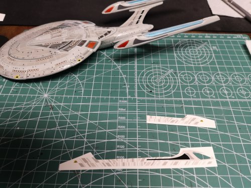

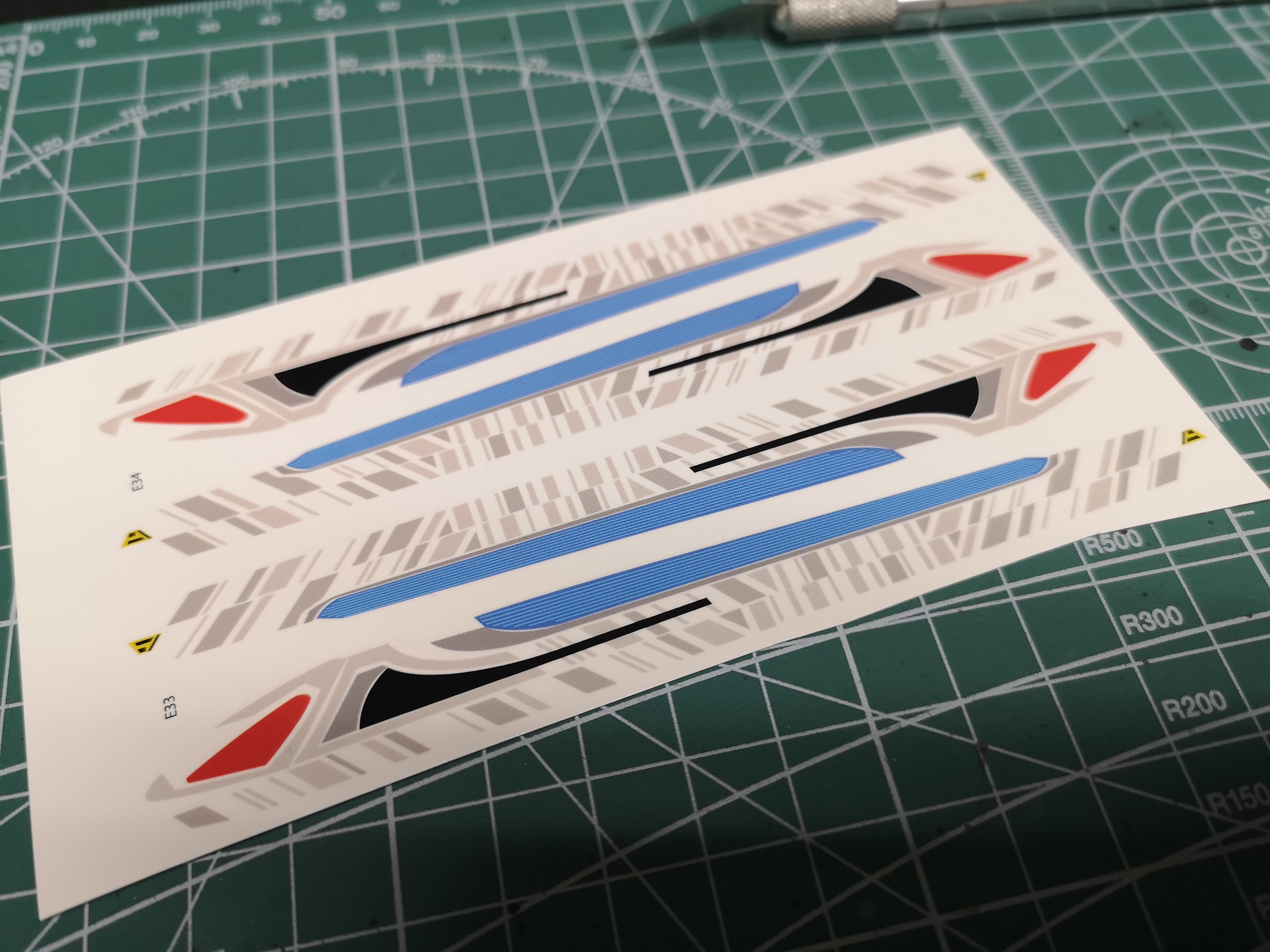

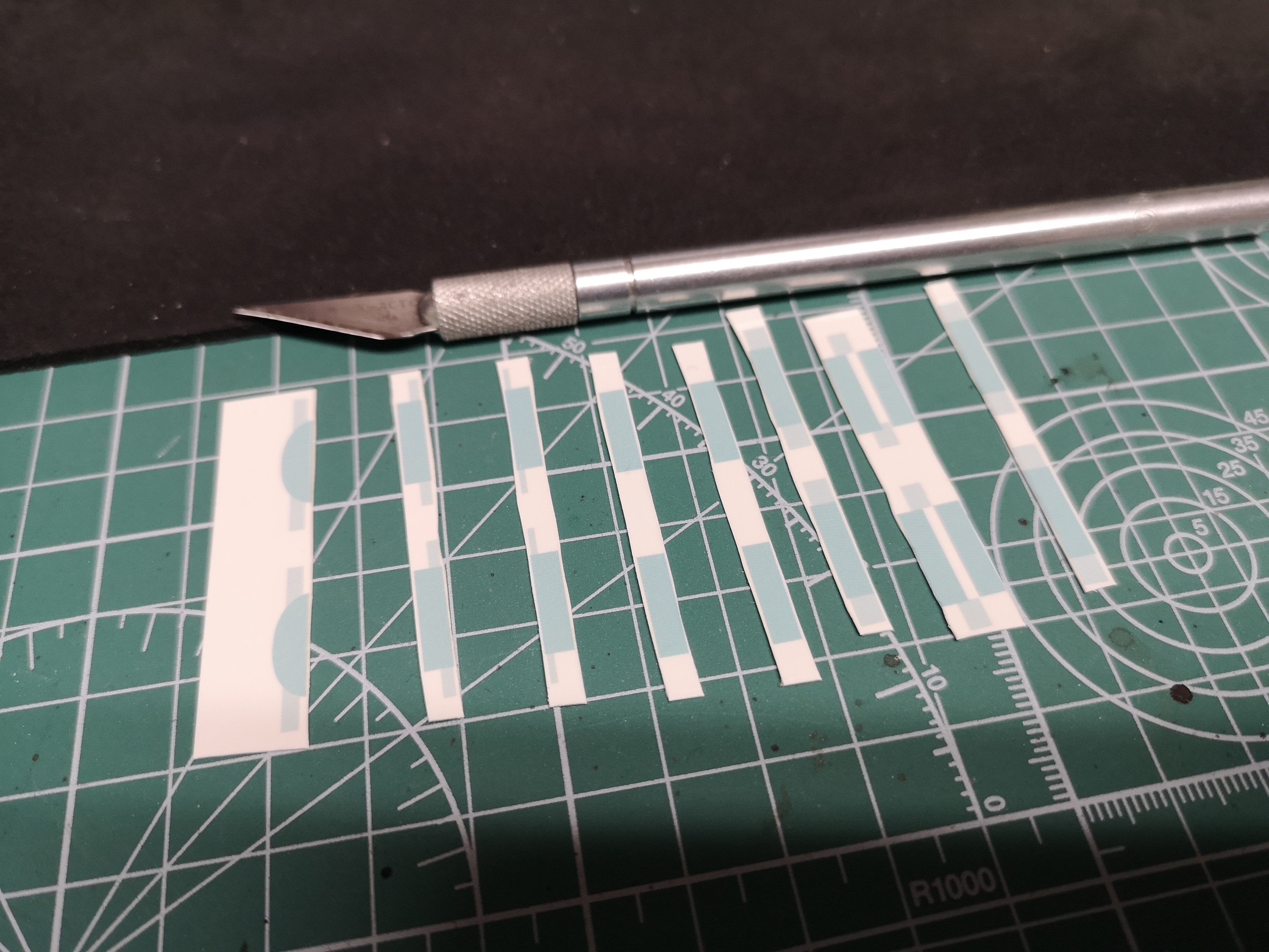

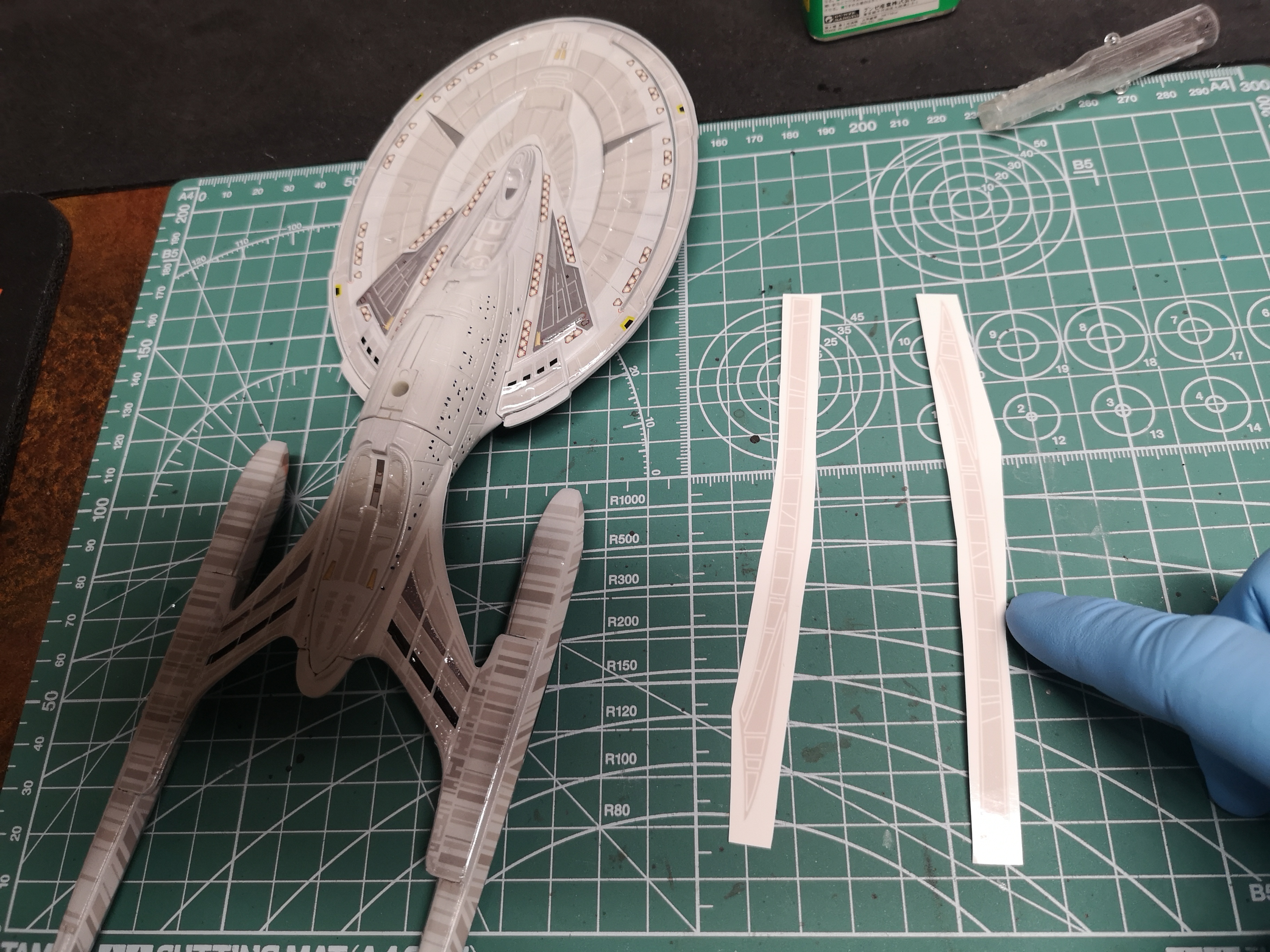

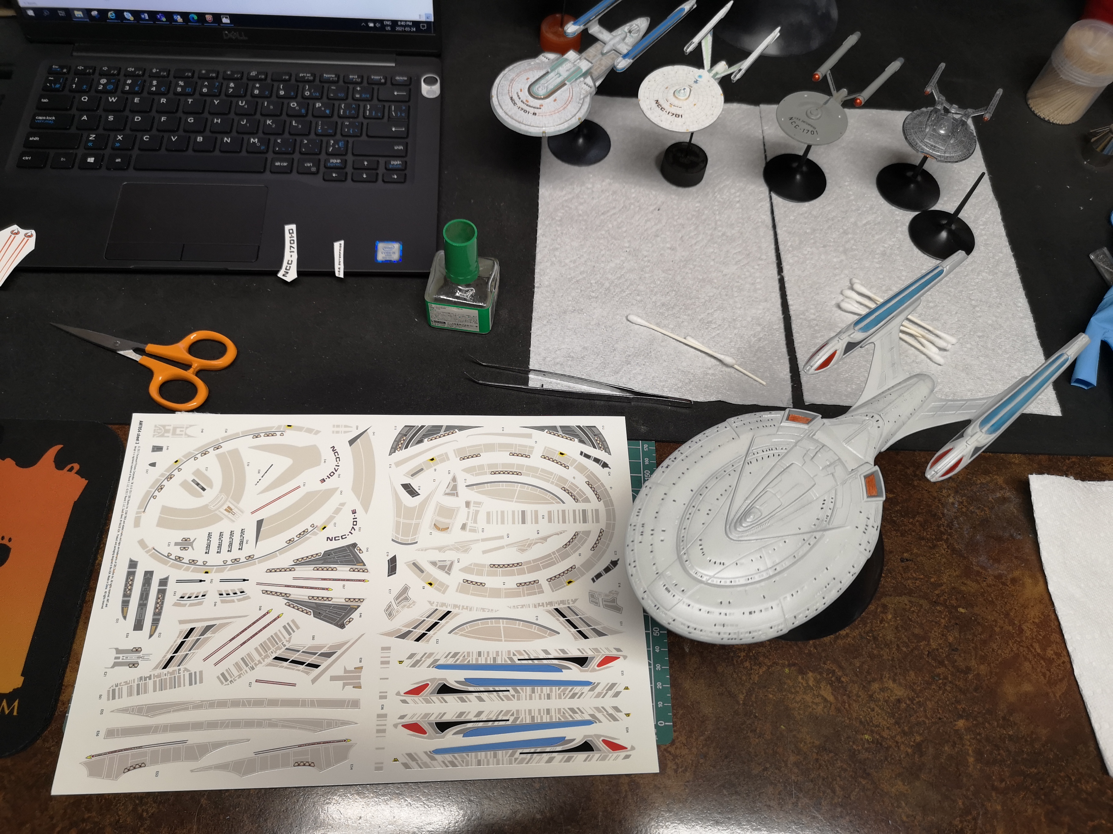

Since I painted the red, blue and black bits, I had to figure out how to cut these out.
There was a lot of contact between the Aztec and black, so I decided to just leave it.
I don't like long skinny decals, lol!

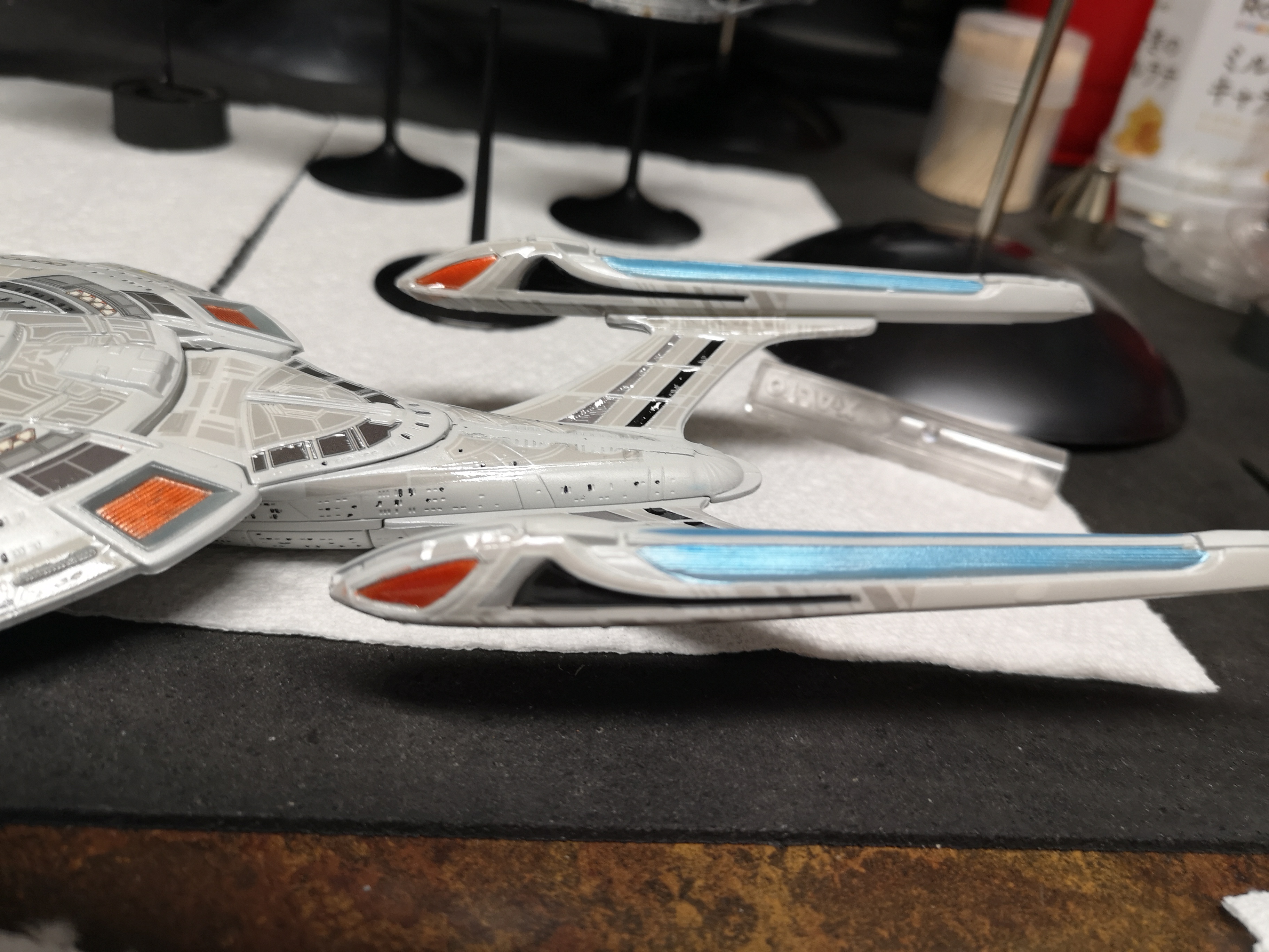

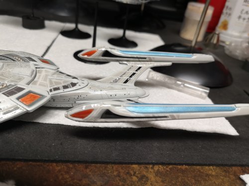

No major mishaps.

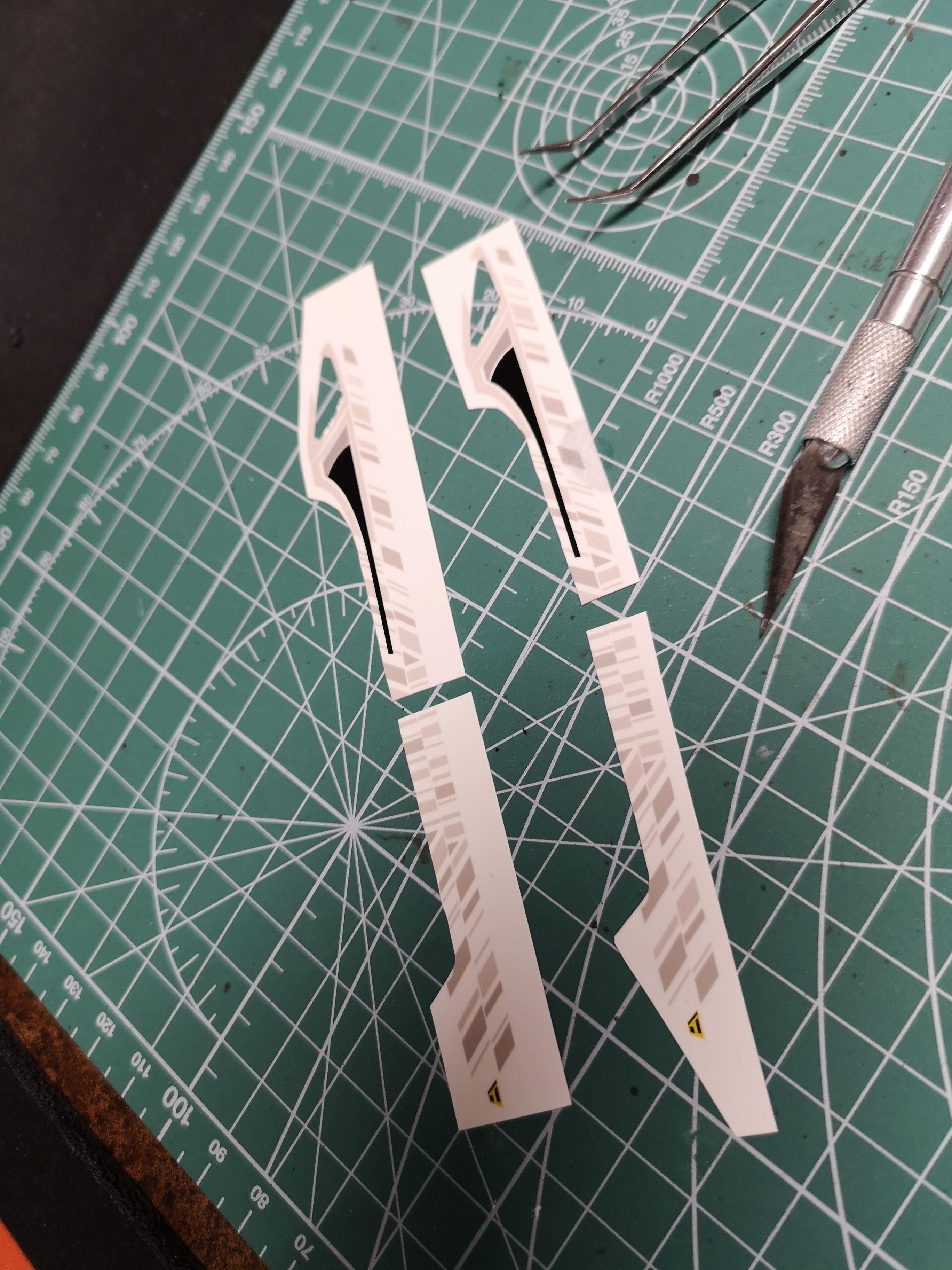

More on ng skinny decals, lol!
This one was a bit awkward though because it twists.
More to follow.
@peter GREAT work on the decals! You got some skills with not only laying down the decals, but also some tenacity to stick with it!

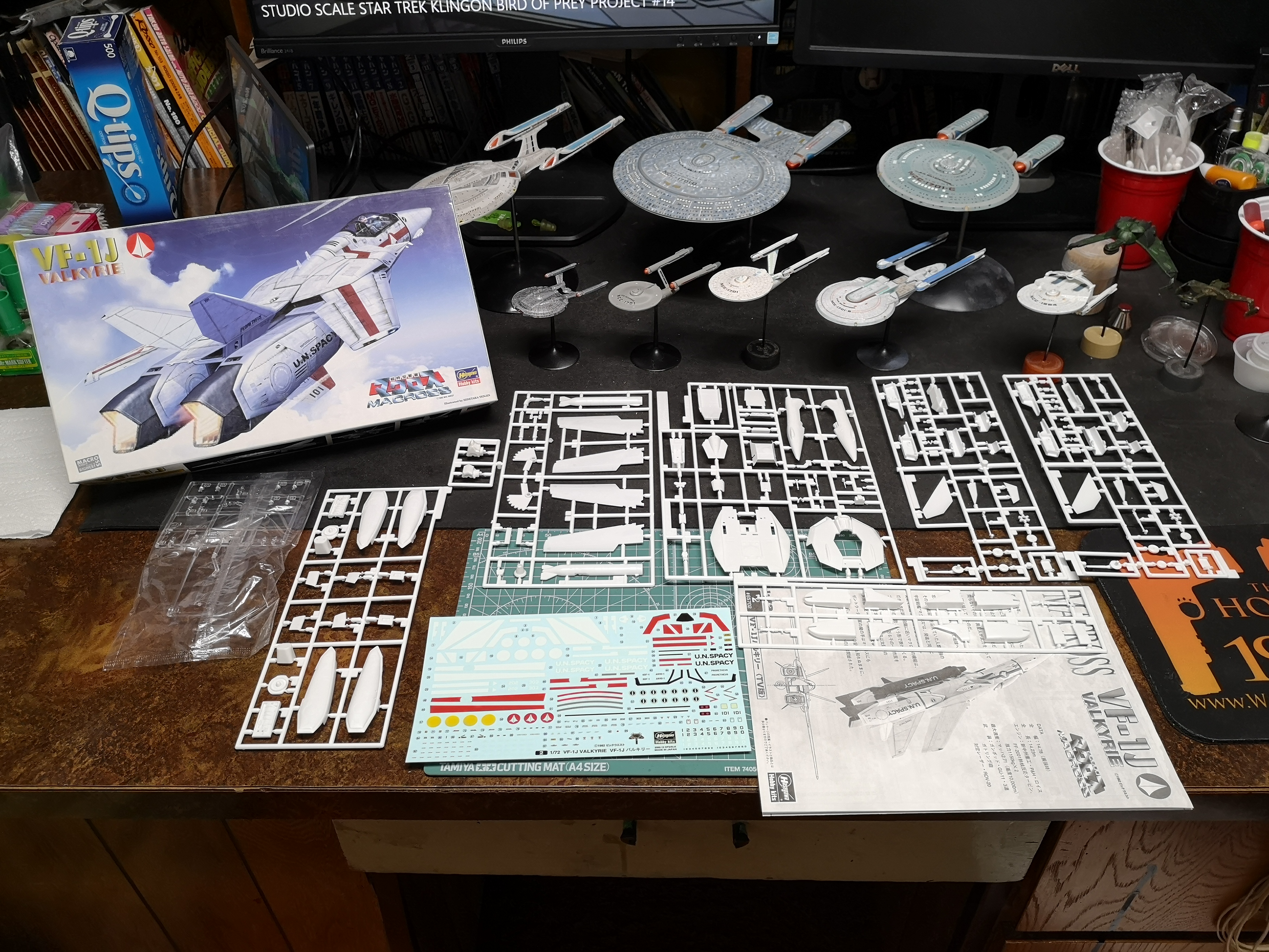

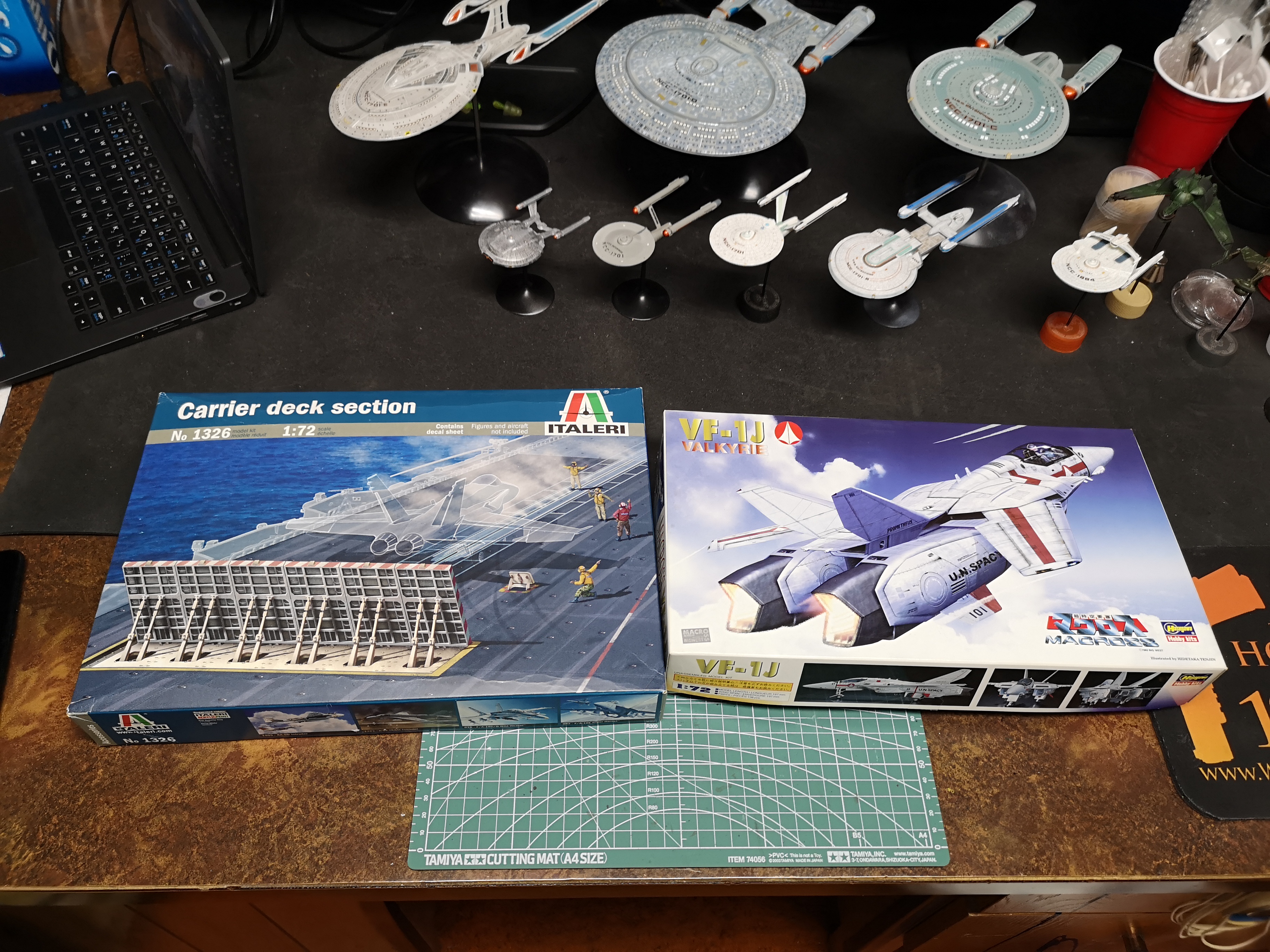

While I'm waiting for the Pledge to cure so I can flat cost the starships, I'm trying to find inspiration for my next build.
I'm thinking this.  The 1J might actually be my very first Hasegawa Valk, bought it from HLJ when these first came out and I never built it, lol!  How long ago was that??!?
This image makes me laugh because it shows the landing gear bay doors closed, and when I did my Skull Squadron with wheels up, I remember what a PITA it was to do them closed.
I have tons of spare TV missiles left over so I can arm the thing at least, but should Hikaru's 1J get a DYRL pilot on the left or should I just throw a lame Imai/Bandai Valk pilot (right) into the cockpit?  Should I even build it as Hikaru's 1J or maybe a non-canon paint scheme.....so many decisions.

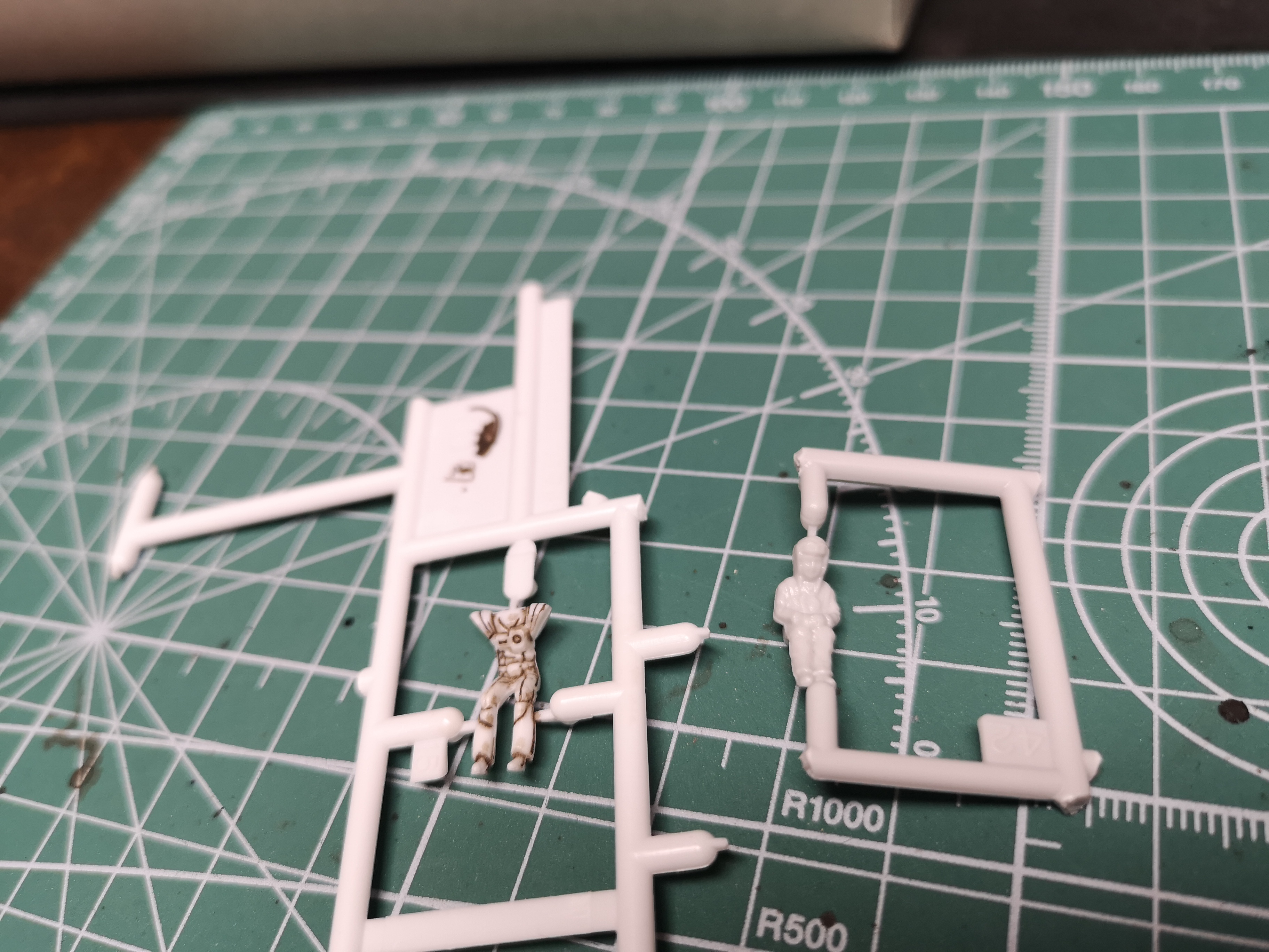

Lol, I almost forgot these things didn't come with pilots.  I wonder what people do for their Elint Seekers and Super Ostriches......
