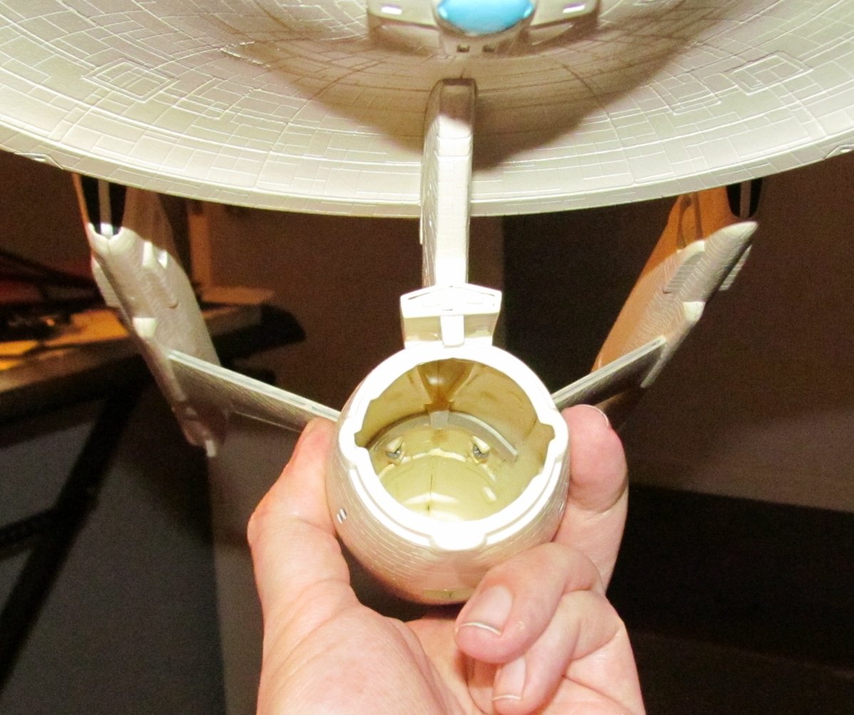

I can now look into the saucer and see where the neck comes into the saucer, but visibility is limited.
I was going to assemble the whole thing then gloss, then Dullcote, but I'm sealing the surface now so when I handle the subassemblies, the decals don't get damaged or come pealing off again.
Also, it will give me time to take a step back and find a resolution before rushing back into it and end up destroying the thing.
I remember that assembly being a pain, but I also wonder which sort of glue you tried.
This is actually one of those cases where I think the good old gunky orange Testors tube did a fair job, because that's all I used when I made mine.

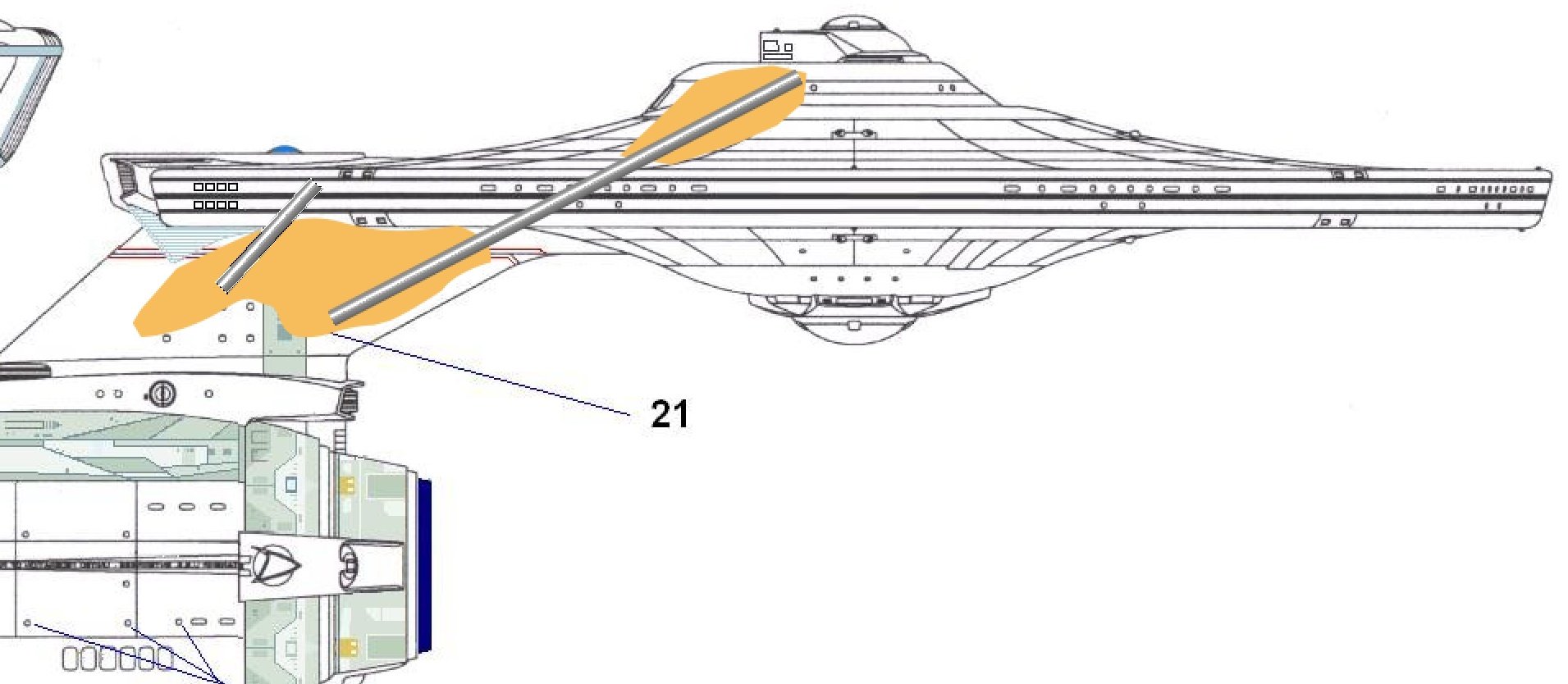

What might actually work as an after-the-fact support though... what if you used some kind of hardening putty in the pylon, and jammed a pair of metal support rods into it and let it harden, then filled the slot on the saucer with the same material, and pressed it down onto the rods?
The pylon looks rigid enough that you could probably open up that slot towards the front, and that would give you some more room to fit supports into it.  If you mounted a support into the leading edge (I'm thinking something like maybe stiff coat-hanger wire), you could potentially bend it so that it slips inside the saucer, and runs along the inside surface supporting it.
In theory, you should have a nice through-line from your new hole, all the way into the neck, if you wanted to run a single support all that way.
In hindsight though, I think you made the right choice gluing the pylon to the lower hull first.  The alternative would mean you have to support the entire saucer when you attached the pylon to the lower hull, and that would make it much more difficult to get a solid connection there, to say nothing of keeping the pylon straight, or managing to keep the gray panels from caving in.

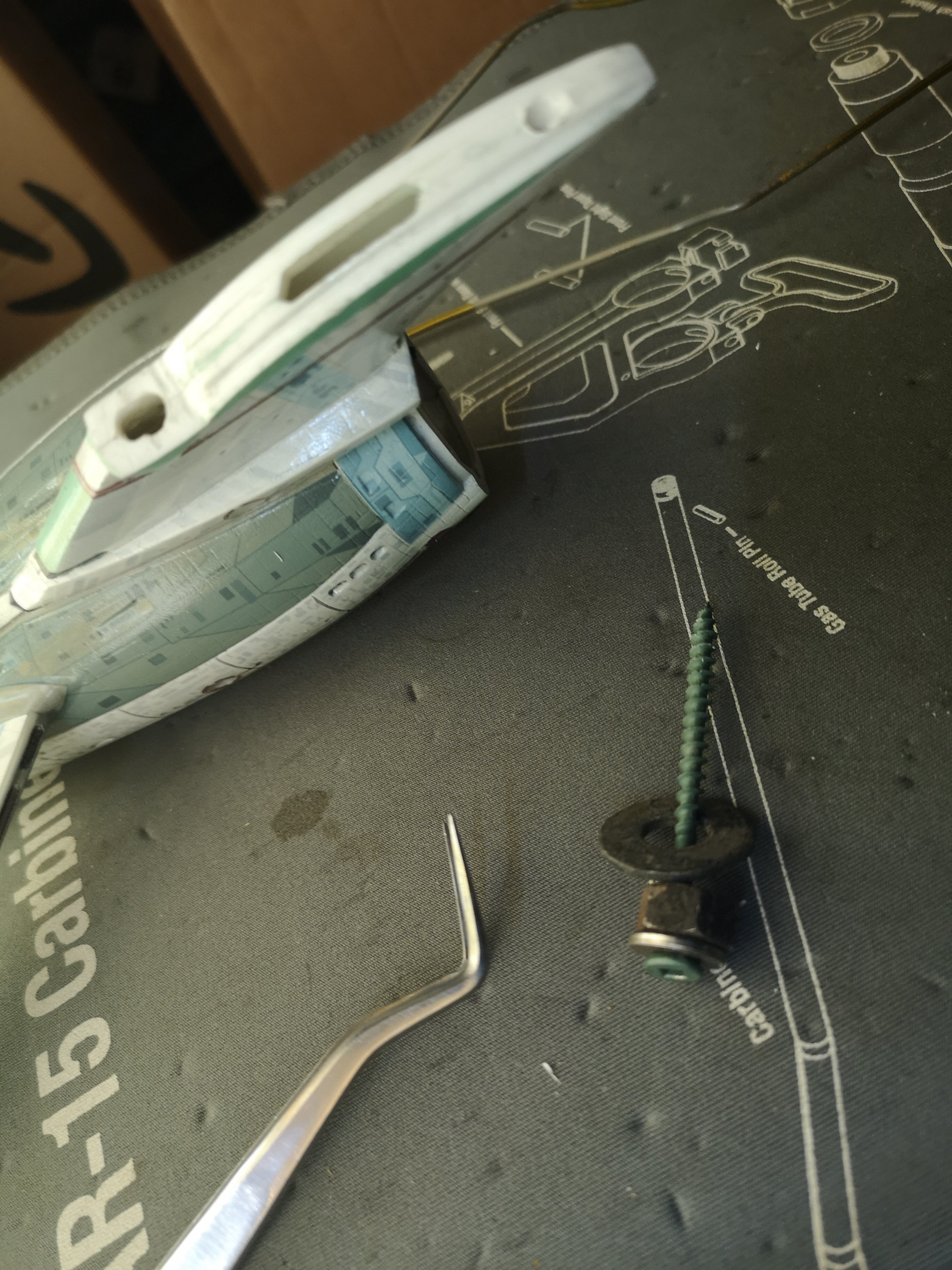

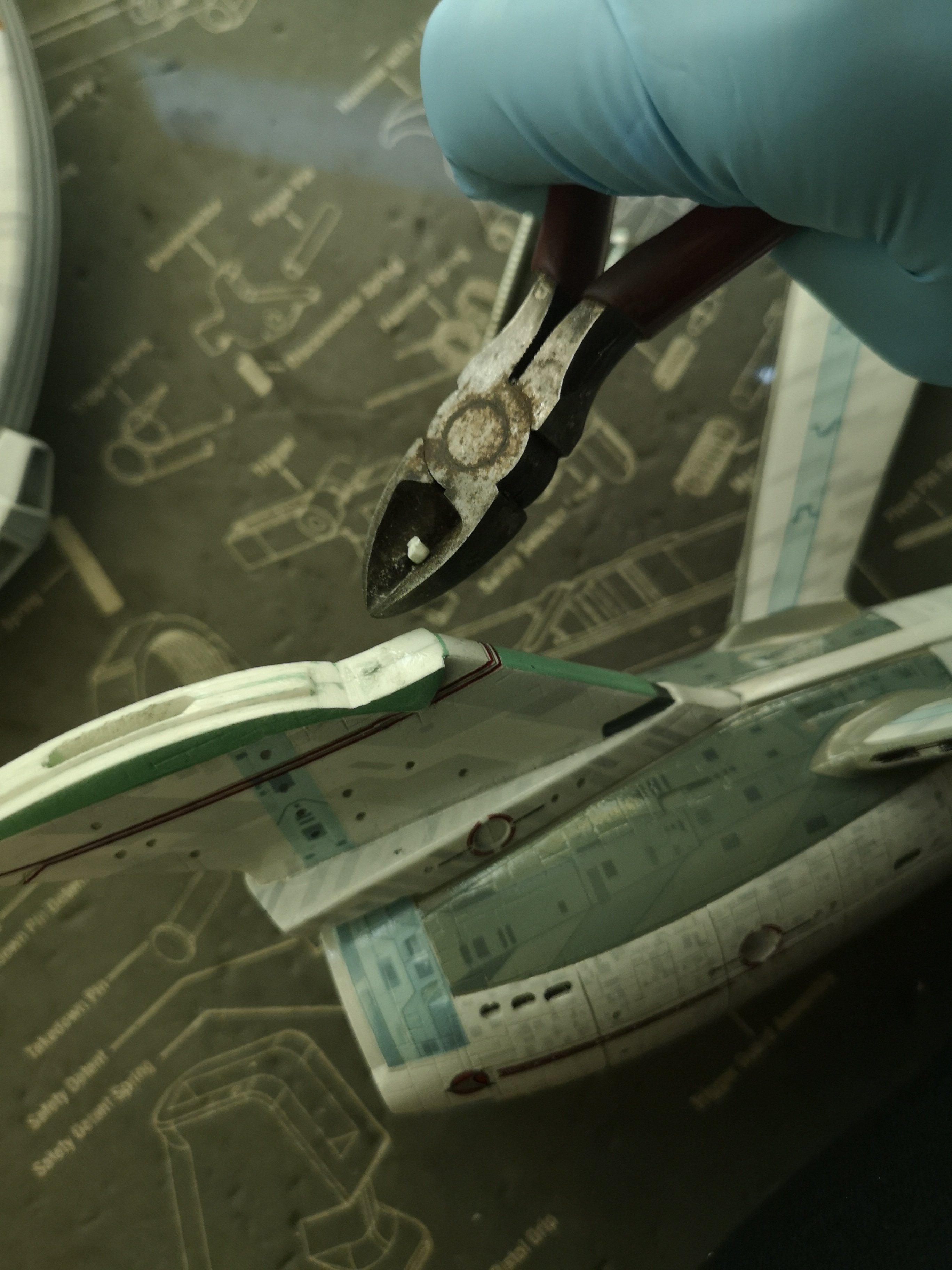

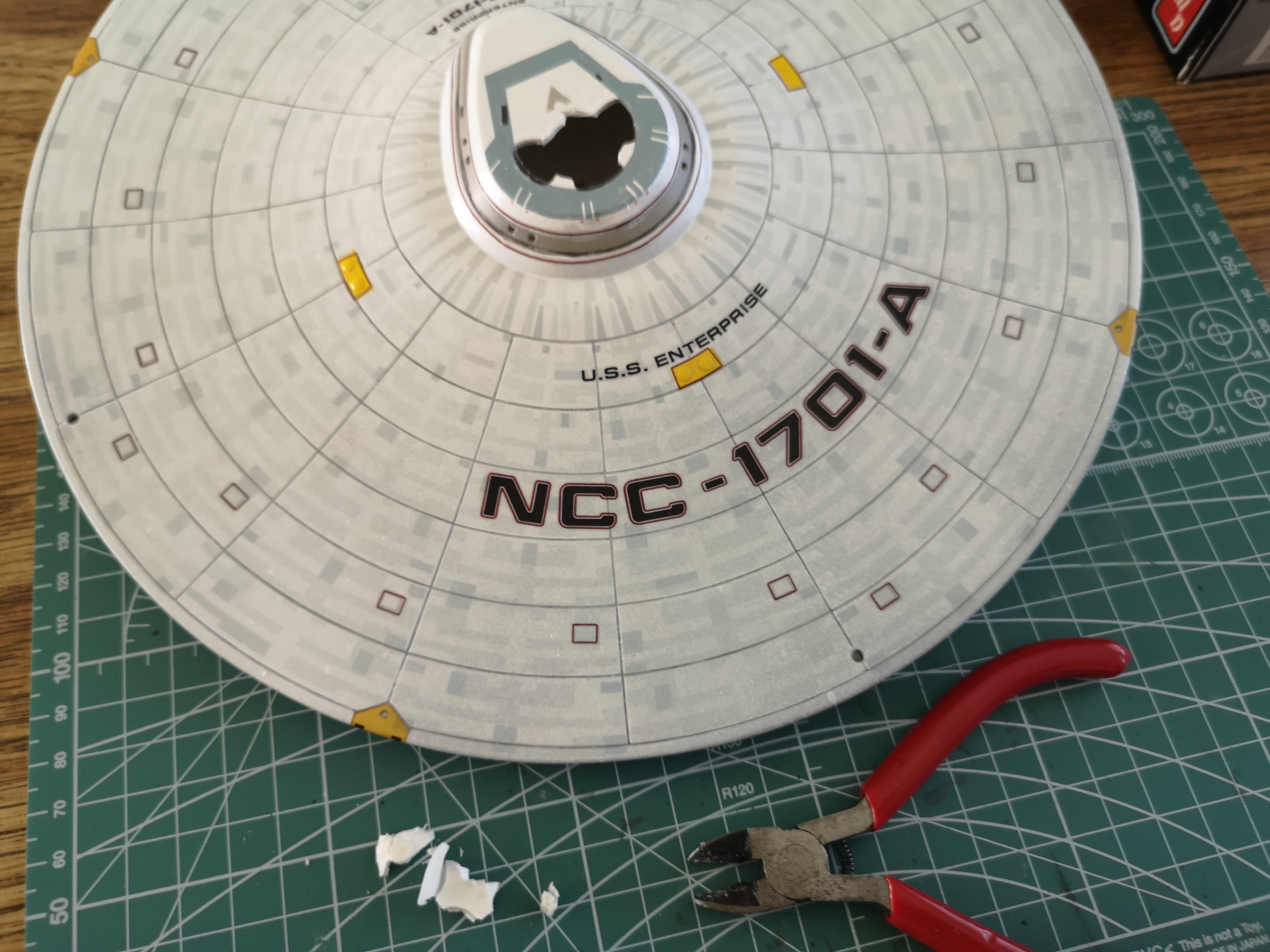

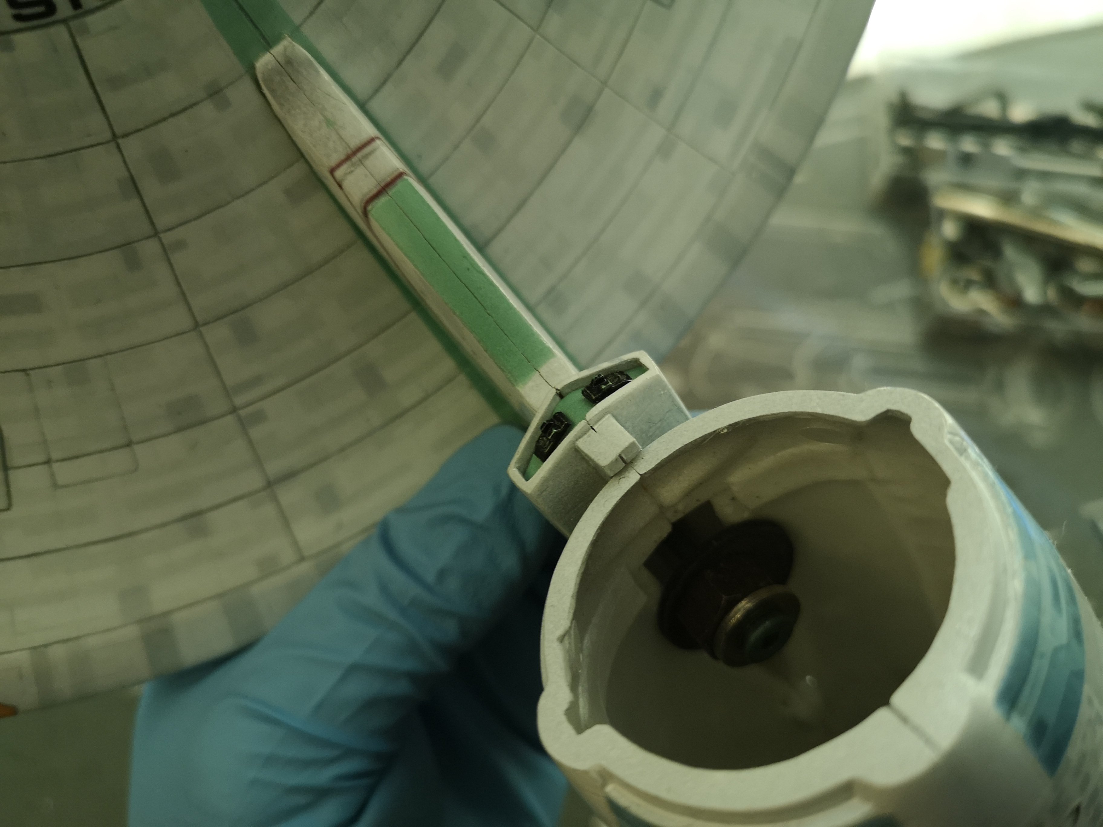

I actually tried to fire a screw into the neck through the bridge hole and saucer, however the saucer just flopped forward.  I also cracked the glue on the neck.
I hate this thing.
One more roll at the dice before I either park this thing or set the self destruct to 60 seconds.  I cut the little peg off since it wasn't doing anything.  Besides it was already soft and gooey from all the times I tried to glue the damn thing.
I drilled a hole where the peg was.  You can also see where I drilled a hole near the front of the neck where I planned to throw in a screw from the bridge.  I might still do that as long as it doesn't crack again.  On the right there is my Mickey mouse hardware solution.
This actually worked on its own.  Saucer stayed in place, no glue or secondary screw from the other side.
Anyway, I pulled it all apart again to dullcote the whole thing.  Will assemble and post pics later.....unless I trip and fall while moving it and the whole thing blows up because AMT/ERTL.  Yes, I would blame them for that too.

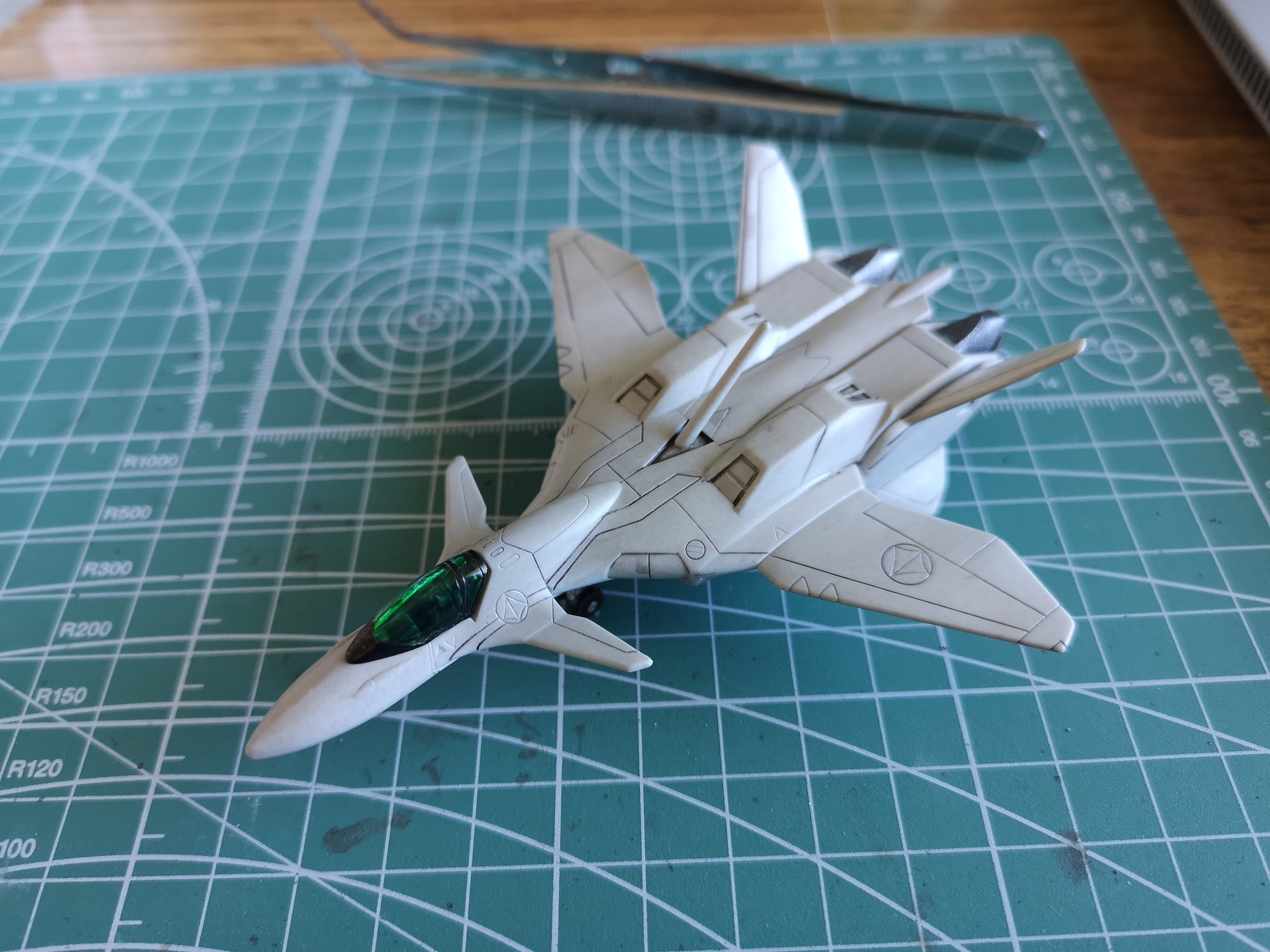

Making some progress on the 1/48 VF-1. Went for more of a black aces style black paint around the canopy.
Oh awesome!  A 1/48 brownie!!

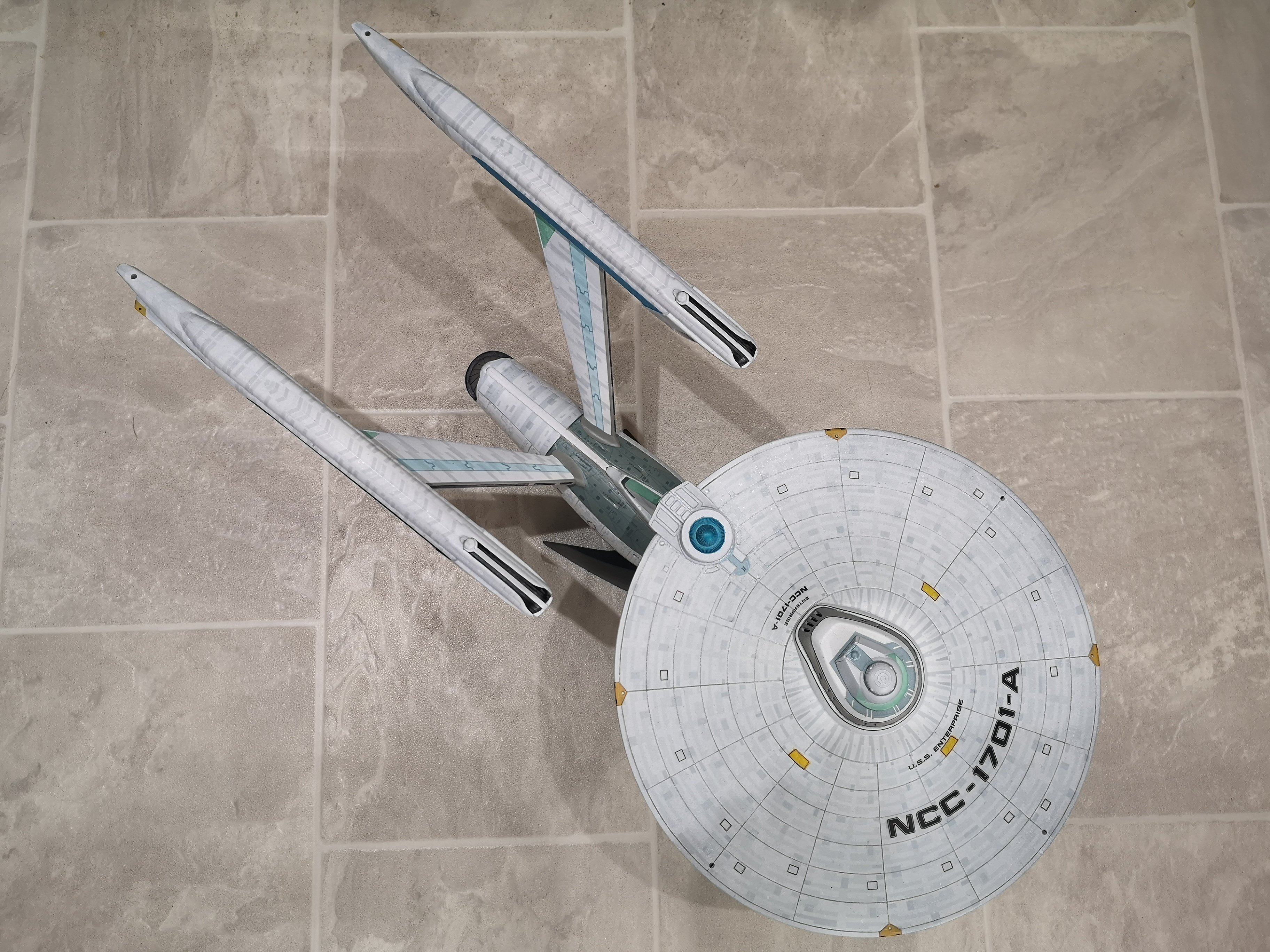

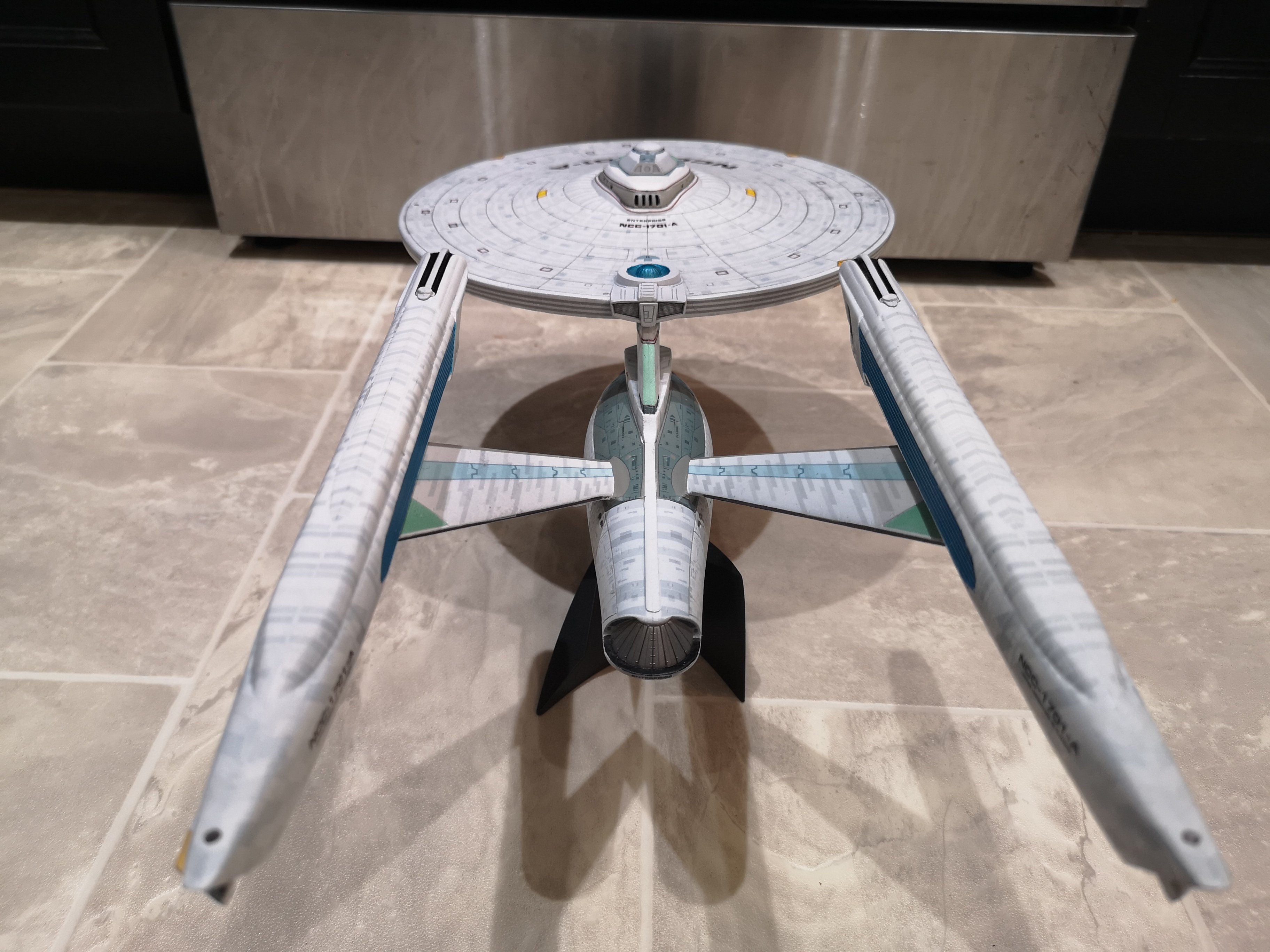

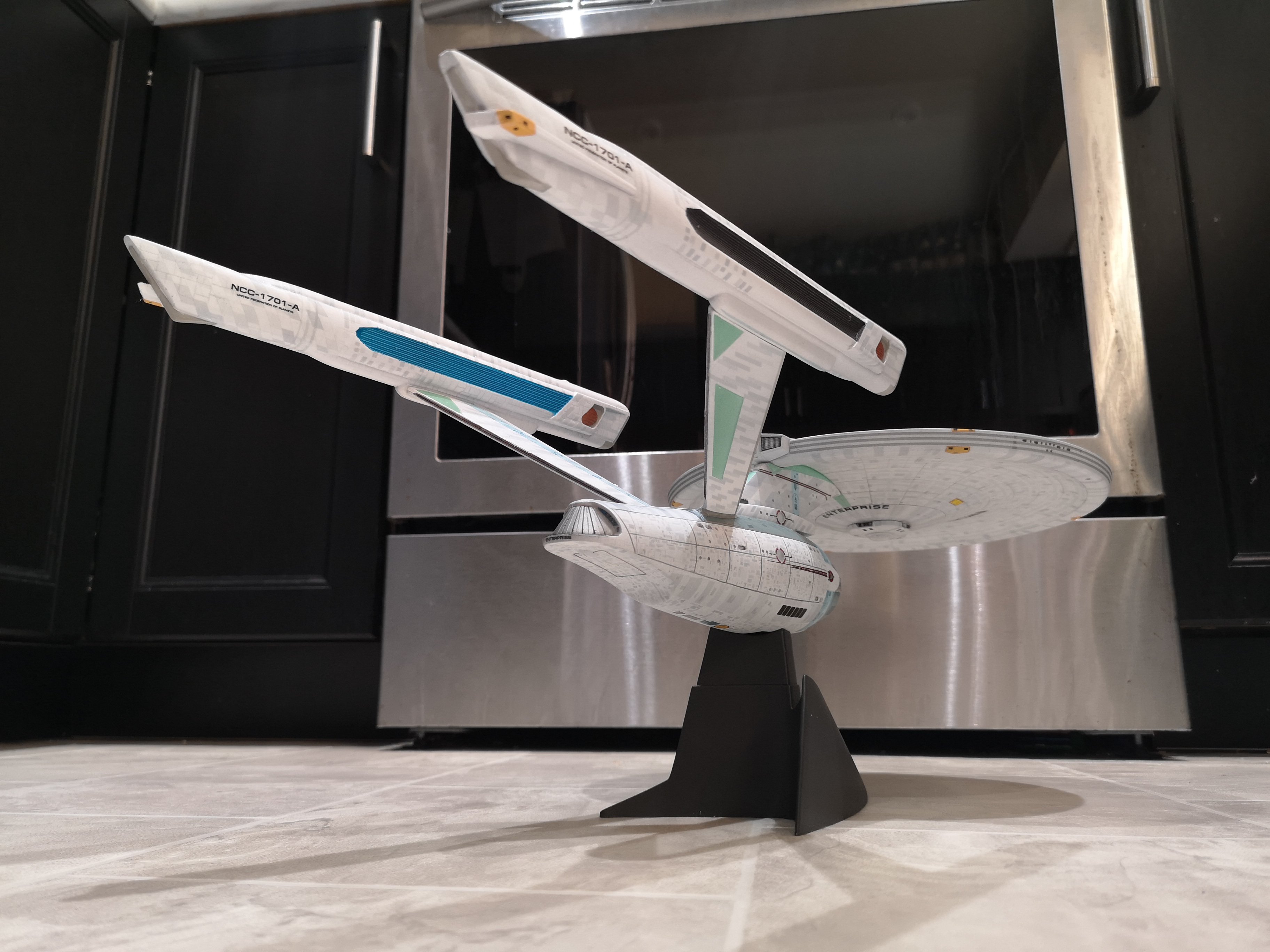

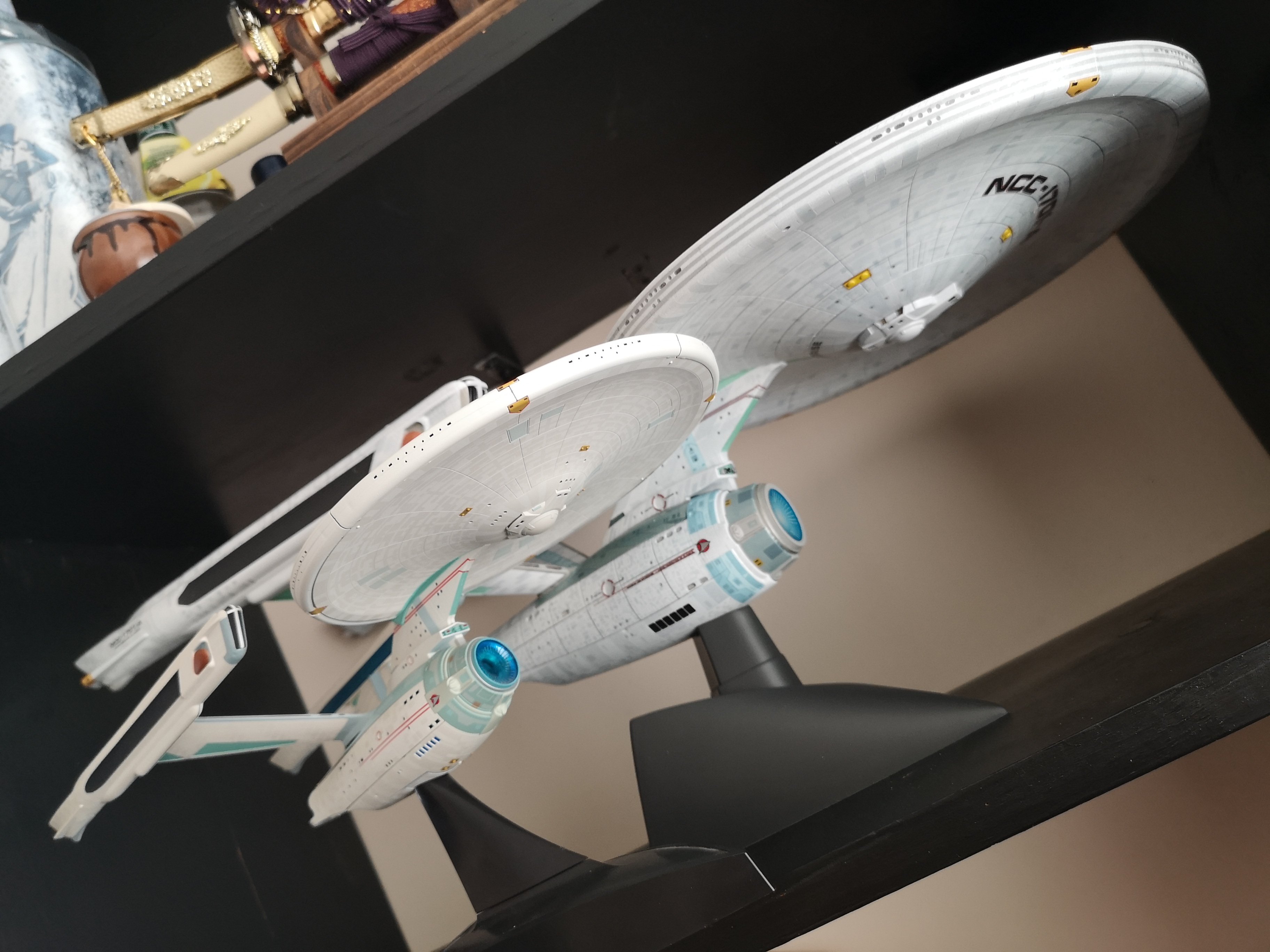

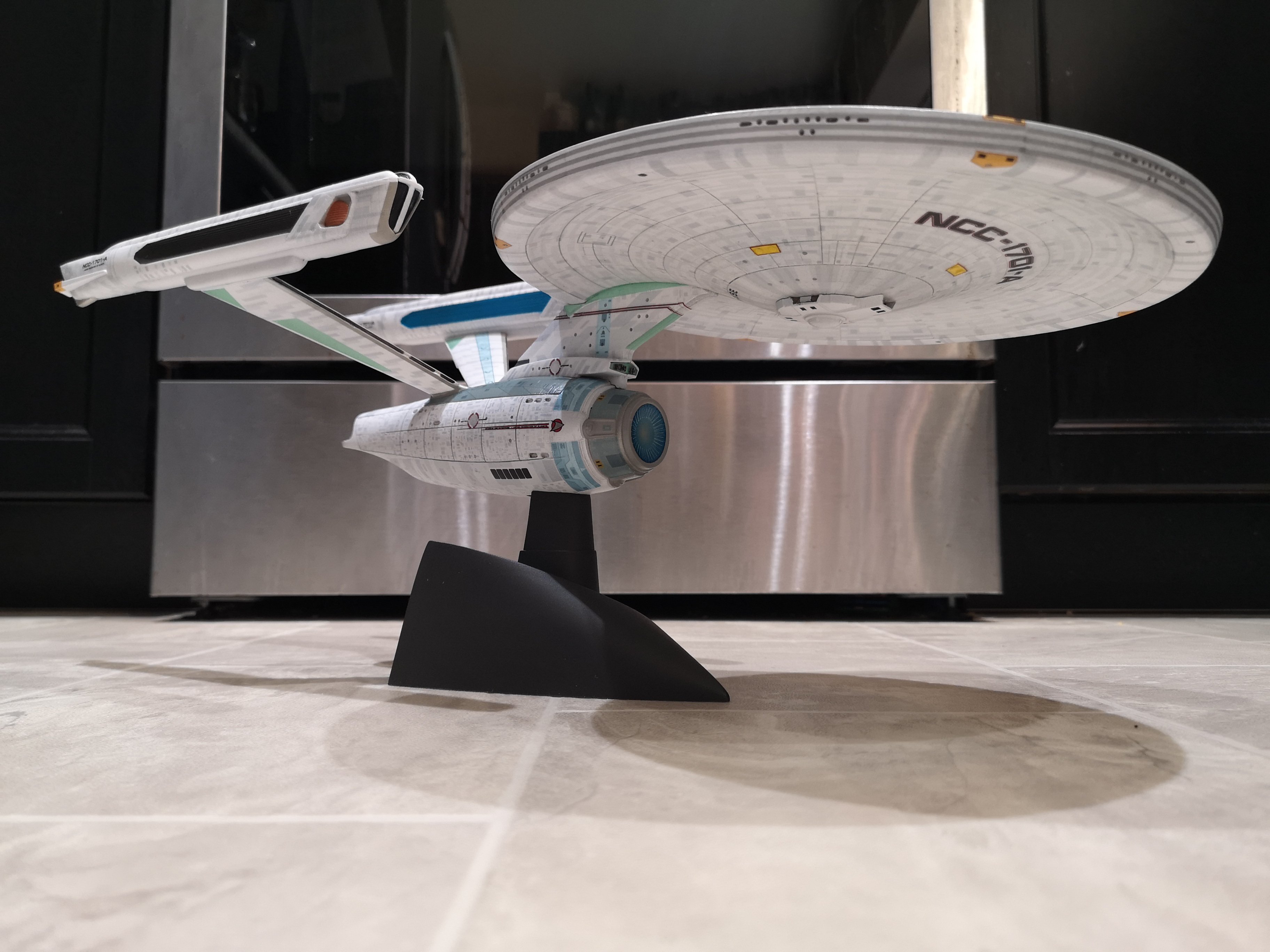

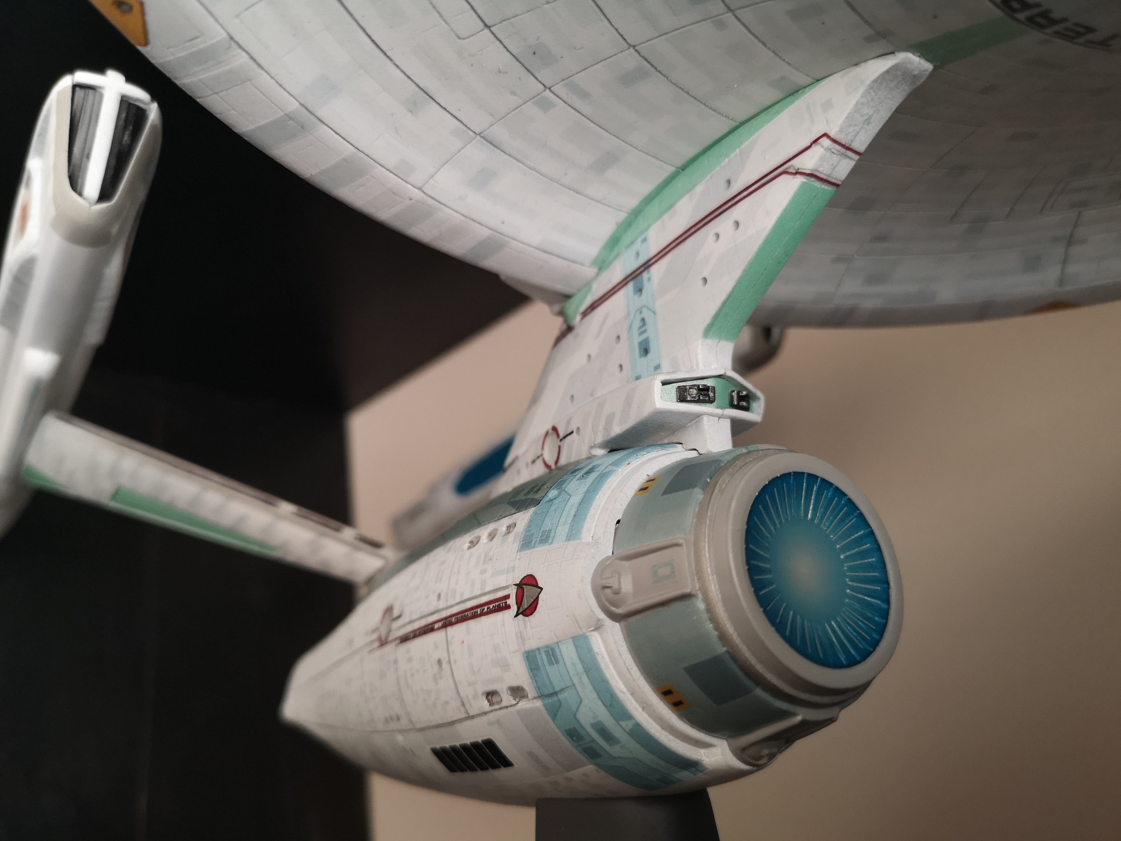

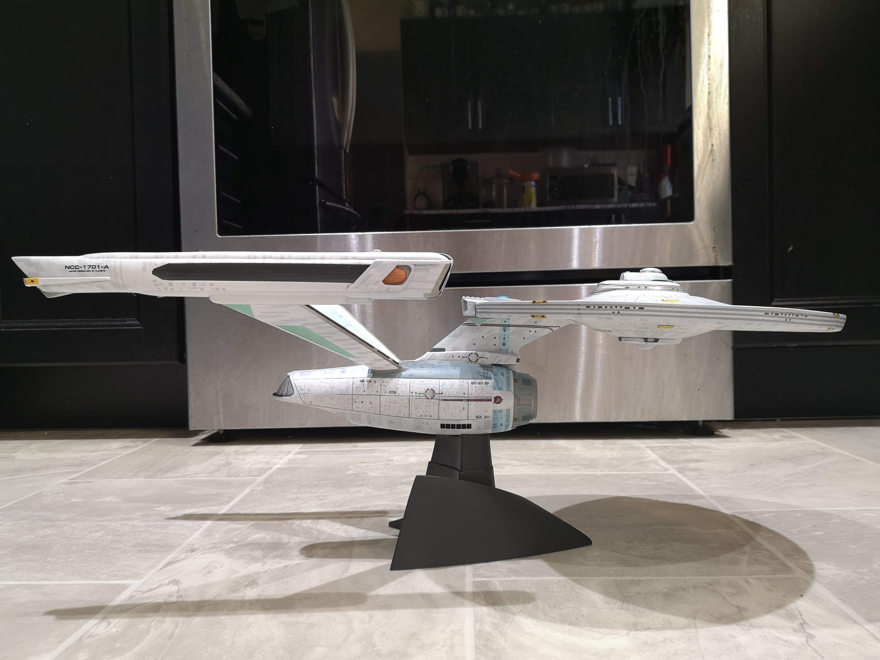

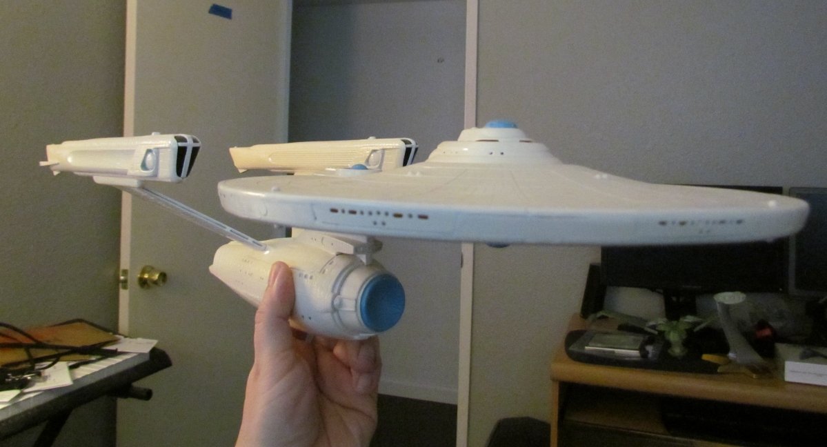

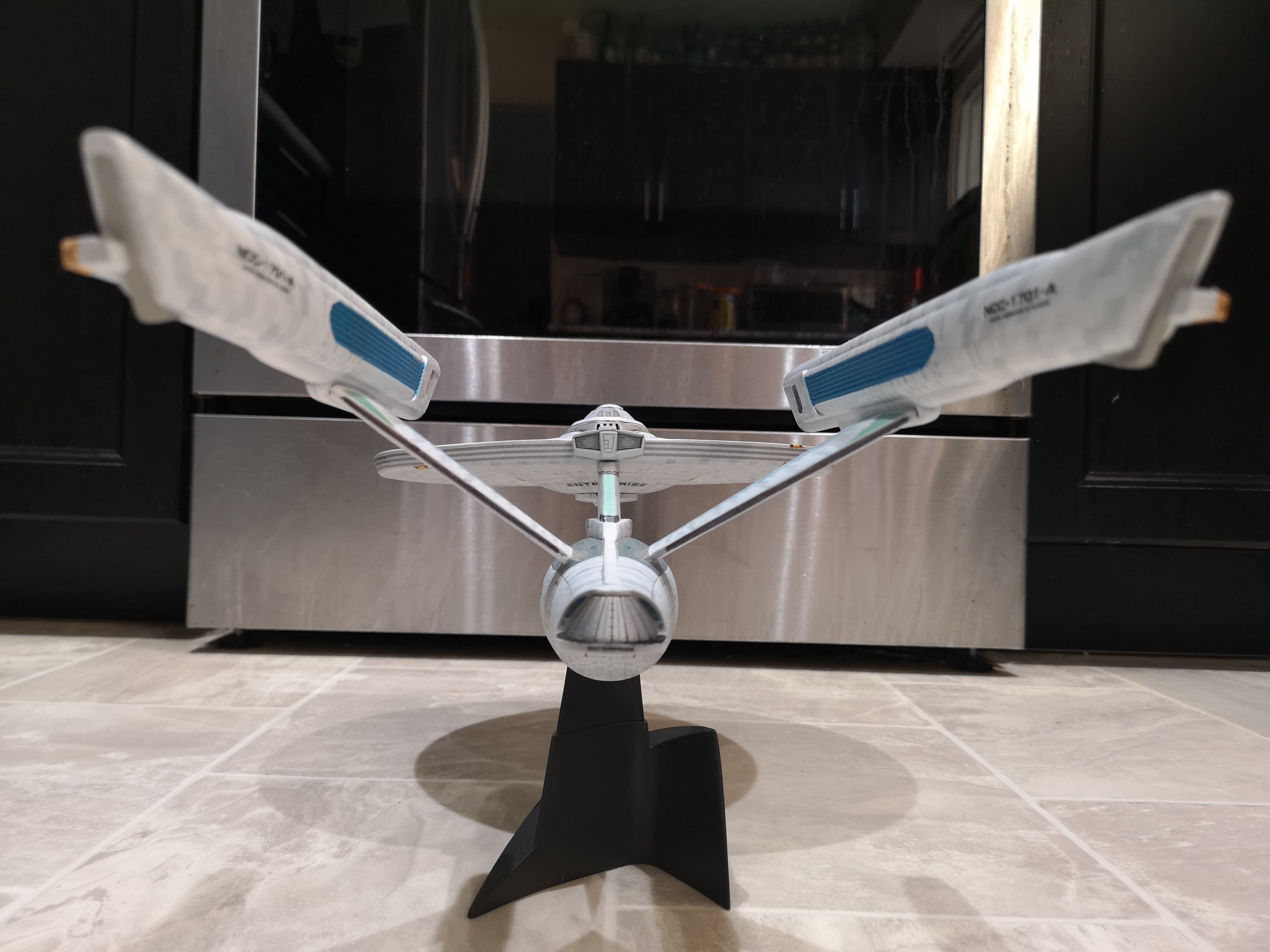

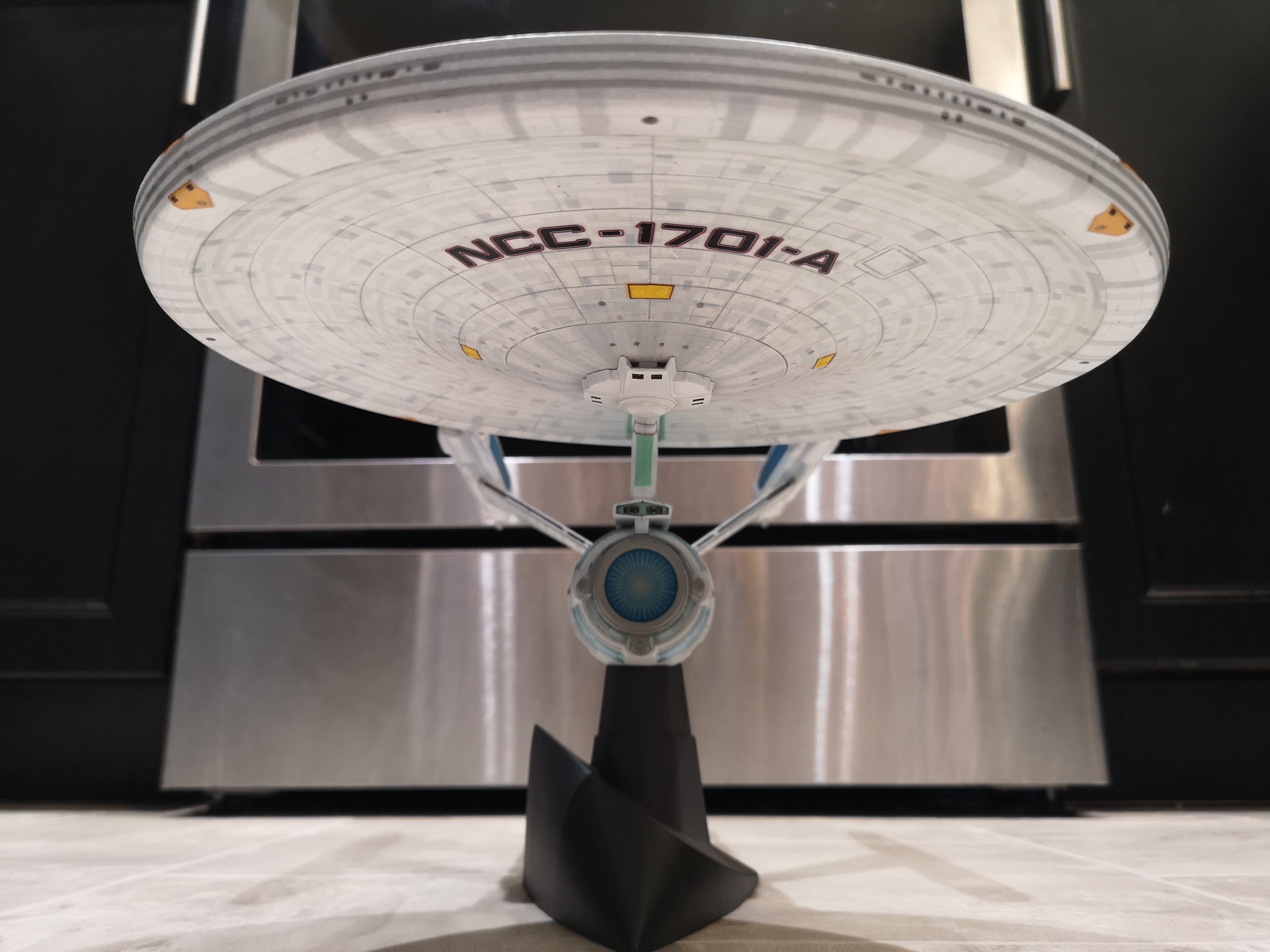

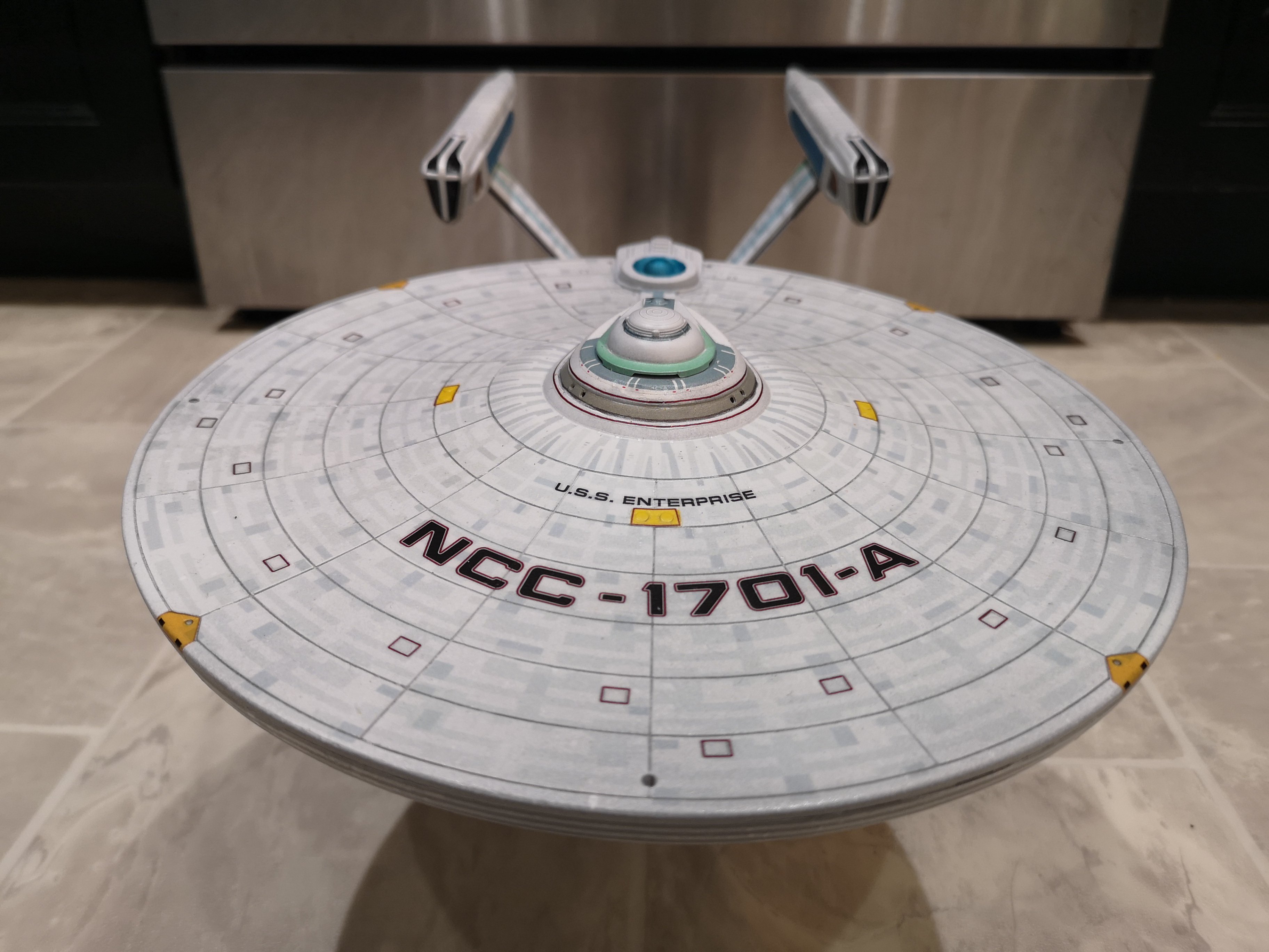

Calling this POS almost done.
Just need to add the clear parts for the blinky lights the kit didn't come with, for now there are just holes there.
Please don't zoom in...looks like a 10 year old slapped it together.  Best viewed from afar, hahahah!
Nacelles are level...saucer is dipping a bit, but at least it's not falling off.  Double screwed and glued.
She's big.

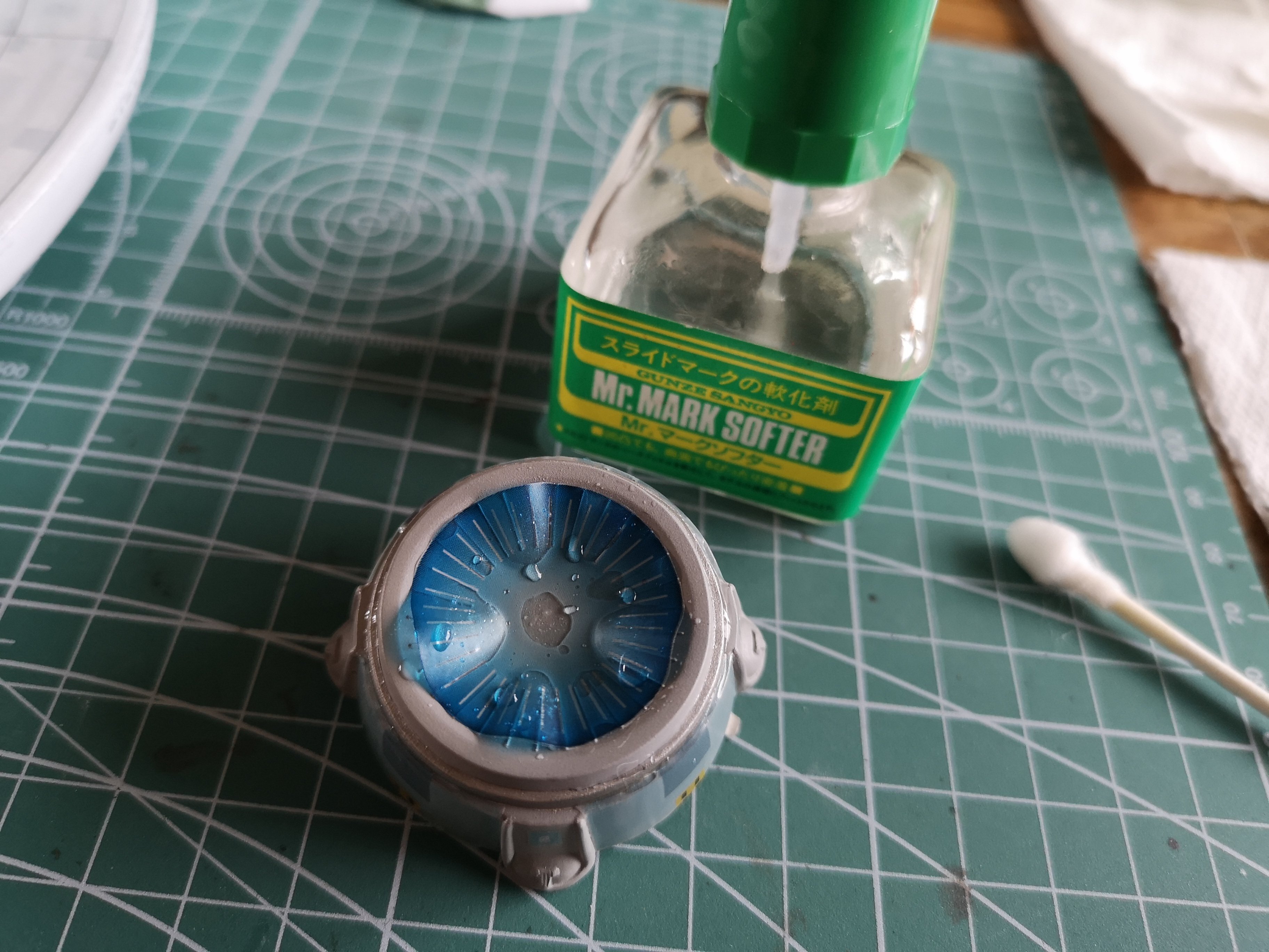

I think.....the decal that came for the deflector dish....it was actually sized bigger before I used Mr. Mark Softer and actually sat over the dish like a drum, semi transparent.  I wonder if I should have left it like that.  I should have taken a picture of it before I started setting it.  This is all I have, but you sort of get the idea.
Next to the Bandai 1/1000 that I sort of used as a decal/paint guide.
Anyway, challenging as hell this kit, can't say I recommend it.  Would have liked the Polar Lights 1/350 version, but not sure I have space for that thing....must be HUGE.
Honestly, I would be thrilled to have something that good on my shelf, in spite of all the pain to make it.  It really came out better than the source material should have allowed.
But yeah, the size is the reason I haven't touched the 1/350 kits.  Those are over three feet long.  I'm going to try my best at the 1/1000 ones, and maybe get the bigger ones someday when I have a full-blown display room.

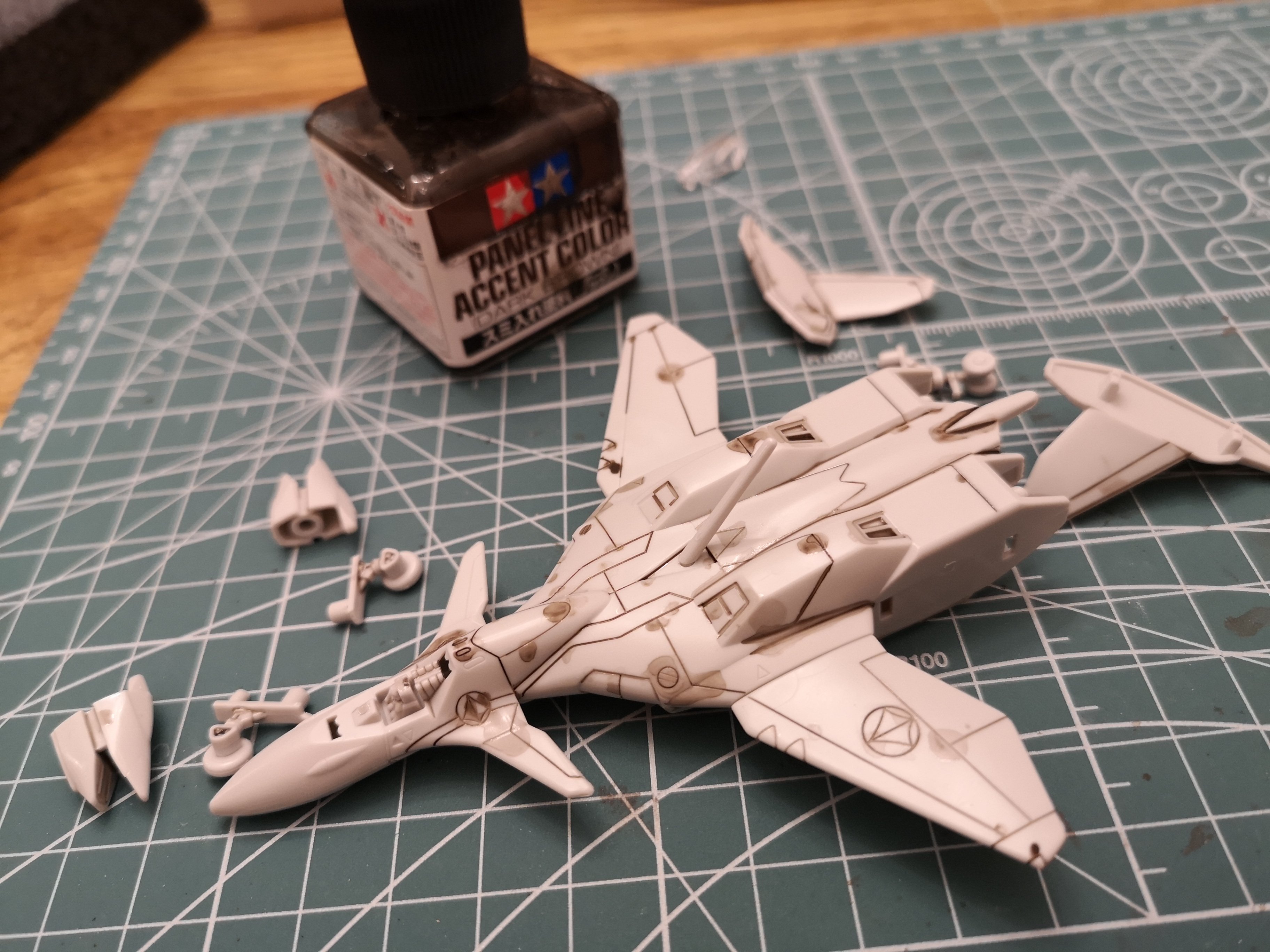

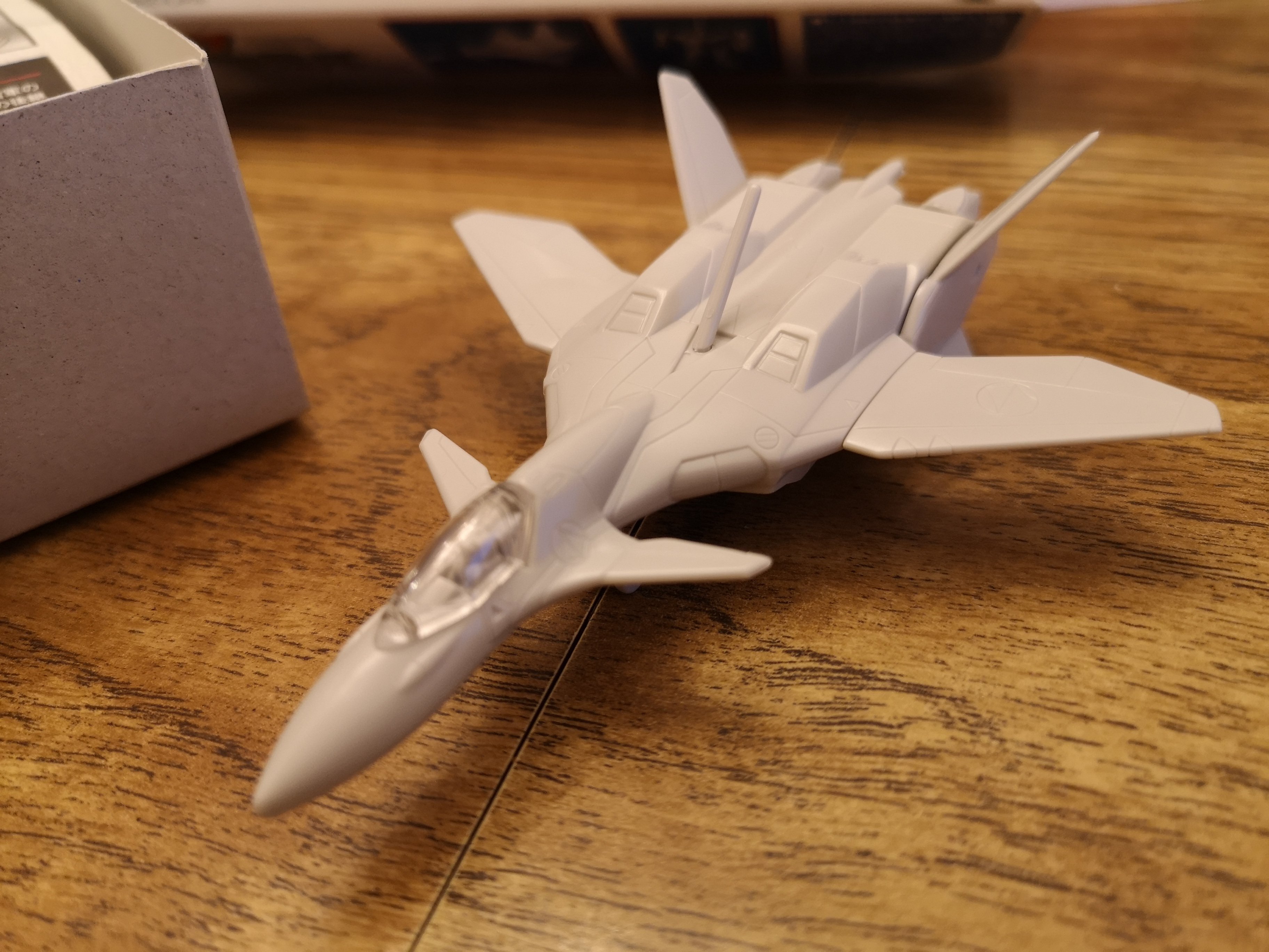

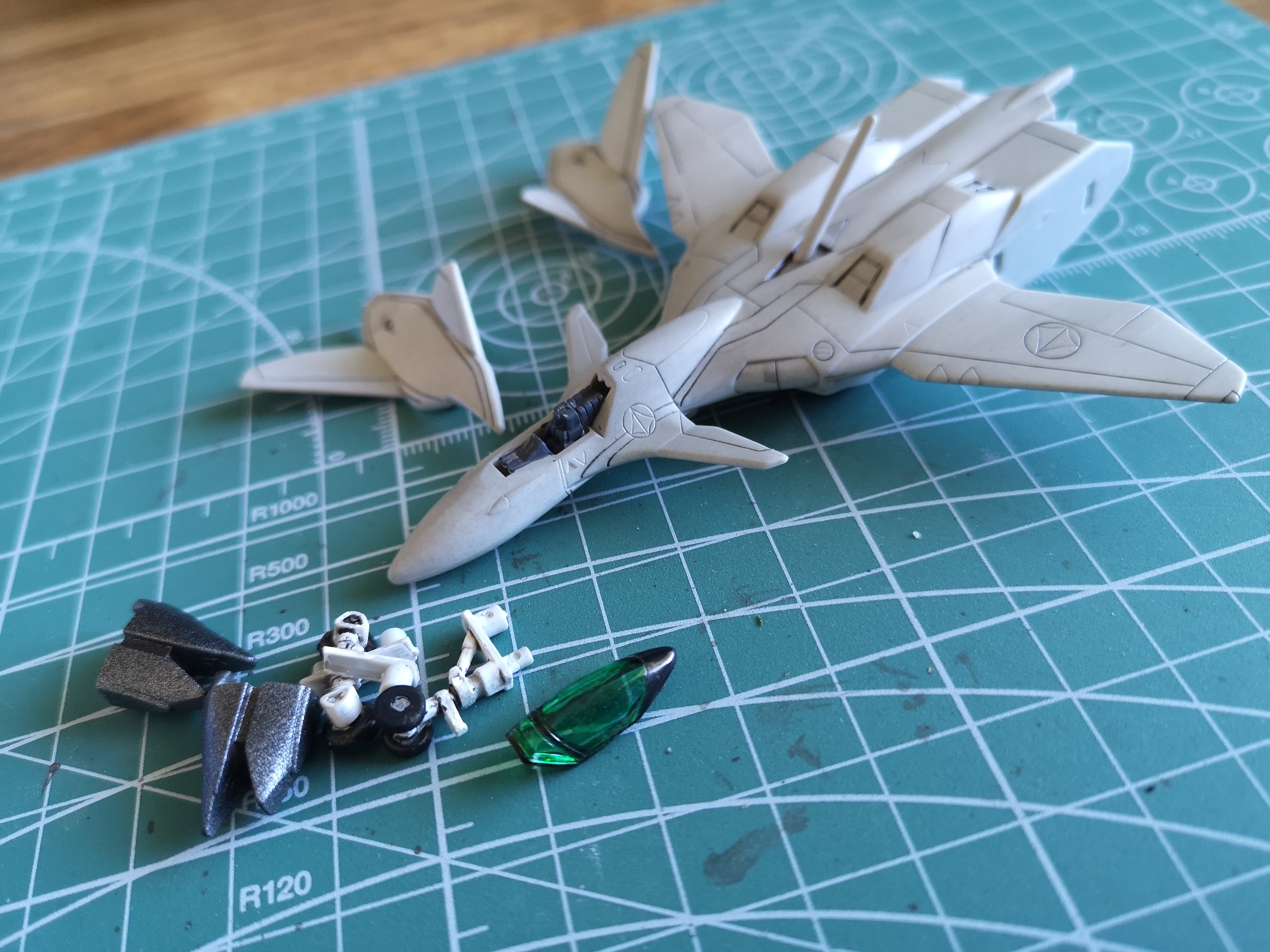

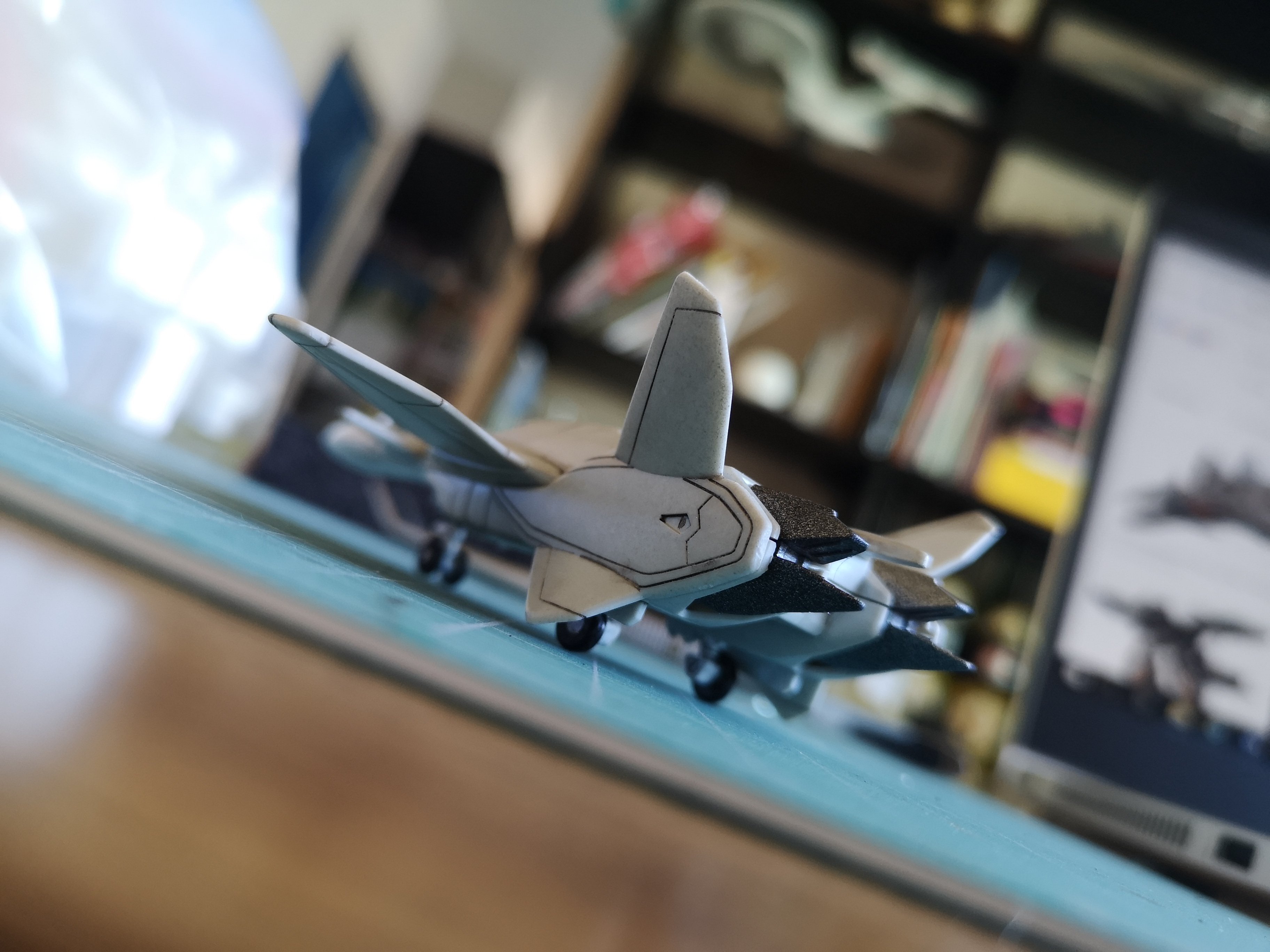

M 5 year old wanted to build a model so I gave him this and he slapped it together:
Pretty clean kit for 1/144 scale.  It actually looks really good, but I'm not super familiar with the VF-11 (old guy here, only the VF-1 exists in my world).  Compared to my old ARII 1/100 kits, this thing looks miles ahead.
It was simple enough to build for my 5 year old to build, and Bandai seemed to do a pretty good job of making sure the parts fit nice and tight, and hide most of the seam lines in the assembly.
I tried to find other kits in this series and scale, but sadly, it doesn't appear that they made any kits from SDFM or even Mac Plus.  Would have been nice to have a YF19 and a YF21 to go with this.
Anyway, after the kid went to bed, Da-Da took the thing apart and added some detail:
Simple build, no primer, no sanding, no mods.
Just some panel lining, paint, and maybe a wash and a touch more paint.

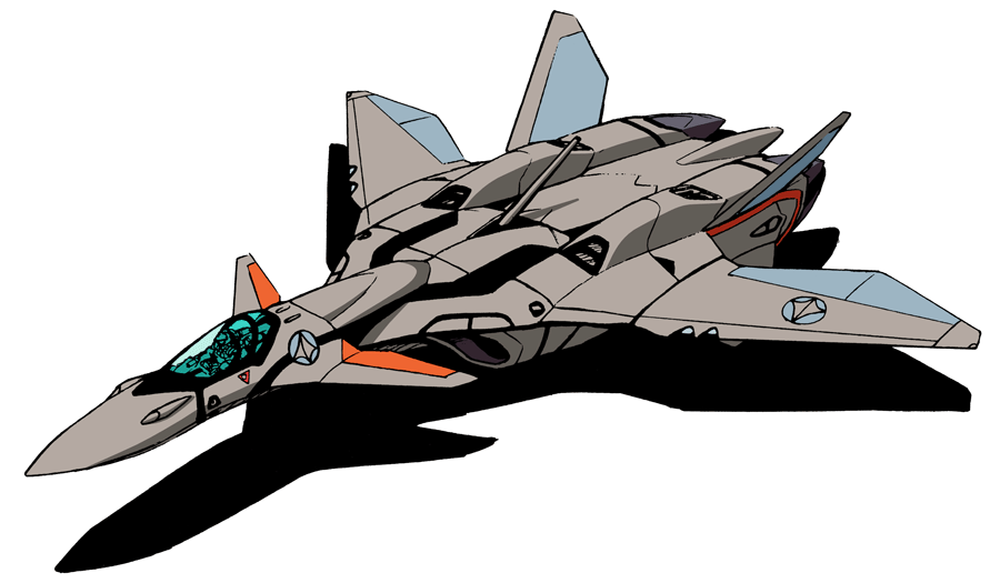

I don't know this plane very well, only experience is from what I saw briefly in M+.  I might do a bit more research to get the colors and markings right, but ultimately, it's for my 5 yr old who hasn't even watched M+ yet, lol!
When he wakes up, I'll ask him if he prefers the current low-vis look :)
eta:
I just looked up some line art from M+ and there is no way my shaky hands will be able to paint the orange highlights on the legs, lol!VF11B_Fighter.gif.5a757e8e1434061700451c107c95deee.gif
