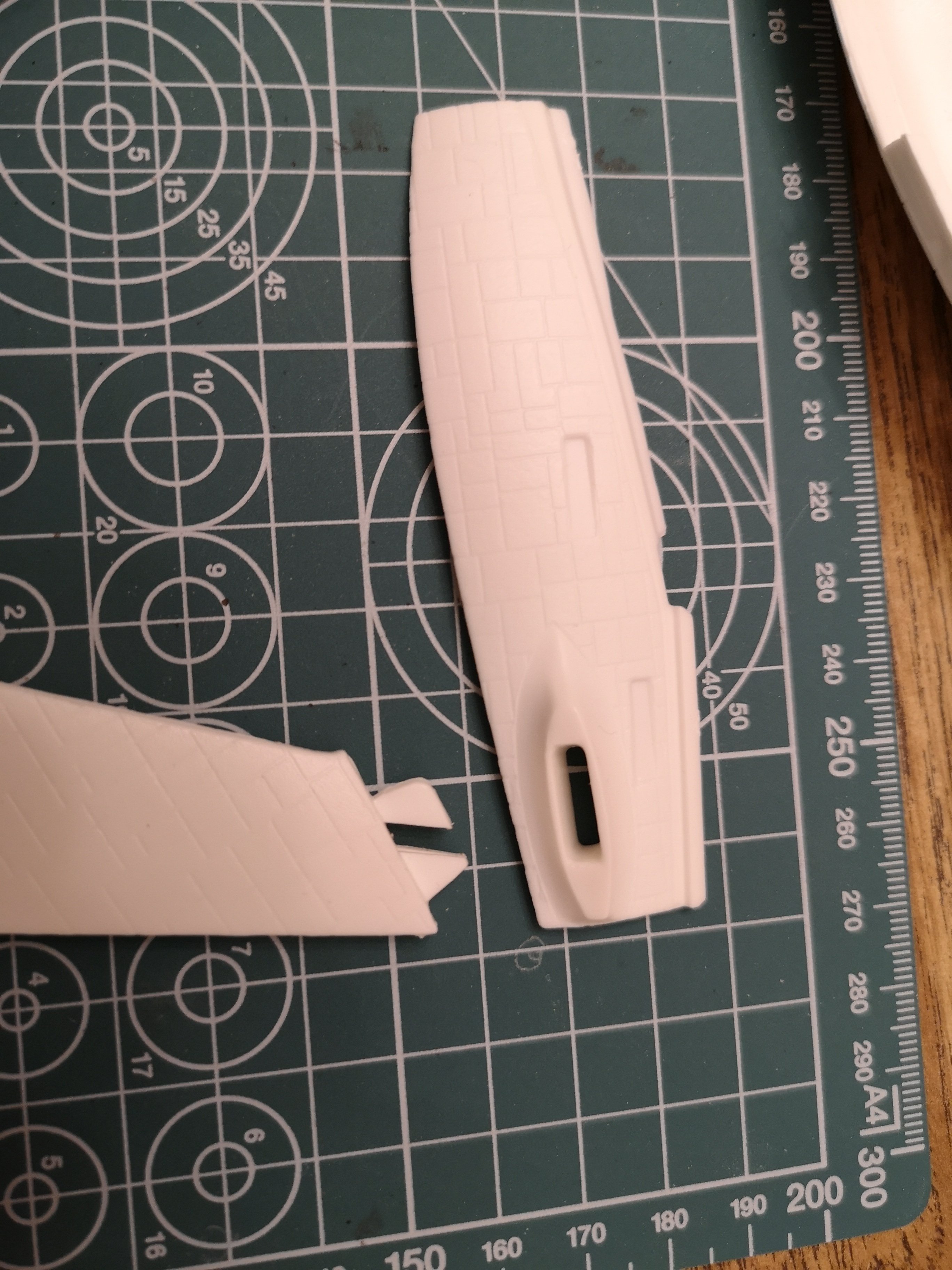

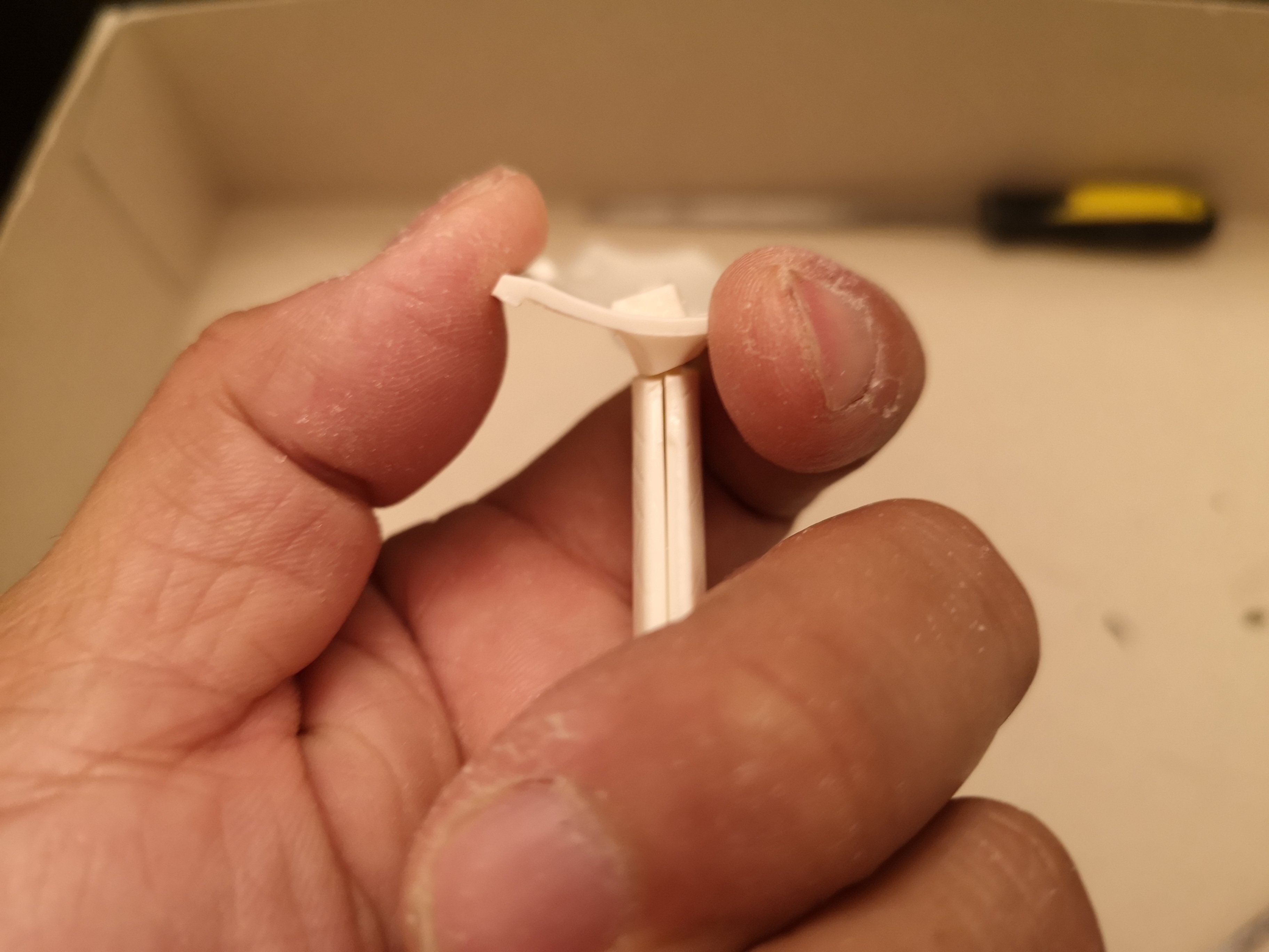

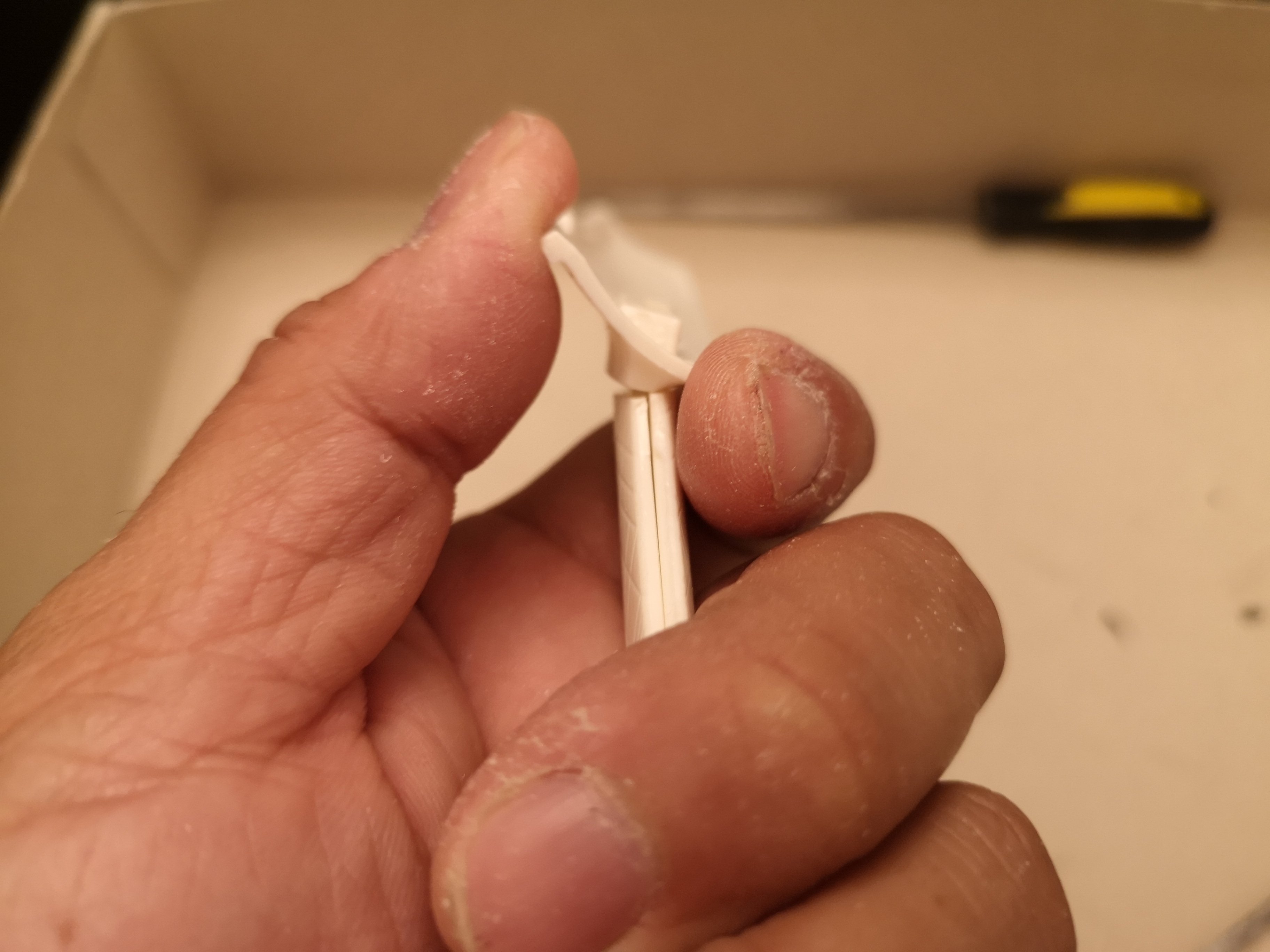

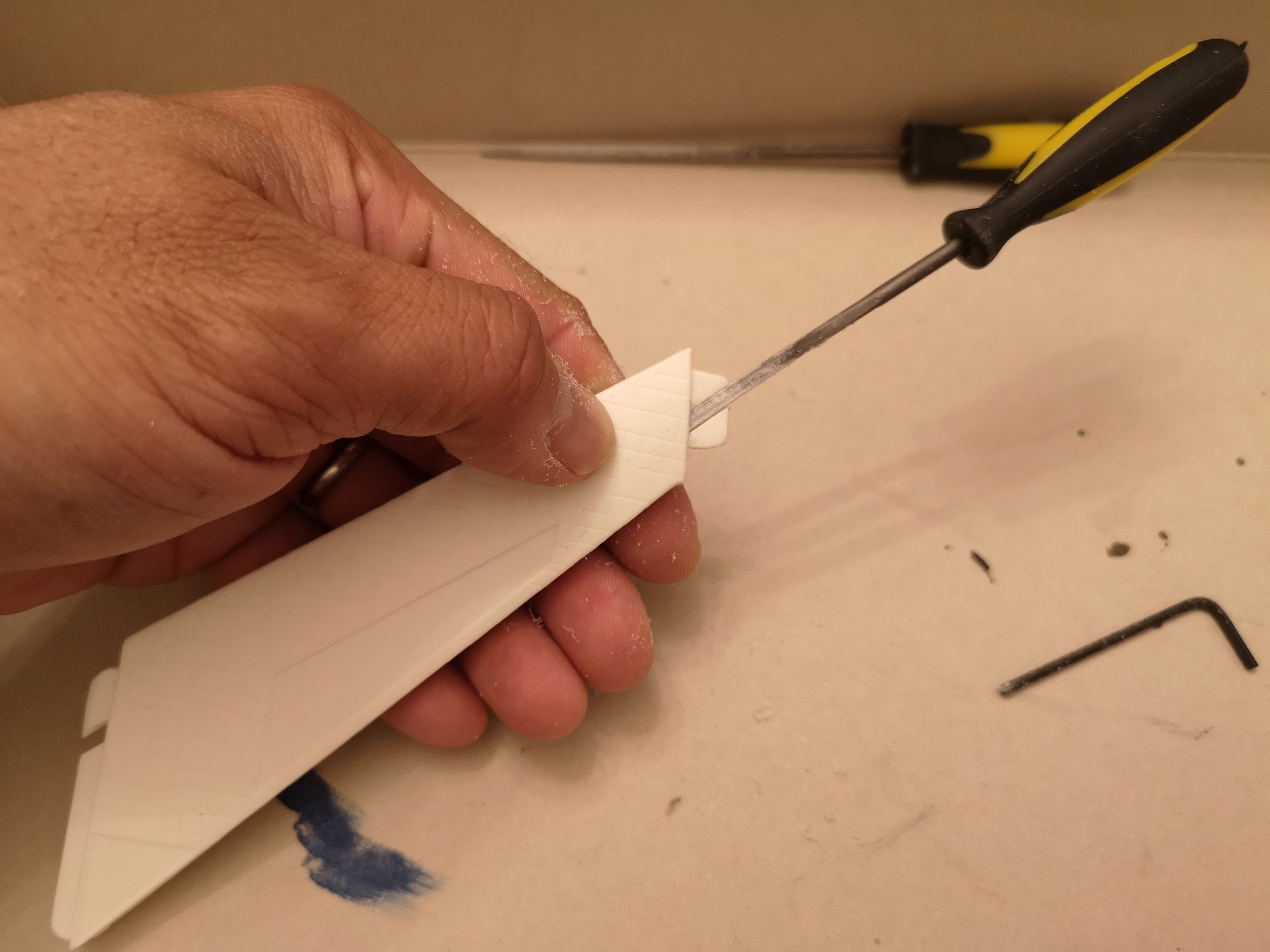

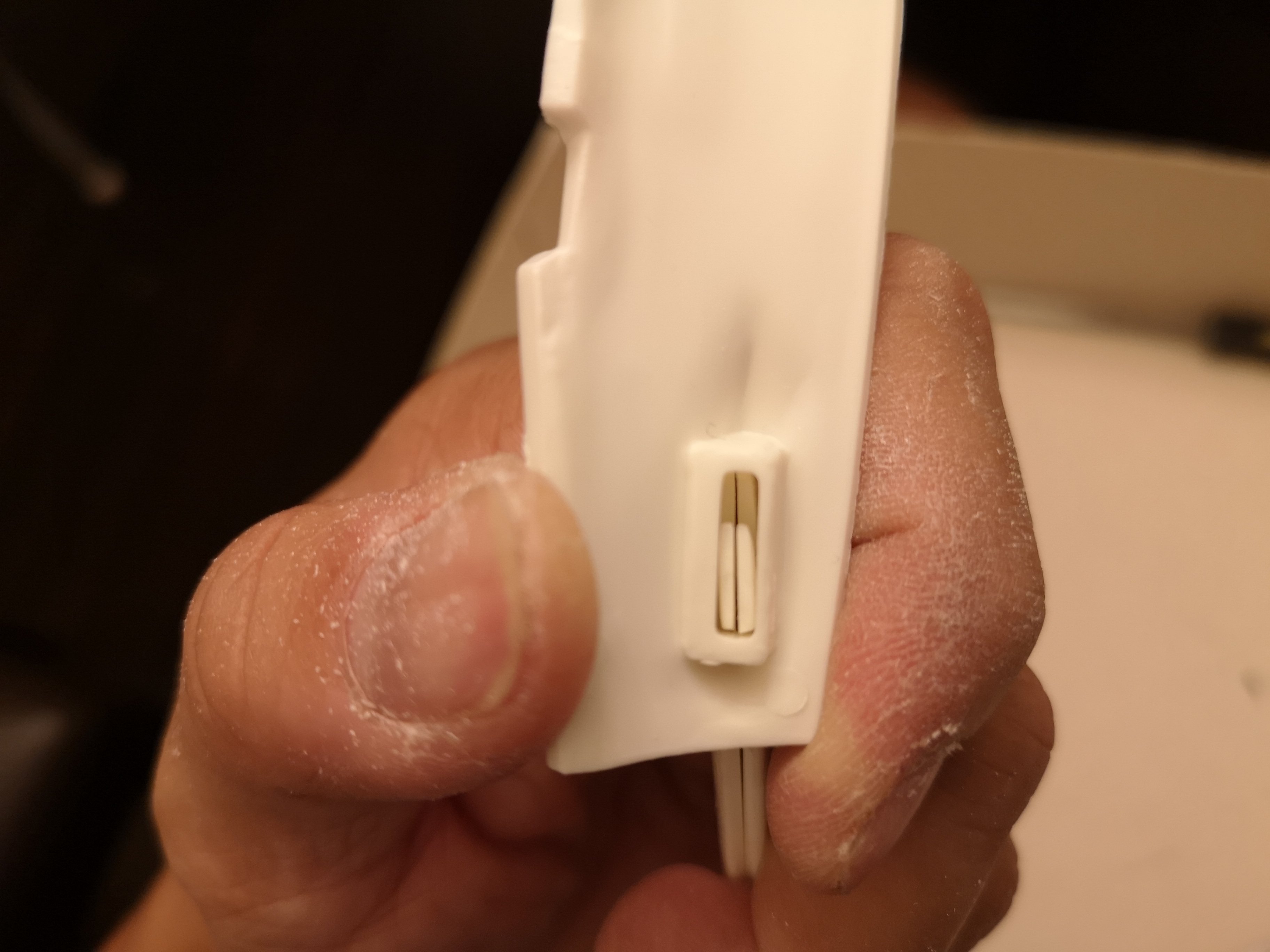

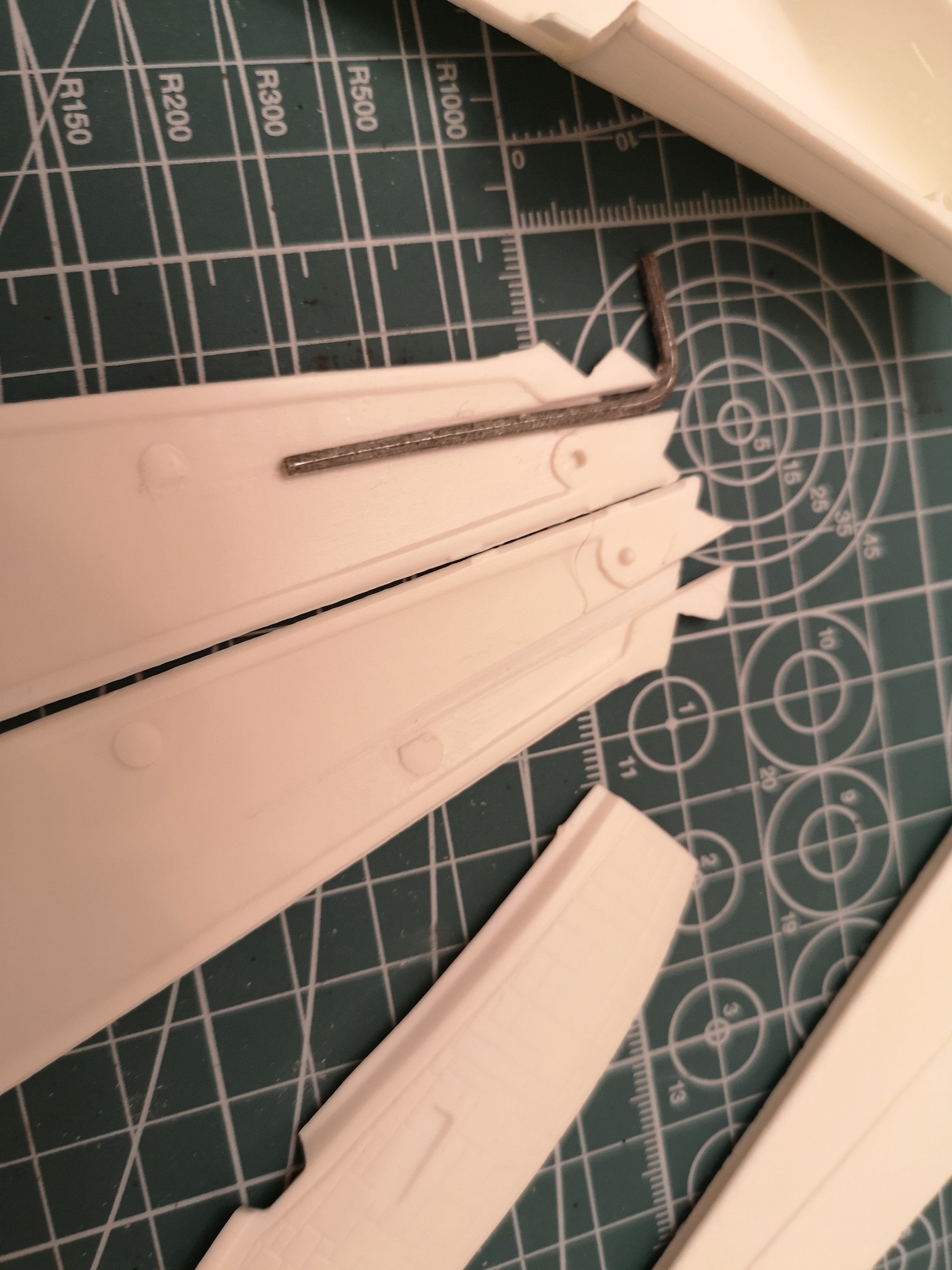

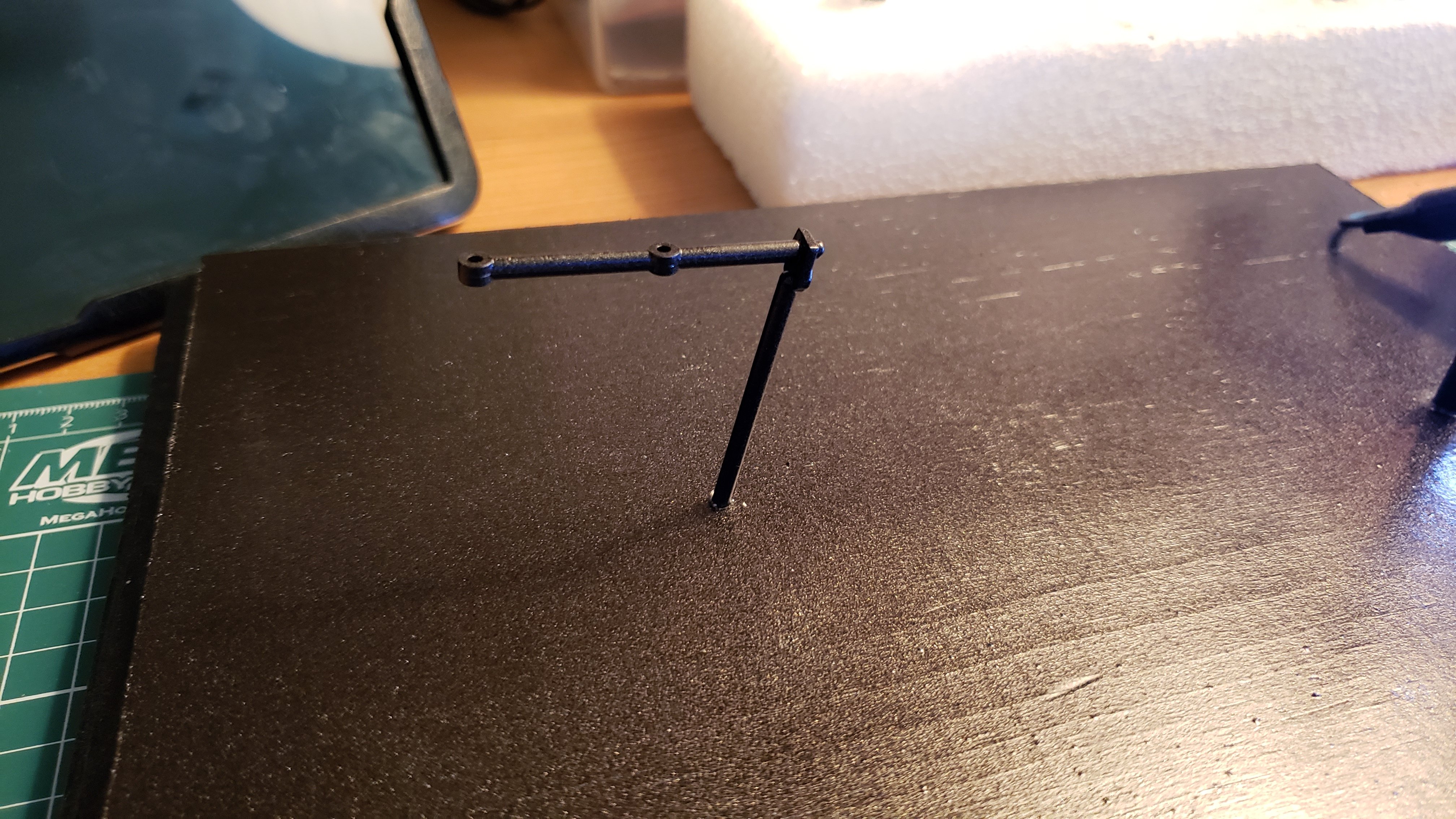

Ok, so this thing is turning out to be more of a nightmare than I was expecting.  I guess in Grade 8, I mashed this thing together with tons of glue, didn't care about seam lines or color accuracy.
I think if I'm going to get through this build without stressing the hell out, I'll have to aim for "just better than my grade 8 build", rather than perfection or screen accuracy.IMG_20200719_004250.jpg.91c1923ff4cbb4ce6fceecb6822e4800.jpg
I don't know who at AMT thought this would be a good idea.  It's absolutely bonkers they did this.
IMG_20200719_010122.jpg.15d1eba60163a5aff0a3c0e717b89575.jpgIMG_20200719_010119.jpg.34f0e78a498ac25b15a4c5643ecb1247.jpg

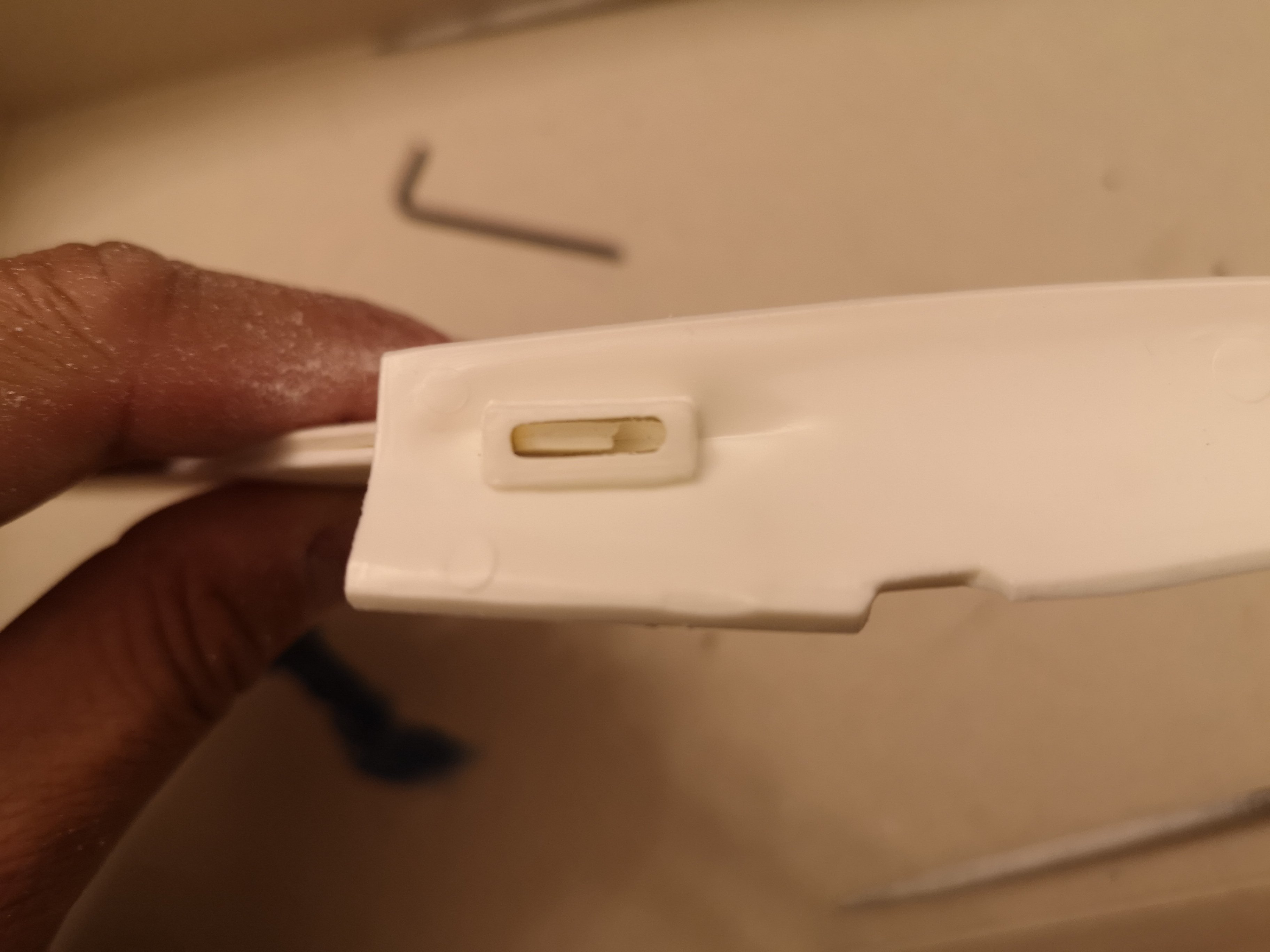

Test fit shows the pylons have this much give either way, lol!
IMG_20200719_010126.jpg.f5c8d549d67a3e3eae82fb5ea58955df.jpgIMG_20200719_005547.jpg.98ccc836c90e1781c193572deae306a9.jpg
No wonder these things wouldn't line up....then eventually break.  I love how the instructions warn how extra care is requir d when assembling them.
It says that model glue can cause the plastic to soften and warp if used excessively and they recommend some sort of instant bond type....guessing super glue or crazy glue.  Interesting way to cover up their engineering deficiencies.
Anyway, I didn't have time to go to the local hobby shop to get brass rods, so I dug through my tool cabinet and found some spare hex keys.  Filed a channel for them.
I have no idea what I'm doing.
The parts fit horribly, like the halves of the secondary hull were never meant to fit together.  The Navigation Deflector pushes the hull apart even further.  This kit is actually going to need putty and a lot of sanding.
I wonder if the newer 1/350 Polar Lights kits have better fitment right out of the box?
Oh well, in this far already, and got the decal set so I guess I better just plow through it and hope for the best, hahahaha!

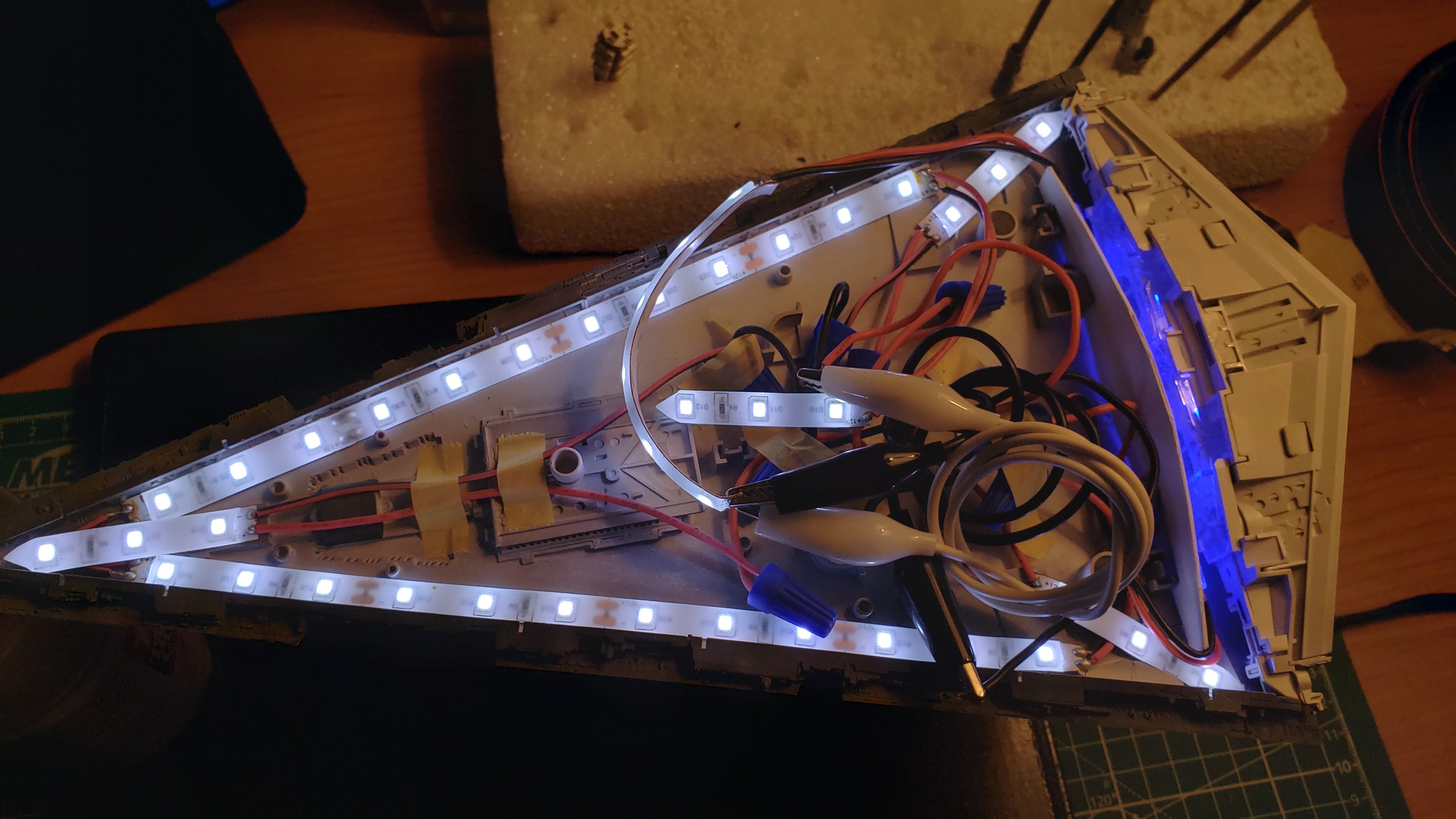

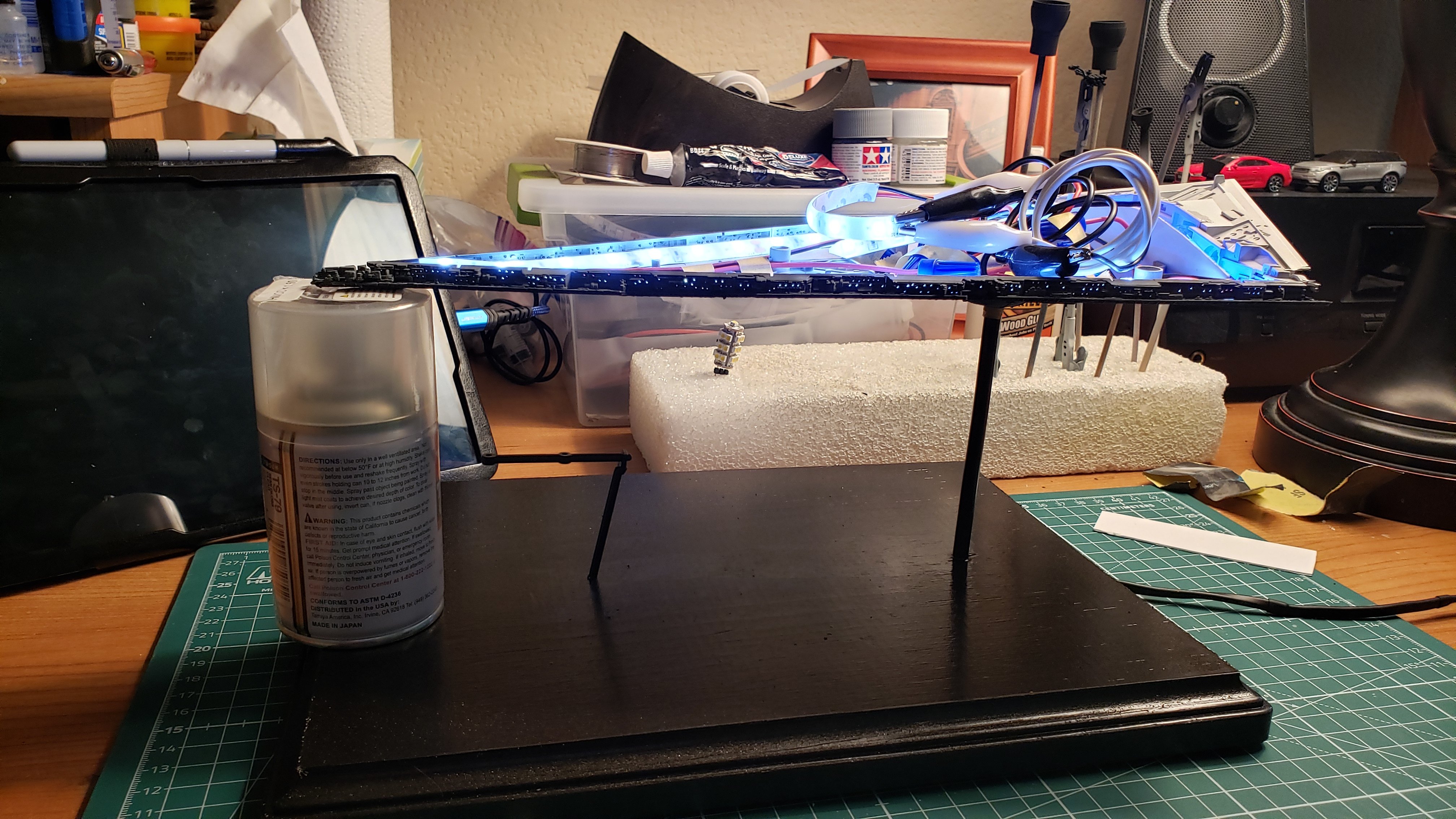

This mornings progress! All LED strips coated with clear frost, full LED light test on the stand and custom holder pylon for the Blockade Runner and teeeny weeeny Falcon made and installed into the base... In the words of the great Morpheous... "He's beginning to believe..."

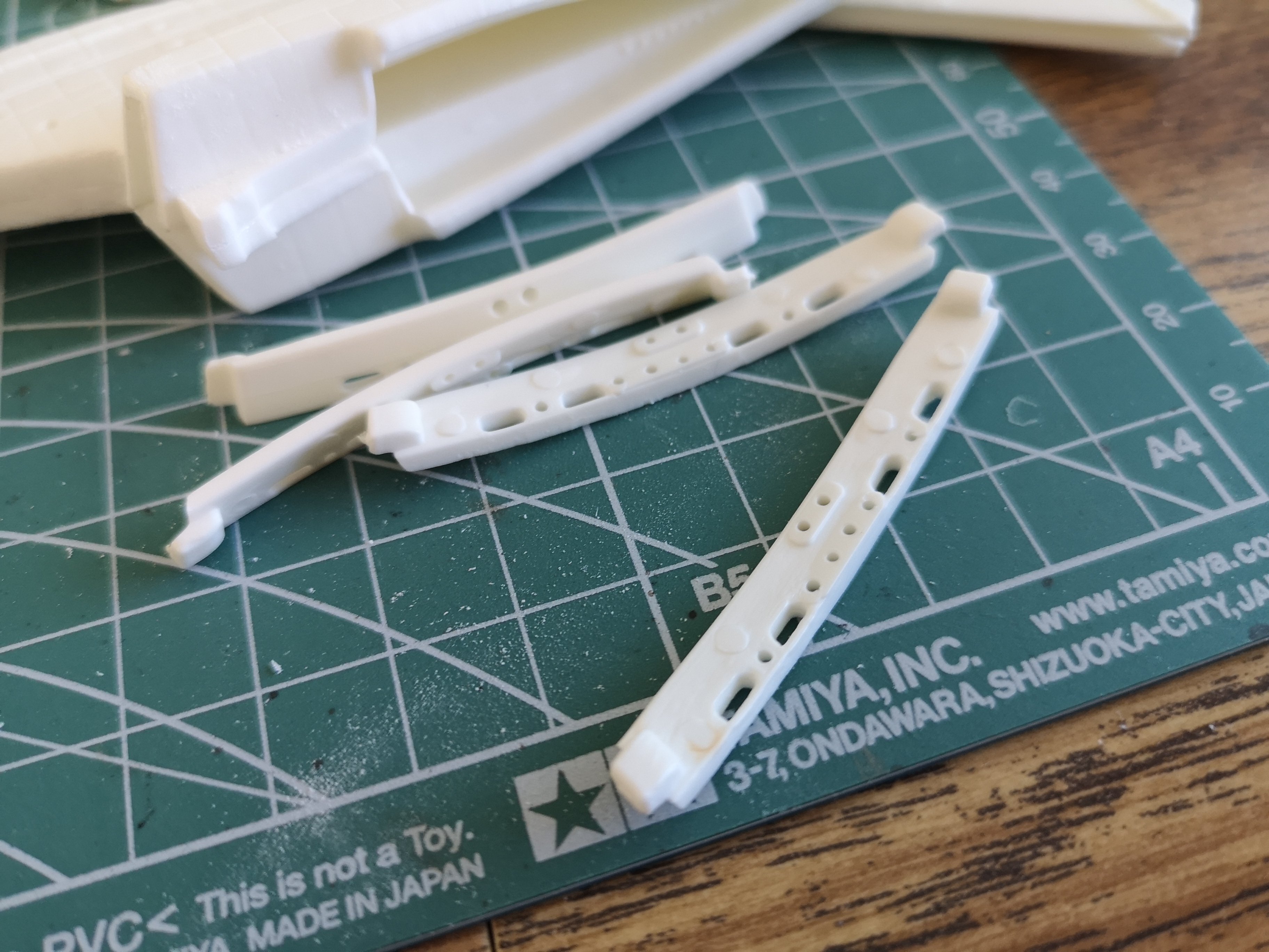

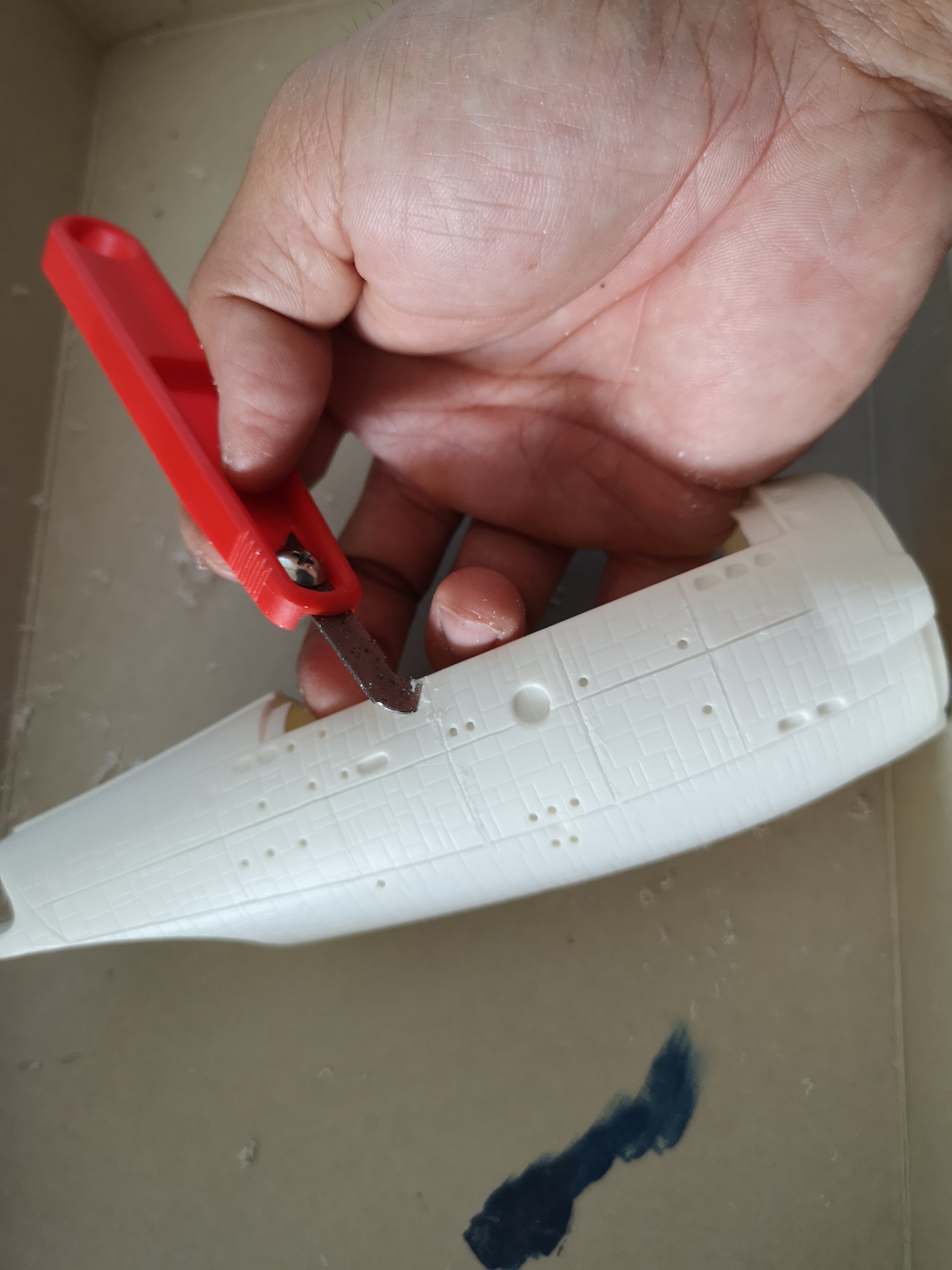

I bought this Bandai kit for my brother 20 years ago for ¥6000, the details were amazing.....sort of falling apart now as he didn't use glue or anything, but I planed to get my 1/537 to look like this.
Figured the Bandai was a smaller kit, so it would be easier with the 1/537 since it's bigger.  Wrong.  I should never have set the standard so high, lol!

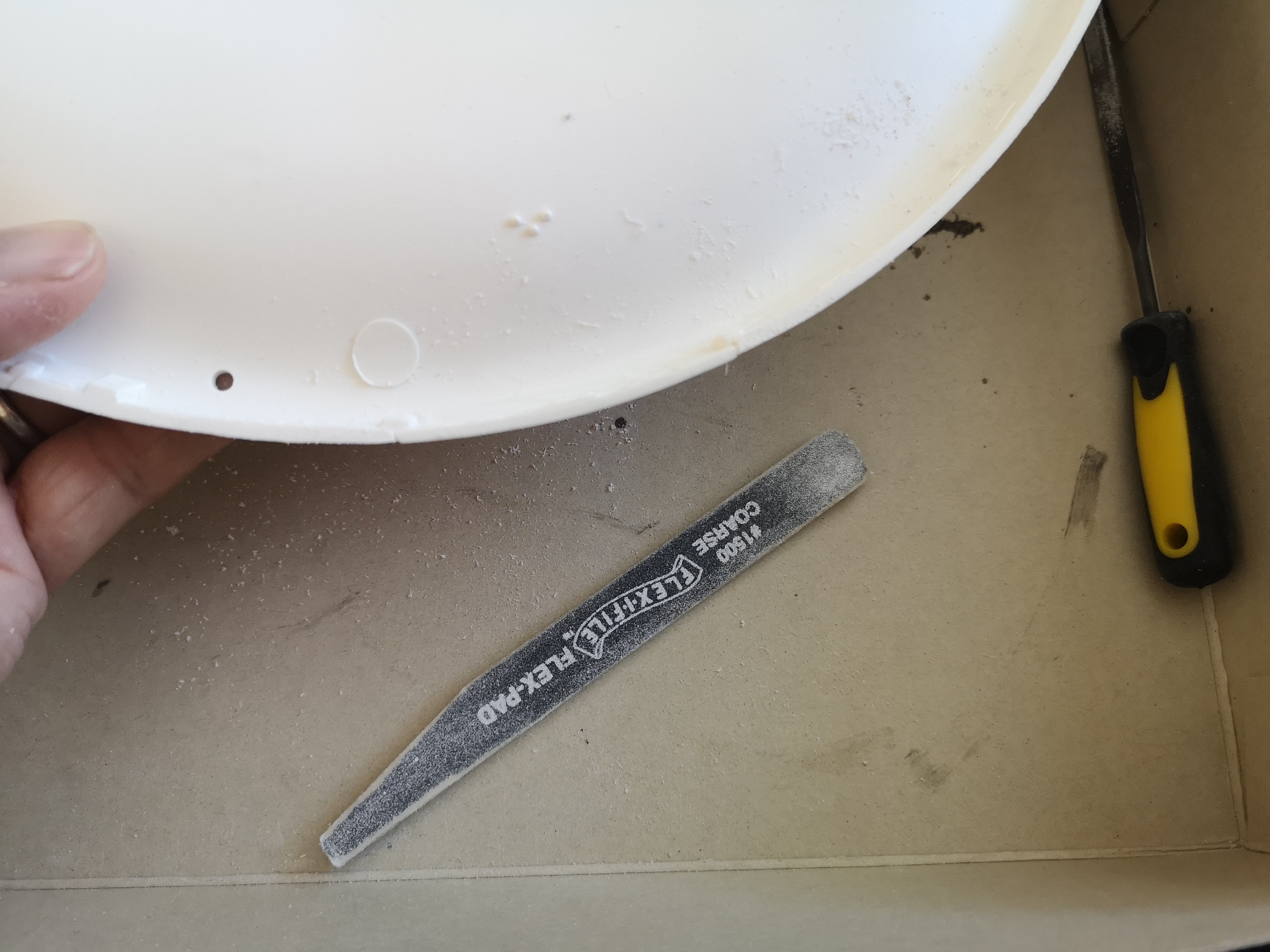

Sanding/puttying the extra grid lines should be fun.  I wonder if I should hose the thing down with Mr. Surface or Tamiya Surface Primer first just to see what I'm dealing with.  This might be the first model I ever used primer, lol!
With my history of sanding experience, I usually lose the details or panel lines I want to keep because I'm a bit sloppy when it comes to sanding.
I'm horrible at scribing too, but I decided to scribe the lines I wanted to keep.  I tried scribing from a blank once and ended up with a jagged zig-zag that looked more like battle damage than a panel line.
Anyway, we'll see what happens with this thing.  I feel like I've embarked on a 5 year mission to finish this thing, but I doubt I'll have the patience to build it past a week, hahahaha!

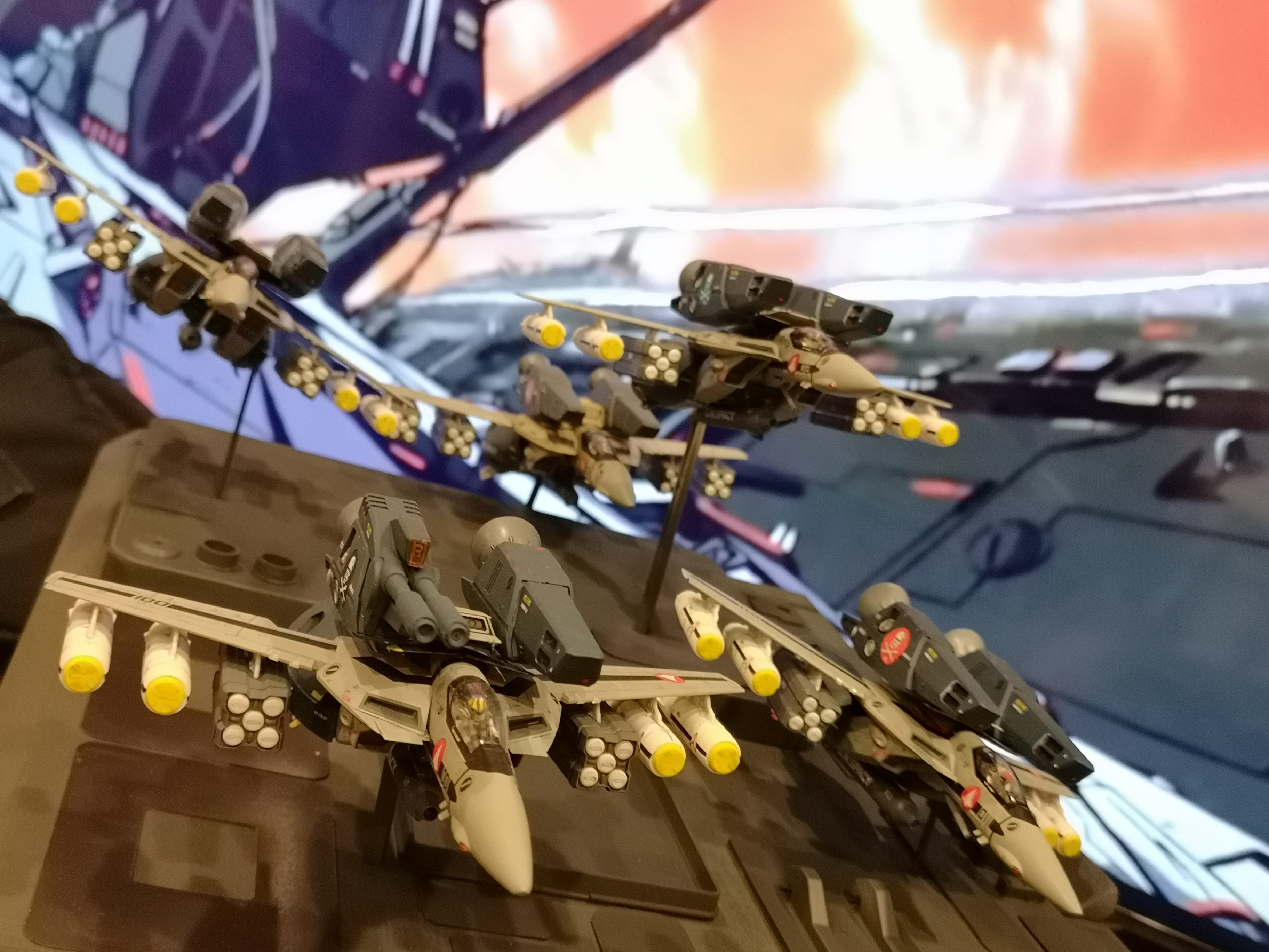

been working little by little on the 1/48 VF-1.
l love how the kit is mostly snap-fit-ish allowing for a lot of dry-fits.
Just wish Hasegawa made closed landing gear doors for their fighter models :(
Instead of building some complex plasticard structure underneath to support the doors I got lazy and just kneaded up a bunch of milliput and then gently pressed the trimmed doors into the milliput until they were aligned as best as they could be. after it cures I can do a little more filling / sanding to make it all flush.

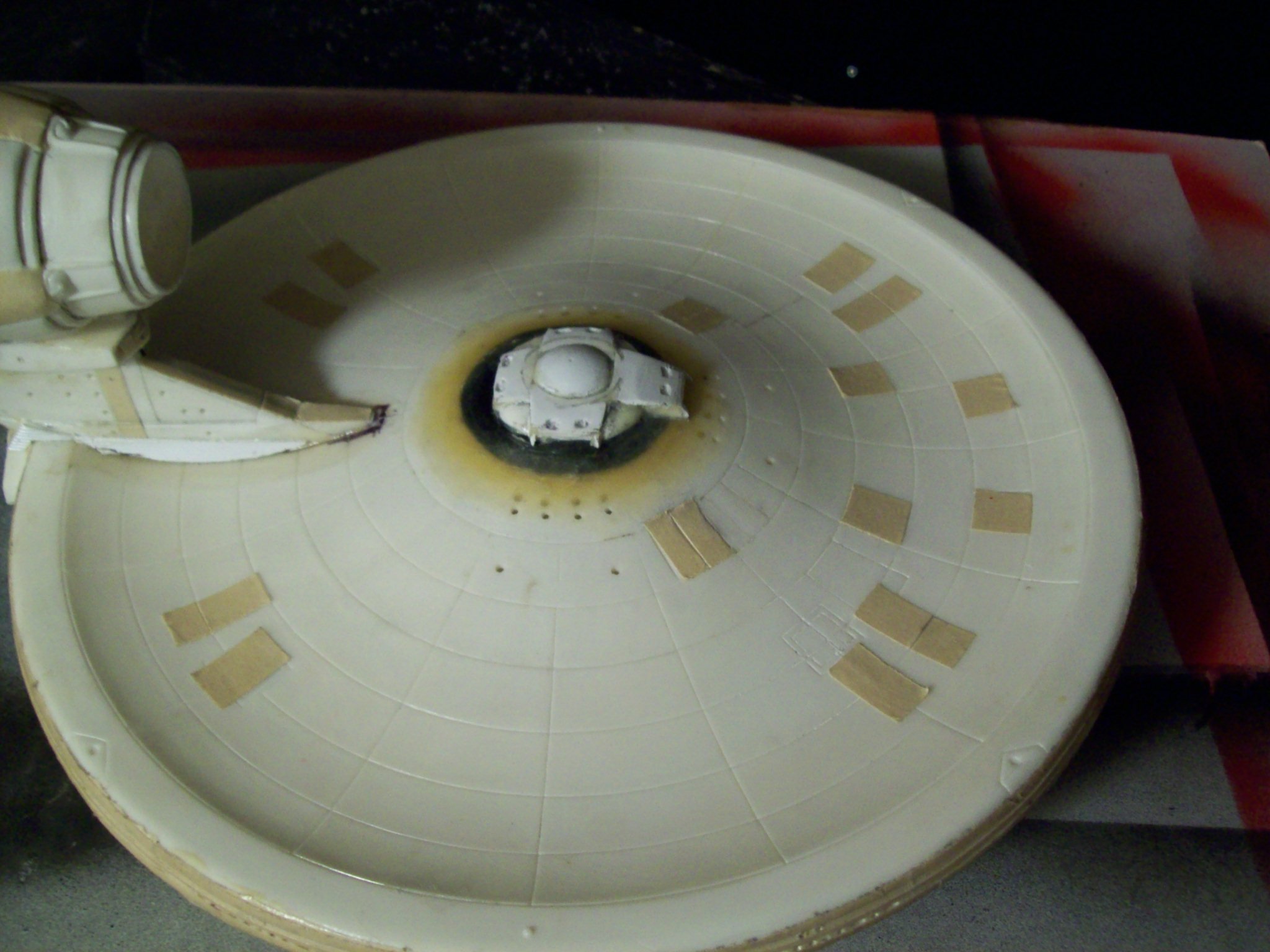

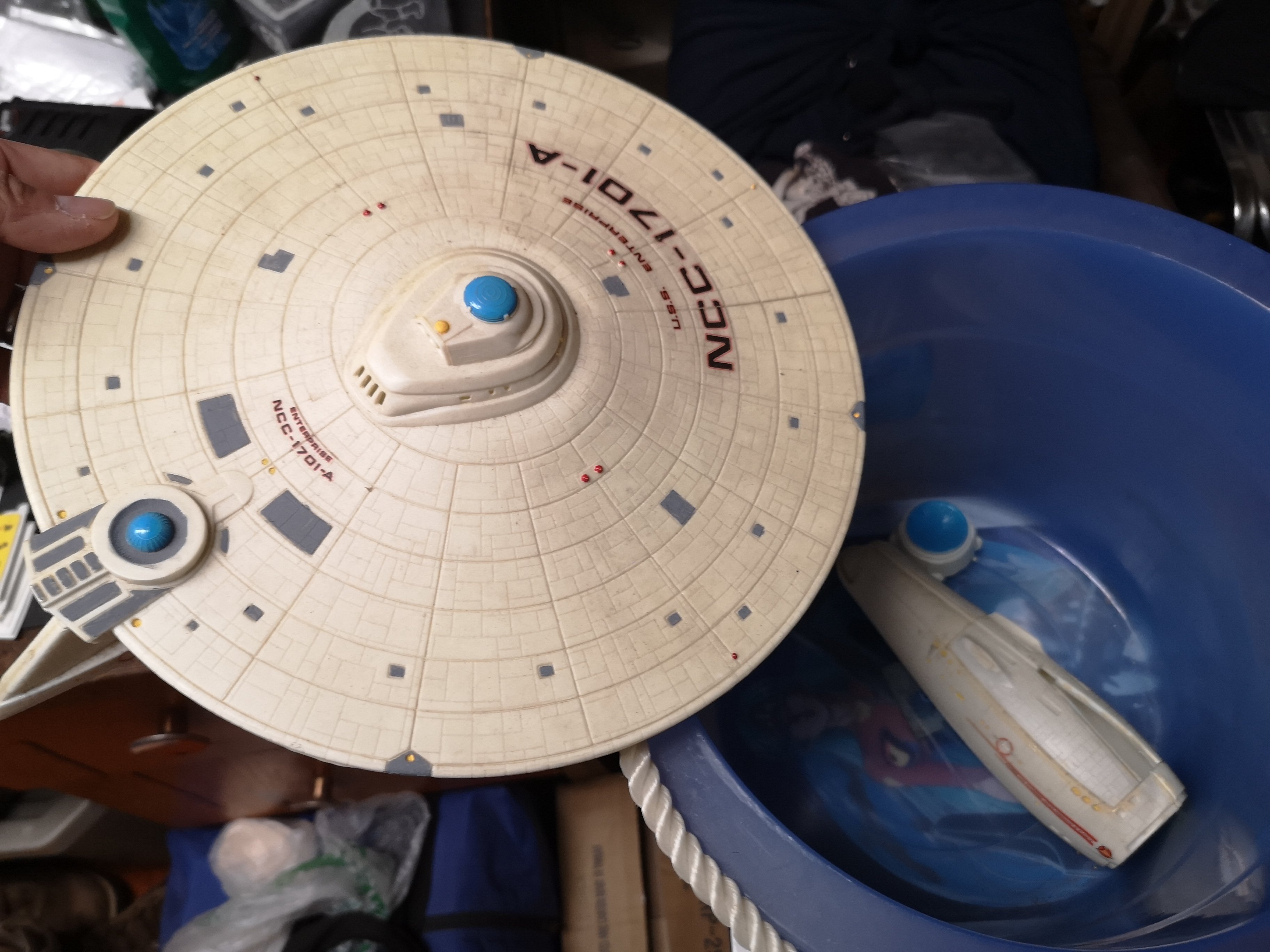

Found the remains of my highschool build:IMG_20200719_110509.jpg.554e8db1f6ceee5d9be47cbd15c70c68.jpg
I'm hoping the new one will turn out a bit better than this, hahHa!

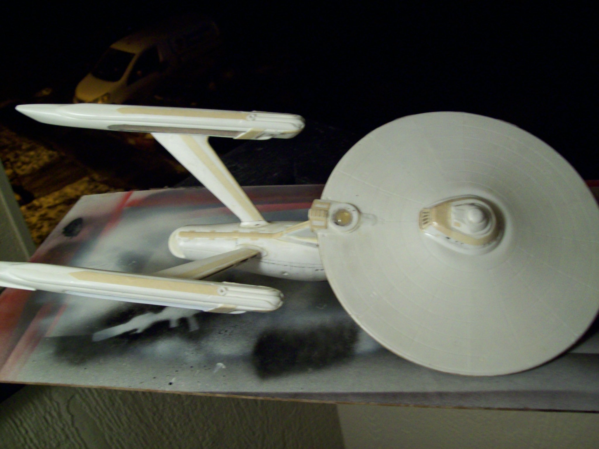

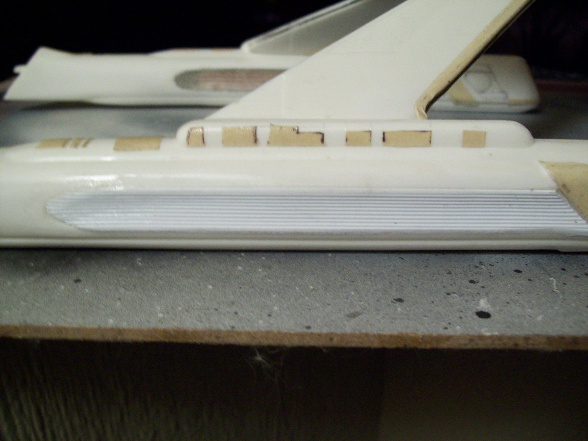

I have a 1/537 that I'm STILL trying to finish:
993689302_000175.jpg.2c03a690c0207b59c7f42f067157930b.jpg 608184483_000176.jpg.d74ceb2967733fcd15b5d37263491a84.jpg 1141635694_000177.jpg.188d04963750f354f59a0279aa99e5dc.jpg
771345694_000178.jpg.4e98f8f817d1ff0bed8bb88e72215141.jpg297672786_000179.jpg.3d18e577f61904f89f562fabbff11031.jpg

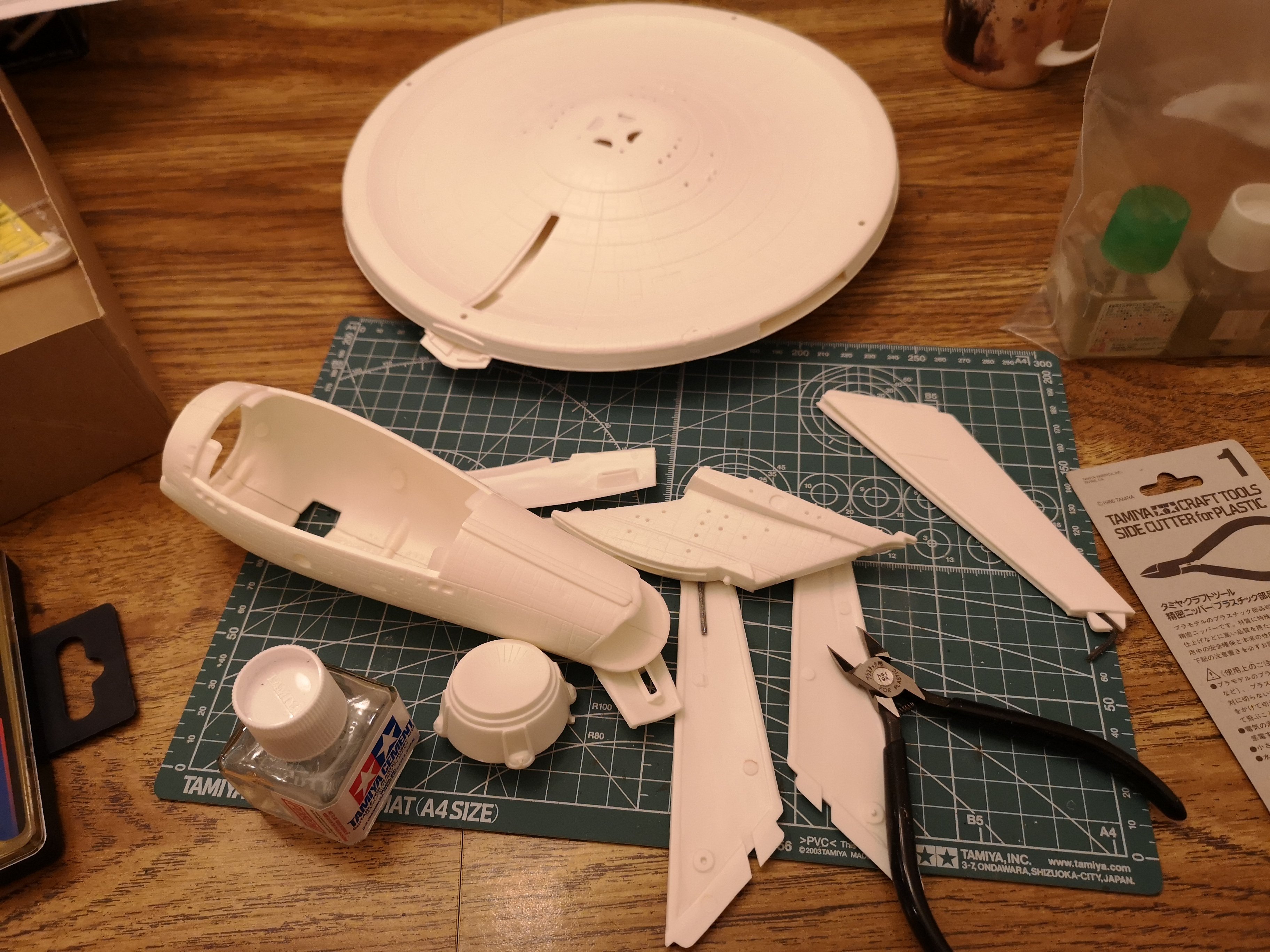

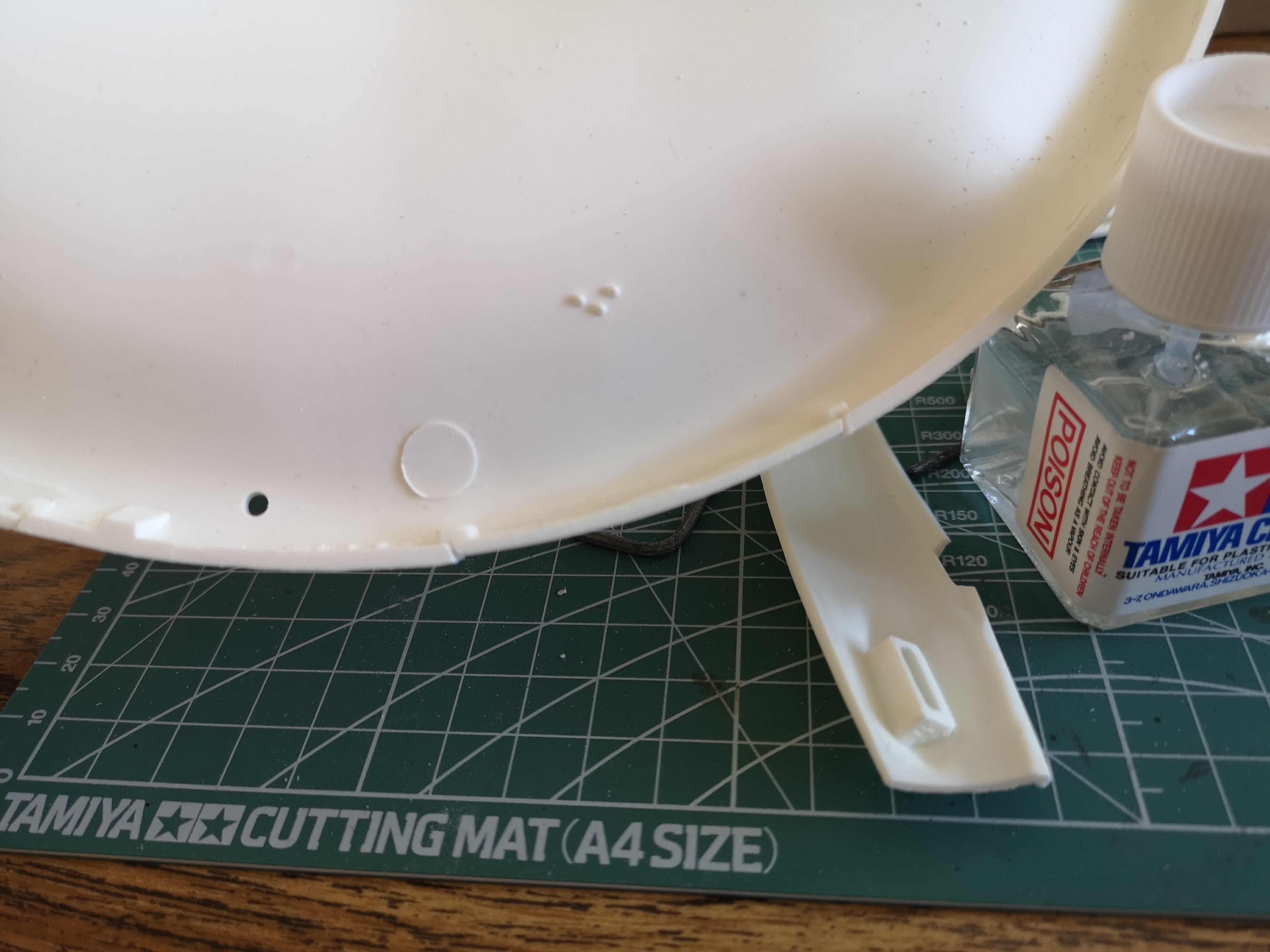

Lovely fit right out of the box:
Sarcasm.
Some of these fit certain parts of the saucer better than others.IMG_20200720_083040.jpg.07c473bd2a7d441473d51c6e2b9057d0.jpg
Most require fitting though
Beforr
After.  Will still require filling once fitted.
