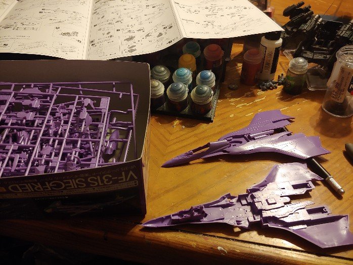

Focslain Posted April 17, 2020 Posted April 17, 2020 So sorry for the lousy picture. I use my phone and the lighting at my work spot isn't the greatest. So after a looong time doing 40K models, I needed a break and started on the Hasagawa models I got. This is the first of five. Plan is to recreate the launch scene from 3rd Live.

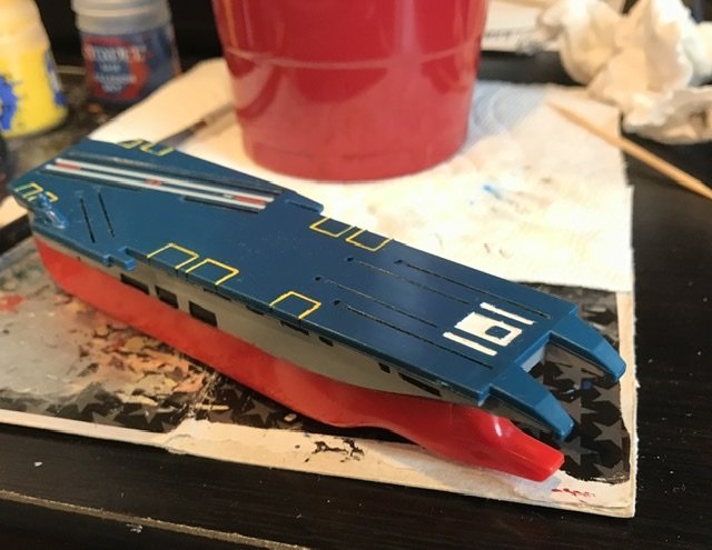

Mog Posted April 18, 2020 Posted April 18, 2020 Don’t wanna hijack tekering’s thread, so here’s my detailed up Prometheus: Mad props to @nightmareB4macross. Yes, I stole your idea for using yellow paint to detail out the elevators. Still working on the Daedalus side details, and I’ll see how badly I skunked up on spray-painting the Matchbox SDF-1’s parts. Been awhile since I spray-painted a toy. I’m horribly out of practice.

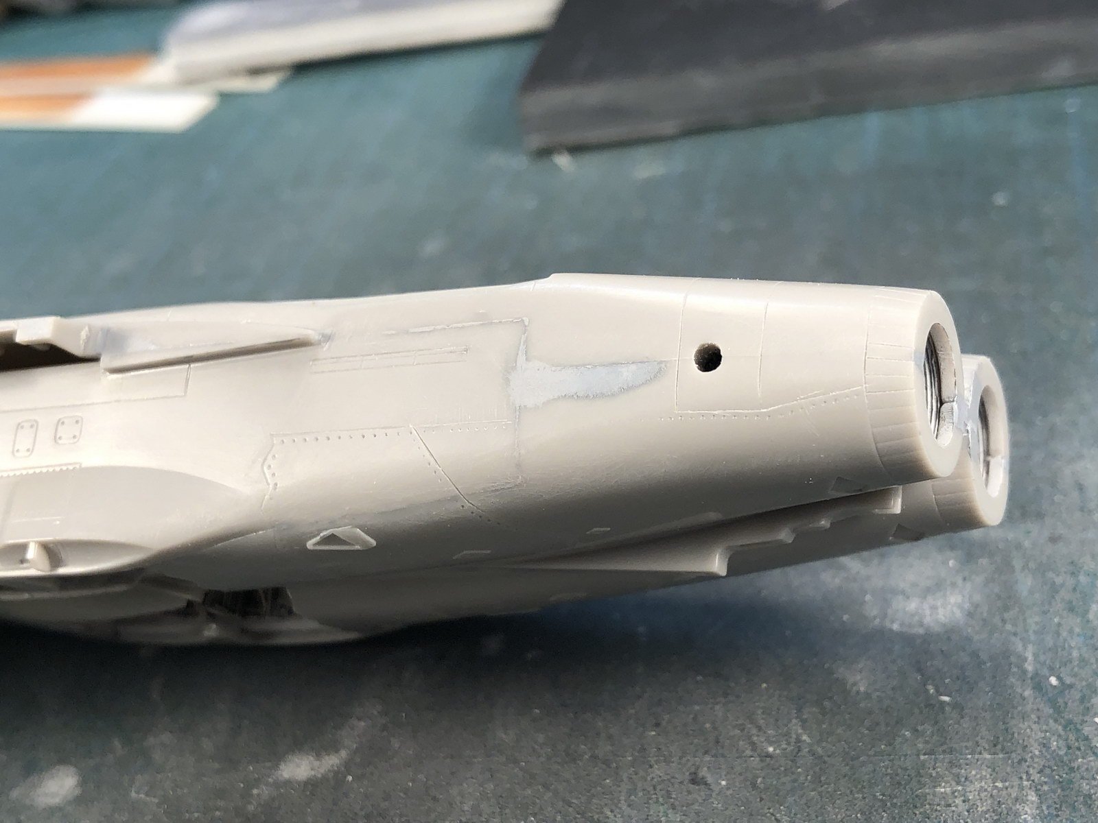

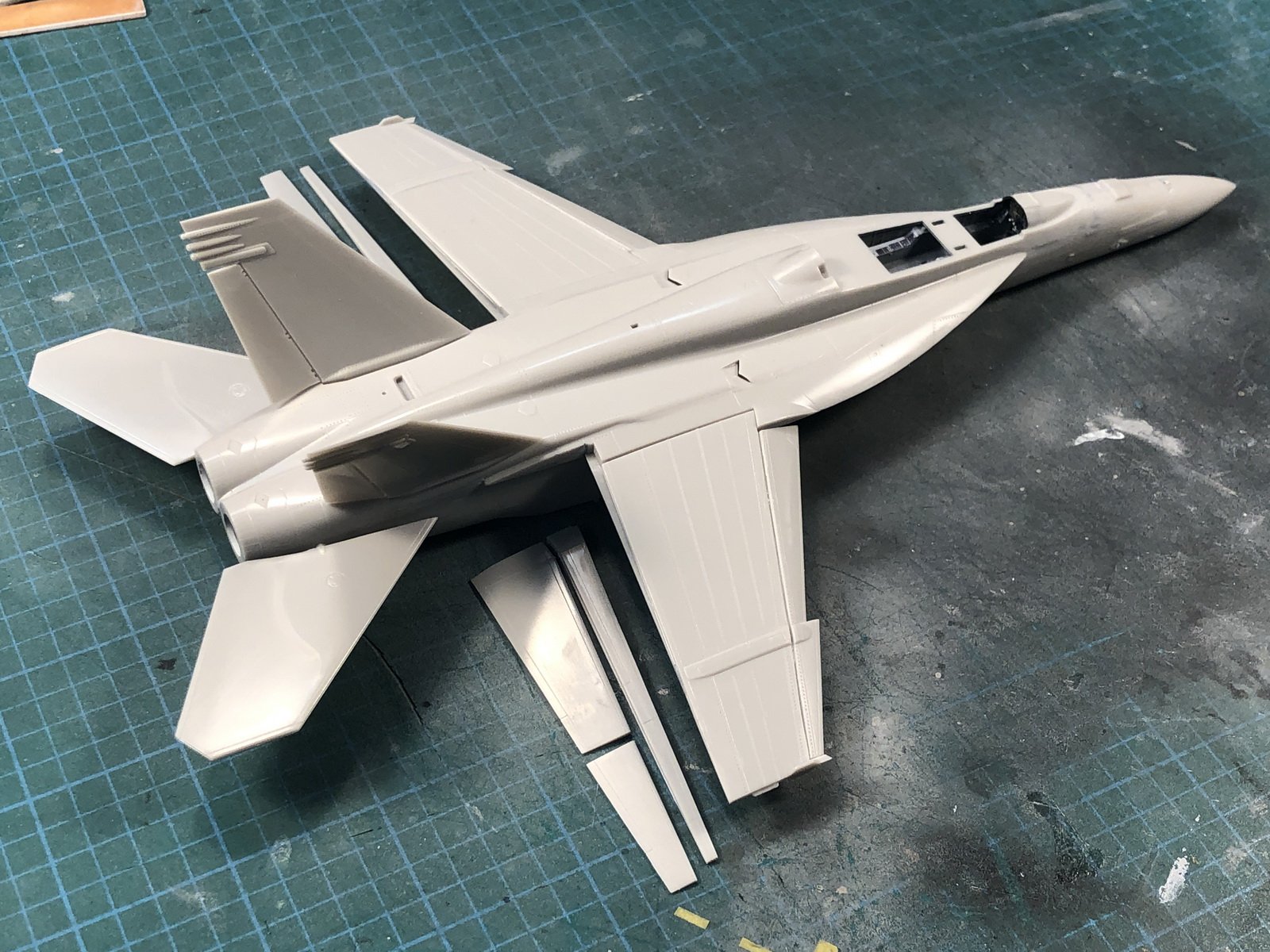

wm cheng Posted April 19, 2020 Posted April 19, 2020 I HATE SANDING!!! POS kit... Definitely do not recommend, no intake trunking at all, I had to build an internal ramp to smooth out an area that would have been so hard to sand flat and flatten the back to have a surface to spray black on instead of just seeing into the plastic guts of the fuselage and no room to put in the full length of the afterburner interior (had to cut those down way too short to fit into the fuselage. Also horrible way to attach the main wings to fuselage assembly, tabs but nothing to tab into structurally, just glue holding against gravity! Also, I made the mistake of thinking I could just alter and make the Aires F-18 Hasegawa resin landing gear wells work with Hasegawa F-18F kit - you can't without tons of surgery, I ended up grinding down the forward gear bay till it was paper thin and the footwell of the cockpit and I was still short, I ended up slicing the wheel bay and making it much shallower than intended to fit both the cockpit and landing gear bay into the forward fuselage. This has been hell almost in the realm of my Bandai VF-25 transformable kit. Definitely not an easy build that I thought I would dip my toes back into the hobby with. It felt like there was more putty and surfacer than there was bare plastic!

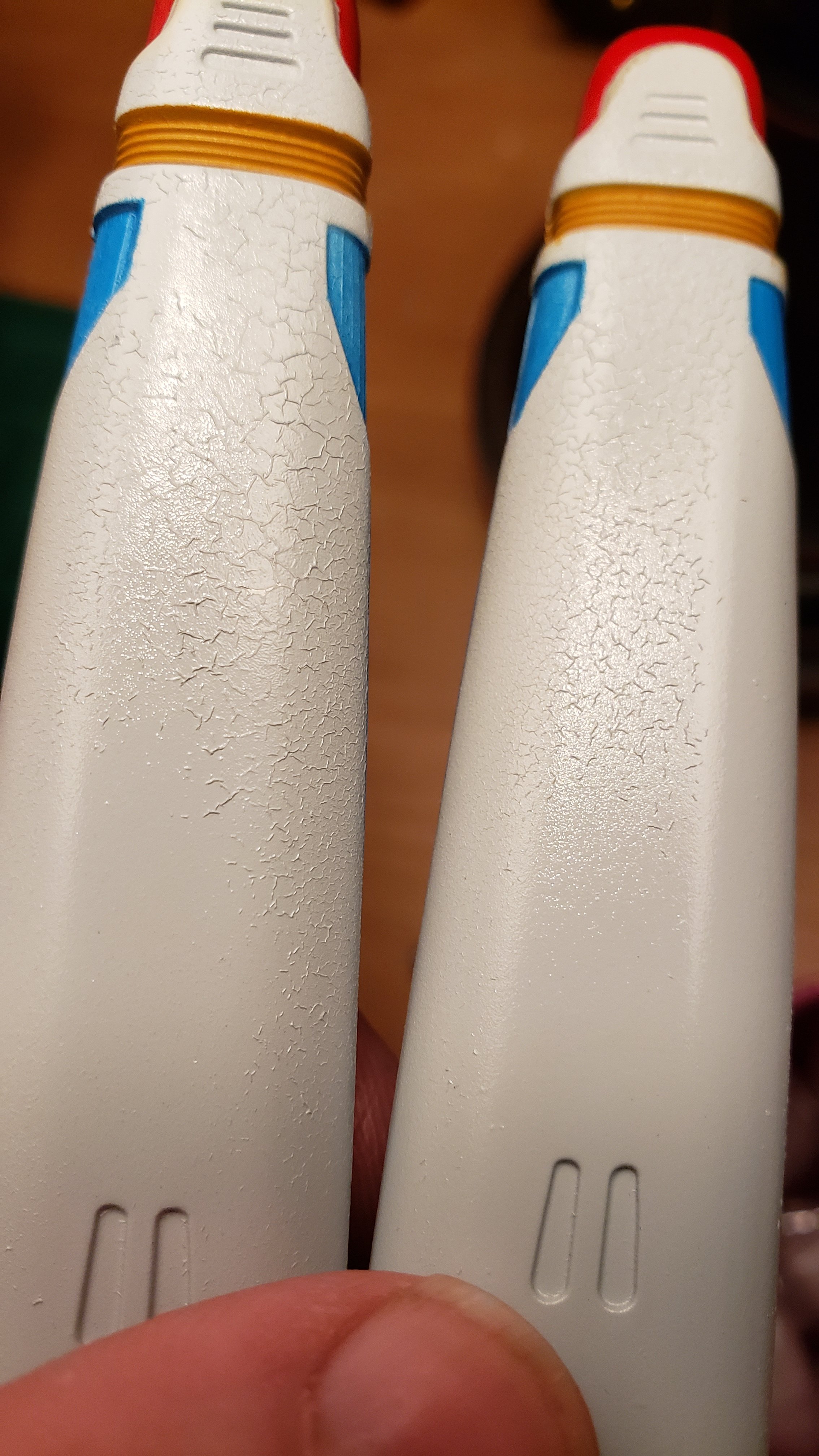

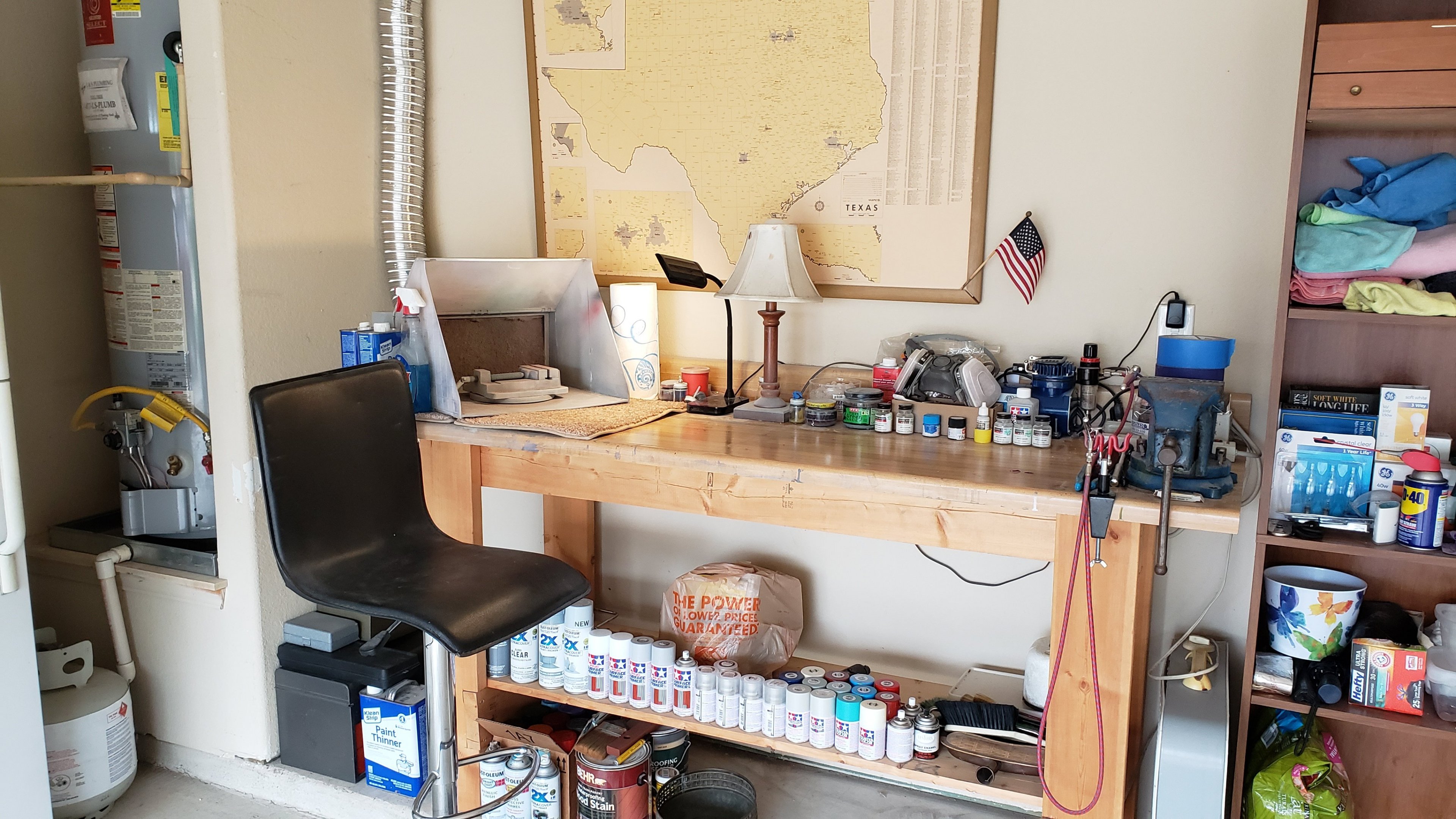

derex3592 Posted April 19, 2020 Posted April 19, 2020 I feel your pain @wm cheng!!! My life today... Wake up, detail touch up Ent D nacelles, which looked PERFECT!... go to garage for quick clear coat with Tamiya TS-13. Good. No worries right? Return to garage shortly thereafter to start 7 hour full garage cleanup and find out that indeed it wasn't that new Clear Coats fault last time.. See 1st pic. Come to find out that the Tamiya can actually SAYS.. DO NOT USE UNDER 50 Degrees. Well FML... it was warmer in the garage but when I opened it up.. Yuppers 48 degrees outside cold that came right on in. Here we go again. I hate myself SO much. If I'd only waited 2 hours.... LOL. On the other hand.. Got the workbench area cleaned up and organized!
Thom Posted April 19, 2020 Posted April 19, 2020 @wm cheng Despite the trials she's coming together nicely. The last F-18F I put together was Academy's 1/72. Push fit, but still a good looking result with a little work. @derex3592 Ouch, quite the peel! At least it was before decals. As for the bench, really nice!
electric indigo Posted April 19, 2020 Posted April 19, 2020 @wm cheng That's how my Skyhawk looks, too. Just look at a current Revell kit and you'll appreciate Hasegawa again. @derex3592 That must have hurt. How about water based acrylic clear coat (like this one)? _ Got the final color of the camo done today:
Bolt Posted April 19, 2020 Posted April 19, 2020 That looks really good @Mog @wm cheng you're still making that bird look good! Even (or especially) with the blood , sweat and cursing. OH man @derex3592 another step back, dang! I hope that's not too hard to correct! The work space looks great. I just reorganized mine too. Gets hectic quick.. Excellent job on the camo @electric indigo ! That looks awesome!
pengbuzz Posted April 19, 2020 Posted April 19, 2020 Man, Derex! That one is just cursed it seems! I had that happen with one of my models in the past: I ended up simply scuff-sanding it smooth, using steel wool to remove any residual paint crack marks and then repainting it. I hope you can do liekwise with this, but I'm honestly sorry that you're going through hell here!
wm cheng Posted April 19, 2020 Posted April 19, 2020 @derex3592 Ouch! I feel your pain - yes so glad that happened before the decals. Been there buddy, you're making me want to build my Star Trek kits (found a Tamiya & Mr. Color pearlescent white paint too) @electric indigo Another smooth as silk perfect paint job!!! Wow, I will try your pre-shading this time (if I ever get to that stage!) - I've always used post shading, but I love how subtle your pre-shading is looking. Thanks for the kind words of encouragement and misery is company so strangely I do feel better. Back to the grind sanding now (although I am trying to cut out the flaps, ailerons and slats to break up that huge wing surface a bit - I think I'm a sucker for punishment :P)

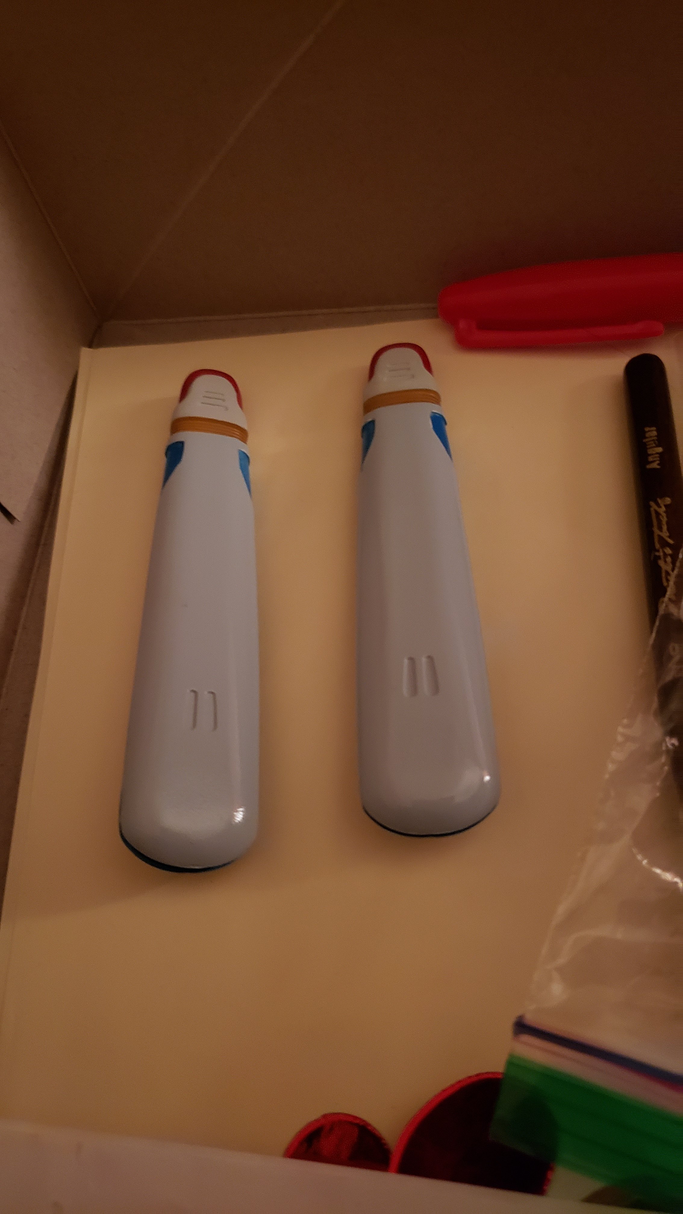

Bolt Posted April 20, 2020 Posted April 20, 2020 2 hours ago, derex3592 said: "Resume course Mr. Data...warp 7. Engage RFO! Looks awesome. Great recovery mate!
joscasle Posted April 20, 2020 Posted April 20, 2020 4 hours ago, derex3592 said: "Resume course Mr. Data...warp 7. Engage." Great!!!
505thAirborne Posted April 20, 2020 Posted April 20, 2020 5 hours ago, derex3592 said: "Resume course Mr. Data...warp 7. Engage."

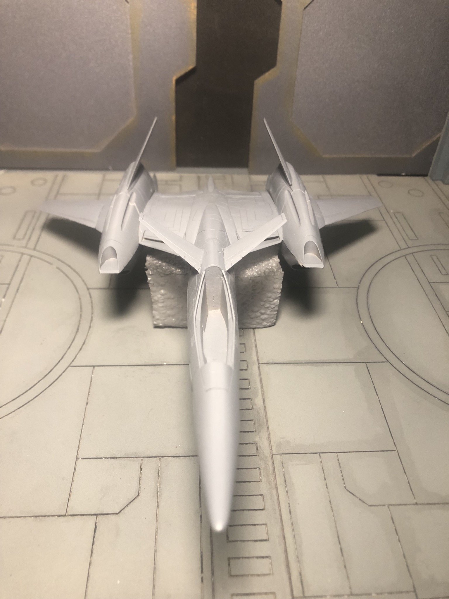

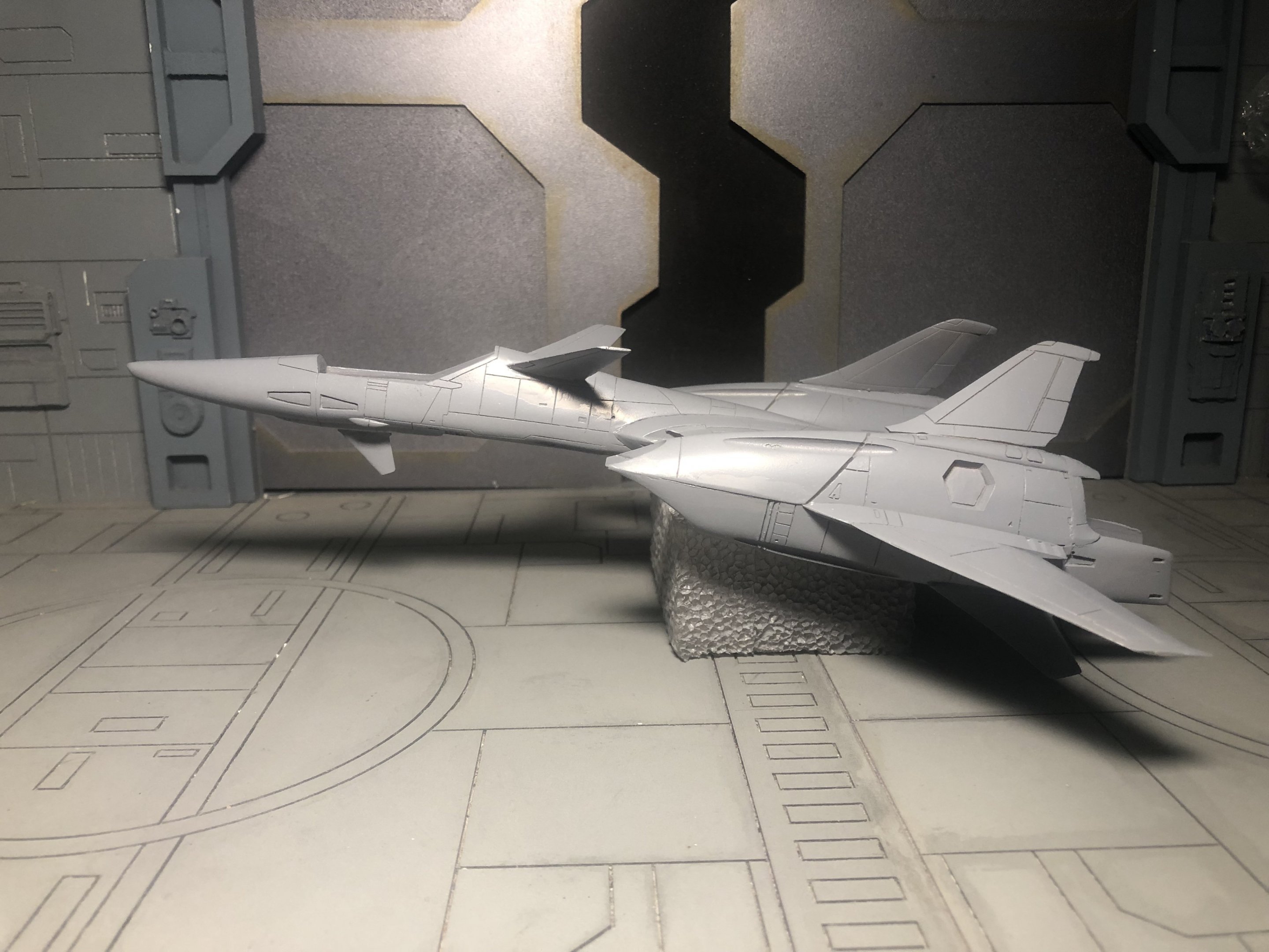

Bolt Posted April 20, 2020 Posted April 20, 2020 As i get close to finishing a few other kits, I've started another 1/72 for my Megaroad-01 hangar. This is the Hobbyexpro resin model. Needs a bit more sanding and filling. It really helps me to have that first coat of paint on. I often miss spots until the paint reveals the truth. See you next deculture
Thom Posted April 21, 2020 Posted April 21, 2020 @derex3592 Very nice recovery! And a lovely looking VF-4 @Bolt

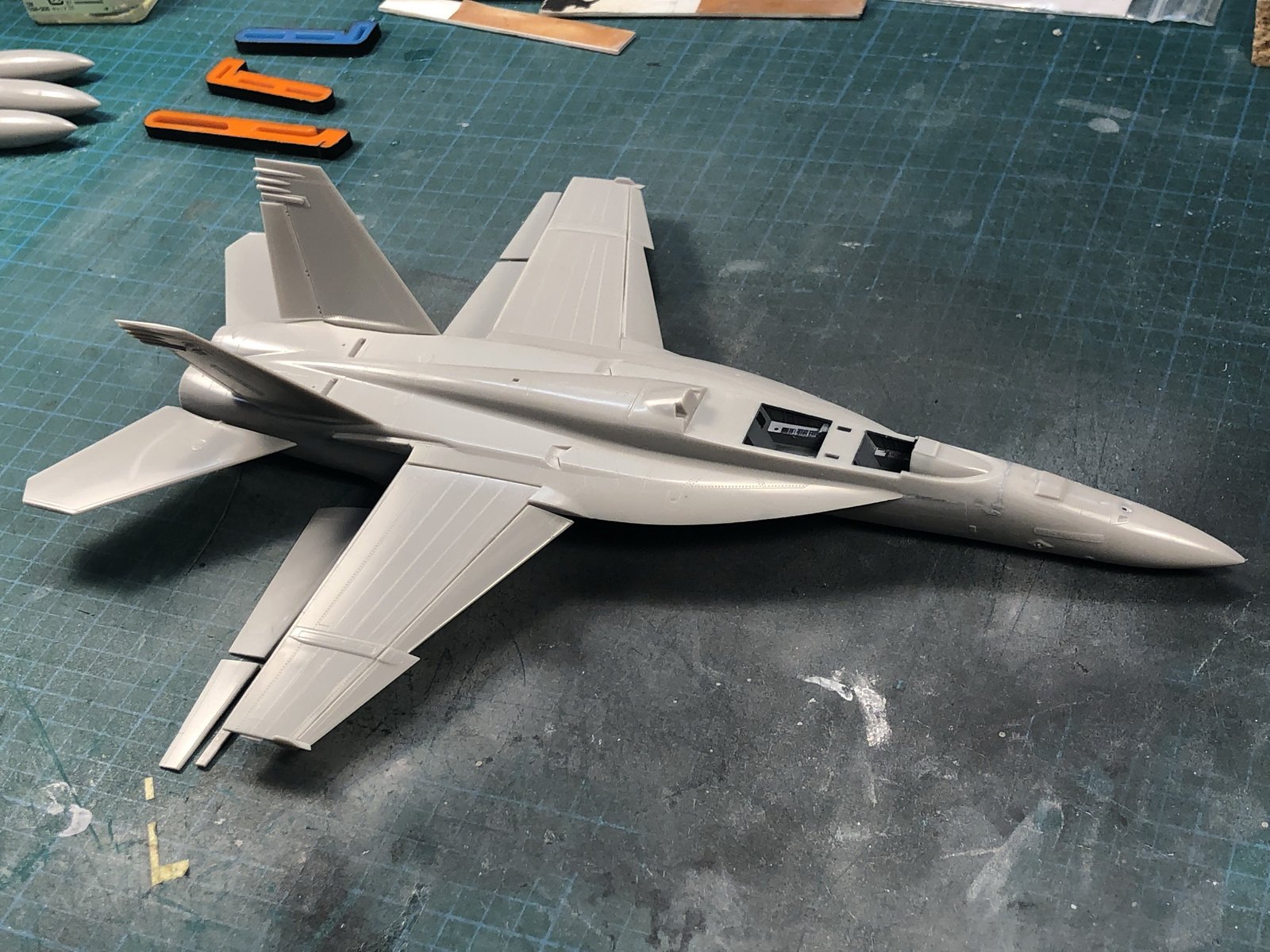

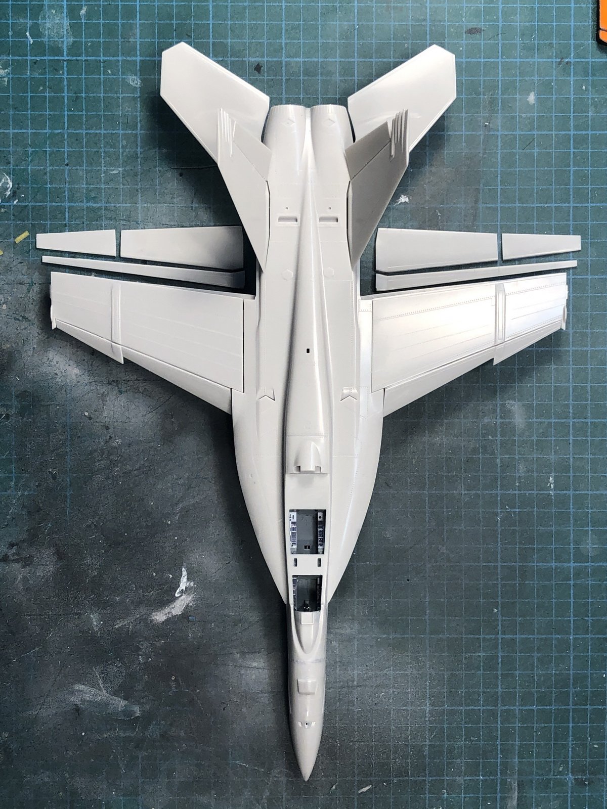

wm cheng Posted April 21, 2020 Posted April 21, 2020 OMG! Starting to finally look like a plane... I love painting and decaling, but I hate the prep work beforehand - however without the prep, the painting would suck.

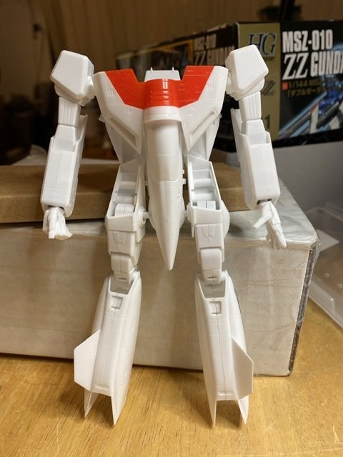

Kelsain Posted April 22, 2020 Posted April 22, 2020 Made some more progress on the VF-1 Battroid this week. Maybe I’ve gotten used to Gundams, but Jeebus, what is going on with these hip joints?
Thom Posted April 22, 2020 Posted April 22, 2020 13 hours ago, wm cheng said: OMG! Starting to finally look like a plane... I love painting and decaling, but I hate the prep work beforehand - however without the prep, the painting would suck. Real nice progress you got! I had dropped the slats and flaps on the 1/72 Academy Super Bug. Turned one part into ten and then had to put them all back together again. Sure feels nice getting some construction done, doesn't it? 9 hours ago, Kelsain said: Made some more progress on the VF-1 Battroid this week. Maybe I’ve gotten used to Gundams, but Jeebus, what is going on with these hip joints? Looking good! Though I have to agree, those hips joints have been the weakest part of the whole design. I remember doing the old Bandai where you had to change out the entire nose cone for Battloid mode. Still got some parts left from that one...

pengbuzz Posted April 22, 2020 Posted April 22, 2020 17 hours ago, Kelsain said: Made some more progress on the VF-1 Battroid this week. Maybe I’ve gotten used to Gundams, but Jeebus, what is going on with these hip joints? Honestly, I would trade out those plastic hip joints for some metal rod or something. That looks hella weak (not your fault!).

MechTech Posted April 23, 2020 Posted April 23, 2020 Sorry about the fit issues wmcheng! One of our club builders is having the same issues. He's about to get covers for all the vents! He's even coated the interior with latex which now looks like Derex's nacelles. I HATE sanding too! Your model is looking great with the flying surfaces cut out. That sucks Derex! Once again, great recovery! And it's probably smoother than an androids butt, but I have nothing to compare to. Electric Indigo, your finish is smooth as always! What ratio of paint to thinner do you use? We have some guys in our club that thin down something like 8:1. They do a ton of coats to build it up. Their bottles look like thinner with a thin layer of paint at the bottom. Kelsain, I agree, go brass with the joints (or ABS sprue). I built my classic 1/48 Hasty knowing the stock knee joints needed reinforcing. I finished the model and the knee broke after completely finishing it off. To make it worse, wires run through it for batteries in the feet. I just can't rip it all up now to fix it without doing major surgery. - MT

Kelsain Posted April 23, 2020 Posted April 23, 2020 Thanks for the tips. At least I’ll have an idea of what to do if it breaks. I’m not intending to do a lot of reposing once it’s done, so maybe it’ll be ok. Also, a good lesson of what to do if things go wrong for my young bench-mates.
