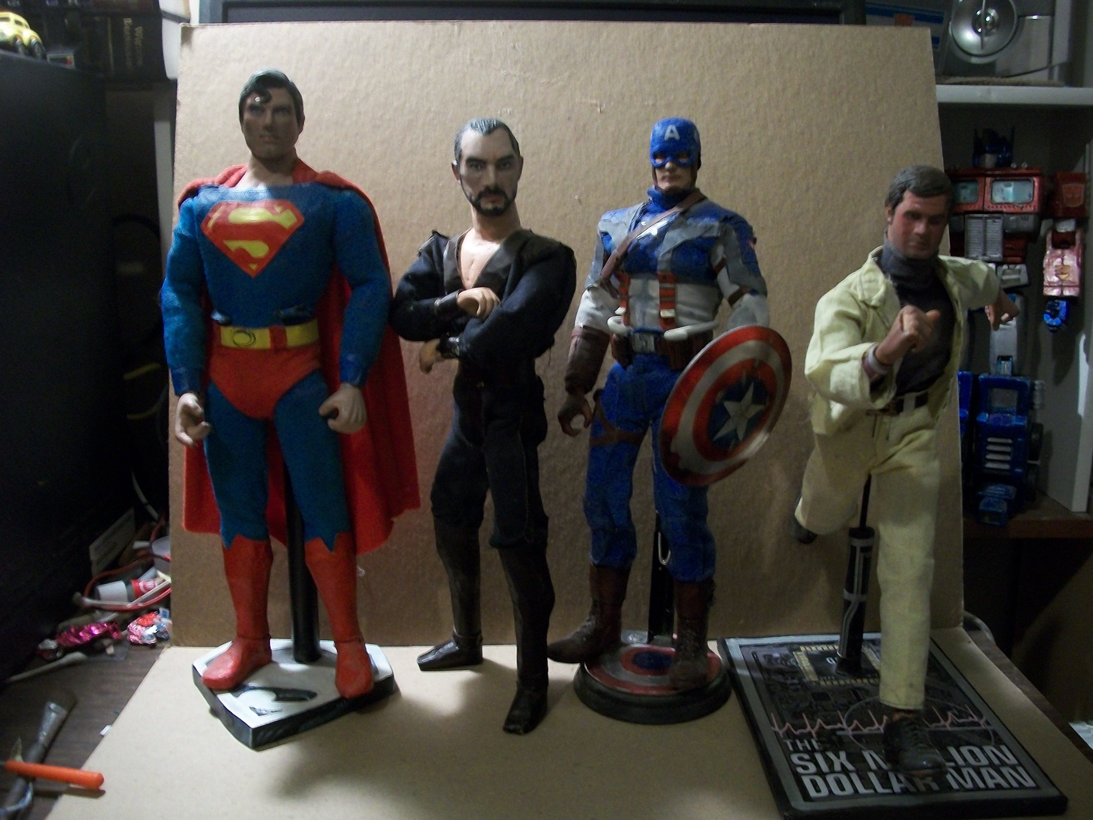

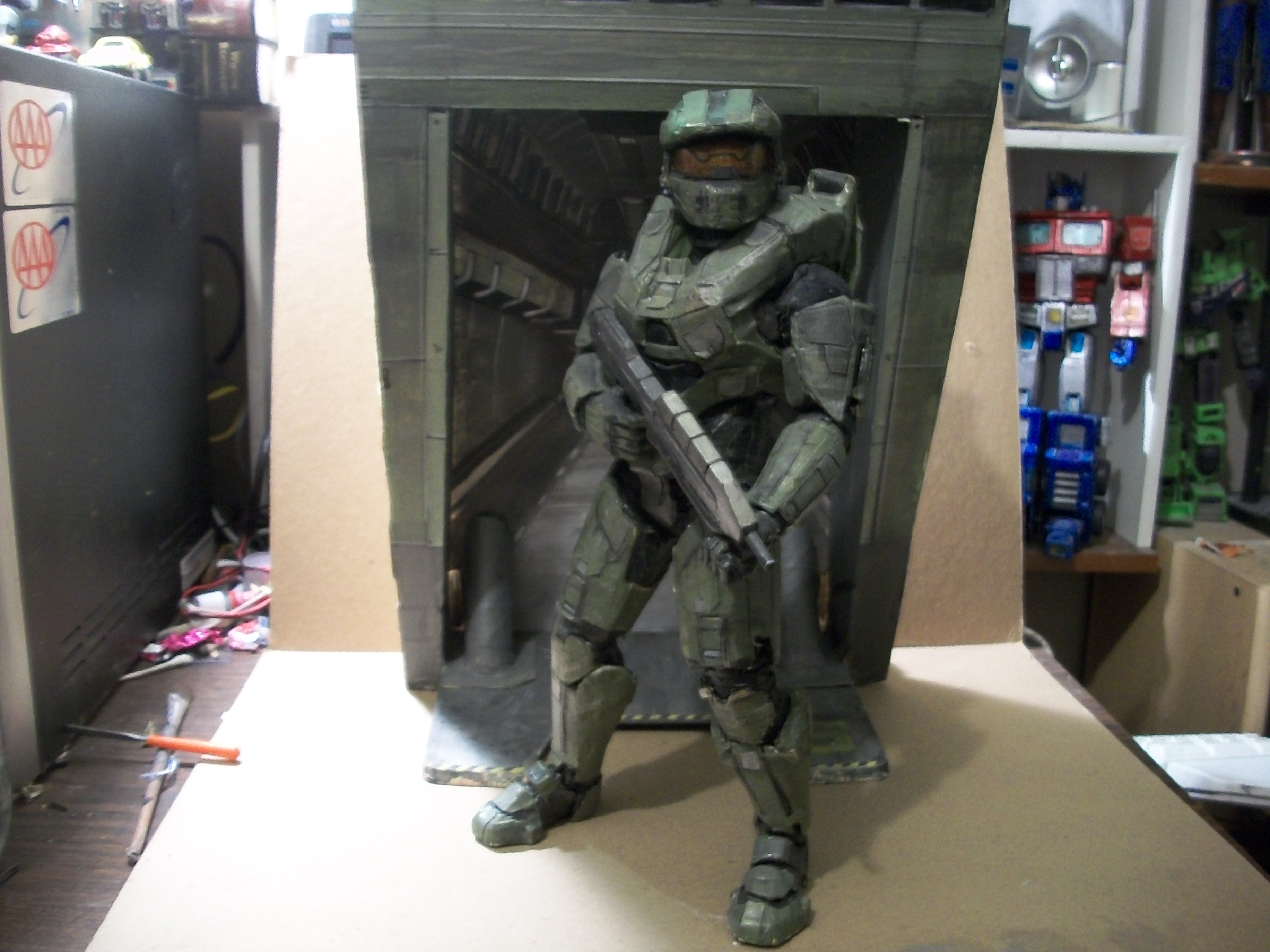

15 hours ago, arbit said:
Some unique skills there Pengbuzz.  I think you could try sculpting.
I already do:
3 hours ago, Thom said:
Dang, Peng, that Pod looks awesome! And nice sculps. Supes and Cap look incredible!
Thanks! General Zod came out so-so ( I don't like the character anyways :p )., the six million dollar man...well, he was only a buck at the thrift store. lol

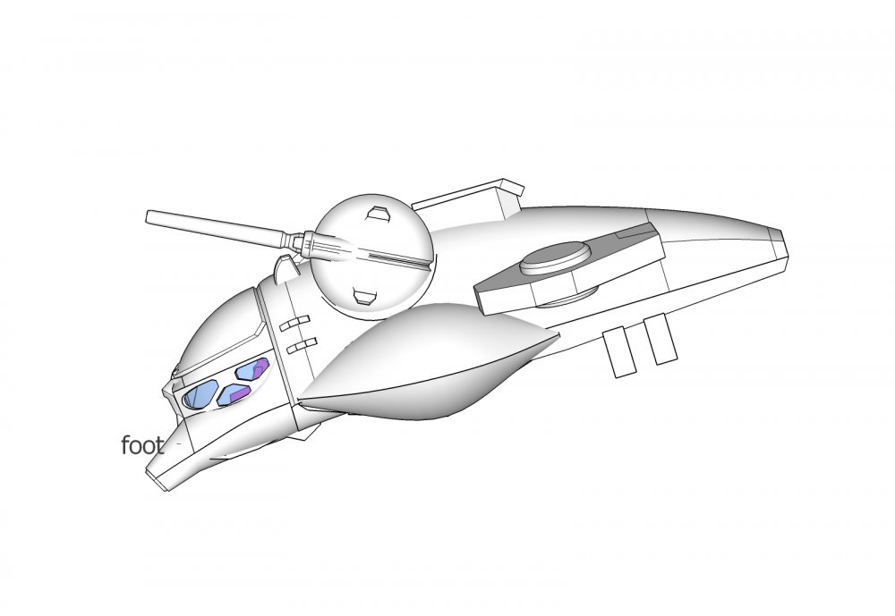

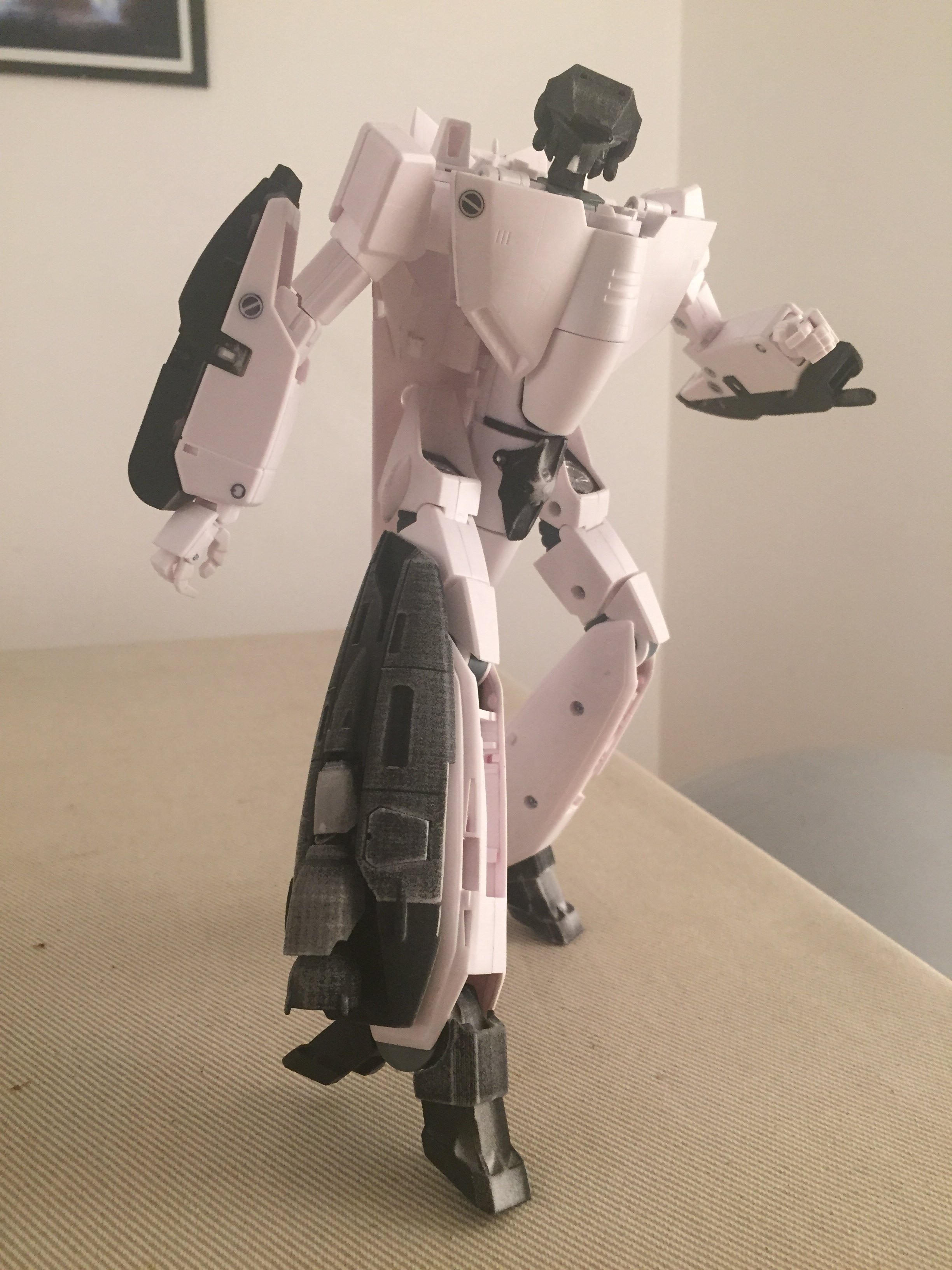

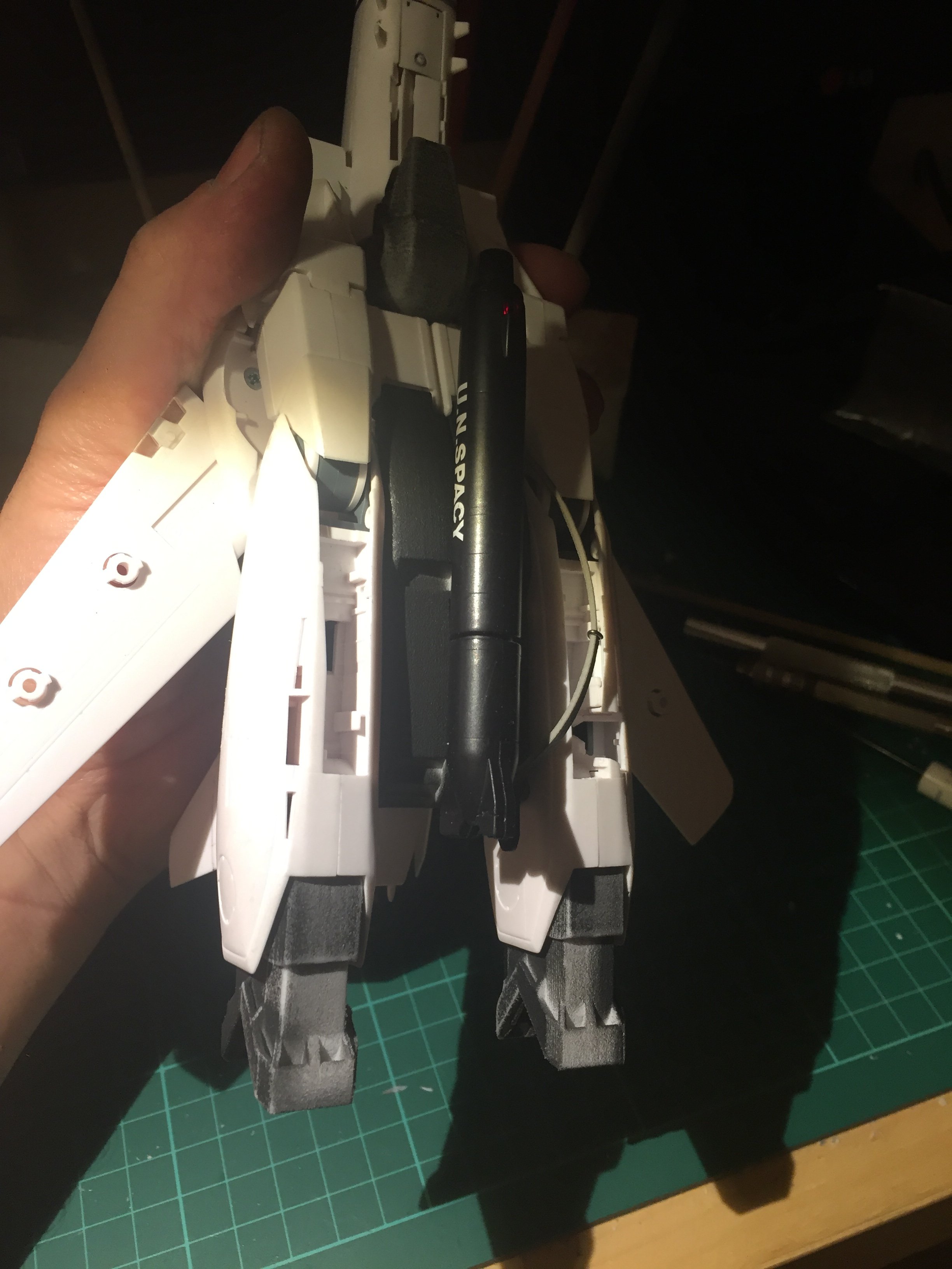

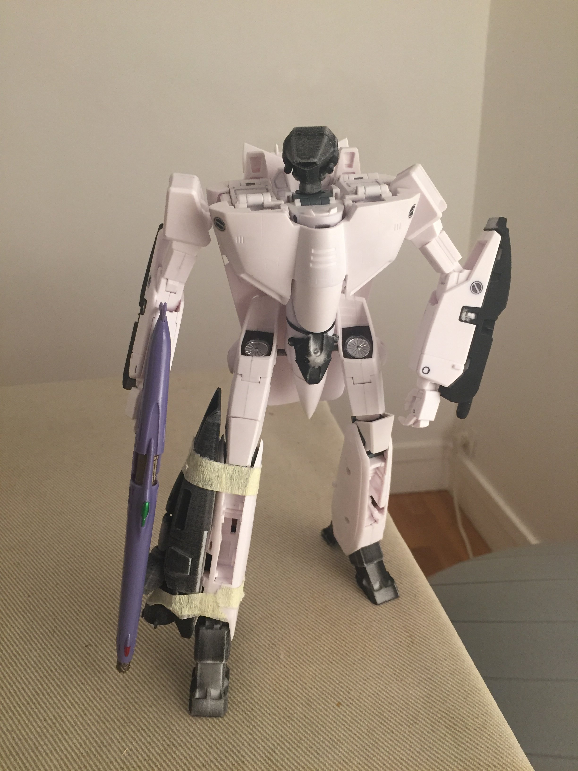

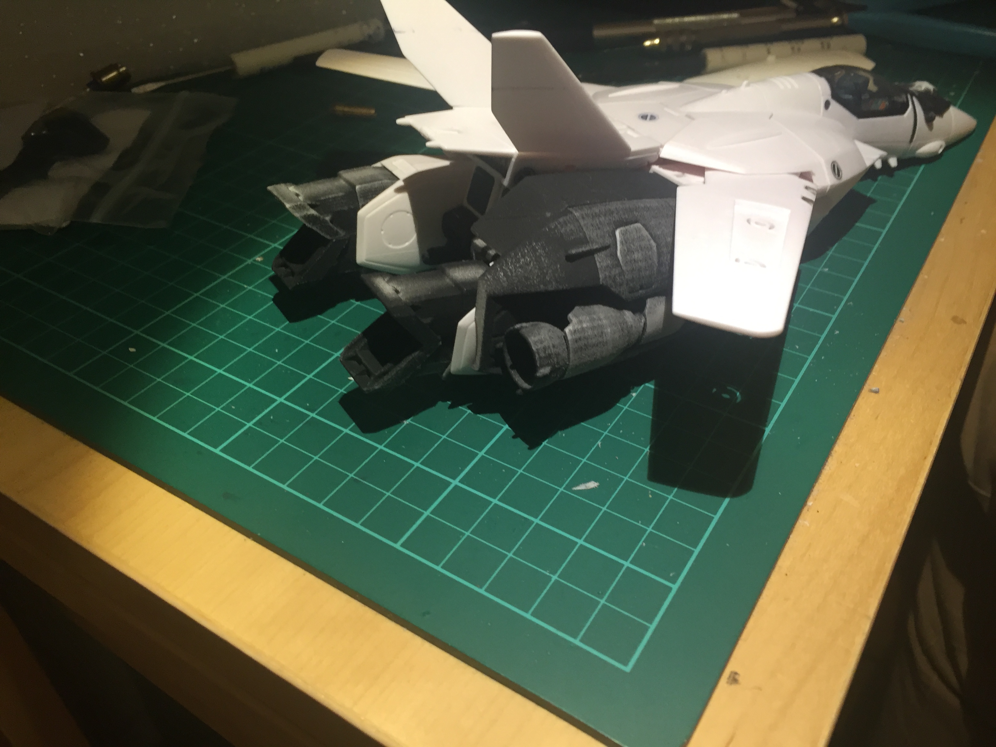

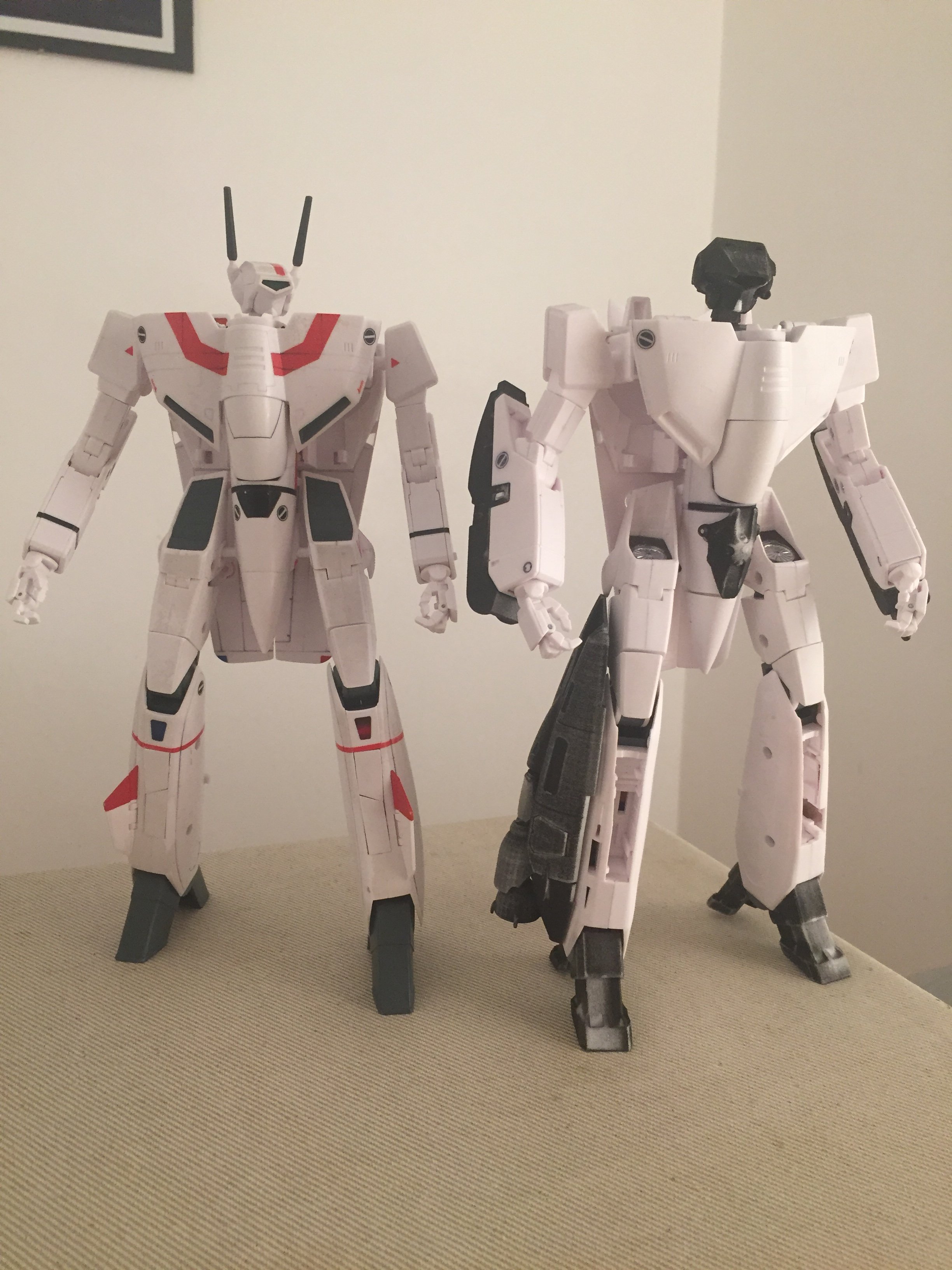

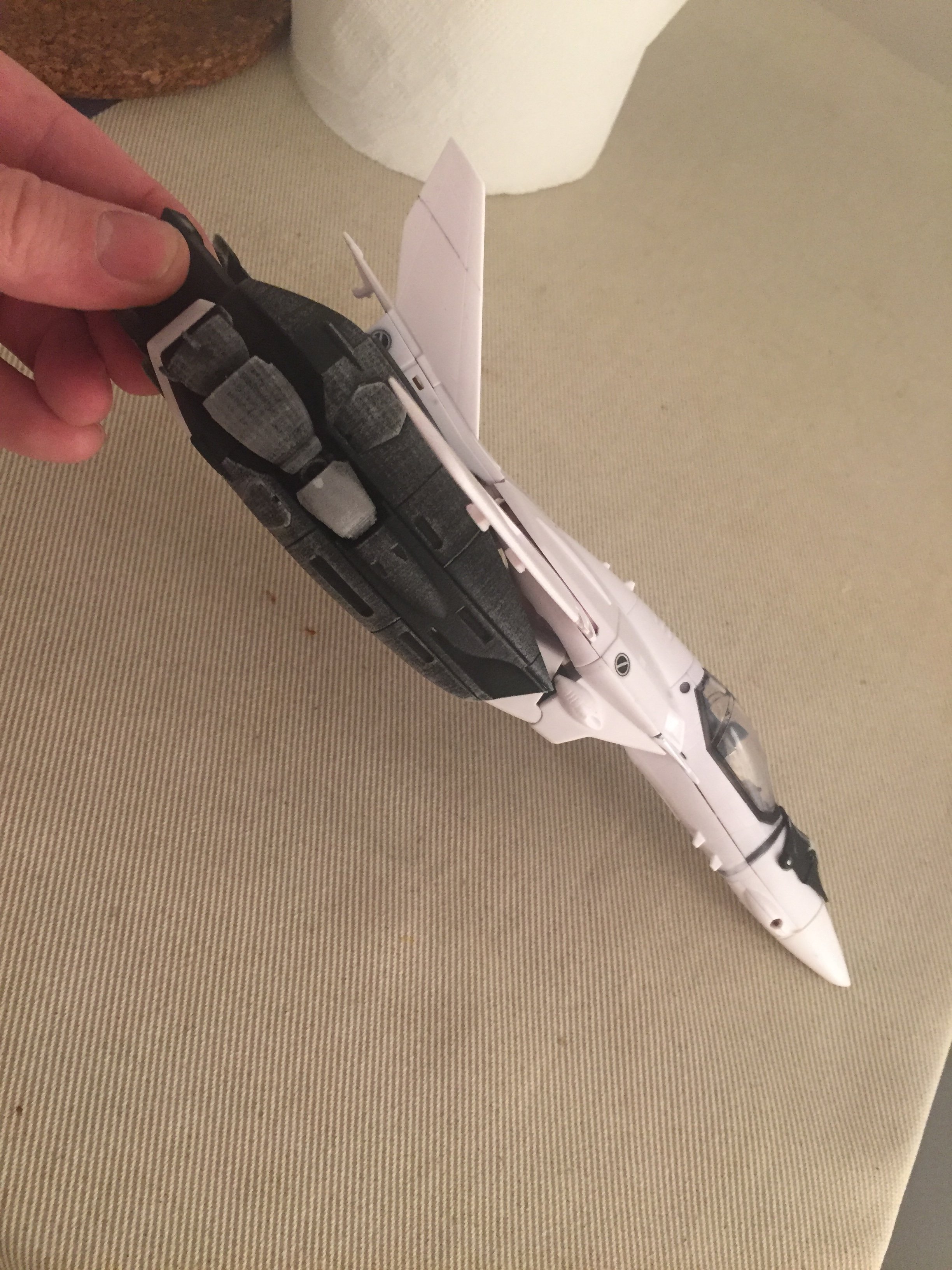

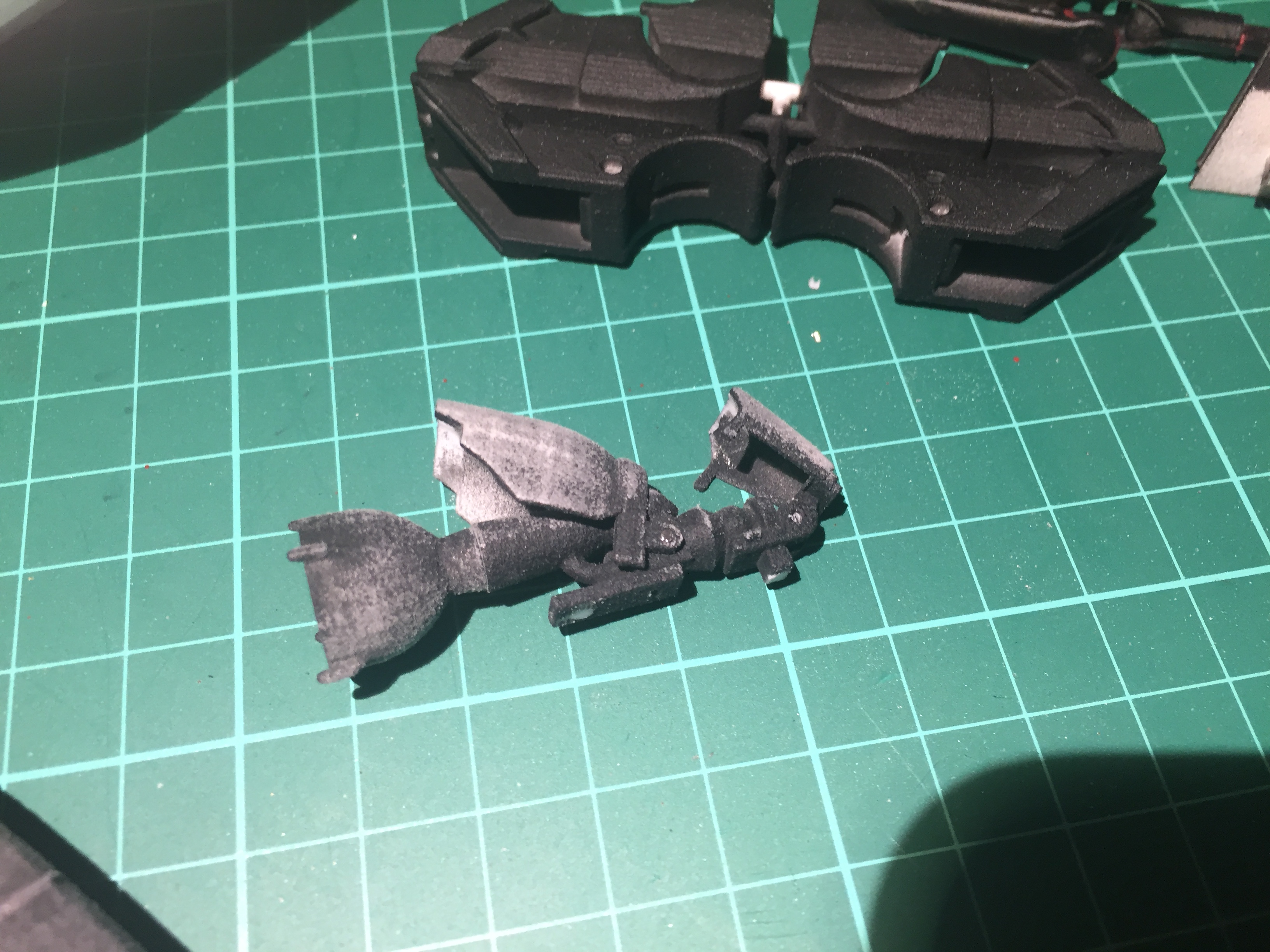

Pretty happy with the arm super parts now, they hold both the VF1 and VF-25 gunpods.
I totally messed the supporting piece of the legs super parts though, but nothing to worry much, since the fix is pretty easy.
The feet are tricky, I guess that they will need to be glued to be firmly attached to the mechanism.
I made a slightly smaller head, the transformation to battroid is far easier now, but somehow the head looks small when taking pictures. But in reality it looks as big as the 1j head. Weird!

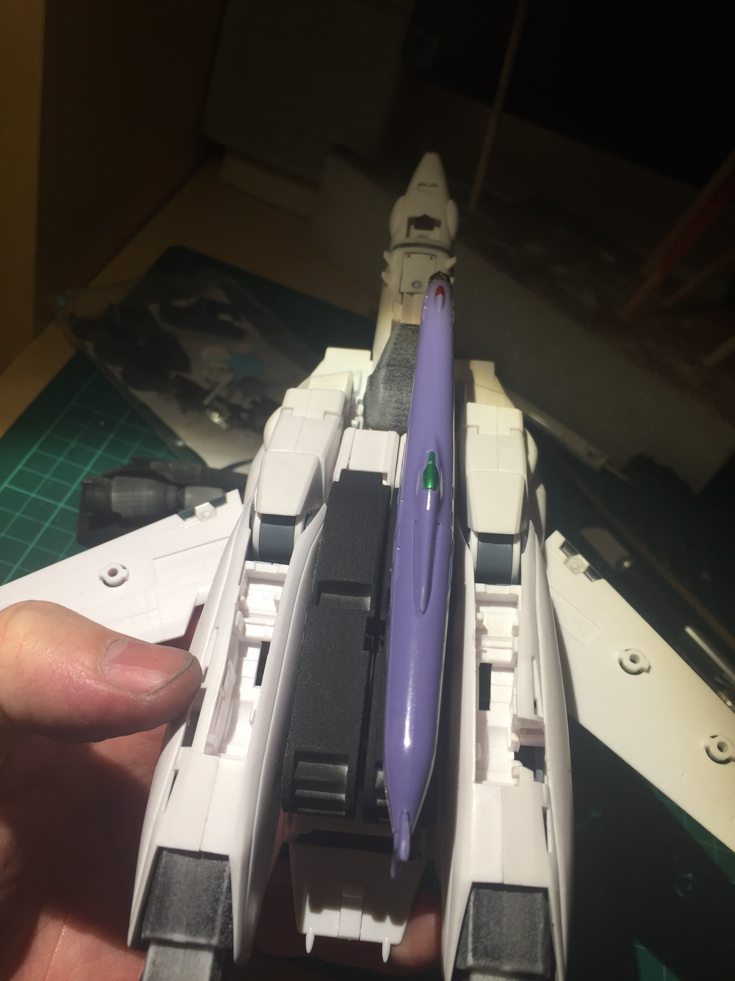

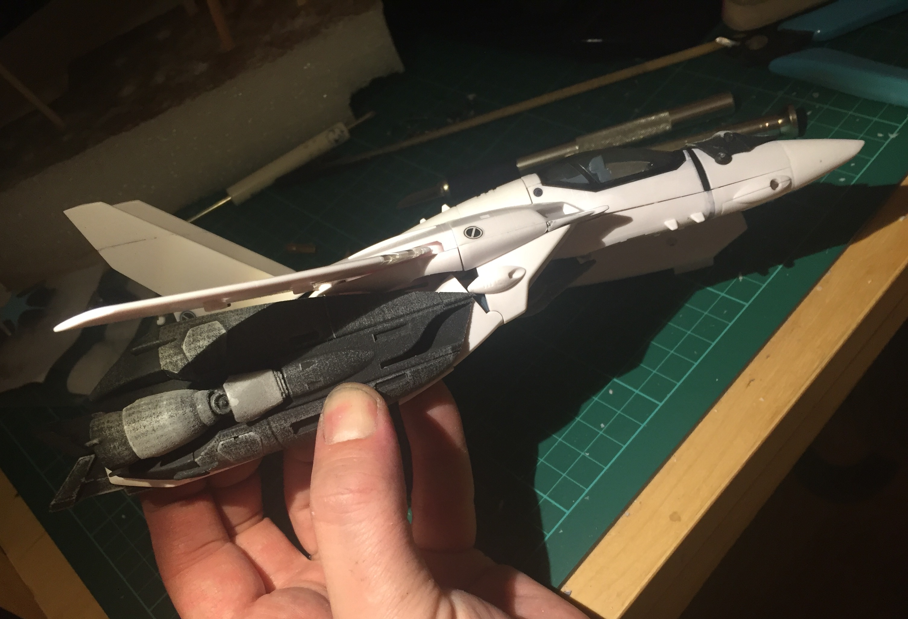

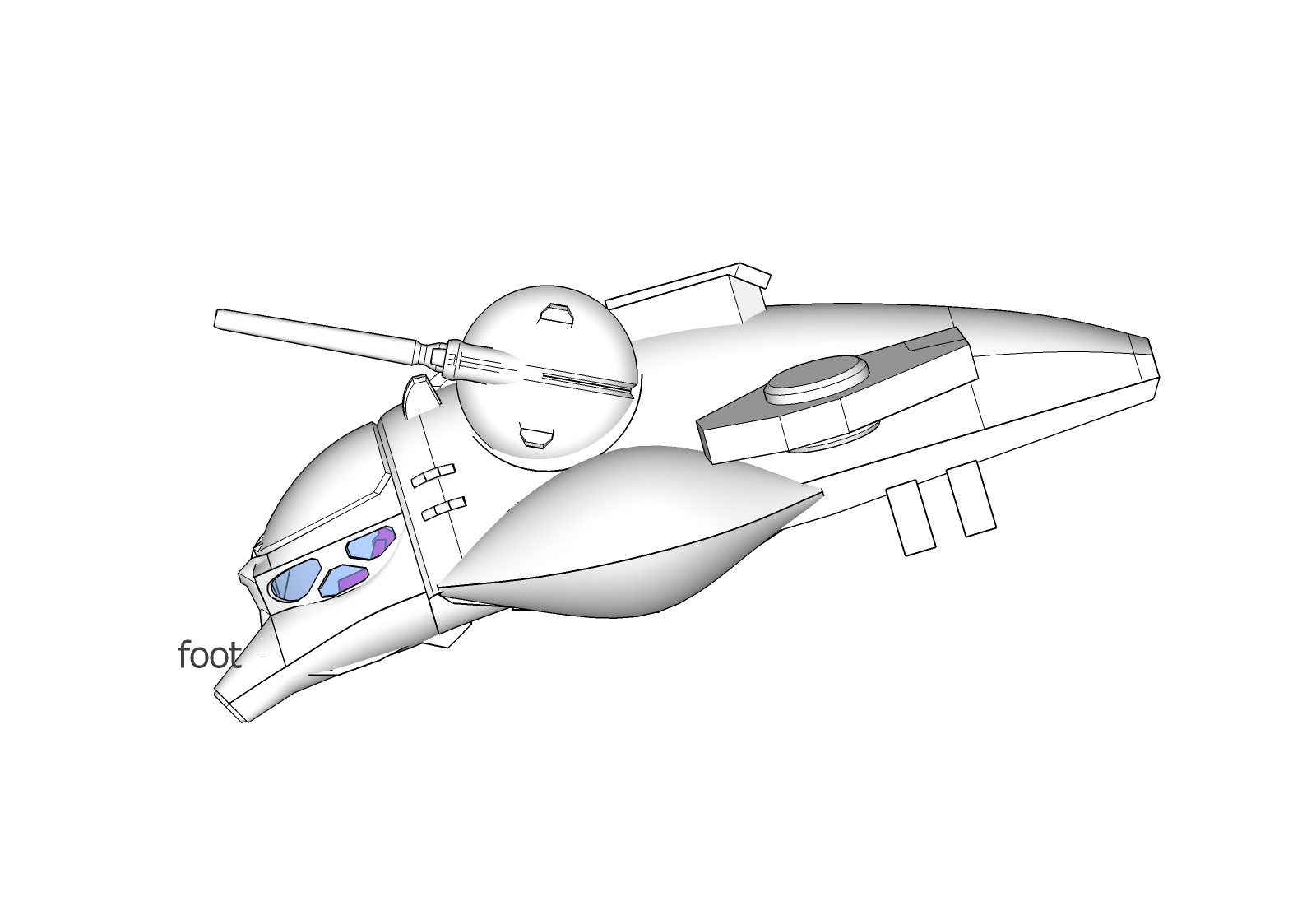

I have fixed all the current issues, and also made a few changes to the 3D files. Now here is only the chest amor plates to modelise, I think I got the solution by replacing the whole back plate and make a new one with the plates already in there.

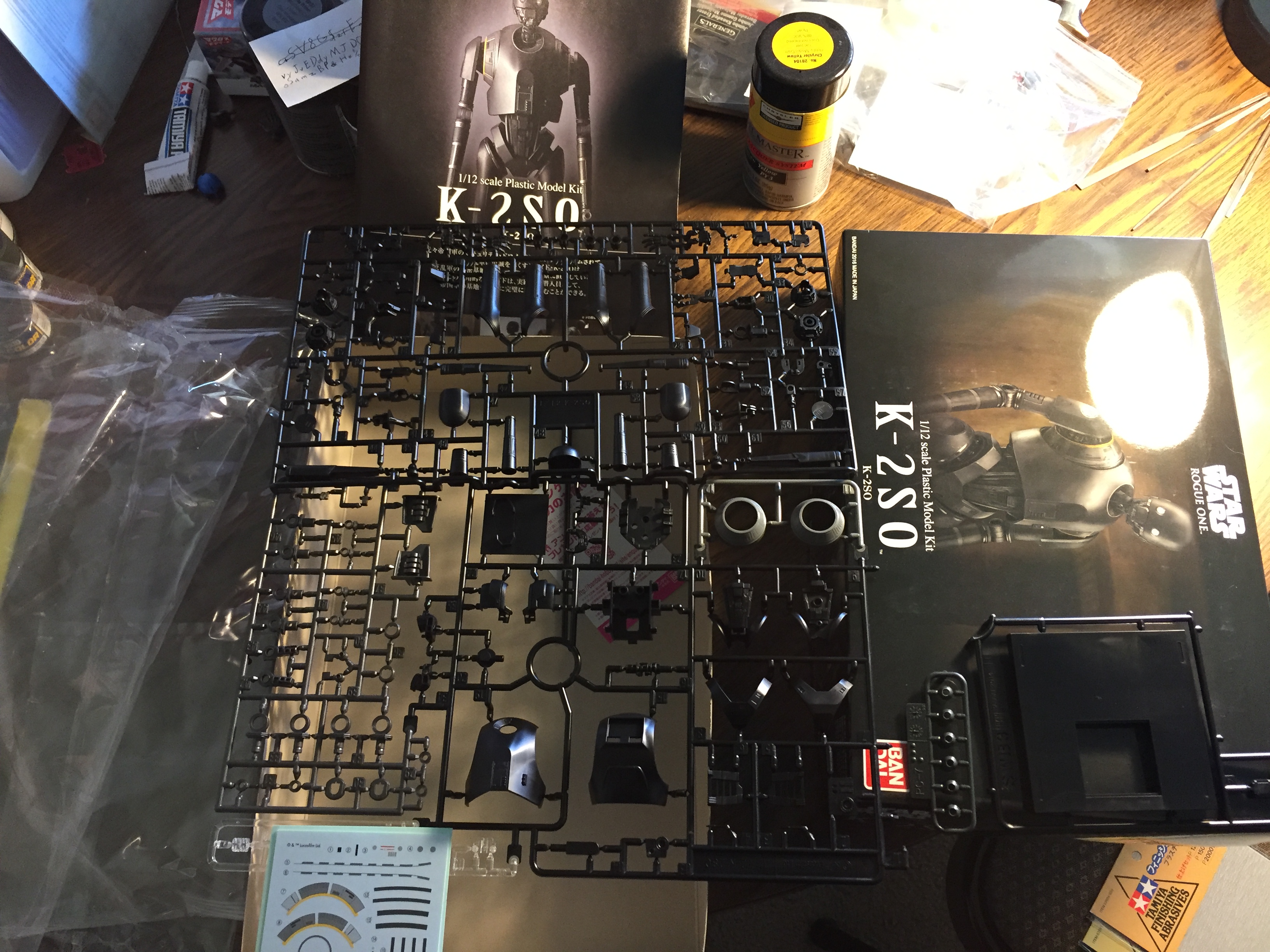

I wasn't paying attention and started this one after taking a break from the playing with plamo competition at Hlj, then realized after checking my emails that it was may the 4th.
I keep going back and forth on whether or not I want to buy K-2SO. He was pretty much the best part of Rogue One, but I have a feeling painting him would be a deceptively easy thing to pull off.  I wonder if some of those awesome Alclad metal paints would be the way to go?...

are those parts available for purchase?
looks very good ;)
looks very good ;)
Thank you! I have a few parts already available in my shop, the one I was entirely satisfied with already. Since the last parts needed a few changes I have the updated models coming soon, so I can confirm that everything works flawlessly.

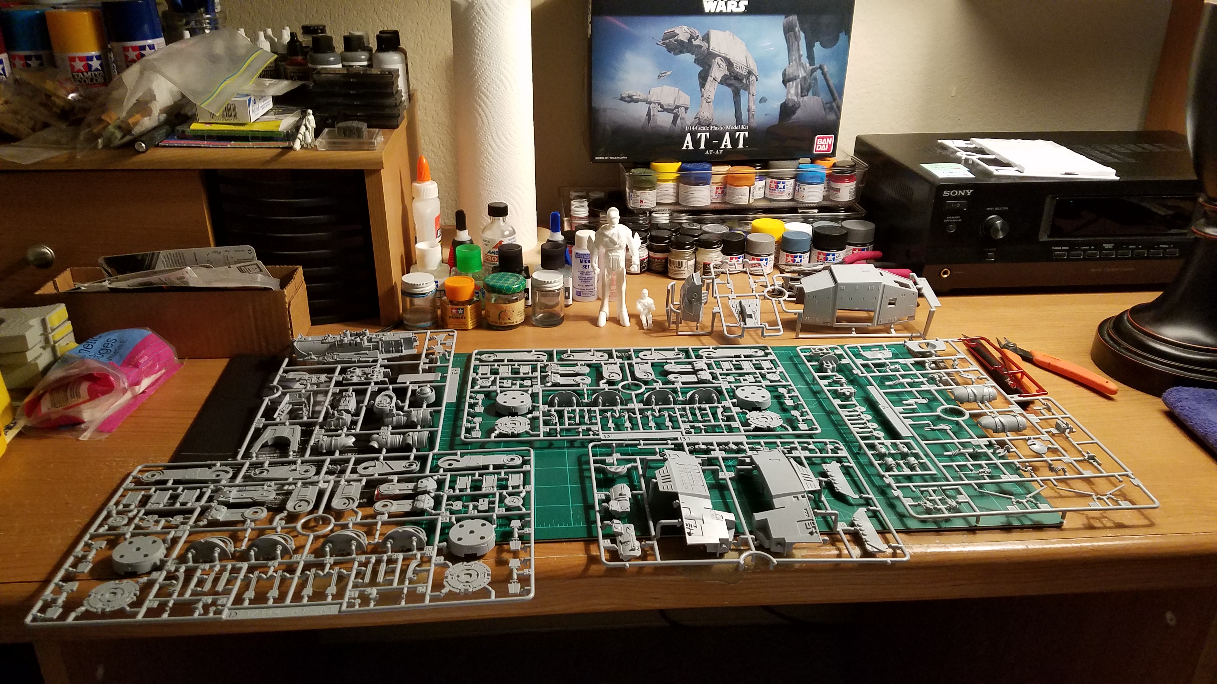

Hey derex, I was actually thinking about mr surfacer black then coating with mr color chrome spray. Then a few bits of small trimmed masking tape around the edges and a base color of really dark grey and medium grey on the lighter parts, then peeling the little bits to make a more scratched look. And finishing with tamiya weathering metallics and maybe do a bit of a dark grey or black for smudges using those tamiya makeup compacts as my daughter calls them. The very small lights may just get masked and coated with clear colors depending on how things turn out with the chrome.
right now I'm still trimming and gluing parts but will play around with some of those methods on some sprue before things get to the end. The parts I'm really not sure on are the elbow and knee clear spacers. I kinda want to leave them out, but I'm not sure the joints will hold the weight. I'm also not sure if I want to leave them clear if I do use them. In the movie there is nothing in the middle of those joints, just empty space.

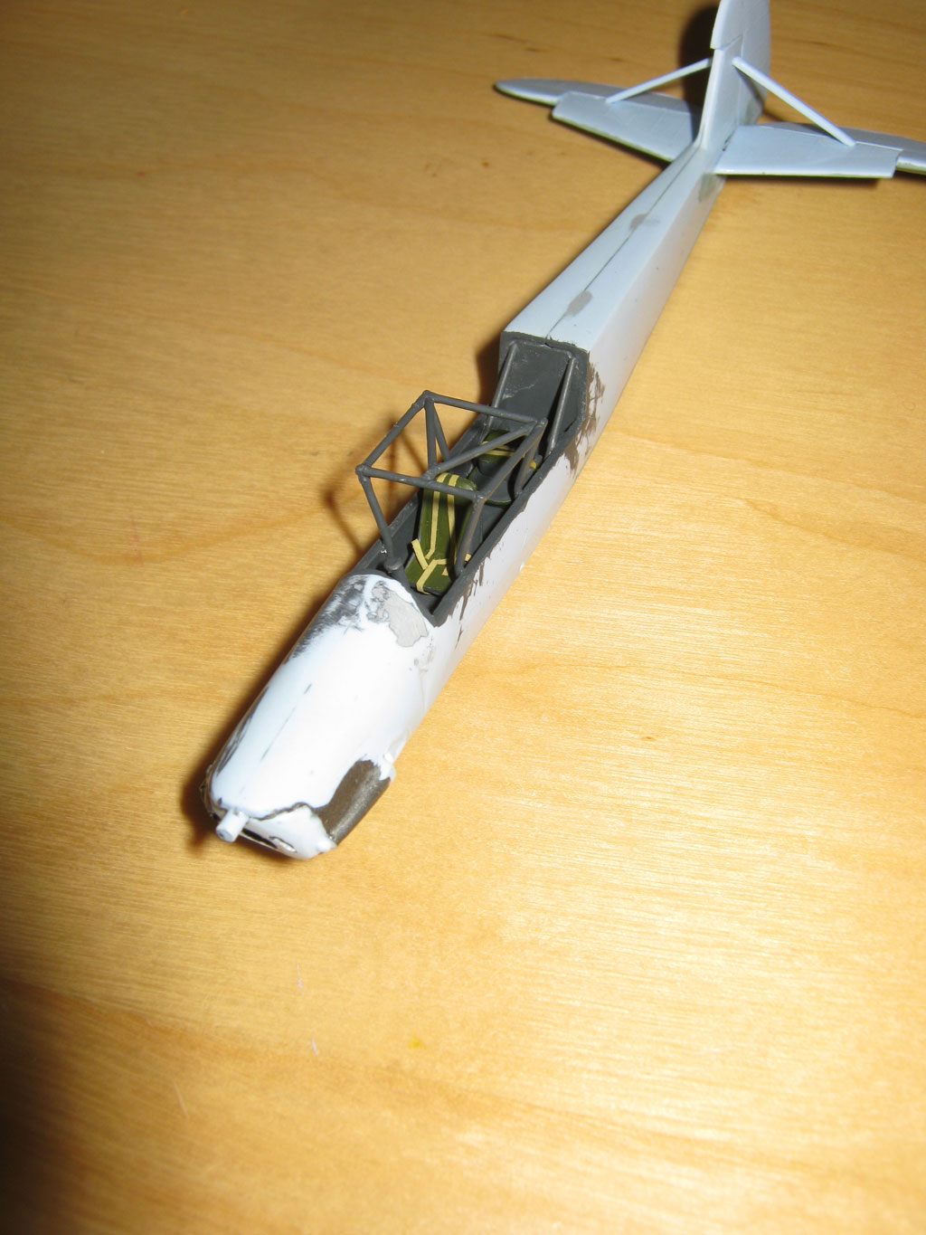

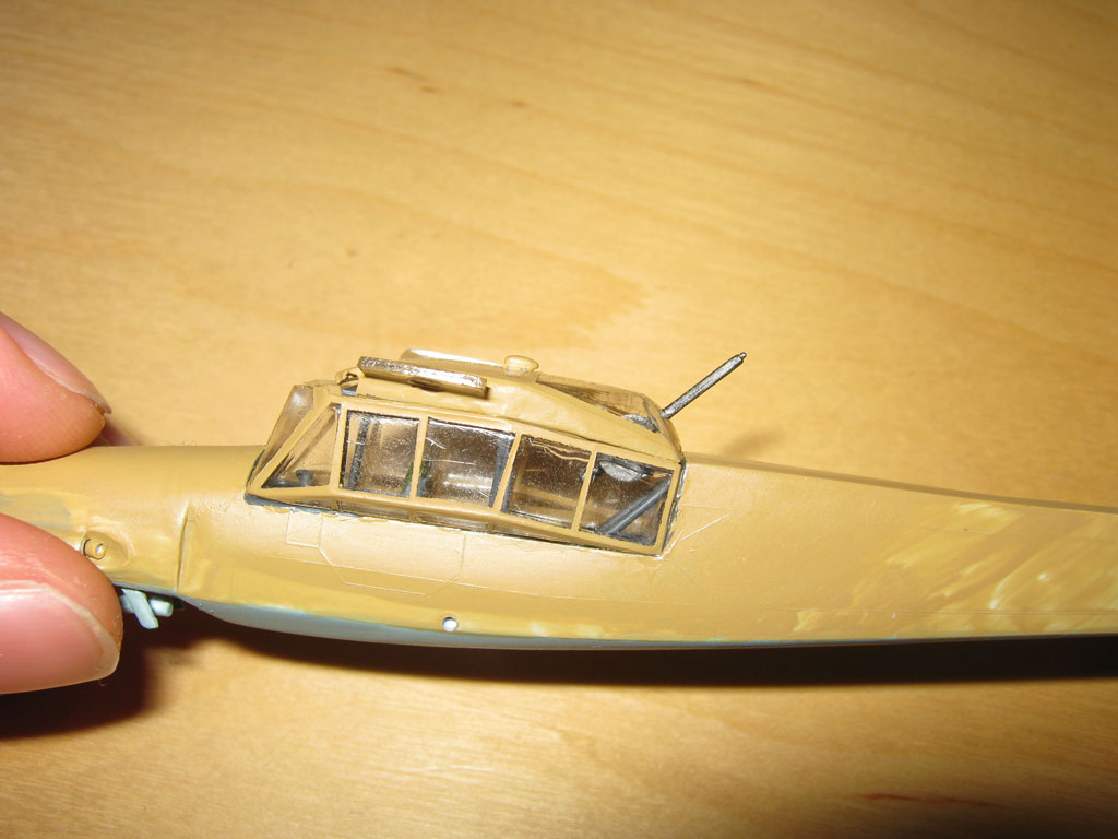

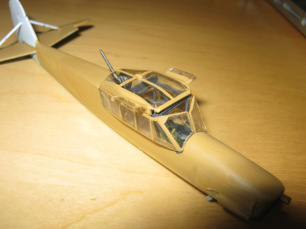

Some updates on the Fieseler Storch.
Got the internal cockpit frame done and also added seatbelts (painted masking tape cut to size):

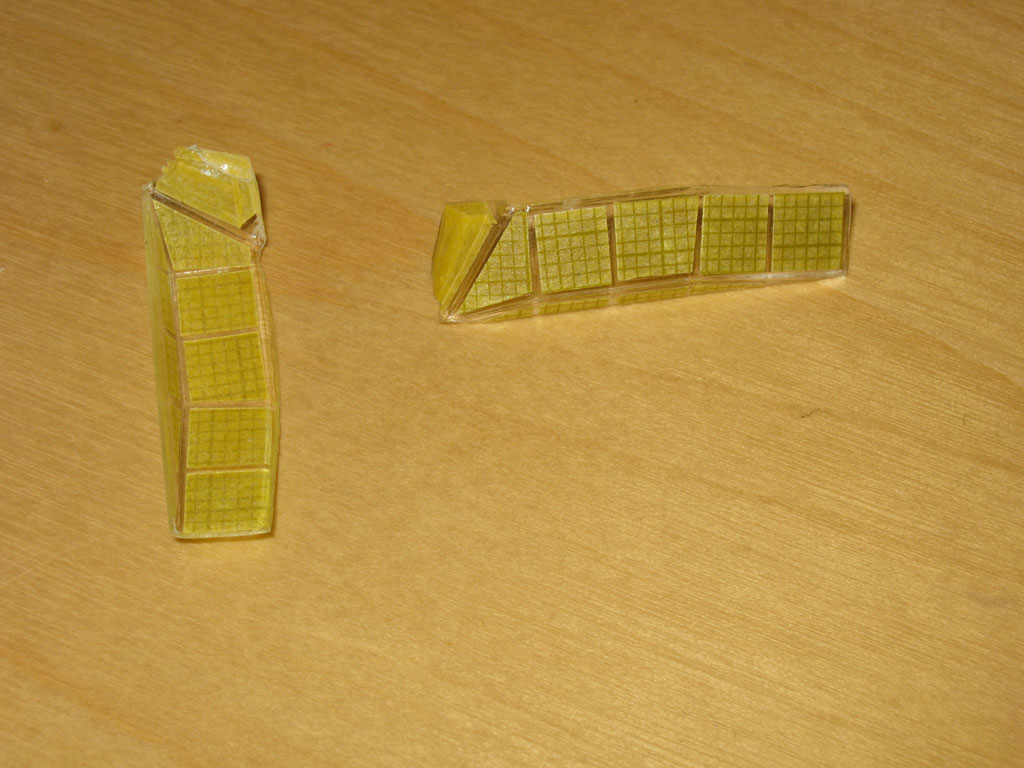

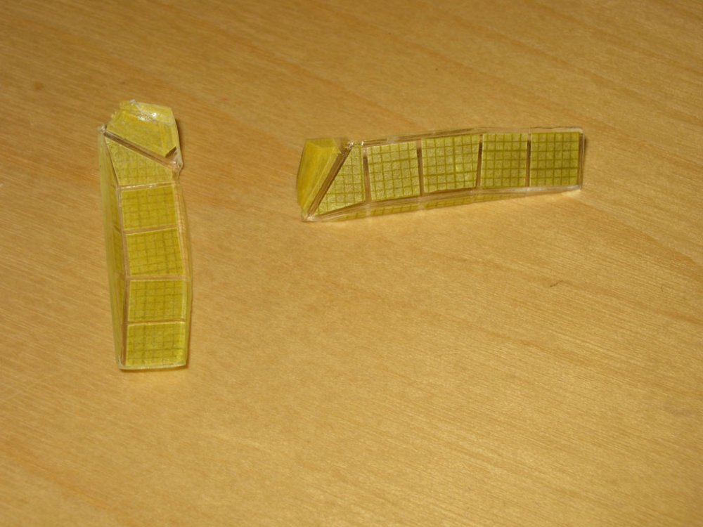

Masked the side windows, which was a pain in the behind because Airfix managed to make the windows different heights and also swapped the position of the intermediate window edges front-to-back on one of the clear parts (both are errors):
I unfortunately managed to crack one of the front windows while masking (really fragile plastic).

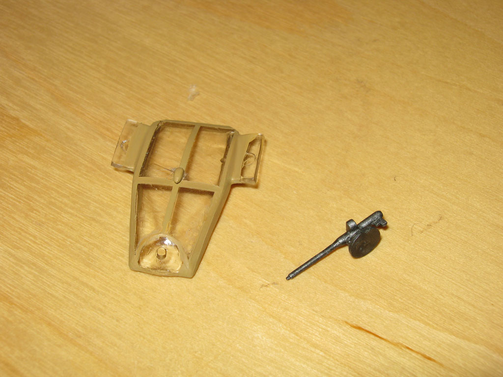

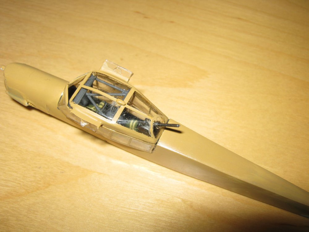

Then, once those had been unmasked and glued into position, I started on the roof windows, which had to be painted in steps and partially without masking because some of the rounded window edges were impossible to mask:
Also painted the machine gun after adding a magazine.

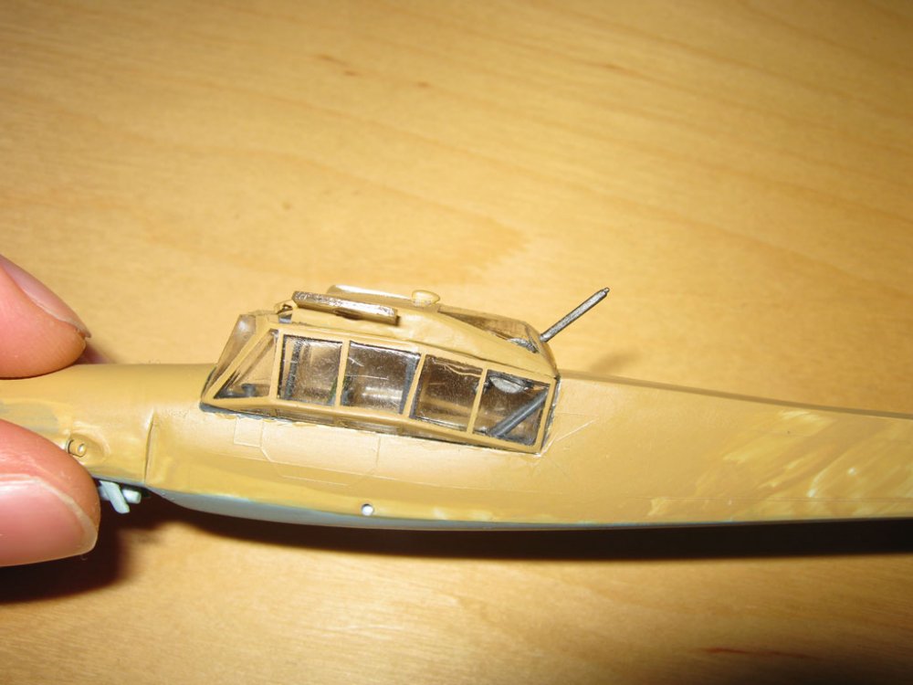

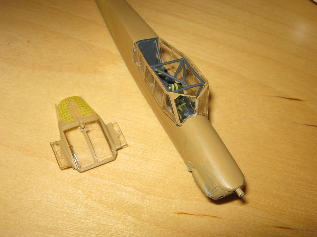

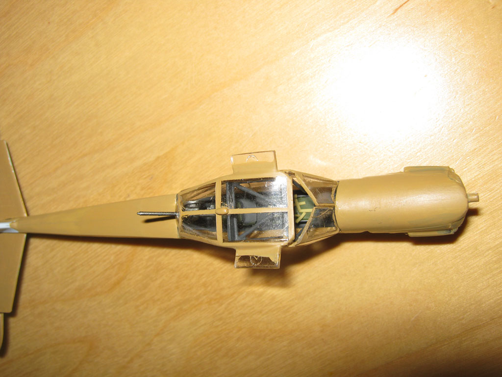

Then I glued the machine gun to the roof and the roof to the side windows:
I will add the missing top window later. The original top window was molded as part of the side windows, which would have left an ugly seam right in the middle.
Some views:
The windows are pretty clear.
Right now I'm busy with painting the camouflage pattern, which is all made up of swirls and pretty tiring to paint.

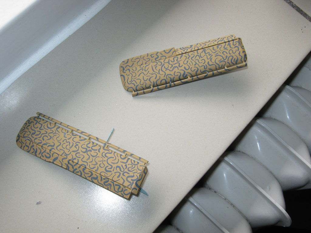

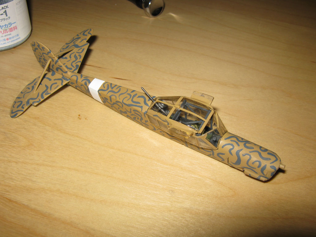

The wings and fuselage with the camouflage pattern and all other painting done:
I also glued the tail wheel to the fuselage:
Because the main landing gear is a fragile affair that will need very careful handling, I think I will first apply the decals to the wings and fuselage before continuing with the main landing gear and other remaining details...
43 minutes ago, Big s said:
That looks like a lot of work for that little plane. It's looking good.
Thanks. It's a 1970s Airfix kit that's pretty good (I've built a lot worse), except that they left off some details that can be clearly seen in the box art (of all places). They also seem to have used a mirrored picture for determining where the door went...:lol:didn't feel like fixing that one.

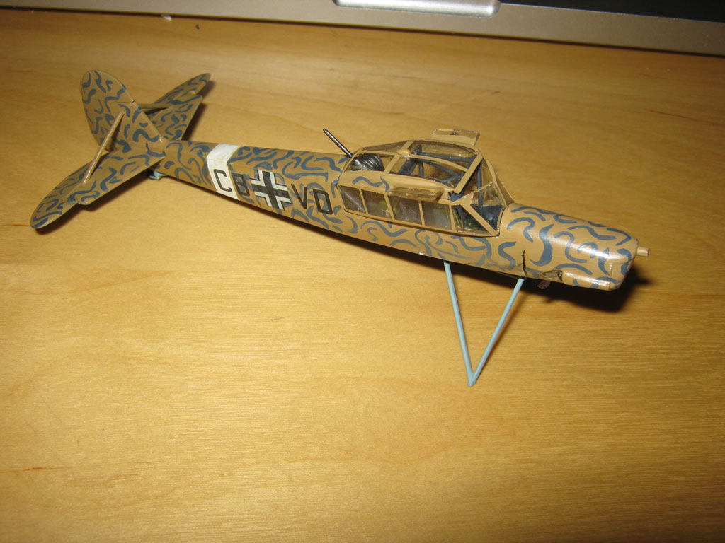

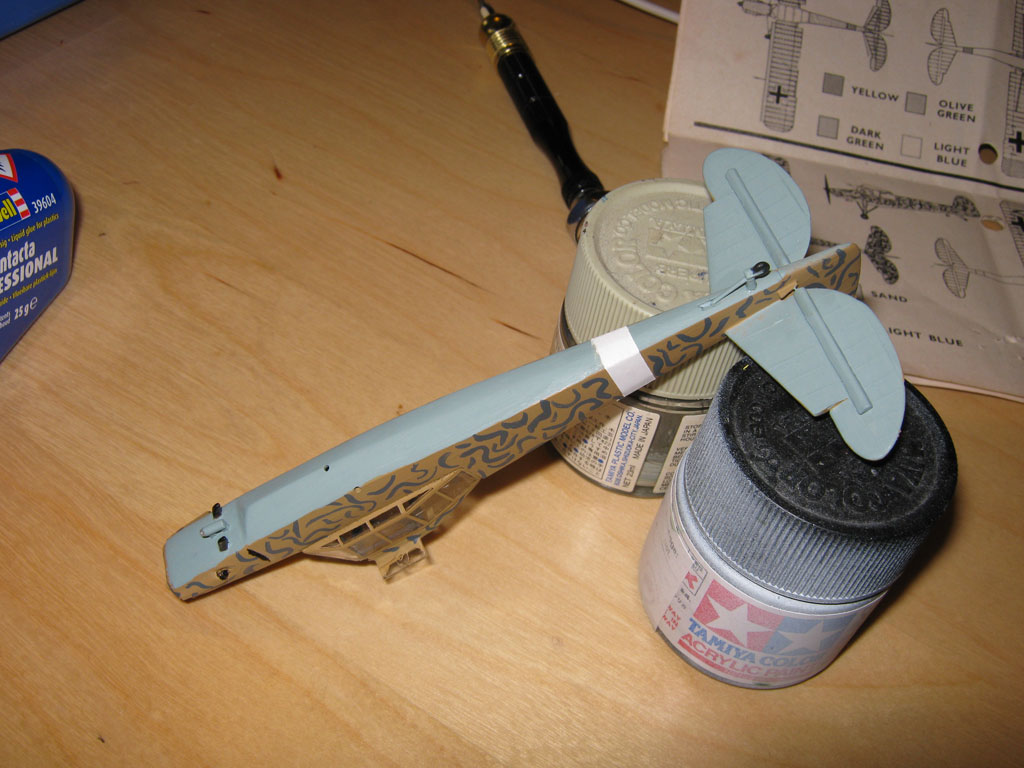

The decals were a bit painful to apply. The white ink seems to have aged badly, and had a tendency to tear/crack when applying the decals. Strangely for 1970s decals, they reacted properly to MicroSet/Sol. Then I clearcoated everything with Tamiya semigloss clear to protect the decals and discovered that too thick a coat dissolved my slate gray paint mix I had used for the camouflage pattern:mellow: Anyway, after some frantic repainting of the pattern on a few places, and a second thinner layer of semigloss clear, the decals are all done. I also added a bit of dirt near the exhausts.

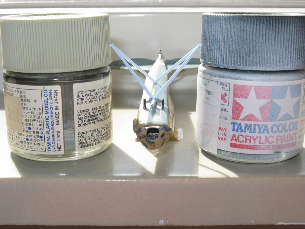

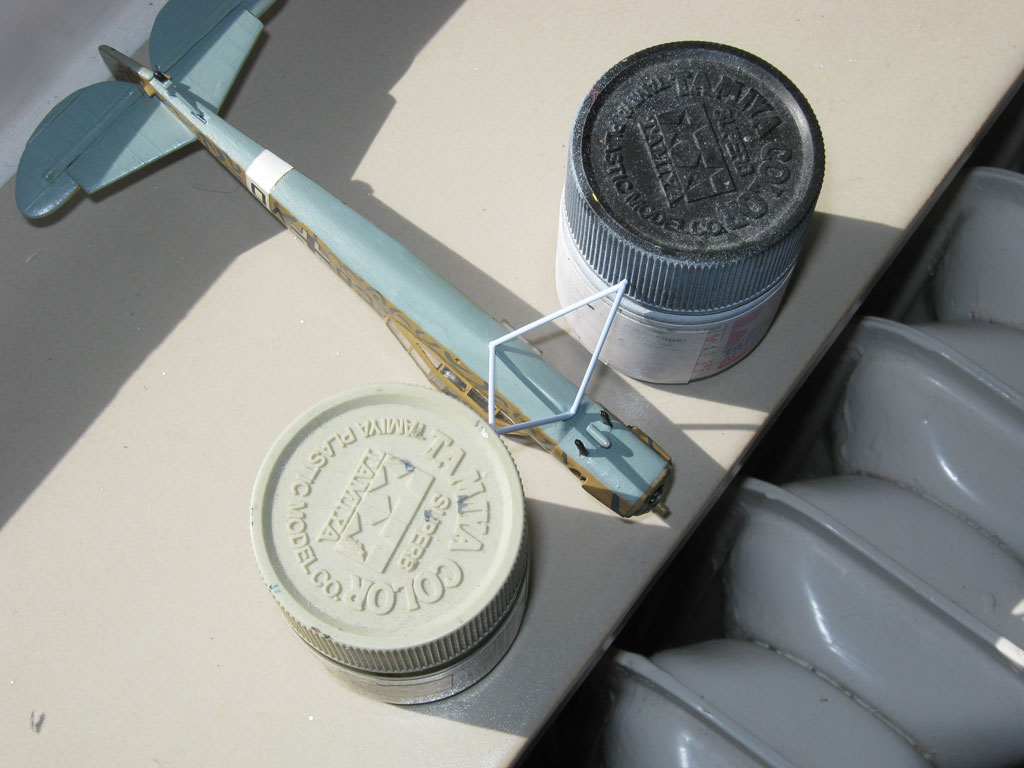

Next, I cut the missing window from some clear plastic sheet. I haven't attached it yet, I'll do that later on. Then I set out on the next daunting task: get the landing gear attached without breakage. First, the frame underneath the fuselage:
Two old bottles of paint to keep it centered, and let it dry for two whole days because the plastic Airfix used remains soft after gluing for quite some time.

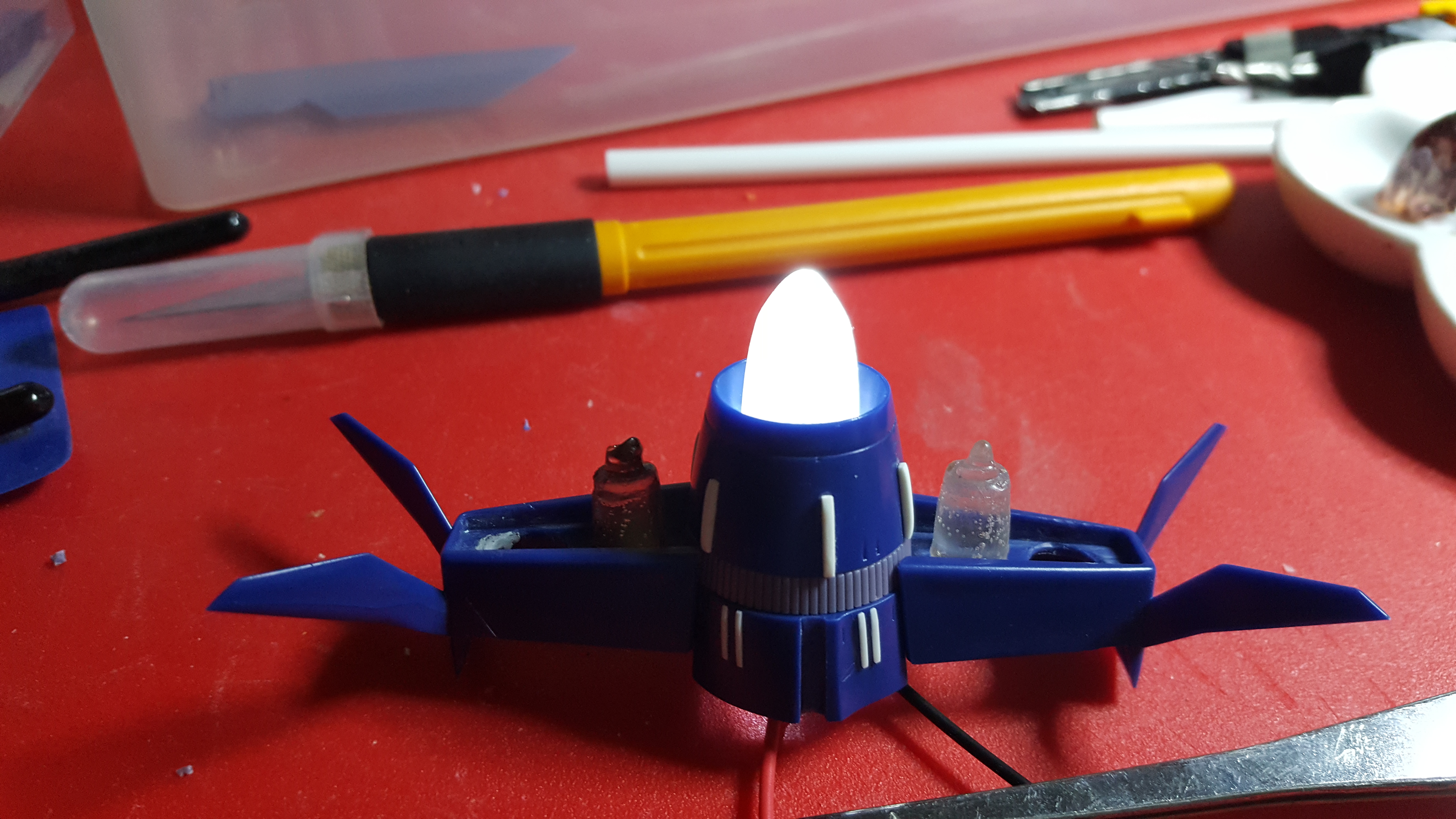

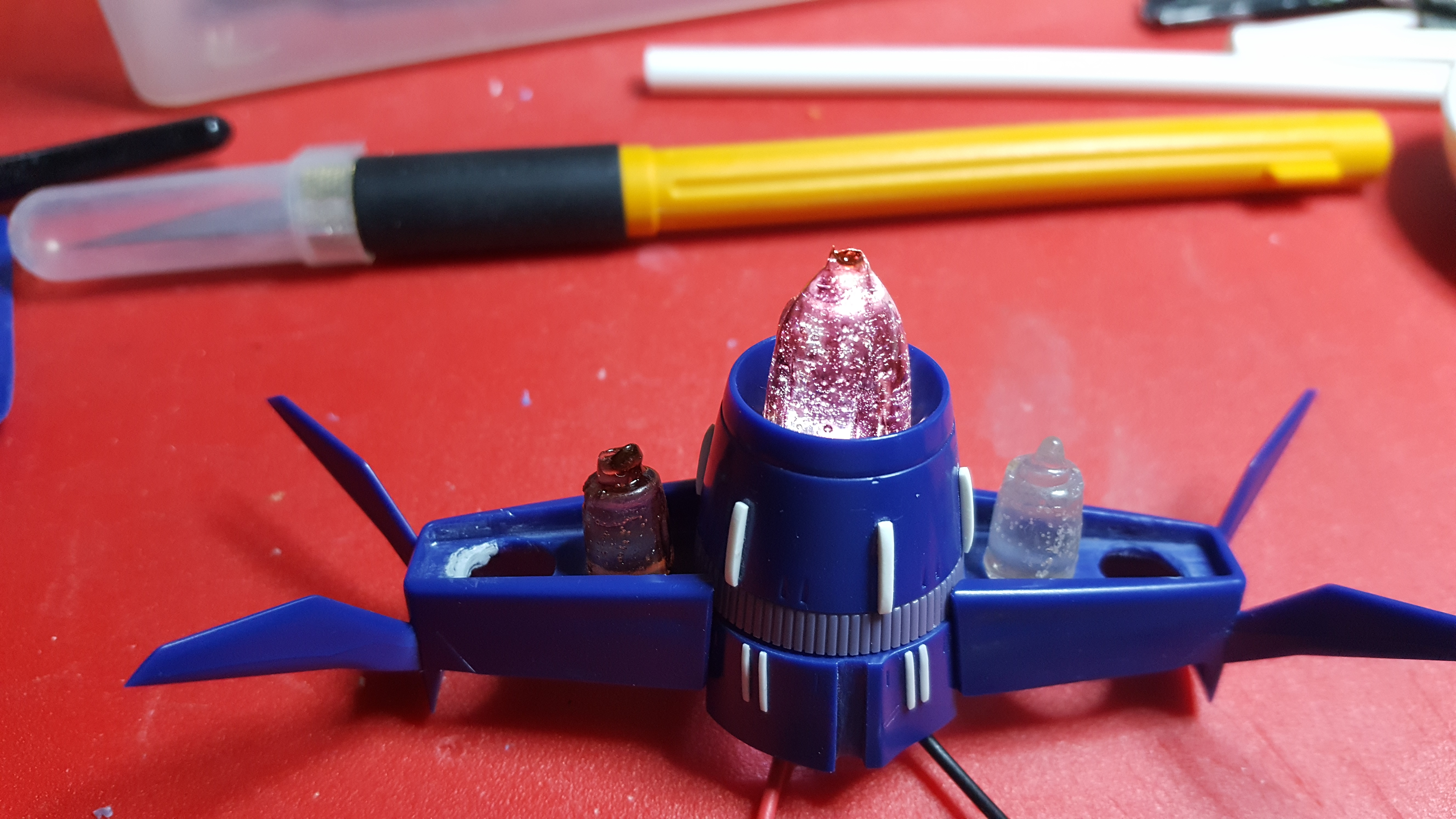

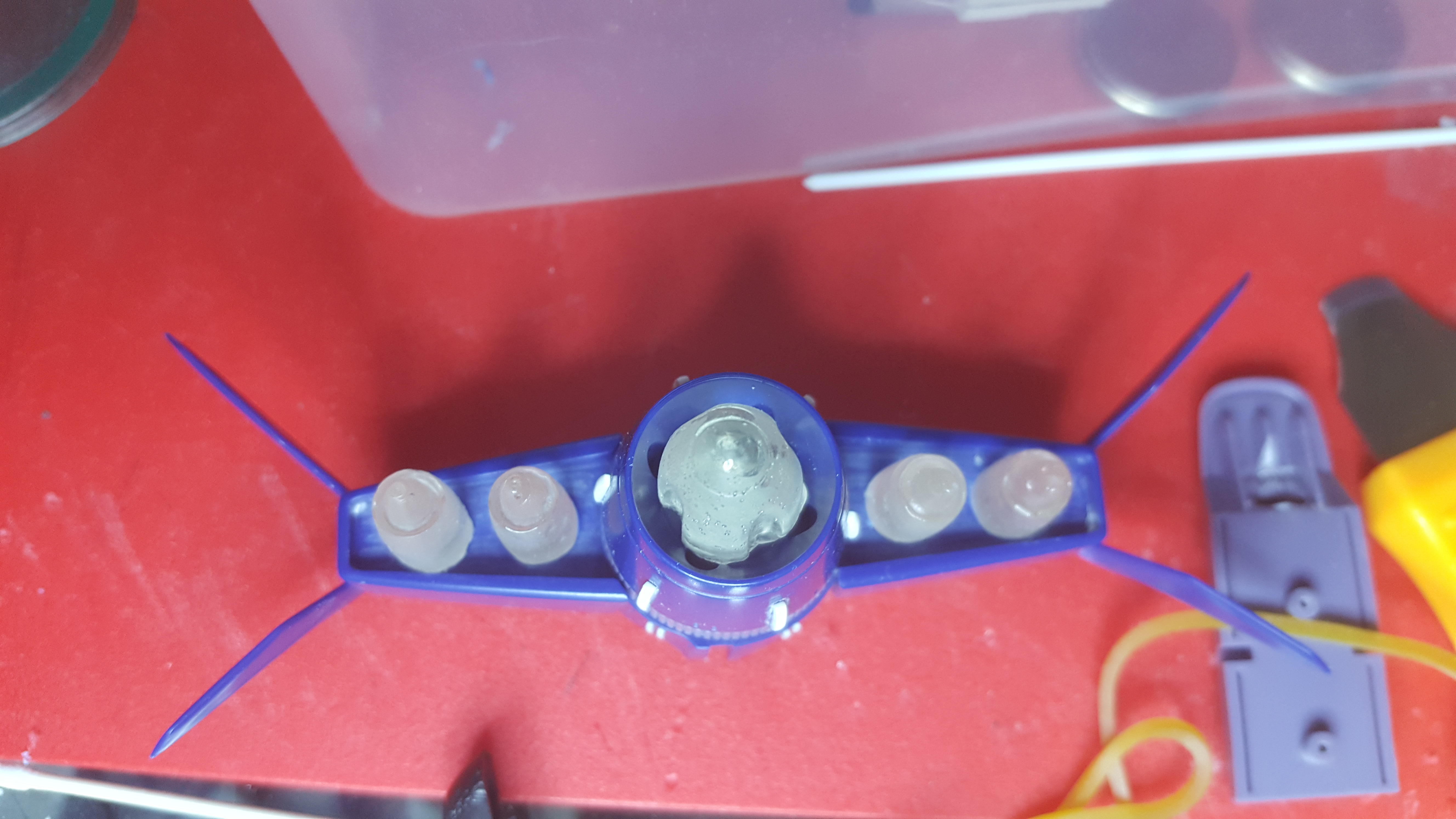

Testing some different lighting with colored and plain clear coats on my resin cast.
I need that crystal resin!

Have fun with that walker. It looks like a really fun kit.
I still haven't picked one up yet, but plan to soon.
It seems like all the Starwars kits I've bought have legs, at least of some type. The R2, R5 combo are questionable, although I still call those legs.

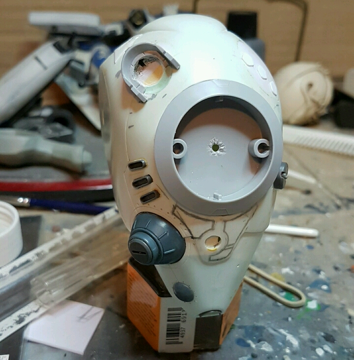

Bandai's ability to mold complex geometric sections in a single piece never ceases to amaze me.  I would have expected a lot more parts for the head cowling. :blink:
Come on Bandai, where's my B-Wing and Tie Bomber? :p
Yes and YES!!!  Also the Star Destroyer that they teased us with and the Lambda shuttle.

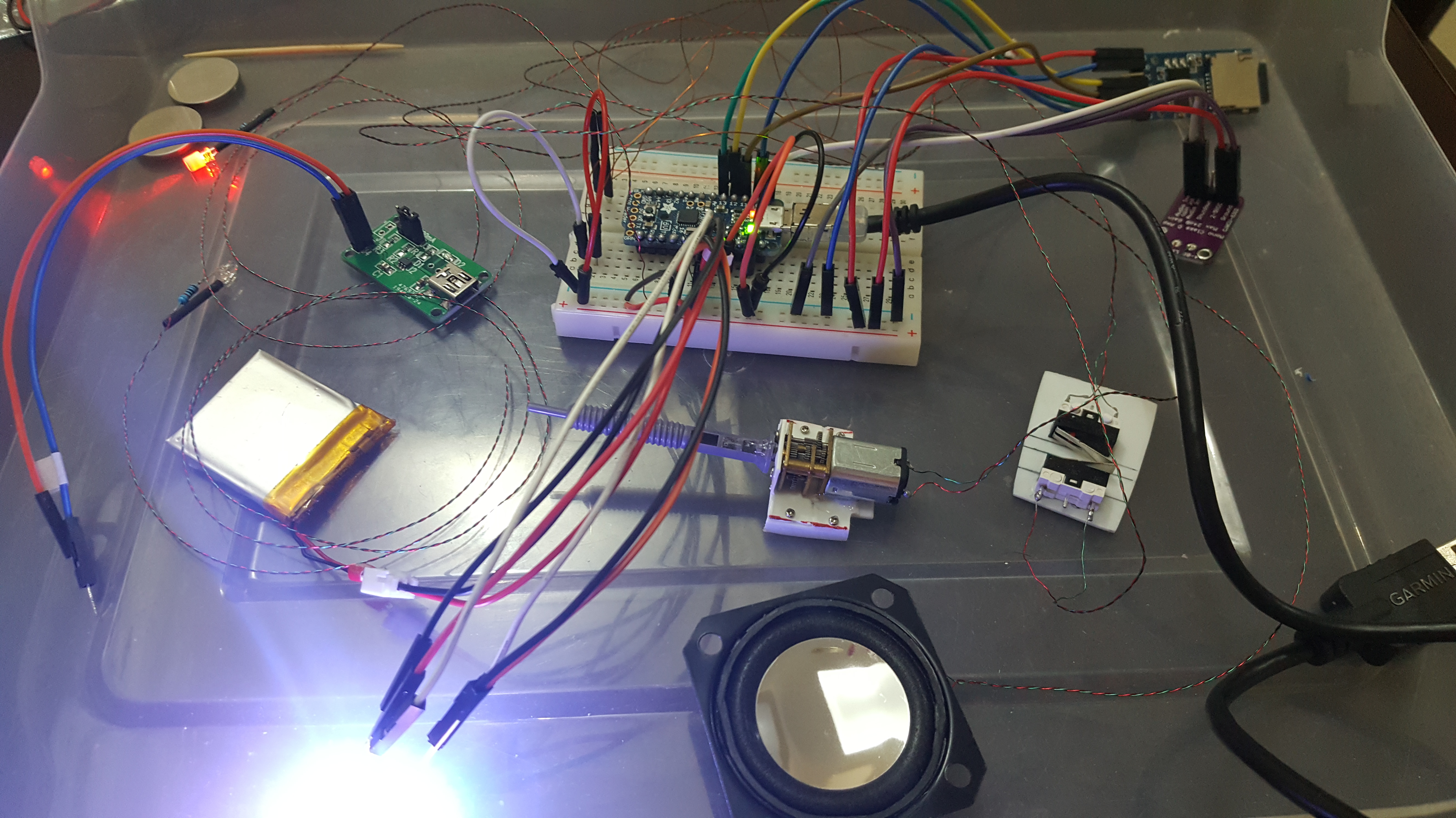

Full wiring setup ready for the Nautilus.
Everything here will be installed in the model after I finish painting.
Lights, speaker, amp, SD card, motor, battery, charger, and switches all playing nicely together.

That's great Arbit! That is also a LOT of hardware!

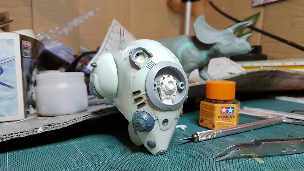

On 14/05/2017 at 1:06 AM, Cesar Enrique said:
Details added to my kit conversion. I love how it looks. We're almost there
These conversion parts are great, I wish I had the skills to do as well.

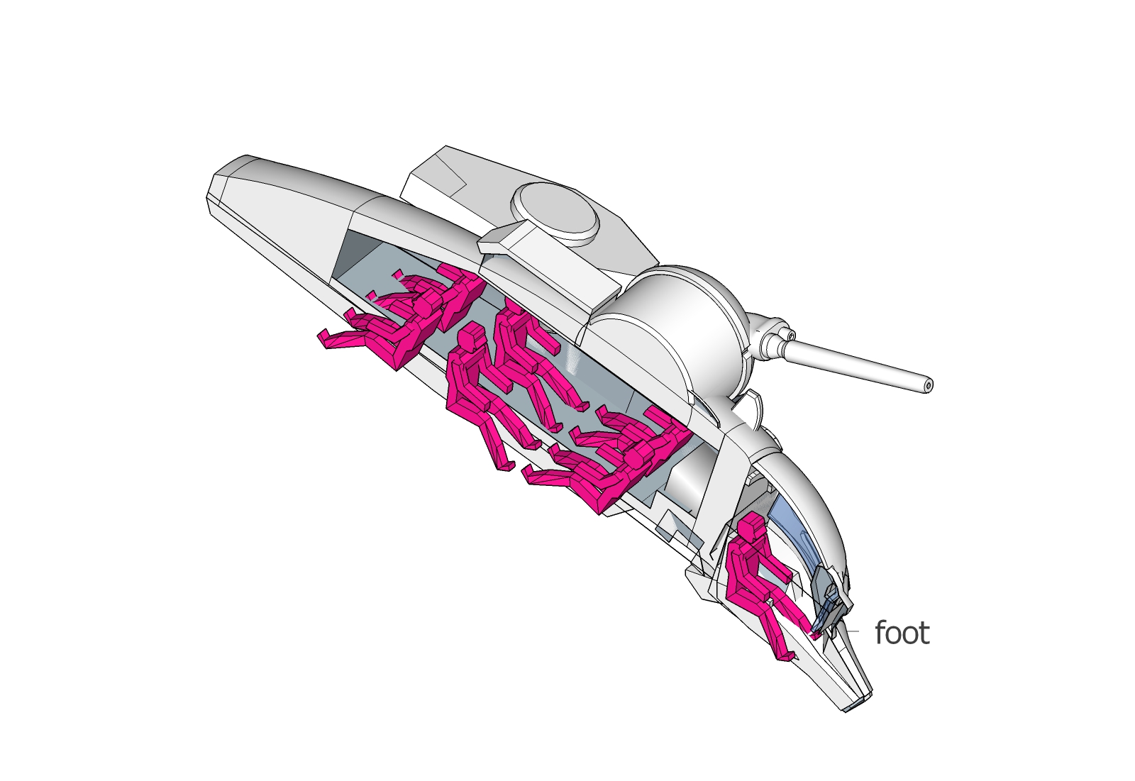

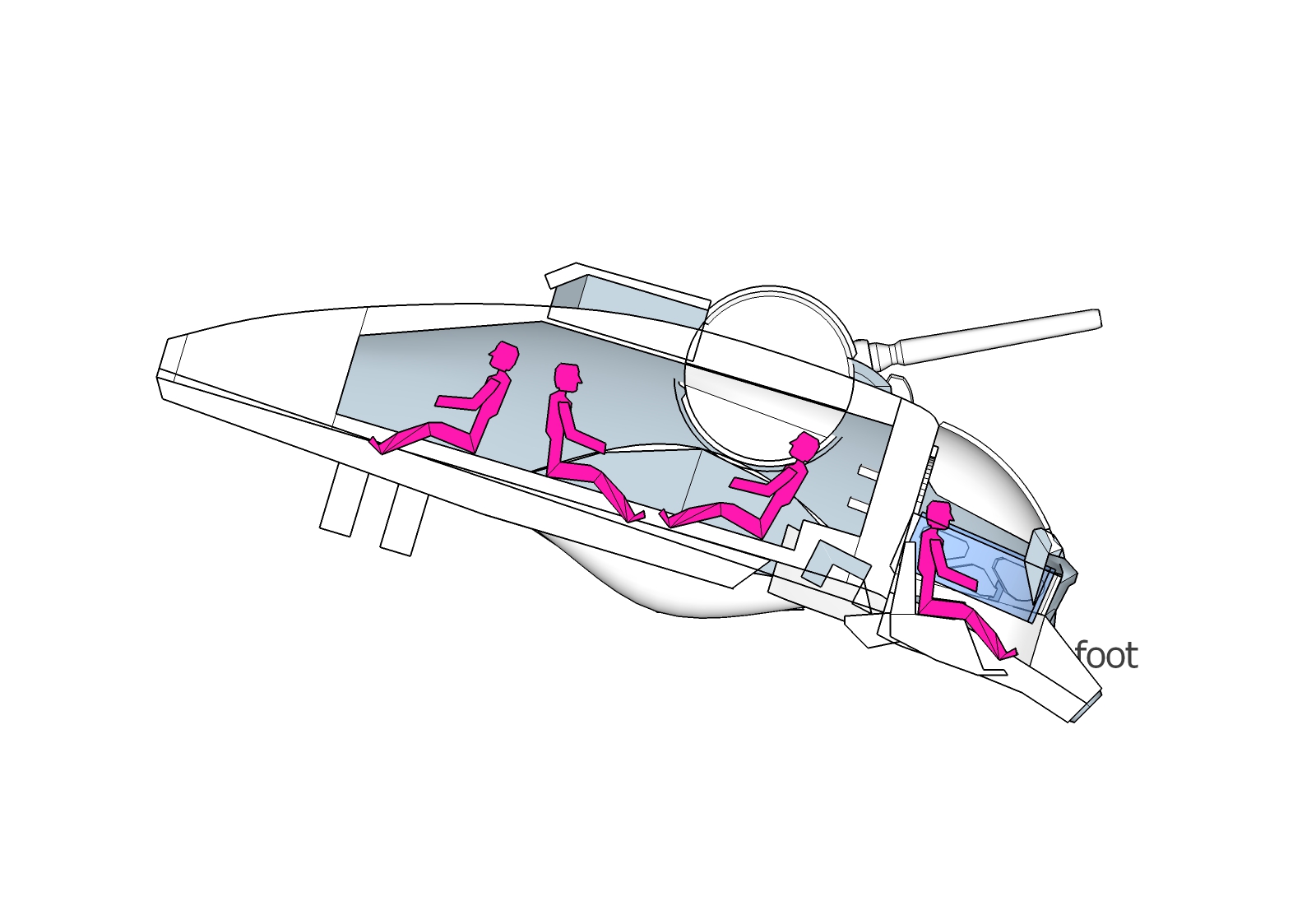

On complete opposite subject, I now have proof that you can put up to 7 people in an octo, including the pilot.
Which kit was that?
1 hour ago, arbit said:
Which kit was that?
Thank you all guys,,! It's tak8ng a little more than I thought, but it's looking so good.
It is the old arii/bandai 1/72 Regult.
AWESOME!!!
