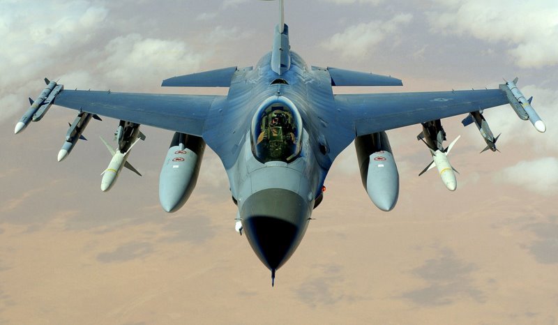

Looks are everything when it comes to public perception of how bad-ass a plane is. F-16 wins there. :)
This is what a F-35 will look like going to war, and here's an F-16 with the same warload. You tell me which looks sexier.

While a clean F-16 and a clean F-35 might have the same performance, the clean F-35 is two bombs or six AAMs away from flying a combat mission, while the F-16 needs to have all the crap in the pic above strapped to it to do the same thing. So yeah an F-16 is a great performer when it's not carrying anything, but strap enough ordinance to it to do something useful and give it enough fuel to carry it further than five feet, and it turns into a dog. The F-35 will be able to perform the clean F-16's airshow routine carrying all the extra weight of the dirty one.
