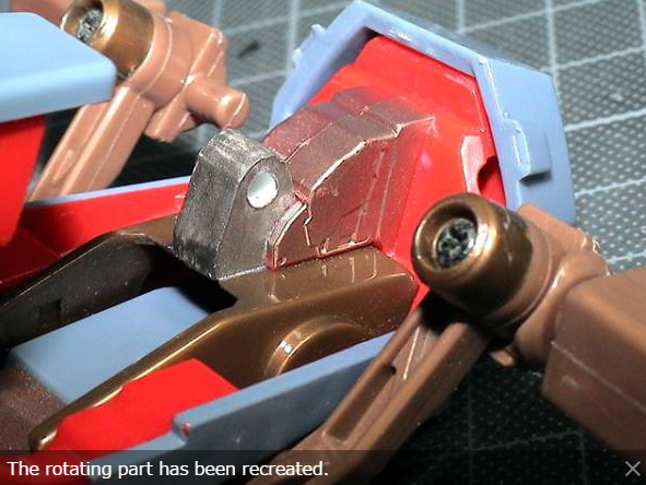

SpaceCowboy Posted August 17, 2020 Posted August 17, 2020 Here's my attempt at redesigning the swing bar and shoulder. Jesus is this toy poorly engineered....I'd upload the STL files, but as I was putting together the left arm, the pin broke off in the same damn way that the original piece did. It just has way too much rotational stress on that point. The swing bar really needs to be cast in metal. The shoulders are annoying in that they are all friction fit, and friction fit parts are hard to get right on a home 3D printer. My printer is about 7 years old with a 0.3mm precision, but the difference between something friction fitting and not friction fitting is somewhere between 0.1 and 0.25mm. So I can eventually get this, but it is a very trial and error process. So the arms are able to hold fine raised from the side but not being held straight out in front (holding a gun, for instance). This also might have to do with it being next to impossible to disassemble the shoulder without breaking tabs of some sort. There is a screw underneath the front circle bit on the shoulder(green), but everything is so tight, it's hard to notice that while trying to take it apart. I ended up breaking the cylinder off on both my shoulders thinking it was just the peg glued in that was holding it. Still, I think I'll be able to have it transforming tomorrow. I just need to reprint the left swingbar, then I'll probably post more pictures and the STL files if anyone else wants to take a crack at them.
SpaceCowboy Posted August 17, 2020 Posted August 17, 2020 So here the garland is back in action. As mentioned above, because of the permanent way Yamato attempted to assemble the shoulders, it is very difficult to get them apart without destroying some of the structure that keeps everything tight. The replacement swing bar makes me very nervous, as even in ABS I can easily snap the whole thing with my fingers. I'm curious to see how Arcadia dealt with this with the new Garland. The two engineering problems I see are that the entire weight of the arm is supported only be the swing bar and a magnet. And by swing bar, I mean a 1mm diameter piece of plastic or metal. And both of these are sort of towards the bottom of the wheel. Anyways, here are the STLs if you want to give it a try. The shoulders are the same on each side (at least mine were), but you'll need to mirror the swing bar. leftshoulder.STL swingbar.STL

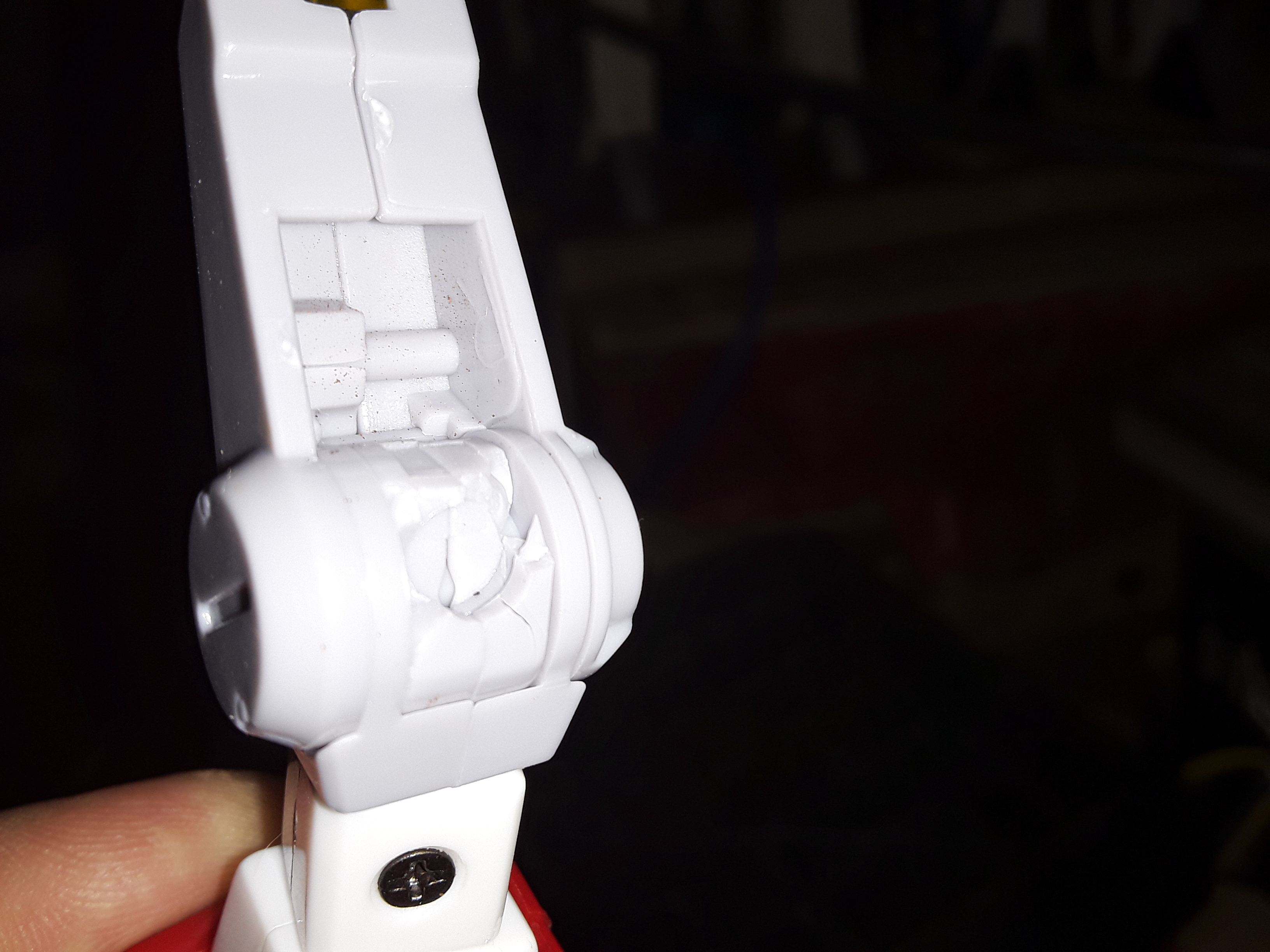

fenrir72 Posted October 6, 2020 Posted October 6, 2020 Late in the game but anyone here know how to get a replacement of this? The shoulder housing just broke off. Thanks in advance.
jenius Posted October 6, 2020 Posted October 6, 2020 My God, what did you do??? That looks like the kind of shattering you see when the factory forces the peg in rather than building the assembly around the peg... Hope we're not all doomed.
Sandman Posted October 6, 2020 Posted October 6, 2020 The tradition of being yamatoed continues on with arcadia.
SpaceCowboy Posted November 25, 2020 Posted November 25, 2020 (edited) On 10/6/2020 at 10:54 AM, fenrir72 said: Late in the game but anyone here know how to get a replacement of this? The shoulder housing just broke off. Thanks in advance. I realize this was a while ago, but the shoulder file I posted are recreations of exactly this part. Getting it tight is another issue, and one I never completely solved. (or is this the new Arcadia Garland that this happened to?! :O ) Edited November 25, 2020 by SpaceCowboy
