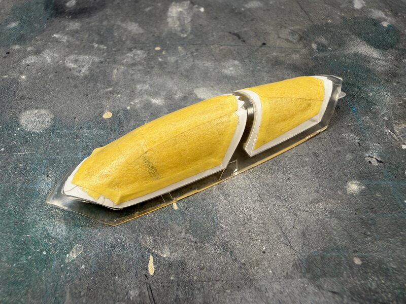

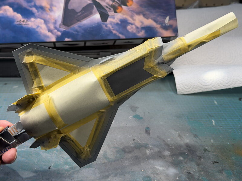

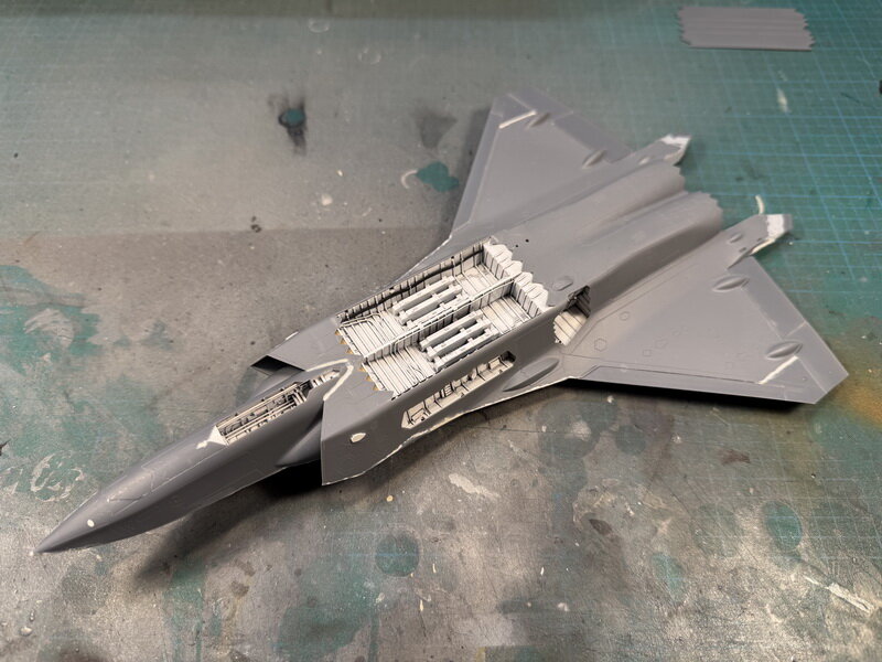

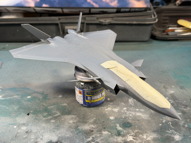

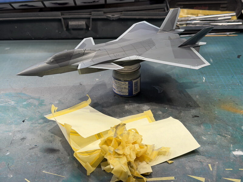

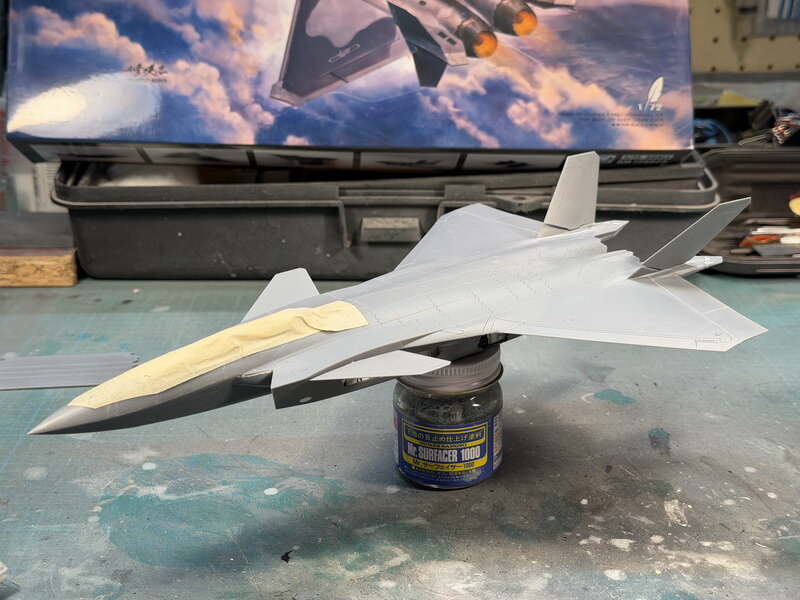

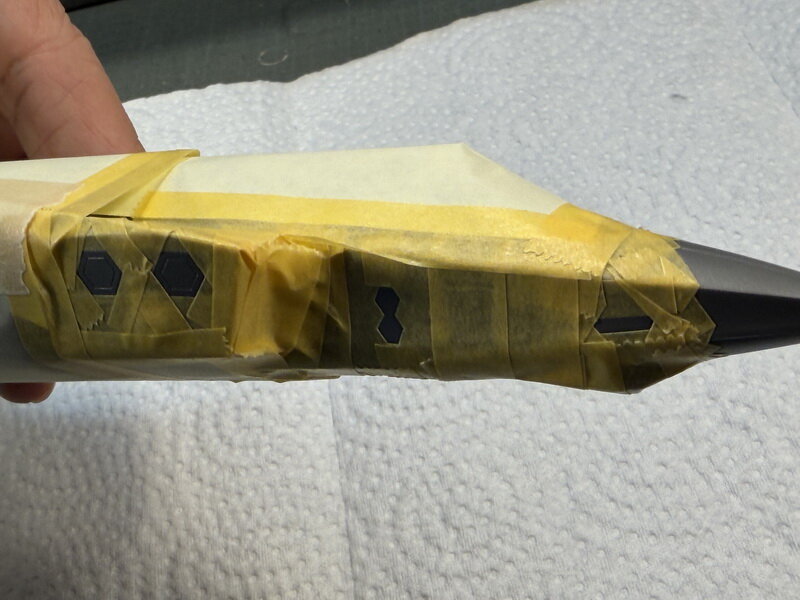

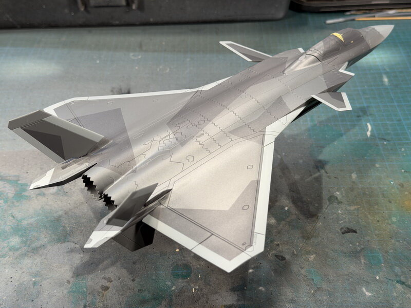

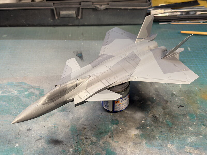

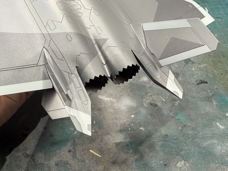

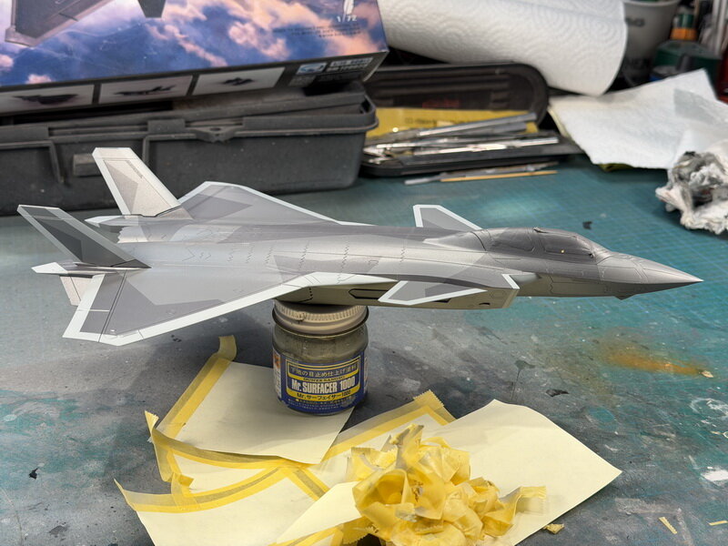

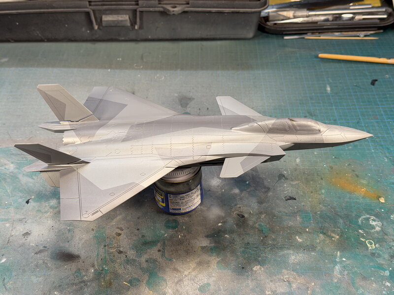

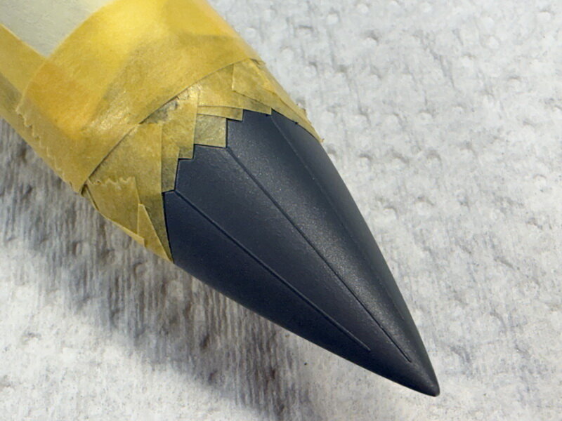

  2. Our thoughts and prayers to you and Mrs Pengbuzz! Good things happen around this time of year, so I hope you get your fair share. Thanks for the update. Some more slow progress (it will slow even more as the holiday activities pick up I'm afraid). So much pre-prep work on this kit before I can even to the fun part of painting! Ended up having to cut off and rebuild all the canard and rudder pins as they are so weak and don't go very far inside, so I had to glue up some solid plastic inside the holes to re-drill the holes so they go deeper and can grab better. So many little things to do like internal braces because the kit just "squashes" the middle of the airframe when glued together or leveling up pieces so they sit flush, I hate work that you never even see when finished! Looks kind of cool with a much lower profile canopy or as a drone unit 😛 So many gaps to fill and sand! masking the canopy inside and out (has the same internal black brace as the F-35 uh). More tiny masking! Sanding around the intakes and getting that tail serrated engine area to fit was a bitch. But its starting to look more like a plane. After a lot more sanding with the spot Mr. Surfacer primer highlighting all the spots that still need more work, after a few tries/days, I get it pretty smooth to a point ready for paint. This is my most hated part; sanding and more sanding, but I've learned the hard way that if I skip out this step and race towards the paint, the next step highlights all the mistakes. After I thought I had addressed all the seams and I sprayed everything with the primer - it showed me there were sink marks all over the place in areas not even close to the seams. I hadn't seen sinks marks on models for 20yrs or on non American kits 😛 I don't even normally primer the entire model, but I am glad I did with this kit. I ended up filling all the depressions with Mr. Surfacer 1000 brushed over and re-sanded smooth. I think I got most of them. They have the colours reversed in the instructions, the light grey is called out as the Mr. Color number for the dark grey and vice versa - luckily I caught that before I started to paint. I should own stock in Tamiya Masking tape, I'm going through quite a lot of it - it really is the best stuff for not pulling paint up with nice sharp lines. I then masked the Spinter Camo pattern which I love. Ended up a bit dark (a little too contrasty for my tastes from all the reference photos), but this ended up working out even better than I had hoped. The next stage I was going to try to replicate that metallic sheen you see in all the newer stealth F-22 & F-35 greys. This was going to be my test bed to lightly mist Alclad Dark Aluminum over the camo so both the lighter grey and darker grey gets the metallic sheen. It ended up lightening the entire model and tying together the two greys really well. Now I know to exaggerate the camo pattern on my F-22 & 35s. The Alcad was the smallest metallic particles I could get in paint, and its not bad, works better on the lighter grey than dark, but really changes with the angle you view and with the light source. Sometimes it looks too light, and sometimes it looks too dark - weird but its more like the photographic references. I was worried that the masking tape might lift the really fine misting of the Alclad, but luckily it didn't - again this Tamiya stuff is worth every penny! Again more masking for the lighter carbon edges of the scheme. Can you tell I'm paranoid with overspray 😛 I'm learning masking for these 5th gen stealth fighters are going to be a bitch! I'm trying to paint most of the details on as there's a very limited decal sheet that was supplied, but also all the photo references has shown me a very clean aircraft with very limited data stenciling. After 2 weeks, here's where I'm at. I've sprayed everything with a gloss coat in prep for decals. I'm really liking the sleekness and lines of this aircraft, I thought it was kind of awkward but maybe because I've been looking at it for too long.
