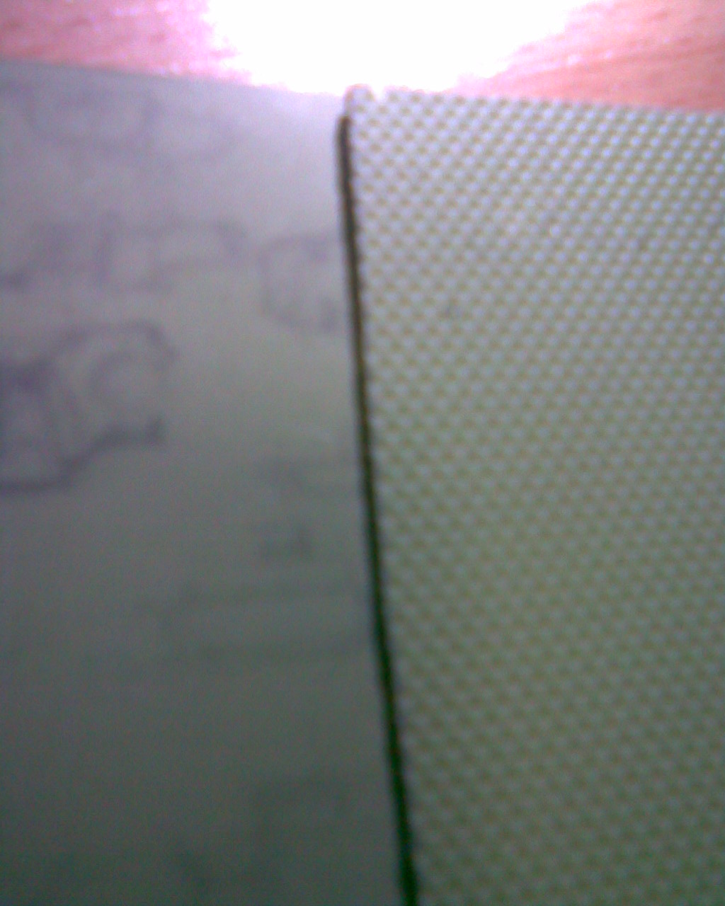

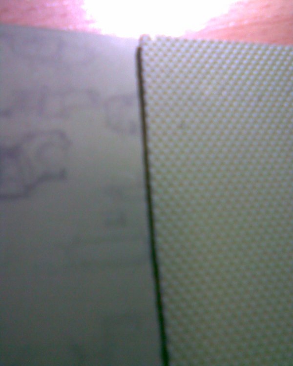

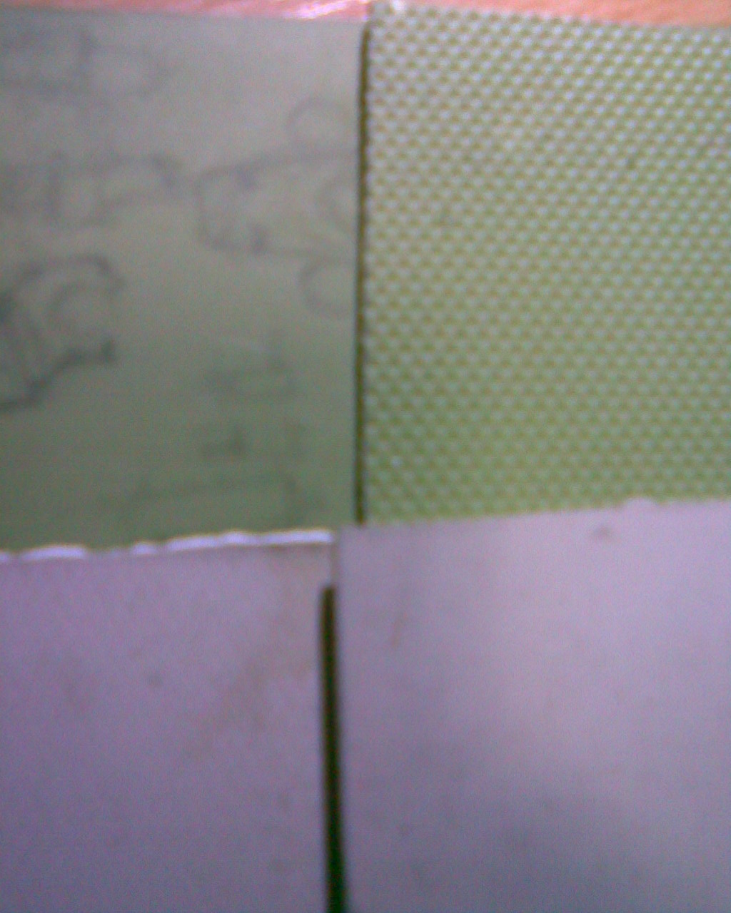

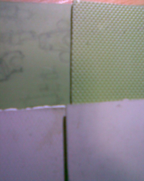

UN_MARINE Posted July 12, 2009 Share Posted July 12, 2009 great build, MaveRick! congratulations on graduating from cardboard to vinyl Kent Vinyl flooring tile, right? stick to the single-color tiles. the laminated ones are terrible to work with. try to find the 1.1mm tiles, they're usually less brittle than the 1.3mm & usually don't have the checkered pattern at the back. Quote Link to comment Share on other sites More sharing options...
MaveRick Posted July 17, 2009 Author Share Posted July 17, 2009 (edited) 505thAirborne: thanks again adam... MechTech: i dunno if scarcity of resources is good.. but yeah.. i think one gets to think and squeeze more of his creative juices when face with such constraints.. UN_MARINE: thanks.. it's inevitable, i always had the feeling that i'll need to abandon the cardboard material and shift to another sooner or later.. i'm not sure of it's brand, but it's around 1.3mm without those checkered pattern you mentioned.. bending is a bit tricky, but i'm starting to get the hang of it. Guys... i'll be posting my progress pics later.. Edited July 17, 2009 by MaveRick Quote Link to comment Share on other sites More sharing options...

UN_MARINE Posted July 17, 2009 Share Posted July 17, 2009 great progress! keep it up UN_MARINE: thanks.. it's inevitable, i always had the feeling that i'll need to abandon the cardboard material and shift to another sooner or later.. i'm not sure of it's brand, but it's around 1.3mm without those checkered pattern you mentioned.. bending is a bit tricky, but i'm starting to get the hang of it. no problem here's the checkered pattern on the 1.3mm and here's the 1.1mm next to the 1.3mm try warming the material up before bending. body heat will do. the material's a little sensitive to heat, it will sag if it gets warm enough. BTW, you might want to check your cutter's blade every 1 tile you use. i used to swap out blades a lot. it's great stuff, but it's tough on tools Quote Link to comment Share on other sites More sharing options...
