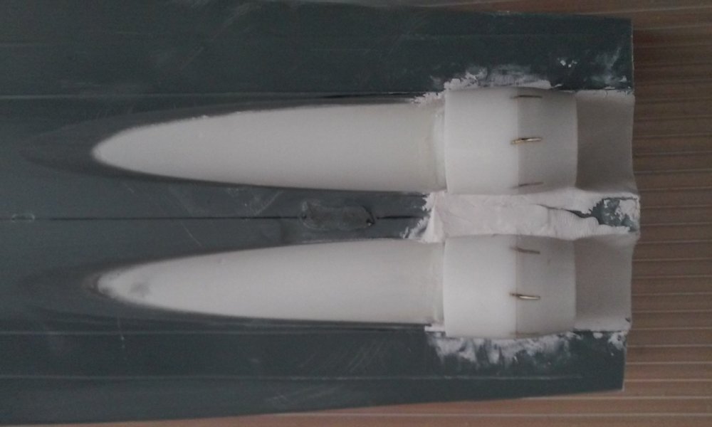

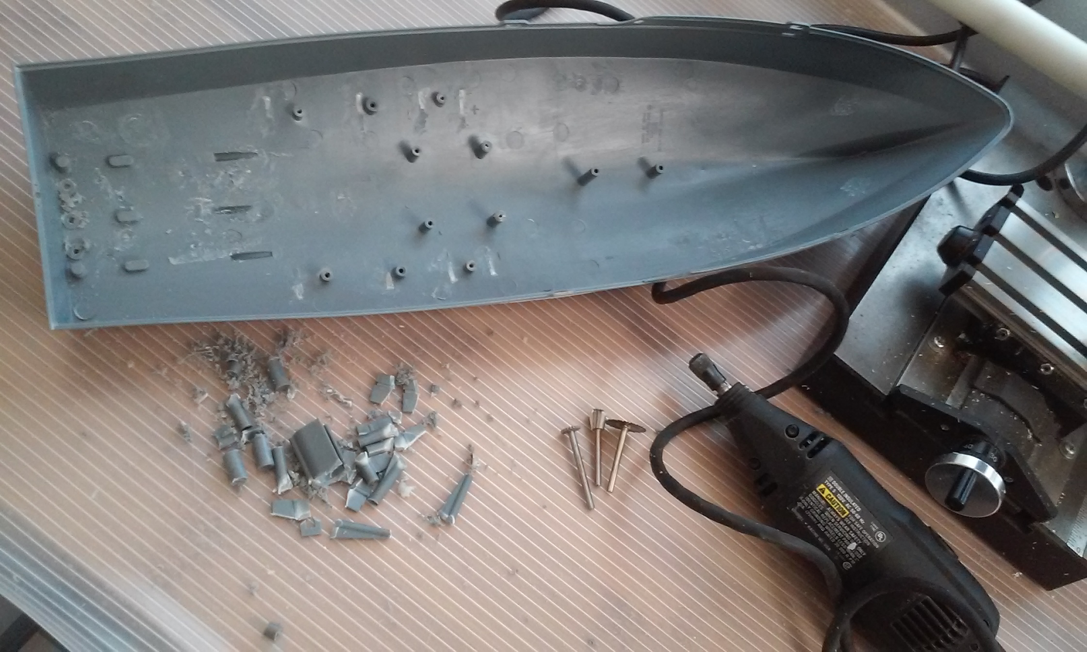

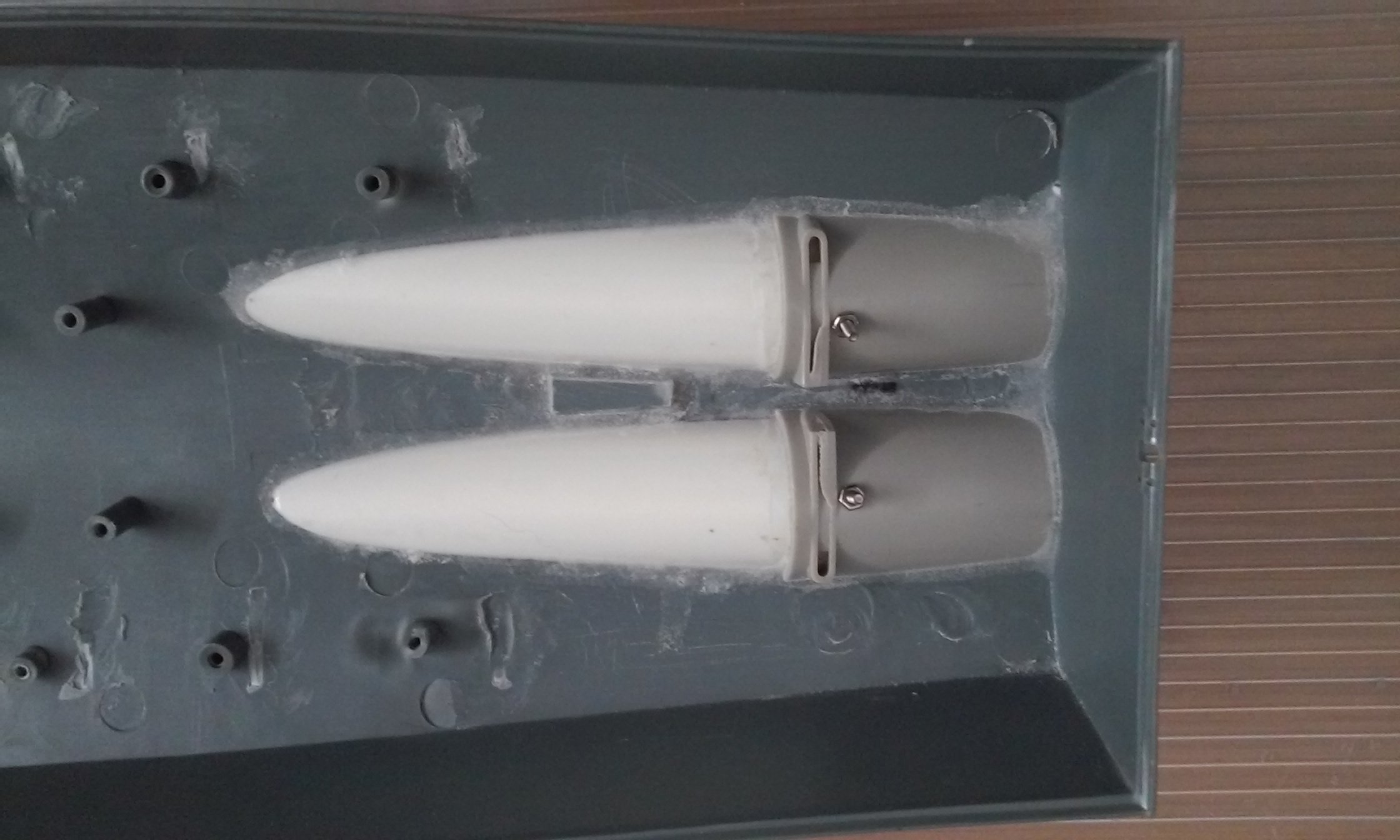

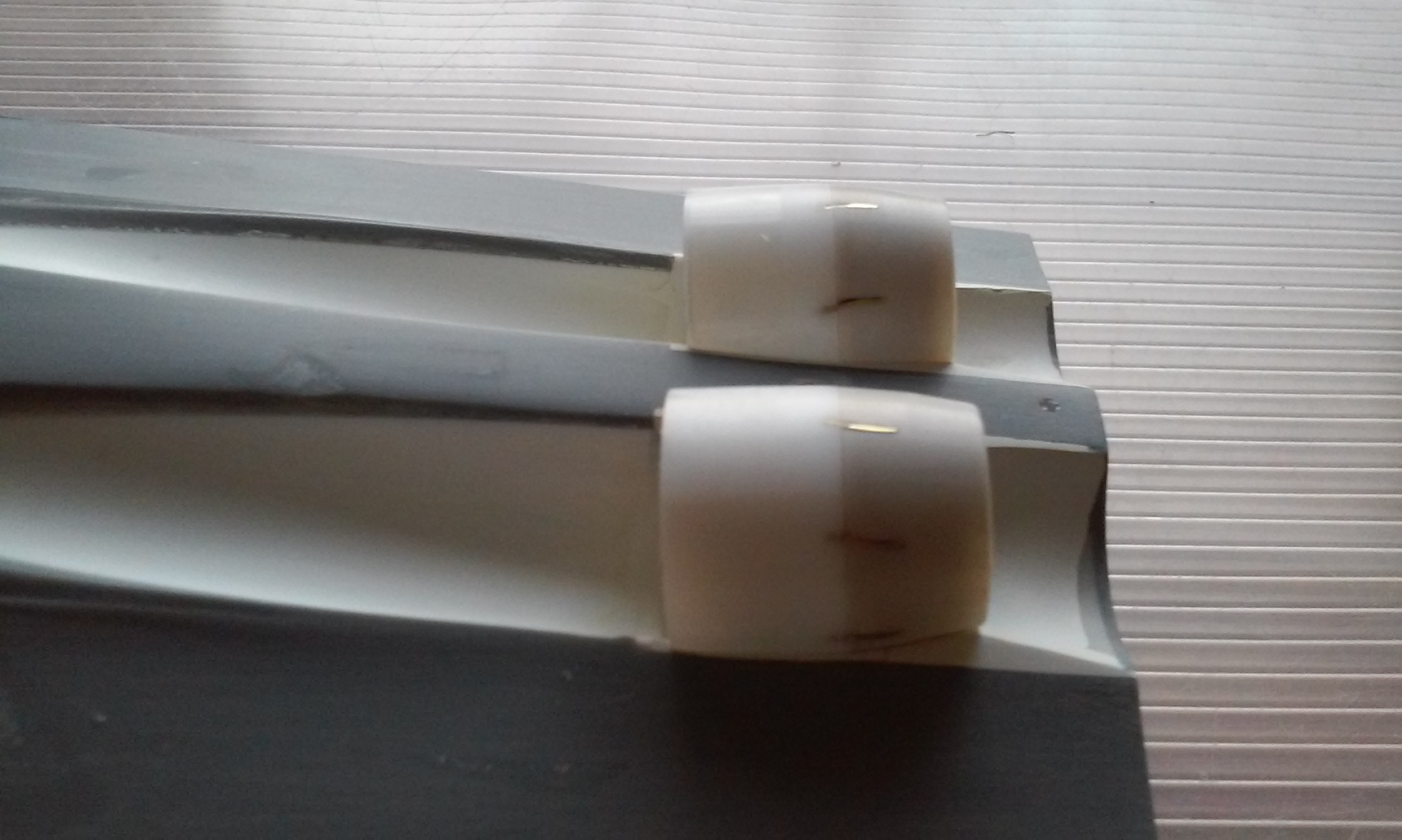

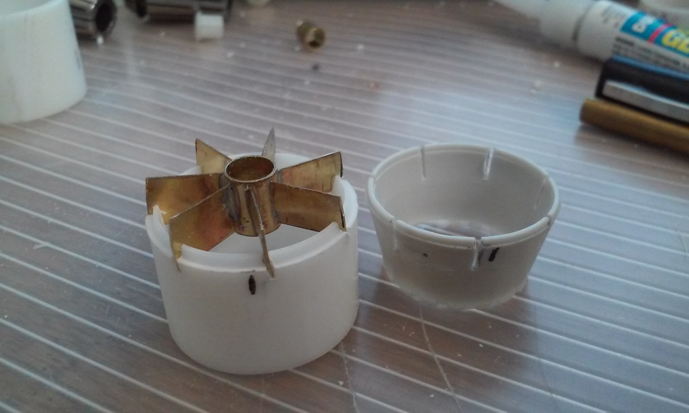

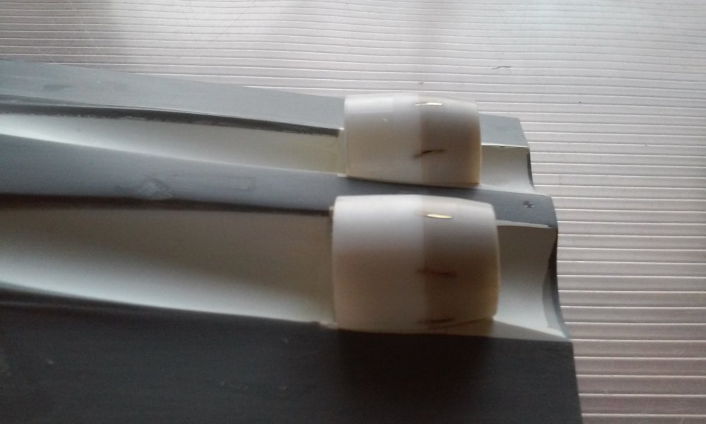

MechTech Posted January 8, 2017 Posted January 8, 2017 (edited) Thanks Sketchley for the links! The color looks good Arbit! The photo looks kinda purplish. FINALLY dug into some styrene work. The structure of the pods are done. It was fun cutting the angled slots into the pods for the stators. If the gray nozzles look to you like they came from an old pod racer kit, you're right! From my spares box. You can see the waterfoil shapes in the stator sides a little better in the finished product. Then I cleaned a lot of junk out of the hull to save weight and make space. The propeller channels are built into the hull from 1" styrene tube and the battery holders for the PT-15. Just waiting for the epoxy to cure now and clean it up. - MT Edited January 8, 2017 by MechTech
arbit Posted January 8, 2017 Posted January 8, 2017 I assume there is waterproofing required. Is it difficult?

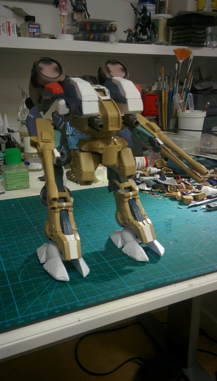

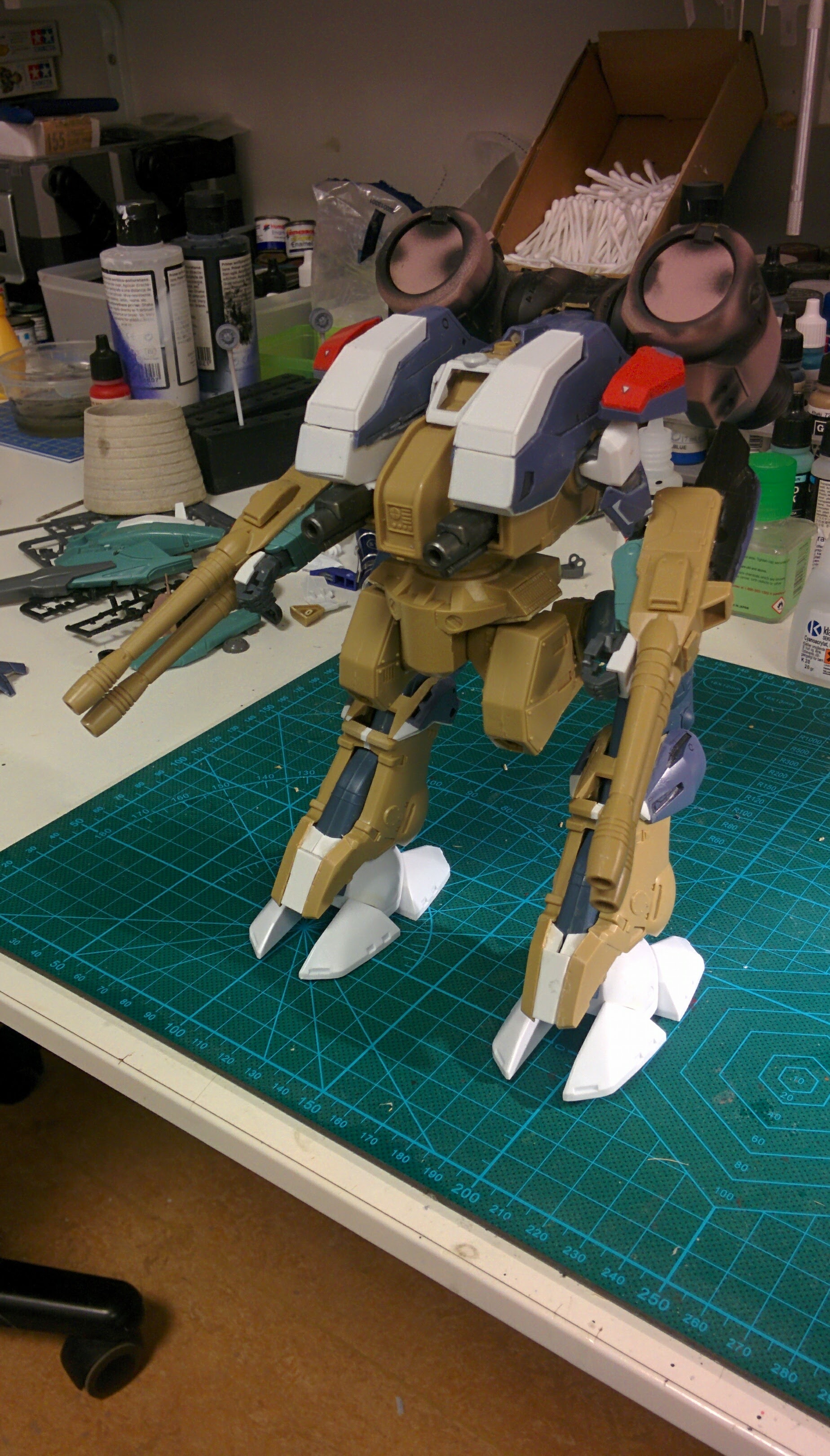

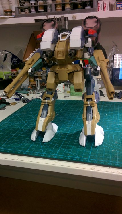

Nyankodevice Posted January 8, 2017 Posted January 8, 2017 well.... the legs look better than i expected
MechTech Posted January 8, 2017 Posted January 8, 2017 The waterproofing is not bad actually. Everything is so small it will go in little disposable sauce cups with lids. The hull will be lined with foam for buoyancy too. Nyankodevice, now I know what to do with all the stuff in my spares box Interesting build! - MT
ARK 3 Posted January 8, 2017 Posted January 8, 2017 2 hours ago, Nyankodevice said: well.... the legs look better than i expected Contract's you did what I was afraid to do, so long back ,,, when Macross came out I was chatting with friend's { who I no longer chat with} I saw the same ideal's your showing in the Mech's back in the 80's now you in the top 10,000 Kit basher's so many of us out there I've always Enjoyed the Creative side of model making. are you going to do the same with all the other part from the kit's you haven't used ? if you do you can call the { Group of Mech's } CALLED { The Junk yard Dog Club.}
Big s Posted January 8, 2017 Posted January 8, 2017 Nyankodevice that is some serious Frankenstein work. Keep up the crazy mad scientist skills.

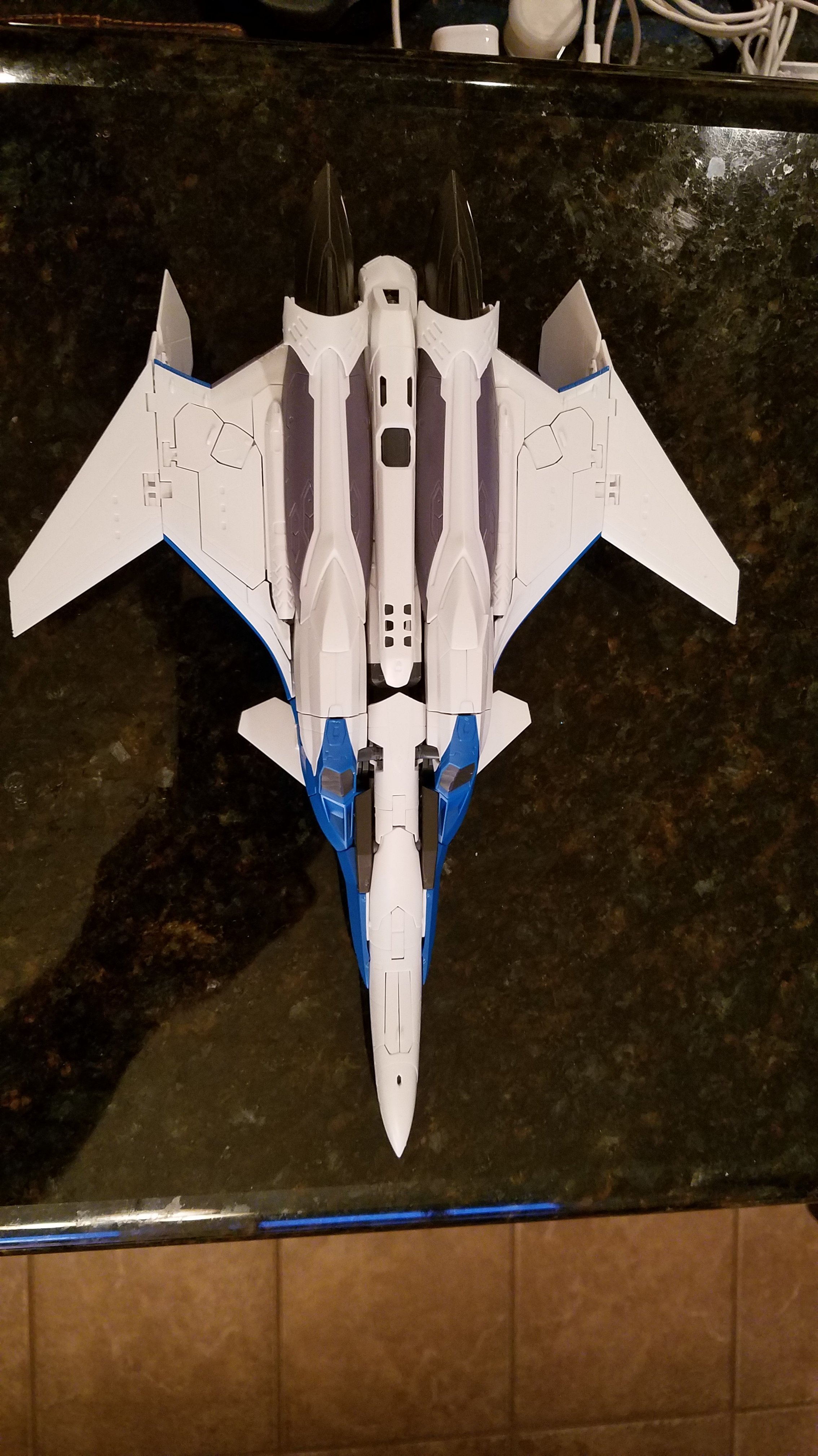

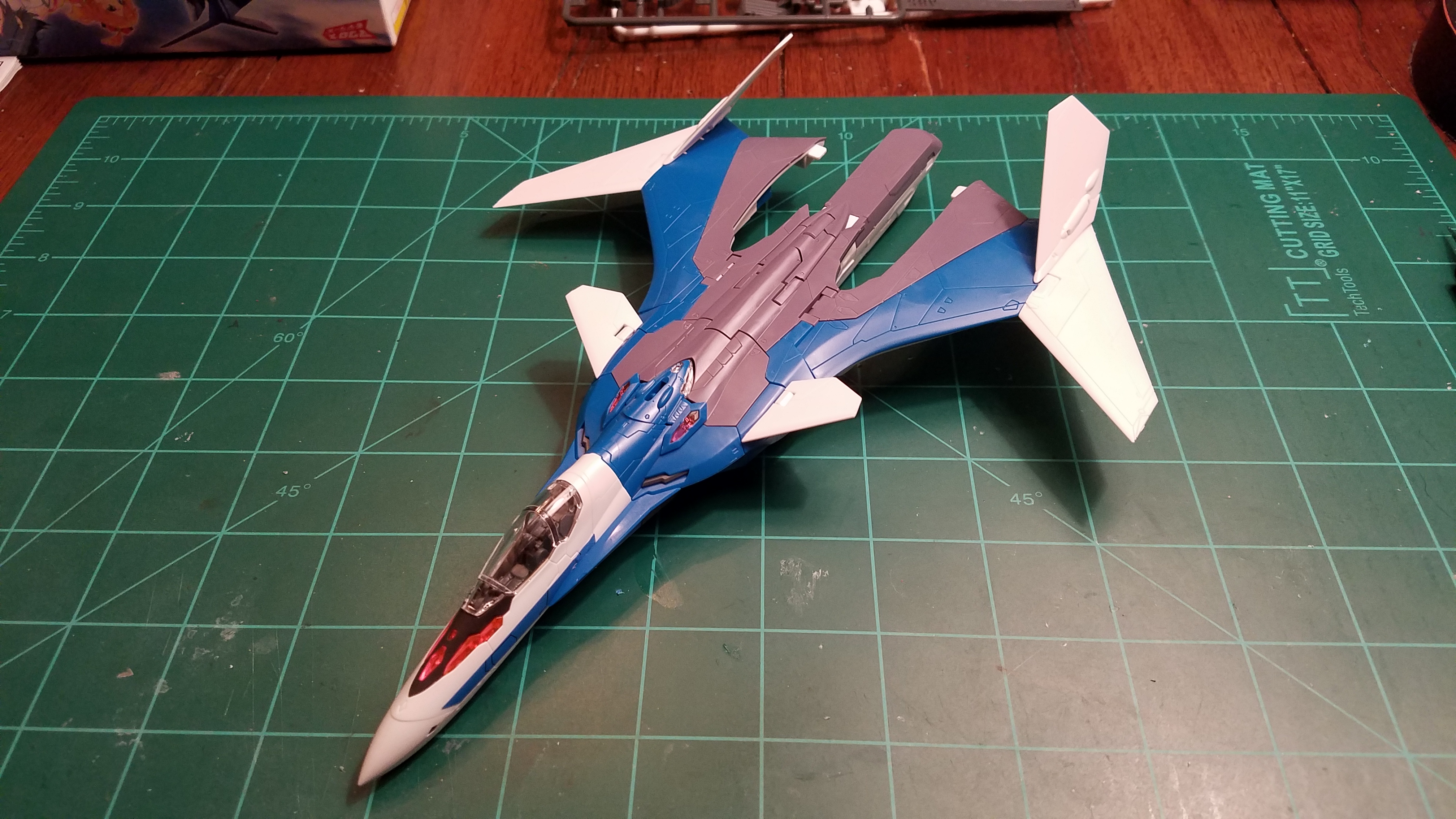

derex3592 Posted January 9, 2017 Posted January 9, 2017 Nice Frankenmecha! Good progress today on the 31 kit, just the legs left to do
arbit Posted January 9, 2017 Posted January 9, 2017 Nyanko, It even looks like a pirate! Give it a skull and cross bones.

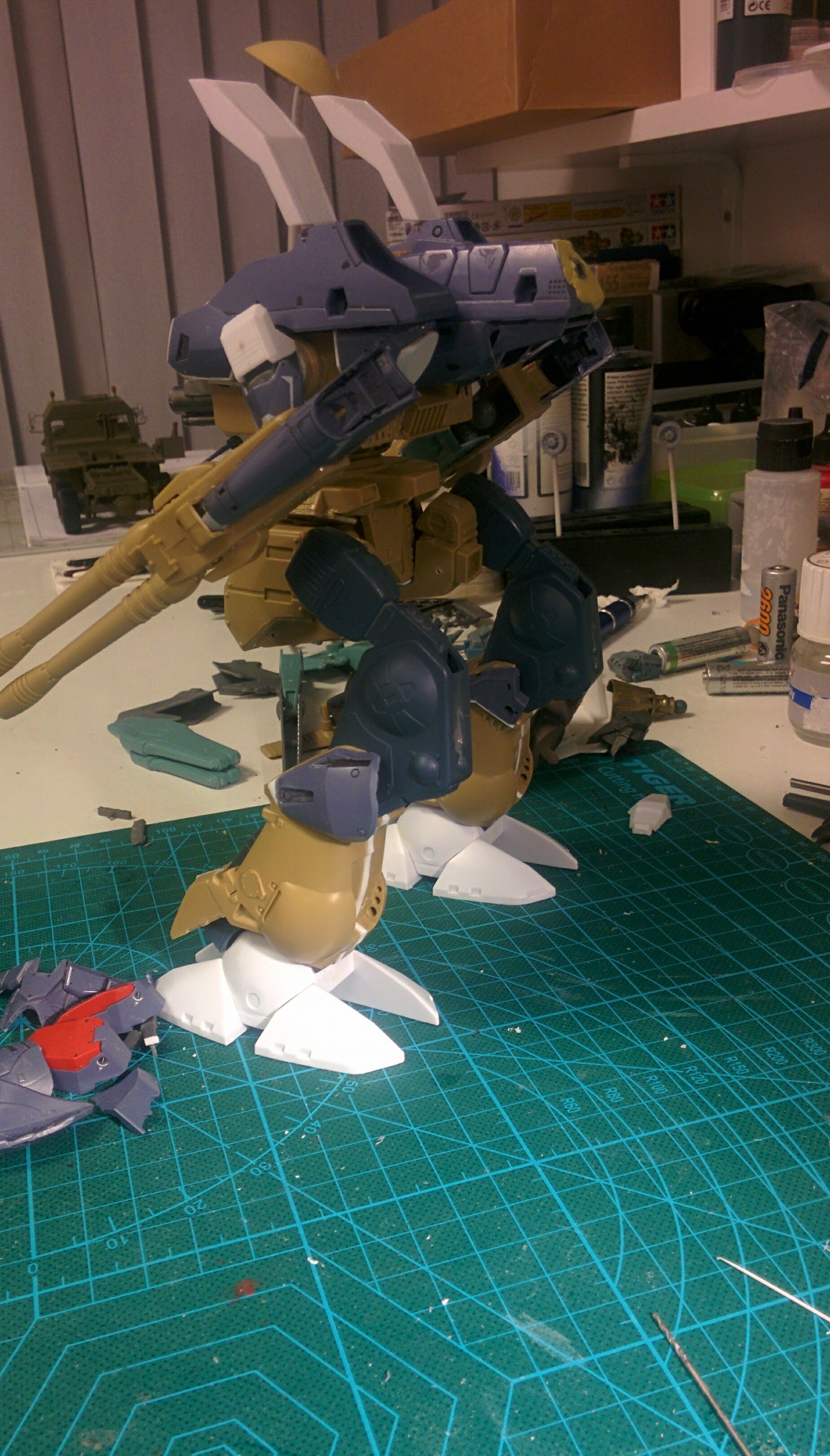

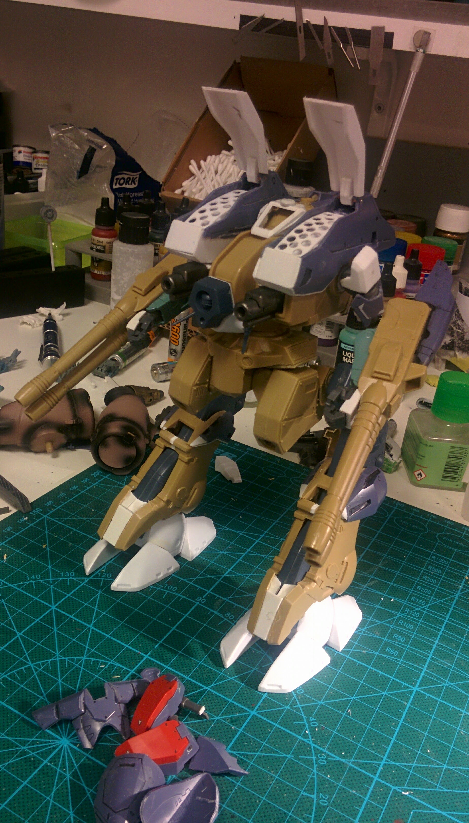

Nyankodevice Posted January 9, 2017 Posted January 9, 2017 made the hatch mechanism.. added the glaug evil eye as a test to see if looked good

Chronocidal Posted January 13, 2017 Posted January 13, 2017 On 1/8/2017 at 4:57 PM, derex3592 said: Nice Frankenmecha! Good progress today on the 31 kit, just the legs left to do Looking good! I did a similar build of one of the Sv-262s over the holidays, just a quick slap-together job. I think that one holds up a bit better than the 31, and feels more sturdy all around. So as far as things to glue on the VF-31 kits, you're going to need it on a few pieces at least. Namely, the plates that are supposed to snap in ahead of the gun barrels under the wings, and the tail mounts. On mine, the tails are only held in by the outer wing segments, so if you try to extend and fold them, the tails just fall off. Those you can probably safely glue in. The gun barrel panels though might actually need to be removed for transforming the valk, since I think the instructions show it (they fixed this on the DX version, the panels are permanently part of the wing). Other things you might want to consider gluing together are the thighs, since mine seem to love to pop apart if I try to move them too much. I've got another Hayate kit incoming, and I might actually just do one using all the stickers to see how it turns out. I halfway think they intend for the stickers to help hold the kit together sometimes.

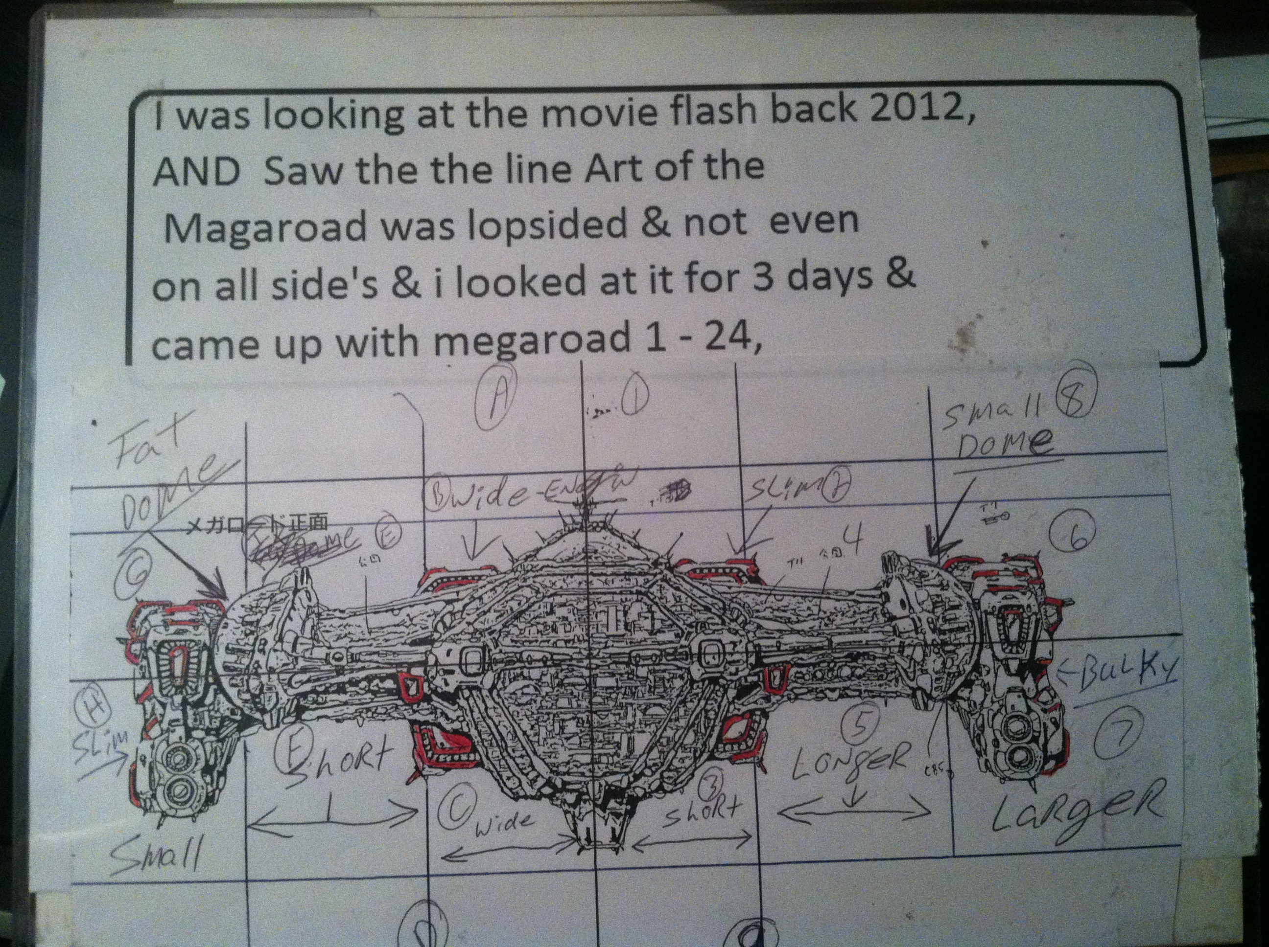

ARK 3 Posted January 13, 2017 Posted January 13, 2017 Ill be back to making the ruff draft model soon,, the cardboard version did not turn out right.

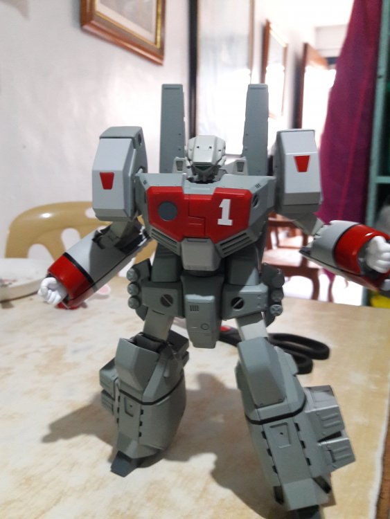

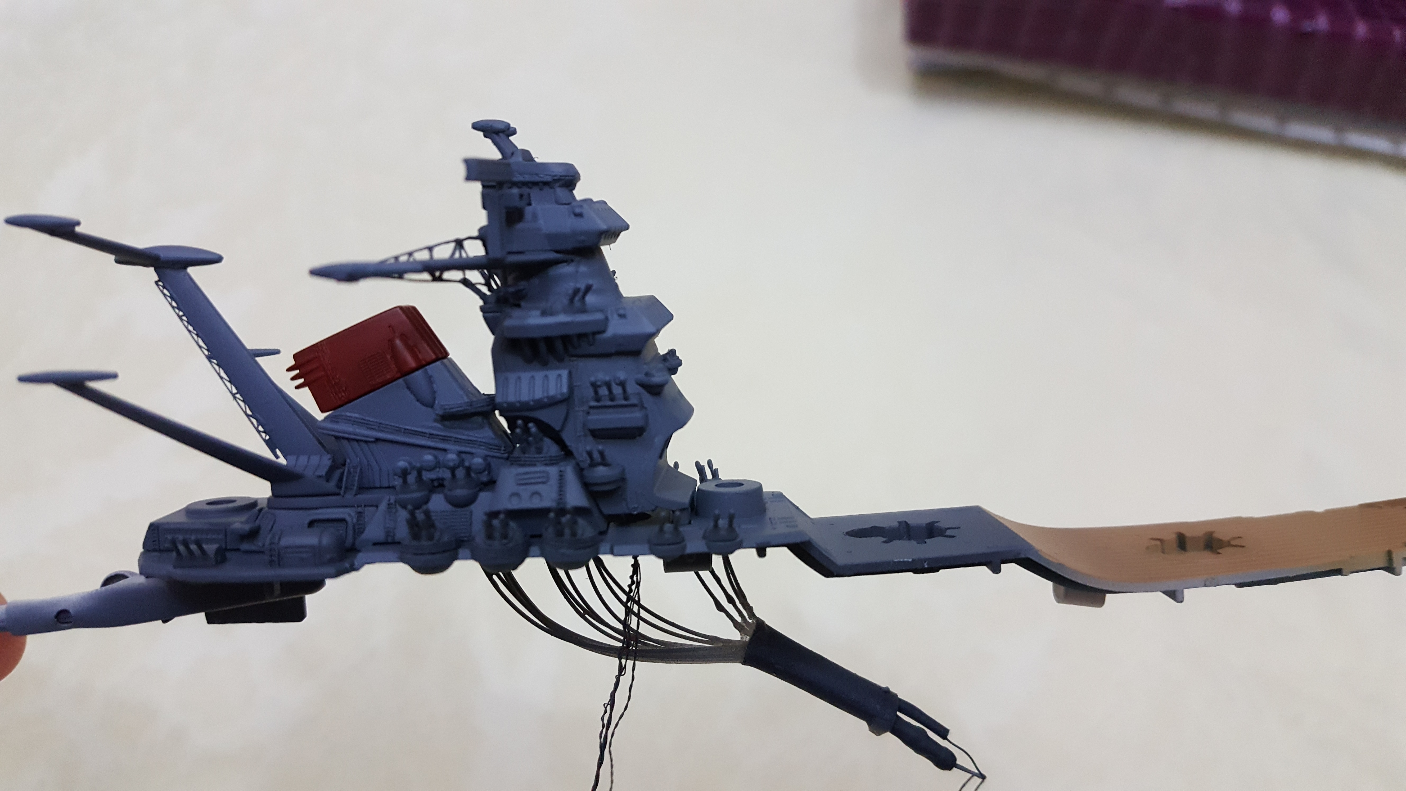

arbit Posted January 13, 2017 Posted January 13, 2017 (edited) 5 hours ago, chyll2 said: Added stripe and small paint apps. Which kit is that? Looks too good for the Arii. Edited January 13, 2017 by arbit
chyll2 Posted January 13, 2017 Posted January 13, 2017 32 minutes ago, arbit said: Which kit is that? Looks too good for the Arii. Thanks arbit. This is the 1/60 Yamato toy repainted. In terms of workflow, it is very close to Valkyrie Addict did years ago. The head was 3D printed from Kurisama shop at shapeway. http://www.macrossworld.com/mwf/topic/40394-valkyrie-addicts-little-shop-of-horrors/

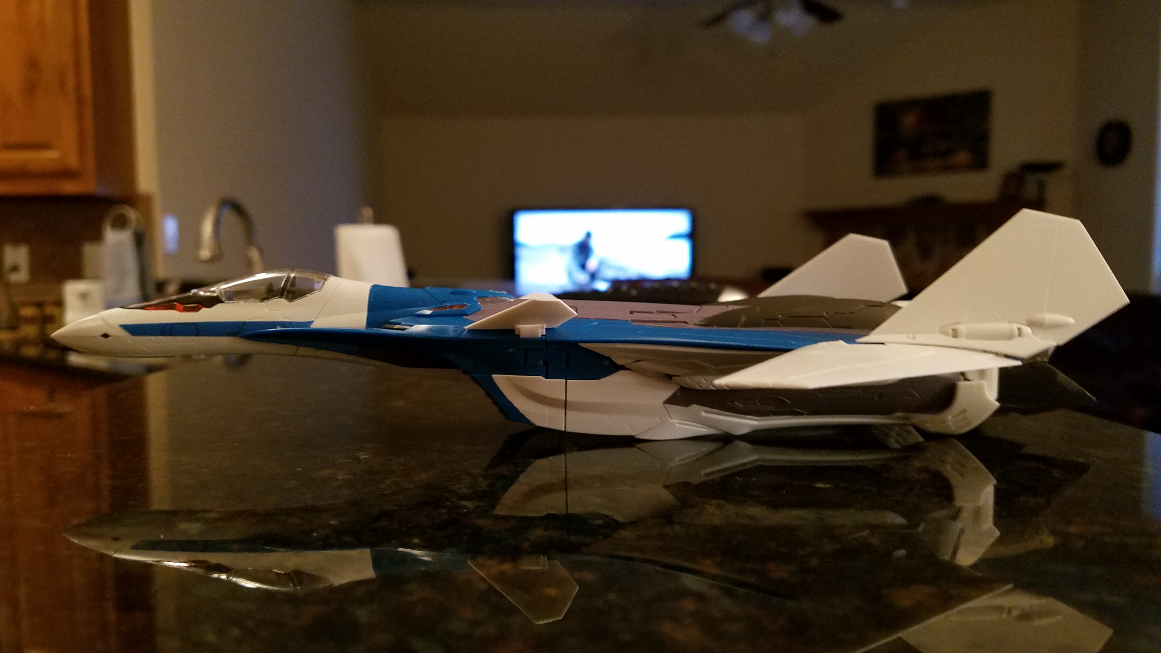

derex3592 Posted January 13, 2017 Posted January 13, 2017 Finished the Vf-31 kit today. Not one drop of glue. This thing locks together SUPER tight in fighter mode. I'm amazed, you can swoosh it around and shake it, nothing rattles or pops off. I would never say it's a replacement for the DX, but for 30 bucks, it ain't bad. Don't know if I'll try a transformation or not. Maybe later, gonna ponder a cool custom paint scheme to do on it.

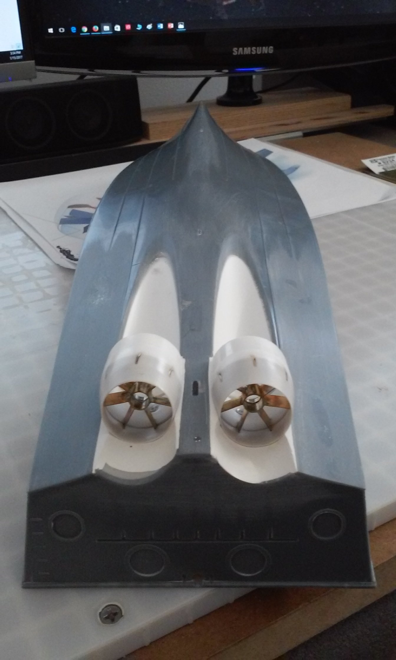

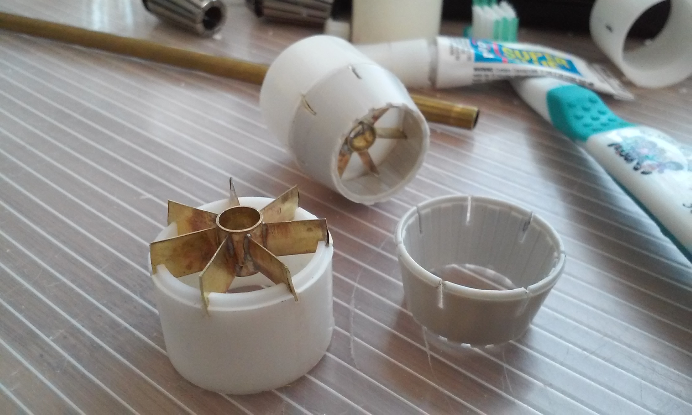

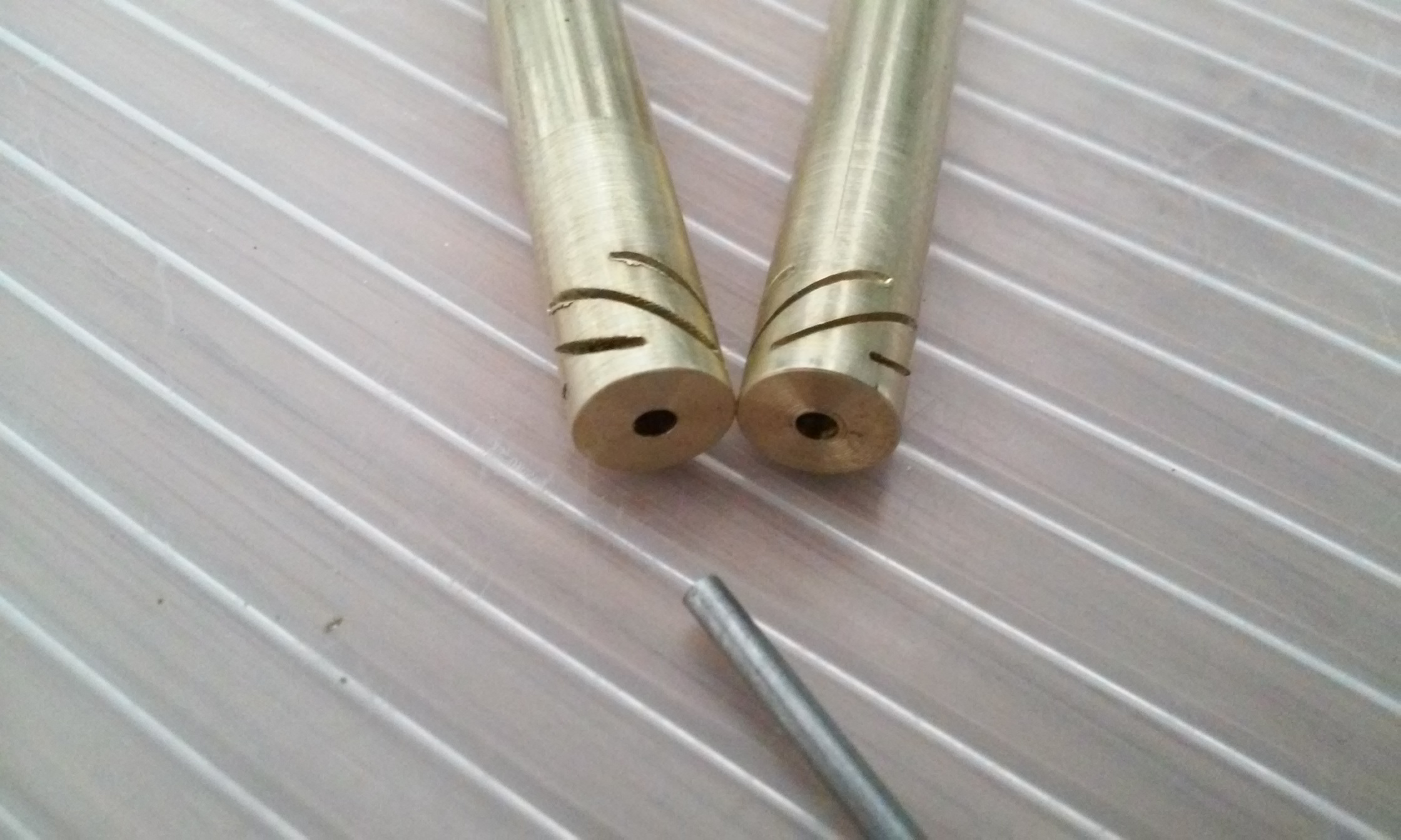

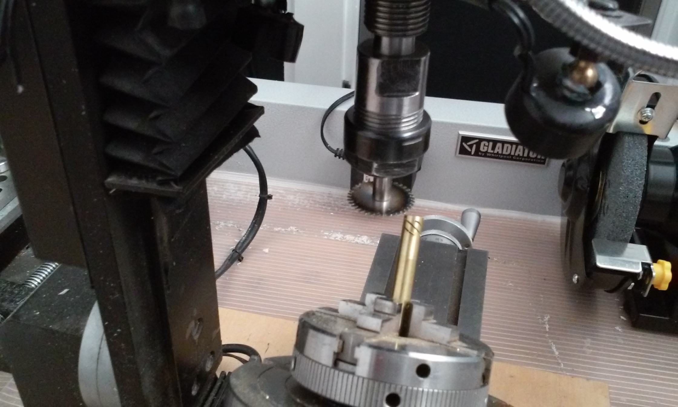

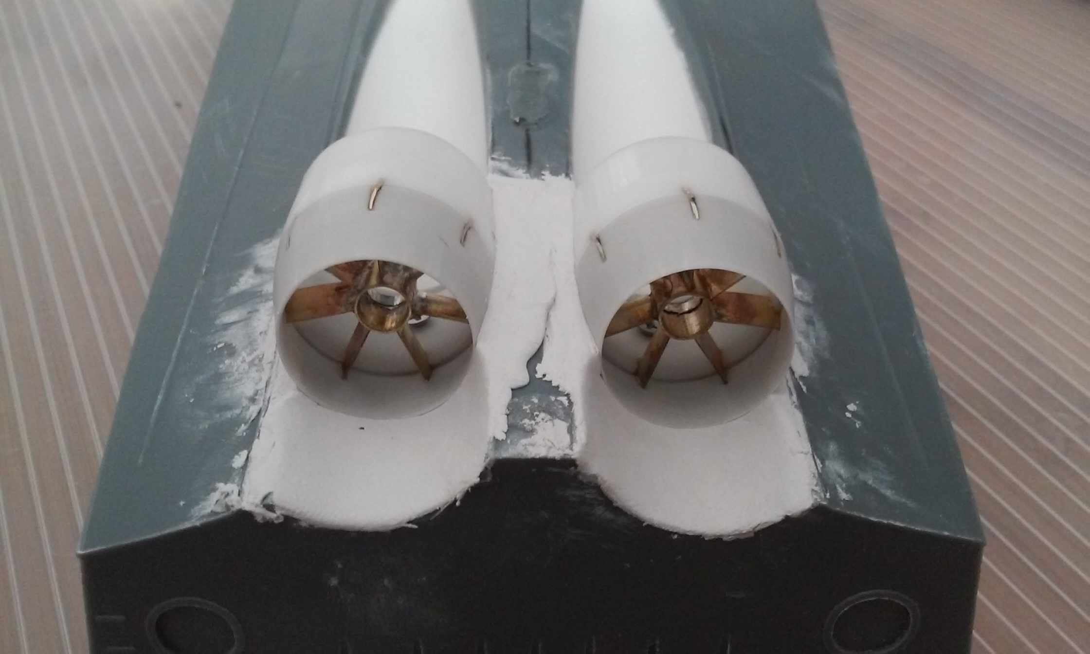

MechTech Posted January 15, 2017 Posted January 15, 2017 She looks GREAT Electric Indigo! Missile Boat is coming along slowly. I cleaned up the stern and machined hubs to solder the prop blades (counter-rotating; soon to be made) onto. The prop shaft is 1/16" stainless steel in the photo. I had to make my own saw blade to get that thin of a slit cut into the hubs. Making jigs and tooling is drawing out this build longer than expected. - MT
