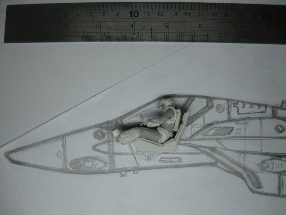

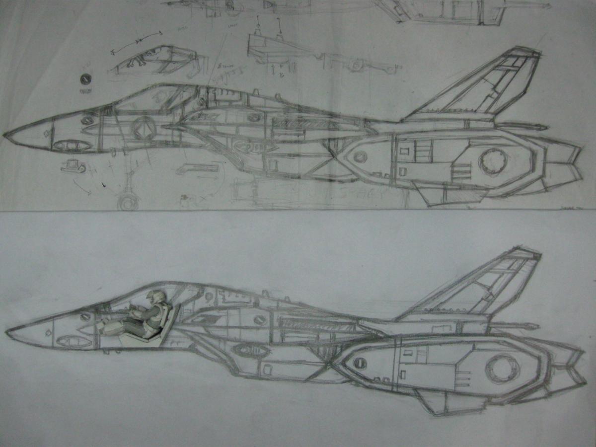

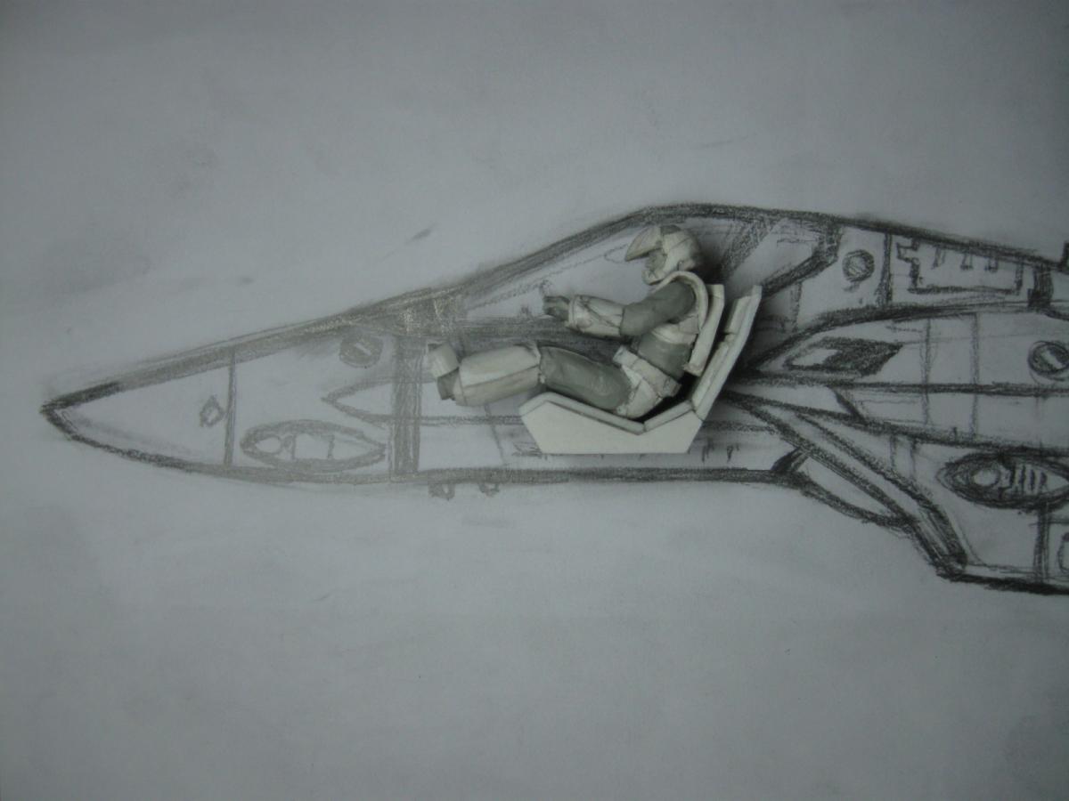

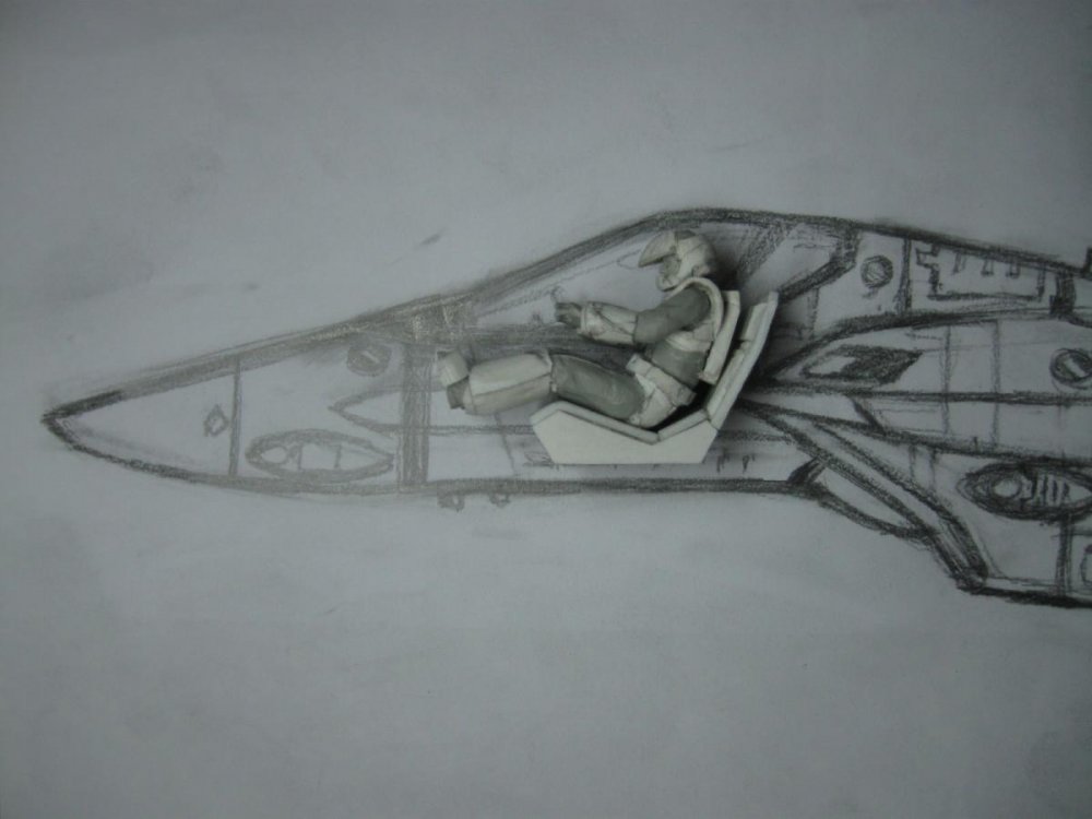

UN_MARINE Posted February 4, 2016 Posted February 4, 2016 nice sketch work! Thanks! Got the math, proportions, & magic line art to play nice (for now). Now there's a little more room for everybody.
spanner Posted February 4, 2016 Posted February 4, 2016 hehe! the pilot looks like he's wearing a diaper!
Ignacio Ocamica Posted February 4, 2016 Posted February 4, 2016 Looking awesome!!! Just my opinion, if you are going to scrtchbuils a 1/35 cockpit/VF-1, I would do the cockpit bigger, you need more space under the seat for the landing gear.
UN_MARINE Posted February 4, 2016 Posted February 4, 2016 Looking awesome!!! Just my opinion, if you are going to scrtchbuils a 1/35 cockpit/VF-1, I would do the cockpit bigger, you need more space under the seat for the landing gear. Thanks! The total length of the drawing is correct to scale, but adjusting to the pilot ends up with a cartoonishly large cockpit, just like the 1/18 Matchbox Vf-1. I could adjust everything to correct for size, but it wouldn't match up with the scale dimensions. Serious dilemma! What do you guys think? 1/35 scale based on official dimensions, or 1/35 based on the pilot figure?
Ignacio Ocamica Posted February 4, 2016 Posted February 4, 2016 Thanks! The total length of the drawing is correct to scale, but adjusting to the pilot ends up with a cartoonishly large cockpit, just like the 1/18 Matchbox Vf-1. I could adjust everything to correct for size, but it wouldn't match up with the scale dimensions. Serious dilemma! What do you guys think? 1/35 scale based on official dimensions, or 1/35 based on the pilot figure? I meant adjusting everything. I would adjust the VF-1 based on the 1/35 scale pilot. Pleaso no 1/18 matchbox VF-1
UN_MARINE Posted February 4, 2016 Posted February 4, 2016 I meant adjusting everything. I would adjust the VF-1 based on the 1/35 scale pilot. Pleaso no 1/18 matchbox VF-1 Cool. There's actually enough room for the landing gear without further adjustments - the seat would just double as the landing gear bay. Definitely "no" to strange proportions!
NZEOD Posted February 5, 2016 Posted February 5, 2016 (edited) The seat ejects so it cant double as the bay. It also projects up and out of the cockpit through the neck when in Battroid mode. Thats a lot of equipment under the seat to allow ejection, tilting in Battroid mode and then extending out of the neck as well. No way the landing gear tucks into this space as well as airframe reinforcing in this area for carrier trap landings and catapult launches... your airframe needs to be bigger. It cant be all packed behind the seat either as in the VF-1D thats where the back seaters legs will be and the seats would be the same. Have a look at the F/A-18 nose gear for an idea of how bulky they need to be for deck landings BTW... your seat design is looking very much like this one.... nice! Edited February 5, 2016 by NZEOD
Nyankodevice Posted February 5, 2016 Posted February 5, 2016 Thanks! Got the math, proportions, & magic line art to play nice (for now). IMG_7279.jpg IMG_7277.jpg Now there's a little more room for everybody. IMG_7278.jpg pilot looks a bit big for that valk... or its a really big guy? but really its almost impossible to make it accurate, cuz alot of anime magic is involved in the cockpit with transformation and whatnot... however i really like what you've done so far. keep up the good work
UN_MARINE Posted February 5, 2016 Posted February 5, 2016 pilot looks a bit big for that valk... or its a really big guy? but really its almost impossible to make it accurate, cuz alot of anime magic is involved in the cockpit with transformation and whatnot... however i really like what you've done so far. keep up the good work The pilot was originally from a 1/35 US infantry kit, so it would be a 6.2ft - 6.4ft guy, I figure. So that's the dilemma - scale the VF-1 around the pilot, or stick to the official dimensions. Thanks! The seat ejects so it cant double as the bay. It also projects up and out of the cockpit through the neck when in Battroid mode. Thats a lot of equipment under the seat to allow ejection, tilting in Battroid mode and then extending out of the neck as well. No way the landing gear tucks into this space as well as airframe reinforcing in this area for carrier trap landings and catapult launches... your airframe needs to be bigger. It cant be all packed behind the seat either as in the VF-1D thats where the back seaters legs will be and the seats would be the same. Have a look at the F/A-18 nose gear for an idea of how bulky they need to be for deck landings BTW... your seat design is looking very much like this one.... nice! Cool. I meant combining the seat & gear bay in a model/toy sense, it was the only way the parts would ft in such a confined space. I wanted to build it with completely separate components - I was on the way to making the bottom half of the seat when I found out it wouldn't actually fit! The seat's based on the line art in Master File, I can only take credit for building it in scale.
spanner Posted February 5, 2016 Posted February 5, 2016 The seat ejects so it cant double as the bay. It also projects up and out of the cockpit through the neck when in Battroid mode. Thats a lot of equipment under the seat to allow ejection, tilting in Battroid mode and then extending out of the neck as well. No way the landing gear tucks into this space as well as airframe reinforcing in this area for carrier trap landings and catapult launches... your airframe needs to be bigger. It cant be all packed behind the seat either as in the VF-1D thats where the back seaters legs will be and the seats would be the same. Have a look at the F/A-18 nose gear for an idea of how bulky they need to be for deck landings BTW... your seat design is looking very much like this one.... nice! i'd love that seat for when I use DCS!
electric indigo Posted February 5, 2016 Posted February 5, 2016 Would it help to call the pilot 1/32 scale?

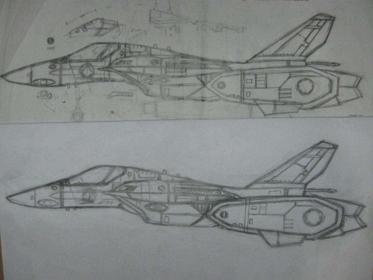

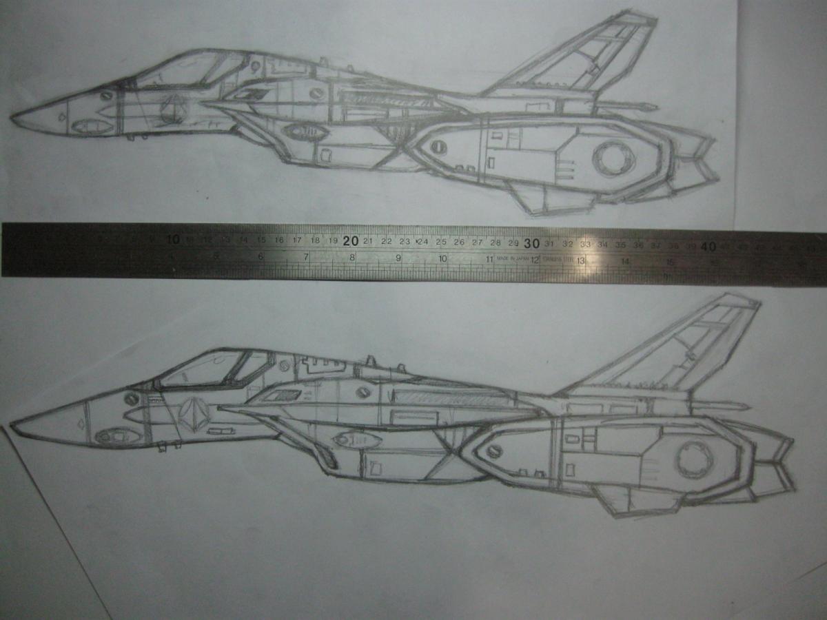

UN_MARINE Posted February 5, 2016 Posted February 5, 2016 Would it help to call the pilot 1/32 scale? We could, but it doesn't solve the space problem. I'd like to avoid sanding away the pilot's bottom half, if possible. The math checks out - a 6'2 pilot + flight suit at 1/35, scales down to 5.5cm tall. (It's like the VF-1 was built around short pilots! ) If the VF-1 is scaled to the pilot, it ends up at 1/31.6 - 1/32 scale. Here's the re-scaled drawing, it solves the cockpit space problem, but it's now a whole 2 inches longer. (1/32 scale) I'd prefer to have the fighter in 1/35 though. (less work!)
Nyankodevice Posted February 5, 2016 Posted February 5, 2016 Well you get more room that way.... May not be real world correct, but it looks more correct.

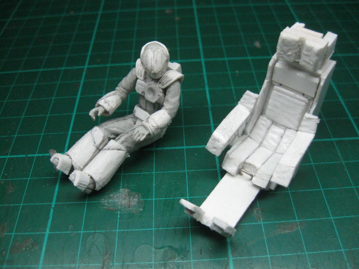

UN_MARINE Posted February 5, 2016 Posted February 5, 2016 Some improvements to the seat. I've decided to stick to the line art dimensions, so it'll be a "true" 1/35 scale fighter. Some magic will be involved. I think I've taken a little too much space in this thread... Time to relocate! http://www.macrossworld.com/mwf/index.php?showtopic=43411

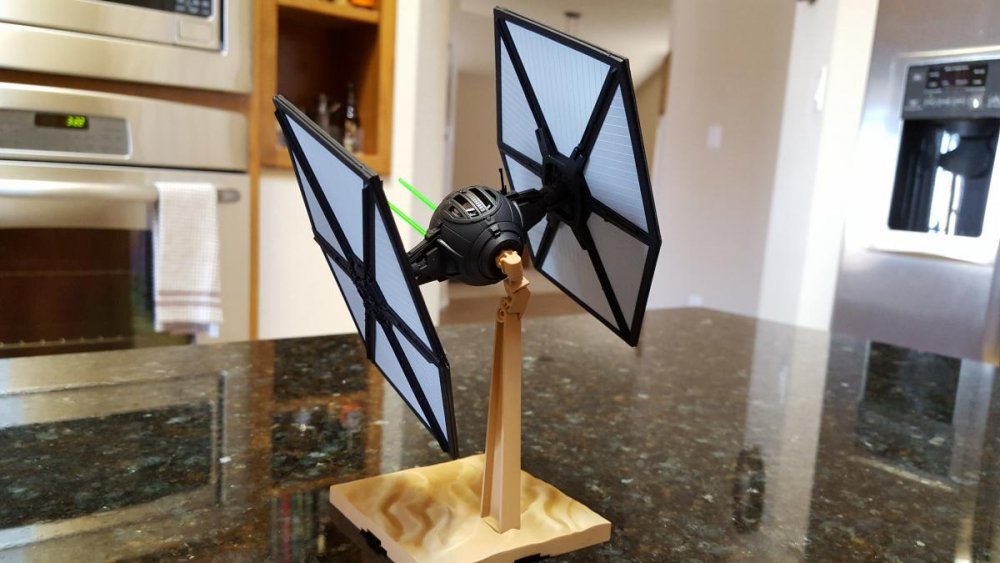

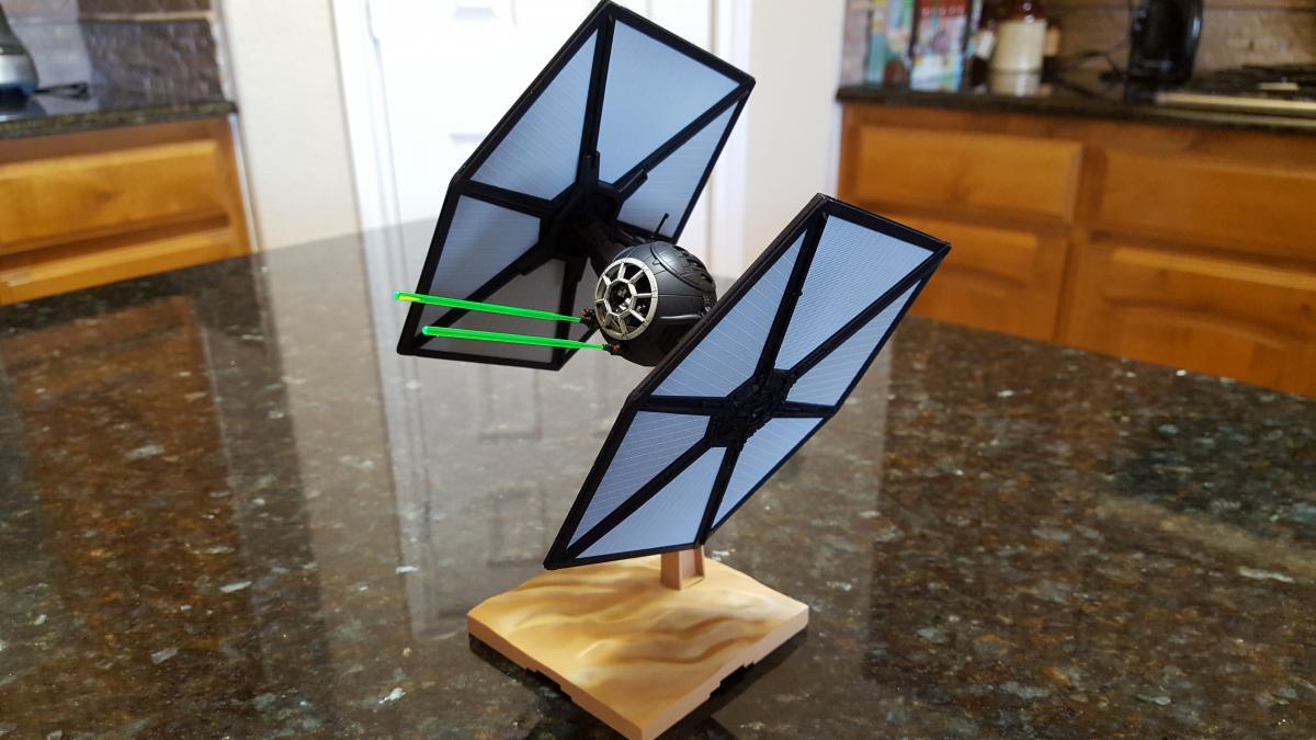

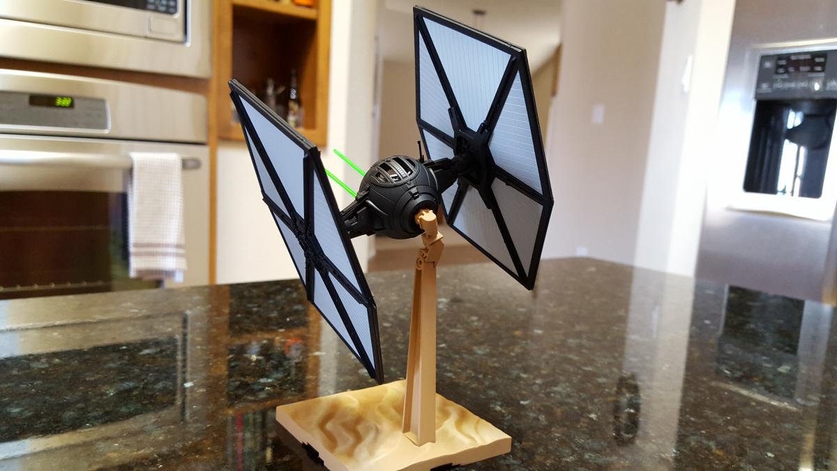

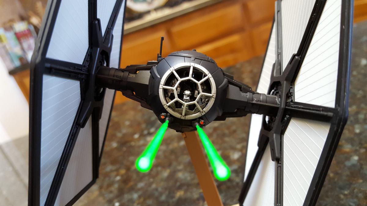

derex3592 Posted February 5, 2016 Posted February 5, 2016 Finished the Bandai 1:72 First Order Tie. Nice easy kit. Painted with Model Master Light Grey and Tamiya semi-gloss black.

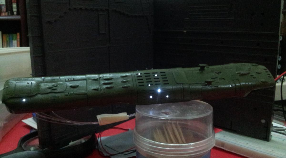

arbit Posted February 9, 2016 Posted February 9, 2016 (edited) Some progress. But doesn't look right to me yet. Edited February 9, 2016 by arbit
Thom Posted February 9, 2016 Posted February 9, 2016 Nice paint booth and great lighting on that Zentradi ship!
