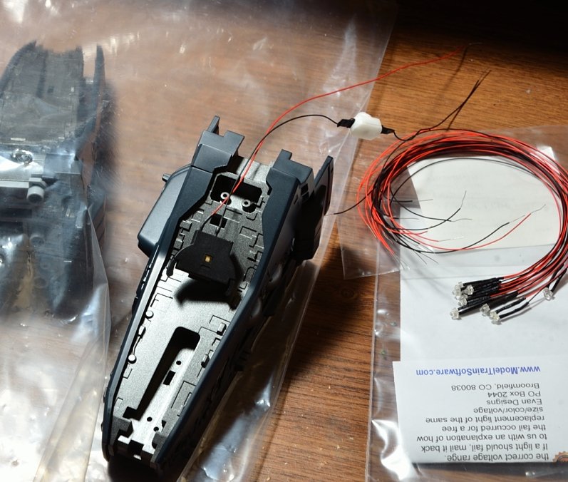

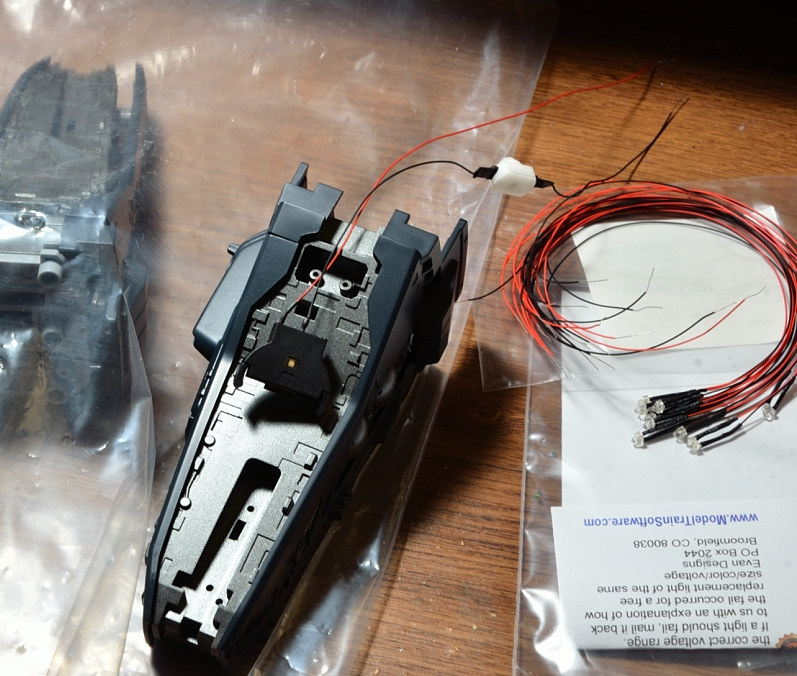

I'm starting to plan out what I'm going to do with mine. I have the decals, materials and tools I want to use now (I think).
I'm going to try putting blue LEDs in each of the thrusters to simulate this:
I found 1.8mm LEDs from this site, http://www.modeltrainsoftware.com, which I believe should be small enough to fit within the thruster wells.
They also have switches and a 3V cell battery holders that should fit within the confines of the leg, hopefully. I fitted the right leg piece together to try to see how I might do it. The switch is just a push button type and I also would like to be able to get at the battery without too much difficulty which may be easier said than done.
So far, I think I might be able to affix the battery holder on the inner side of the leg just underneath the domes, drill a hole and route the wires through and then out the bottom where I'll attach the LEDs and put the switch in the pit hidden by the thruster plate. I ordered some 5/16" x 1/16" neodymium disc magnets, with 2lbs of holding force, to use instead of screws to keep the sides of the leg and the "foot" in place so I can just pull them off to get at the battery and the switch.
Well, that's the plan anyway. It may or may not work out. I'll have to wait 'til everything arrives so I can see if there actually is enough clearance. This is the first time I'm trying anything like this in addition to building out my first model from pieces cut off from sprue, so hopefully I don't royally screw this up.
You can place the battery holder here as well. It seems easier to replace battery this way. You just need to cut out some parts thou.
Link to comment
Share on other sites
I may try that if my original plan doesn't work out. I want to try to keep the cutting to a minimum if possible.
How are you keeping the cover in place? Magnets as well?
I was going to, but the parts just fit without it.
Link to comment

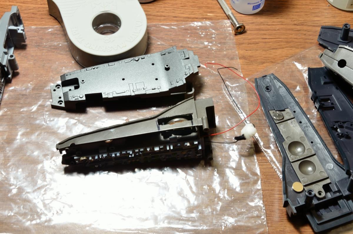

It turns out that the battery holder was larger than I thought. Neither method will work here I think.
I have another location I think I can put it. I'm waiting for my dremel to arrive so I can do some cutting inside the leg and make a slot to insert the battery like a coin.

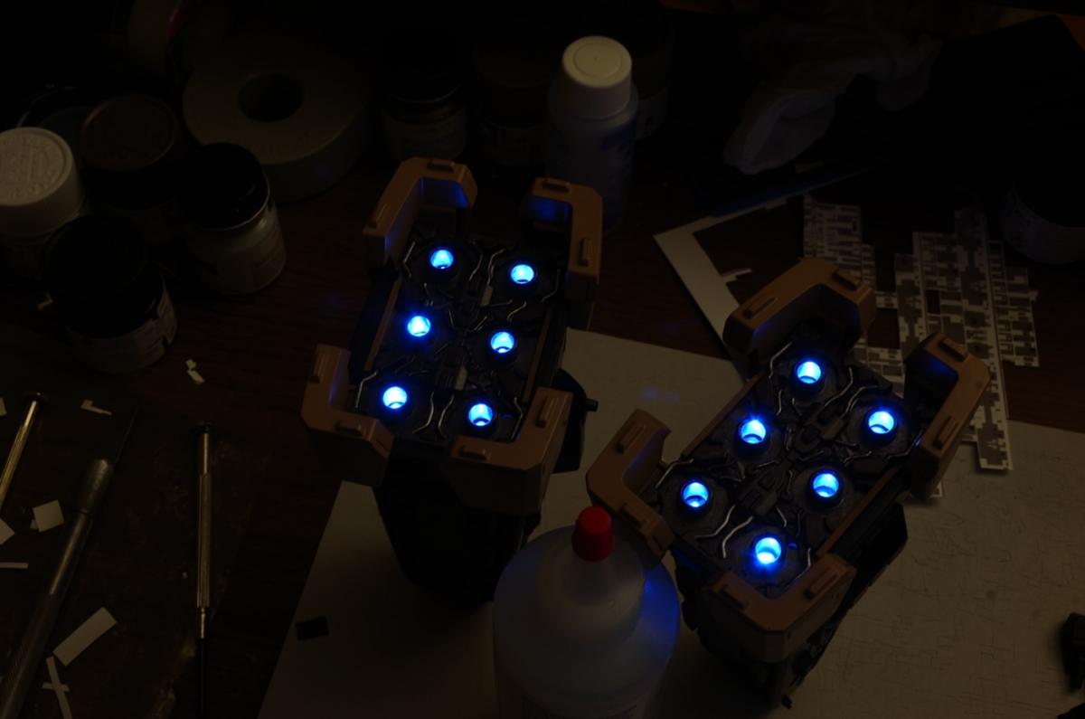

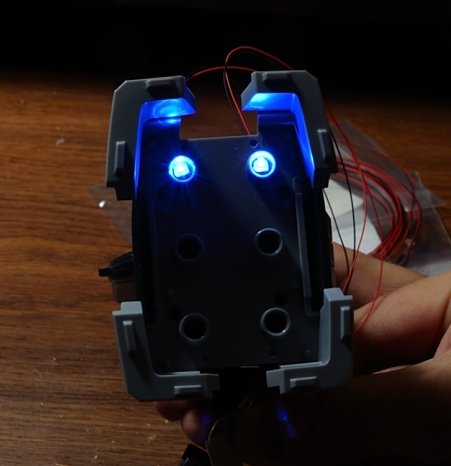

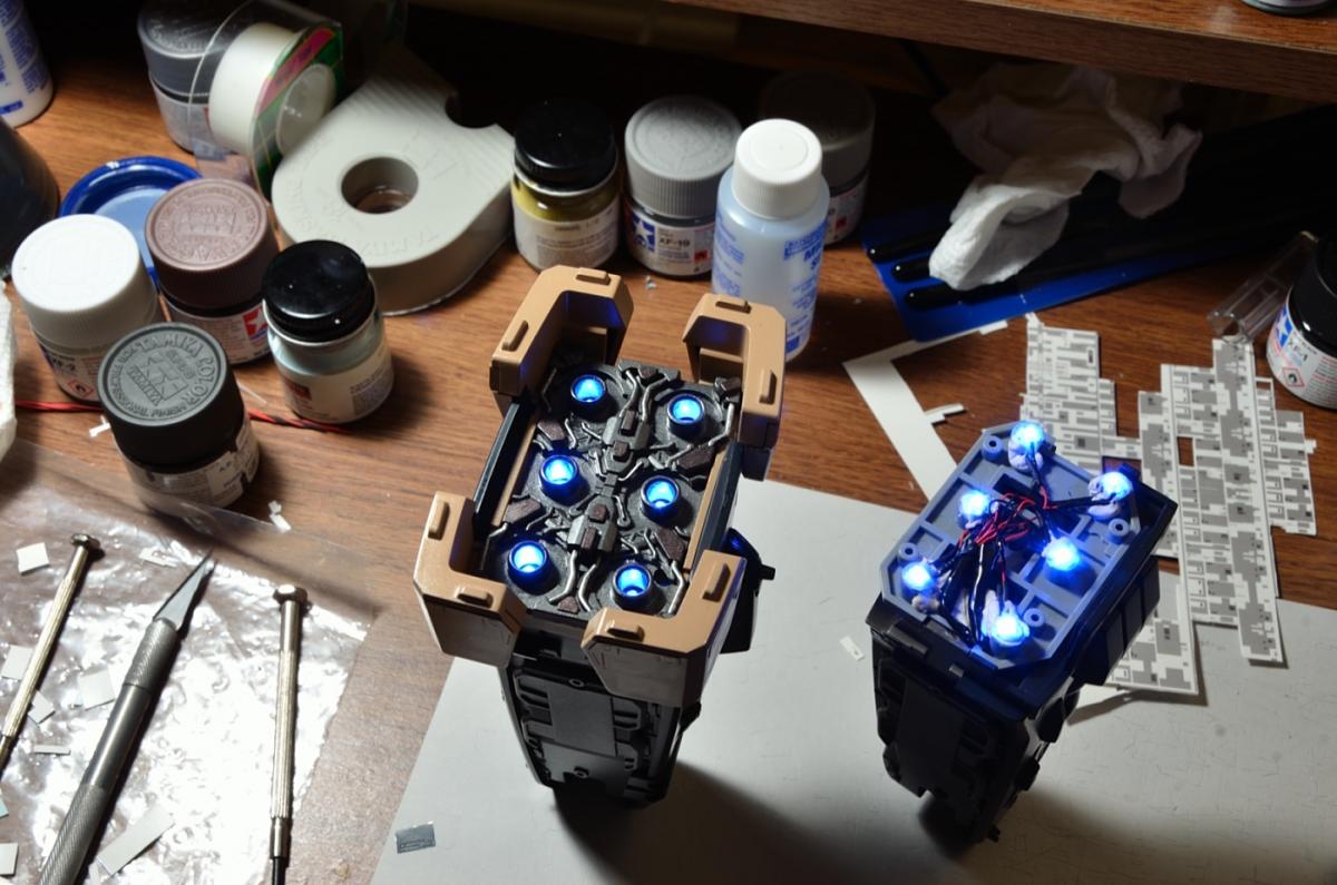

Testing the lights to see how they look:

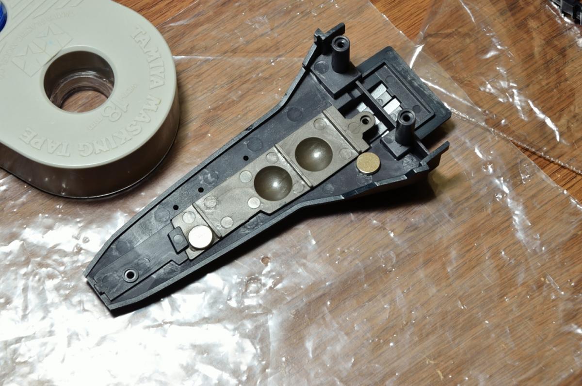

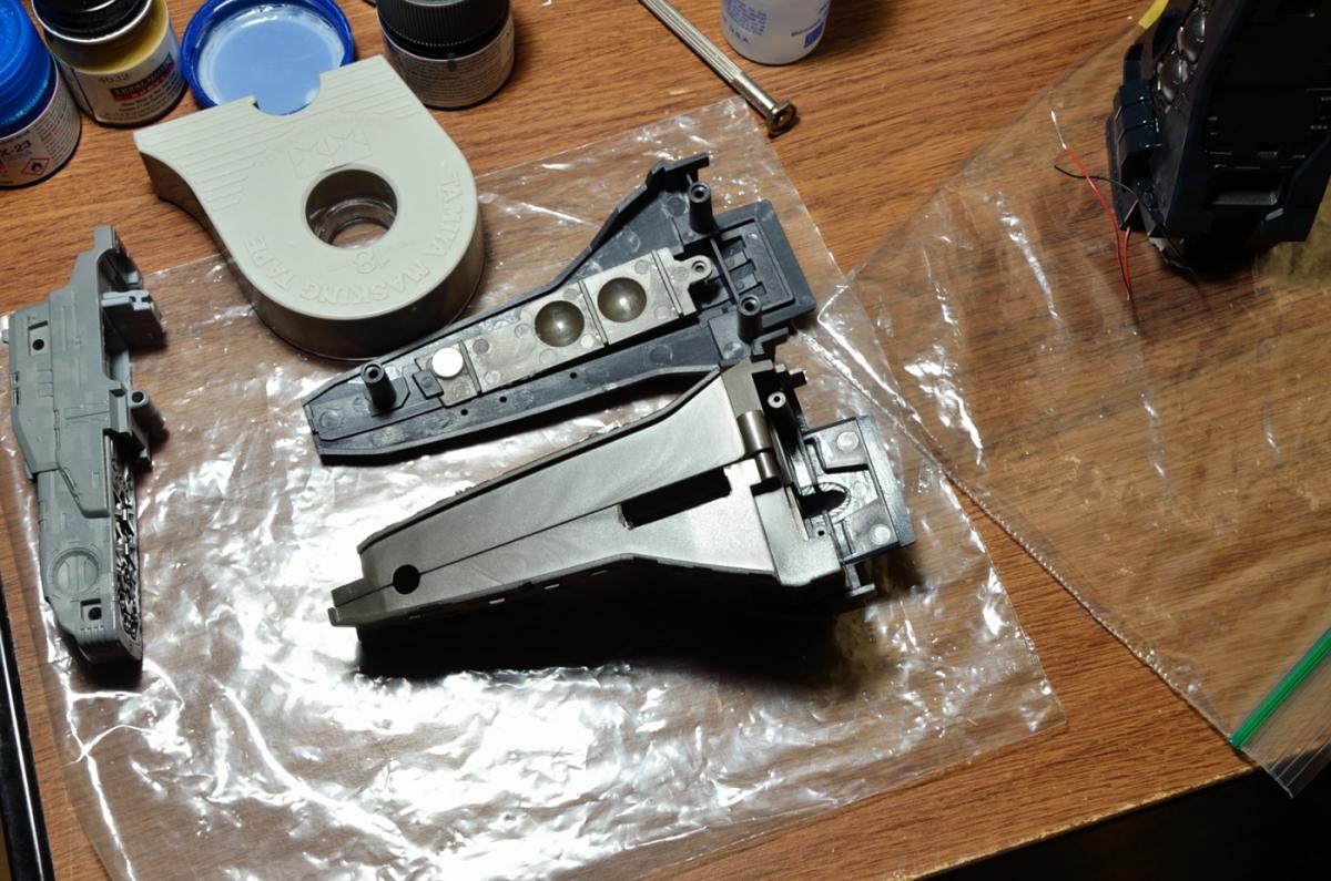

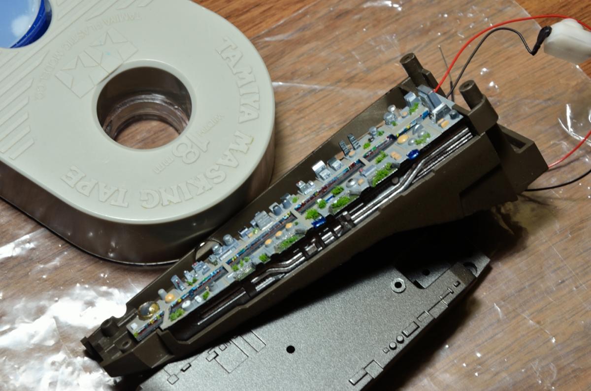

So here's the solution I went with.
I cut "coin slots" into the sides of the legs. The side with no city was easy as I could just grind down the slot I needed right from the edge.
The leg containing the city was more difficult. I had to cut the slot below the city. The inner wall was the more difficult part as I had to fit the grinding disc inside.
In retrospect, it probably would have been smarter if I had practiced on other things before I started going at it with the brand new Dremel I got which I've never had any experience with whatsoever (or any rotary tool for that matter). It was more difficult than I had anticipated, but I got the job done.
Slot cut lower than in other leg:
The battery is below the city so it's not visible:
I also added magnets so that I could just take the covers off without having to mess with screws and removing the caps.
They seem to hold pretty well. If I have a magnet with 2lbs of force pulling on another identical magnet, does that mean I have 4 lbs of pulling force or do magnets not work like that?

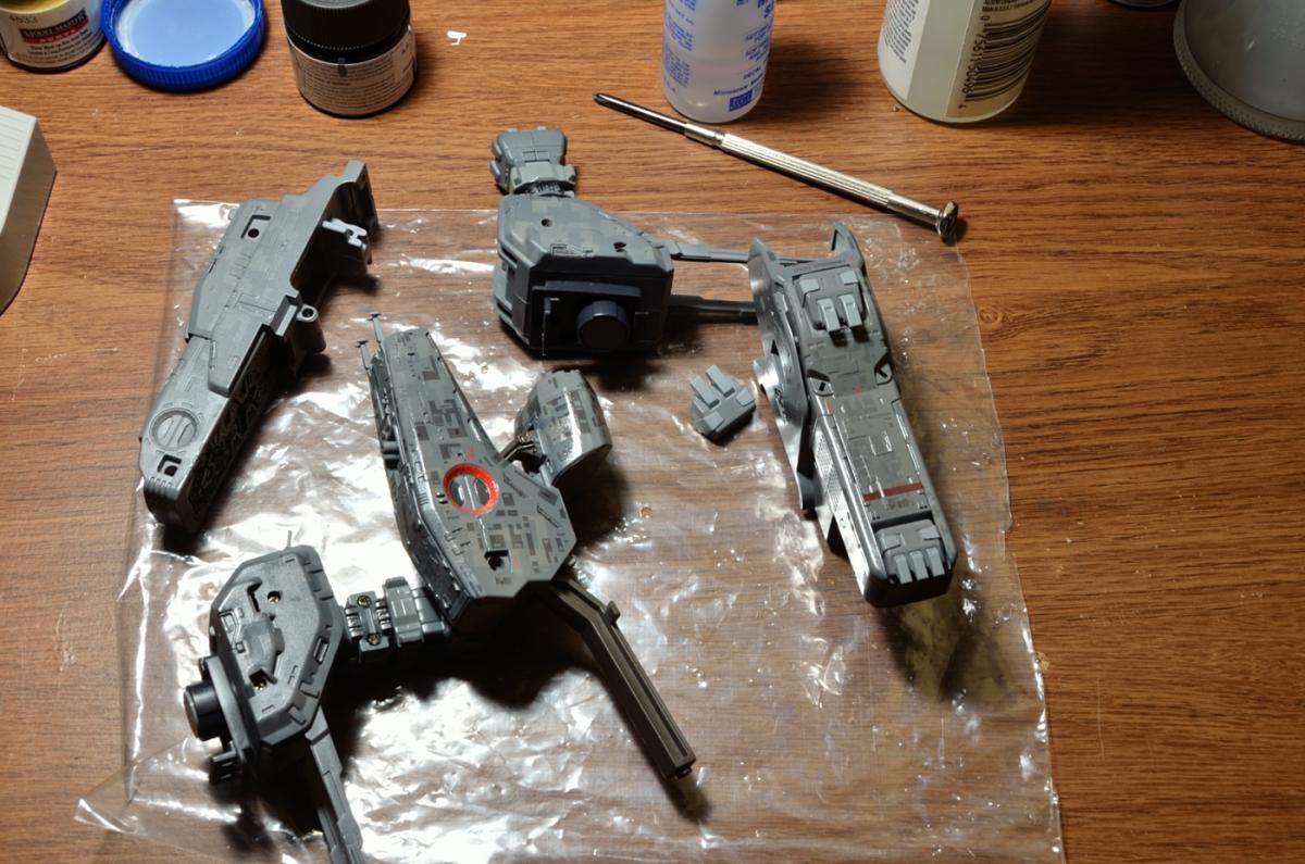

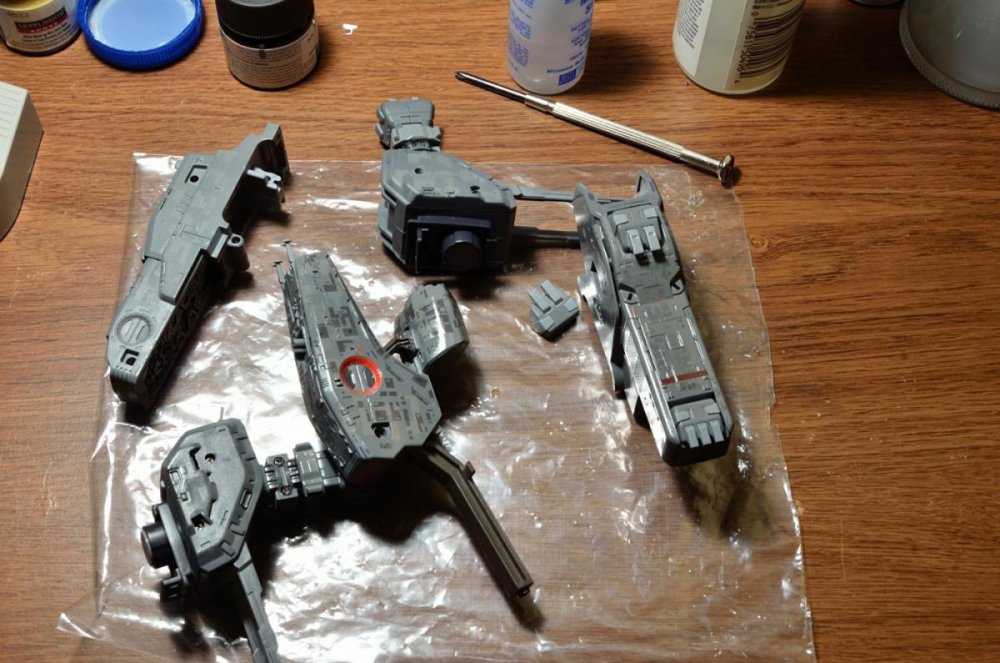

I also have started applying decals after putting together the major components.
The red rings are a huuuuuuuuuuge pain to apply, but I'm a total newbie when it comes to waterslide decals as well. I honestly didn't think I'd be able to do it. I also got and started using the decal sheet that WMCheng used on his. I think those decals look great and was a stroke of genius. I made a filter, or whatever the terminology is for a coating to change the overall color tone, using the same dark sea gray diluted with Future to make it more transparent. Sprayed it over the section that holds to bridge to test if it I could coat the surface without overdoing it and completely hiding the decals. It seemed to work so I'll probably be using that on the rest of the SDF-1 as well.
