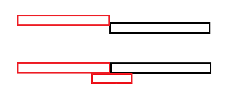

From there remasking (hell) begun for the gold accents. I choose to stick with Mr. Color 9, so that the gold would match the gold used on the decal lettering. I don't generally like this gold compared to Gianotes or Starbrite, I have to admit it does look sharp on this planes livery!.
Sometimes it is best to cut the tape to the thickness of the stripe you want and then mask around it to get uniform/even spacing. You'll waste a bit of tape but, much better knowing everything it 100% the correct thickness!
