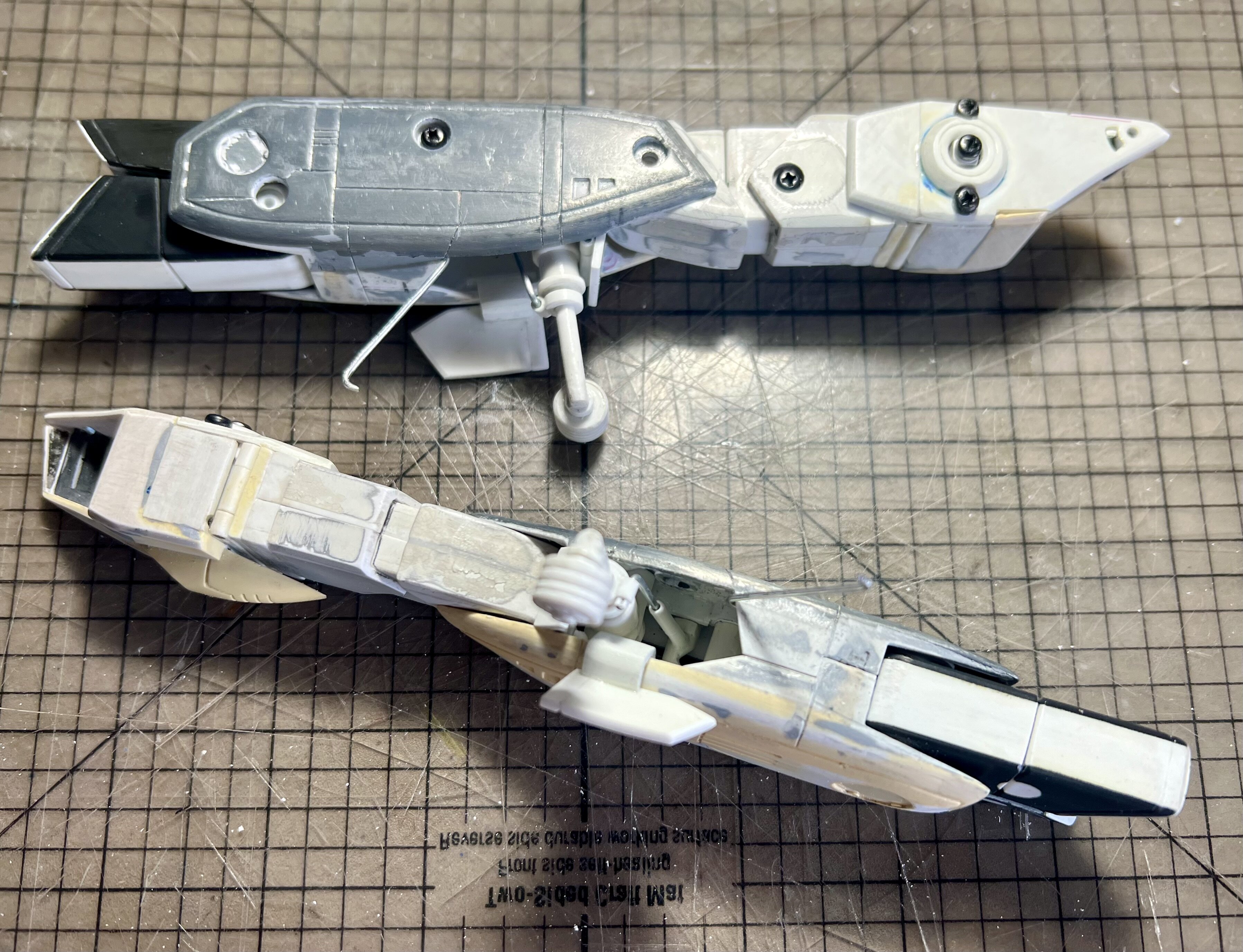

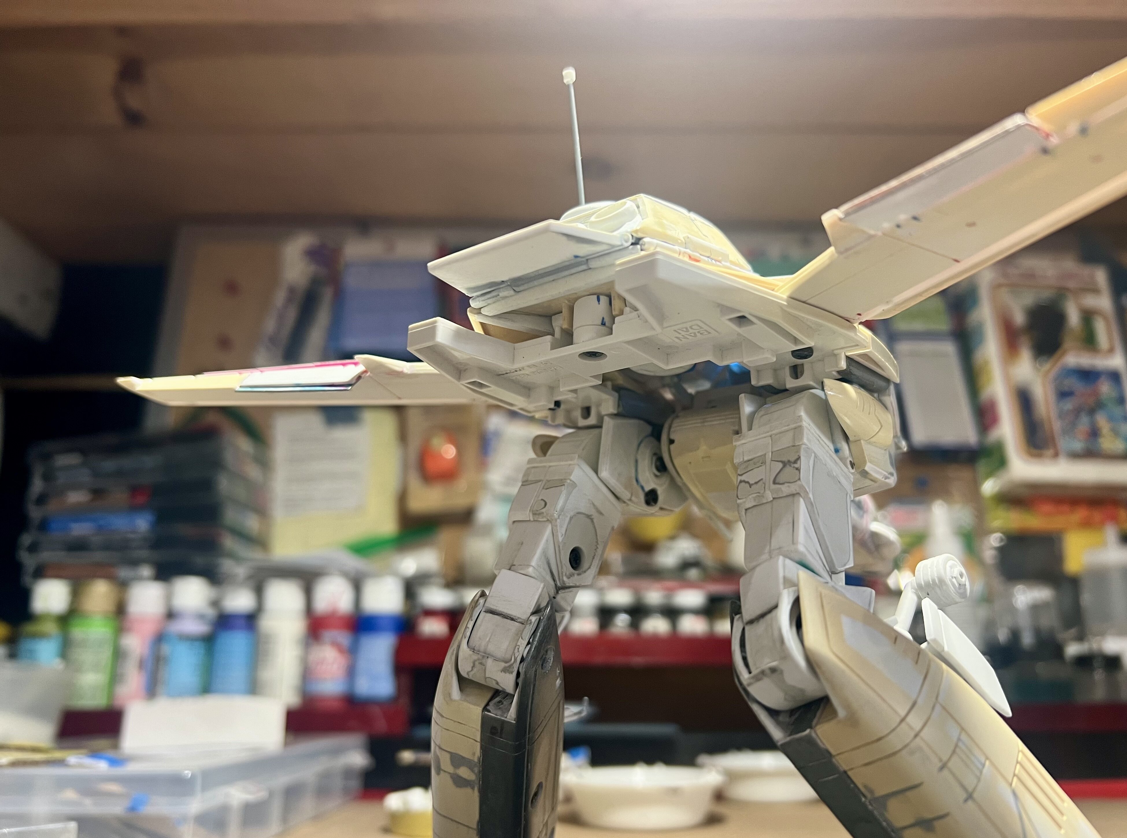

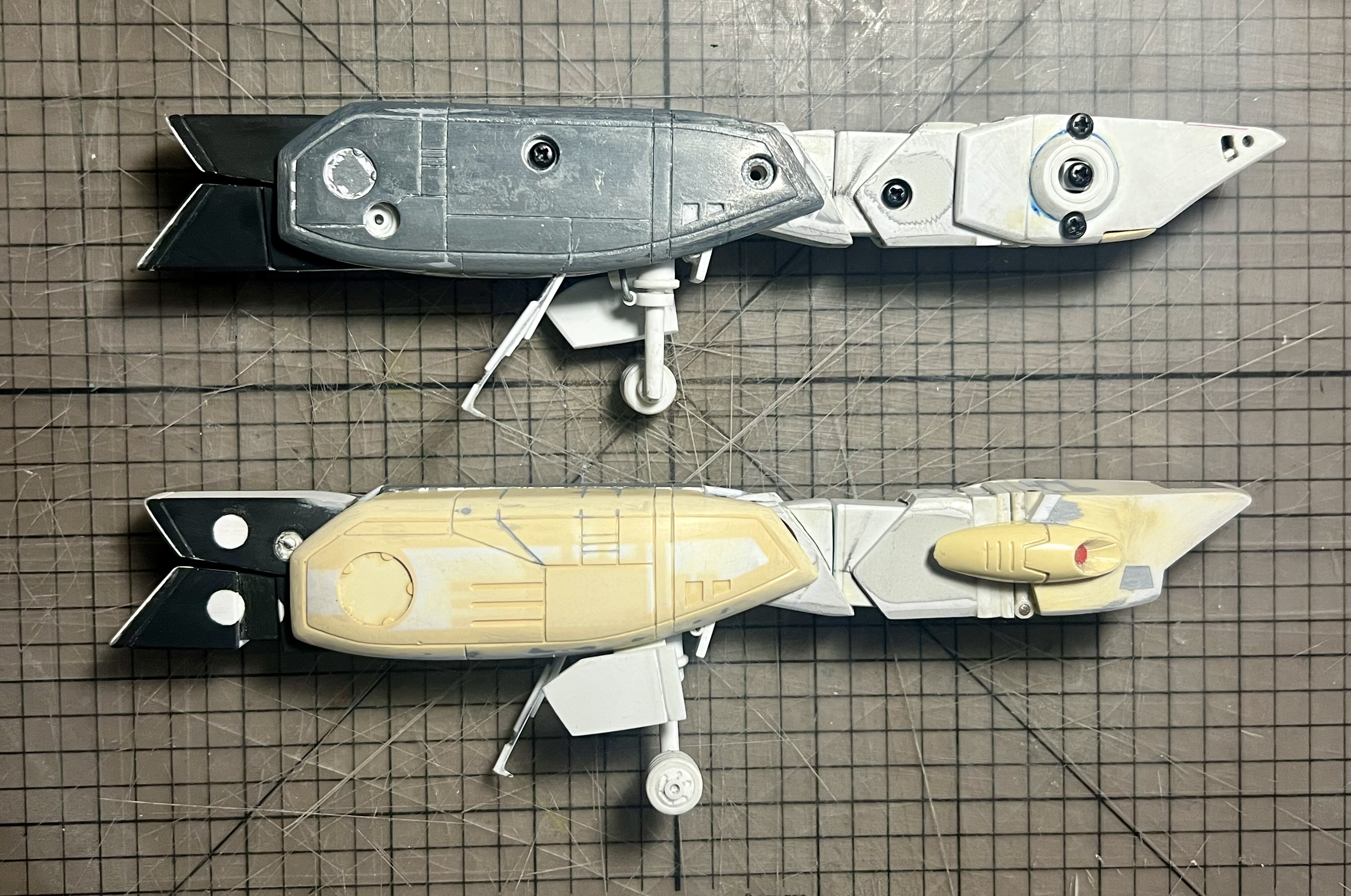

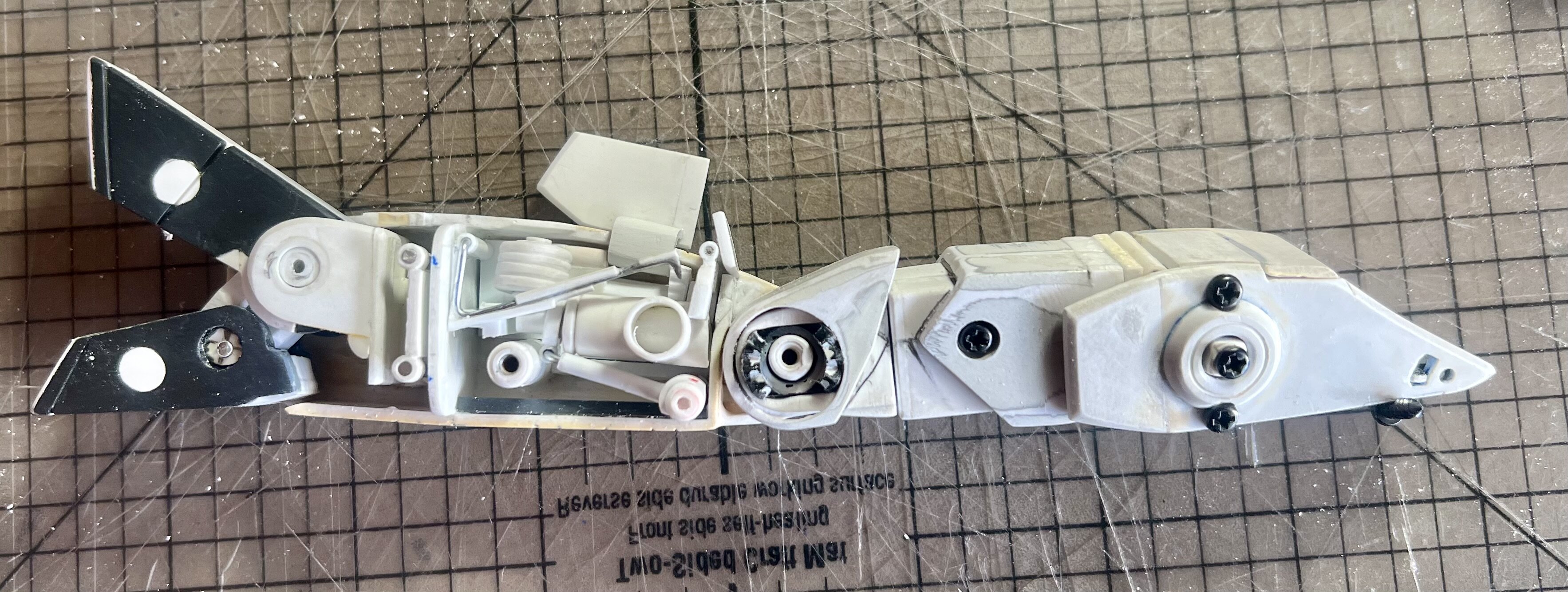

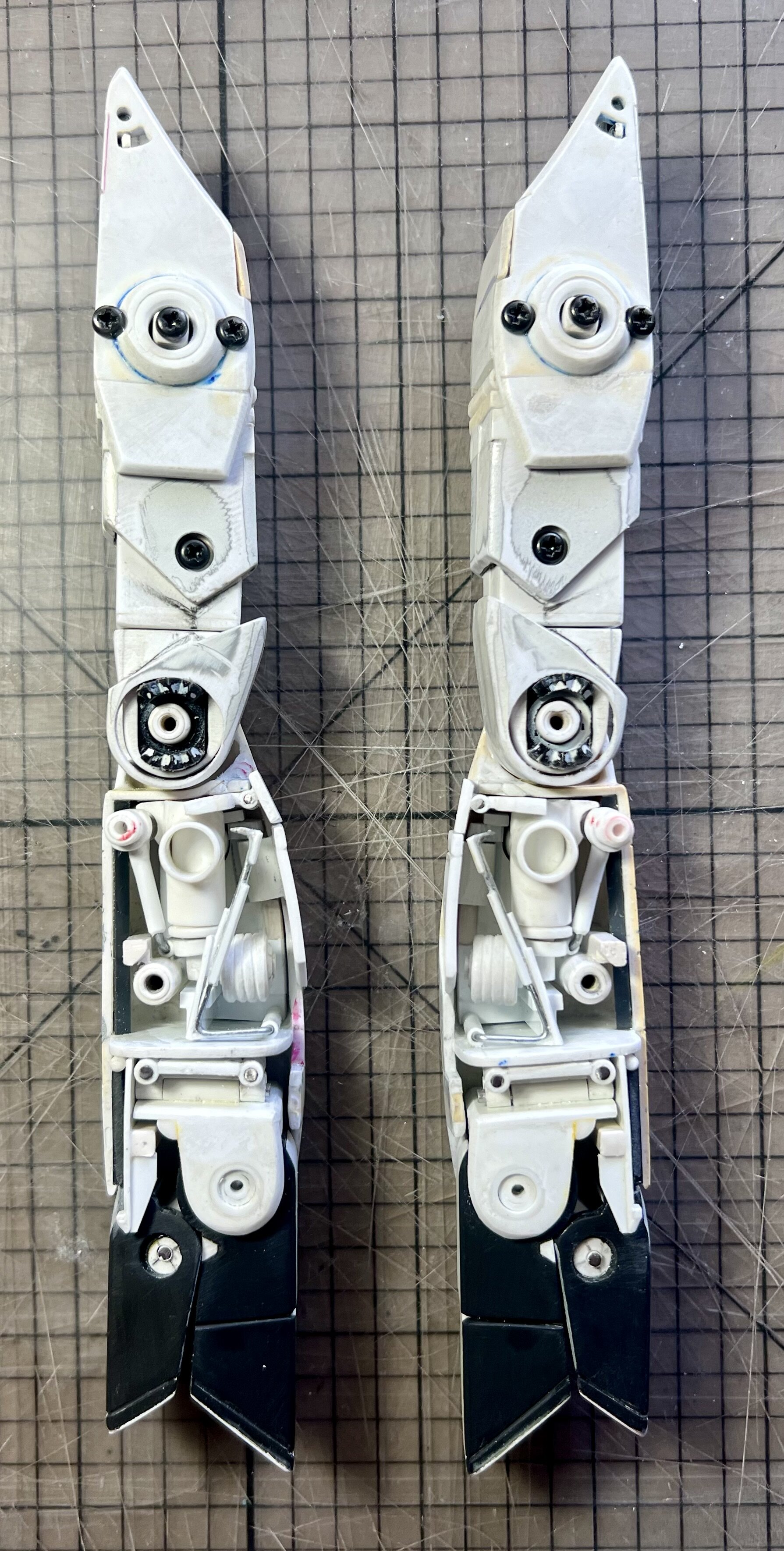

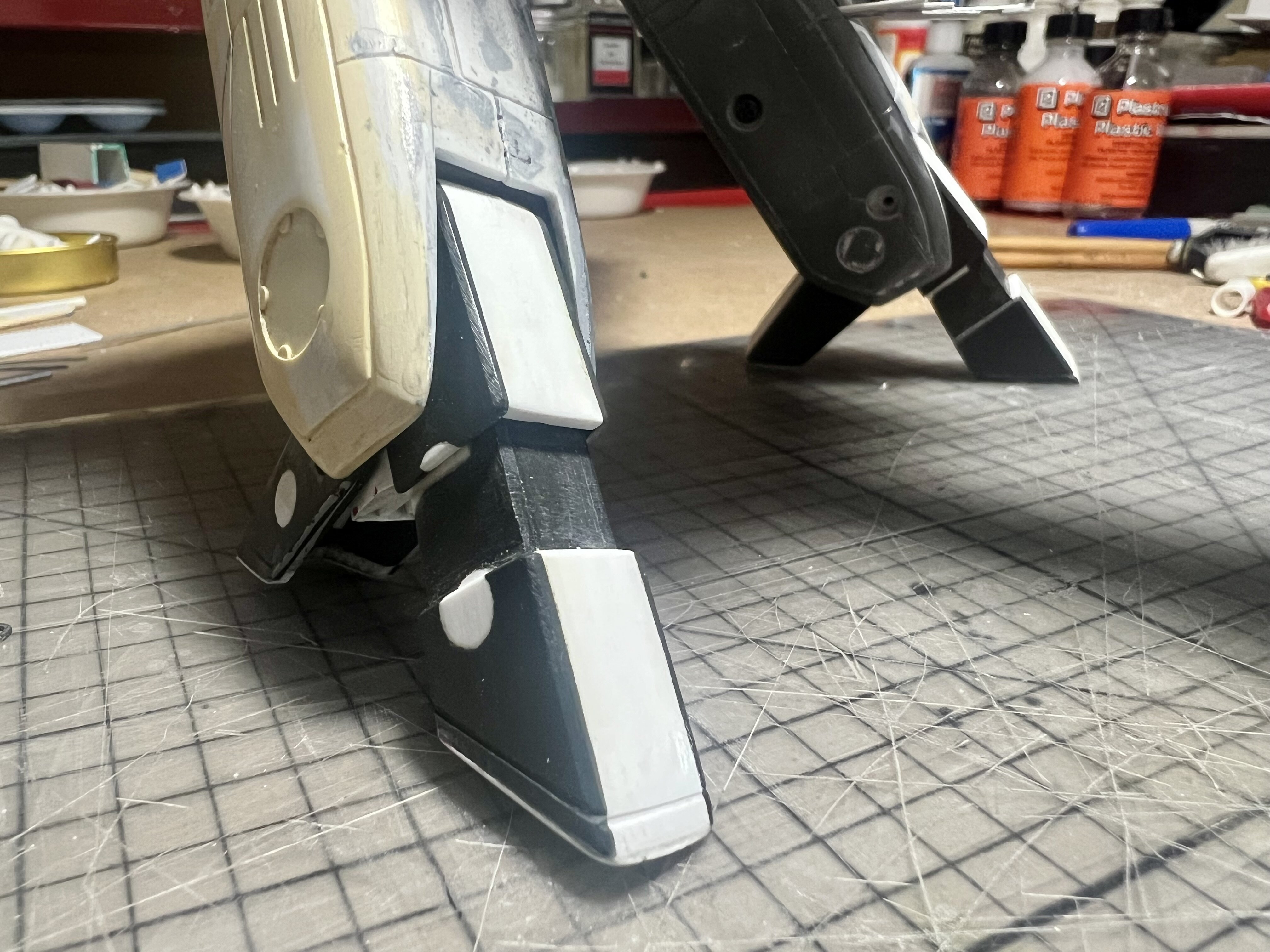

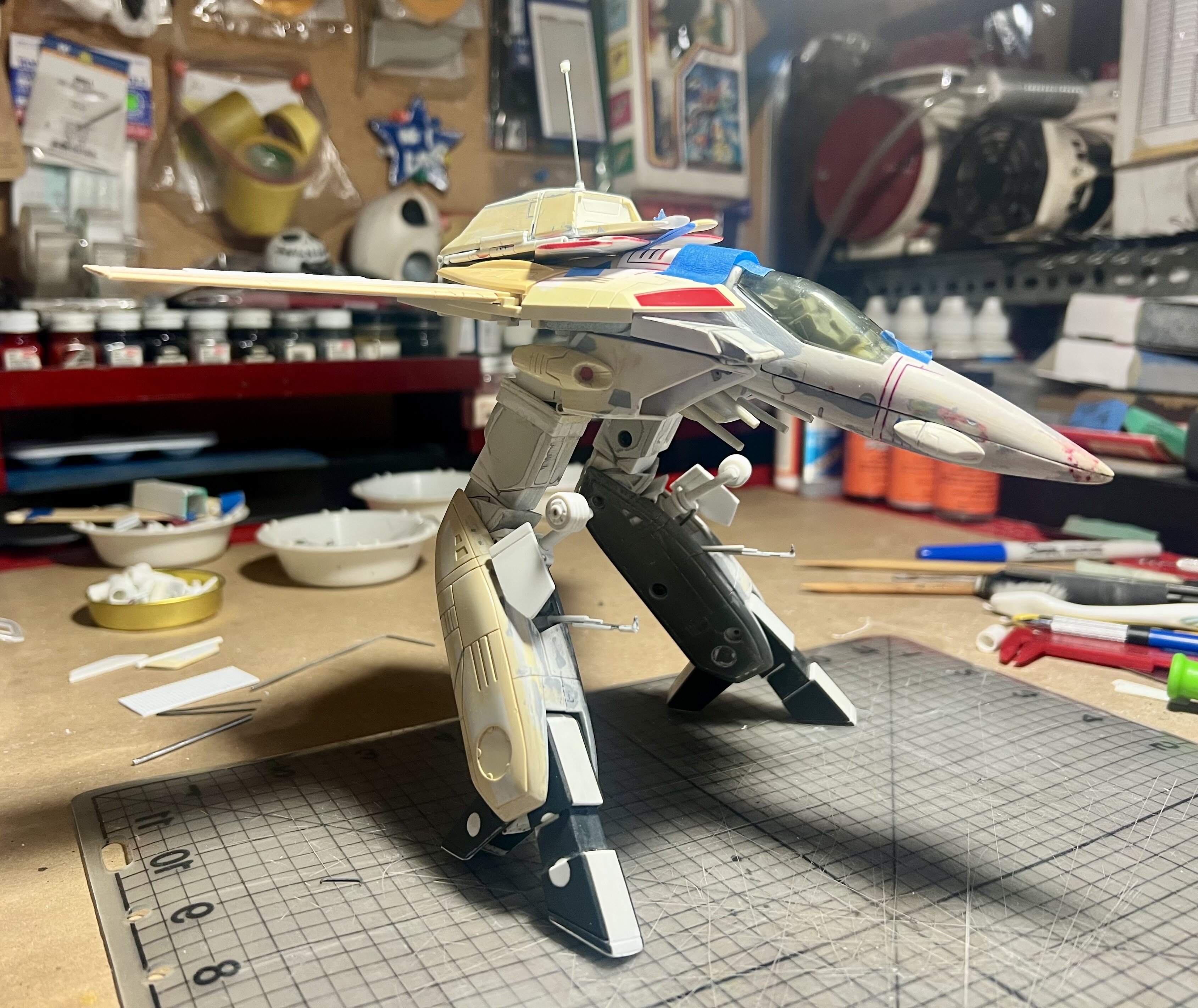

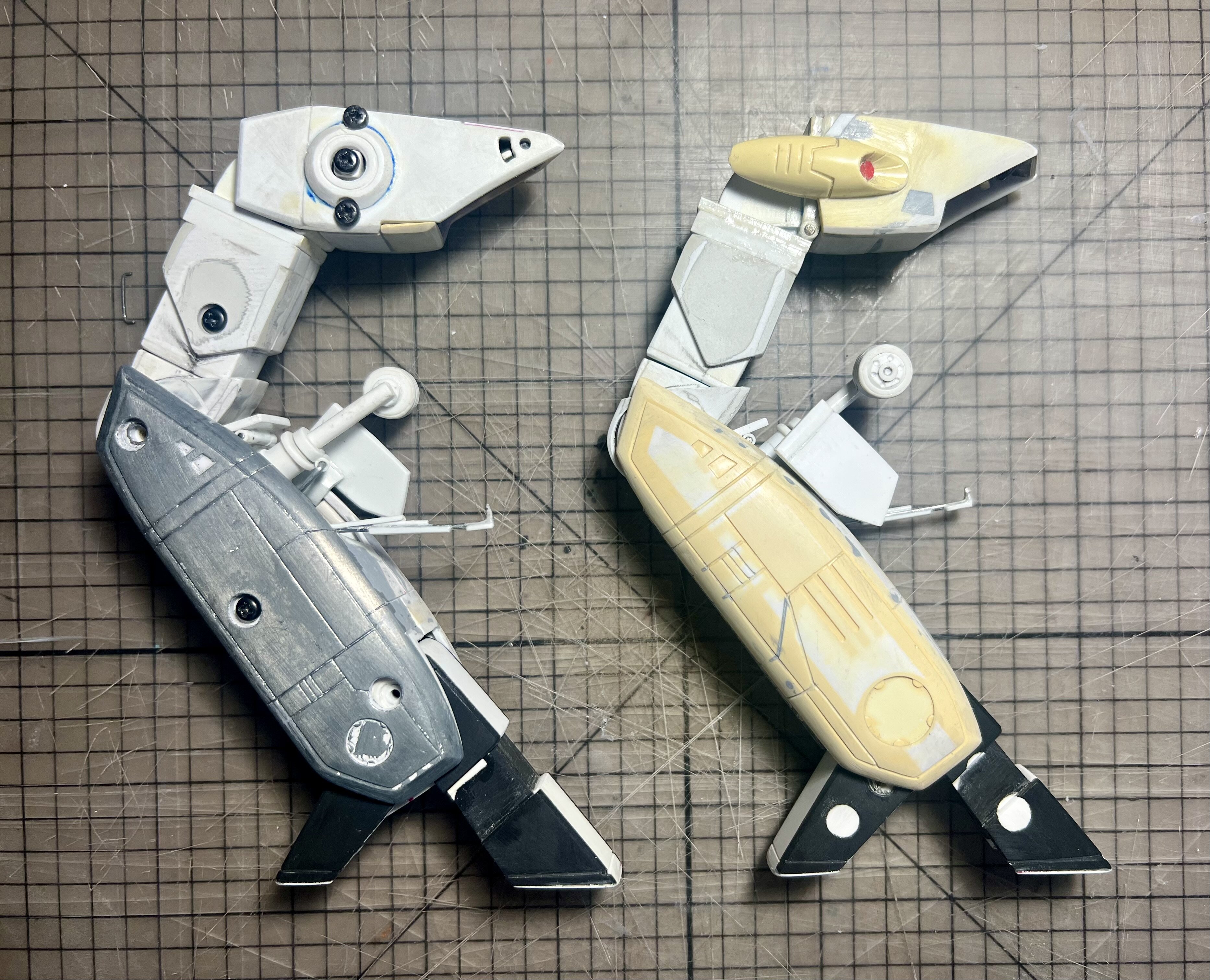

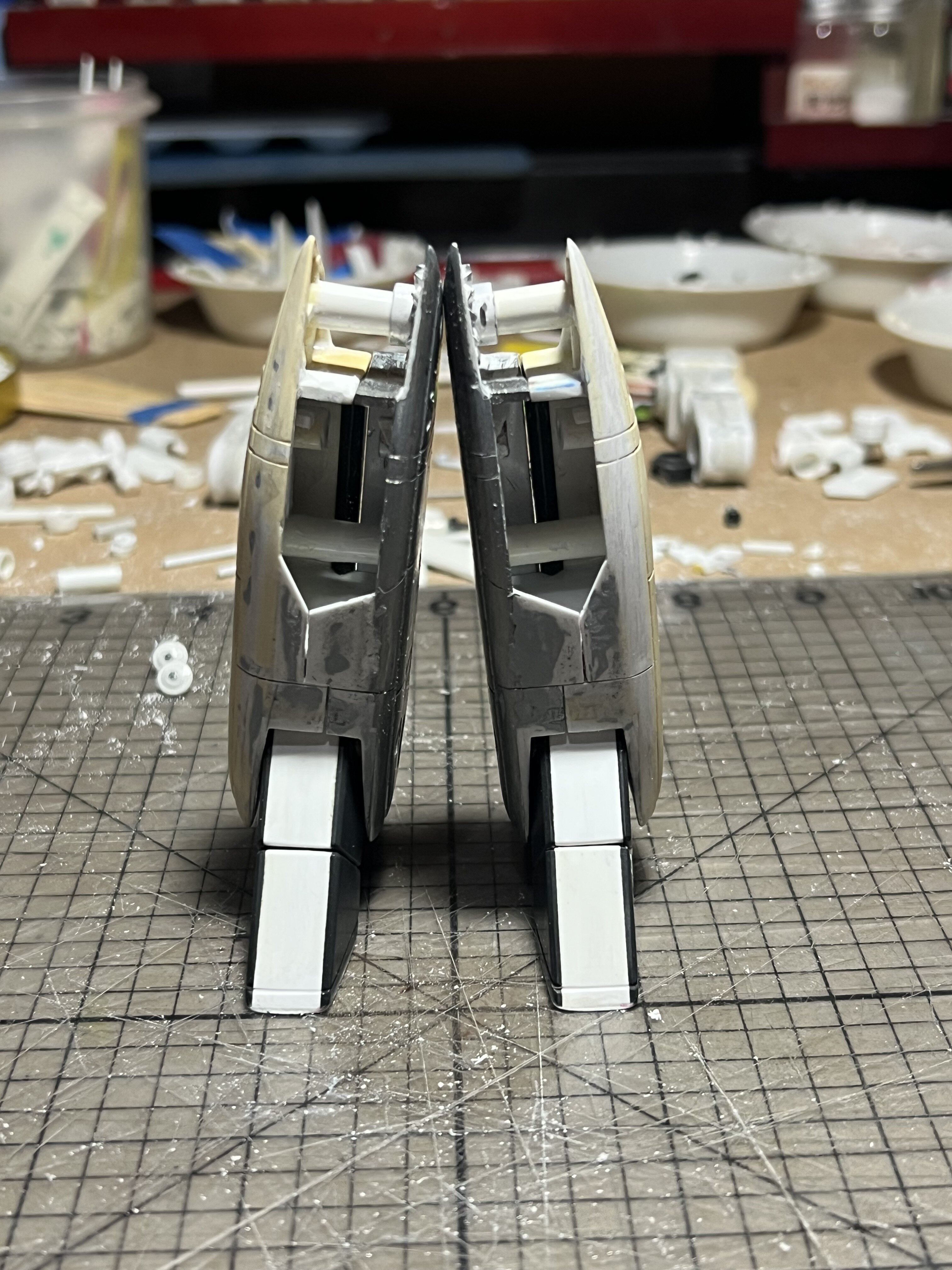

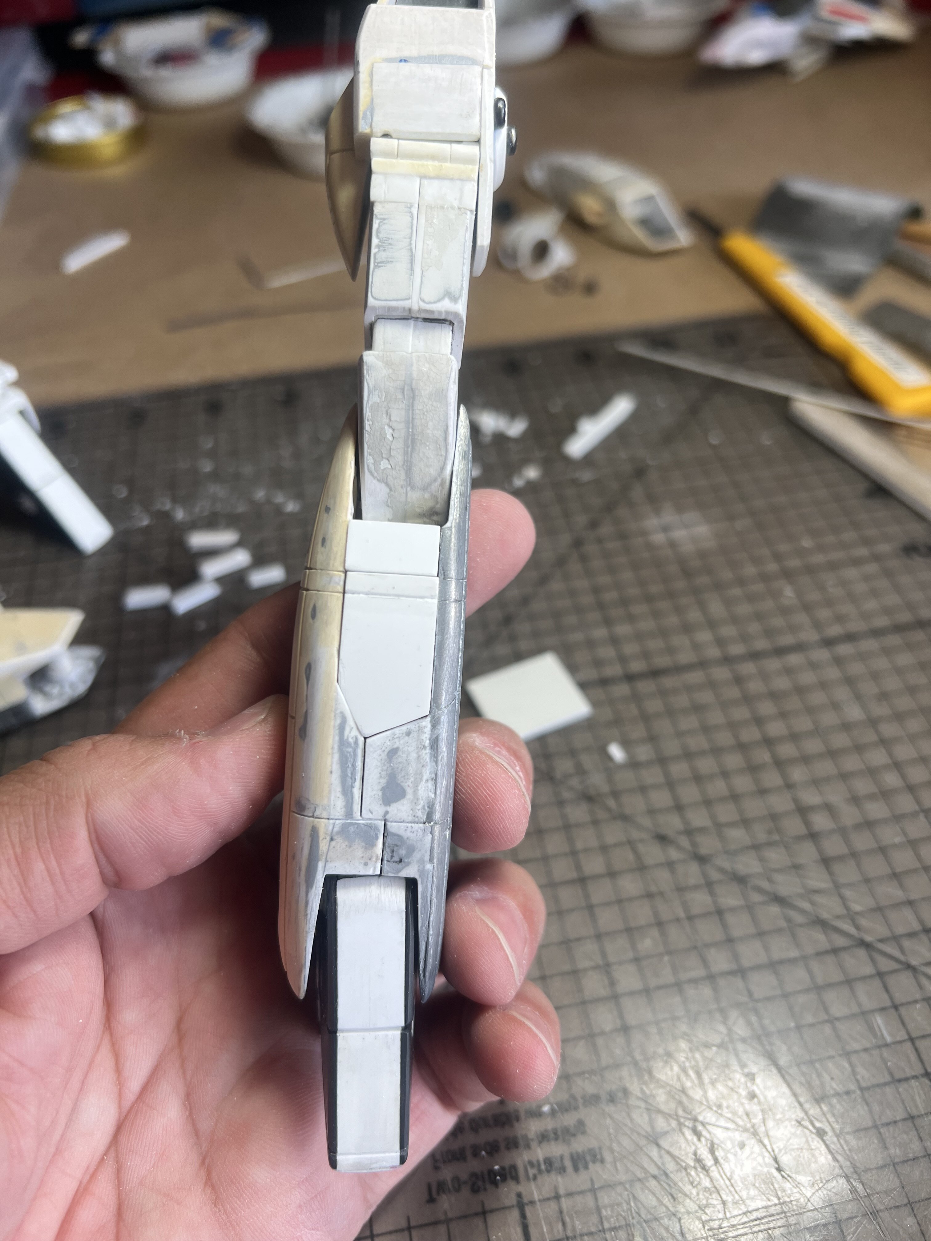

nightmareB4macross Posted January 18, 2025 Posted January 18, 2025 Mechanics that work. the leg is balancing on it’s own with no screws holding the halves together. Quote

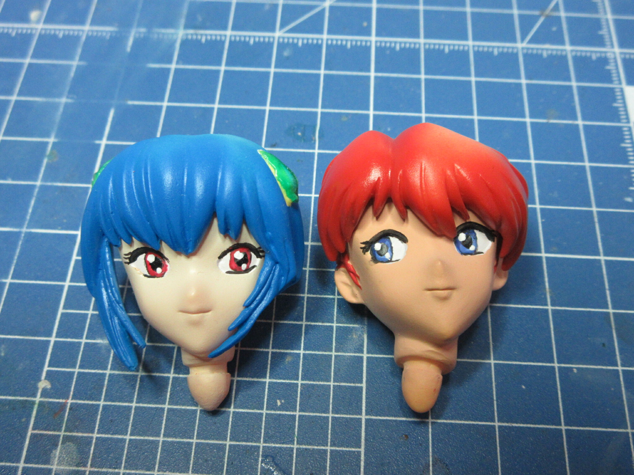

SteveTheFish Posted January 20, 2025 Posted January 20, 2025 More progress on my Eva girl sofubi set. Unfortunately, I cannot do justice to the original character designs by Sadamoto with a paintbrush, but I guess this effort is acceptable. No eyebrows yet and the hair color you see is merely preshading. But I suppose the eyes for Rei and Asuka are done, with the finishing touch being the light pools in their eyes. Quote

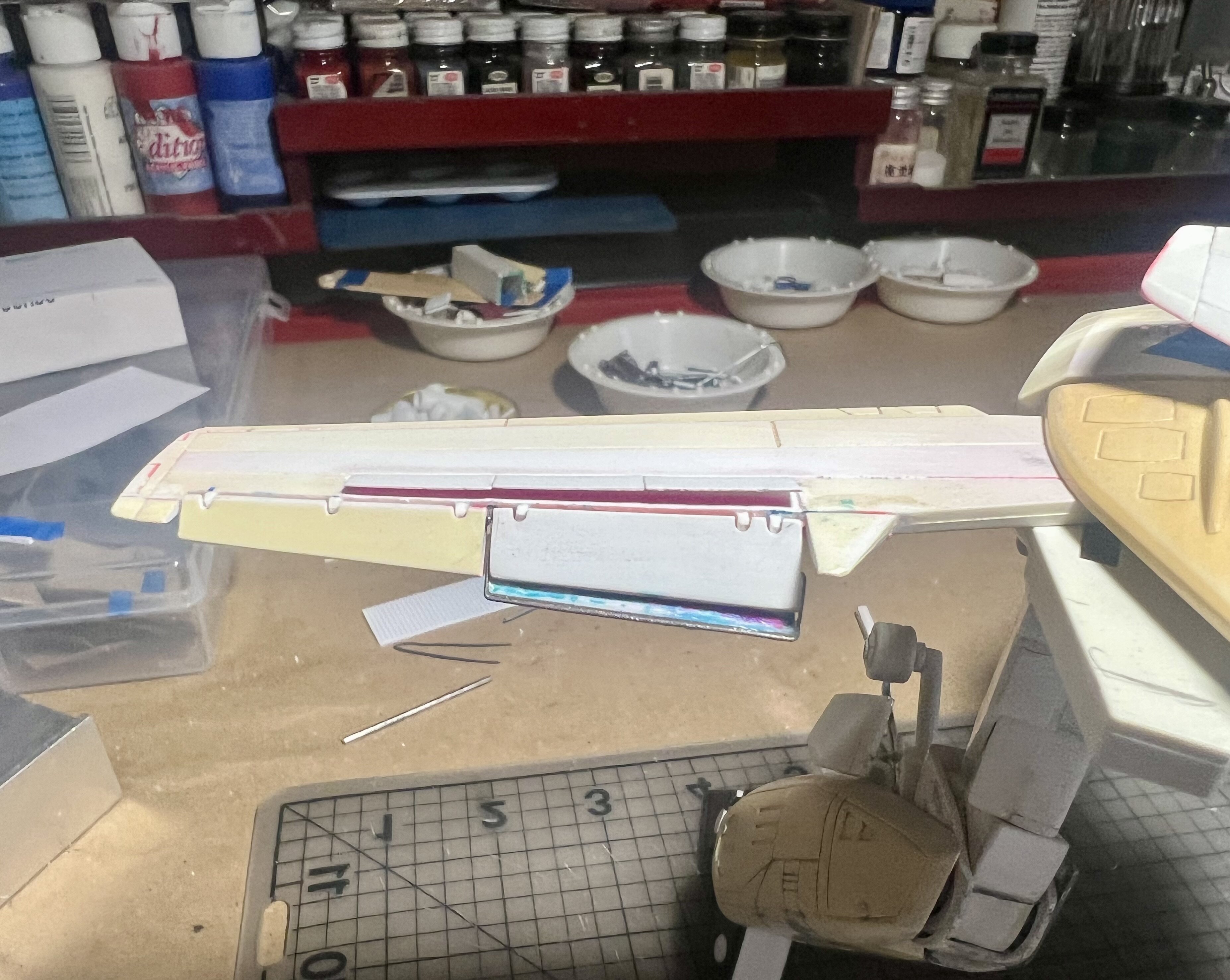

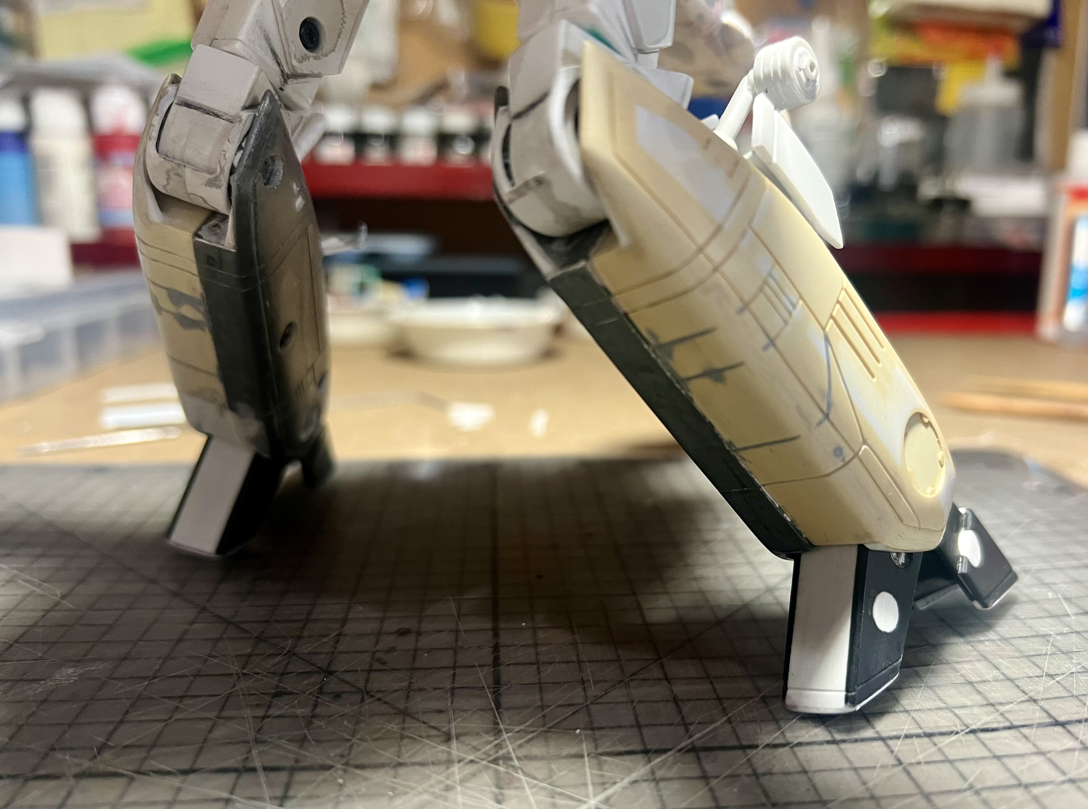

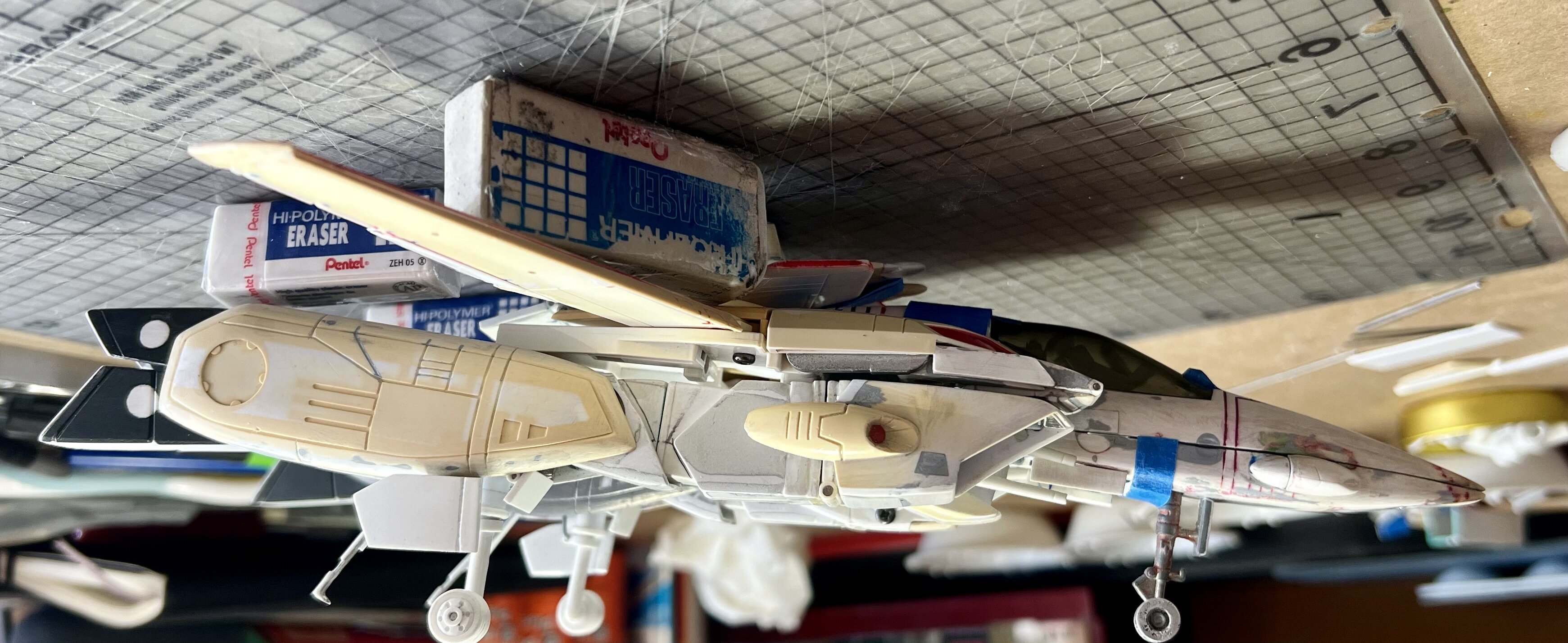

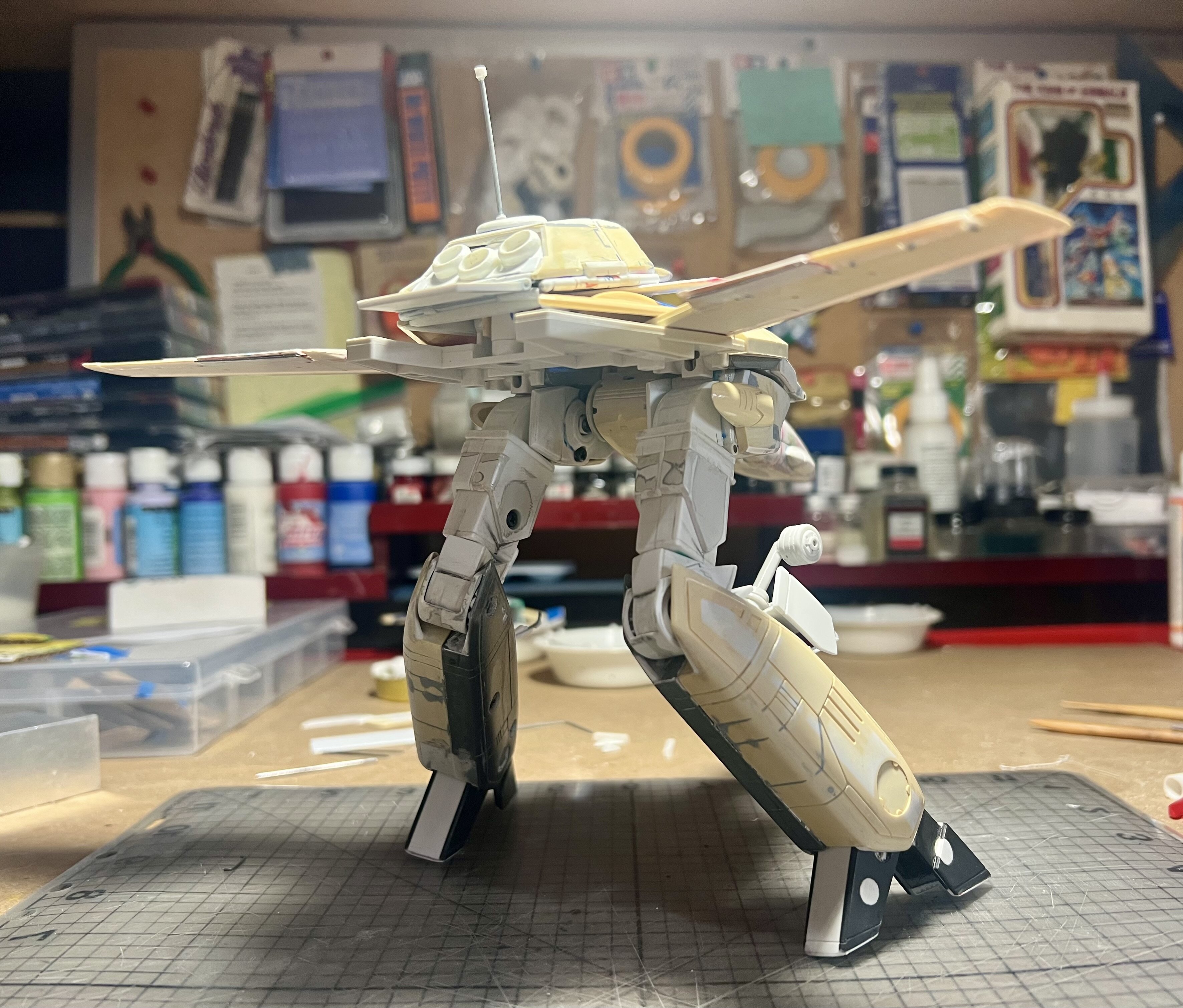

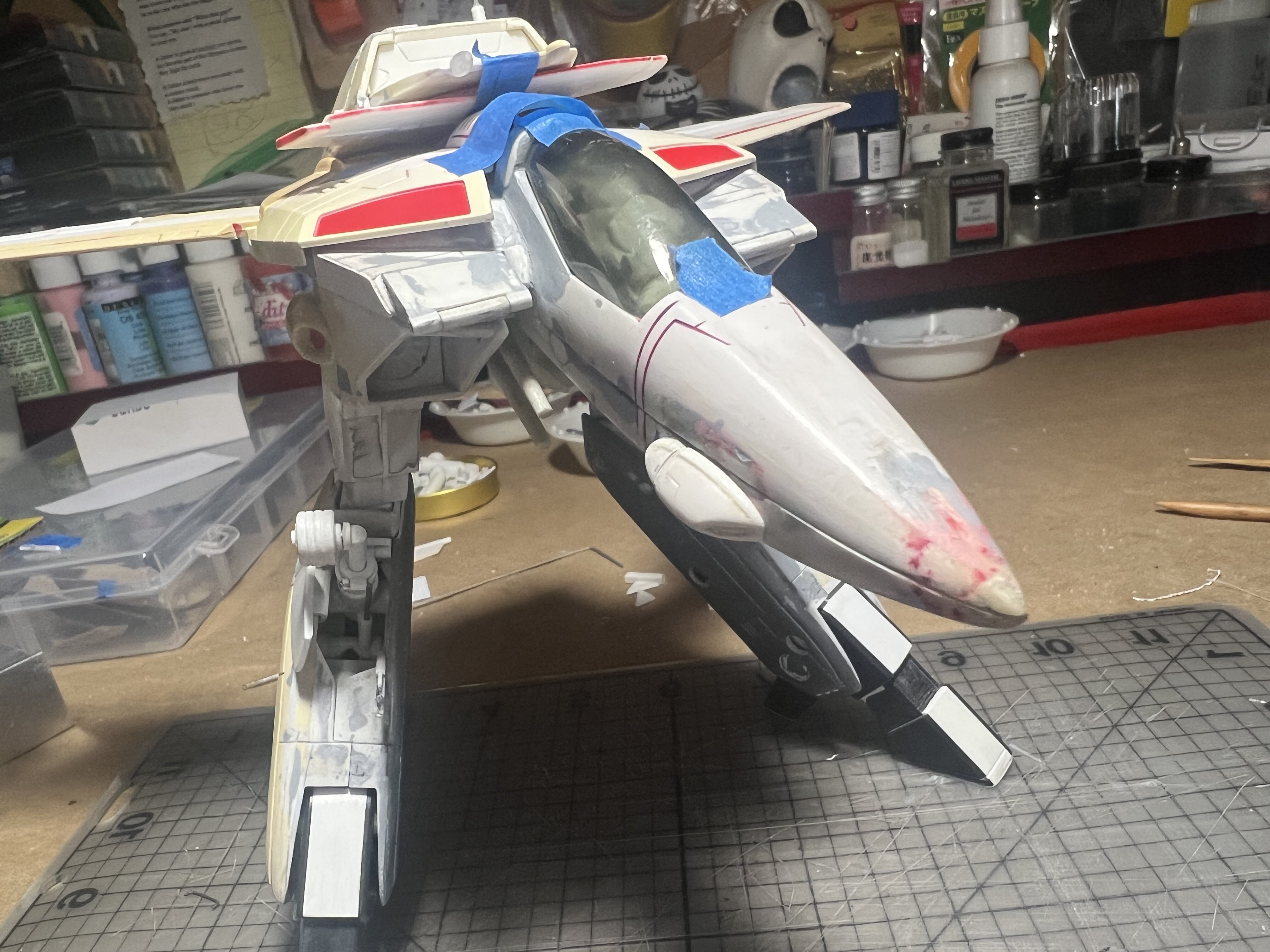

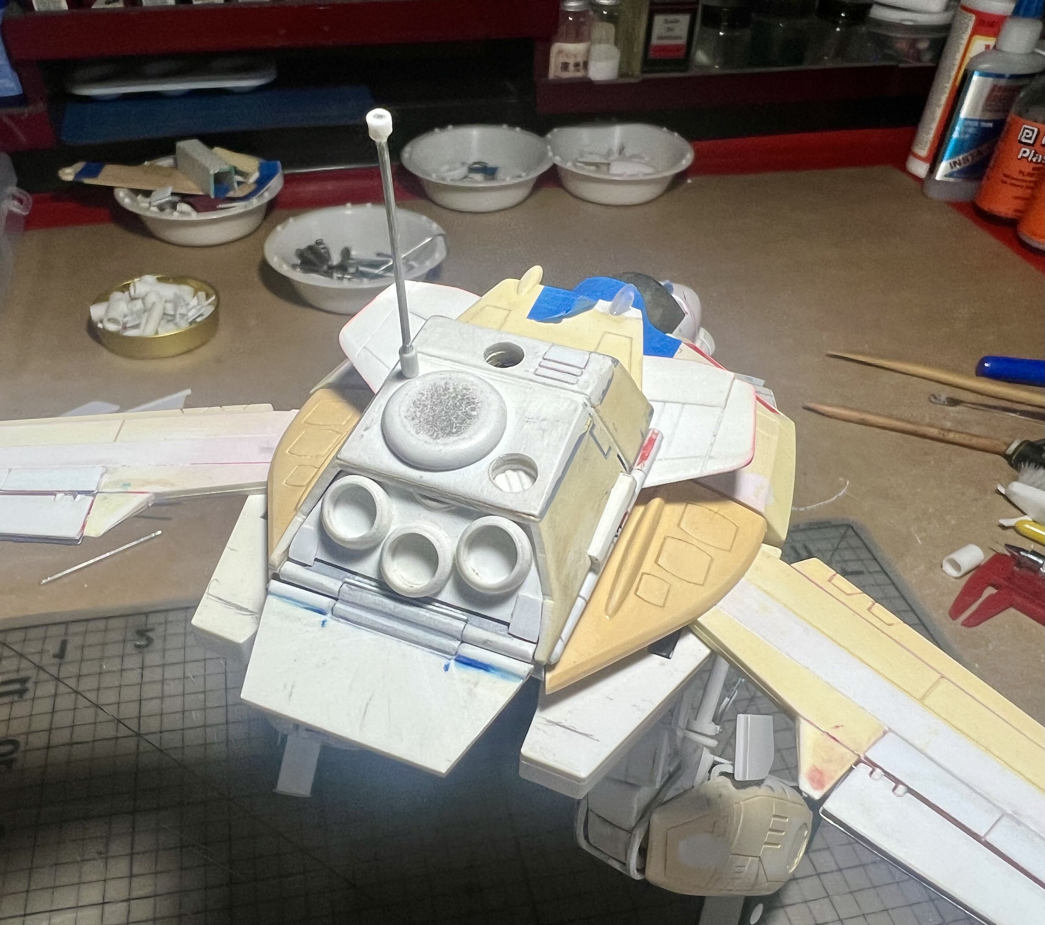

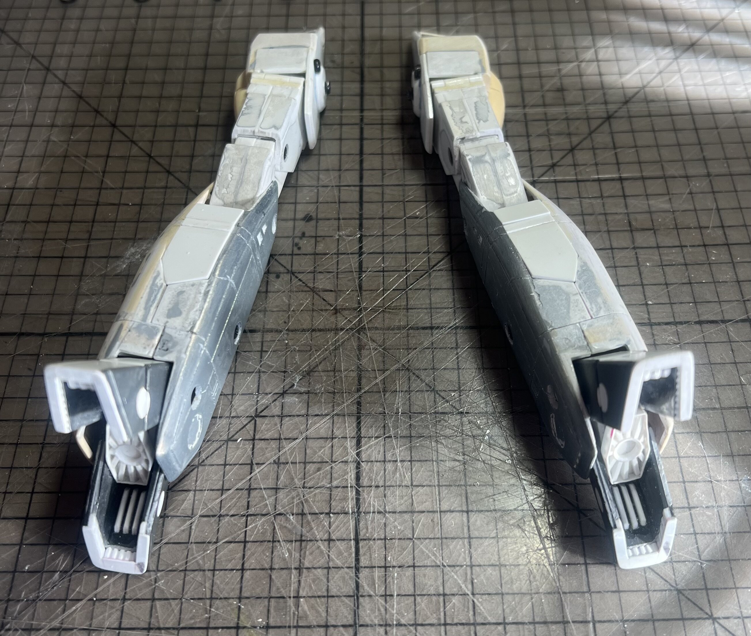

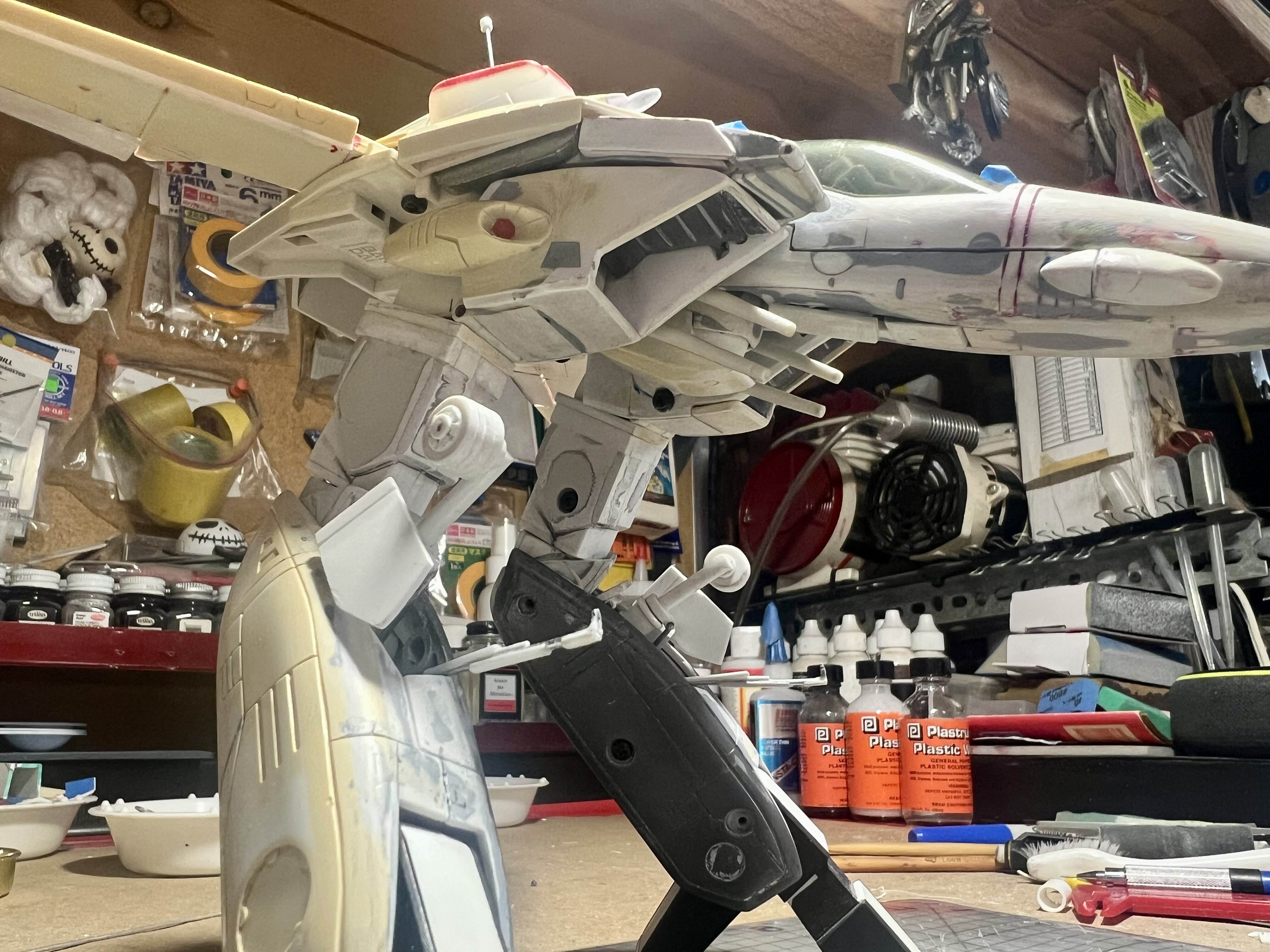

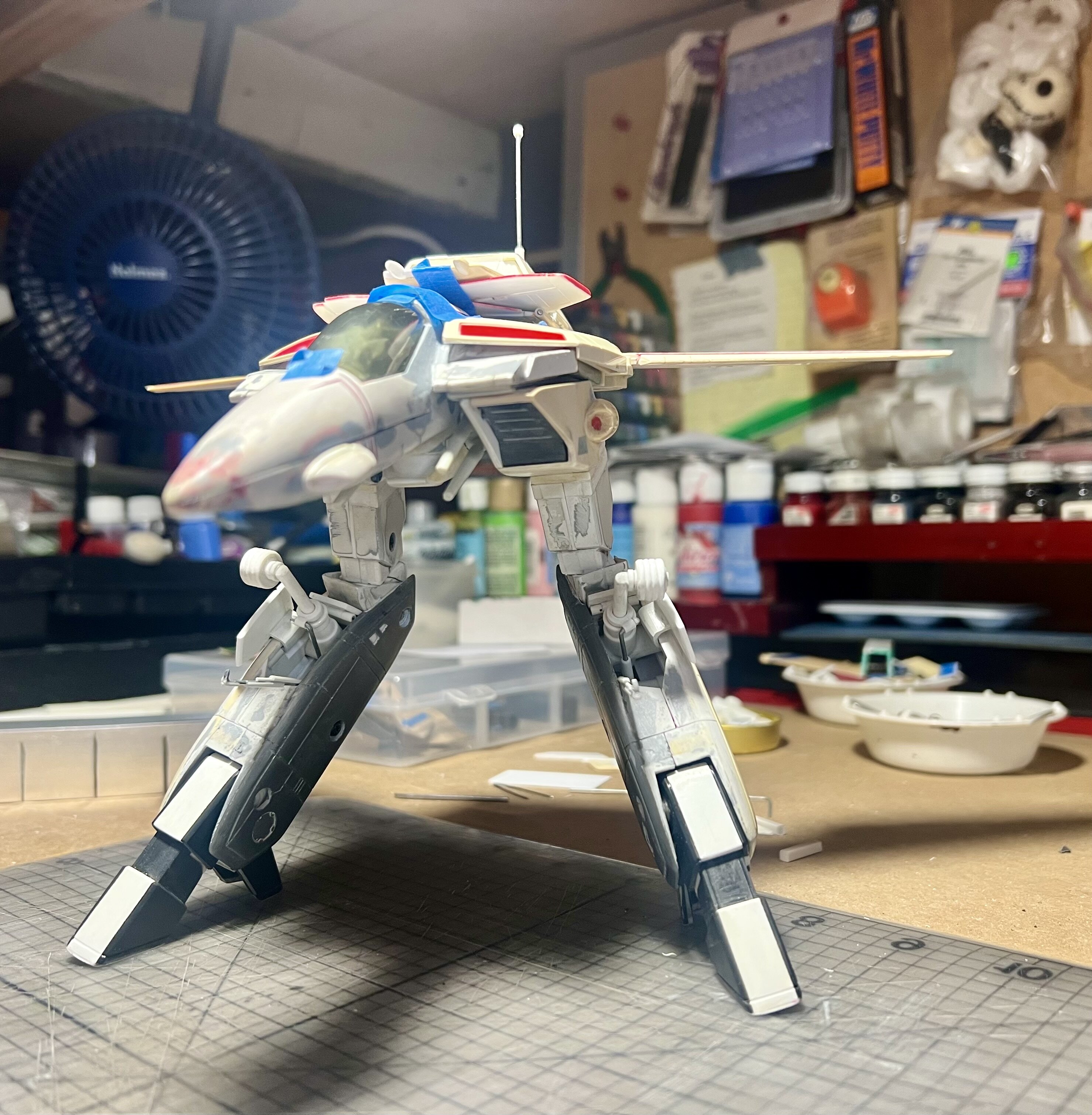

nightmareB4macross Posted January 21, 2025 Posted January 21, 2025 There are only a couple more parts to add and then complete the final details. Quote

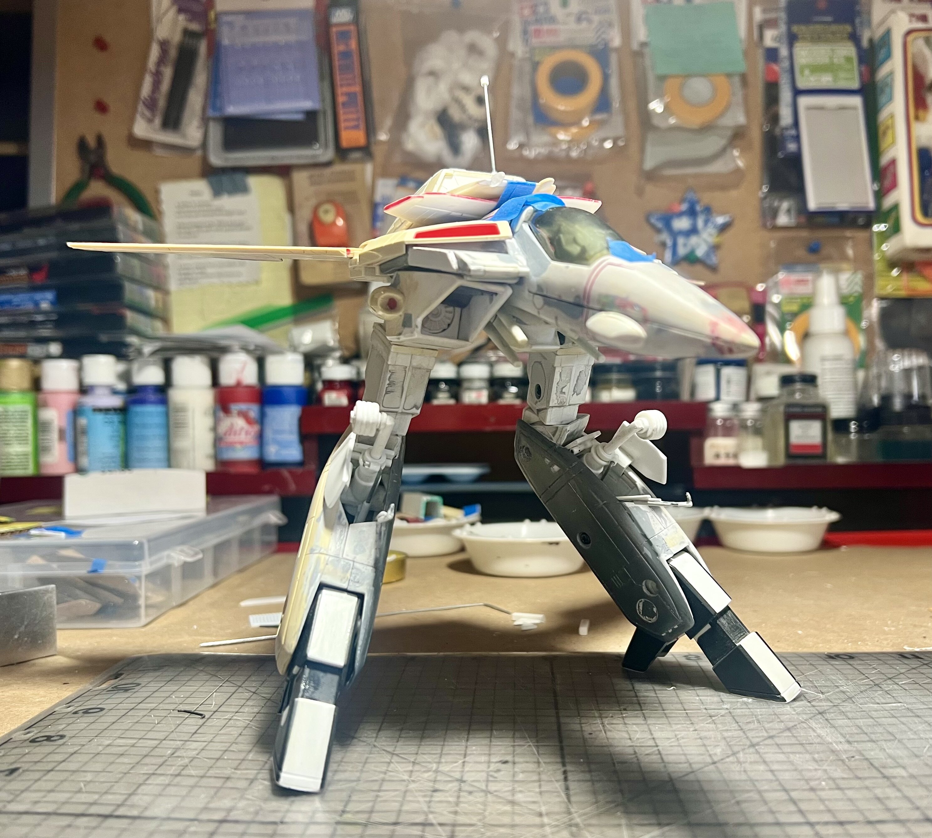

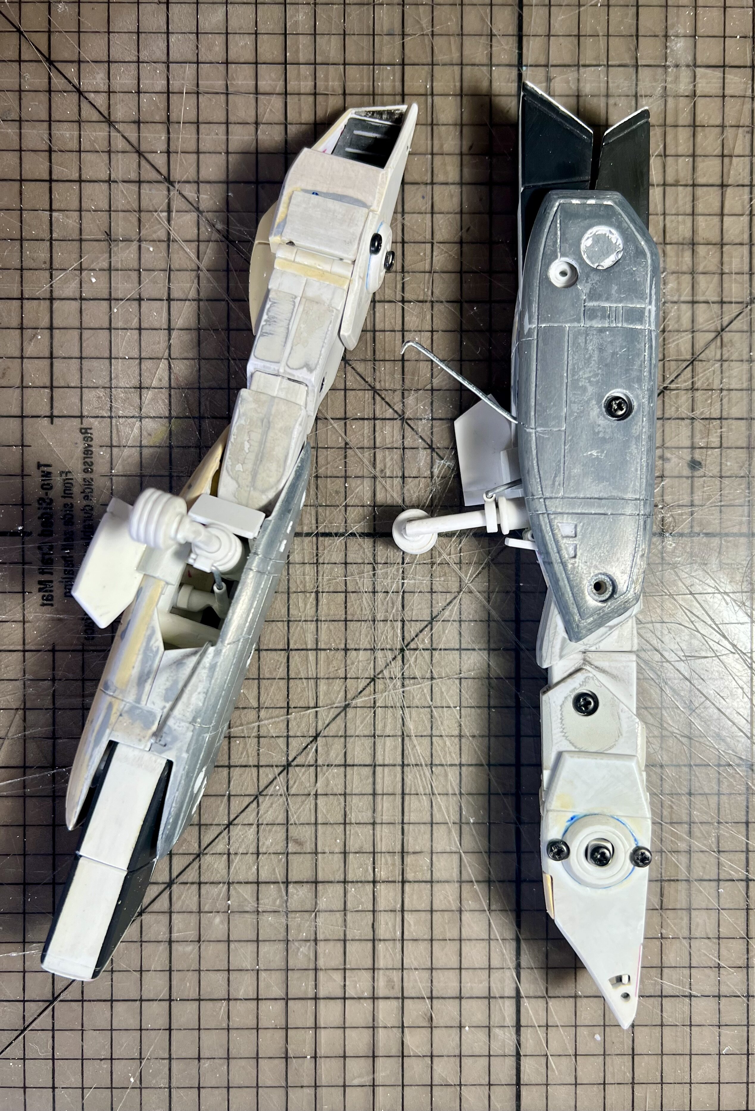

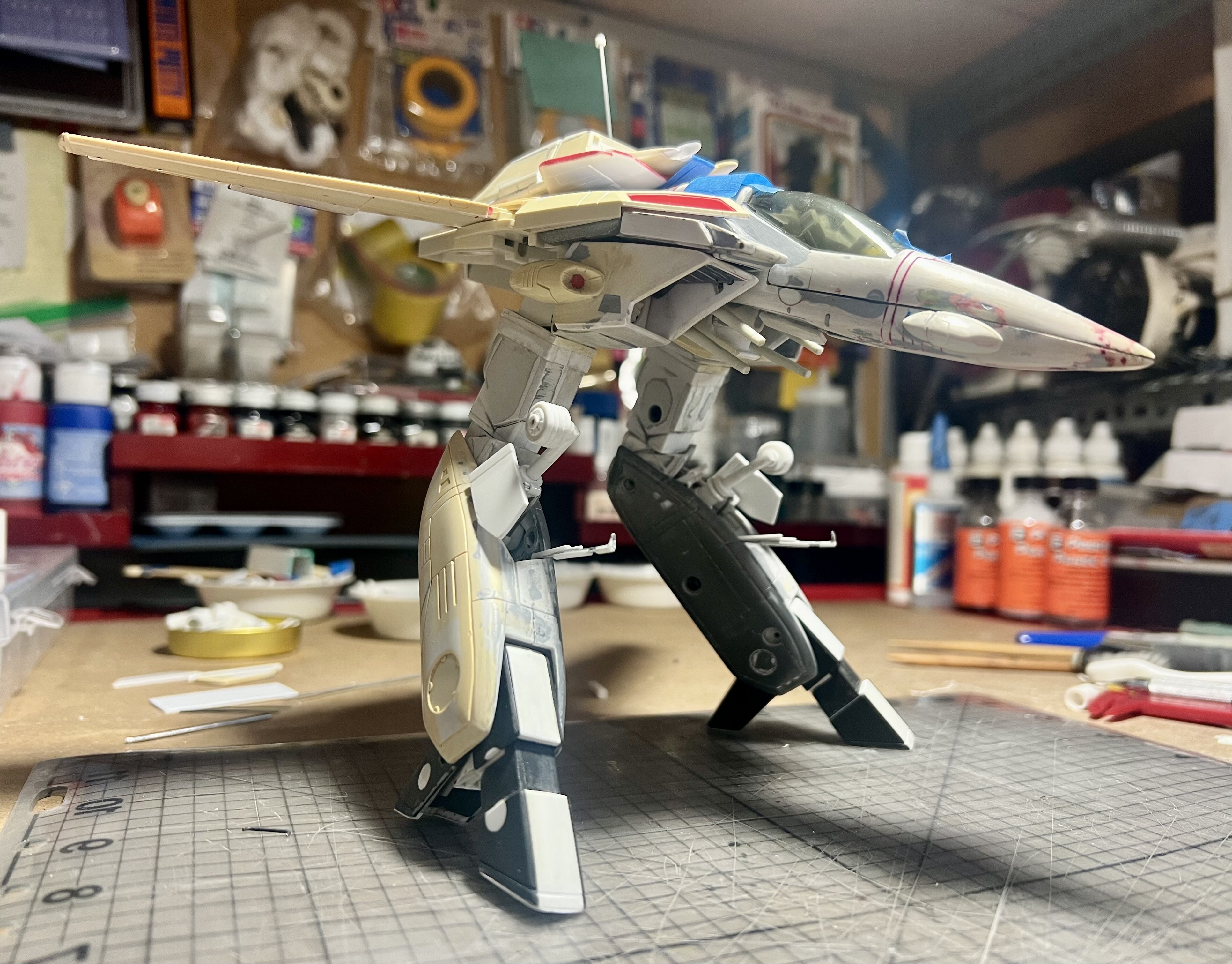

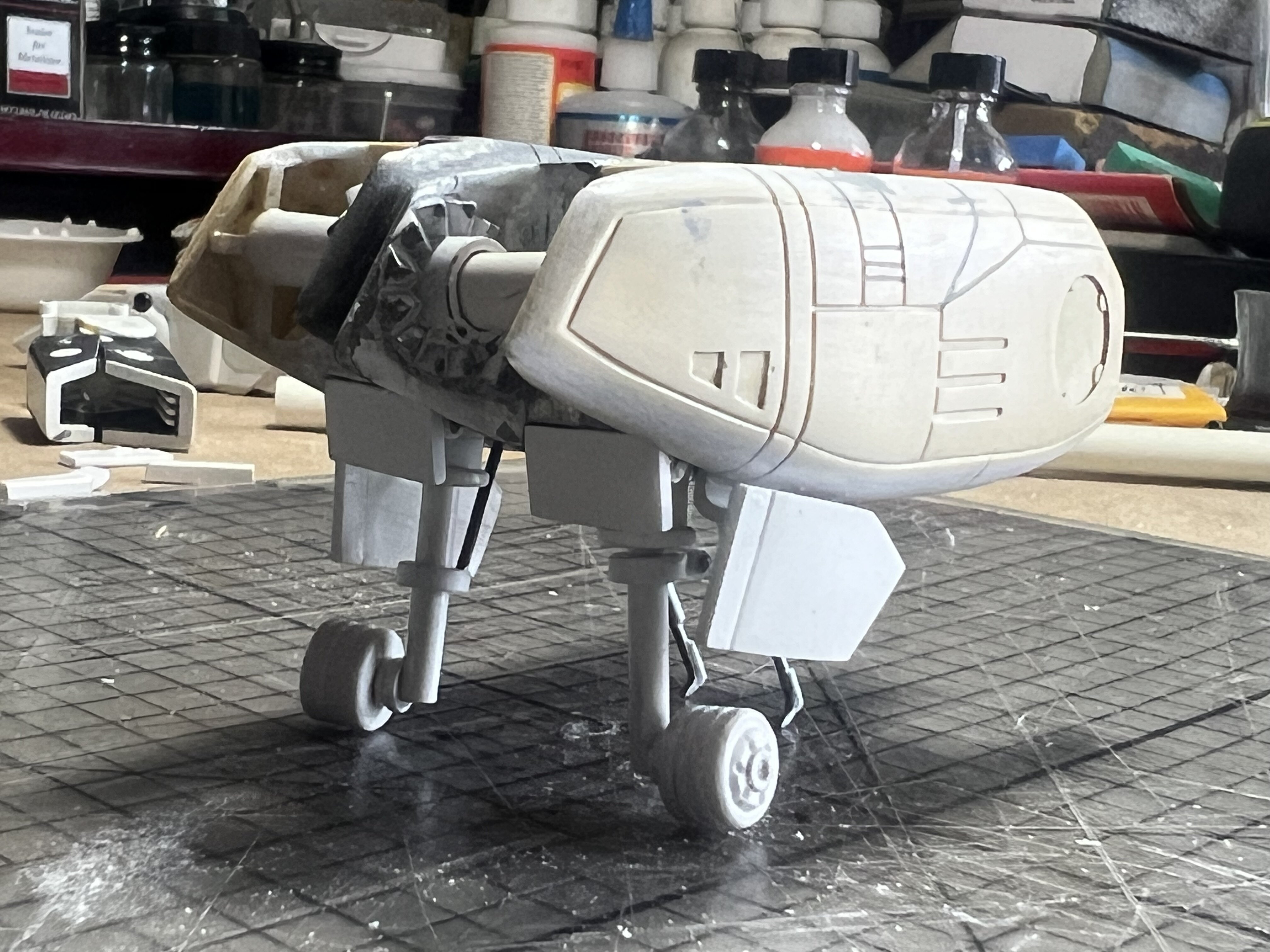

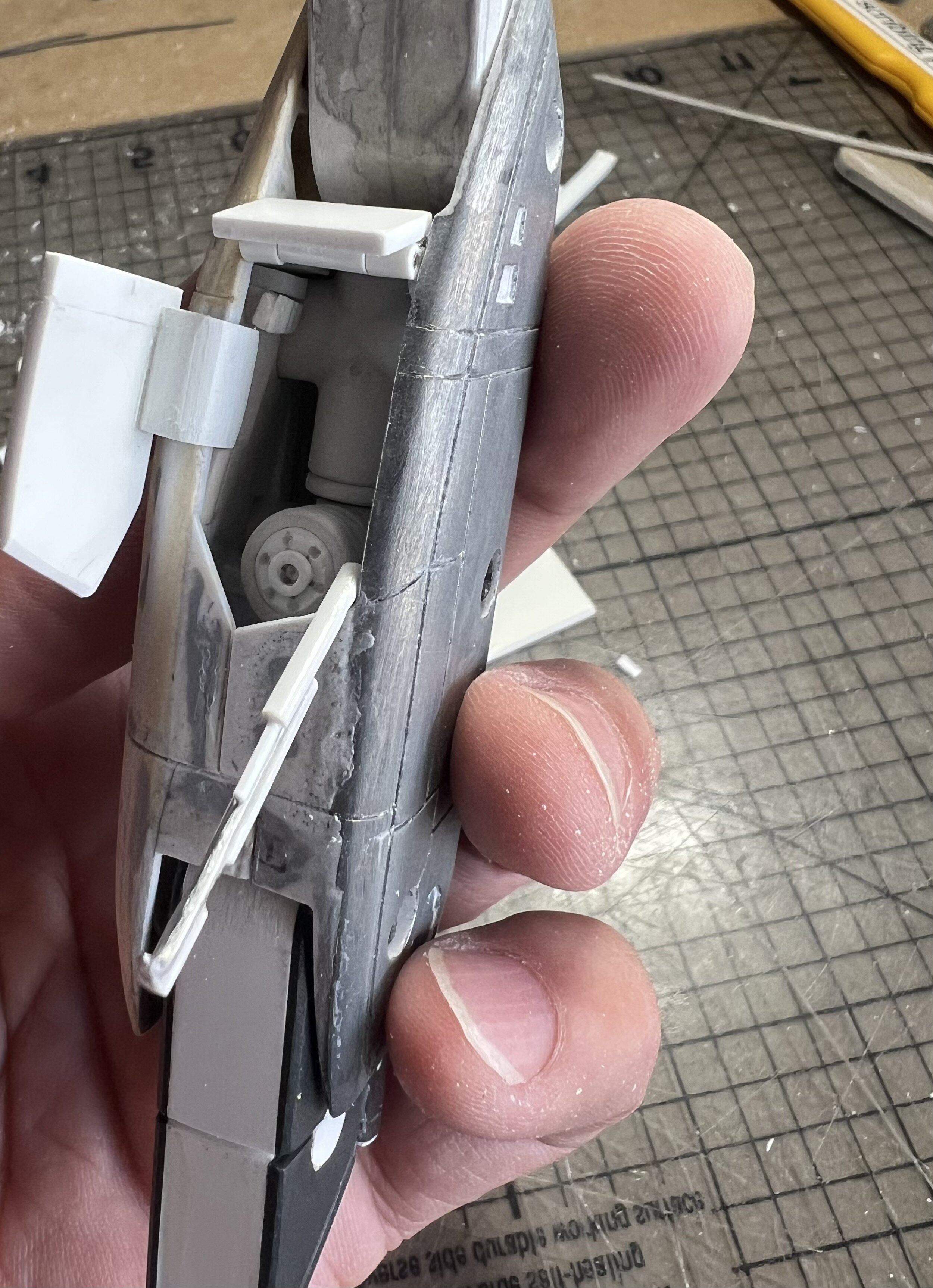

nightmareB4macross Posted January 22, 2025 Posted January 22, 2025 Setting more parts. Legs are just magnetized to stick together. The landing gear are more than strong enough to hold up the weight of a VF-1 with any armor configuration, and more. Quote

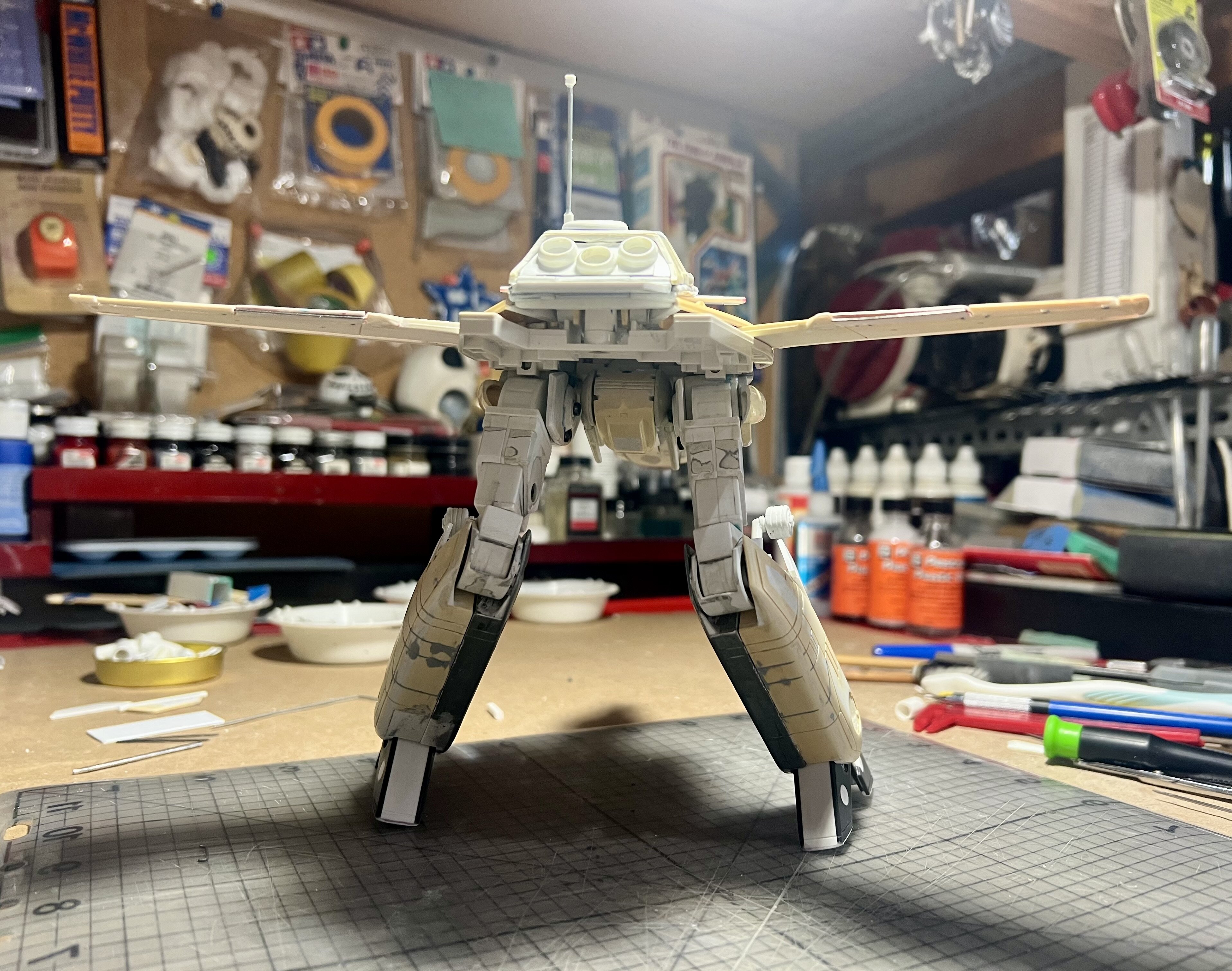

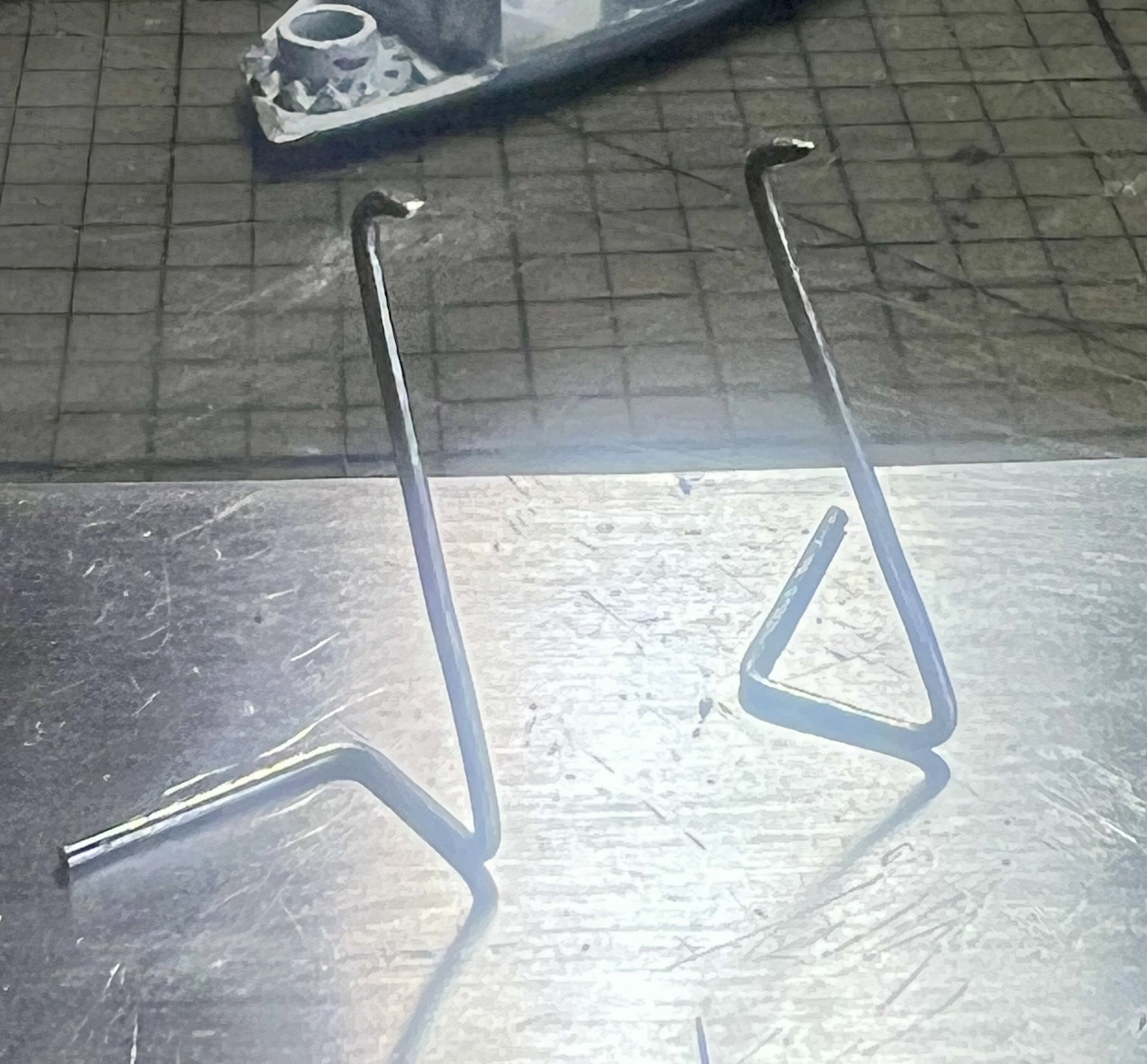

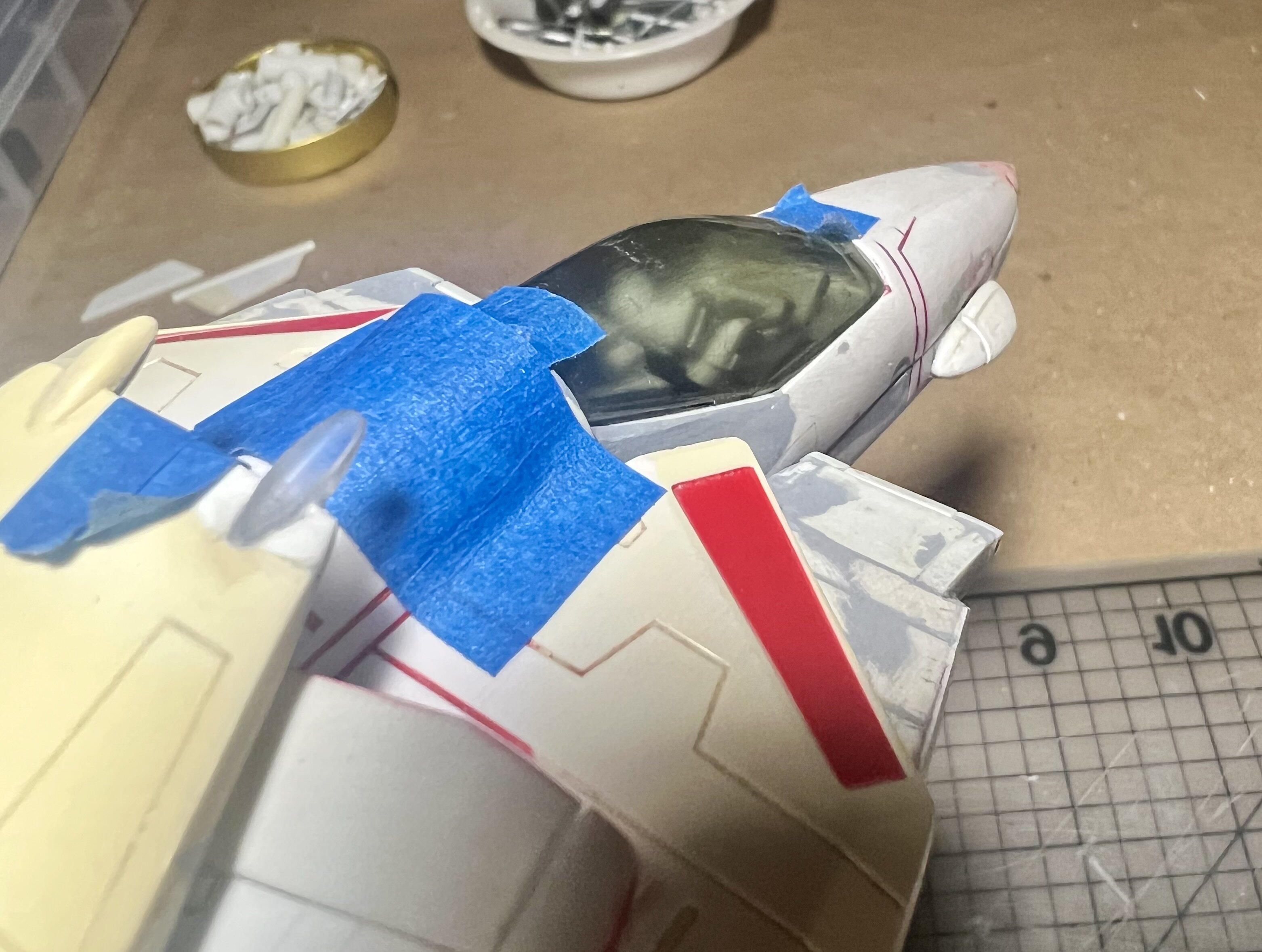

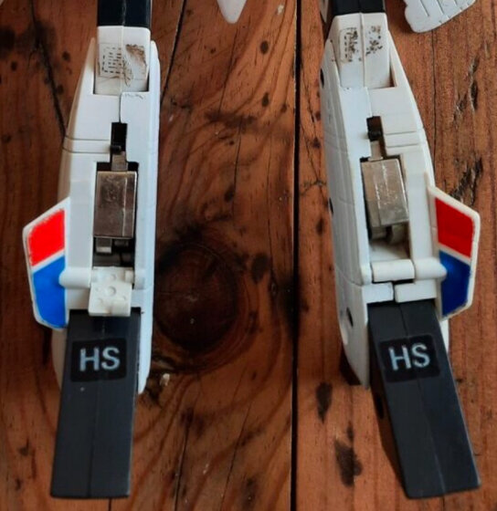

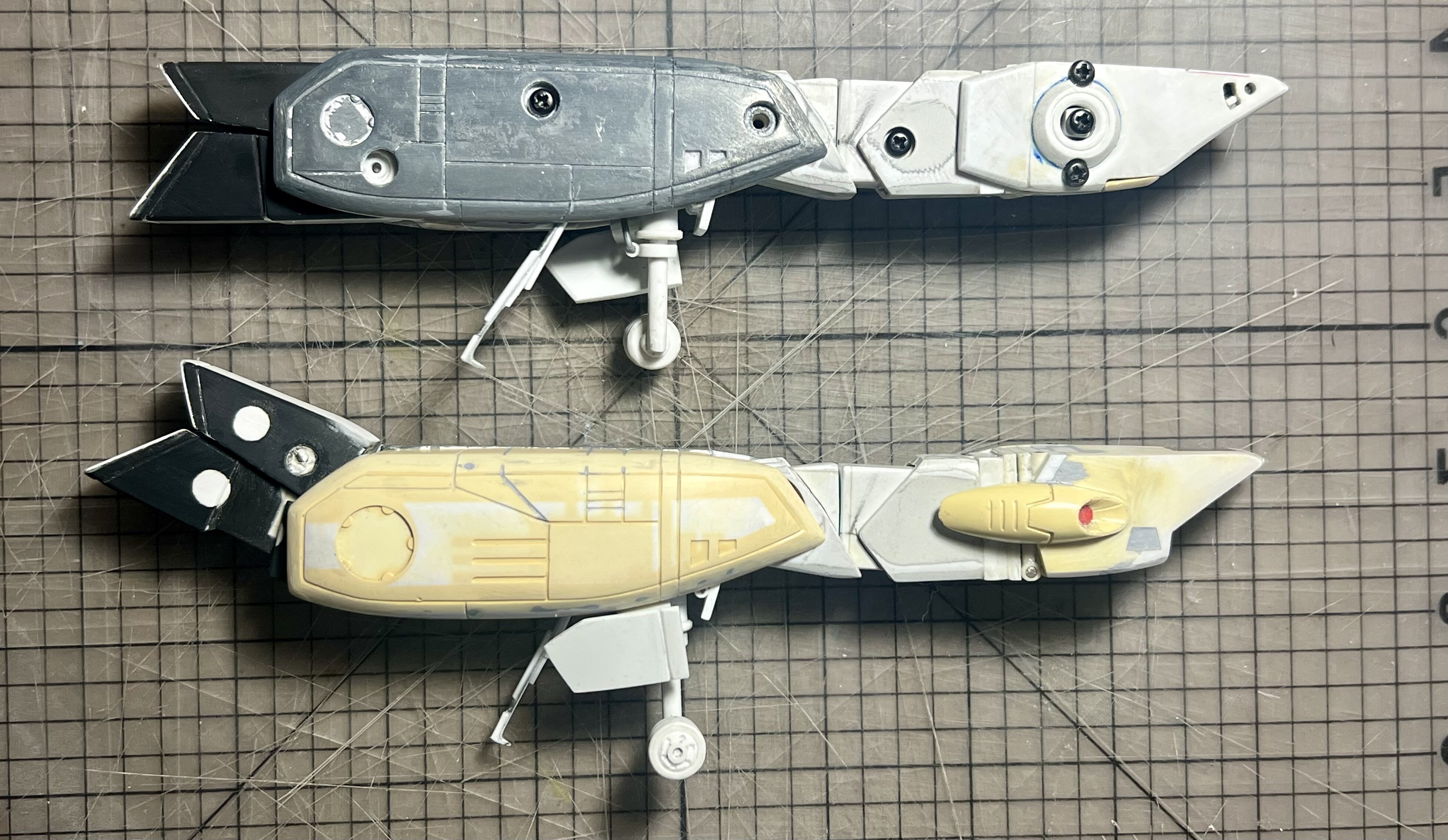

nightmareB4macross Posted January 23, 2025 Posted January 23, 2025 Definitely changing the front landing gear. Quote

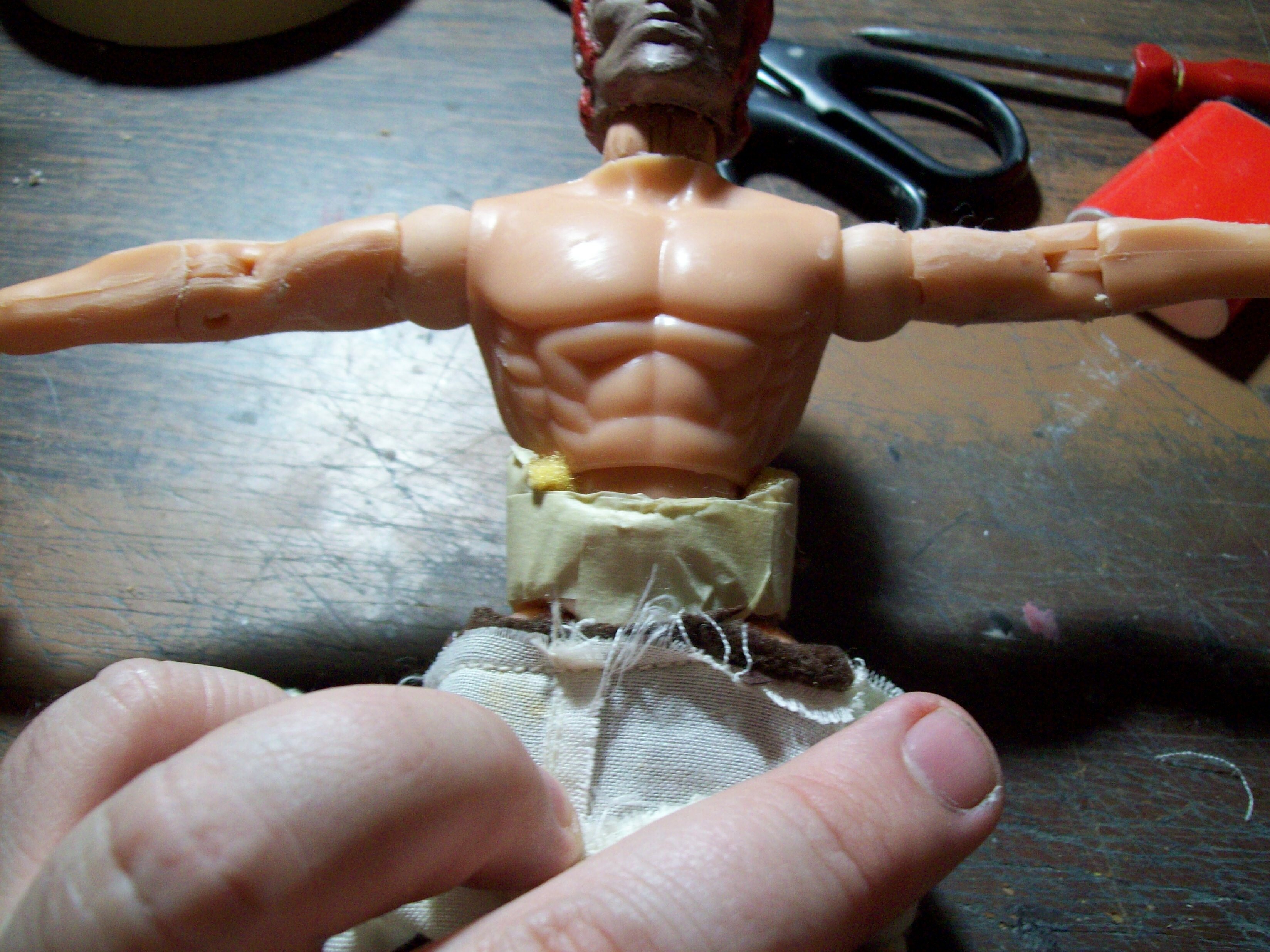

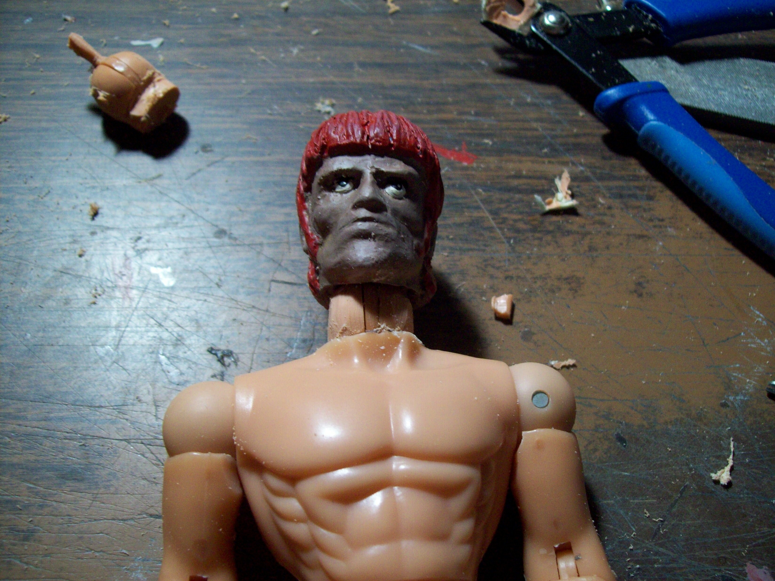

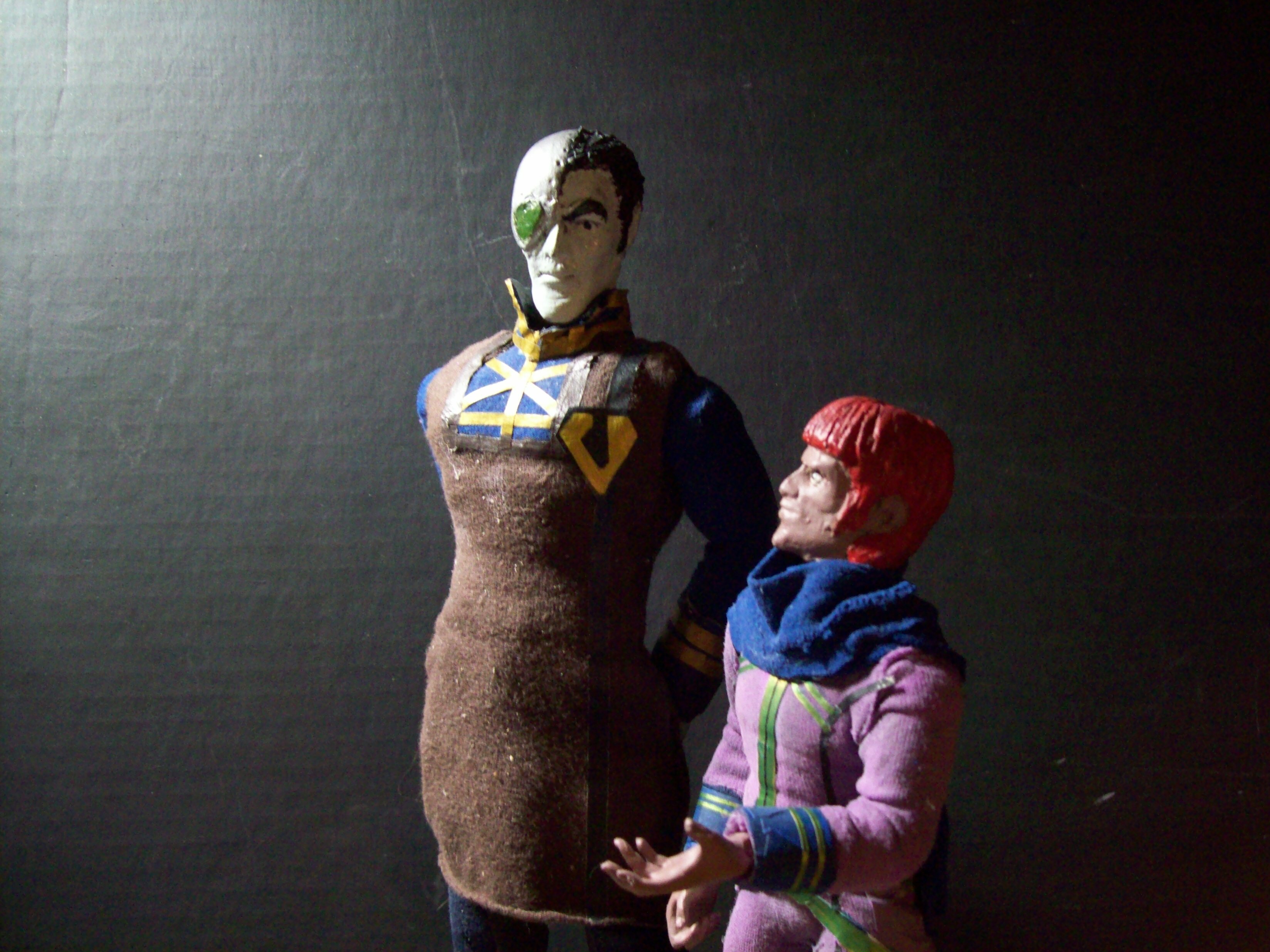

Thom Posted January 24, 2025 Posted January 24, 2025 Fortuitous find @pengbuzz! Exedore is looking Excellent! And who knew Frodo was so ripped!? @Cheese3 Real good look battroid! Quote
derex3592 Posted January 24, 2025 Posted January 24, 2025 Exedore/Frodo definitely didn't skip chest/tri's and bi's and core day! 😂 Quote

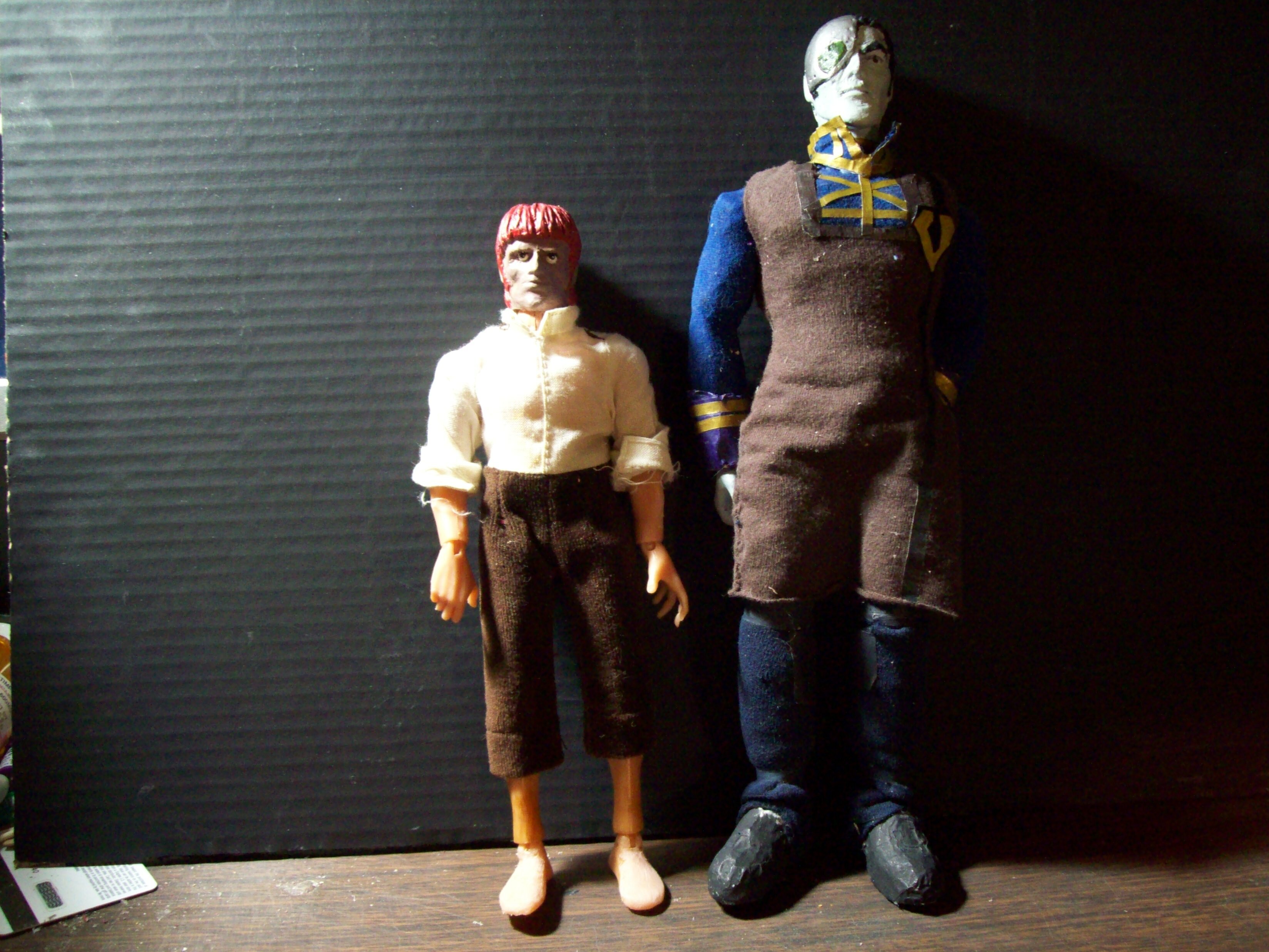

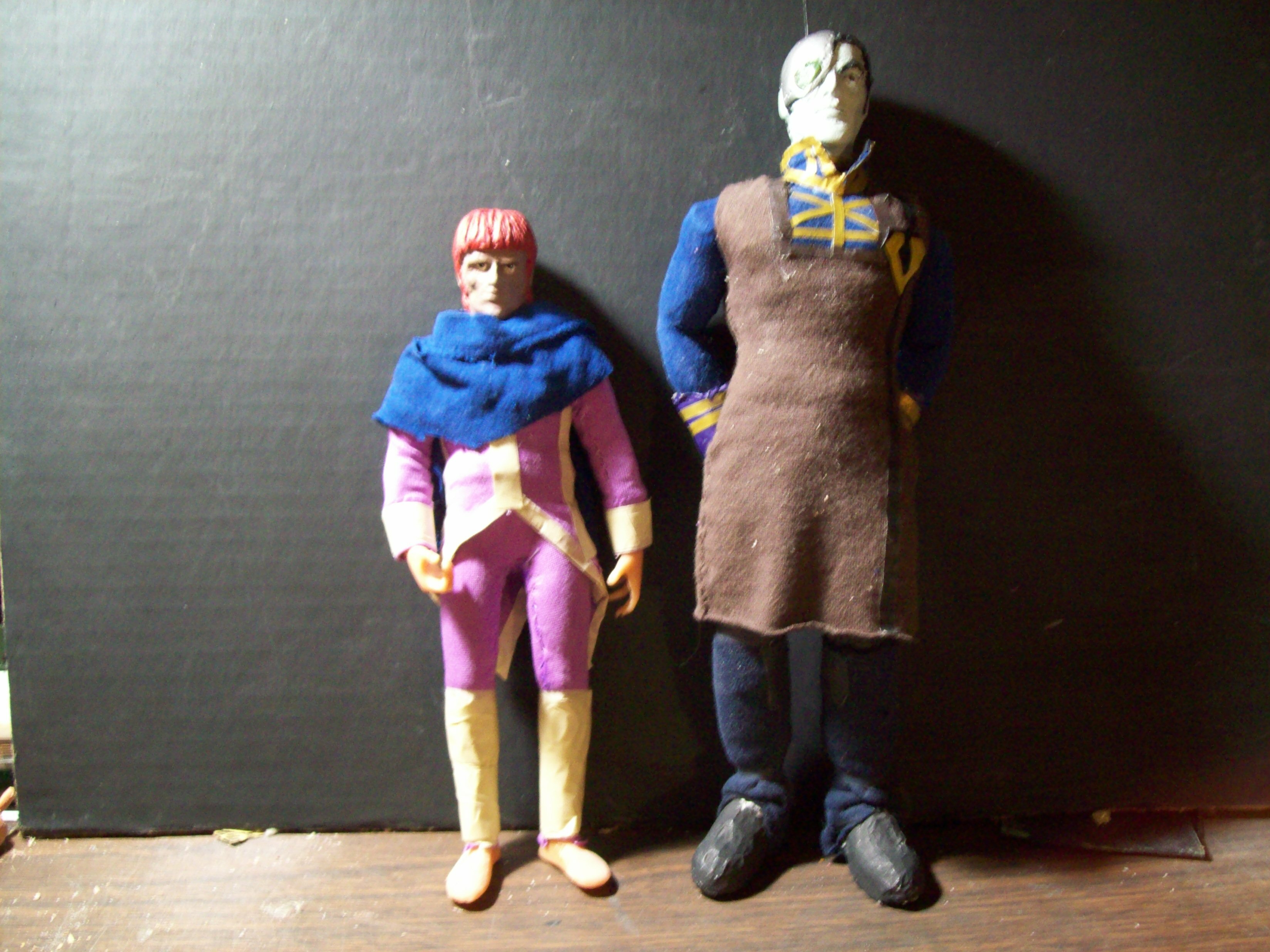

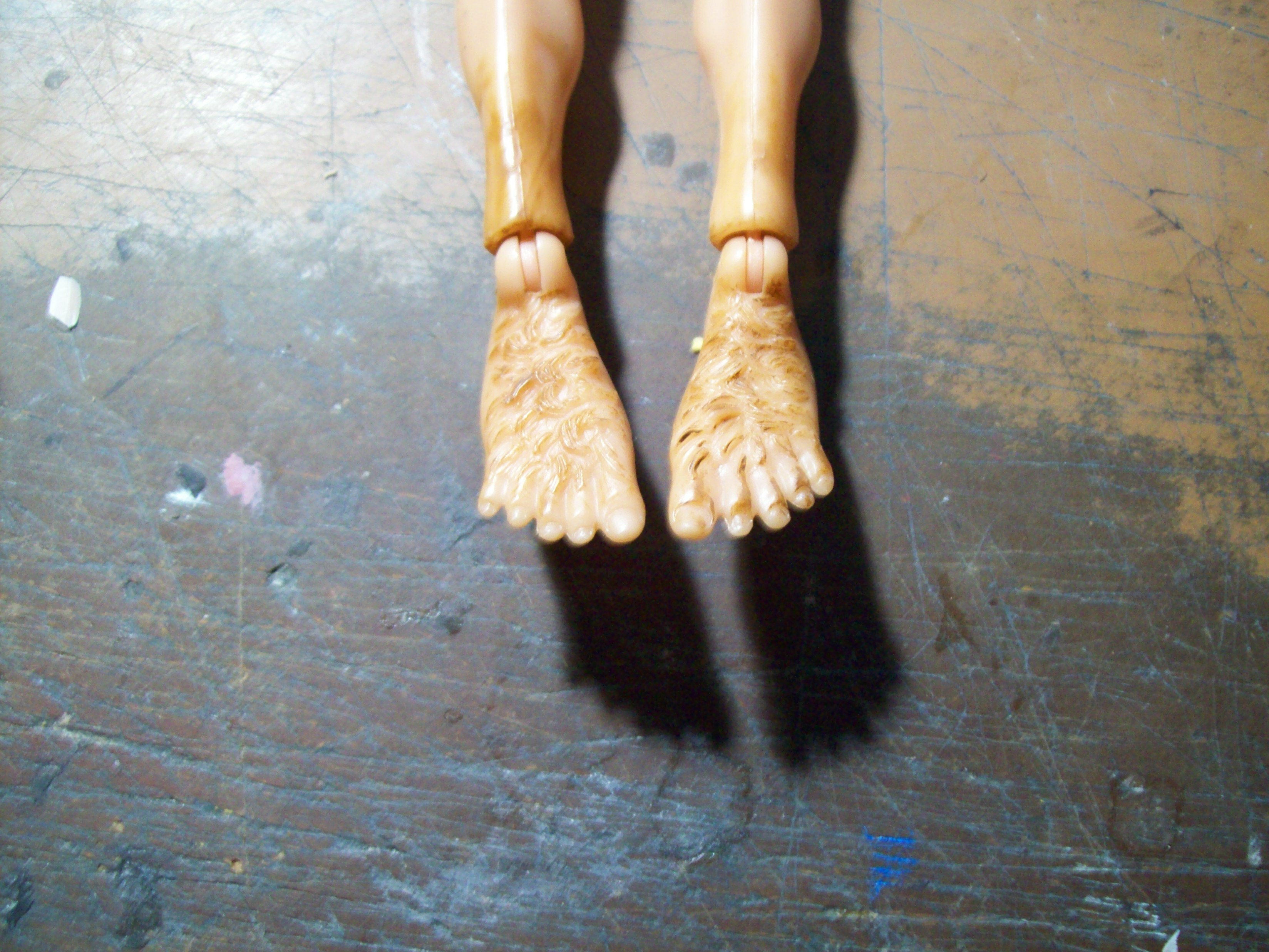

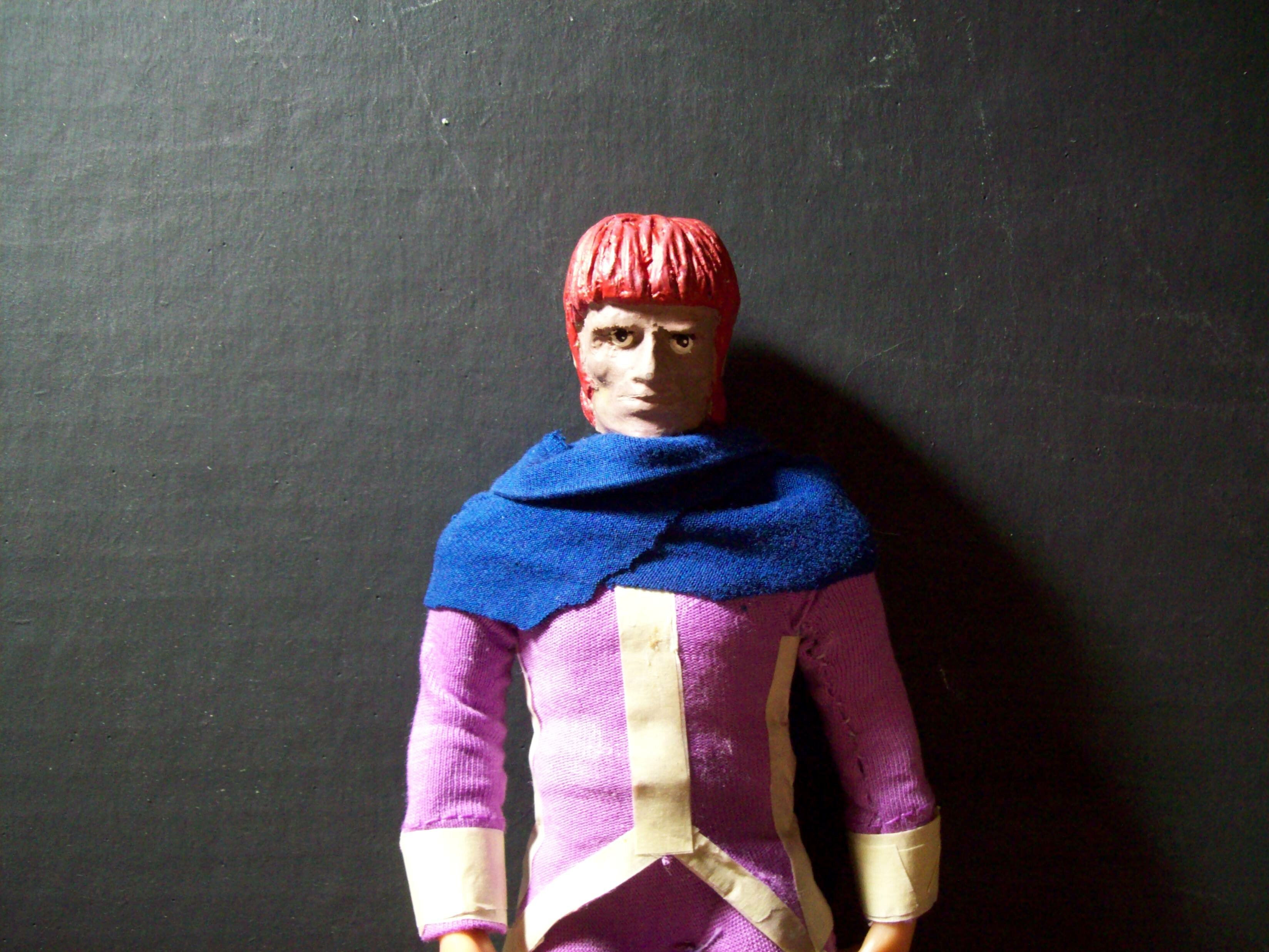

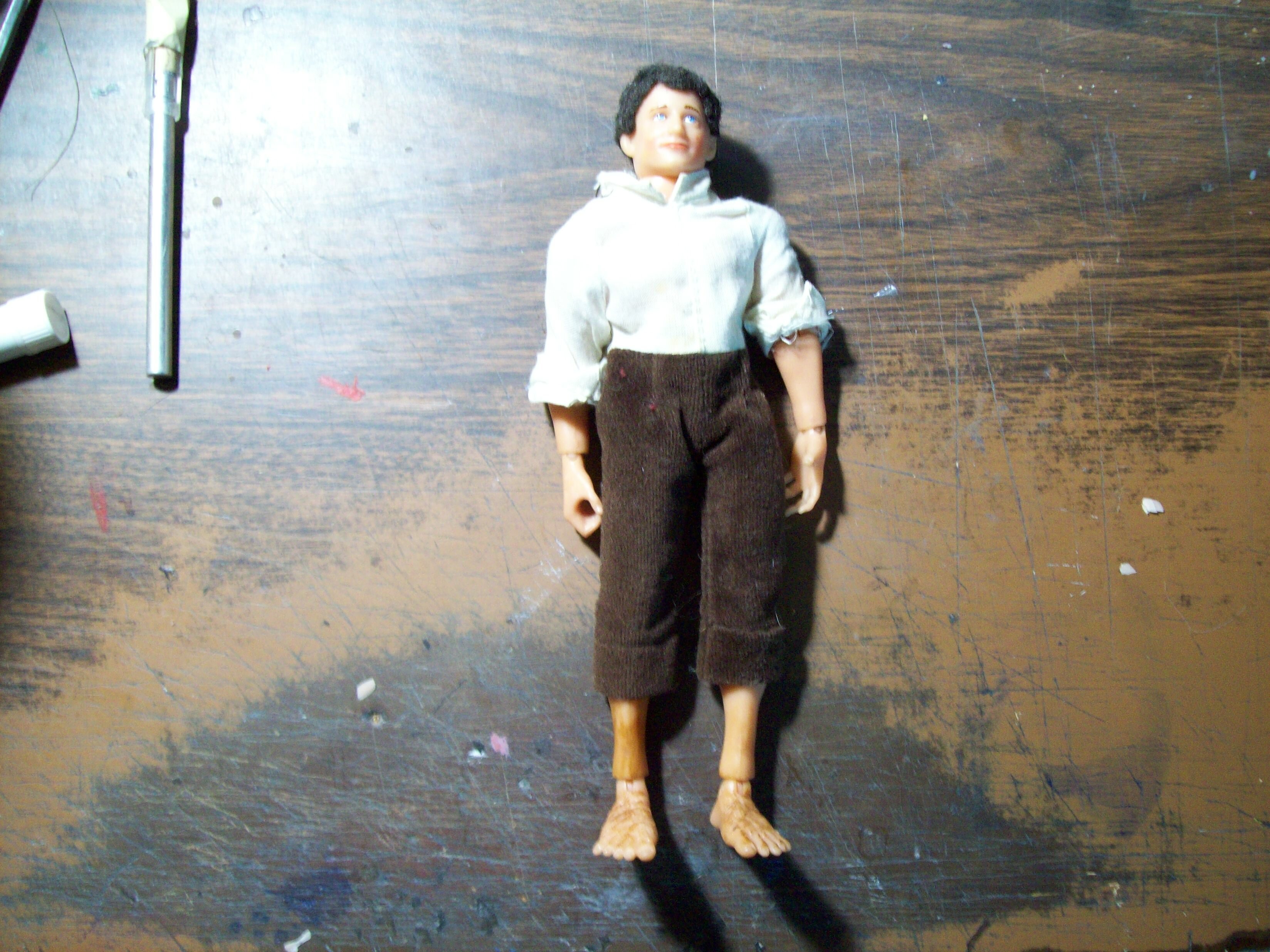

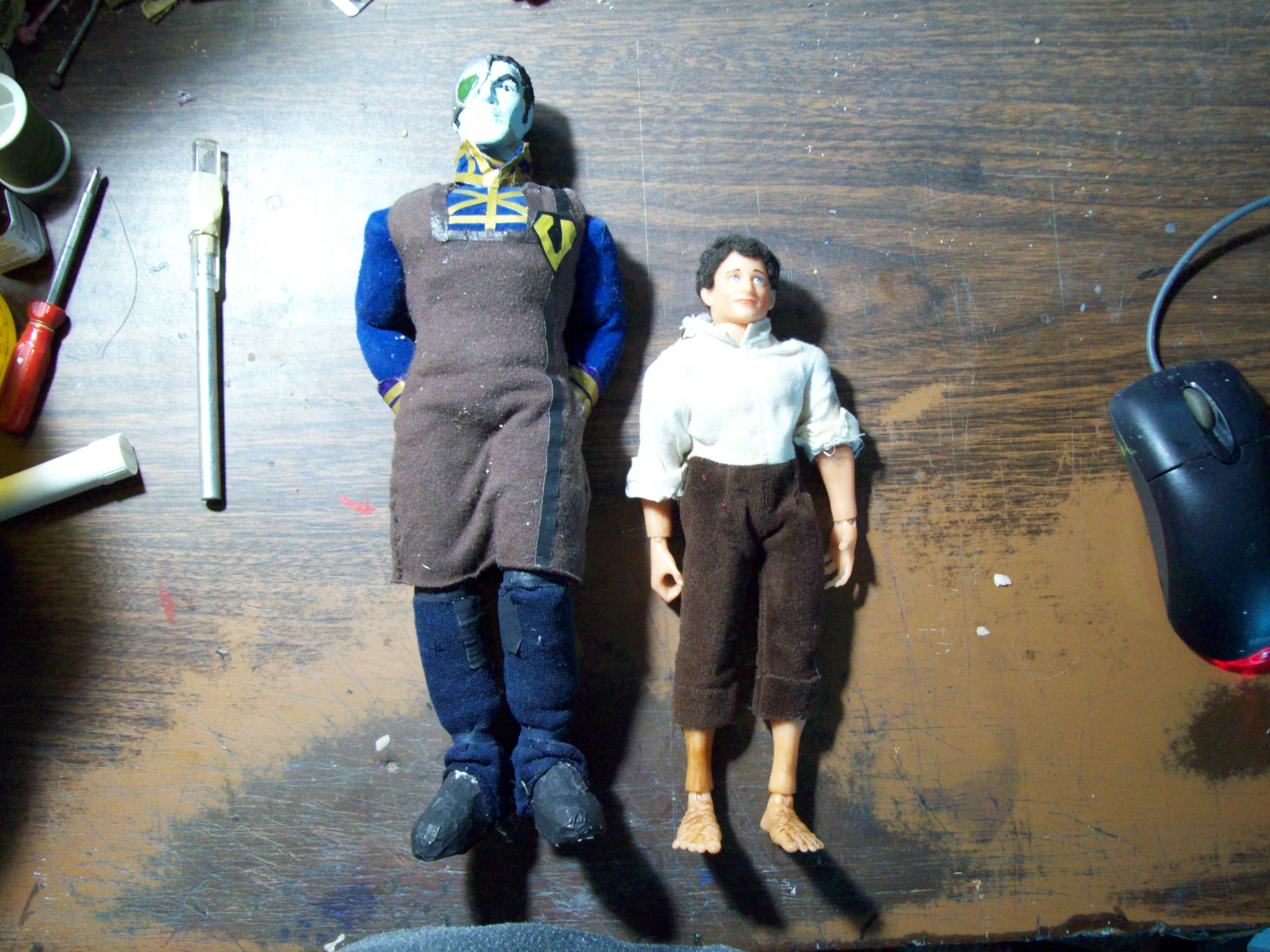

Big s Posted January 24, 2025 Posted January 24, 2025 14 hours ago, pengbuzz said: UPDATE: I ended up scrapping the old body for exedore (got the head painted though), and got an LotR Frodo figure (1/6)- Height and size comparison to Breetai: Exedore's head just happened to not only be in scale with Breetai's, but Frodo's as well" Thankfully, he'll have shoes (eeeeww!! Hobbit feet!😞 Installation of new neck joint into body (the old one wouldn't work with Exedore's head): Size/ height comparison with new head in place (sorry about the outfit!): Waist padding (the original waist was waaaaaayyyyy too narrow!): Basic outfit in progress; still needs work and some "toning down" colorwise: Starting to look legitimate here!: BTW: can anyone imagine these two belting out "You've lost that lovin' feeling" by the RIghteous Brothers? Stay tuned... I guess they’re going on an adventure Quote
Big s Posted January 24, 2025 Posted January 24, 2025 1 hour ago, pengbuzz said: And a shot of Breetai consulting with his advisor: Stay tuned... Is he about to hand him the one ring Quote

F18LEGIOSS2 Posted January 25, 2025 Posted January 25, 2025 On 1/22/2025 at 9:01 PM, nightmareB4macross said: Setting more parts. Legs are just magnetized to stick together. The landing gear are more than strong enough to hold up the weight of a VF-1 with any armor configuration, and more. What type of cement and plastic did you use for the landing gear bay doors? It looks very solid. I 'm searching several types of cement for my Legioss and VF1 elintseeker (1/32 scale) DIY. Quote

nightmareB4macross Posted January 26, 2025 Posted January 26, 2025 9 hours ago, F18LEGIOSS2 said: What type of cement and plastic did you use for the landing gear bay doors? It looks very solid. I 'm searching several types of cement for my Legioss and VF1 elintseeker (1/32 scale) DIY. I use styrene and Plastuct Weld. Depending on the application, mm widths will change as needed. For a build like this I usually use 1.5mm down to .5mm. Any thinner is used for detailing or to build up parts that have been cut a bit short. The door, hinge, and retainer are all styrene, no metal pins needed for this. With the PW I have keep a separate bottle where I add plastic bits and shavings to create goop that acts as a filler and to strengthen joints where gaps are visible. Once thoroughly dry, I can sand the parts smooth. This same concoction will also help you bond styrene to other materials like metals and provide a very solid adhesion. Just be sure to clean and rough the metal surface first. For the landing gear I pre-shape metal rods or paper clips and envelope them with styrene to provide extra rigidity and solid structures. Hope this helps. Quote
Chas Posted January 26, 2025 Posted January 26, 2025 That looks so darned good it almost brings tears to my eyes! 👏👏😱 Quote
Thom Posted January 26, 2025 Posted January 26, 2025 @nightmareB4macross The engineering and thought behind that is phenominal! Love that you captured that 'toed-out' stance that is iconic for the Gerwalk. Quote
MechTech Posted January 27, 2025 Posted January 27, 2025 @nightmareB4macross That is BEAUTIFUL engineering and work on those pieces! @F18LEGIOSS2 If you have Acetone, that is one of the BEST cements for ABS. It is super thin and dries FAST, so watch how you use it if so. - MT Quote
Papa Rat Posted January 27, 2025 Posted January 27, 2025 On 1/26/2025 at 12:48 AM, nightmareB4macross said: I use styrene and Plastuct Weld. Depending on the application, mm widths will change as needed. For a build like this I usually use 1.5mm down to .5mm. Any thinner is used for detailing or to build up parts that have been cut a bit short. The door, hinge, and retainer are all styrene, no metal pins needed for this. With the PW I have keep a separate bottle where I add plastic bits and shavings to create goop that acts as a filler and to strengthen joints where gaps are visible. Once thoroughly dry, I can sand the parts smooth. This same concoction will also help you bond styrene to other materials like metals and provide a very solid adhesion. Just be sure to clean and rough the metal surface first. For the landing gear I pre-shape metal rods or paper clips and envelope them with styrene to provide extra rigidity and solid structures. Hope this helps. Wow! Amazing work ♥️ Quote
Bolt Posted January 28, 2025 Posted January 28, 2025 On 1/26/2025 at 12:48 AM, nightmareB4macross said: I use styrene and Plastuct Weld. Depending on the application, mm widths will change as needed. For a build like this I usually use 1.5mm down to .5mm. Any thinner is used for detailing or to build up parts that have been cut a bit short. The door, hinge, and retainer are all styrene, no metal pins needed for this. With the PW I have keep a separate bottle where I add plastic bits and shavings to create goop that acts as a filler and to strengthen joints where gaps are visible. Once thoroughly dry, I can sand the parts smooth. This same concoction will also help you bond styrene to other materials like metals and provide a very solid adhesion. Just be sure to clean and rough the metal surface first. For the landing gear I pre-shape metal rods or paper clips and envelope them with styrene to provide extra rigidity and solid structures. Hope this helps. Haven't been on this particular thread in a long time. Your project is awesome @nightmareB4macross , great job Quote

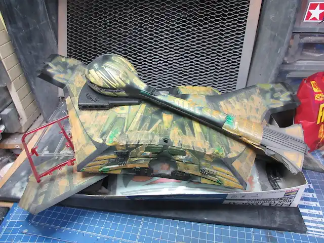

SteveTheFish Posted January 29, 2025 Posted January 29, 2025 I've dusted off my old, abandoned Klingon K'Tinga kit after I gave up on it because the photoetch and the bad instructions screwed me up. So many mishaps with this, and it's mostly the fault of how badly the photoetch fits over the plastic. The PE band that goes across the bulb is NOT the same size as the plastic pieces its supposed to cover. I really wish I had not bothered with it. First of all, the instructions have some of the parts numbers switched or just plain wrong. Secondly, I guess I'm just used to building Japanese model kits because I am not trained in having to read a friggin' PARAGRAPH detailing the assembly when simple pictures could just suffice (as Japanese kit makers are capable of doing). I started this in December 2018 and I rage quit this project the next year. It's been in this Hasegawa F-14 Tomcat box, collecting dust on the floor for several years. I want my revenge. Quote
Thom Posted January 29, 2025 Posted January 29, 2025 @SteveTheFish Good luck on your revenge spree! And that is actually a good name for the ship if it is ever done. Or in Klingon, Bortas. Quote

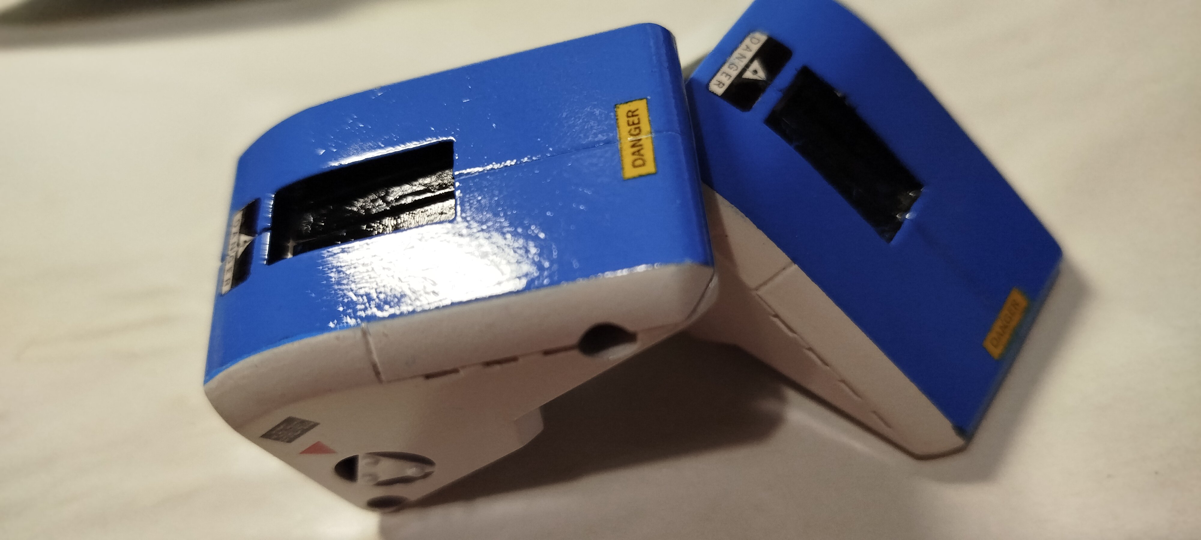

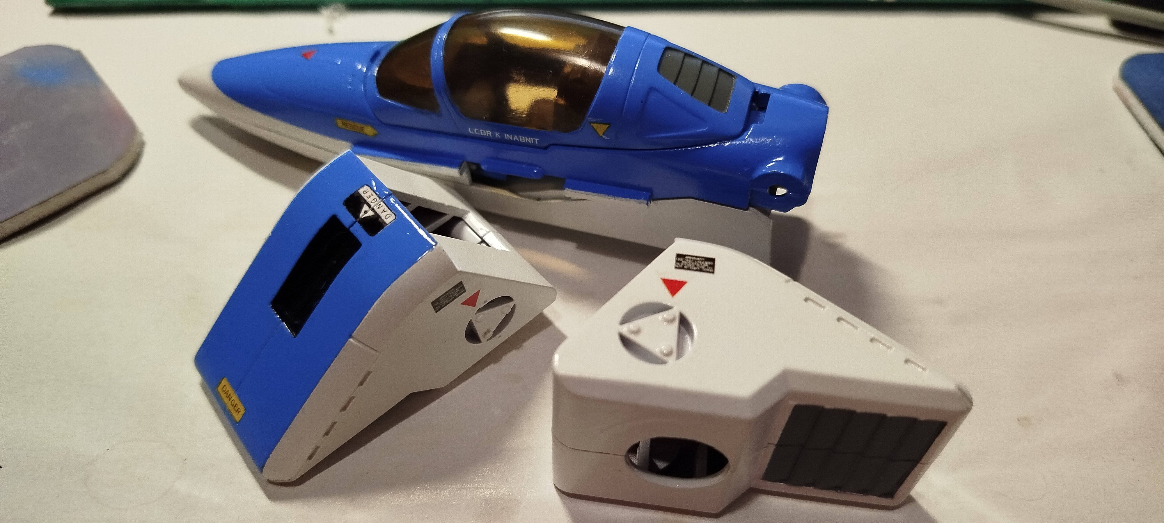

F18LEGIOSS2 Posted January 29, 2025 Posted January 29, 2025 Update on my Legioss: grey color and clear varnish are applied on these 3 parts. Quote
F18LEGIOSS2 Posted January 29, 2025 Posted January 29, 2025 Next step : sanding and polishing with MICROMESH Quote
