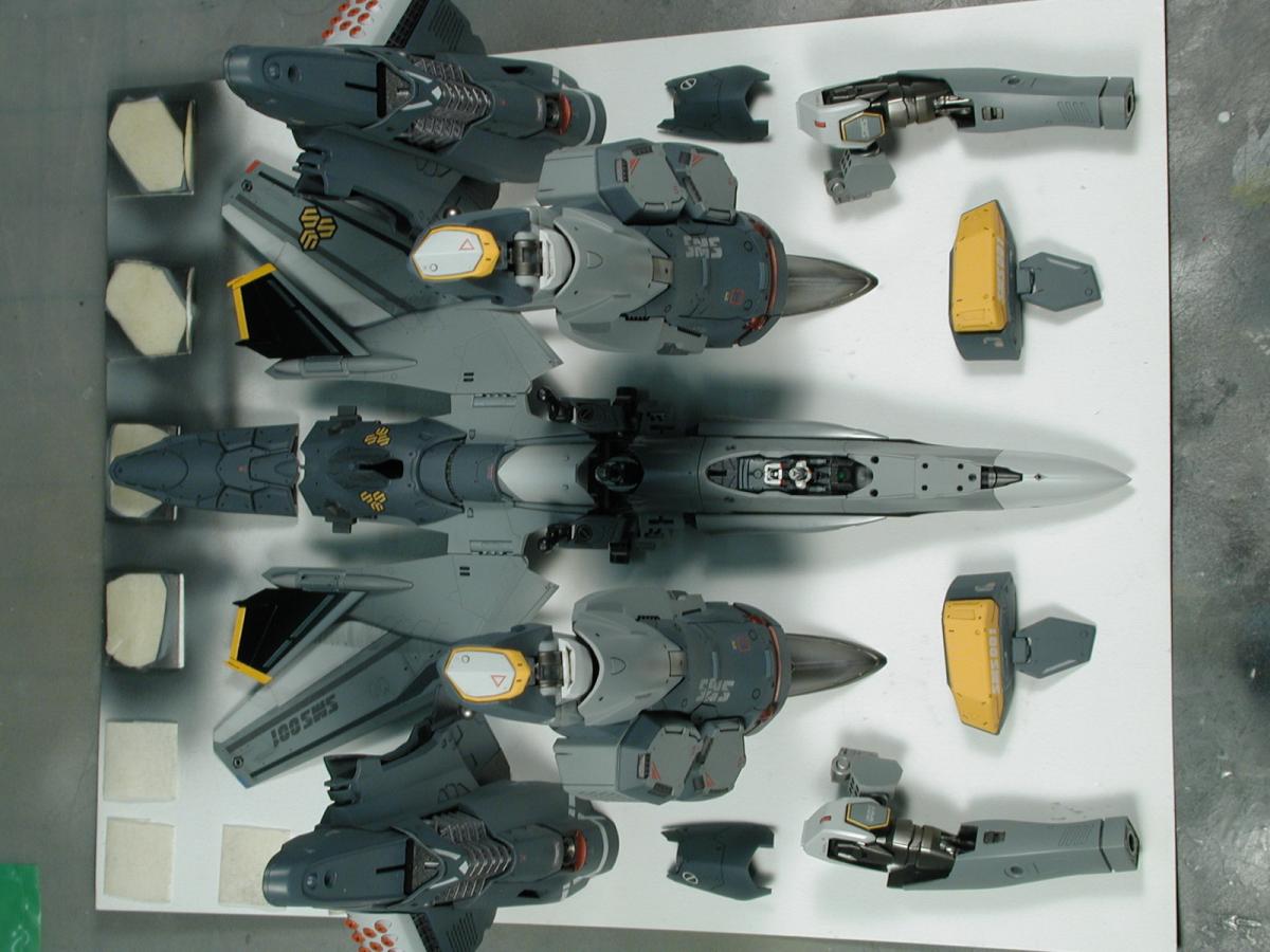

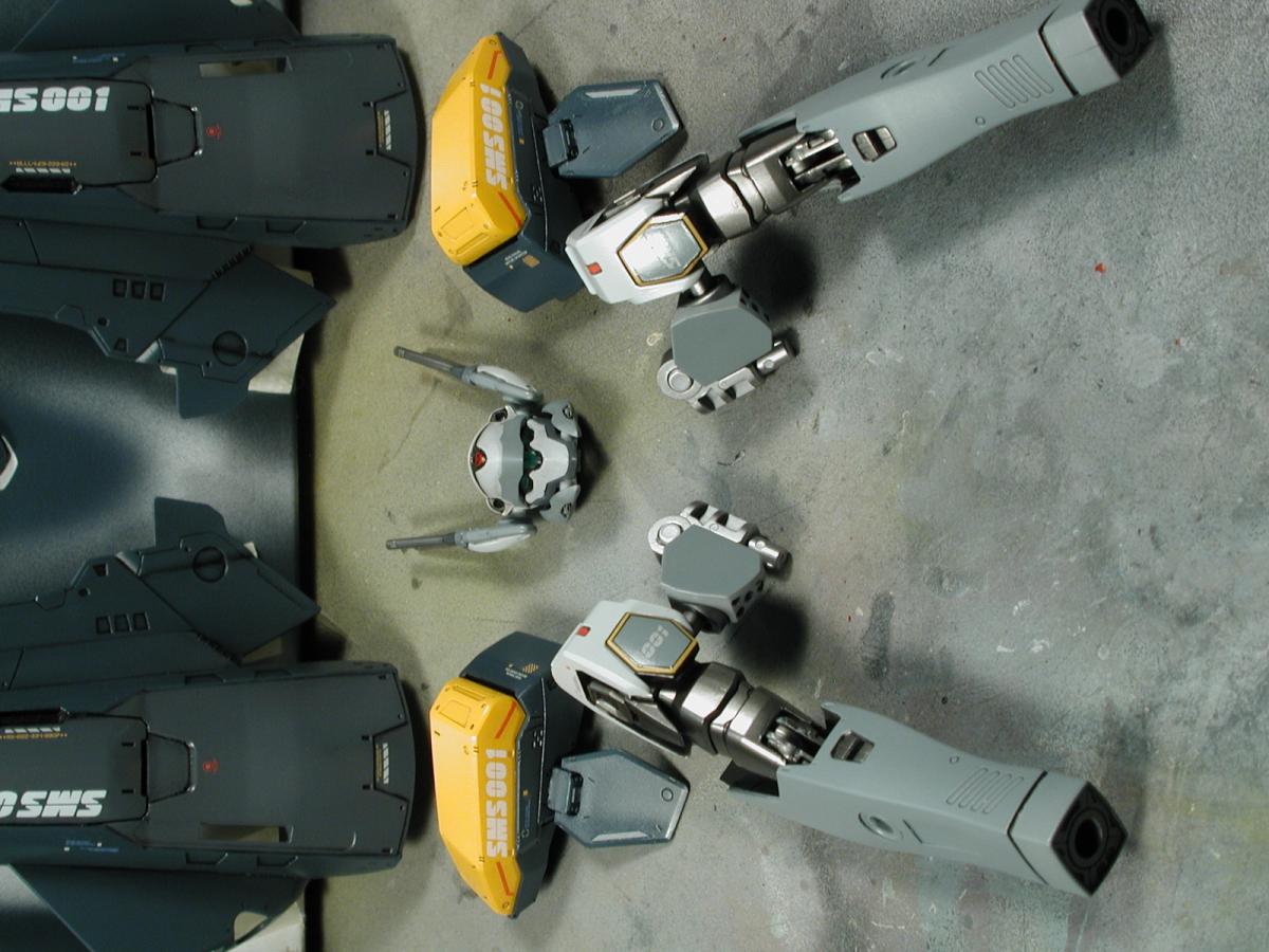

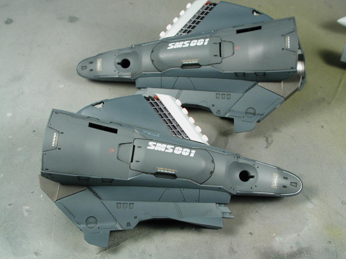

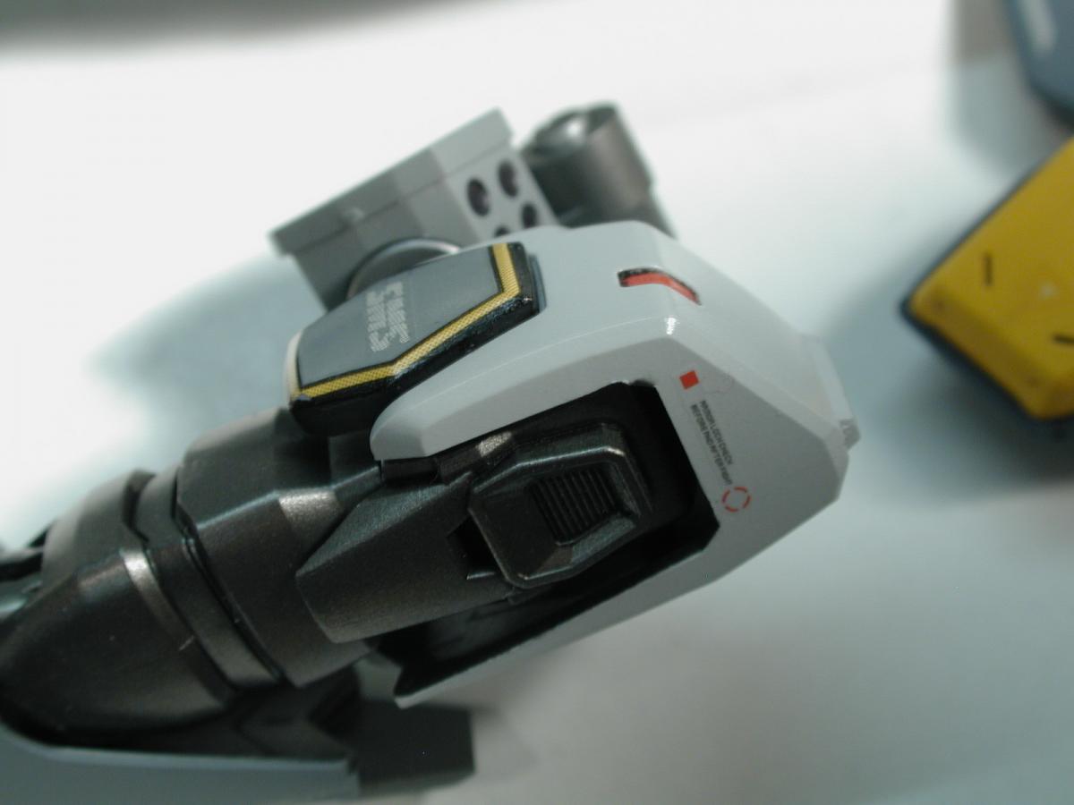

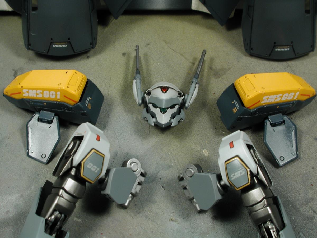

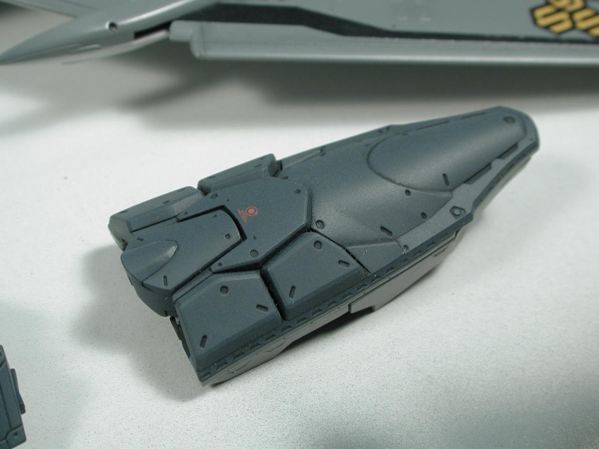

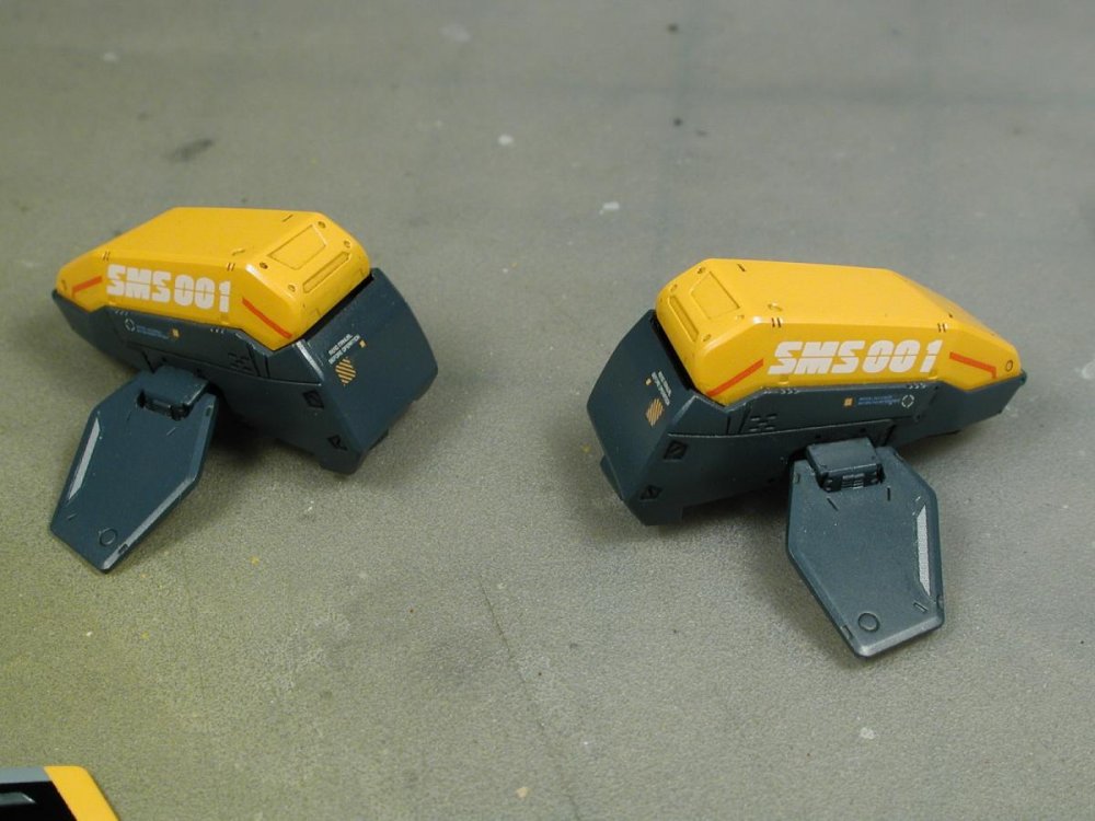

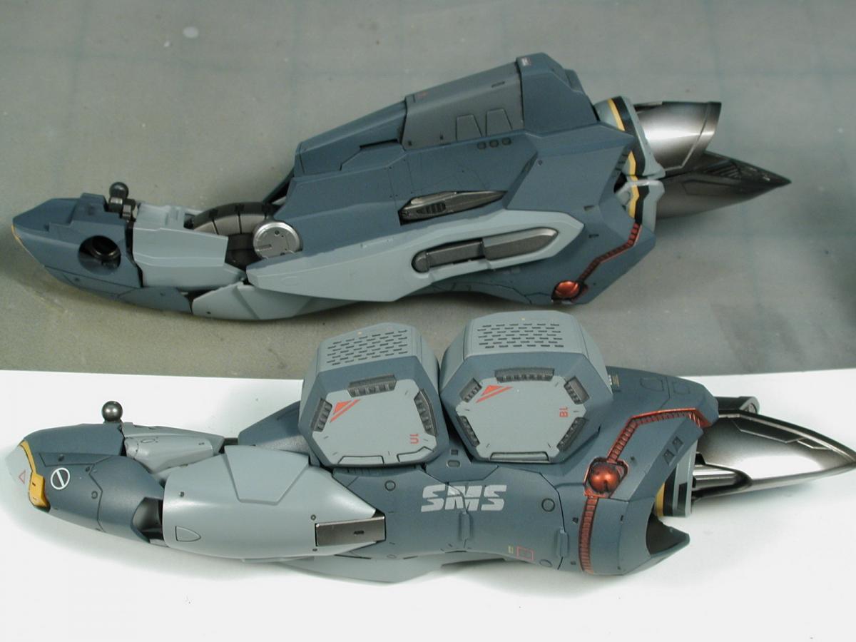

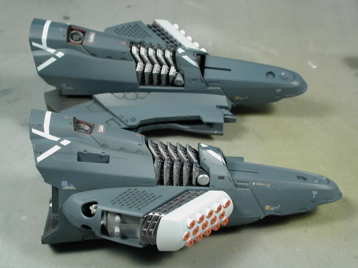

wm cheng Posted February 23, 2013 Posted February 23, 2013 Thanks! Yes, I checked the junk mail and its not in there, I am still getting notifications from other threads subscribed - just not this particular one. Thanks, finally making some headway... but still lots of tiny warning data stenciling on the fast packs before I can clear coat them in a matte finish before assembling them - so its still in a million pieces at the moment.

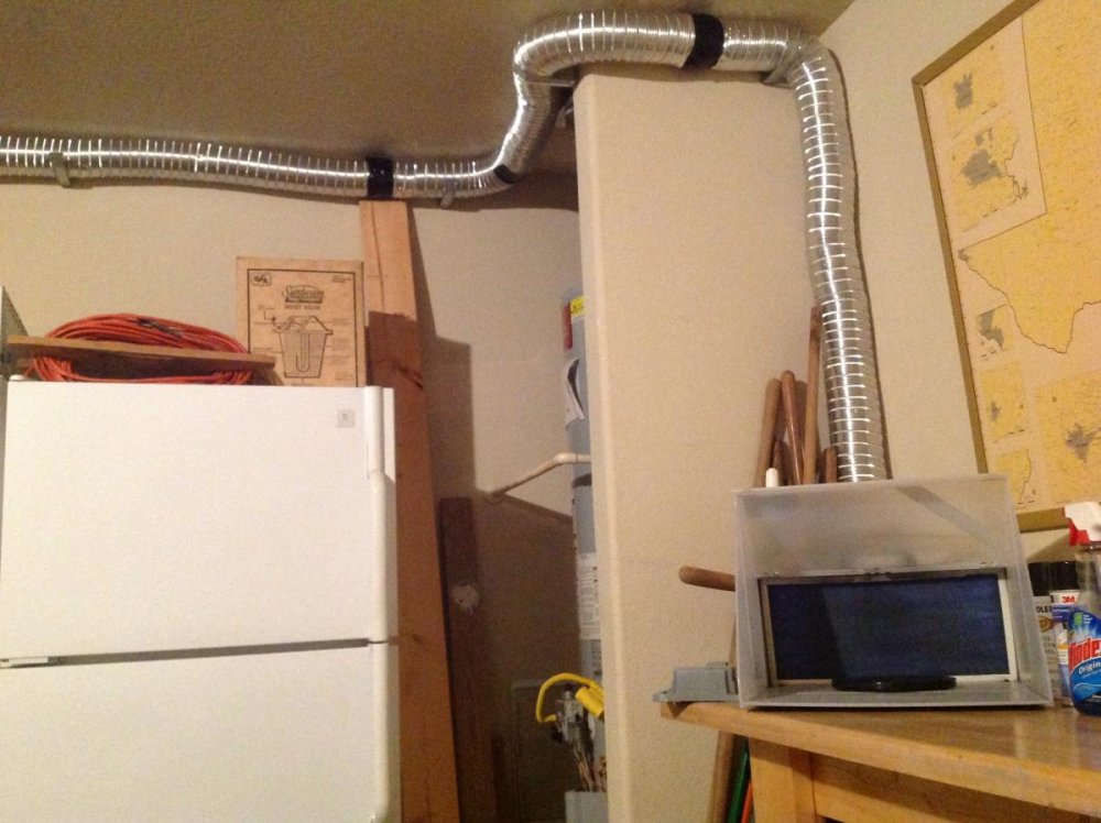

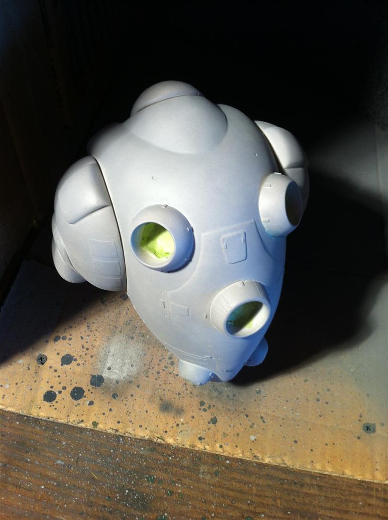

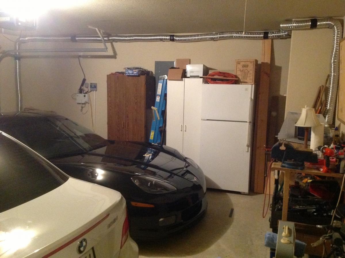

derex3592 Posted February 23, 2013 Posted February 23, 2013 Finally bought a medium size spray booth and then made myself a ventilation system yesterday on my day off. Thought I would share...hopefully now I can make some headway on my Enterprise D. Light block covering an all clear model is turning out to be a pain!!!
GU-11 Posted February 23, 2013 Posted February 23, 2013 Is that booth good enough for rattle cans? Mine's only strong enough for airbrushing; then again, it's not even an actual spray booth.
Jefuemon Posted February 23, 2013 Posted February 23, 2013 Finally bought a medium size spray booth and then made myself a ventilation system yesterday on my day off. Does the booth's fan have enough oomph to push air though that long of a tube setup?
derex3592 Posted February 23, 2013 Posted February 23, 2013 Well...I tried spraying some paint thinner through my airbrush as a test..and I can definitely smell thinner at the end of the tube.and I can feel a slight whiff of air at the end of it...not much but enough I think. I'm gonna actually try to paint some Sunday so we shall see.

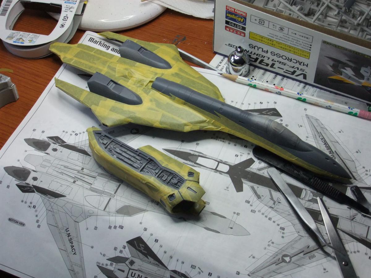

Jefuemon Posted February 23, 2013 Posted February 23, 2013 Doing some hard-core masking. I learned from the 1/72 YF-19 to not bother using the small line decals on the legs. Painting them is much less of a hassle.

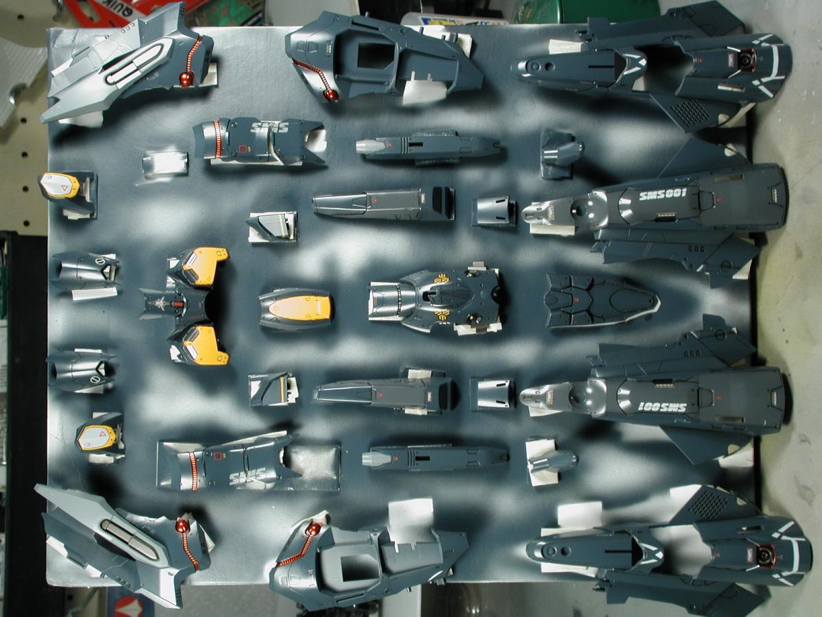

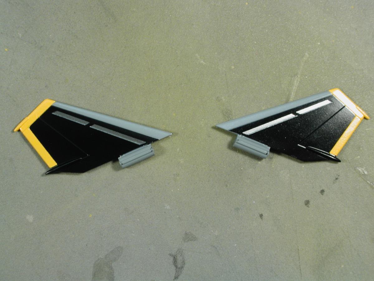

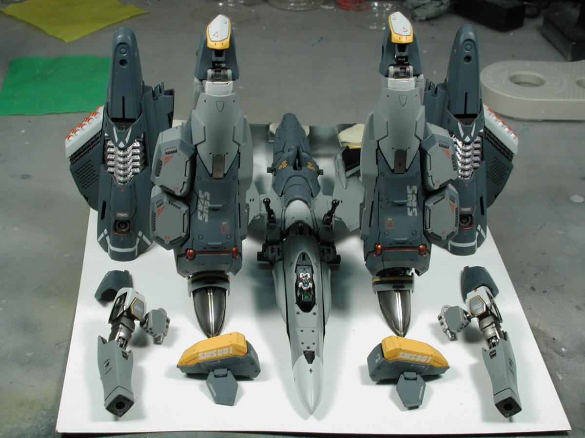

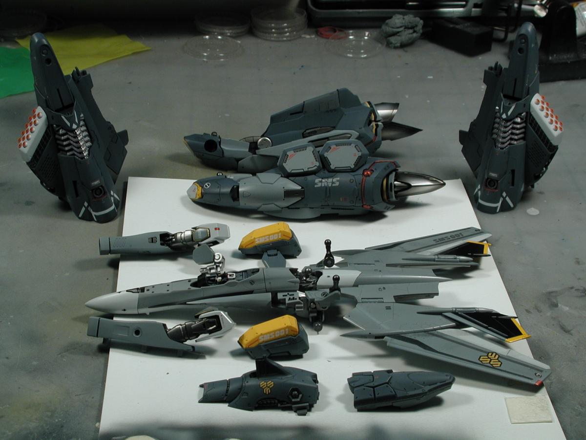

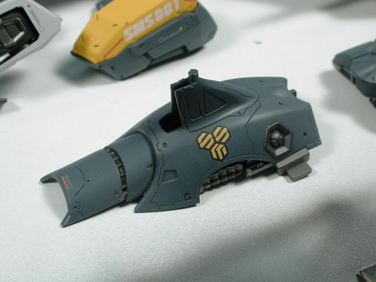

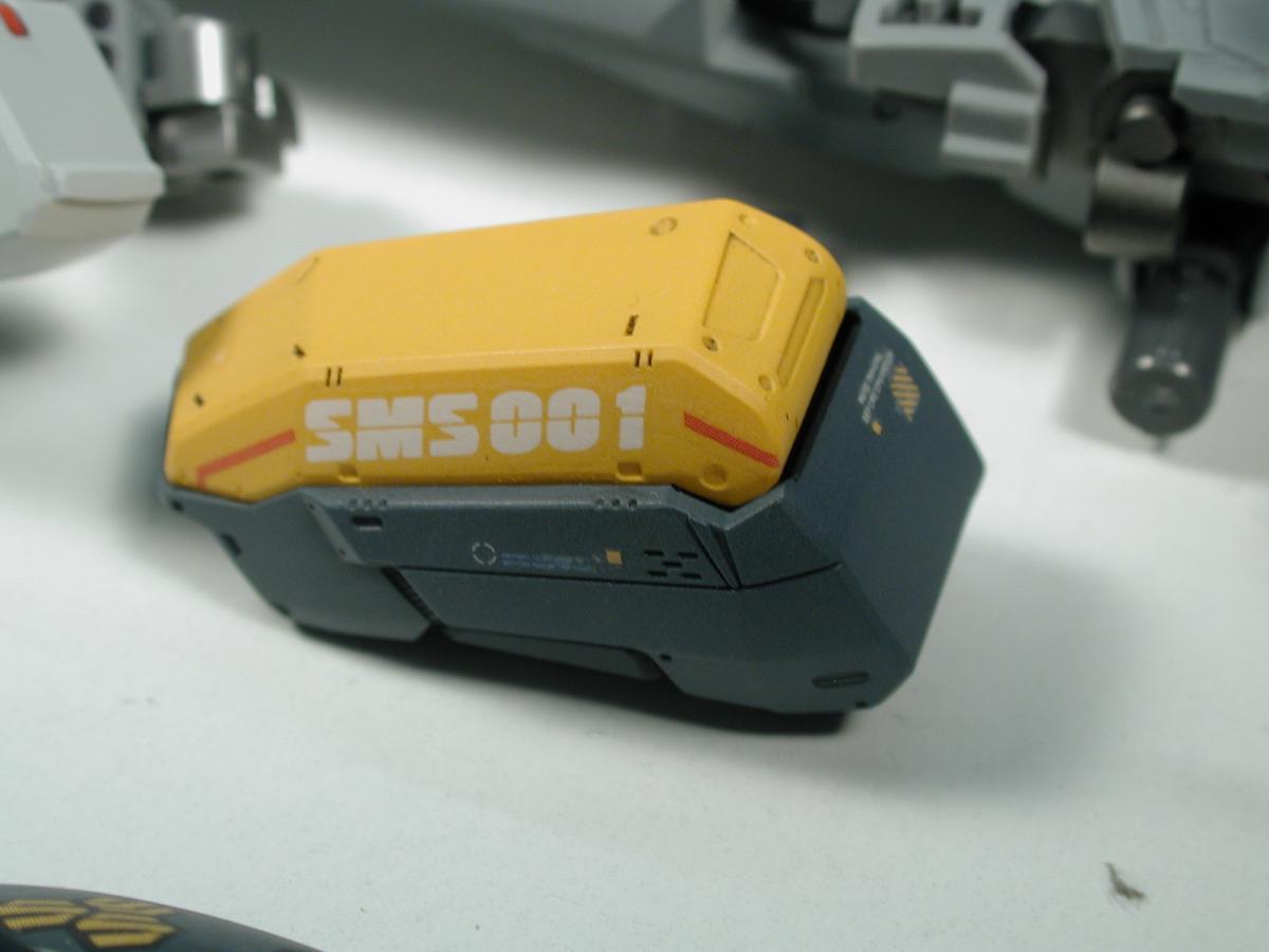

wm cheng Posted February 23, 2013 Posted February 23, 2013 Well, another 12hrs later... more masking... - discovered this Alclad Stainless Steel, if airbrushed onto something with a gloss coat (done for the decals) - it goes on amazingly smooth and reflective - the rudder inset silver is done with this stuff and really glints in the light like real polished metal! Some warning stenciling, in face that's all I've been doing to all the darker armored packs while I have the gloss coat on them. I wanted to get all the data stenciling on before I seal it in with the flat/matte clear coat so I can start assembling them Disaster struck though... I broke those little arms holding up the neck/head to the collar (parts J-23 & J-24) while I was trying to strip them down to repaint them (I seemed to be doing that a lot on this build - I vastly underestimated the scope of this build when I started - it wasn't the easiest kit to get "back in the saddle" with - I've had to re-learn a lot of decal handling and painting) Anyone with a spare part to sell me? http://www.macrossworld.com/mwf/index.php?showtopic=38586 I've pilfered one of my other VF-25 kits in my stash for now - but its a shame to lose one of those kits for these 2 very import parts.

EXO Posted February 23, 2013 Posted February 23, 2013 About the spray booth. Just make sure that you change your filter often enough. It should be mostly air that gets pulled into that vent tube. Leave your fan on for a while to push out all the air once you're done painting. If you're worried about extra chemicals going outside you can put a lint trap in the middle of the tube close to your booth for extra filtering. Of course use the right filter not regular lint wire.
MechTech Posted February 24, 2013 Posted February 24, 2013 Sadly, most small spray booths don't have enough draw on them. The fans that would work cost more and are noisy. A coworkers wife has a simialr sized booth and only air brushes food coloring onto her cakes. She always has "colors" around her nose afterward. I've even switched to Micro Sol Microweld (the GREEN bottle). It's citrus based and I've noticed I no longer get headaches from model building - that says something right there! I DO need to get a new mask though! - MT

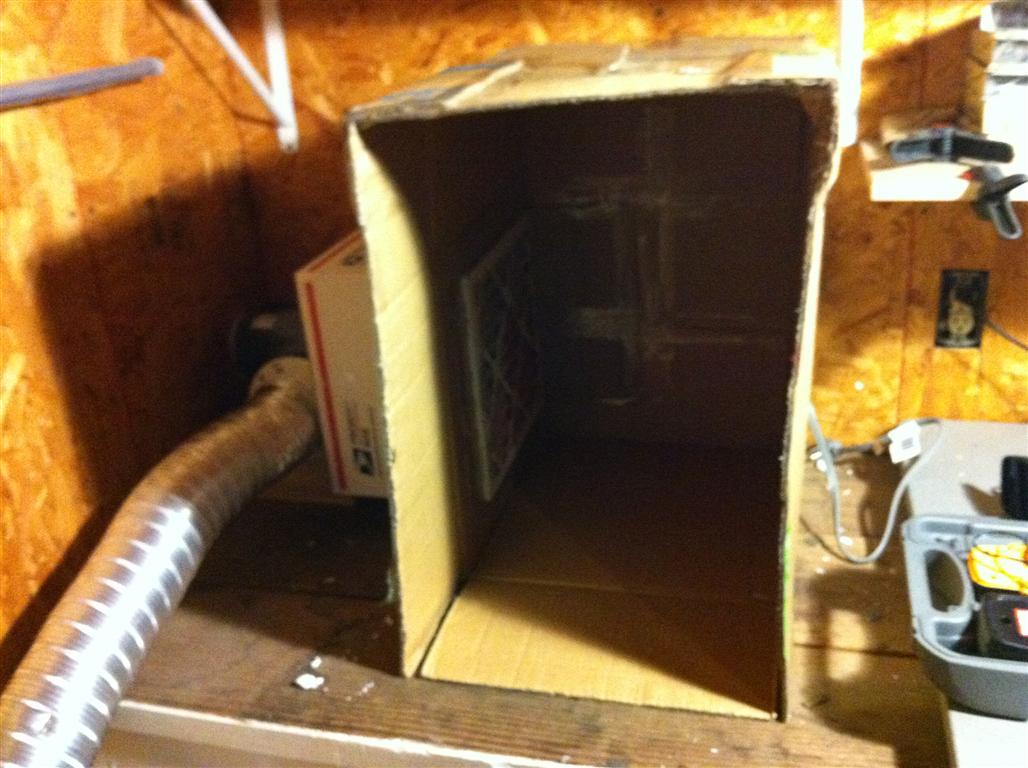

EXO Posted February 24, 2013 Posted February 24, 2013 Here's what I call my GPS... ghetto paint station. Most of the money was spent on the blower and vent, also a couple of work lights. Everything else was found in the garage. The big box is a case for Yamato 1/48s and you can see what holds the filter. I was putting together a booth made of plastic bins but I couldn't find a good size plus I thought the cold and the repeated reheating of the room would make it crack. I gotta say though, this thing is sturdy and you can see the particles getting pulled into the filter against the light. Rohby put together the blower on a stand for me. Getting a lot of painting done.
mechaninac Posted February 24, 2013 Posted February 24, 2013 Ugly, cheap, crude, and utterly brilliant!

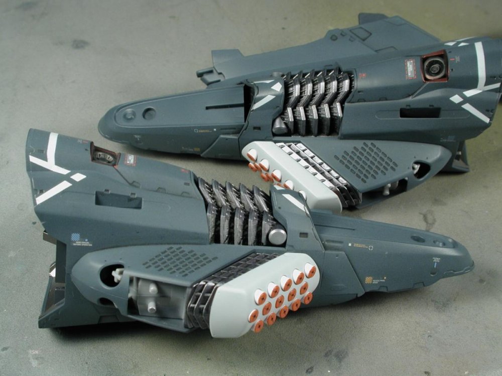

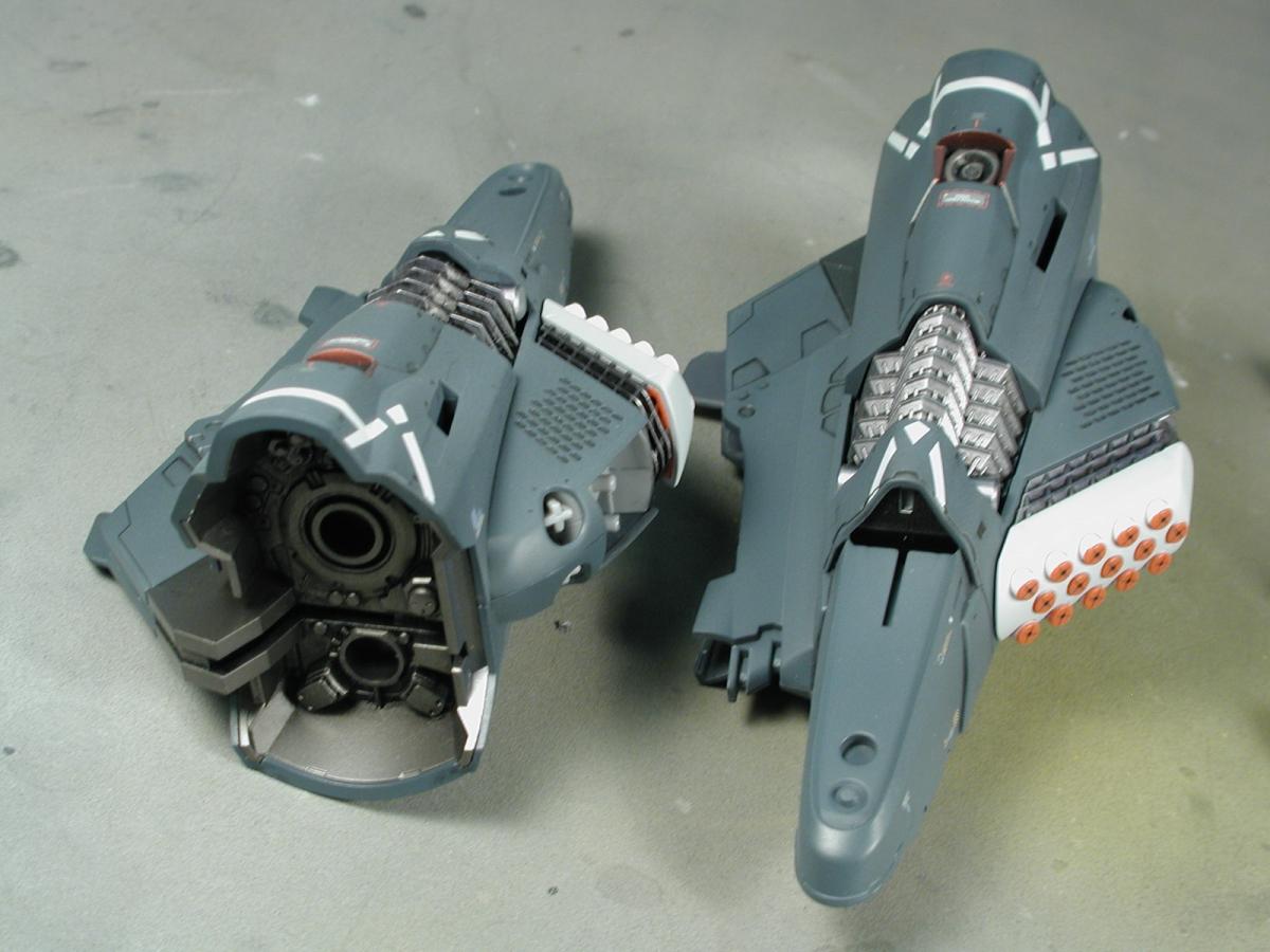

wm cheng Posted February 24, 2013 Posted February 24, 2013 I love ghetto setups! My first air compressor when I started my airbrushing was a junkyard fridge compressor that I rigged up with a sponge on the cylinder head which I kept wet so it would cool it down as it got hot and shut off (right in the middle of some important spray!) Well, finally one of the best parts - I matte/flat clear coat the packs and start assembling the pieces! All this is before the weathering - its pretty much spanking new now. Well, my mid grey turned out a little dark when it dried, the wet paint colour perfectly matched the plastic, but with the additional semi-gloss clear coat it darkened it a tad. Plus the darker fast packs definitely lightened up with the matte/flat coat, not sure if there's enough contrast yet. There's still a lot of other decals to go onto the plane and clear coat that, plus all the missiles, fins, guns, engine nozzles and gak, before I can assemble it and start weathering (I'm worried the weathering will start to tie together all the different shades a greys a little too much).
MechTech Posted February 24, 2013 Posted February 24, 2013 Ghettofabulous EXO! My last booth was cardboard too. I've gotta build another one (the Daedalus is too big for one ) -MT The finish and weapons load came out great on that missilicious build WM! - MT

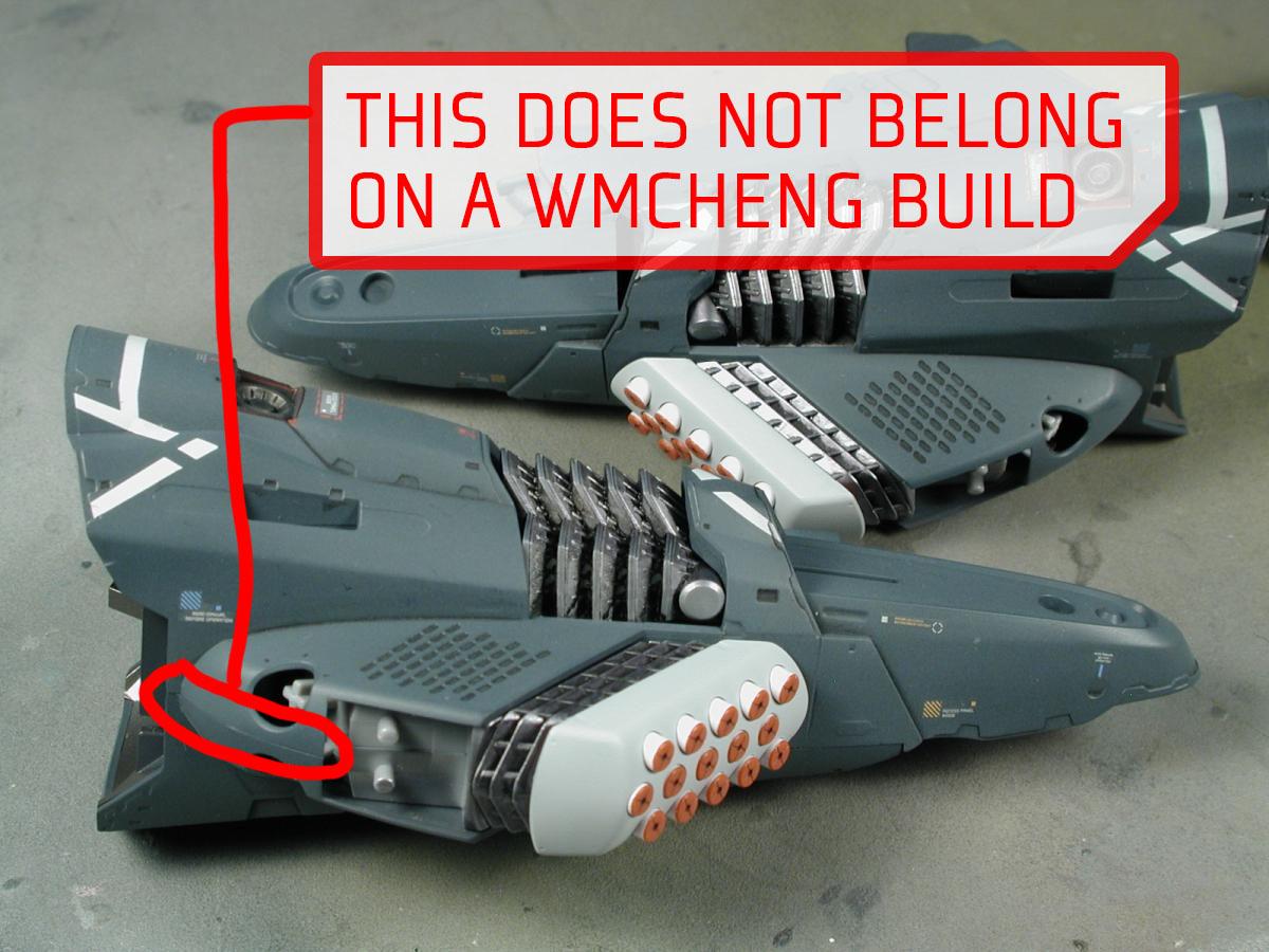

PetarB Posted February 24, 2013 Posted February 24, 2013 (edited) . . . Edited February 24, 2013 by PetarB
wm cheng Posted February 25, 2013 Posted February 25, 2013 HA! You caught me!! I was debating that seam for days!!! I was trying to weigh the seam against tremendous masking of all the metalized parts and the awkward masking of the rear plate which I wanted in metal, but had to be in as well as the fins before the two parts were glued together. Yes, I hate Bandai parts breakdown when you want to paint it. The other way was to assemble it to this point and spray the whole thing blue/grey, then mask out the blue/grey to spray all the metalized parts, but I couldn't get into all the fins and nooks and crannies properly from this angle. Argh, I loose either way. Unless I had tonnes of time and patience and majorly mask like crazy - I was in a rush and didn't known when I'll start work again.
PetarB Posted February 25, 2013 Posted February 25, 2013 Sorry I couldn't resist. But I take your point. This is the single reason I have not completed any of Bandai's kits on this subject. I can't live with the seams that comes from the engineering of the kit. Every so often, I open the box again, assemble a few more pieces, thinking I'm just going to do the basic Ozma. But then I remember the Hasegawa version of the same is imminent, and I sight with relief...
