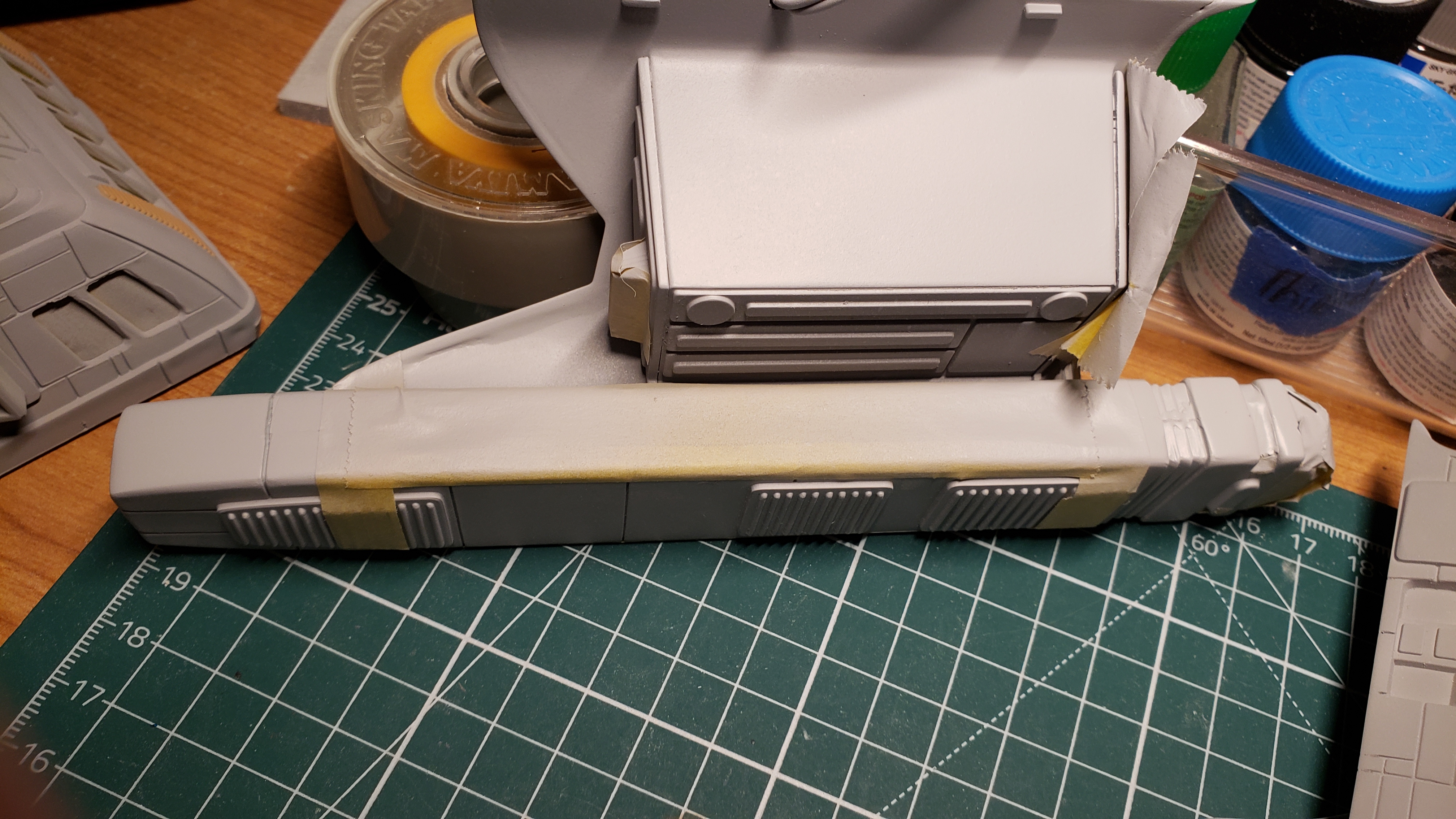

2 hours ago, Chronocidal said:

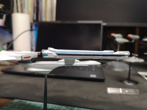

Speaking of the E, boy I wish someone would tackle that ship with a new mold.  The Polar Lights 1/1000 kits are just so much better than the old AMT/ERTL molds.
I'm messing with that same kit right now, and the plastic just has this mushy, gummy look and feel to it.  Molding is all soft, and despite the white stress marks I'm making all over the pylons, I cannot for the life of me get these nacelles aligned.  They sit evenly for a couple hours, but the plastic just slowly drifts back into the default cockeyed position.
Far as assembly goes, I'm considering clipping off the assembly tabs, and detailing the saucer, hull, and nacelles separately.  I'm almost considering doing the aztec pattern using pencils like I remember seeing someone (I think it was derex?) use on one of the 2009 Trek kits, but the tiny patchwork of panels on this particular ship is just a load of chaotic nonsense. :p

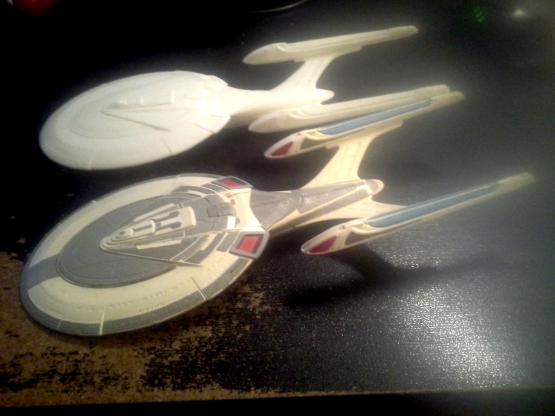

Found the box with my older version of this kit.. same nacelle alignment issues, but the saucer fit seems better somehow?  Maybe the paint helped it.  I think I sprayed the whole thing with a white rattle can in the mid 90s, before brushing the details on, with what I felt were pretty acceptable results for the time.
Oh man, I remember brush painting the details on my old Refits back in the 80s and 90s.....except I didn't even lay down a base coat with rattle can, just brushed straight into the plastic because it was molded in color!

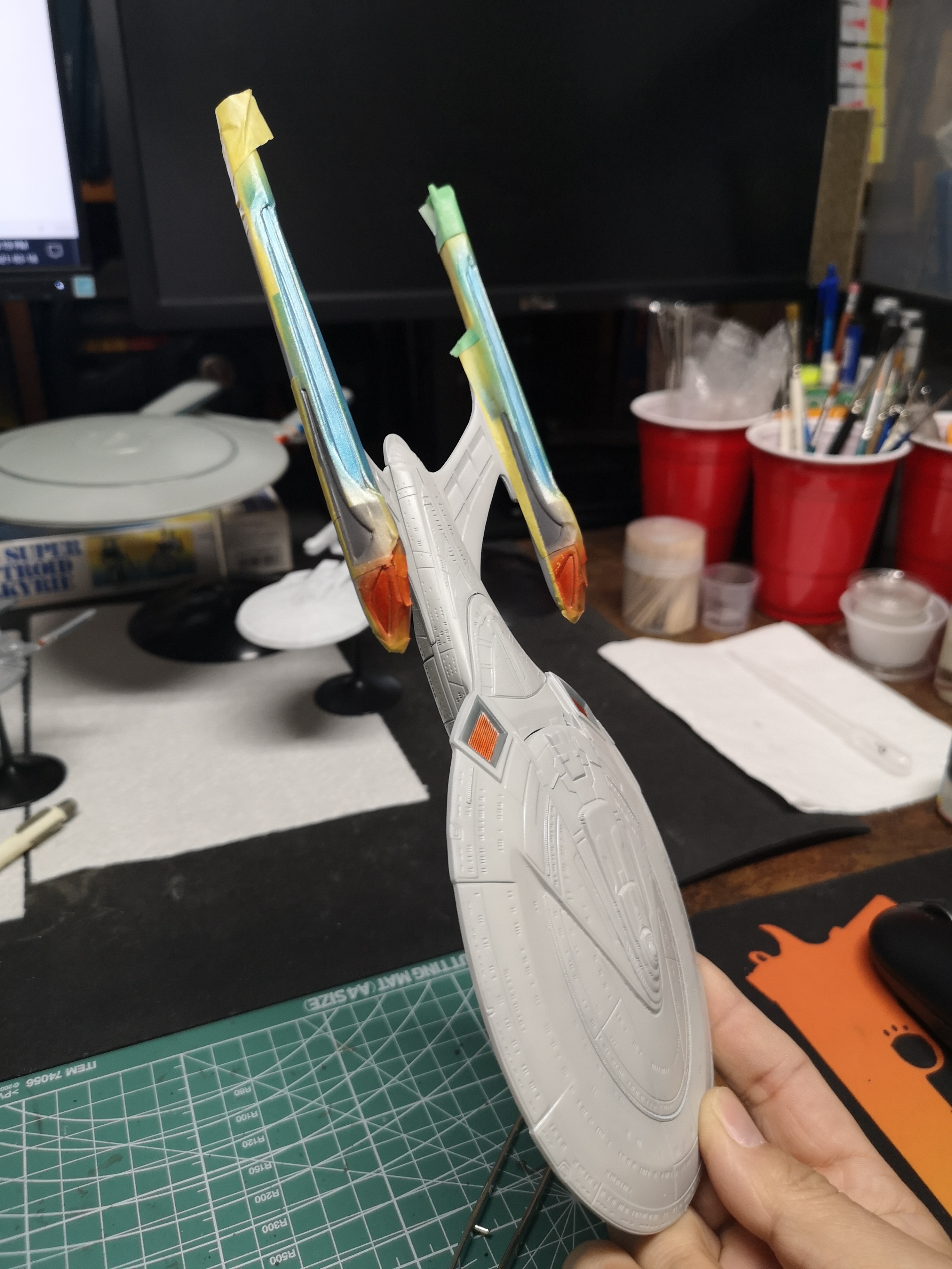

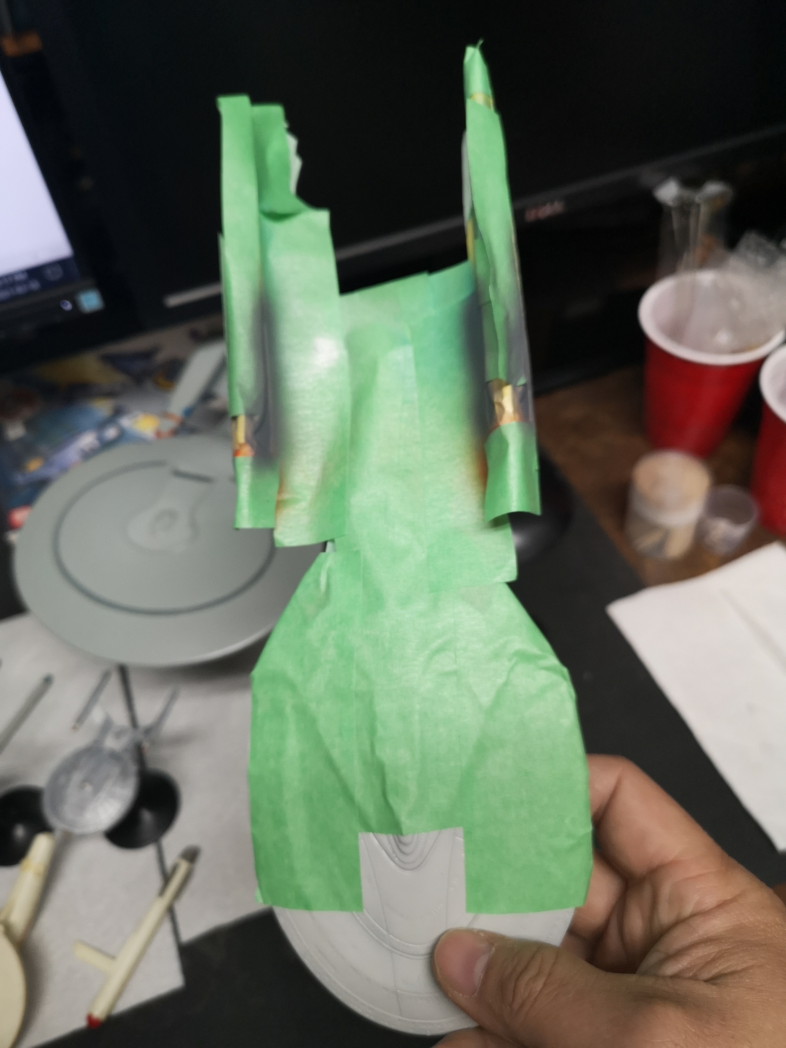

@peter - free bit of advice...if you have any red left, mask off and airbrush the red front bussard collectors on the E. The red decals suck for those. I wish I had done it. I airbrushed the saucer impulse engines red which looked great and I wished my red on the nacelles would have been the same. Just my .02.

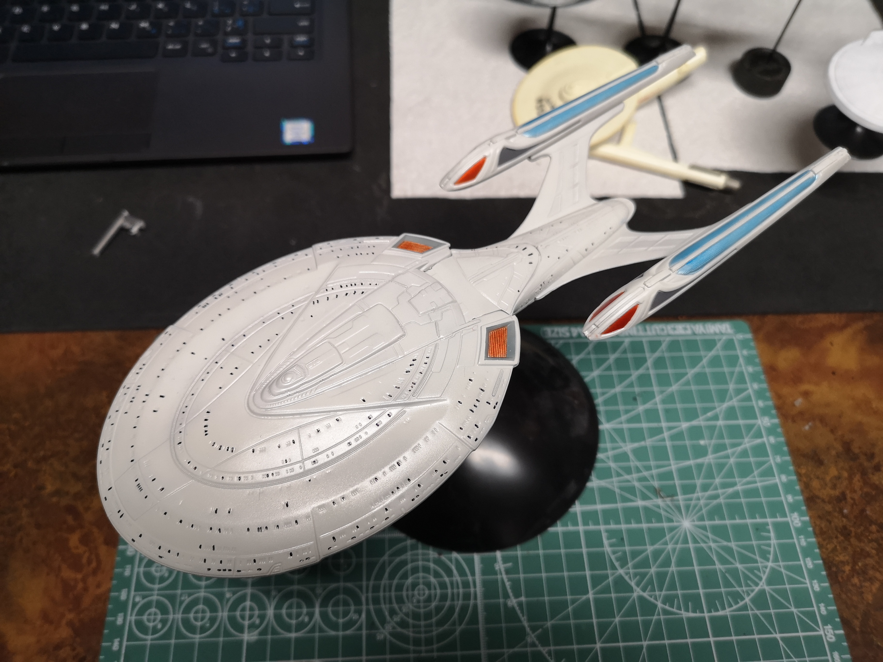

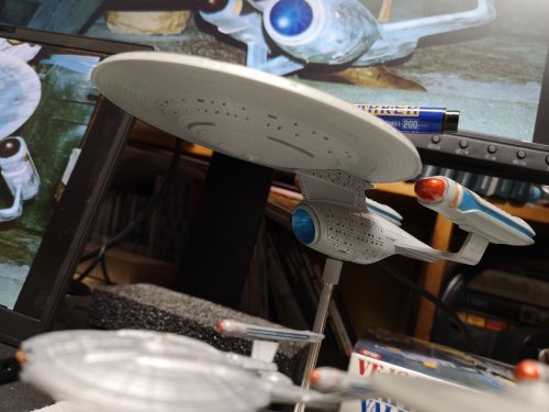

Ok, followed your advice, managed to squeeze a bit more life out of my clear red.
It's not perfect, but I agree, it looks better than the decal.

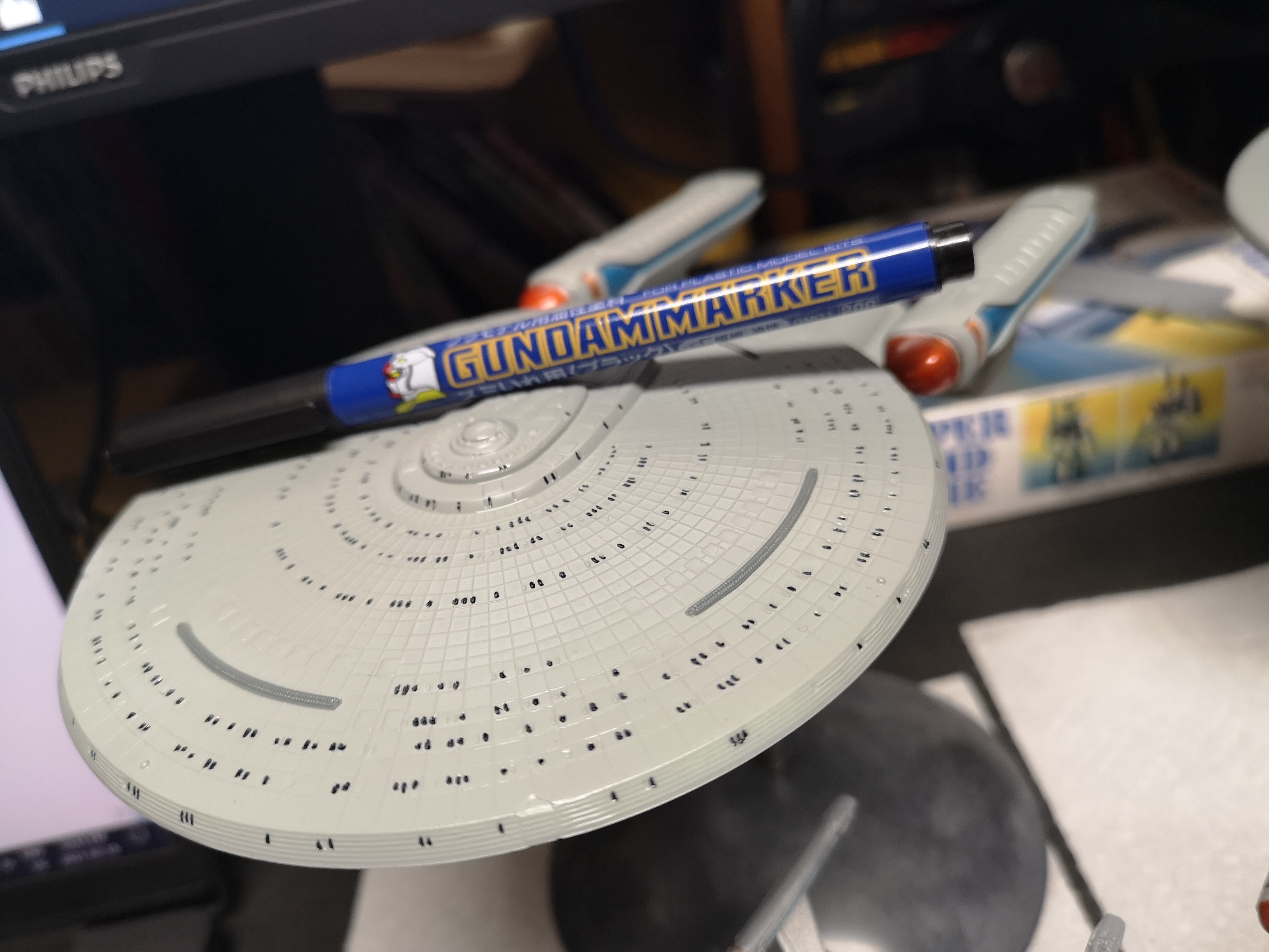

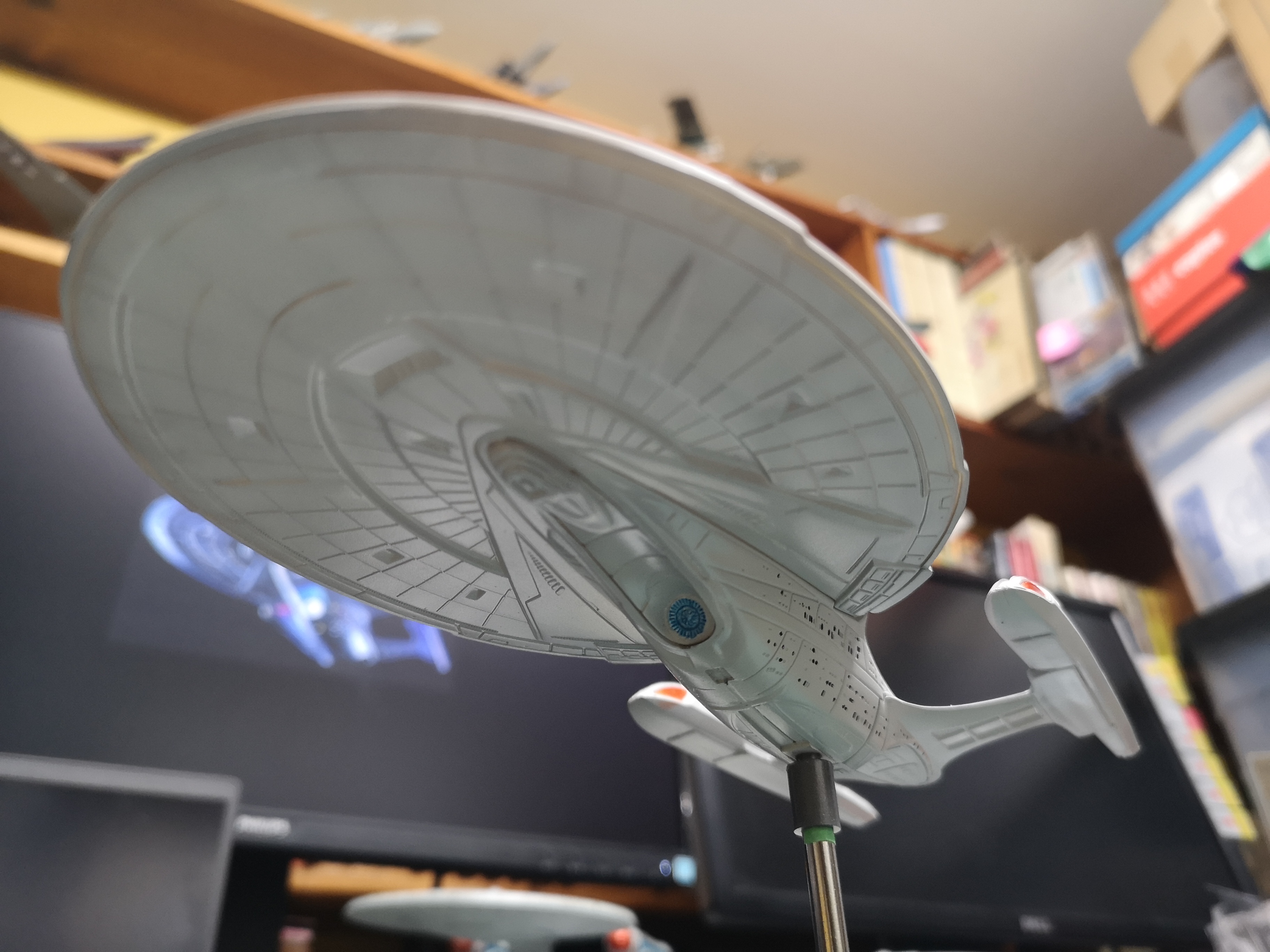

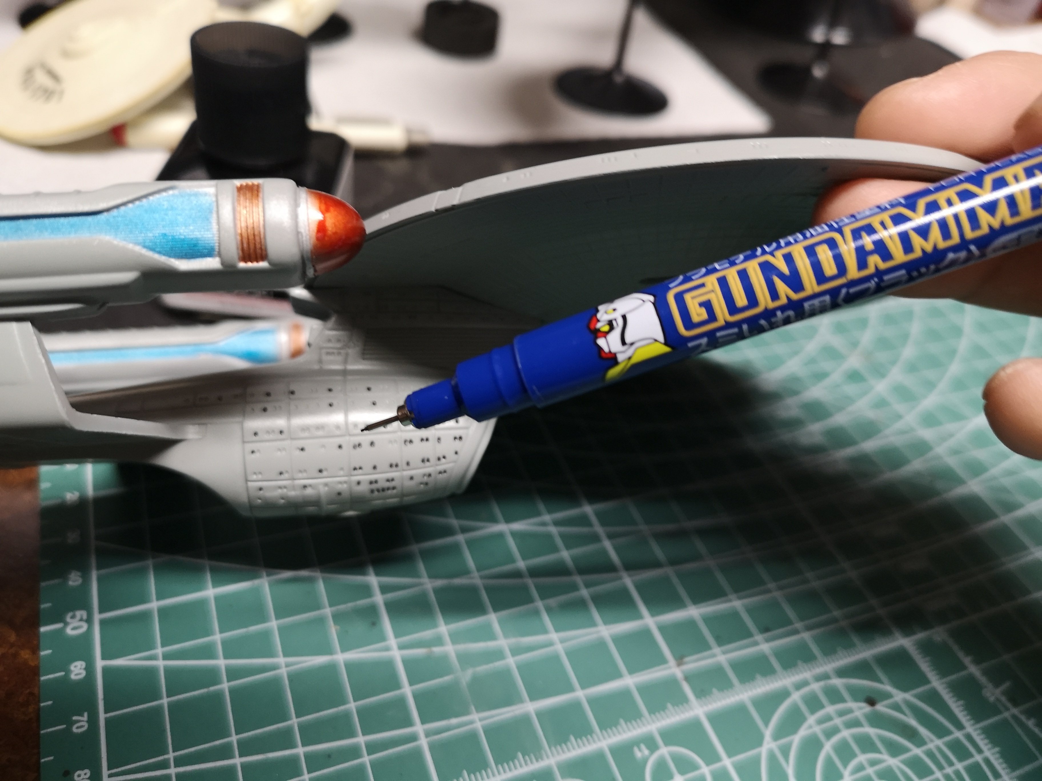

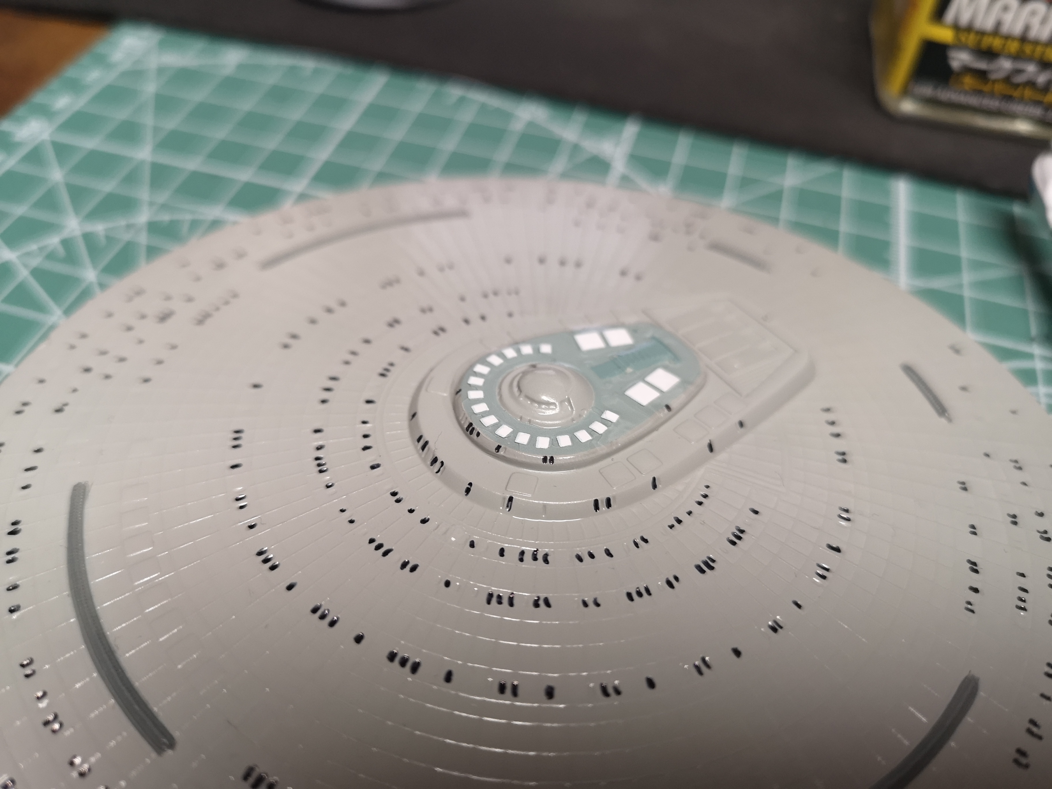

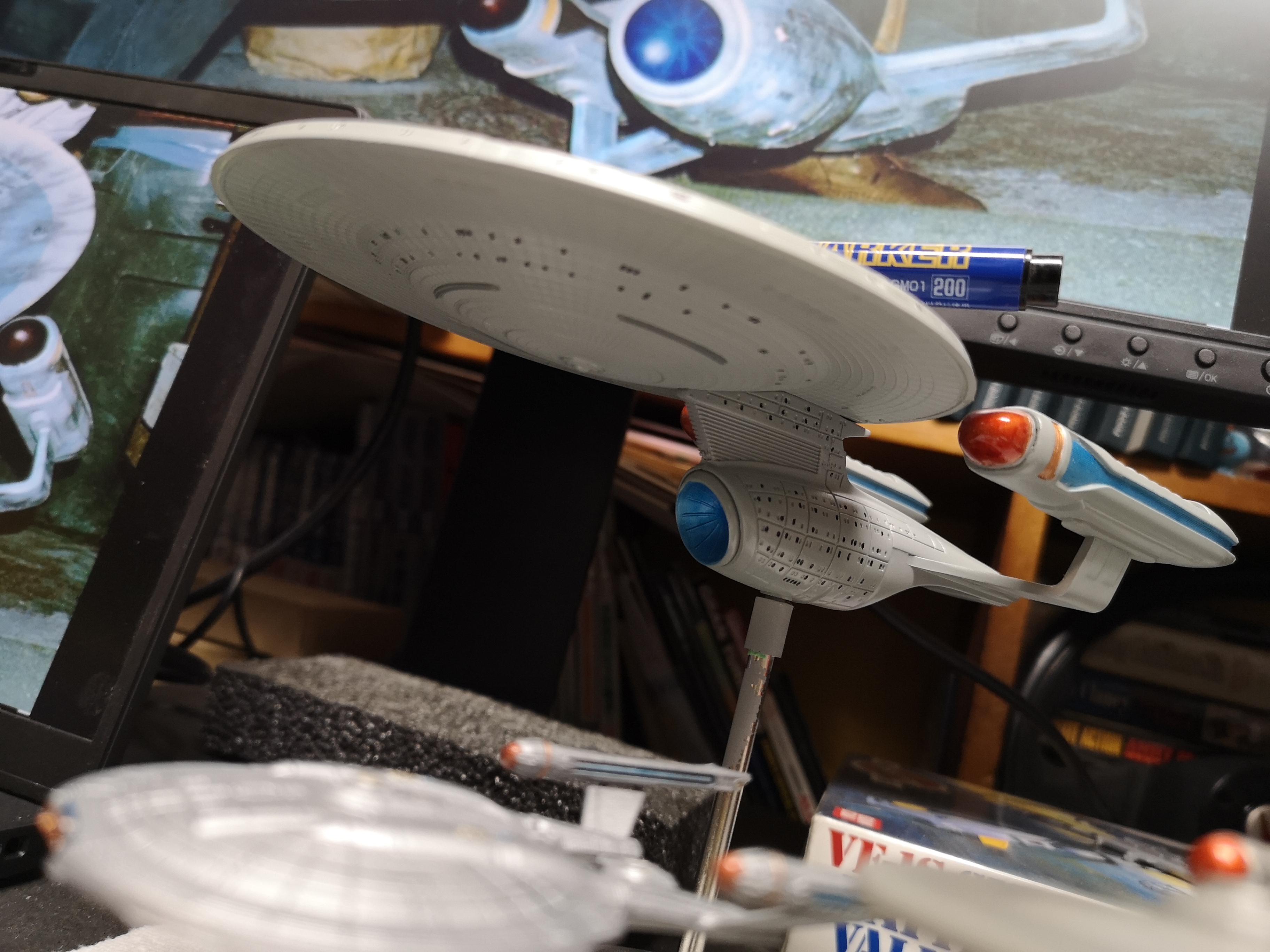

Small update, I didn't have time to get started on the decals, but I read somewhere that it was suggested to do the windows before the decals so I figured I would give it a shot.
I considered using Tamiya panel liner, but gave the Gundam marker a shot.
Cleaned up any major blemishes but if you don't zoom in it looks ok.  Except I may have turned off too many lights on the Ent C

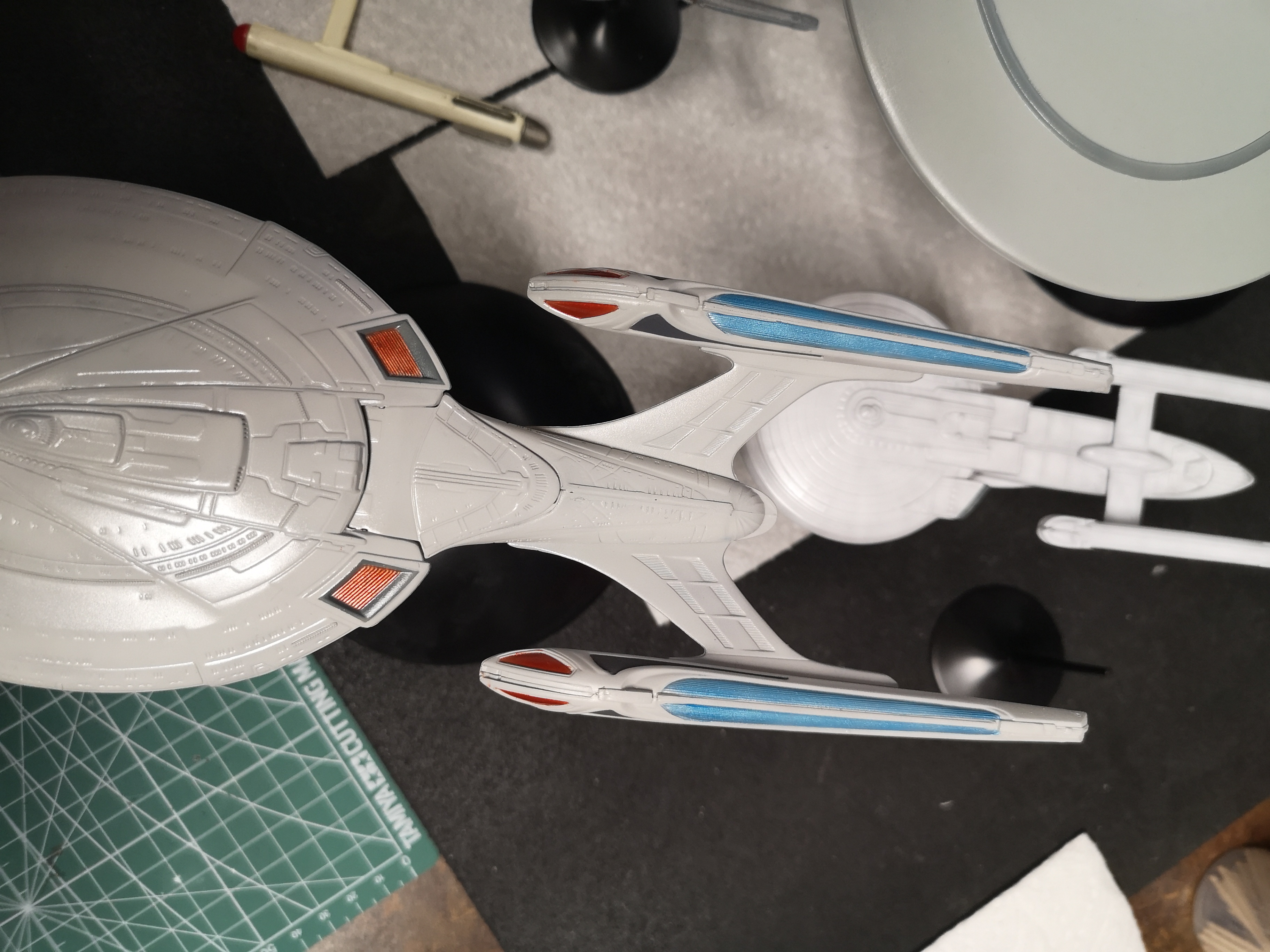

The Ent E felt like it had smaller windows, and they weren't as well defined as the windows on the C.
I know, the deflector is supposed to be yellow, but I'm going with an earlier production design where it was originally supposed to be blue.IMG_20210319_014226.thumb.jpg.c93e303ce17d1521a64d2bfce0d2a946.jpg
I may try to get to the decals tomorrow, but I might do a once over to see if there is anything else I should paint that he decals don't cover.

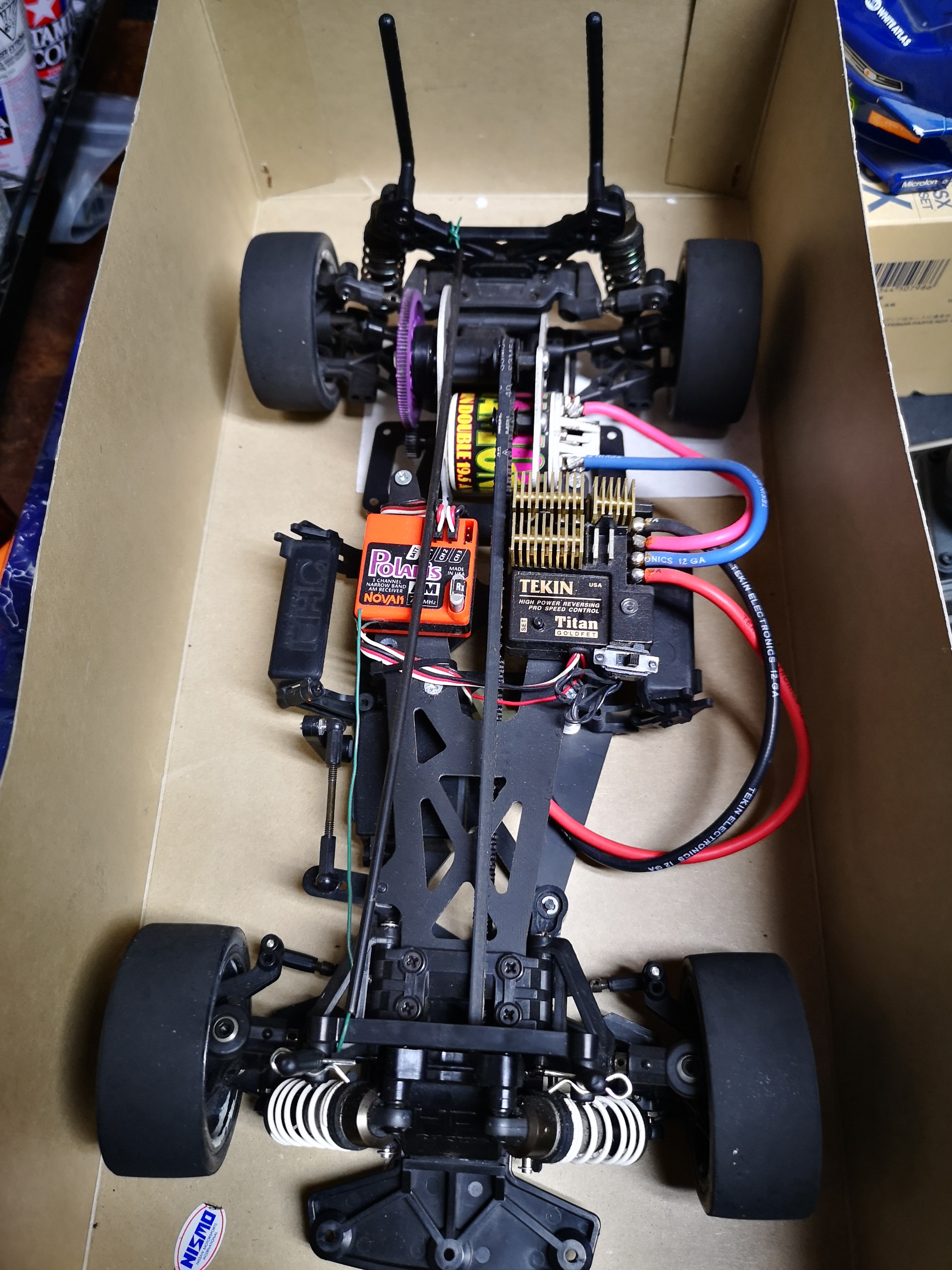

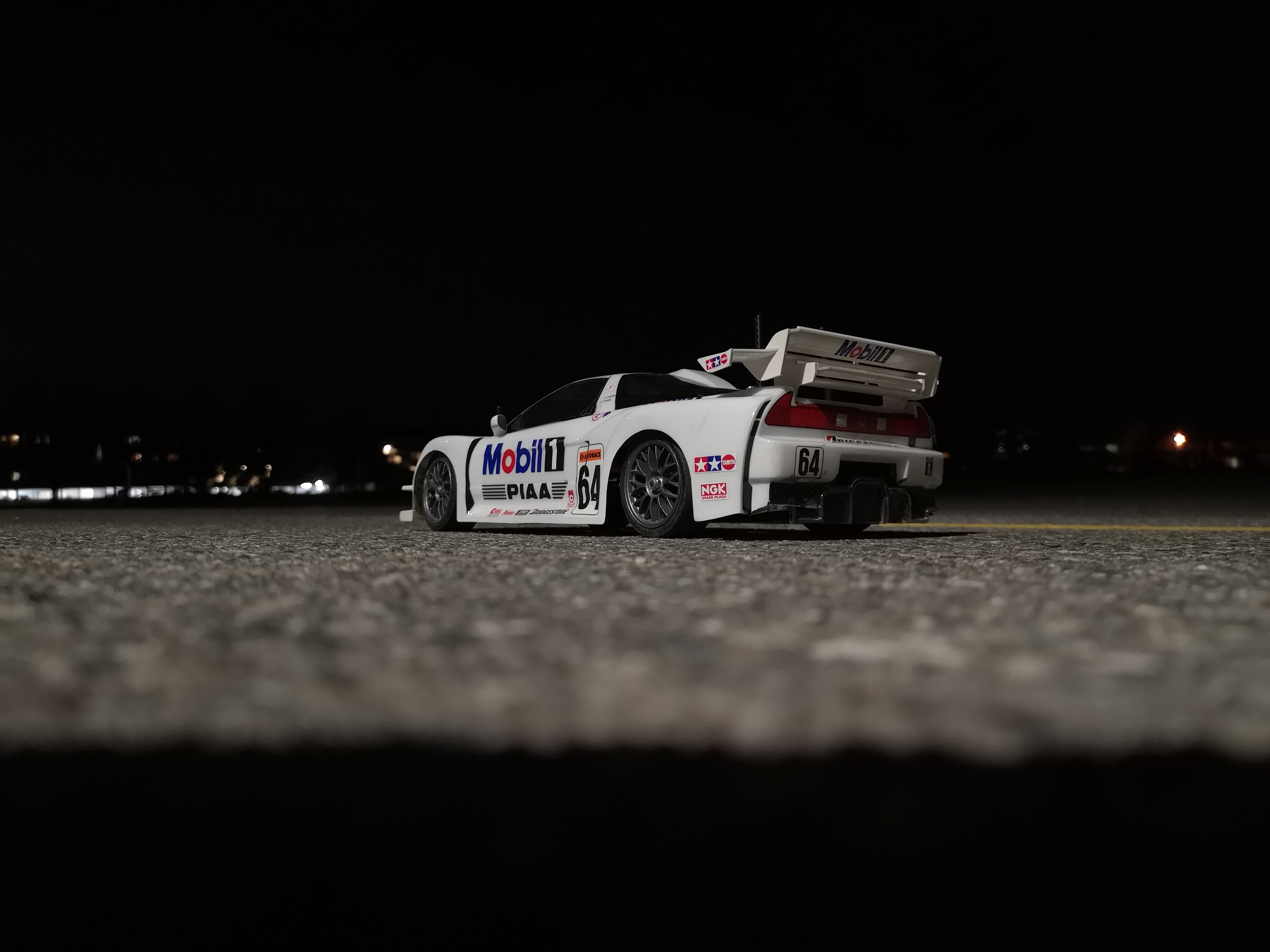

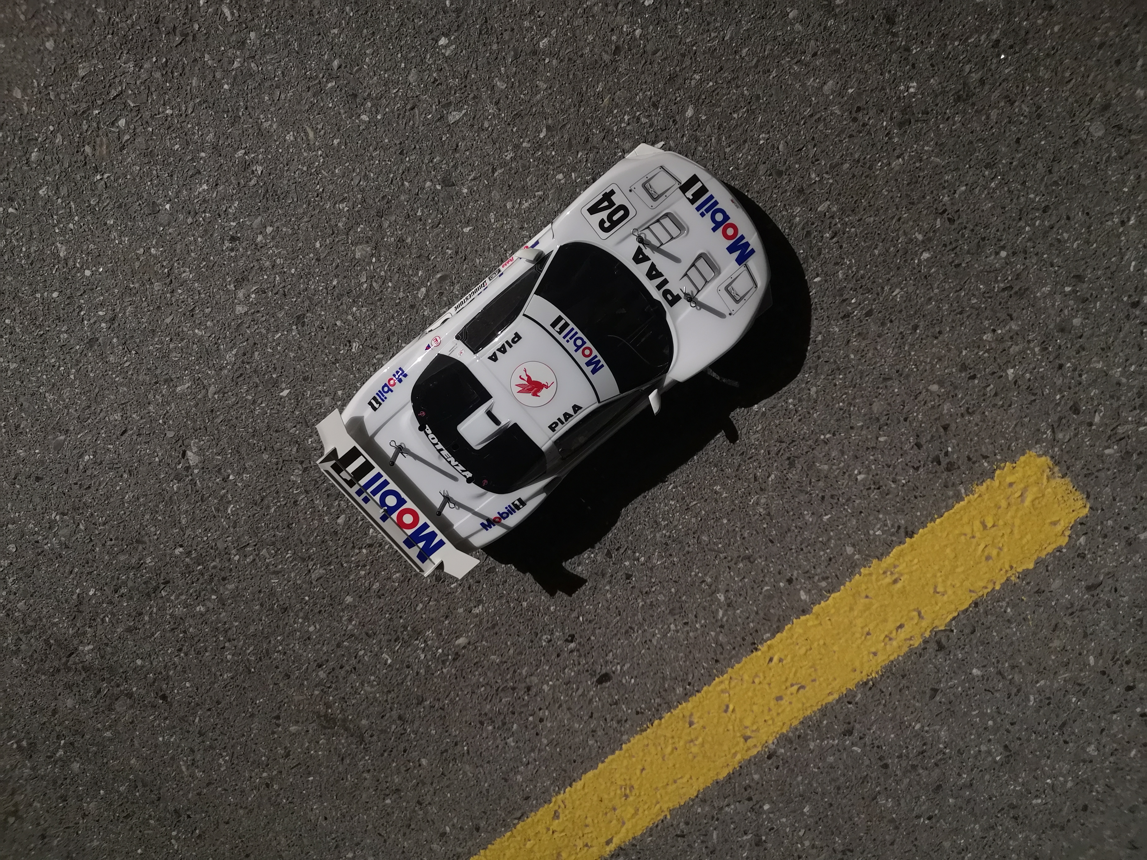

I know nothing of RC cars, but I got this from a buddy ages ago.  Played with it for a bit, then the remote died and the car sat on a shelf for more than 20 years.  Just dug it out the other day, got a new remote and fresh batteries and took it for a spin, forgot how fun they can be :)
IMG_20210312_193202.thumb.jpg.0edb314e2238c2485aedd6912e8cd1cb.jpgIMG_20210312_193141.thumb.jpg.074025041a7d7a39b81e7816ea1d0506.jpg
Oooh Nice! What kind of chassis is that? Looks like one of those fancy TT-02 custom chassis with cambelt transmission for 4WD.

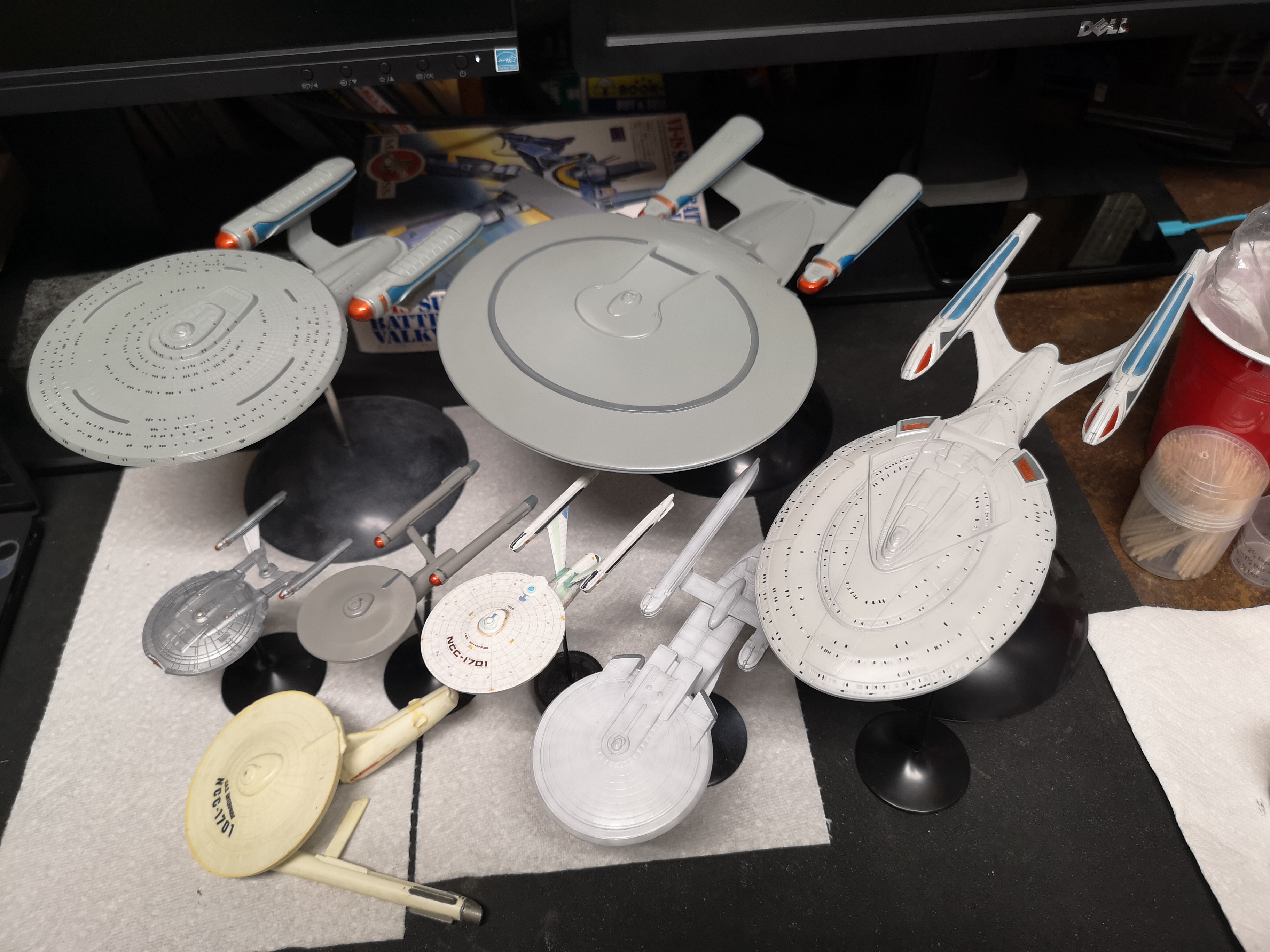

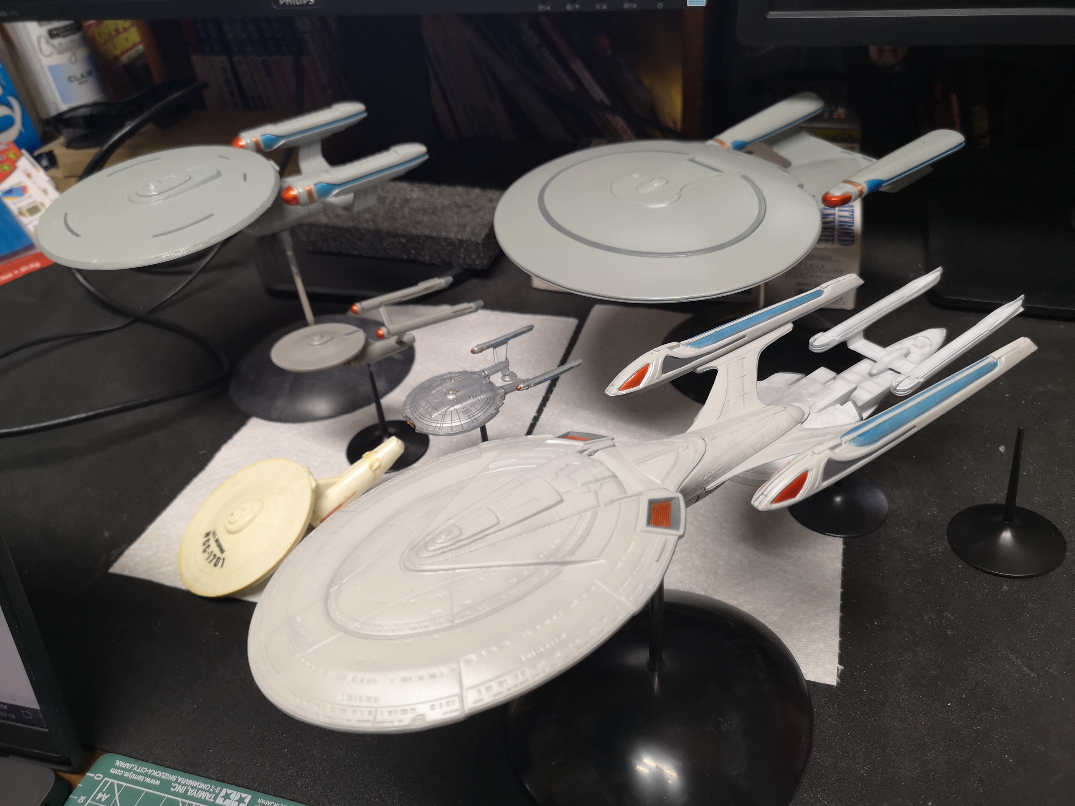

Some more time traveling today:
The set of 7 Enterprises becomes a sadistic mission to finish them at some point no matter what....you HAVE to keep going, because you keep thinking to yourself, man, this is gonna be SOOOO cool if I can only make them look half way decent! They are a bit of a rabbit hole to go down.
All looking really good, and actually the blue deflector is more accurate for that rounded alley.  I believe the color changed when they redesigned that area to make the full-scale set for First Contact easier to manage.

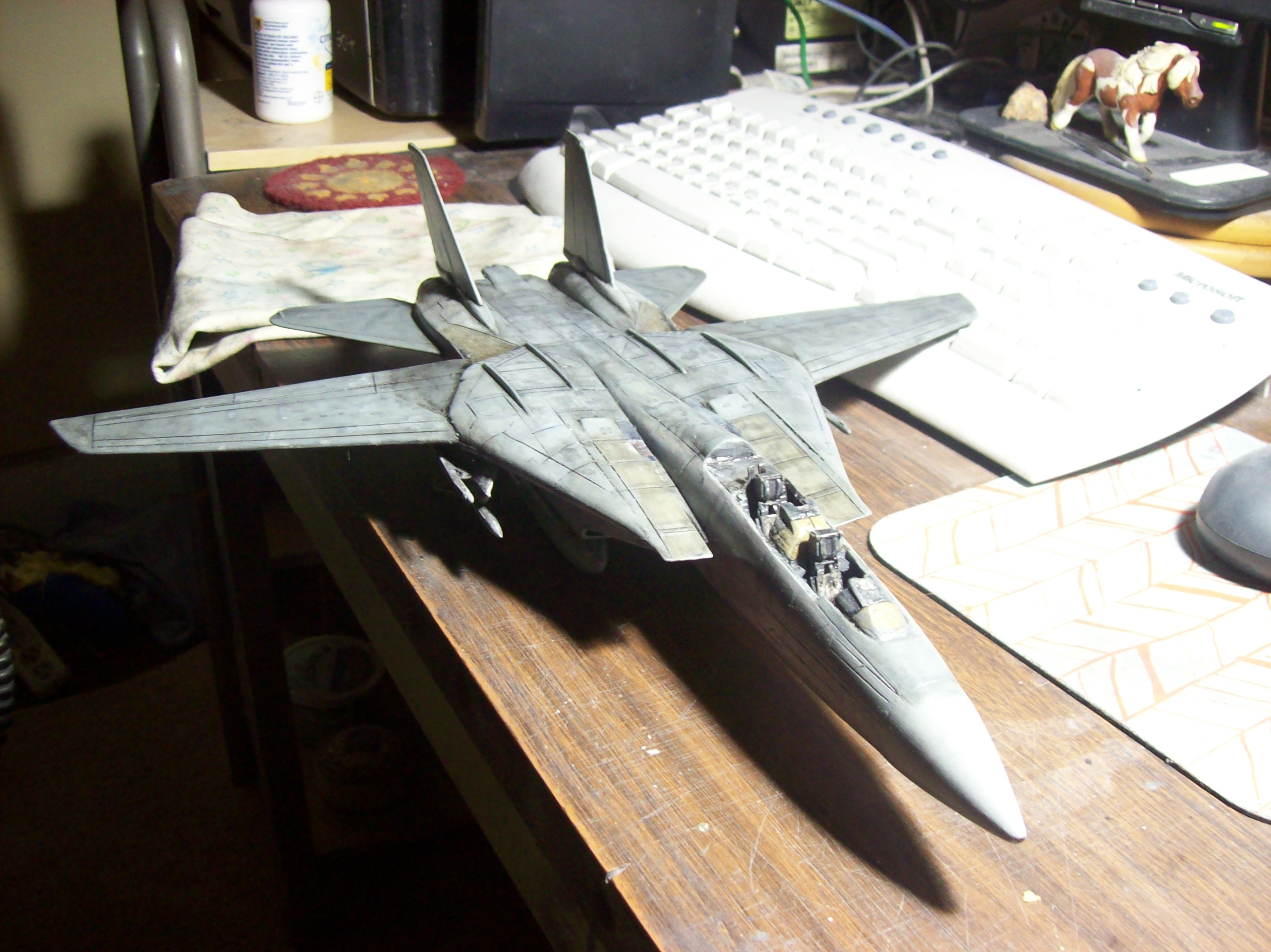

Some more work:
Finally beginning to resemble something other than a turd with wings....

Looking good!!
Haha, actually, I know nothing of RC cars, someone gave this to me a long time ago, but it is fun to play with :)
That looks good.  Hope to build a Valkyrie that looks that good.
New to airbrushes so precious Valks were built with rattle cans only, no shading.

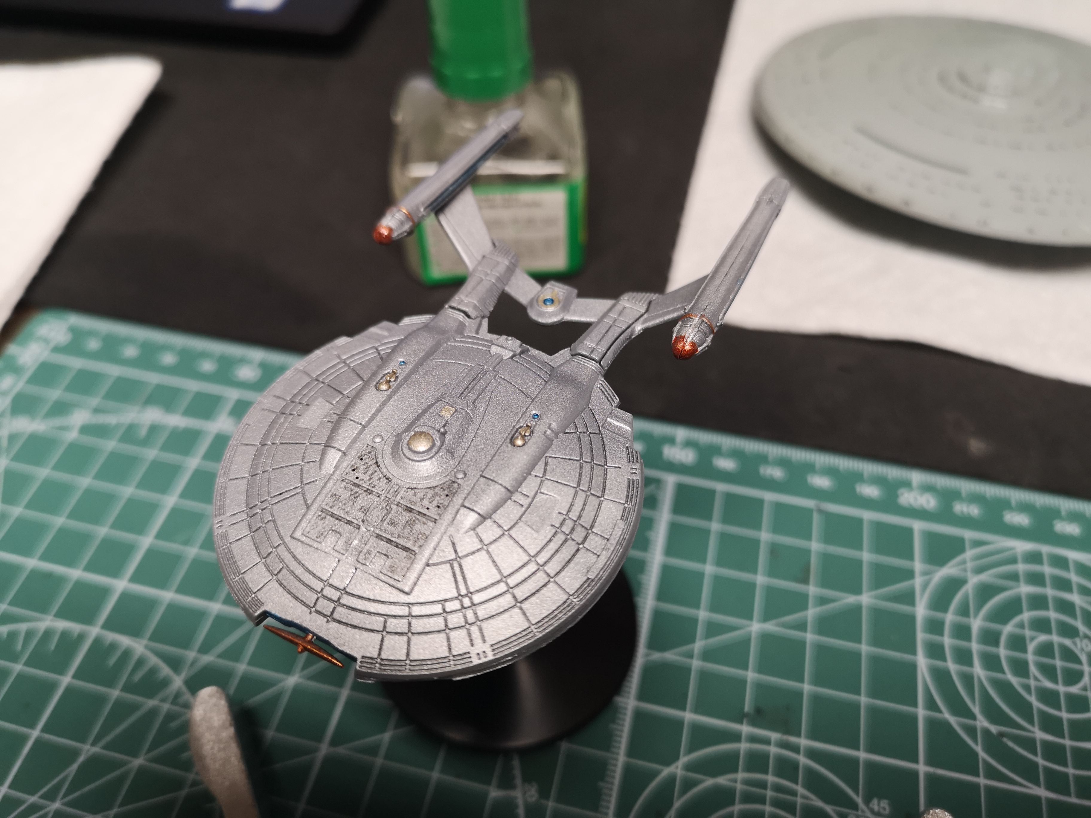

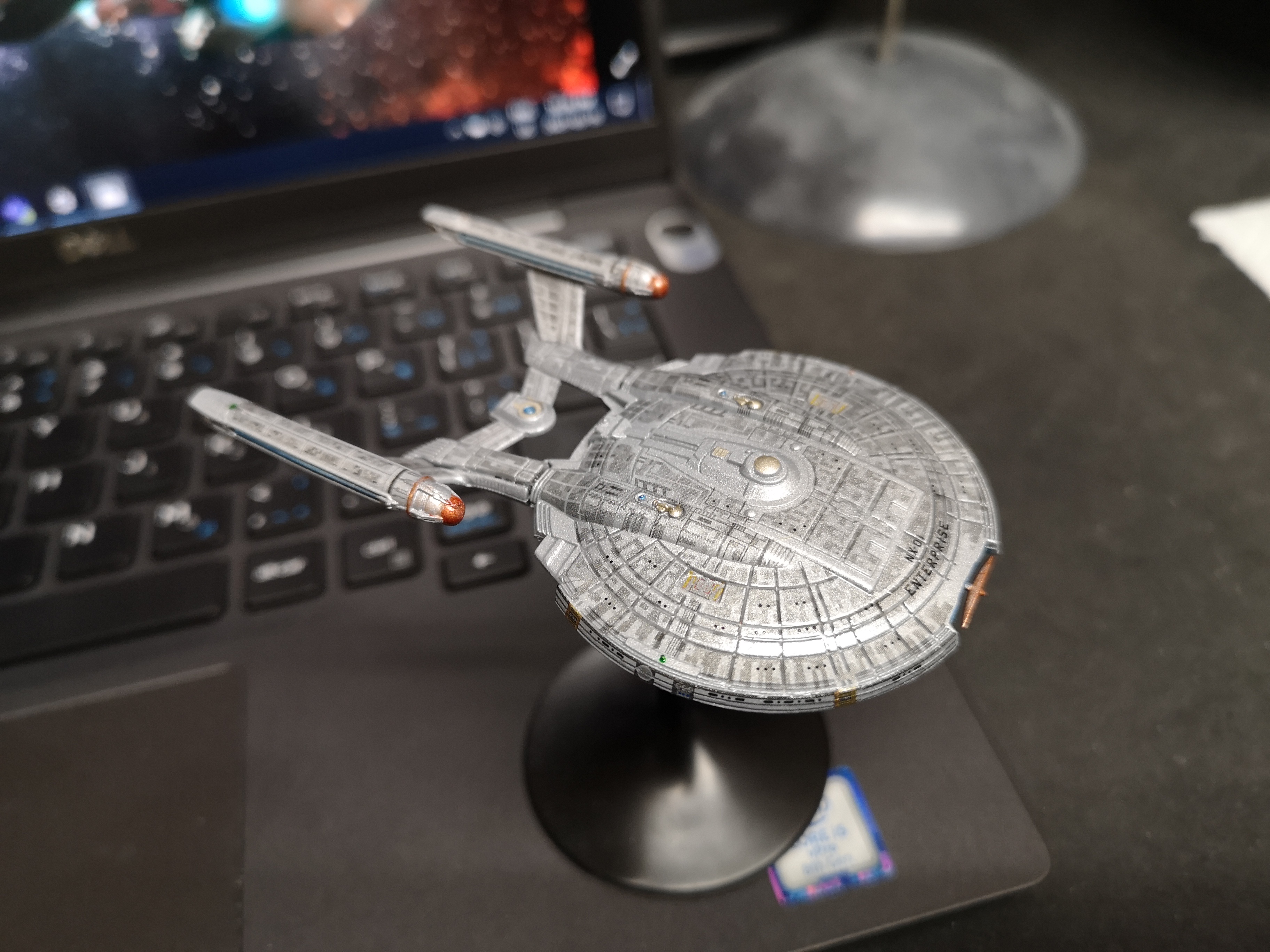

Lol, it is a bit sadistic isn't it?  IMG_20210319_114846.thumb.jpg.64578f750191608e606d047b701f035d.jpg
First decal down.
They seem more sturdy that the crappy ones that came with the Cadet Motion Picture series, but they are still prone to fragmenting if the water is too cold, or if I muck around with them too much.

That NX-01 is turning out quite nice.  I'm envious that you can add it to your bookshelf!

Yeah, unfortunately, all of the panel lines got filled in again and the paint began cracking and separating. So...back to the stripping tank it goes.
meantime, I'm going to be working on something a bit less stressful...
...the 1/537 REFIT.

Haha, the NX has been the most cooperative so far.
The Ent B nacelle decals are the worst.
Will post pics of the mess later sometime.

All we see are the end(ing) results, and it is looking good. Nice save by the Wifey!

Well, right now, it's in prep to be stripped (again), after an issue with the paint. Starting to wish it were a Tamiya kit instead of this mess.

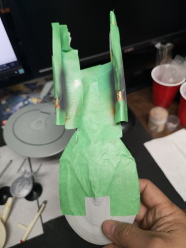

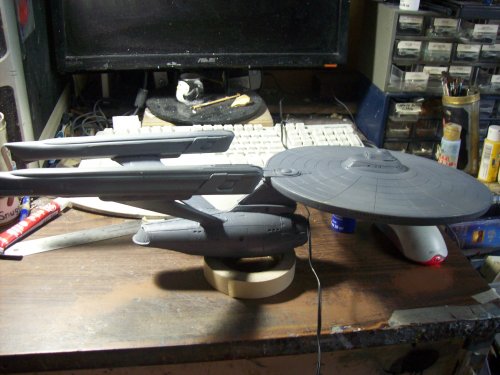

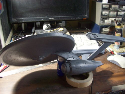

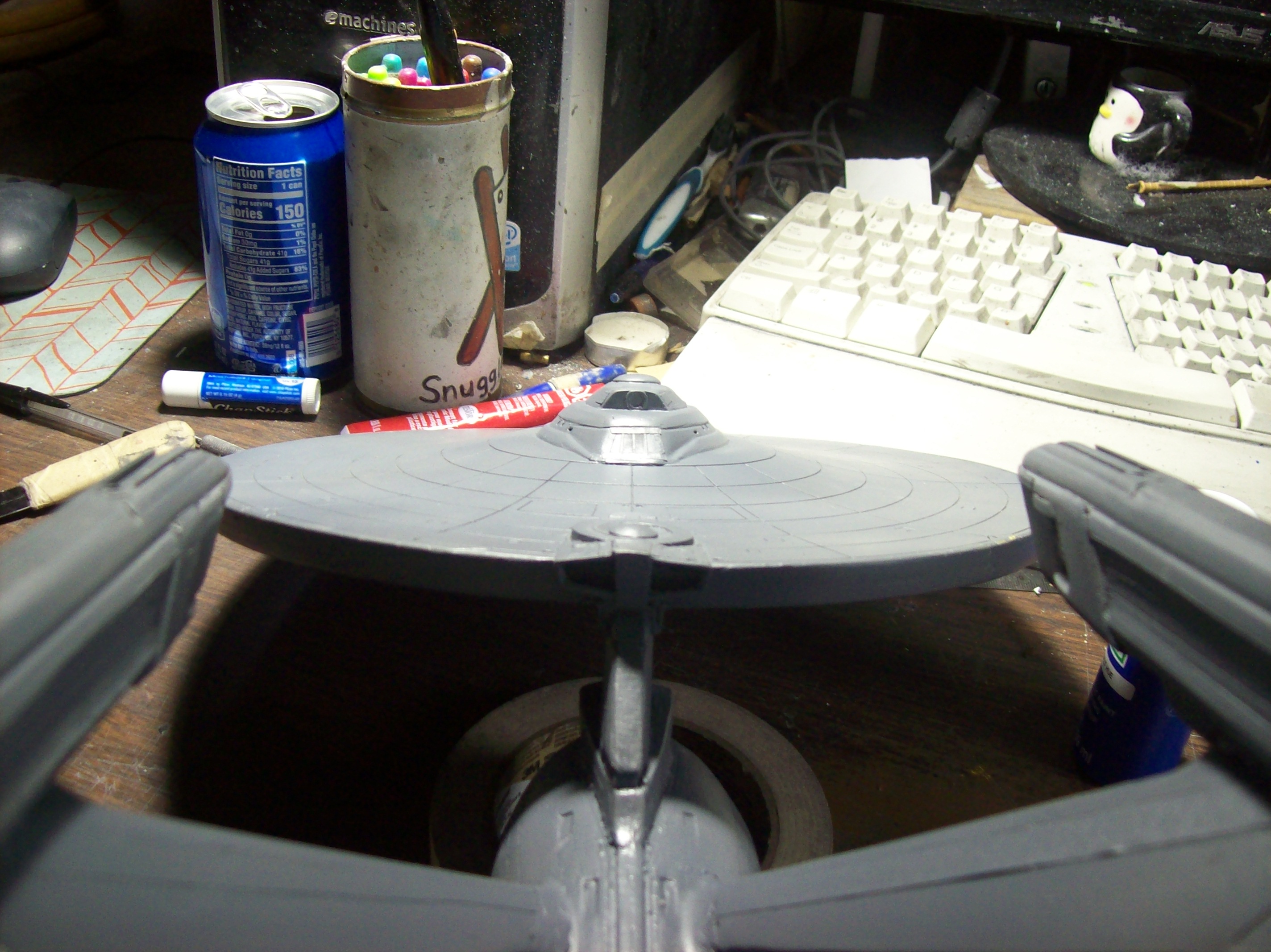

Okay... finally got the warp nacelles reattached, and the ship is together again for the first time in roughly 3-4 years (give or take a decade):
1606896041_100_00121.thumb.JPG.cd8b453ac8c3fe55ab2566e6105b4558.JPG567366709_100_00131.thumb.JPG.f991298354fd0670594bb7cd1c63356f.JPG
After all the work that has been done, the warp nacelles are still uneven and misaligned, the details are a bit crude (still needs phaser banks for one!) and I have no decals for this thing. Regardless, I'm continuing on and will take this at least until I get to the decalling stage. Enough work has been put into this since 2011, and I'd like to call it done. But when you have a PITA Tomcat that needs stripping yet again, suddenly it doesn't seem like so much of a task to reassemble a decade old "problem project".
Stay tuned...

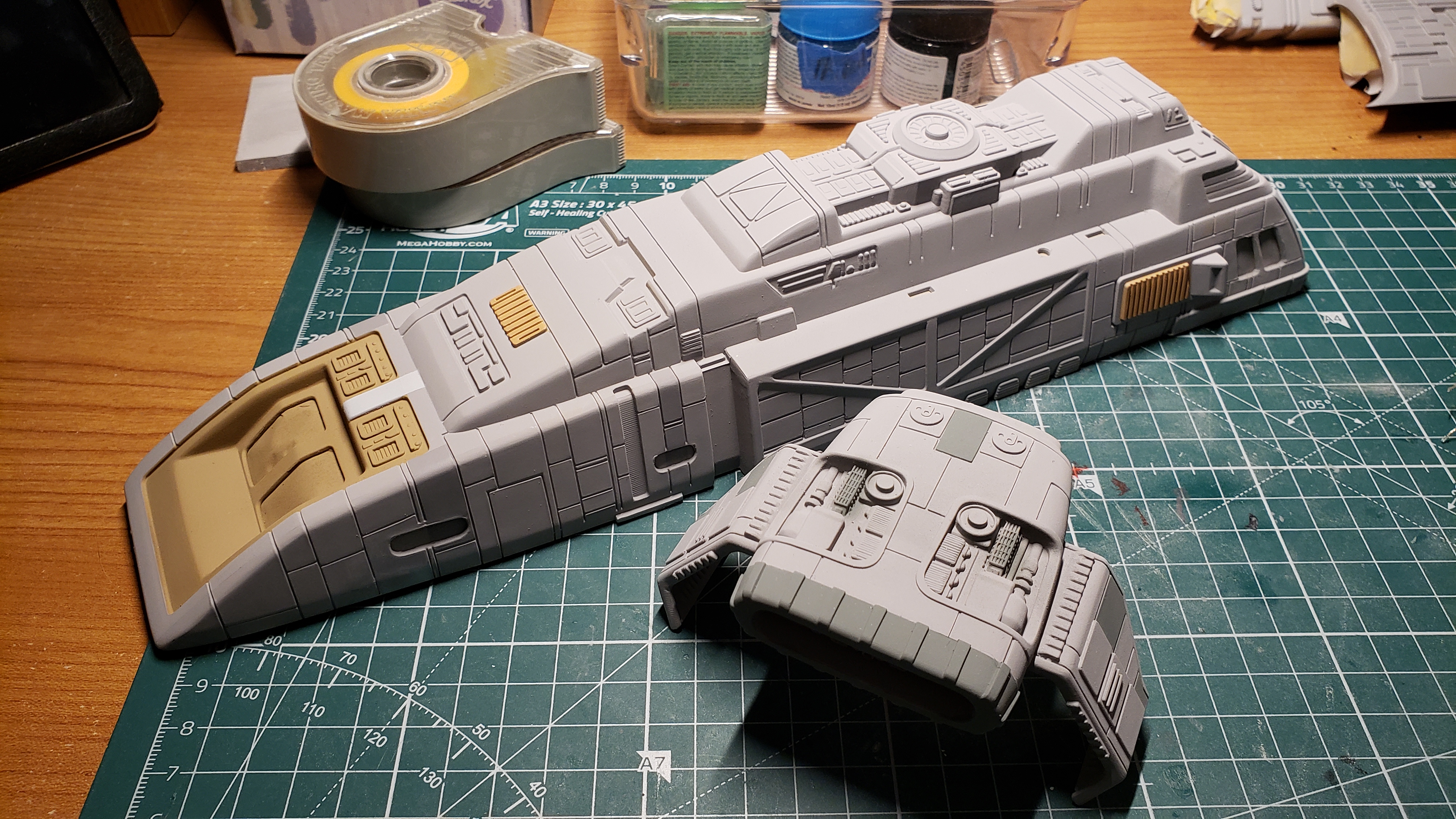

Some actual painting has been done! and seams are sloooowly going away.... uhhhgggg...
Coming along great. Some nice color and tones.

We have faith in the 'buzz! The good news is it's harder to tell any miss-alignments unless you're really eye-balling it

Runabout is looking good, might have to get one of those some day.

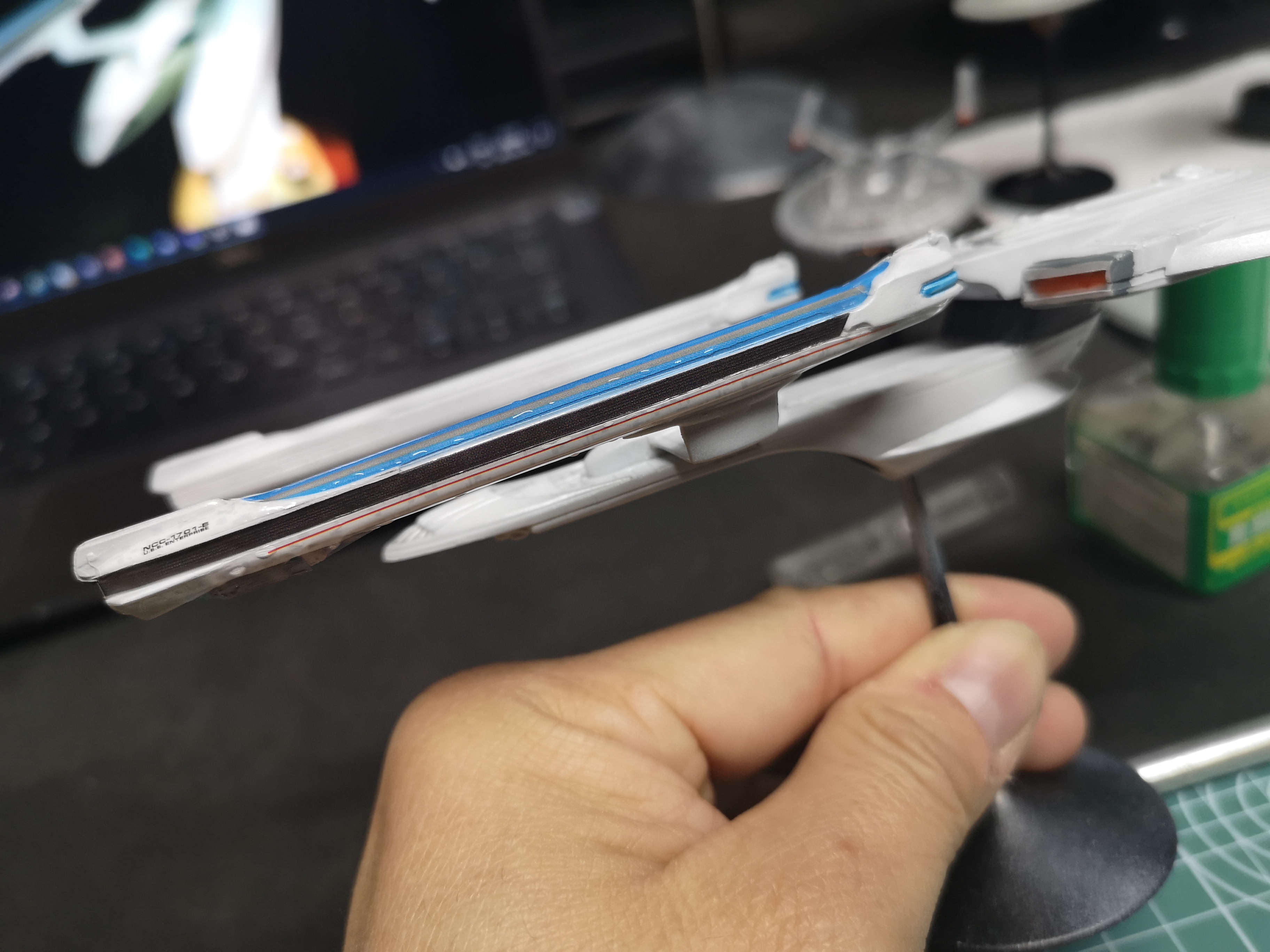

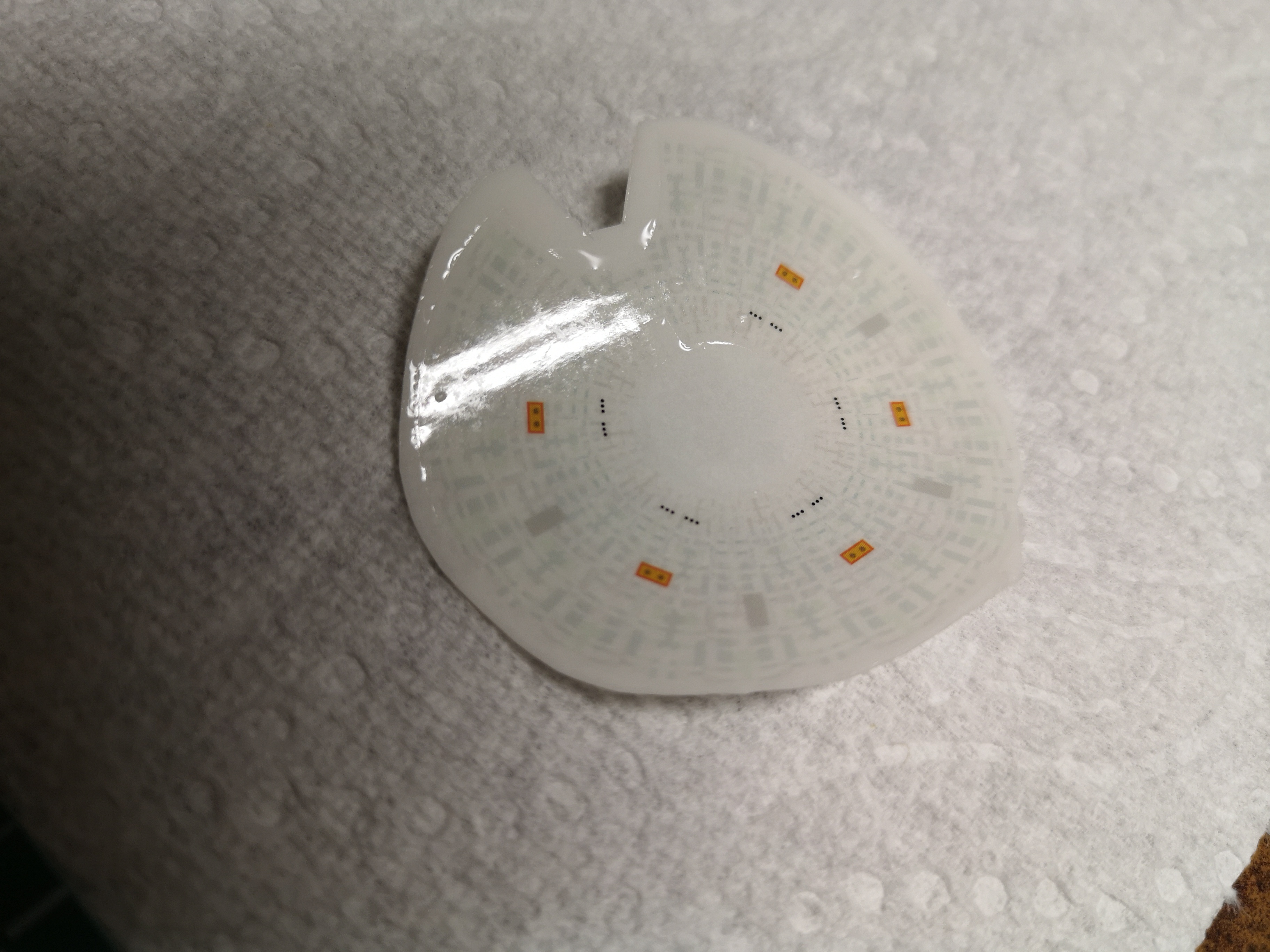

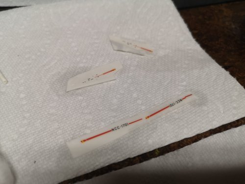

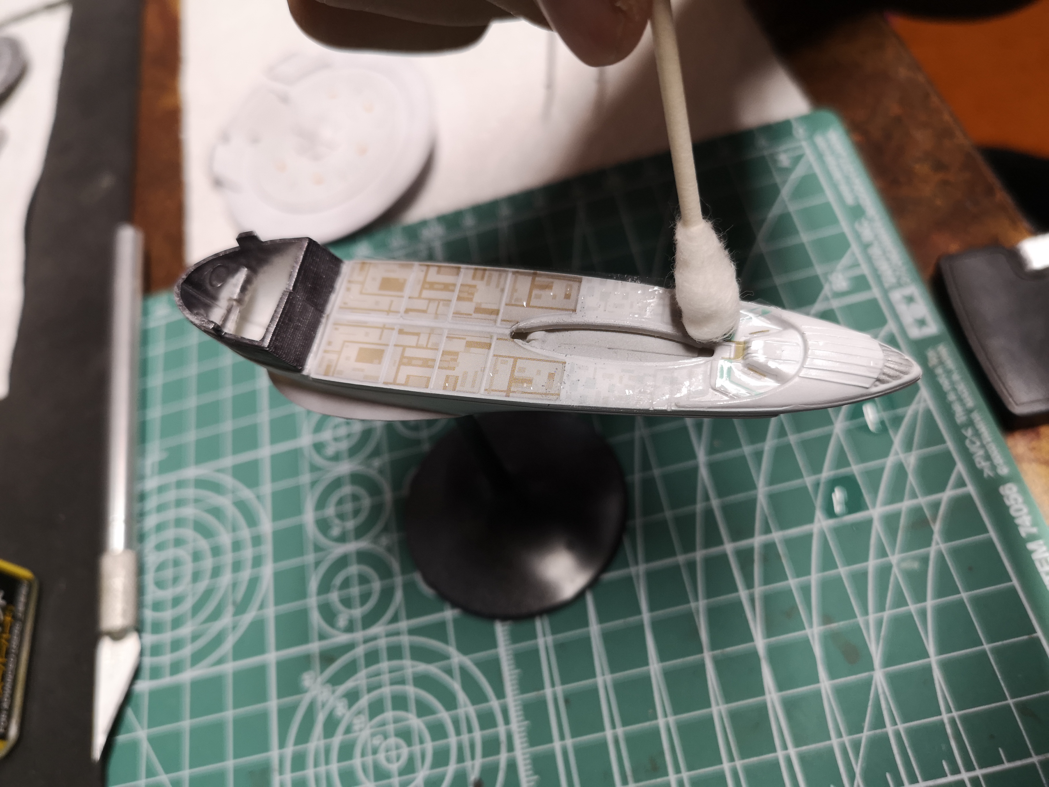

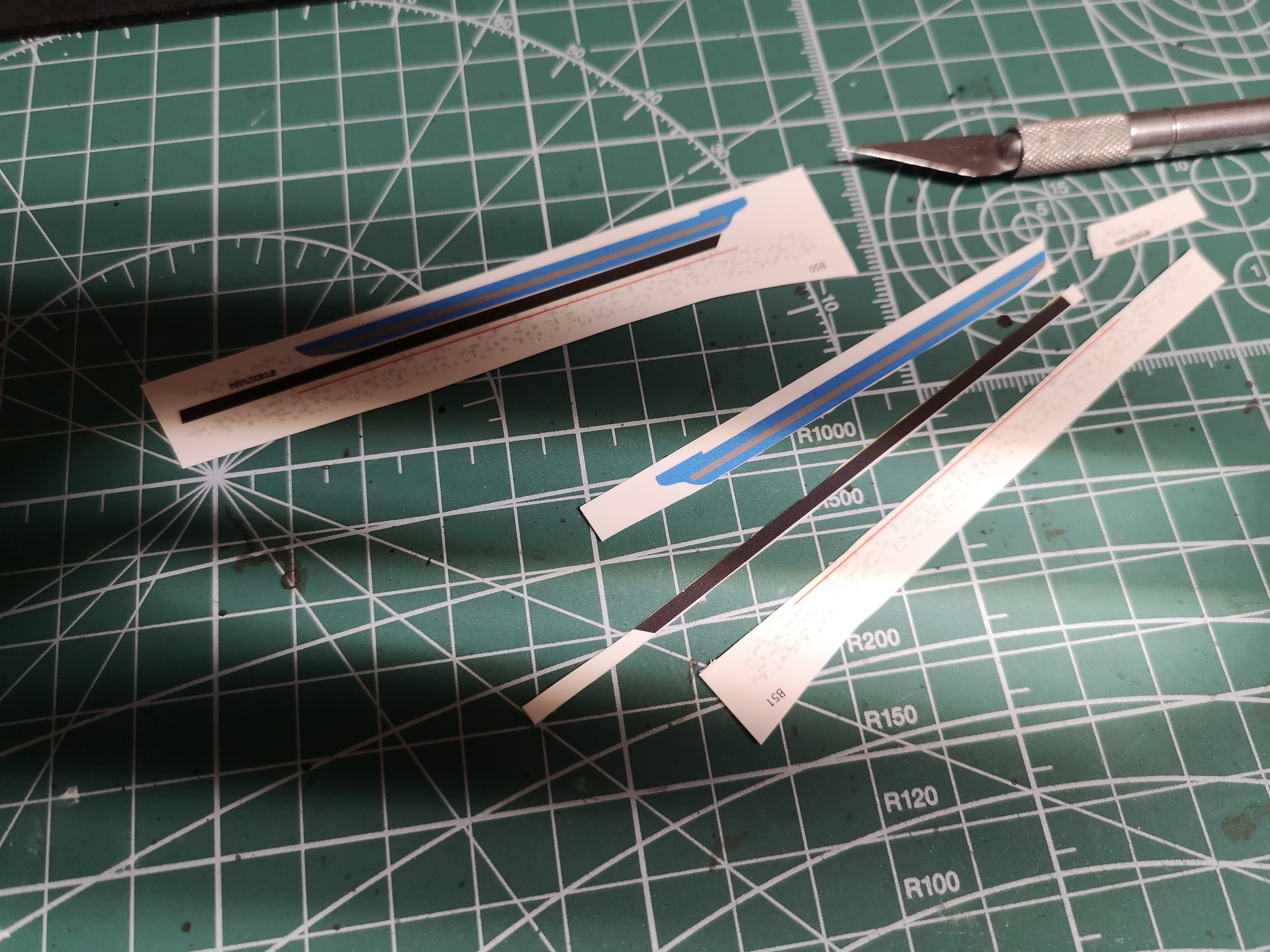

Decal update.
Ent B nacelle wrap around decal does not like to wrap.  Best to cut it I to 4 parts, the blue bits, the grey bits,, the Aztec bits and the registry.
I got stupid and decided to see if it could go on as one piece:IMG_20210319_171744.thumb.jpg.ddac945d3fae019019186c880bef5f32.jpg
And totally mangled it.
Cut it like this, and it will make it a bit easier, but if I had to build another 2500 Ent B, I'm mask and paint the blue and gray bits.

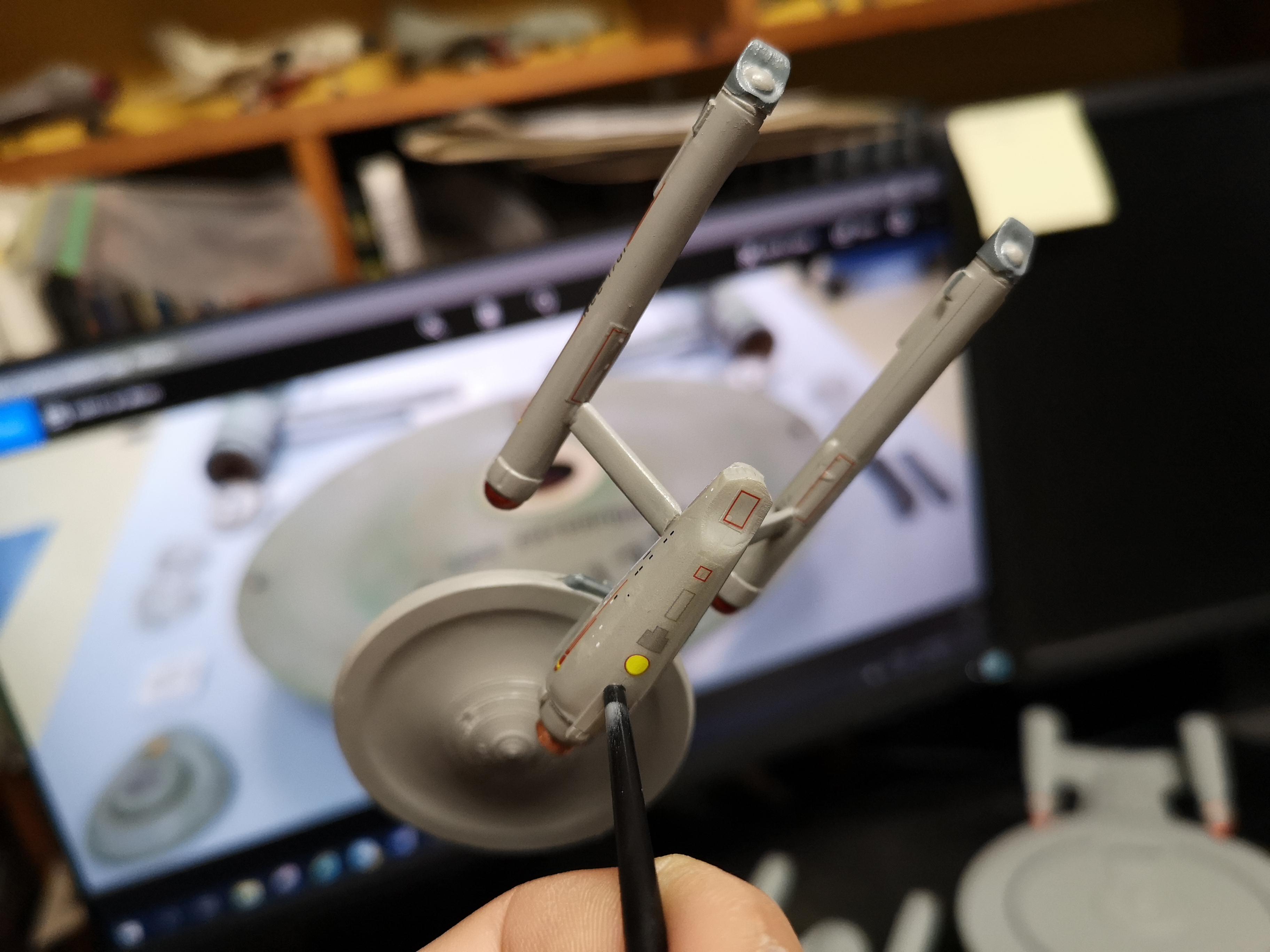

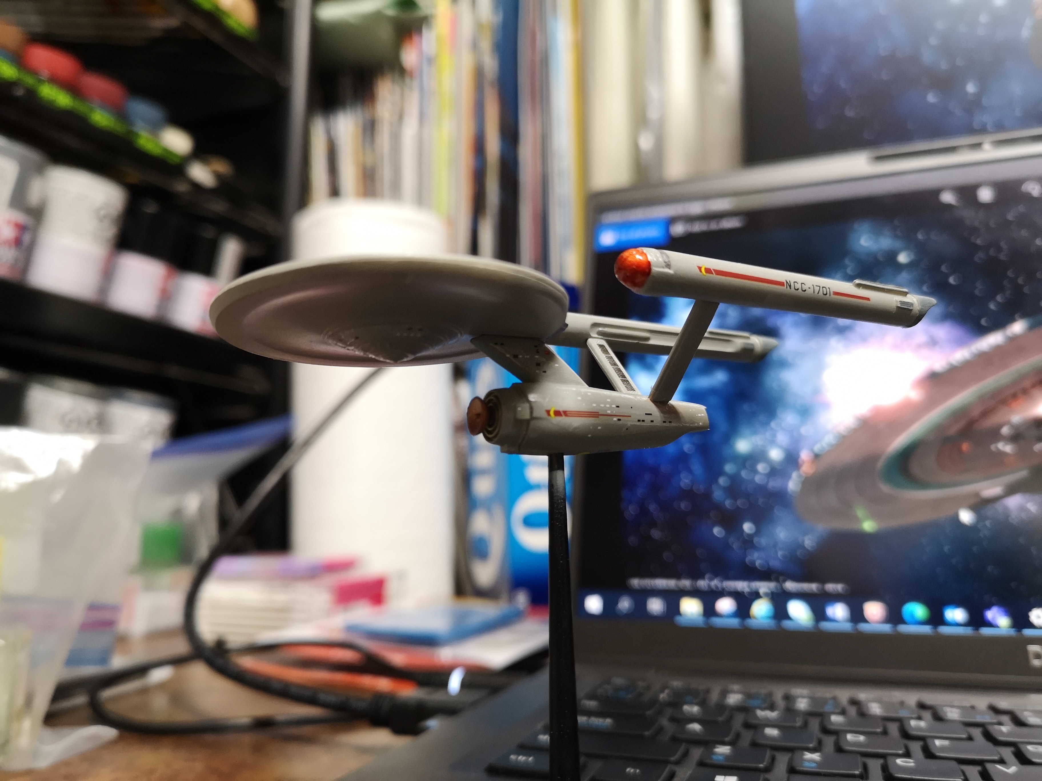

TOS Ent had a bit of decal fragmenting, but nothing catastrophic.IMG_20210319_223623.thumb.jpg.22446af0868e1f73b13a0553a7ec97d5.jpg
This thing had decals for markings that I didn't know the ship had.  Going to be honest, was never a huge fan of the TOS style, I grew up on the Refit.  But the TOS is growing on me.IMG_20210320_215408.thumb.jpg.0e26fff4fe85dc4e1de7f91f9ad6c030.jpg

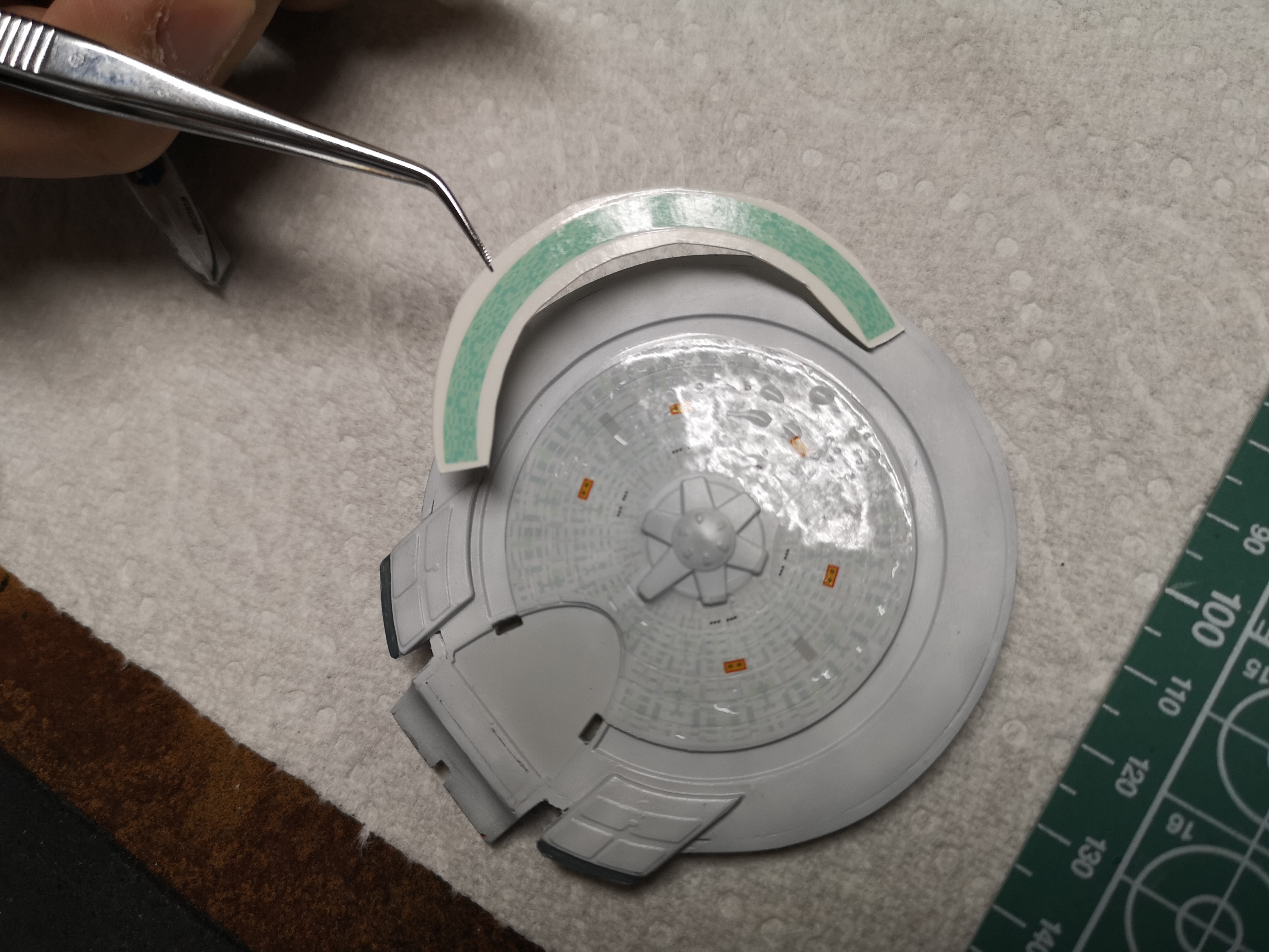

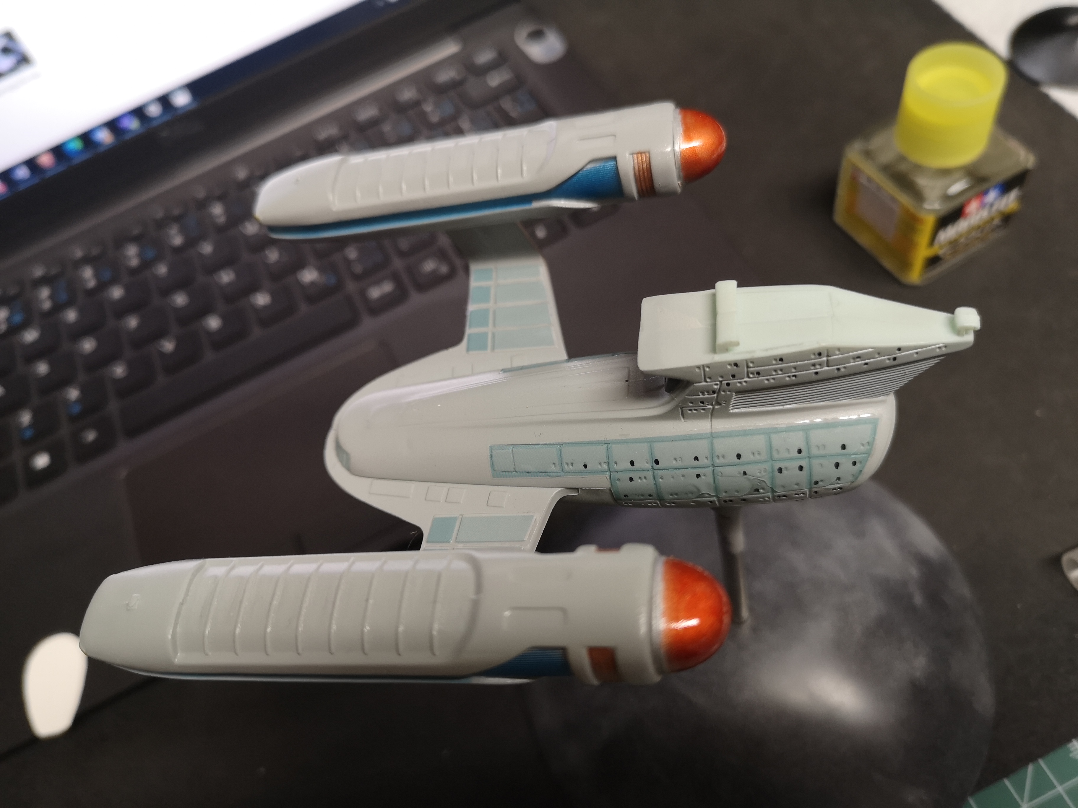

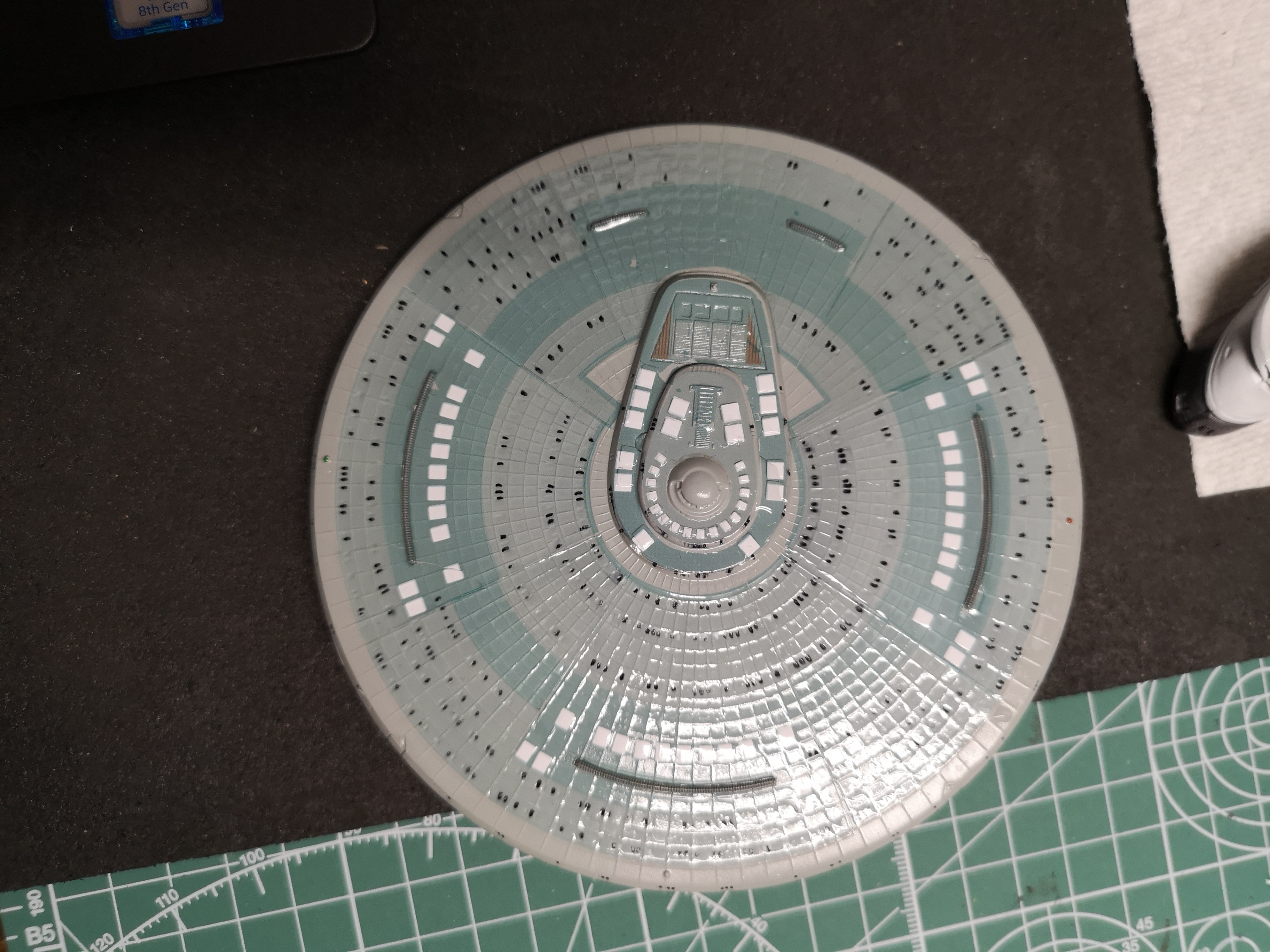

Ent B main saucer, bottom.  This piece did not want to go on in one piece, and as a result fragmented when placed over some curves.
The flat parts of the Ent B had no issues, but I refuse to give credit to AMT for NOT screwing this up, lol!IMG_20210320_221112.thumb.jpg.98af71bd12daf8c7919a558ac74ab293.jpg

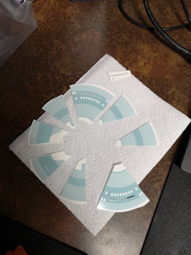

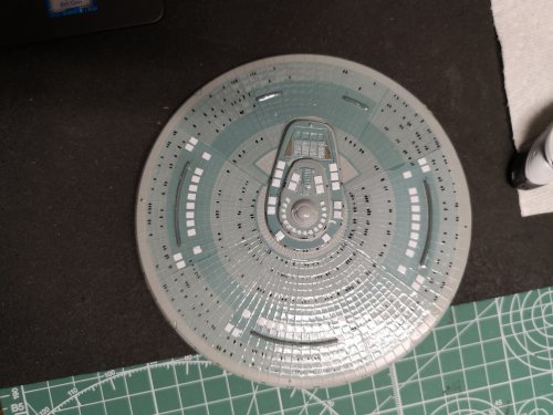

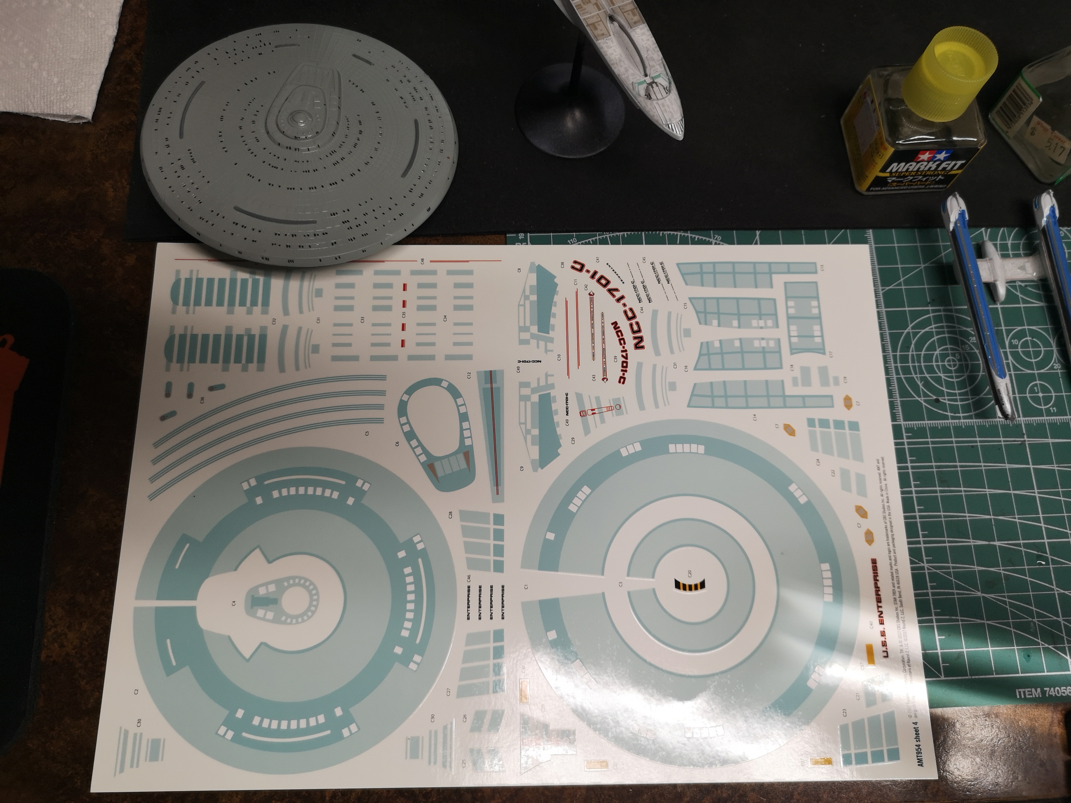

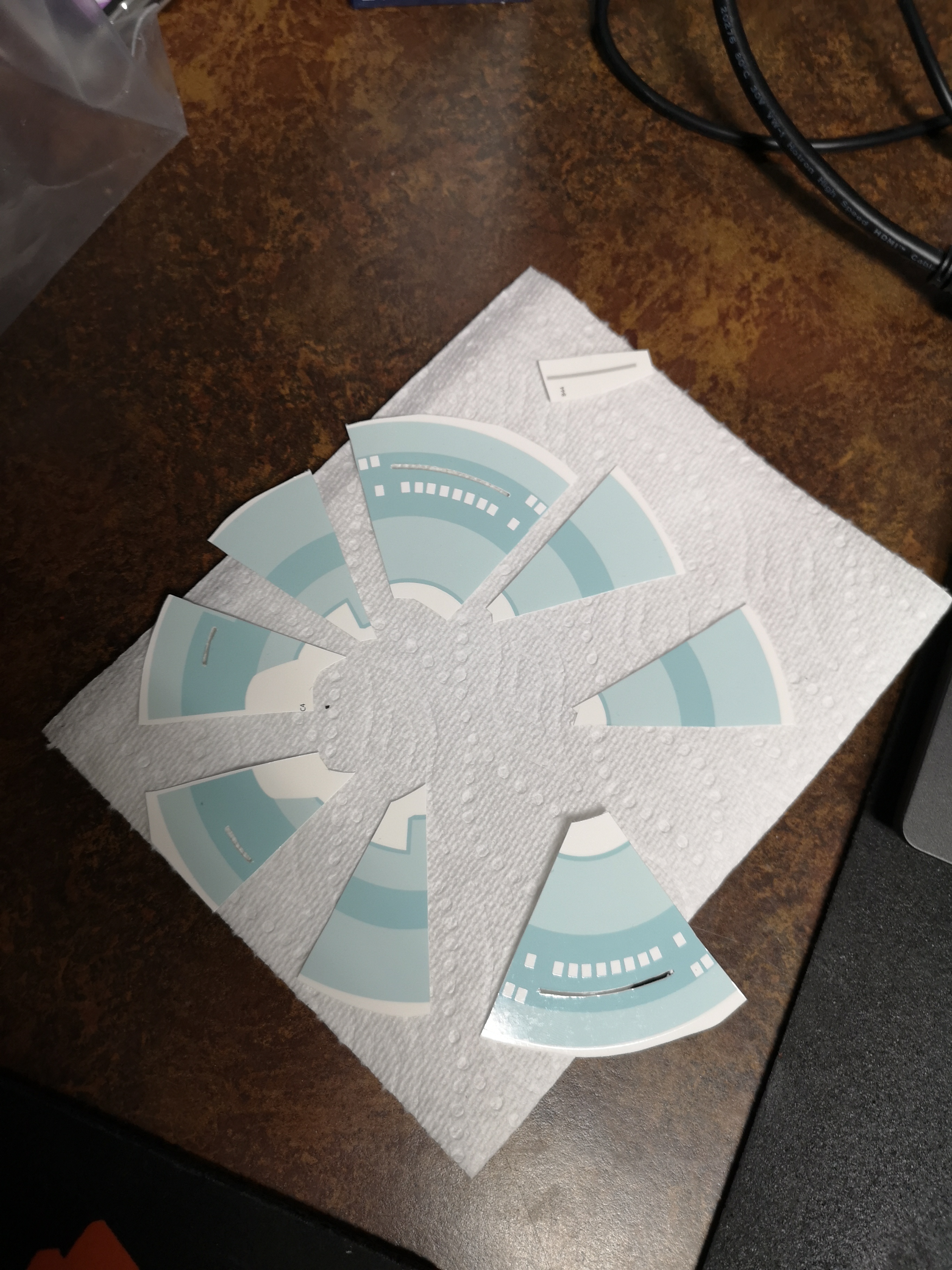

The Ent C is what terrified me.  I haven't seen many people that have had good luck with this one, particularly the saucer.
Started off with something smaller and easier.
The hull decals were curvy, but not that bad.IMG_20210321_134022.thumb.jpg.b9db0f8fbdd523b76be9eda8f65db78e.jpg
Decided to follow what some had done and cut the main saucer decal into a pie.
By jig-sawing it back together was a bit of a nightmare.  Some overlapping, some misaligned parts.
There is no winning when it comes to the Ent C, lol!

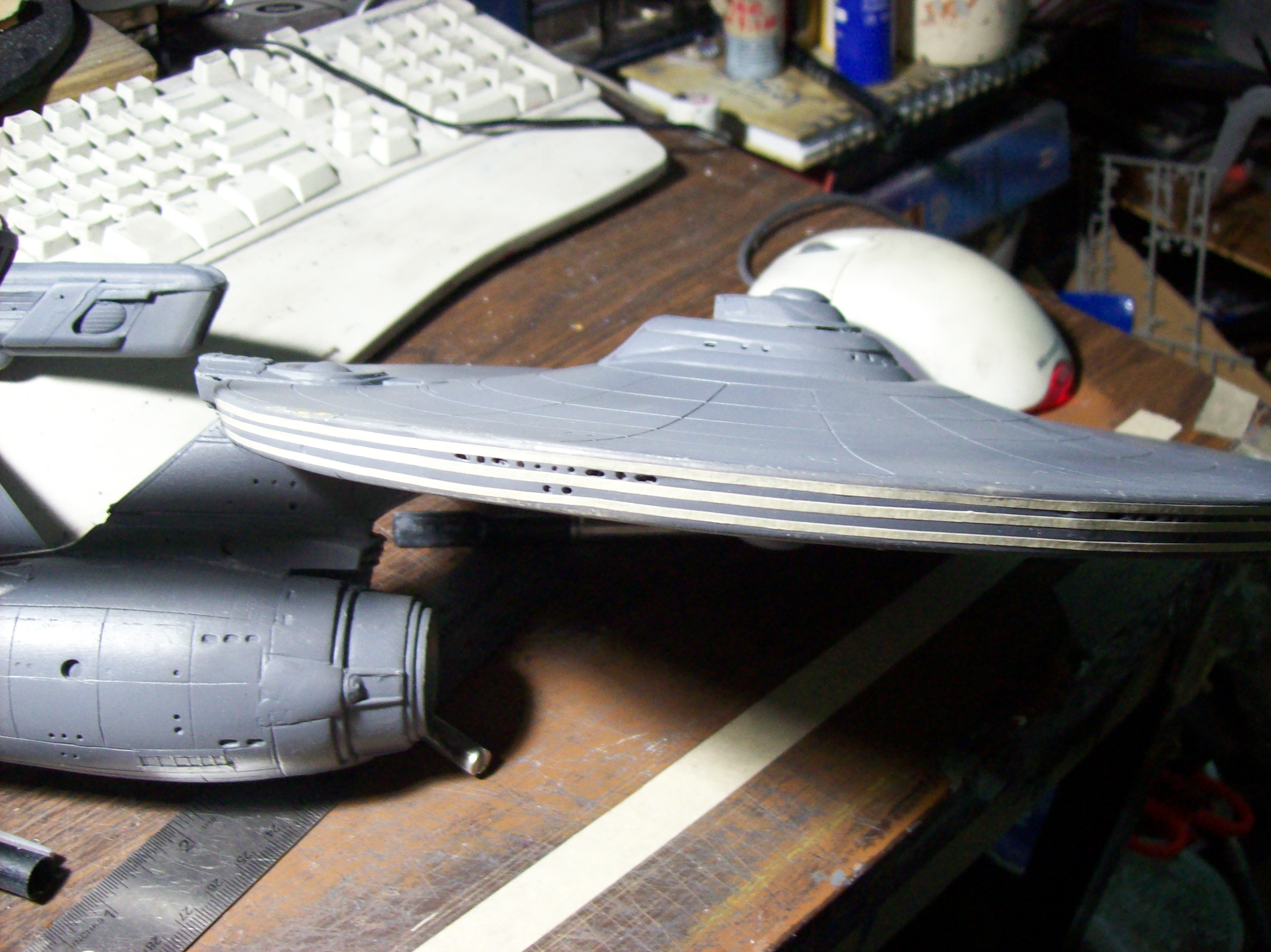

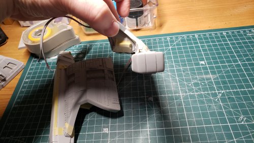

UPDATE: my solution to the bands on the saucer edge:
Some thin-cut (and very long!) strips of masking tape, under slight tension, run around the length of the saucer edge. I just primed them along with the rest of the saucer edge; more pics when dry. meantime, waiting on getting some good flat-white spray paint.  I really don't want to have to do another repaint!
Stay tuned...

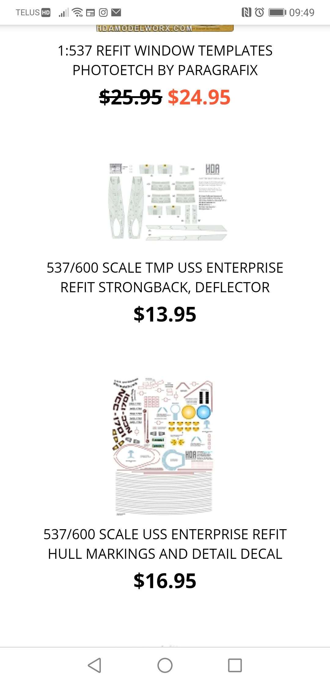

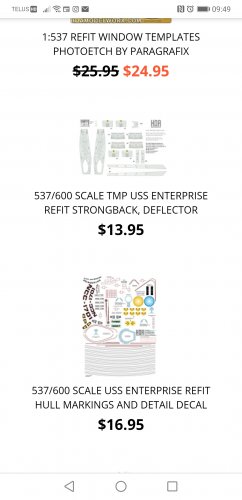

Check out @Dobber penciled work on his Aztecs....they look amazing:
http://www.macrossworld.com/mwf/topic/35120-whats-lying-on-your-workbench-mk-iv/?do=findComment&comment=1534707
also, HDA also has the hull markings:
https://hdamodelworx.com/537600-SCALE-TMP-USS-ENTERPRISE-REFIT-STRONGBACK-DEFLECTOR-HOUSING-and-Pylon-Decals-_p_217.html
$13.95
https://hdamodelworx.com/537600-SCALE-USS-ENTERPRISE-REFIT-HULL-MARKINGS-AND-DETAIL-DECAL-SET_p_218.html
$16.95
Not to sound like a salesman for HDA, but their decals are amazing.
Screenshot_20210322_094954_com.android.chrome.thumb.jpg.9bbb351e316cc93aaa5de8a61a7f6912.jpg
