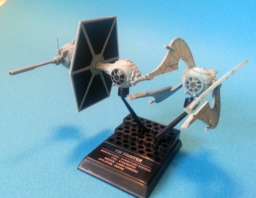

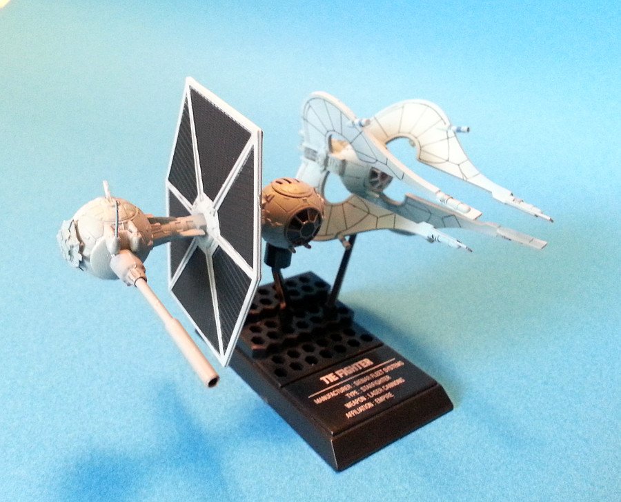

Took a small detour from Macross and went back to Star wars for a bit..
1:144 models..

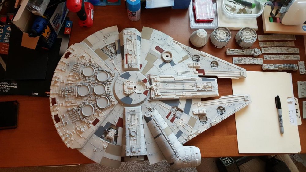

This morning I had a chance to finish up the different colored panels on the top of the Falcon. I actually liked the colors Hasbro went with for the sticker sheet, so I mixed some colors to match them. All panels done with Tamiya acrylics. It's a little different from the way my 1:72 FM's came out, but I like it. Besides, I've never seen any two Falcons that were the same! Looking forward to weathering and engine lighting next!

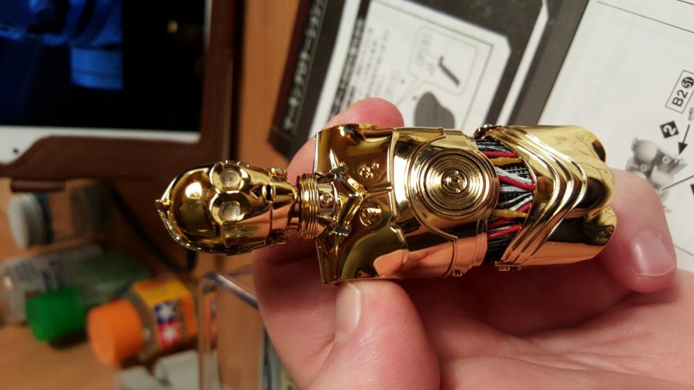

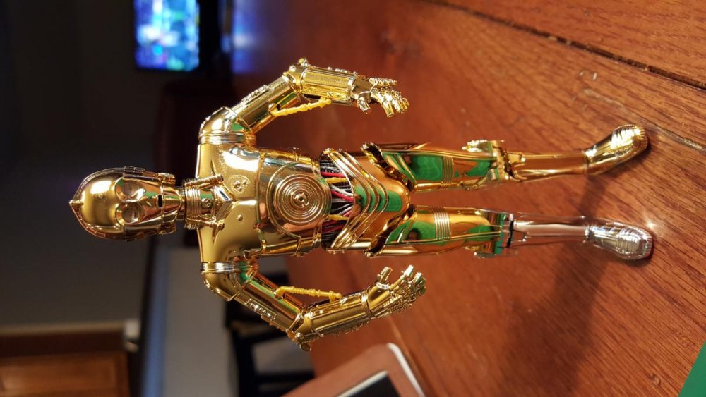

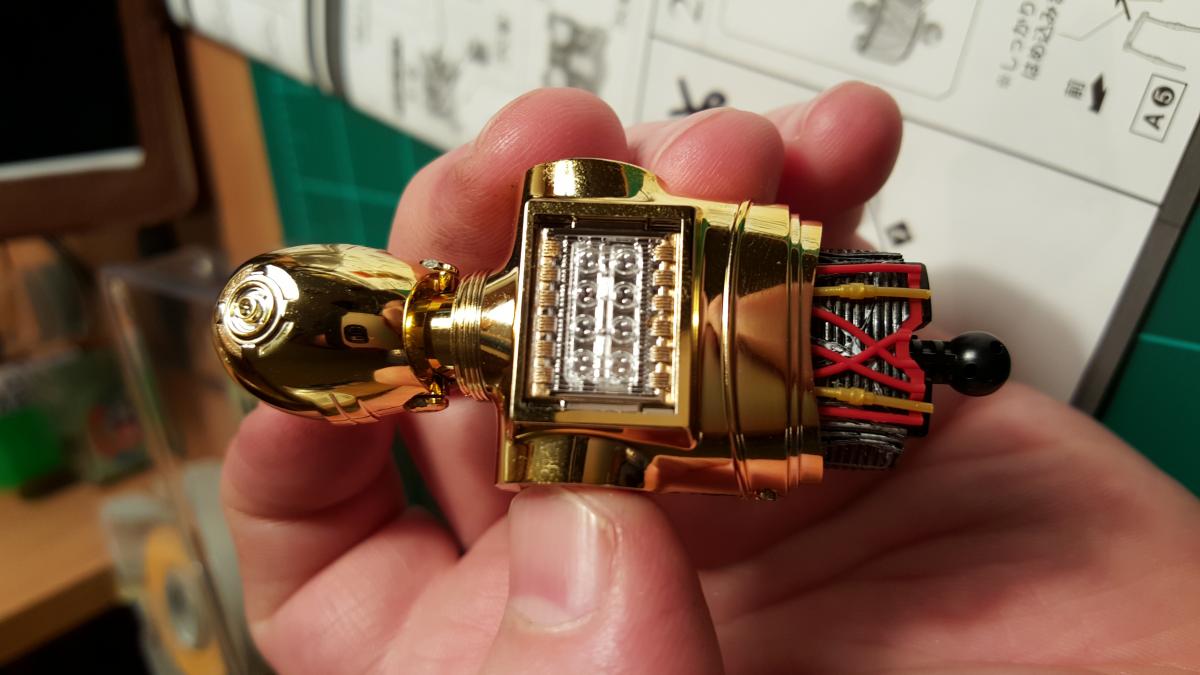

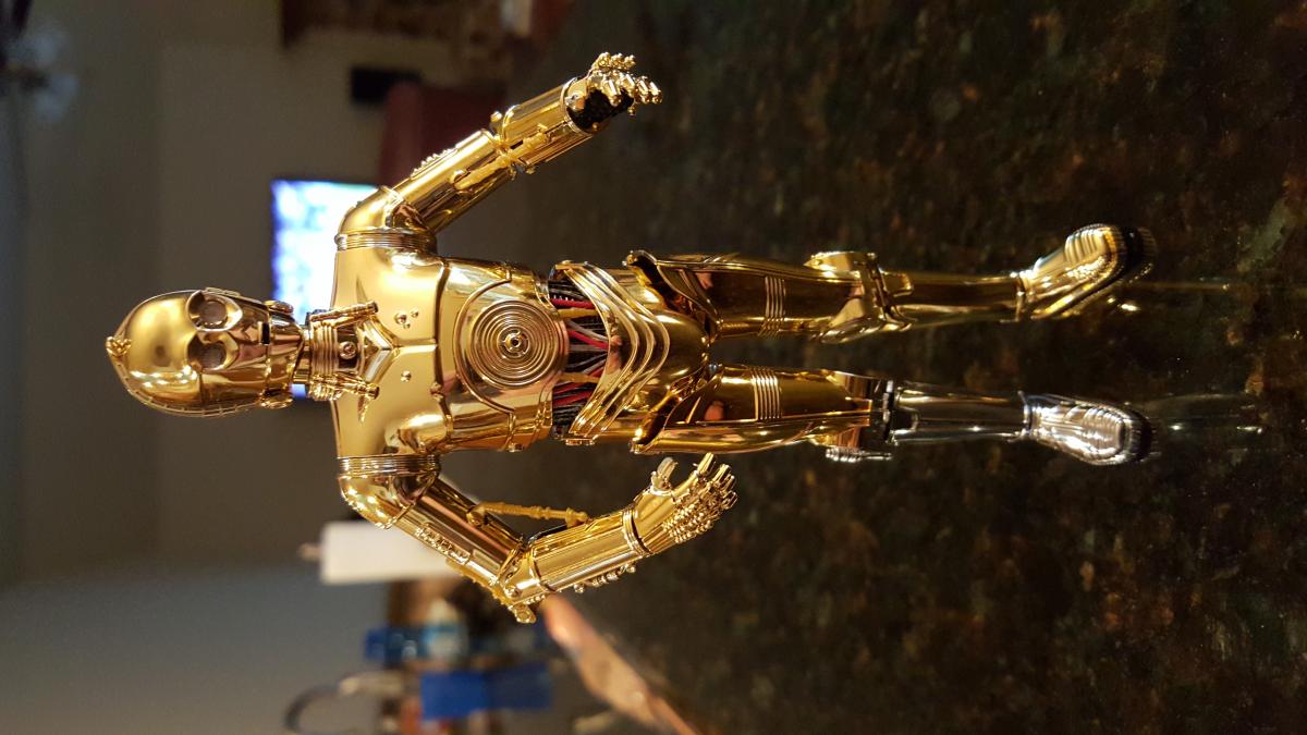

Also, I worked on 3PO some yesterday.

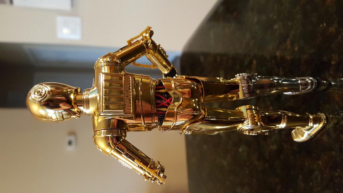

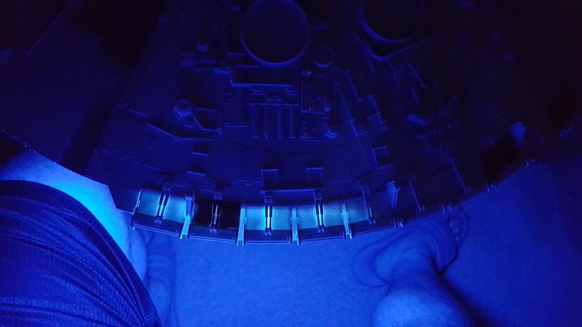

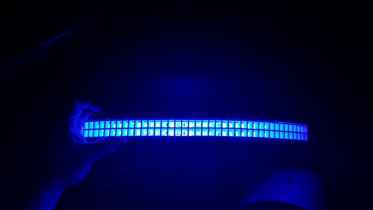

Finished up 3PO while watching the Giants beat my Boys...moving on!.....here's a sneak peek at the engine lighting for the Falcon. This is about a 5 inch strip...it will be 24 inches all in...LOL! Gonna need some light block on the very back, but I have a plan for that I think.

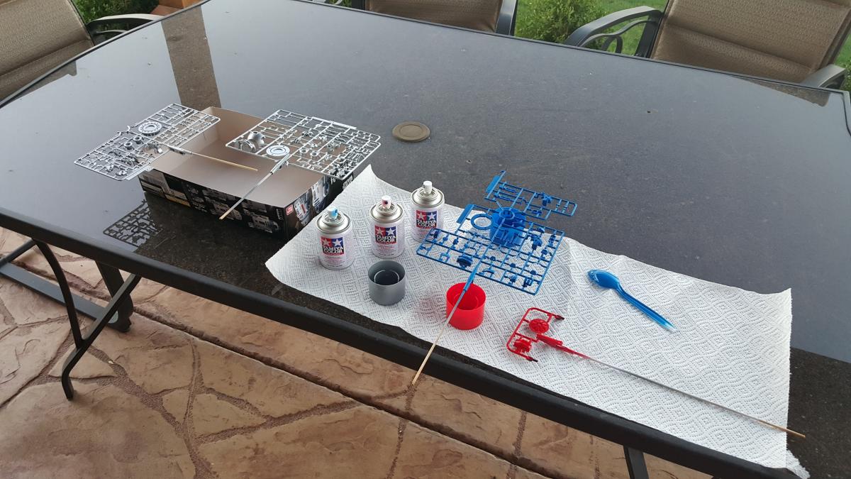

such a nice night outside tonight, decided to get it done old school in the back yard with some spray paint for the droids! This Tamiya spray paint really is good stuff... pricey, but very good.
loving the engine lighting glow effect! B))

Love the ginat Falcon so far Derex. The engine glow looks great! - Phill

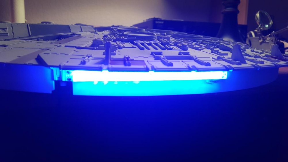

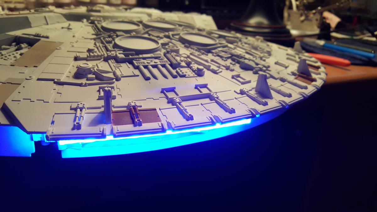

Full Falcon engine light test with the 3D printed engine grate in place. . 24 inches of blue LED tape and it's wired to an On/Off switch. Personal victory!!!

The engine looks great! It's hard to believe that's 2 foot-o-lights!

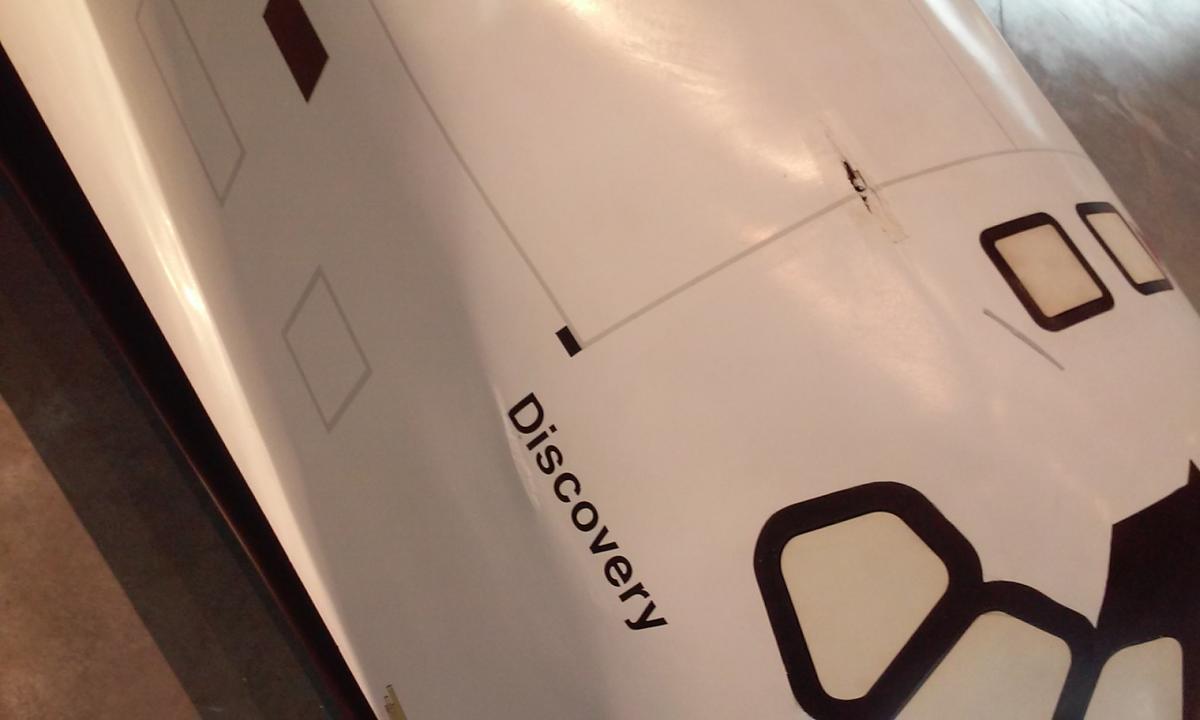

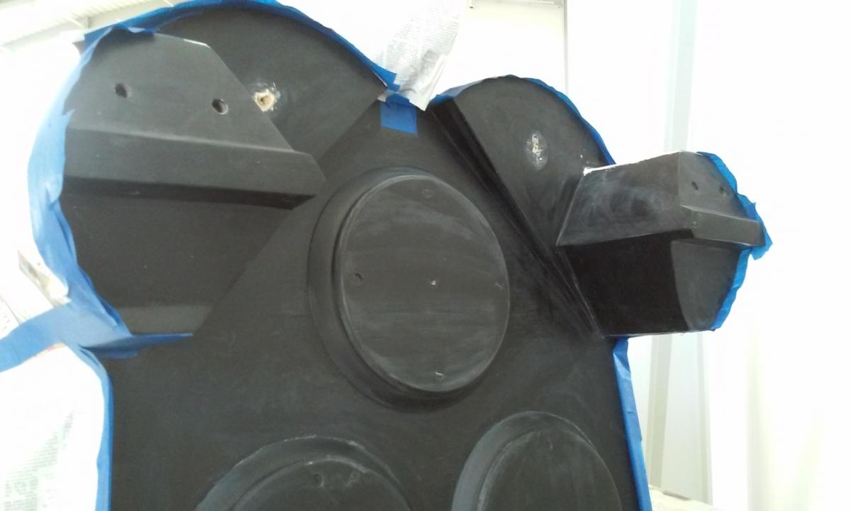

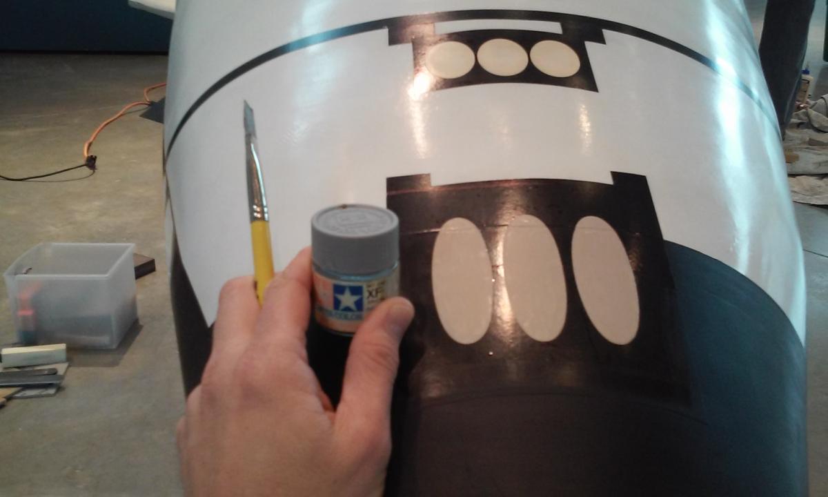

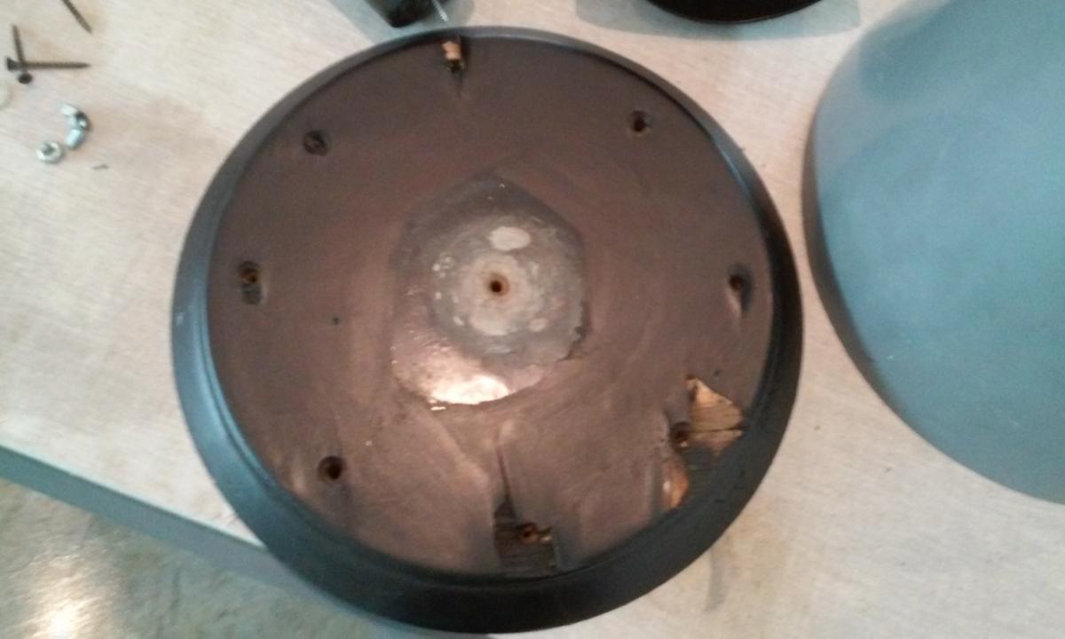

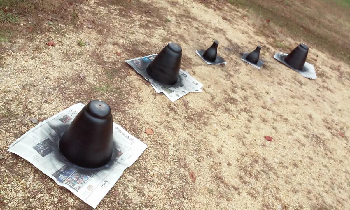

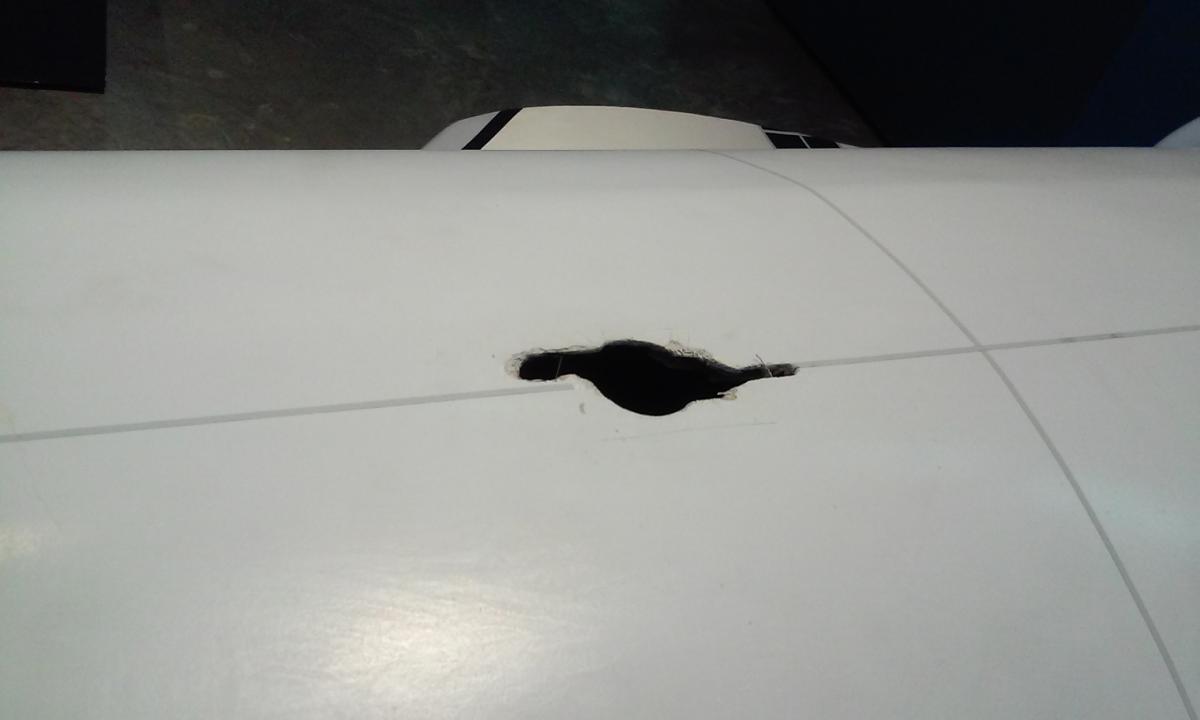

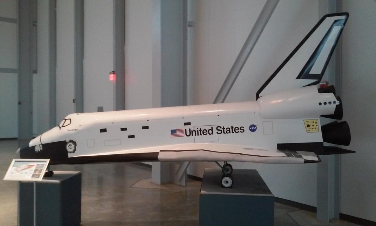

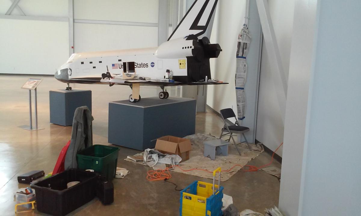

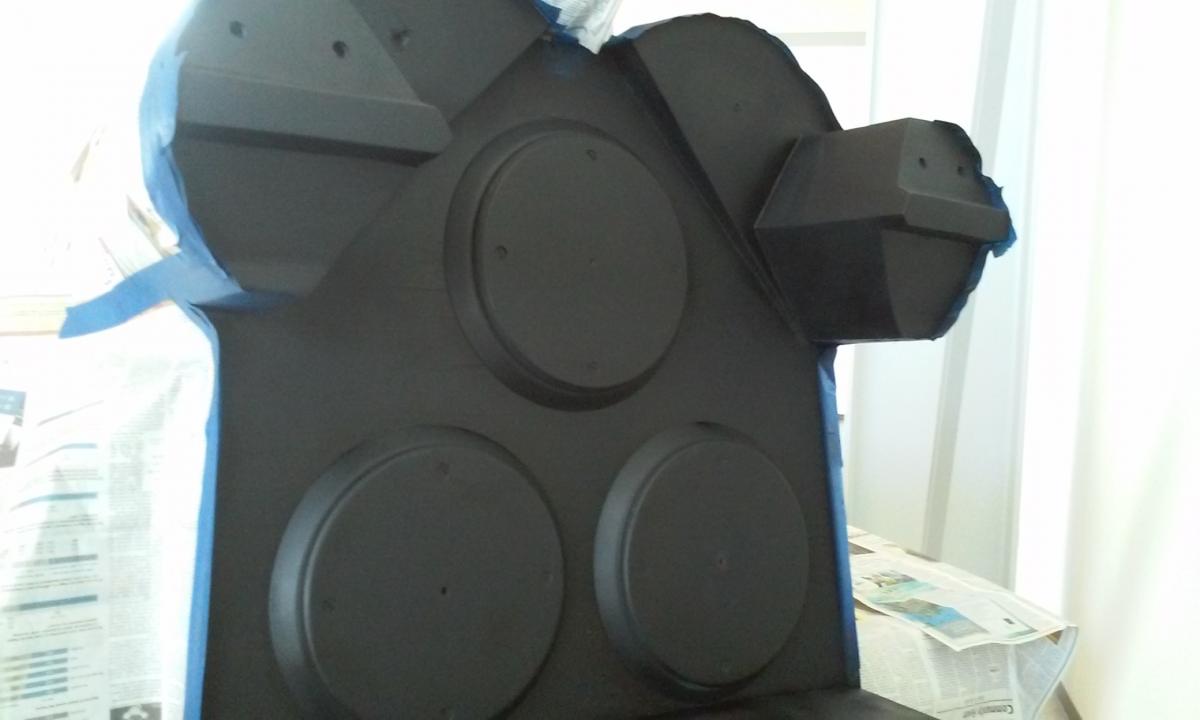

Between going back to school full time and volunteering at my local museum, I have been VERY busy! Like no Macross models getting churned out of my shop :( . At least I'm getting to do some model making right now. Our museum recieved a 1/10 scale model of the Space Shuttle Discovery a while back that needed some cleaning and fixing up. So another volunteer and I have been restoring it and getting it ready for display. How big is 1/10h scale? The size of an American minivan - really! There is an I-beam going through the middle with other structures welded to it. Plywood frames and stringers make up the build with thin plywood covering which in turn was covered with fiberglass cloth, resin and a gel coating. The plywood is rotted or gone in some places making restoration a pain!

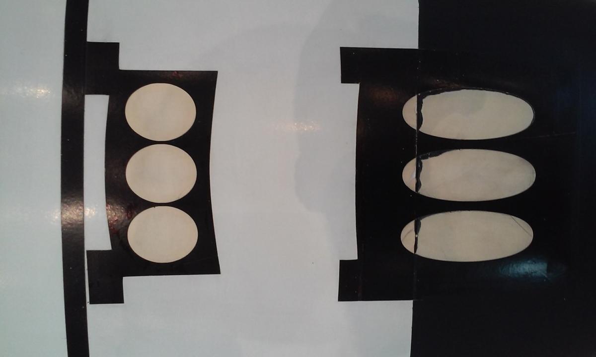

The first photos show the damage from decades of wear and tear.

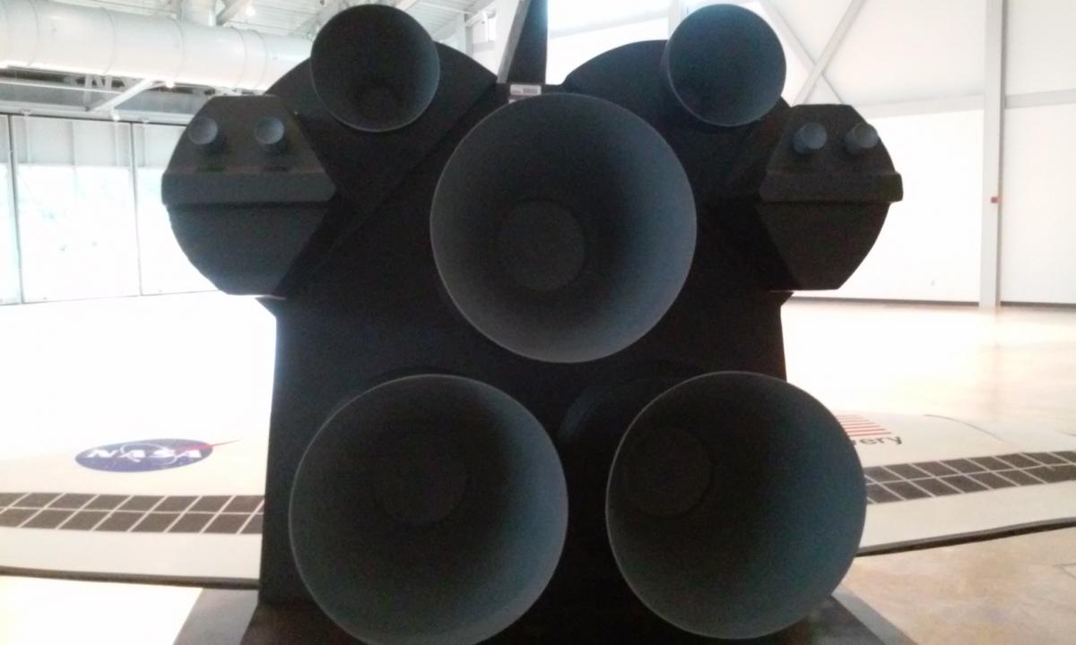

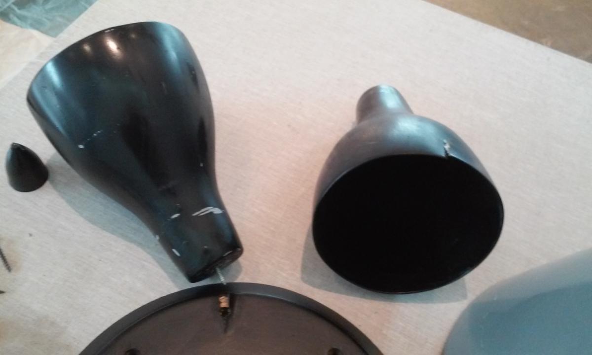

The next photo shows how big the engines are, the size of a bathroom trashcan! I stuck a bag in one just to compare. Someone painted the nozzels light gray. I made them flat black with interior dark gray as most photos I've seen of actual missions. A "ring" affect was made with the paint to simulate the engines rings, but keep it close to original specs.
The final photos are of the post-restoration work ready for display. It's not perfect (the left wing was ill-repaired by someone years back), but at least people can start enjoying it.
Last year I think I had the largest Macross model completed (the Daedalus). This year I guess I'm going for the largest scale model worked on in North America. If anybody knows different, the museum actually wants to know ;) - MT
Holy cow that is one big space shuttle model! And Discovery is my fav of the bunch!! Looks amazing and you are lucky guys being able to work on it! Friggin awesome!
MechTech, that's awesome! A 1/10th shuttle. They're lucky to have your skills at their disposal.
When you get done with that, you can start a Prometheus to go with the Daedalus.
Thanks! It took 8 people to lift it onto the stands where it will temporarily stay for a while. It was tough repairing the holes since nothing was under them and we couldn't get access behind them.
Ironically I've also got a 1/10th wind tunnel model of the Convair Sea Dart taking up half my shop. That sucker weighs at least 80lbs! They don't make them like that anymore. - MT

MechTech, that shuttle is awesome. And you get to do that for work or is it volunteer only? Even so, I can only dream of something like that!

It's an honor to volunteer there. As a matter of fact, EVERYONE is a volunteer there except the gift shop personnel. Another side benefit, I work with some pioneers in the aviation industry. Some examples: first pilots of the H-3 Sea King, C-2 Greyhound, F-9F Panther and a lot of other really cool veteran pilots or program managers like weapons systems. Lot's of cool stories and inside info.

Great work there on the shuttle, at that scale modeling takes so many other skills on board. One time where woodshop class comes in handy.

Thanks Big F! Yes, woodshop came in handy! The outer wings are removable panels and thanks to whoever worked on this before us, the panels would not align at all on the left side. In fact, the tip drooped like on an XB-70 wingtip. We had to shim it with quality plywood and break, then re-glue parts of the spars.
If the cargo bays opened up, a six foot tall person could sleep (or ride) inside this beast! That's big enough for me. No, no more big scale Macross models - please! :wacko: I'm still a small scale guy at heart! - MT
