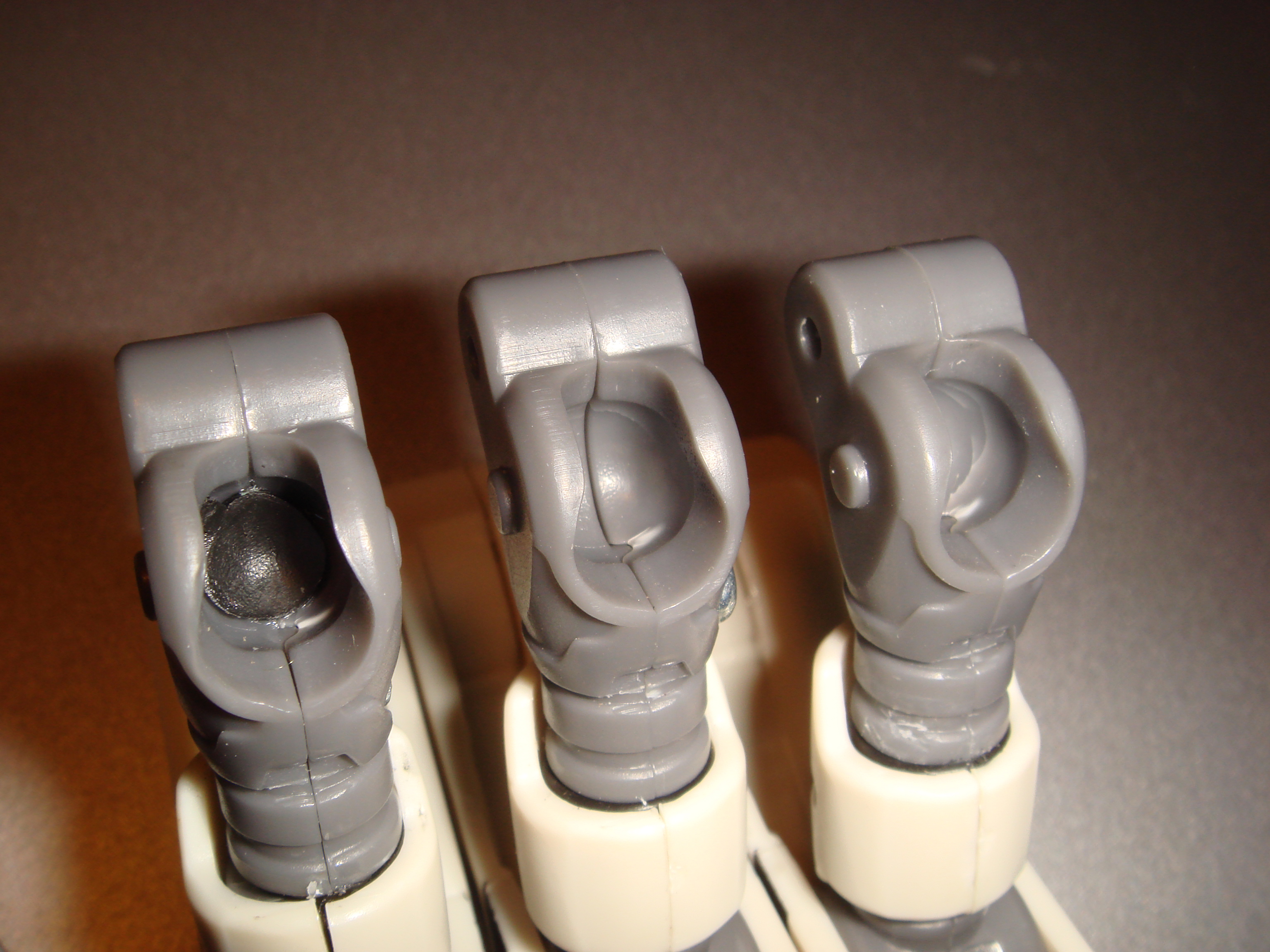

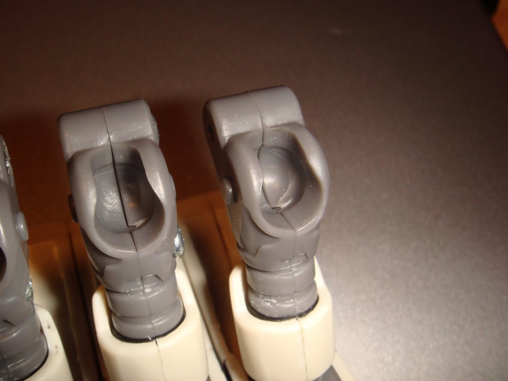

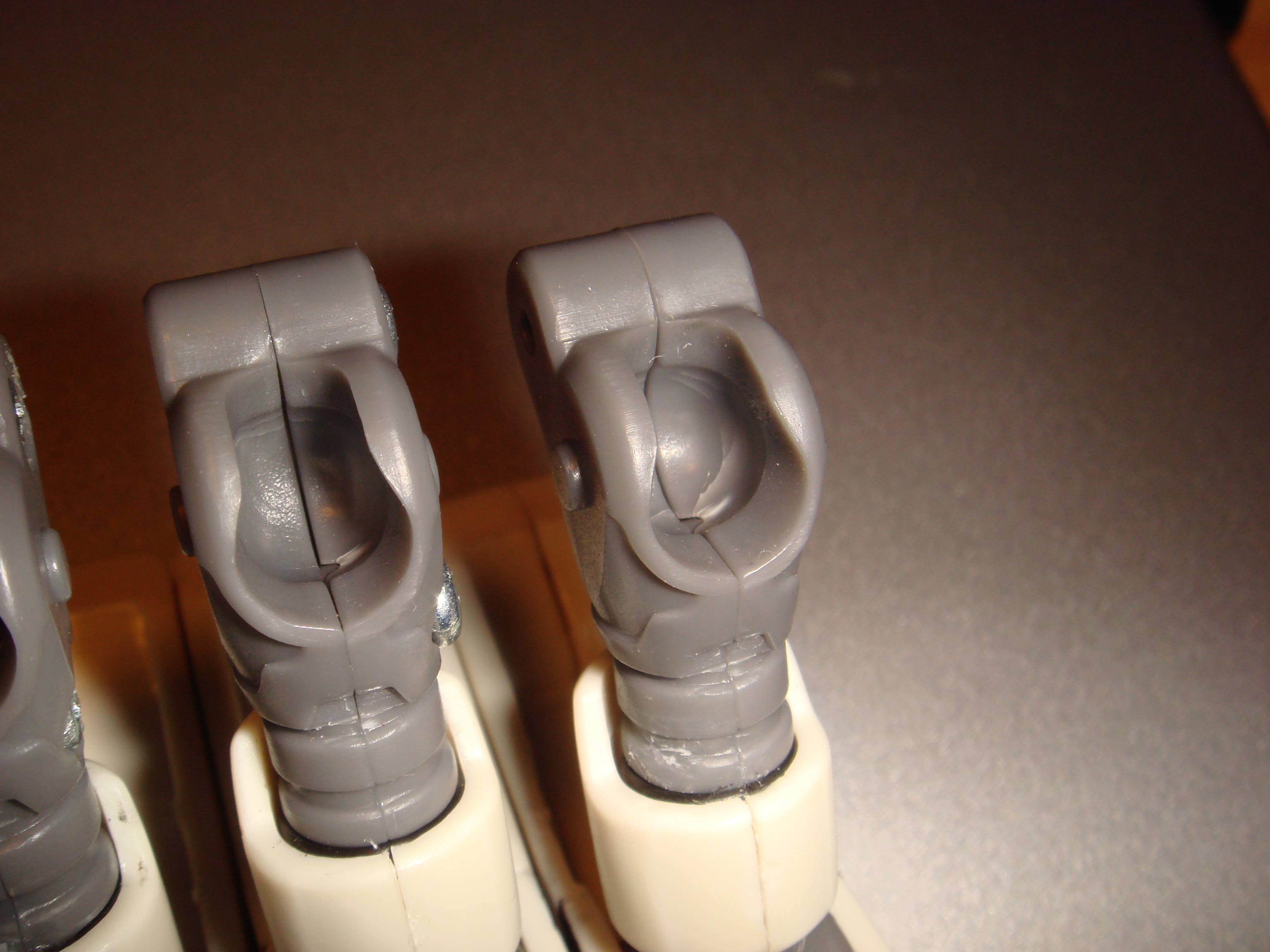

PsYcHoDyNaMiX Posted August 9, 2007 Posted August 9, 2007 (edited) Pics FTW... Kind of hard to say thats a chemical reaction b/w two of the same plastics. Either poor engineering or poor assembly. My conclusion for the engineering theory is that they made the male connector too big in diameter (or the female too small in diameter) and they made the pilot diameter hole (for the screw too small). Therefore, after putting the tight fitting male into the female connector then inserting the slightly larger screw (either from the diameter or from the threads) the plastic will stress and possibly split. Oh yes... My theory for the common chinese factory worker (I am chinese, but not a factory worker from china). If it's already a tight fitting piece and all doesn't split or stress; if the factory worker decides to put glue to hold it together the glue will weaken the plastic then harden to refine it, but in all cases can cause the plastic to stress as well. For what I was talking about last night: http://macrossworld.com/mwf/index.php?s=&a...st&p=505002 The following pics are the replacement arms from HLJ straight out of the production bags. Completely unused. Edited August 9, 2007 by PsYcHoDyNaMiX

Sumdumgai Posted August 9, 2007 Posted August 9, 2007 Hmmm, if male connector is too big... Use Lube. Your explanation makes sense to me psychodynamix. But I'm betting that the chemical reaction is just the nail in the coffin when combined with your theory. So Yamato doesn't seem to think it's the ball joint being ovular as opposed to spherical that's causing the problems.
Scream Man Posted August 9, 2007 Posted August 9, 2007 id say its the chemical reaction combined with the pressure u have to put on the shoulders to pull the arms out.
PsYcHoDyNaMiX Posted August 9, 2007 Posted August 9, 2007 (edited) Those pics of the arms I have above were the replacement arms sent from HLJ. They were not taken off my current VF-0S, so they should've not experienced any kind of pressure from the ball joint. ***EDIT*** They were completely unused from what I'm aware of. They're straight out of the production bags. Edited August 9, 2007 by PsYcHoDyNaMiX
Lonely Soldier Boy Posted August 10, 2007 Posted August 10, 2007 Nor they've been in touch with the ball joint, so the "chemical reaction" argument don't work here. This is weird. Those shoulders are about to explode already.
eugimon Posted August 10, 2007 Posted August 10, 2007 Okay, I took a look at my busted arms, and I noticed something. The sides with the most damage, are always the side the rubber cap was predominantly attached to. The one arm with the least amount of damage, had a loose rubber cap that wasn't glued to the inside of the ball joint. So, there's some ancedotal evidence to back up yamato's chemical reaction story.

do not disturb Posted August 10, 2007 Posted August 10, 2007 i completely disassemble each of the arms on my 0A and figured out what was causing the breakages. its basically the rubber insert pieces being too thick and/or too much of it within the ball joint of the shoulder as well as the rotating section of the forearm....its even worse here than the shoulder. i removed the shoulder rubber pieces, clean off excess flash, and trimmed the rubber cap down a bit for a cleaner fit...this was pretty easy to do. i then took apart the forearm section only to discover that there was more broken pieces that i could've imagined...grrr! after glueing everything back together, i cleaned up the rubber piece A LOT cause its way too thick for the purpose it serves and for the amount of space that is available. then i took some fine grit sand paper(800) and sanded around the rotating sections(bother inner and outer) as its was not completely semetrical and too tight of a fit even without the rubber o-ring. after making sure everything was fitted properly and looked as it should(no pieces bending or stressing), i assembled everything back together. so far so good but i have a feeling the replacement arms will also suffer from these issues since they come assembled by the factory. they should consider offering all the repleacement pieces disassembled so that we can do it right, instead of relying on yamatos factory worker.
eugimon Posted August 10, 2007 Posted August 10, 2007 yeah. I posted this same information when the arms came out. But those of us who got the 0S arms are in a worse place, because the arms come glued together.
