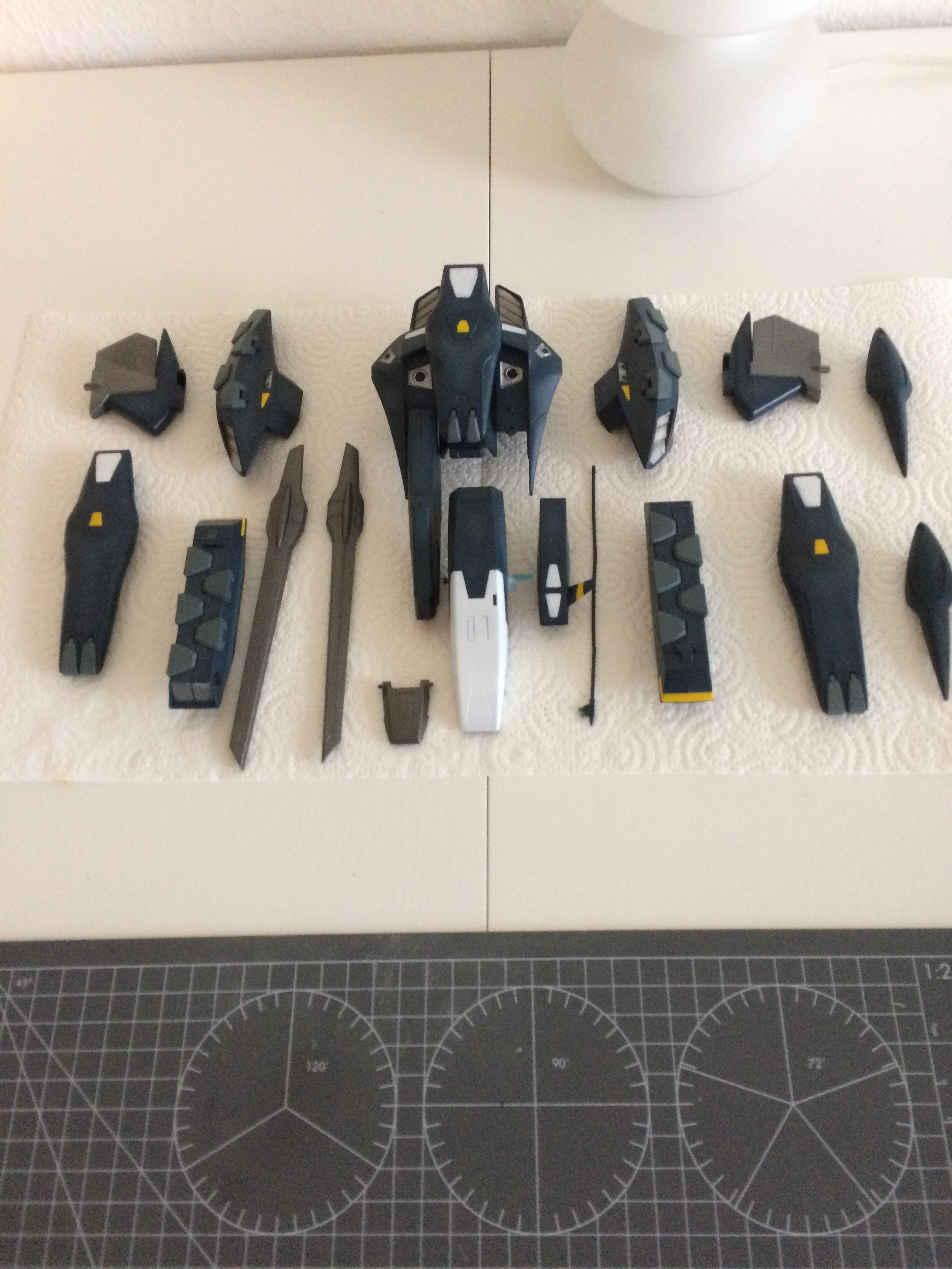

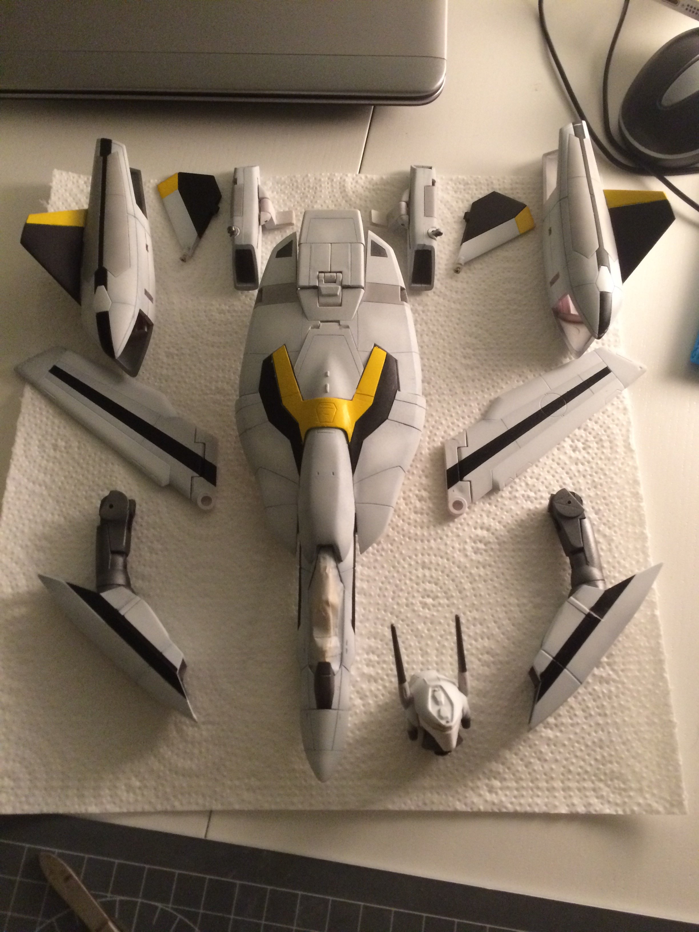

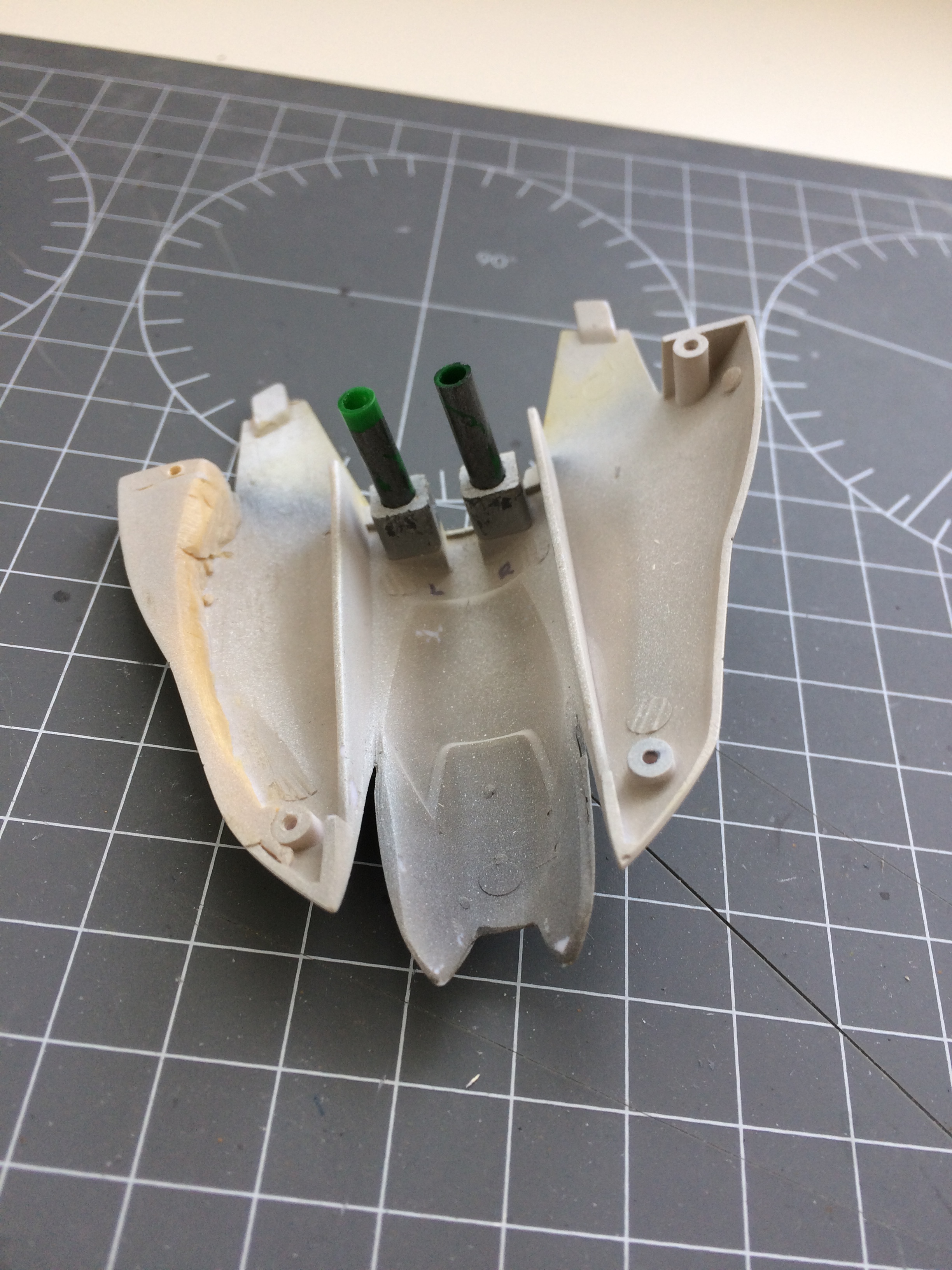

So I finally have been able to finalize the "rescue plan" of the wrapped chest piece. Working with BlueStuff has been very easy, I liked it, and worked very well with epoxy putty, just needed some time of sanding and the job was done. I also took the time to paint the pilot in a Roy fashion :ph34r:
I also worked on the arms, adding some magnets that will connect with the body to lock them in place more securely. Mod not done finalized yet (needs some sanding and putty), I think about them as additional air intake/exhaust...

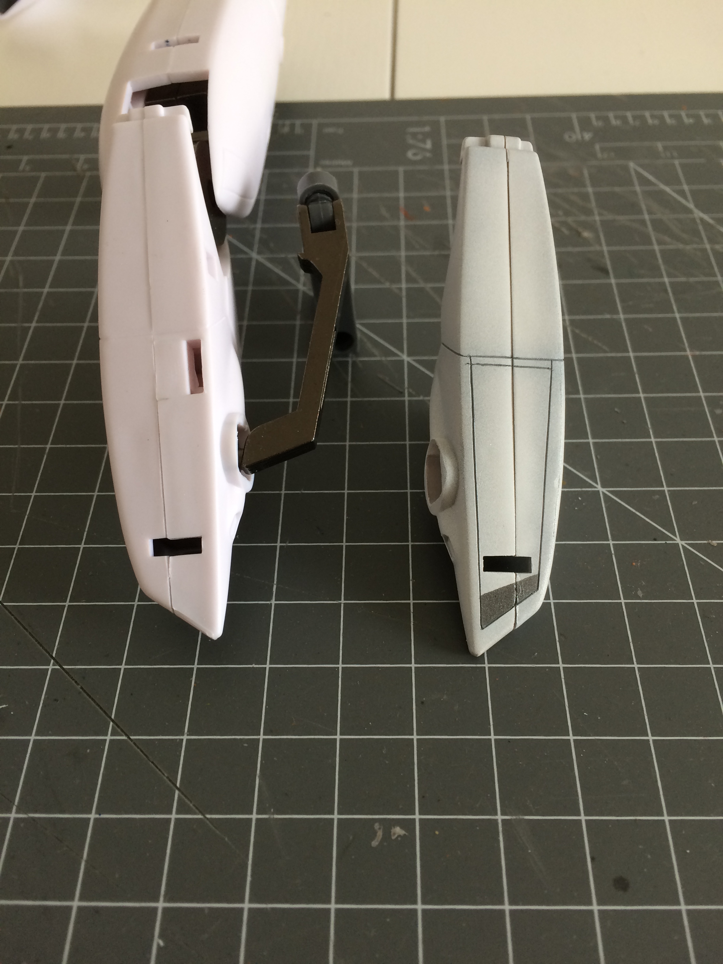

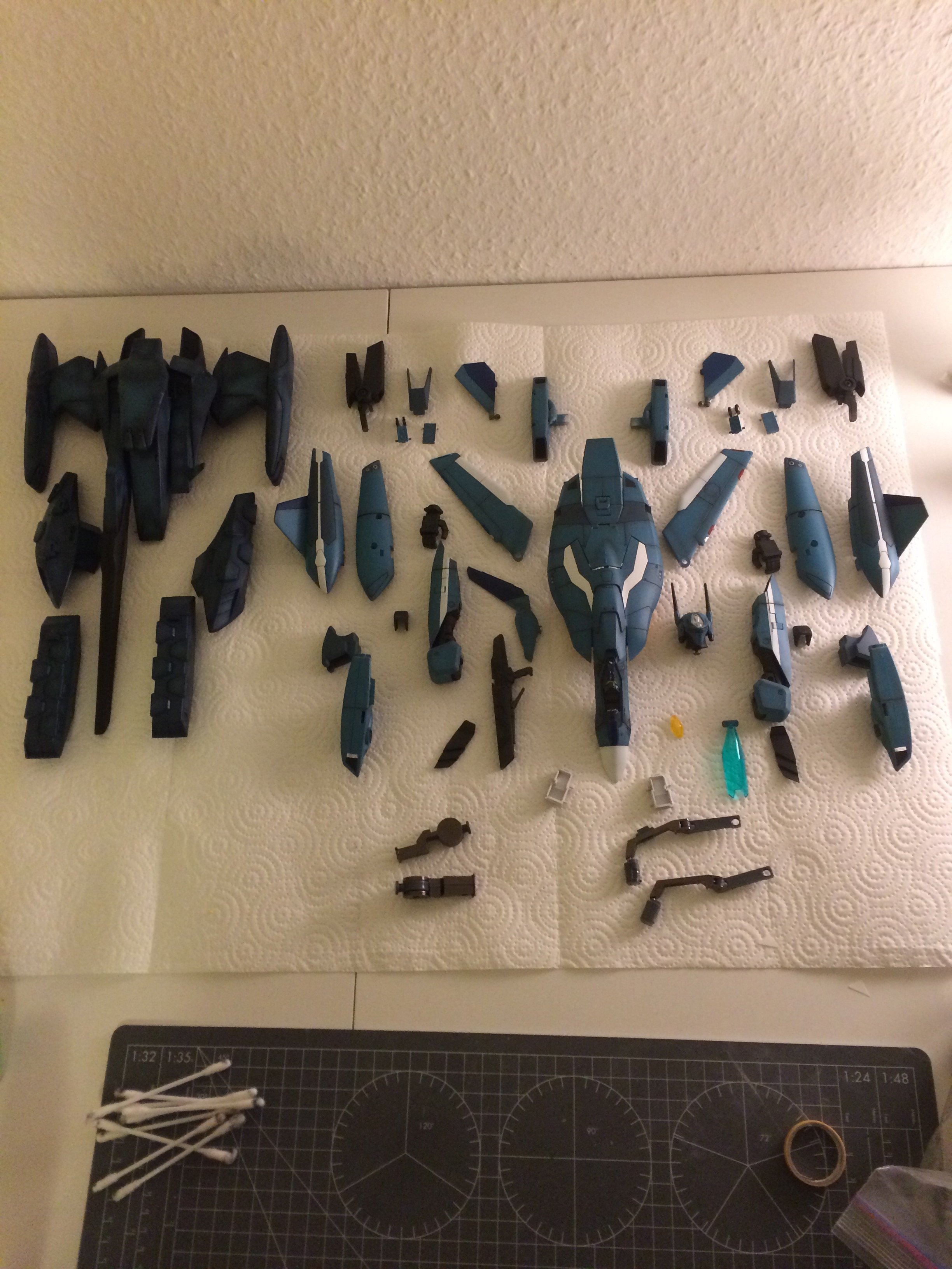

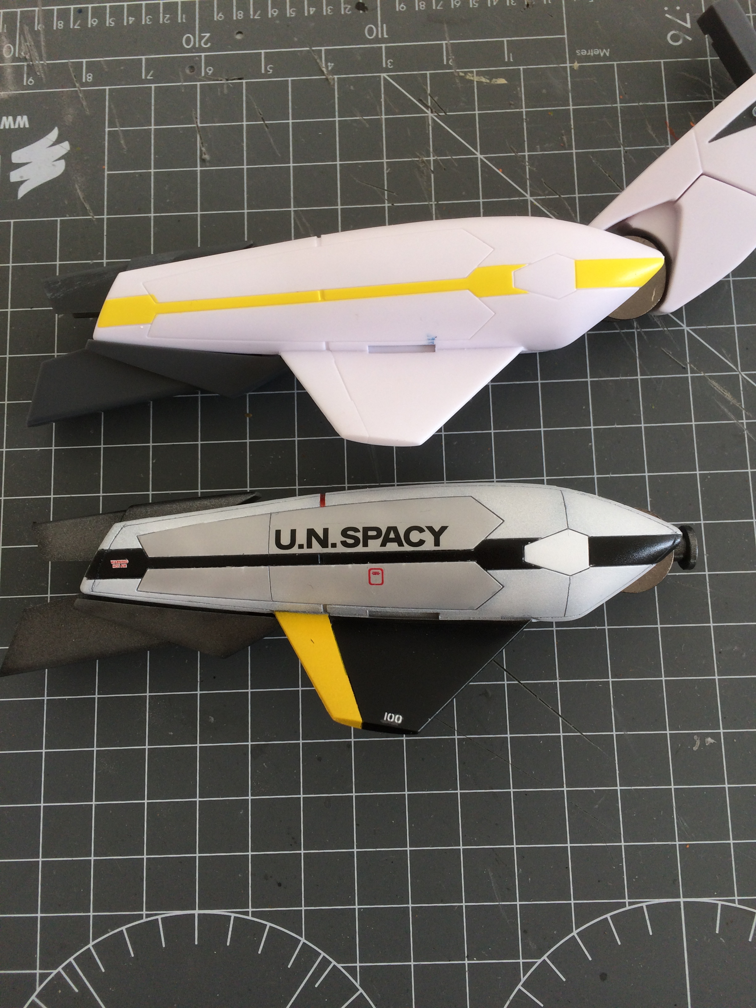

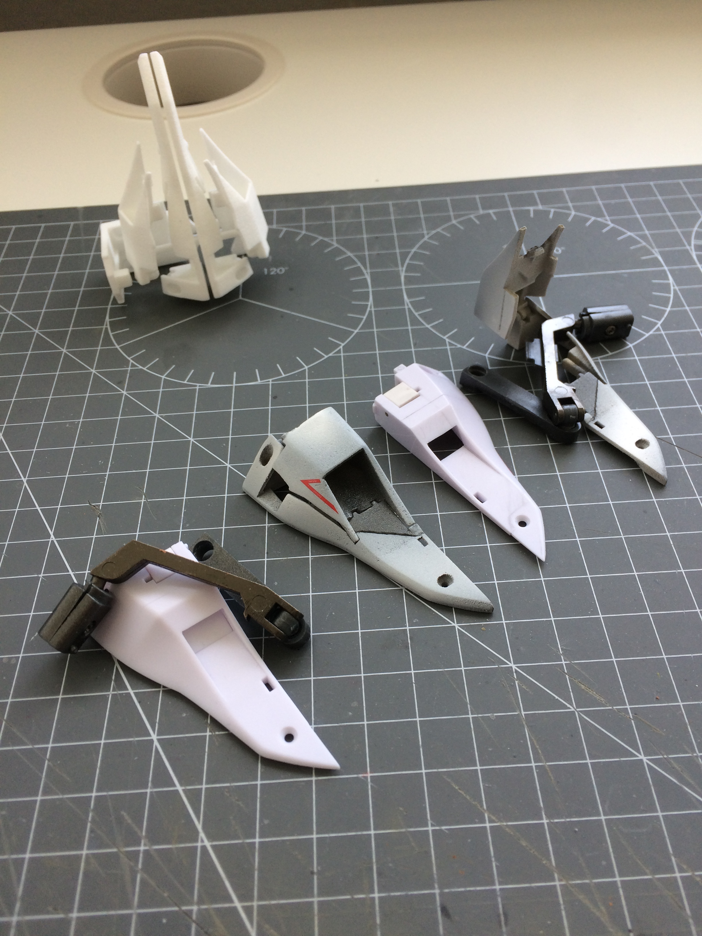

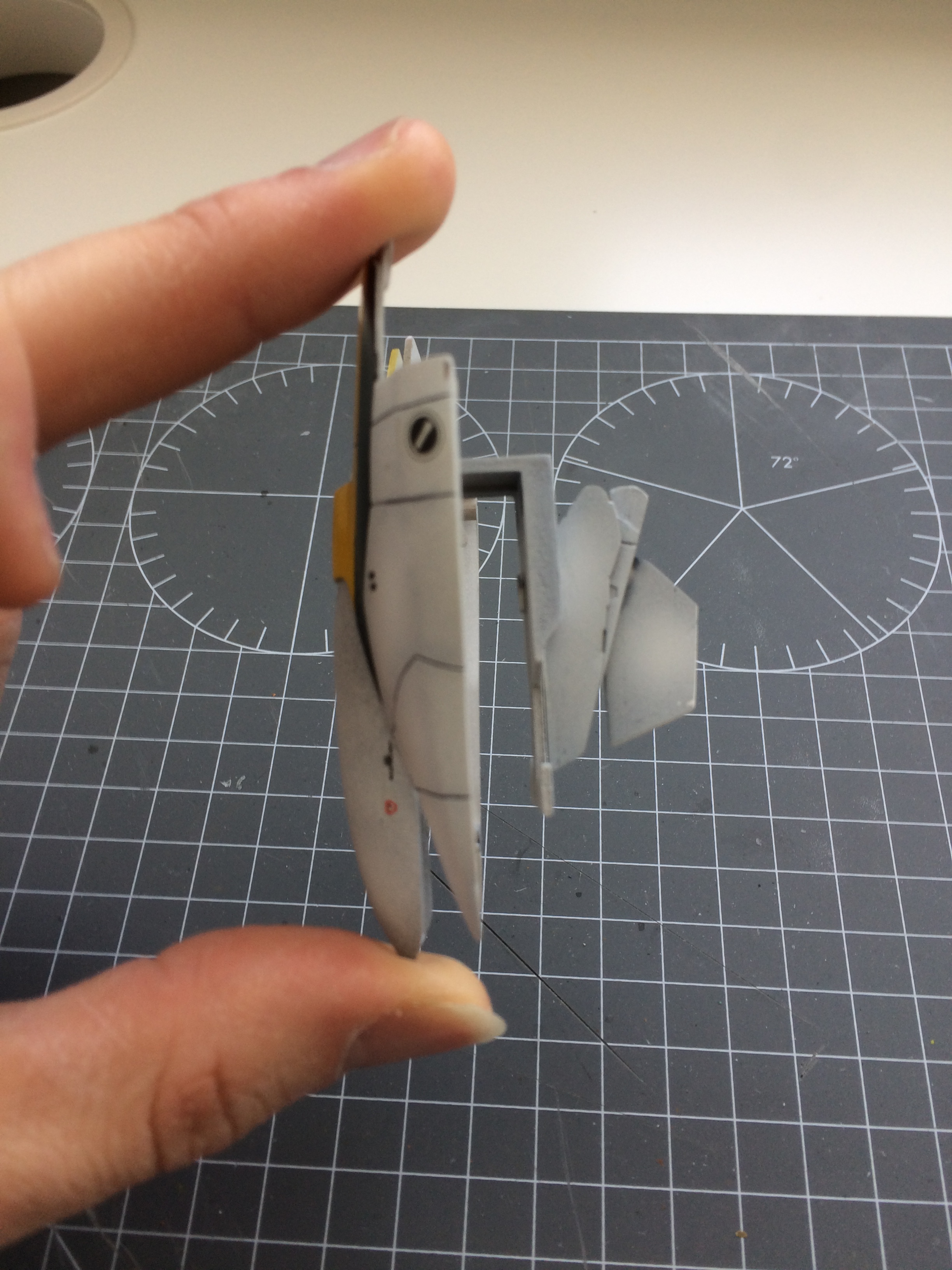

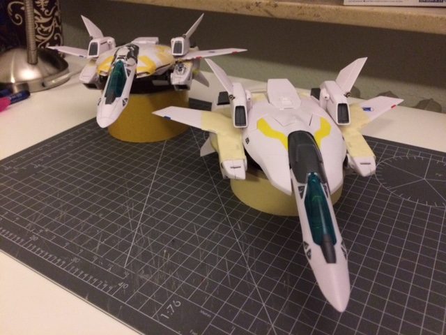

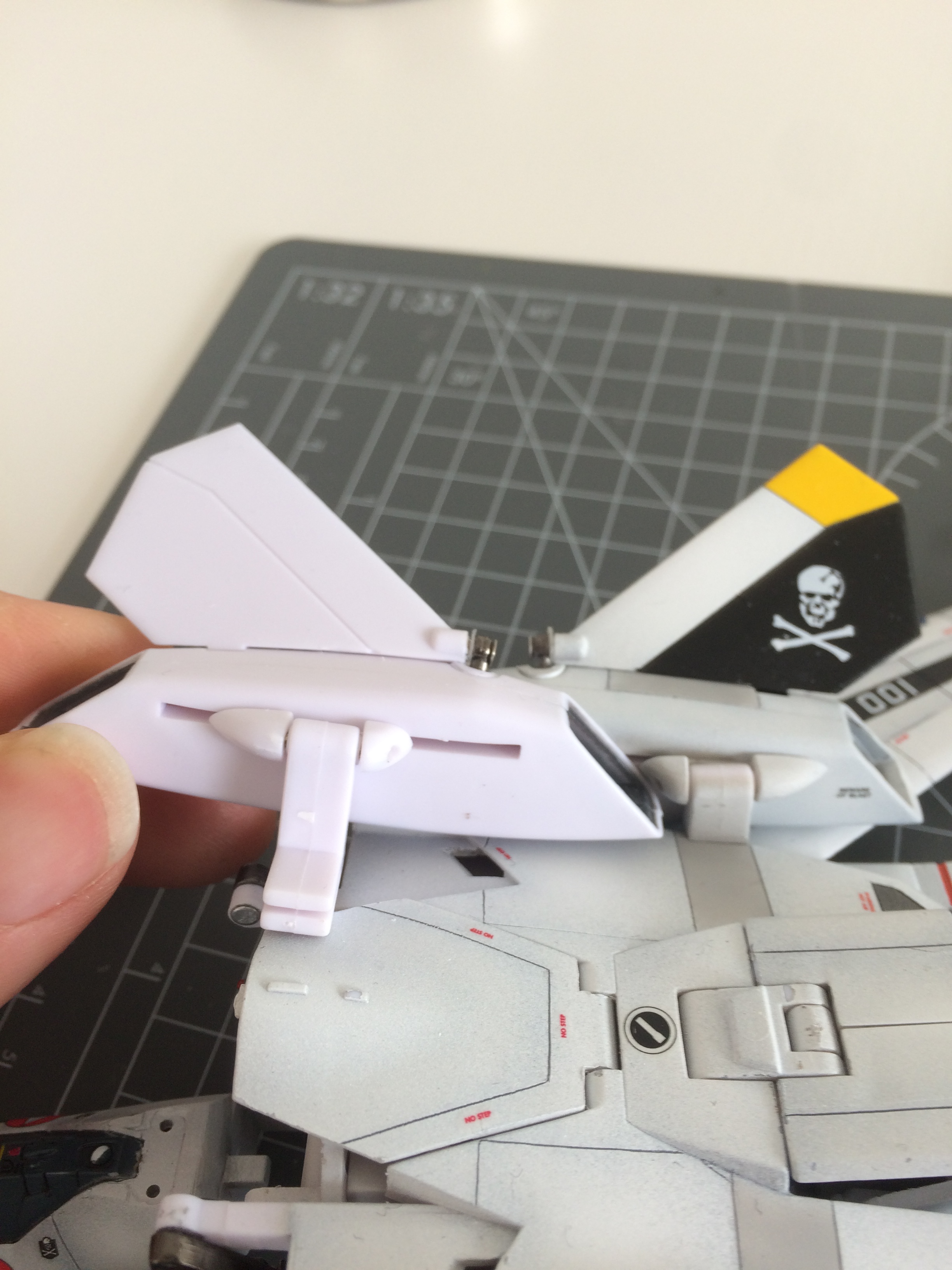

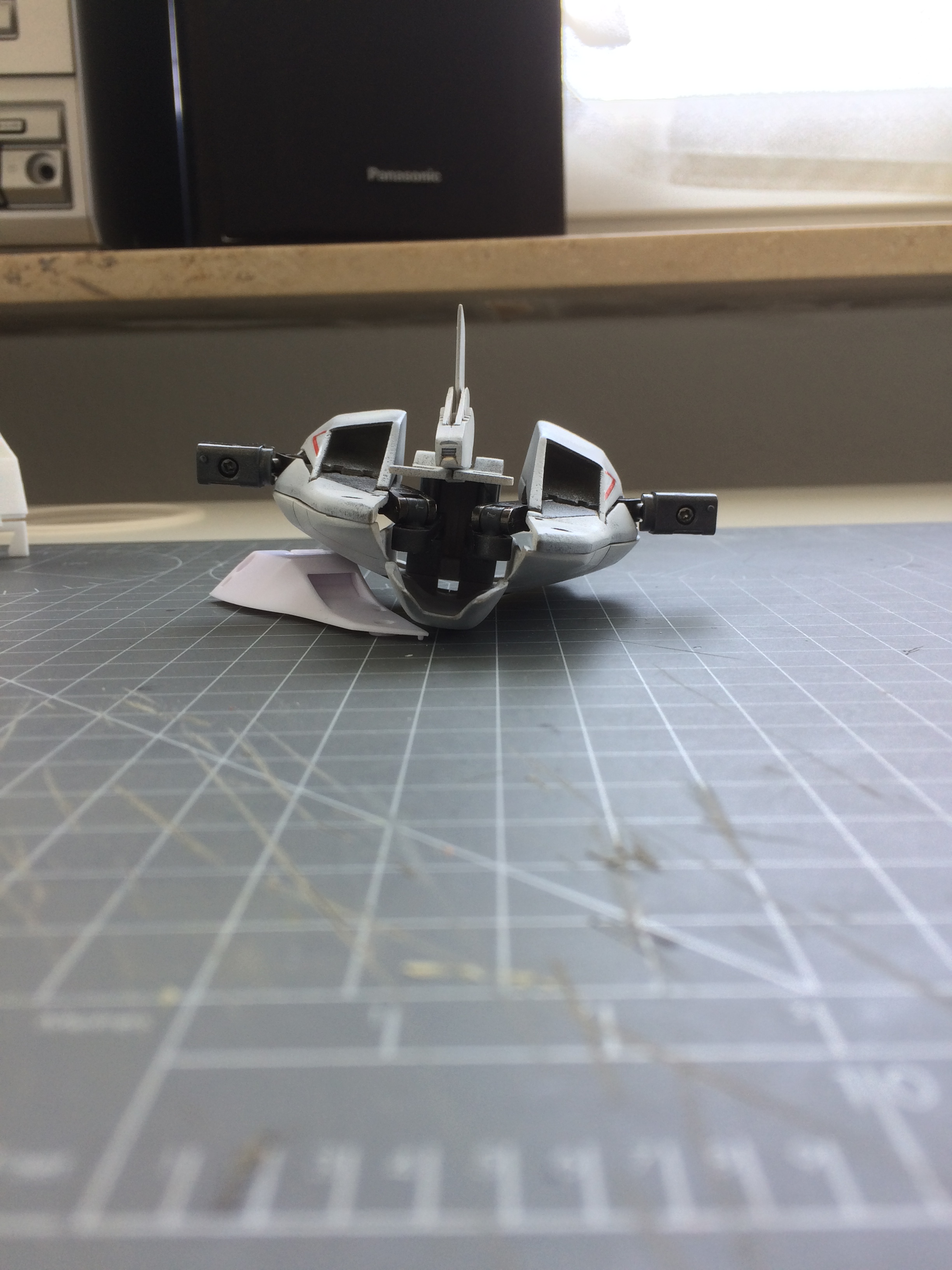

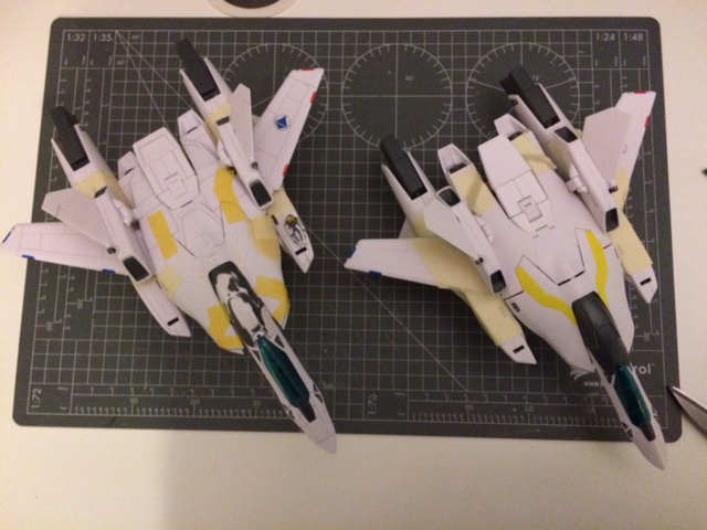

Finally I had also time to work on the other VF-2ss to see if the concept works. Topline:
1 - Remove completely the plastic piece that makes the arms move from fighter to GW/BT mode, and instead use magnets to make them attach directly on the underside of the main body
2 - disconnect the legs from the metal swing bars, replace the leg connection with a ball joint housing (so snap on/off with the metal swing bars ball), and add magnets to make them attach to the main air intakes on the body (attachment points that will be sued for the arms in GW and BT mode)

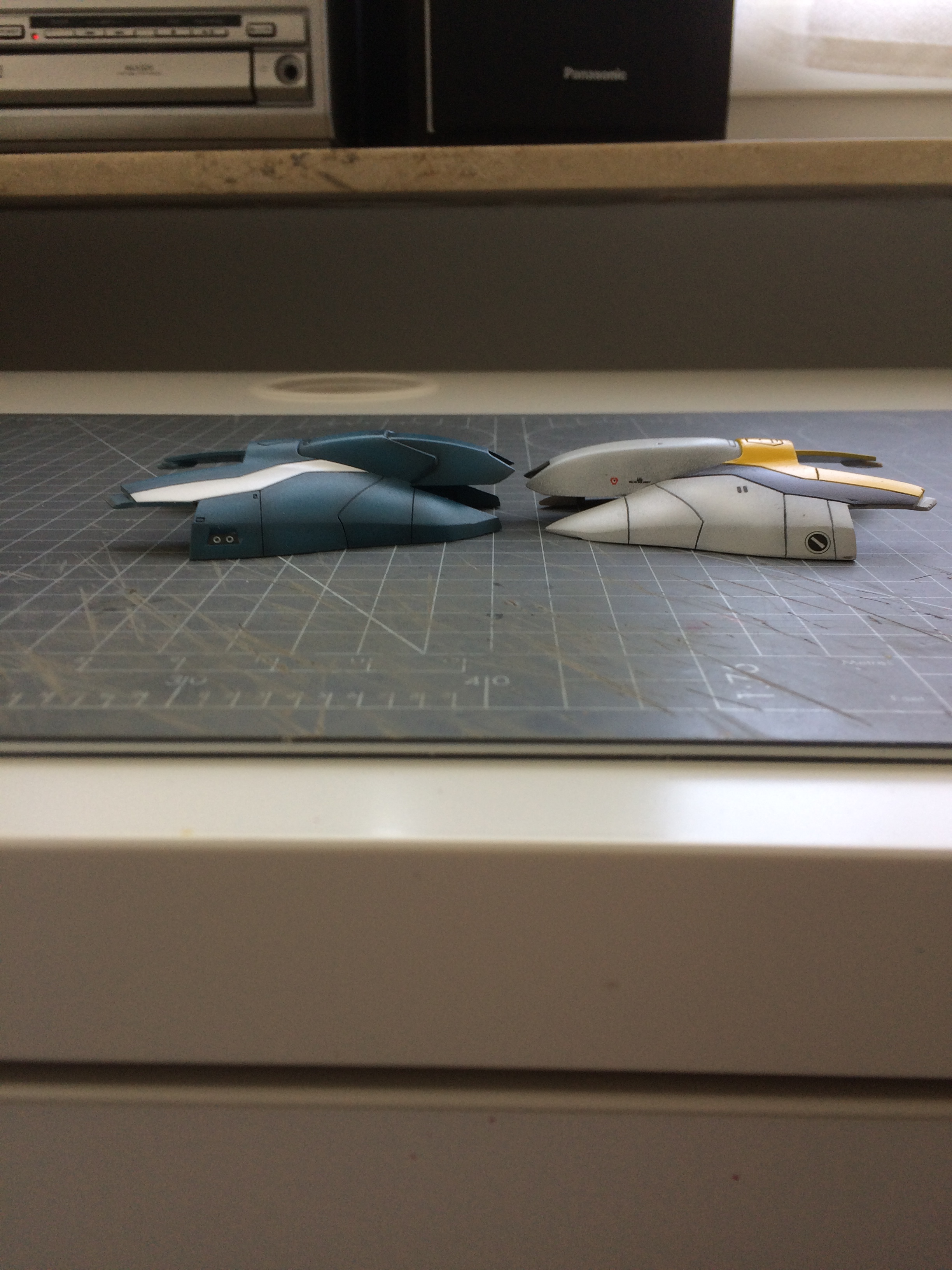

The concept works and the fighter mode looks slimmer already (the dorsal booster needs to be modded to be sitting on the wings).
With this mod, however, the arms end coming out too much from the back of the plane, and it doesn´t look as compact as with the current modification I did. See comparison, left old, right new:
Not sure what I think about it, but they look cool together!

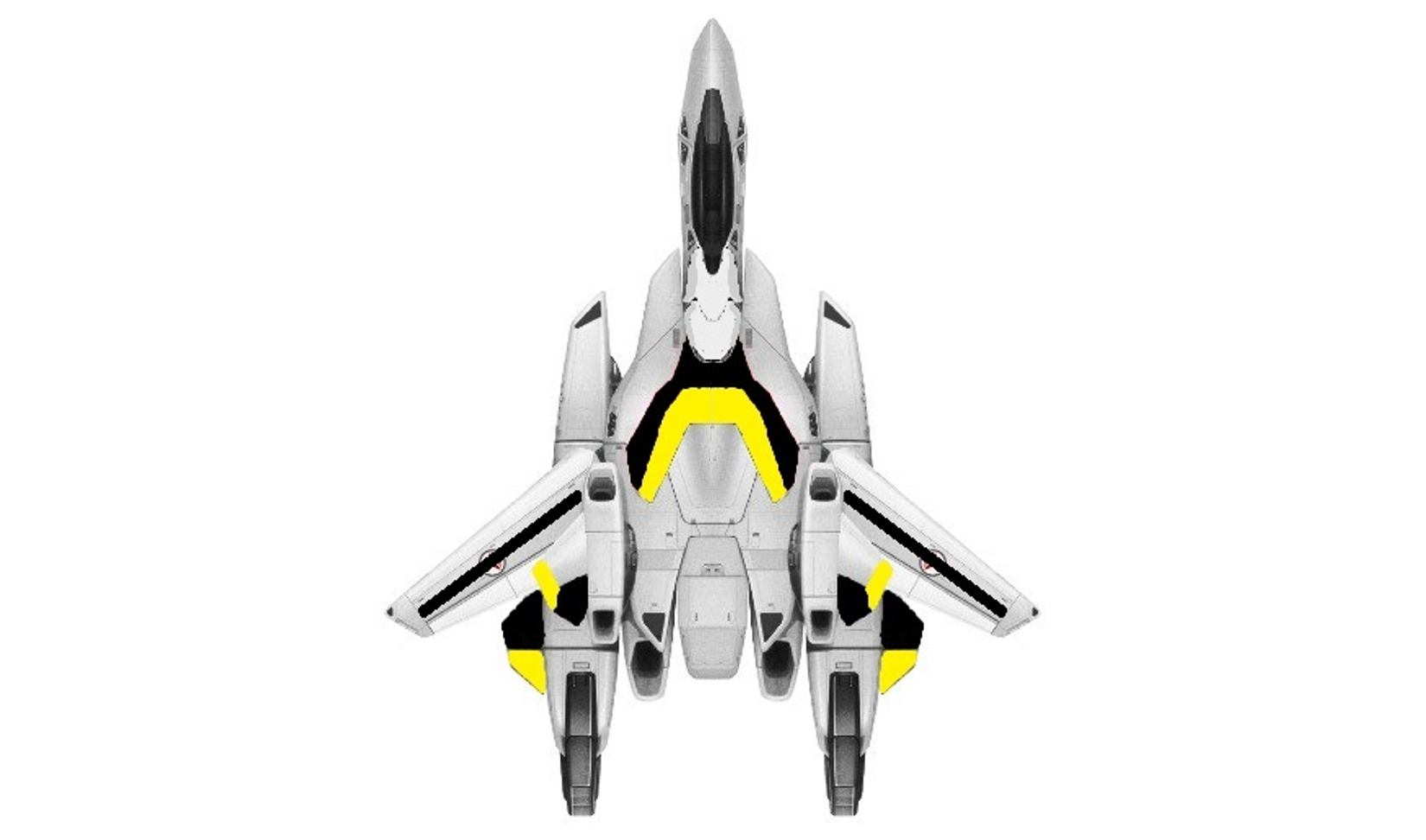

Also, had some fun trying the Roy paint schemes I had in mind :)

Both Mods look good from here, what a difference it makes when you put the legs in the proper position. I bought a  bunch of magnets a year ago to try the same Mod, but I was worried about taking the plastic apart and this was with the Silvie 2SS.

thanks a lot! So I'm slowly wrapping up this project, hope to finish in the next couple of weeks, and I want to recap the mods done so if any other want to mod their ET VF-2ss there is a detailed reference. Included in the pics below also the original toy. I'm doing a Roy colour scheme with a DYRL vibe so not all the steps are needed.
I apologize for the long and heavy post, hope it is ok for the moderators.

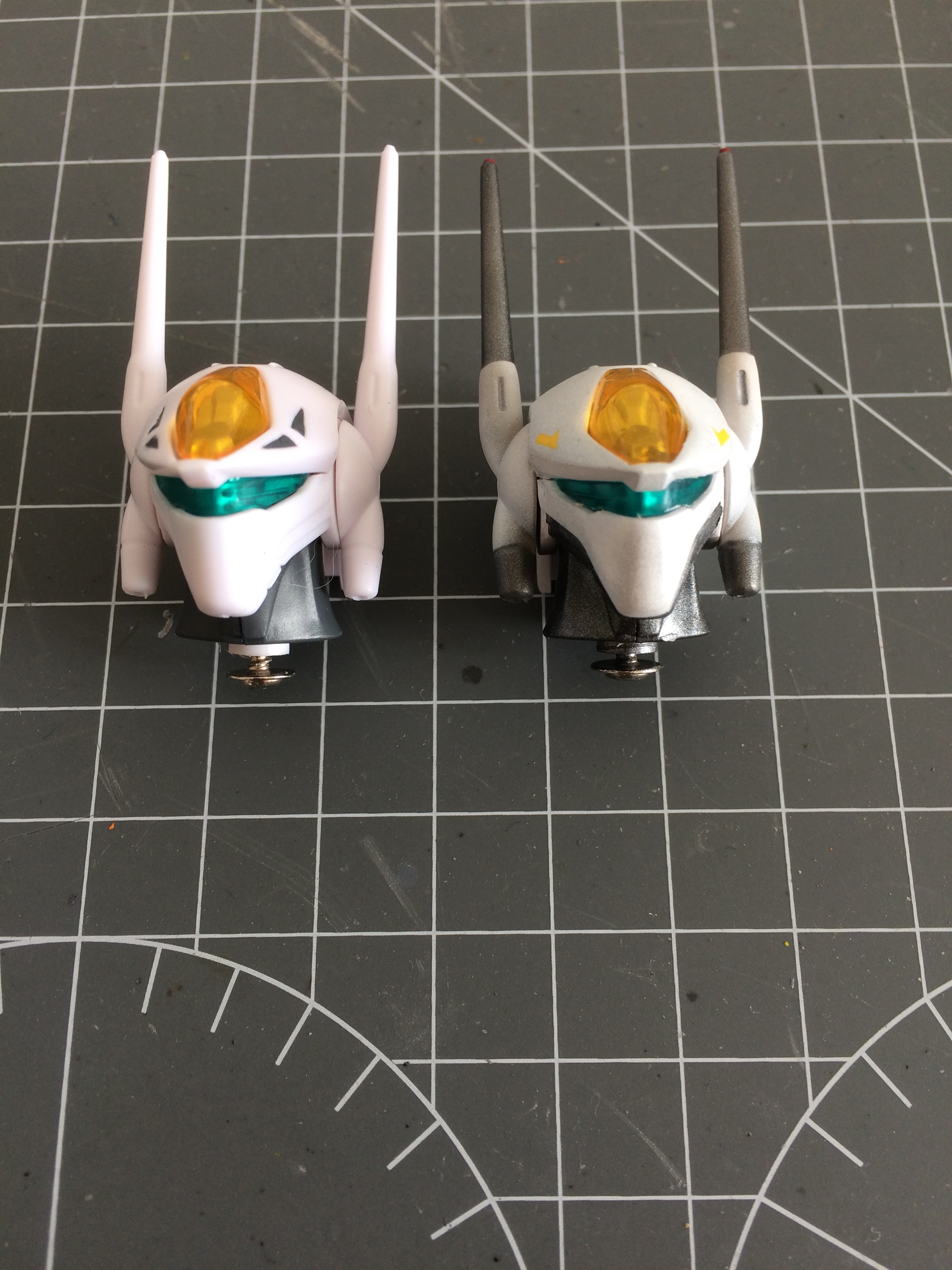

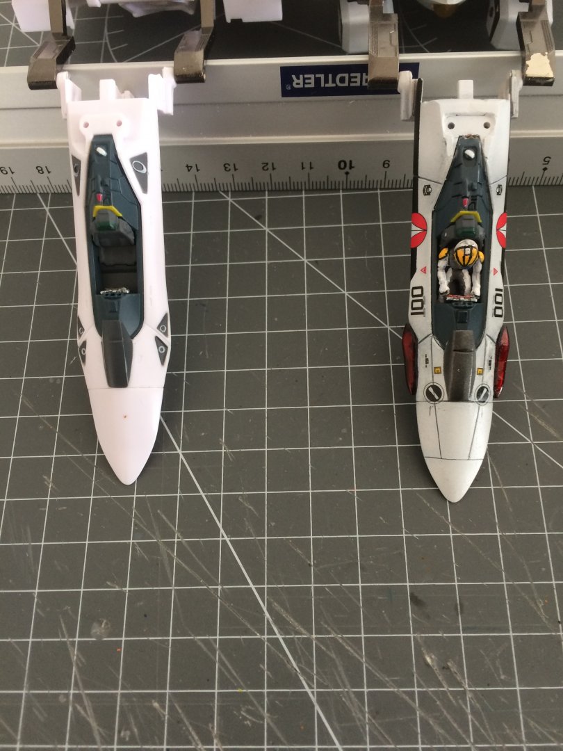

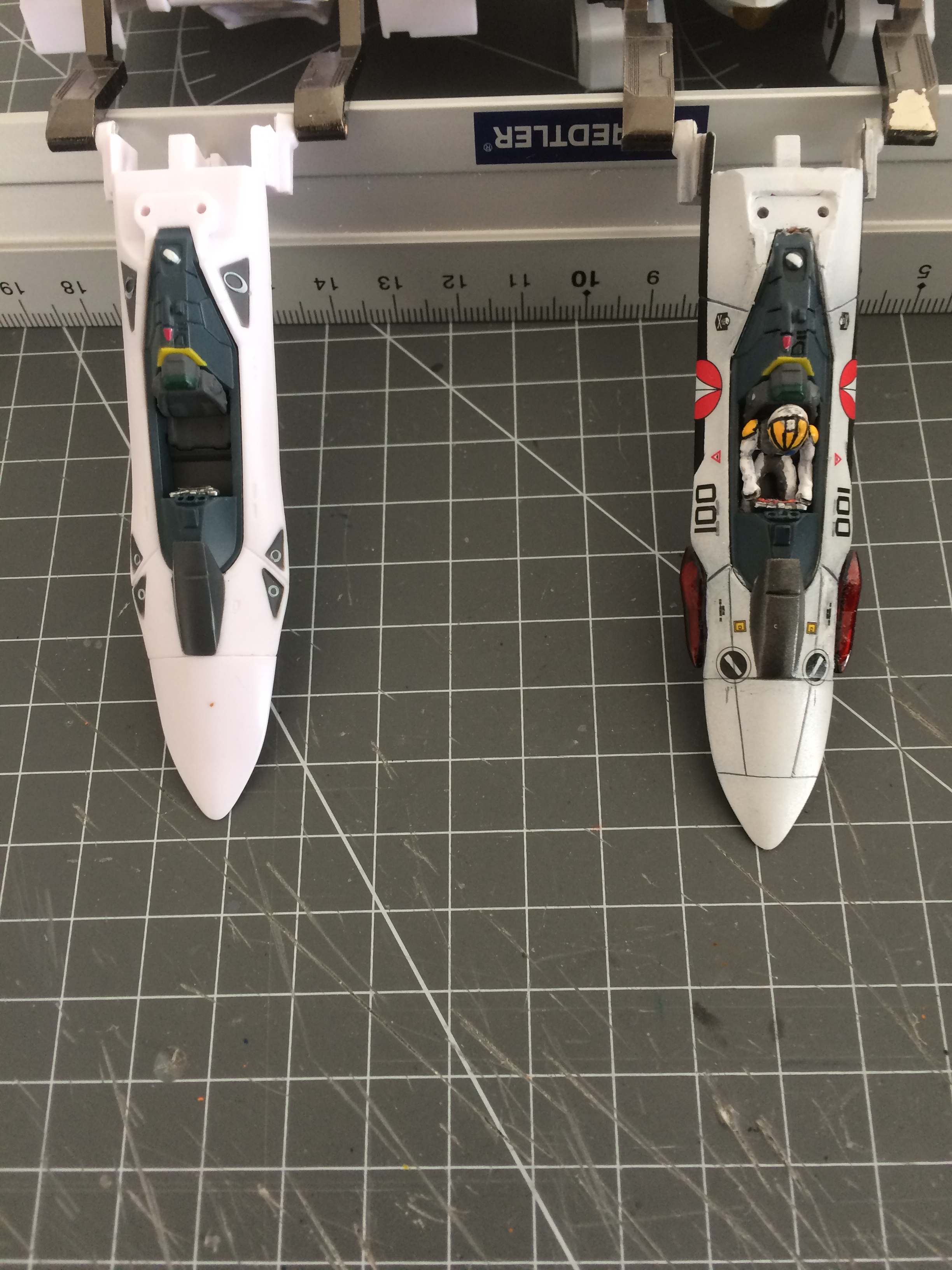

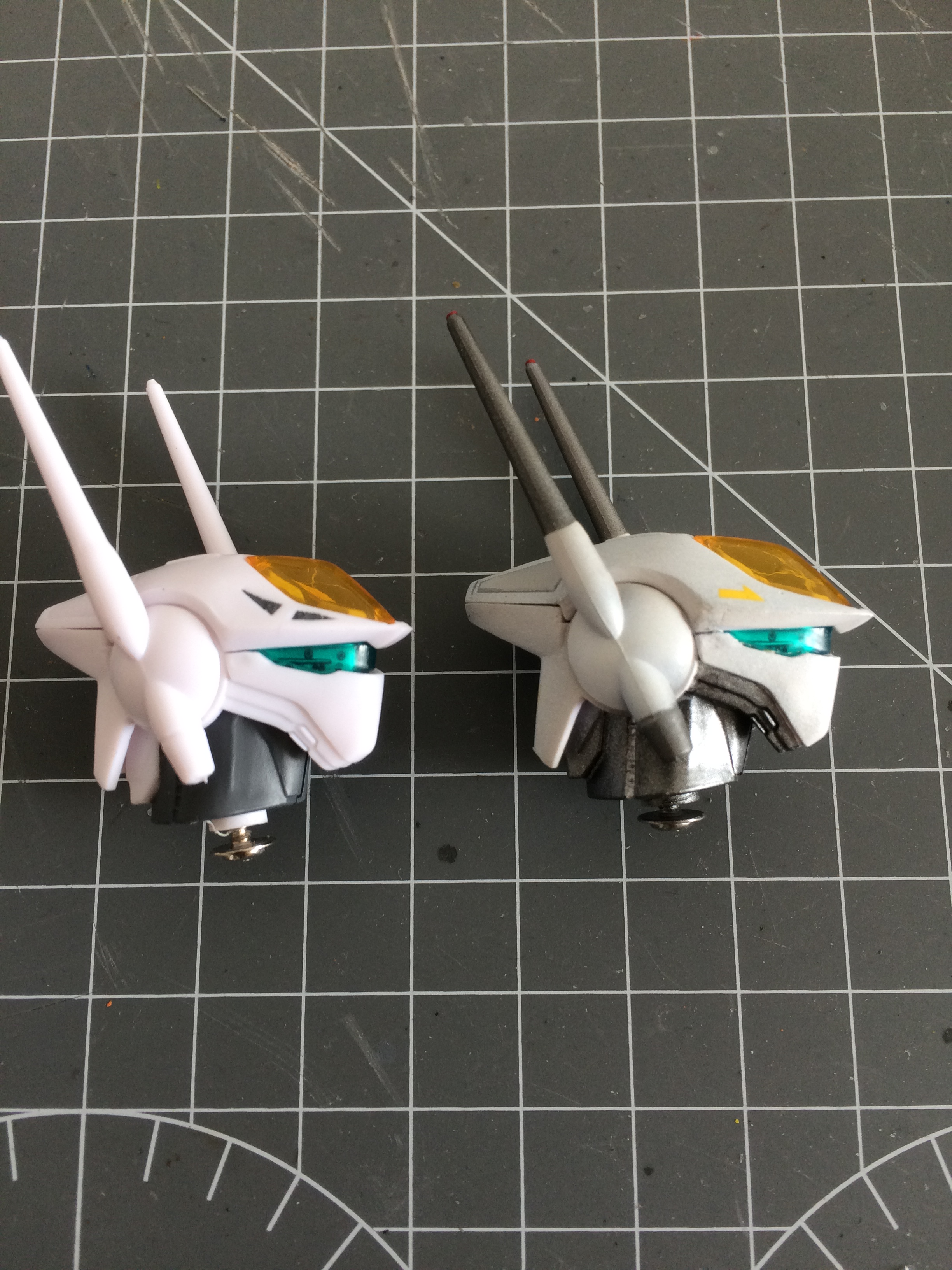

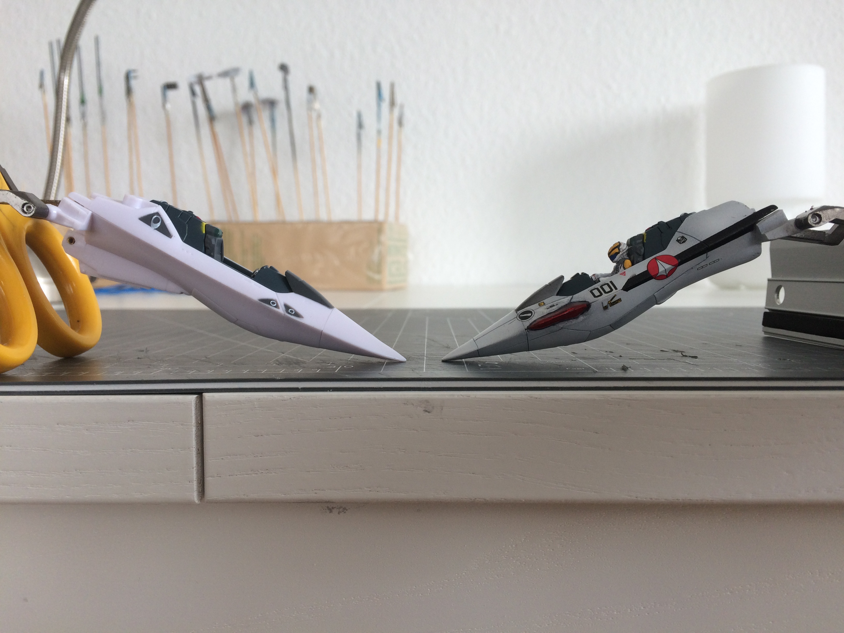

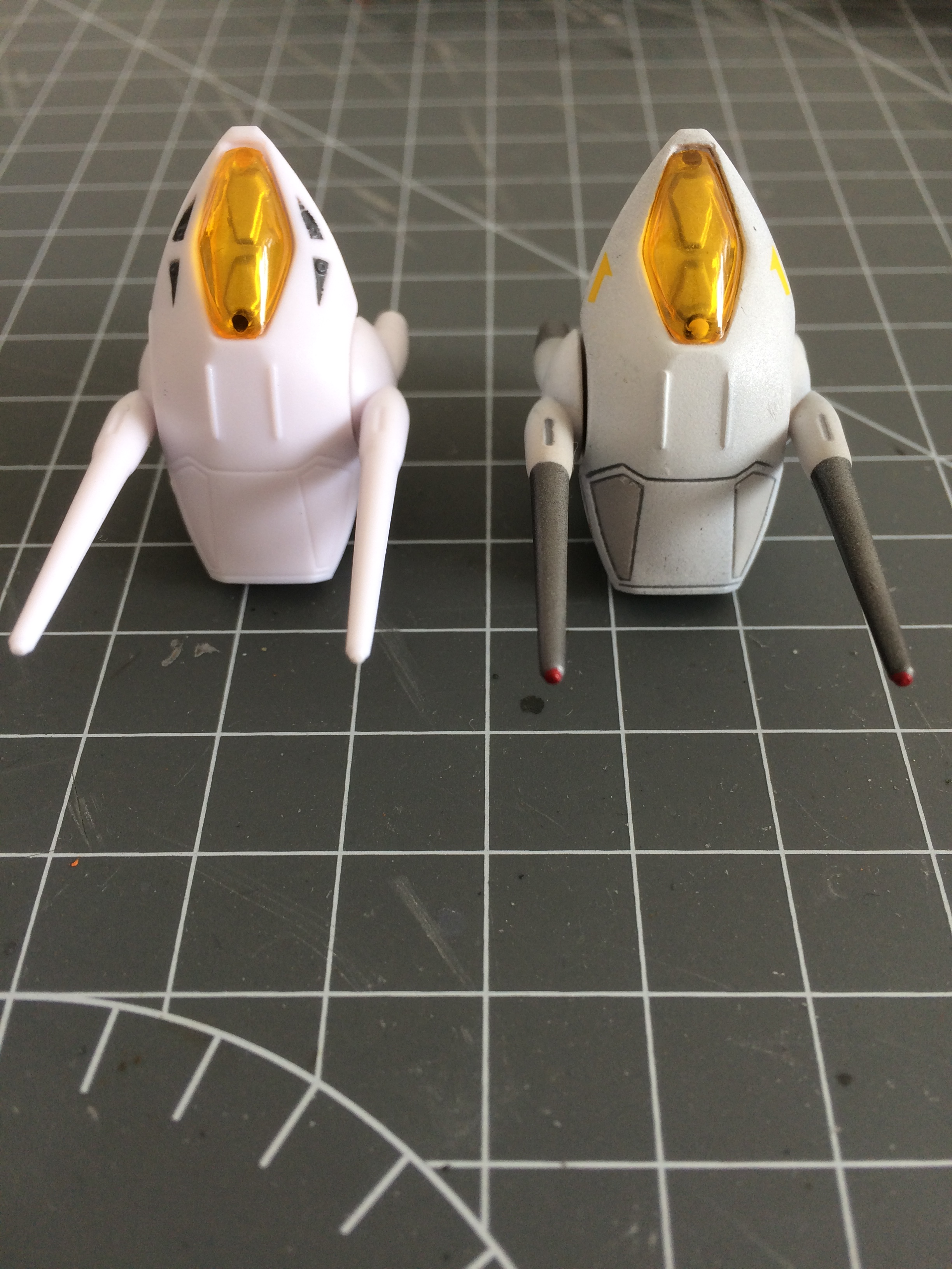

1 - Head
Remove the small thrusters, fill with epoxy putty and recolor the face to give a slimmer profile.IMG_0843.thumb.JPG.feba2a99272da635d592f7c462aab3ad.JPGIMG_0845.thumb.JPG.14946c28293380398ebea6f3f0ef0681.JPGIMG_0846.thumb.JPG.3c50f8536140763811b2972867391100.JPG
2 - Backpack
made shorter removing also the central part (full section with the pegs is gone, also the inside needs to be partially removed to allow the backpack to be able to close for battroid mode). Tail re-shaped to match the profile of the head.IMG_0847.thumb.JPG.564bce2843fa9feb0da5a7dbf657c082.JPG

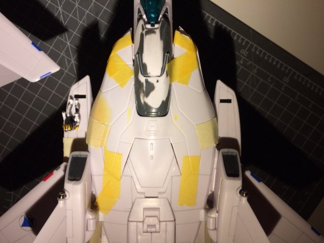

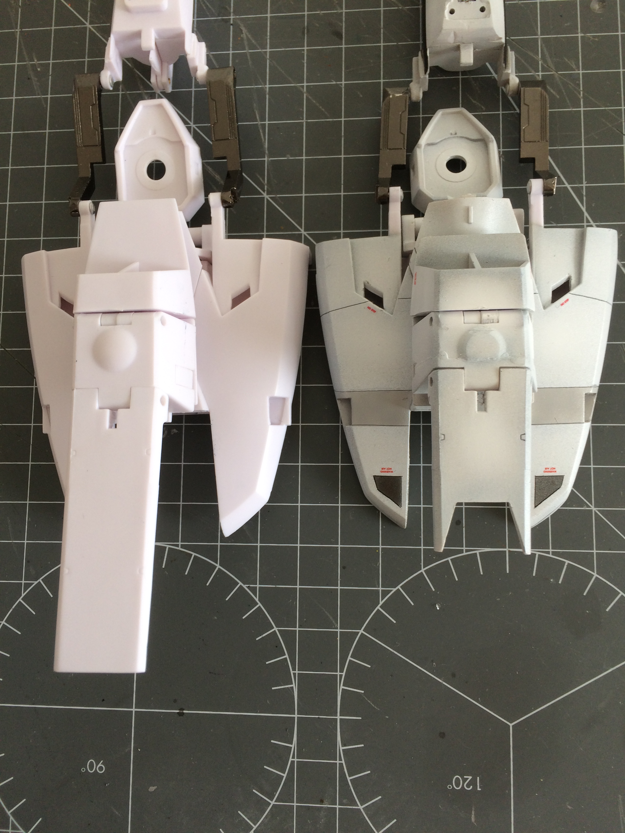

- Body

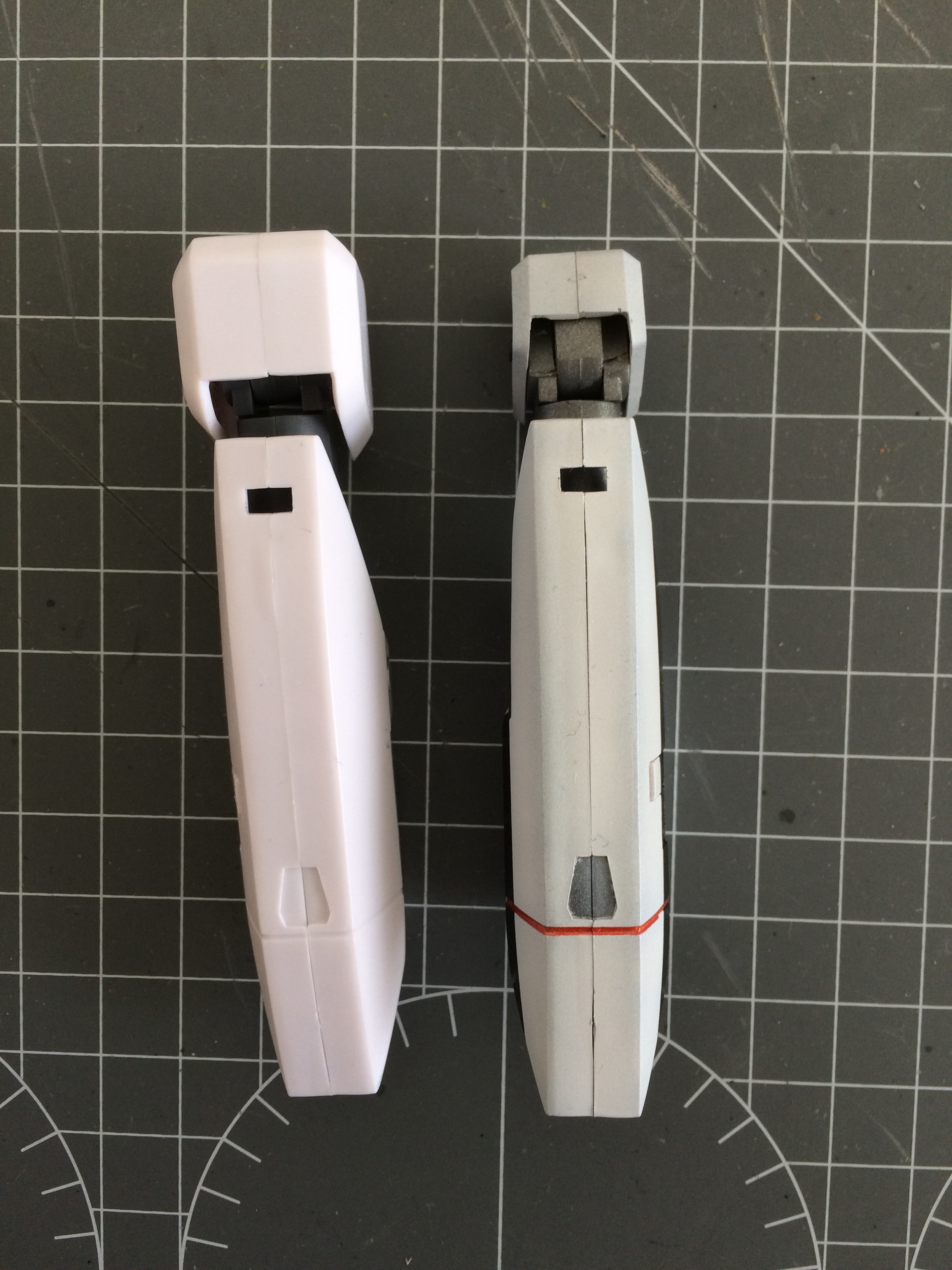

All sanded 1.5 mm to make it look slimmer, same for various pegs. The internal cover now sits over and not inside as before.
- Lower  Leg
Added panel lines.

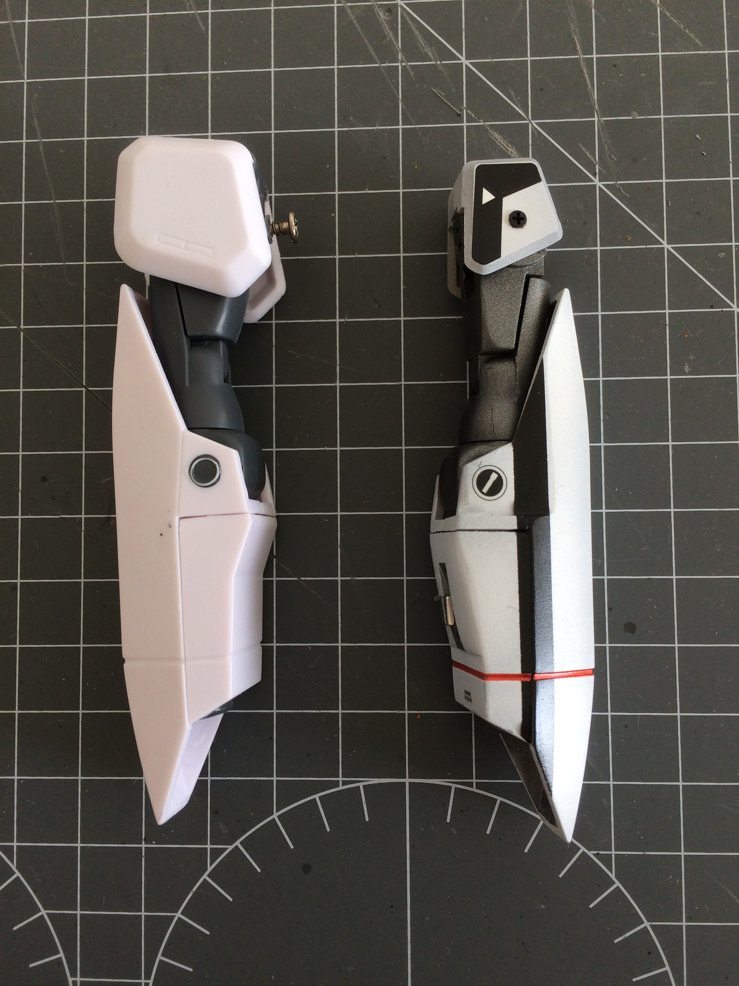

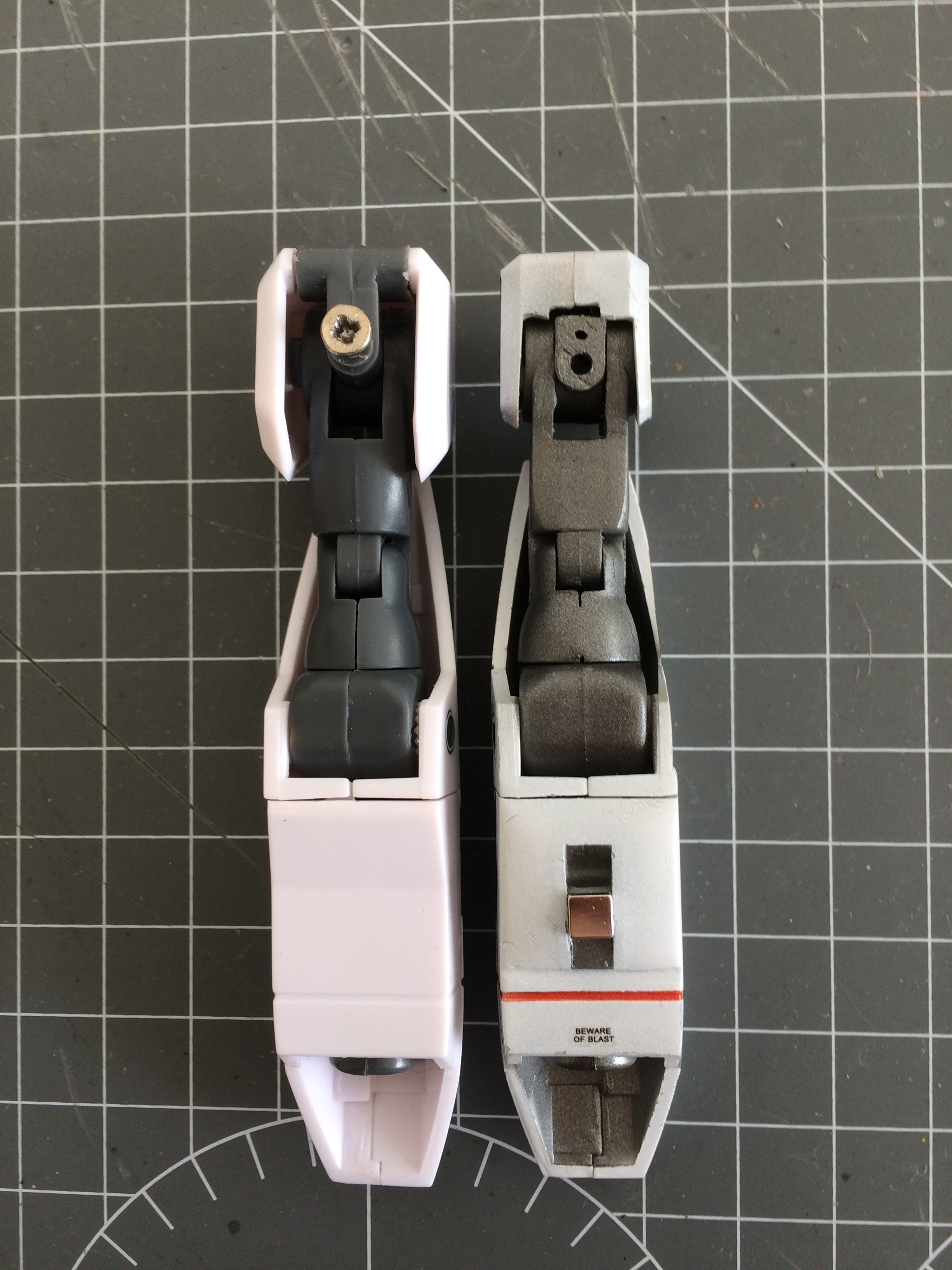

- Arms and Shoulders

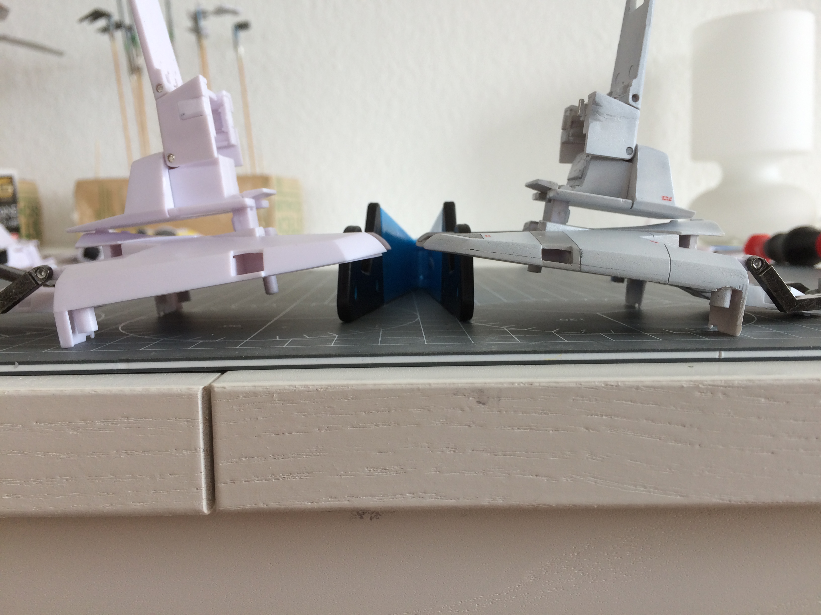

Completely new shoulder (based on Hasegawa battroid kit, the screw allows rotation) armor and the shoulder joint cutted down to minimum. Upper arm sanded more flat and filled with epoyz putty. Lower arm sanded in the front part (the one that is on the inside side in fighter mode) near the elbow to accomodate the backpack as they will sit higher close to the body. added magnets to lock to the body and around epoxy putty to make a more natural profile. Added macross screw for DYRL vibe.
IMG_0851.thumb.JPG.a4d48165d8bab79347336d9aef4e2b6a.JPGIMG_0852.thumb.JPG.7e980dafded6e3e034561920b08c7923.JPGIMG_0853.thumb.JPG.0782a1dc493971cd4583950df112cfcc.JPG
- Body part 2
massively redesigned connection piece body-arms to allow new position. Shoulder attaching point sanded and cutted to do not crush against the chest piece and body intakes.
- Chest piece
Added panel lines, removed thrusters and filled with epoxy putty, shield made a 1 piece with epoxy putty, added macross screws.

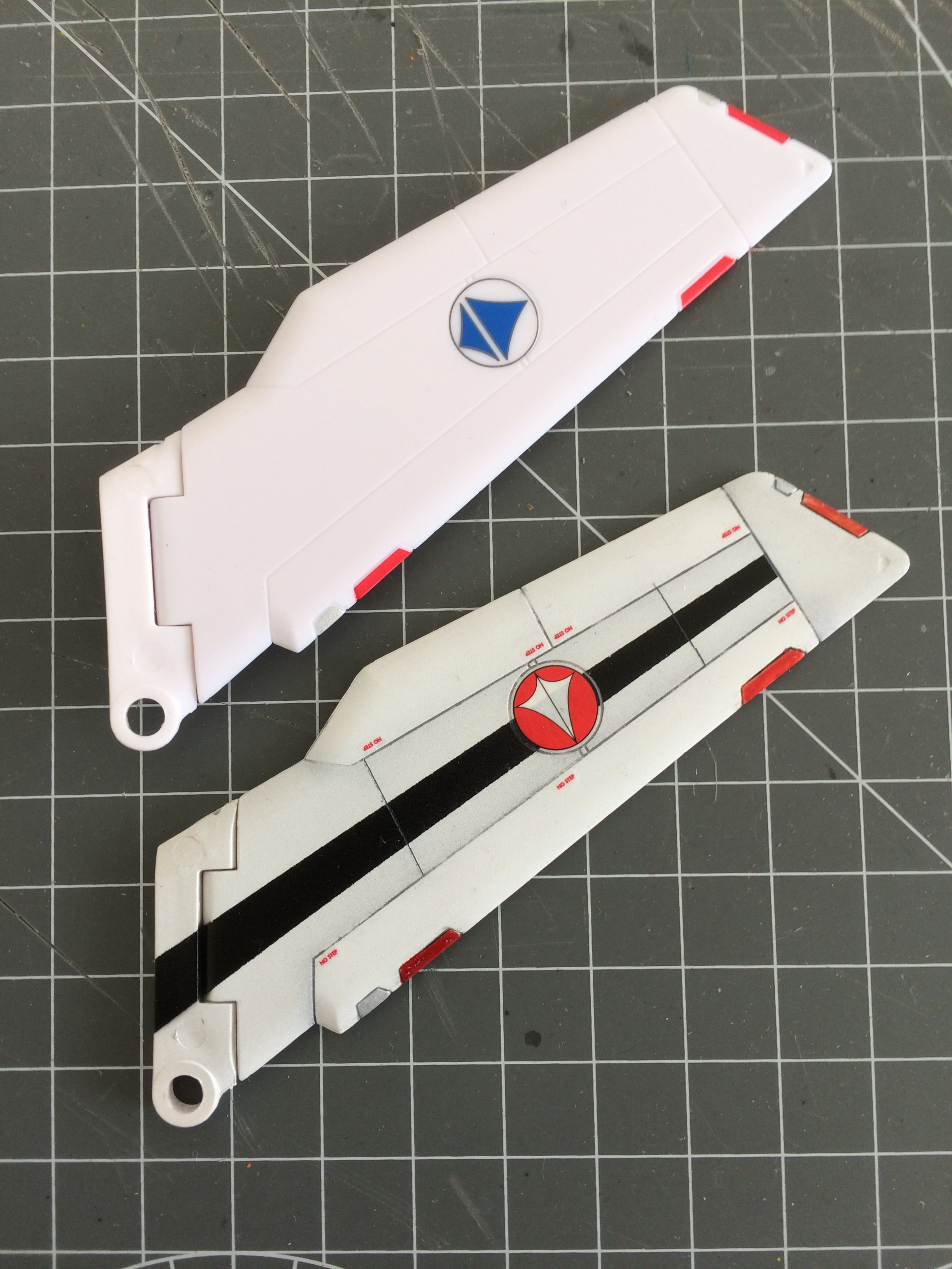

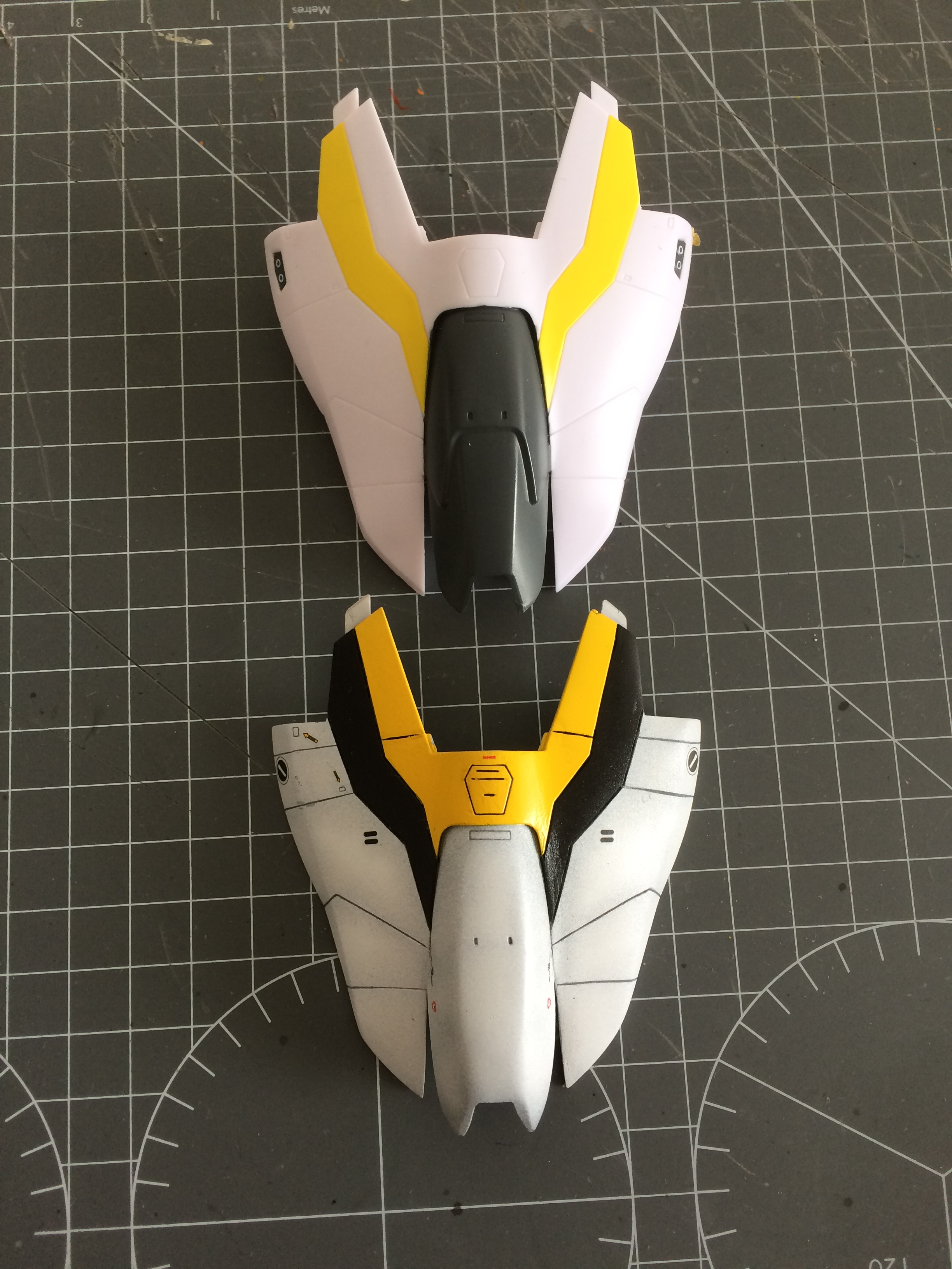

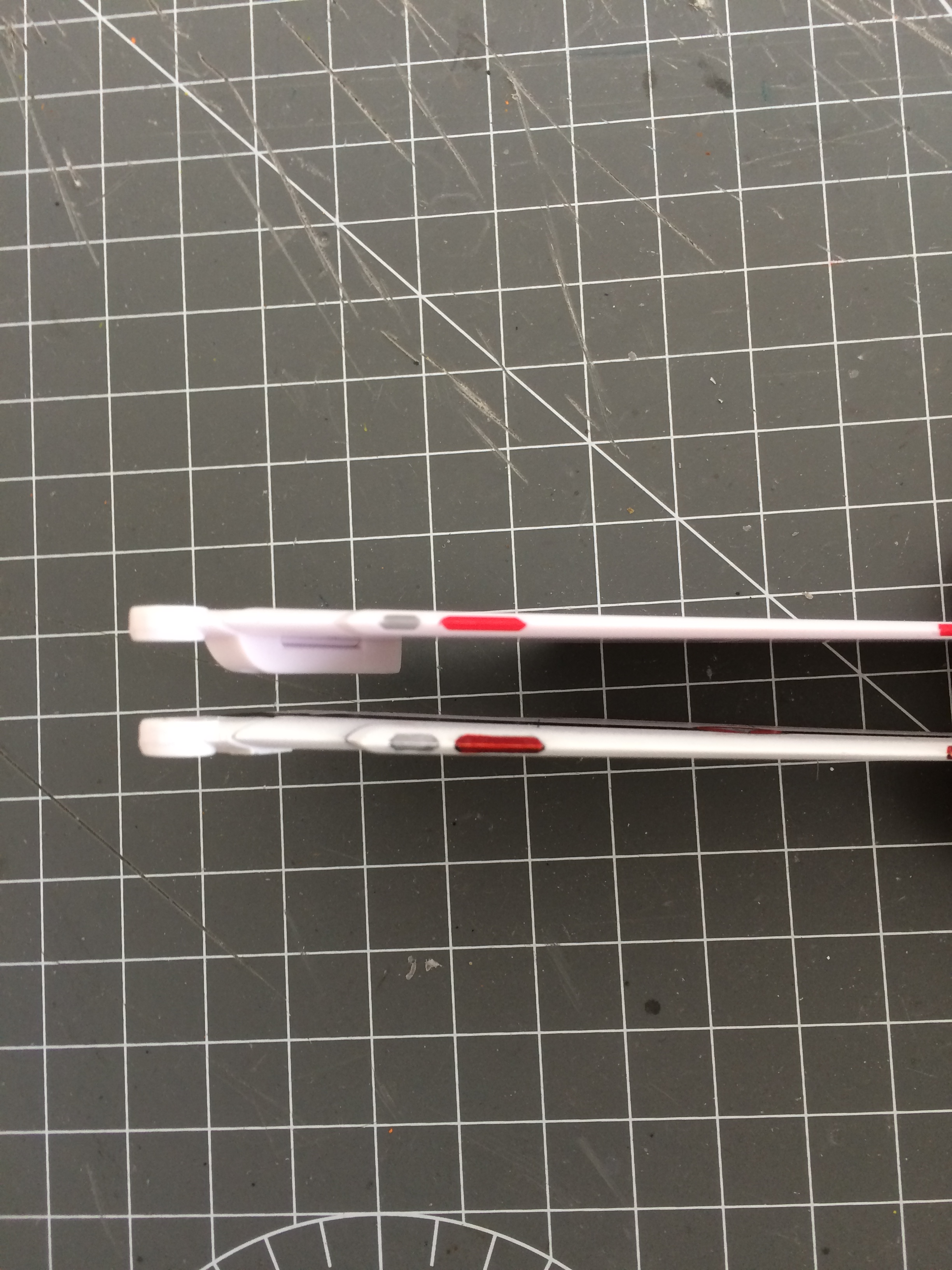

- Wings
Sanded to be flat and panel lines added.
IMG_0854.thumb.JPG.64d1f9f53c3b27df1fad1cf538cc2beb.JPGIMG_0855.thumb.JPG.97f73e2e29e89759727841a30eefeb08.JPG

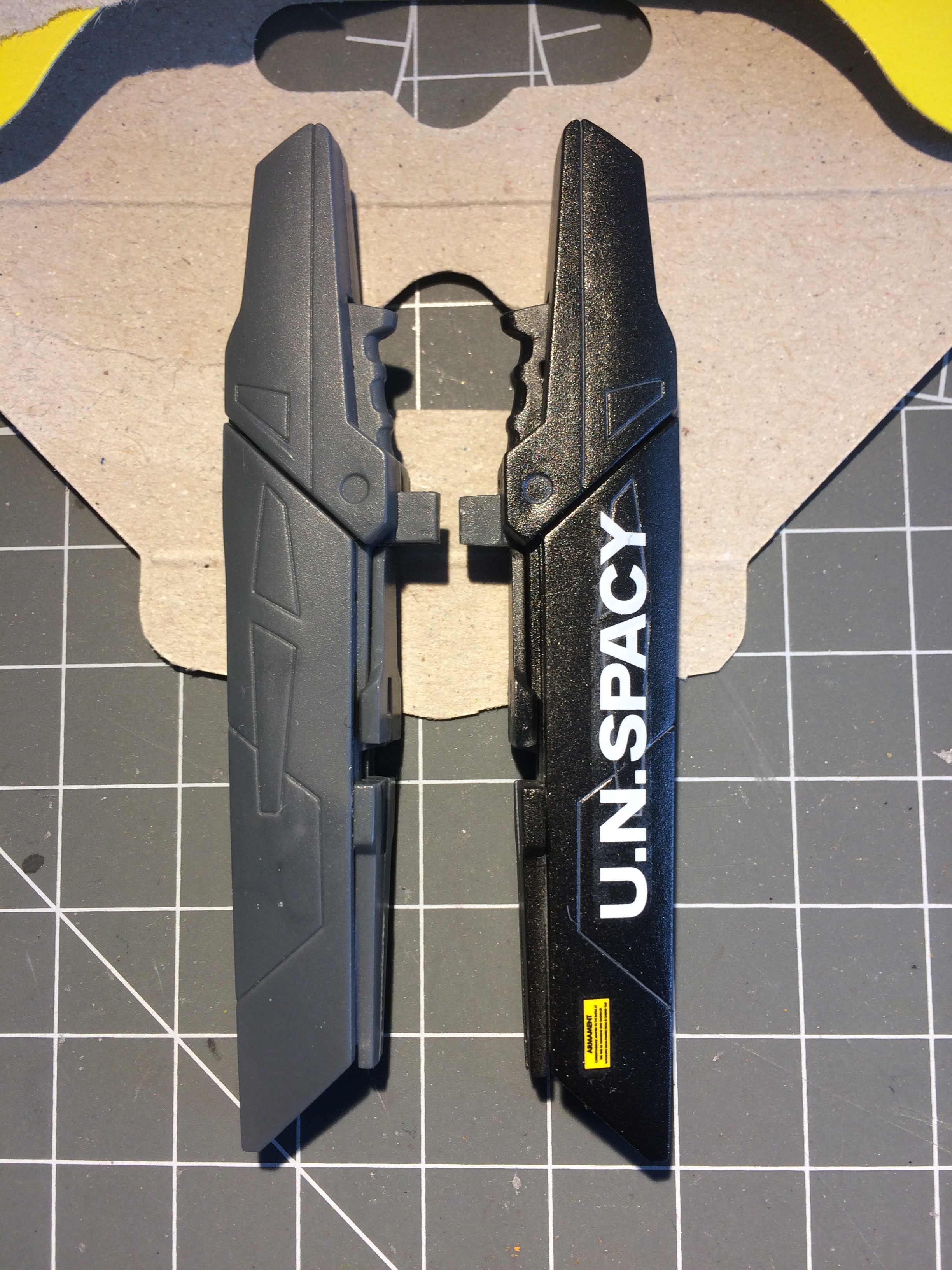

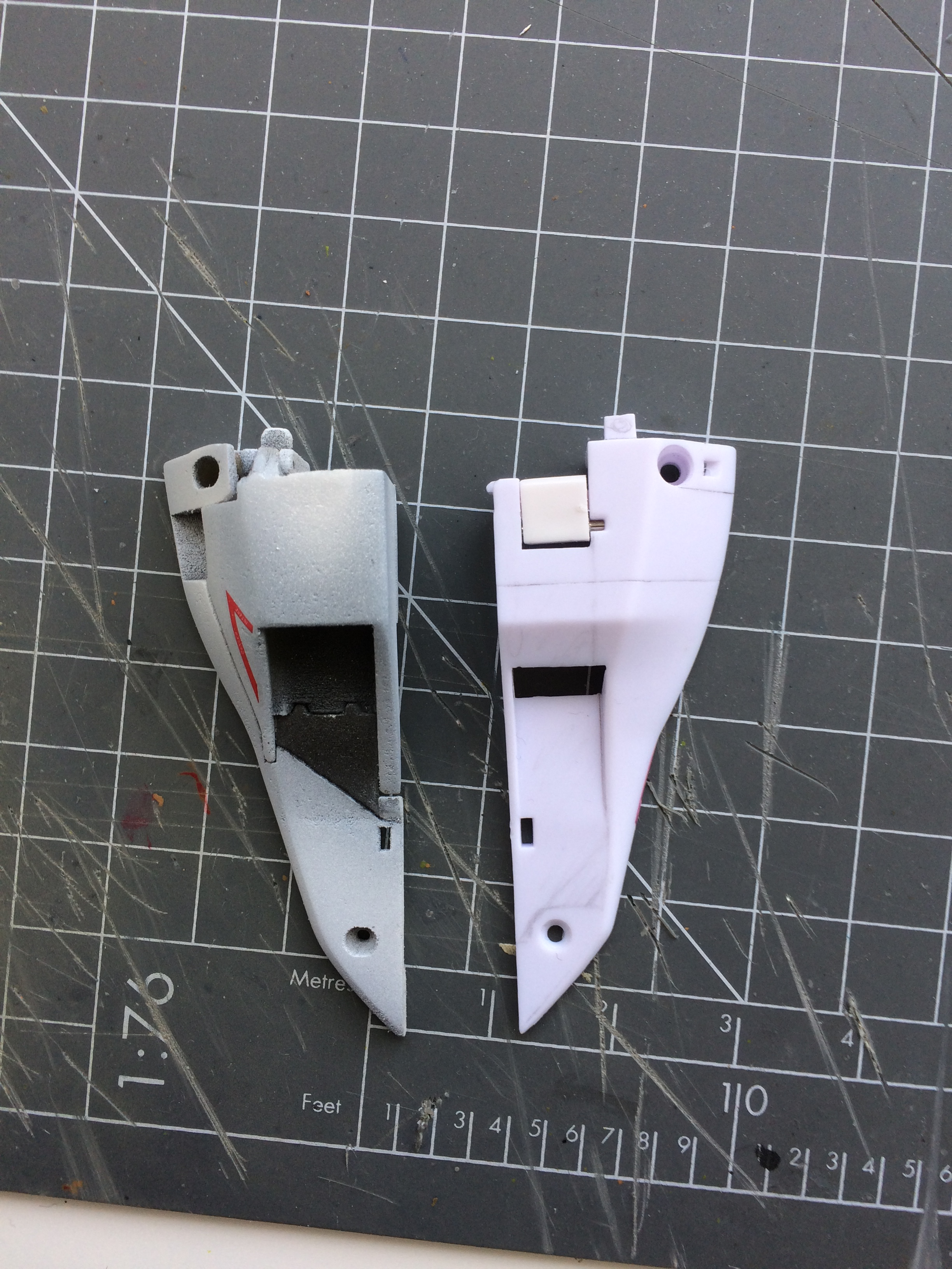

- Dorsal Boosters
Intake and exaust cutted to make them shorter. Connection piece cutted and reglued to be able to enter in the hole in the body (after the mod it is less wide) and have the boosters closed to the body. Added detail.
IMG_0856.thumb.JPG.e1b34853f978cc542bdd37f279c095cb.JPGIMG_0857.thumb.JPG.881a0c633475c63337925f7a2988ae7d.JPG

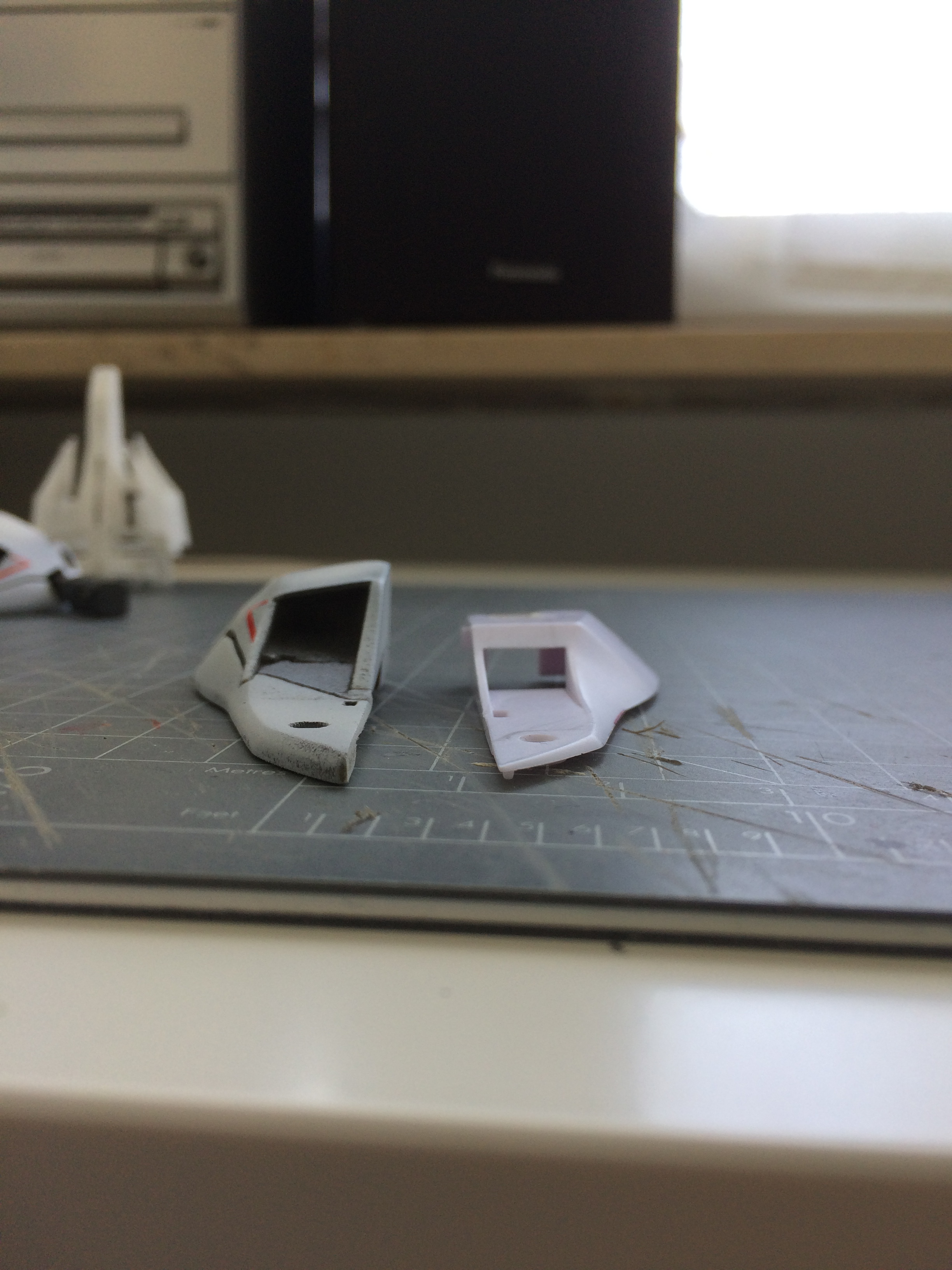

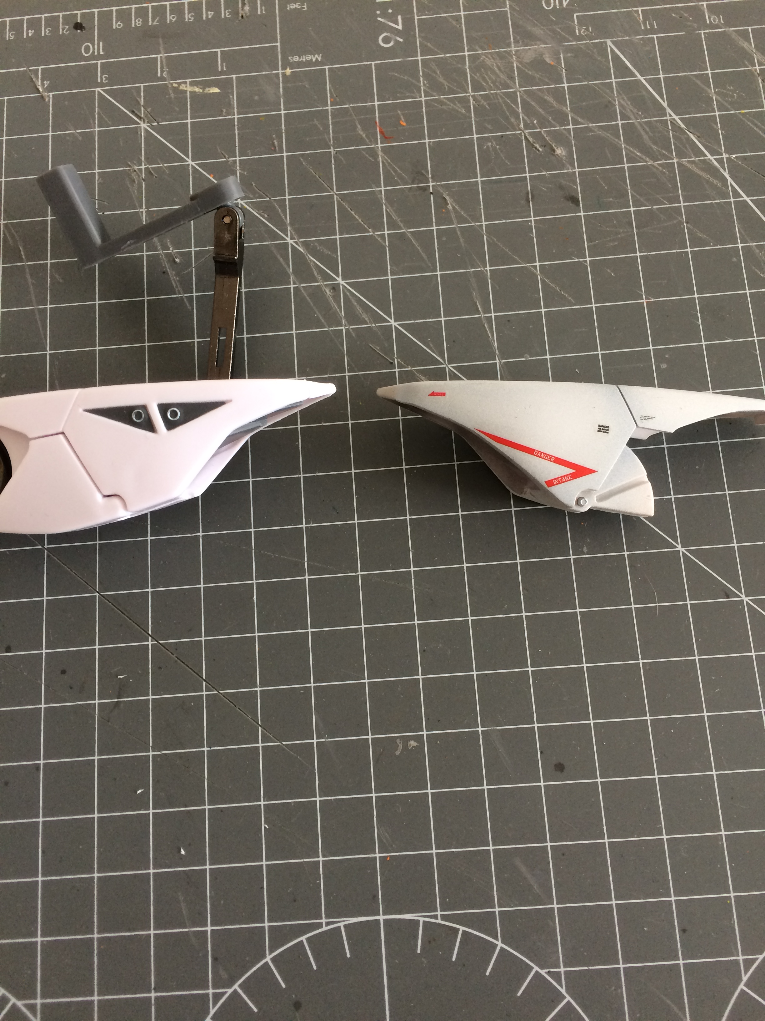

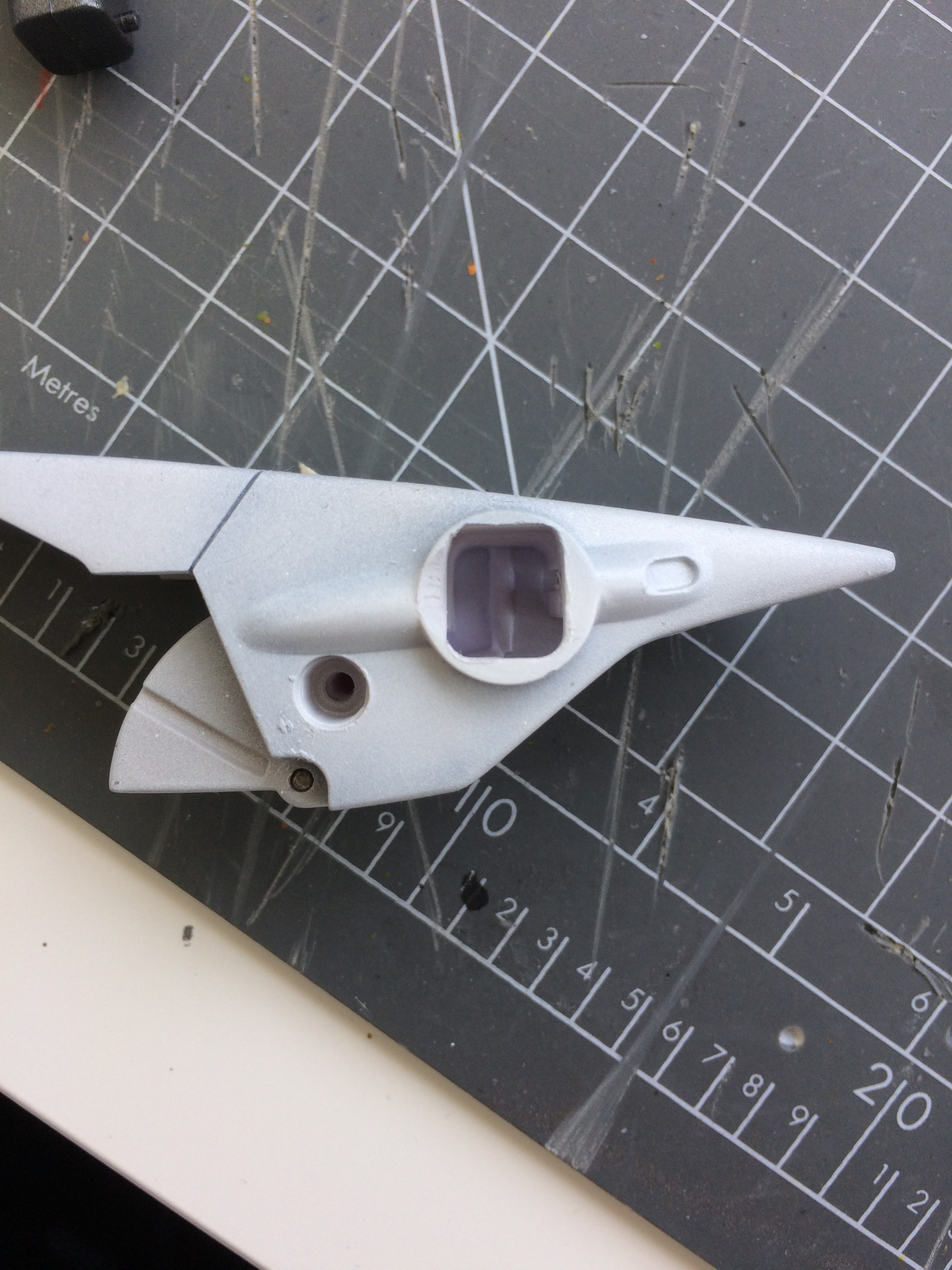

- Leg Intake
Again, removed the thrusters and filled with epoxy putty, as well as other holes. Added details ad per lineartIMG_0860.thumb.JPG.db29555a2a6b7e4655dbb65810482812.JPGIMG_0861.thumb.JPG.d867f89e34a5d869d60617e7396fdcca.JPG.
That's all for now, tomorrow I should be able to post the nosecone.
Cheers!

- Vertical Stabilizer
Added panel line to be able to have a 2-colors color scheme
- Gunpod
Attaching peg sanded down so that it cansecurely attach to the backpack while in figther mode
- Nosecone

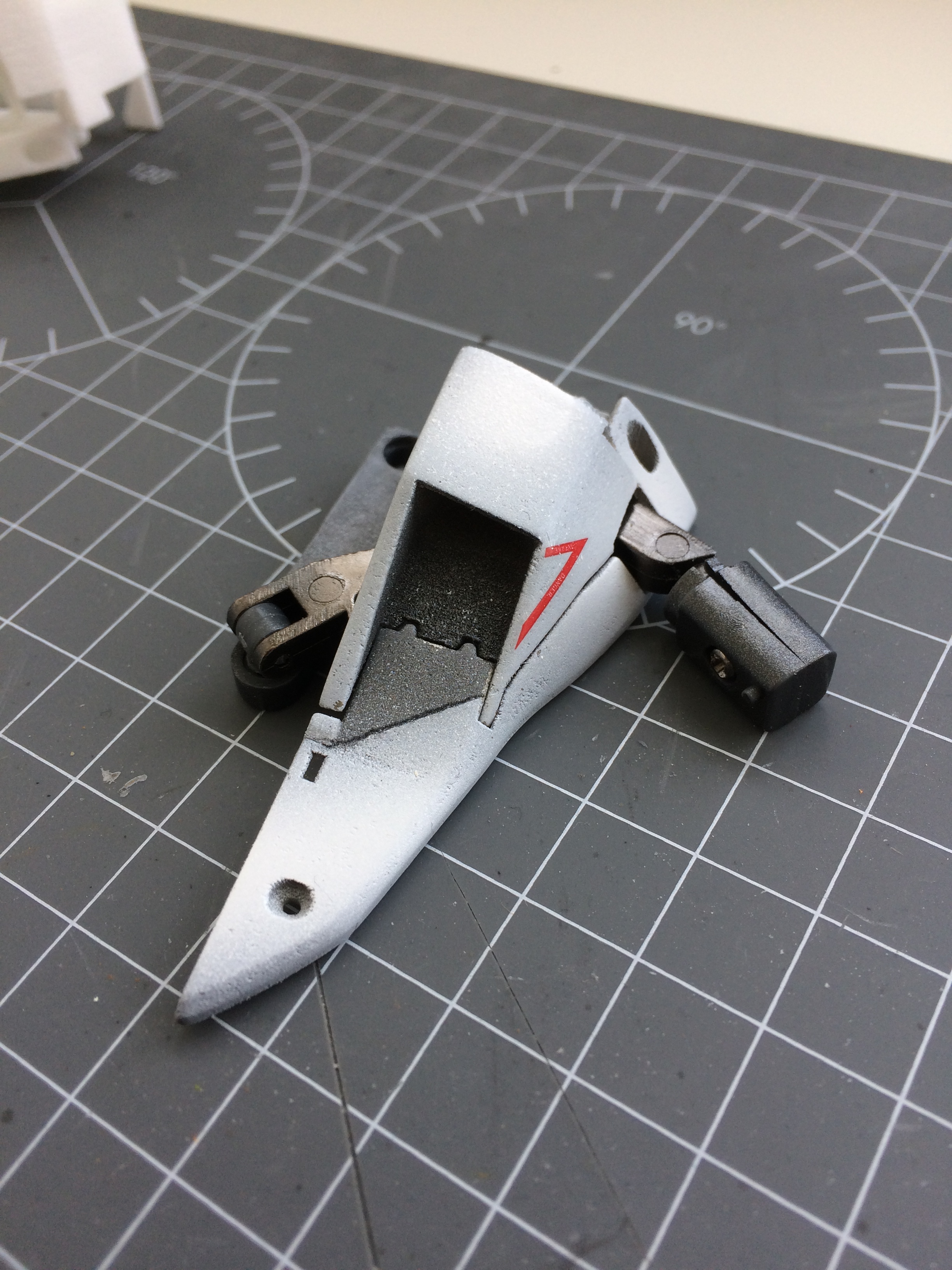

ventral fin removed, remaining gap filled with epoxy putty.Also here, removed the trusters, fill with epoxy putty and added macross screws. New panel lines and sides carved to be able to allocate red clear visors (from hasegawa yf-19 kit) as the vf-0s (i love the red visor). Epoxy putty also used to fill the back of the nosecone so minimal gap will be perceived against the heat shield while in figthermode. Pilot recoloured.
that's all for now :)

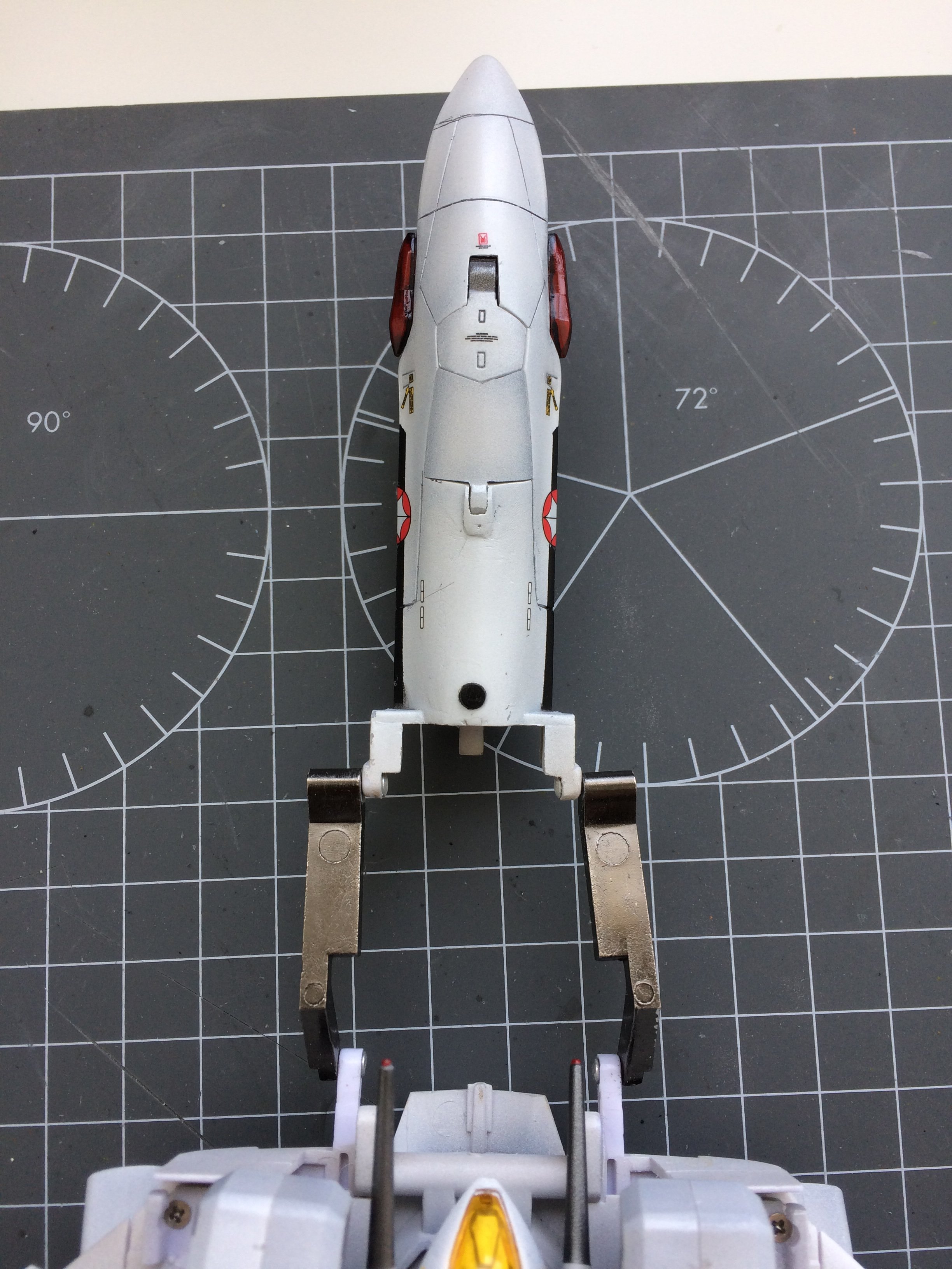

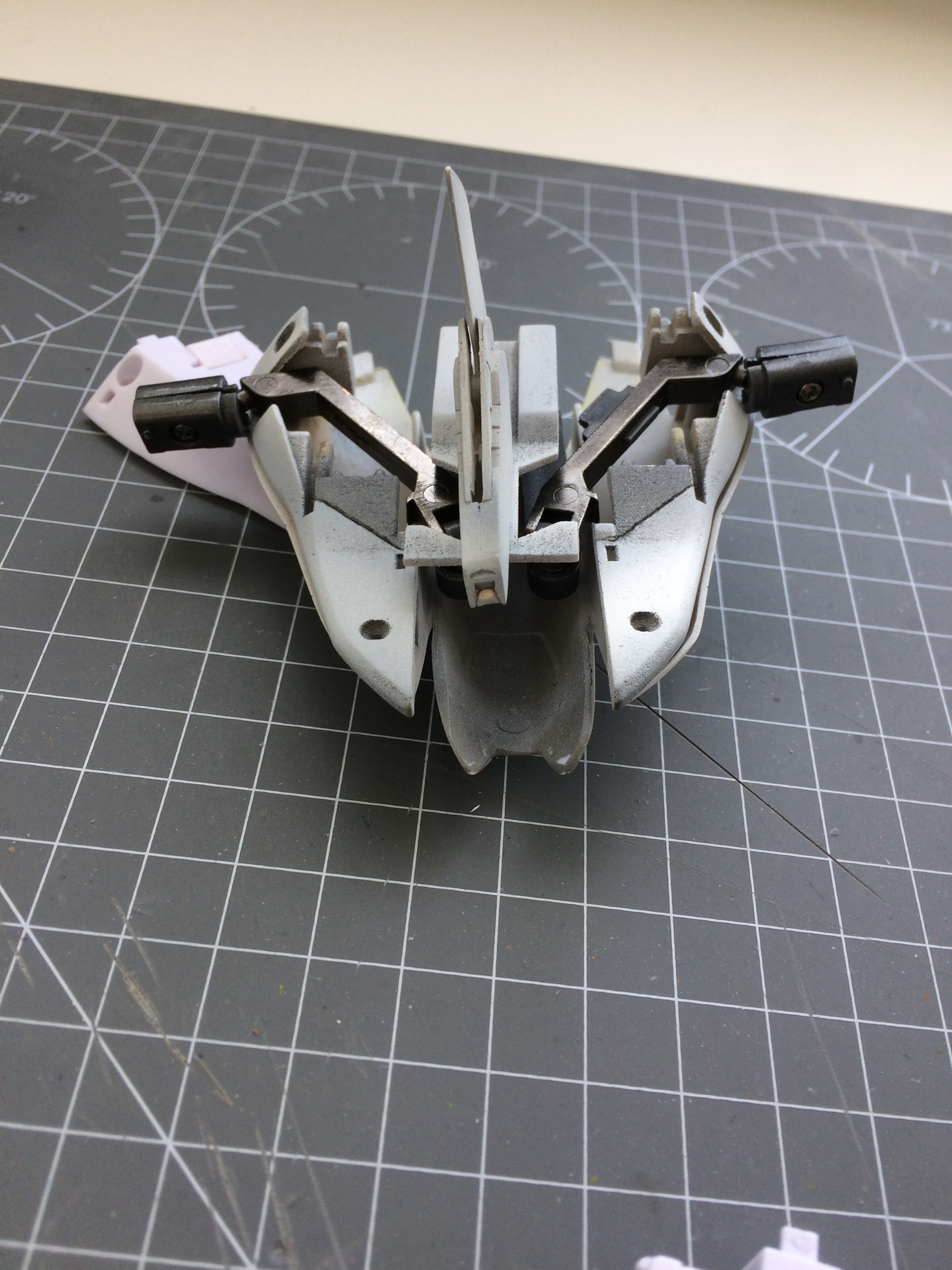

and now the last set of mods regarding the repositionin of the legs and in general the under part of the front of the fighter.
First of all, thanks a lot @Xigfrid that helped me out with the 3D design of the new pieces, really great member of the forum with true passion for macross stuff!

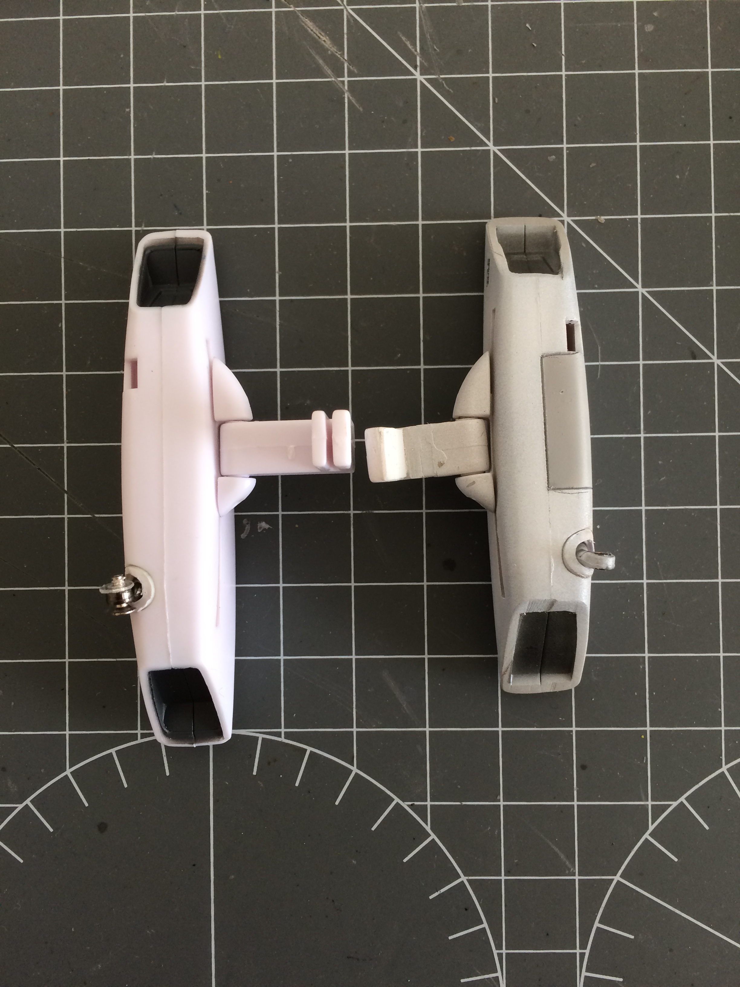

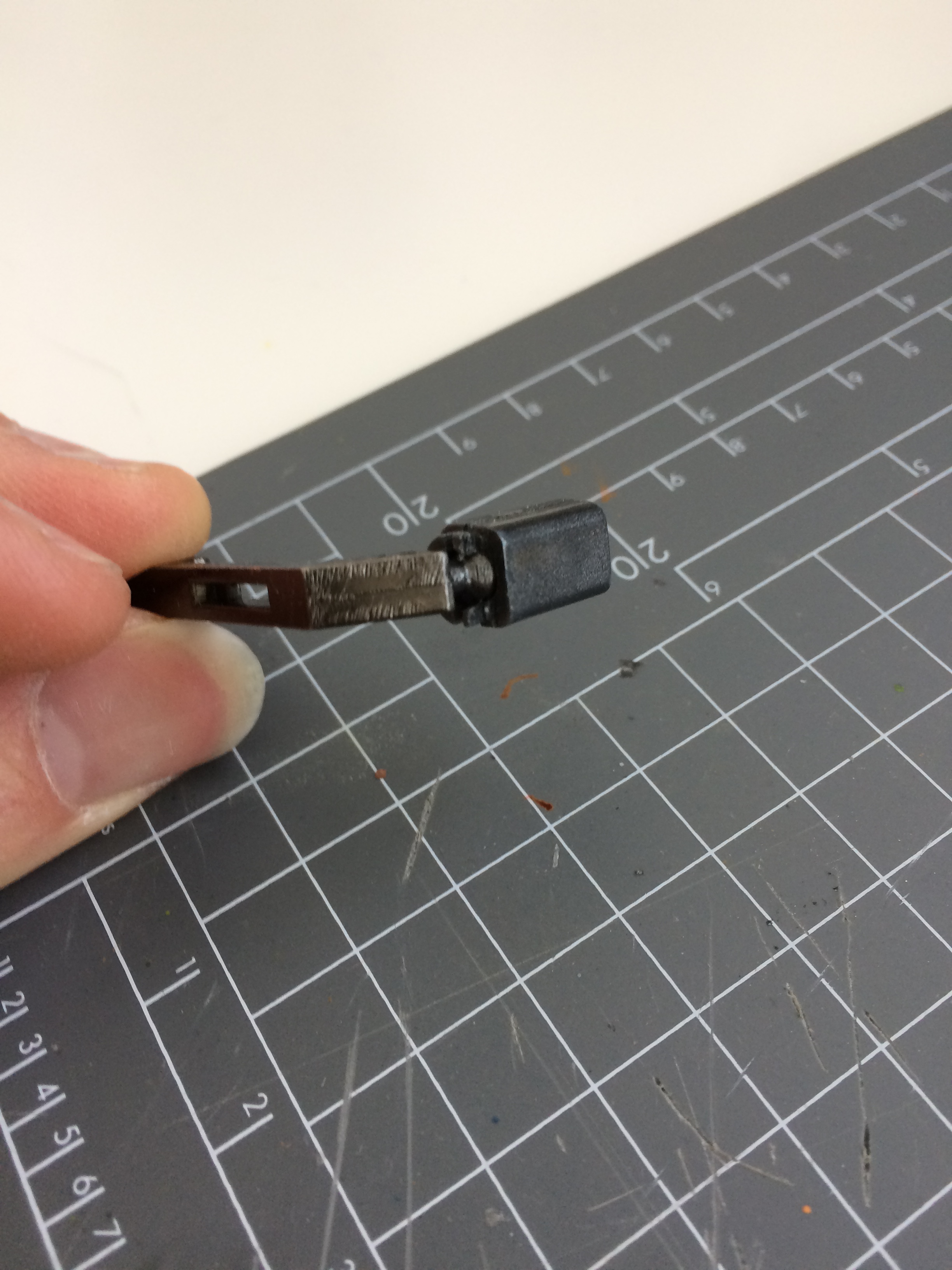

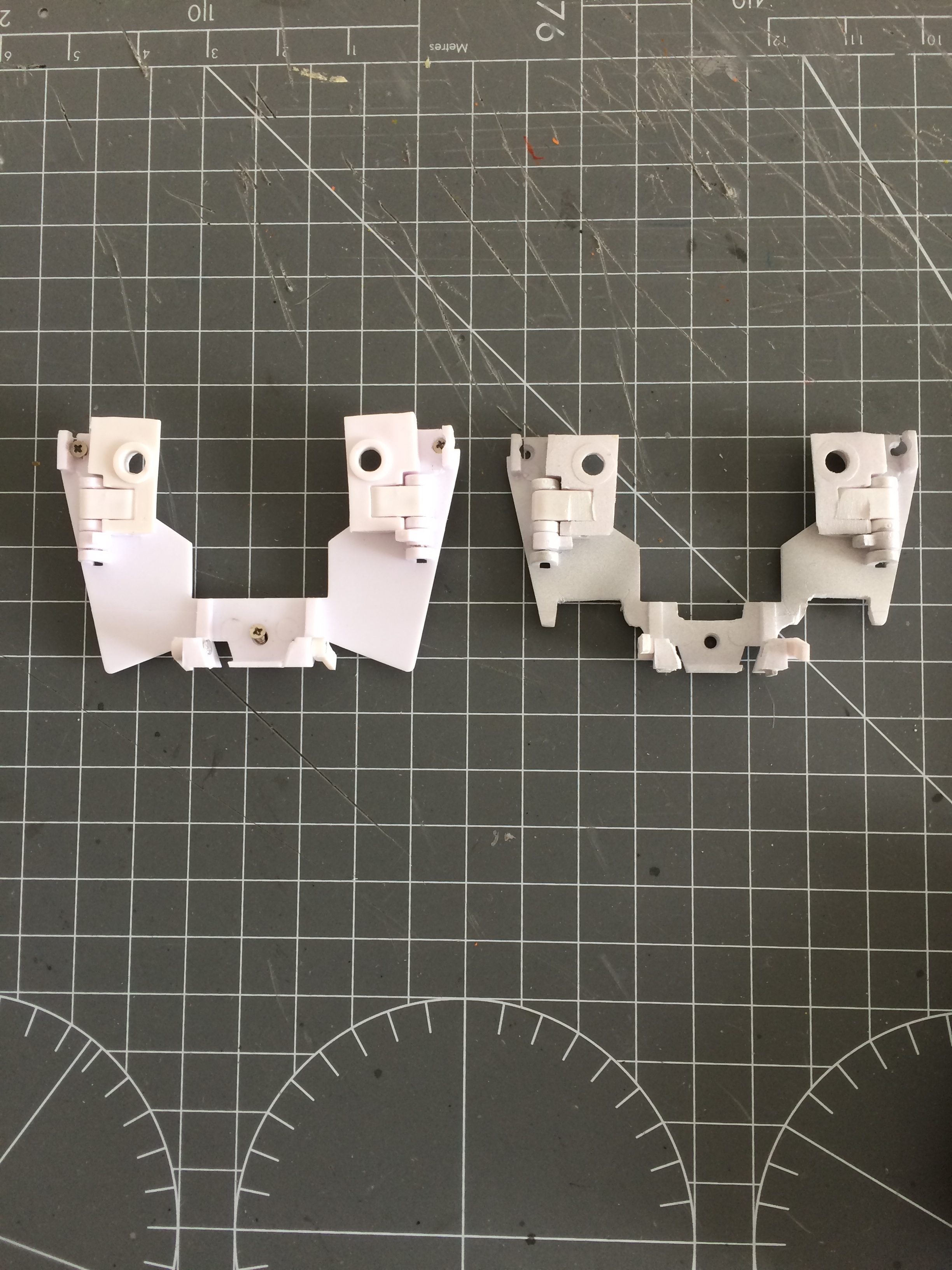

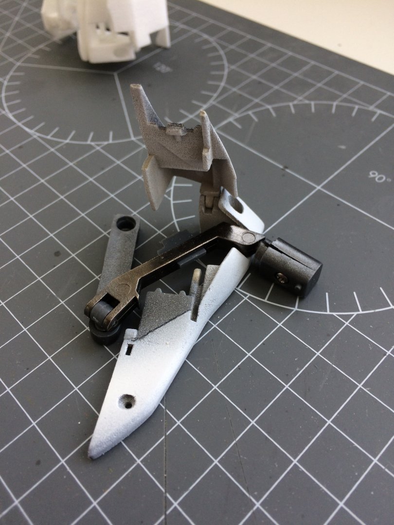

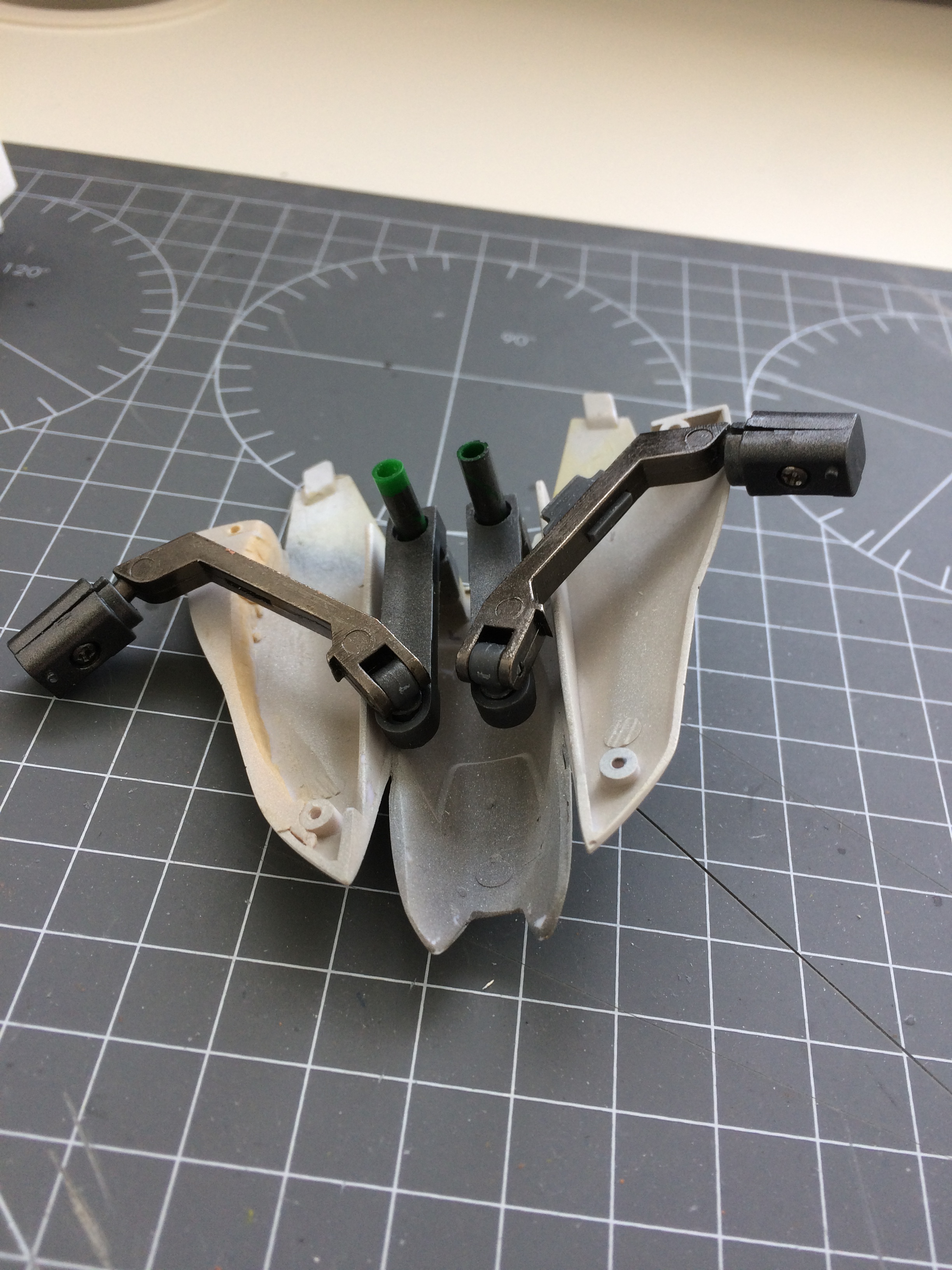

- Leg joint
The housing for the metal bar needs to be modified to allow a good range of movement so that the legs can be positioned parallel (by removing a part of the housing for the ball joint) and separate (by enlarging the opening in the leg intake part so) from the body.
IMG_0902.thumb.JPG.105cb716e85091f868c8e3ee0ce0b511.JPGIMG_0904.thumb.JPG.3032dada91275b9fb72265cd26153d01.JPG

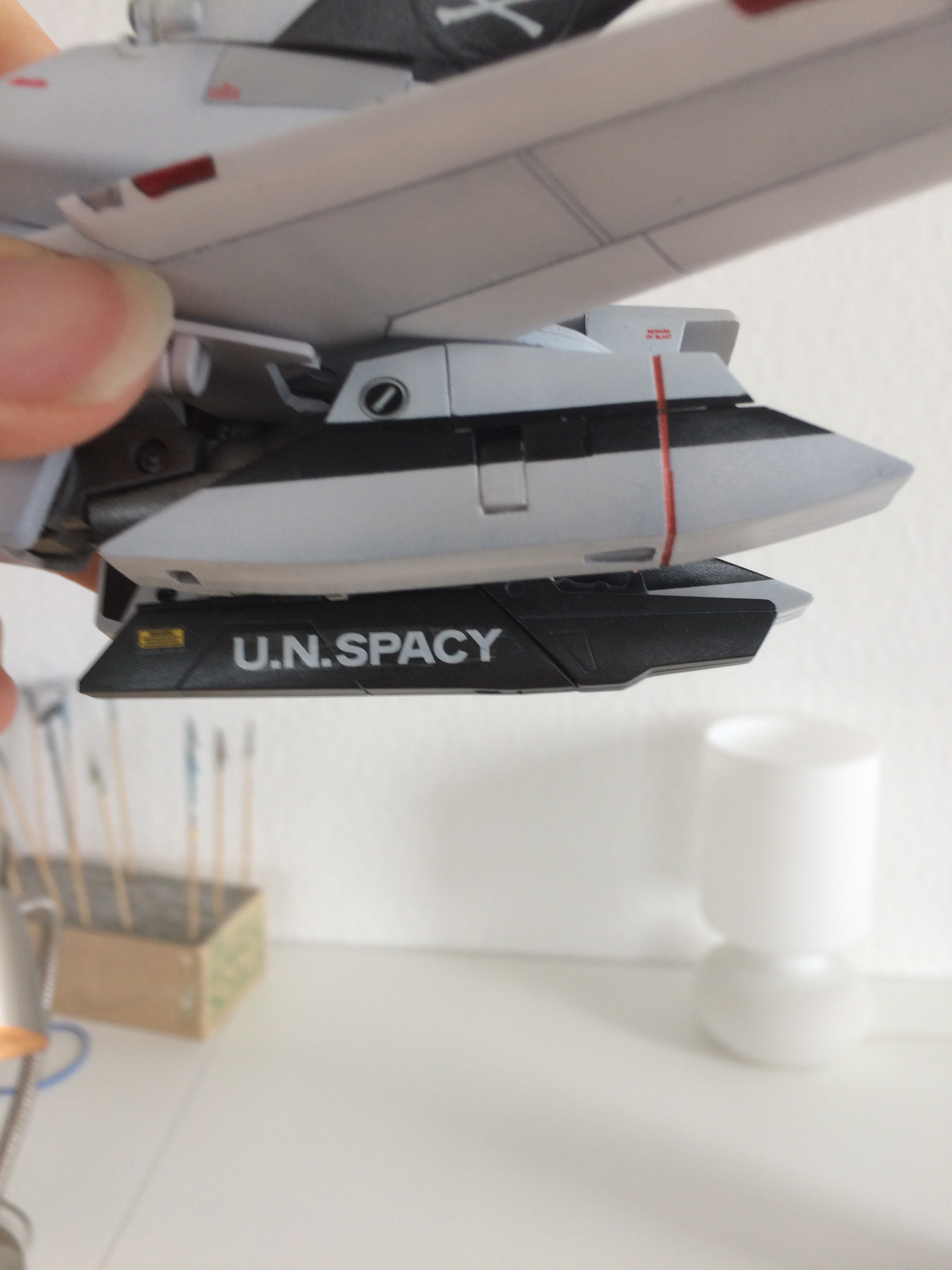

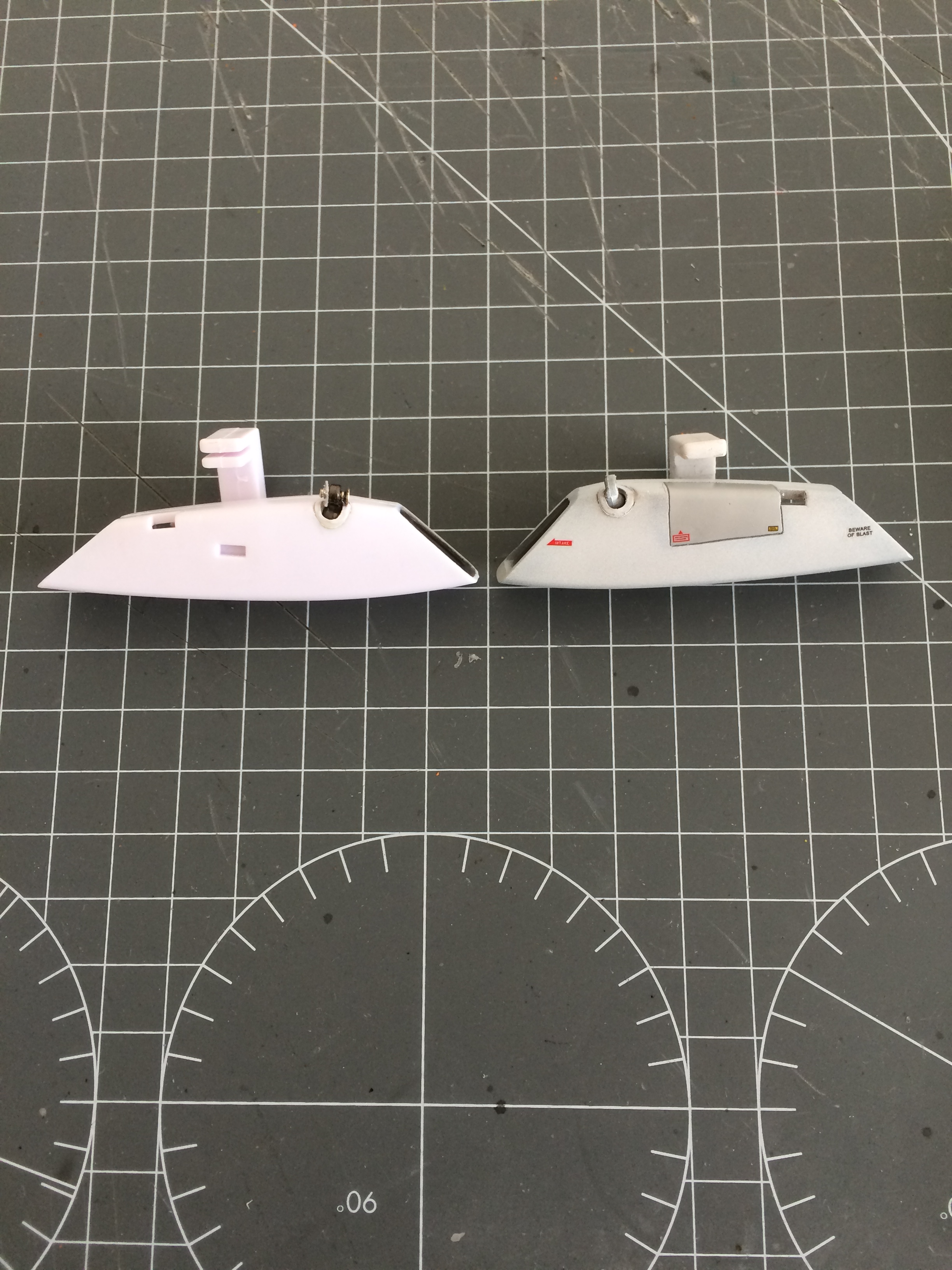

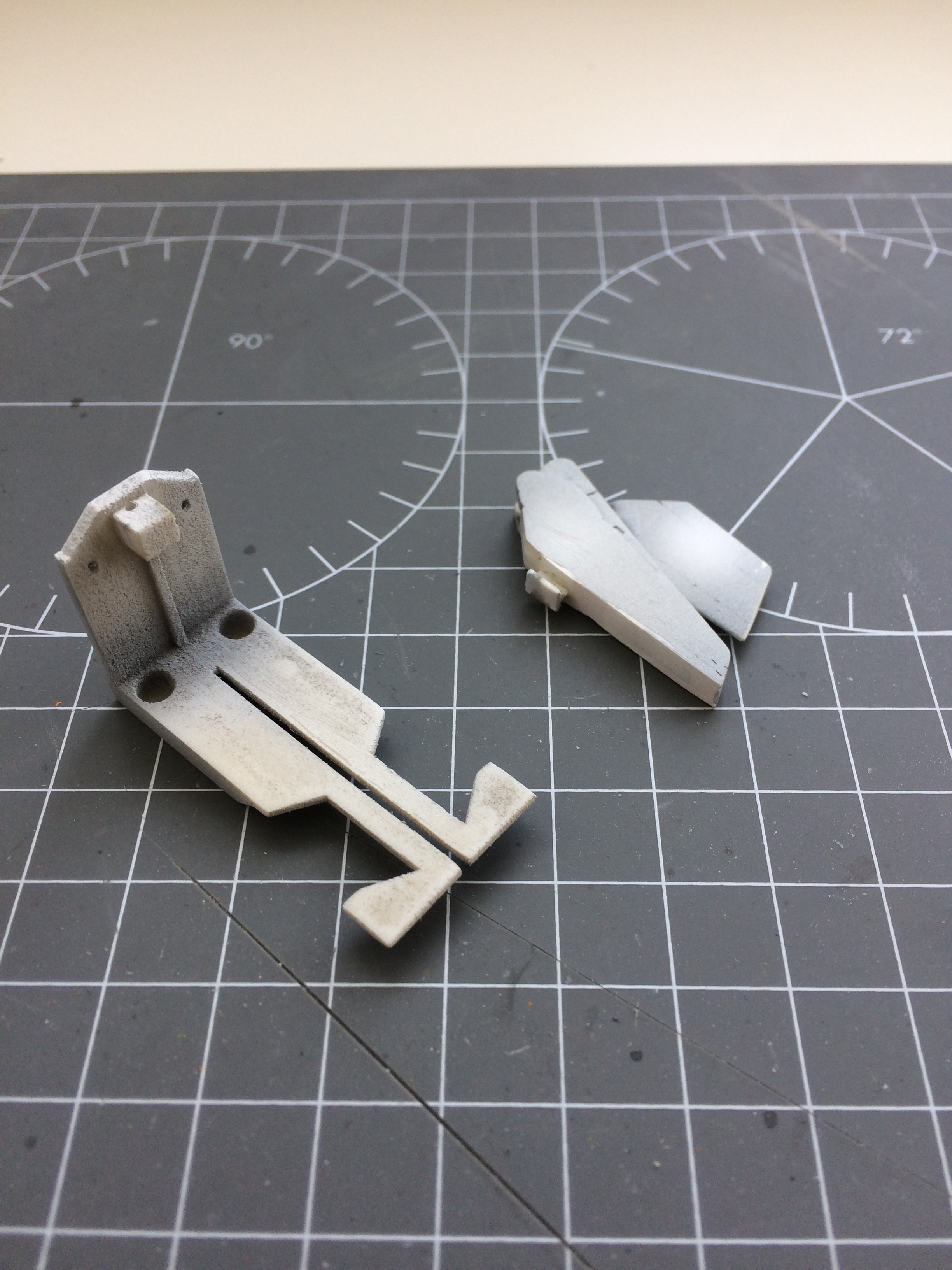

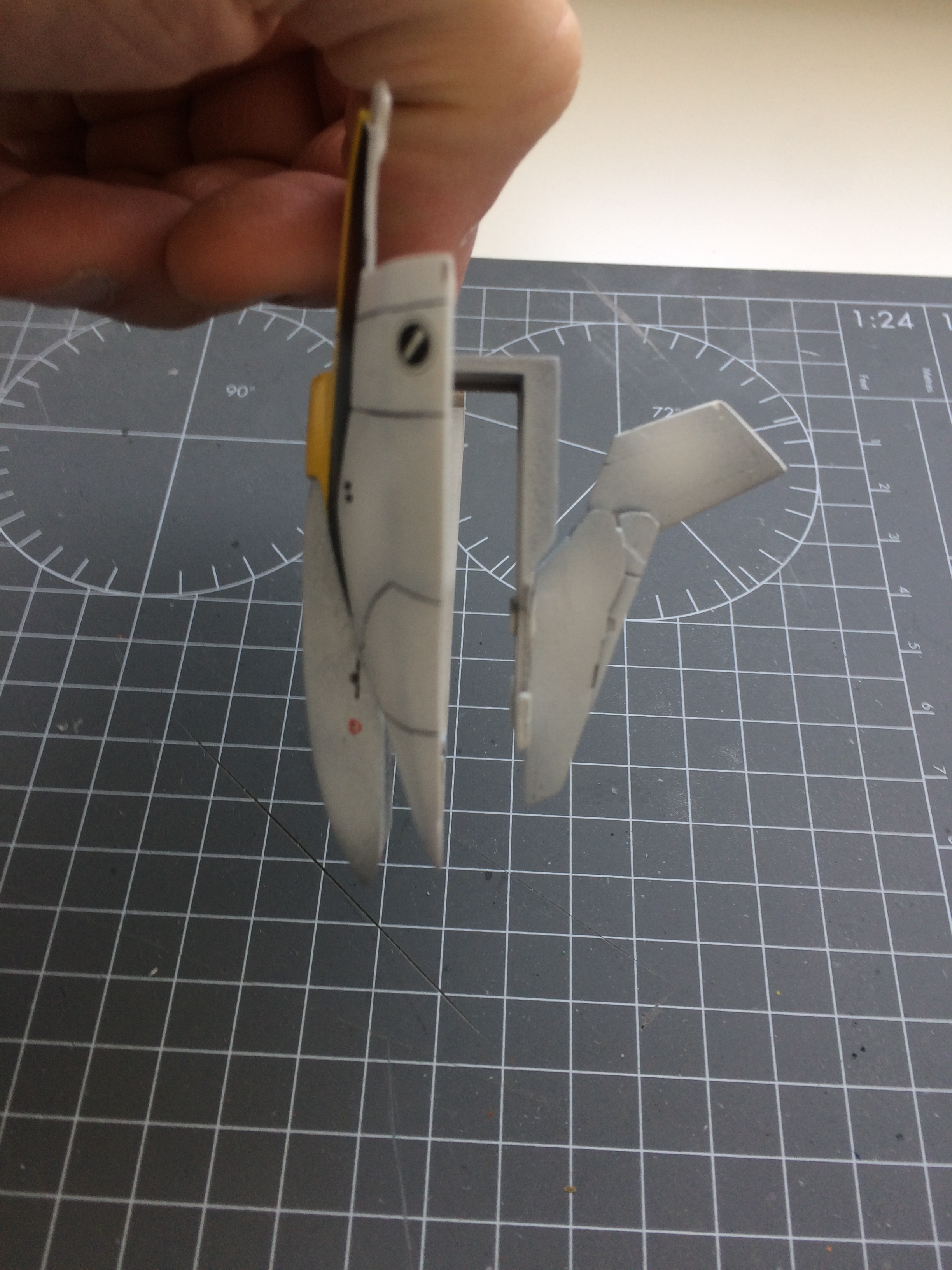

- New ventral fin system
a) New fin (based on gundam build parts - wings) crafted with a T shaped pin that allows it to move along a opening and incorporated magnets to lock to the nosecone in fighter mode
b) New 3D printed piece cointaining i) the opening to funcion as a rail for the fin and ii) the round holes to fix one side of the tubes for the new leg transformation system
IMG_0888.thumb.JPG.364a806a155d4c6e6e61fb2b9ed125a5.JPGIMG_0889.thumb.JPG.11a0996a634c703960f35a9d876e493b.JPG
pics in fighter and battroid mode positions
IMG_0890.thumb.JPG.5acc0d0c88e7c31d485dd2bf4ad8067b.JPGIMG_0891.thumb.JPG.45877ab945deaaf4cae8758c8d635335.JPG

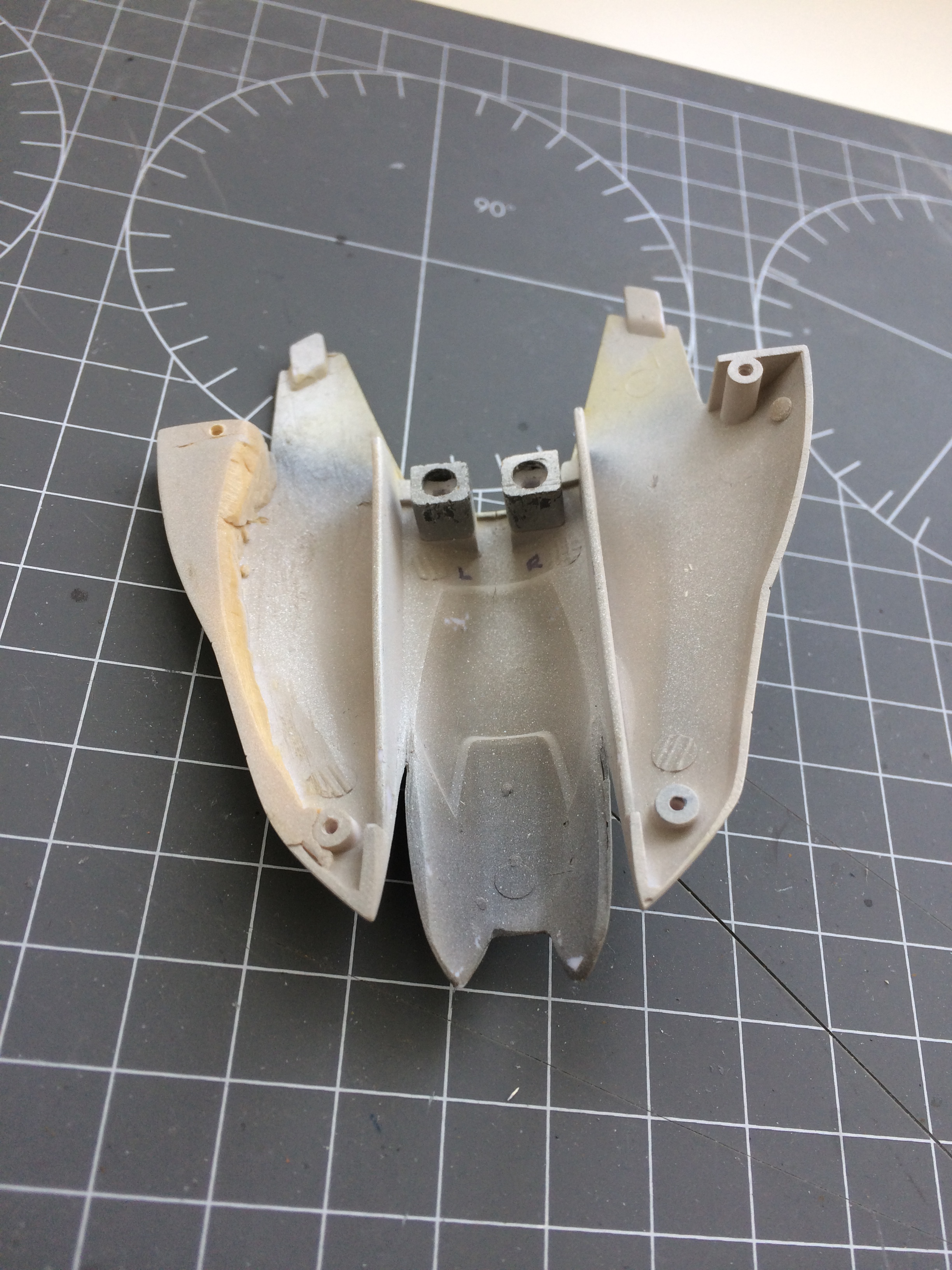

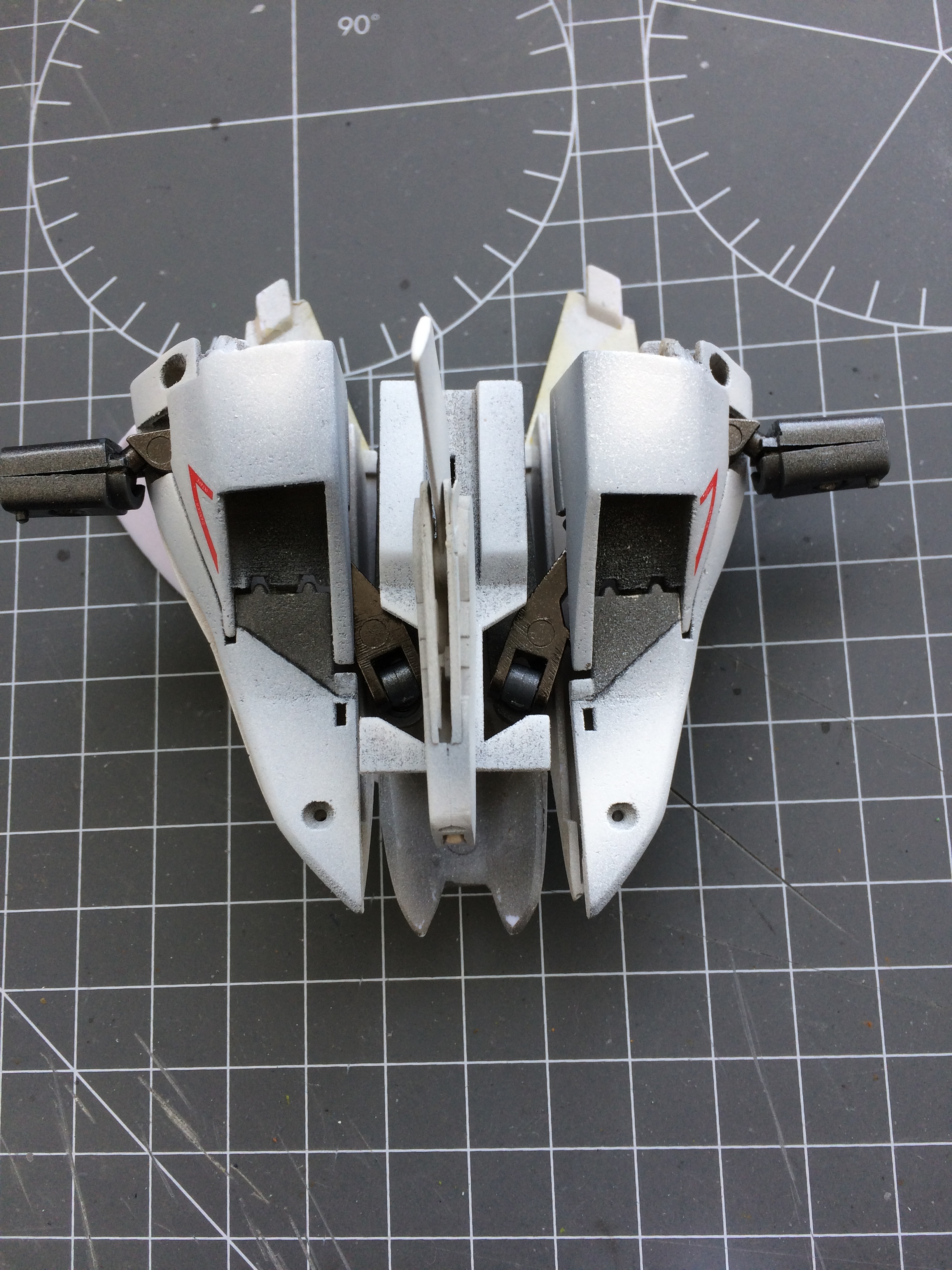

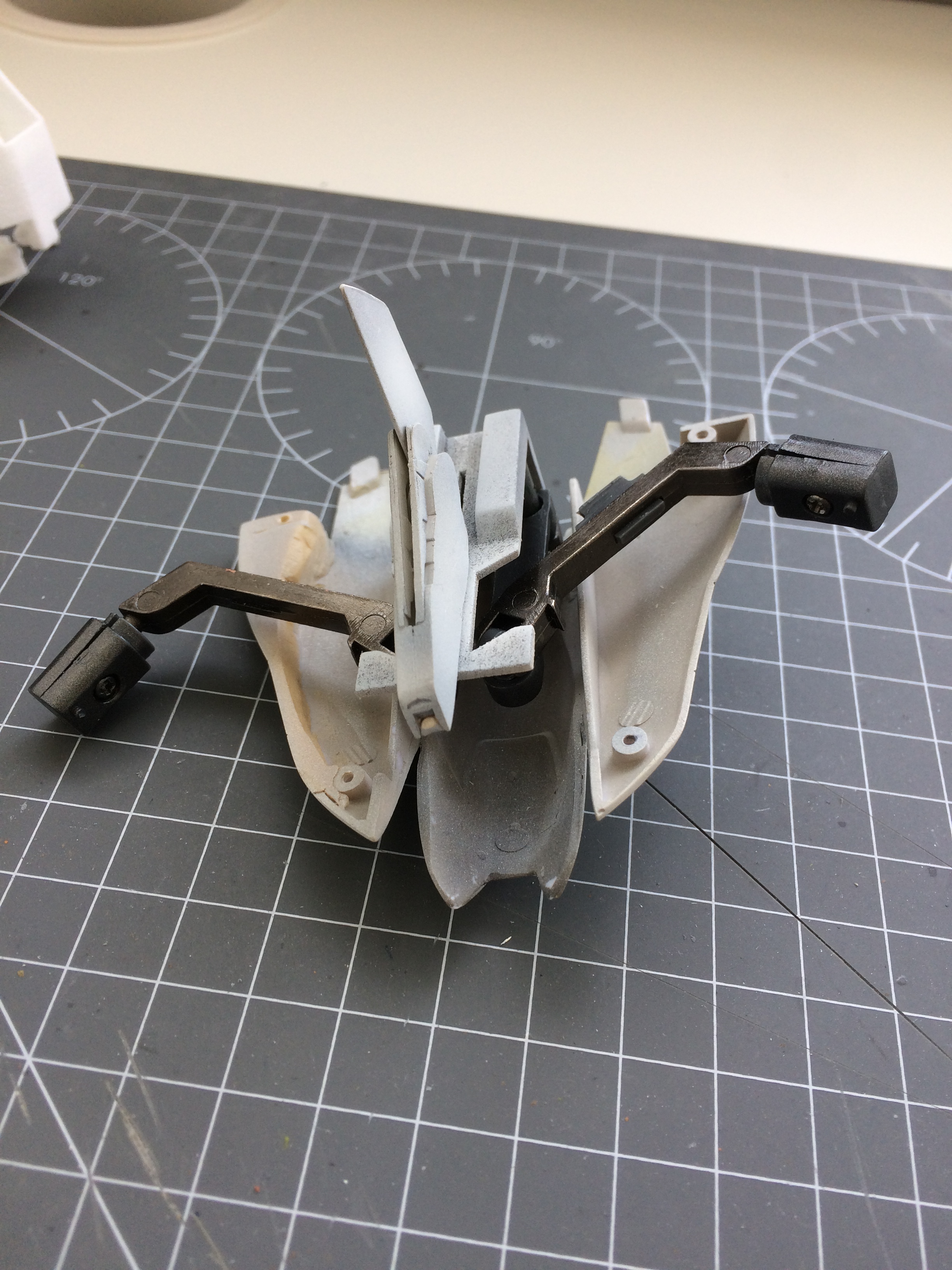

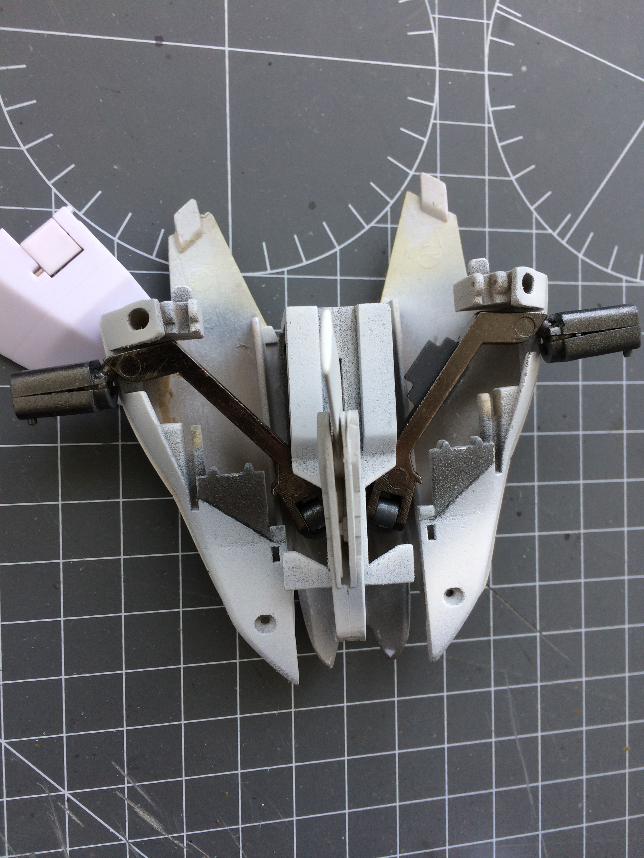

- NEW INTAKES
this is the key part of the mod, withouth @Xigfrid it wouldn't have been possible to make it! new 3D printed air intakes that can open and allow the metal bar to be positioned inside them, not under. Some pictures:
the new pieces are also thiker (with a bigger intake) than the original, so the shoulders will look less "pending under the body" and instead more integrated in the design in fighter mode
IMG_0885.thumb.JPG.14fe190914954b921b9786b5ba262d0b.JPGIMG_0886.thumb.JPG.756c4c2f51da01a0ce7fdf497564e14f.JPG

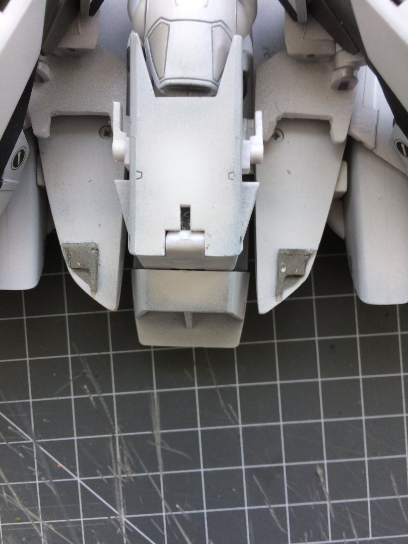

a summary of the building sequence:
1) add the tubes (leg attachment will be periscopic)
IMG_0892.thumb.JPG.b056bb63d94a80cf18cb5e028cf0a9c2.JPGIMG_0893.thumb.JPG.33791c89bb8471e38138f0fa4e72c9c5.JPG
2) insert the legs  and block them with the fin system piece
3) attach the main piece of the new intake and then the closure
upside down front view of how it should look
what do you think?
slowly and carefully assembling the all thing now checking that all is ok, next update complete pictures!
