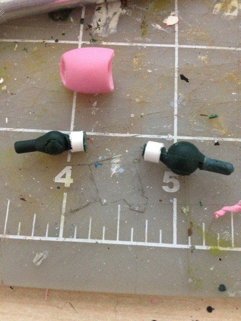

varitechs Posted March 2, 2014 Posted March 2, 2014 (edited) i had ordered several balljoint and it's seem that the best choice is this one: HOBBY BASE DOUBLE BALLJOINT PPC-T05 So i made some test this afternoon, not bad isn't it?: Edited March 2, 2014 by varitechs
derex3592 Posted March 2, 2014 Posted March 2, 2014 Looks good! How are you attaching the shoulder part to the body???
varitechs Posted March 2, 2014 Posted March 2, 2014 (edited) It's just Plasticine :-) Edited March 2, 2014 by varitechs

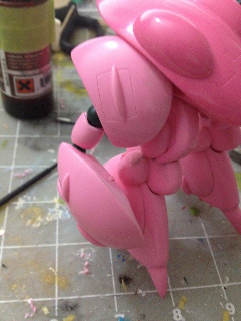

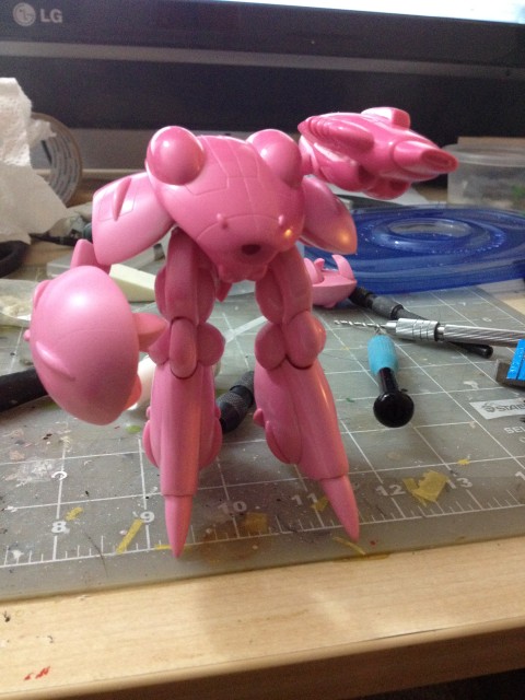

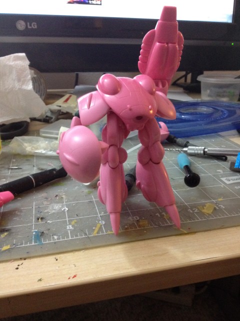

Ignacio Ocamica Posted April 4, 2014 Posted April 4, 2014 I'm doing the same mod to mine! I still have to decide how to connect the shoulders to the body.
EXO Posted April 4, 2014 Posted April 4, 2014 I placed a metal pin in between and I'll be filling the gap with 5 min epoxy or thick CA. The hip joint is also ball jointed.

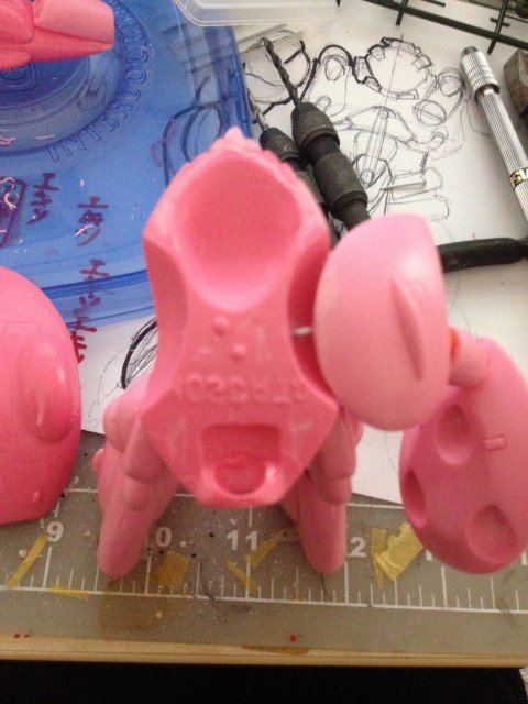

Tober Posted April 5, 2014 Posted April 5, 2014 I placed a metal pin in between and I'll be filling the gap with 5 min epoxy or thick CA. WD_0148 (Small).jpeg The hip joint is also ball jointed. OMFG!!!! In the background... on the drawing pad... is that what I think it is...? YES!!! You use the same silver drawing pen as I do!!! Are you taking hints from Yacadia or just plain teasing with that Bioroid ortho?

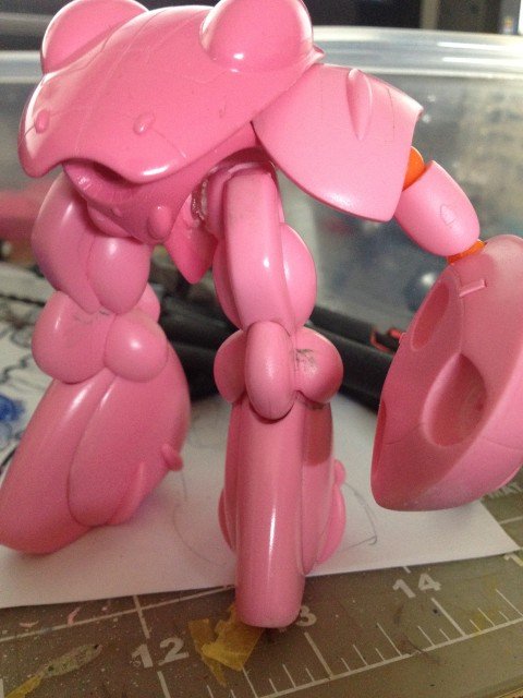

EXO Posted April 6, 2014 Posted April 6, 2014 Those are revoltech joints I'm using as a place holder. I'll be using Hobby Base Joints with special mods. I'll post the mods on here. http://www.hlj.com/product/YLSPPC-T09 Tober... that's just a drawing!!! (For a sculpt I'm doing for a custom figure commission... ) I forgot about it, I didn't put it there on purpose.

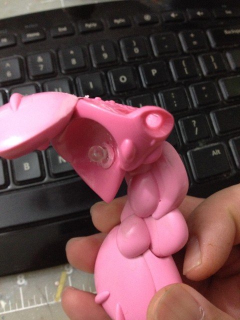

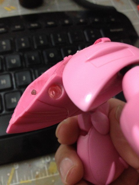

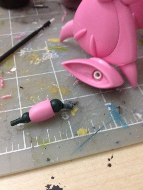

EXO Posted April 11, 2014 Posted April 11, 2014 The orange ball joints are Revoltech. The green ones here are Hobby Base joints. I hollowed out the arm piece so I can put styrene rod inserts in there. Since there's not enough room for both stems of the ball joints, I melted the tips to the diameter of the styrene rods. Now they won't be able to be pulled off. Once I glue both stems inside, it's placed permanently. I move the stems around once the glue on the inserts dries to make sure that they are not glued down also.

EXO Posted April 11, 2014 Posted April 11, 2014 Thanks guys! I played around with putting ball joints at the knees and feet but decided against it. The movement is almost negligible it's not worth screwing up the line art look. There's additional joints on the hip socket and where the beam cannon meets the main body, none of which will interfere with the look. The ball joints on the arms are almost the same size spheres as the ones I took out. Also, I'm 100% sure that the paint will scratch in those areas if there's any kind of movement.
Twoducks Posted April 11, 2014 Posted April 11, 2014 ....................................................................................................................... The orange ball joints are Revoltech. The green ones here are Hobby Base joints. I hollowed out the arm piece so I can put styrene rod inserts in there. Since there's not enough room for both stems of the ball joints, I melted the tips to the diameter of the styrene rods. Now they won't be able to be pulled off. Once I glue both stems inside, it's placed permanently. I move the stems around once the glue on the inserts dries to make sure that they are not glued down also. WD_0152 (Small).jpeg WD_0153 (Small).jpeg WD_0154 (Small).jpeg .................. yoink!!
DarrinG Posted April 11, 2014 Posted April 11, 2014 The ball joint / styrene / melting thing is awesome to behold. Great tutorial. You forgot I had your address - expect a box soon . . .

varitechs Posted April 14, 2014 Posted April 14, 2014 The orange ball joints are Revoltech. The green ones here are Hobby Base joints. I hollowed out the arm piece so I can put styrene rod inserts in there. Since there's not enough room for both stems of the ball joints, I melted the tips to the diameter of the styrene rods. Now they won't be able to be pulled off. Once I glue both stems inside, it's placed permanently. I move the stems around once the glue on the inserts dries to make sure that they are not glued down also. WD_0152 (Small).jpeg WD_0153 (Small).jpeg WD_0154 (Small).jpeg My test was good but not perfect... finaly i use the same ball joint as you. the result is really very very good, thanks for the idea
