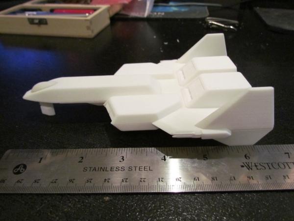

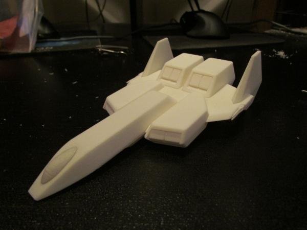

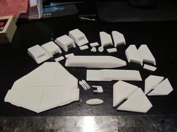

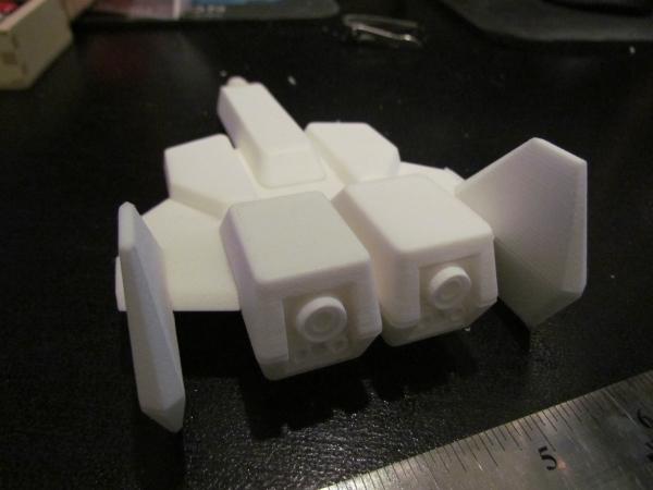

So, have to say I'm pretty impressed that this thing went through. I was fully expecting the tiny little wing cannons to get rejected by Shapeways, but even those came through.
In hindsight, I'd probably make the tails simpler, so I have some revisions to make, but I don't know if I'll order another myself. For now, I'm just happy to see that it came out really nicely.
I don't even know what scale this thing is honestly. The game specs say the ship is over 100 feet long, and this is a bit under 7 inches, so it's a something like 1/180th :p This was about as big as I wanted to make it, or the cost would have shot up significantly.

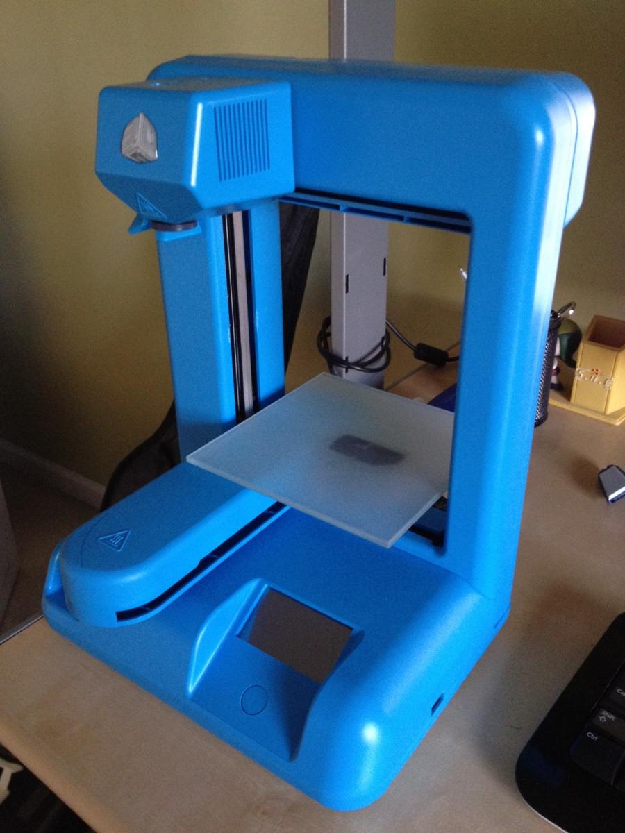

So it's finally here. Drove down to Staples after work to pick it up.
I have finished the initial calibrations for printer height and installed the software. I like the software.... only complaint was that it basically needs files in STL format, which I could easily convert with Mesh Lab. From there on, you can scale, and rotate the model around any axis.
I'll do a simple print tomorrow, see how things go.
