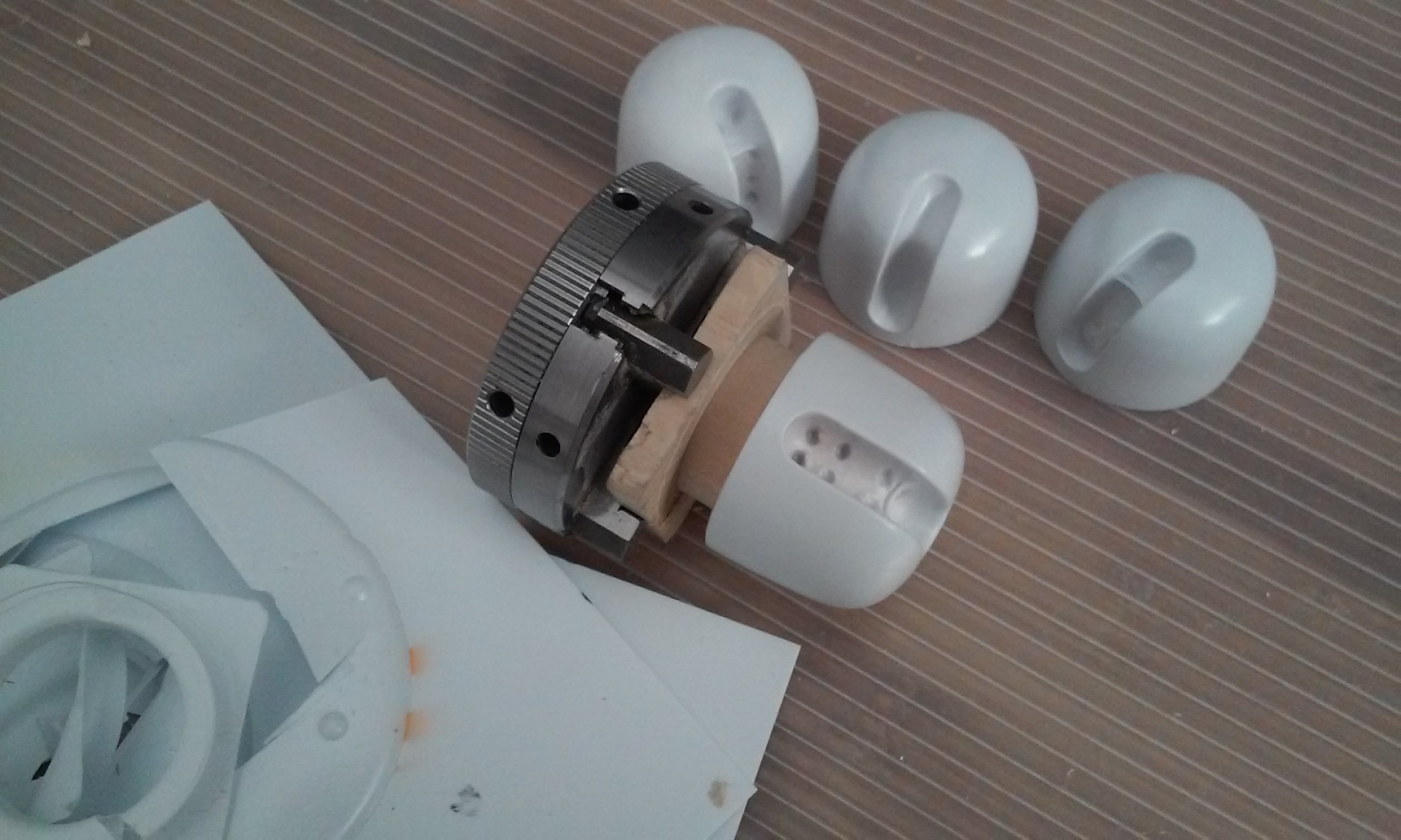

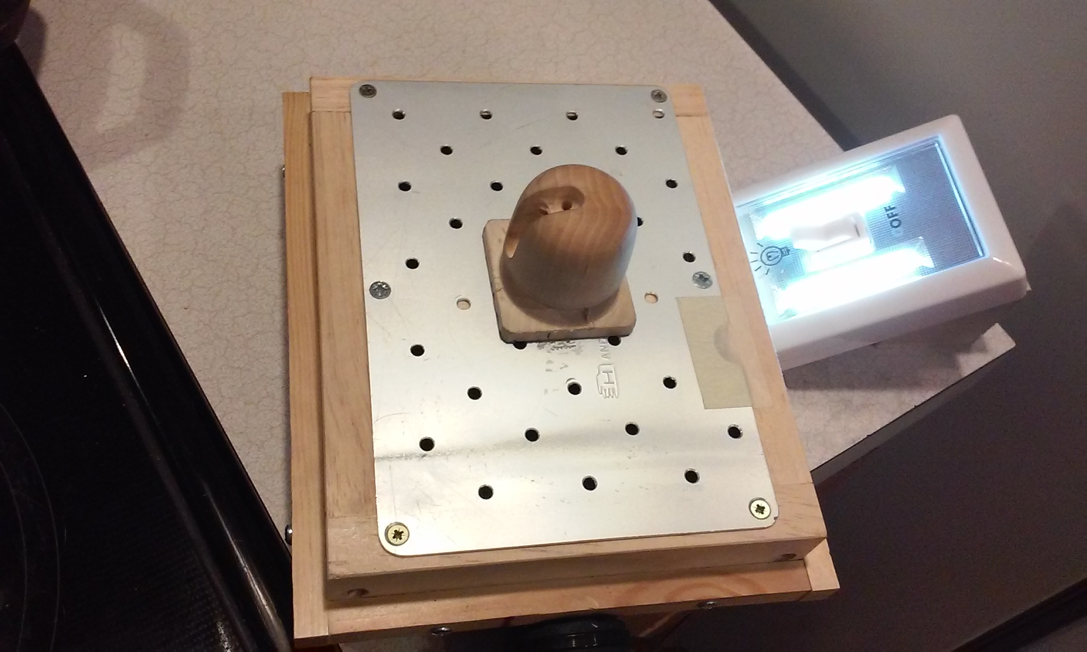

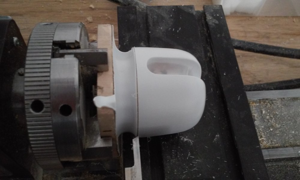

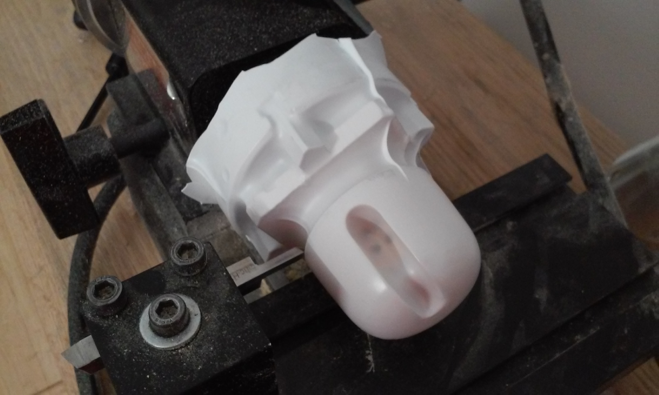

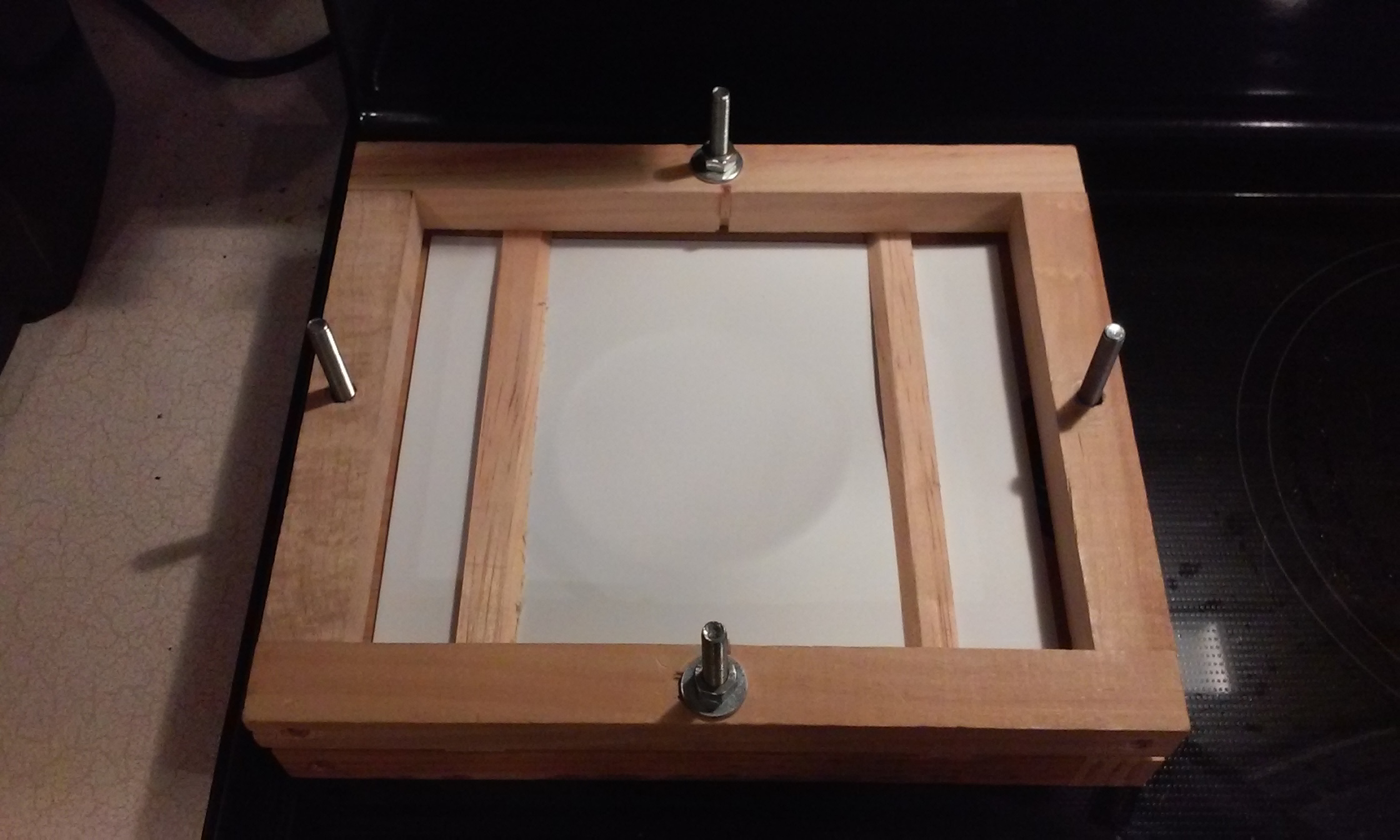

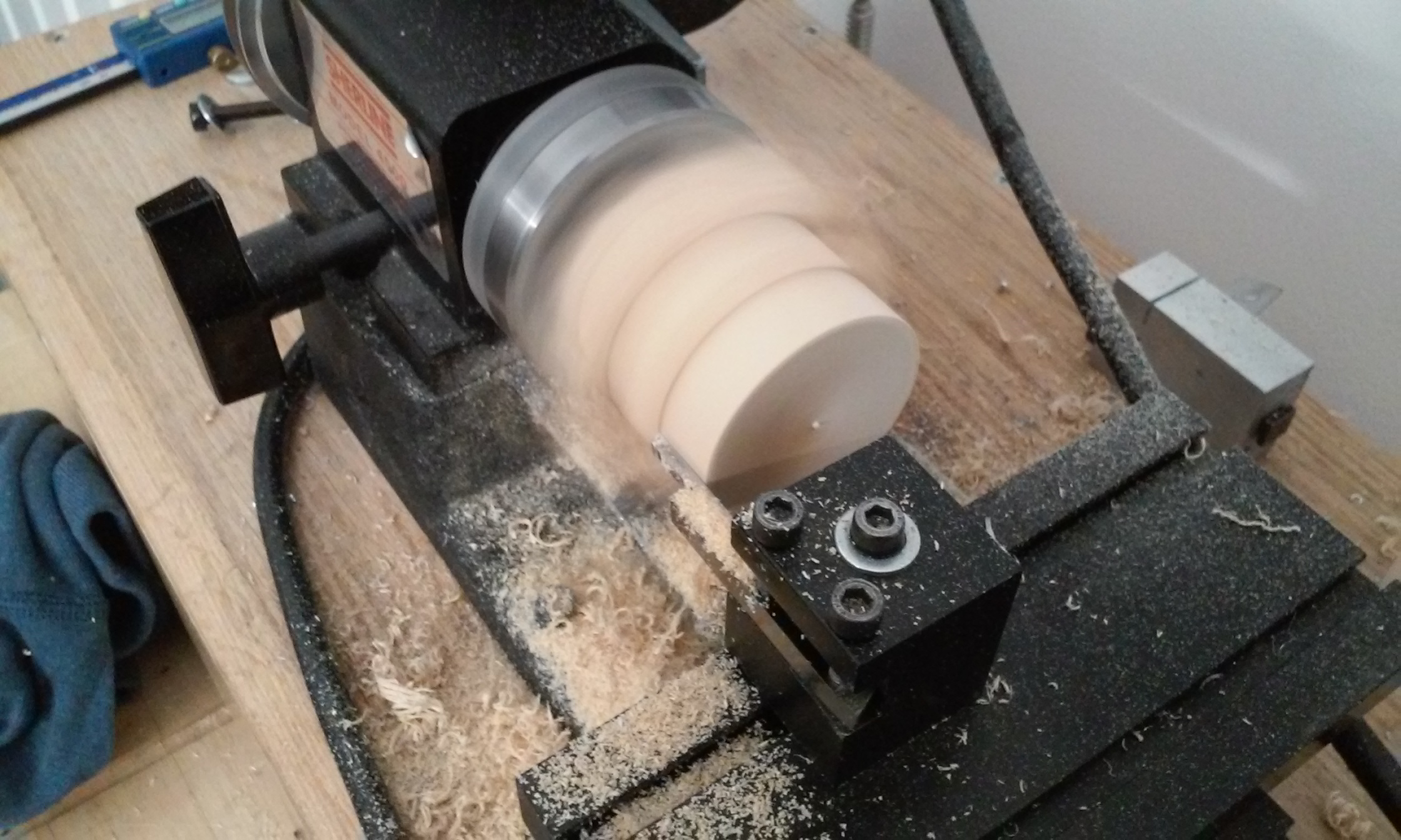

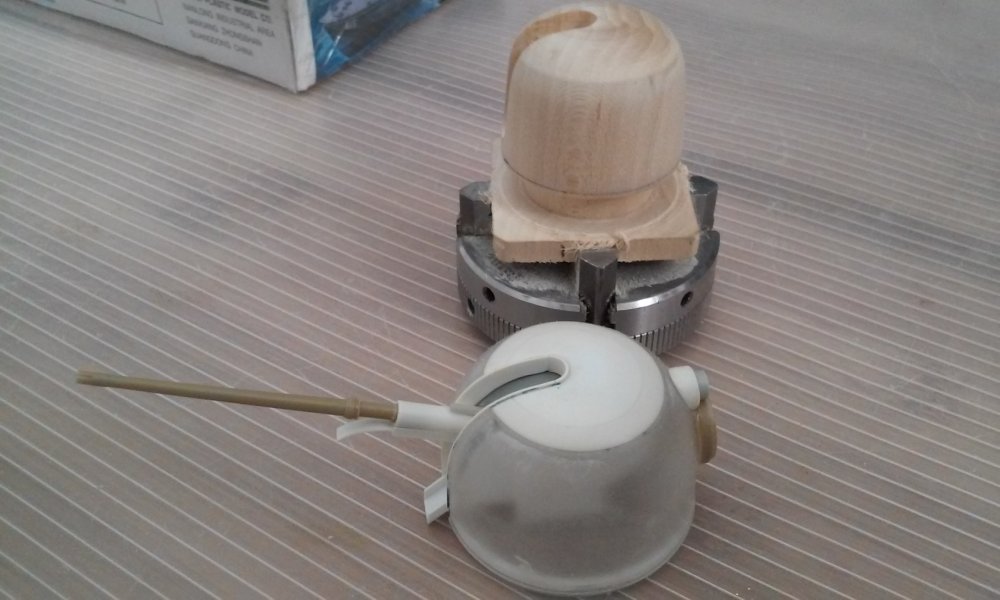

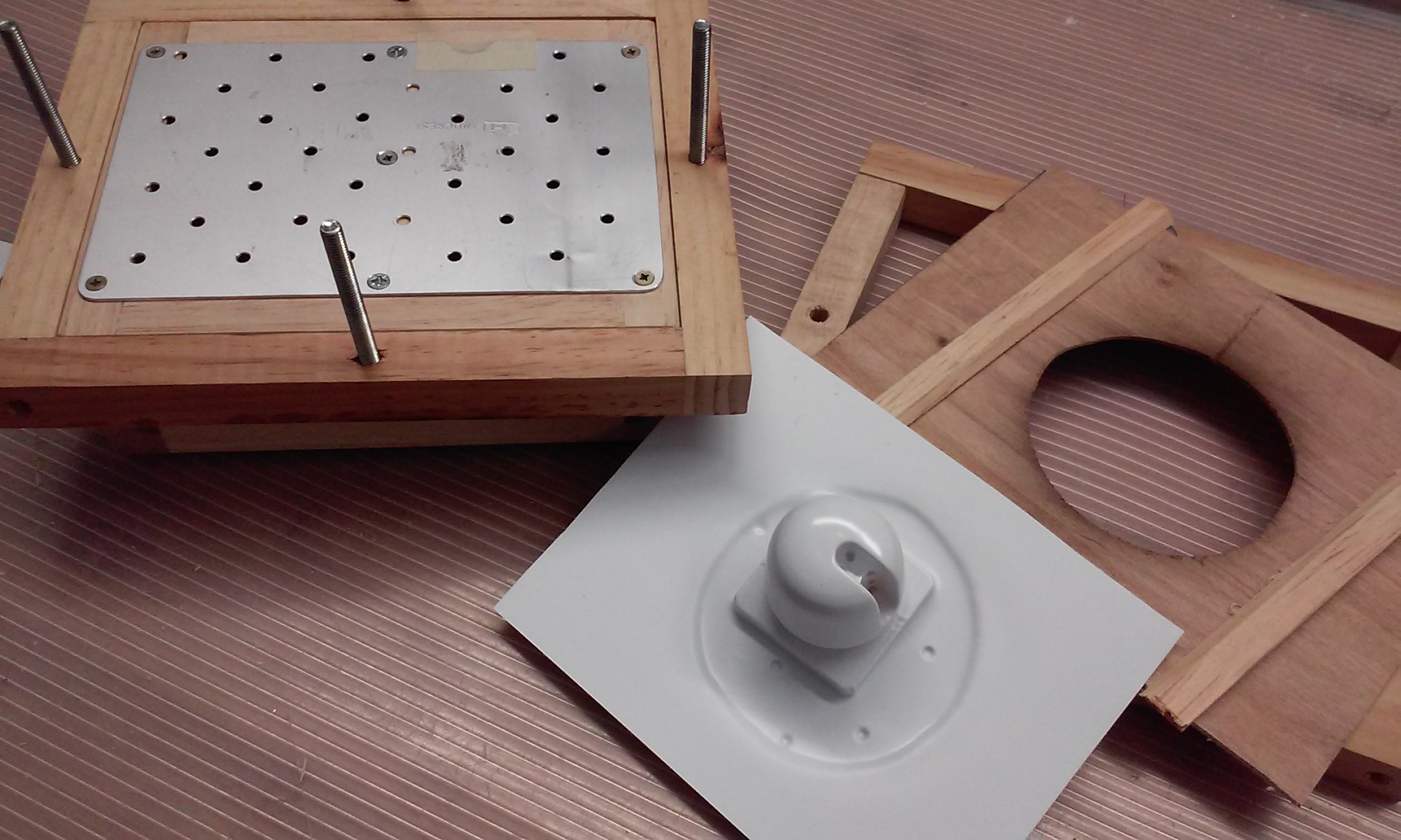

MechTech Posted February 9, 2017 Author Posted February 9, 2017 For those of you looking to do some vacu-forming, its been a couple of years since I did my last project using it. I forgot some things and wasted a lot of plastic thinking I was having temperature issues with the plastic. Long story short, think of a blanket. When you droop a BIG blanket over something, you get webbing in between where the blanket hugs whatever you are drooping it over. I did some research and was like "DUH" - forgot about that!" So I took the vacu-forming box I made and added a plate with a hole in it to reduce the plastic available to pull over the mold or "buck". Plus less plastic means I wasted less. So a quick walk through for anyone wanting to do vacu-forming. First I made the "buck" on my lathe and machined the gun port into it. In order for the plastic to get into nooks and cranny's, you need air holes for the vacuum to reach in there and pull the plastic in. This will be a 1/72nd Oto Melara 76mm ship's turret. Next is a photo of the buck and original turret I made like 15 years ago. Long story short, it is WAY too big and kinda heavy to go on an R/C boat. The photo with a pulled (molded) piece on the lathe shows the failure of having TOO much plastic around the buck causing webbing and ruining the part. To add insult to injury, I still had to cut it off too! Next photos are the vacuum box with frame to hold the plastic. Since the adapter makes a smaller hole that is hard to line up with the buck, the light helps you see and align them up. The next photos show successful pulls and how they were cut off on the lathe. The last photo shows the buck and molding. Note the holes in the buck to suck the plastic into the gun port. (sorry, photos wouldn't load in order no matter what I tried) Hopefully this helps someone and you don't waste a couple feet of plastic like I did! - MT
pengbuzz Posted February 9, 2017 Posted February 9, 2017 Great post; some days, i wish I had my own machine shop. I'm lucky to have a dremel tool.
