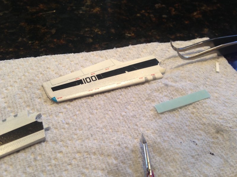

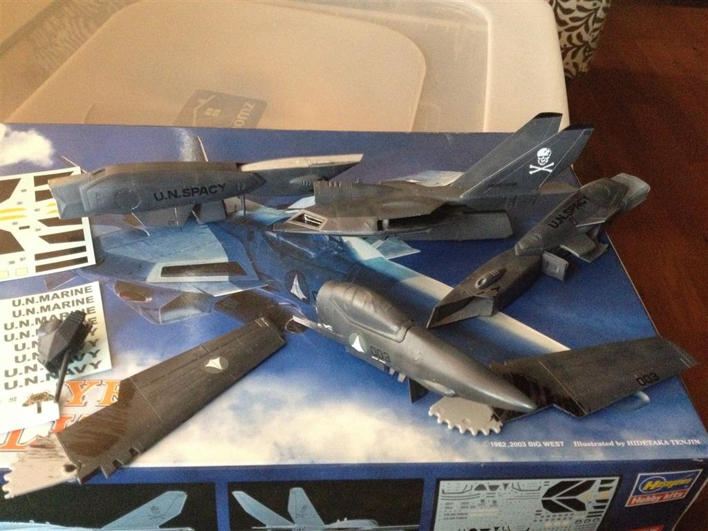

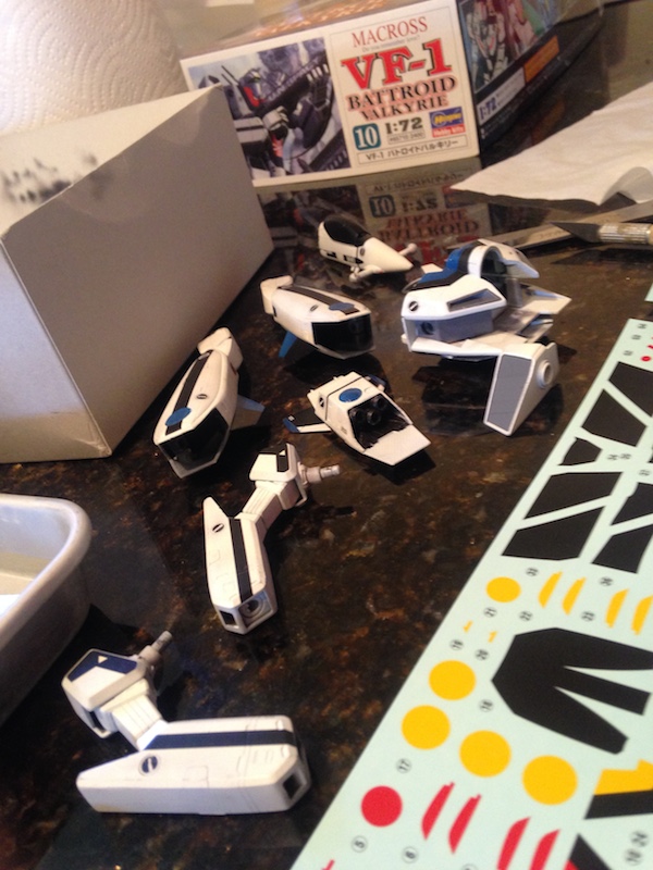

ce25254 Posted April 20, 2015 Posted April 20, 2015 I finally got to start putting decals on my VF-1S yesterday. I learned a few things⦠Applying decals is not entirely compatible with two espressos and no food. Patience⦠it took a lot longer for the decals to release than I expected. The stripes decals do look pretty nice, but I don't regret painting a lot of the black areas. The vernier decals. Argh! I had a hard time with them. I started with these and tore three of them. I had debated about whether or not I should paint the verniers by hand. I decided to paint them, but had mixed results, and then backtracked and went with the decals, mostly. I won't know which technique looks better until after I put a dull coat and weathering over everything. These Hasegawa decals are really thin. Trying to move them around by poking them with a sharp tool or grabbing them with tweezers off the backing ended badly. As long as I stuck to a brush to move them around I was (mostly) OK. I am so so so so scared to put on the skull and crossbones. I had a lot of fun at this stage. It's so rewarding when it all starts to come together. But again: I'm so glad that I decided to do this kit before touching anything I care too much about! (Later I might trash this kit for a DYRL Max/Millia showdown dio.)

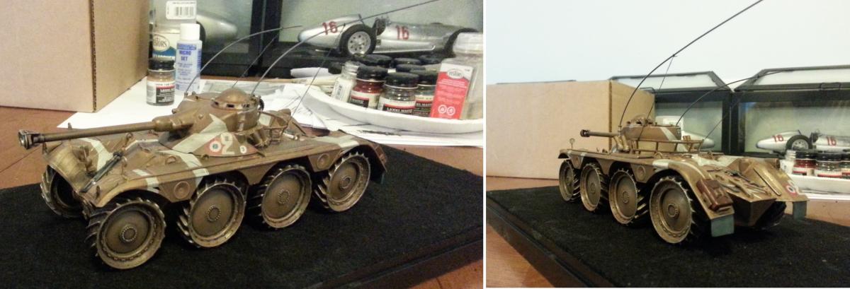

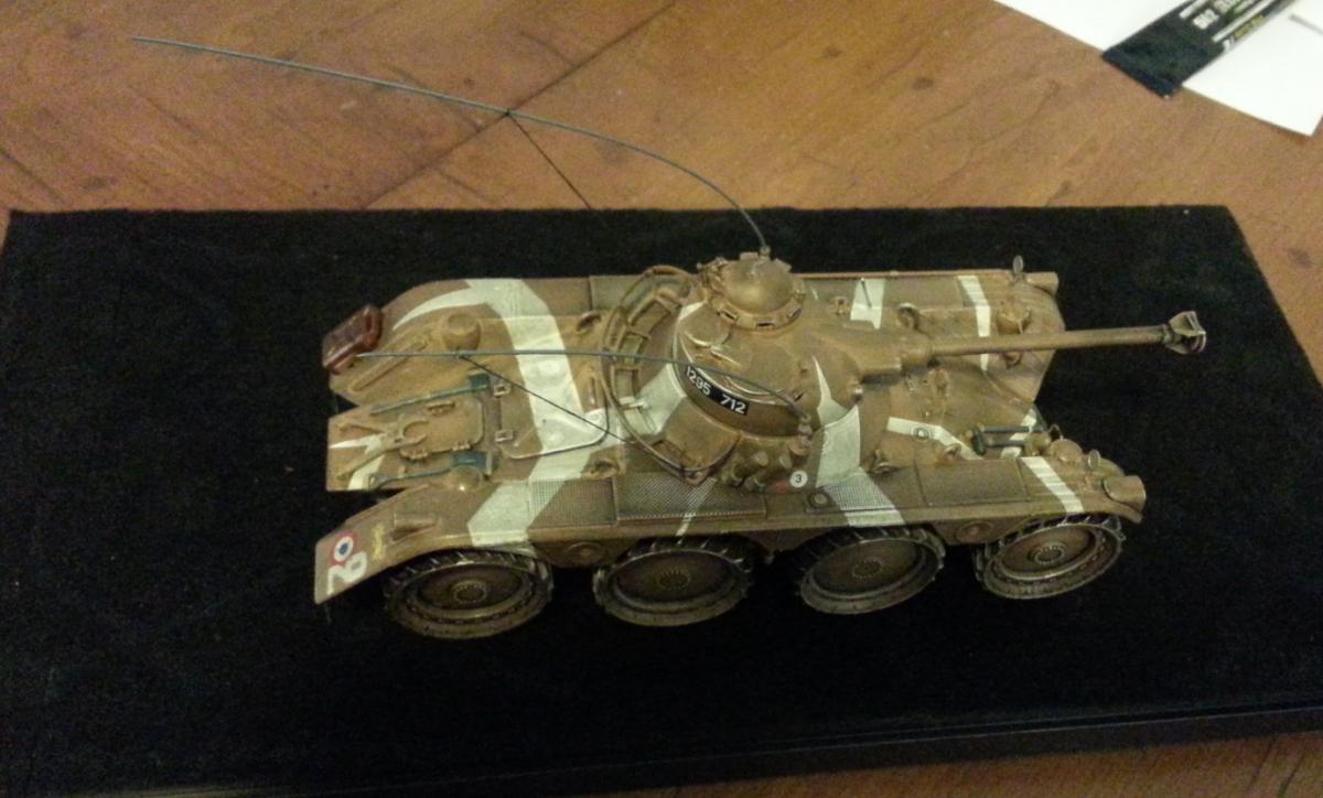

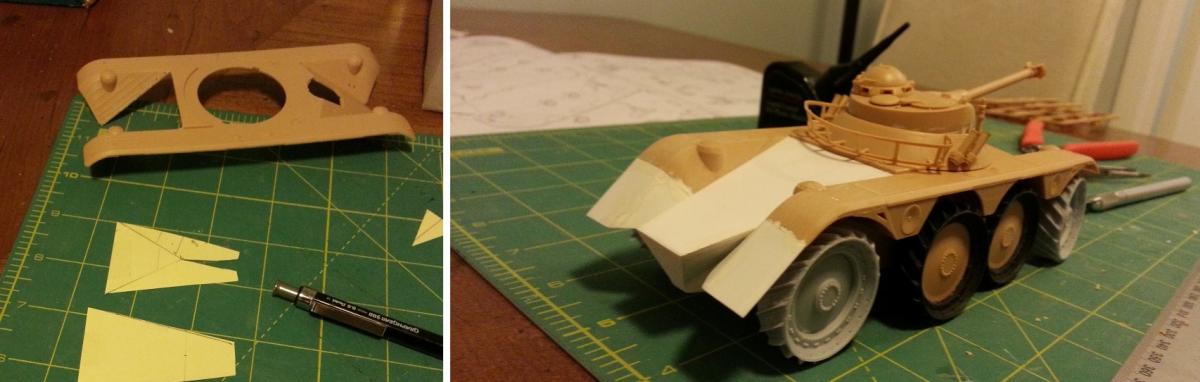

Phyrox Posted April 20, 2015 Posted April 20, 2015 Yet another modified AFV, this one a bit further off the beaten path. Panhard EBR with a few tweeks: New rear deck to replace the "push-me-pull-you" symmetrical design (which is useful, but looks dumb). New metal wheels all the way around (no rubber tires for this guy). Image 1 shows the hull immediately after rear driving area was completely removed alongside the newly formed rear deck and extended fenders. Images 2 and 3 are the finished product. A bit esoteric, but a nice kit, and a really fun modification.
Jefuemon Posted April 21, 2015 Posted April 21, 2015 I finally got to start putting decals on my VF-1S yesterday. I learned a few things⦠Applying decals is not entirely compatible with two espressos and no food. Patience⦠it took a lot longer for the decals to release than I expected. The stripes decals do look pretty nice, but I don't regret painting a lot of the black areas. The vernier decals. Argh! I had a hard time with them. I started with these and tore three of them. I had debated about whether or not I should paint the verniers by hand. I decided to paint them, but had mixed results, and then backtracked and went with the decals, mostly. I won't know which technique looks better until after I put a dull coat and weathering over everything. These Hasegawa decals are really thin. Trying to move them around by poking them with a sharp tool or grabbing them with tweezers off the backing ended badly. As long as I stuck to a brush to move them around I was (mostly) OK. I am so so so so scared to put on the skull and crossbones. I had a lot of fun at this stage. It's so rewarding when it all starts to come together. But again: I'm so glad that I decided to do this kit before touching anything I care too much about! (Later I might trash this kit for a DYRL Max/Millia showdown dio.) Photo Apr 19, 10 25 11 AM.jpg Photo Apr 19, 10 25 28 AM.jpg I've found that Hasegawa decals work best with very hot water. I use water out of a electric hot water pot at around 96 degrees Celsius, and soak the decals about 30 seconds. Come right off no problem.
chyll2 Posted April 21, 2015 Posted April 21, 2015 so far I built two hasegawa kit, one is 0D and one is 25S. The newer hasegawa kit has better decals now, they are rather very thick that I even have a hard time destroying the decals using a model knife. The older one is thin and imo, more fragile but really, when compared to Bandai water slide decals, it is still miles ahead.

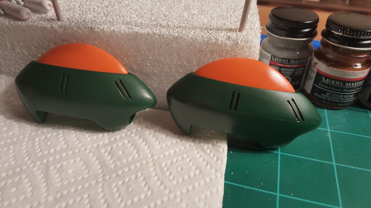

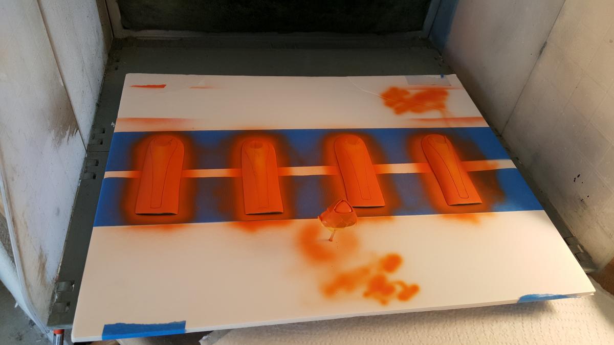

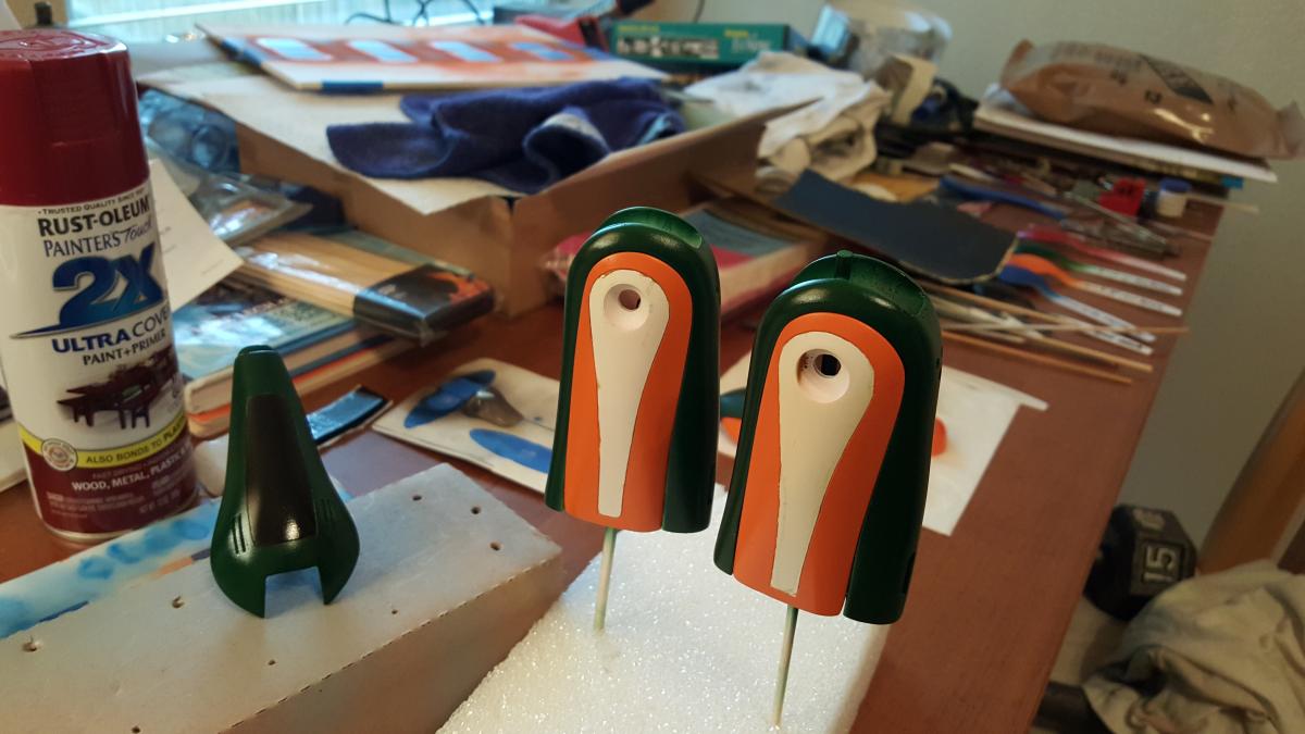

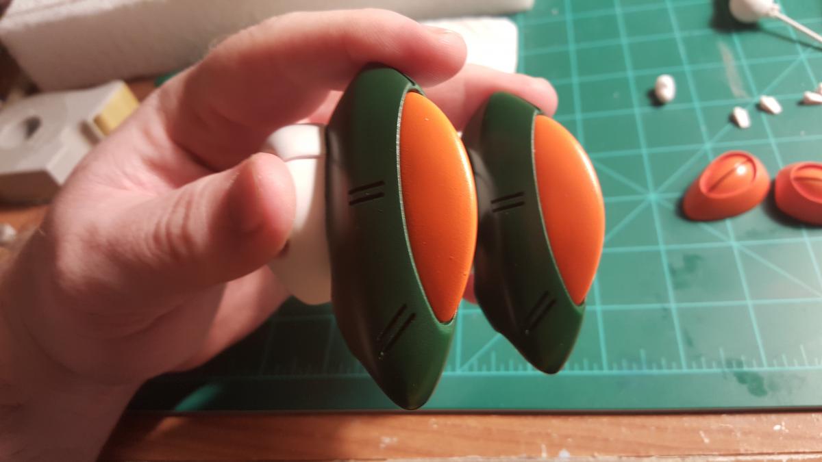

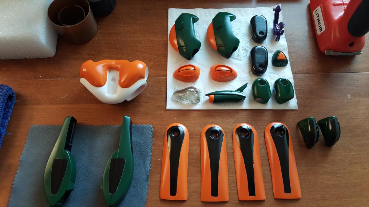

derex3592 Posted April 26, 2015 Posted April 26, 2015 Not terribly much to report this weekend, just some orange leg parts. Crazy busy at work last week and upcoming week as well, so taking it easy.

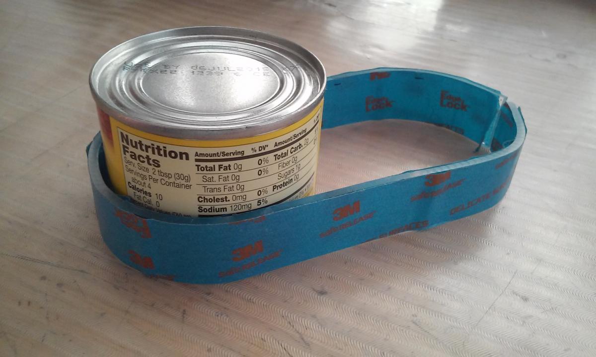

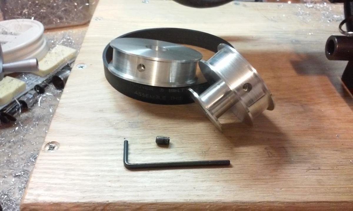

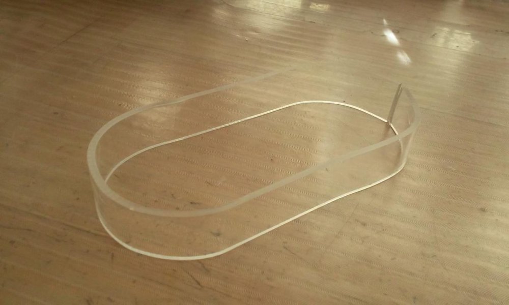

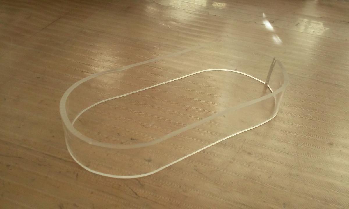

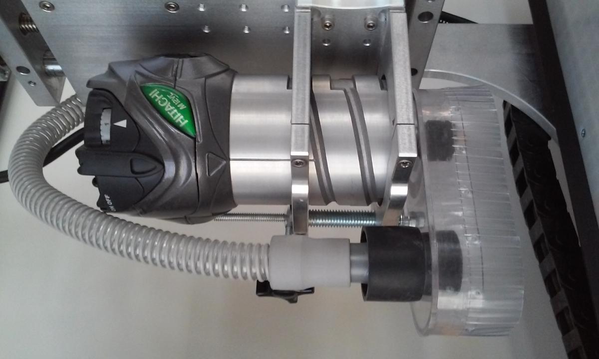

MechTech Posted May 4, 2015 Posted May 4, 2015 Meals Rejected by Ethiopians-my gut rumbles at the memory of them! Some awesome looking stuff guys! No time for modelling working on my schooling. But getting ready for the Daedalus kit in what little time I have. A couple of weekend projects to include litterally toasting some plastic to make a vacuum pickup for my CNC machine and chilli can for the mold. My mill seriously lacks power so I made pullies to gear it down. It's still gutless, but works better and adding lube to the cheap bearings that had none quieted it down some.-MT

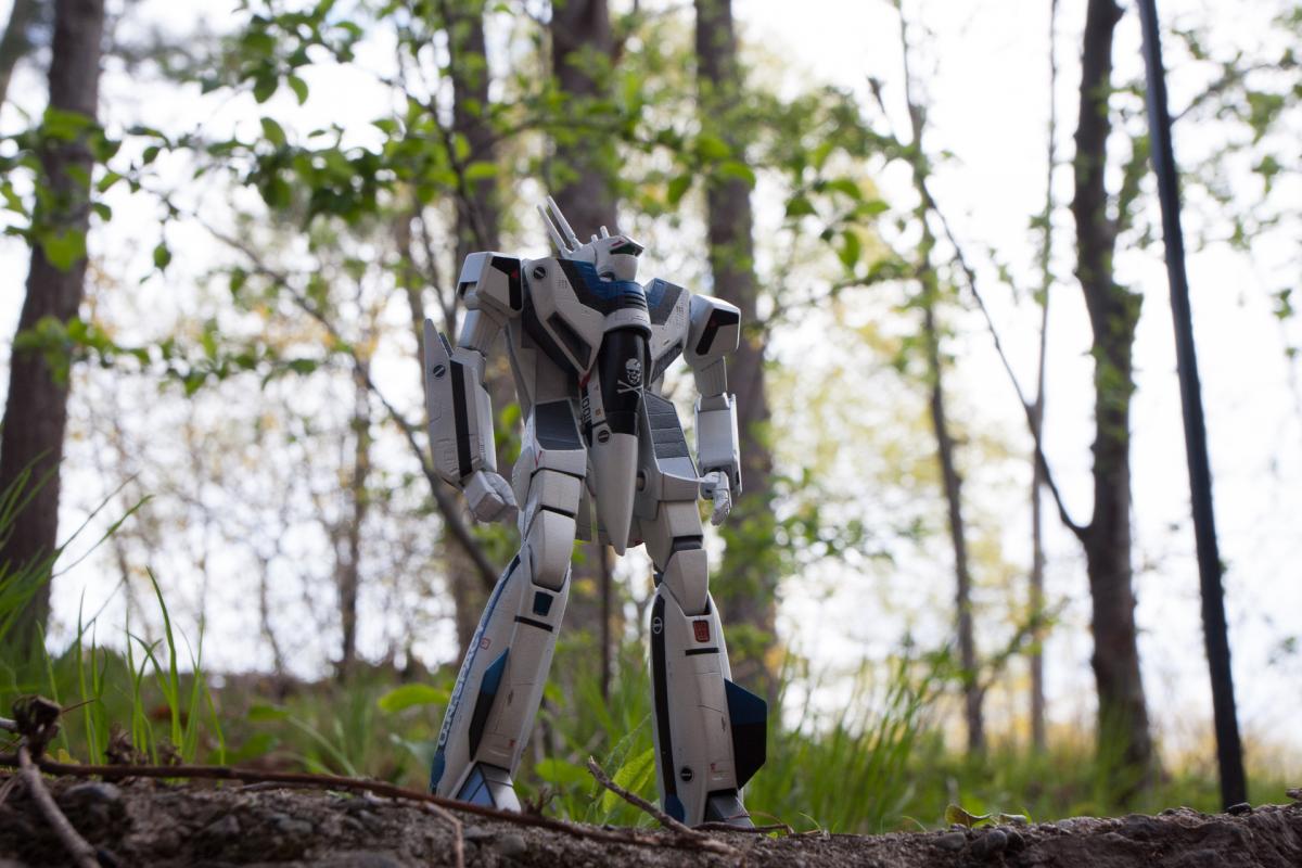

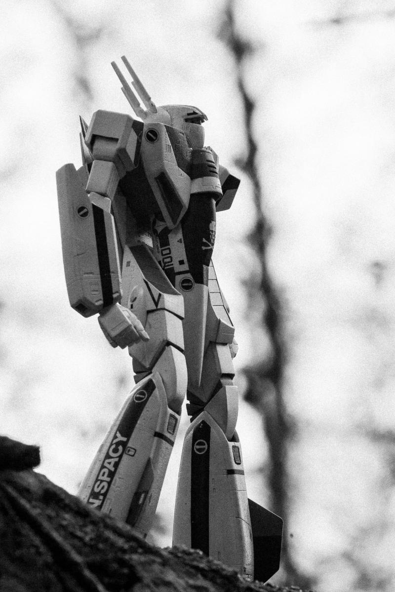

ce25254 Posted May 4, 2015 Posted May 4, 2015 I've finished my decal work on this kit. @jefuemon you sure are right about hot water for the decals. I was pretty scared about tearing the two jolly roger ones but they went on great. I'm a little bit frustrated about a crack that appeared in the hip intake as I installed the legs onto the body, and in the legs when I put in the lights. Oh, and I accidentally dripped too much CA inside the leg to secure the fins, and it ran up the leg and froze up the left knee! At least it's frozen straight. It was a beautiful day and I couldn't resist taking a few pictures, even though I'm not quite done! (still to go: clear coat, panel lines, head cannons, rifleā¦)

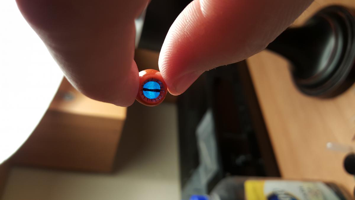

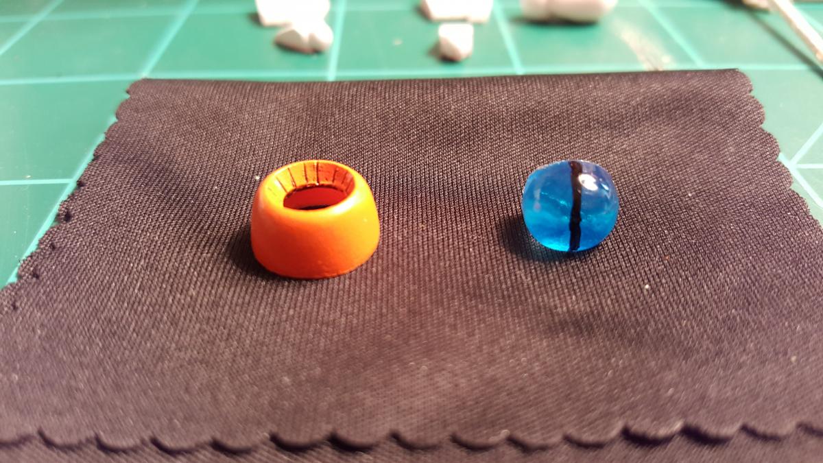

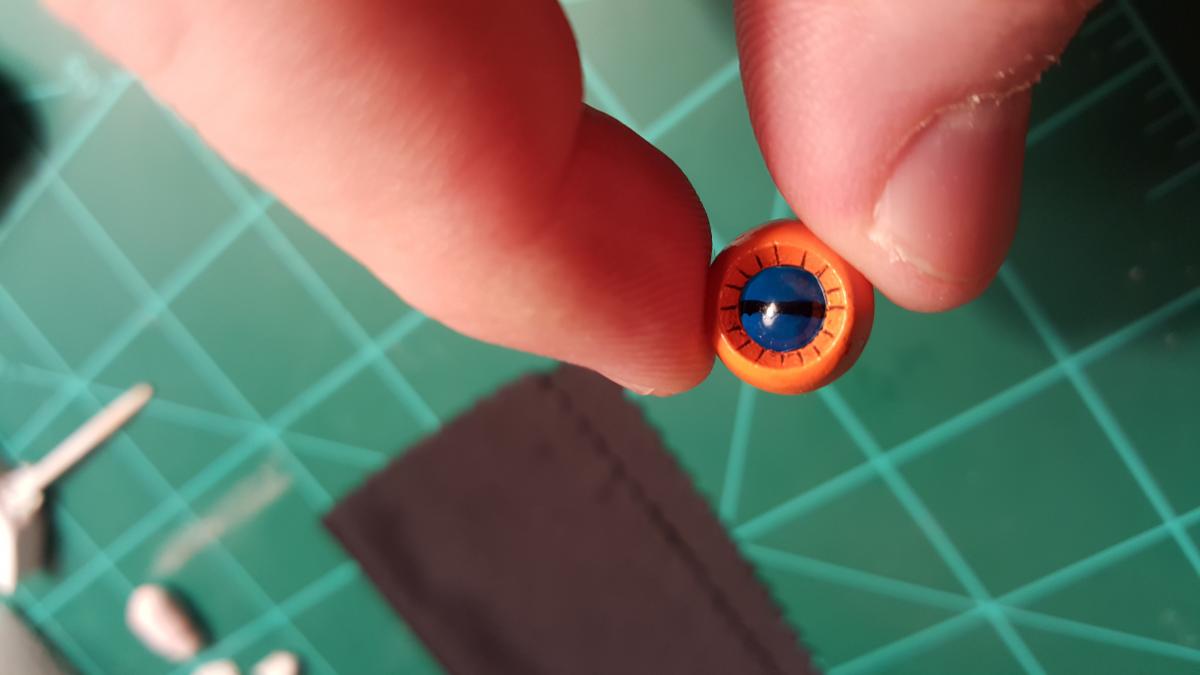

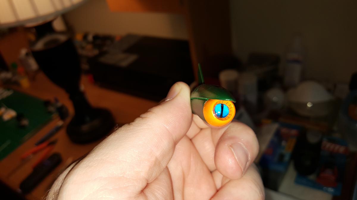

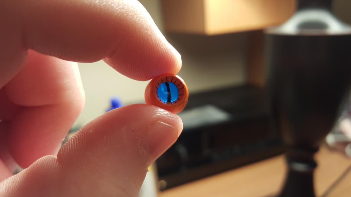

derex3592 Posted May 7, 2015 Posted May 7, 2015 This has been a battle..... , shame the blue will only be seen with a camera flash, but hey, at least I'll know it looks good!
spanner Posted May 7, 2015 Posted May 7, 2015 Hey y'all... just finished this up (almost... some details need to be fixed). Its a Hasegawa F/A-18F kit, in the VFA-2 scheme, using Modern-Hobbies USN/USAF pilots. Next one will be a 1/72 Hasegawa VF-1 gerwalk. I'm not sure what scheme I'm going to build however... either the OOB hikaru, or DYRL Hikaru, or Cannon Fodder. Any thoughts? Great build Noyhauser! Looks fantastic! F-18's are certainly one of my favorite fighters!
captain america Posted May 7, 2015 Posted May 7, 2015 This has been a battle..... , shame the blue will only be seen with a camera flash, but hey, at least I'll know it looks good! Unless you install a blue LED in the head. Regardless, I think it looks fantastic!
electric indigo Posted May 8, 2015 Posted May 8, 2015 As for a low-complexity approach, you could back it with aluminium foil to get some nice hints of the blue when the angle of view is right.
derex3592 Posted May 9, 2015 Posted May 9, 2015 I'm going to polish up the back part of the blue part as much as possible, I may try the aluminum foil idea...thanks Electric Indigo. Sadly Cap, I have zero practice or skills to try lighting a normal kit, much less a resin one. I will leave that to one of the true masters lurking around here. More updates later this weekend hopefully!

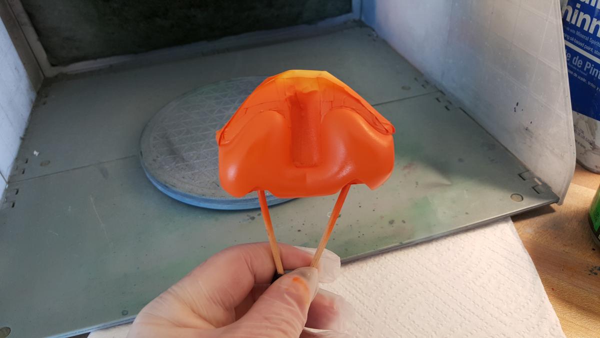

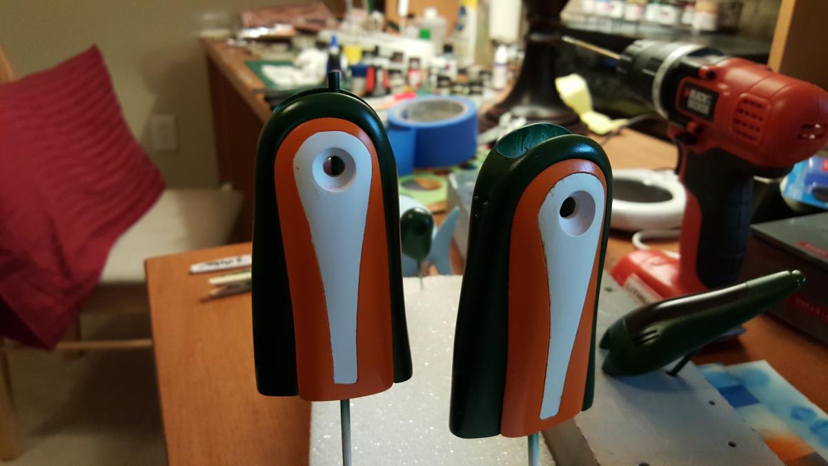

Galaxy_Stranger Posted May 11, 2015 Posted May 11, 2015 Good progress today.... Yer not gonna stick an LED behind that eye??
