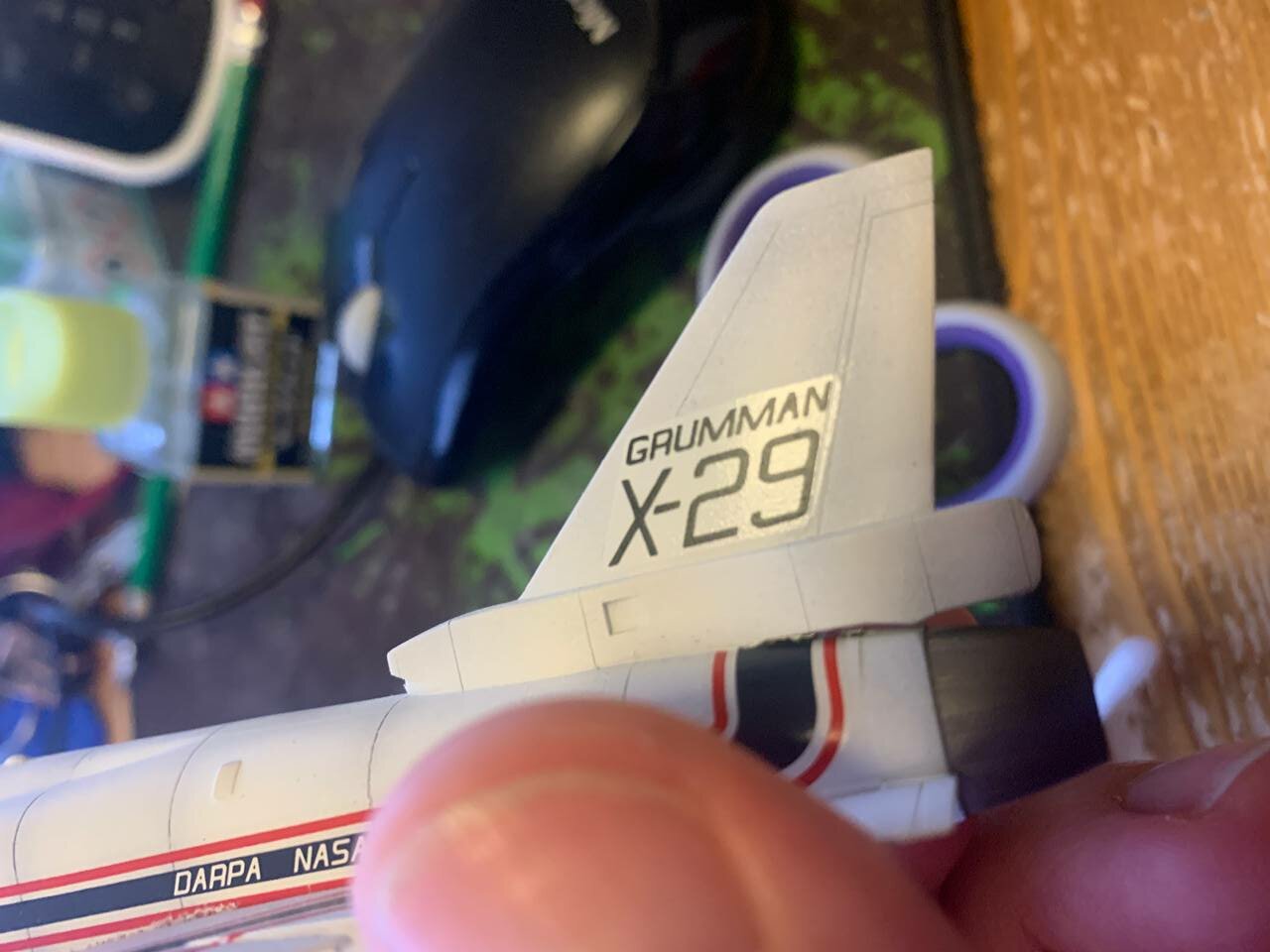

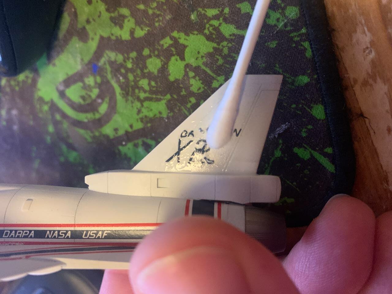

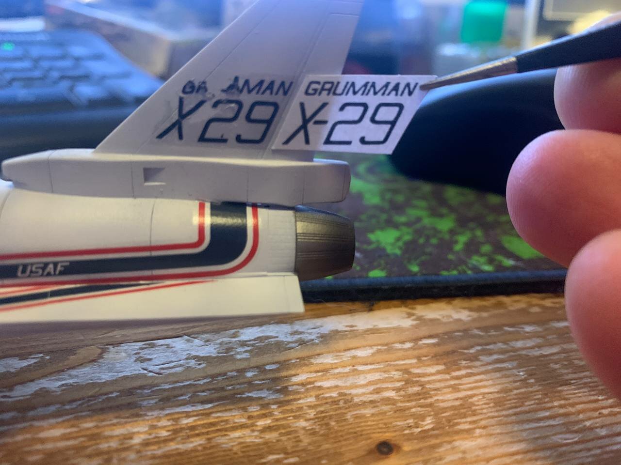

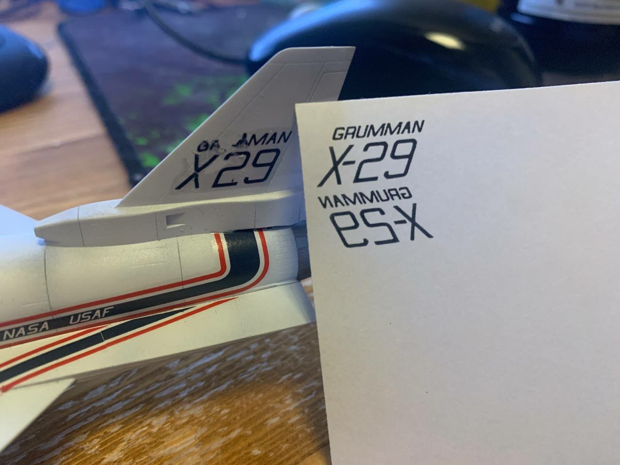

Urashiman Posted April 17, 2023 Author Posted April 17, 2023 @electric indigo that looks awesome. I‘ve been making progress on the X-29. I hate super large decals. If they didn’t came off the transfer sheet in some space they just rip apart. Got some cracks in this already, but was able to fix with tamiya mark fit super strong. Except for this piece of #$&@!? of a water decal. It just crumpled up under my thumb when applying decals to the other side. I either have to print a new one and apply that or will draw on the letters by hand. Not happy man! Absolutely not happy!
Big s Posted April 17, 2023 Posted April 17, 2023 Those big thin decals can be tough. I have less trouble with them since I stopped using decal glue. Just water and a gloss surface. Then something like micro sol after the application and a bit of gloss over the top. I do have occasional rips and tears with those, but the water seems a bit more forgiving about wrinkled messes and repositioning. Are there any decal sets that have that one on the tail that you could use. I think hobby search had quite a few in their aircraft or military section
Urashiman Posted April 17, 2023 Author Posted April 17, 2023 1 hour ago, Big s said: Those big thin decals can be tough. I have less trouble with them since I stopped using decal glue. Just water and a gloss surface. Then something like micro sol after the application and a bit of gloss over the top. I do have occasional rips and tears with those, but the water seems a bit more forgiving about wrinkled messes and repositioning. Are there any decal sets that have that one on the tail that you could use. I think hobby search had quite a few in their aircraft or military section No worries, I have decal transfer sheets for toner based printers. I’ll just scan it off the instructions and work it in PS then print it.
Big s Posted April 17, 2023 Posted April 17, 2023 1 hour ago, Urashiman said: No worries, I have decal transfer sheets for toner based printers. I’ll just scan it off the instructions and work it in PS then print it. Glad you have that option to save your build. It’s looking good so far

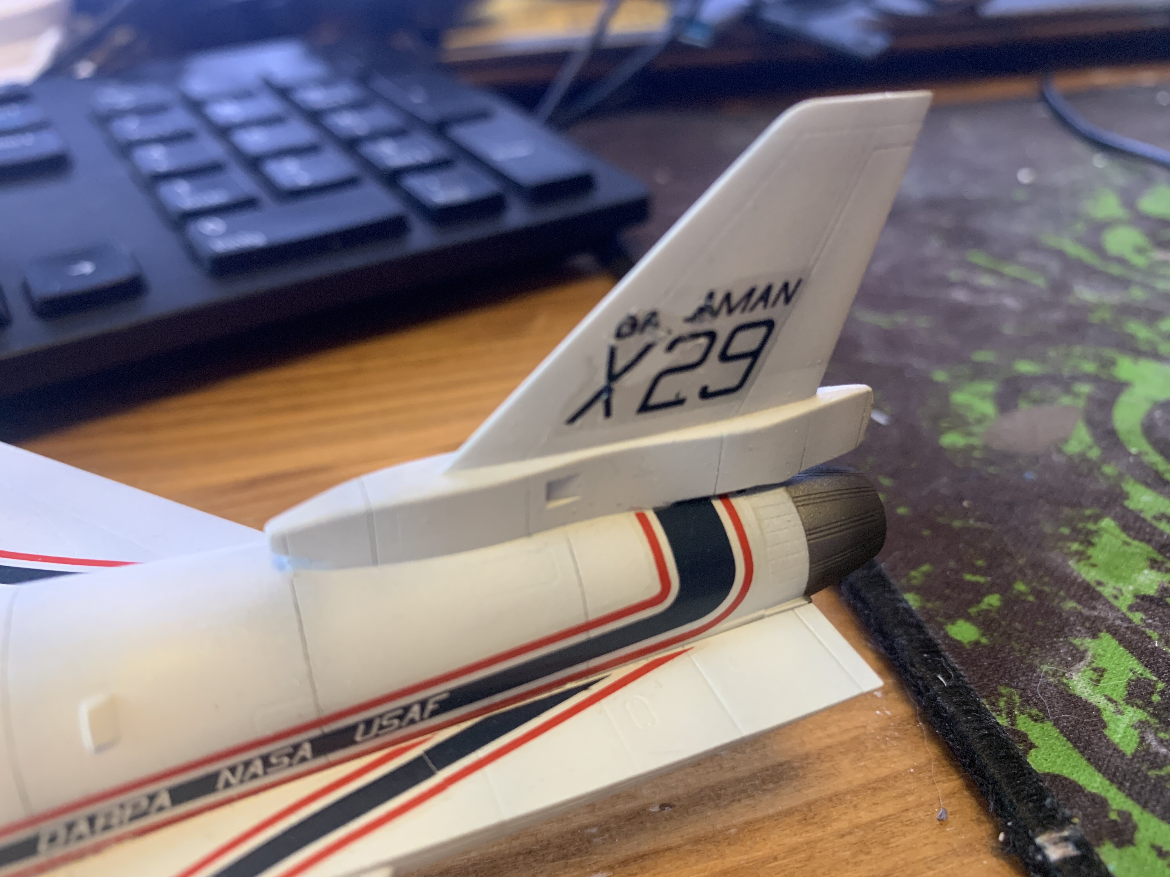

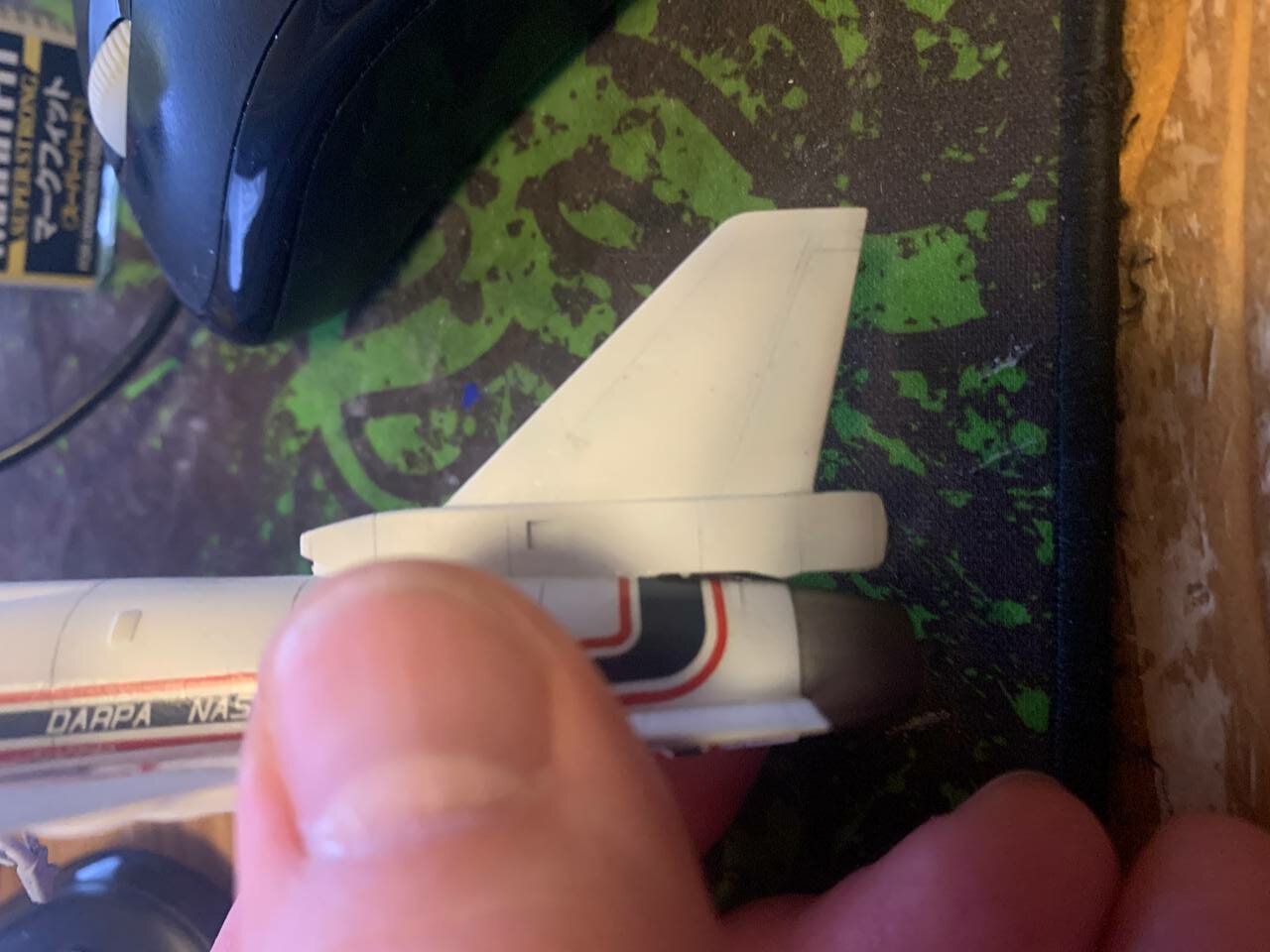

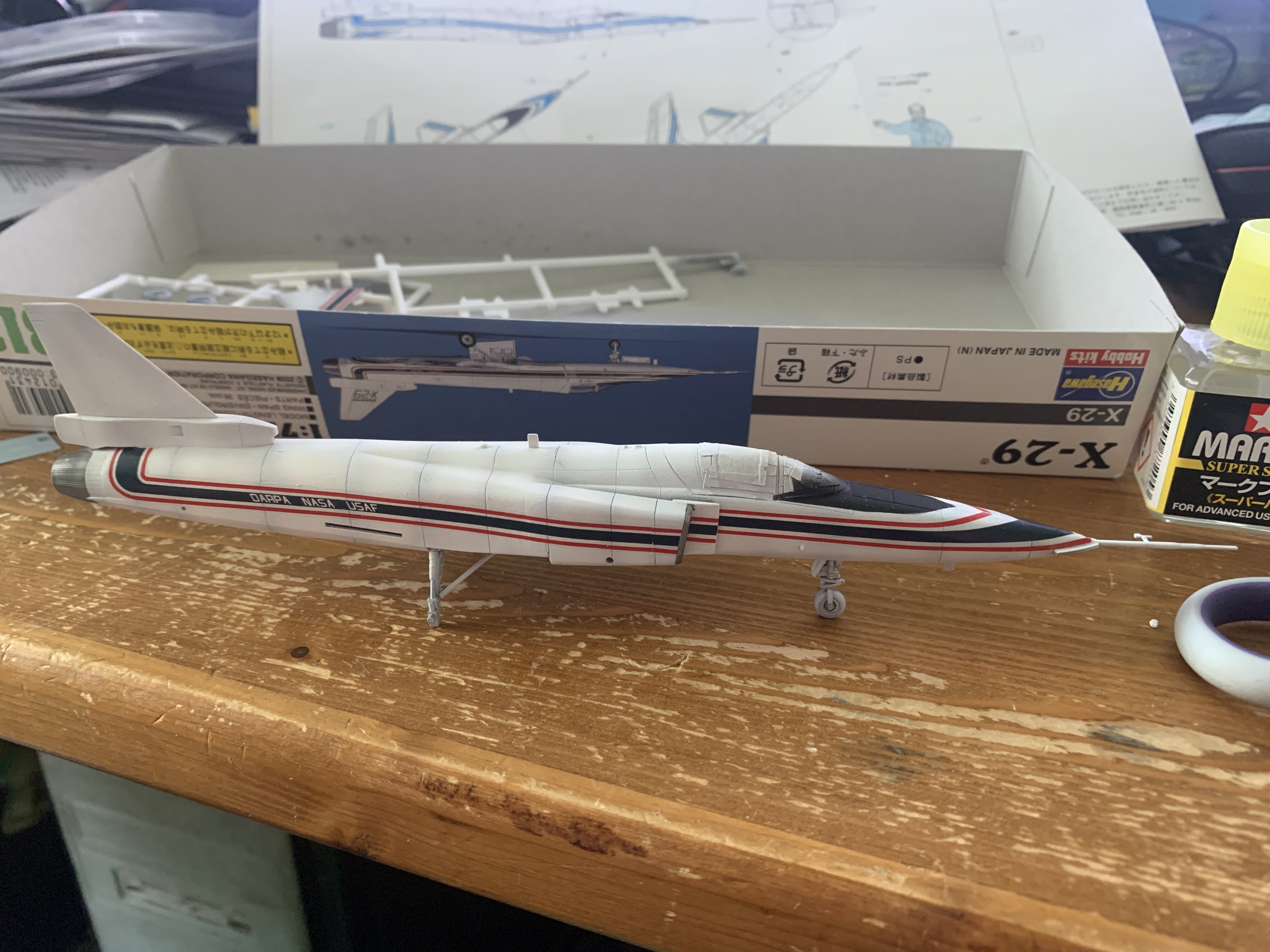

Urashiman Posted April 18, 2023 Author Posted April 18, 2023 (edited) Okay ... I think I saved it. I spend an hour in PS, scanned the instructions, then I redrawed the GRUMMAN X-29 logo and tweaked here and there. Then I did the first testprint on standard 90g paper. The size is correct and it looks detailed enough. Time to rub off the old decal with solvent (IPA and decal softener). As good as new, I guess. Then I printed to the transfersheet and cutted out the decal, putting it into warm water to detach. Et voila! It worked! The gloss will be matching after coating the modelkit. MUAHAHAHAHAHAH! Edited April 18, 2023 by Urashiman
arbit Posted April 18, 2023 Posted April 18, 2023 11 minutes ago, Urashiman said: Then I printed to the transfersheet and cutted out the decal, putting it into warm water to detach. Cool. Nice save!

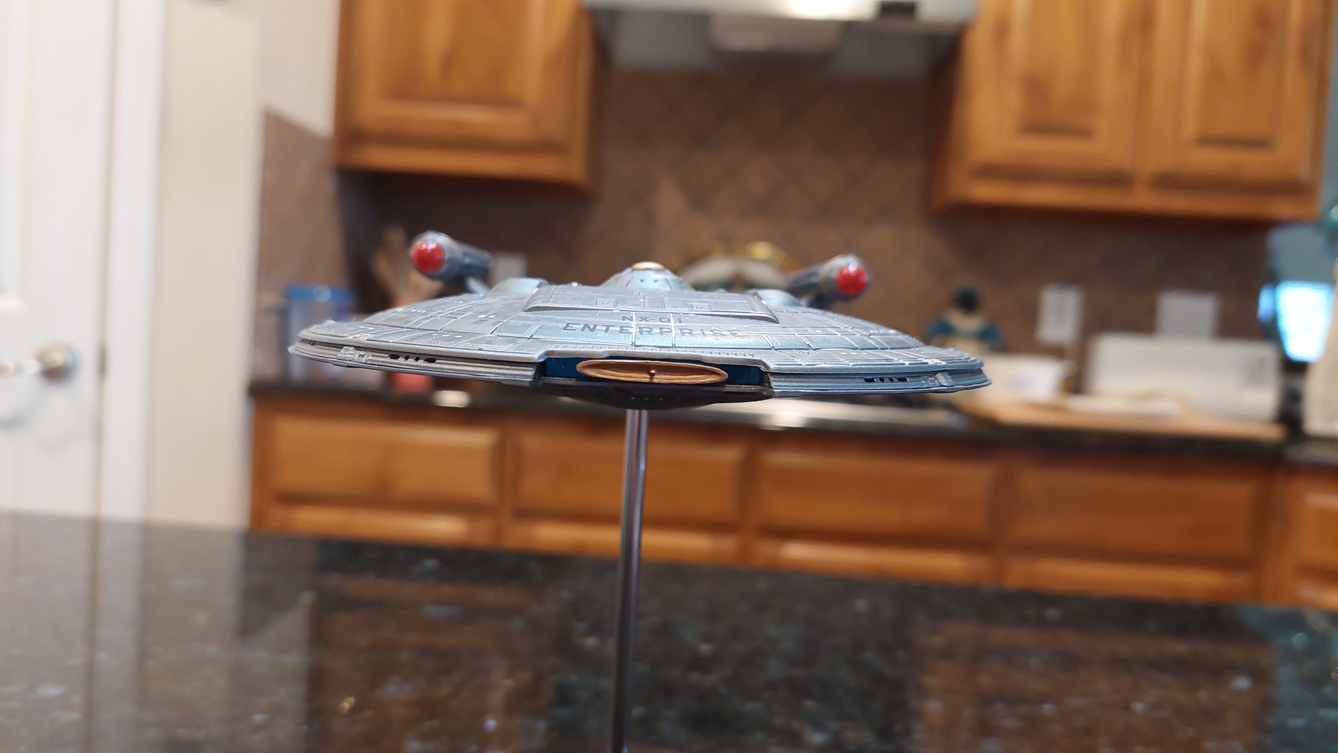

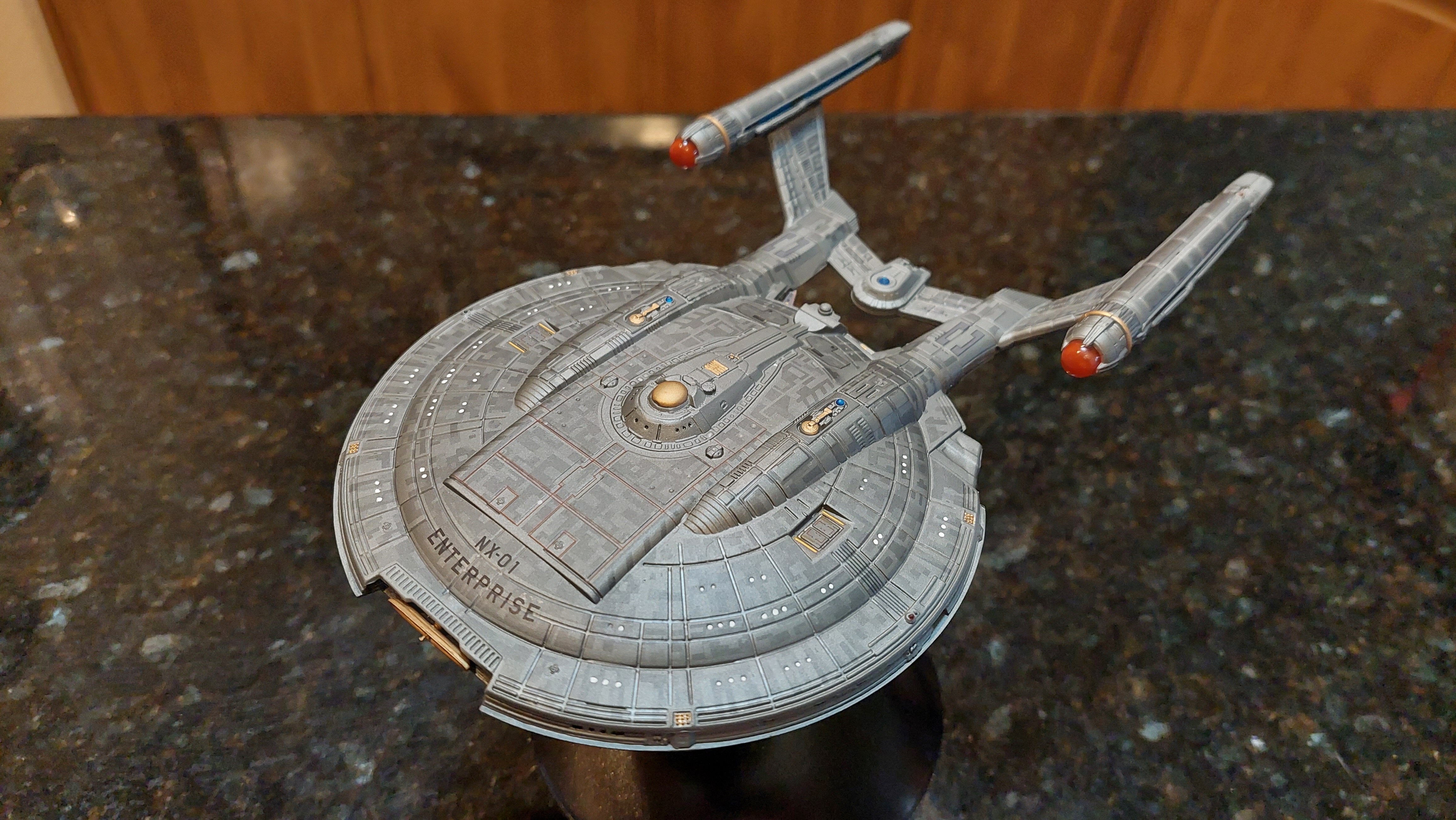

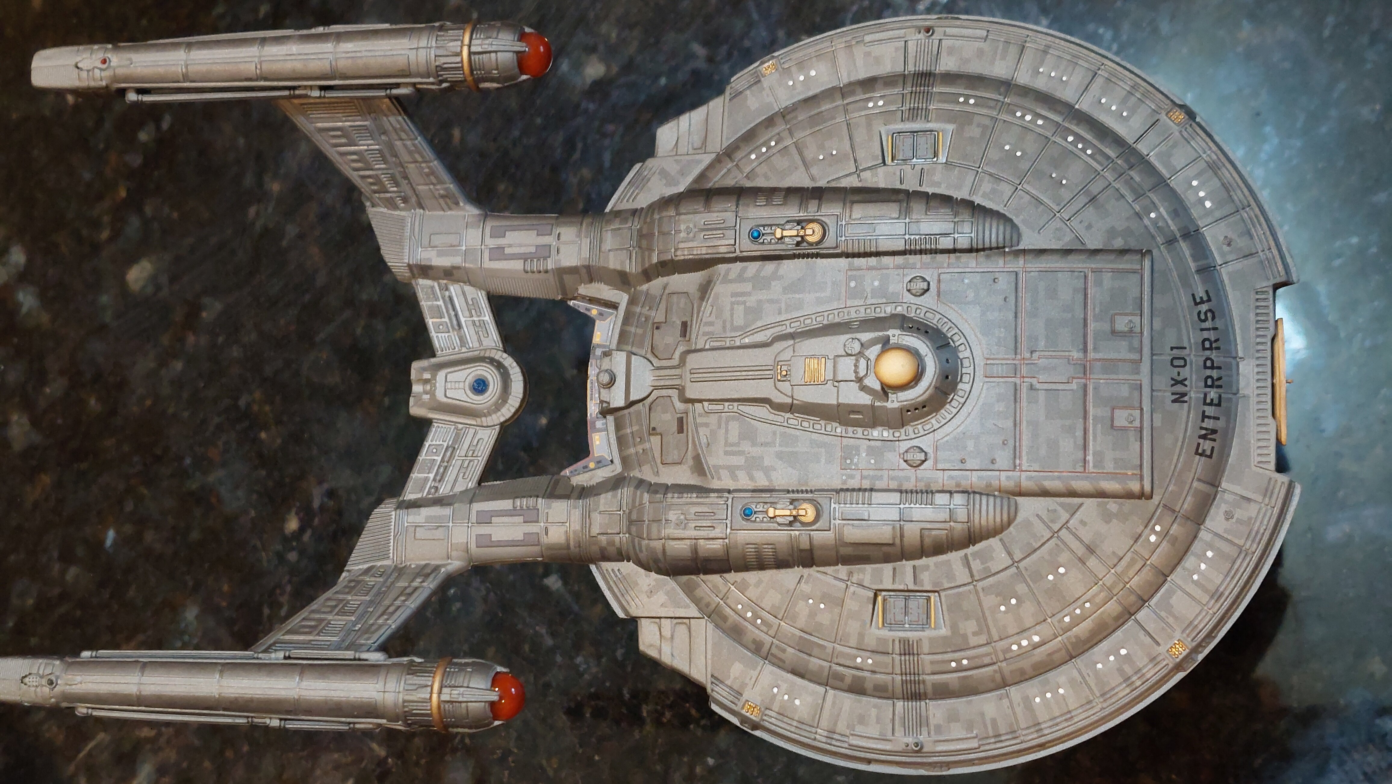

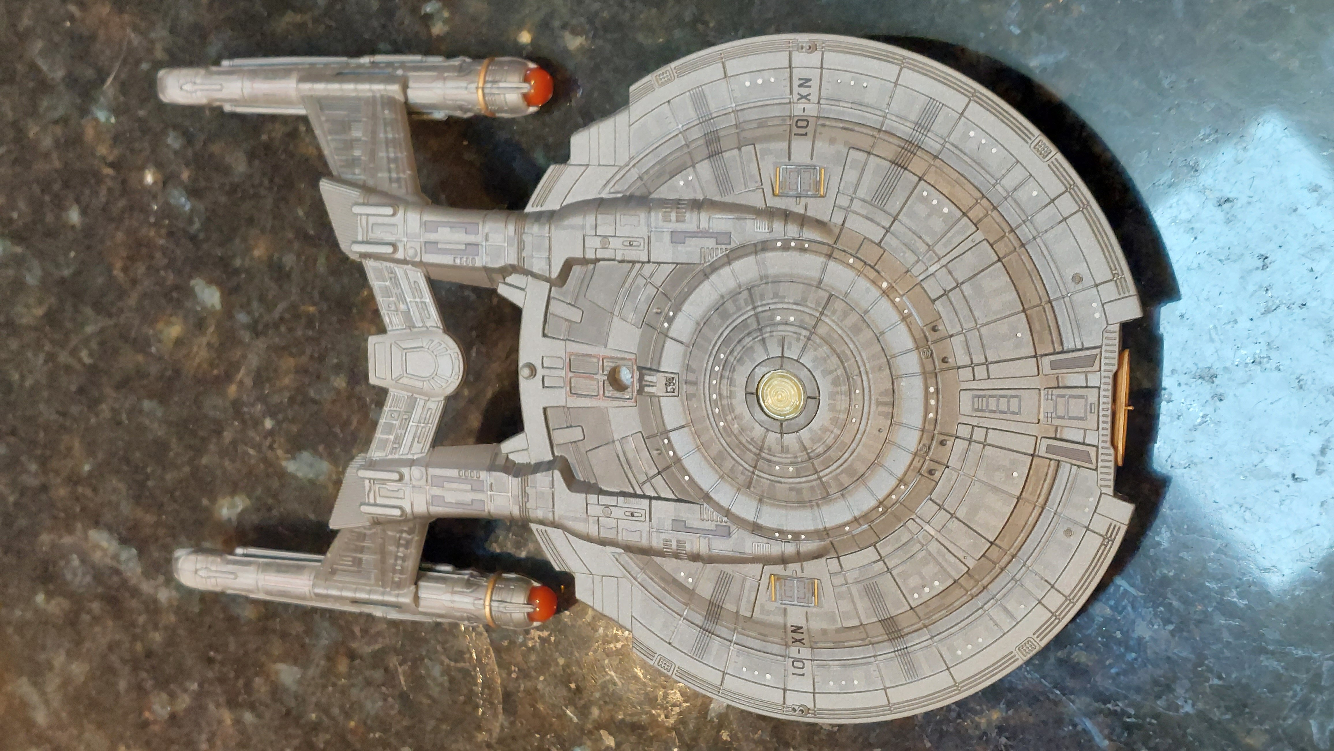

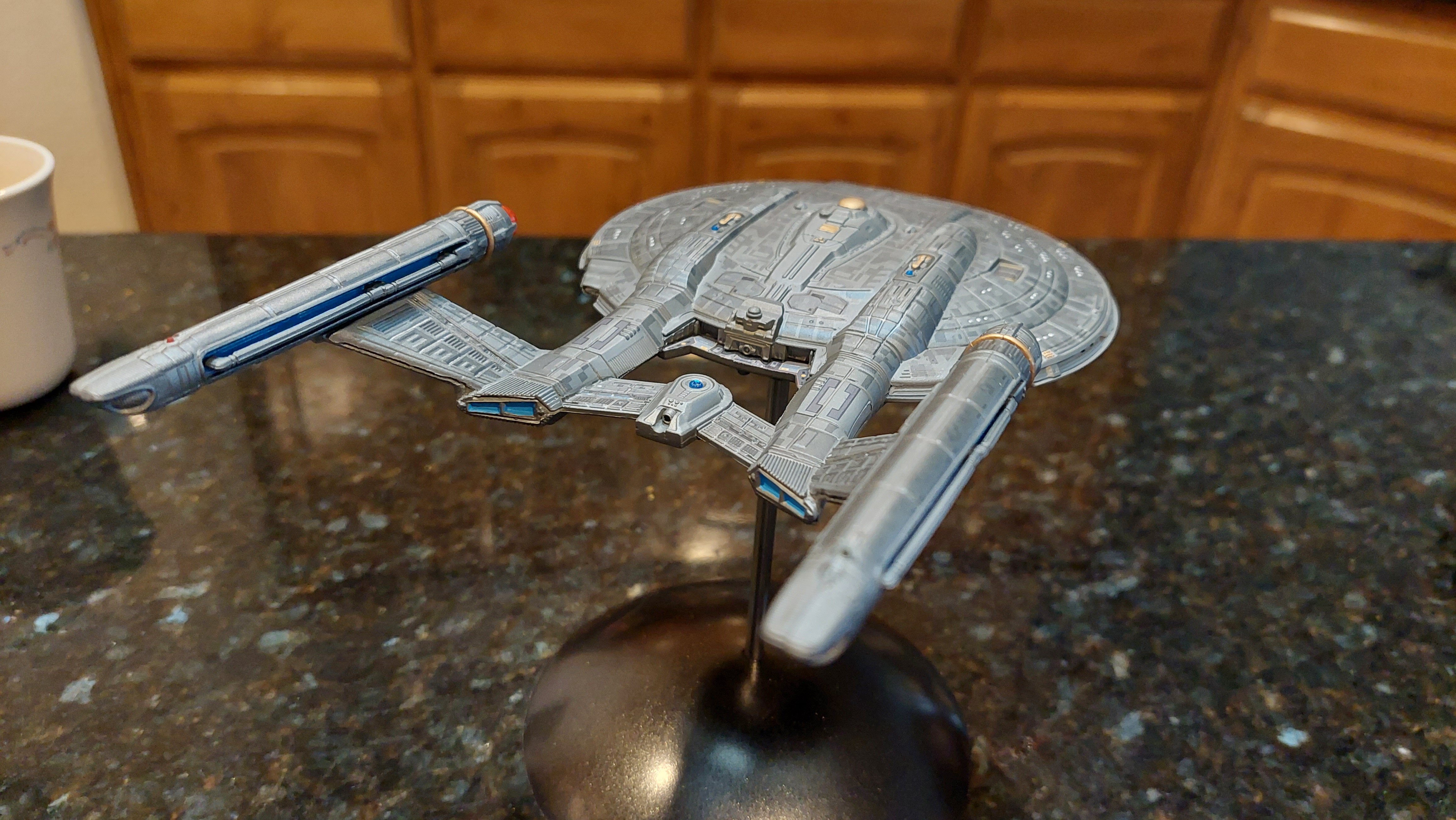

derex3592 Posted April 18, 2023 Posted April 18, 2023 Polar Lights 1/1000 NX-01 ENTERPRISE is ready to leave spacedock! I went off high res pics of the CG model. Full Aztecs top and bottom along with kit decals. Great little kit. Nothing bad to report really. Some putty and sanding on the engineering section on the back, but nothing crazy. If I had nothing but money and time I would build two more of them, one being the refit (which it does come with the parts for) and the other as the alternate universe ISS Enterprise, just to be able to use the crazy giant yellow lighting/sword decals on the top of the saucer! Enjoy the pics! Moving on to the A Refit, Voyager and the original Enterprise now!

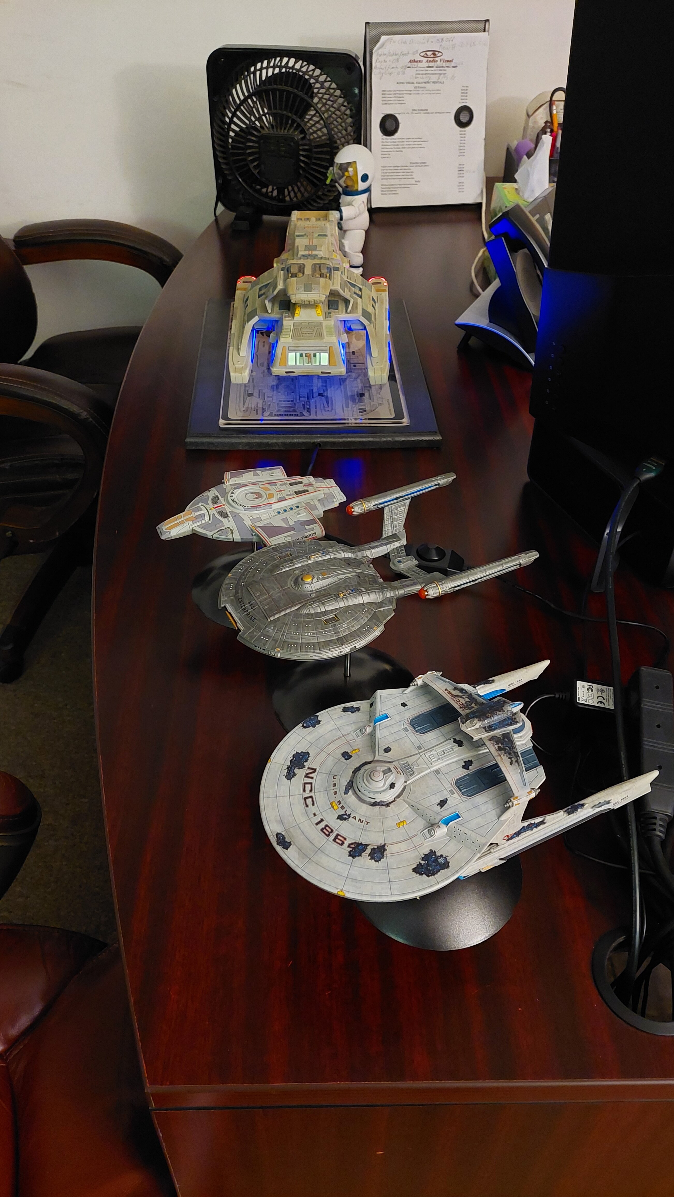

derex3592 Posted April 20, 2023 Posted April 20, 2023 @wm cheng My 1/1000 scale mini fleet so far.... I'm gonna need a bigger desk at this rate... LOL 😂
