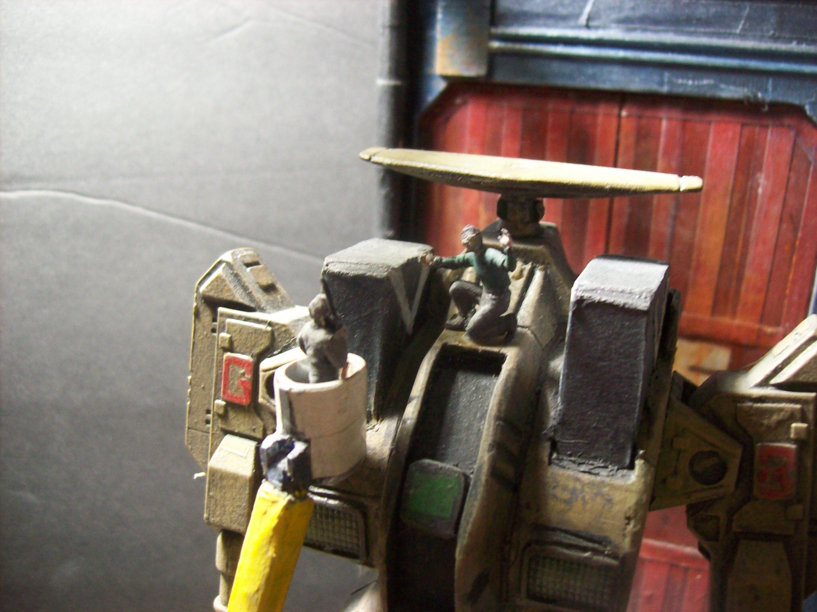

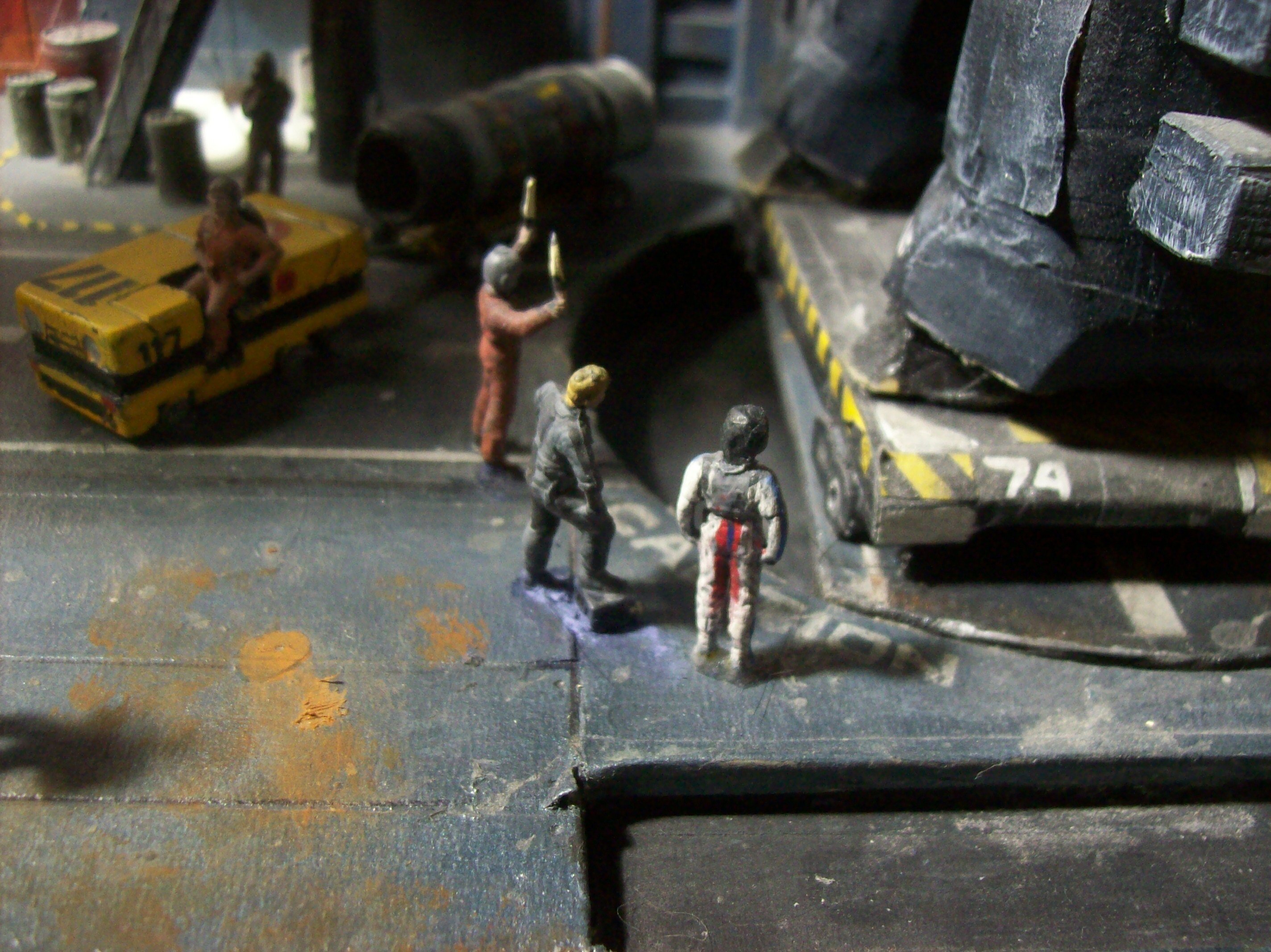

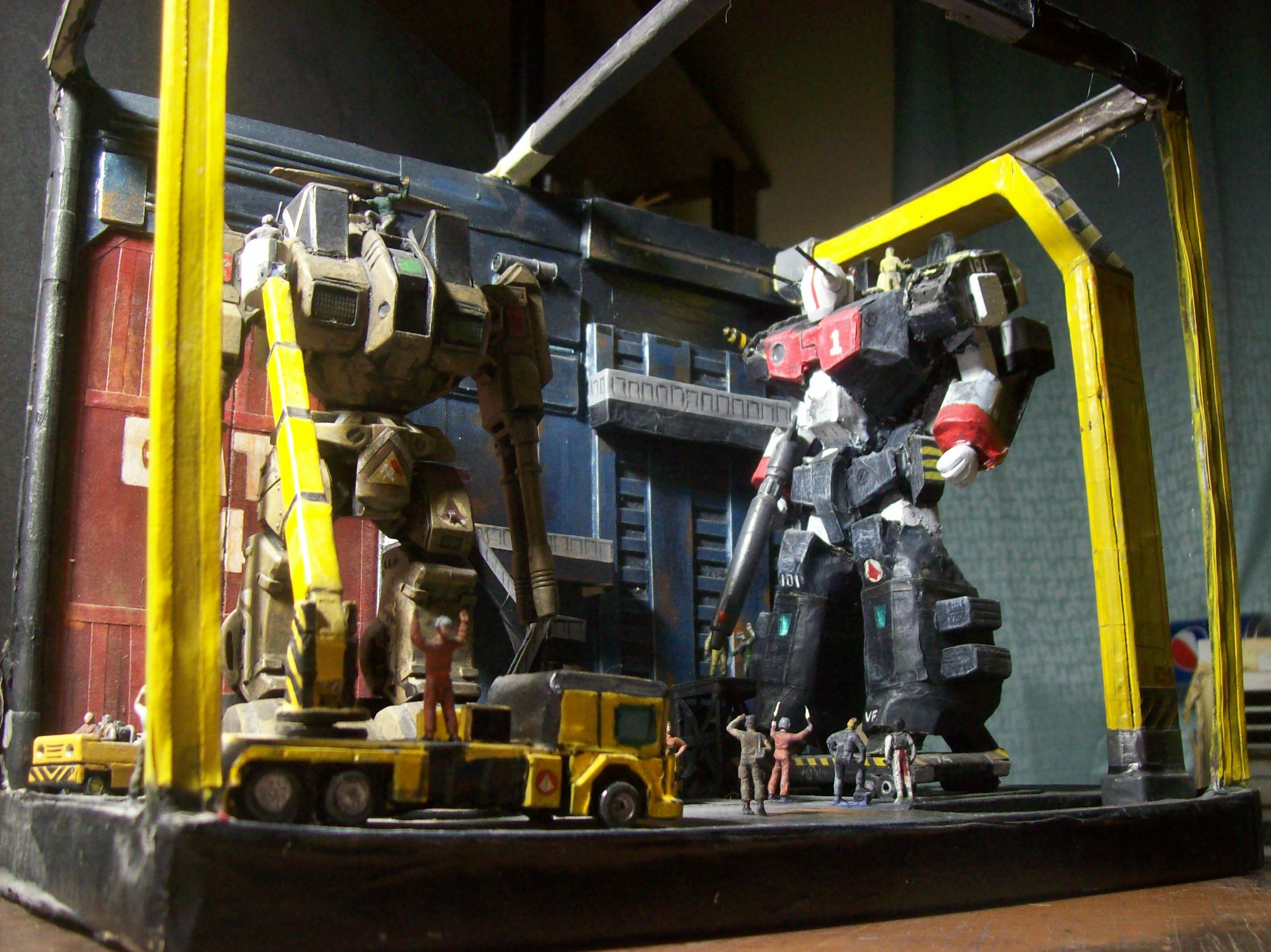

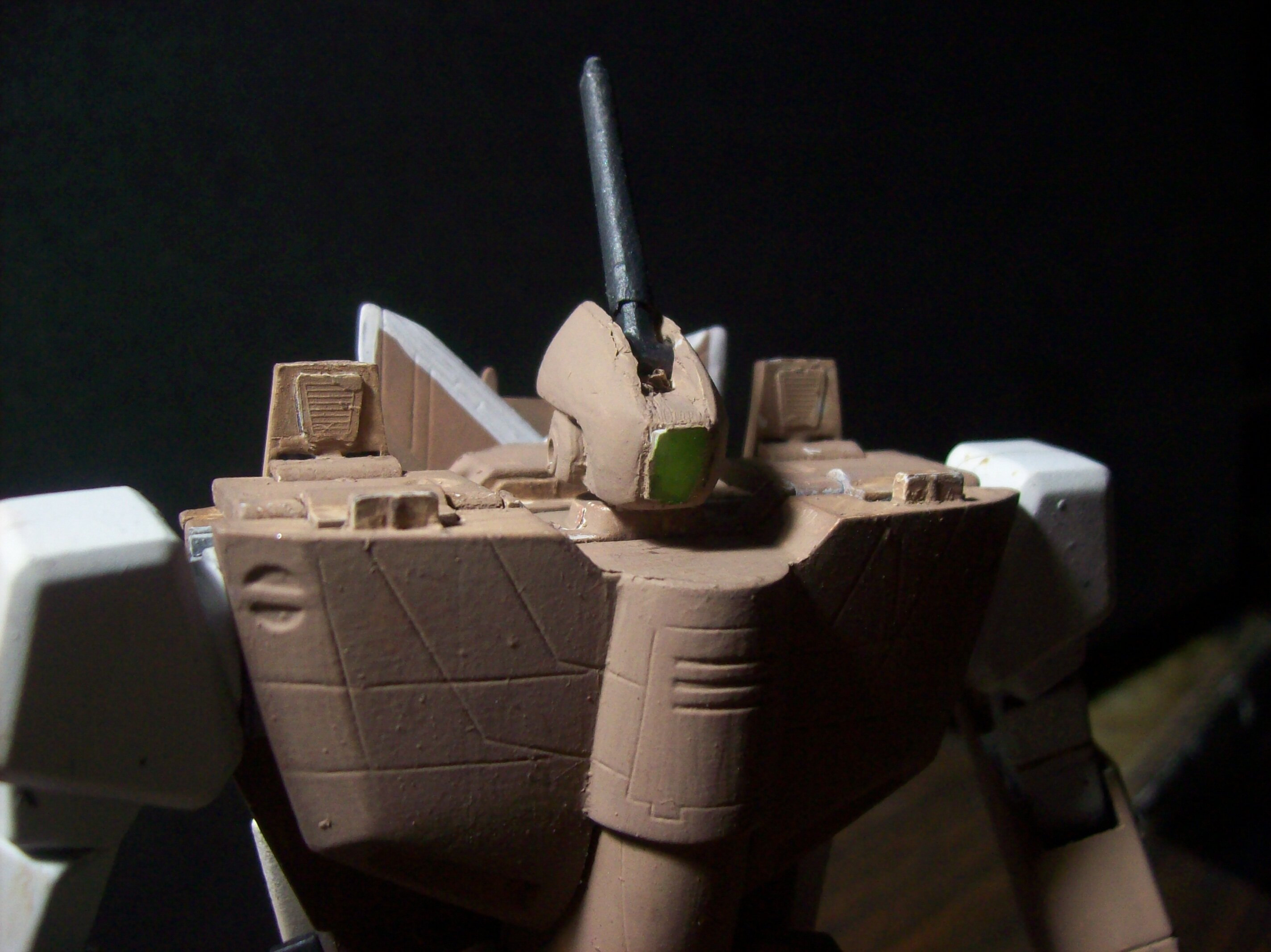

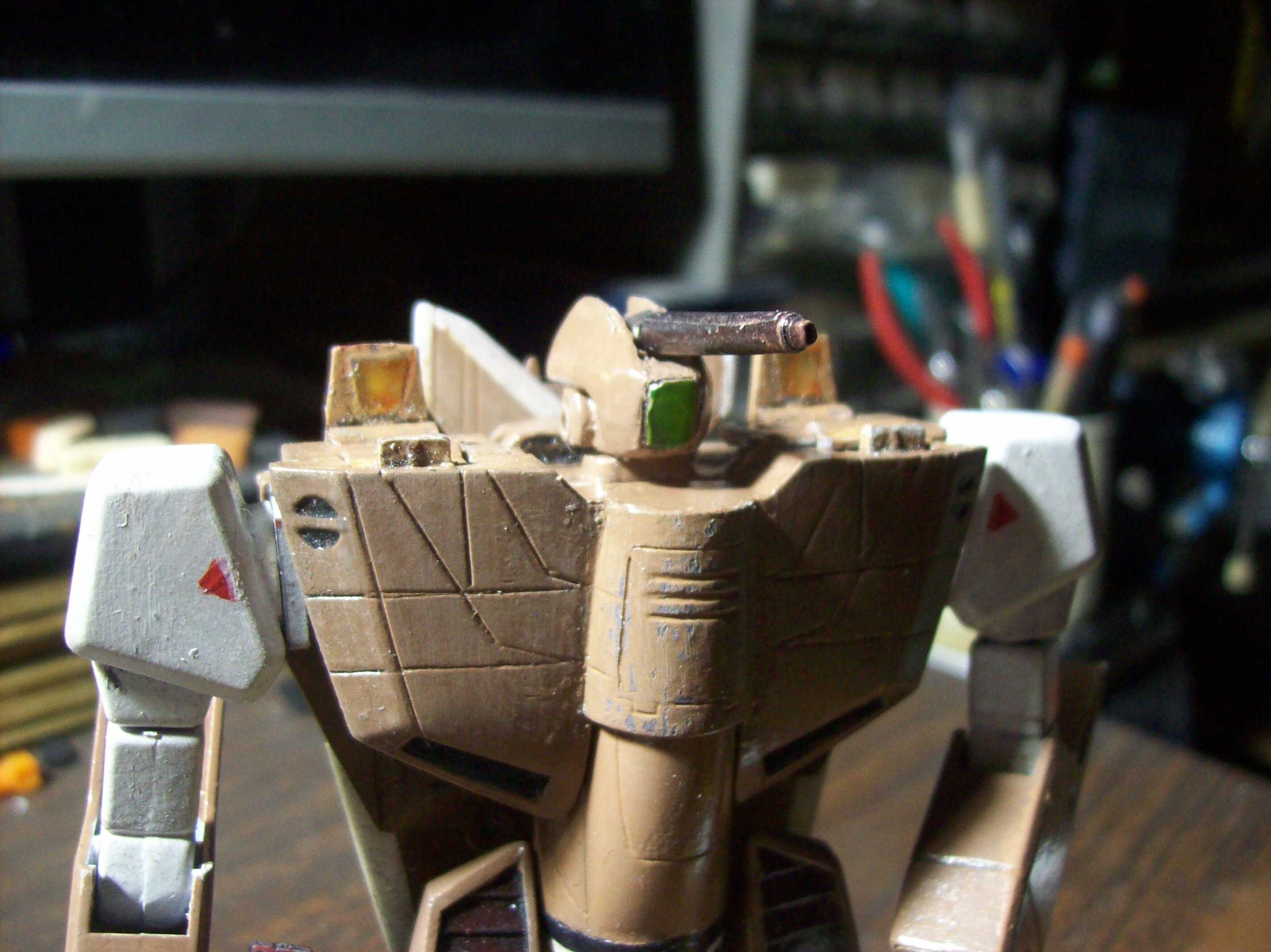

UPDATE:

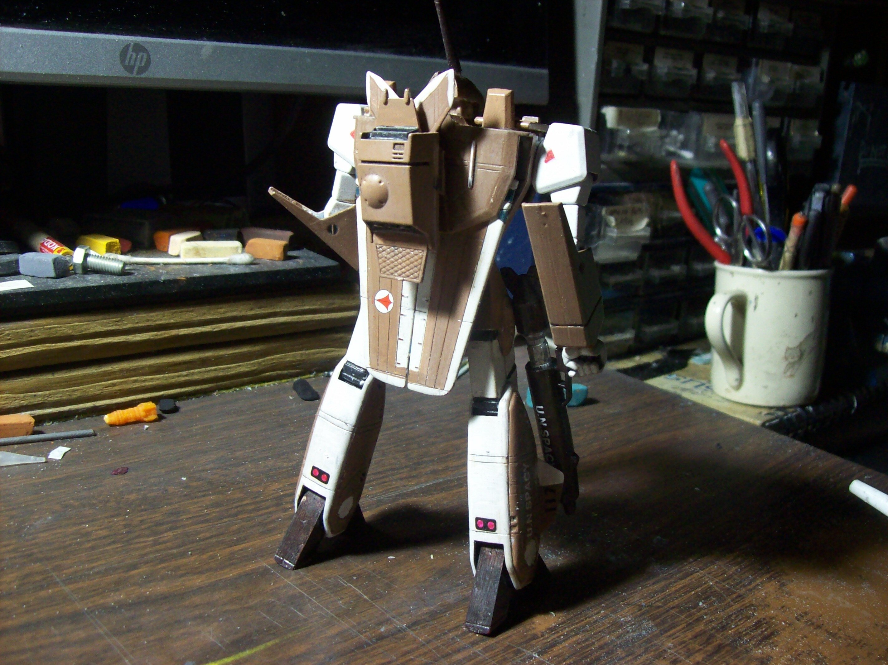

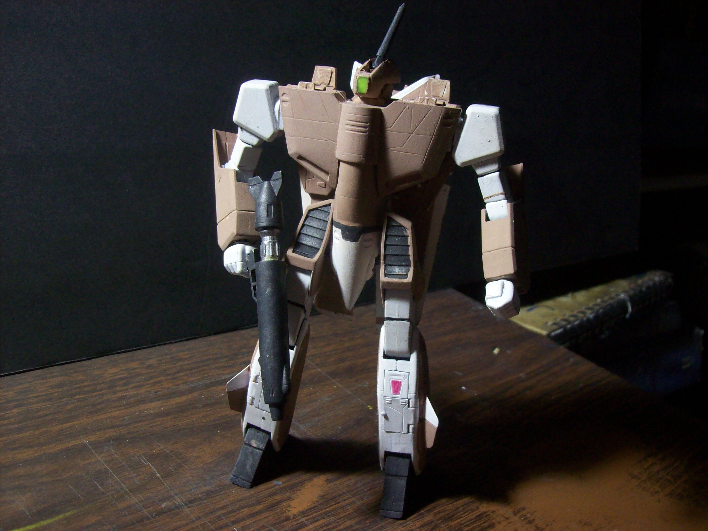

Well, here's what I've been up to as of late-
1) Repairs on my 1/72 Armored Factory:
101_1048.JPG.f36aab2171692cfba8e52a9a942117fe.JPG   101_1050.JPG.d39da9f108b3c0192b99ce2f92fae8bd.JPG
101_1051.JPG.07eb5144c66b957984ea9a664e8ab7ca.JPG   101_1052.JPG.daf1963c4bd3b7cf685af0285ac2cd4c.JPG

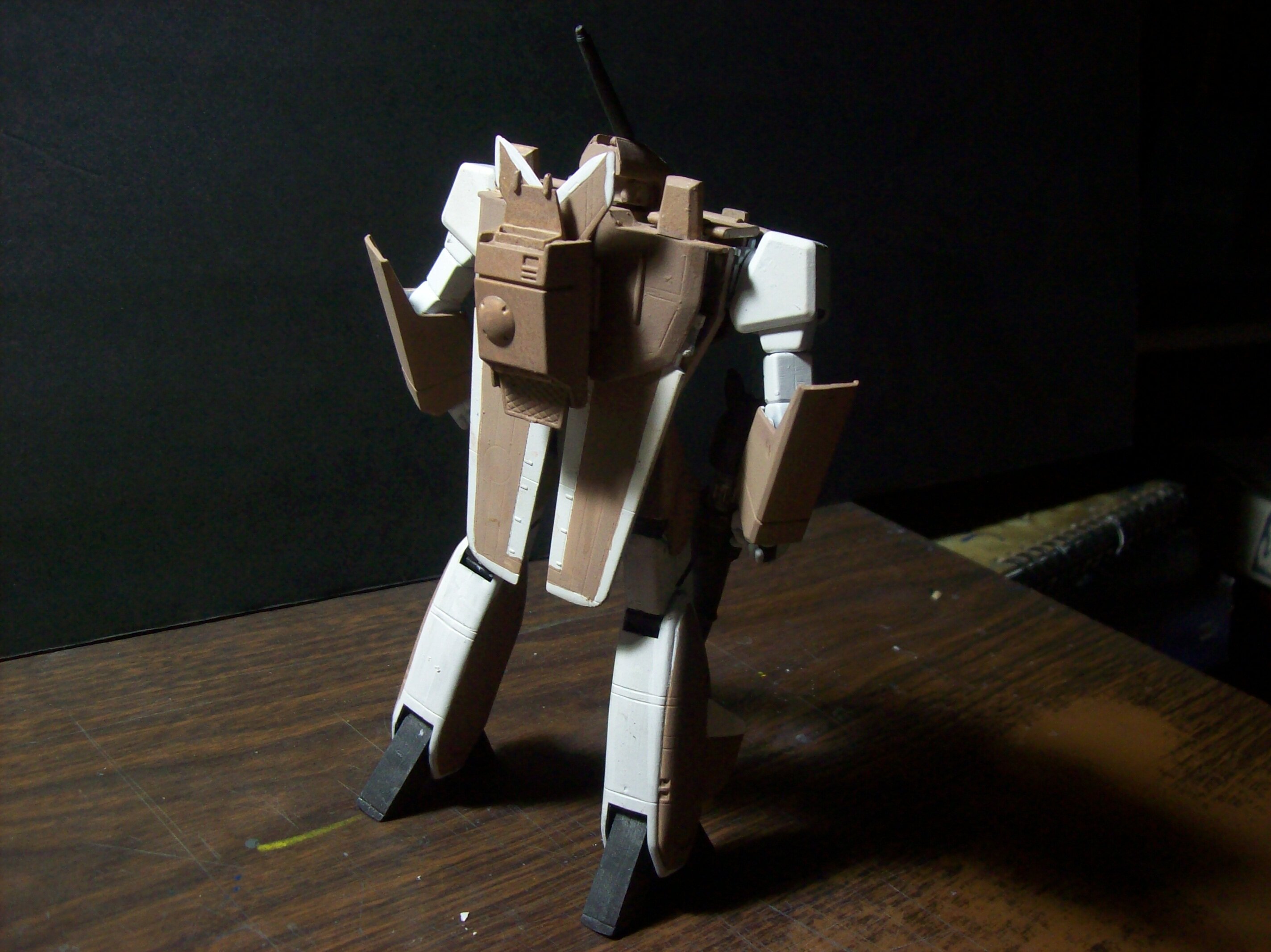

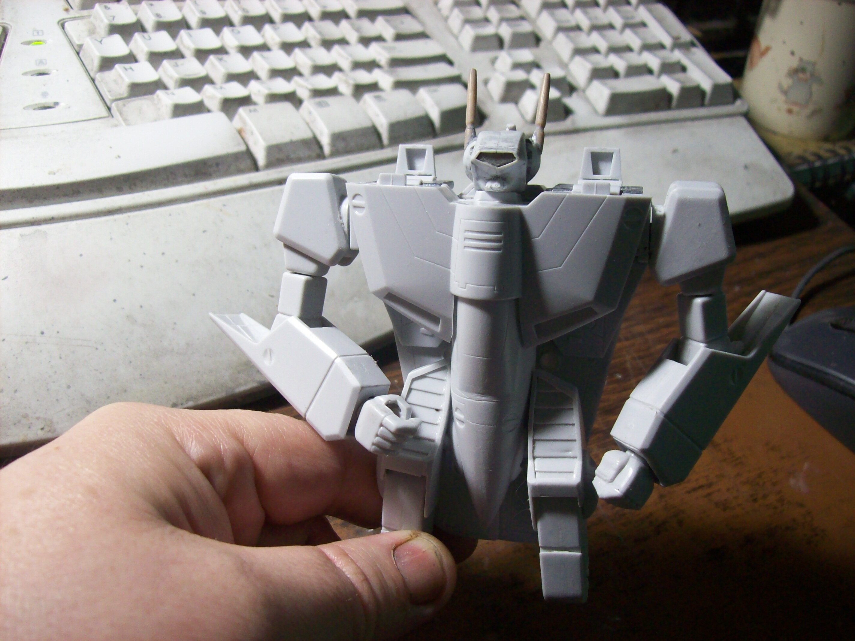

2) Building a new body for Hikaru's VF-1J (I switched to the newer model instead of trying to rework the old one, as red plastic and a white finish don't exactly work!):
101_1057.JPG.b740924780d214126d99ed60858471fe.JPG 101_1058.JPG.b5ea2bc1675c37eb8a3060578b835454.JPG
3) I was finally able to fix the slider mechanisms on the old VF-1 body, but now had no head for it. So....
101_1034.JPG.dc043068f3a5de7e6ffbaec5fc8b8871.JPG   101_1035.JPG.76c08a645dec784397118f1b9e347d6f.JPG
Where I'm at now:
101_1053.JPG.08b7028a02970fee9f8827ff9323098c.JPG 101_1054.JPG.410d8cde4367504ec4376cf5bddc689f.JPG
101_1055.JPG.c40c29da132b5600fb8e36923dc3fa3d.JPG 101_1056.JPG.c58cccd3cc71ecaf4002c436bd98e077.JPG
Still working on refining the paint job and need to get decals on this; I'll try to have some more pics tonight.
Stay tuned...
Thanks! Yeah, its time to get this one done, hopefully soon.
@pengbuzz Your factory and Valk are looking great! I'm glad you can tackle the cannon fodder scheme. Too much masking for me!😁 - MT

I really love the color palette especially the contrast between the green eye and the chest of the body, it makes your eyes drawn to the center and upper torso. Also what did you make the head peice out of?

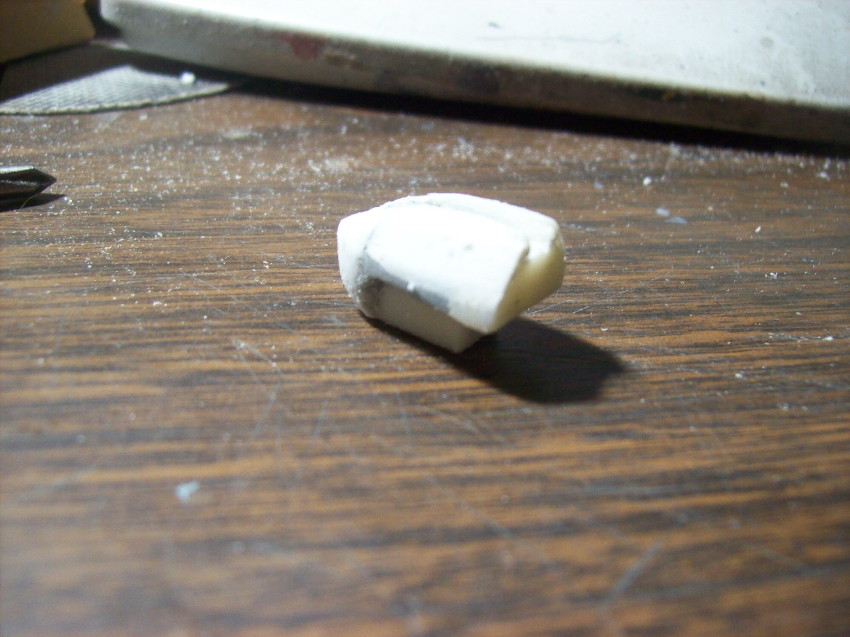

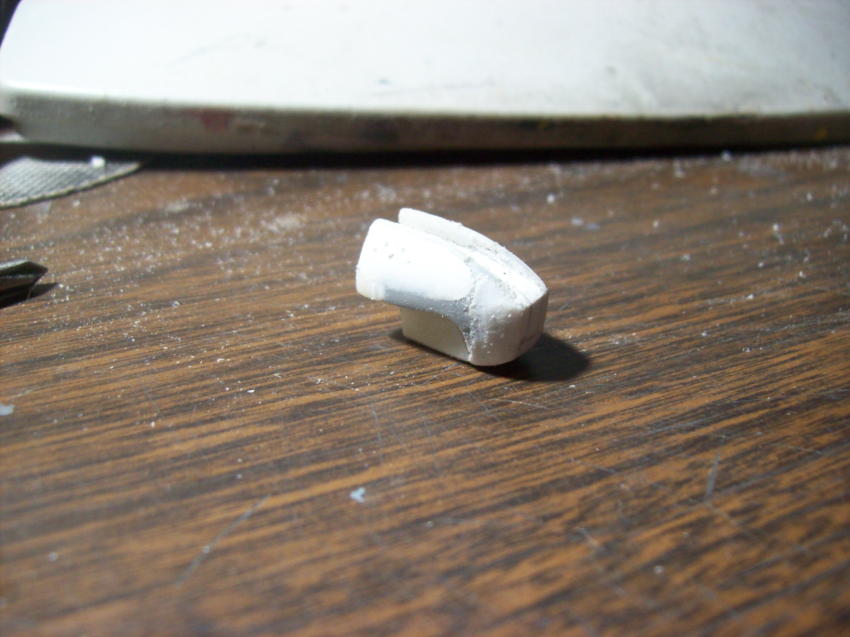

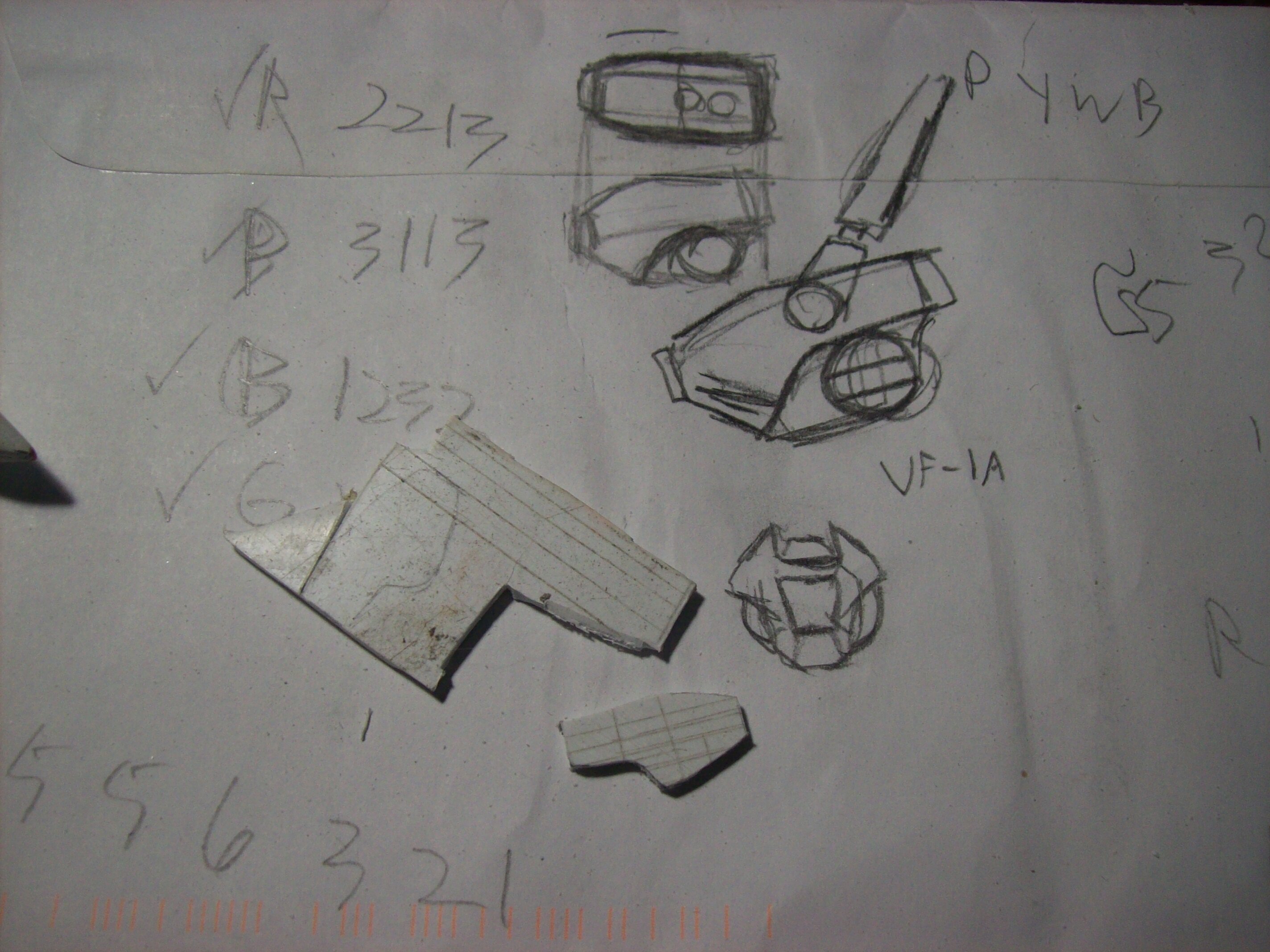

Thanks! The head was made from 1/8 inch sheet styrene. I simply sketched the profile of it onto paper, traced it onto the styrene, then cut out one piece and used that as a template to trace and cut 3-4 more. I glued them together and put it under a stack of heavy books to make the glue "weld it" into one solid chunk. After that, it was a matter of using a rotary tool, craft knife ("xacto knife"), needle files, sandpaper and a huge metal file to refine the shape.

I know that you obviously have tools to make the exact changes you want but the craftsmanship seems to be perfect, it's pretty much fully symmetrical.
Just simple hand tools and a motorized tool. But anyone can do it with hand tools; my arthritis makes the rotary tool necessary.

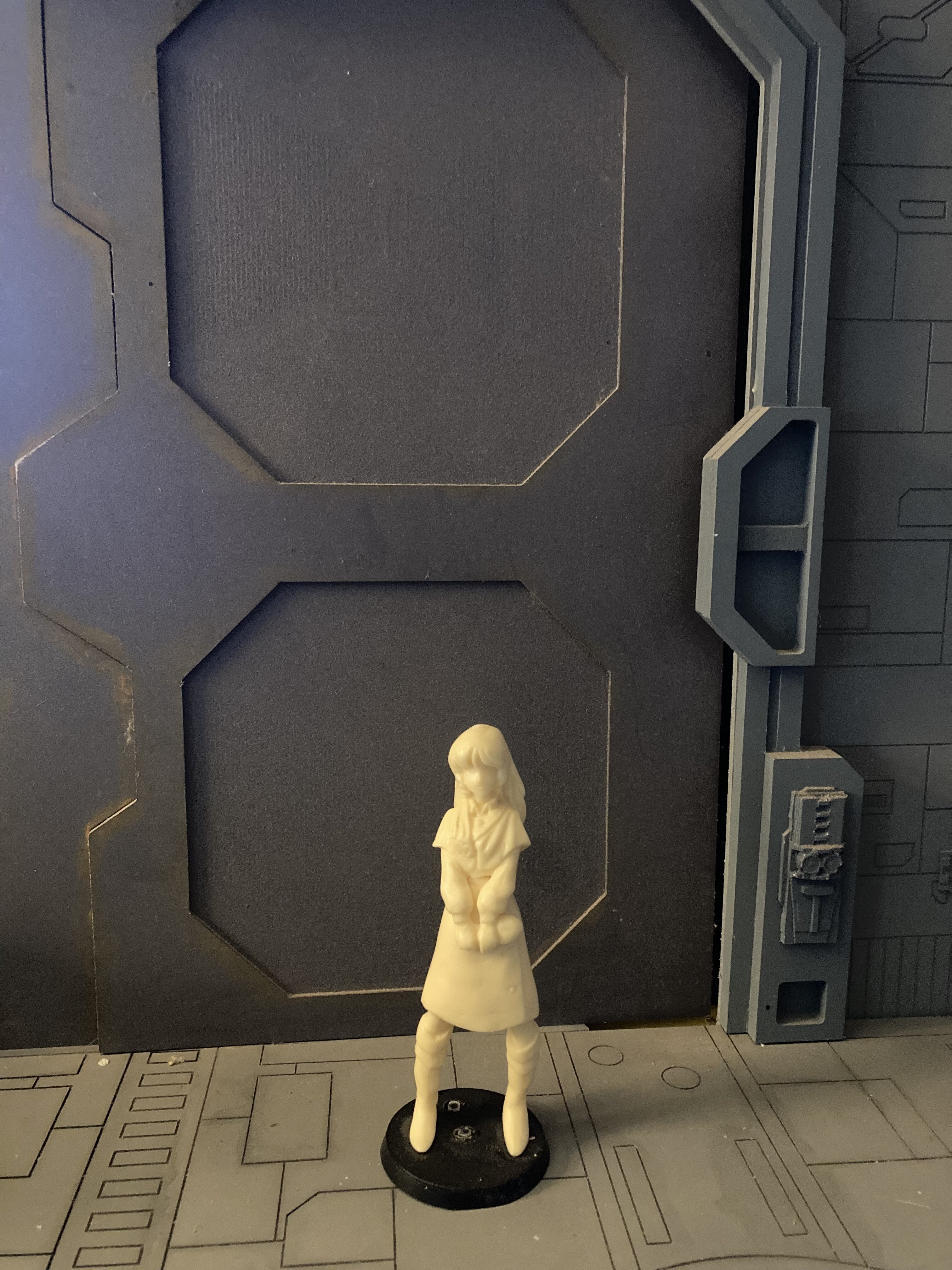

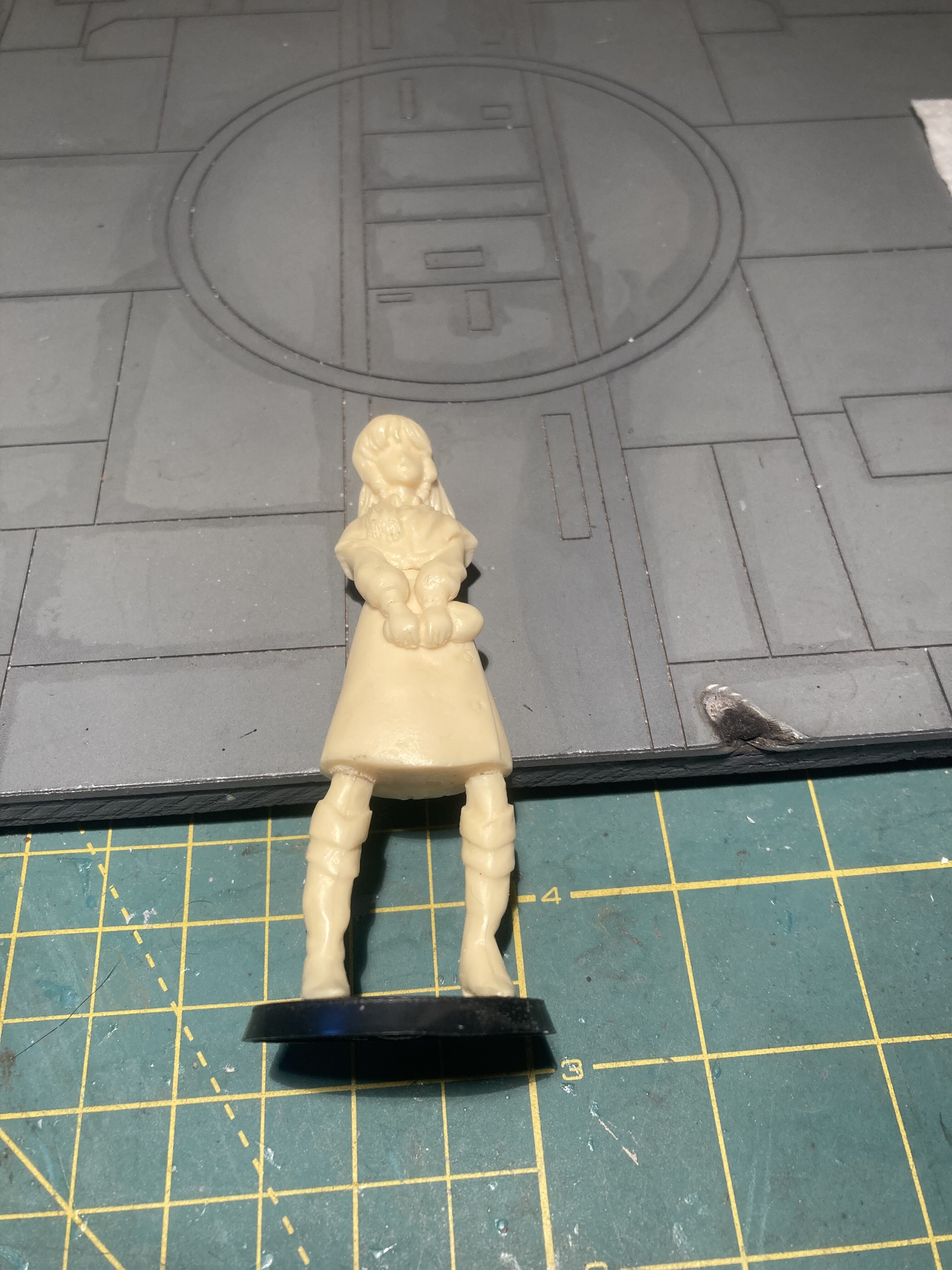

I've  got my resin version sitting on the workbench. Patiently waiting.51528235-E681-42AE-82A4-59C480D78FFE.jpeg.2c1e3cd7b28bdaf4211555d1969d7b7e.jpeg

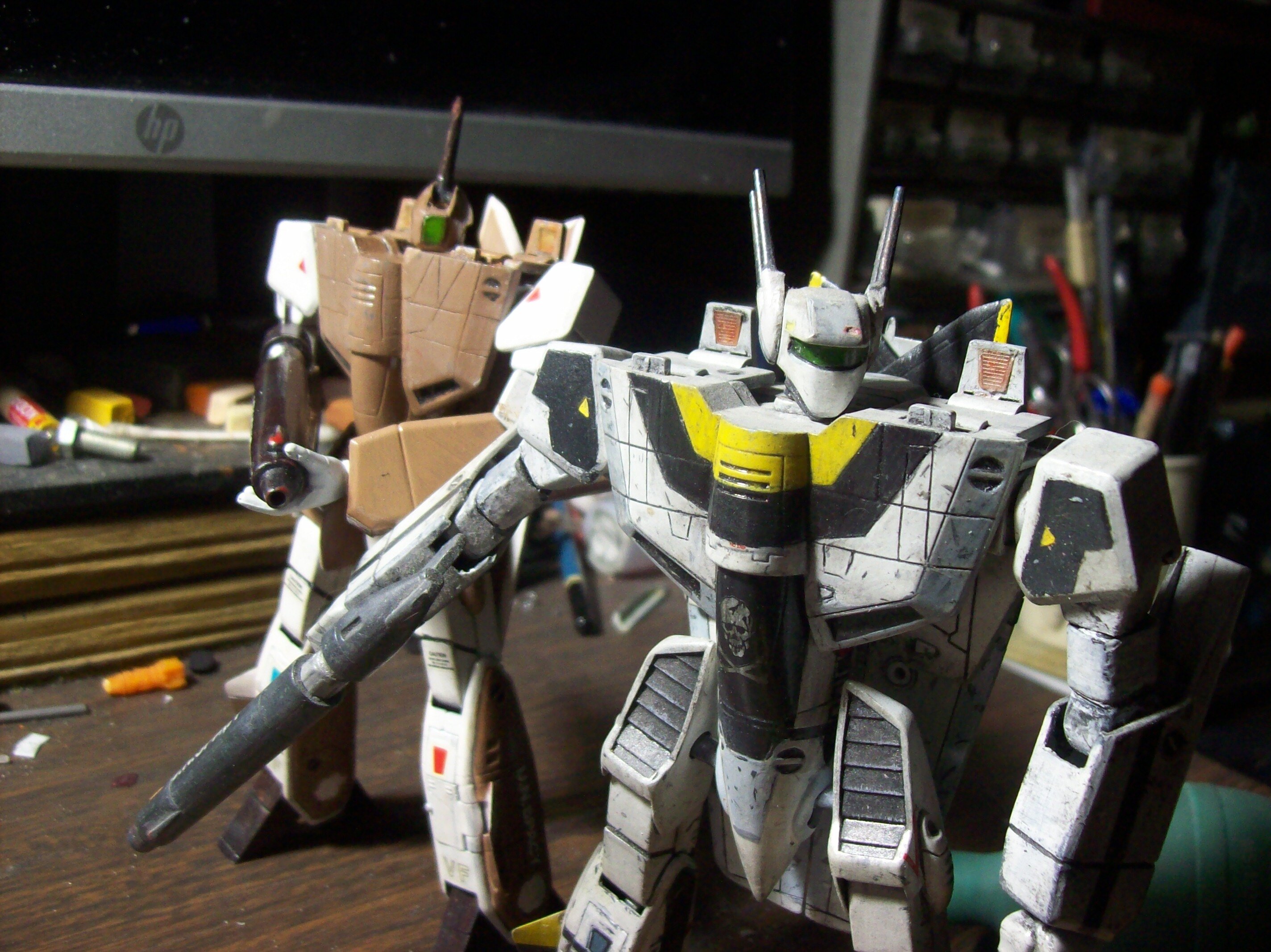

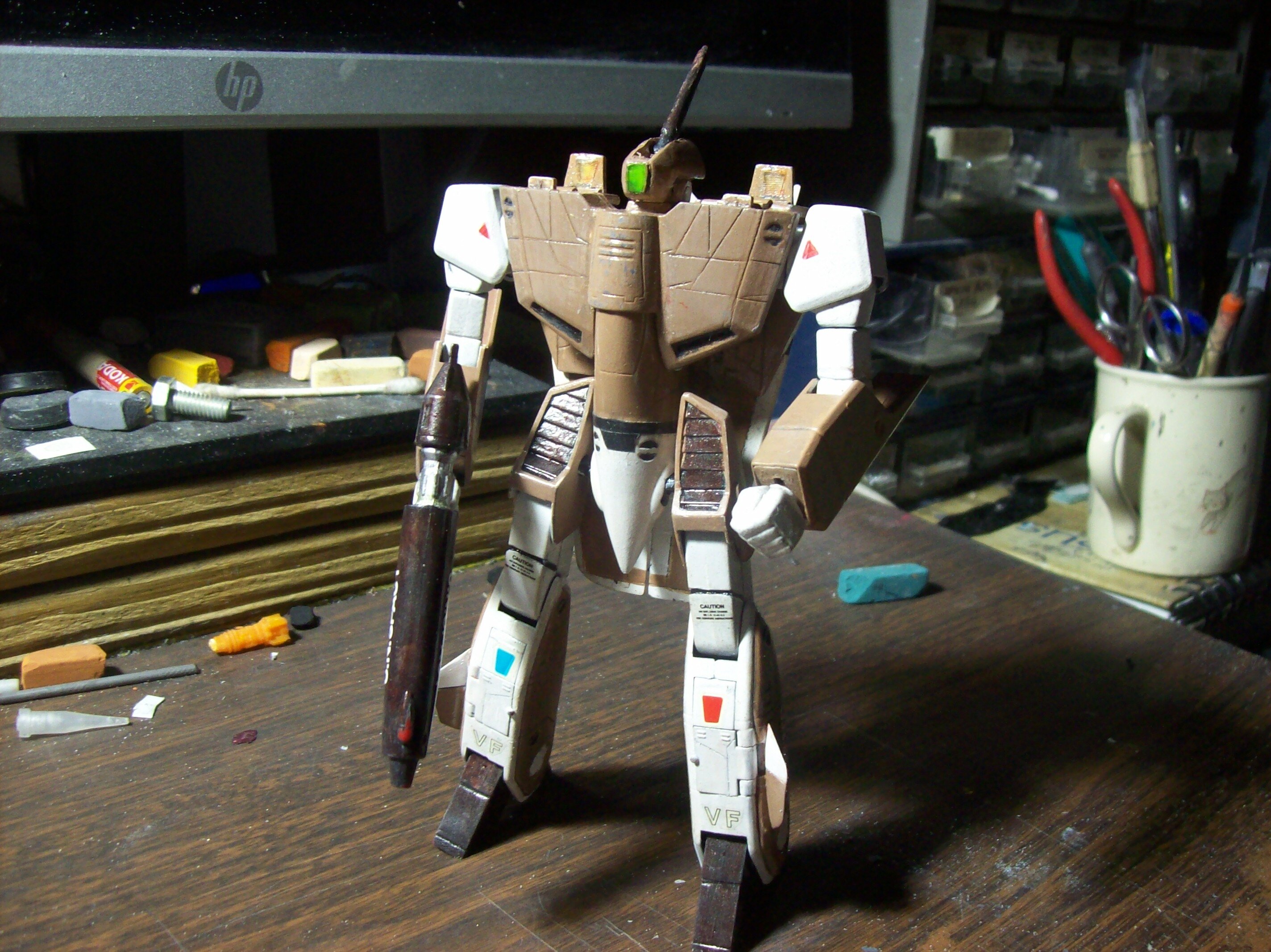

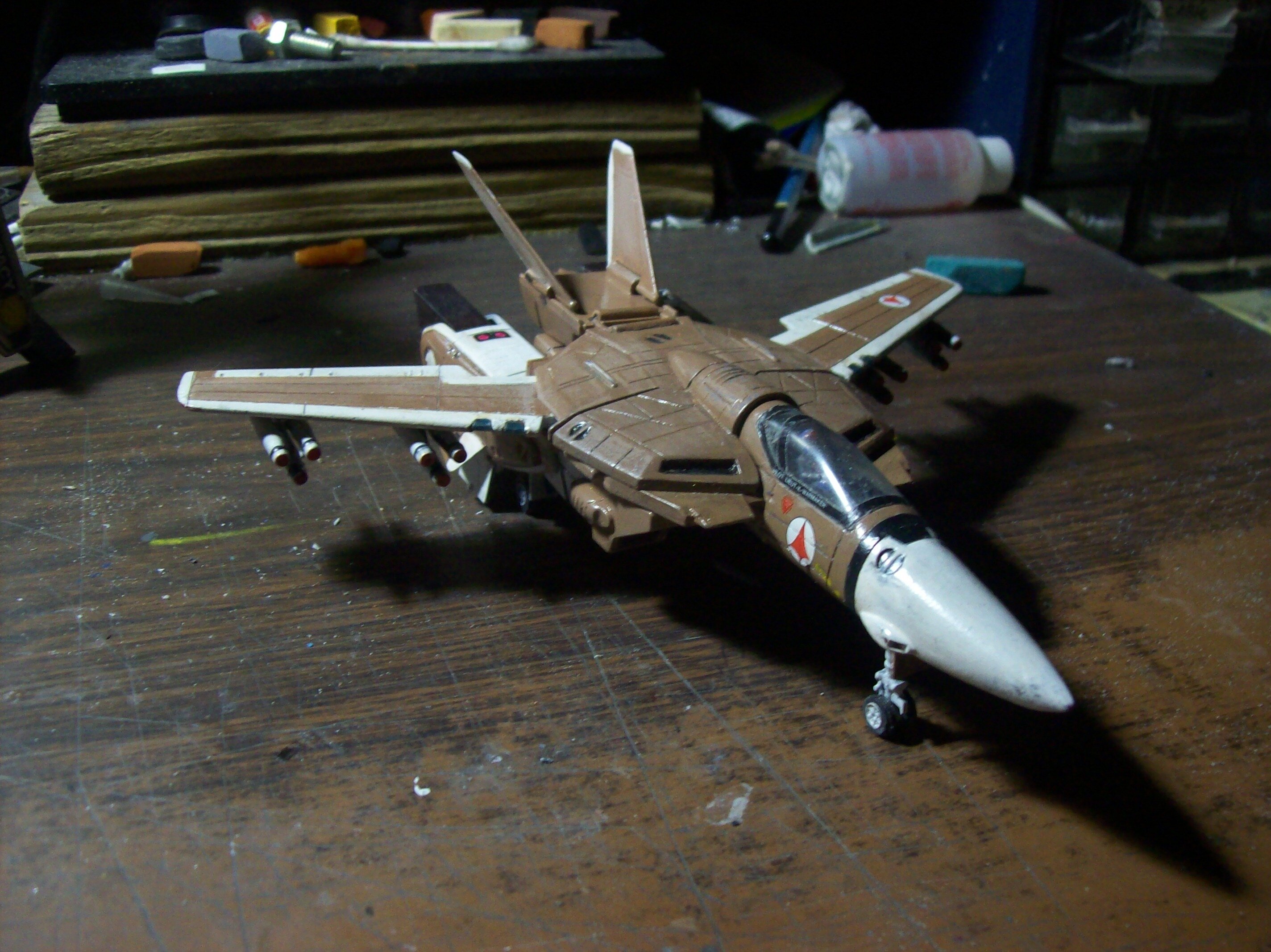

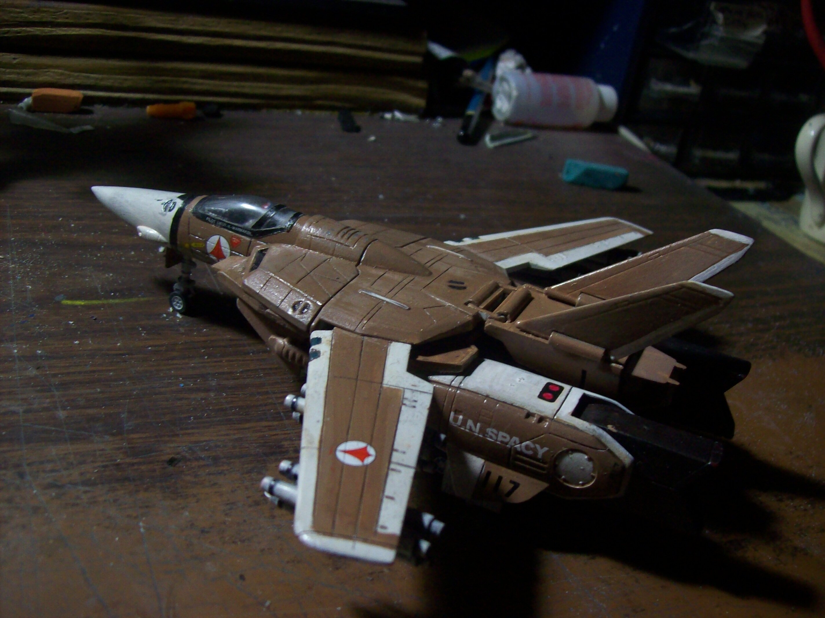

UPDATE:
Well, got 3 things going on right now, but the 1st one (VF-1J Rebuild) is on hold until I get an issue settled with one of the transform joints. Meantime, progress on the other 2 to report:

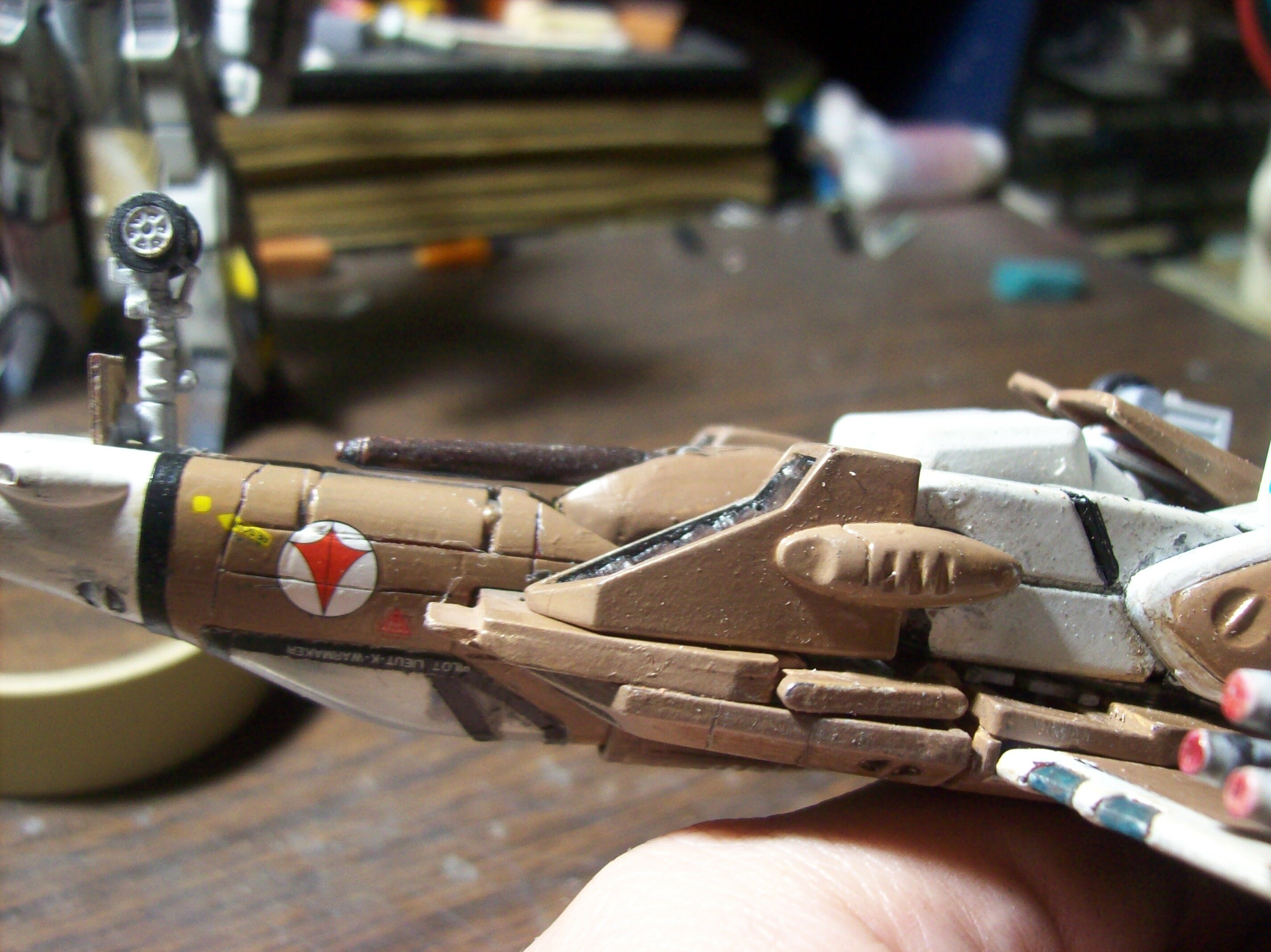

1) The VF-1A "Cannonfodder" is approaching completion:
101_1069.JPG.0687a9e59b36e370658a00383cd77ba0.JPG    101_1070.JPG.cf4e2fefda97a422f9d71e6579b01c6b.JPG
101_1071.JPG.17db0f91d24e2e1c648bc4e37f926565.JPG    101_1072.JPG.0e2e6a0ae430cafa80c37e2023349746.JPG
Yeah, I know the roundels are the wrong ones (destroid version); I don't have any spares of the red with white delta on them (need the ones I have for Hikaru's Vf-1J that I'm working on). I figure since the valk is in brown shades, maybe its' a bit more forgiveable? Anyways, pics in fighter mode:
101_1075.JPG.6458729d6752e2464dfde2a4bf4b7553.JPG    101_1076.JPG.de491ff3b93d1e6adb06401cf3c25857.JPG
101_1077.JPG.521508c42afd6f368f43a38e9243faf5.JPG    101_1078.JPG.16f84cc690d79e233cd7b304cf8cc5cf.JPG
101_1079.JPG.89bb96cec4014aa1e5346084803840b5.JPG    101_1080.JPG.b1931dd26fe17b243bf53828a3904041.JPG
It just needs a few touch-ups still, some weathering (wash/drybrushing, panel fading) and some minor details added (certain stripes, verniers painted in/ decaled). Otherwise, it's pretty well done.

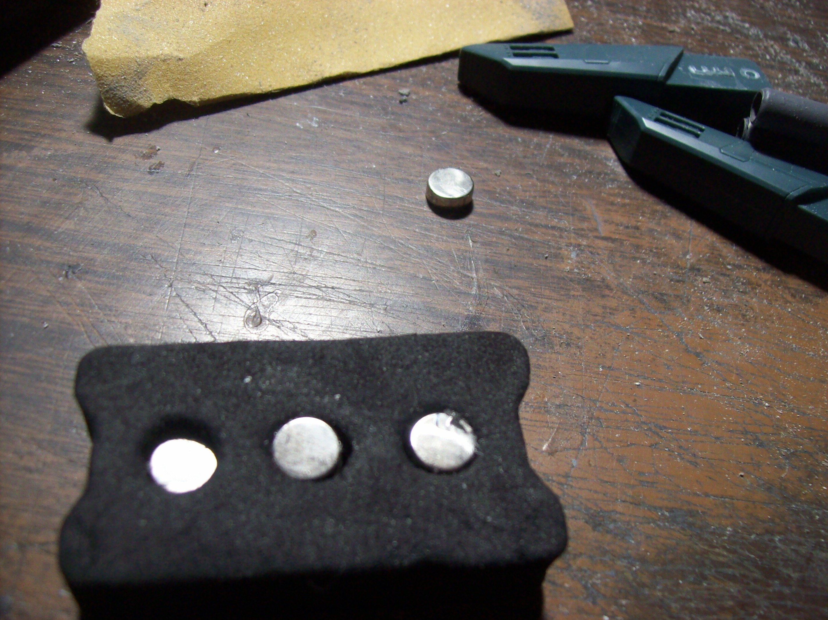

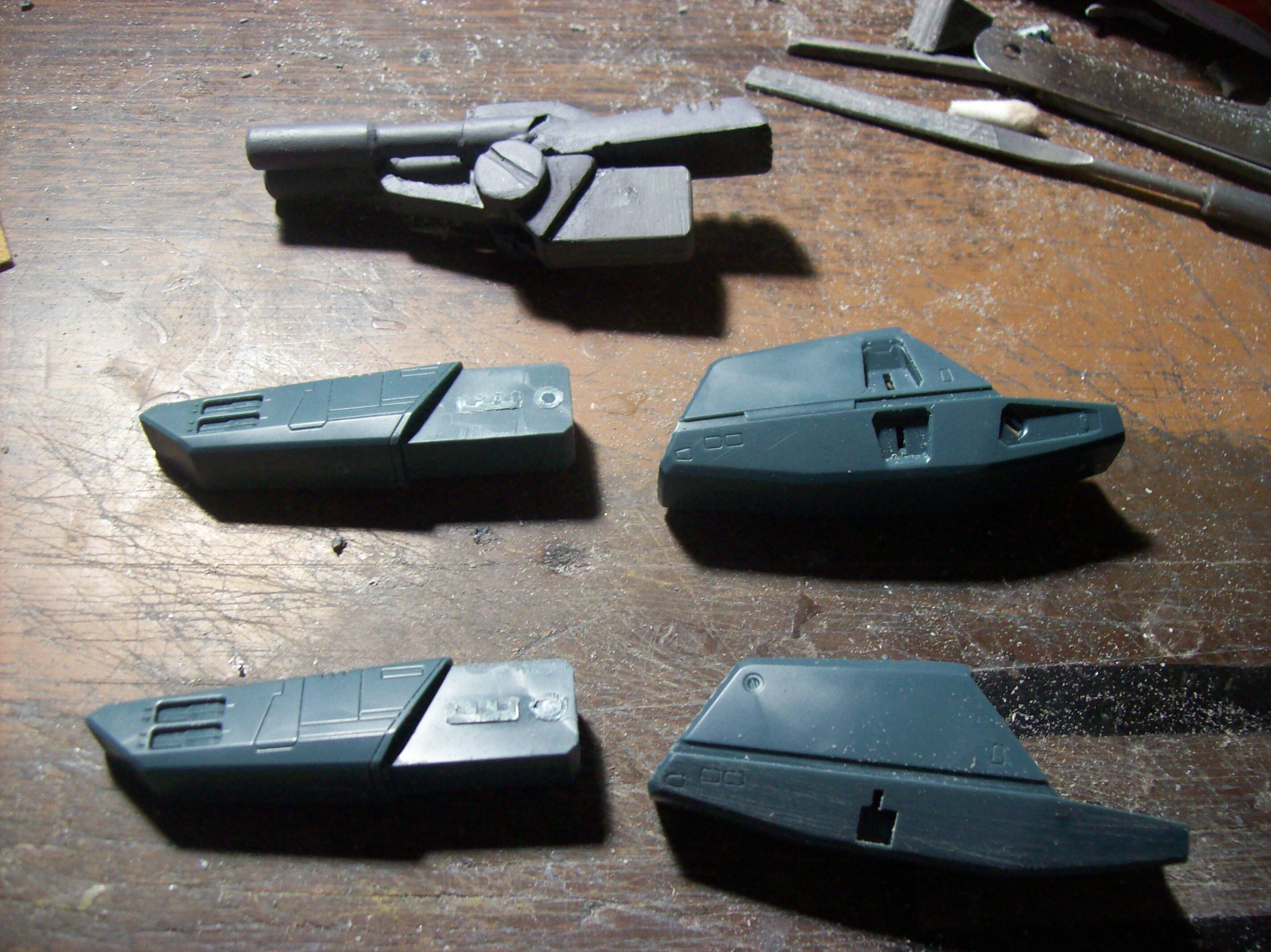

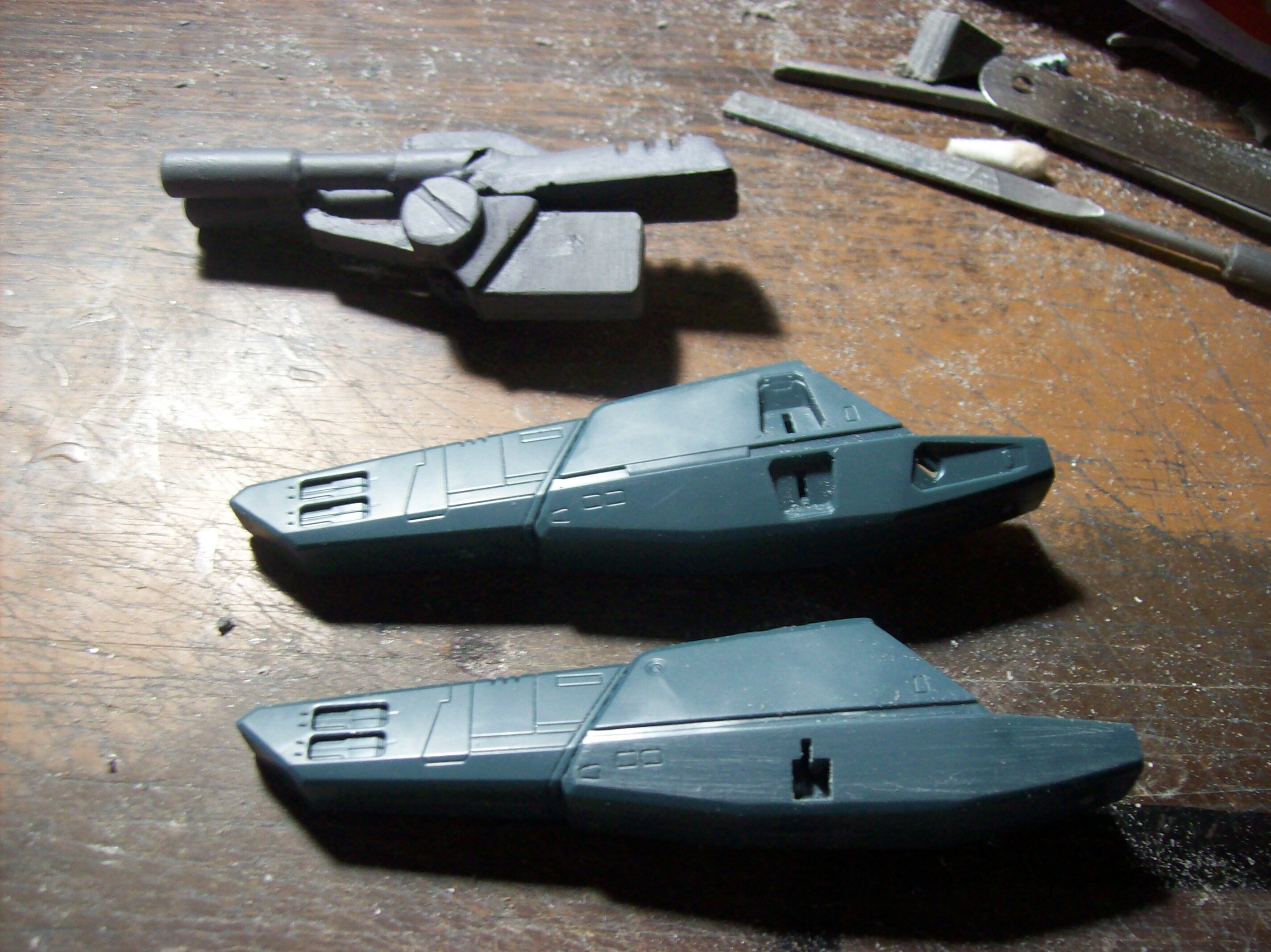

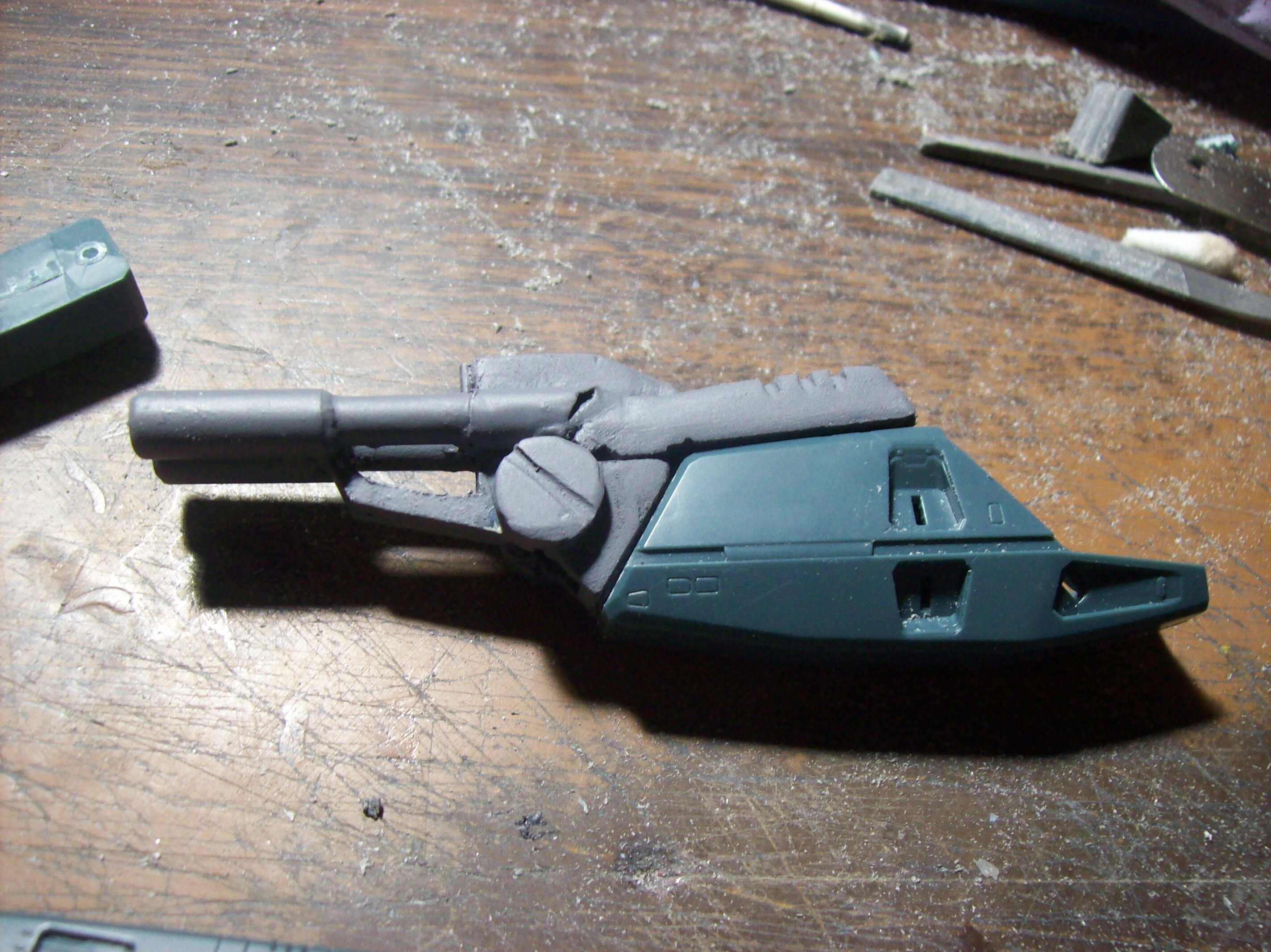

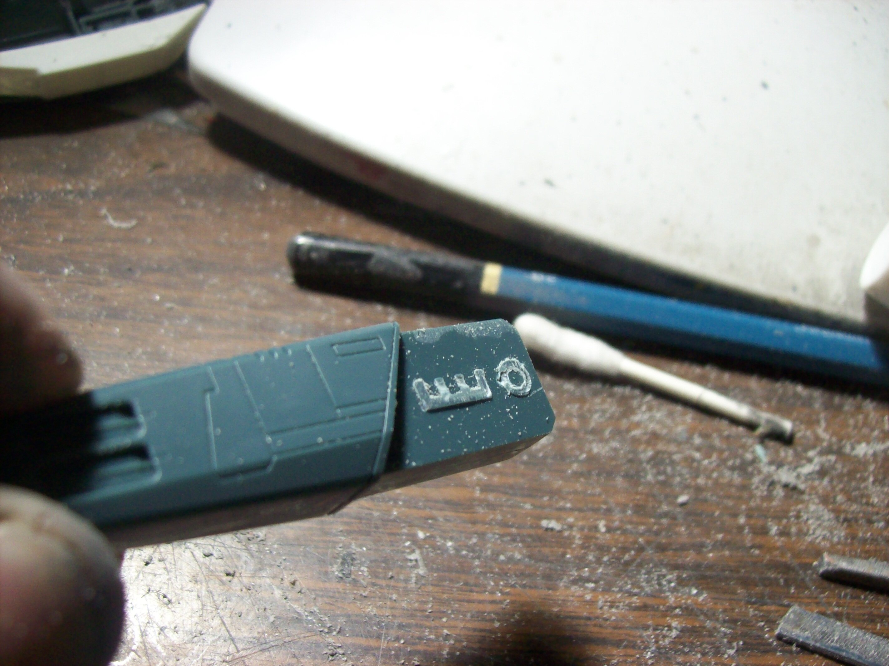

Now onto project 3: the removable armor for the VF-1's:
I managed to rescue the Mauler RO-X2A dual laser cannon from the other project (which died when our upstairs neighbor's bathroom leaked water through our ceiling!) and rework it to fit the new boosters:
101_1059.JPG.17a623683c77b75ff7c515ce5187efa8.JPG    101_1060.JPG.f719e0bc176f811eda216a3301de8f48.JPG
I found that by clipping off the attachment pegs for the fronts of the boosters and sanding them down to where they still hold friction, the fronts can be removed while assembled and replaced on either side with the Mauler cannon (which I added a square peg onto after copying it from the missile pod fronts):
101_1062.JPG.6e92db3e7d60550a1b3f47c9e38a2dab.JPG    101_1065.JPG.0bbe5f69fe25beafc14adb8cb278ab57.JPG
As for attaching the armor: I got 12 neodymium magnets (and have 2 larger ones as well); my plan is to glue thin metal plates onto all 3 valks, while attaching the boosters to one main bracket that will slot in between the "backpack" and the back, with a larger magnet in the bracket and the plate on the valk's back (said plate painted the same color as the valk's hull).  The arm and leg armor will get 2 magnets each to attach them to similar metal plates, while tabs that slot into the valk at certain points should help keep them in place:
Stay tuned folks... more to come.

What a coincidence, I have not seen that resin figure.  But what's wrong with her leg position?
My version is in a "T-Pose".  It's not a real pose. You design the figure in this pose and prepare the armature bones for the actual pose later.

Liking it, @pengbuzz. Building up your Macross squad. As for the kites, I didn't even notice the difference until it was mentioned. It looks good.
Thanks; eventually (Lord willing) I'd like to do a second VF-1A in Ben's colors, as well as Max and Miryia's valk's.

Seriously though: most major construction on the new VF-1J is nearly complete; I just have to finish the fighter cockpit and a couple of other things. Then we can get to painting soon (hopefully). They're selling our apartment building again, and I truly resent the circus of potential buyers that stream through here when that happens, with little to no regard for our life here.
Stay tuned...

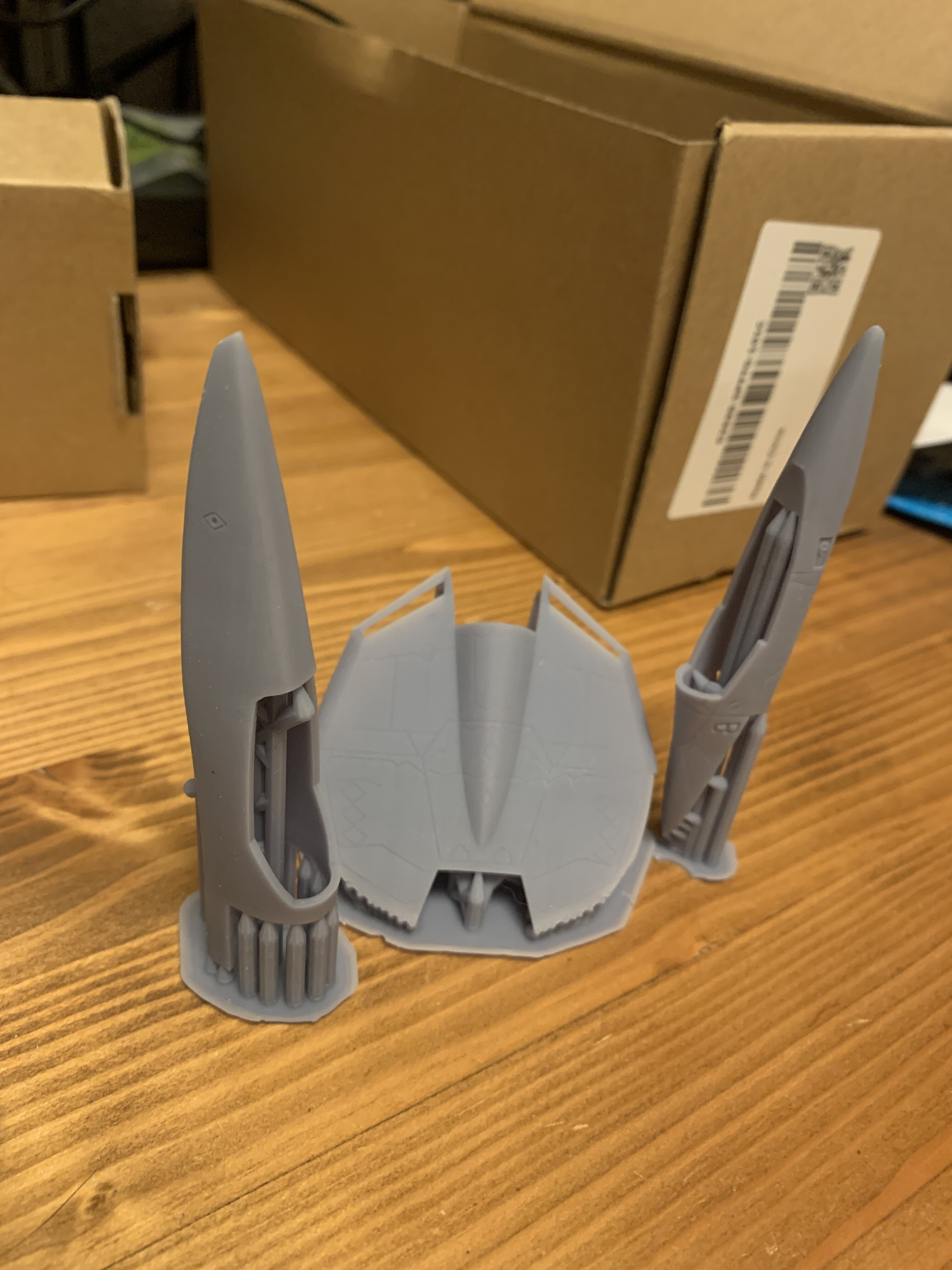

I purchased the ABS like resin from Anycubic and made some test prints today. It smells a bit more than the eco resin (which is really low odor), and leaves a weird white residue in the print bed and on the print. Using Isopropanol, I was able to remove it, but still strange.
it seems a bit more flexible, which is good. Here is a picture.
from left to right:
new VF-1P nose, work in progress
old VF-1P fuselage, needs to be reworked to be thicker.
new reworked VF-9 nose, done.

I don't think there's too much wrong with her legs. Maybe a bit bow legged. But i take it as anime style..🤷95779D89-CCD2-4105-BEE9-57FA93DEFDDF.jpeg.b324a2494c7417e2fd3a4322e282403f.jpeg

Really nice looking! So what's up with the V-1p ? I don't think I've seen that yet..
The VF-9 nose looks sweet.
