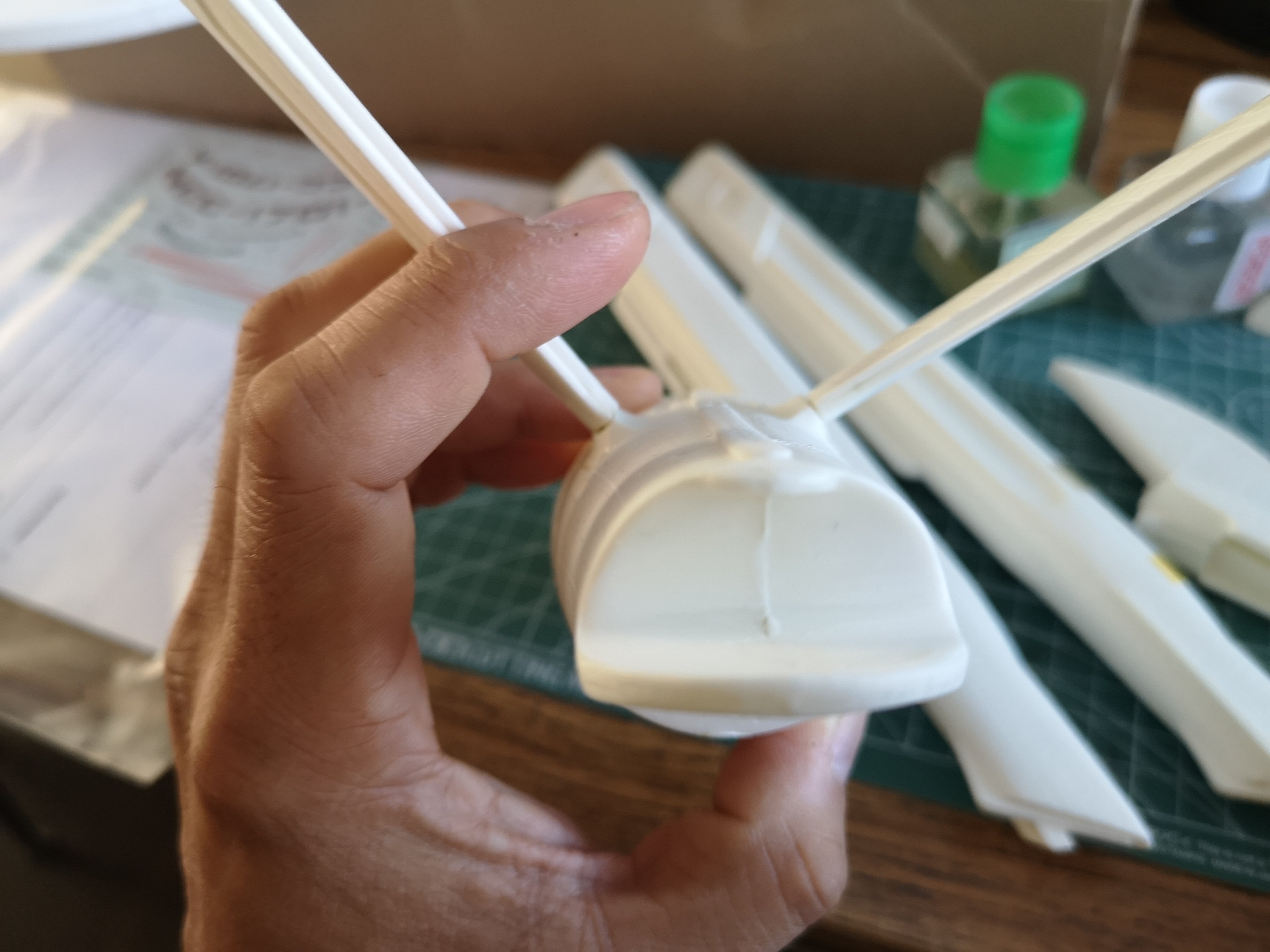

peter Posted July 21, 2020 Posted July 21, 2020 One pylon fits ok, it's stiff and almost a bit too tight. The other one looks like it was meant to be posable. It flops up and down and even rotates. If I didn't buy those fancy Aztec decals, I'd probably throw this kit in the garbage, lol!

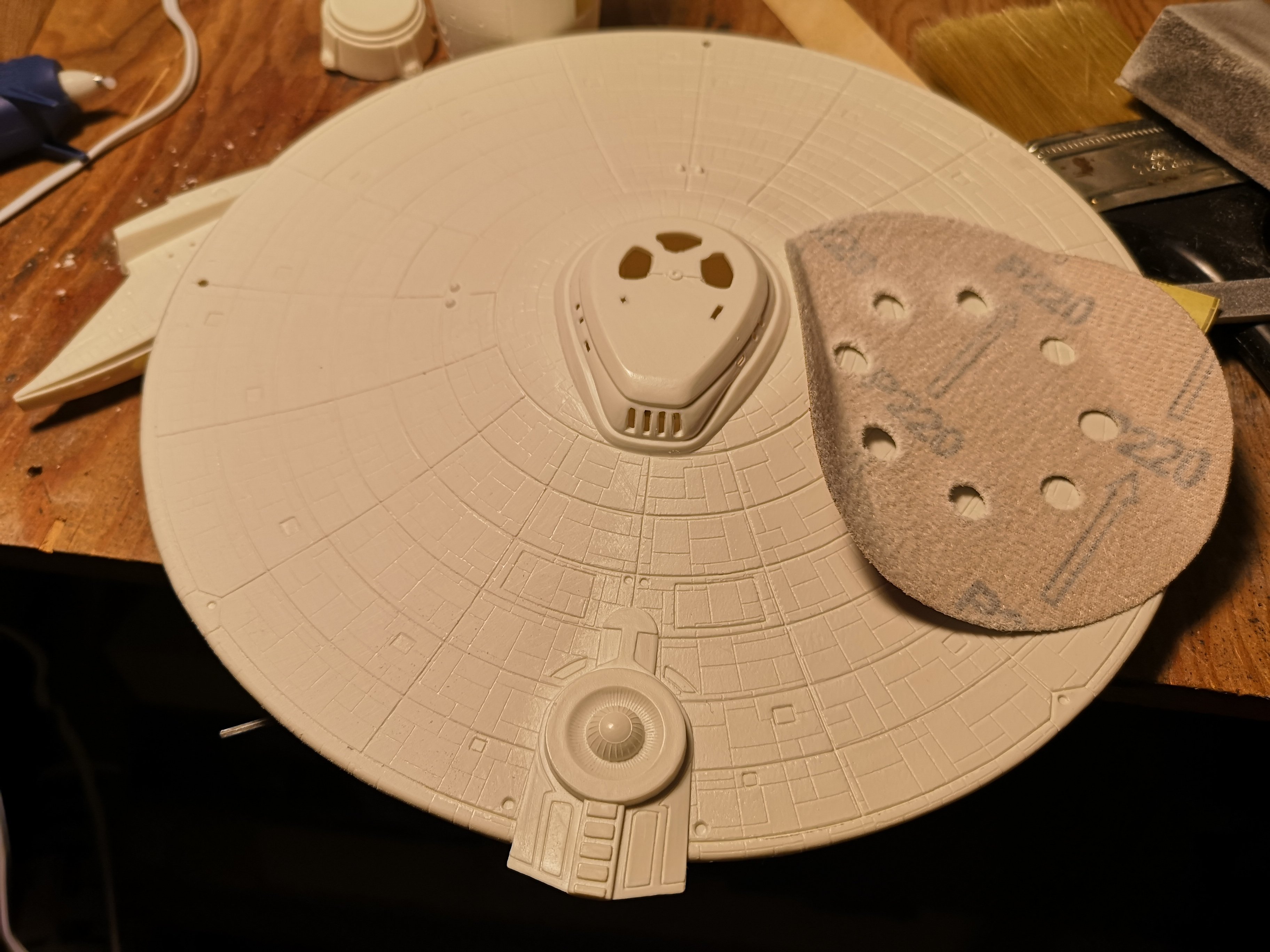

peter Posted July 21, 2020 Posted July 21, 2020 I've been sanding with 320 and taking my time, but some of these panel lines are pretty stubborn. One on the right is untouched. But I got a little impatient and decided to try 220 on the saucer.....and it barely scratched the surface. Almost threw the sanding pad onto my orbital sander, lol!
pengbuzz Posted July 21, 2020 Posted July 21, 2020 5 minutes ago, peter said: I've been sanding with 320 and taking my time, but some of these panel lines are pretty stubborn. One on the right is untouched. But I got a little impatient and decided to try 220 on the saucer.....and it barely scratched the surface. Almost threw the sanding pad onto my orbital sander, lol! Do yourself a HUGE favor: get a polyester-based filler and fill the panel lines that you don't want. If you try sanding all that off, you're going to be there forever, not to mention you'll run the risk of sanding off detail and drastically changing the shape of the hull. Ask the gang here for a good suggestion on filler putty.
peter Posted July 21, 2020 Posted July 21, 2020 27 minutes ago, pengbuzz said: Do yourself a HUGE favor: get a polyester-based filler and fill the panel lines that you don't want. If you try sanding all that off, you're going to be there forever, not to mention you'll run the risk of sanding off detail and drastically changing the shape of the hull. Ask the gang here for a good suggestion on filler putty. Lol, thankfully I read your post. That definitely will be easier than sanding the hell out of it. Honestly, with the kids at home running amok, working from home because of Covid 19, I'm surviving on average 4 hrs of sleep with model building thrown in. Leads to bad decisions, lol! Going to fill the unwanted lines before going at it with any sanding, lol! Time for more coffee and maybe a nap.

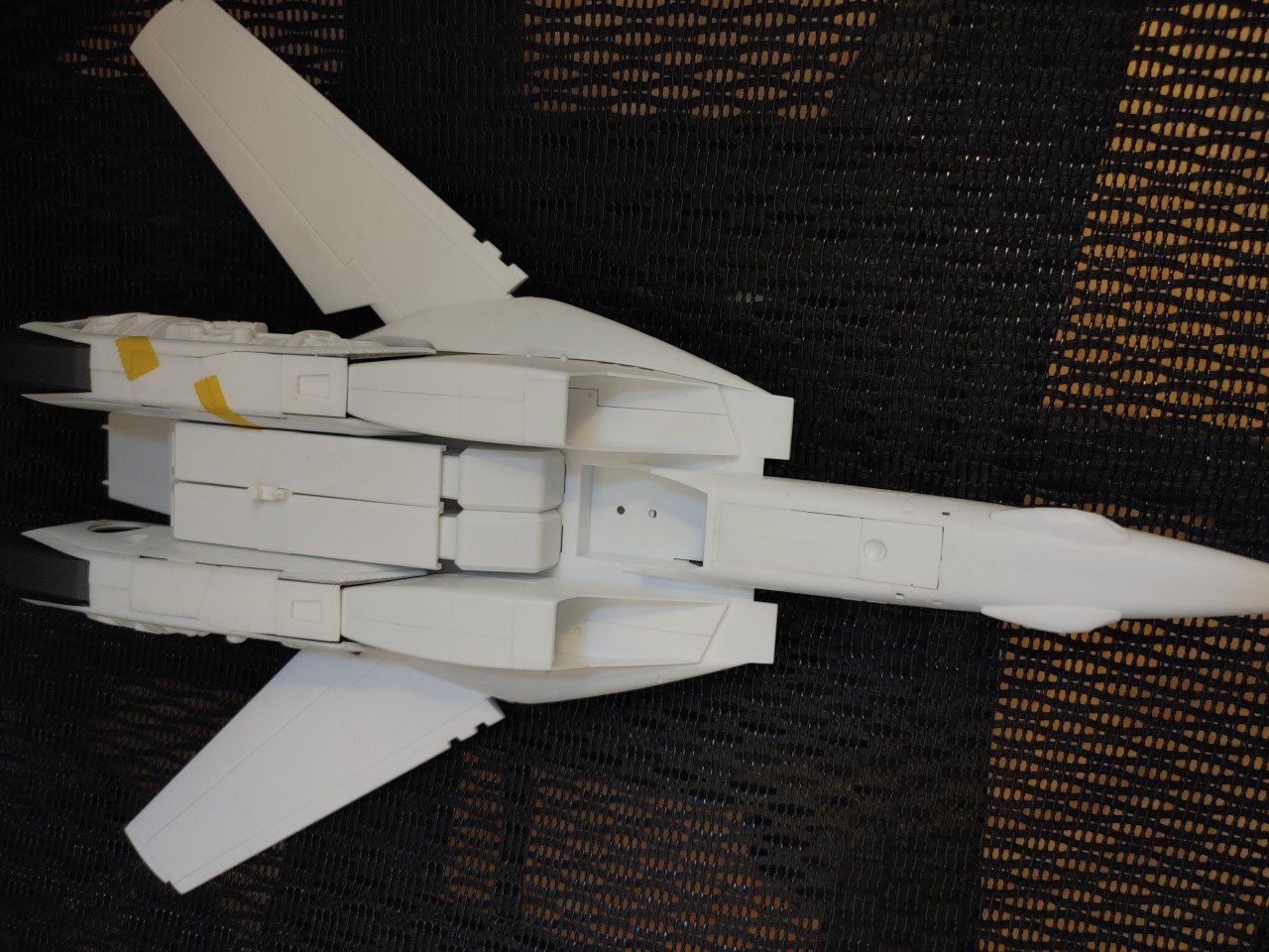

joscasle Posted July 21, 2020 Posted July 21, 2020 On 7/19/2020 at 5:35 PM, Duymon said: been working little by little on the 1/48 VF-1. l love how the kit is mostly snap-fit-ish allowing for a lot of dry-fits. Just wish Hasegawa made closed landing gear doors for their fighter models Instead of building some complex plasticard structure underneath to support the doors I got lazy and just kneaded up a bunch of milliput and then gently pressed the trimmed doors into the milliput until they were aligned as best as they could be. after it cures I can do a little more filling / sanding to make it all flush. Hasegawa 1/48 kits are great Valkyries!!

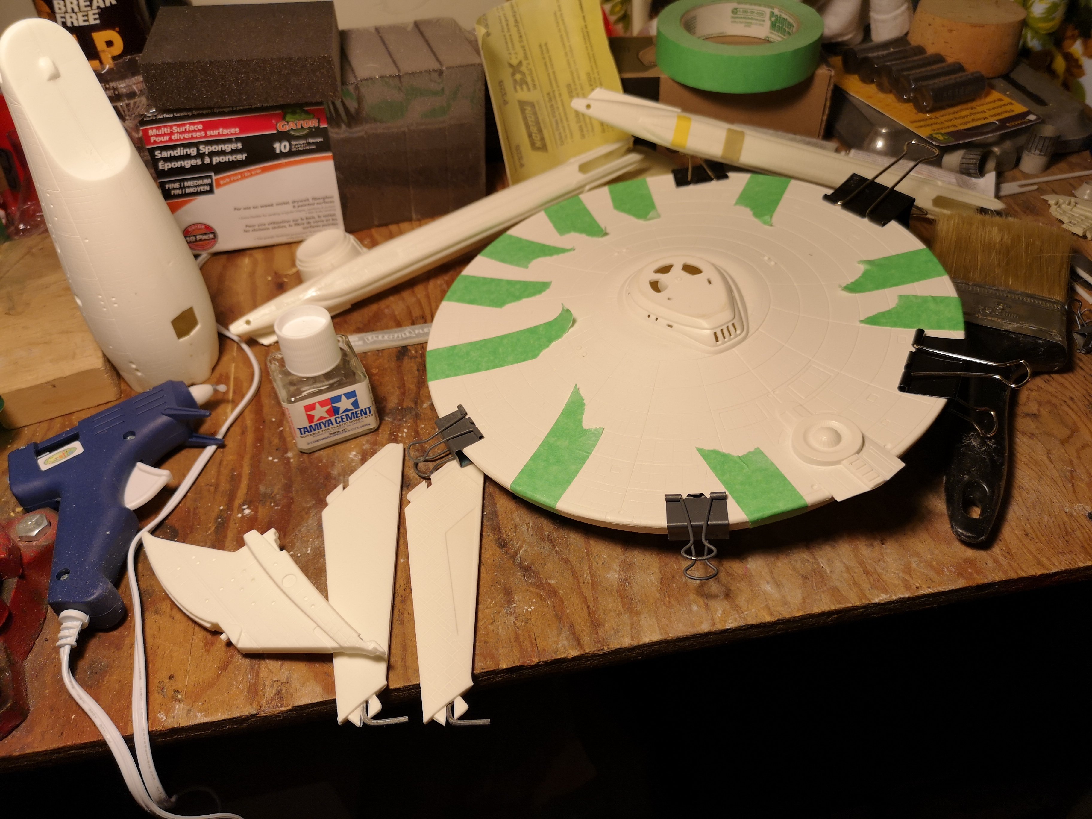

peter Posted July 22, 2020 Posted July 22, 2020 The current $hit-show I'm in now: The saucer did indeed require that much tape and clamps to lock it all down when gluing it. What a clusterfuk. I hate this thing, lol! So, I was going to listen to you guys and dig out my Mr. Surfacer, but that may have dried out 10 years ago and I may have thrown it out. So I was about to visit the local hobby shop and find some filler, but there was ice cold beer in the fridge. I stayed for one beer and one beer became two. Out came the orbital sander and I went to town on the saucer. When the dust cleared, all of the panel lines were still visible but definitely knocked down a bit. I promise no beer tomorrow and I'll go find some Mr. Surfacer tomorrow. That saucer is ridiculous.

Thom Posted July 22, 2020 Posted July 22, 2020 8 hours ago, peter said: The current $hit-show I'm in now: The saucer did indeed require that much tape and clamps to lock it all down when gluing it. What a clusterfuk. I hate this thing, lol! So, I was going to listen to you guys and dig out my Mr. Surfacer, but that may have dried out 10 years ago and I may have thrown it out. So I was about to visit the local hobby shop and find some filler, but there was ice cold beer in the fridge. I stayed for one beer and one beer became two. Out came the orbital sander and I went to town on the saucer. When the dust cleared, all of the panel lines were still visible but definitely knocked down a bit. I promise no beer tomorrow and I'll go find some Mr. Surfacer tomorrow. That saucer is ridiculous. Sometimes you have to surrender before the battle can be won. Here's to hoping you start liking it soon.
pengbuzz Posted July 22, 2020 Posted July 22, 2020 10 hours ago, peter said: The current $hit-show I'm in now: The saucer did indeed require that much tape and clamps to lock it all down when gluing it. What a clusterfuk. I hate this thing, lol! So, I was going to listen to you guys and dig out my Mr. Surfacer, but that may have dried out 10 years ago and I may have thrown it out. So I was about to visit the local hobby shop and find some filler, but there was ice cold beer in the fridge. I stayed for one beer and one beer became two. Out came the orbital sander and I went to town on the saucer. When the dust cleared, all of the panel lines were still visible but definitely knocked down a bit. I promise no beer tomorrow and I'll go find some Mr. Surfacer tomorrow. That saucer is ridiculous. On those pylons, you're going to want at least an epoxy to glue them into place (trust me on this). And when you do, you may want to set this so that after gluing the pylons (but before they cure) you can align the warp engines so they don't go in weird directions and adjust the pylons as they cure. Those tabs and the plastic they slide into are not very strong, so REINFORCE THE HELL out of them before you commit. You'll be doing yourself and the model a huge favor.
joscasle Posted July 22, 2020 Posted July 22, 2020 11 hours ago, peter said: The current $hit-show I'm in now: The saucer did indeed require that much tape and clamps to lock it all down when gluing it. What a clusterfuk. I hate this thing, lol! So, I was going to listen to you guys and dig out my Mr. Surfacer, but that may have dried out 10 years ago and I may have thrown it out. So I was about to visit the local hobby shop and find some filler, but there was ice cold beer in the fridge. I stayed for one beer and one beer became two. Out came the orbital sander and I went to town on the saucer. When the dust cleared, all of the panel lines were still visible but definitely knocked down a bit. I promise no beer tomorrow and I'll go find some Mr. Surfacer tomorrow. That saucer is ridiculous. Stay at home !!! There are many web stores where you can buy Mr. Surfacer. By the way, just put a little Mr. Thinner in that old Mr.Surfacer, it will come alive again!

peter Posted July 22, 2020 Posted July 22, 2020 3 hours ago, pengbuzz said: On those pylons, you're going to want at least an epoxy to glue them into place (trust me on this). And when you do, you may want to set this so that after gluing the pylons (but before they cure) you can align the warp engines so they don't go in weird directions and adjust the pylons as they cure. Those tabs and the plastic they slide into are not very strong, so REINFORCE THE HELL out of them before you commit. You'll be doing yourself and the model a huge favor. Yeah, lol, I will definitely reinforce the pylons. Filed a channel and glued a hex key into each pylon, definitely stronger than those flimsy tabs, but yeah, will have to goop on epoxy and let it set properly. Lol, back when I was a kid, I probably bashed out this kit in less than two days.

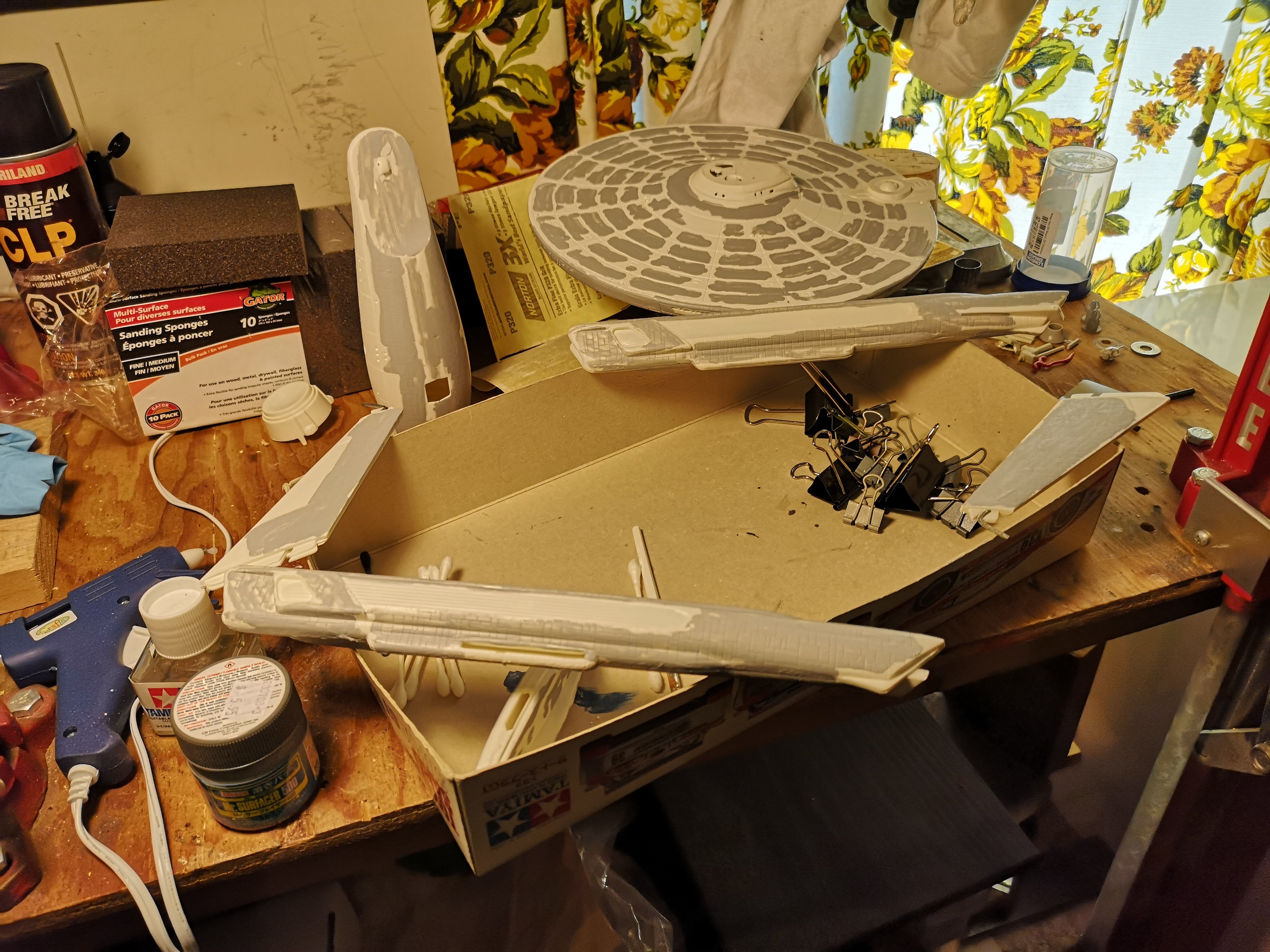

peter Posted July 23, 2020 Posted July 23, 2020 (edited) Mr. Surfacer is flammable right? Might be handy in case I feel the need to have this thing re-enter the atmosphere. Excuse the mess, the last few models I've built (Hasegawa) were relatively clean build, clean enough to build on the dining table, but this one....wow, I've never been covered in so much dust every time I touch the thing. I honestly don't recall prepping the surface this much on any kit I've built. Go easy guys, I honestly have no idea what I'm doing. I think the saucer was a real guinea pig because it probably has three or four different methods of trying to get rid of the panel lines, lol! I think I hand sanded 1/4, puttied another 1/4, then took the orbital to the whole thing and now I'm using 500 surfacer. It's going to look craptacular, lol! I'm watching Polar Lights 1/350 builds on YouTube and I'm just amazed at the detail and accuracy. Edited July 23, 2020 by peter

pengbuzz Posted July 23, 2020 Posted July 23, 2020 10 hours ago, peter said: Mr. Surfacer is flammable right? Might be handy in case I feel the need to have this thing re-enter the atmosphere. Excuse the mess, the last few models I've built (Hasegawa) were relatively clean build, clean enough to build on the dining table, but this one....wow, I've never been covered in so much dust every time I touch the thing. I honestly don't recall prepping the surface this much on any kit I've built. Go easy guys, I honestly have no idea what I'm doing. I think the saucer was a real guinea pig because it probably has three or four different methods of trying to get rid of the panel lines, lol! I think I hand sanded 1/4, puttied another 1/4, then took the orbital to the whole thing and now I'm using 500 surfacer. It's going to look craptacular, lol! I'm watching Polar Lights 1/350 builds on YouTube and I'm just amazed at the detail and accuracy. You're doing fine so far; it's going to need a lot of surface prep to remove those engraved panels, so just let the process "be the process" and work to get it finished. Take it slow and don't rush to complete any sections. if you need to, take some time off for a little bit and switch to another project. Mine is still in primer and re-re-reworking!

Thom Posted July 23, 2020 Posted July 23, 2020 11 hours ago, peter said: Mr. Surfacer is flammable right? Might be handy in case I feel the need to have this thing re-enter the atmosphere. Excuse the mess, the last few models I've built (Hasegawa) were relatively clean build, clean enough to build on the dining table, but this one....wow, I've never been covered in so much dust every time I touch the thing. I honestly don't recall prepping the surface this much on any kit I've built. Go easy guys, I honestly have no idea what I'm doing. I think the saucer was a real guinea pig because it probably has three or four different methods of trying to get rid of the panel lines, lol! I think I hand sanded 1/4, puttied another 1/4, then took the orbital to the whole thing and now I'm using 500 surfacer. It's going to look craptacular, lol! I'm watching Polar Lights 1/350 builds on YouTube and I'm just amazed at the detail and accuracy. Don't let the current look of it get to you. It is 'In Process' which is a normal part of any build. Some are cleaner - and some are messy as fuk! No matter how it looks now, remember the Mythbusters shining turds. 12 hours ago, Gabe Q said: @peterWow! Remind me to never attempt to build a Star Trek kit! I admire your perseverance! @Thom, @MechTech, and @joscasle thanks for the kind words! Here's a little more progress.! Fantastic coloring on those parts!
