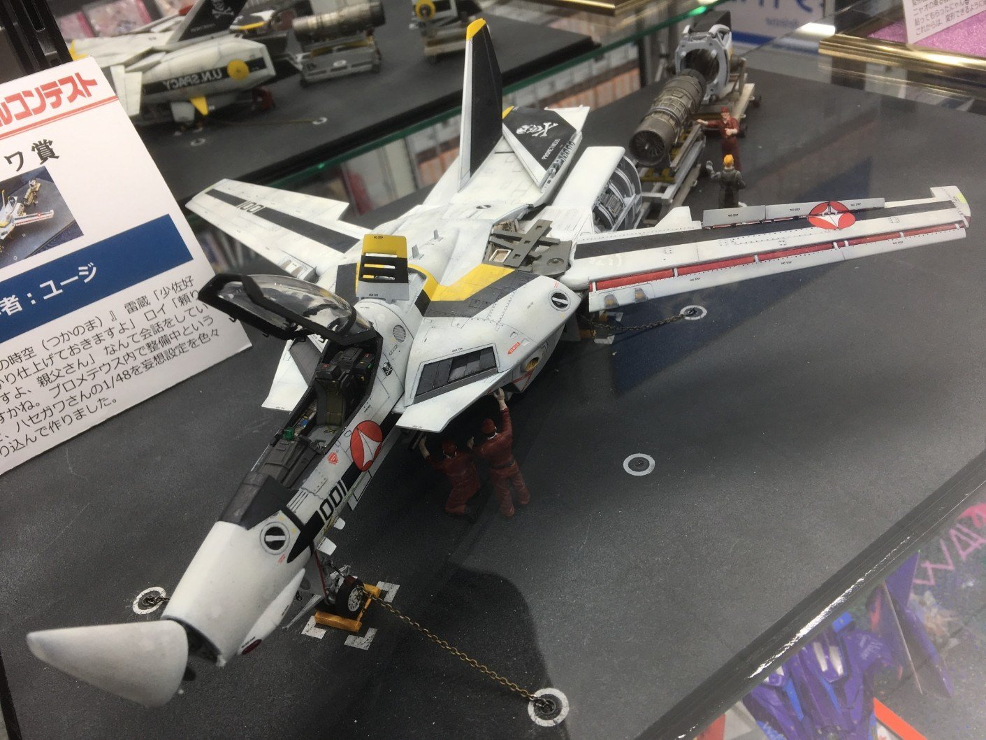

arbit Posted May 26, 2020 Posted May 26, 2020 (edited) 15 minutes ago, David Hingtgen said: I think maybe you're confusing the flaps, with "other bits that can move". It might help to circle exactly what you mean? The only time the flaps would be down when climbing, would be immediately after takeoff, while still slow but accelerating. In a fighter jet, this would only last a few secs. (and they'd only be down a little) Here's a good example, not mine. There are all kinds of flaps there in repair positions: Leading edge (down), outboard flaps (up), inboard flaps (up), and ailerons (down). So if I wanted to have a wheels up configuration at any point in flight, with as many of those displayed open accurately, what could I do? I;m ignoring other real-world flaps that are not in this model. Edited May 26, 2020 by arbit
NZEOD Posted May 26, 2020 Posted May 26, 2020 (edited) Those are split flaps. I'm going to assume from the rear you'd see them split in two with red painted between and the other half down. They are using them as speed brakes/dive brakes. I'd have to check the master file on if this was ever the intent. Cool diorama too but... not enough tiedowns on that plane. Should be two to 4 more on the nose gear or main gear. Only bugs me because I'm doing a similar diorama with a vf4 Edited May 26, 2020 by NZEOD

joscasle Posted May 26, 2020 Posted May 26, 2020 6 hours ago, arbit said: Here's a good example, not mine. There are all kinds of flaps there in repair positions: Leading edge (down), outboard flaps (up), inboard flaps (up), and ailerons (down). So if I wanted to have a wheels up configuration at any point in flight, with as many of those displayed open accurately, what could I do? I;m ignoring other real-world flaps that are not in this model. LOVE that build!!! looks like 1/48

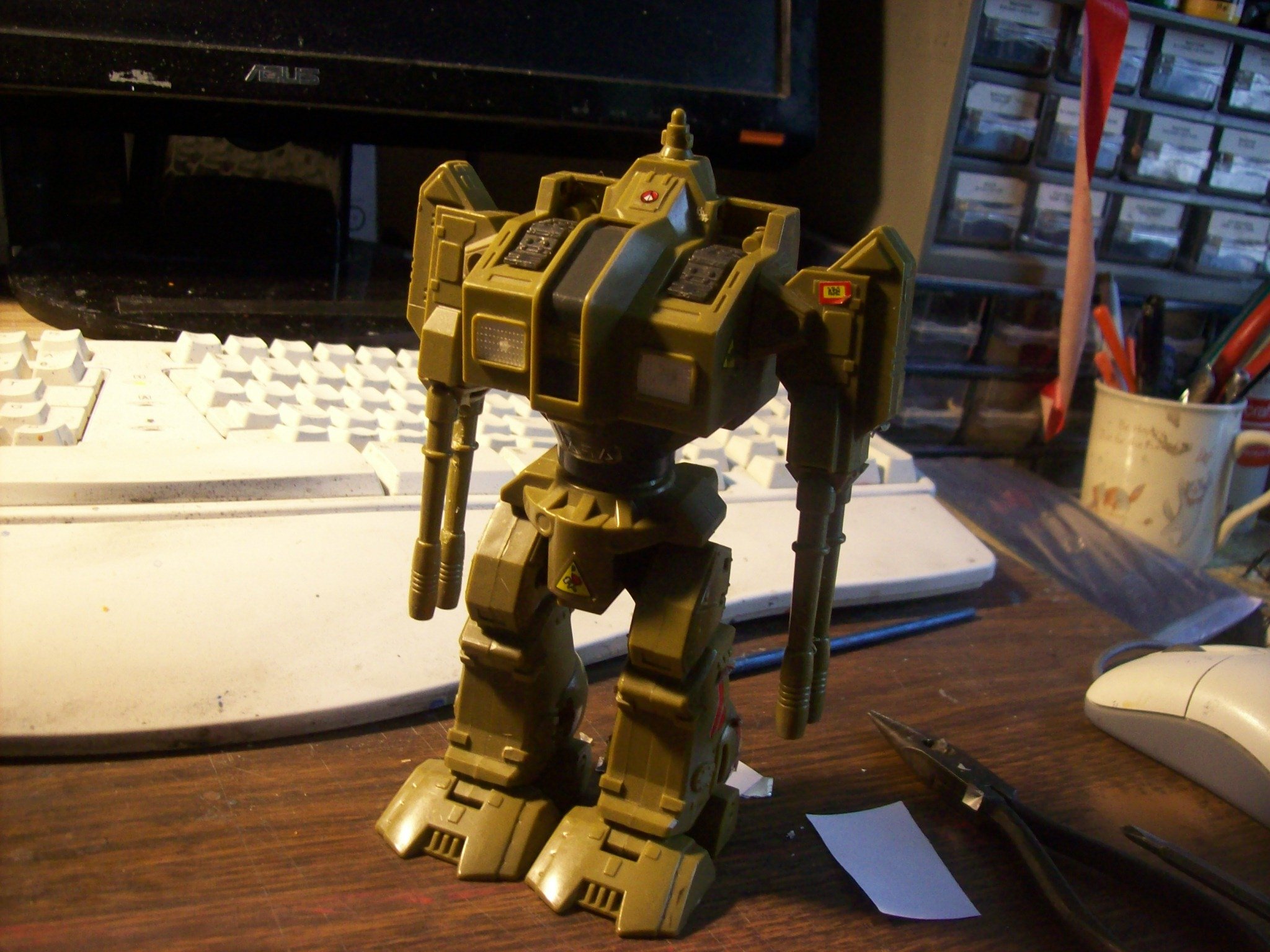

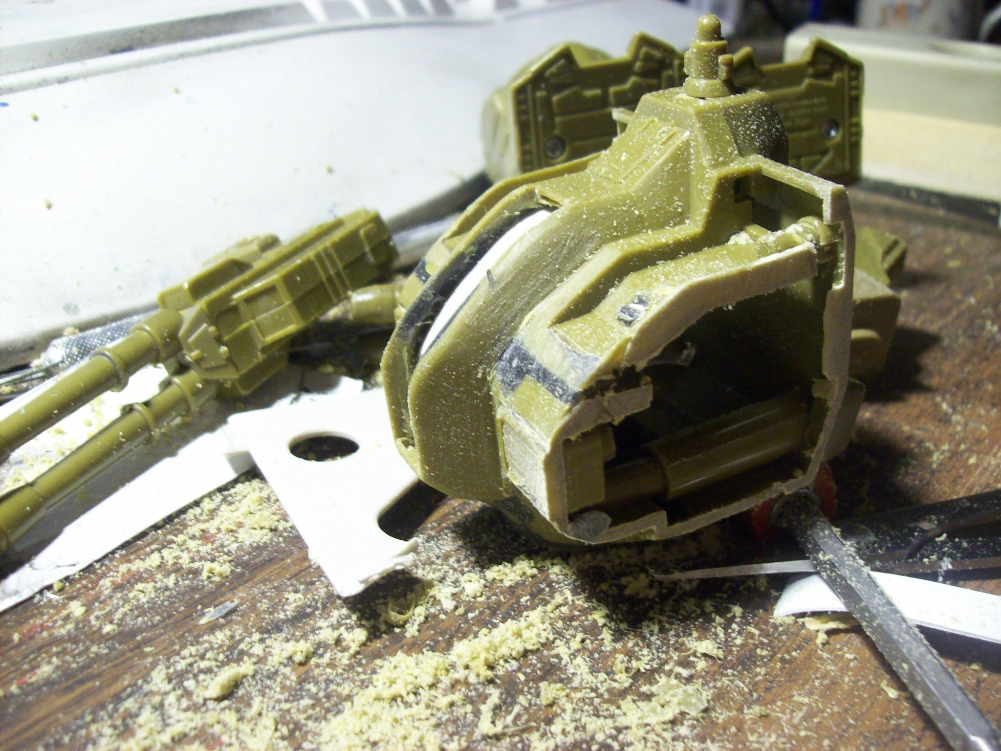

pengbuzz Posted May 27, 2020 Posted May 27, 2020 UPDATE: Some work on the Defender 1/72 (Matchbox/Playmates)... What I started with: Where I am now: Stay tuned...
David Hingtgen Posted May 27, 2020 Posted May 27, 2020 Those aren't "split flaps", split flaps are something totally different. (and similar to zap flaps). The VF-1 has no ailerons, same as the F-14. The VF-1 wing and F-14 wing are quite similar, though the VF-1 actually has more complex flaps, flat-out airliner-esque. Leading edge has SLATS, no flaps there. Moves downward only, and must extend laterally to move down. (F-16's and F-18's have flaps there, can move down AND up and pivot to do so, no lateral extension) Trailing edge has slotted fowler flaps, rare for a fighter jet but usually seen on airliners. Much like the slats, downward-only, also has lateral movement, but an even more complex and effective system than the slats. Inboards are doubled-slotted, outboards are single-slotted. (F-14's are single-slotted all the way across) Immediately ahead of the flaps, are the spoilers. I don't think I've seen anything canonically showing them, but it's very logical to have them, based on the F-14 and the details we can see. Effectively upwards-only on most planes, but on the F-14 they can depress downwards by a few degrees when the flaps are out to close up the gap/reprofile the upper surface. When they're all up (both wings) they're basically speed brakes. When they're up on only one wing, they're for roll control, replacing the ailerons.
nightmareB4macross Posted May 27, 2020 Posted May 27, 2020 8 hours ago, pengbuzz said: UPDATE: Some work on the Defender 1/72 (Matchbox/Playmates)... What I started with: Where I am now: Stay tuned... The changes made to the chest are done really well. Are you using putty to reshape the chest area?
pengbuzz Posted May 27, 2020 Posted May 27, 2020 (edited) 11 hours ago, nightmareB4macross said: The changes made to the chest are done really well. Are you using putty to reshape the chest area? Thanks! and no; I am simply sanding them down and filling whatever voids that are left with plastic welder (epoxy). There's a lot of plastic there, which allows for most of what I need to do. Aside from the boxiness and being slightly out of scale, it's not too bad (although I did have to cut the sides off and remove about 1/8" of material): when I first got this a few days ago, it didn't even have the radar blade at top; that I scratched up from a couple of planks of thick styrene and simply glued to the post (after consulting the design drawings at Macross Mecha Manual: pic courtesy of Macross Mecha Manual. (http://www.macross2.net/m3/sdfmacross/destroid-defender/destroid-defender-schematics.gif) Here's wherre the project is as of today; The light makes it look a bit more yellow than it actually is; it's kind of an olive drab instead of the khaki the painting instructions I found for the old 1/72 scale model suggested. But I guess they come in all sorts of colors from what I've seen. i just need to build the sensor eye and the ammo boxes for the shoulders now and I should be good to go. Edited May 27, 2020 by pengbuzz

MechTech Posted May 28, 2020 Posted May 28, 2020 Pengbuzz - That Defender is looking great! It must be "fun" working in ABS. I think I have that same toy holed away somewhere in my stash. - MT
pengbuzz Posted May 28, 2020 Posted May 28, 2020 2 hours ago, MechTech said: Pengbuzz - That Defender is looking great! It must be "fun" working in ABS. I think I have that same toy holed away somewhere in my stash. - MT Yeah, it's "fun" all right; considering I'm using nothing more than an xacto knife and a sanding block with 80 grit in it to work this, it keeps "the joys of Carpal Tunnel Syndrome" firmly in mind. But that said: at least the plastic is holding up well to the mods!
MechTech Posted May 28, 2020 Posted May 28, 2020 That's cool. I hear you about carpal tunnel. Right hand is healed, may need to go in for work on the other. ABS doesn't like to sand smooth like styrene. It gets "hairy." Sometimes acetone can give it a nice surface afterwards like 3D printers use to clean up bias marks on their prints. I started building a model in ABS and that was the only model I ever sold "halfway" done. The cements for it are toxic and then there's the whole sanding thing... - MT

David Hingtgen Posted May 29, 2020 Posted May 29, 2020 4 hours ago, MechTech said: That's cool. I hear you about carpal tunnel. Right hand is healed, may need to go in for work on the other. ABS doesn't like to sand smooth like styrene. It gets "hairy." Sometimes acetone can give it a nice surface afterwards like 3D printers use to clean up bias marks on their prints. I started building a model in ABS and that was the only model I ever sold "halfway" done. The cements for it are toxic and then there's the whole sanding thing... - MT I'd say "fuzzy", but yeah---working with ABS sucks. Doesn't sand nicely, doesn't glue nicely. It'll paint nicely, but really likes its "shape/structure" left alone.
pengbuzz Posted May 29, 2020 Posted May 29, 2020 4 hours ago, MechTech said: That's cool. I hear you about carpal tunnel. Right hand is healed, may need to go in for work on the other. ABS doesn't like to sand smooth like styrene. It gets "hairy." Sometimes acetone can give it a nice surface afterwards like 3D printers use to clean up bias marks on their prints. I started building a model in ABS and that was the only model I ever sold "halfway" done. The cements for it are toxic and then there's the whole sanding thing... - MT Yeah; they offered me surgery, but after hearing about the "bowstringing" effect it can have, I declined. 42 minutes ago, David Hingtgen said: I'd say "fuzzy", but yeah---working with ABS sucks. Doesn't sand nicely, doesn't glue nicely. It'll paint nicely, but really likes its "shape/structure" left alone. As far as sanding goes, I found hitting it with 0000 steel wool works. As for gluing, I use Devcon Plastic Welder, which sticks pretty well. Shaping it: I wait until i'm in a really rotten mood, then sand the living daylights out of it, white threatening it: "Listen, you heaven-forsaken piece of crap: you give me ANY trouble and so help me I have a microwave with YOUR NAME all over it!!!" (Usually works :D )
electric indigo Posted May 29, 2020 Posted May 29, 2020 Sanding some epoxy resin garage kits really makes you appreciate sanding ABS.

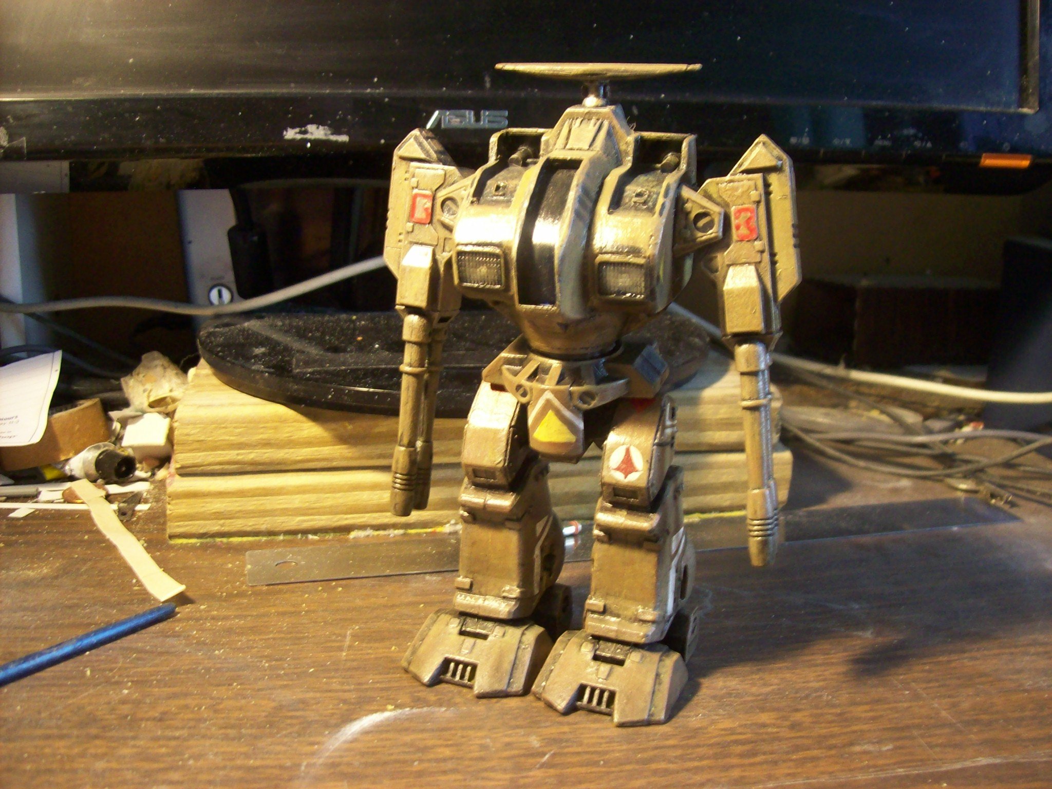

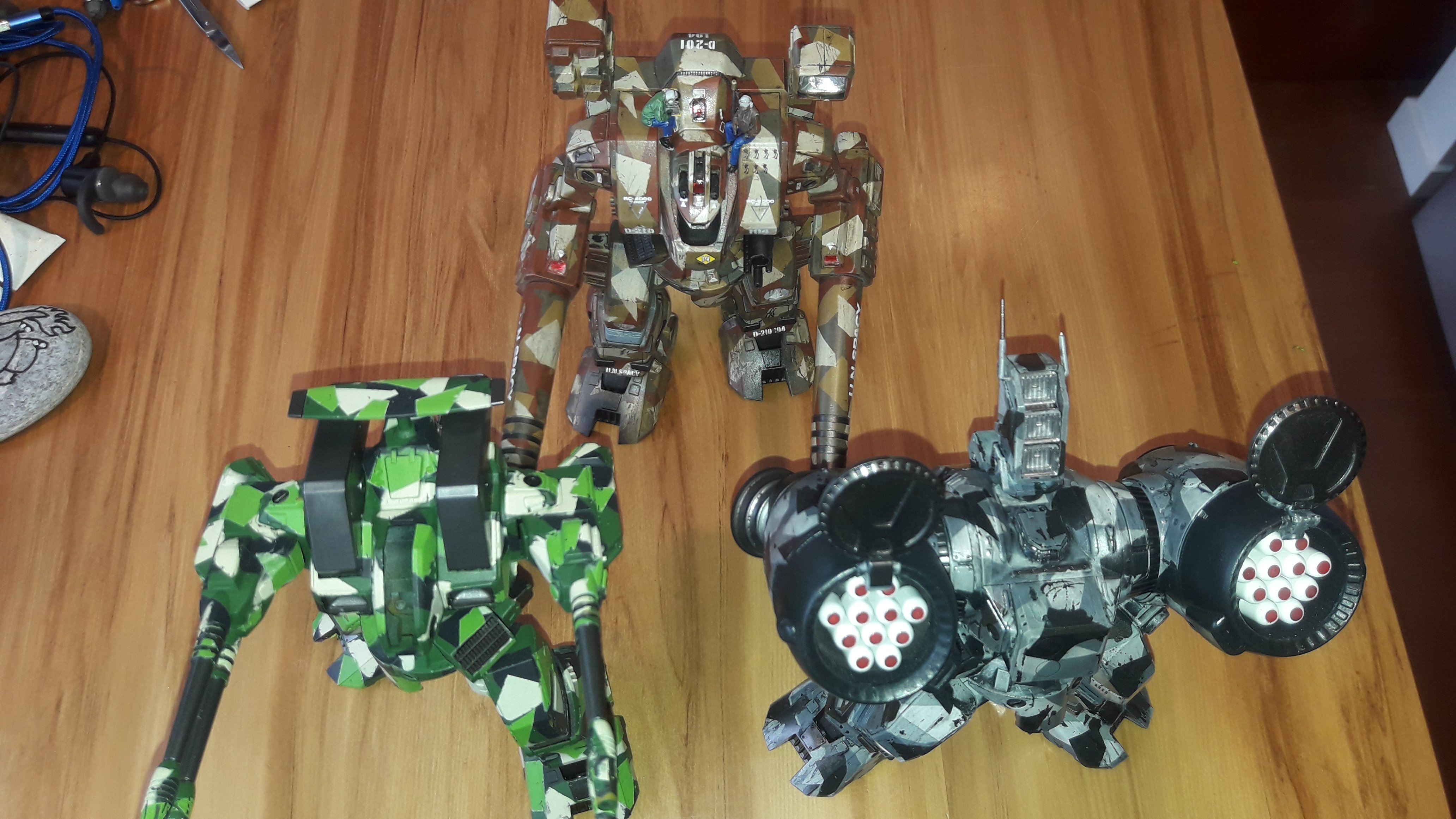

pengbuzz Posted May 31, 2020 Posted May 31, 2020 Good to see MW members helping one another out! We have an awesome fandom indeed! Speaking of destroids... UPDATE: I'm just goign to call this one "done": I weathered this one like I would a tank: with some subtle "oil dot filters" and varying shades on the hull. Also dd a couple of heavy oil sludge washes, and some heavy drybrushing. i wanted this to look like it had seen some hard service aboard the SDF-1. It now graces a spot in the maintenence hangar: And that's a wrap! Next project: figuring out what's for dinner....

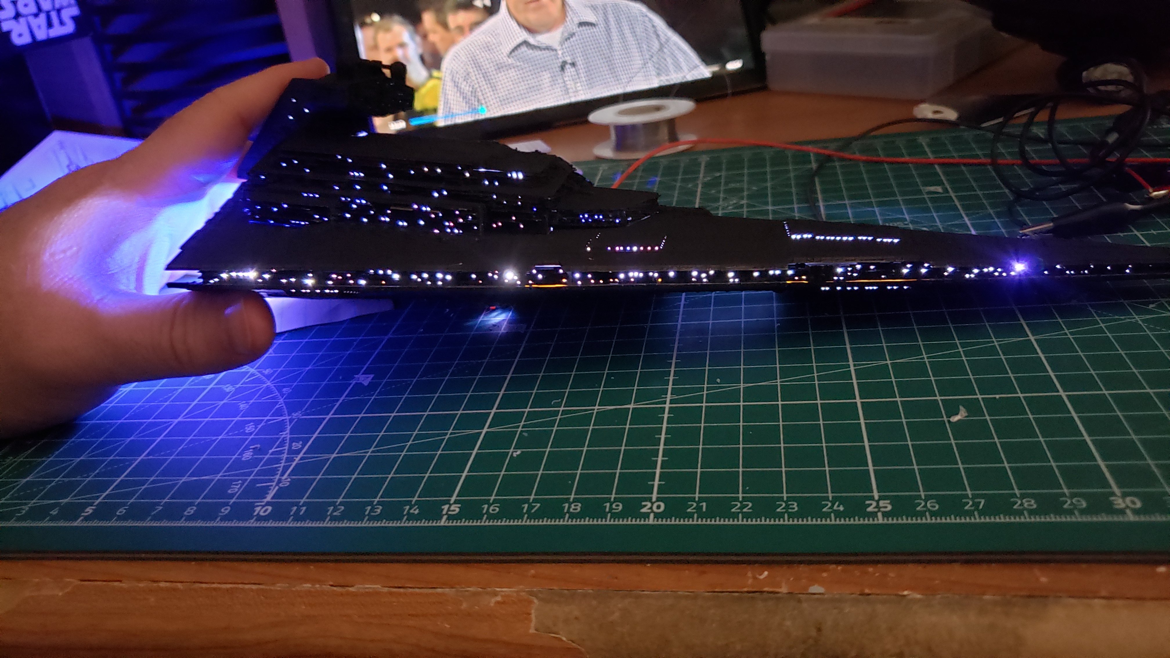

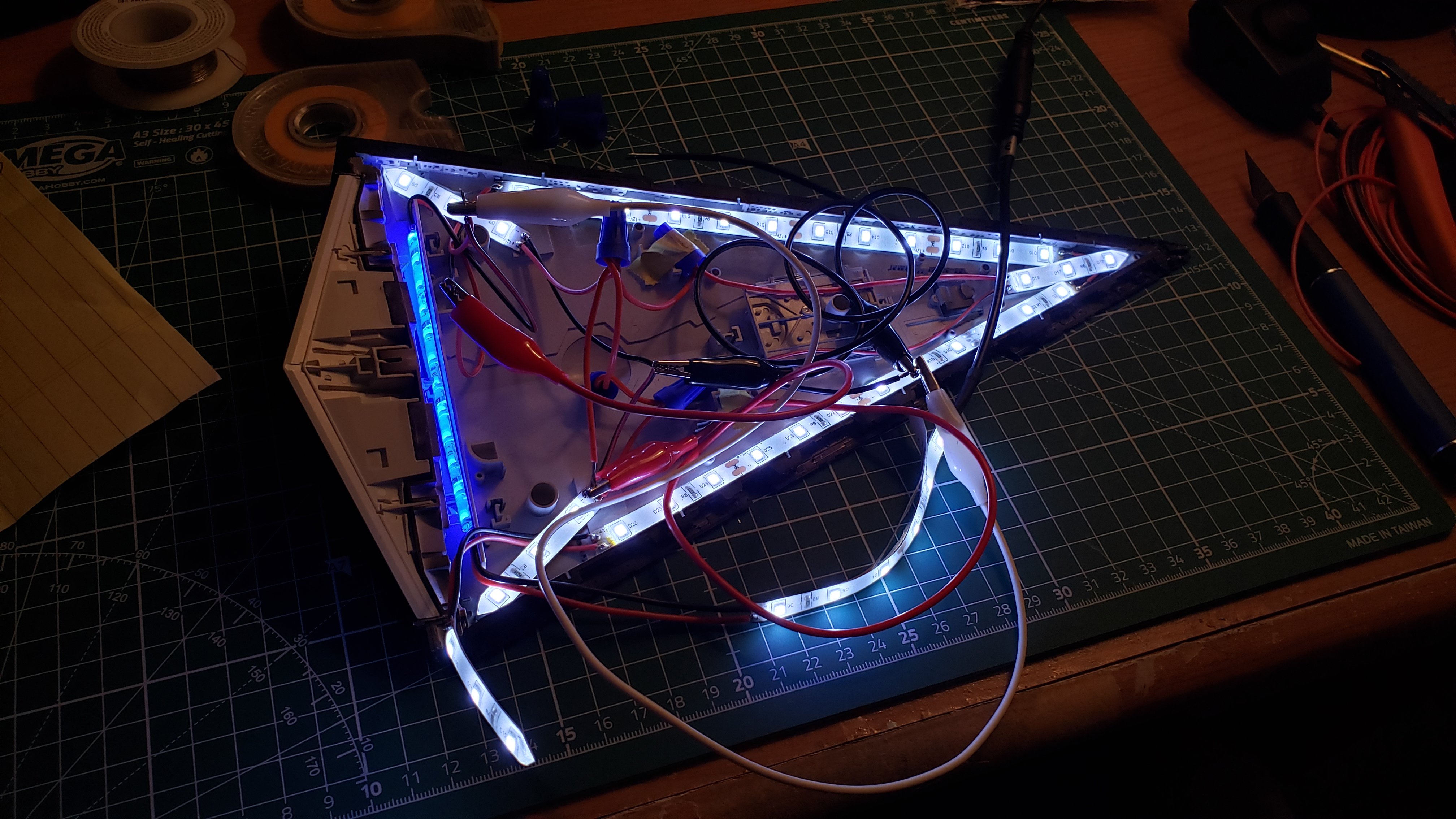

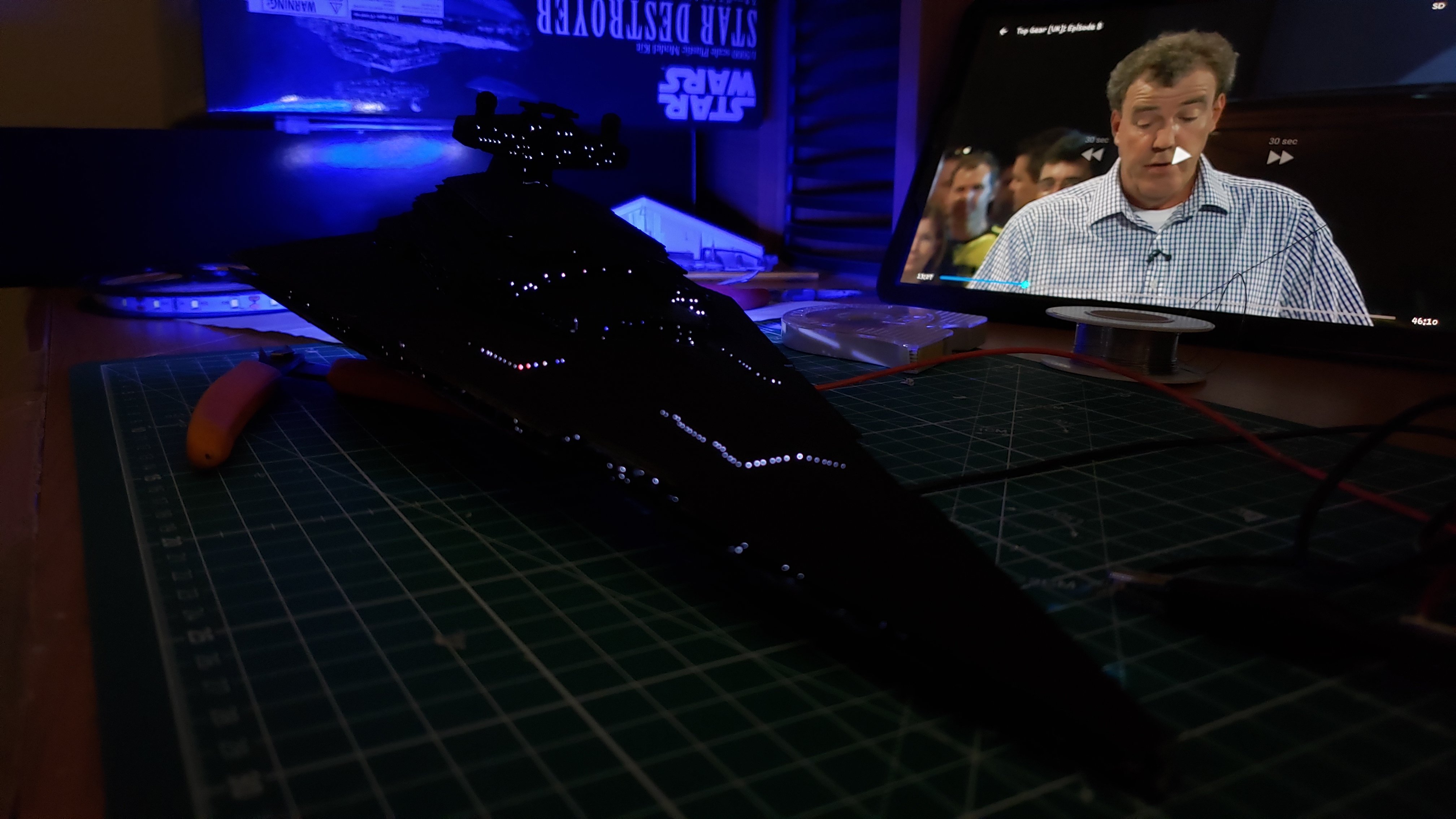

derex3592 Posted May 31, 2020 Posted May 31, 2020 (edited) Full F'N led light test today! BOOM! Edited June 1, 2020 by derex3592
