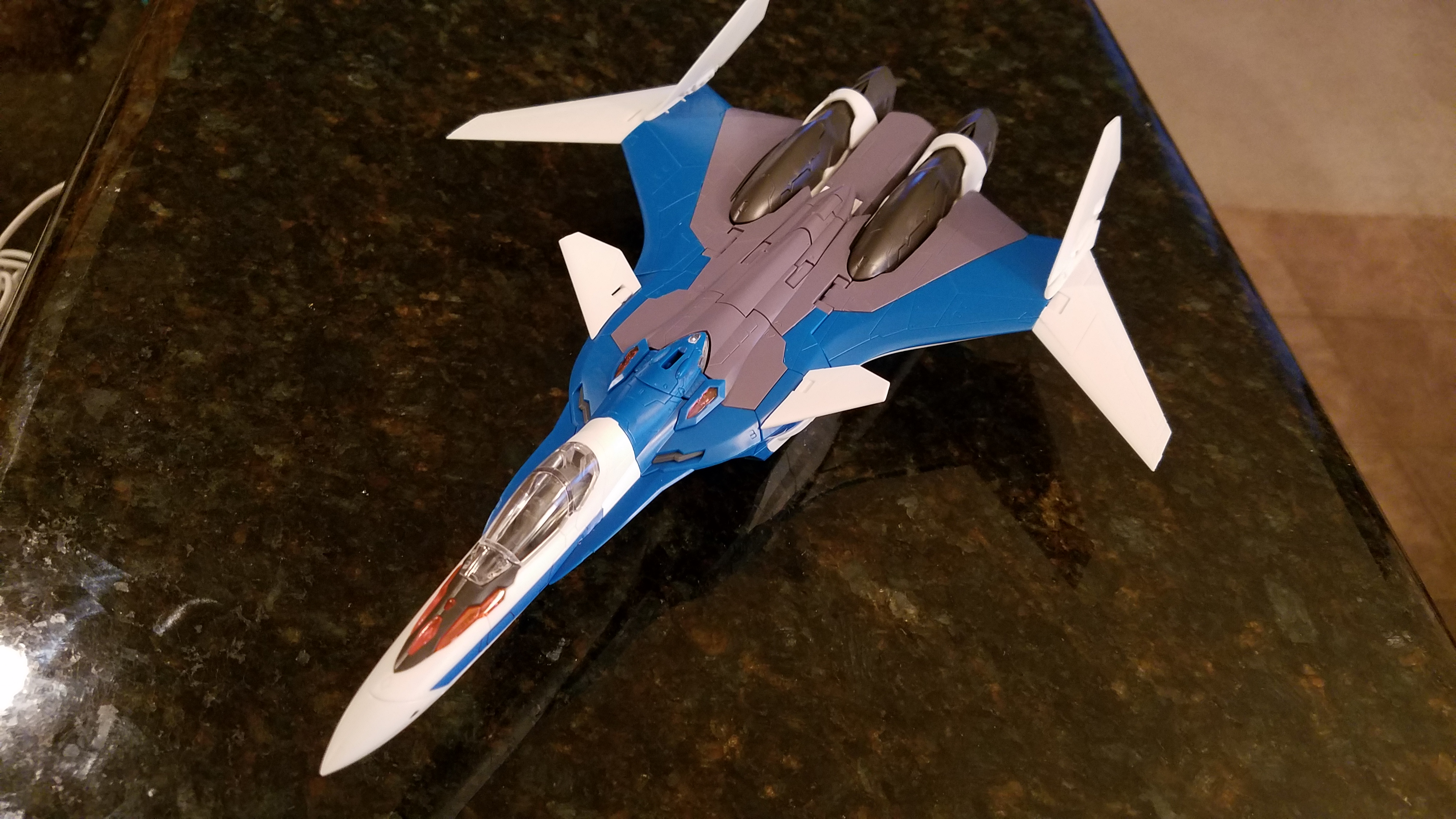

spanner Posted January 16, 2017 Posted January 16, 2017 On 1/14/2017 at 10:33 AM, derex3592 said: Finished the Vf-31 kit today. Not one drop of glue. This thing locks together SUPER tight in fighter mode. I'm amazed, you can swoosh it around and shake it, nothing rattles or pops off. I would never say it's a replacement for the DX, but for 30 bucks, it ain't bad. Don't know if I'll try a transformation or not. Maybe later, gonna ponder a cool custom paint scheme to do on it. *snipped* Awesome! and impressive that not a single drop of glue required! My son has definitely changed his mind about (not) getting one and I think the only way I'd buy one is if the VF-31A variant was available.. Perhaps I'll wait till they release it and give it a go! Has there been any mention about it?

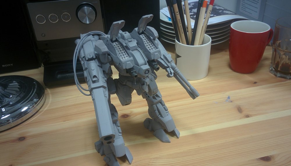

Thom Posted January 16, 2017 Posted January 16, 2017 (edited) 15 hours ago, electric indigo said: Thanks. You can see more WIP pics here: https://www.flickr.com/photos/romansland/sets/72157628135010356 Thanks for the link. Great work on that. And for just a second, I thought this was a screen-grab! Edited January 16, 2017 by Thom
NZEOD Posted January 16, 2017 Posted January 16, 2017 hahha ok... its not??? I thought it was as was amazed at how accurately the side nose panels were the the "screen" shot with the black background!

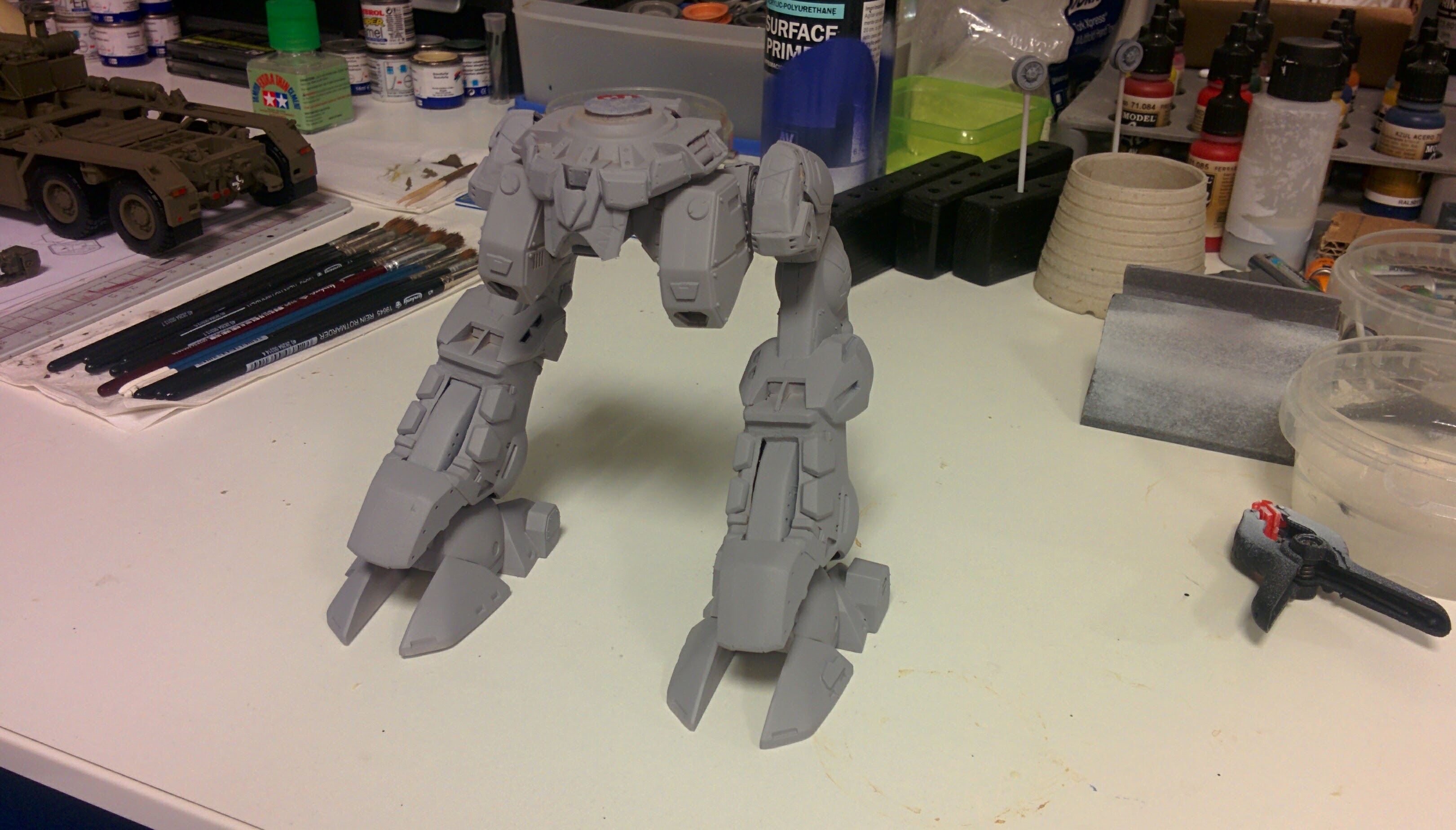

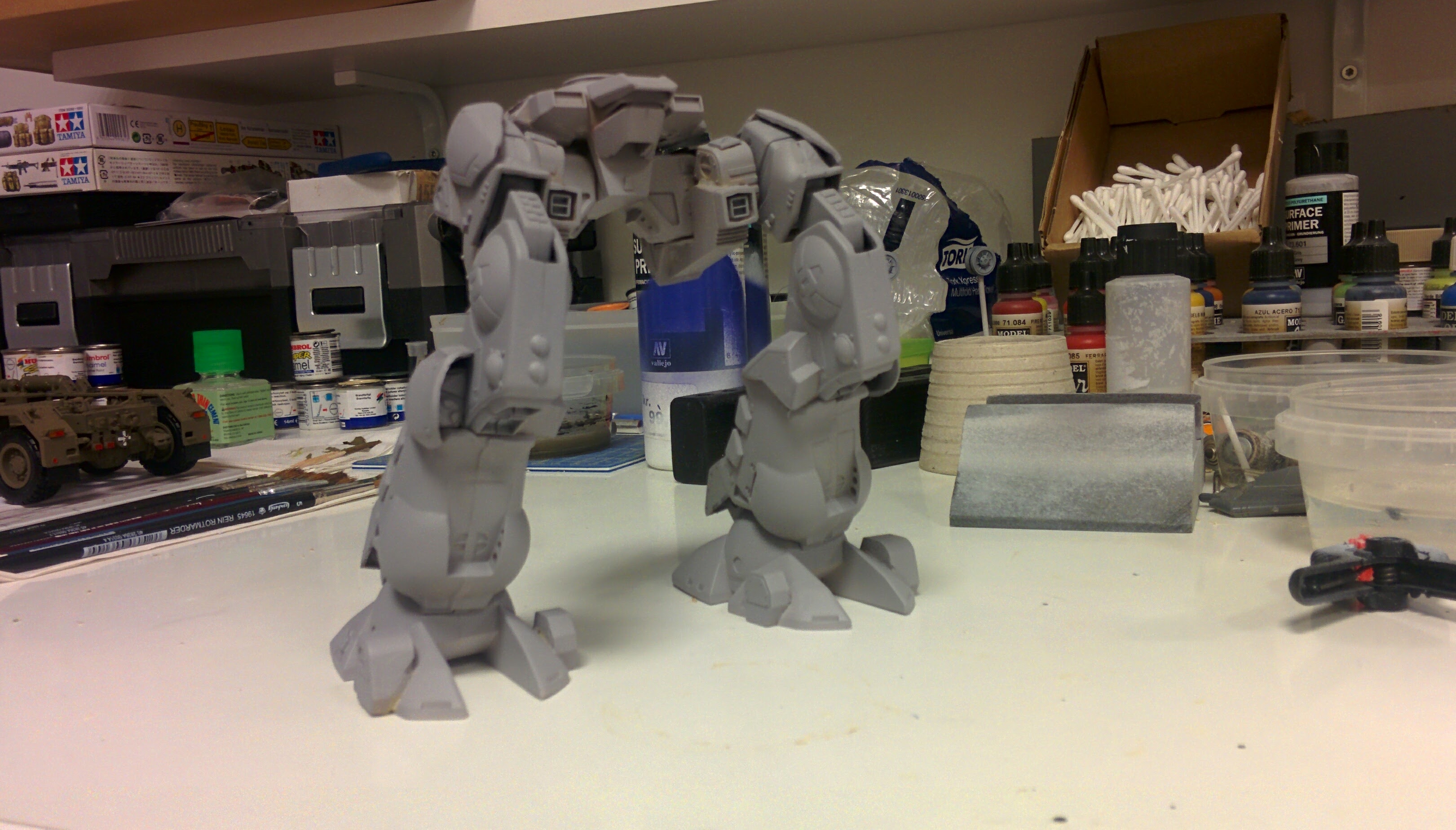

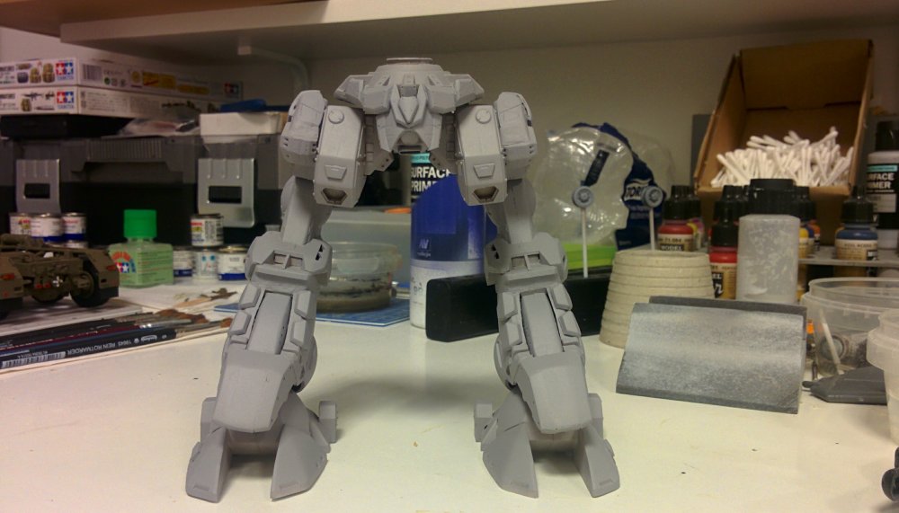

slide Posted January 18, 2017 Posted January 18, 2017 21 minutes ago, Nyankodevice said: the legs are pretty much done! They look Great!

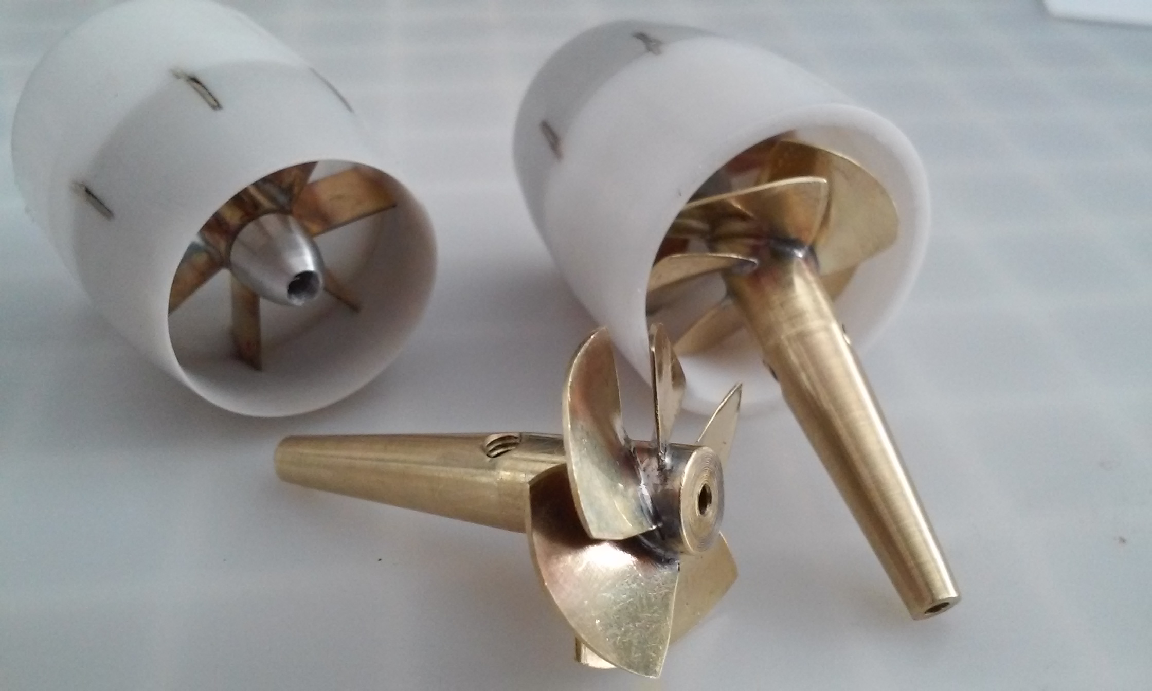

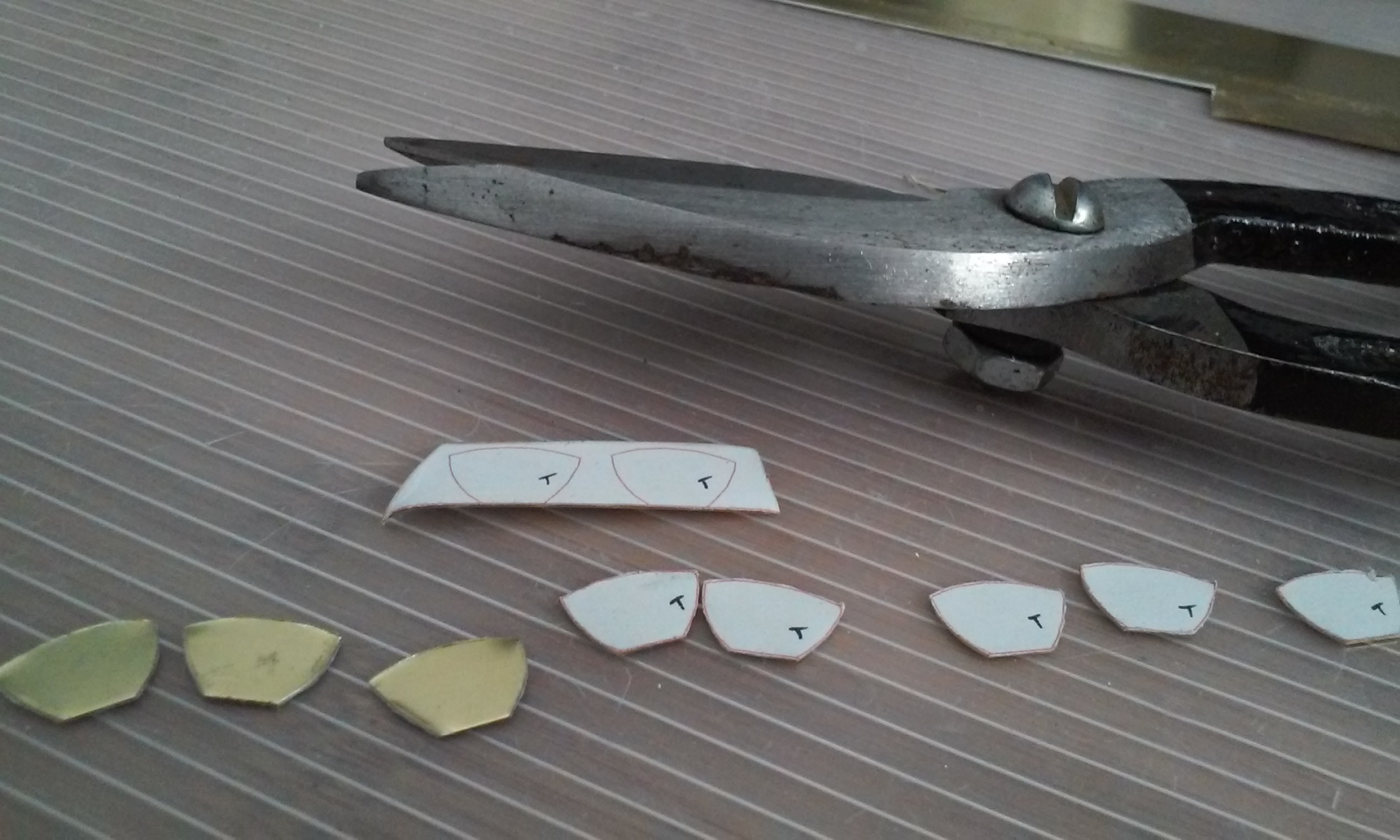

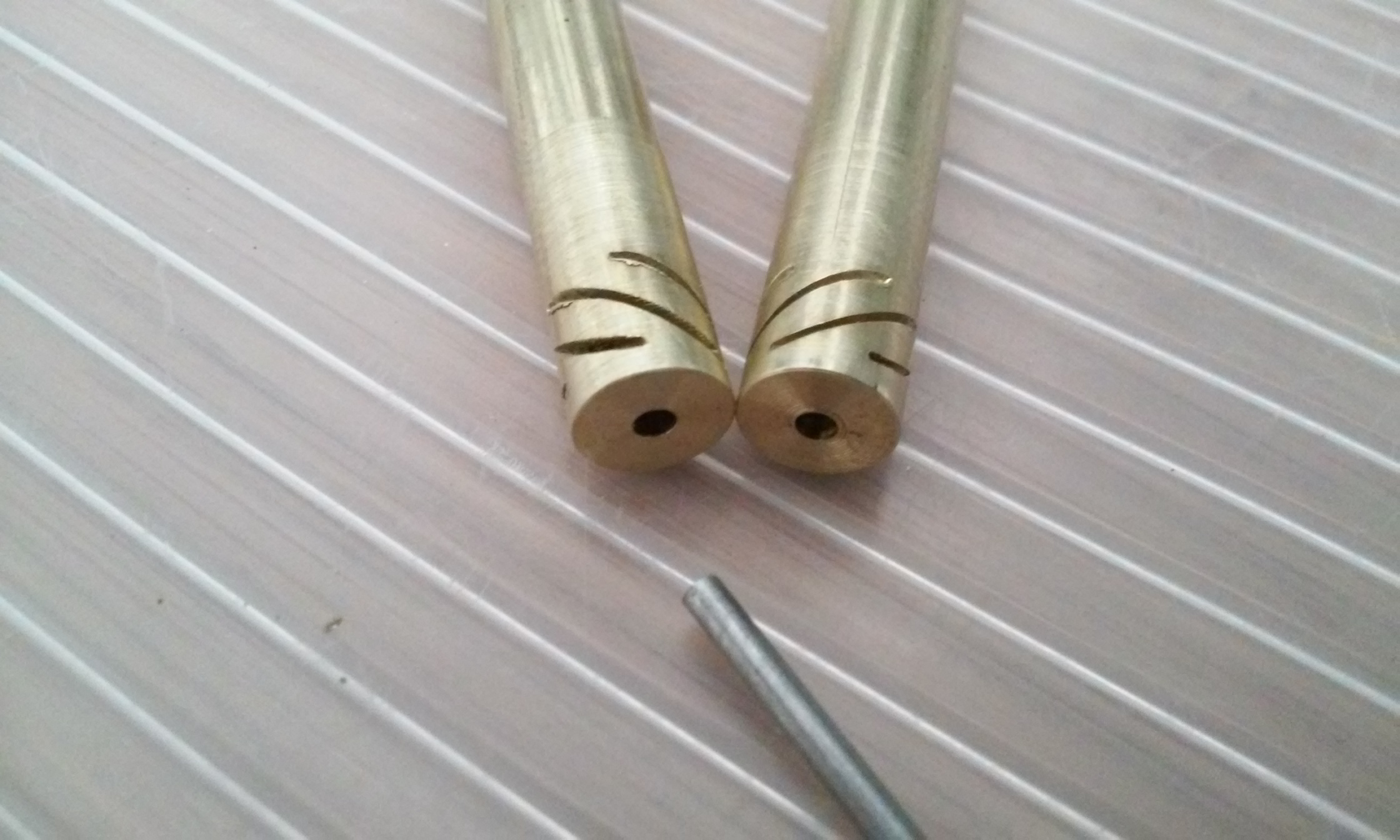

MechTech Posted January 18, 2017 Posted January 18, 2017 Great work guys, I gotta give you props, so here's two!!! First the hubs from last week slit to accept the blades at the correct angle. Then the blade template printed and pasted (rubber cement), then the blades cut and rough filed. Finally the prop hubs were turned to blend into the prop shaft and the blades were soldered, then shaped and angled with a jig. The blades have an airfoil (hydro foil) cut into the leading and trailing edges. The props and pods are ready for the prop shafts to be made now. 3mm set screws will attach them to the prop shaft. I can almost taste the water! - MT

Xigfrid Posted January 19, 2017 Posted January 19, 2017 And they even have a foil!! MT I can't imagine what you can do with 3D printers.
MechTech Posted January 19, 2017 Posted January 19, 2017 Thanks guys! I still need to get on the 3D printer band wagon. For now, it's faster to do it "old school." - MT
mickyg Posted January 19, 2017 Posted January 19, 2017 Given the amount of work you do with metal, I think a 3D printer would be most useful for you in building jigs. Still, given your penchant for engineering, I'm guessing you'd do some amazing things with one, just the same.

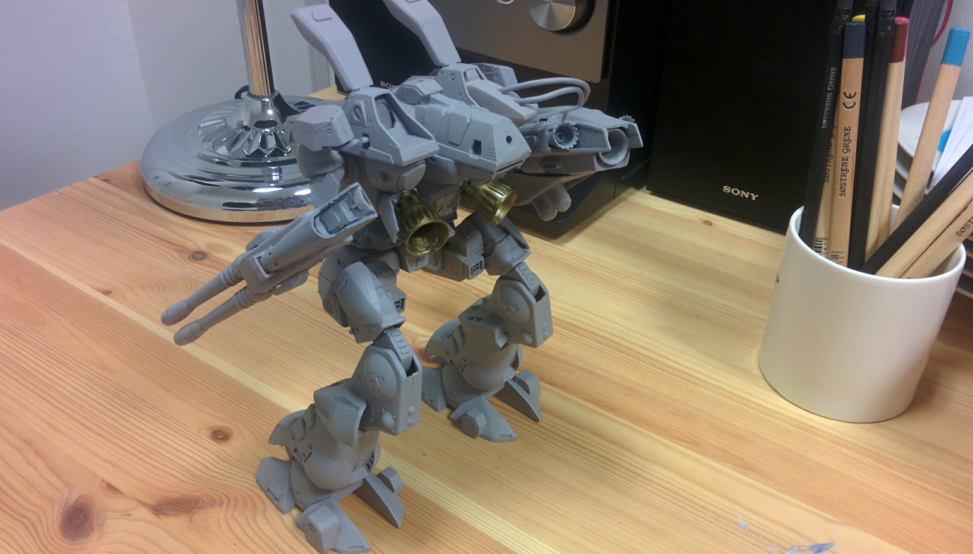

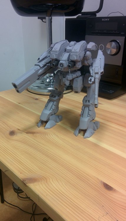

electric indigo Posted January 20, 2017 Posted January 20, 2017 Just another day at Kusanagi Motors...
arbit Posted January 20, 2017 Posted January 20, 2017 On 1/19/2017 at 3:53 AM, MechTech said: Great work guys, I gotta give you props, so here's two!!! First the hubs from last week slit to accept the blades at the correct angle. Then the blade template printed and pasted (rubber cement), then the blades cut and rough filed. Finally the prop hubs were turned to blend into the prop shaft and the blades were soldered, then shaped and angled with a jig. The blades have an airfoil (hydro foil) cut into the leading and trailing edges. The props and pods are ready for the prop shafts to be made now. 3mm set screws will attach them to the prop shaft. I can almost taste the water! - MT So how will it run? Is it going to be remote control?
MechTech Posted January 20, 2017 Posted January 20, 2017 Thanks Micky G! Cool mods Electric Indigo. Yeah Arbit, R/C. I mentioned to you before about some guy using Arduino, but he just used it to alter receiver signals. He had 3 motors and speed controls using Arduino to tell only one control to go in reverse. I"m using one brushless outrunner motor per linear jet. I have two sticks coupled together and two speed controls so I won't need all that extra aggravation. - MT

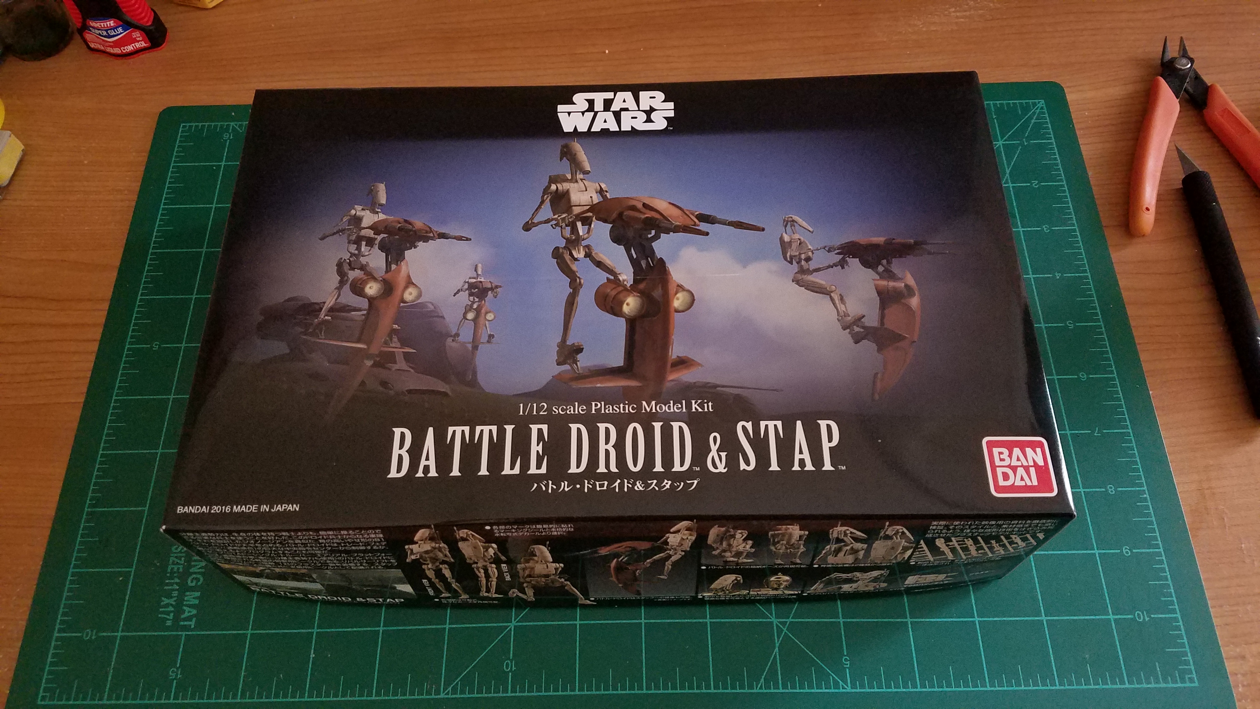

derex3592 Posted January 21, 2017 Posted January 21, 2017 Some prequel love!!! i always had a soft spot for the poor battle droids... the Jedi just went through them like butter.. LOL

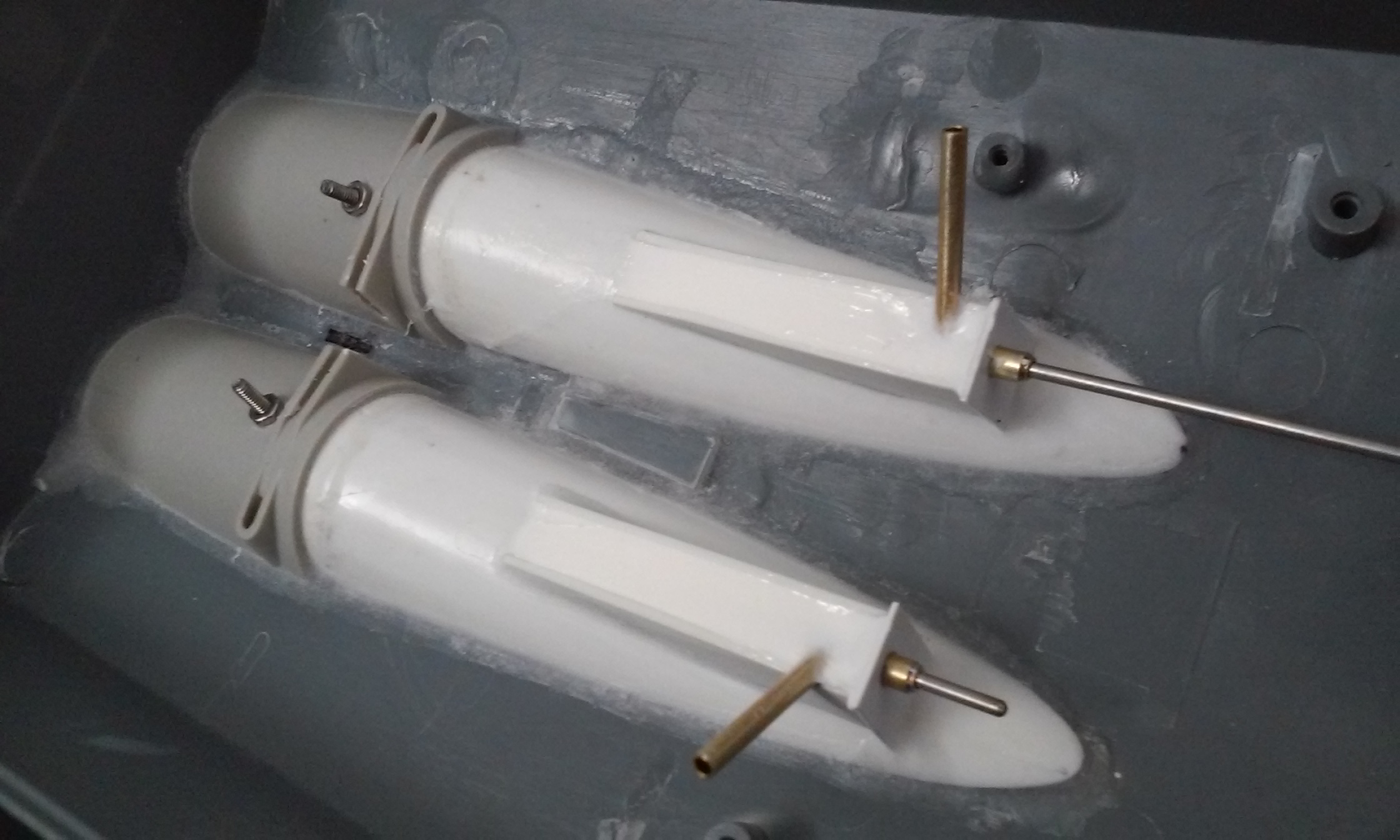

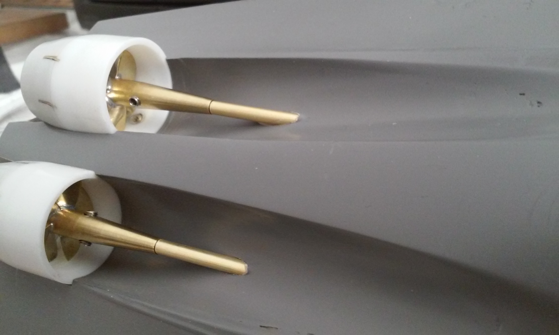

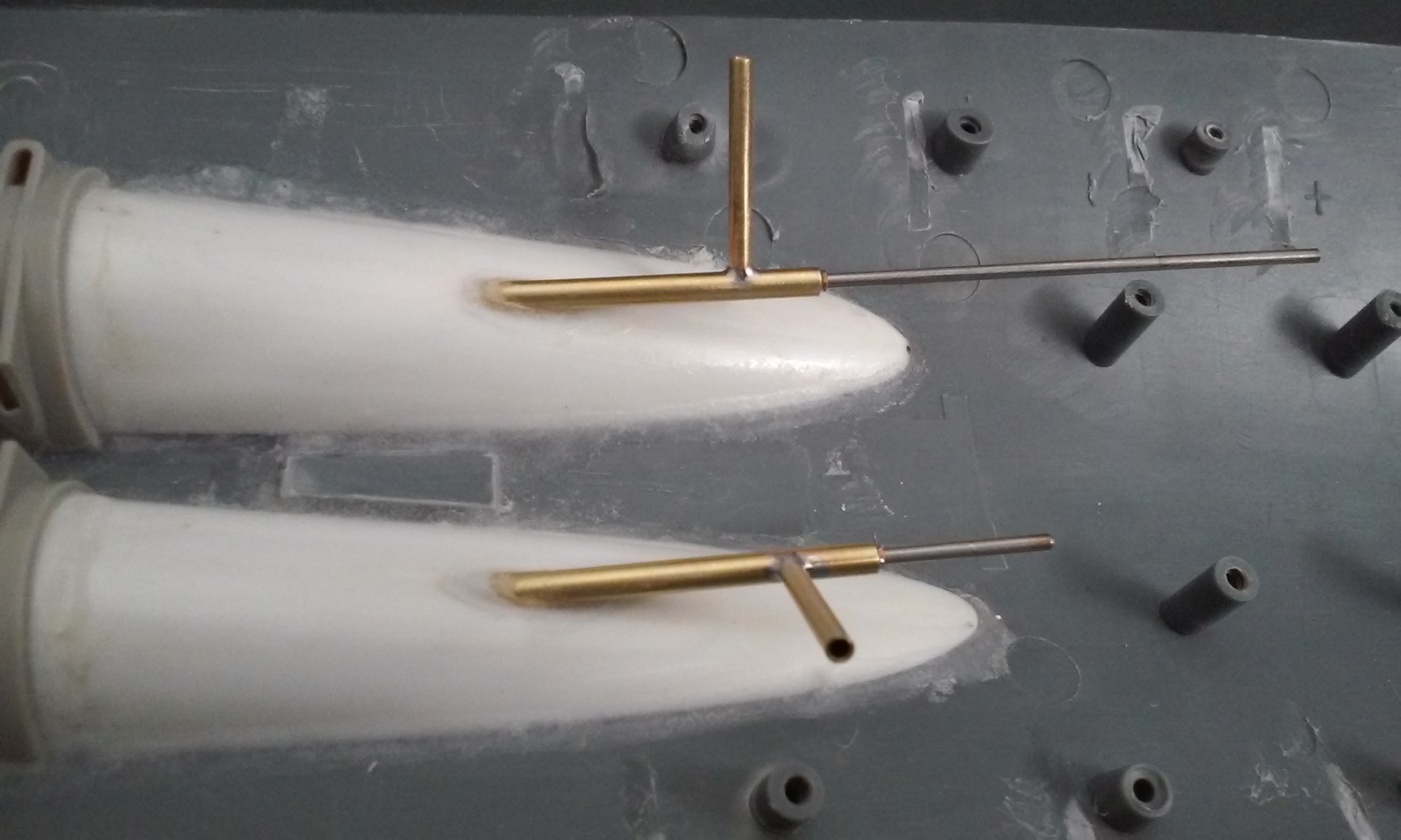

MechTech Posted January 22, 2017 Posted January 22, 2017 Nice effects Lt Zombie; styrene guts n all! @NZEOD - "Men, blow up the Scentsy box - it has to go!" My model got shafted, er ah shafts - dual prop shafts. The prop shafts are now are installed. I built boxes around them and poured silicone RTV into them as a water seal and to absorb vibration helping keep them quiet. In the last photo you can see how the props blend nicely into the prop shafts. Still need to shape the protruding rims of the nacelles. The grub screws will also be ground down so they are flush on the props. - MT

NZEOD Posted January 22, 2017 Posted January 22, 2017 (edited) How have you sealing the rotating shafts against the shaft holder tubes? Lots of grease or oil down the side feed tube? Edited January 22, 2017 by NZEOD

MechTech Posted January 23, 2017 Posted January 23, 2017 (edited) Cool NZEOD! I'm looking forward to a video or something. By the way, we love Weatabix! The pipes are filled with oil or grease. I've never had one leak on me yet. The shaft sits in a bearing which sits in a tube. The space is filled with grease / oil and seals it off while lubricating the bearings. Going for motor mounts and connectors today. - MT Edited January 23, 2017 by MechTech

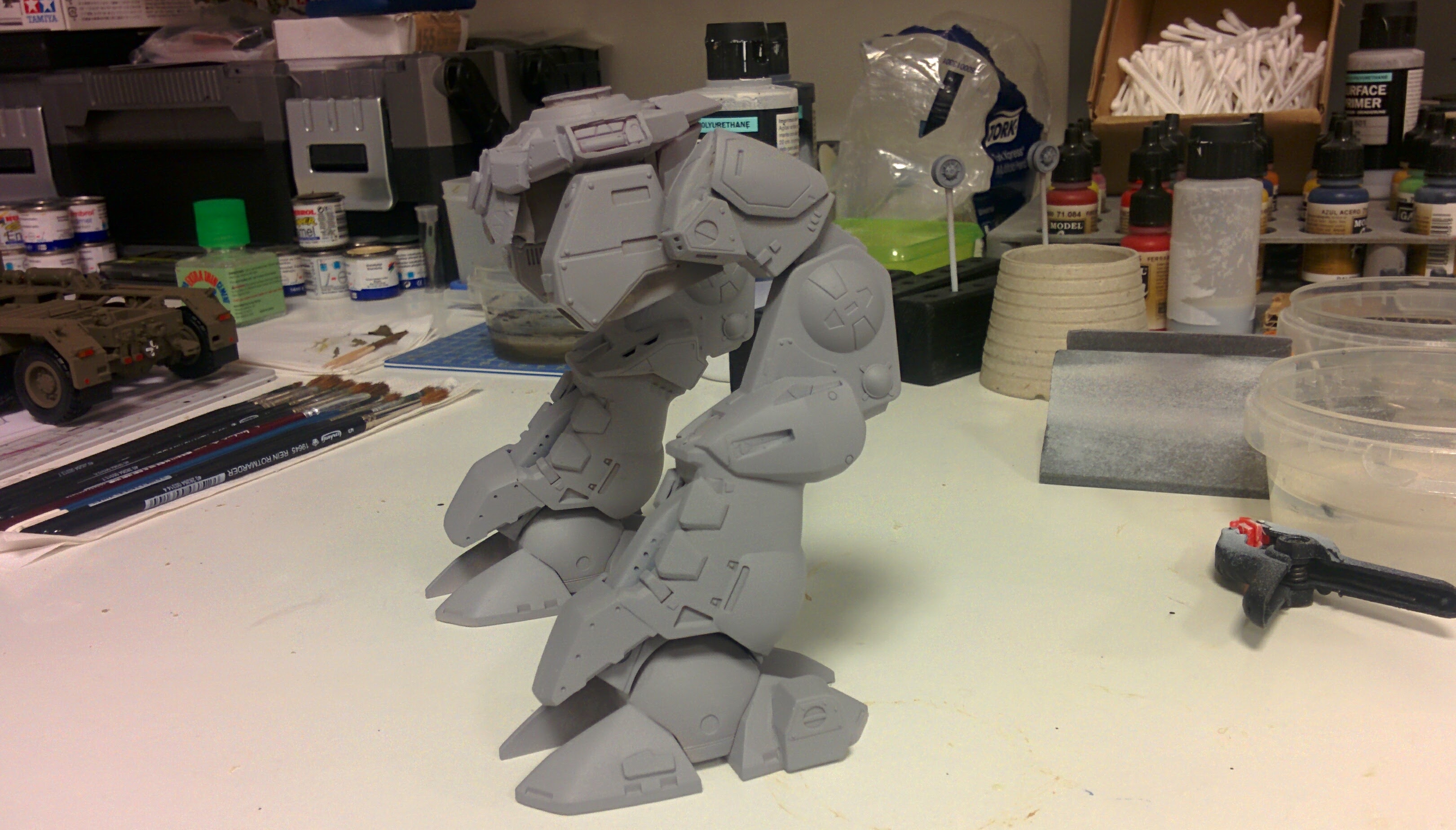

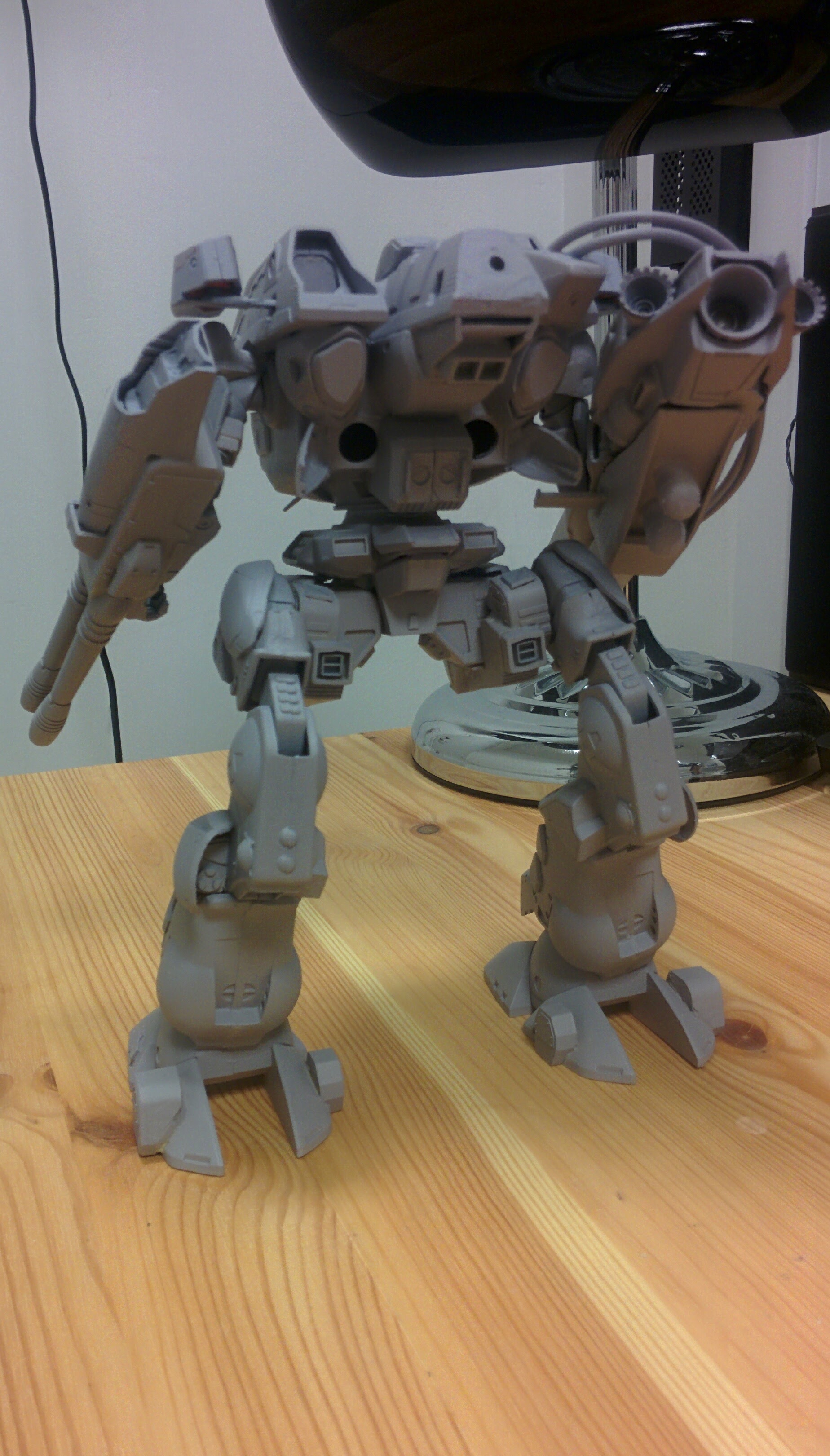

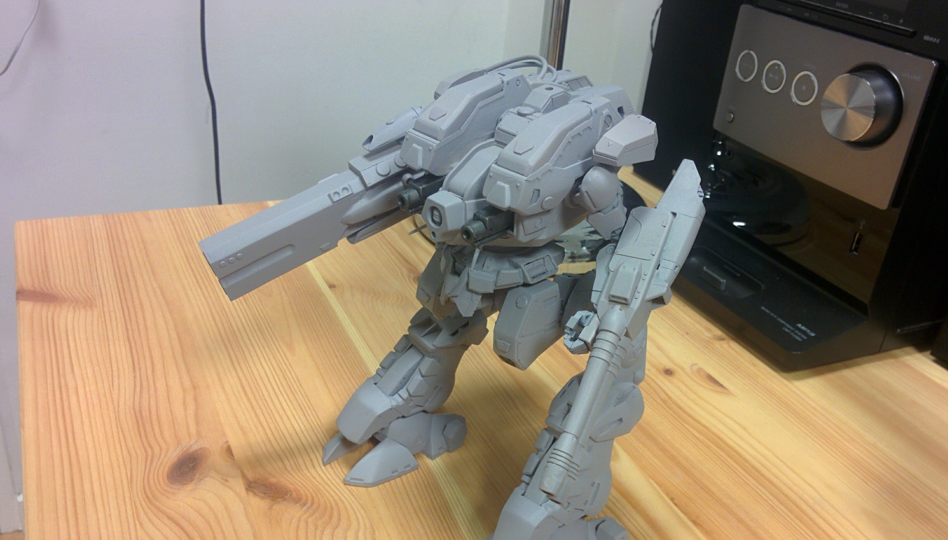

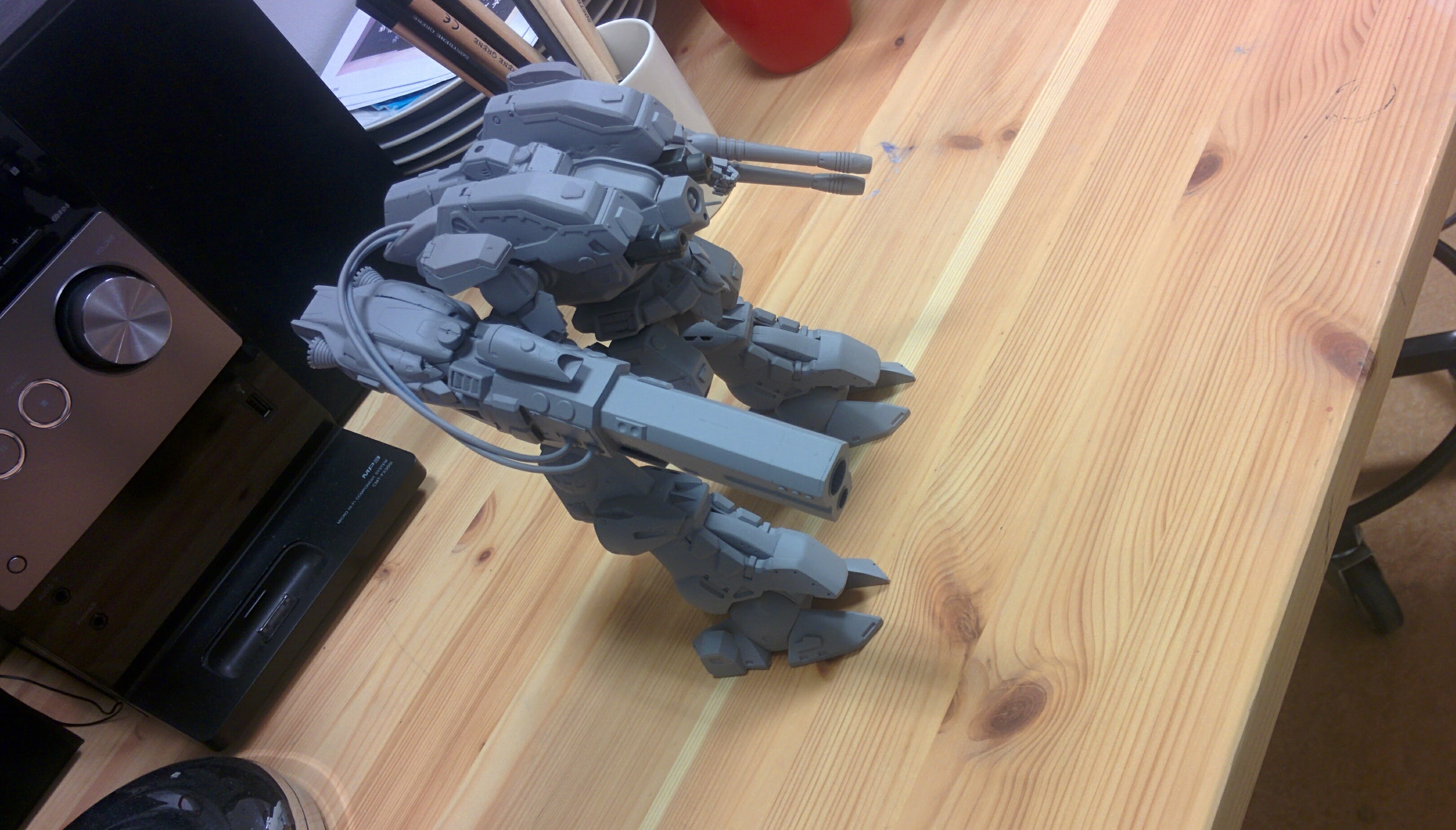

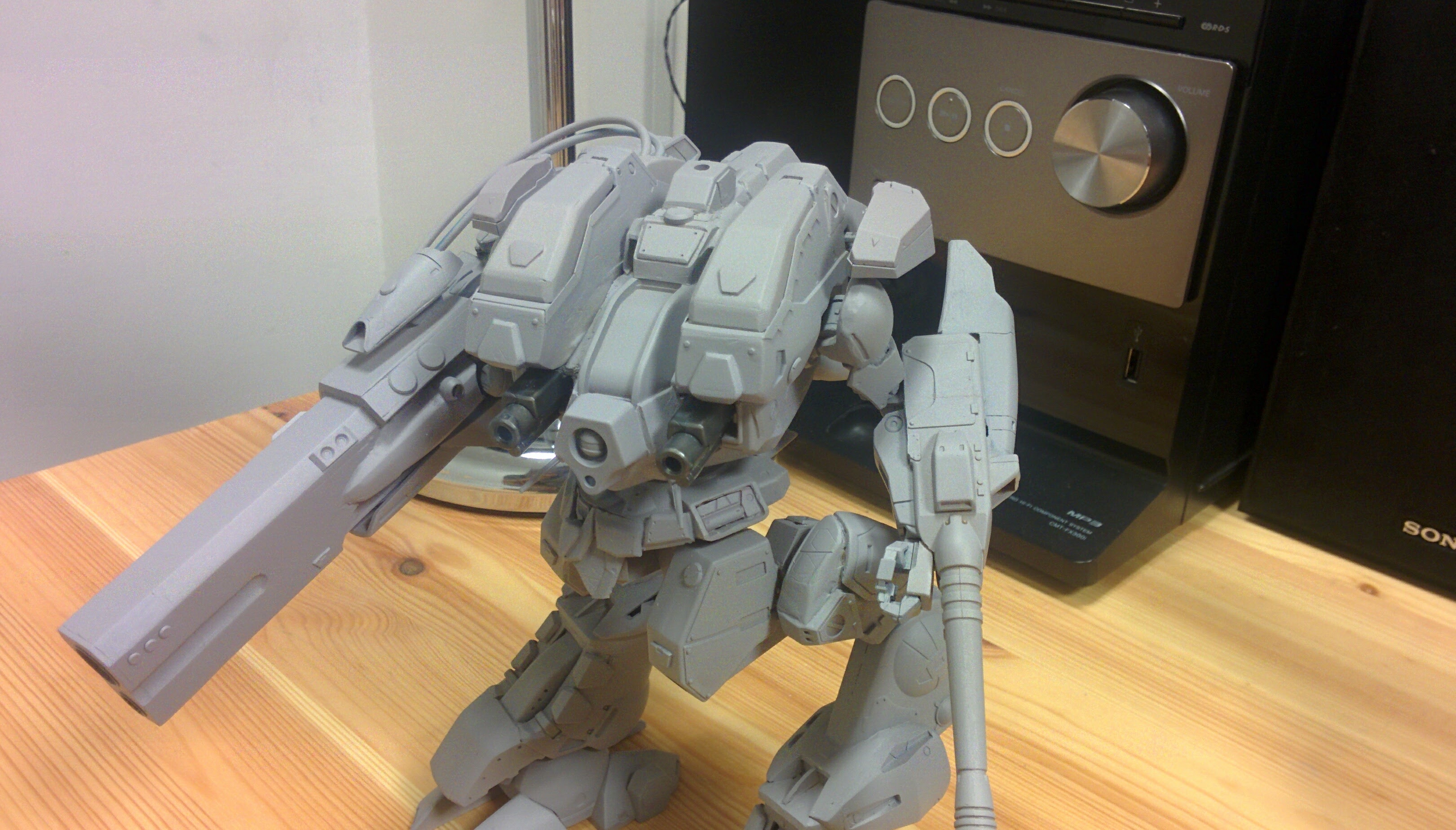

Nyankodevice Posted January 23, 2017 Posted January 23, 2017 well its almost there, i still need to make a battle scanner/ radar suite
