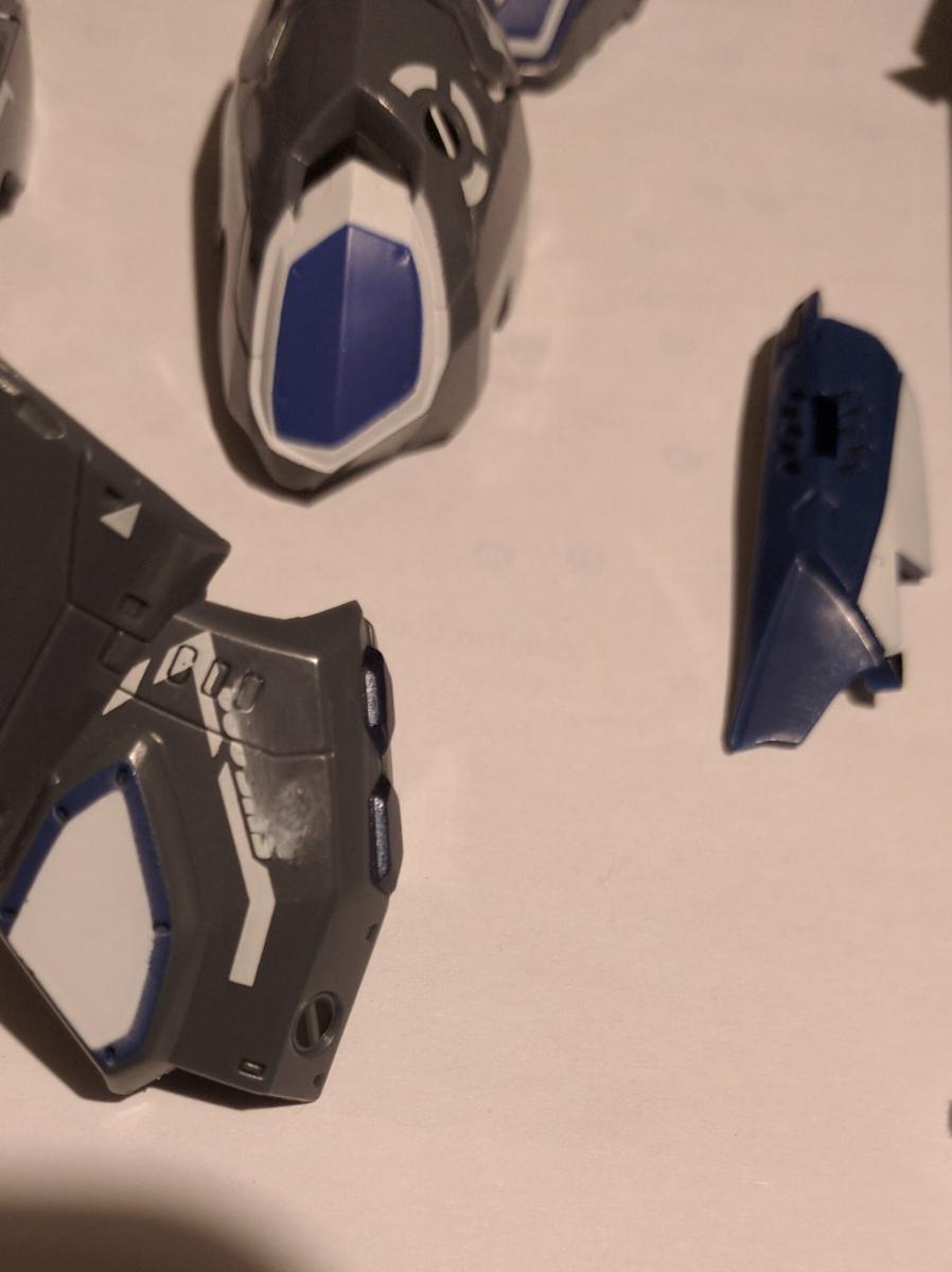

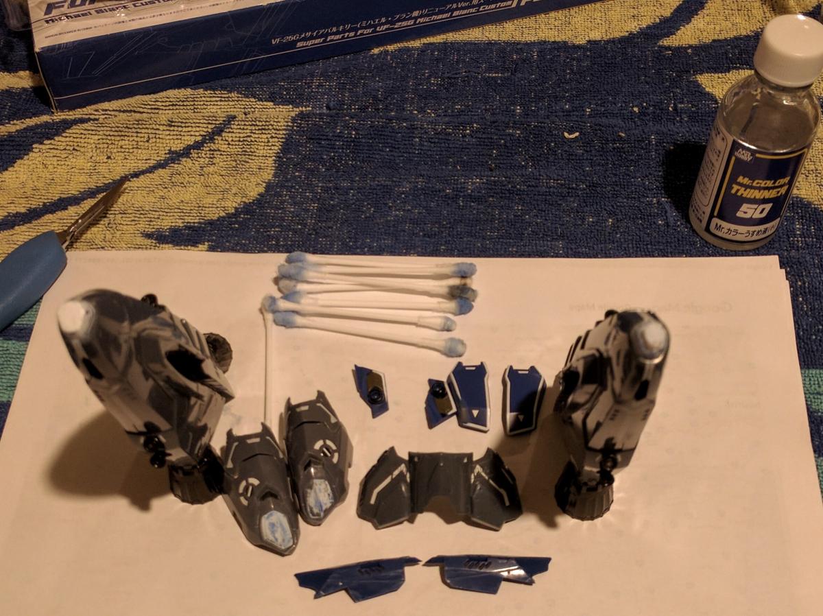

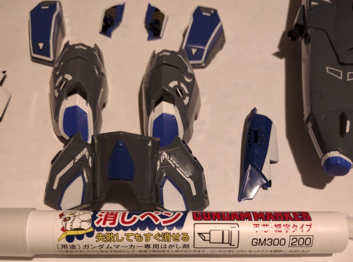

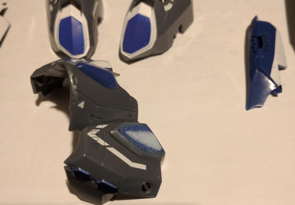

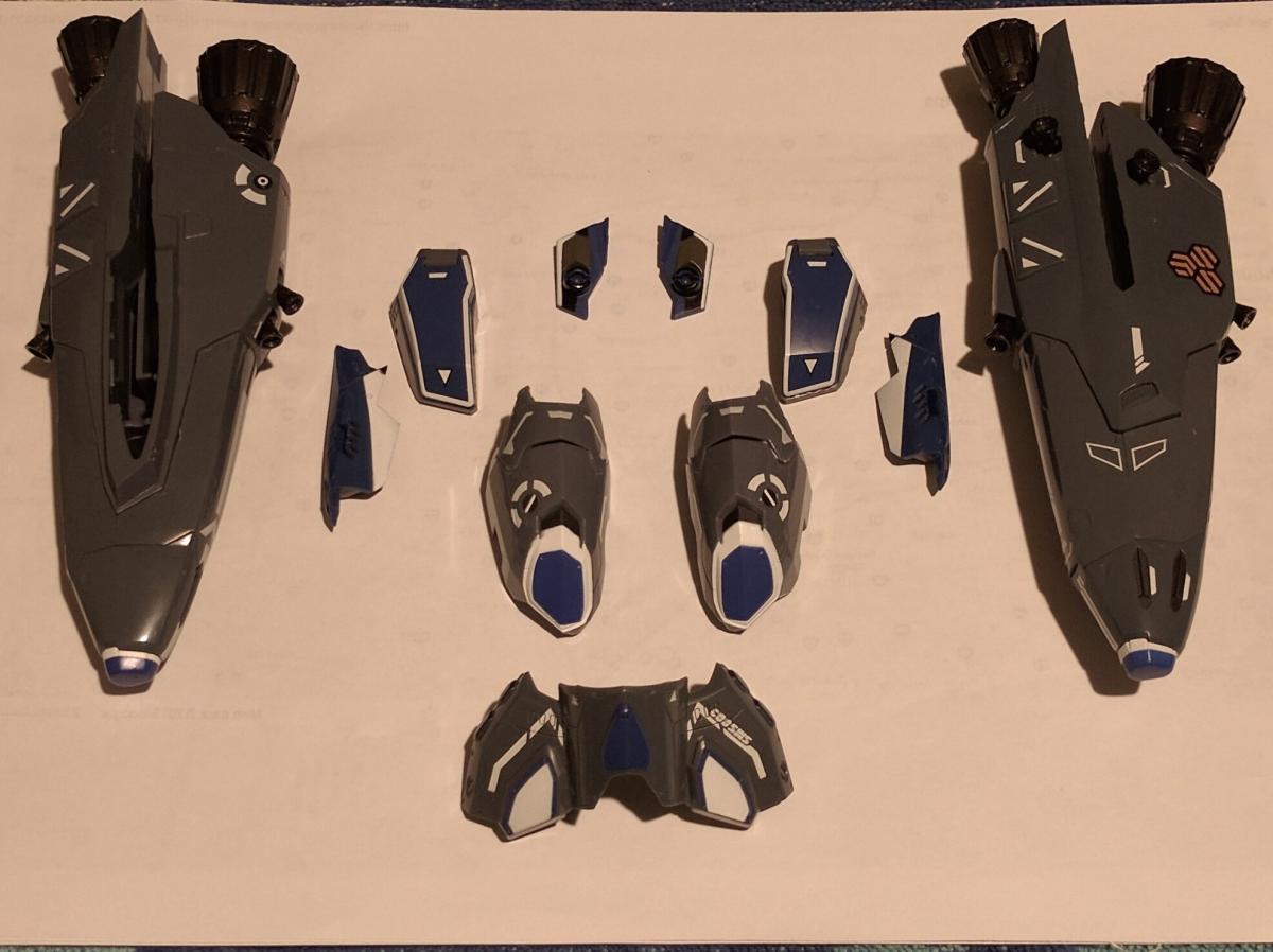

mickyg Posted November 8, 2016 Posted November 8, 2016 (edited) Have had a number of things "on the bench" lately but mostly non-Macross. Been working on some home theatre speakers mostly. But last night, finally had a chance to start working on some Macross stuff and pulled my VF-25G Super Packs out of the closet. Given how outrageously expensive Alto's Super pack is on the second hand market, I decided to modify my second set of Michael parts to suit. The plan is to strip the blue and white paint, where necessary, change the numbers from 003 to 007, and repaint the red, black, white scheme. I discovered by accident recently, that good old Gundam Marker eraser will strip the stock Bandai paint quite easily. I think this is mostly alcohol in these pens but there may be other solvents as well. Either way, it does the job very nicely. And note to customizers out there, don't use the eraser pen to clean up any Gundam marker mistakes, unless it's over plain plastic. You'll end up with a nasty surprise. Here are a few pics of the process (apologies for the horrendous white balance. I couldn't fully correct it without rendering the blue as a horrible gray instead): These are the parts I'll be modifying (not pictured are the leg armor with the 003 to be removed) First swipe with the gundam marker remover The marker remover Working on the blue parts And a group shot, post paint removal (along with the cotton swabs I used to get it all done). I switched to Gunze lacquer thinner for a few of the more stubborn areas. This worked a little bit faster but if all you've got is Gundam eraser, the added hotness of the lacquer wasn't really that big of a difference. Some observations on the process so far: Anywhere there's blue paint, it's undercoated with white first This makes paint removal messy, with a cloudy slurry leaking into the panel lines that you really have to be careful about The paint apps are messy from the factory, but not everywhere. Those hip covers are particularly bad and I'll be happy to make them a lot neater during my repaint. There's no need to completely remove the white paint in some places. I'll have to undercoat the red anyway so I have left it in some places. Hopefully it adds to the look of weathering. The shoulder missile mounts are molded in blue. This will have to be painted white. I hate painting white, especially over a dark blue. I see no need to completely remove the blue from the shoulder missile covers. I plan to mask over the white triangle and other white mark to preserve them, then paint a white undercoat, followed by the red. The paint will be thick as a result but hopefully not too noticeable. The replacement 007 markings will come from either the Bandai transformable kit or the Hasegawa Super Messiah kit. The size difference between 1/72 and 1/60 is negligible. Edited November 8, 2016 by mickyg

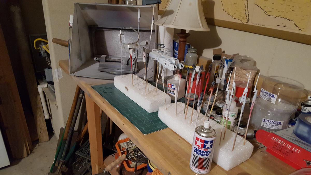

derex3592 Posted November 9, 2016 Posted November 9, 2016 Slowly sanding and priming the rest of the SDF-1 kit... slowly but surely so I don't screw up any other parts. I hate this part.. doesn't ever feel like I'm making progress on seam lines on these old kits.
